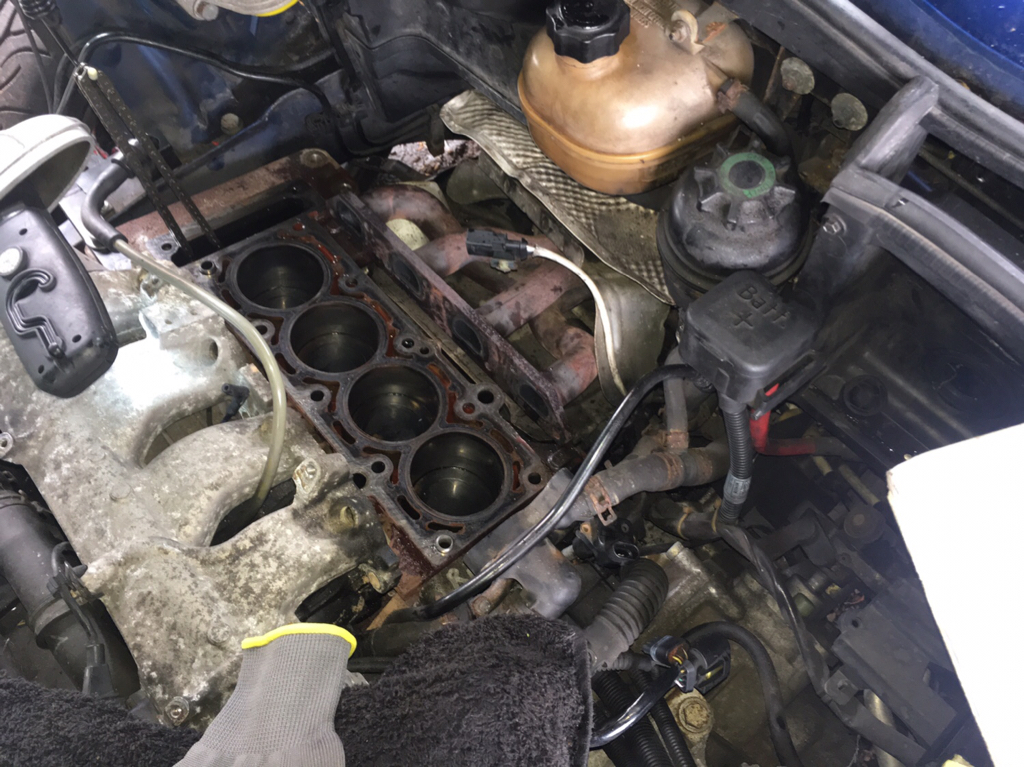

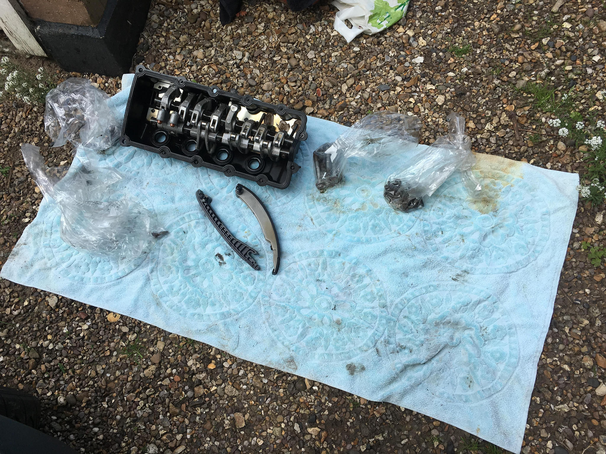

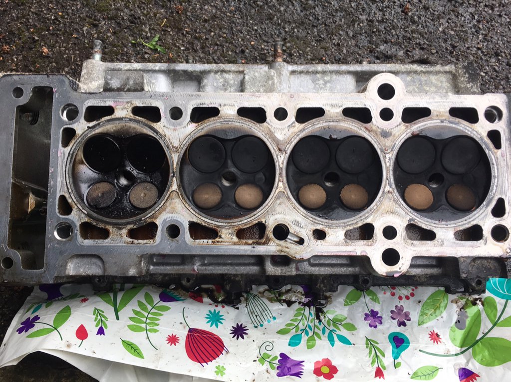

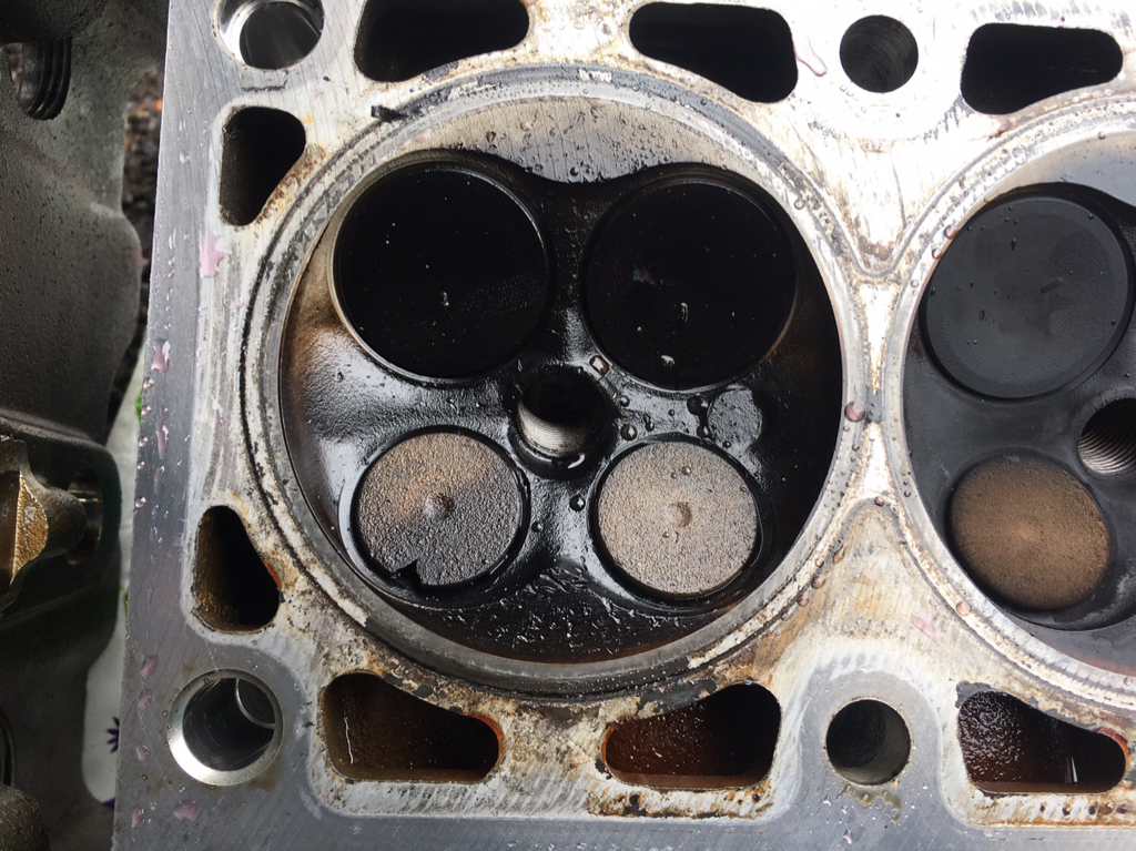

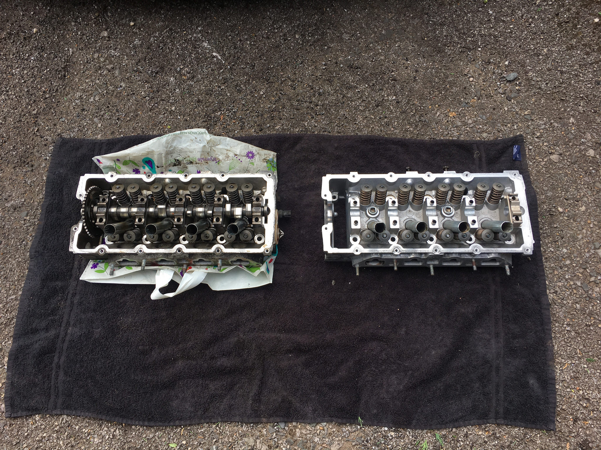

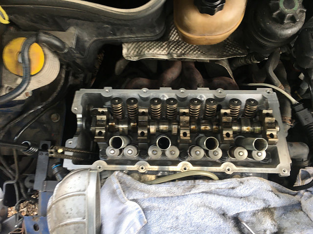

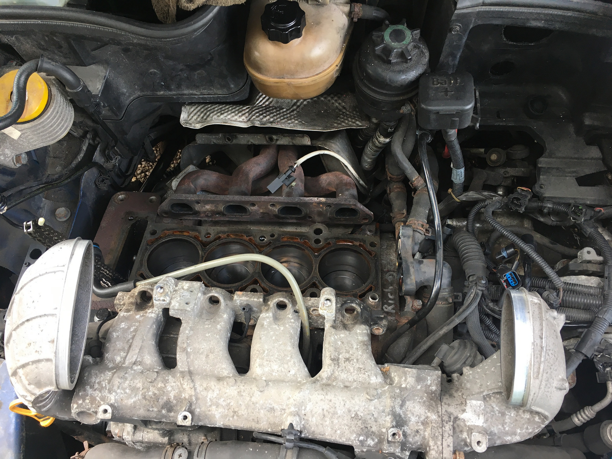

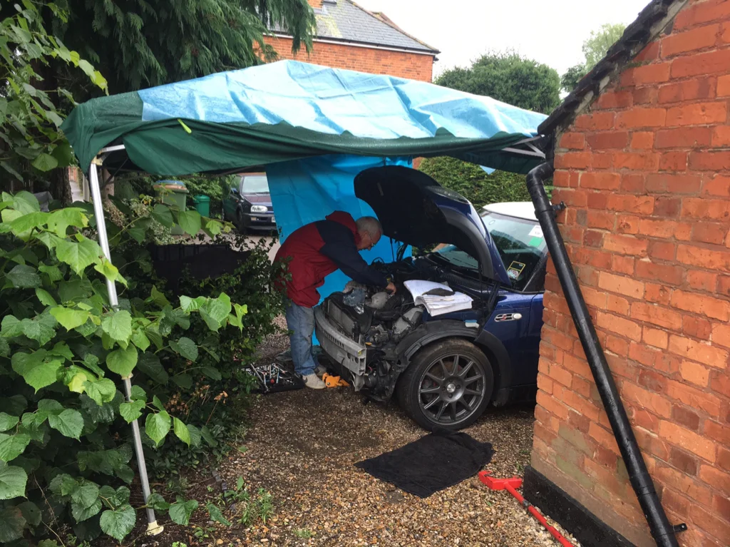

This weekend Sarah's dad came over & we took the head off the Mini, in the pi55ing rain. Rather surprisingly, the pistons are all fine, bar a few tiny indents from when it ate the spark plugs, its simply got a dead exhaust valve on cylinder 1. Probably something to do with the spark plug tips falling off after the map/fuel problems i had previously no doubt! I've got a refurbished standard head to go on, so will be putting that on shortly.
As an aside, despite my fear of the unknown & the potential difficulty involved, taking the head off was surprisingly easy with the correct tools/Bentley manual. Perhaps i bought the 182 a little early 🙈

So are you rebuilding it then getting it mapped properly so that it doesn't eat plugs this time?
In effect, the map was slightly off the first time as the s/c belt that Lohen had fitted was wrong prior to its initial map back in 2010, so when i fitted the proper belt & went on track, the boost was too high & the fueling not enough (poor explanation, but there or there abouts). This was then sorted by 1320. Second time round MSV had dead fuel in their tank - the car is mapped for VPower and what i put in onsite was NoPower. They dipped it and refunded me the cost of the trackday (no admission of liability though obviously). So my assumption is that once i've plonked the new head on, all will be fine again.
Mr Trailer Man
In theory it should be ok yeah, but i'd get it dyno'd at least so they can check the AFR's.

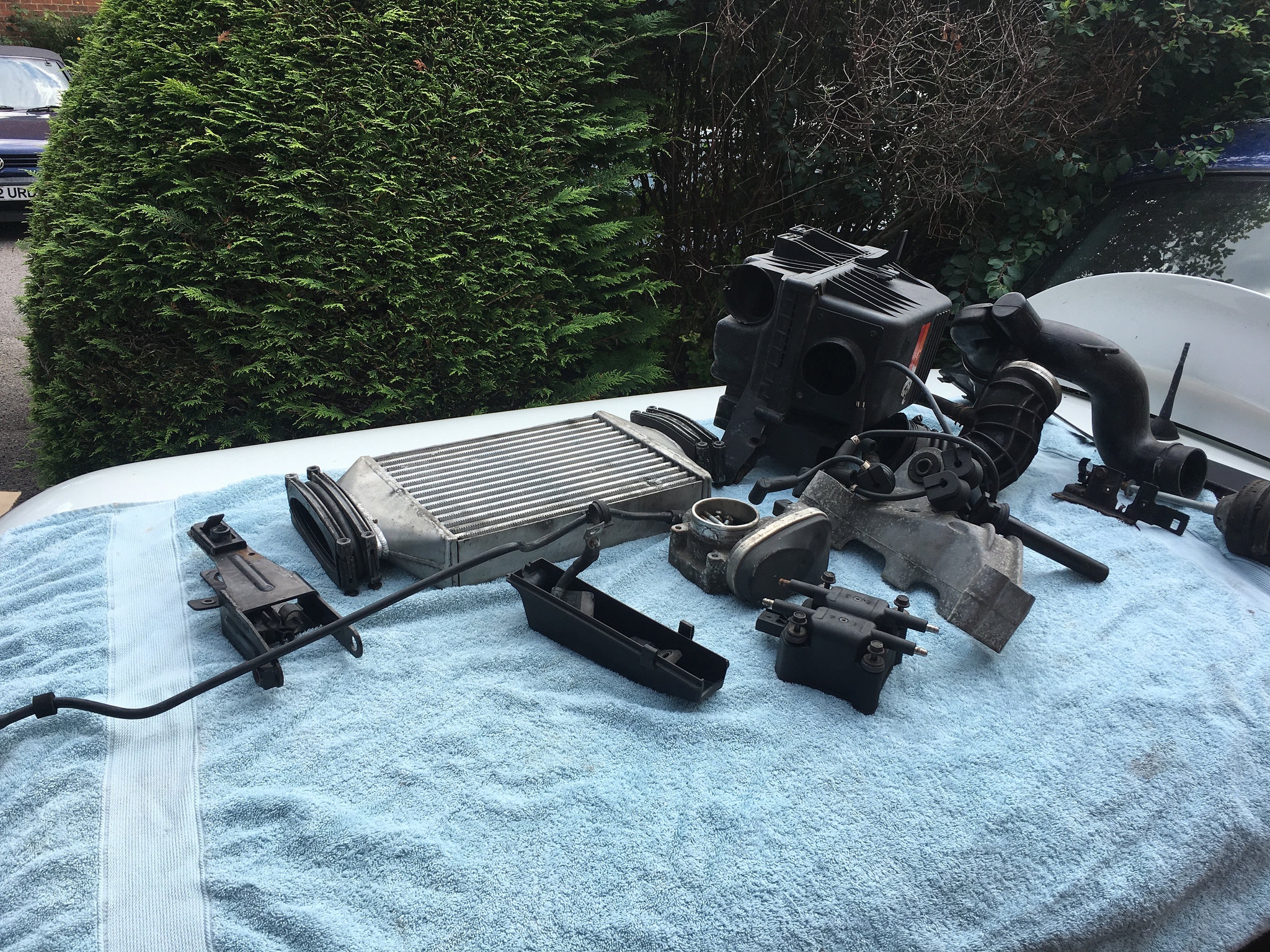

Started by getting everything together in some kind of organised chaos:
Untitled
by Sir_Dave, on Flickr
Untitled
Untitled

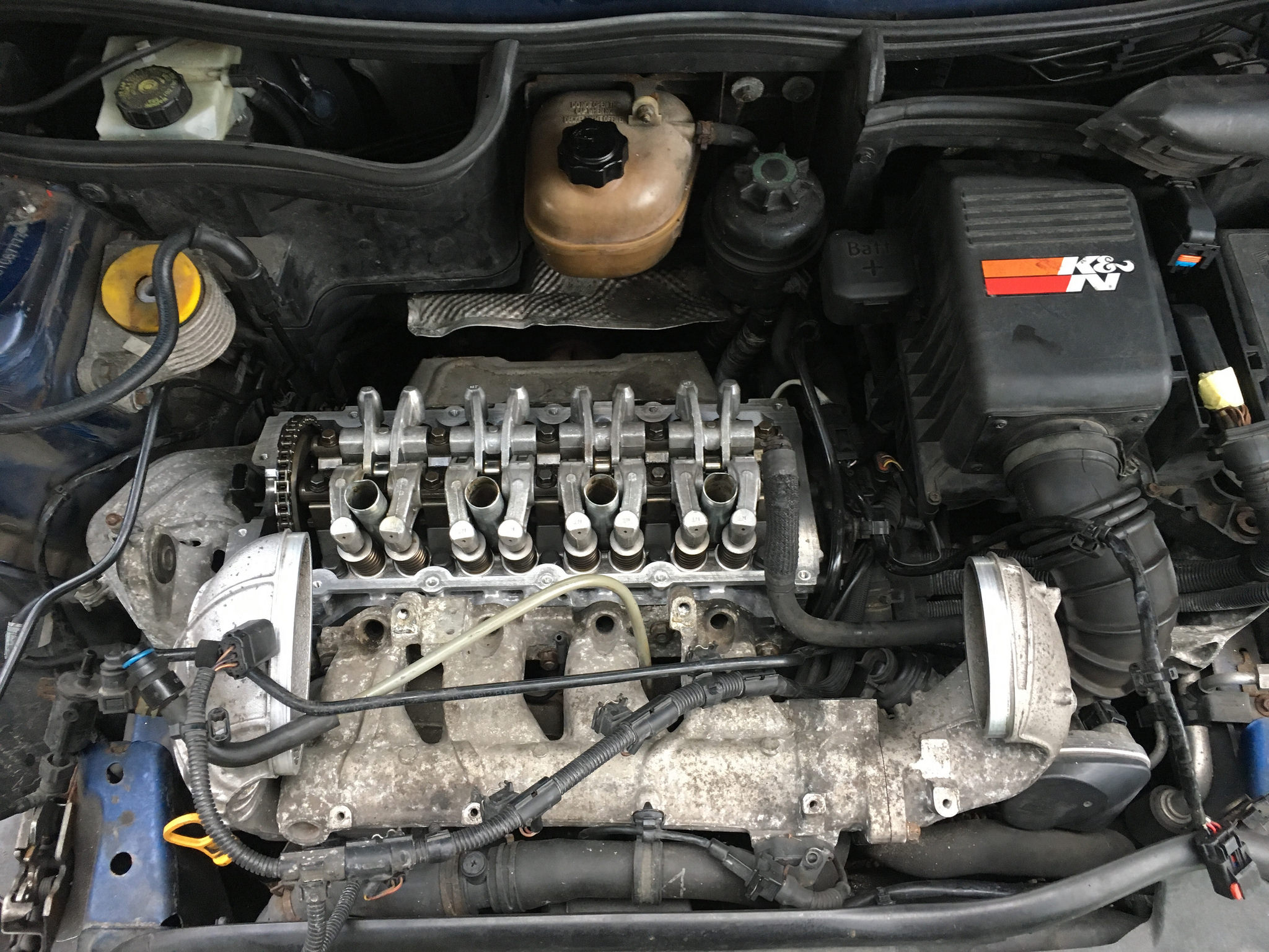

Then stared at the engine for a little while:
Untitled
Started to put it all back together:
Untitled
Untitled
Until i was at this point on Sunday morning:
Untitled
Just need to put some cheap oil in it now so that i can get it up to temperate & fill/bleed the coolant, then i'll give it another oil change with the decent stuff once i know everything is all in & working ok. Hopefully get that done on Sunday with any luck ... then its MOT time.

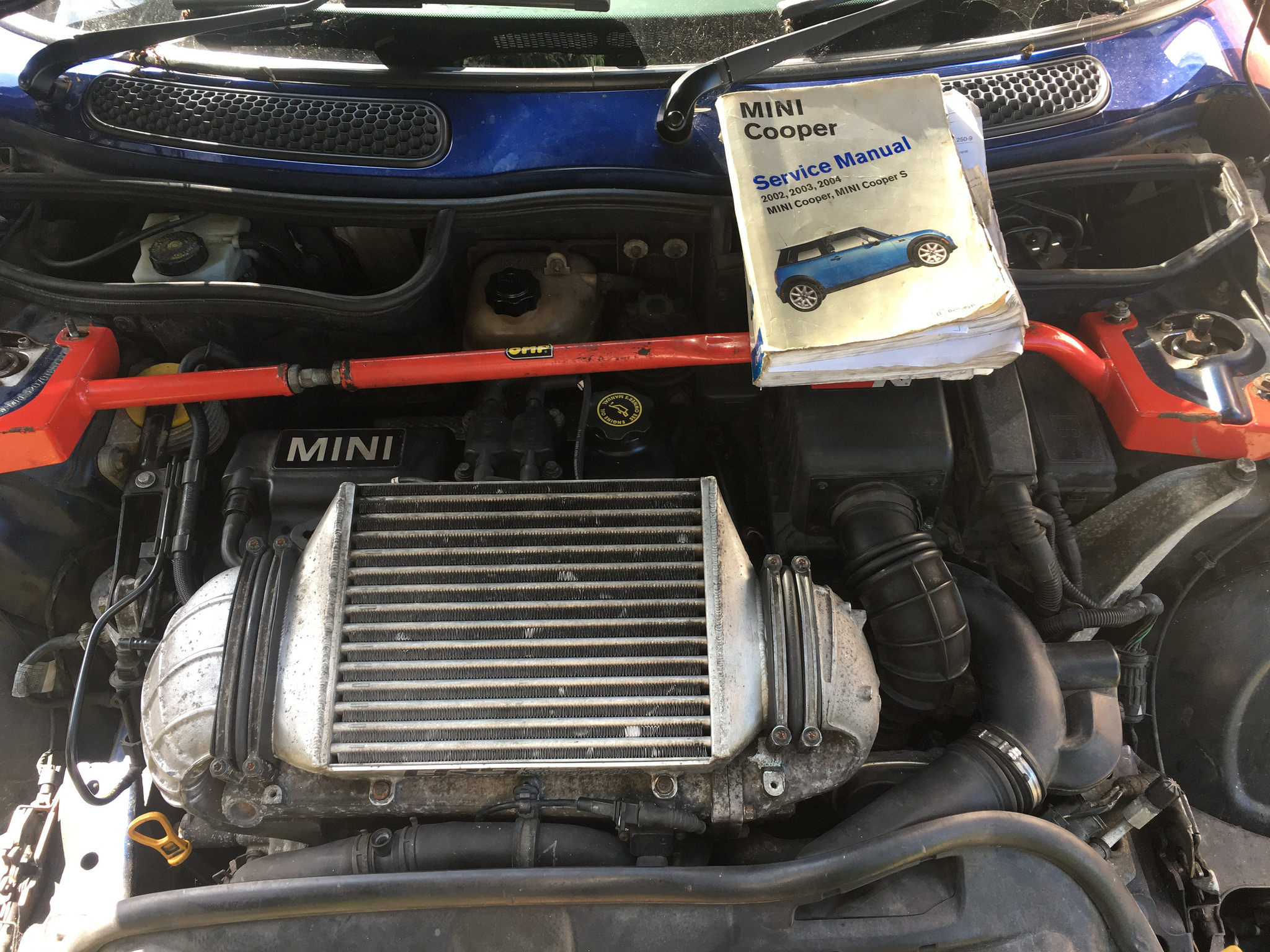

What I/c is that Dave?
Its an early GRS "Motorsport Version", without the diverter that they fitted onto the later ones. Have been tempted on occasion to fit an Airtec FMIC, but they are a hell of a lot more money & id loose boost/need to move up to a 17% to offset it. This one generally keeps temps where i need them and it'll only get close to "temp clipping" IAT's on a very warm trackday - i keep an eye on temps with the Scanguage and let off on the straights to manage that anyways.
When I had a pulley fitted the other day at Millsy's autos he suggested a 15% is best anyway. Especially if they ever see a track and that's even with an upgraded I/C. He said he's taken 17% off cars and they've seen better gains on the road and track. I don't know how true this is but he seemed a very genuine guy with a vast knowledge that's for sure.
If you can get close to clipping temps on a 15% with upgraded I/C on warm day I'm guessing what he's said it true.

What sort of IAT are you reaching on track etc?
From memory, low to mid 50's. With this setup, its very rare that i ever lose power, well, unless the valve has broken up 😂
Yeah, he's bang on to be honest, for my type of use (or even if you want to drive hard on a warm day), there' s absolutely no point having a 17% unless you have a FMIC/Meth imho. Better off having slightly less power, but nicer IAT's and longer S/C life. More boost, but for less of the time seems bit pointless! I've never been one to chase power though ... in reality, mine only pushes out 220 bhp or so and feels far slower in a straight line than the R56 was - but in the corners/on track, the chassis/gearbox work i've put in means its fairly immense.
