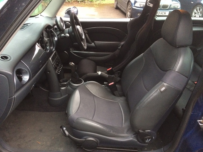

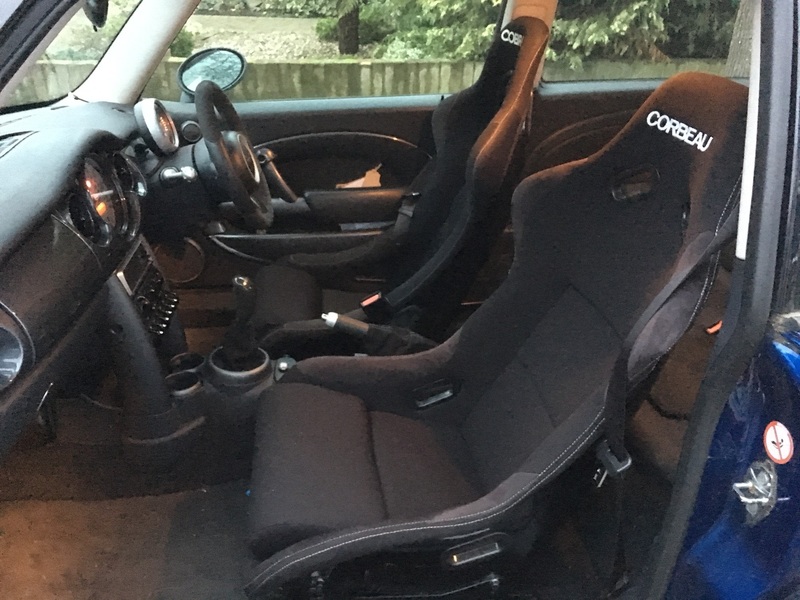

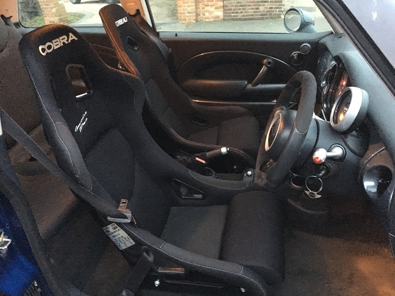

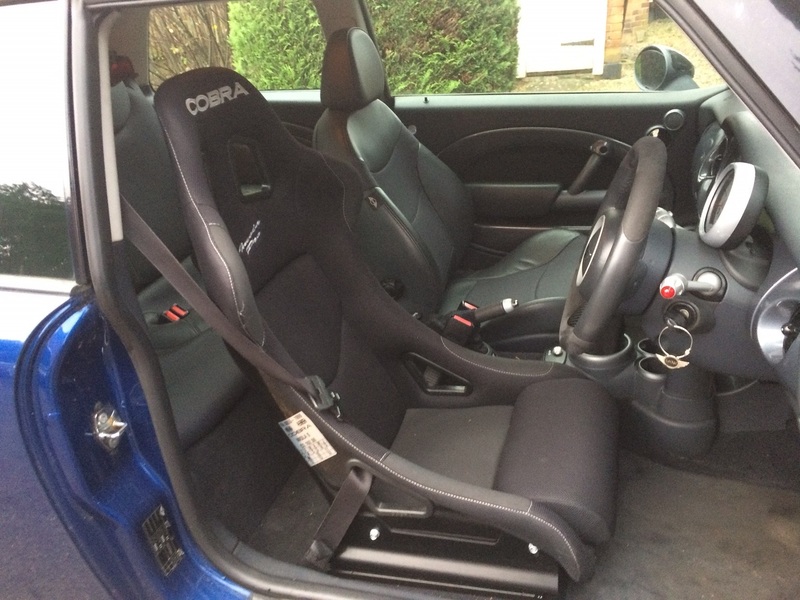

Then i moved onto the passenger seat, having had Warren's Corbeau Clubsport in my bedroom for the past 6 months it was time to get it fitted!
So from:
To this:
Unfortunately it was pretty dark when i was finishing it all off, so i need to swop the OMP subframe around so that the seat can slide forwards more, but that'll only take 30 minutes now i know how it all goes together. Next Tuesday im off to 1320 to get the facelift gearbox/Quaife/new clutch fitted, so hopefully that'll make a massive difference to how the car drives!!

Should of mentioned about the subframe, looks the wrong way round when fitted correctly!
Sir_Dave
ClioSport Trader
Oh ffs lol. I put it in the way it looked correct, faffed about for an hour & a half putting it in, taking it out, dismantling it all, to work out the specific order it needs to go to bolt it all in, fitted the seat, then realised that that's as far forward as it would go. By this time it was dark however & i needed a beer. My work light had also melted my windscreen pillar trim as well, so i was grumpy 😂

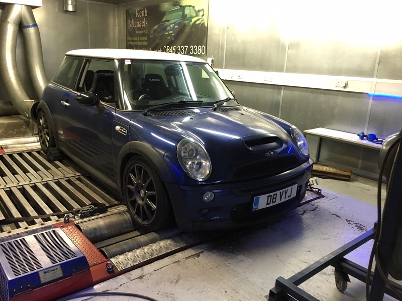

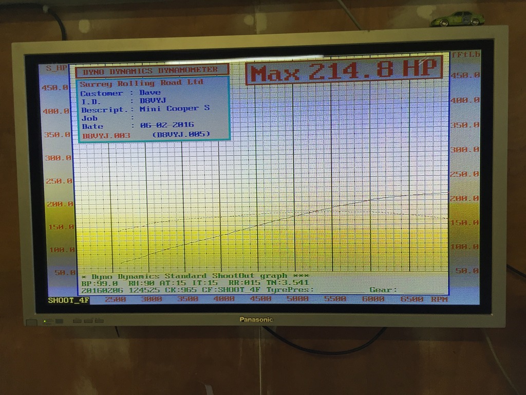

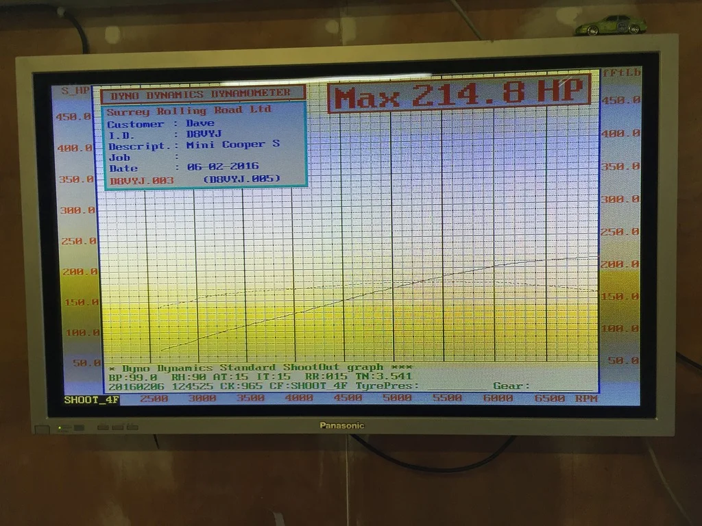

What did she make?
215bhp, so a little less than the 225 or so that i expected, but i'll just put that down to hotter inlet temps (over 50oC when it went on the rollers) and possibly a slightly aging s/c loosing a bit of boost perhaps. Will post up the graphs tomorrow, but it was just a nice smooth curve, ie more revs, more power, no weird dips/peaks, all perfectly fine in terms of AFR/mapping etc. Happy enough, peak power isn't that important to me, just like to know its running ok :up:
Everything was dwarfed by the C6 RS6 that turned up & put down 615bhp 😂
Sir_Dave
ClioSport Trader
215? Isn't this cammed too?
Yeah, the newman is a fairly mild cam compared to the Cat though! It did 195WHP (circa 225ATF) at 1320 this time last year (when it was mapped again) & doesn't feel any different tbh, certainly no slower. I'm not that bothered, at the end of the day its got 100k hard miles on it now, all on the original s/c (most people replace them before now), & the s/c belt has done 3 track days so probably stretched a little, ill get it changed out tomorrow. This time next year i plan to fit a facelift/teflon s/c and a janspeed manifold/tomcat which will get it back up to slightly better numbers im sure, but if i was changing HP id just buy an RS6 😂

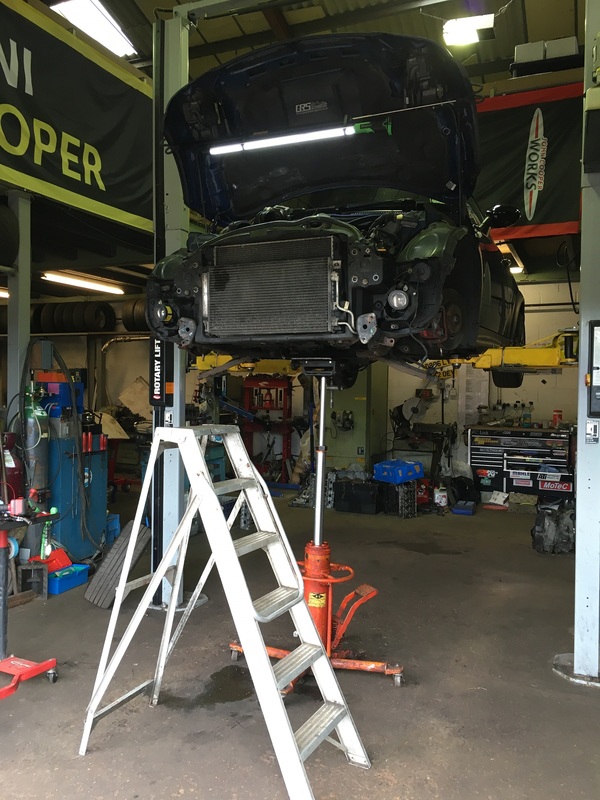

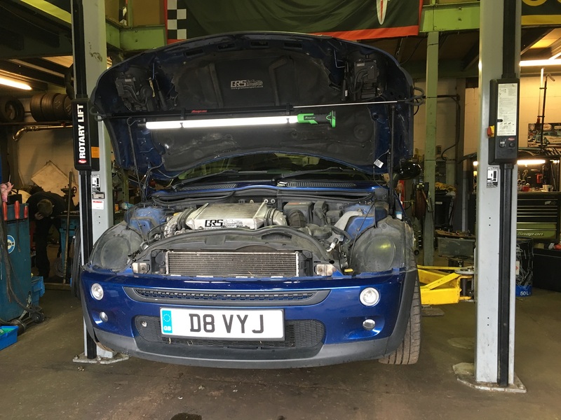

Last Tuesday I spent the day at 1320 Mini getting a few bits & bobs fitted.

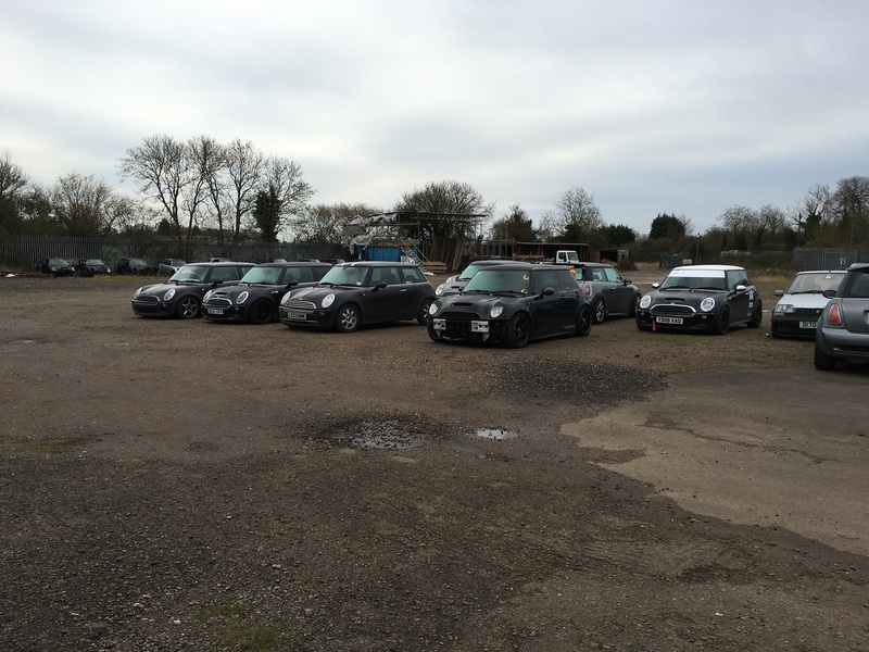

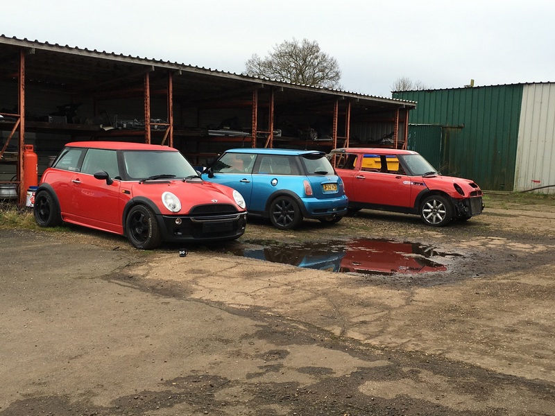

Lots of mini’s, all in various states of brokenness/turbodness:

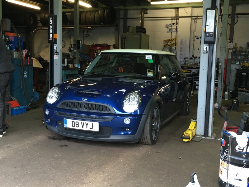

The turbo’d car that my facelift box/quaife came out of:
Apparently it was in a black turbo’d mini before that as well, so hopefully its not so fussed about my lack of power/torque lol.
Time to pull it apart!
Yeah, wouldn’t have fancied doing this on the driveway!!

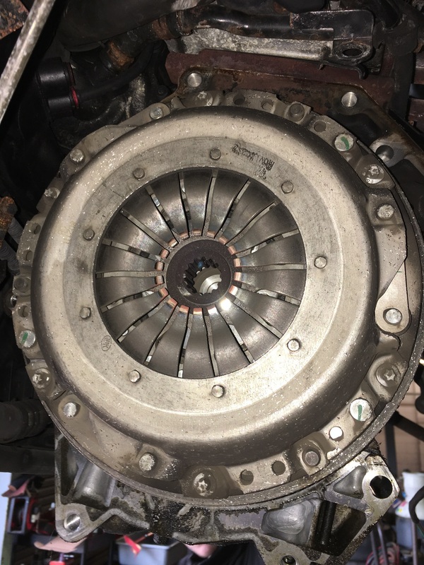

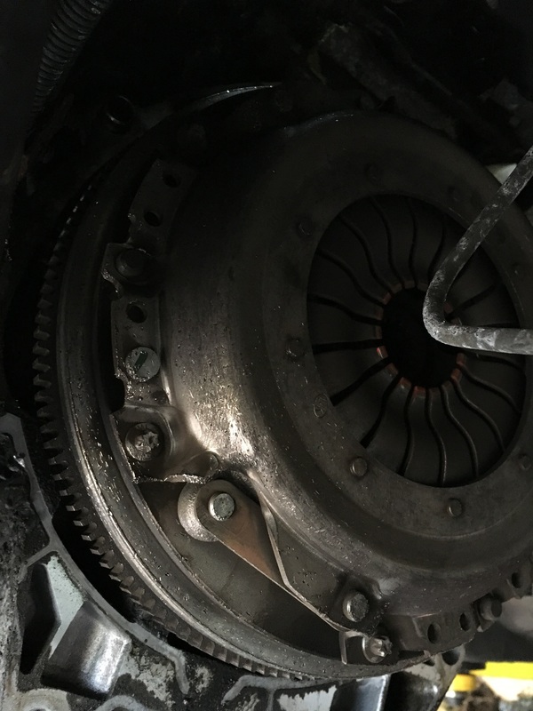

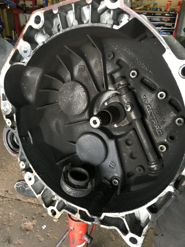

Gearbox off, & the clutch release bearing wasn’t where it was supposed to be apparently:
So that (or something else related to it) had been rattling around inside the gearbox, making a bit of a mess:

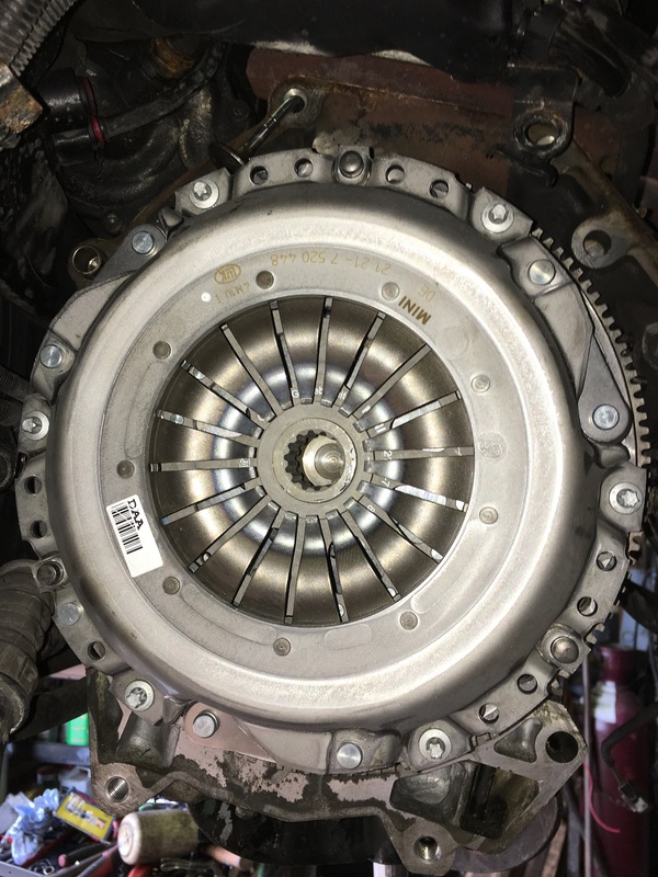

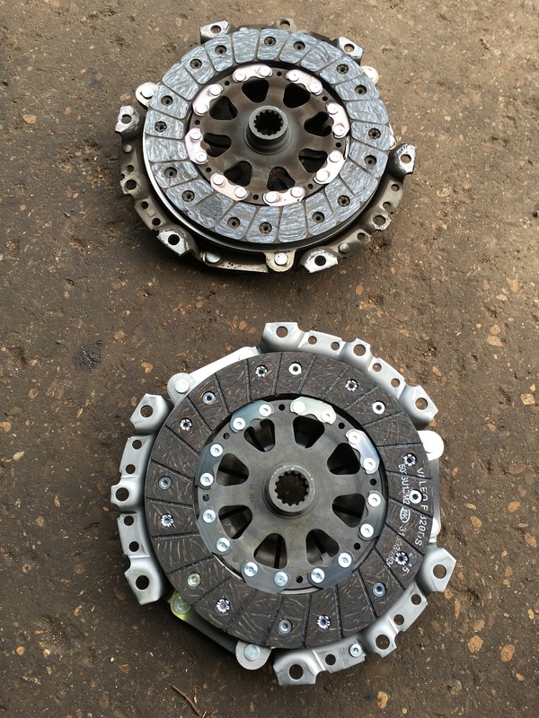

New clutch to go in, old one was fine, but for the sake of £200 in parts, it might as well be changed.

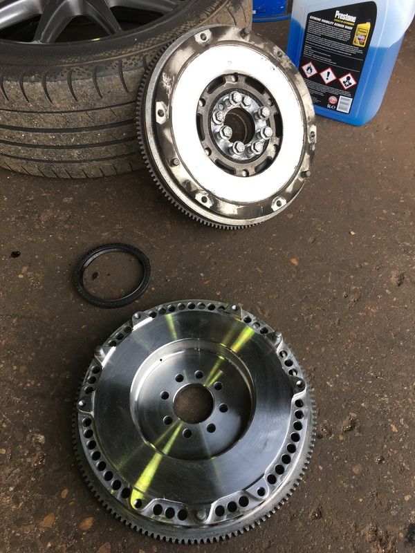

At that point, I lifted up the standard dual mass and was amazed by its weight!! Flipping heavy, so I enquired as to whether 1320 had any single mass lightweight ones floating about, they did … £400. Gave Thomas/Scott’s minis a little rev in the car park, then bought one haha.
All mounted back up

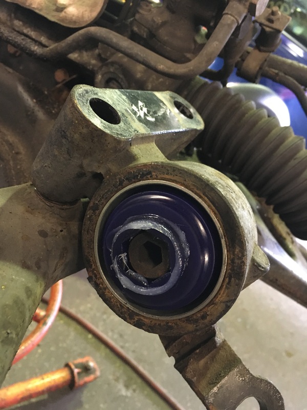

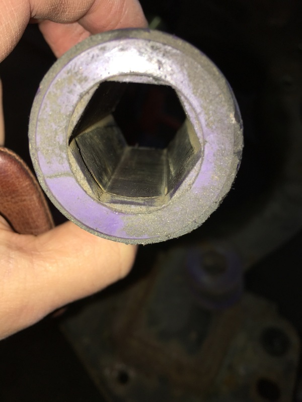

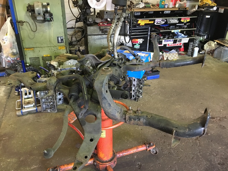

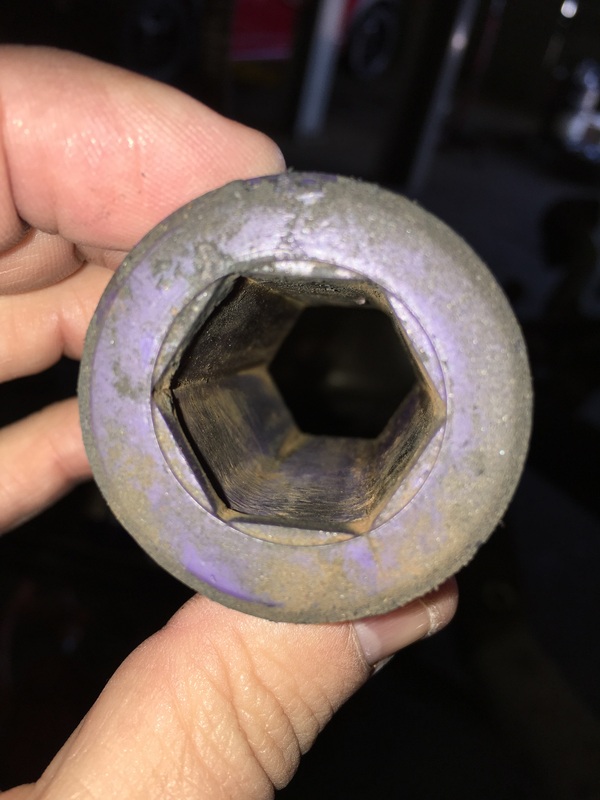

Once that was all put back on, it was time to move onto the subframe to check everything over, steering has been a little wobbly ass of late … and the culprit? Knackered Powerflex wishbone bushes, naturally these aren’t supposed to be rounded on the inside:
They are supposed to be more like this:
So in some Superpro ones (£100 or so) go instead, problem solved.
After that everything was put back together while I kicked around my old bushes with Alan:

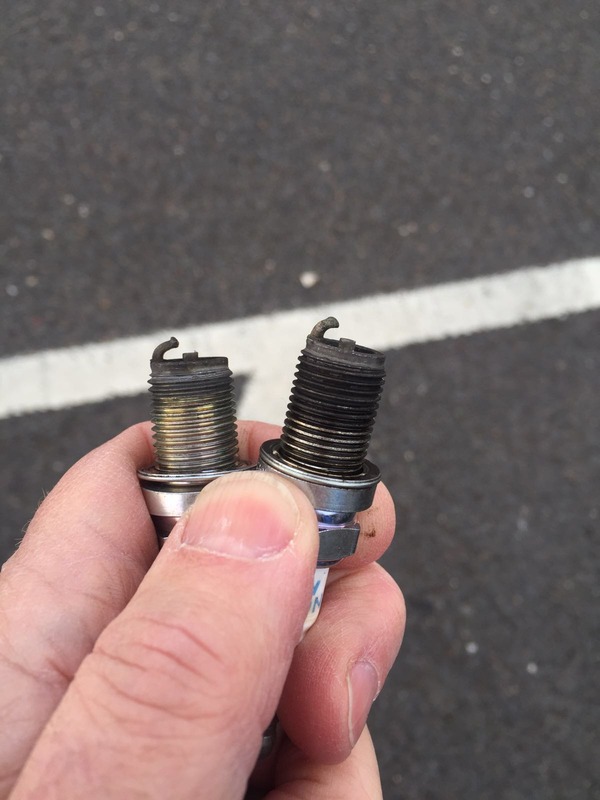

The afternoon wasnt so great, but that is covered more here: http://www.cliosport.net/threads/melted-spark-plug-causes.762279/#post-11045180 I think its mostly fuel related (i filled it up with Bedford's own fuel at lunchtime, instead of the Shell VPower i normally use/its mapped for, so c'est la vie/probably a coincidence etc), but will be checking through everything else as well.

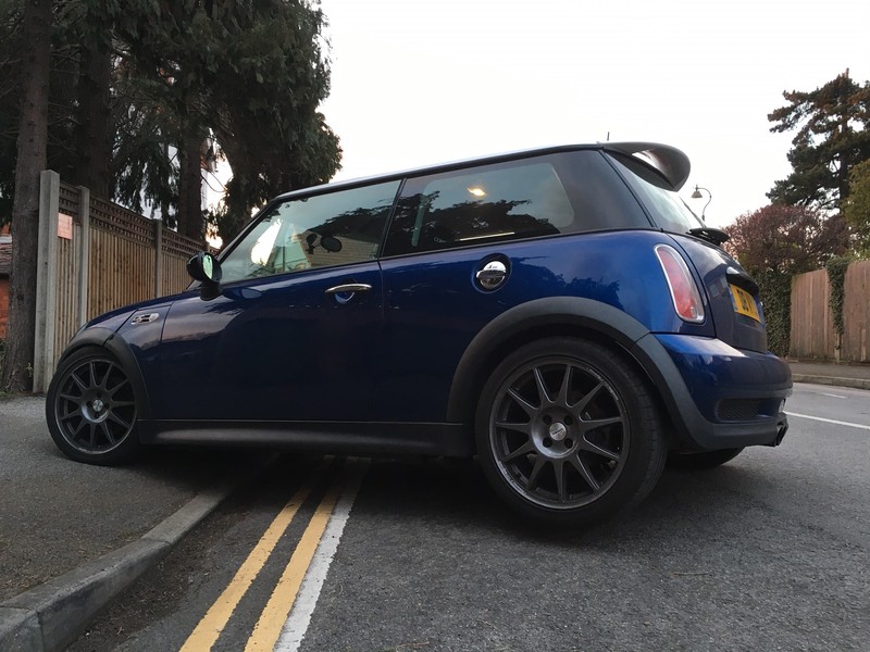

Took this picture last night as it amused me, would seem the mini is setup fairly stiff ...
