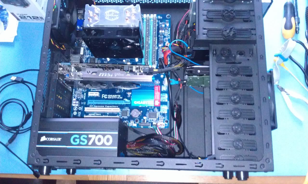

I've got a horrible feeling the EVO 212 won't fit in the case now the motherboard standoffs are on.
Oh well case modding here i come
Wilkeh
  MK4 Anni & MK5 Edt30
Precisely :)
Told you in was big mate!
I had to remove the side 200mm case fan to fit it in. I have an Antec P190 and it's not exactly a small case :cool:
  Bumder With A Buffer
Cable management??
Panic over It fits :)

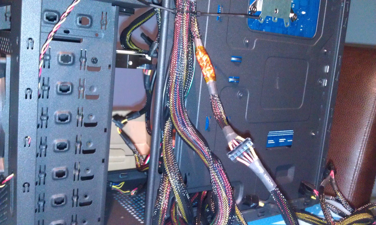

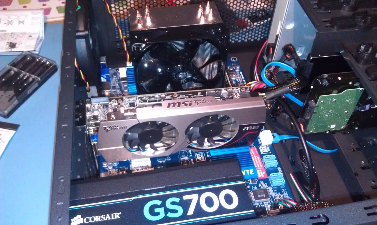

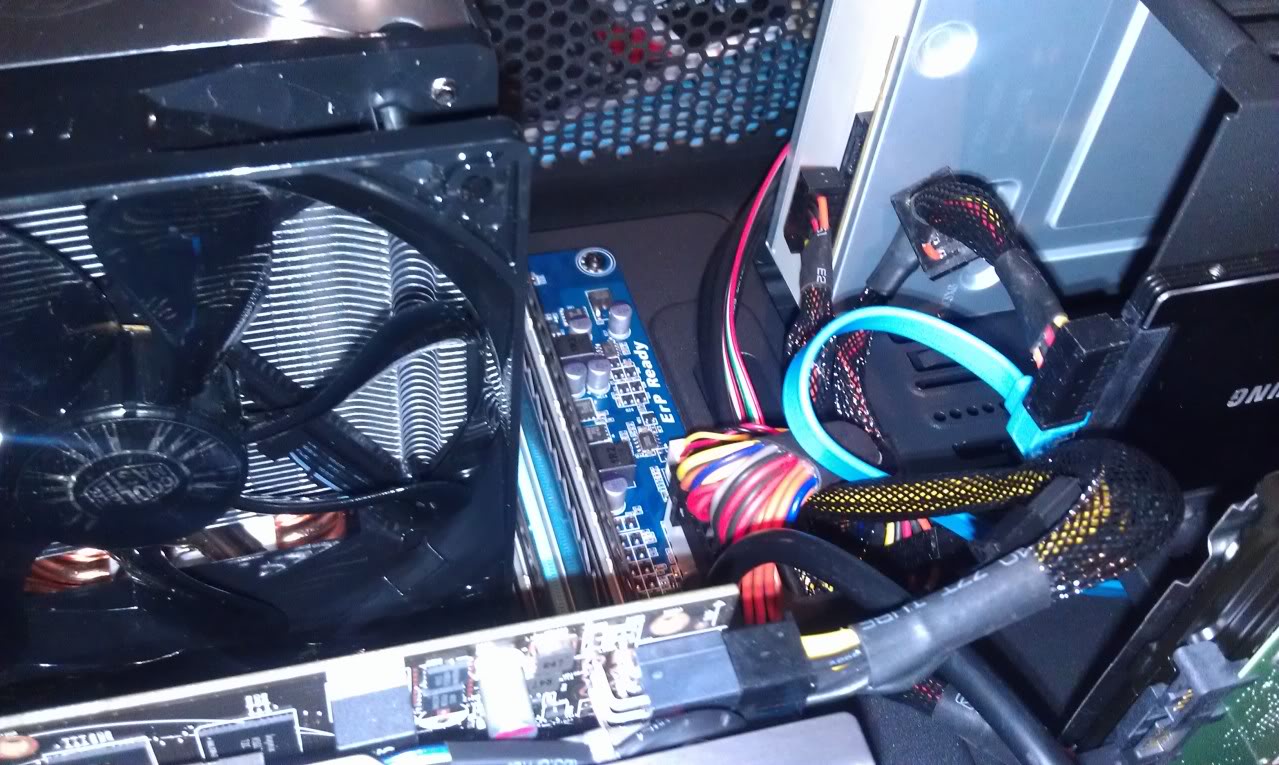

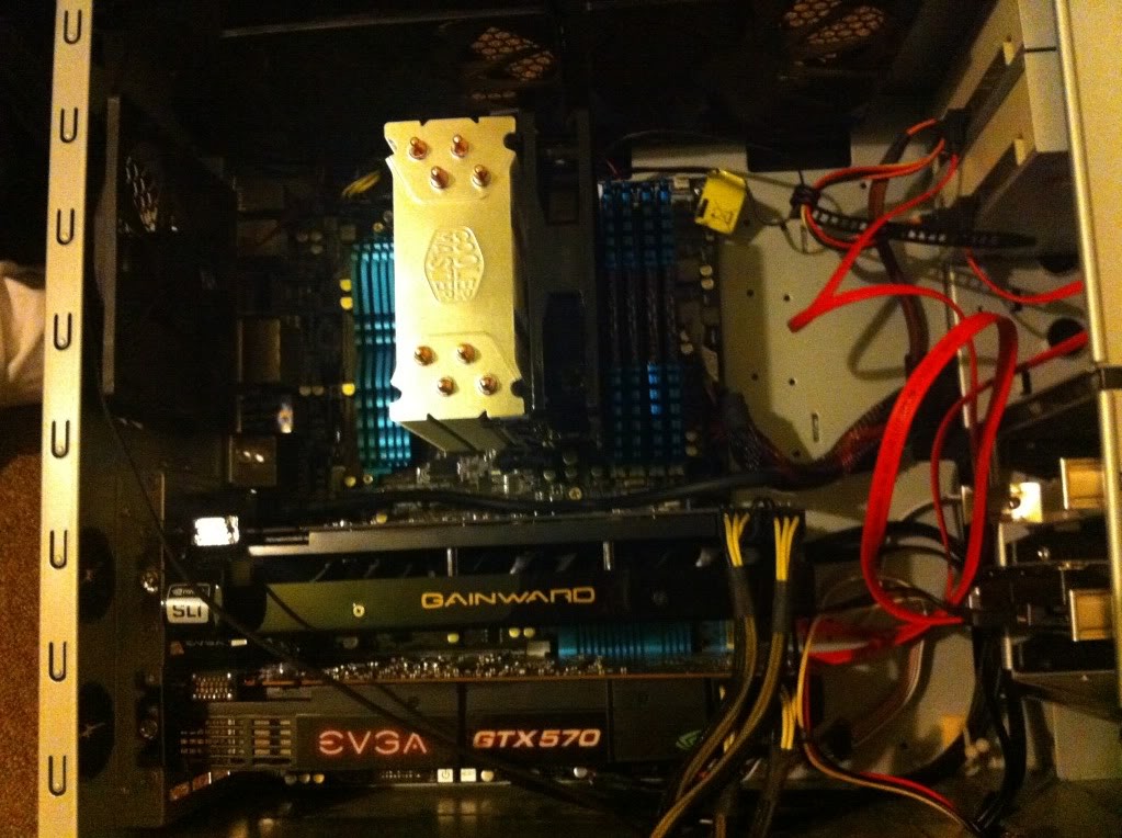

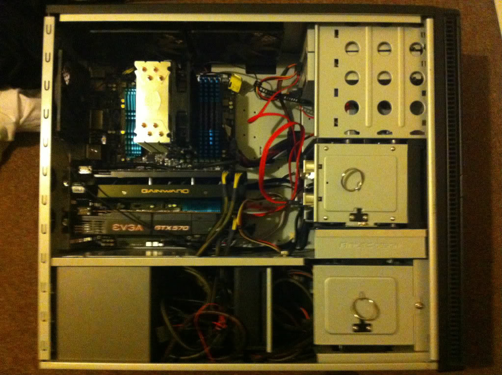

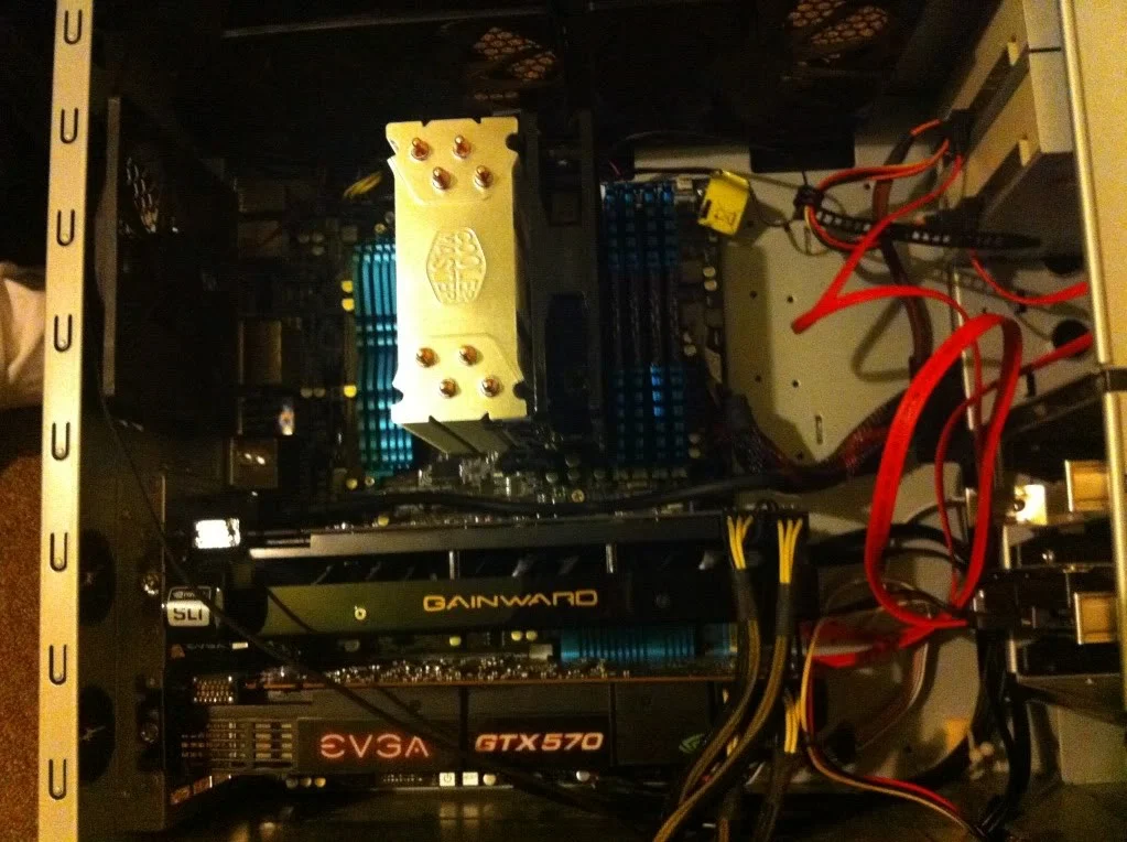

A few install pics (note the EVO 212 is NOT in place yet is only resting on the CPU) My cable management could be better. I Might address that later.

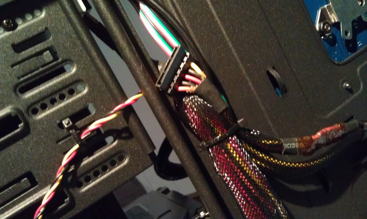

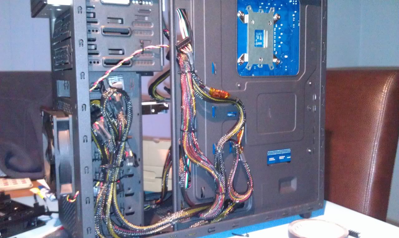

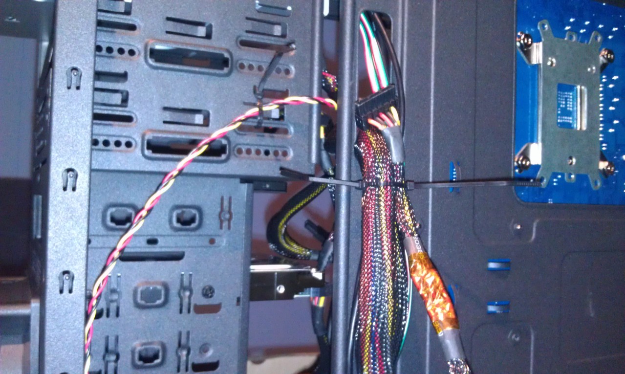

Cable management. I removed a couple of the crimp on sata cables as I didnt need 8 of them. Plus they were pissing me off and too bulky (2nd pic). Each wrapped in Kapton tape to insulate.
spare unwanted cables from PSU hidden beside the hdd trays. I may well geta modular PSU eventually. I HATE excess cables.
All bits installed..Question am I right to put the SSD into the 6gbs sata port or the usual 3gbs?? Does it matter?
This is pretty much how it is now apart from not hooking up the HDD just yet
Only one thing that is ballsed up so far is the aurdio leads from the XIGMATEK front panel is too short to reach the connector on the mobo :( It sit in the bottom lefthand corner just hidden by the PSU so need to buy an extender. I could probably build one to be honest but I found one on SCAN for £4 so not worth faffing over.
As said I might tidy up some of the cables a bit more but im pretty happy so far. Just got to put the EVO 212 in place and atempt a boot up...!!! :eek::eek:

By the way the 212 will cover your first ram slot. You can get away with lifting the fan slightly over it and attach it towards the top of the heat sink.

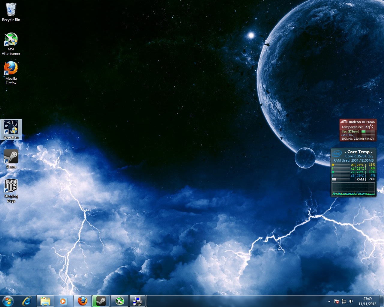

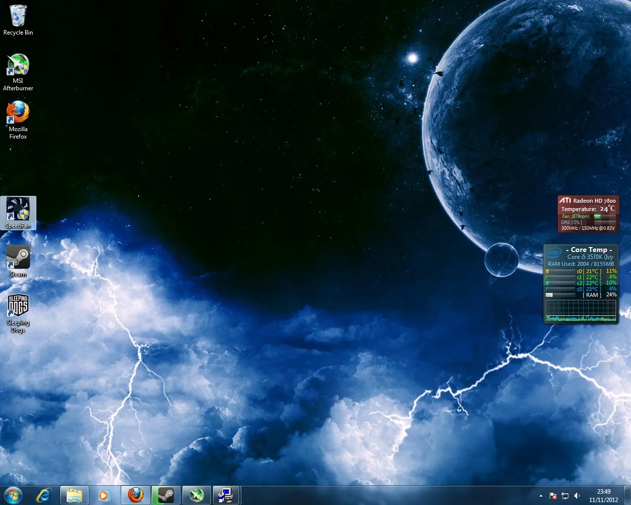

All up and running and sorted. Well apart from any graphics tweaks I need to do.
Core temps sitting nicely at around 23 degrees normal, havent tried whilst running games yet as waiting for them to install from steam so taking a while.

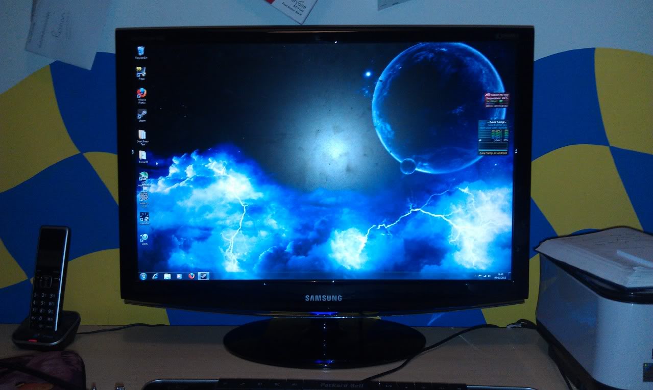

Got myself a Samsung Syncmaster 2433.
Was being thrown out at work as the screen was rather dull and as soon as any sort of feed from VGA or DVI was plugged in the screen would turn off. Thing is it wasn't turning fully off...only the backlights were turning off, you could still make stuff out on the screen. Stripped it down and found one of the tubes was dimmer then the others and by swapping which connection they plugged into the fault moved = duff psu.
So ordered a new PSU from Chinaland and that turned up today....
Ahhh yeah. A £220 monitor for £24. Nice. (ignore the wallpaper I have not painted the spare room since moving into this place in January...honest!!)
