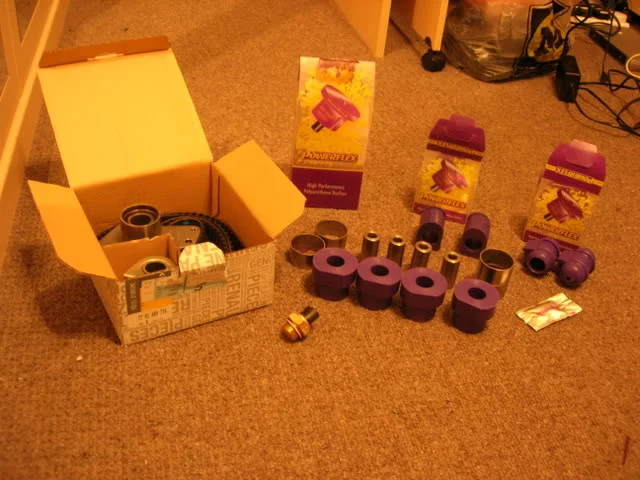

Fitted the ARB bushes tonight after getting 24mm ones on you lads' recomendation and Im convinced they're too big. They feel quite loose on the ARB and when tightened fully in the U claps on the subframe it creates a small gap above and below the bar in the bush. Cant be right, surely?
