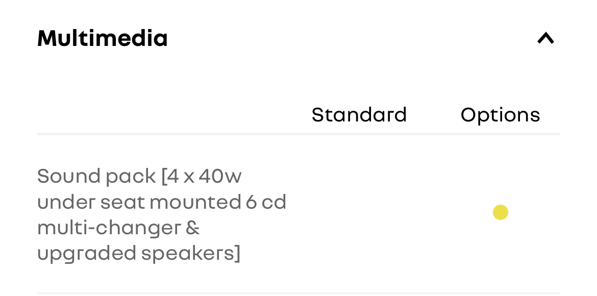

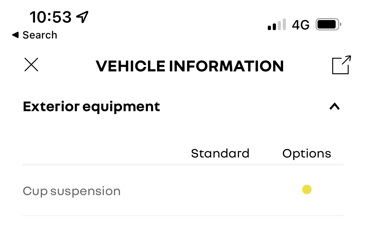

A check on my Renault revealed:
which I had been told (but good to know for sure)
And
Which I did not know. Result: old skool choons.

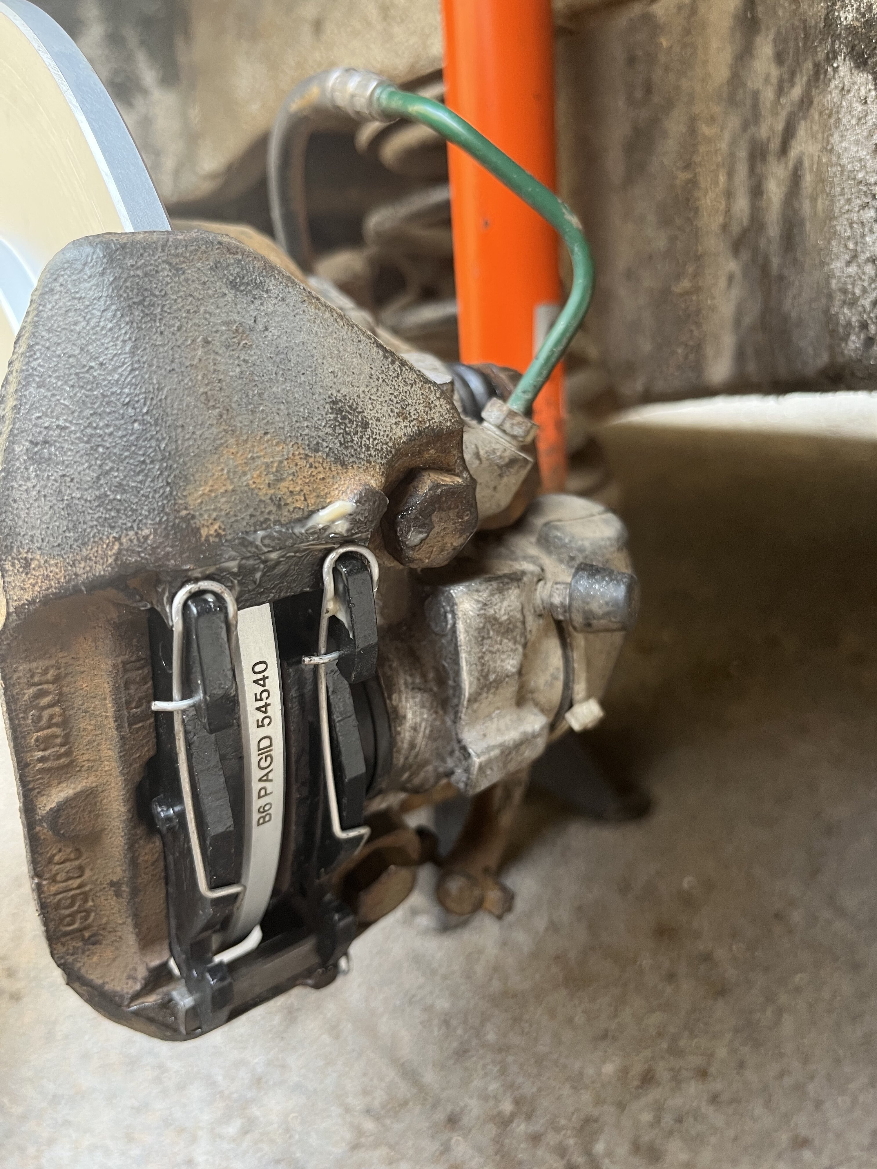

A little progress.
Gone from:
To:
And done a temporary fix on
the seller wasn’t lying when he said the brakes needed done. Discs were not the worst (the back ones are tho) but not much left in these:

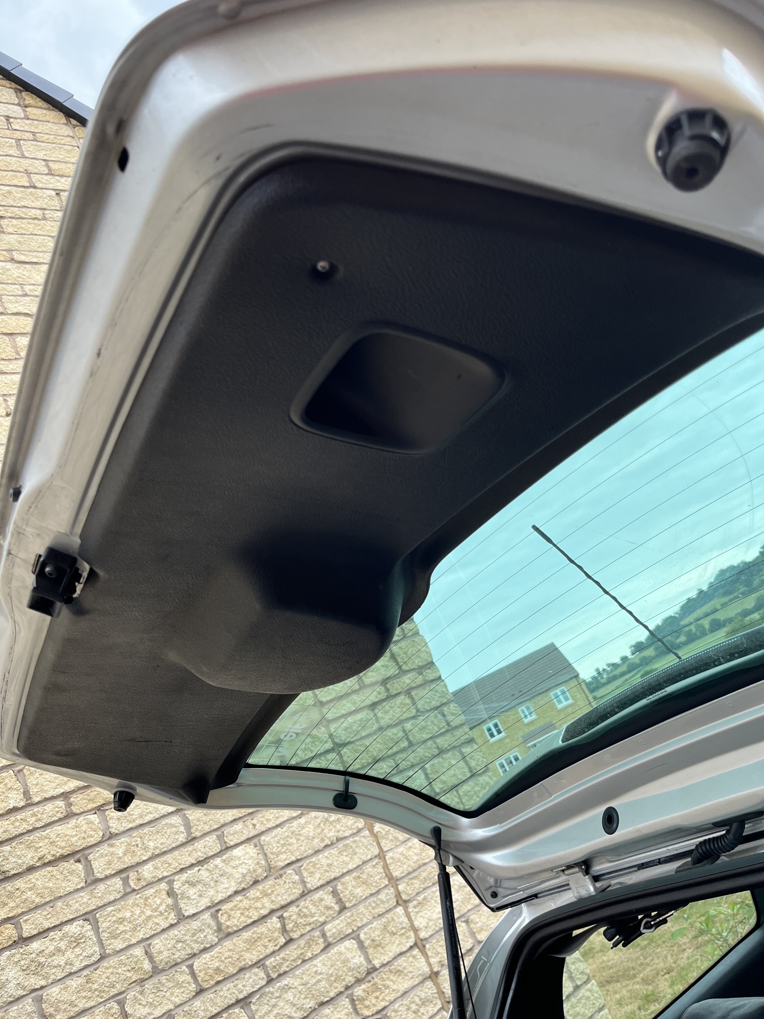

First of many questions:
Should there be a front half wheel arch liner in there? There is one to the back but nothing to the front…
There should yes, if by front you mean covering the front bumper opening. They are pretty hard to get hold of mind you as the cliosport ones are model specific and… no longer available!

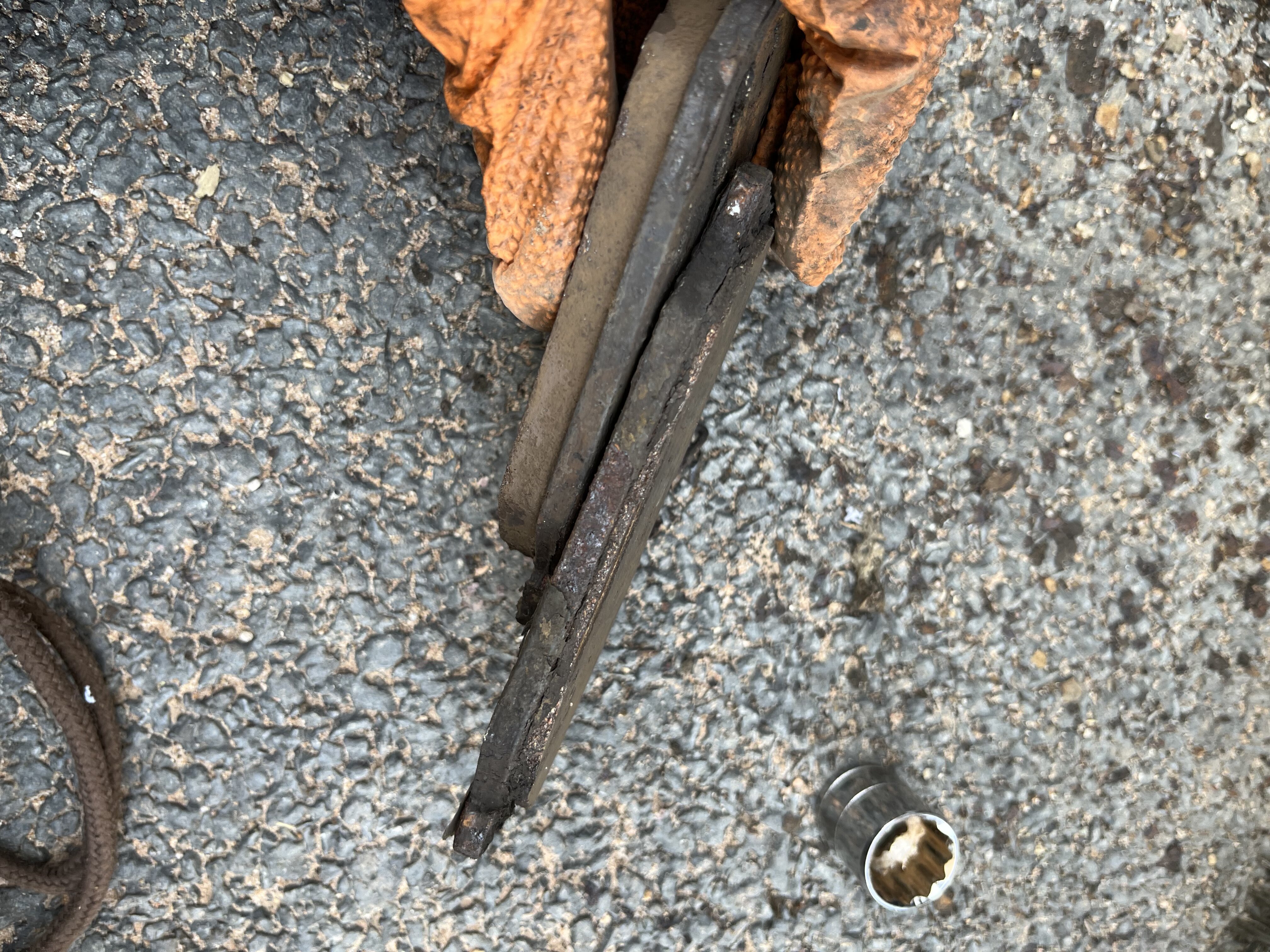

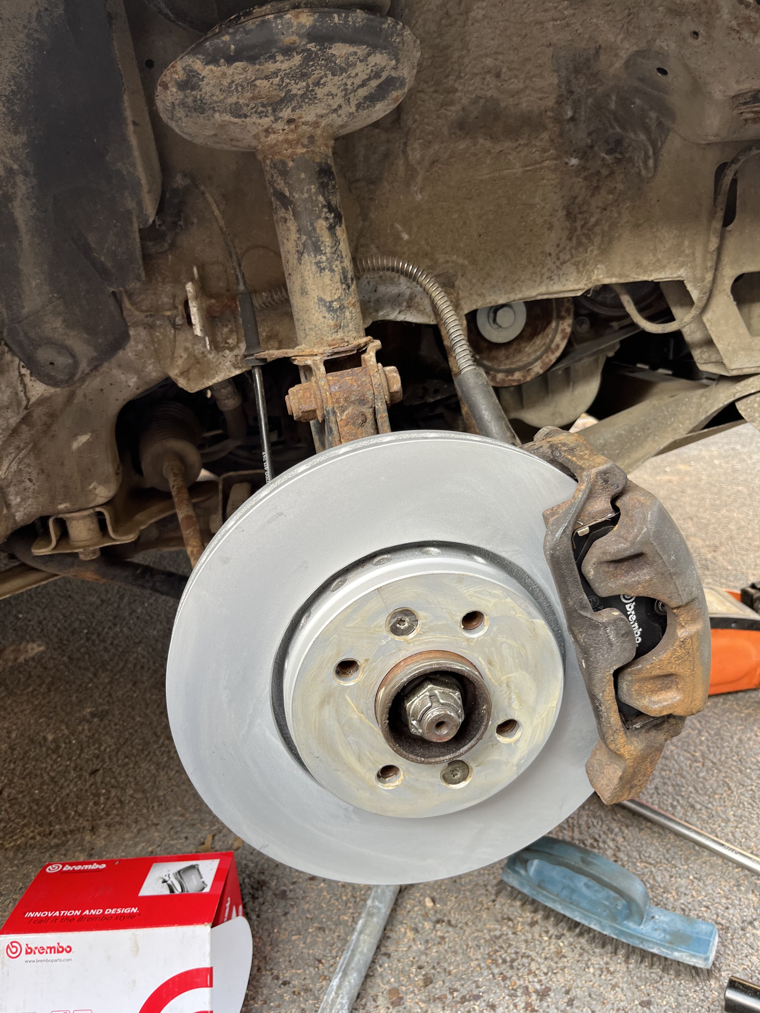

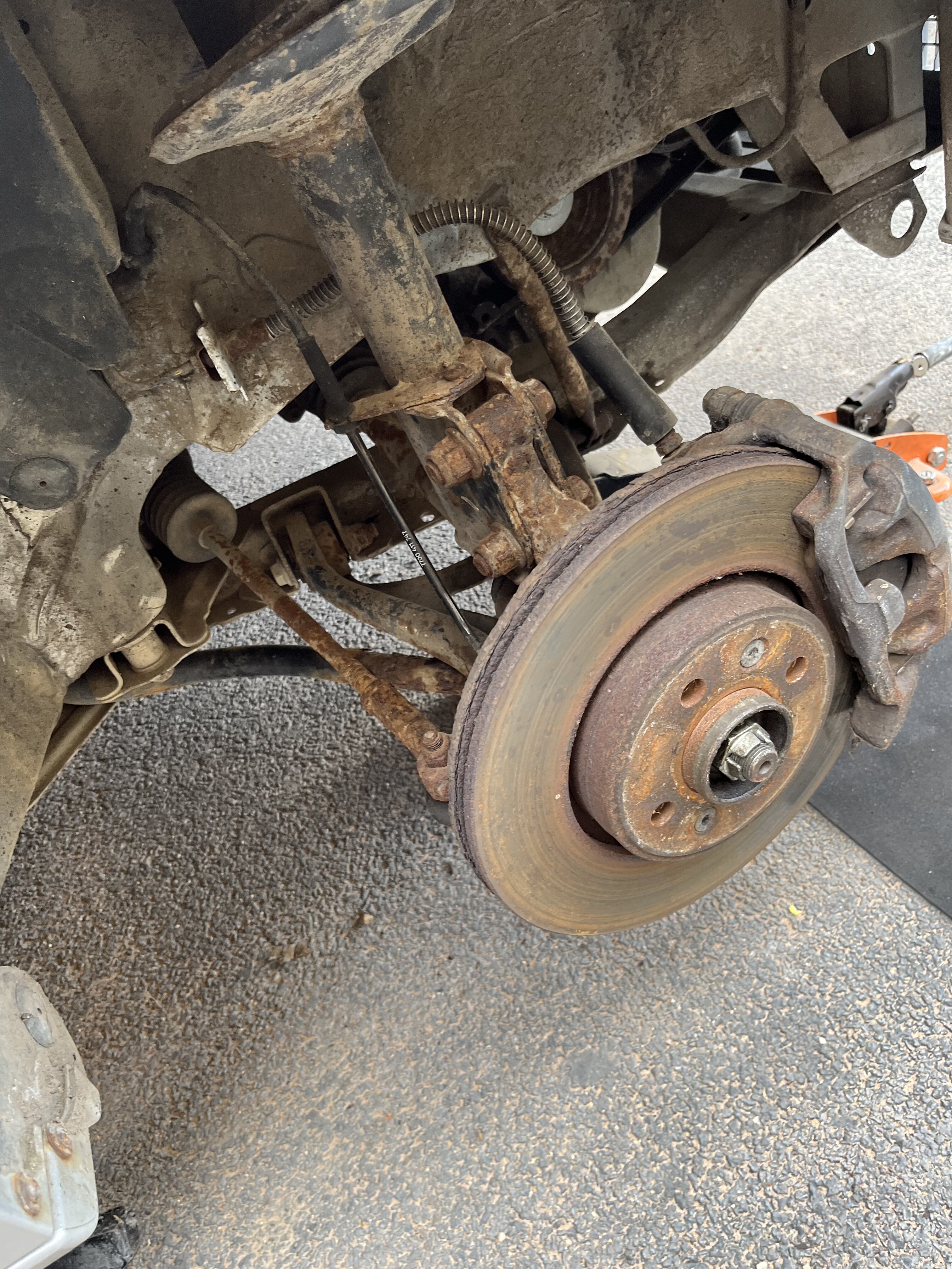

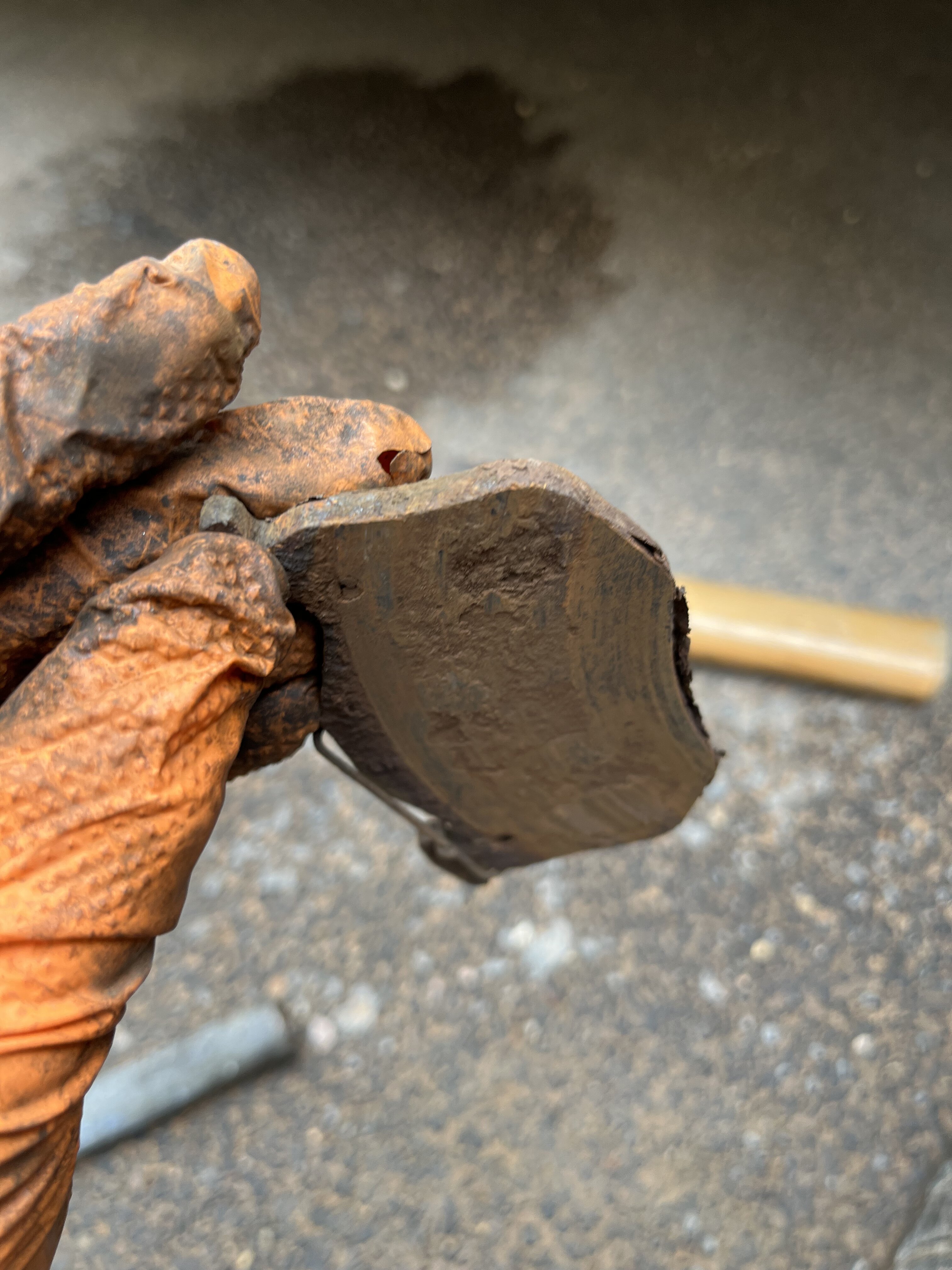

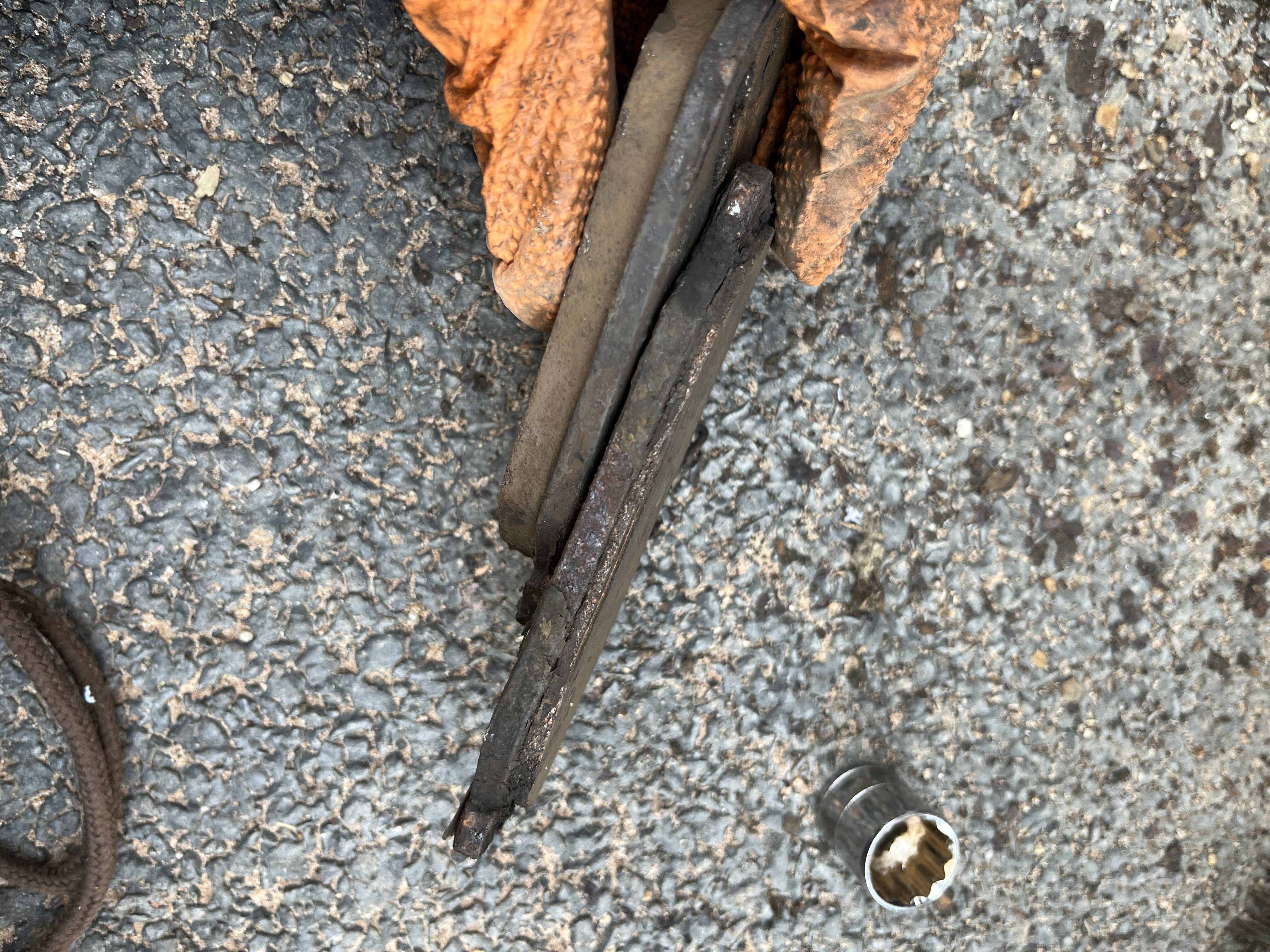

Back brakes were worse than the fronts.
Front:
Back:

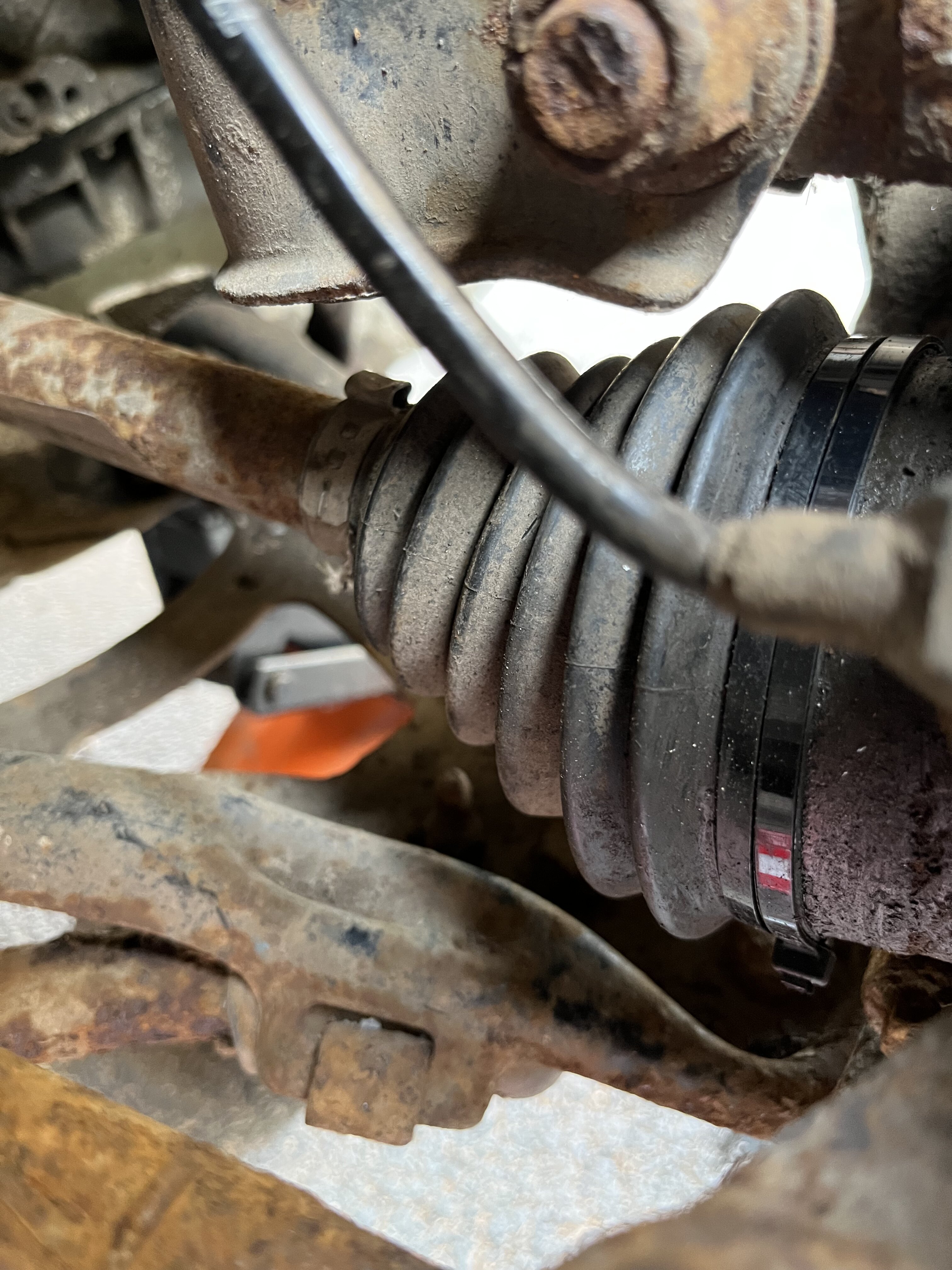

discs were shot too, but most annoying is that someone who has worked on the car was clumsy as…
Rear caliper piston seal torn (looks like screwdriver damage) and the n/s cv boot punctured by something sharp.
New boot and calliper seals are on order, but I am stuck for forward progress for a couple of days.
Also: I thought Peugeot were bad with packaging, and my Abarth 500 was worse, but whoever thought the brake reservoir location on a clip 182 was a good idea? Seriously?
Front:
Back:

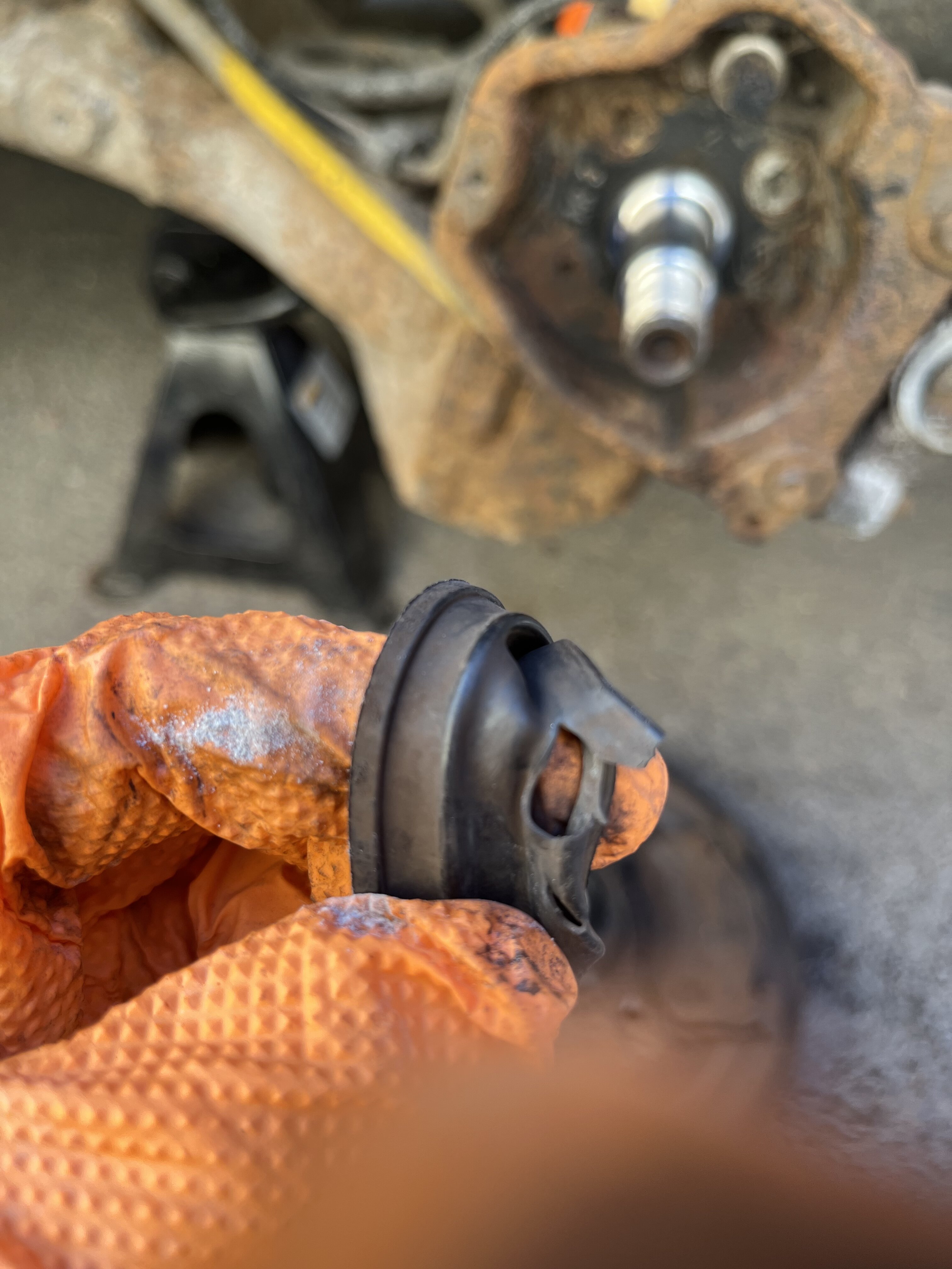

Should be fine, what usually happens is they come off with the disc, people fit the new discs without it and it destroys the rear wheel bearing!
I had a Renault dealer miss them in my ex birds 1.6 16v MK2 and the rear bearing failed and destroyed the stub axle and wheel bolts in the process 😂

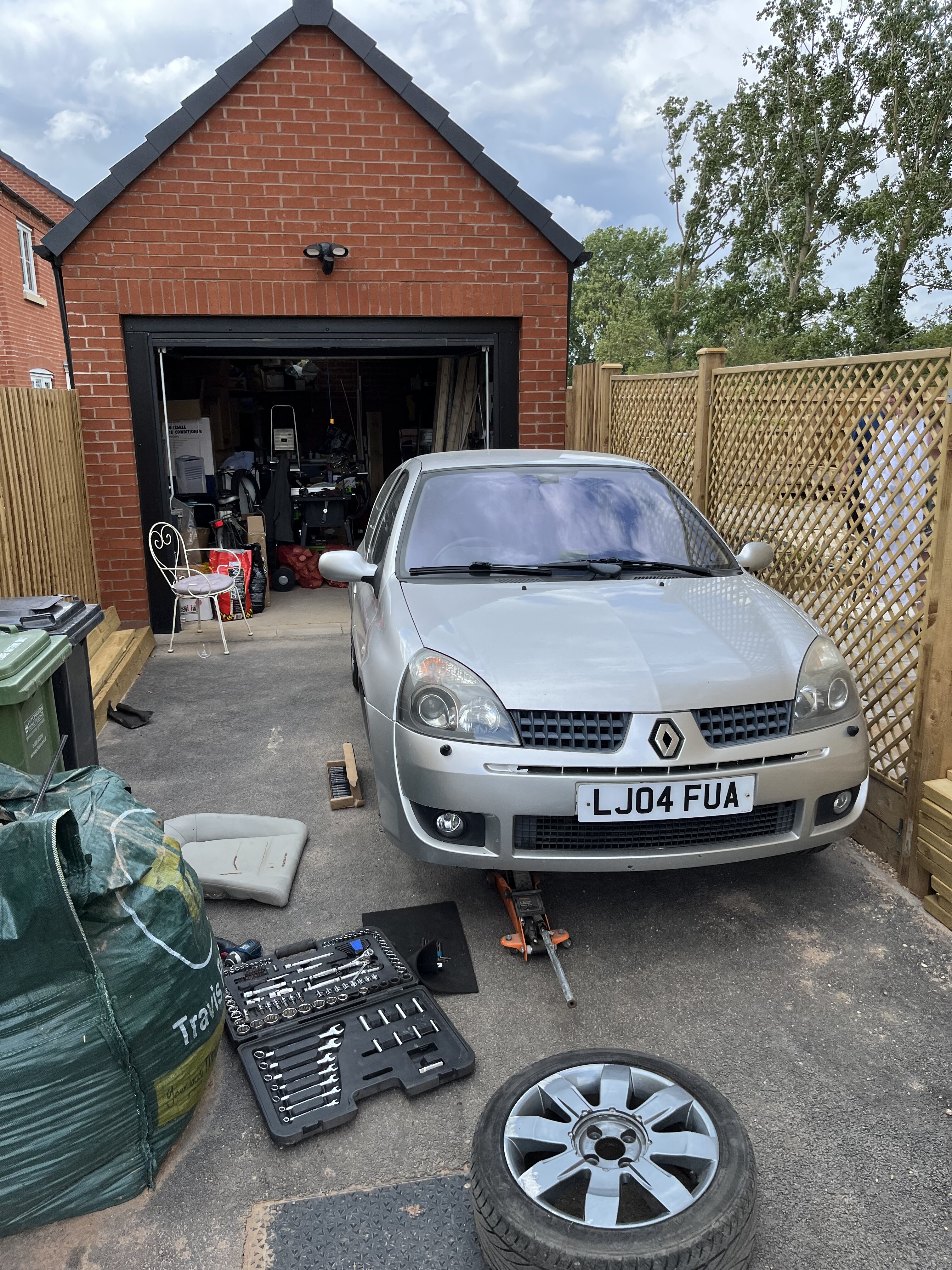

Well, today was a bust. ☹️
Got all set up and got my parts stash ready:
Cleaned up the calliper, wound back the piston and fitted a new seal, which was definitely needed:

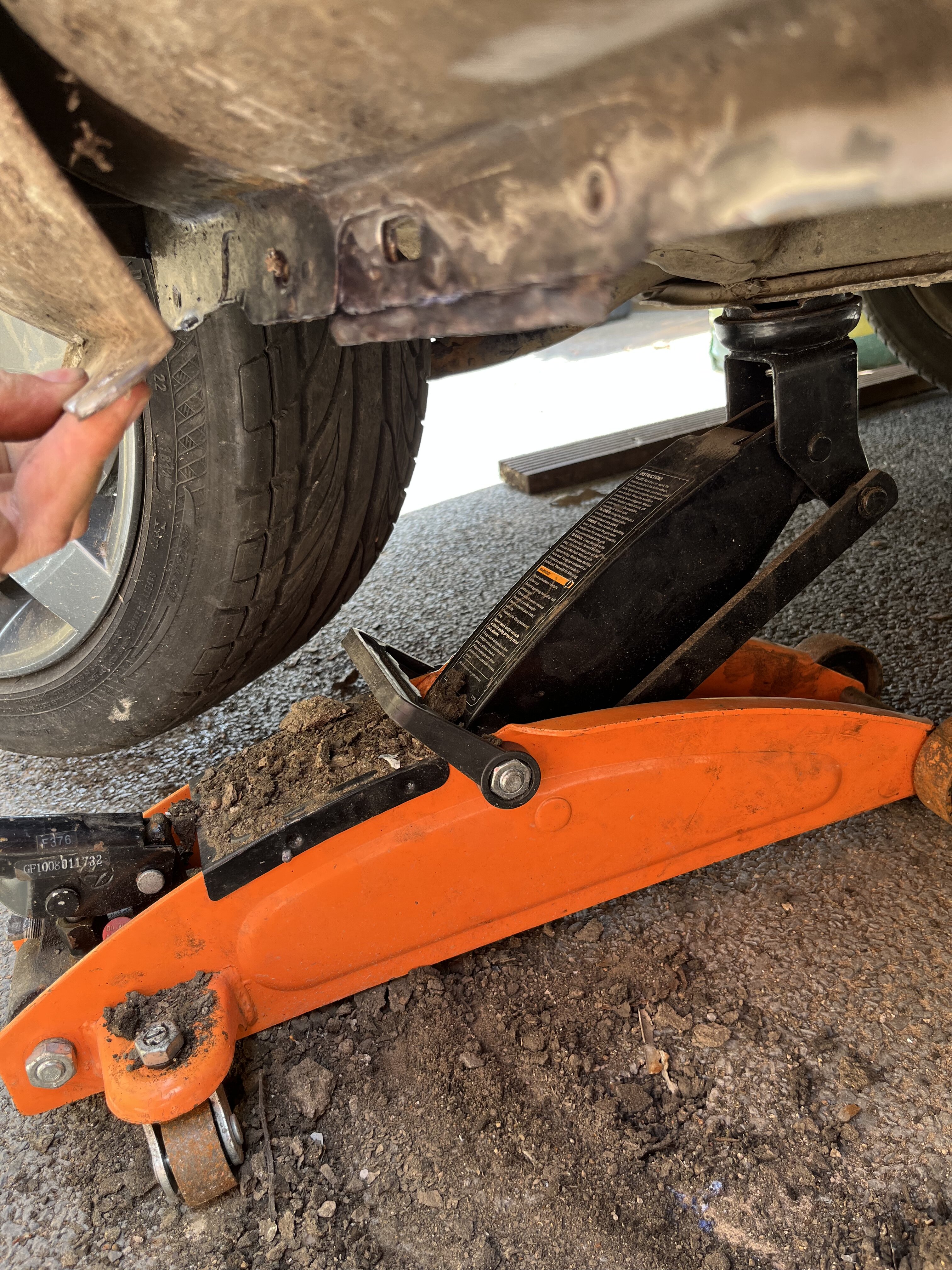

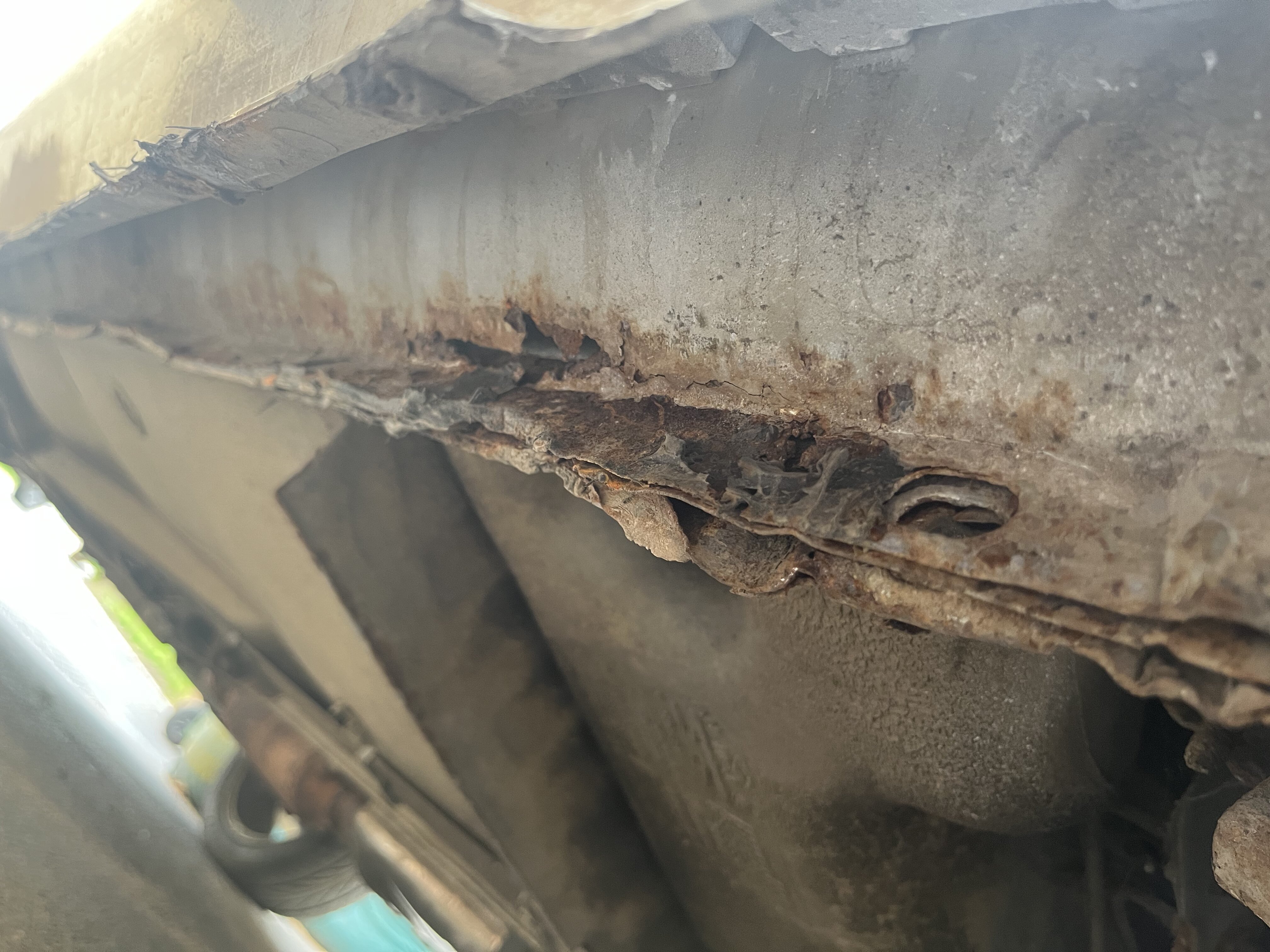

Frustrated, I thought id just tidy up the frayed jacking point on the same side while I’m there, and I now have a dilemma because the sill has a rust hole. Looking from within the quarter panel, it looked ok, just surface rust but now I’ve cleaned out the mud there is a decent hole. The car has had a new quarter on it that side at some point and the back was never painted.
the rust is very localised and I think it will only need about 30cm of the sill replaced, but not what I wanted to find.
Given it hasn’t been tested for 3 years I am so tempted to whack the sill extension back on and take it for an MOT without saying anything to see if it is all good elsewhere before spending out on welding. (I wouldn’t drive it or sell it as is, but I done want to bury a chunk of money getting the welding done only to find a bunch of other issues.) what do you all think…?

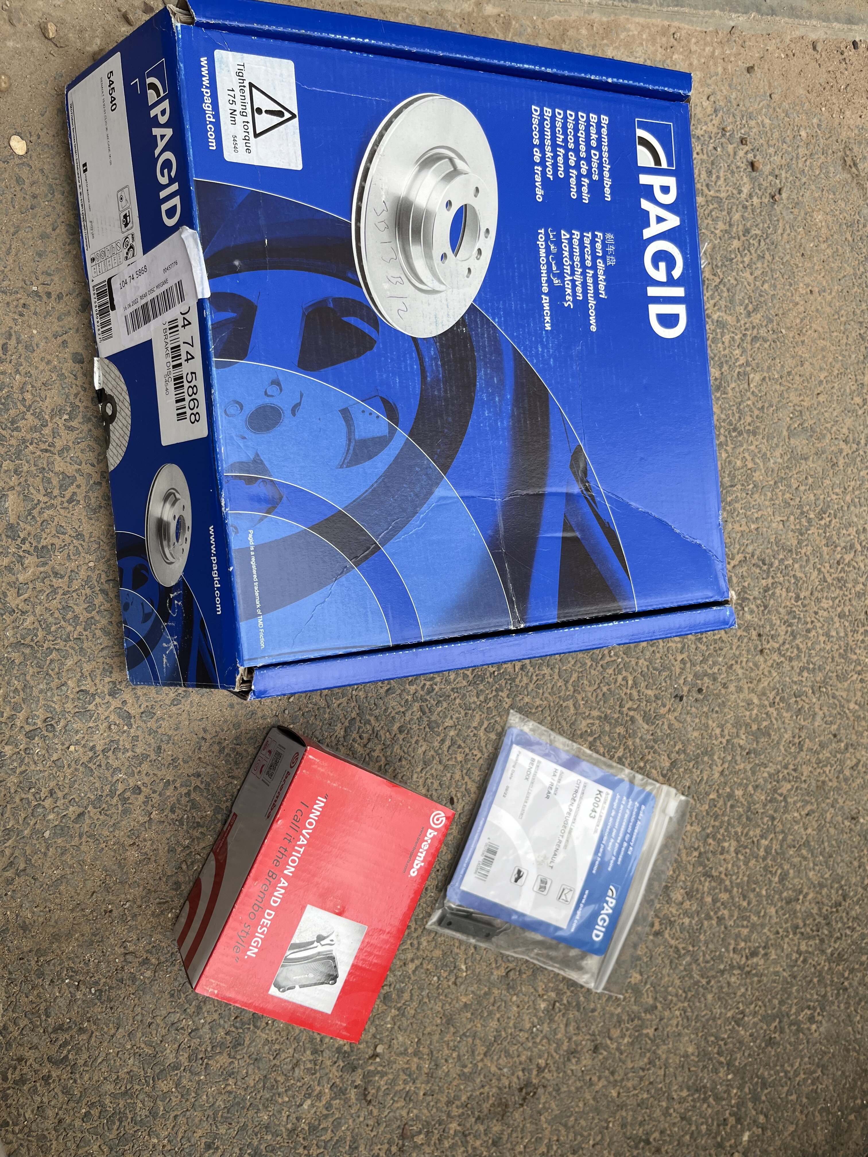

Parts finally arrived and progress has been made:
New rear discs and pads:
Again Pagid/Brembo combination. I’ve always rated Pagid coated discs and the Brembo pads seemed a good oem level fit.
the caliper has had new piston seals, slider seals and a quick grease.

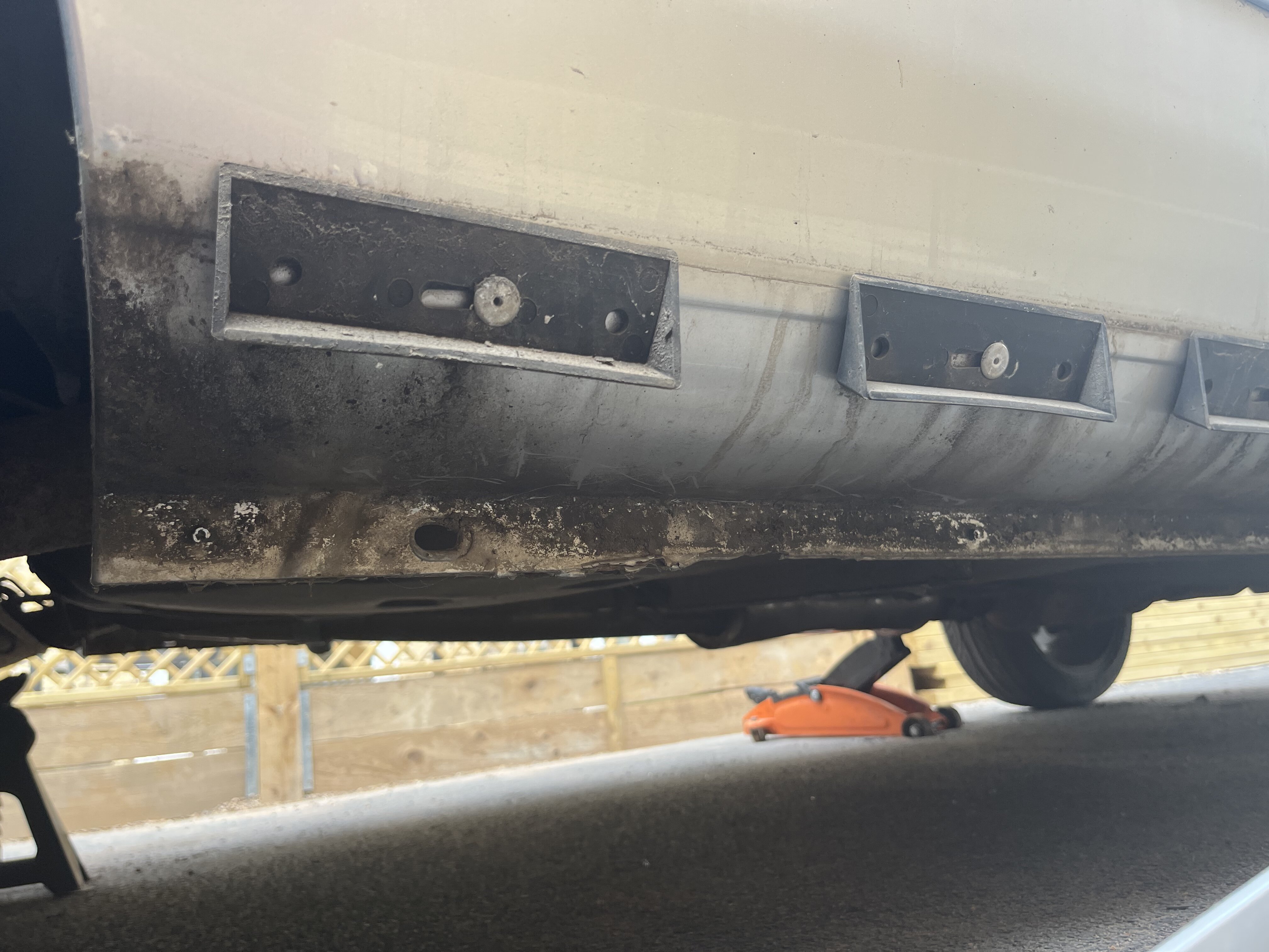

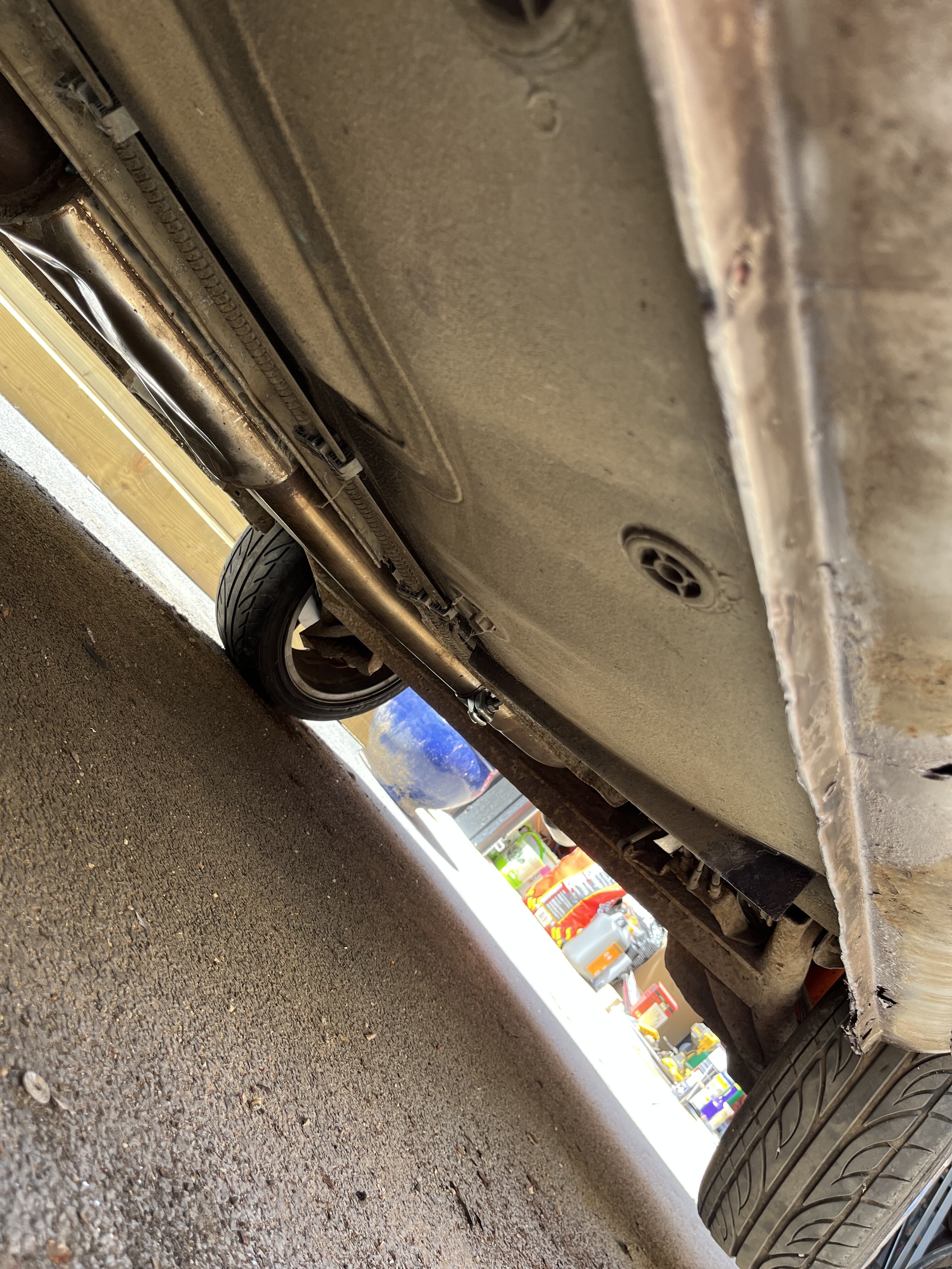

bodywork wise I took the sill covers off and the passenger side is definitely poorly:
But only the rear 30cm or so, the rest passes the screwdriver test at least. What I don’t know is how bad the inner sill is…
on the other hard the driver side is filthy but solid as a rock with not even surface rust (from the outside):
Work hasn’t stopped (although the heat has not helped) so I am running through, straightening out the trashed jacking points and tidying up the pinch welds on the sills to make it MOT presentabl
HOW MUCH mud gets trapped behind the wheelarch liners? 😂
This sill is past making right without welding, but straightened up for now until we see what else an MOT throws up. I have put stainless rib nuts in to the good news is that I still can’t find any other rust on the car. I suspect when I eventually drop the beam and take the wings off will be the acid test, but happy so far.

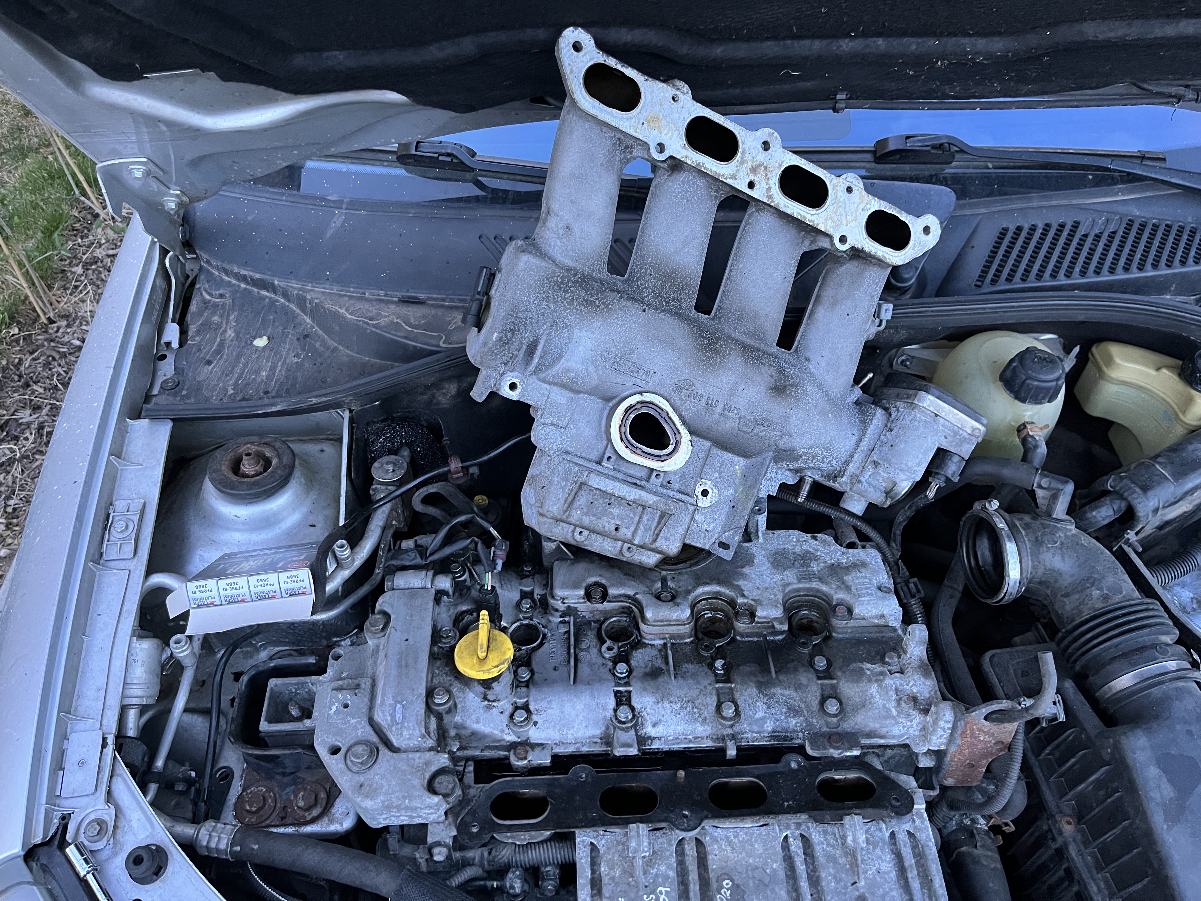

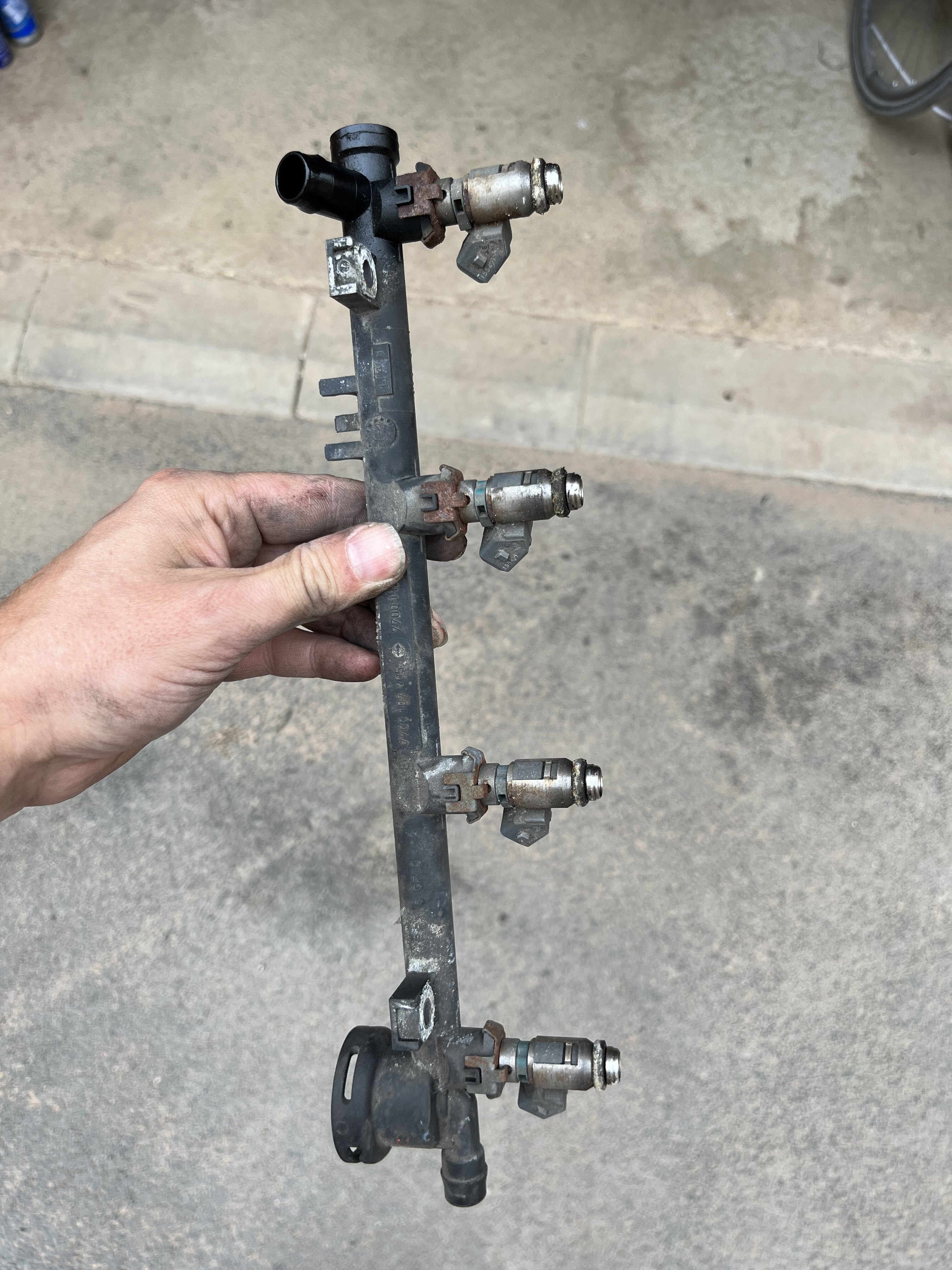

So today I was trying to cure the miss at idle and low revs. I thought, given the car looked to be intact original injectors I would do injectors first so:
out with the old:
And in with the new:
no change, (pain but i was going to do injectors anyway given the age and mileage) so started digging into the ignition side. Leads look brand new, plugs still to be checked, but the coil is a Renault part and cracked all along the bottom. Guess what I’m buying next…

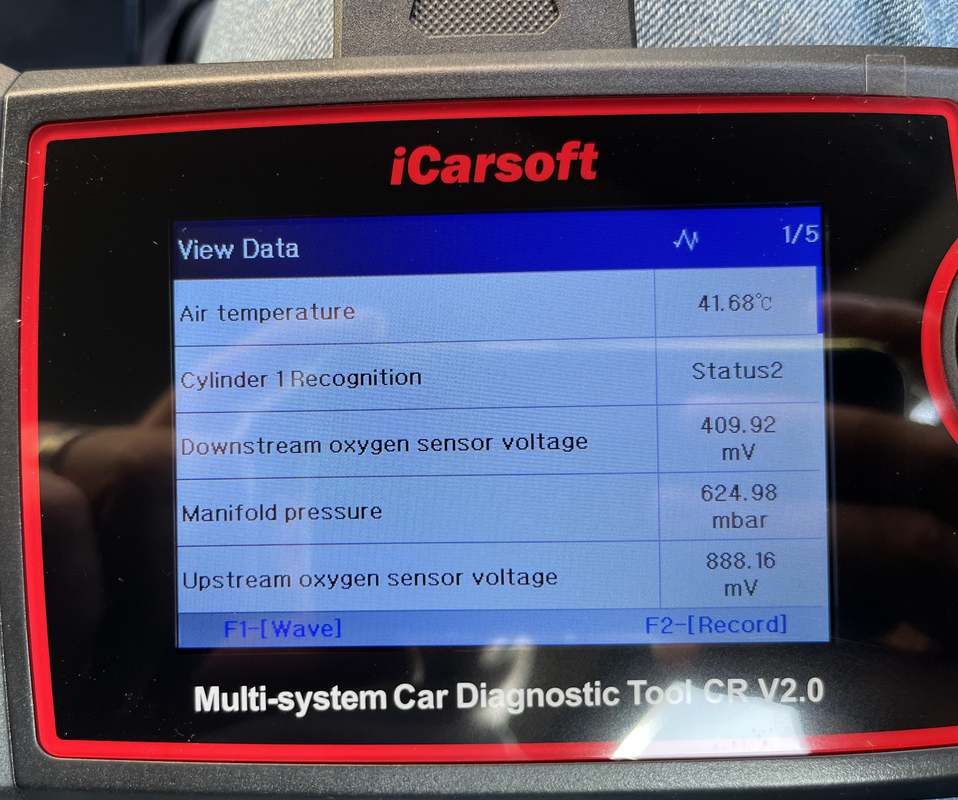

NO. Still lumpy on idle. The old plugs looked new but sooty as well.
No error codes but when idling, values are as follows:
manifold pressure is around 620mb at idle, and just over 1000mb with the engine off.
Upstream lambda oscillates between 19 and 890mv or so.
downstream lambda is pegged just over 400mv.
figuring I have wasted my money on plugs, injectors, leads and coil and should have had the valve timing checked as the first stop…

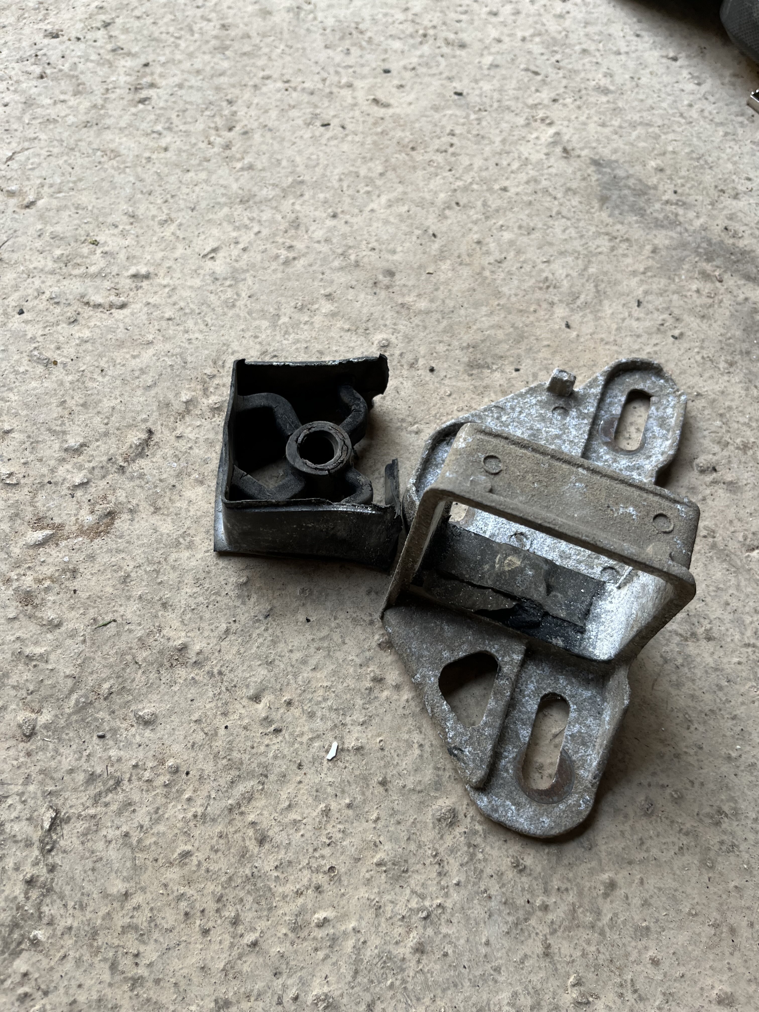

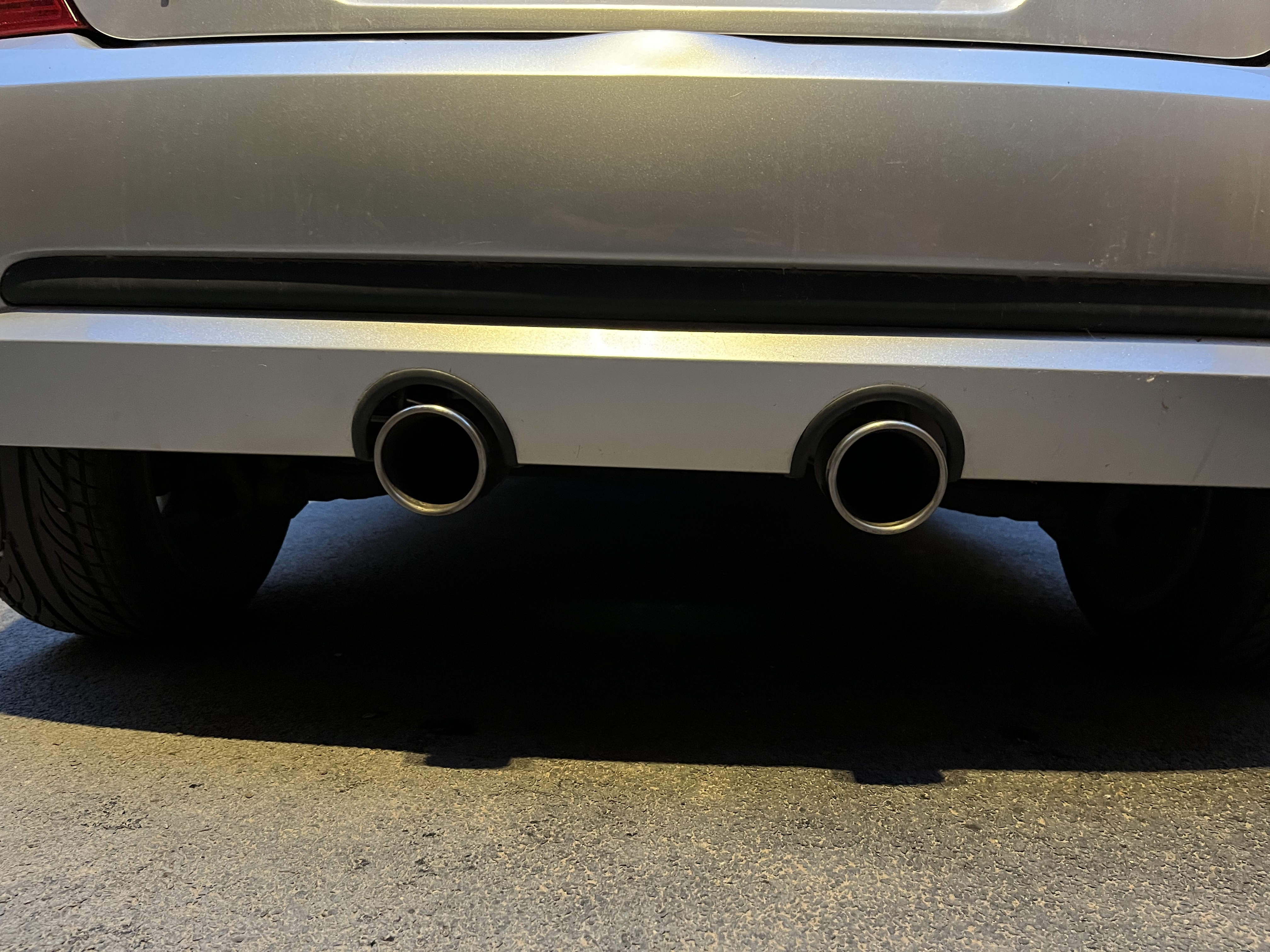

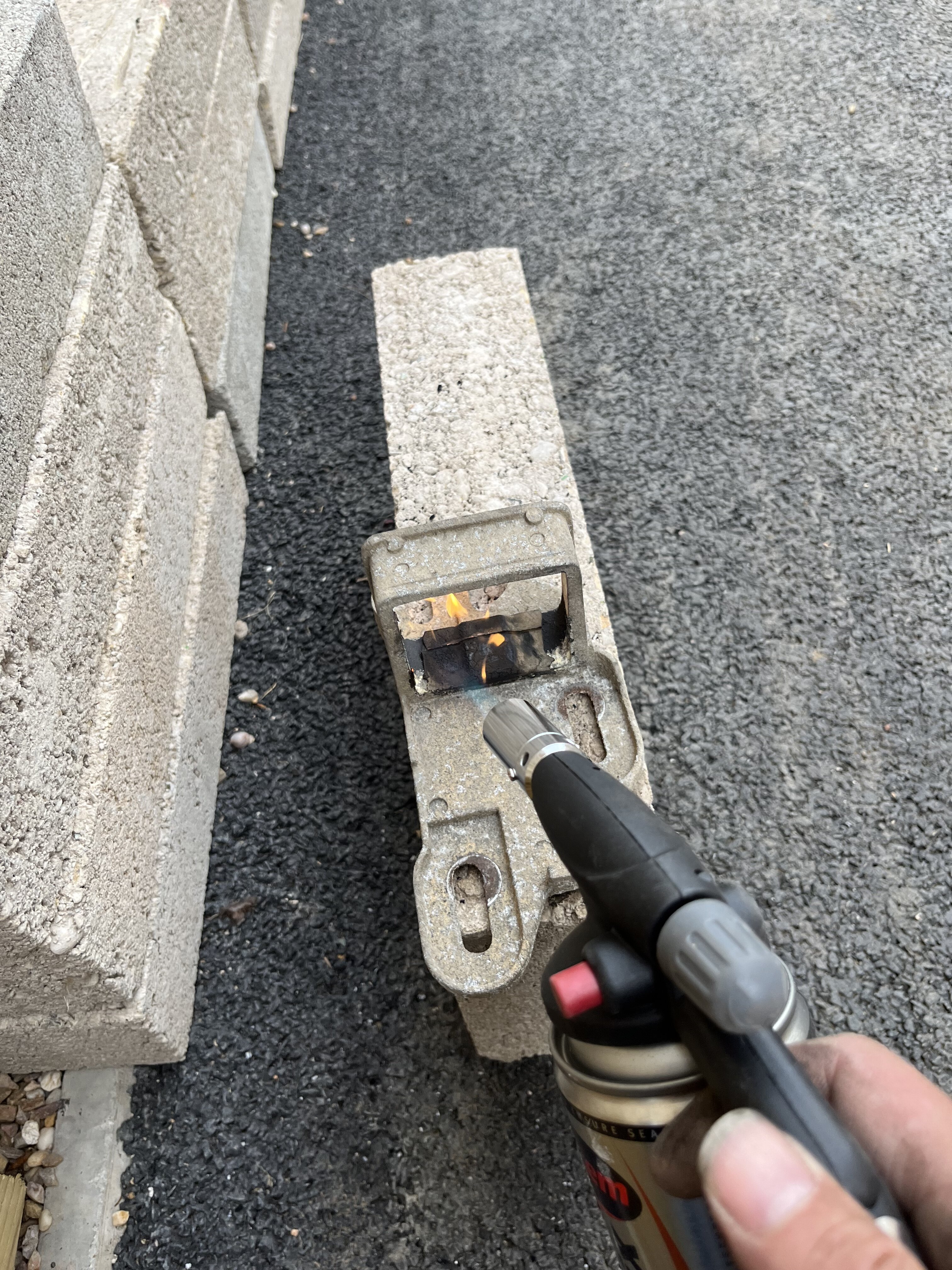

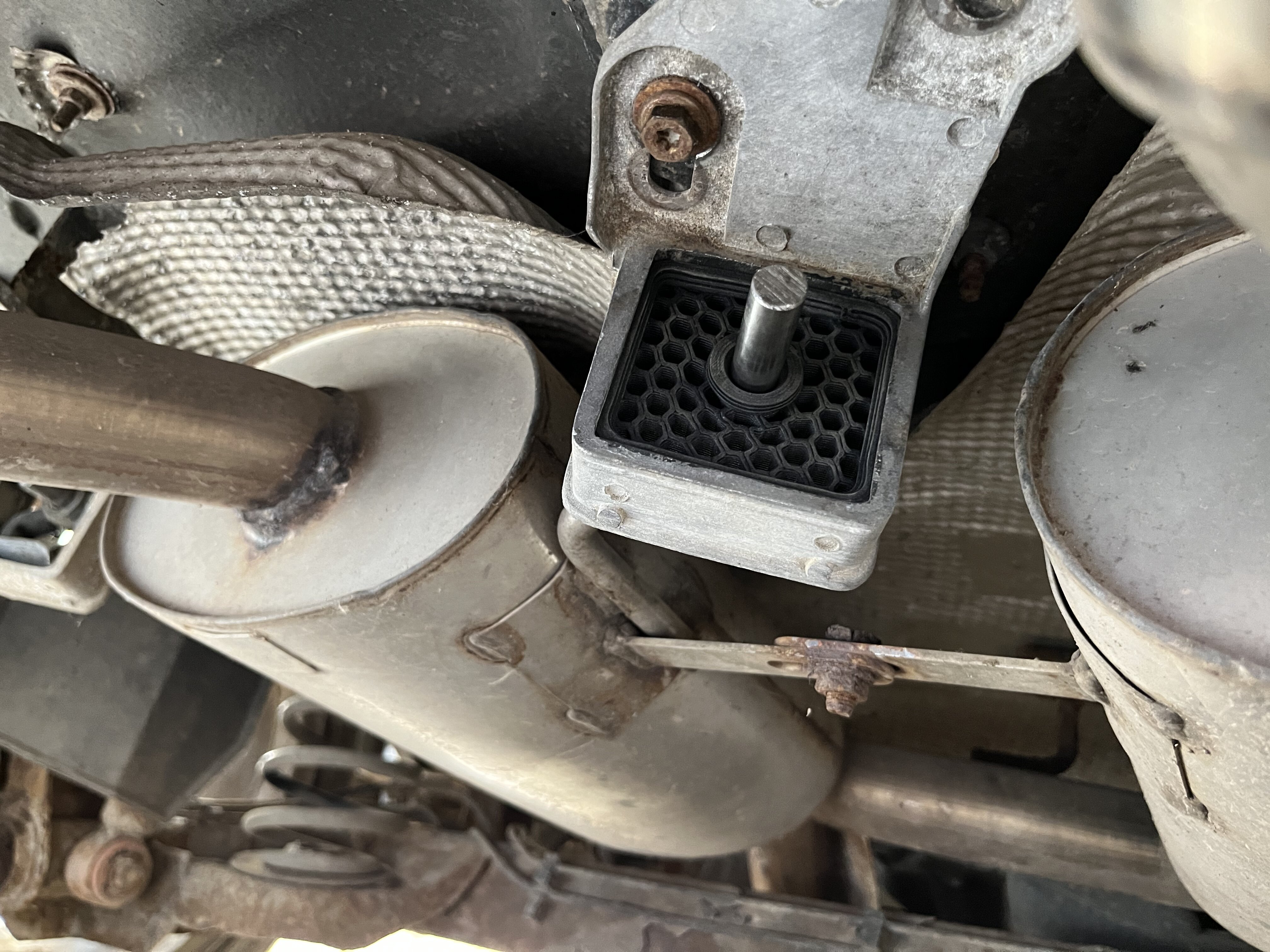

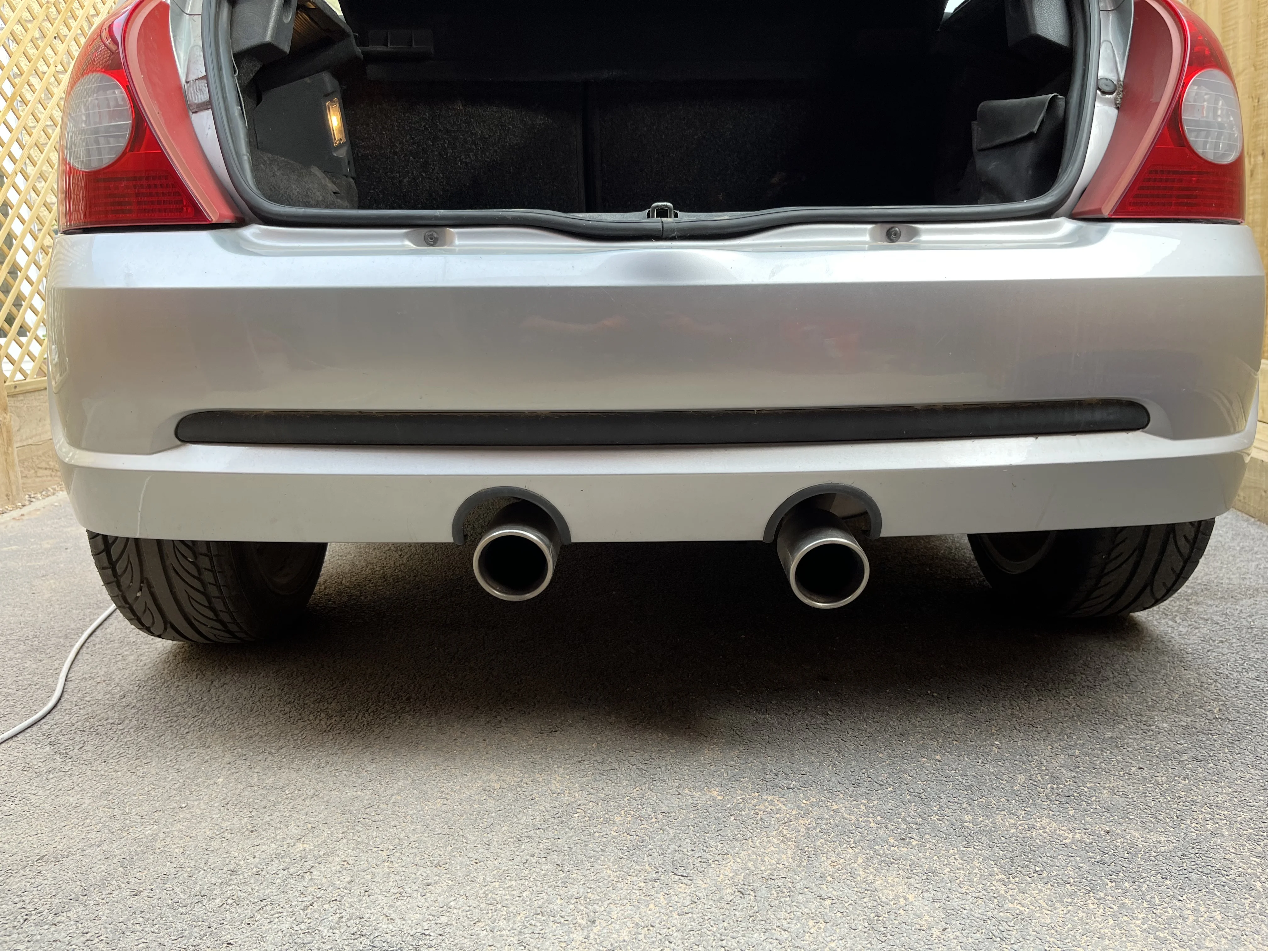

Today I sorted the exhaust.
Started here:
Caused by:
Did a bit of this:
Added a couple of these:
Not perfect but:
Sorted the loose heat shield too with a couple of huge stainless steel washers. Not rattling anymore…
im going to put a couple of tyres on it and see if it will pass an mot…

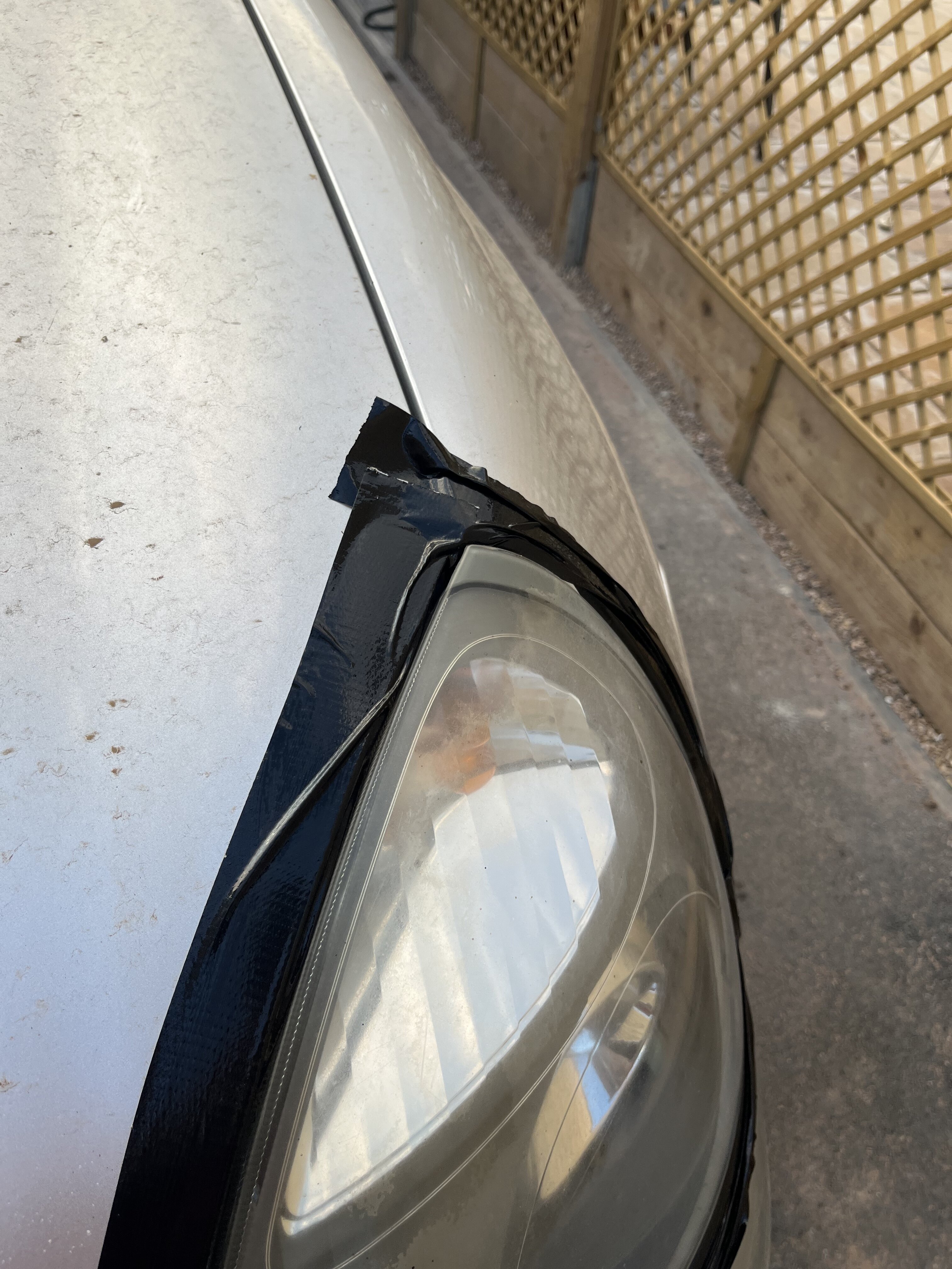

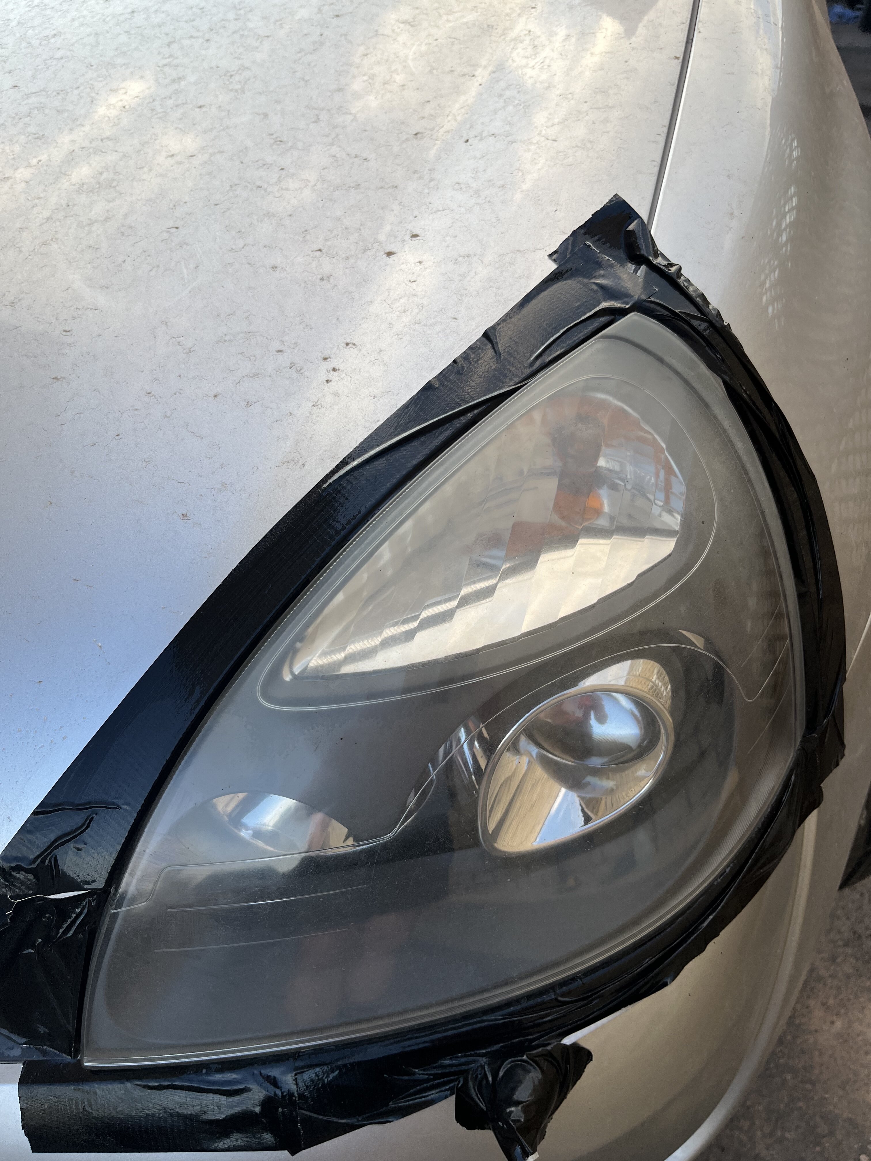

Oh and it did my favourite French car trick. Drive to the MOT garage is less than 15 mins. A sidelight bulb blew between home and the garage. How do they know to do that? 😜😂
