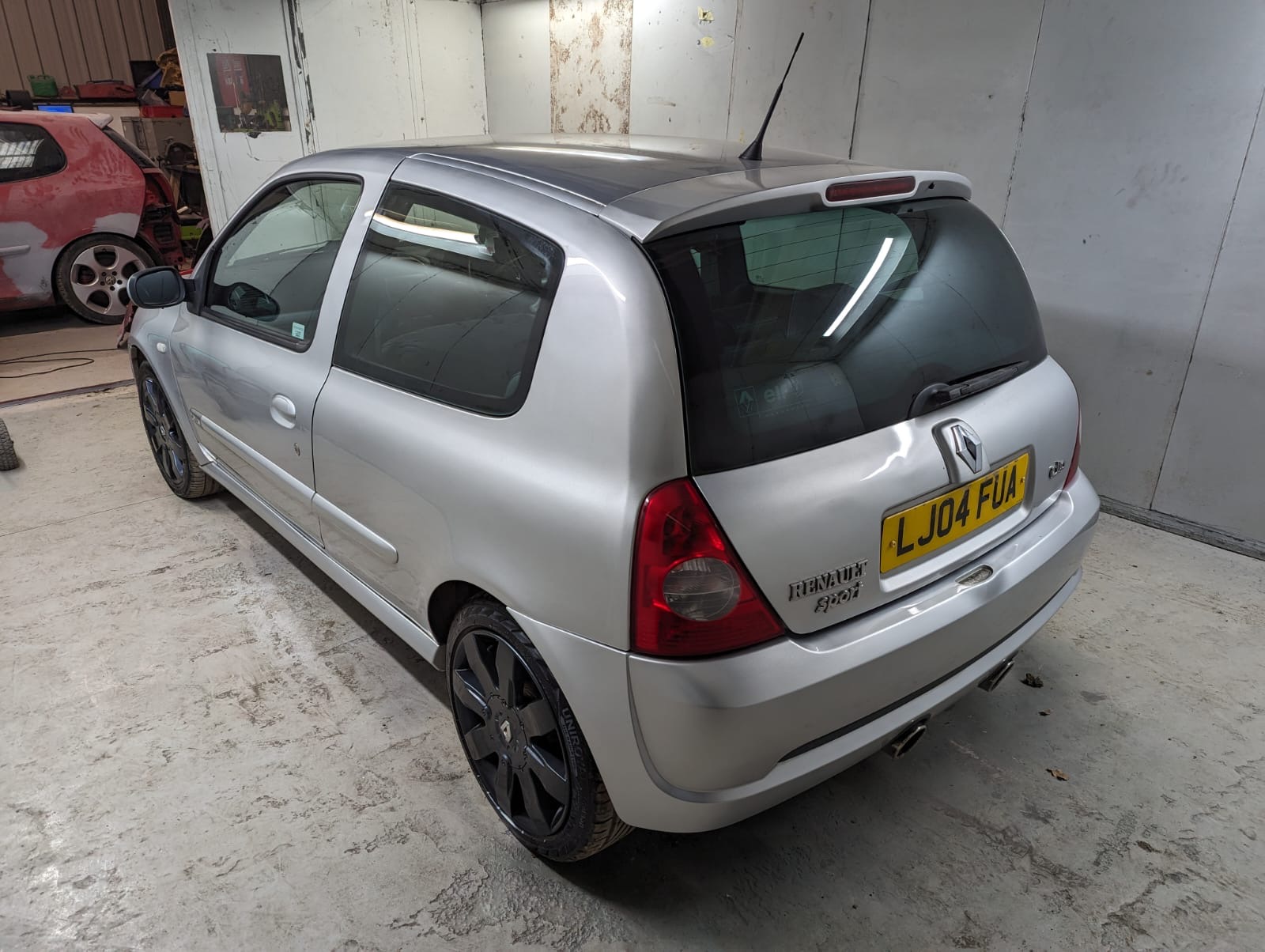

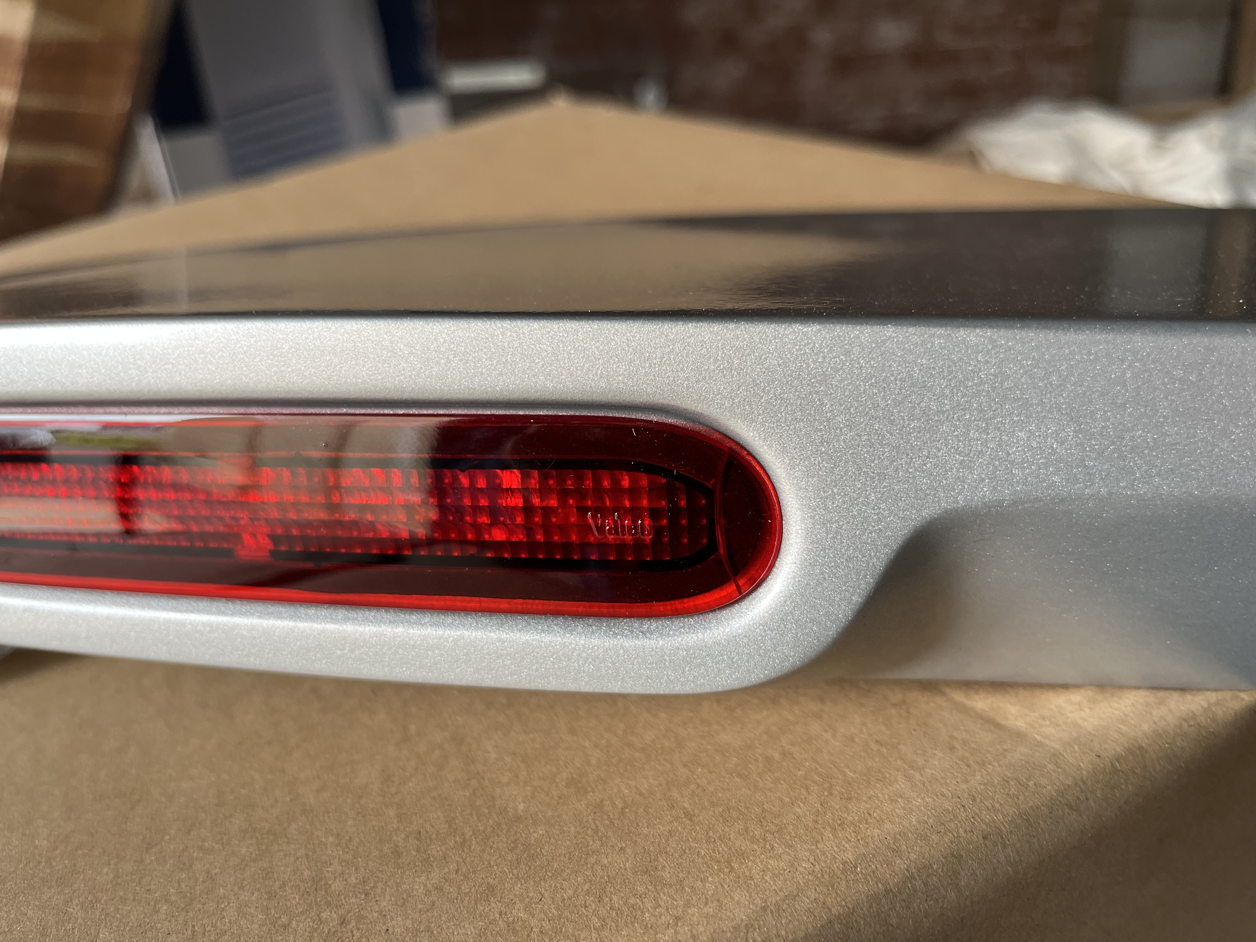

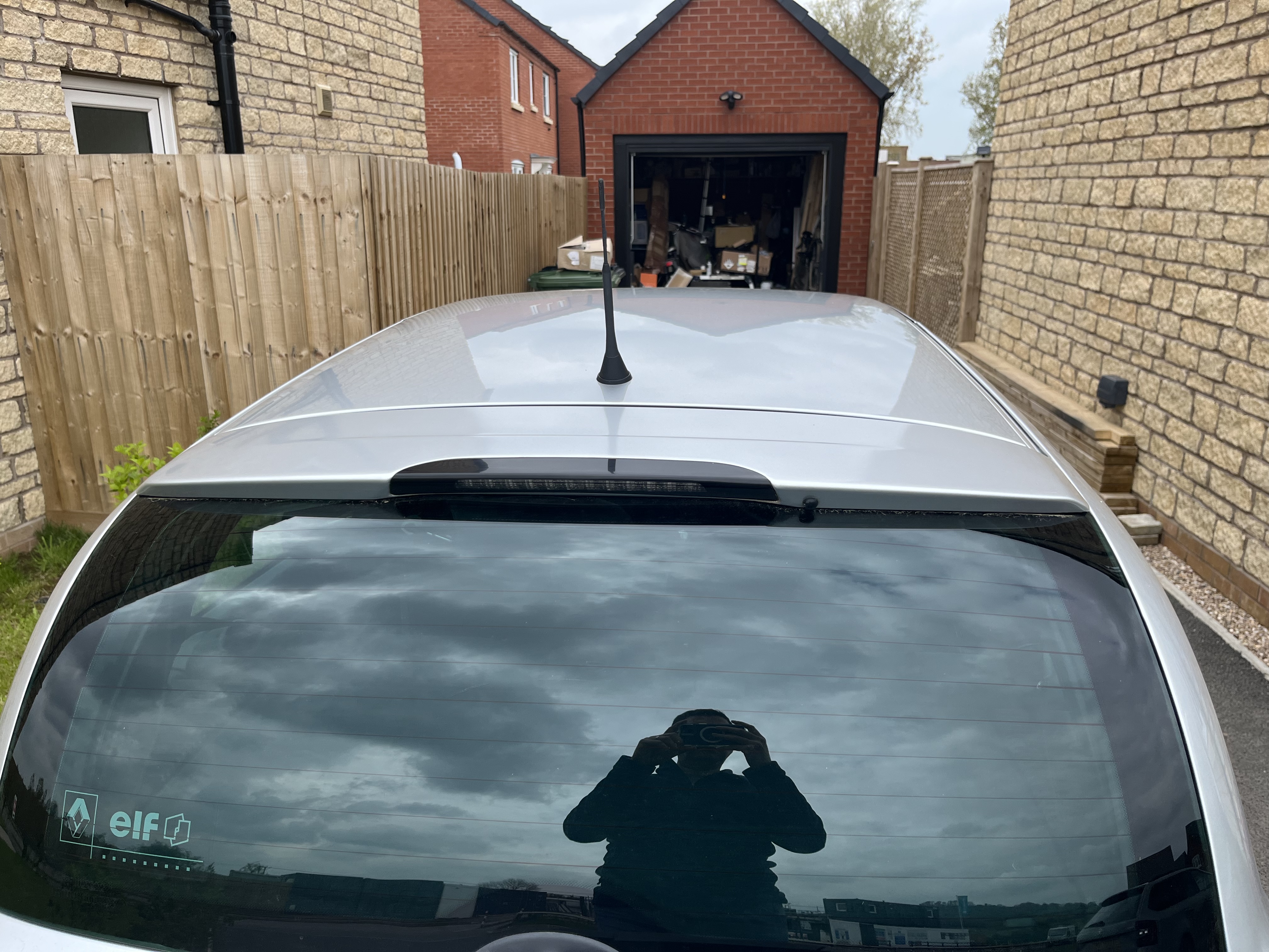

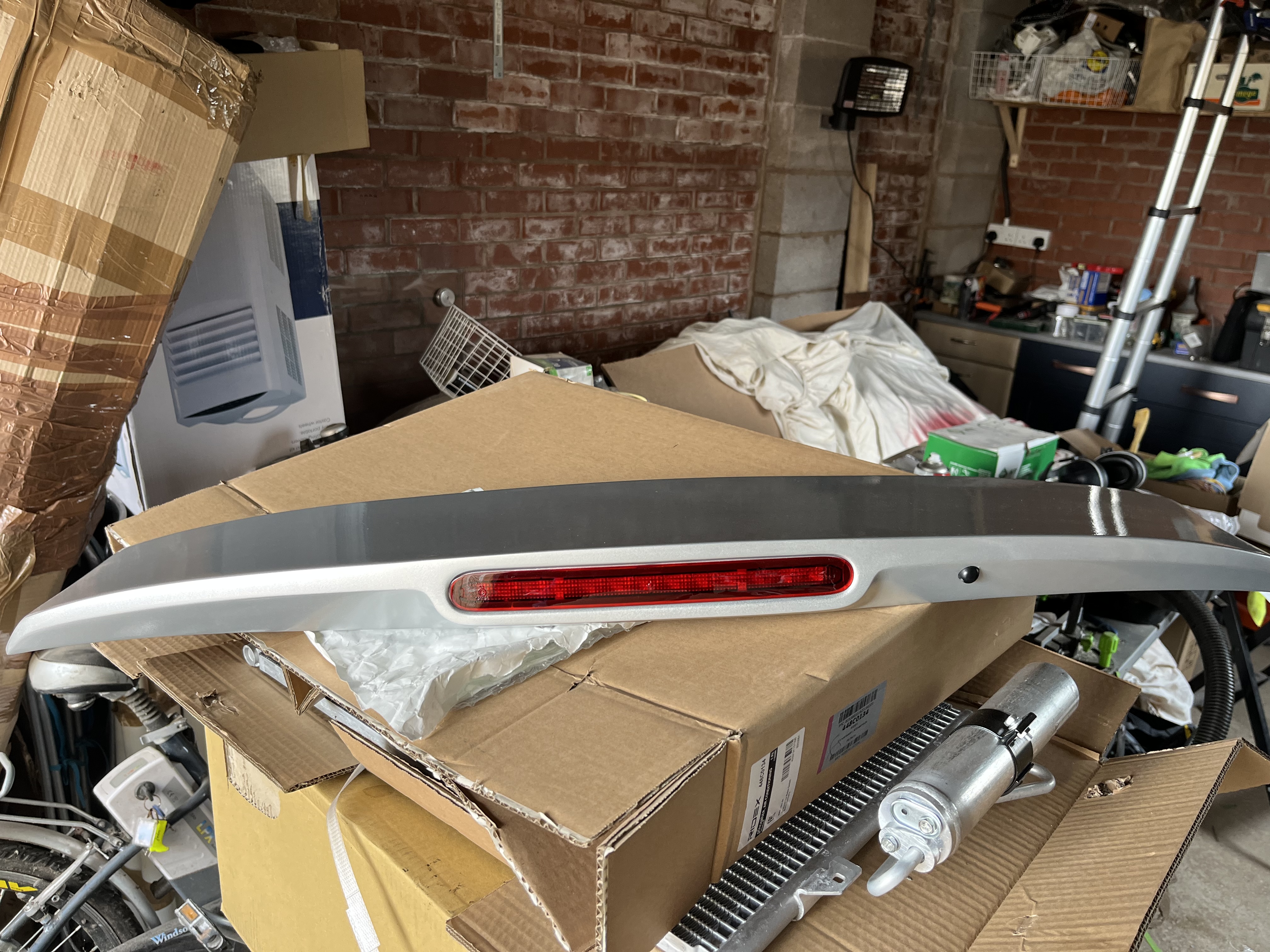

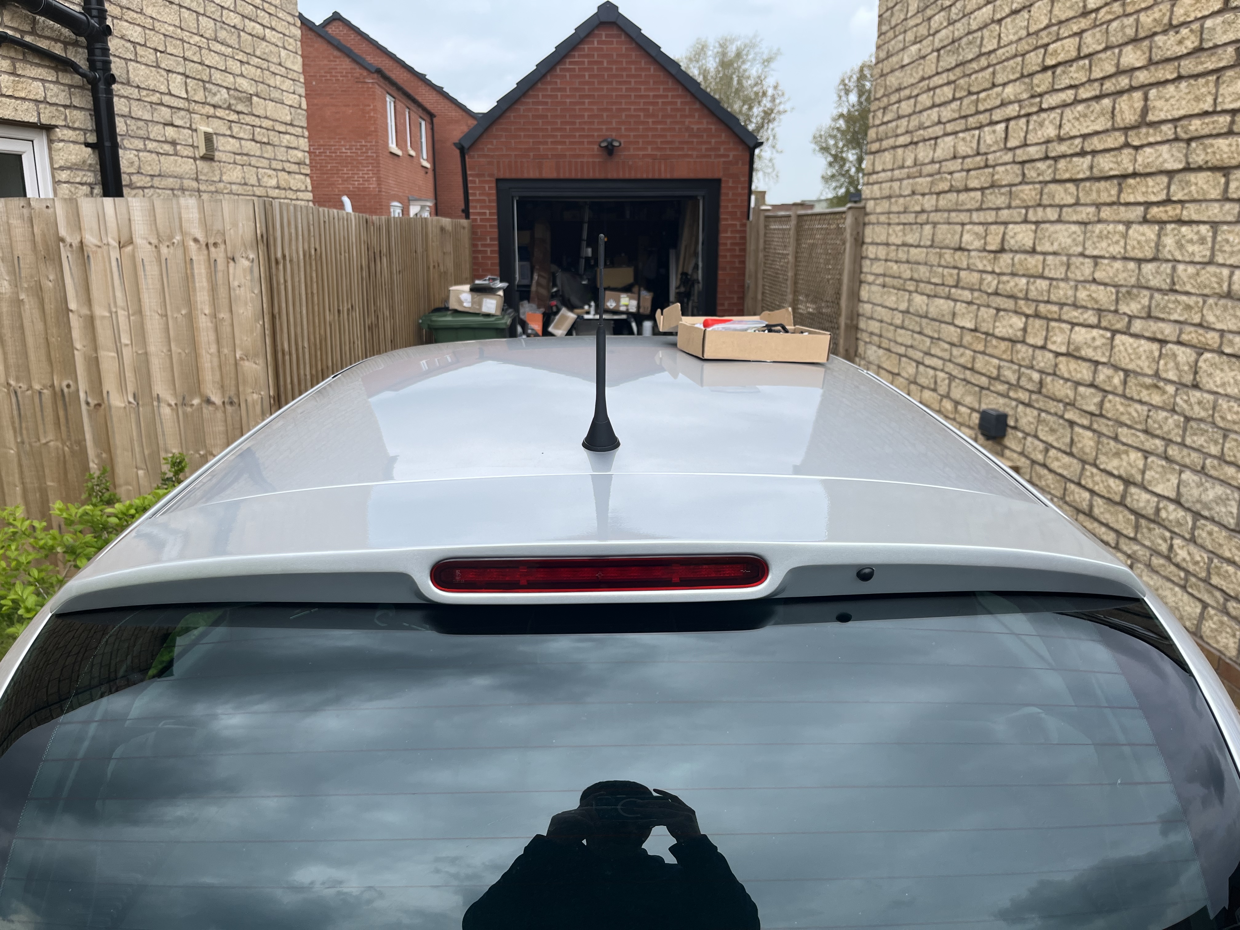

To celebrate, I have fitted my cup spoiler. That was a pig of a job. Did the team who designed it actually see a Clio tailgate in the process????
So from:
To:
Somehow I haven’t got the in between photos, but nothing much to see.

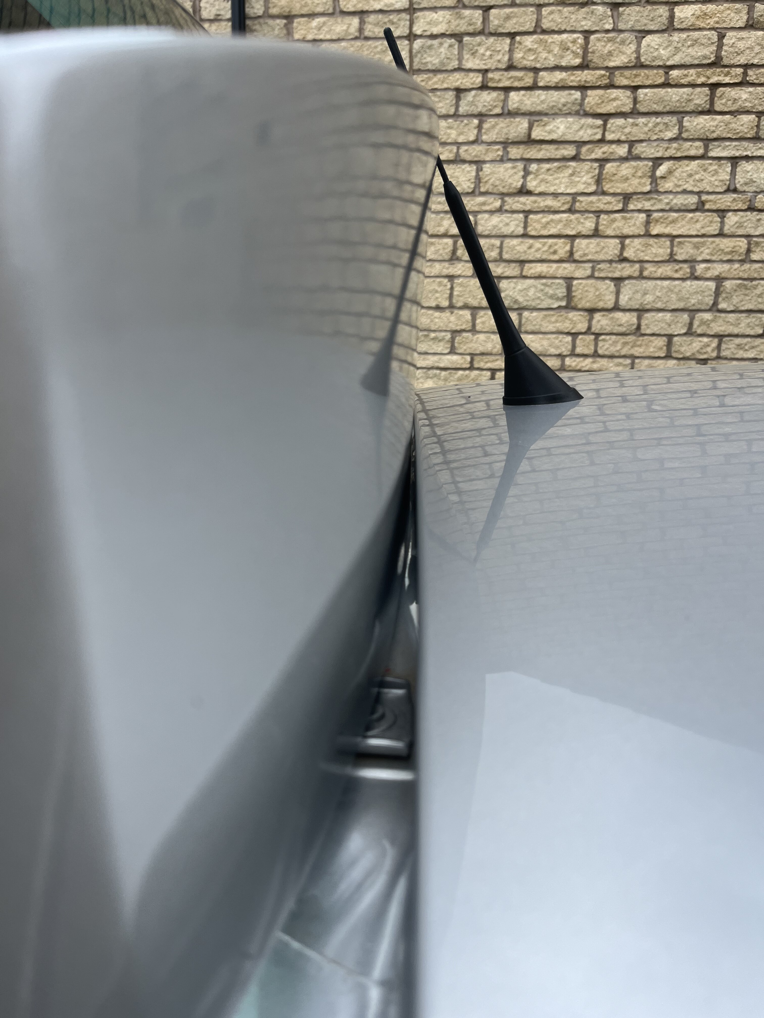

It took some adjusting to miss the rear edge of the roof:
But it does miss now, honest.
I even managed to tweak the aftermarket aerial base so they don’t touch!
Happy days. Also, at no point after fitting did I pull out the washer jet to check, disconnect the hose inside the spoiler, have to remove and refit. Definitely not. There are no photos to show otherwise….🤥
So I now have a Pseudo FF!!!

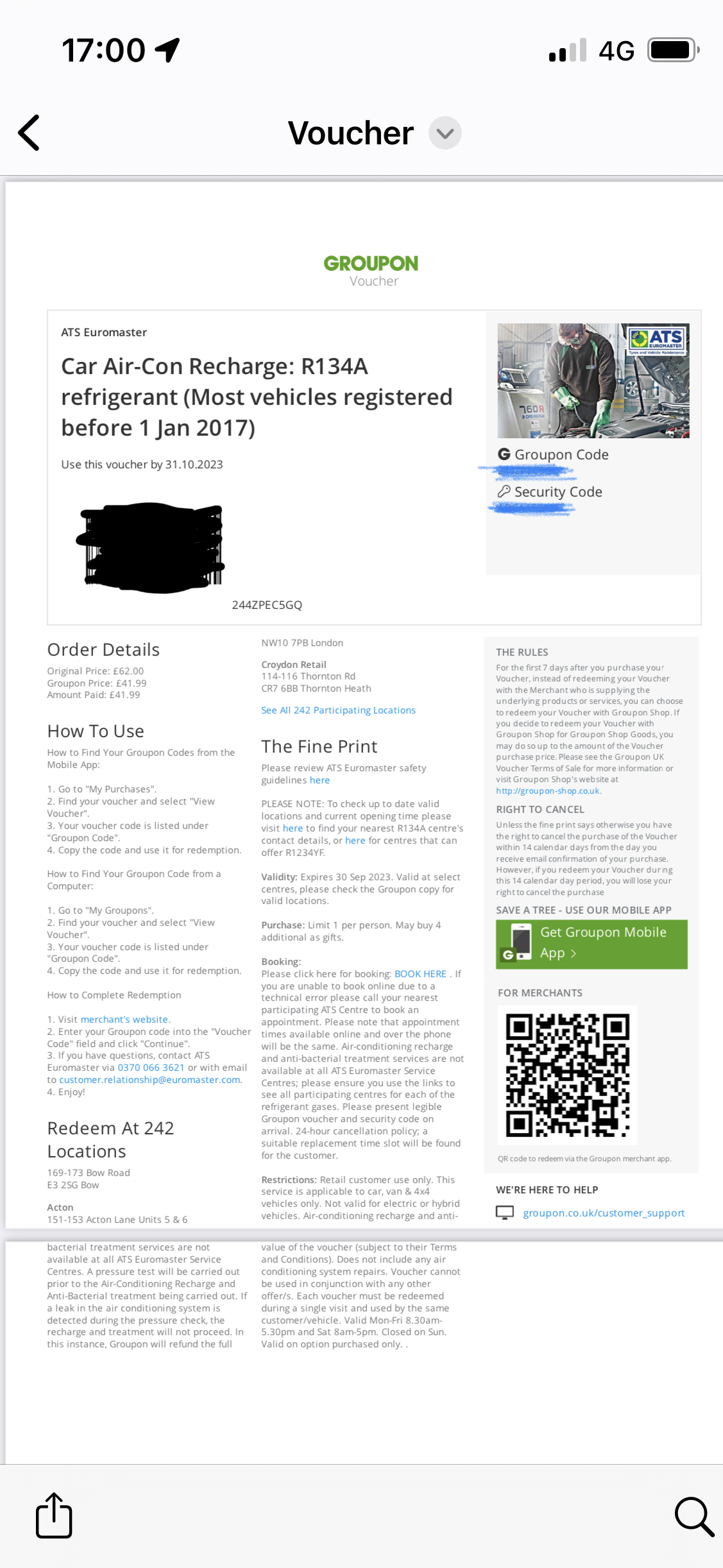

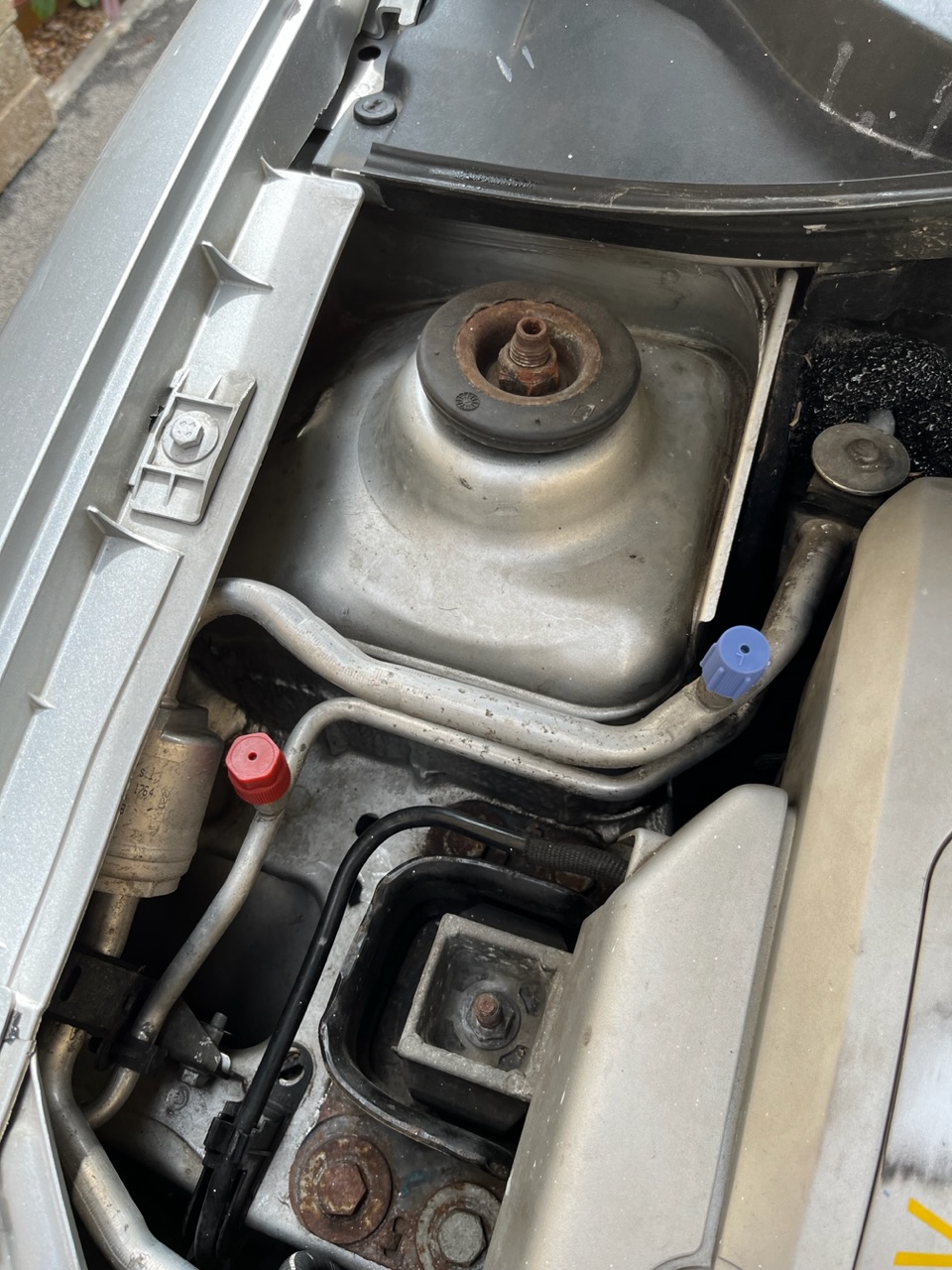

I went for a road trip for work down to Penzance and the Clio performed faultlessly so pretty happy with that! While I was up there I saw this offer and I was staying right next to an ATS so it seemed rude not to:
Aircon is now ice cold! Yay!

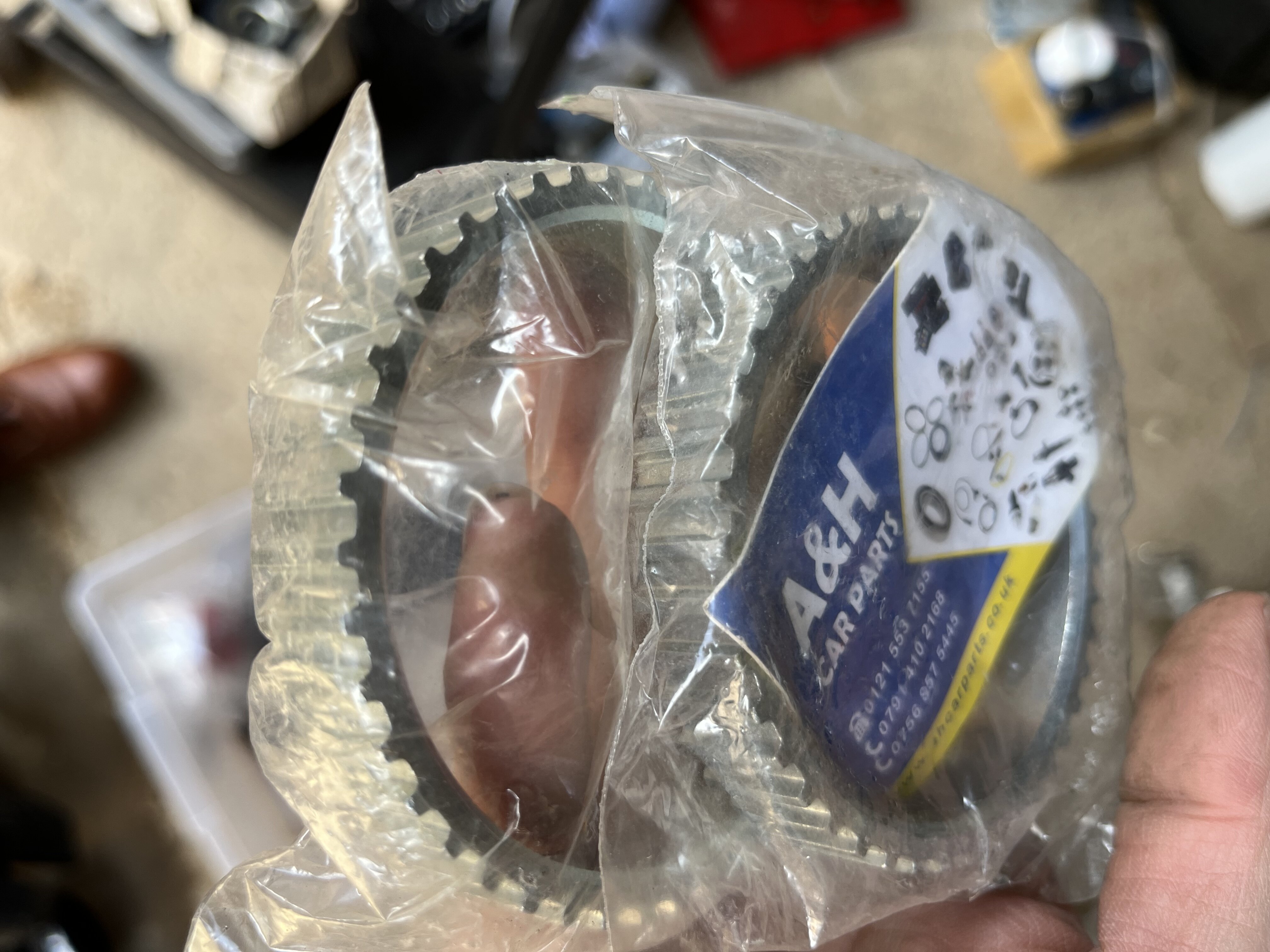

On the way back I did quite a bit of Facebook parts collecting:
That lot should keep me busy for a while.
Apart from the abs rings they are all genuine parts too so really happy about the haul, for what I consider a very fair price!

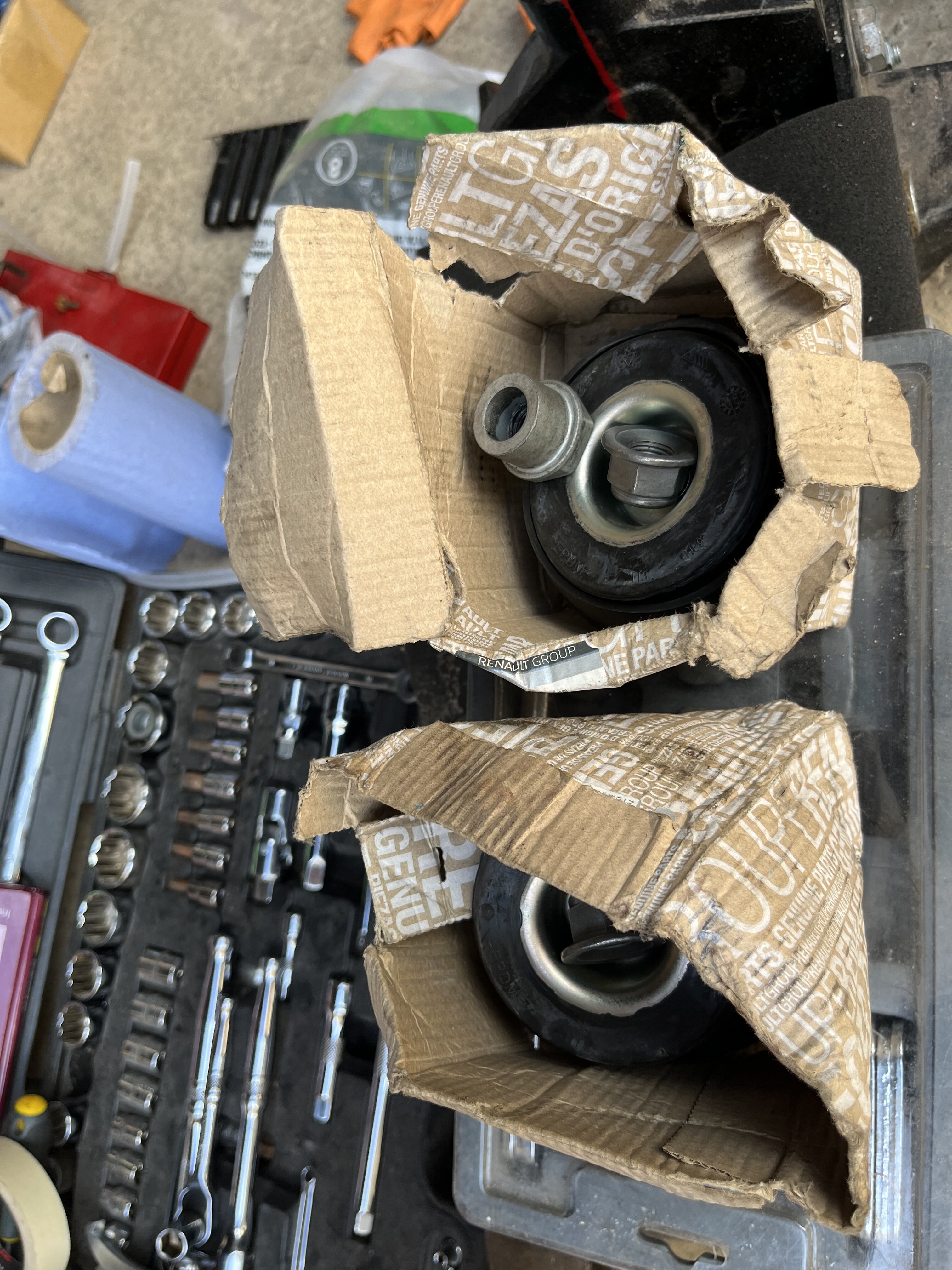

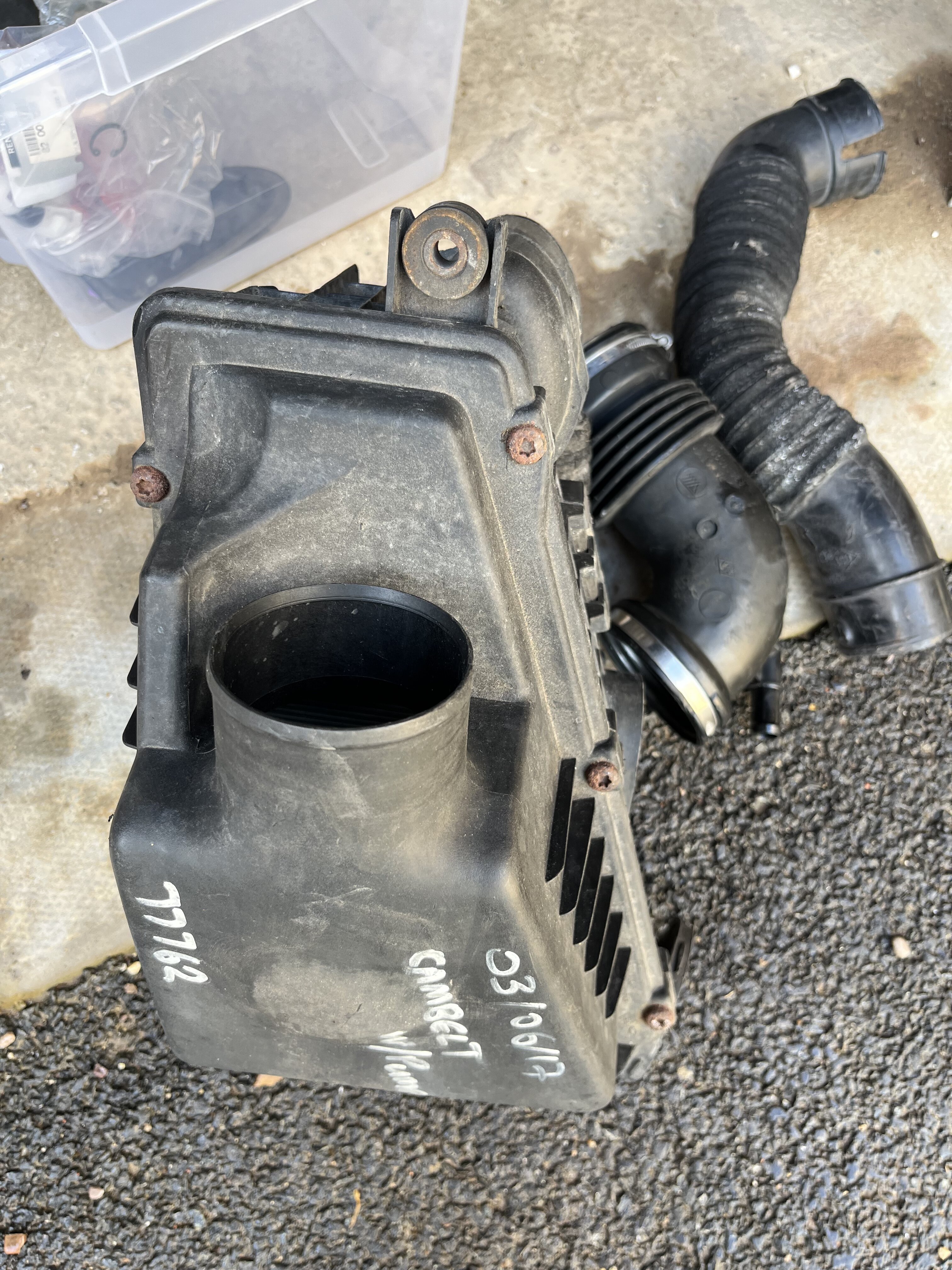

In the box there was also:

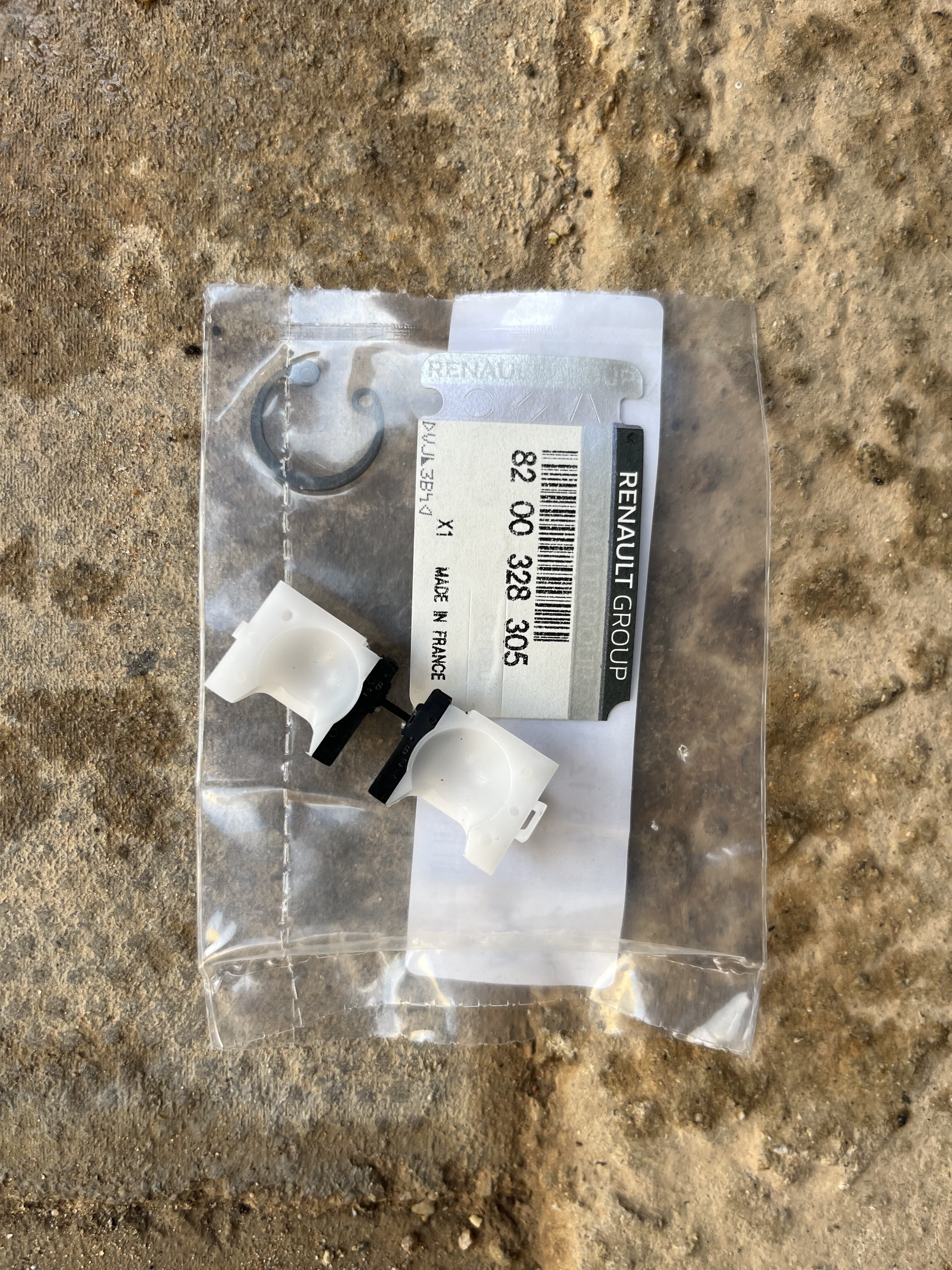

Obviously one is a circlip, but any idea what the plastic part is or where it and the circlip are for? 😁
Mr Underhill
On the way back I did quite a bit of Facebook parts collecting:View attachment 1642032
The plastic bush is where your gear selector shift rod sits. The circlip holds the bush in.

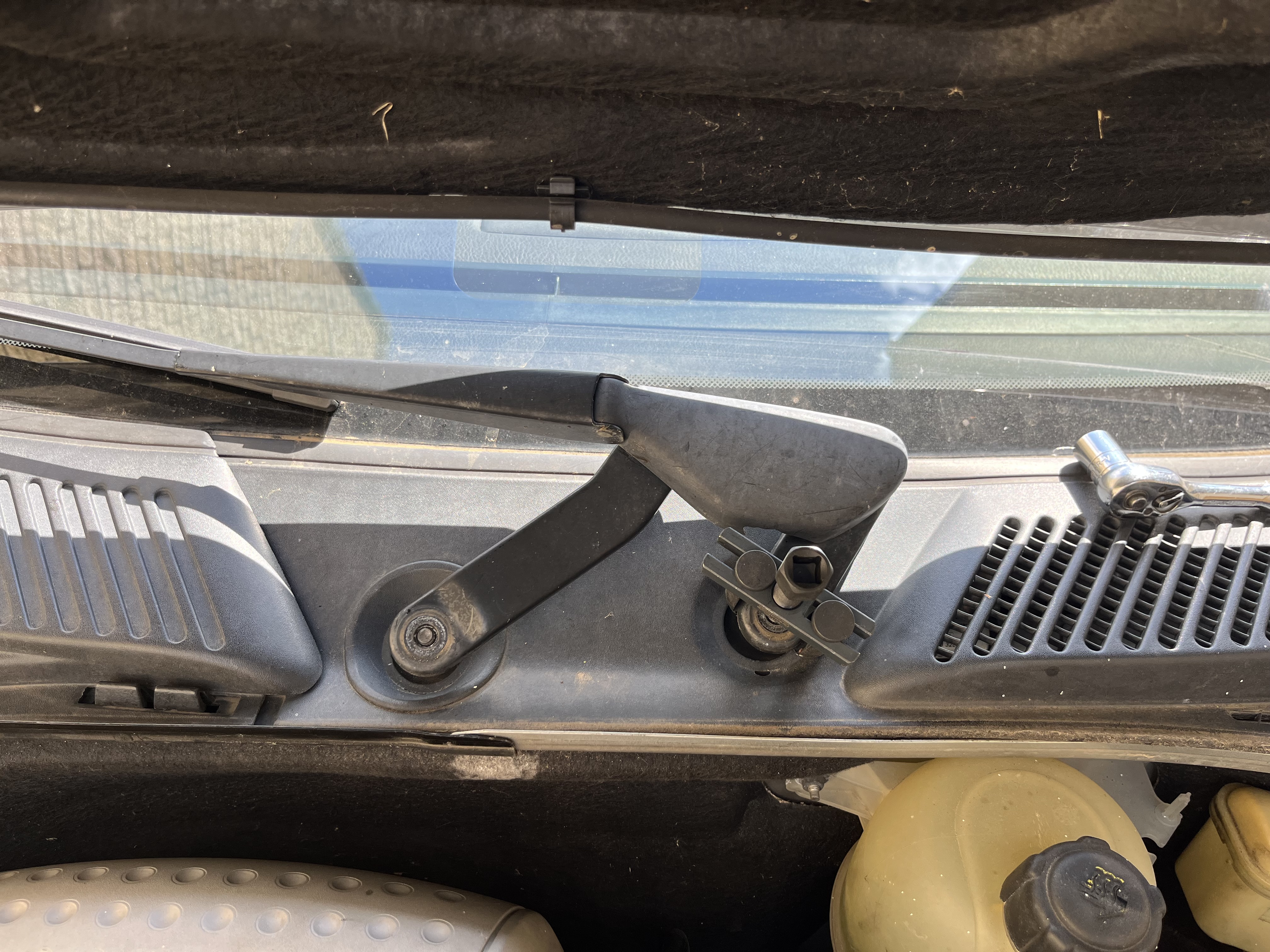

Broke my wiper removal tool tho so no washer pump change today. ☹️
Brian J
  Clio 182
Wiper removal tool returned to Amazon and refunded, and a better one bought.

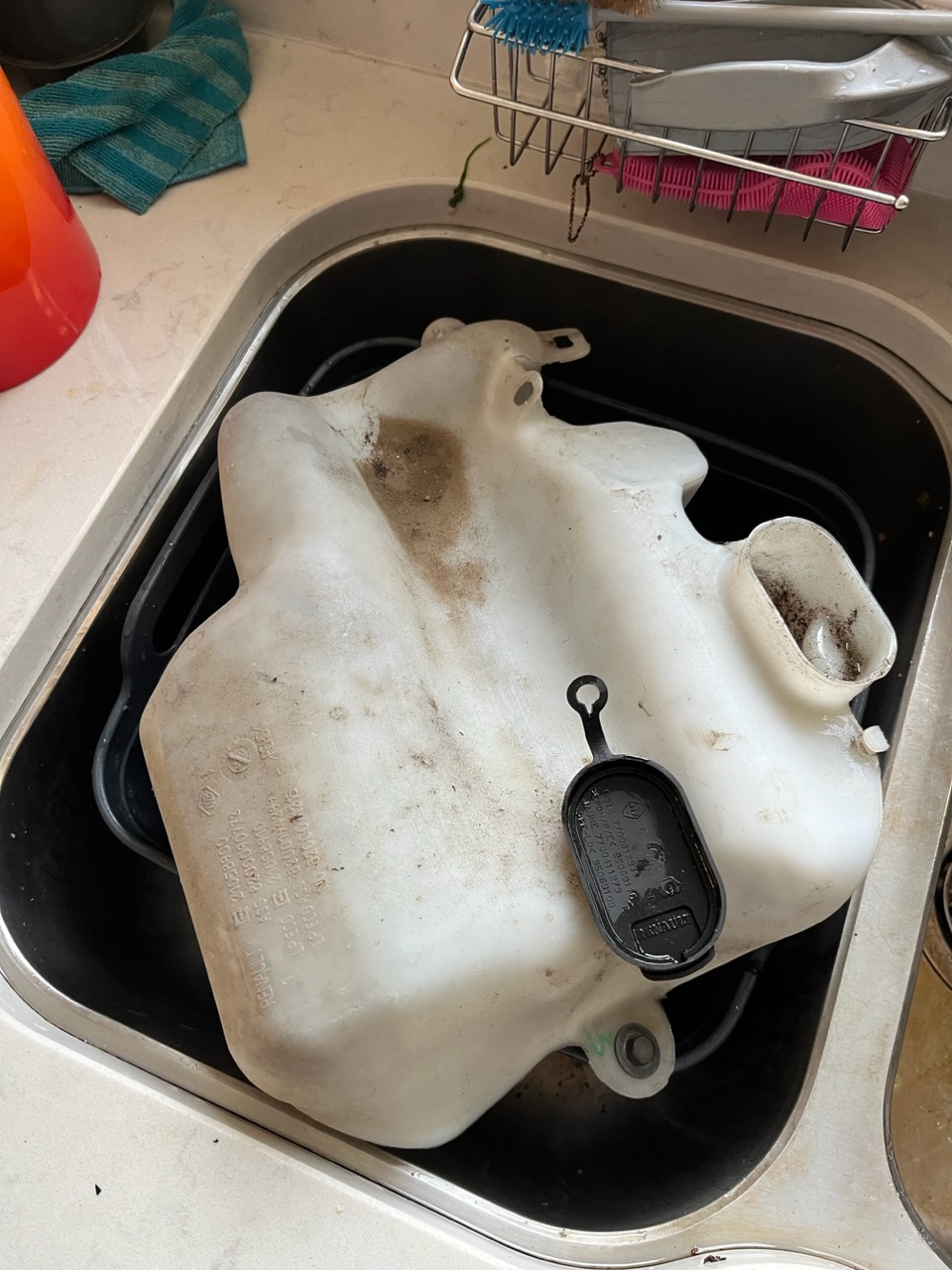

This led to:
Quick scrub:
Cleared the tubes with my bike pump, checking that water sprayed out of both headlight washers. All good.
Refitted:
I was all happy with working washers and headlight wash, and then this started:
It’s leaking constantly out of the washer nozzle. What’s doing that? Crappy replacement pump? (it WAS Ridex from AUTODOC), duff washer jet? Is there a valve in between?

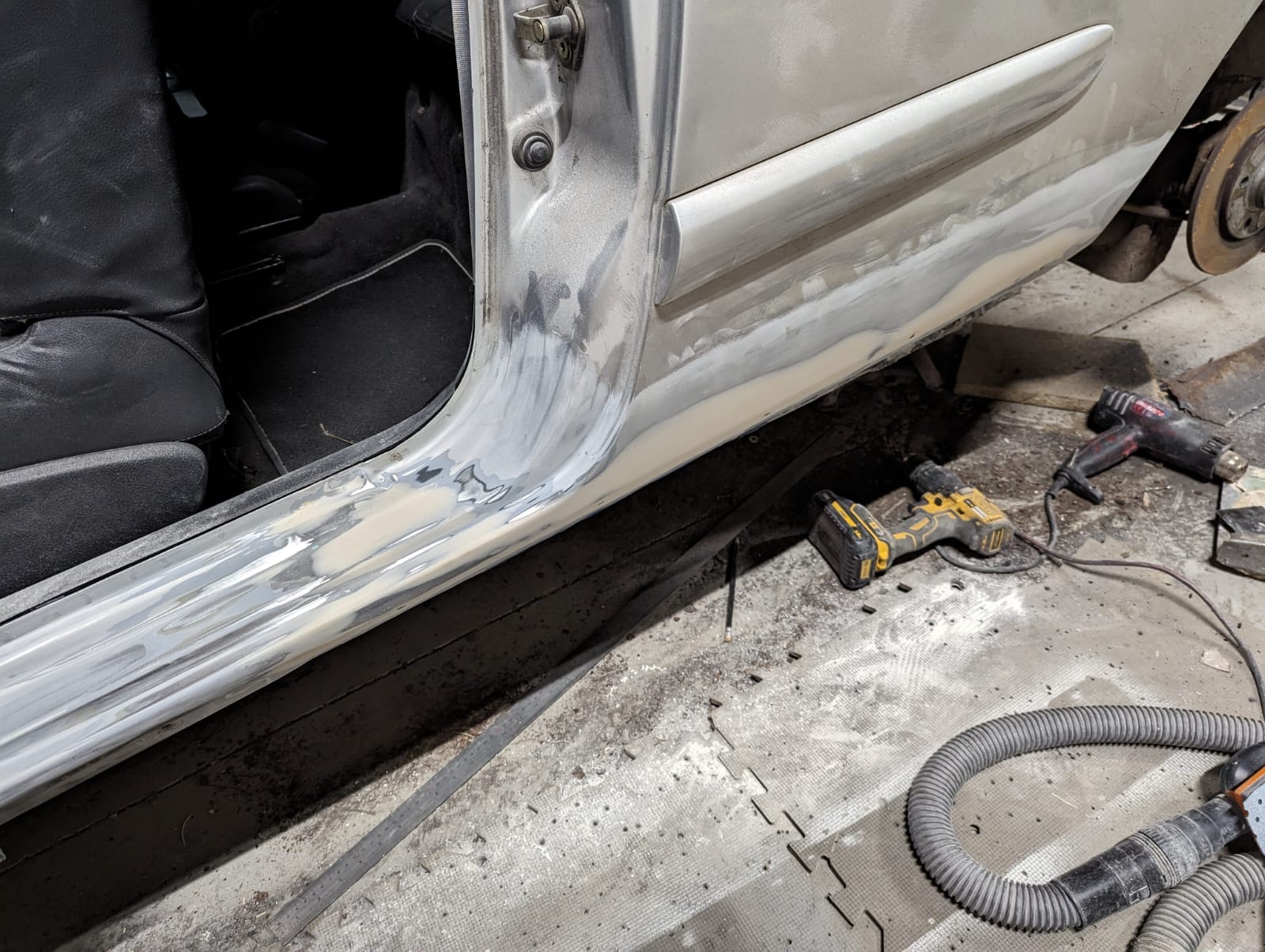

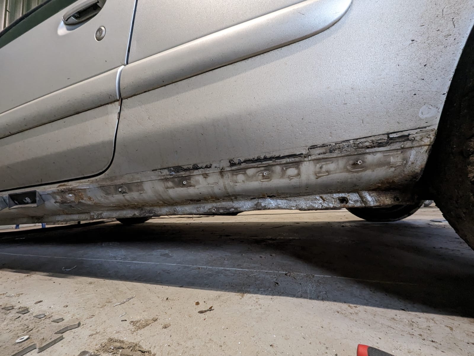

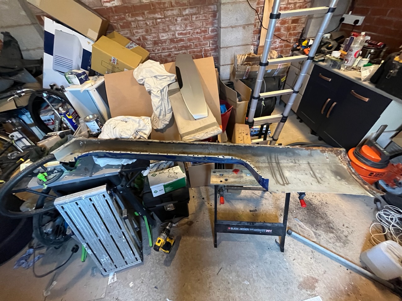

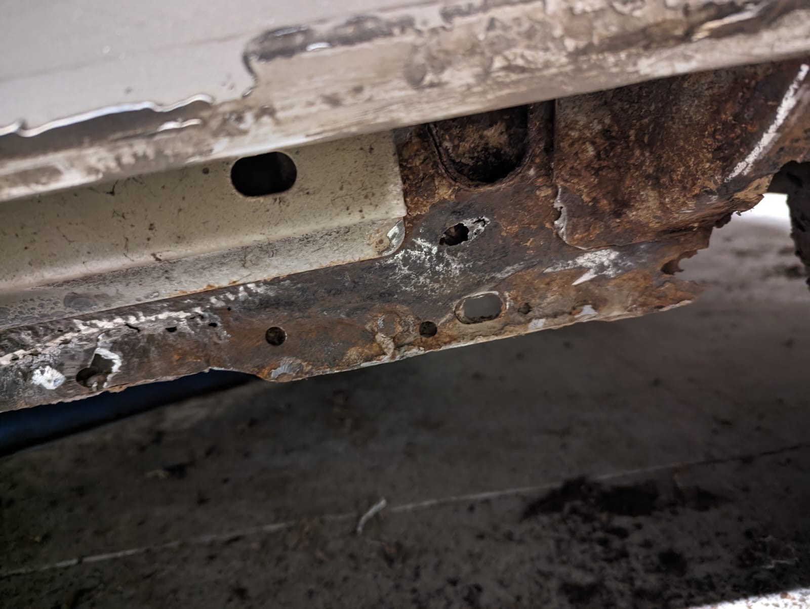

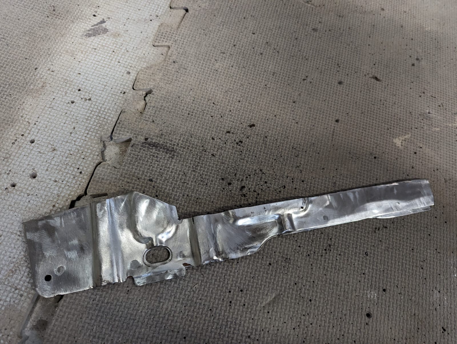

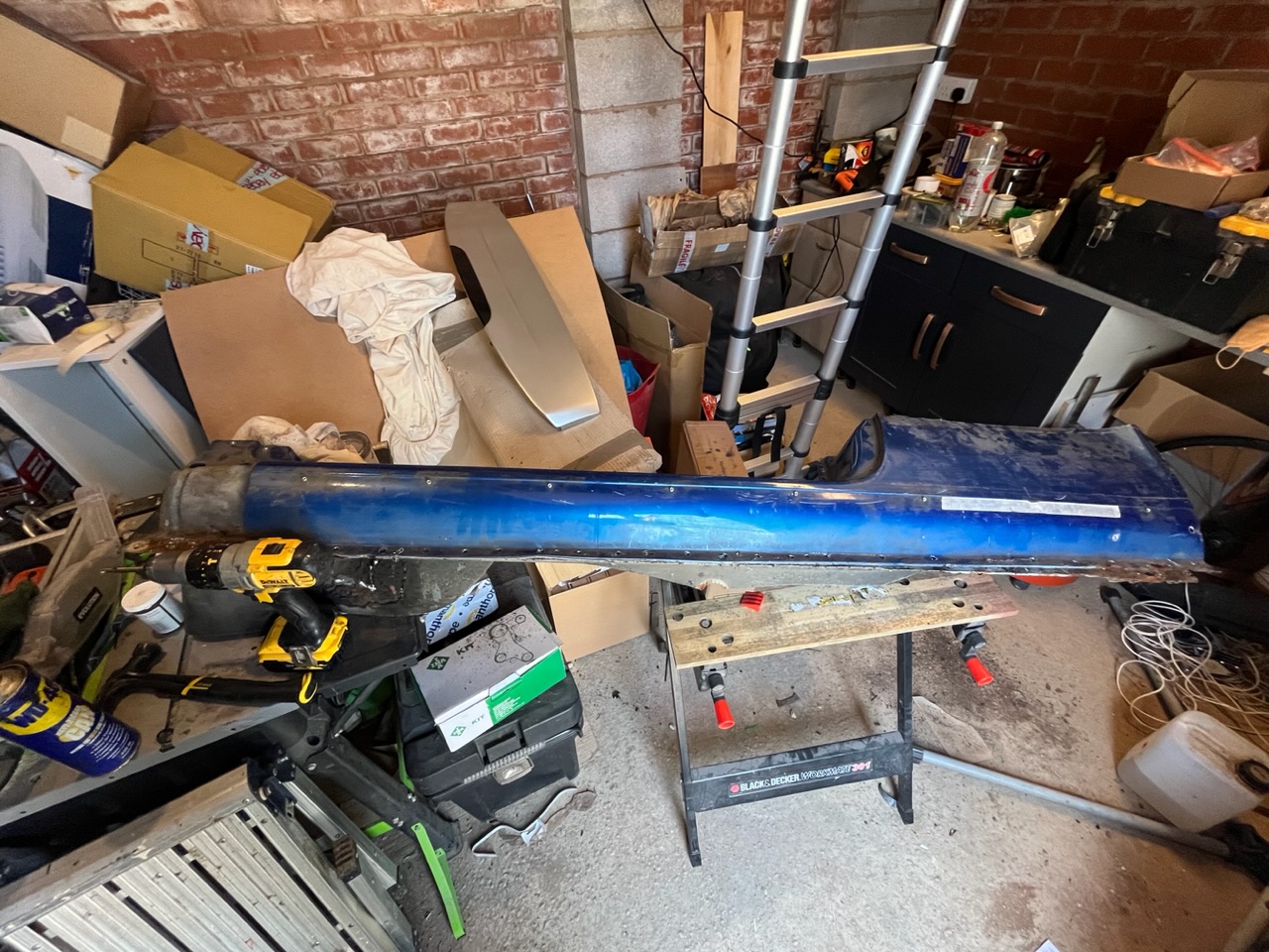

I have had a passenger sill cut for some time, to repair the rust from a previous 1/4 replacement that was never rust protected.
So:
Plus a lot of spot welds drilled,
Turned into:
The rust is surface, so I will remove it with some citric acid solution, prior to painting and prepping for fitting.
I have a mate who is a talented bodywork guy, so hopefully I can talk him into helping with welding, which is well out of my comfort zone!

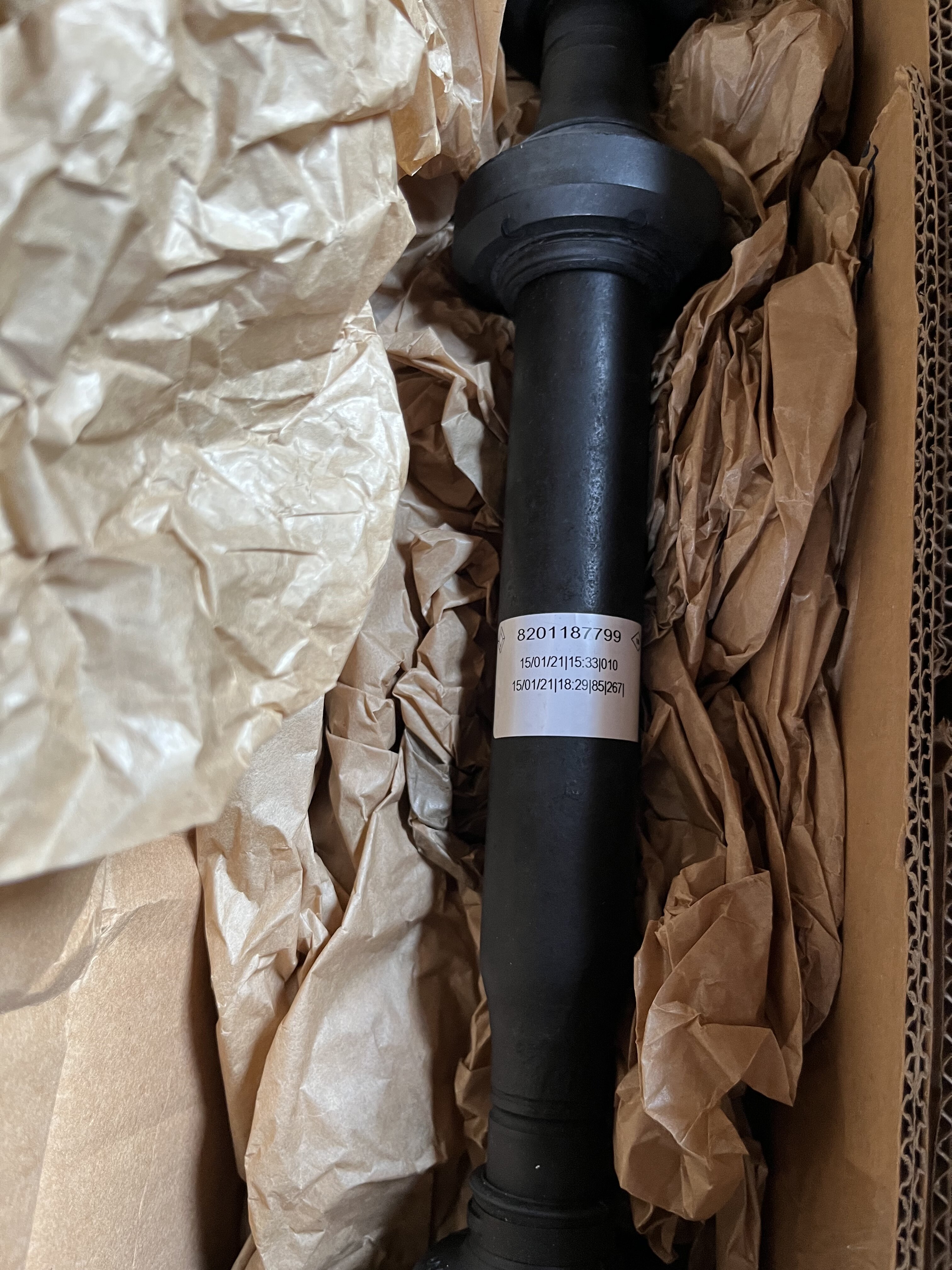

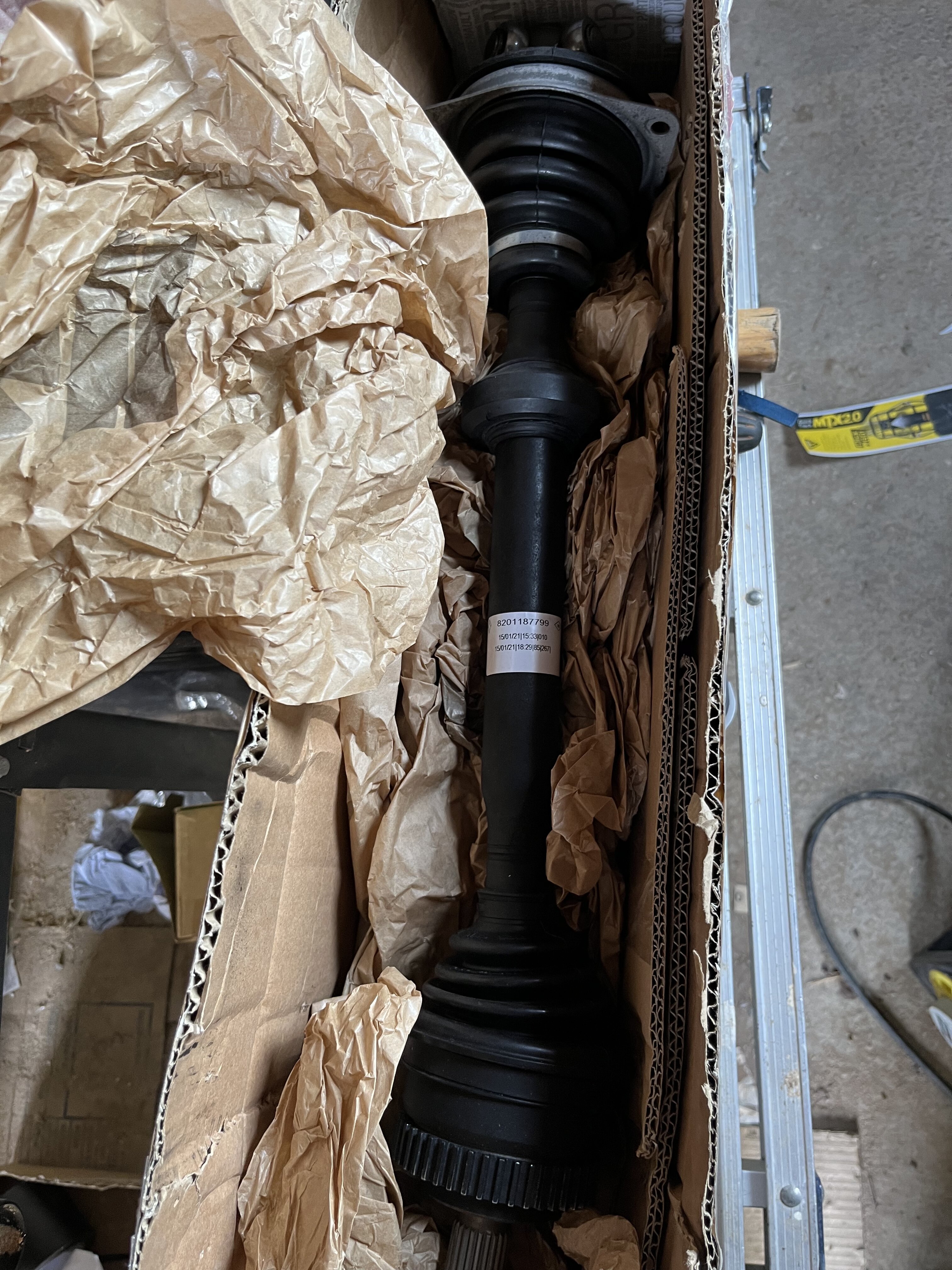

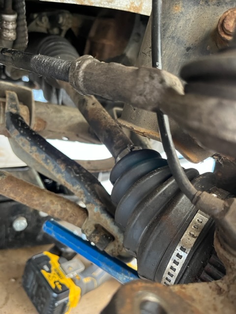

First up was my hard won NOS passenger drive shaft. (Both boots shot on the old one and grease and gearbox oil everywhere was getting tiresome.
The O/S driveshaft outer boot was also worse for wear due to some careless span wrong by a previous owner so a new GKN one was fitted:

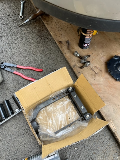

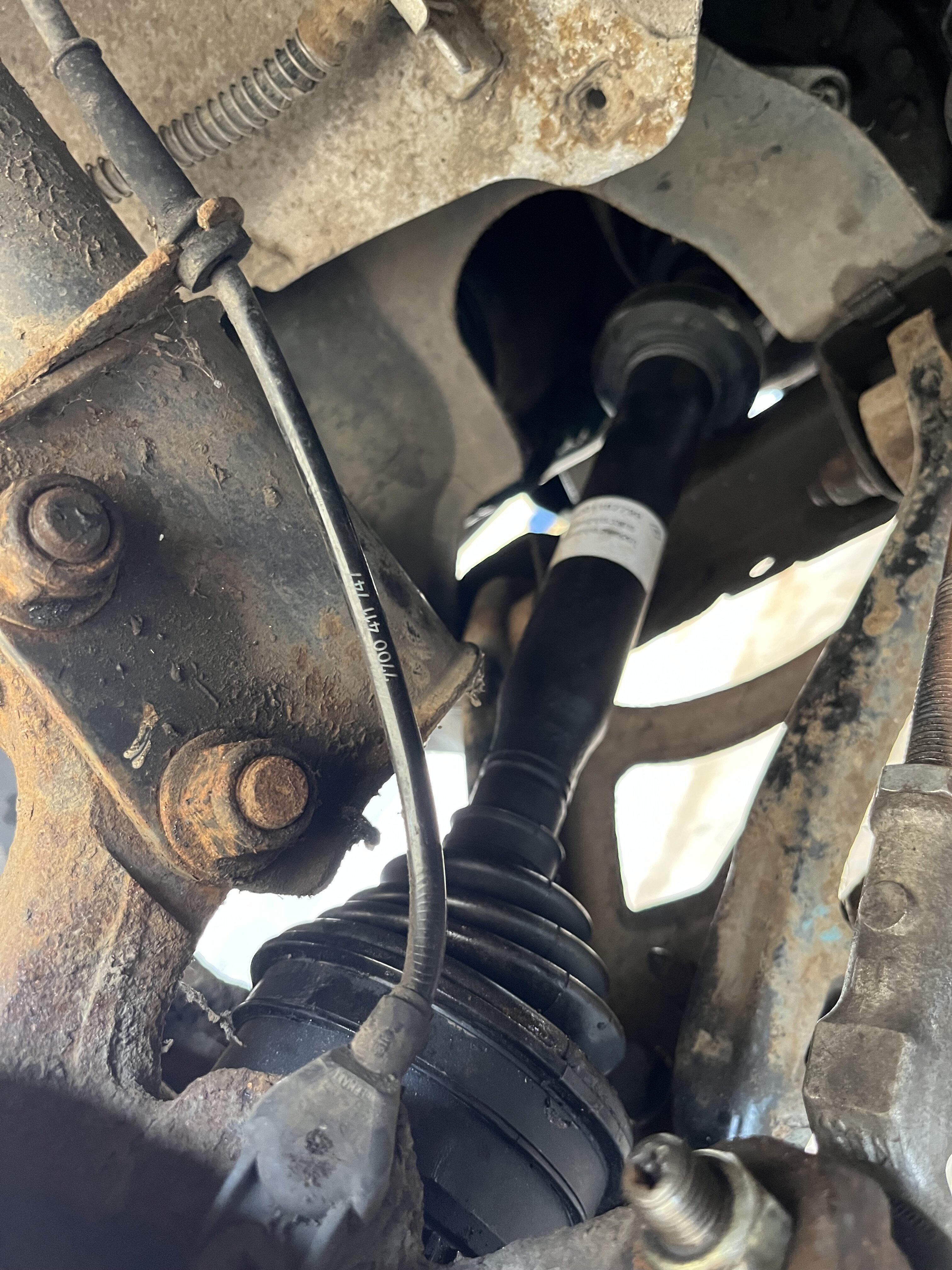

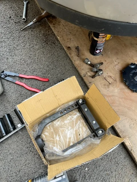

Got myself one of these for removing the joint in situ:
They are amazing.
I have increased the value of the car 1000% with that rarest of rare parts.
From:
To:

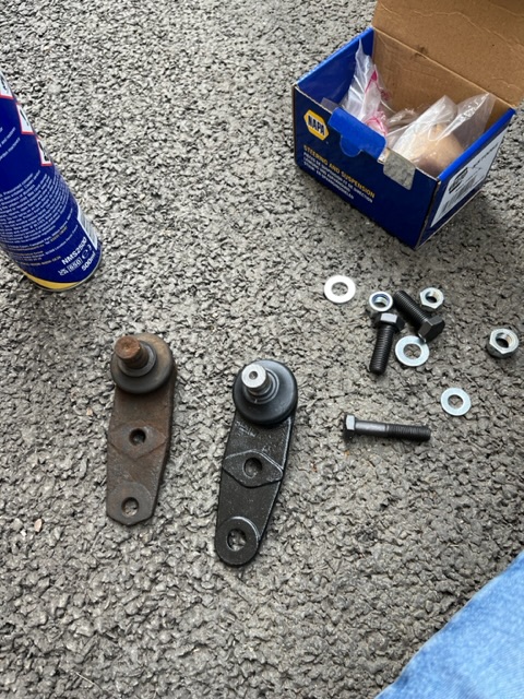

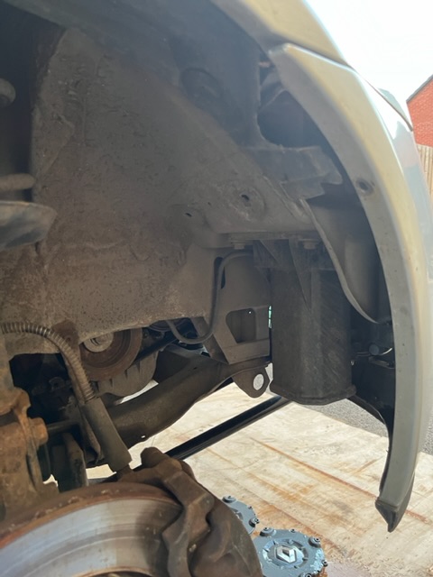

While there I noticed that the ball joints were both loose and old.
My local factors only had Nappa in stock. Let’s hope they are ok.
Got to love previous mechanics. Near side pinch bolt was in from the wrong side so the caliper had to come off to remove it.
Offside was a non-sport ball joint with the 10mm bolts!

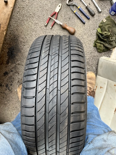

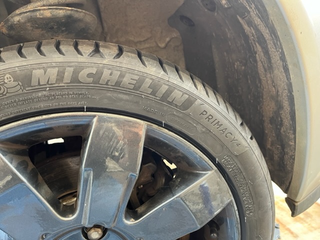

New boots. I was going to go for PS3s, but I noticed that ps4s are much better reviewed, and a couple of German tyre tests on a golf gti put the Michelin Primacy 4 neck and neck with the ps4 for lap time, with the benefit of lower cost, greater comfort and less road noise… we will see. They have to be better than the barely legal Toyo proxies anyway.

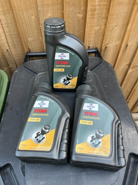

Gearbox refilled:

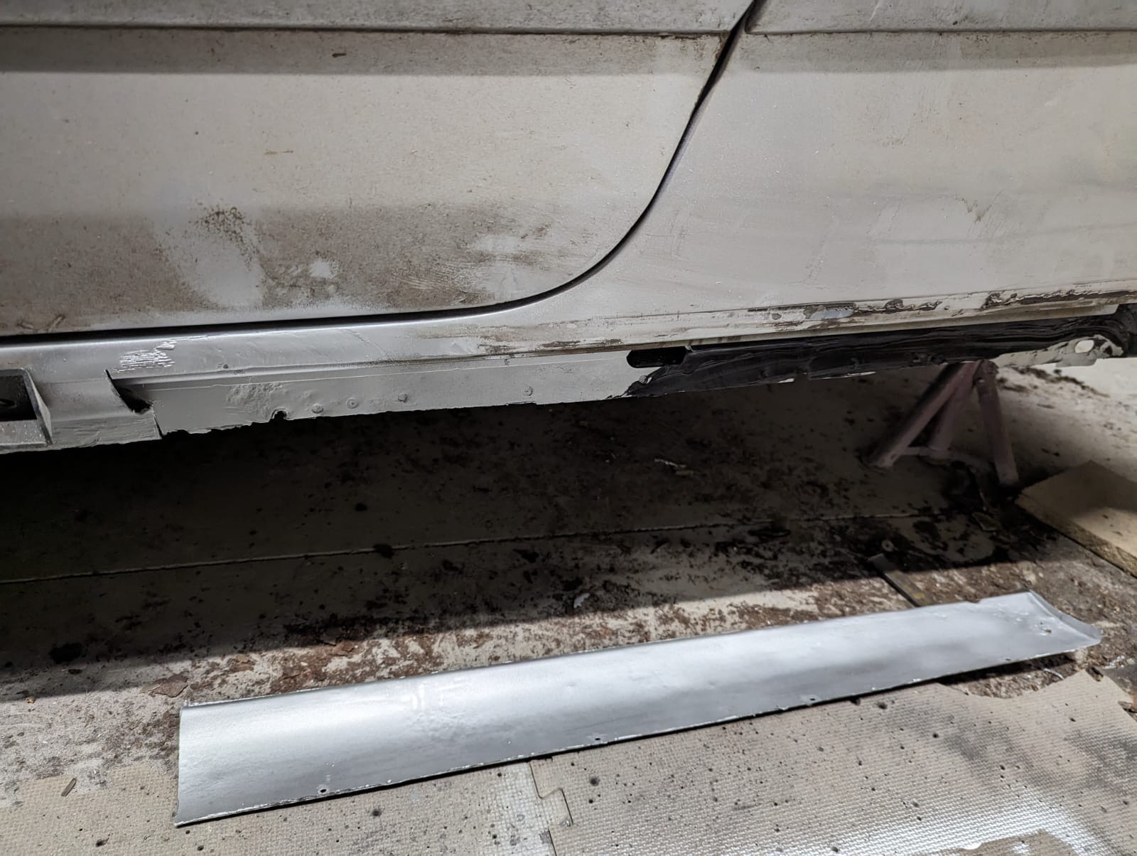

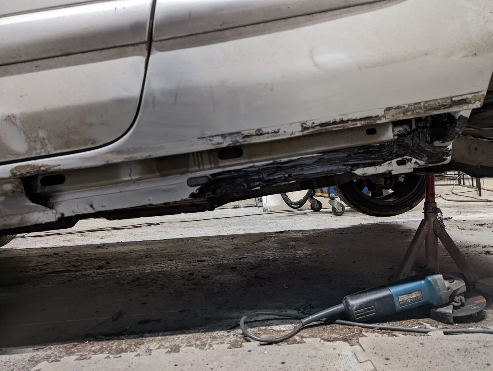

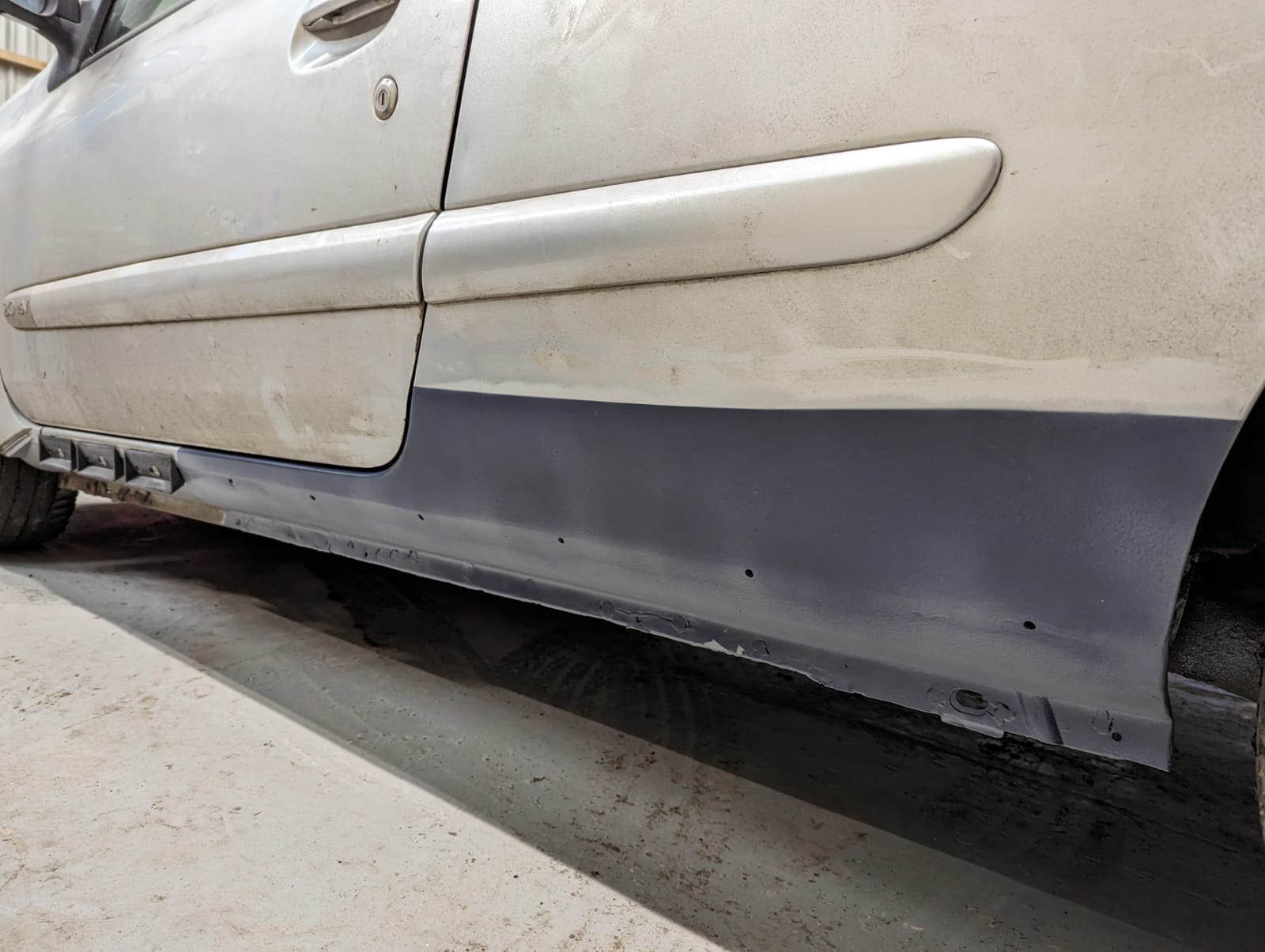

Finally got my Bodyshop pinned down. Dropped off for replacing the rear half of th n/s sill. Hopefully that will see me rust-free for a few years. The o/s is really solid, just the n/s had a new quarter and they didn’t rustproof the rear. ☹️
Photos when I get it back…
Brian J
  Clio 182

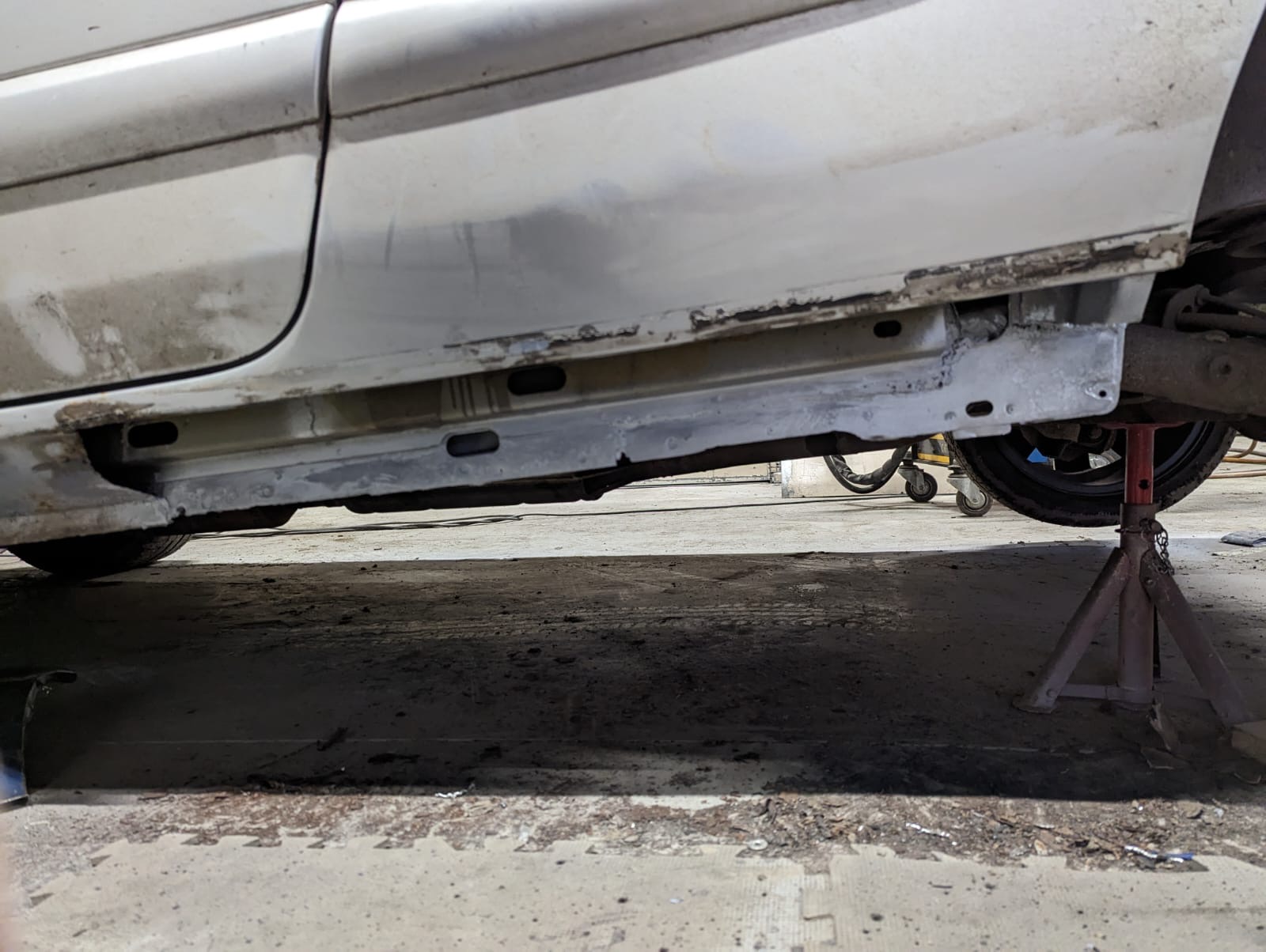

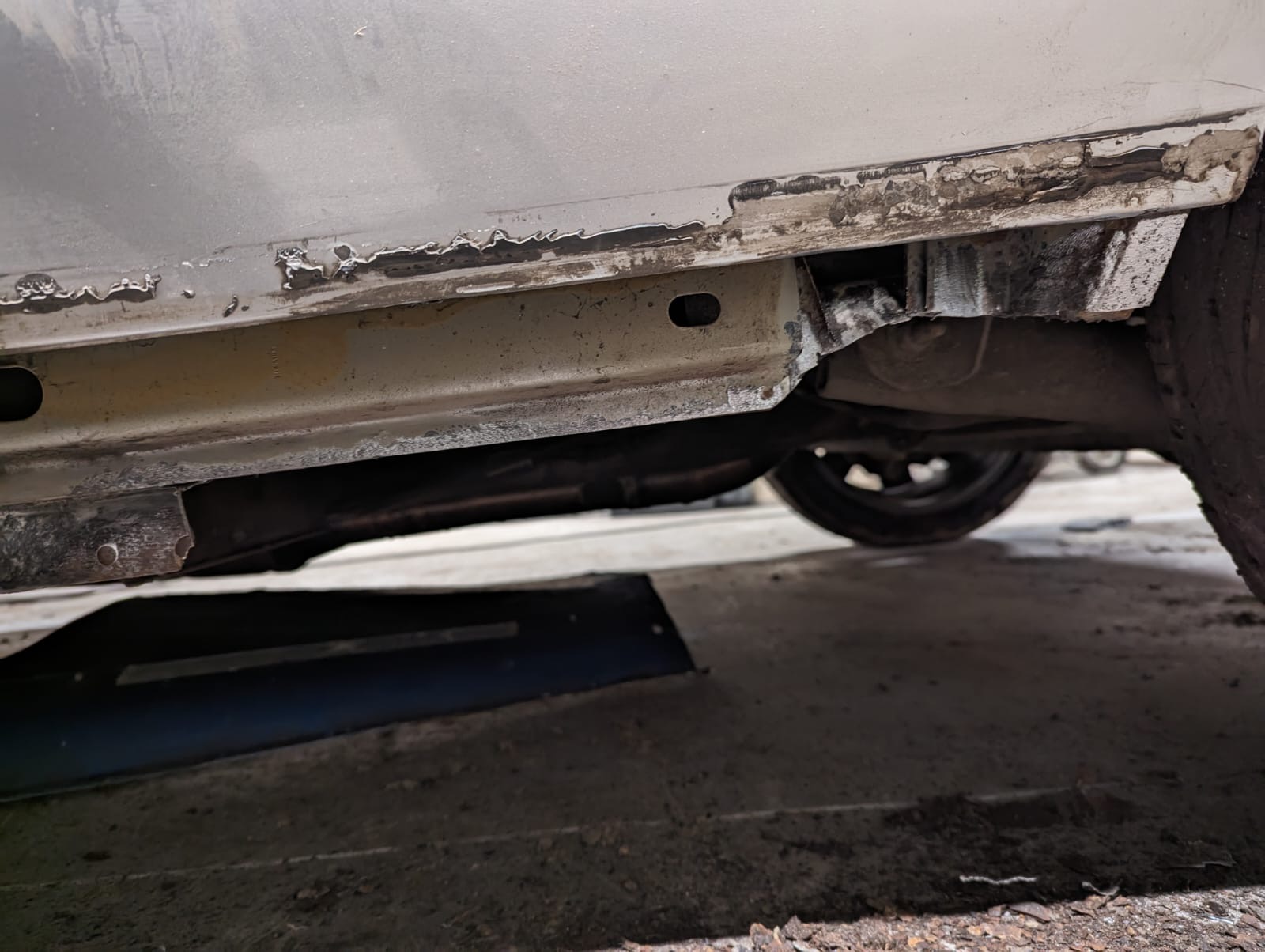

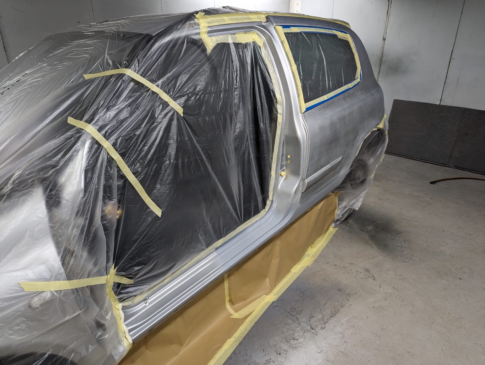

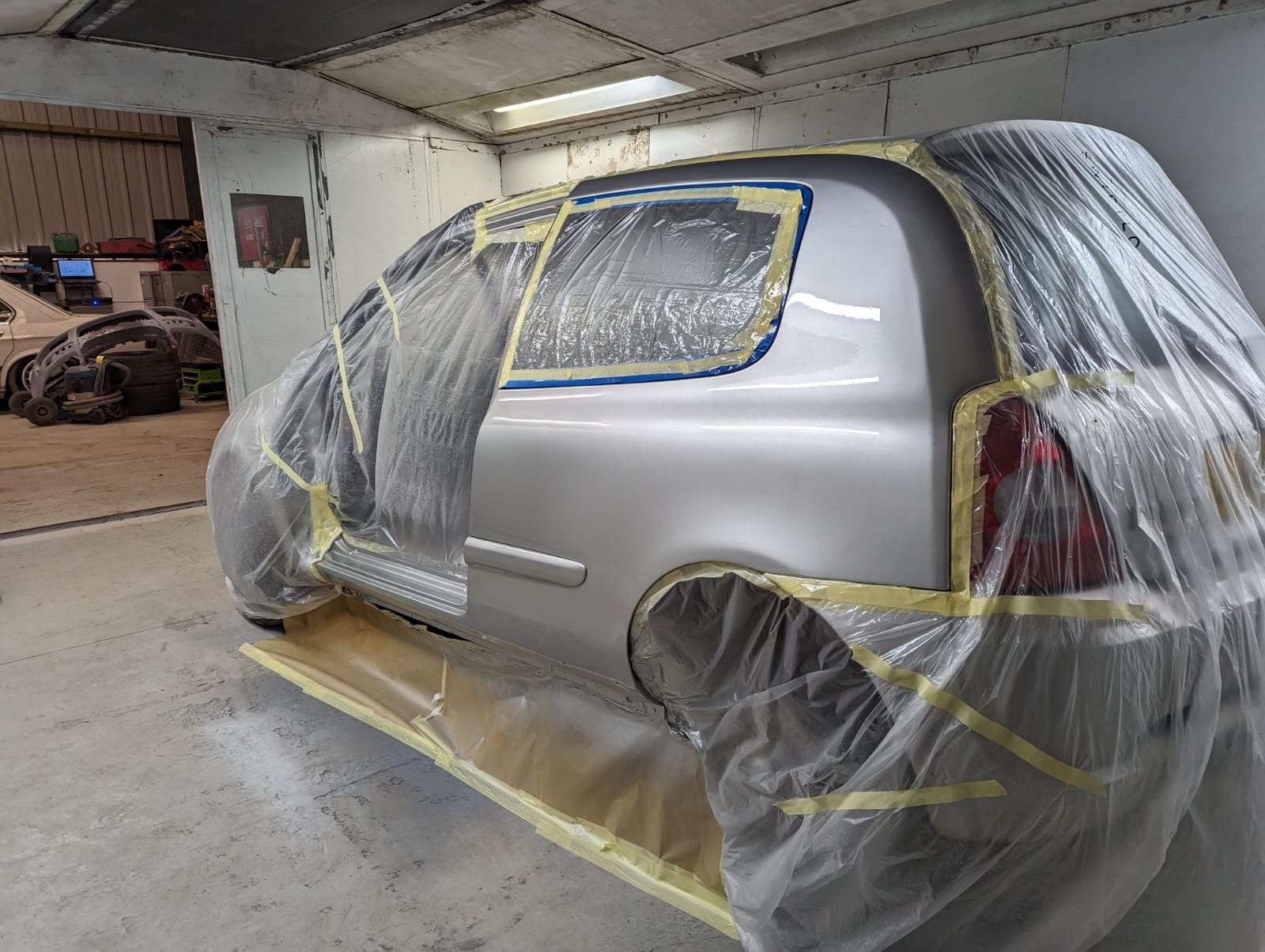

Update from the Bodyshop: it’s done and ready to collect.
Rust was worse than expected and the inner sill, arch and support panel were also going:
Fortunately I had a cut including all sill panels:
Solid again:
