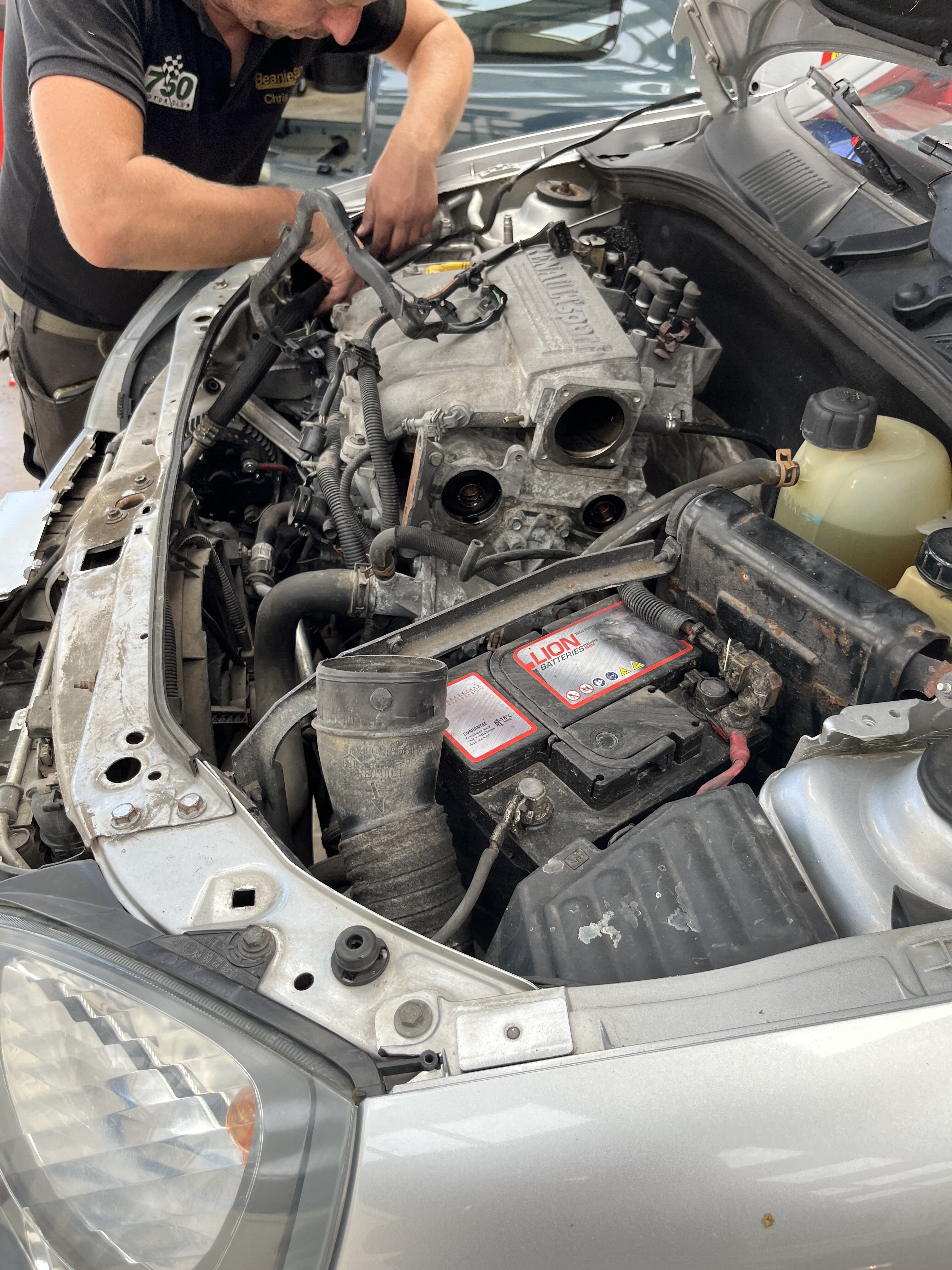

still like the way it drives but it was obviously down on power quite a bit. Non. Working aircon was a killer. ☹️

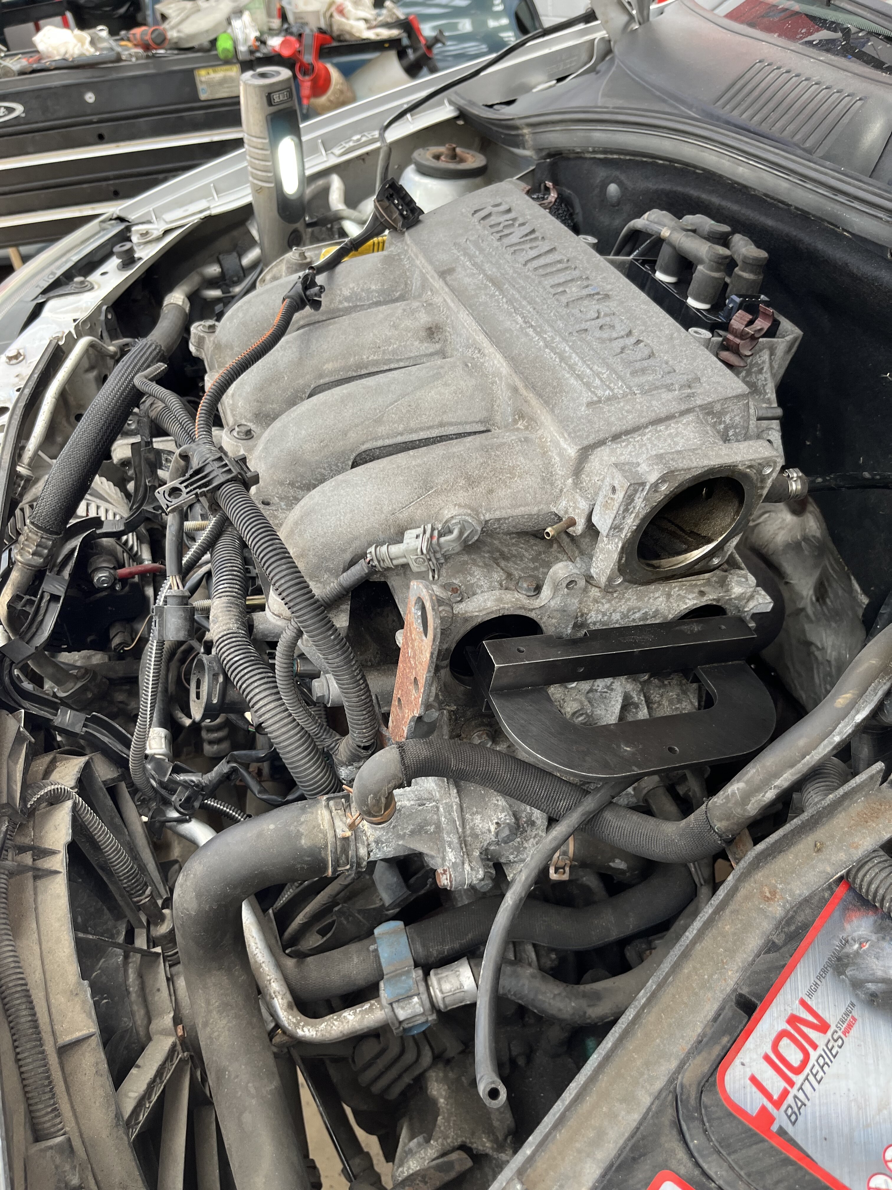

Arrived for some TLC:

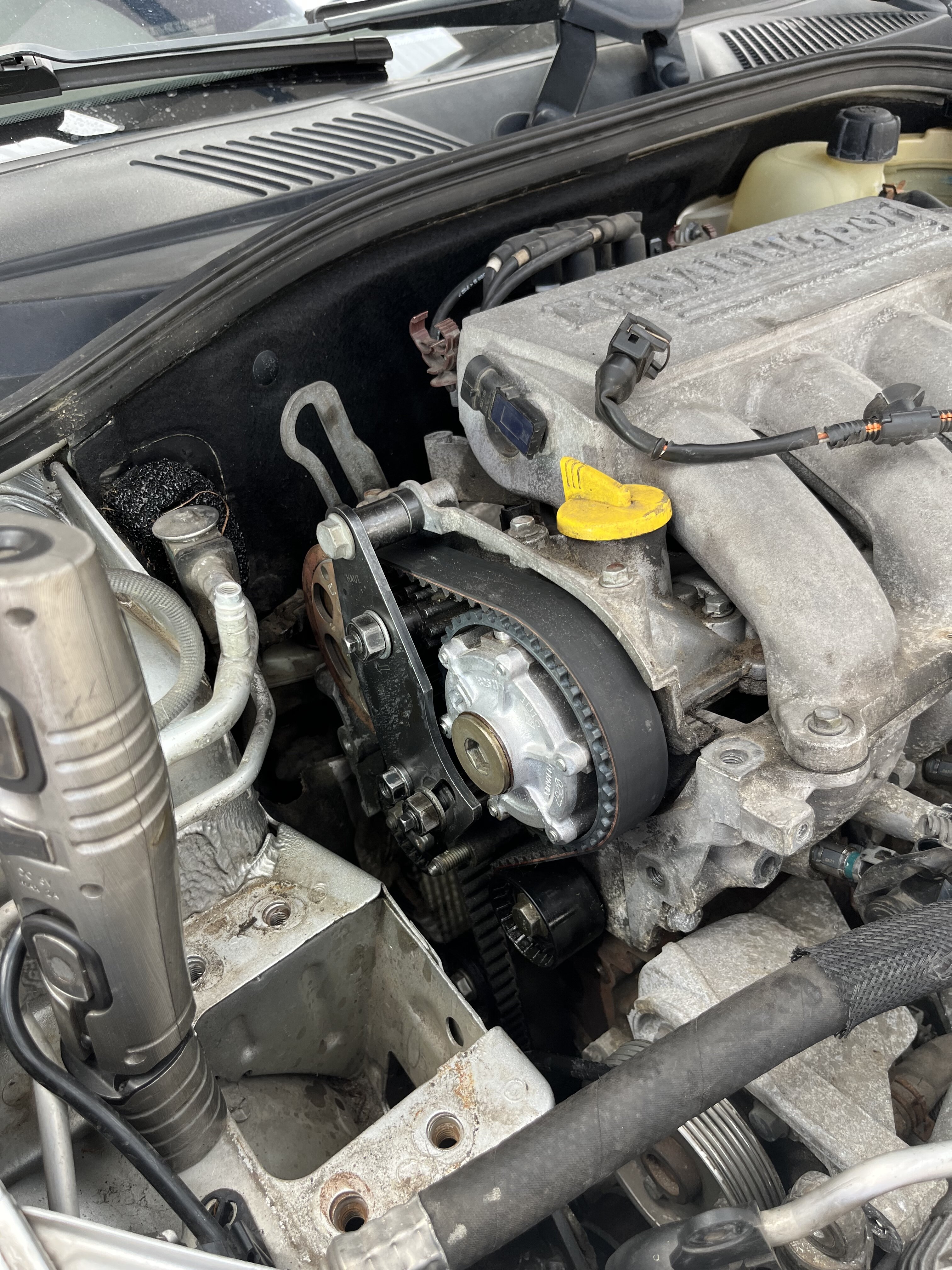

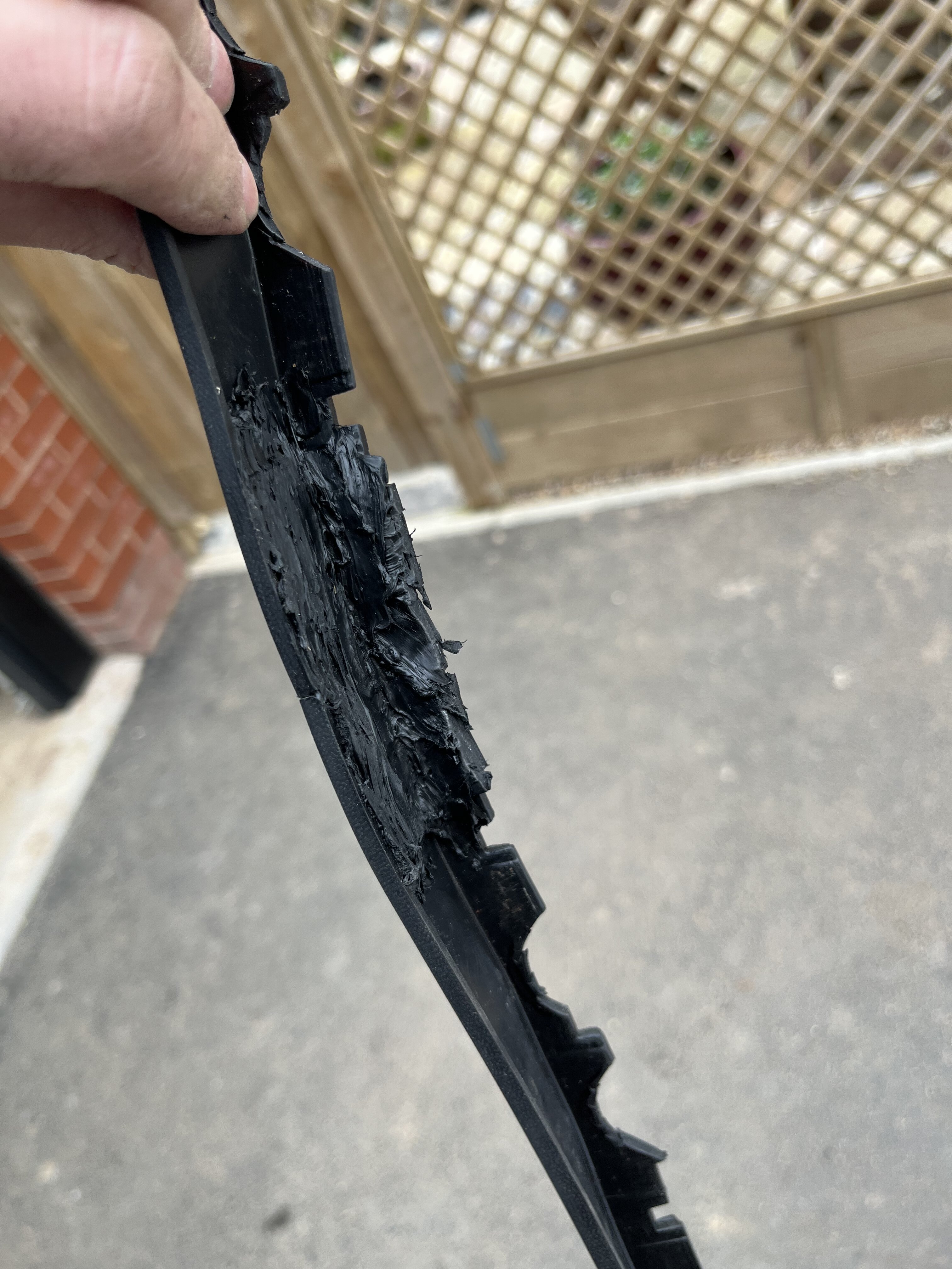

The conclusion was that the timing belt is definitely new, as are the dephaser and tensioners, but the timing was way off:
Sorted:
but:
In spite of the new aux belt, the tensioner was trashed, the water pump is ancient and the lower timing belt cover awol.
was not expecting g that so won’t get it back now till next week.

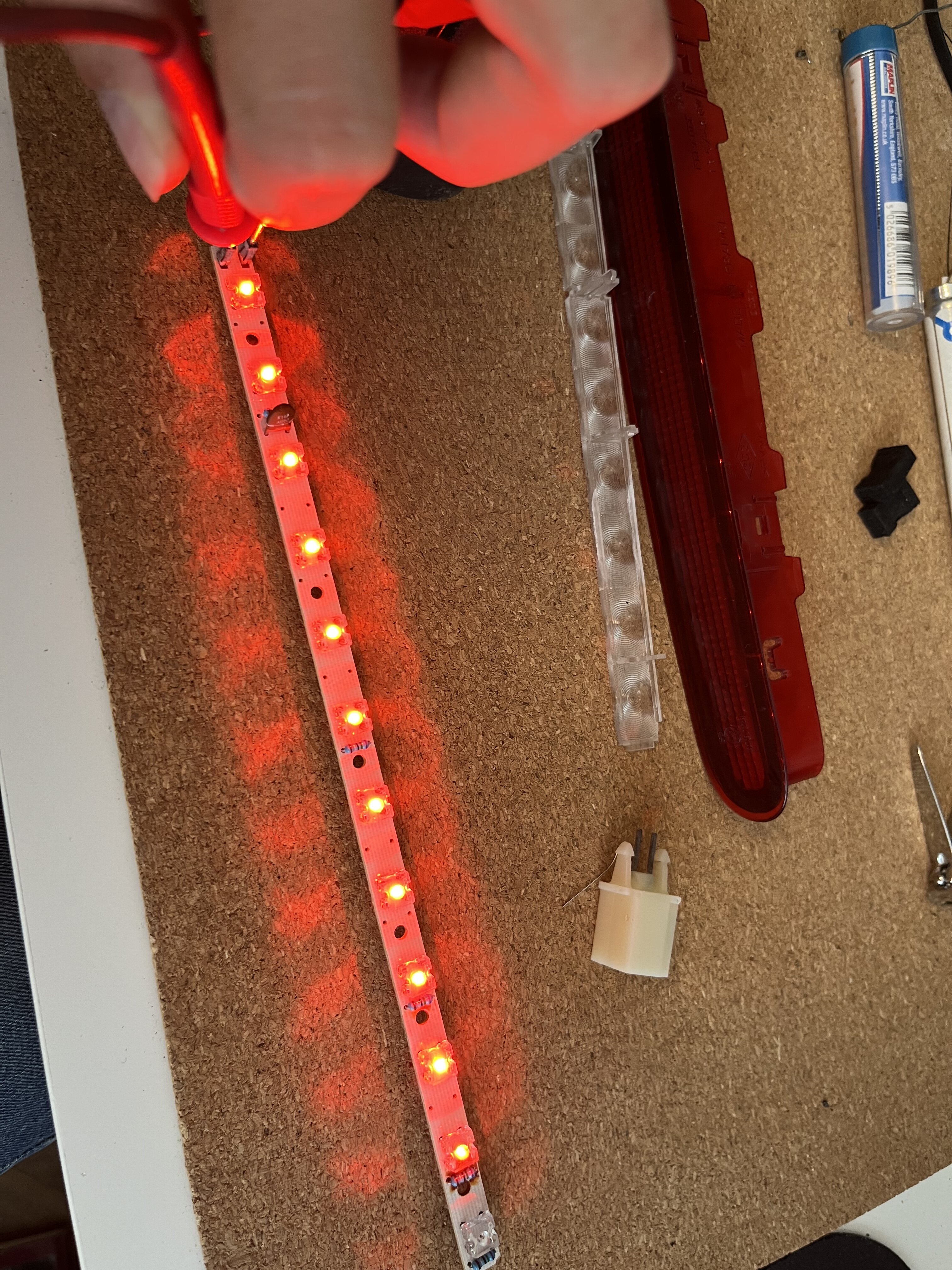

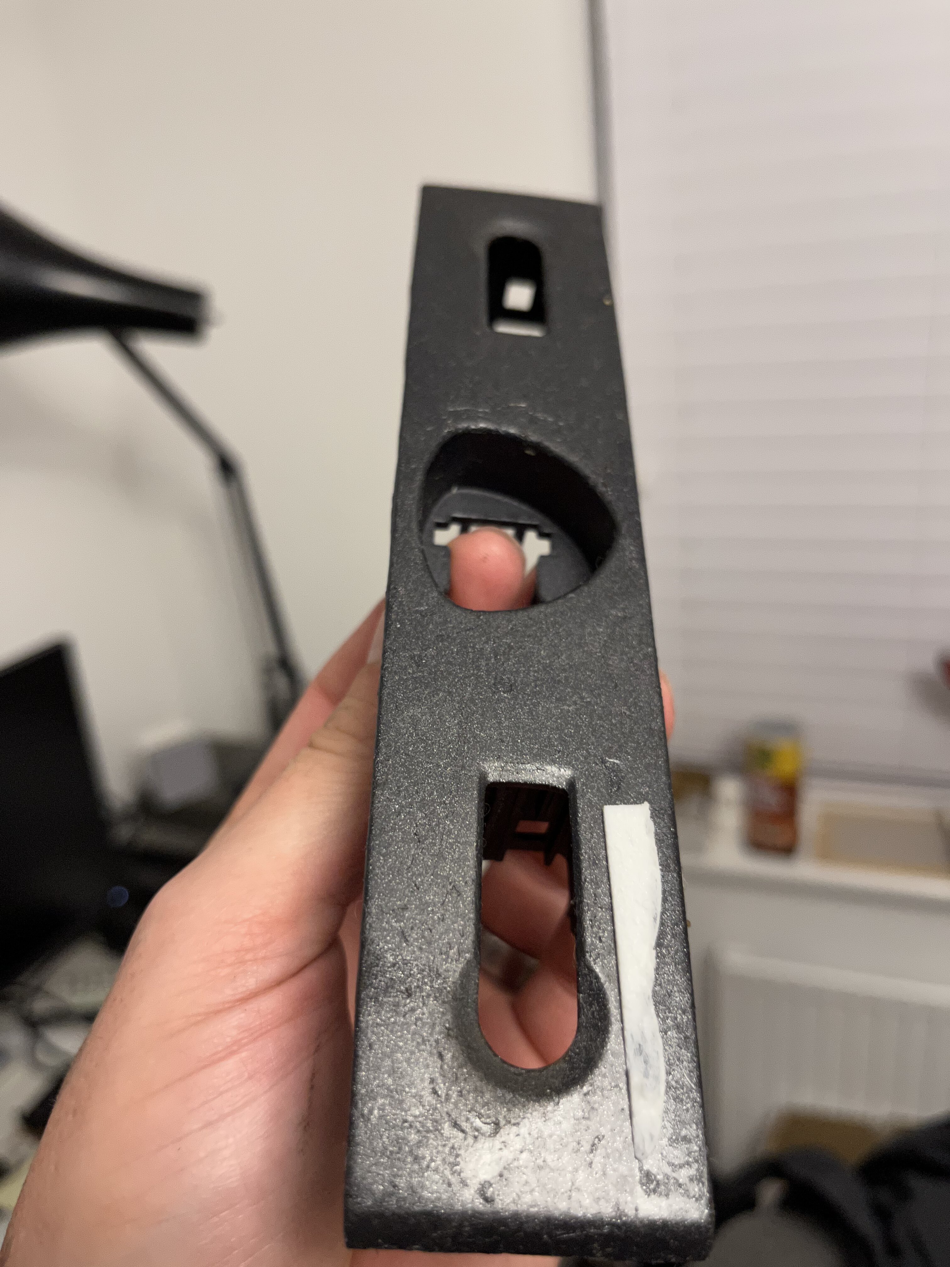

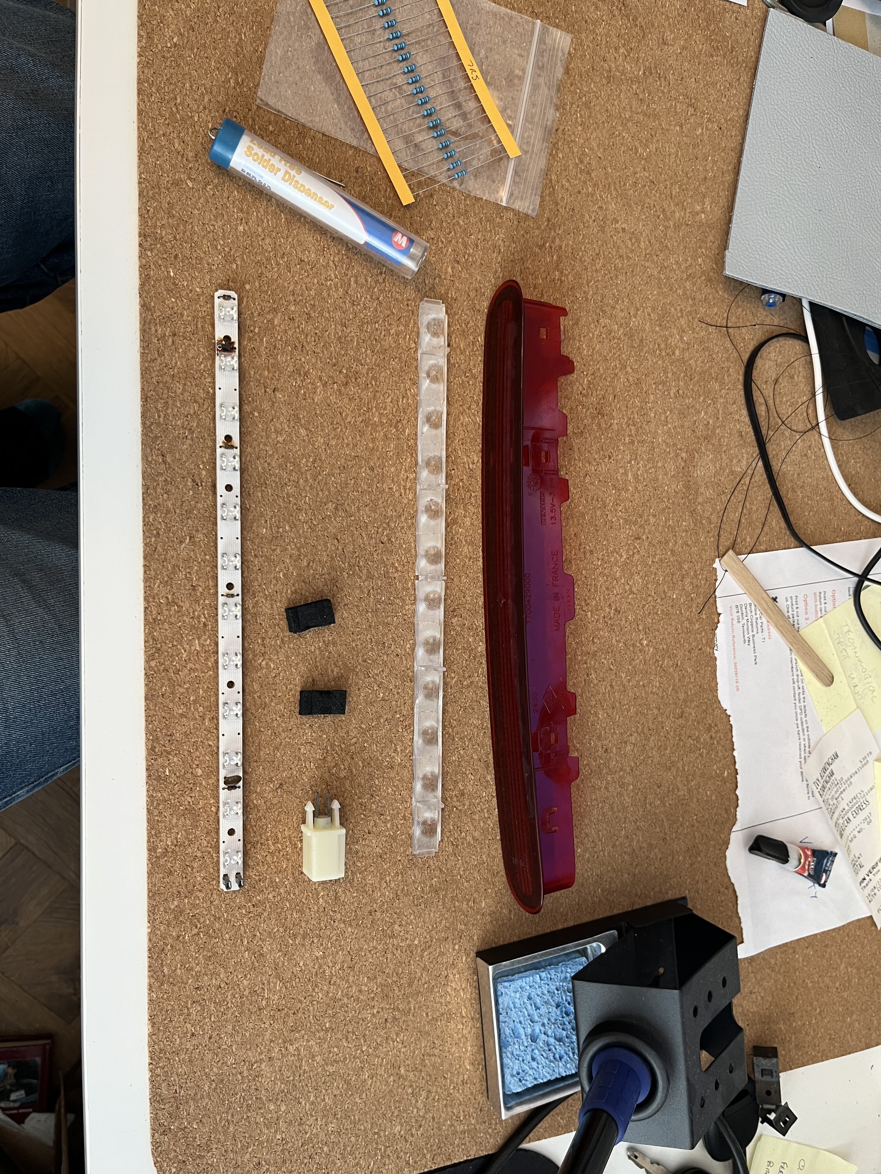

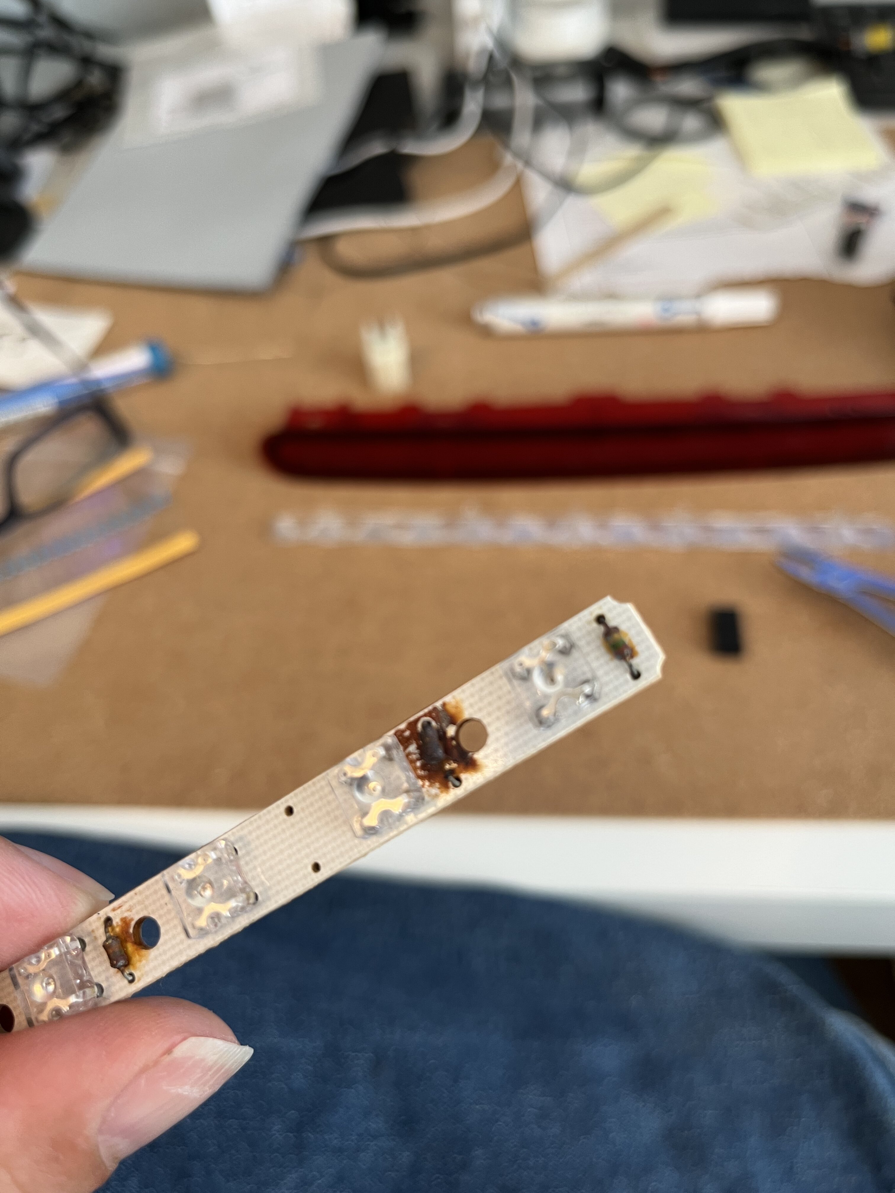

Repairing cup brake light:
Can’t imagine why the resistors were not working…
So near. One led seems to be dead, so replacements are on their way.

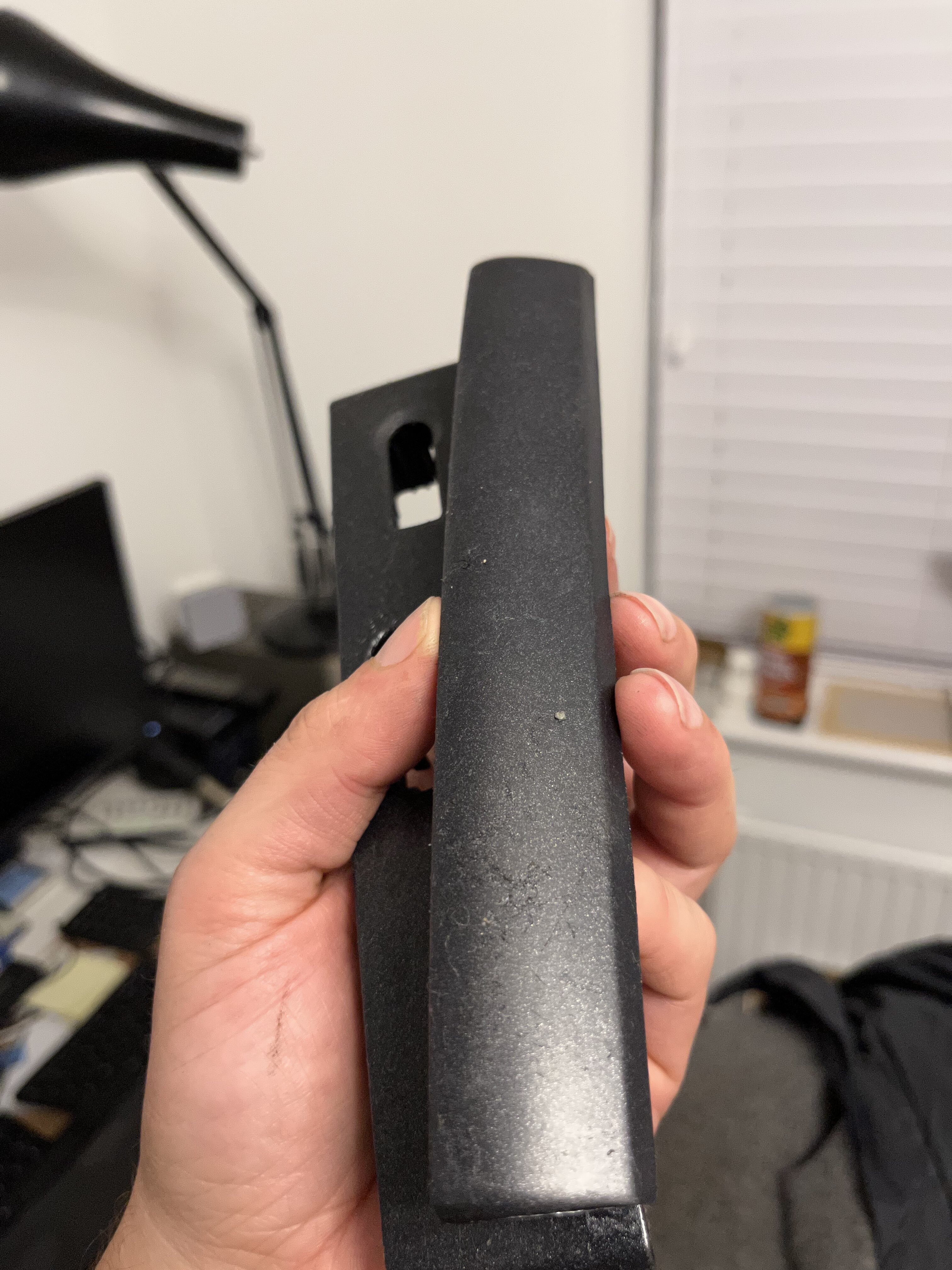

The plastics have been cleaned up and some small cracks glued. Spoiler repairs to follow.

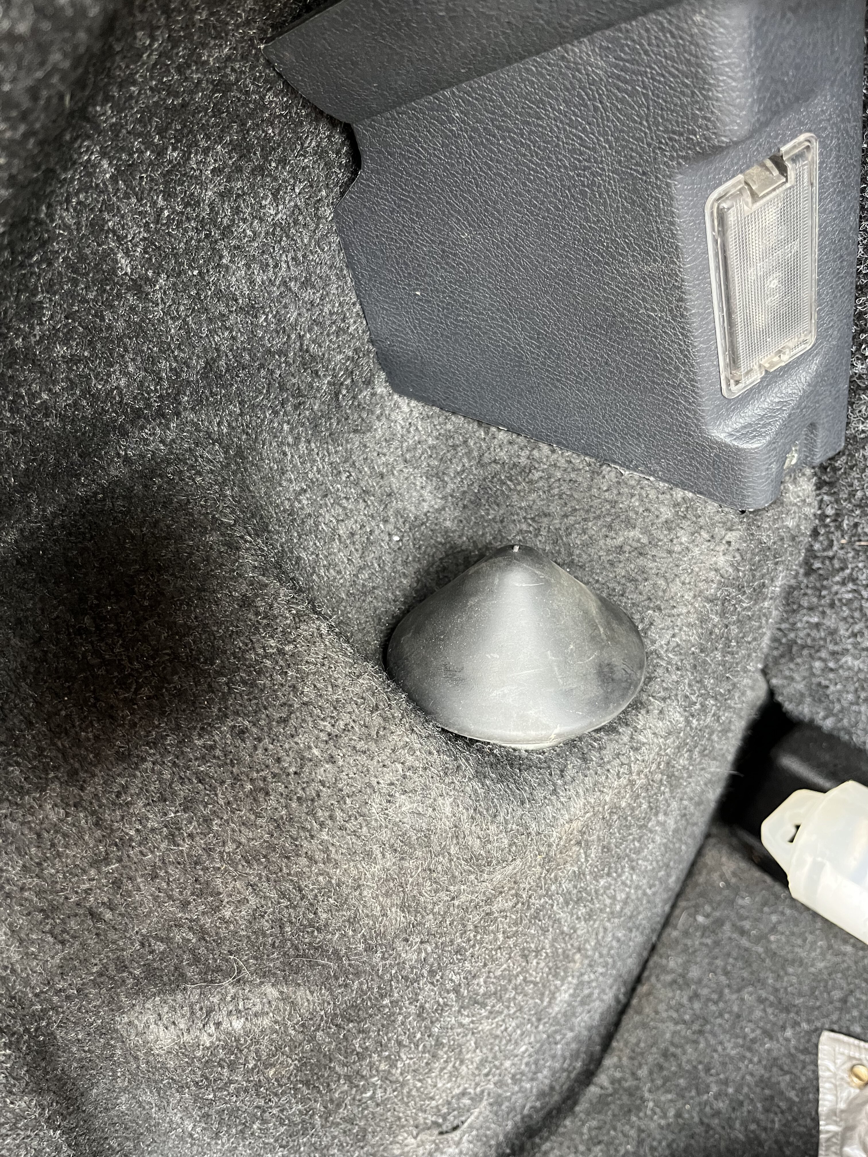

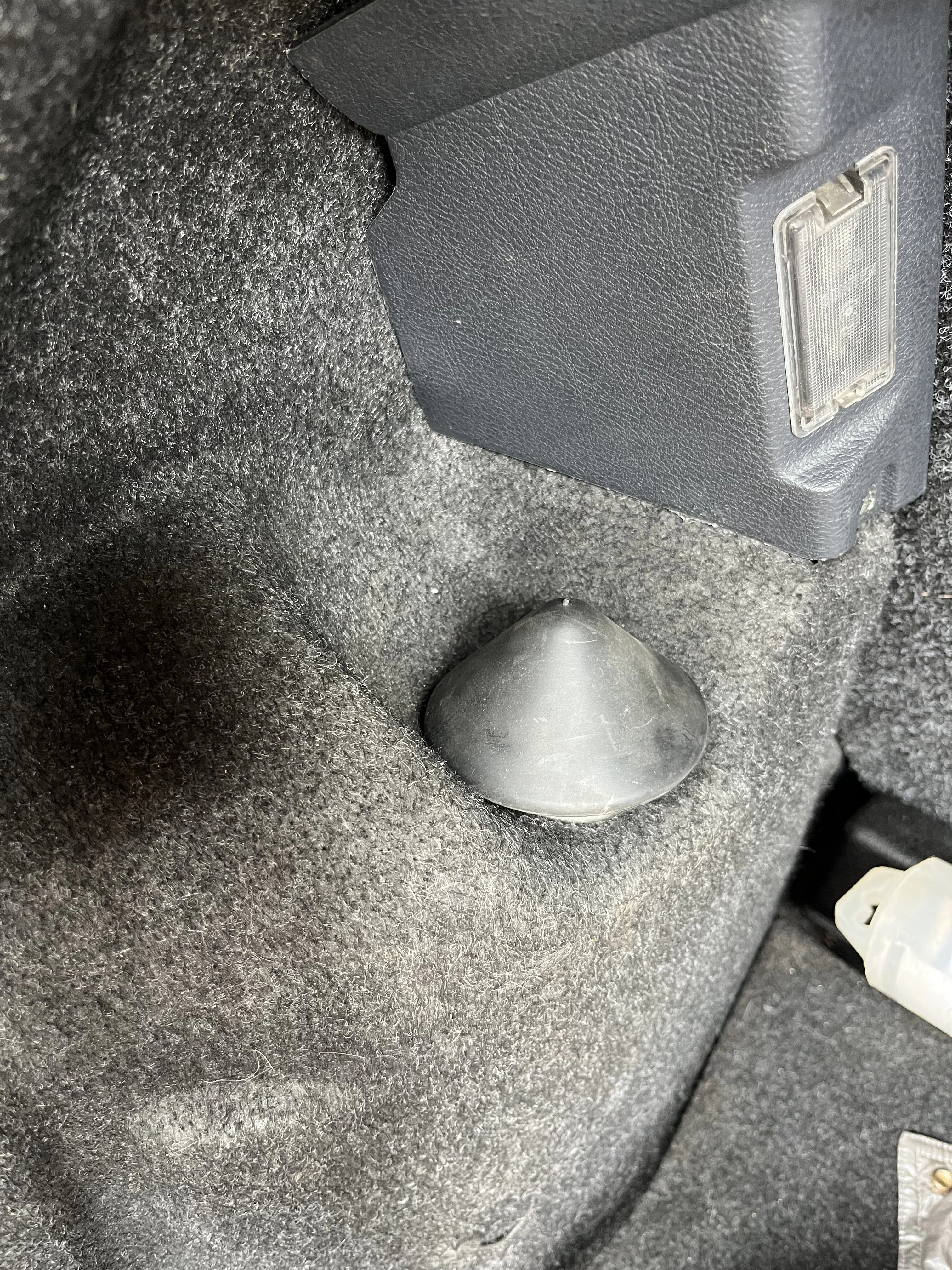

I have reseated the drivers door card with butyl rope and put some rtv behind the boot grommets. That has cured the two leaks I found in the recent heavy rain.

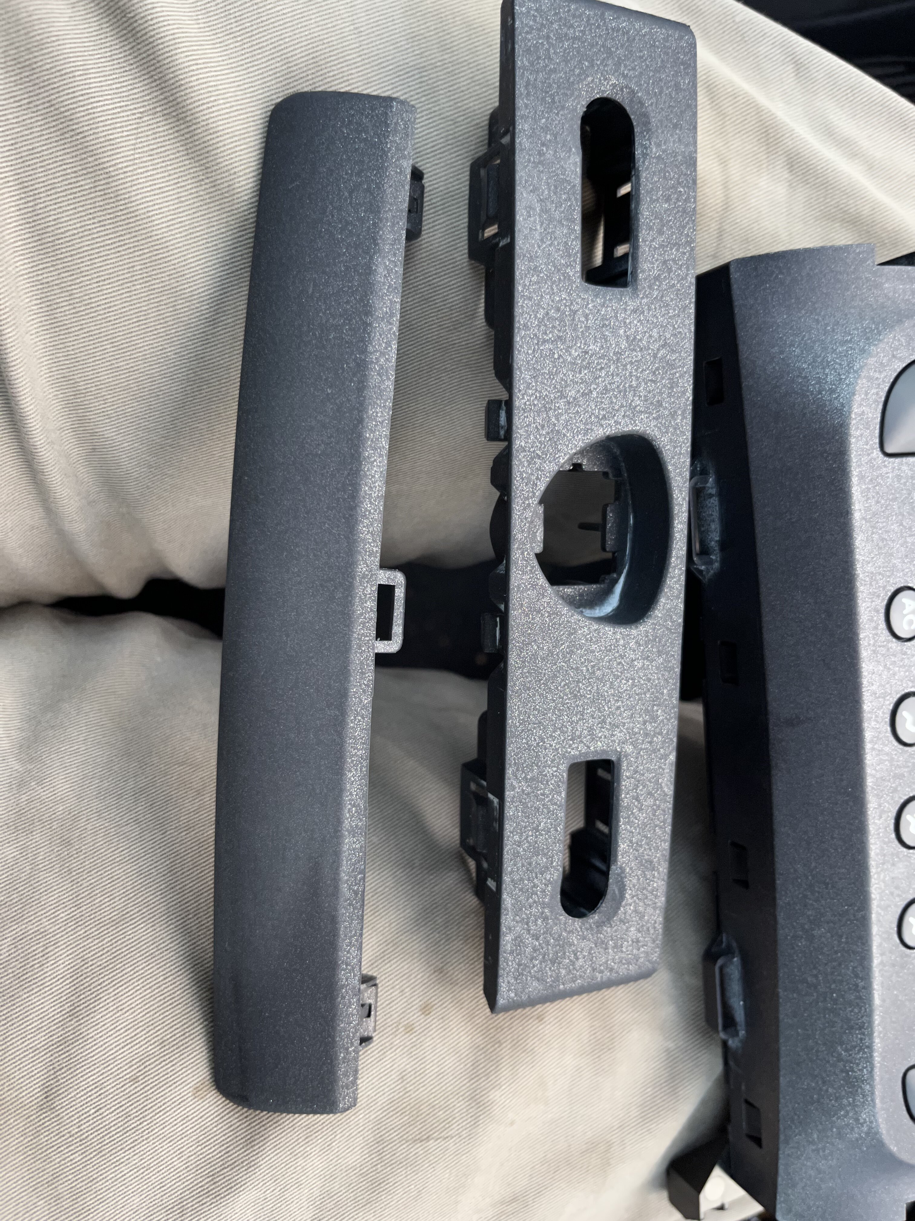

I have done some cosmetic work:

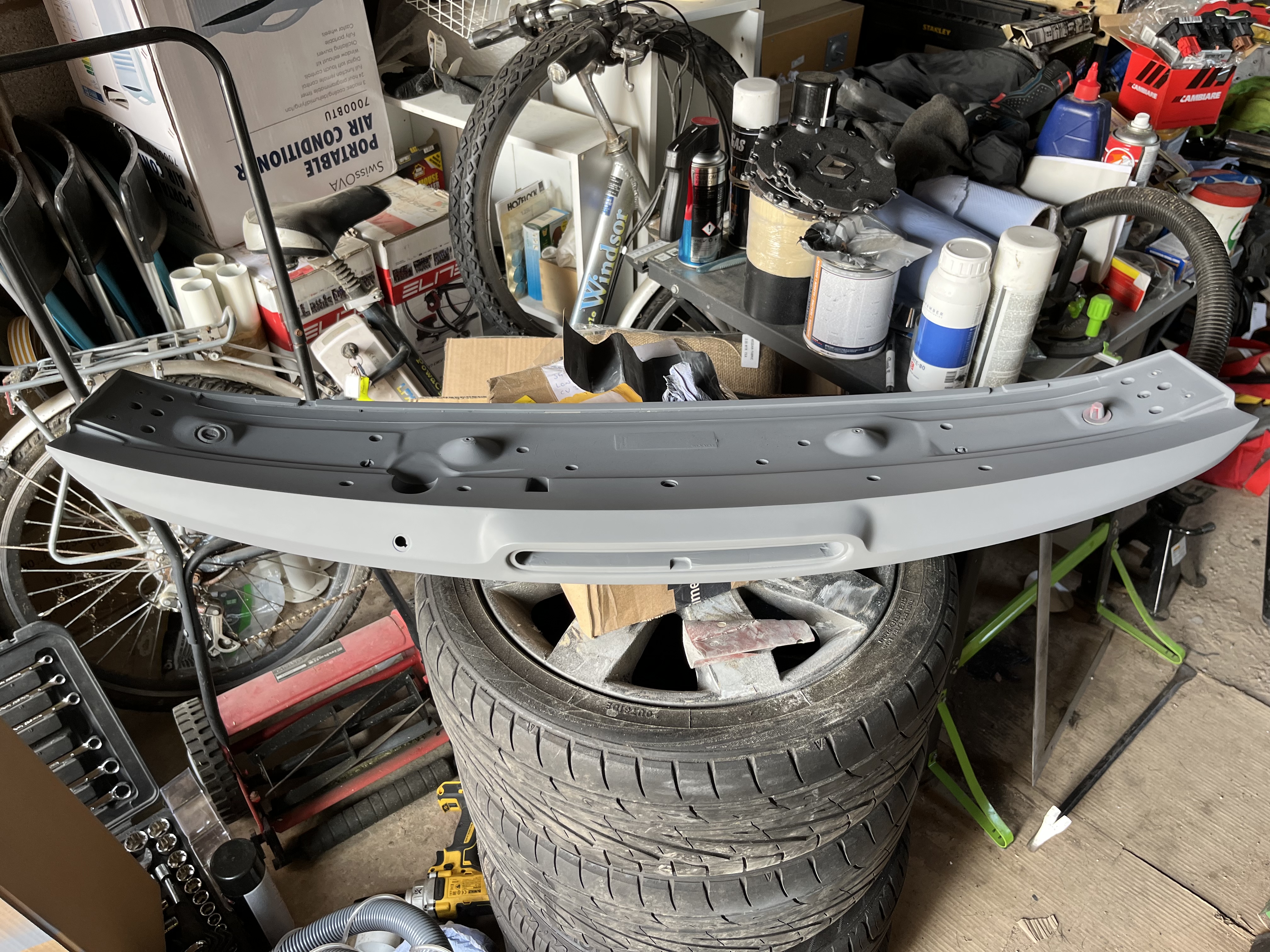

cup spoiler prep for paint:

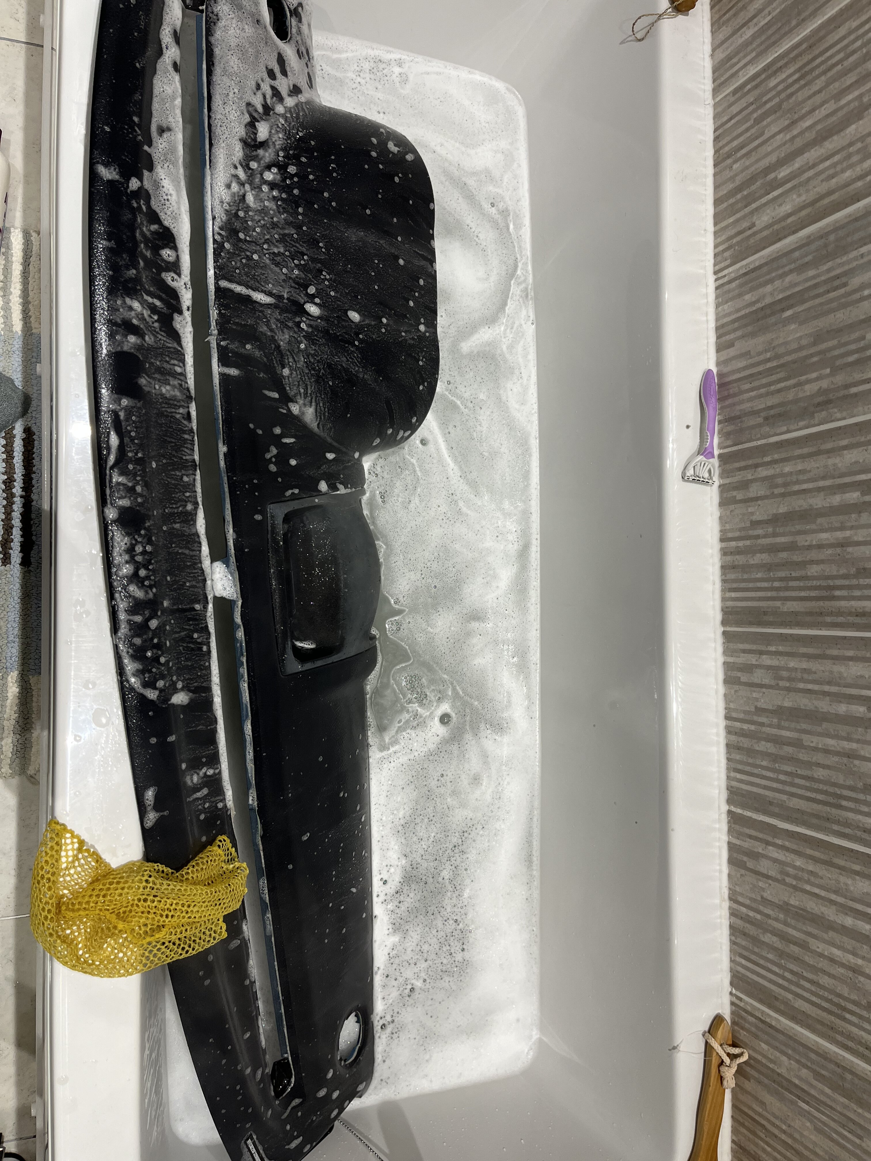

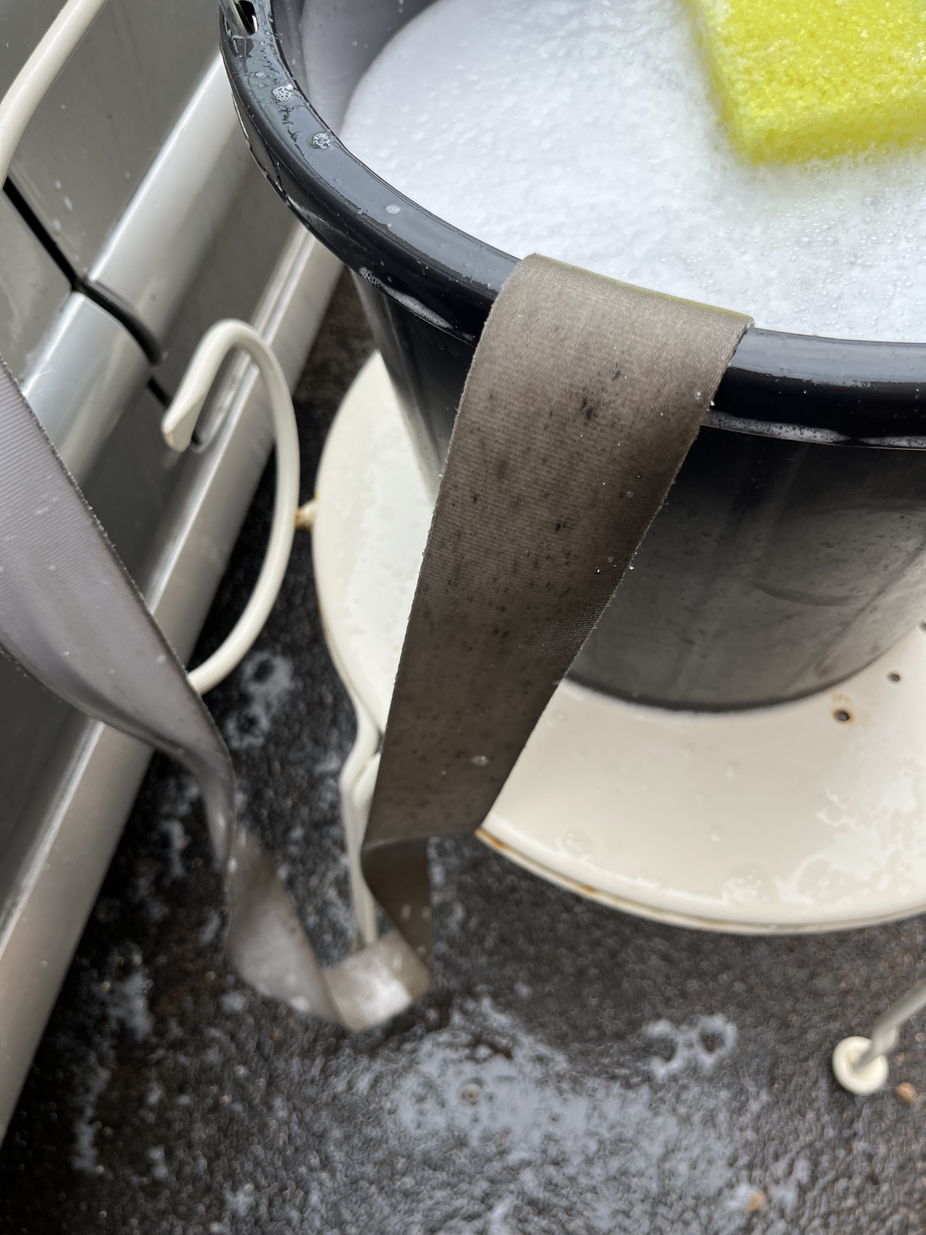

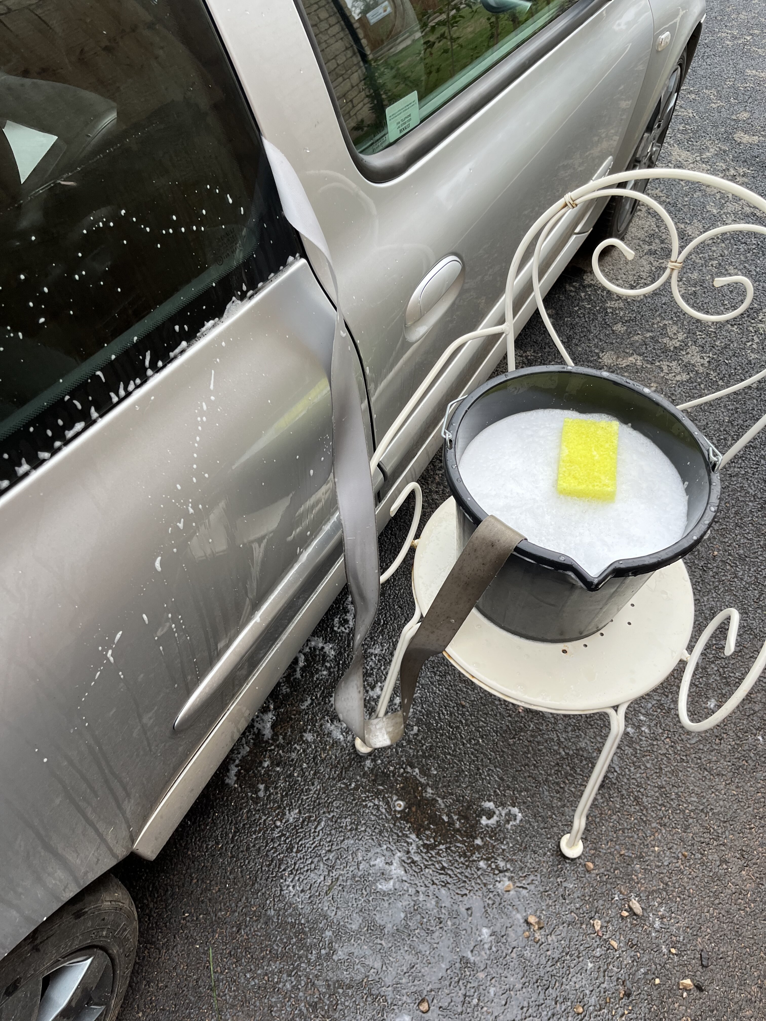

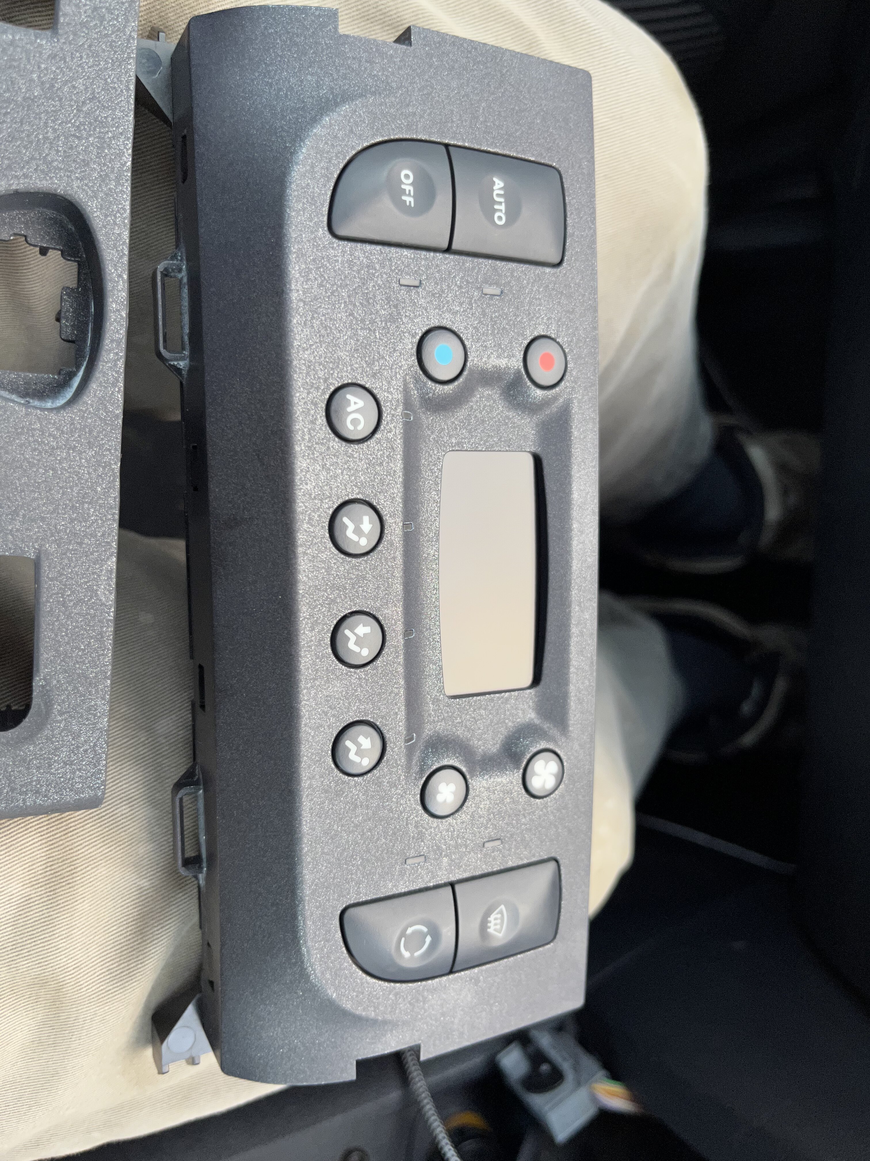

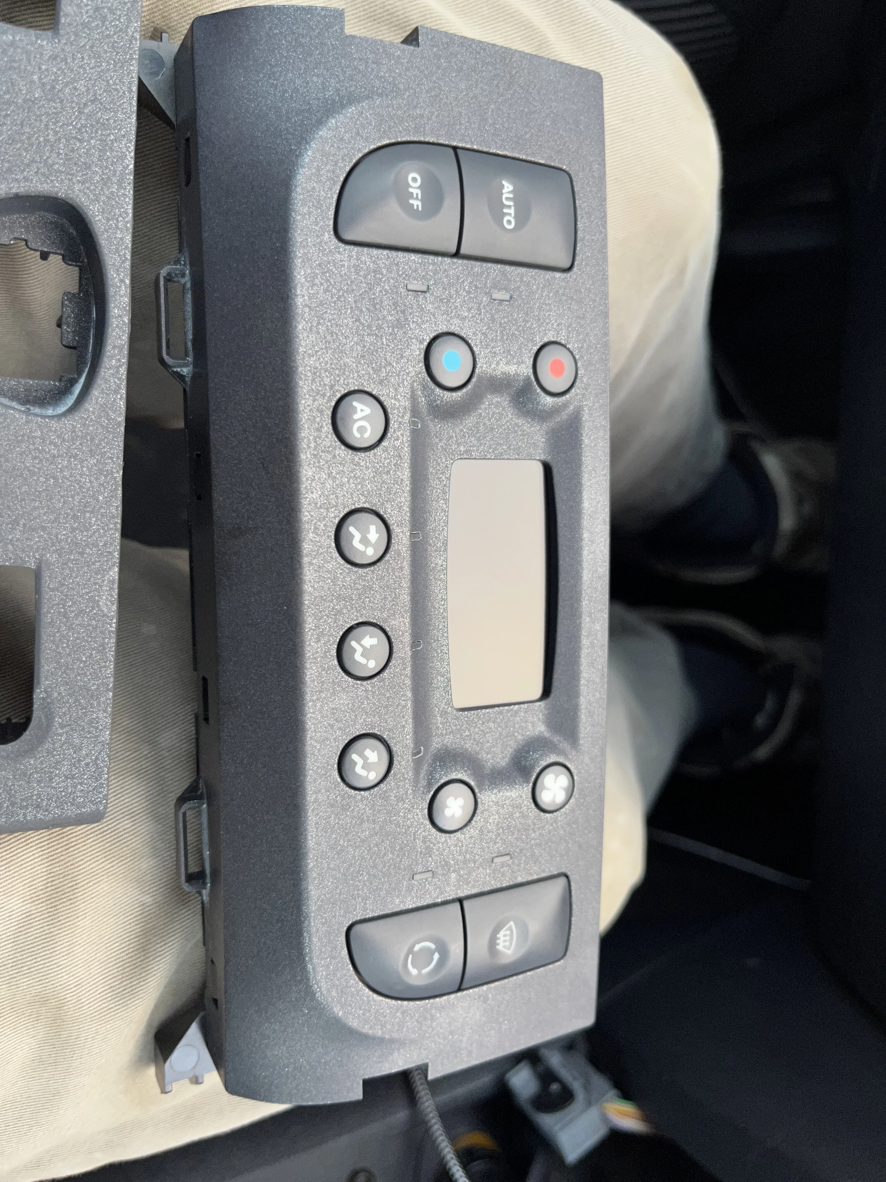

Gusting sticky mess from all centre dash components using the hot water and washing powder method.
before:
During:
After:

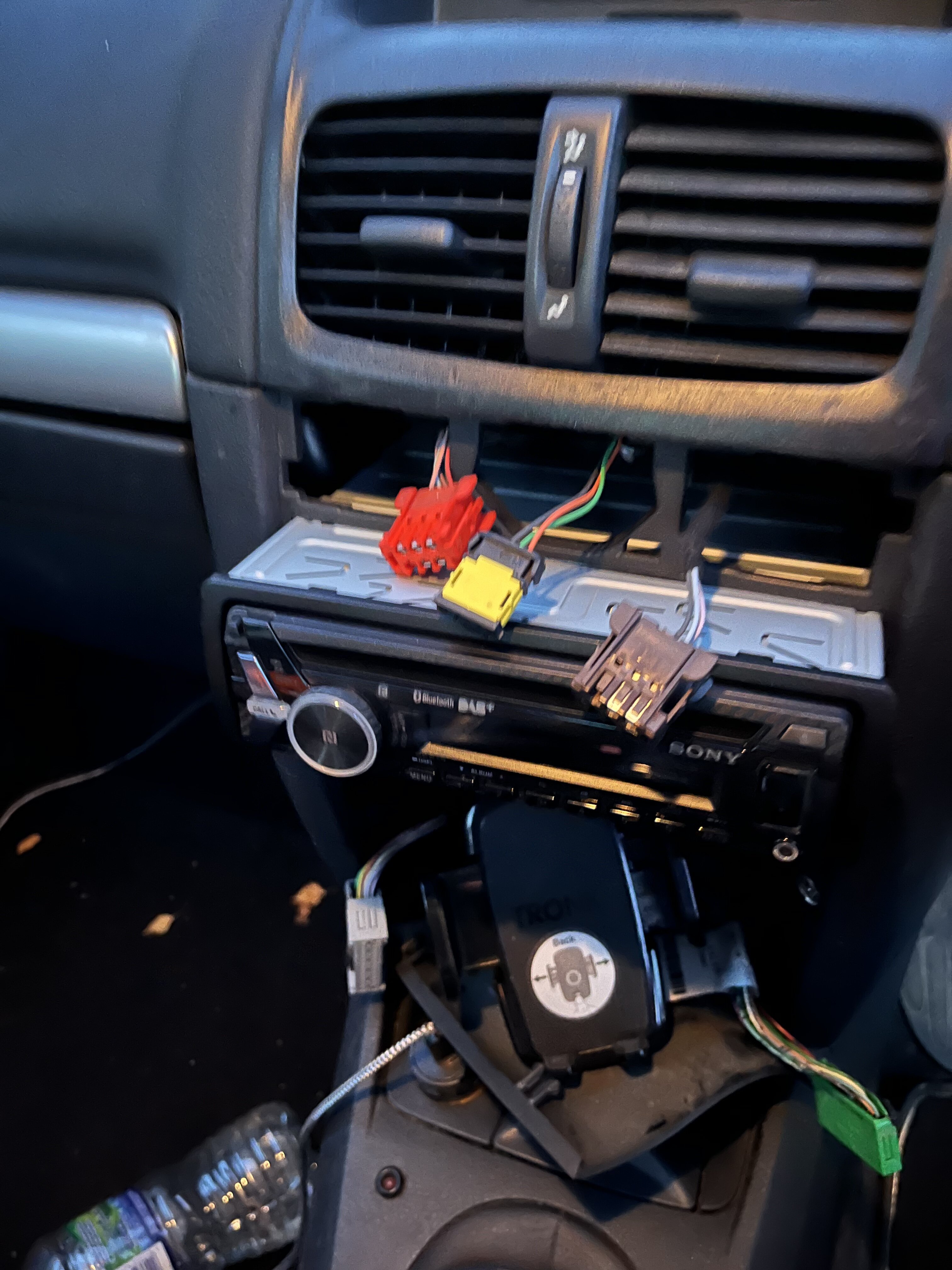

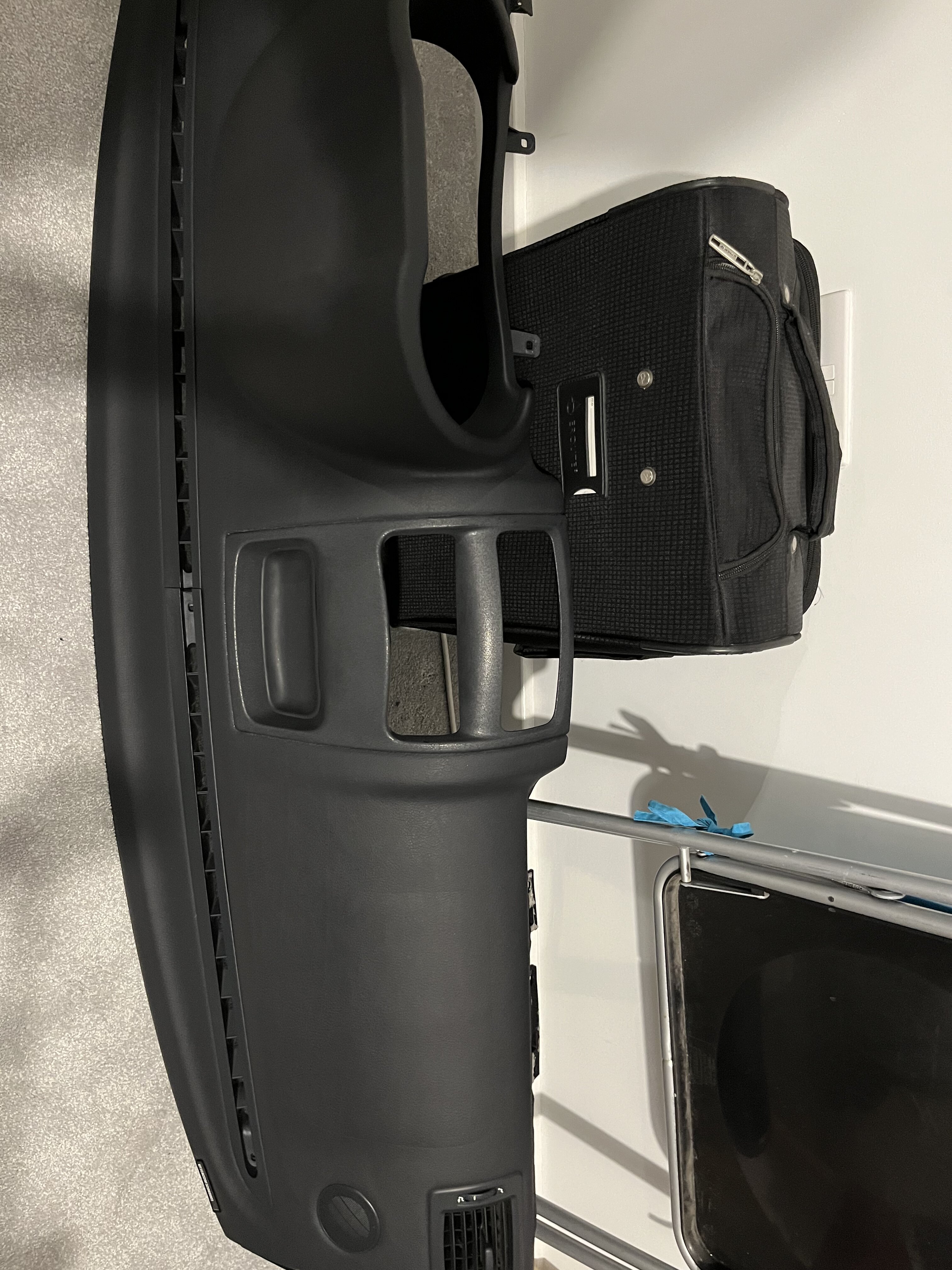

The dashtop got the same treatment, but it is also out so I can run some cables for tunes.
current state of play:
Hopefully that will be an upgrade on the tuner list.

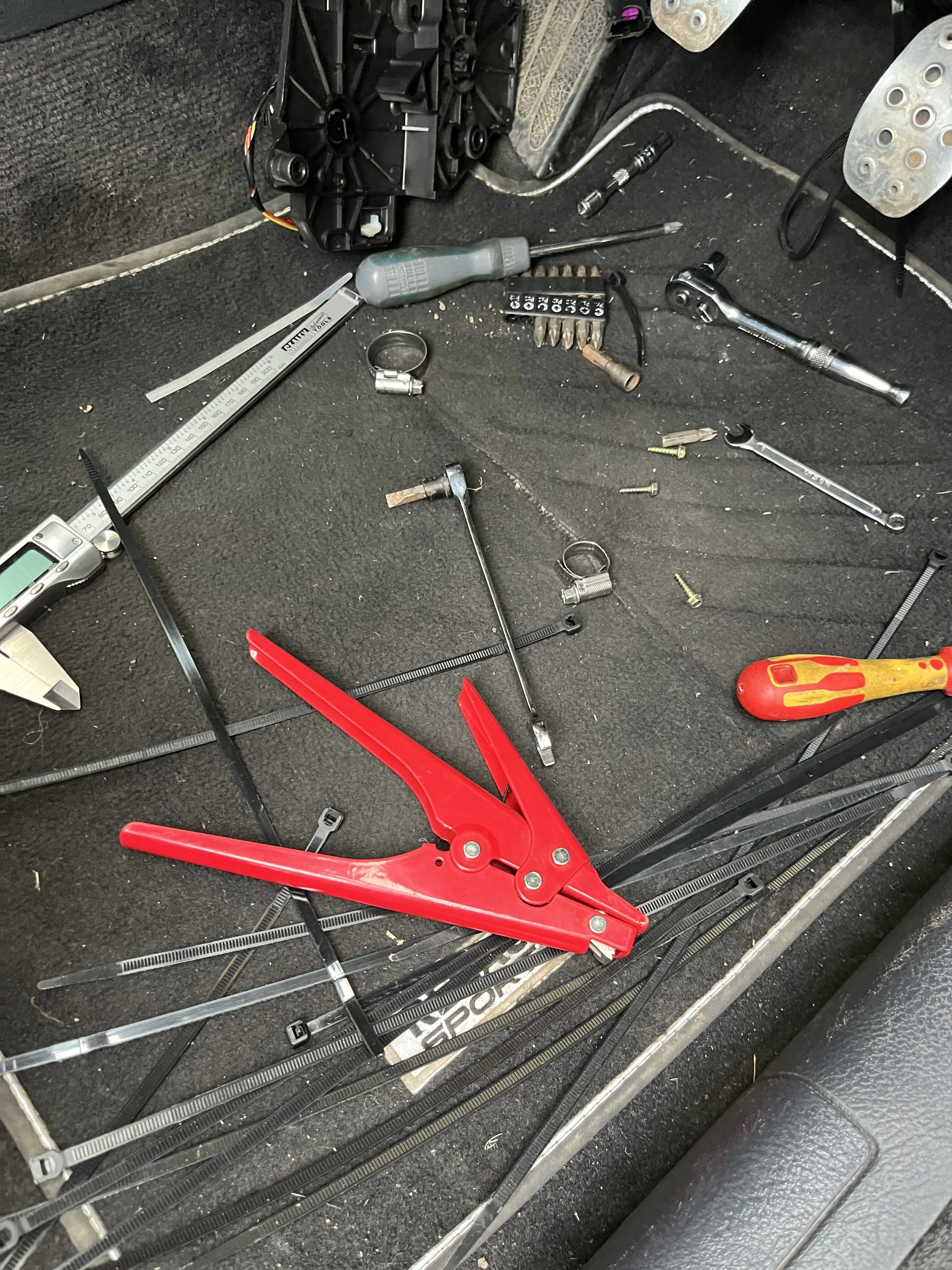

I fitted a new roof mount dab antenna (no pics, sorry) and ran the cables down the side trim to the front. Hopefully tomorrow will see the head unit and cabling buttoned up. BUT, has anyone had the problem when fitting an aftermarket stereo that the cables hit the dash and hold it out? The RCA pre-outs on the Sony are on the right and the rca cables hit the dash when the stereo is still about 20mm out from the dash. I figure I am going to have to drill a couple of holes in the dash, in the stereo hole to give enough depth for them. Any ideas?
The dashtop got the same treatment, but it is also out so I can run some cables for tunes.View attachment 1619764
90 degree RCA adaptors. I had to do the same

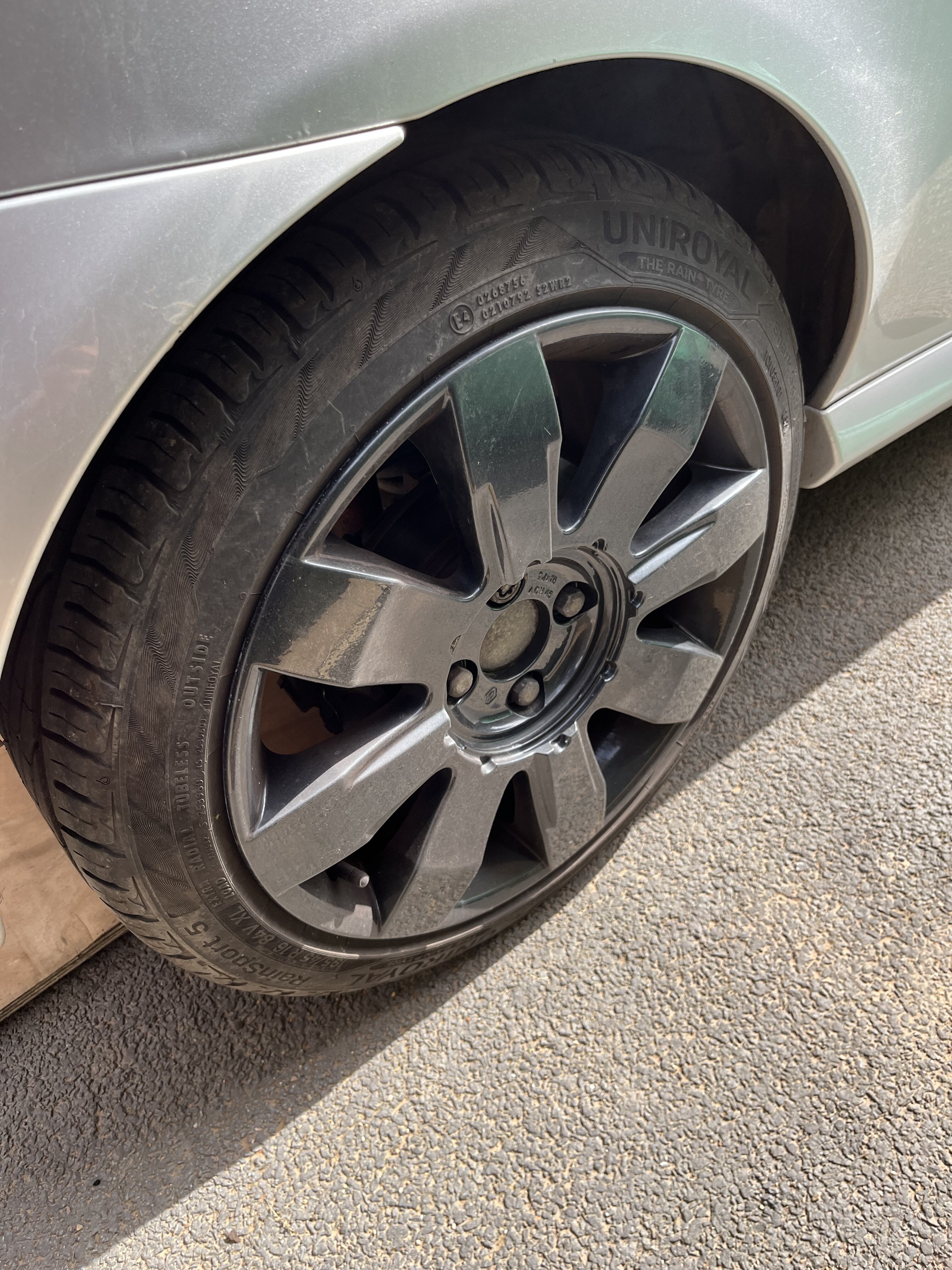

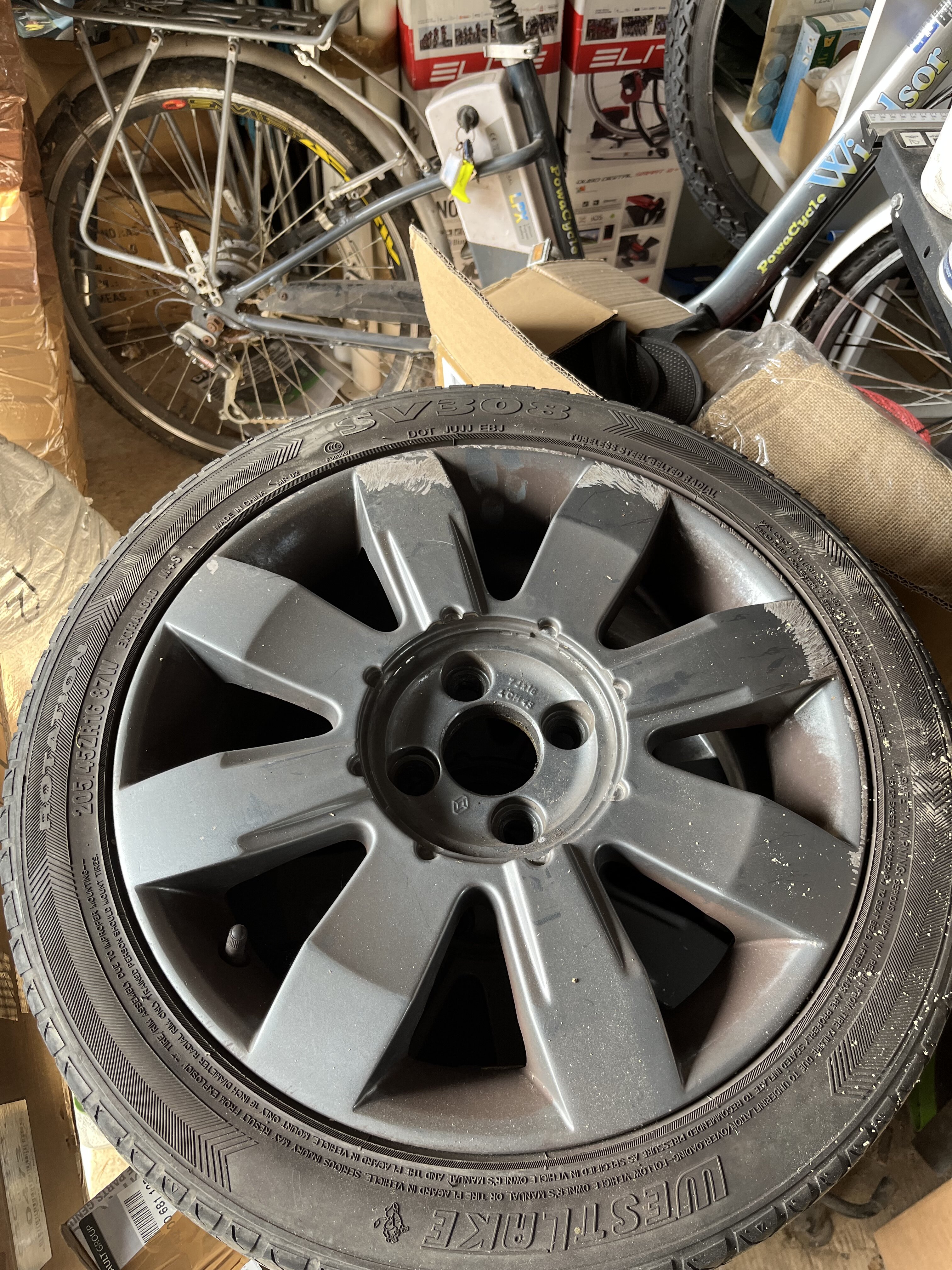

10 year old ditchfinders on 50p shaped rims are gone

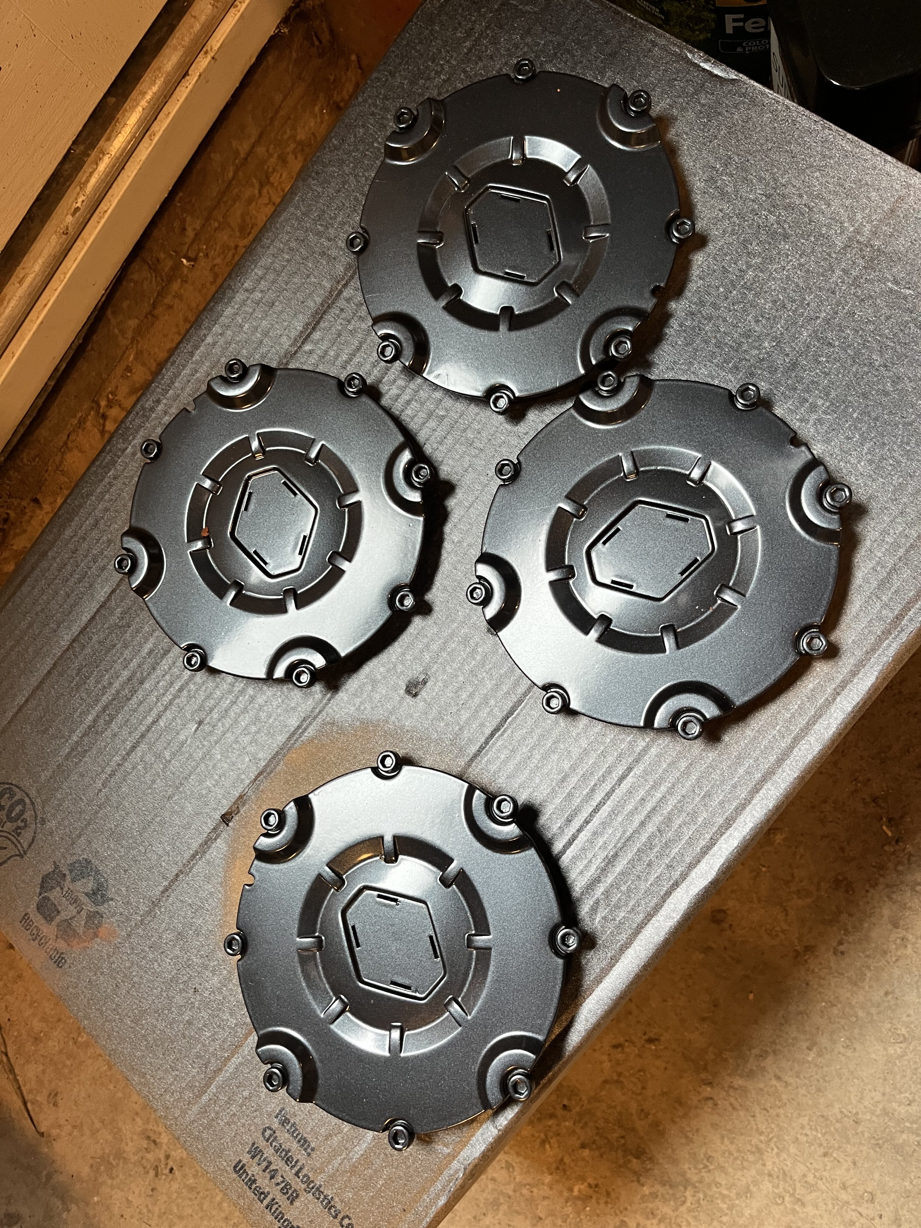

Rainsport 5s on refurb wheels are on:
Centre caps are being sprayed up:

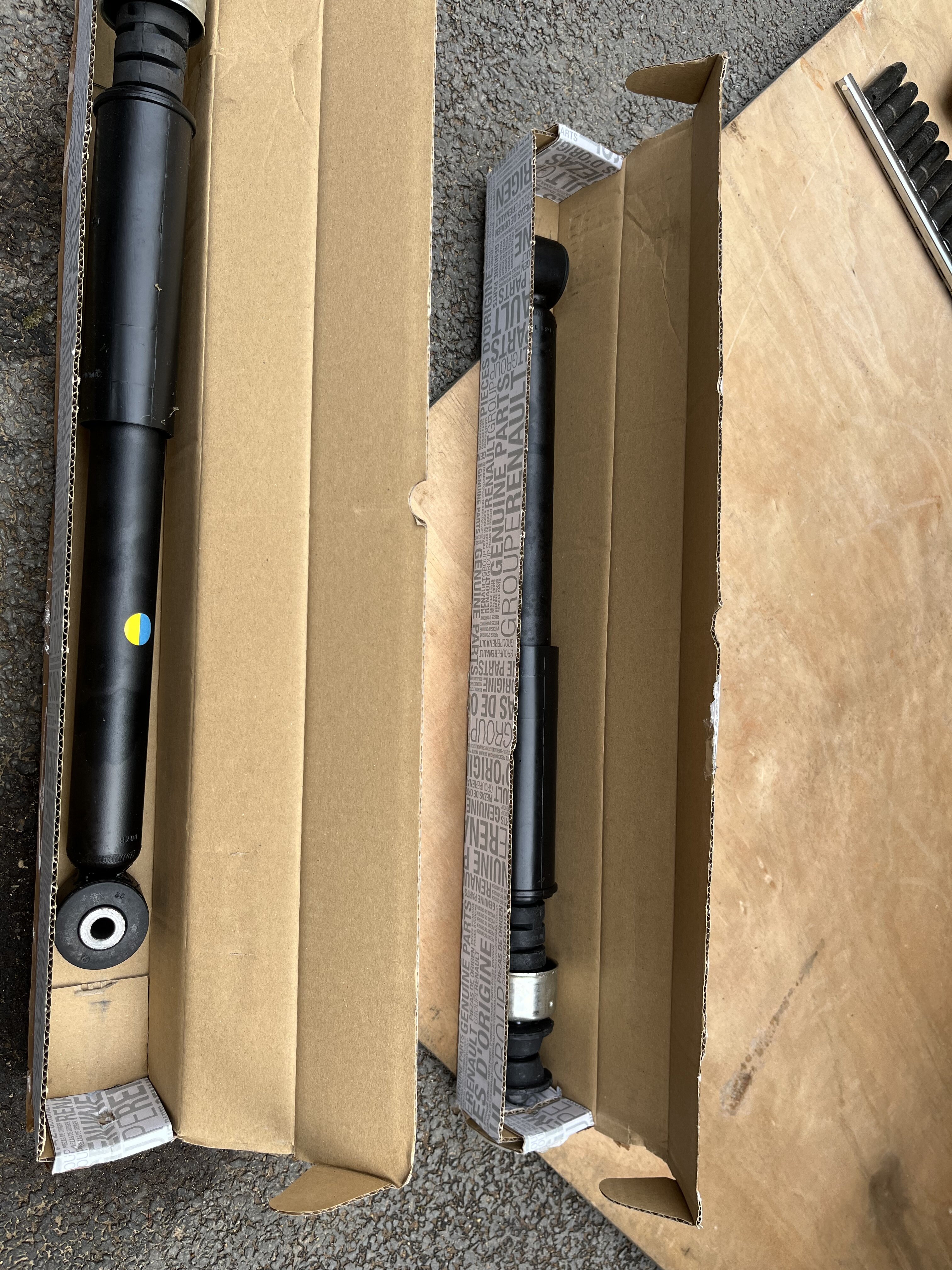

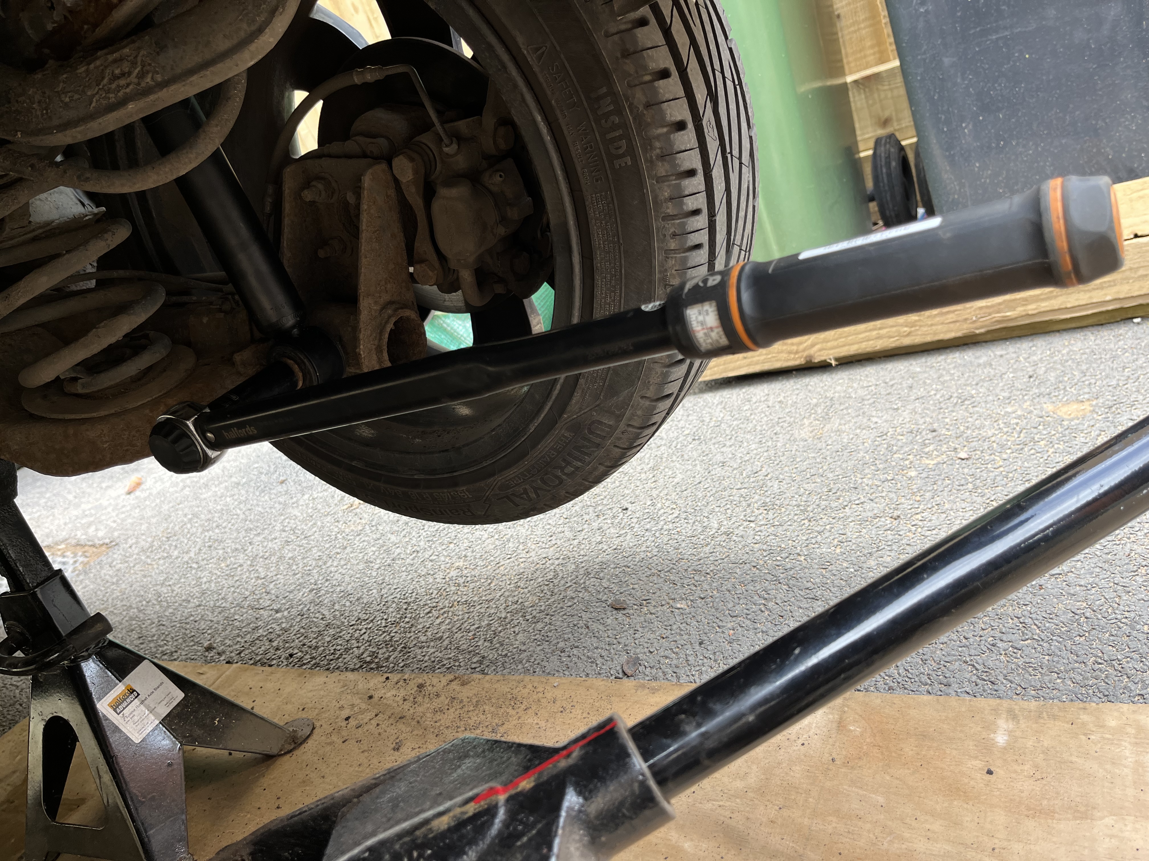

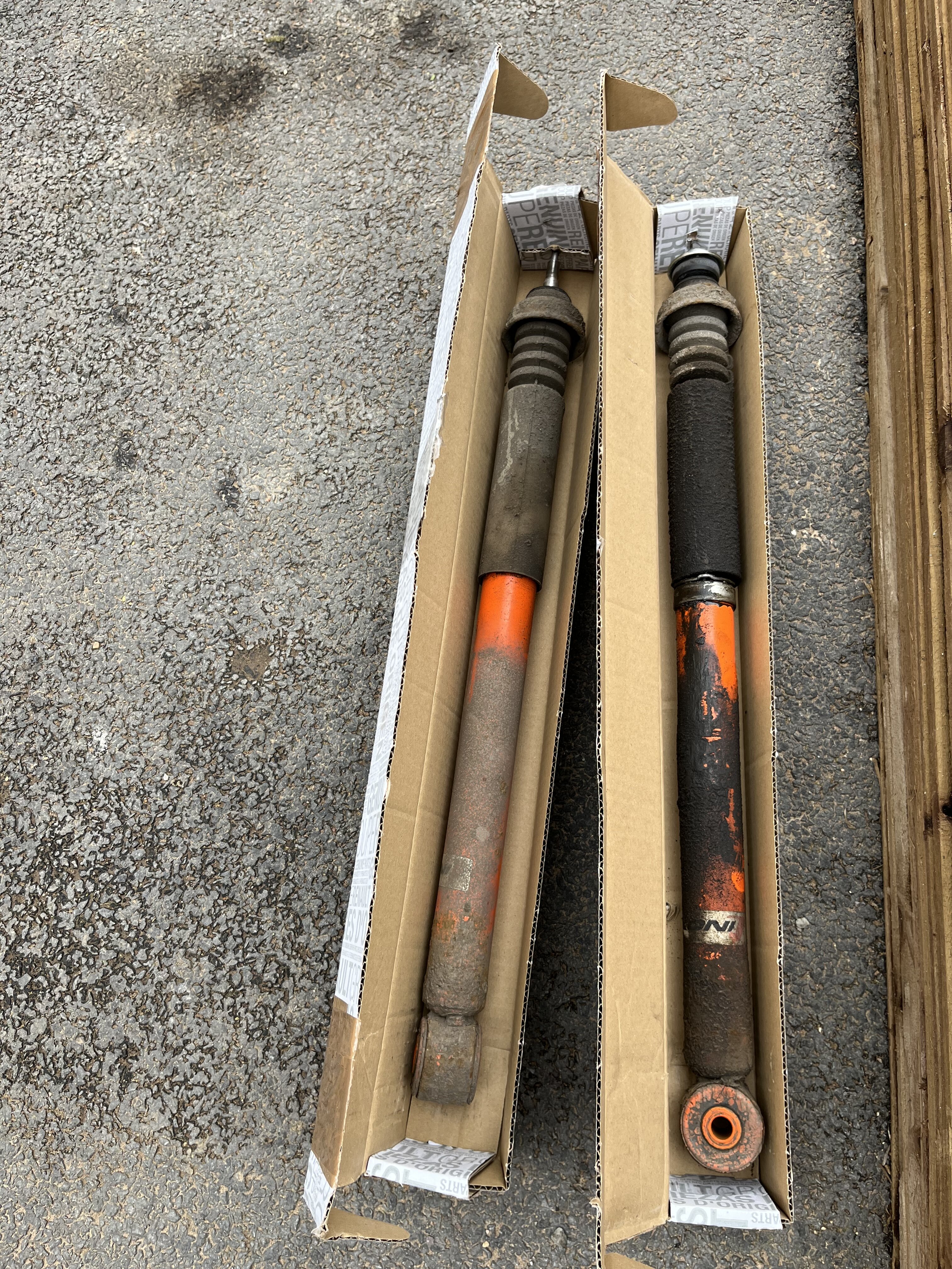

Also leaking koni rear dampers are off and binned.
New cup dampers are fitted:

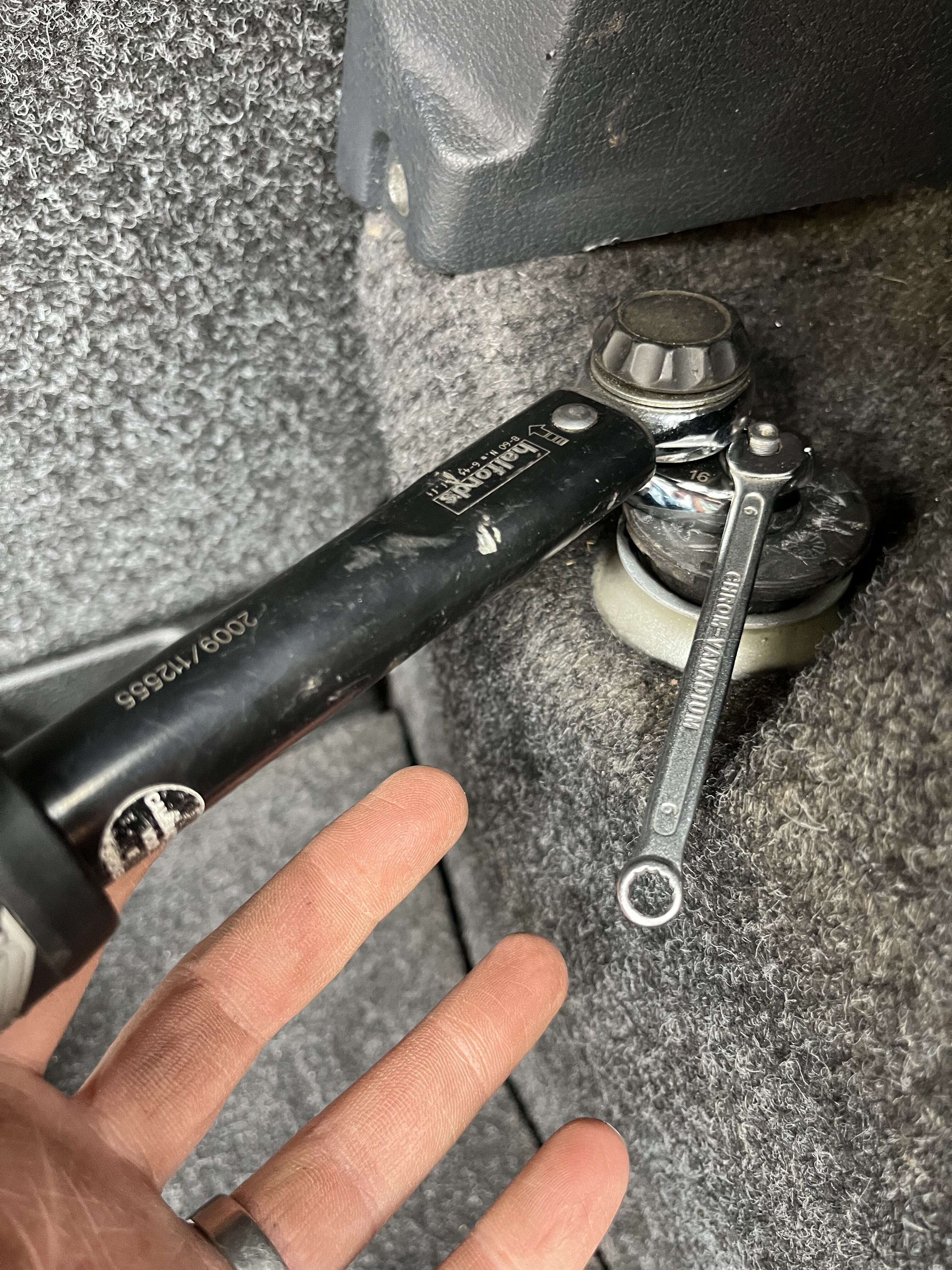

Probably a total waste of time to torque the top mounts to spec with a crows foot and a 6mm spanner rather than a rattle gun, but I want it right so hey!

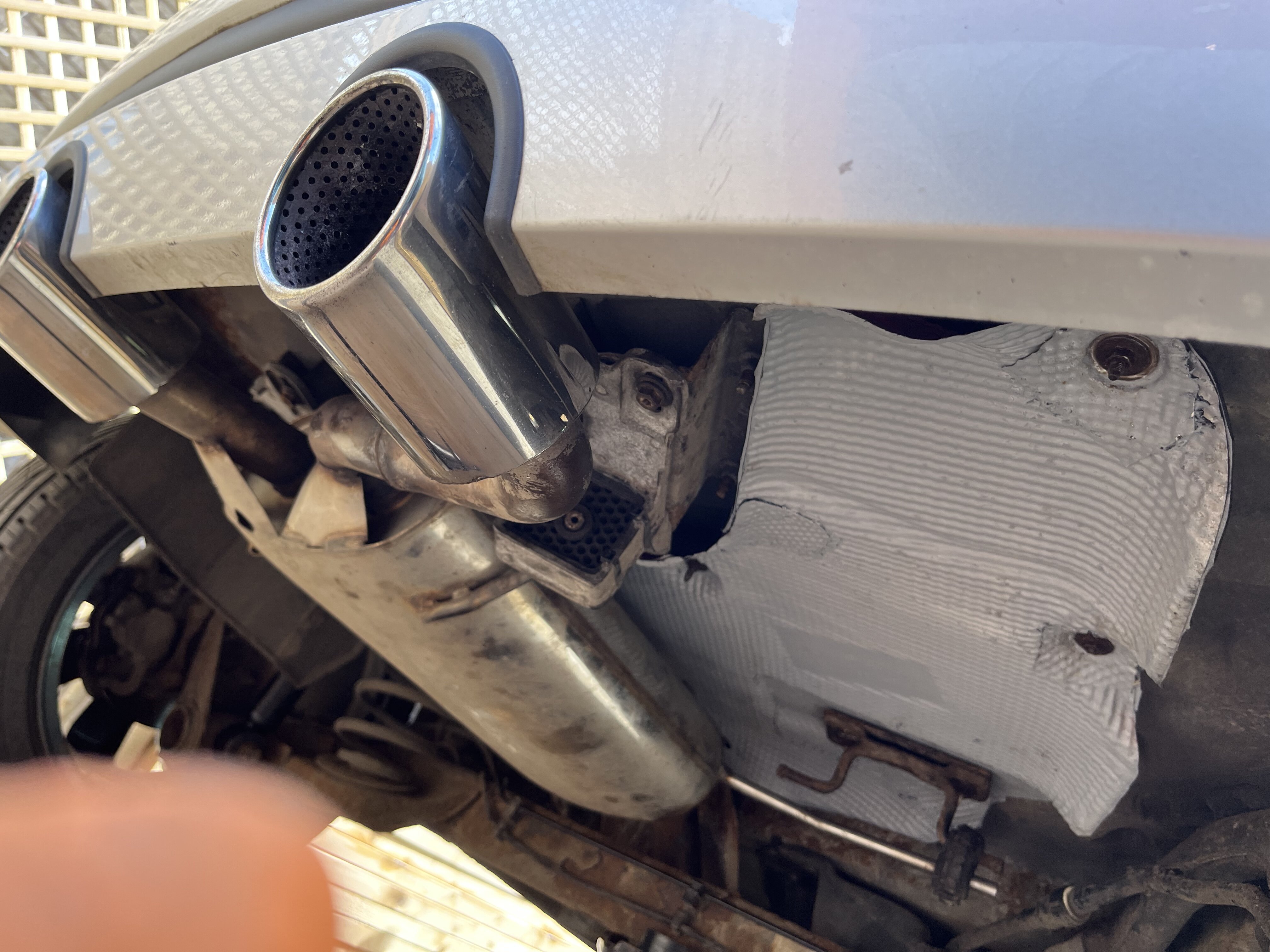

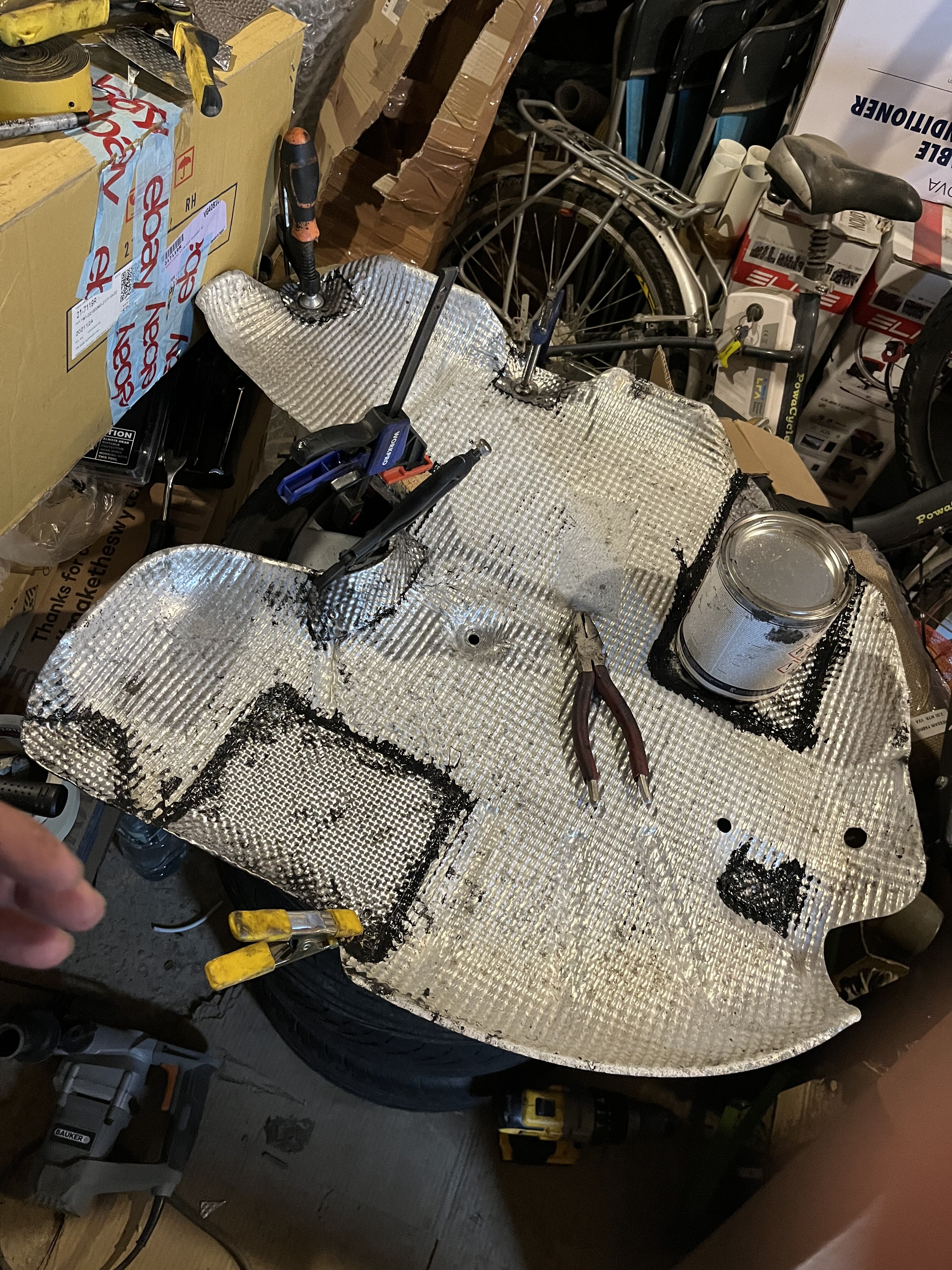

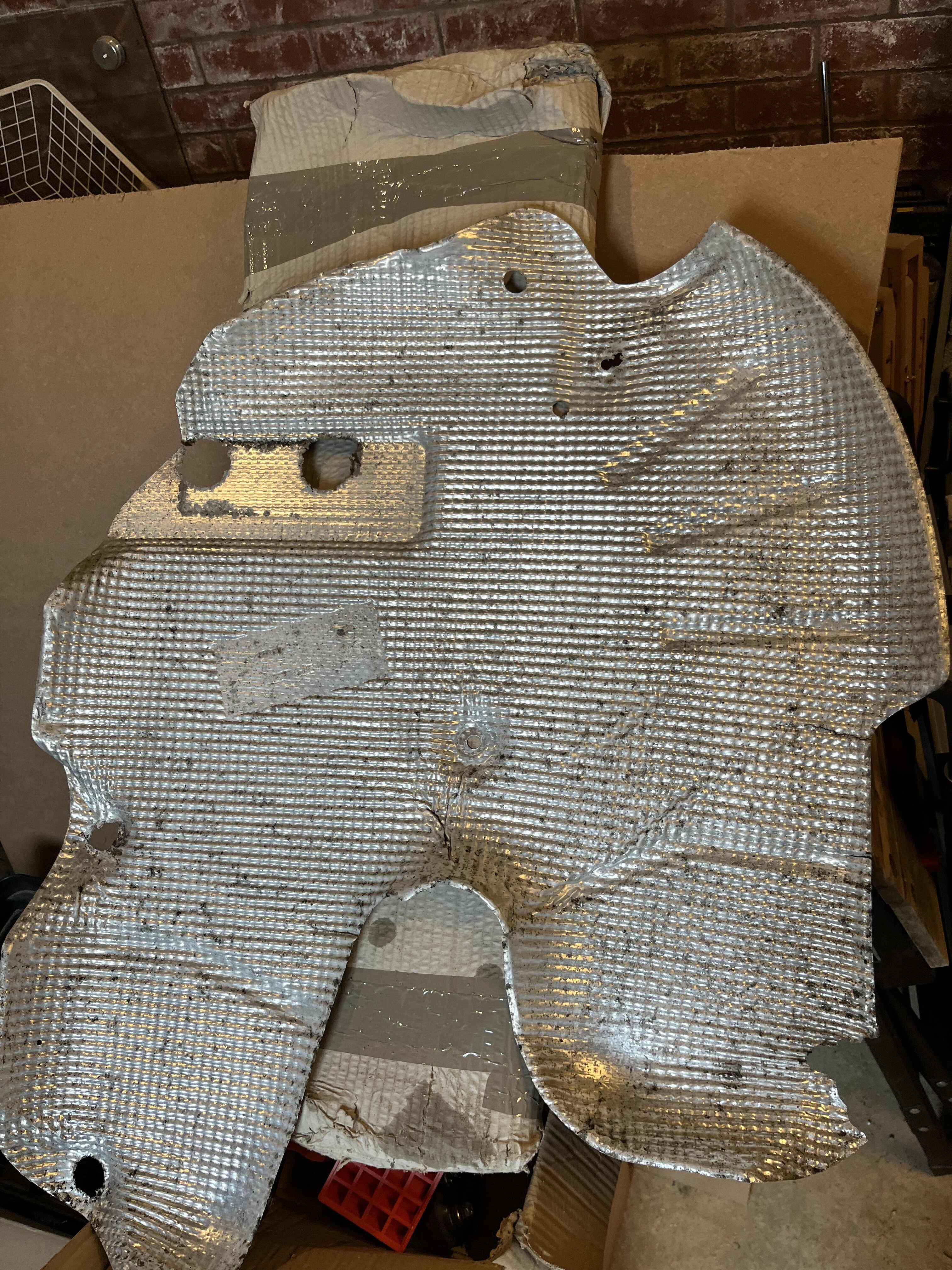

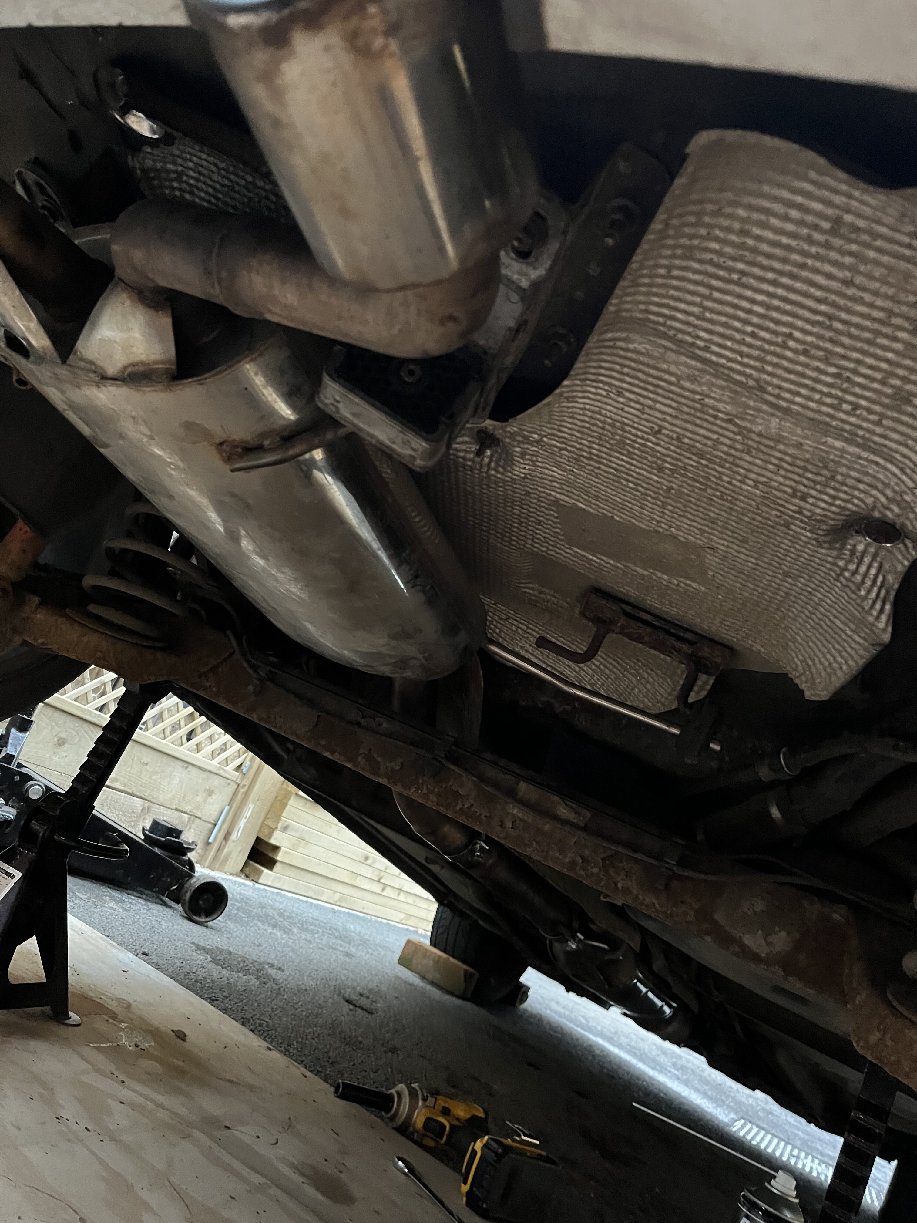

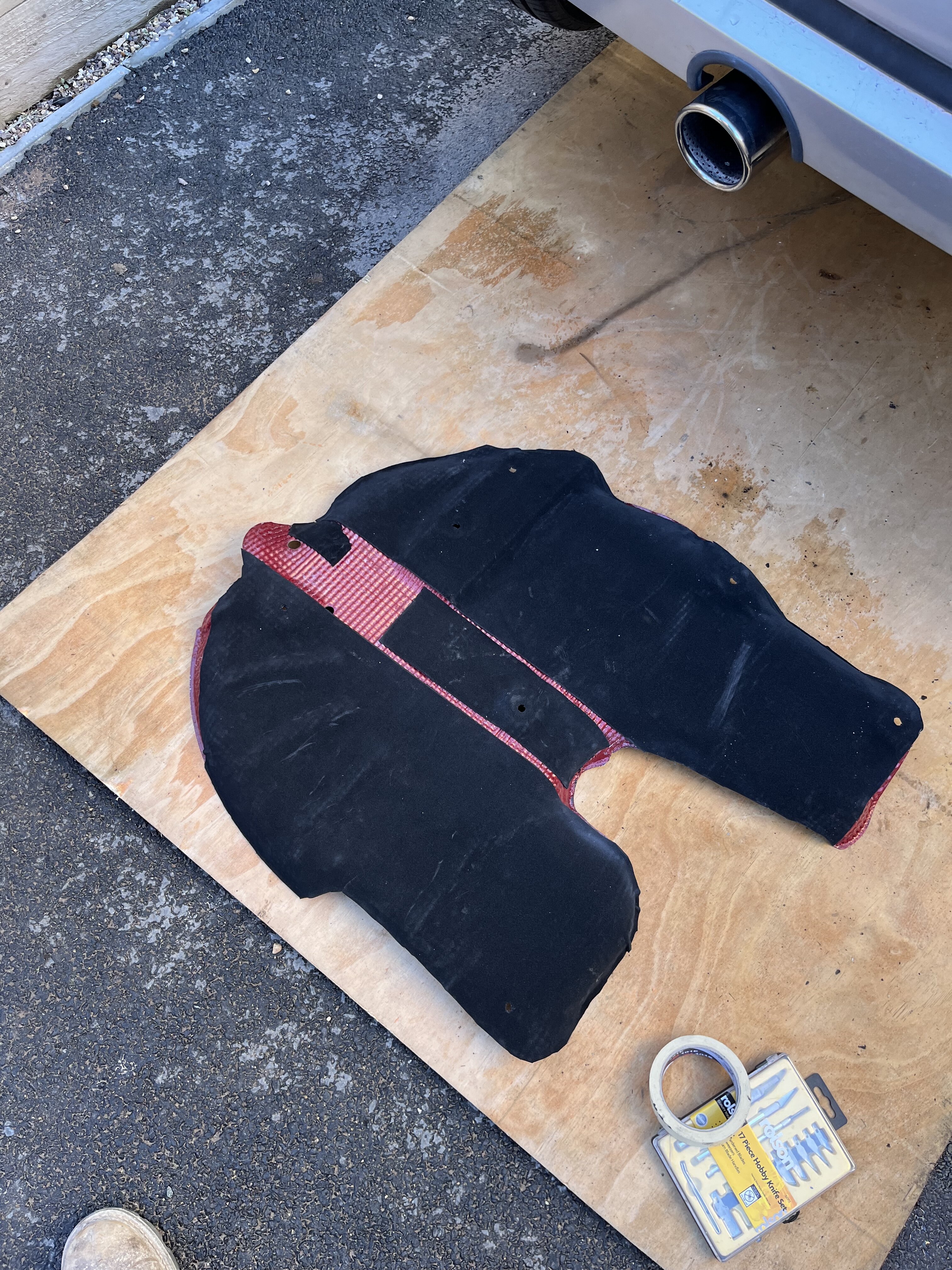

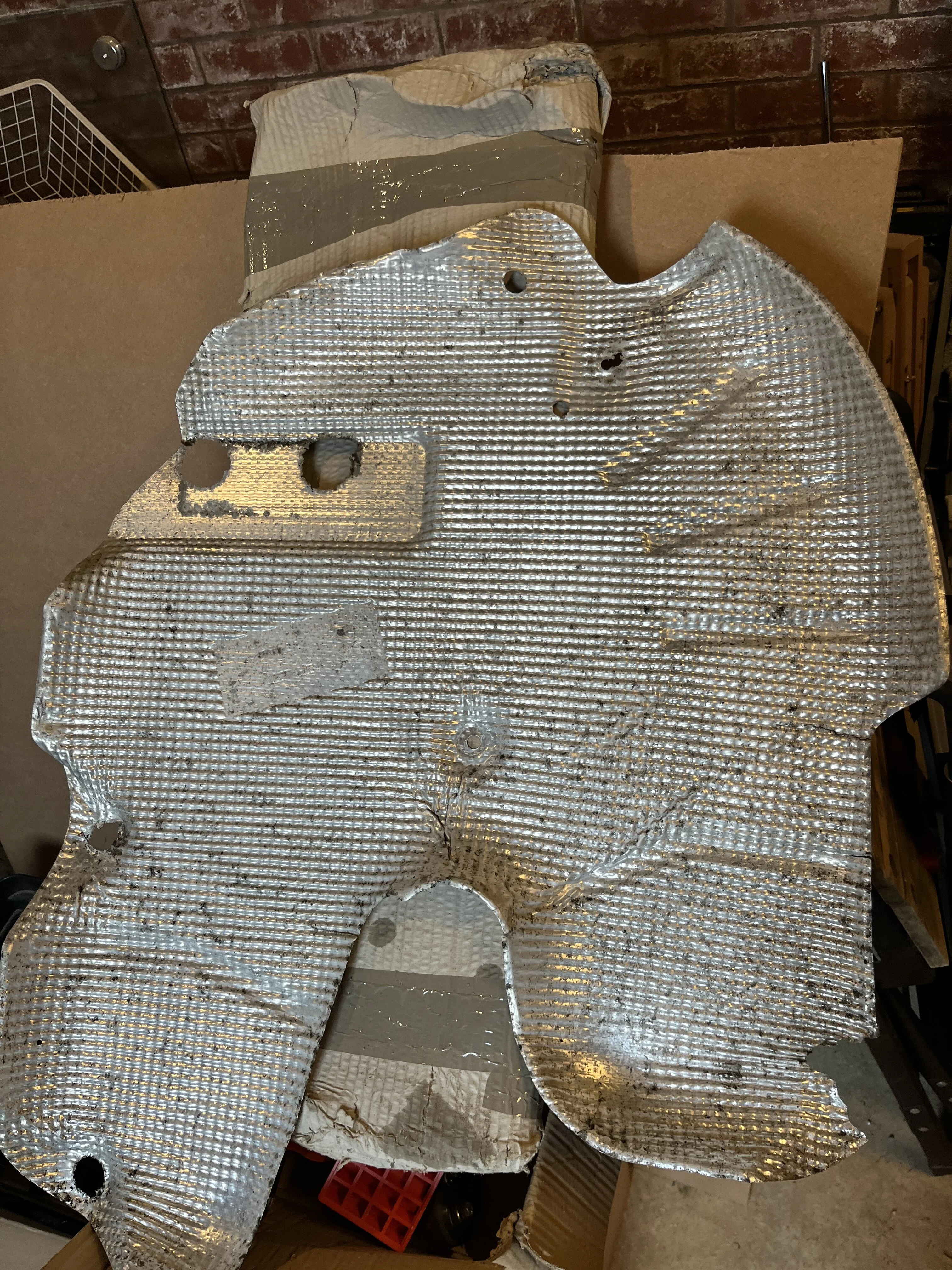

Last battle of the day is with the rattling exhaust heat shield. It’s cracked and the holes have split all over the place so:
Remove, clean and dry:
Repair with a sheet of heat shield from car builder solutions:
Waiting for the tiger seal to go off so I can re drill the mounting holes, cover with foam, and refit!

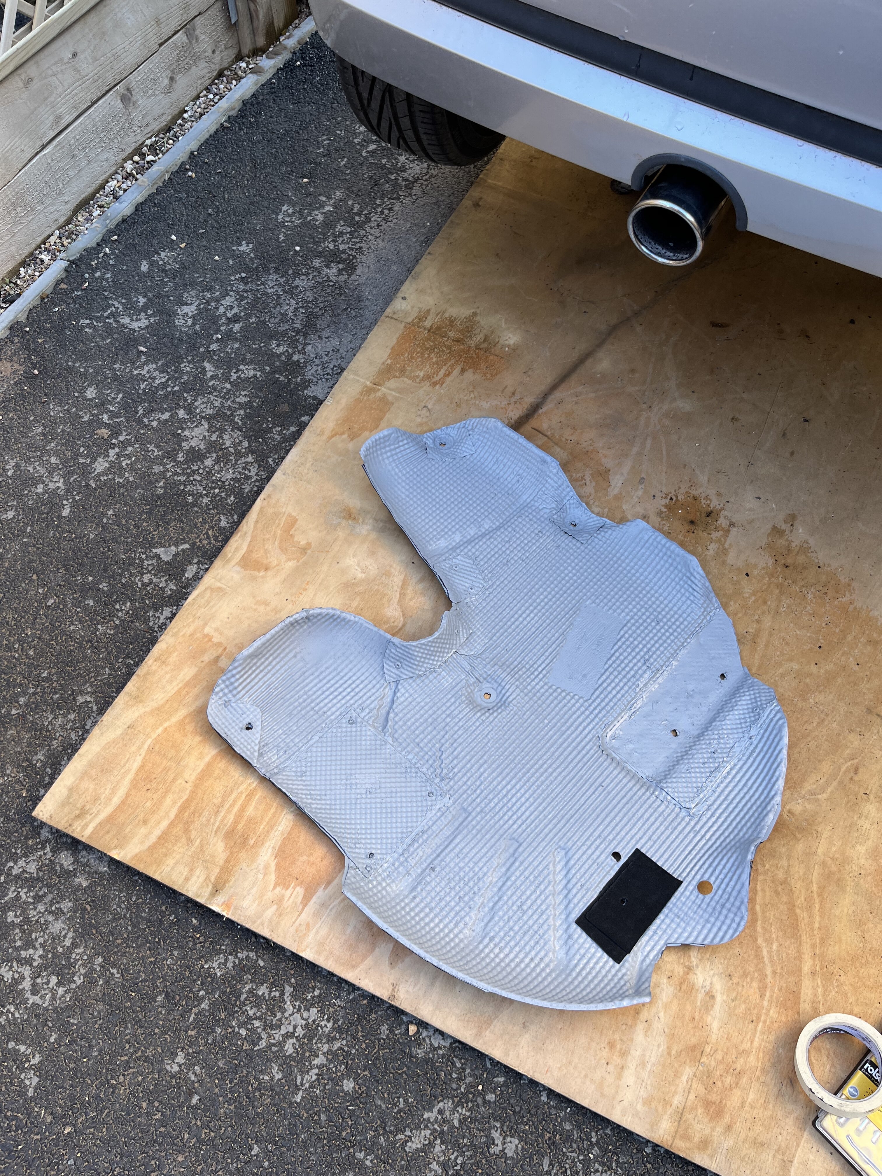

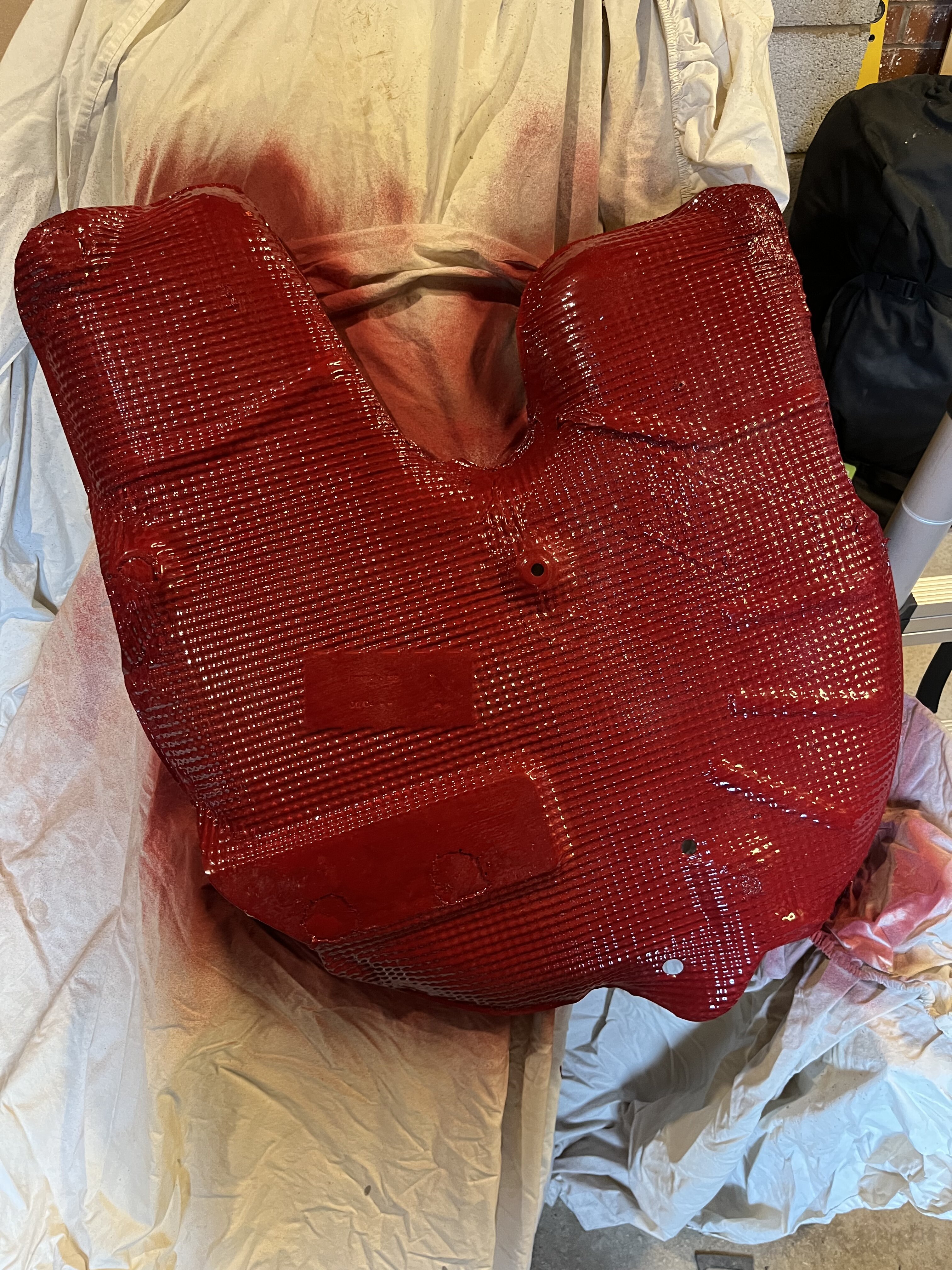

Thought I’d give the top some corrosion protection. Nissan red because I had a can from an old car
Heat shield finished off.
Painted top and bottom to combat corrosion, and a layer of 1mm closed cell foam to stop rattles:
Fitted:

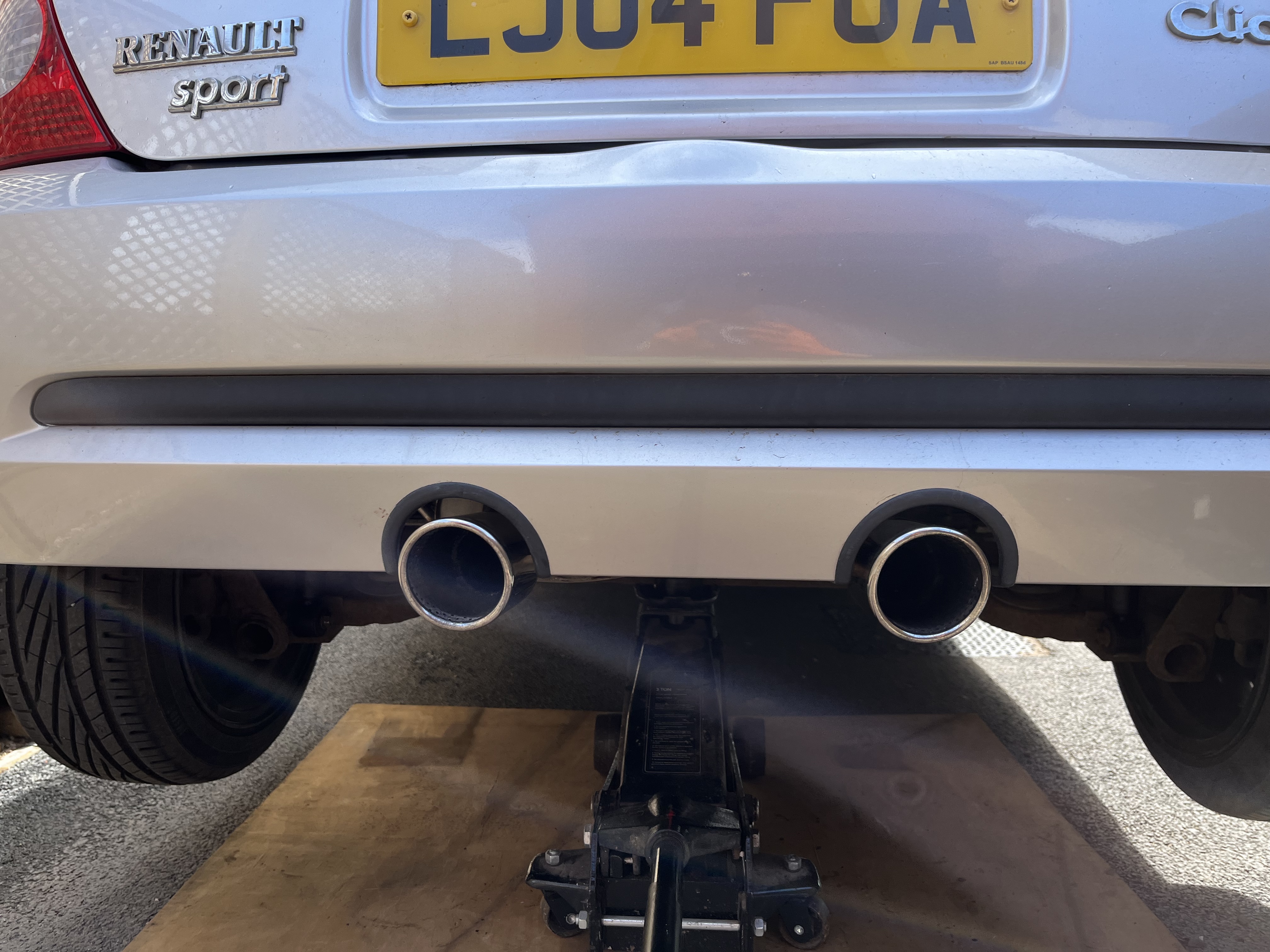

And exhaust tips polished and centred nicely:

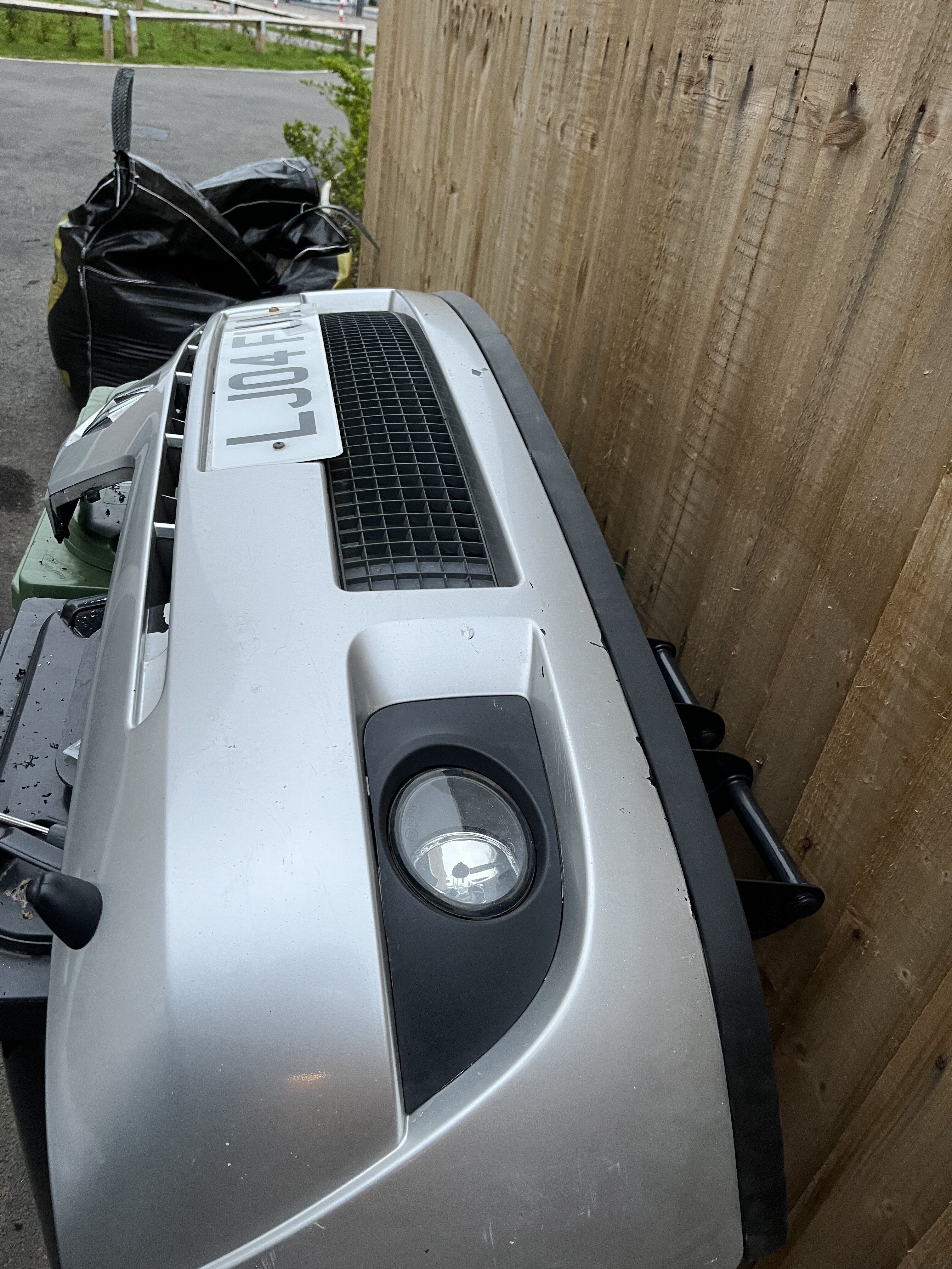

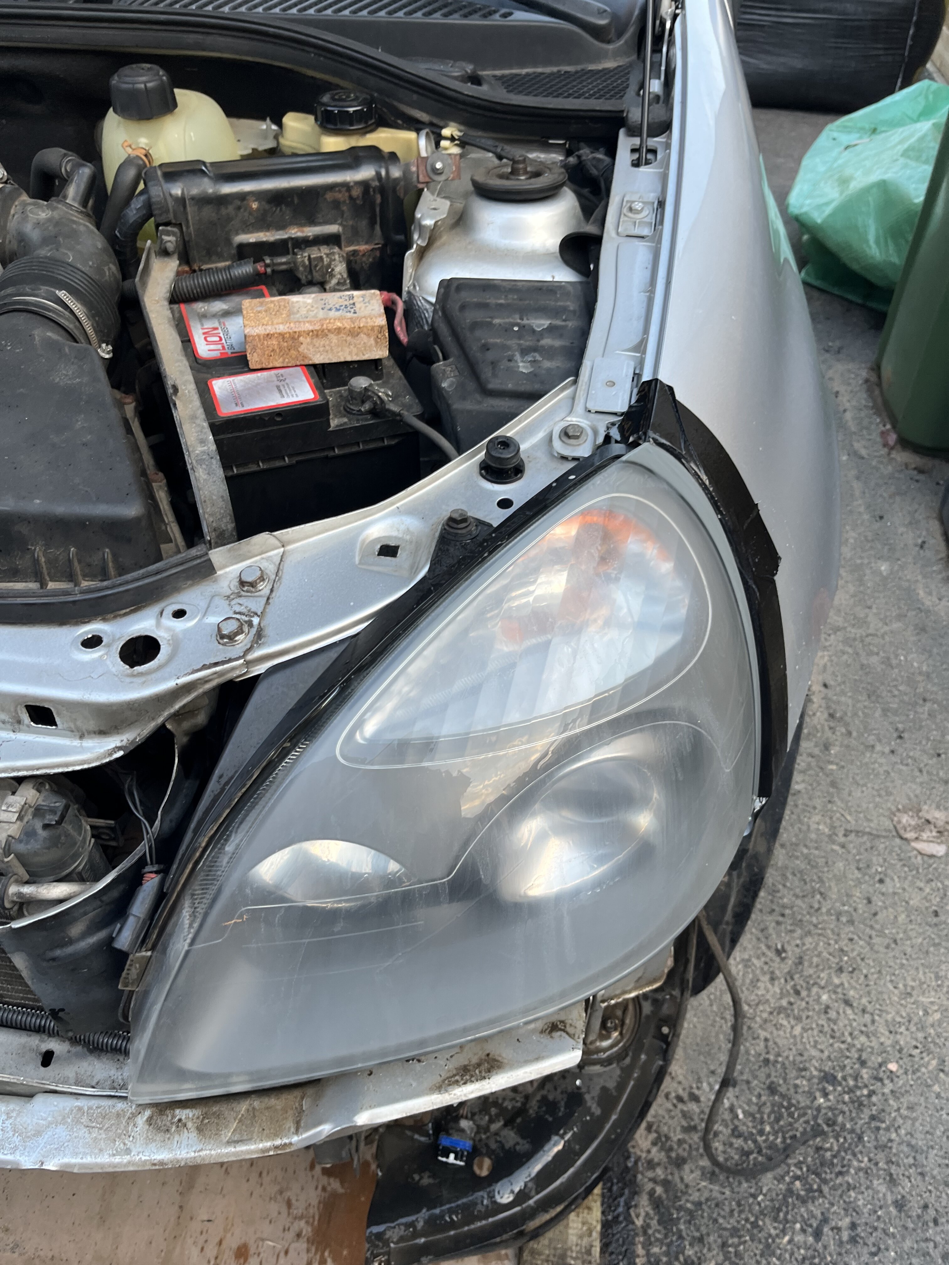

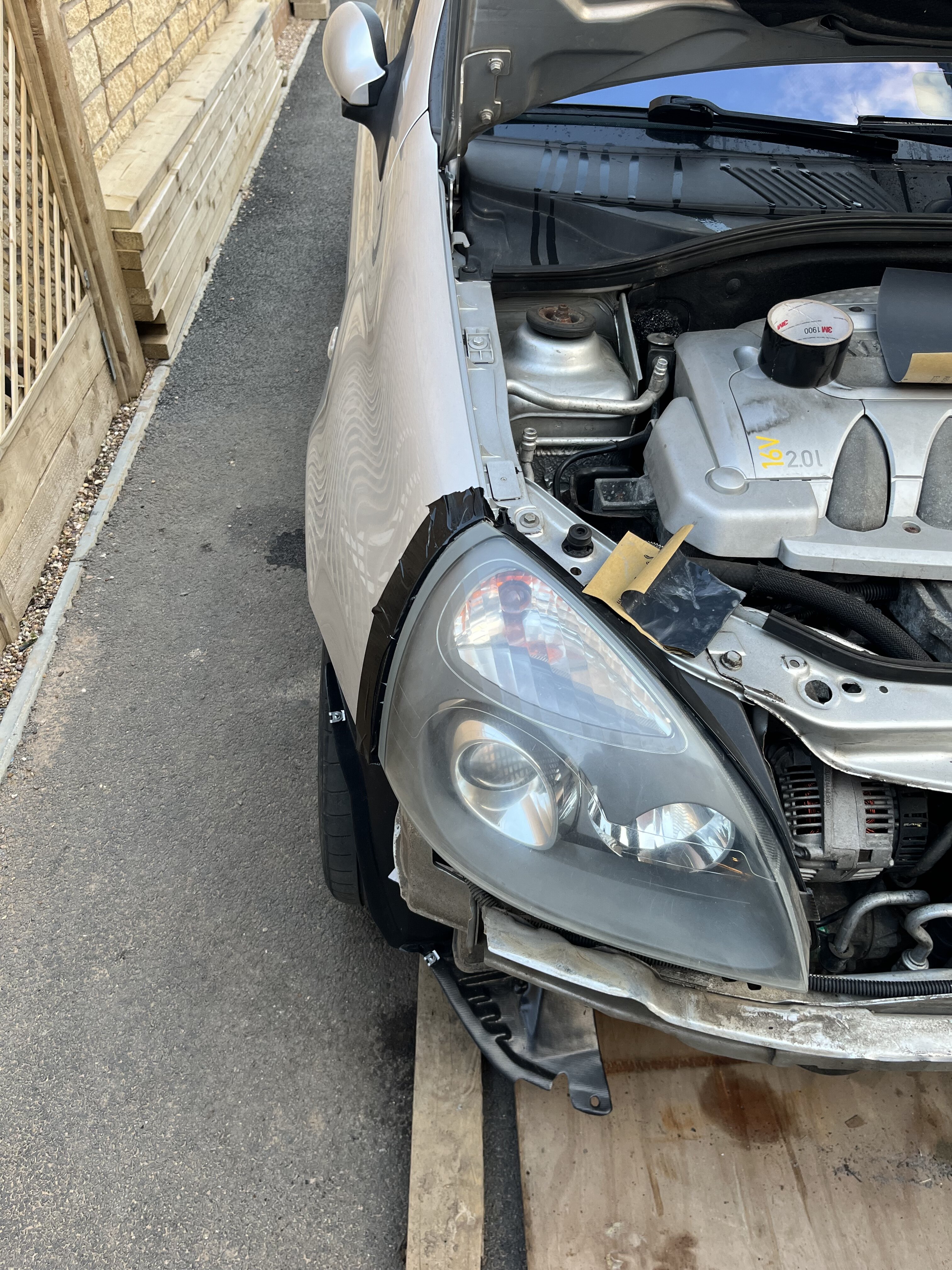

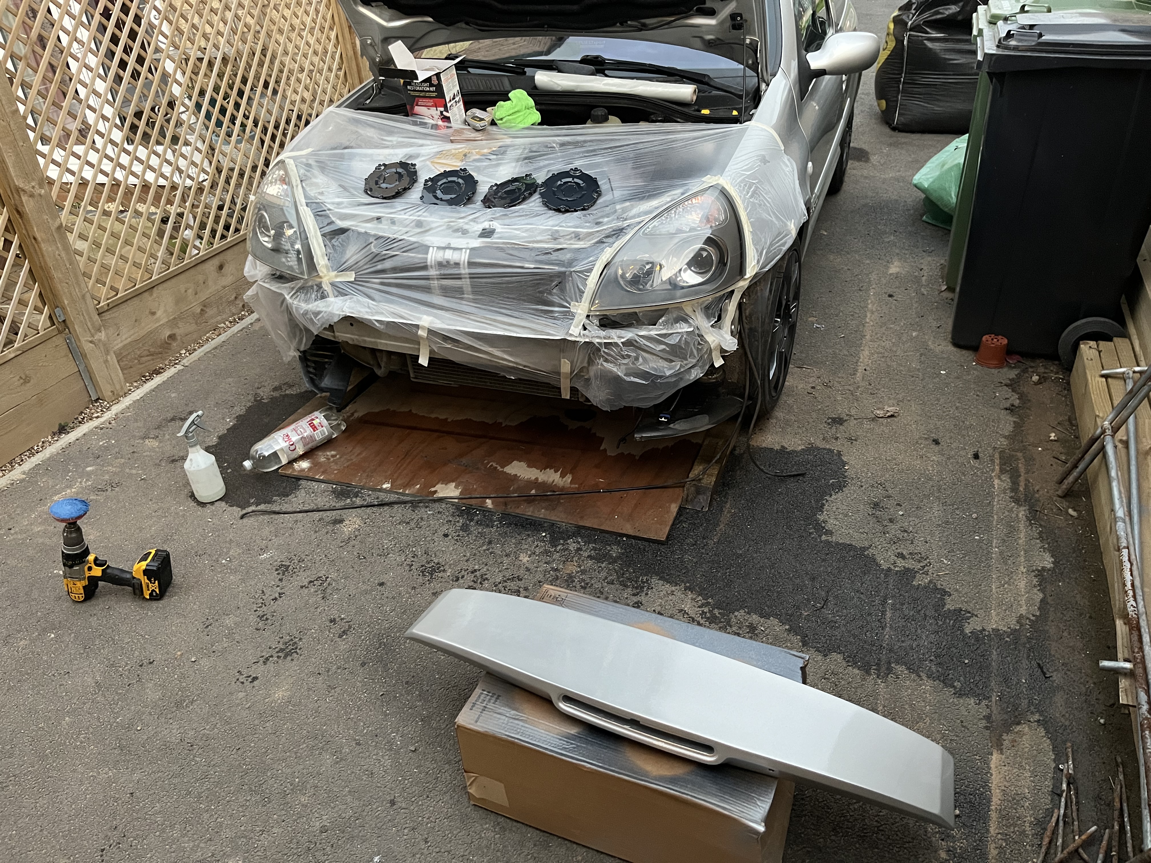

Just waiting for my Autococ delivery now, the next job is the front bumper off for the following:
Replace cracked headlight washer
Fit Skoda fabia splitter
Plastic weld the grille
Polish headlights (attempt 2. Will lacquer them this time not use the stupid ‘protector’ spray in the kit)
Fit new aircon condensor
Replace aircon seals.
Fit front wheelarch liner

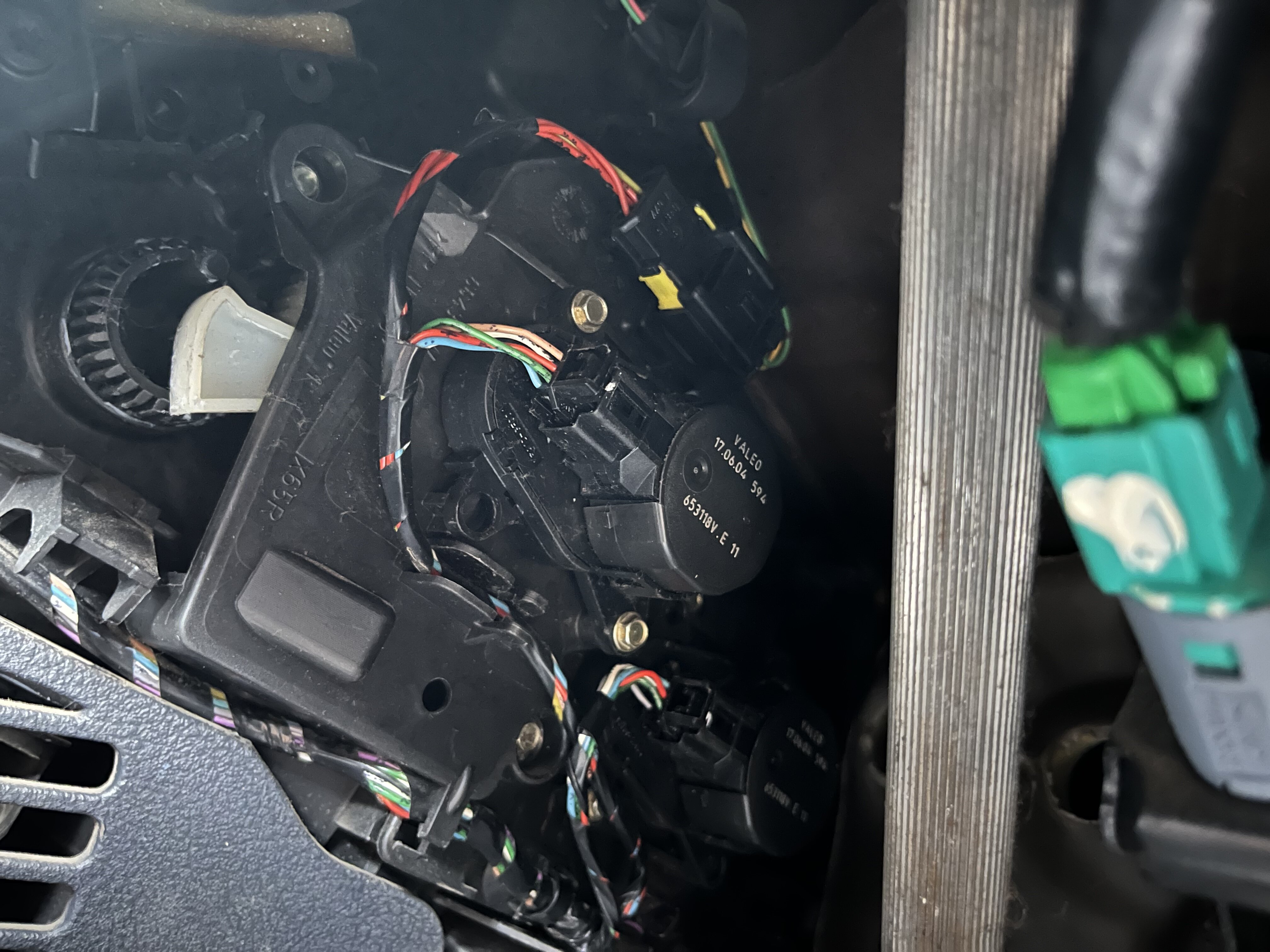

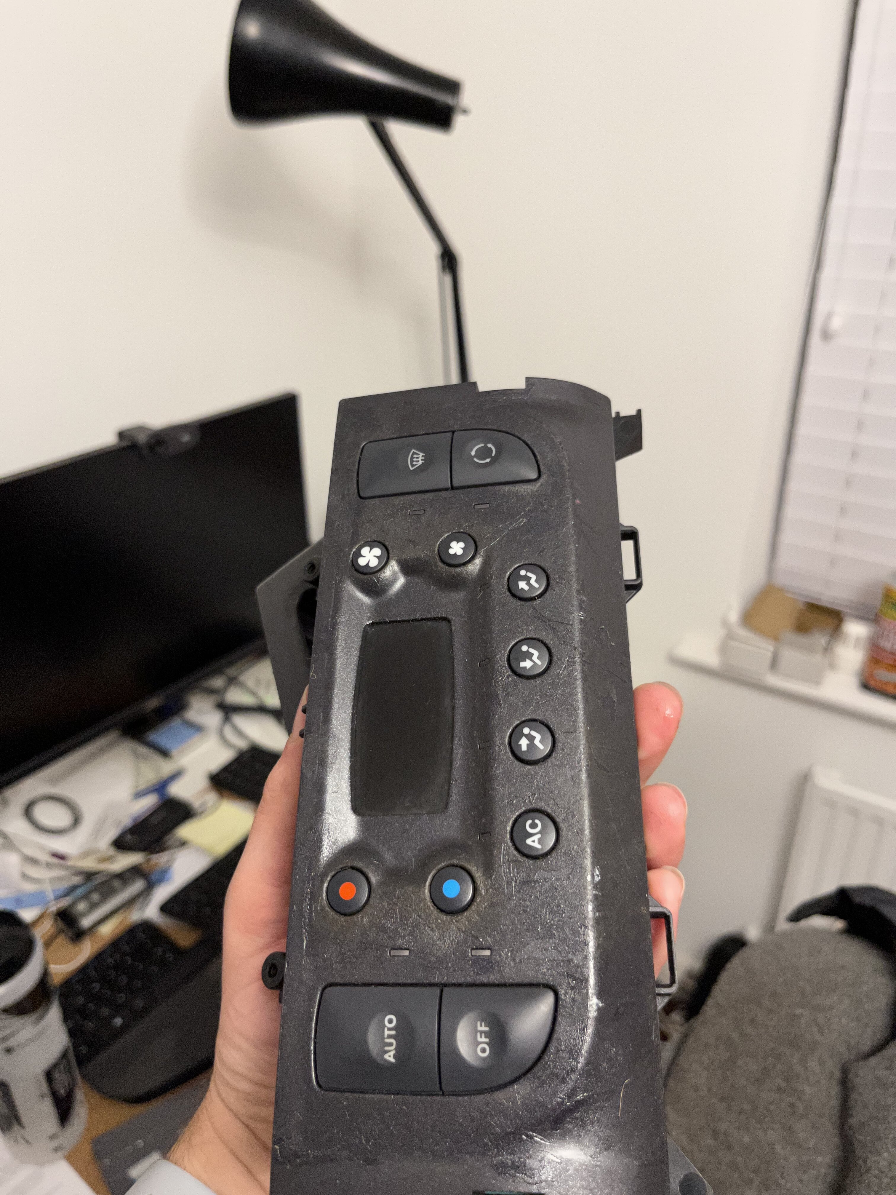

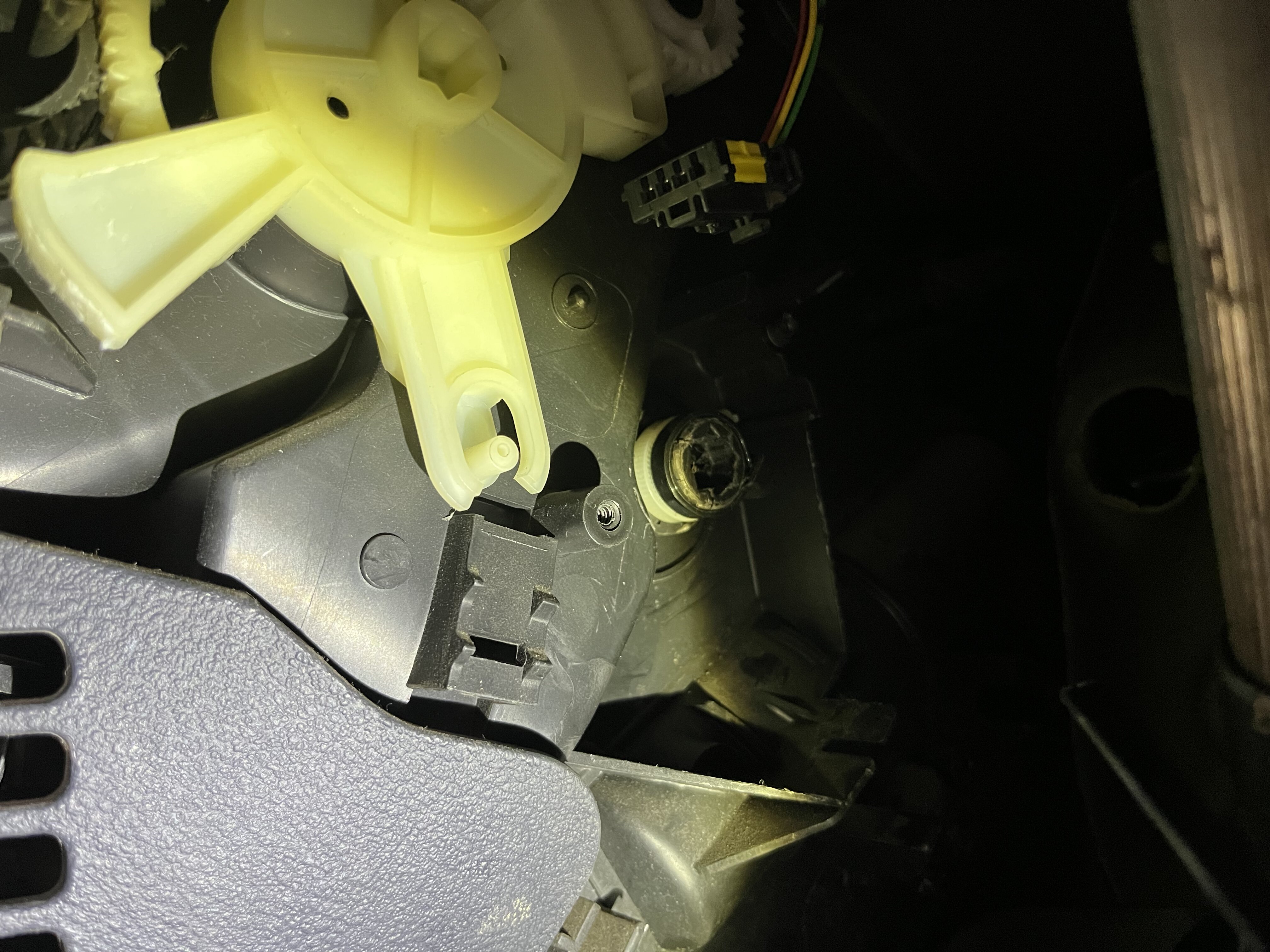

Rainy today and I’m feeling rough so no major work, but I have been having hassle with the heater lately blowing odd temperatures. A quick search led me to the star shaped gears on the heater box so:
Led to:

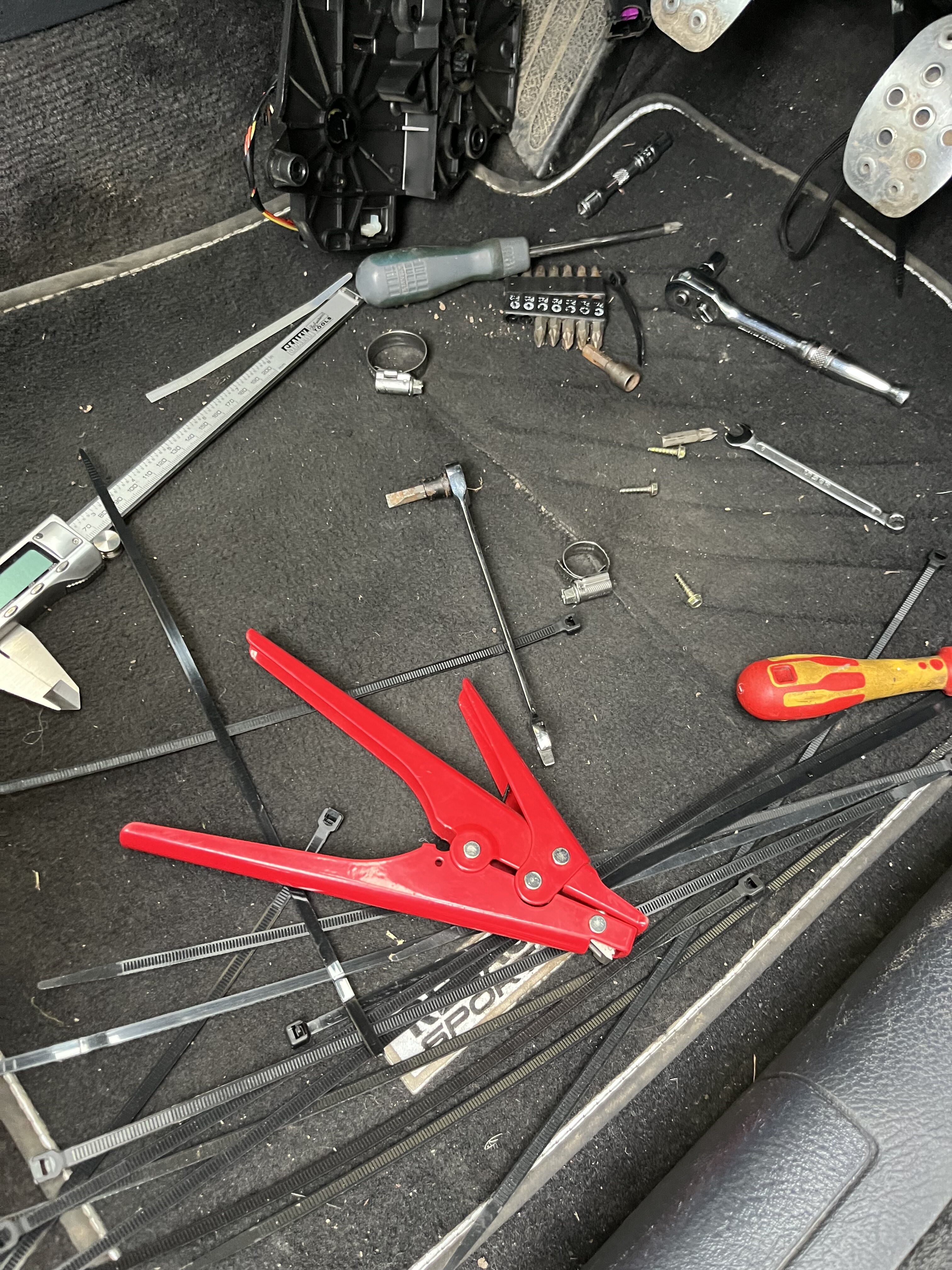

I couldn’t get a jubilee clip on and I’m too anal to deliberately remove the spring clip from the expansion bottle and replace it with a jubilee, so cable ties it is.
After several attempts and many cuts on my hands I got to:
I have a heater that goes hot and cold when I ask!!!!

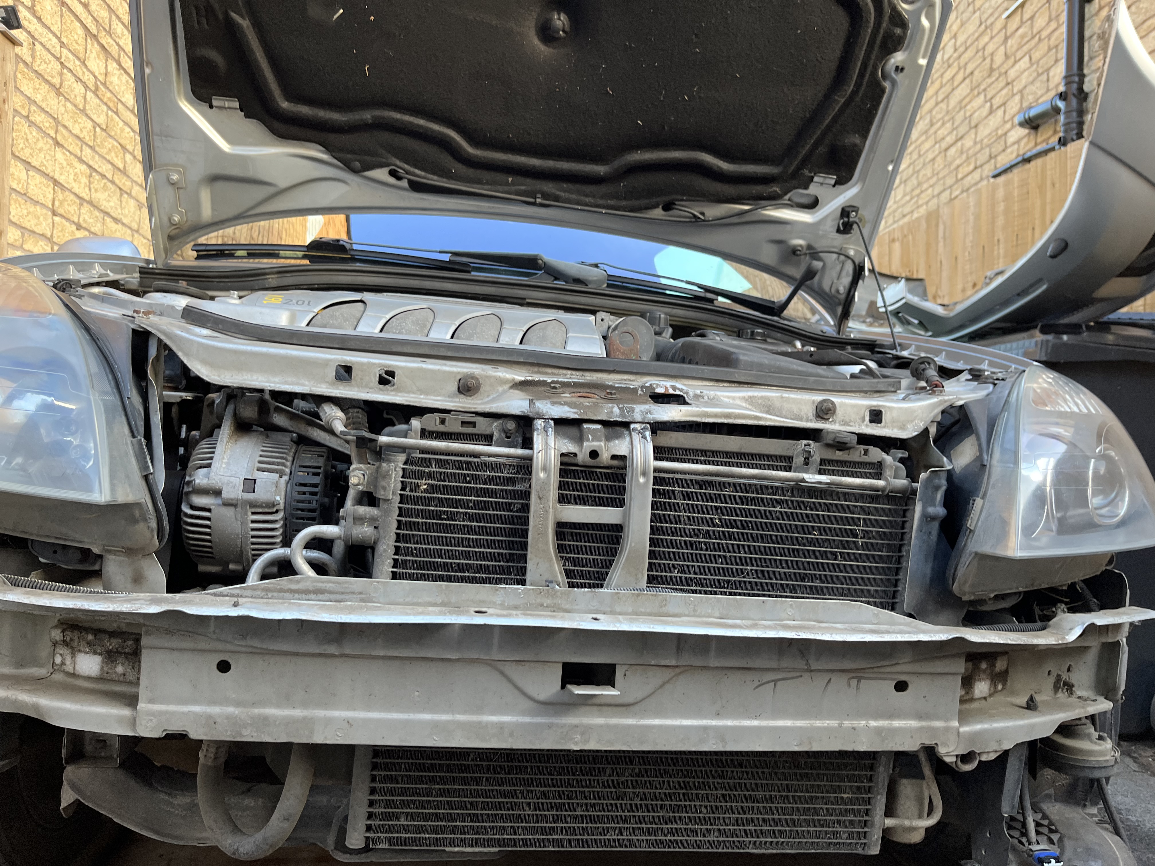

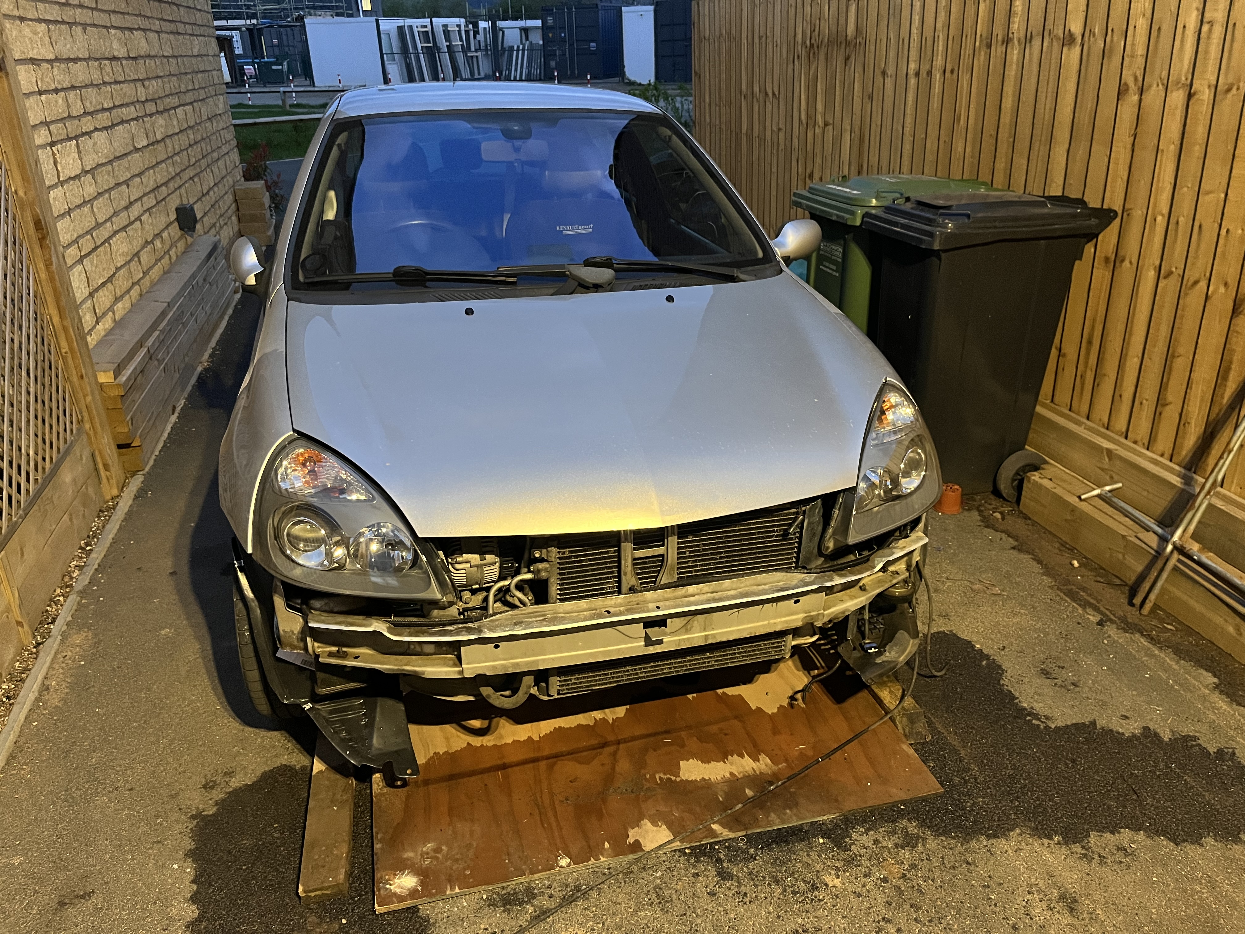

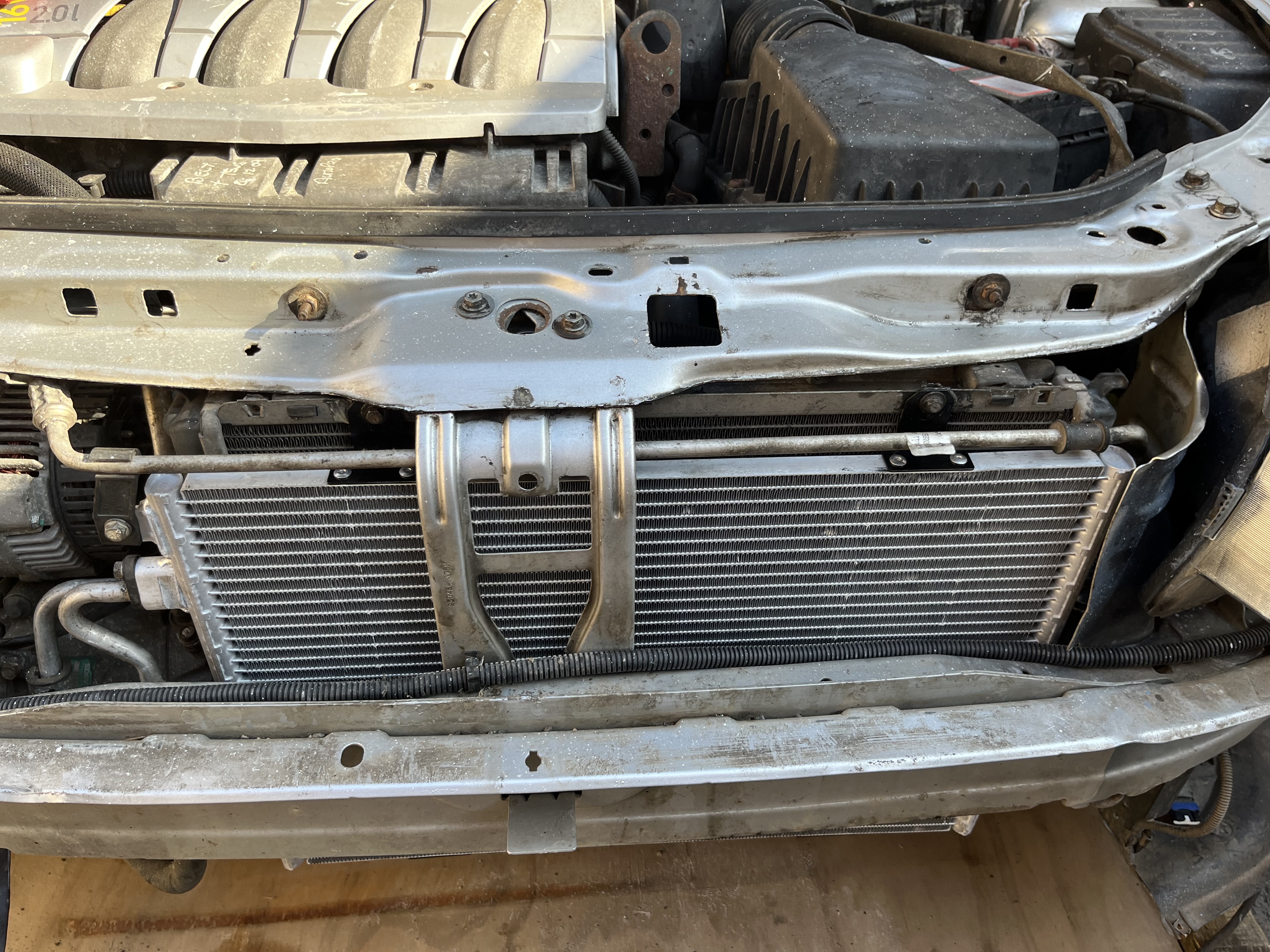

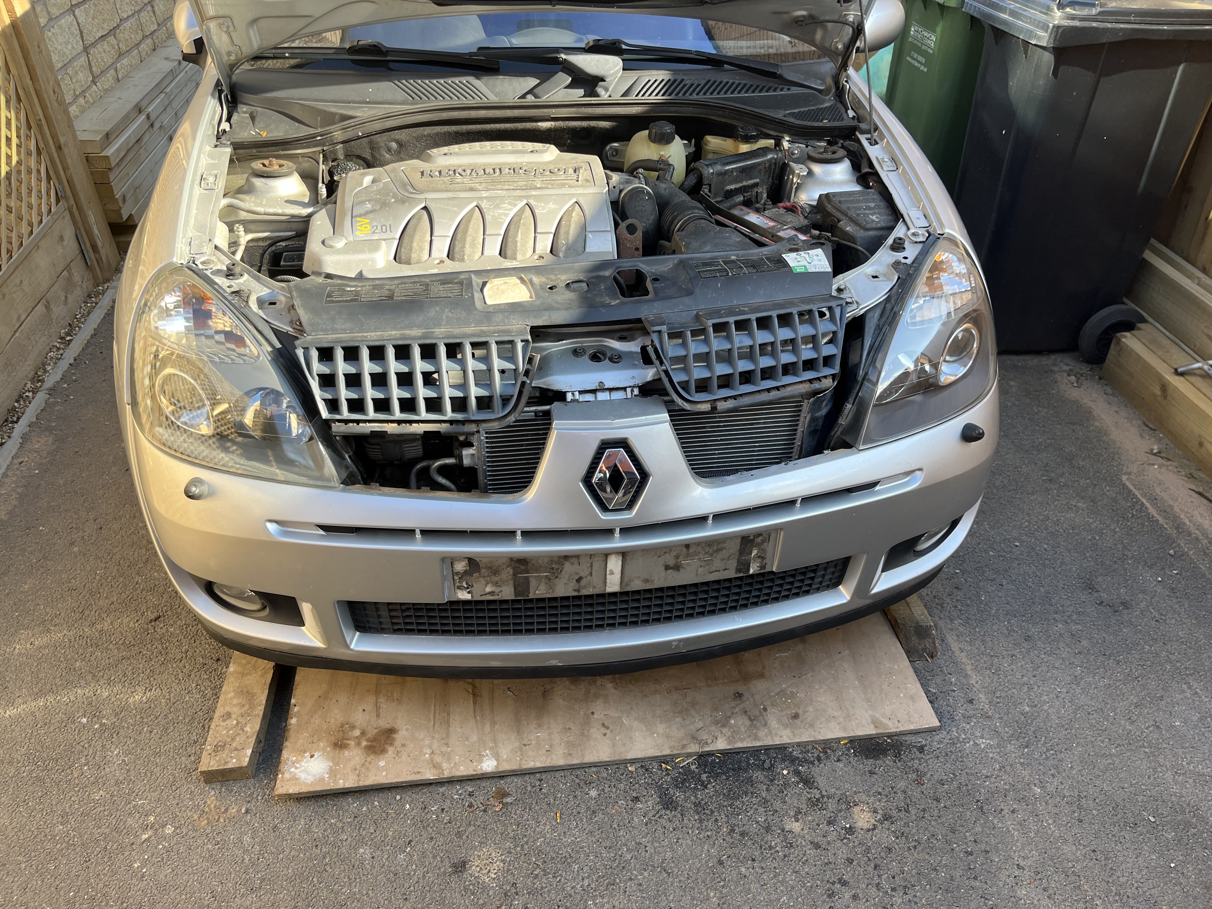

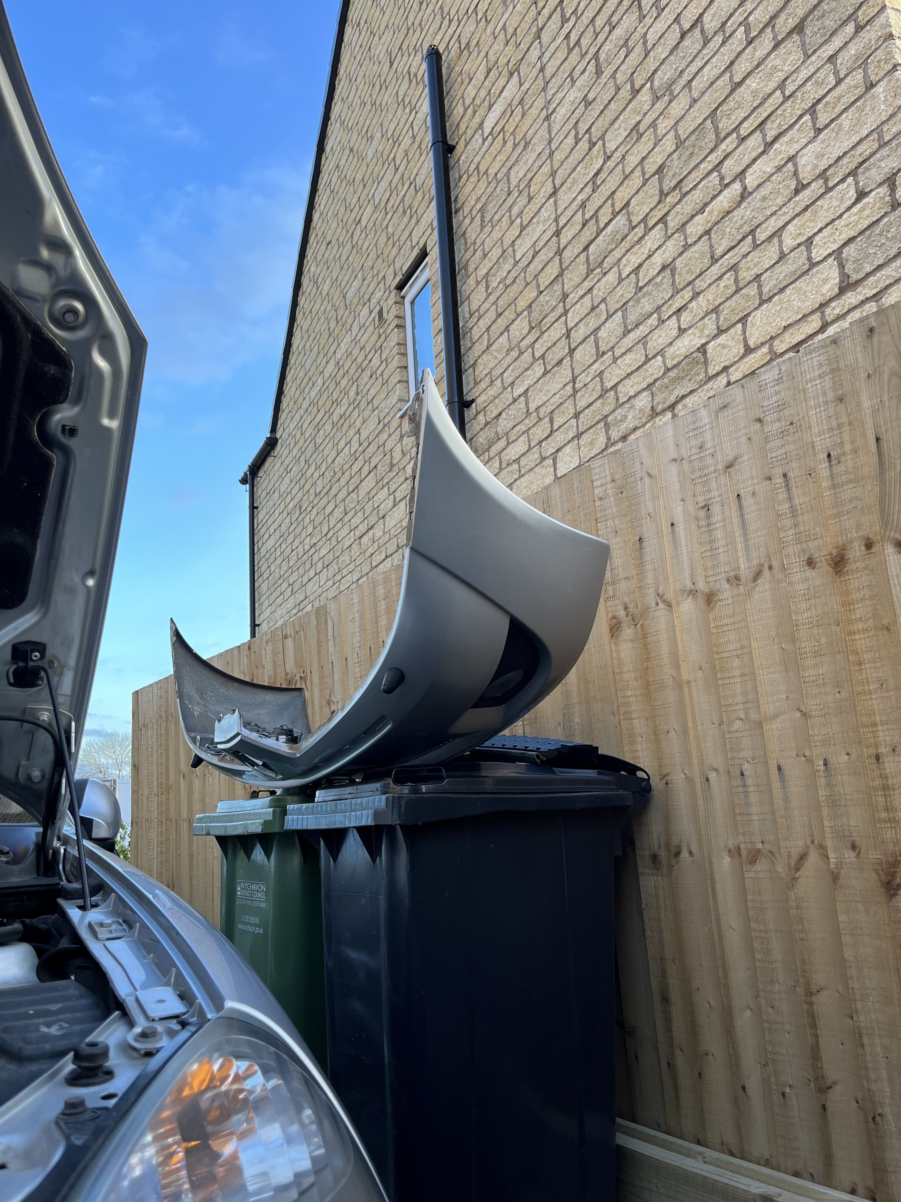

Frustrating day. I stripped the front end to fit the new AC condenser, and Autodoc have shipped the wrong part. Also, I cracked the bumper pulling it out of the the clips. :-(
Spot the difference…
Fighting with Autodoc returns now. Anyone know a UK supplier?
Slightly tempted to drill out the rivets and move the mounts onto the new condenser…

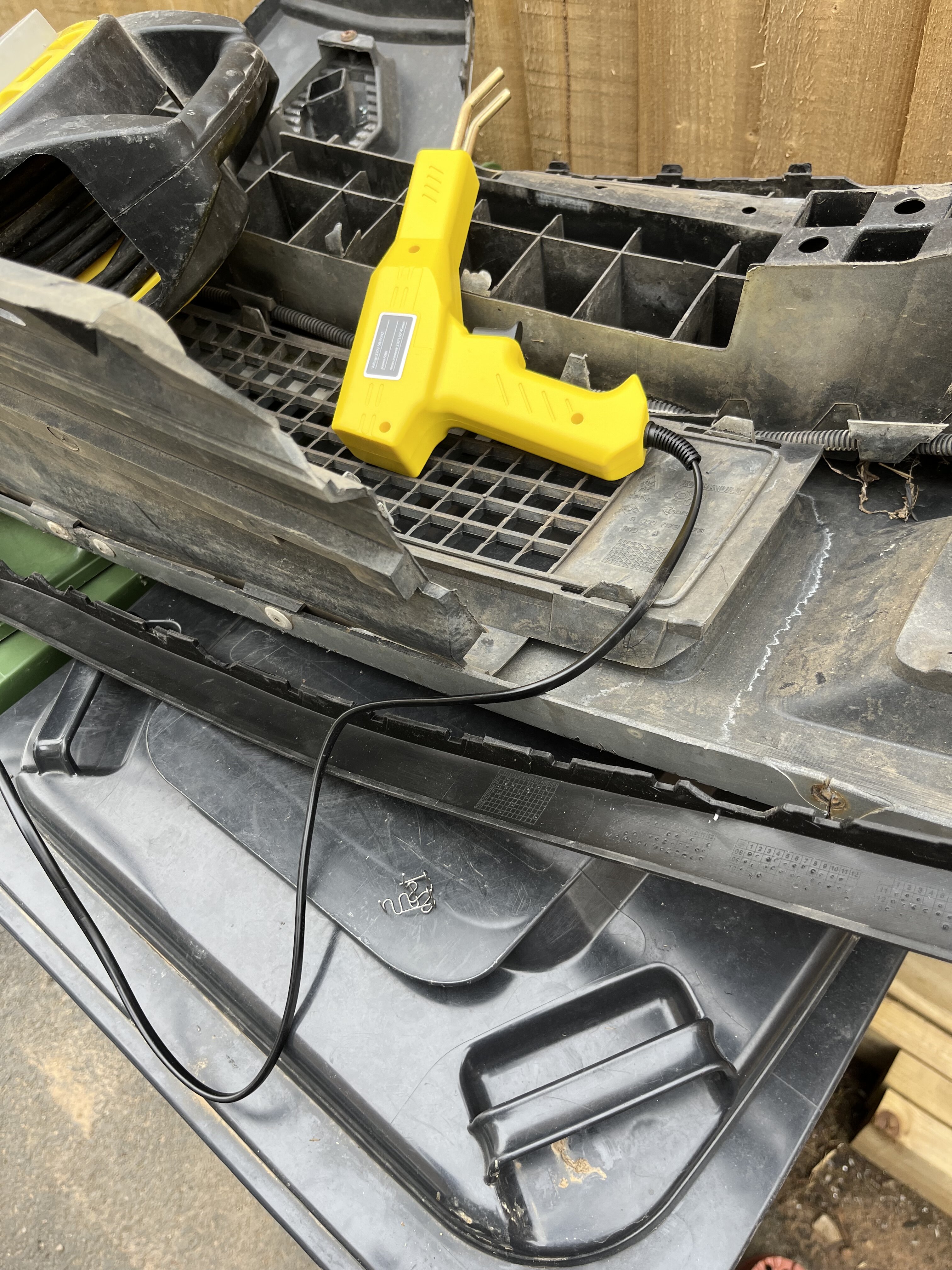

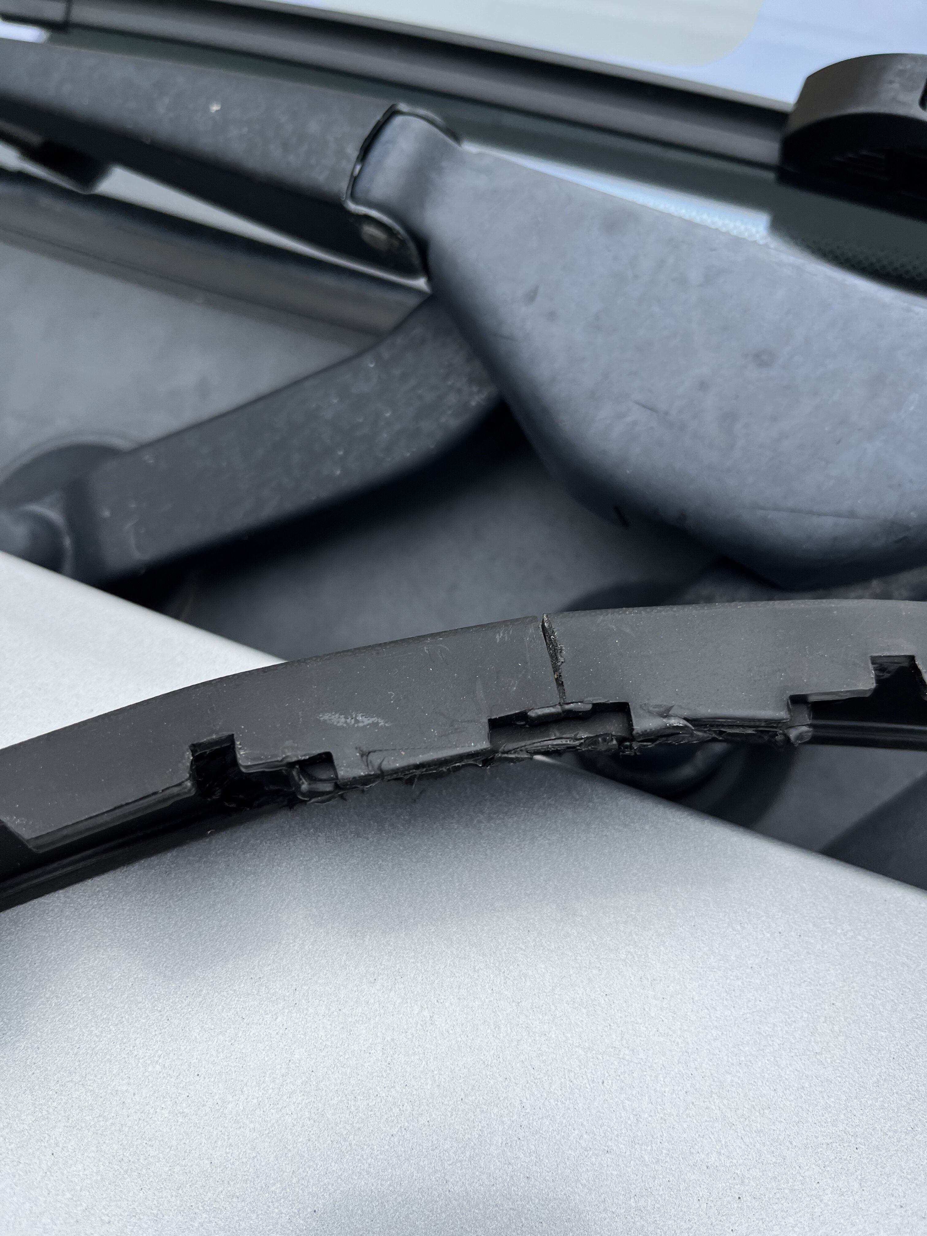

Does anyone know what plastic welding rods I need for the bumper?

Use a hot stainless stapler/plasric welding kit to repair your current bumper. The chinese spec ones on ebay are £15 ish and work excellent, i repaired my kangoo grill bracket recently with one and its solid.
Something like this. https://www.ebay.co.uk/itm/38468058...QrVQpEdQKi&var=&widget_ver=artemis&media=COPY
good advice taken! Thx.

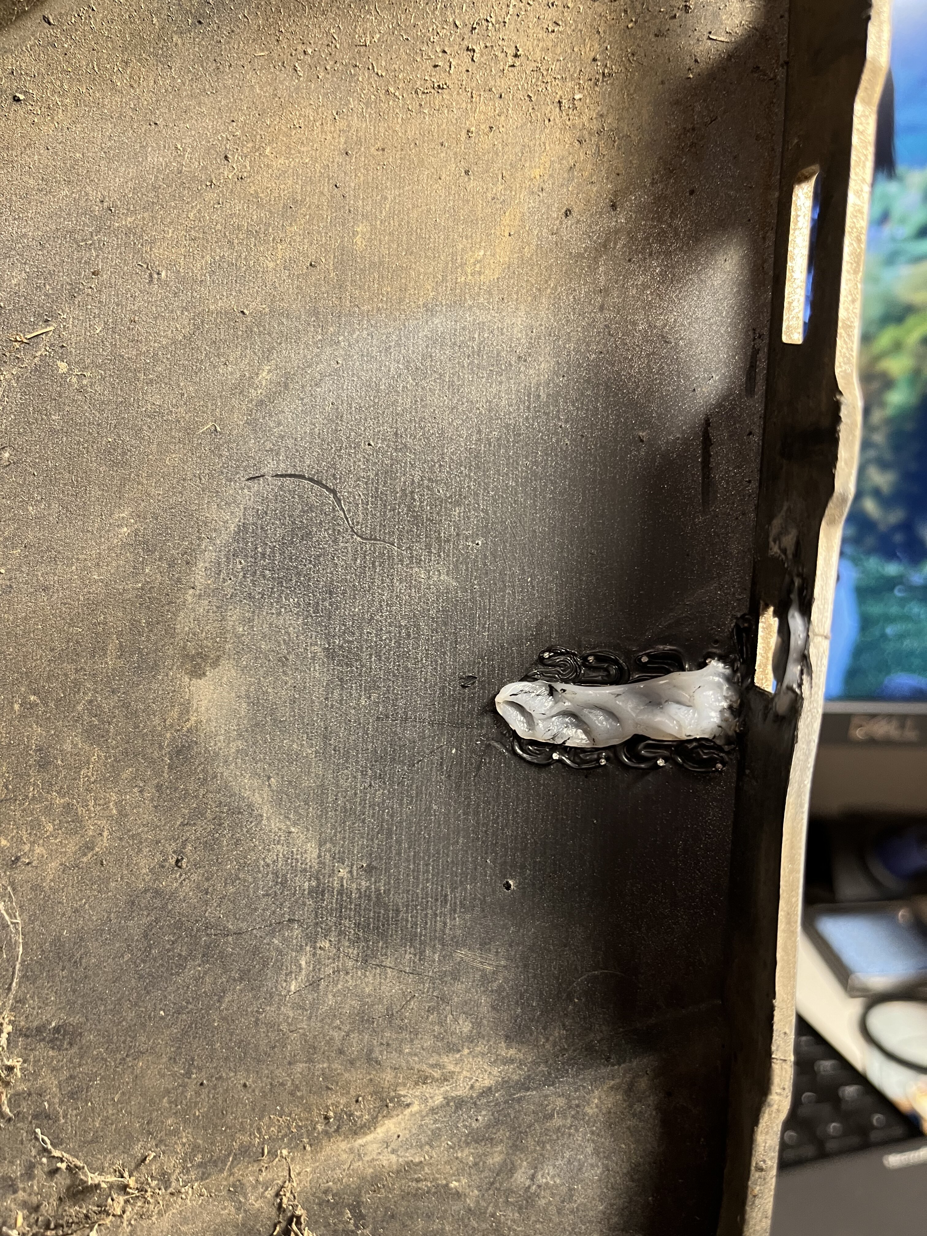

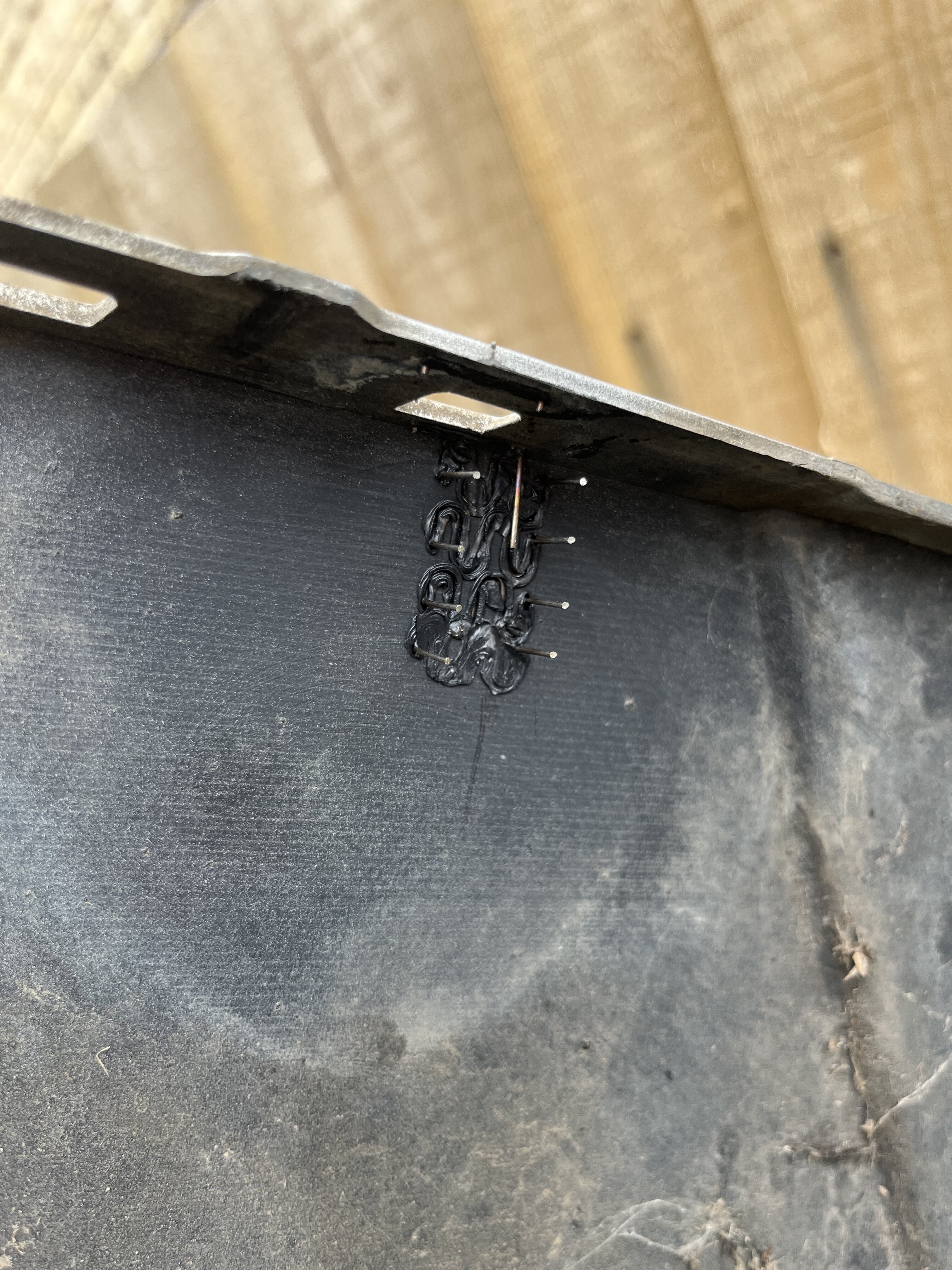

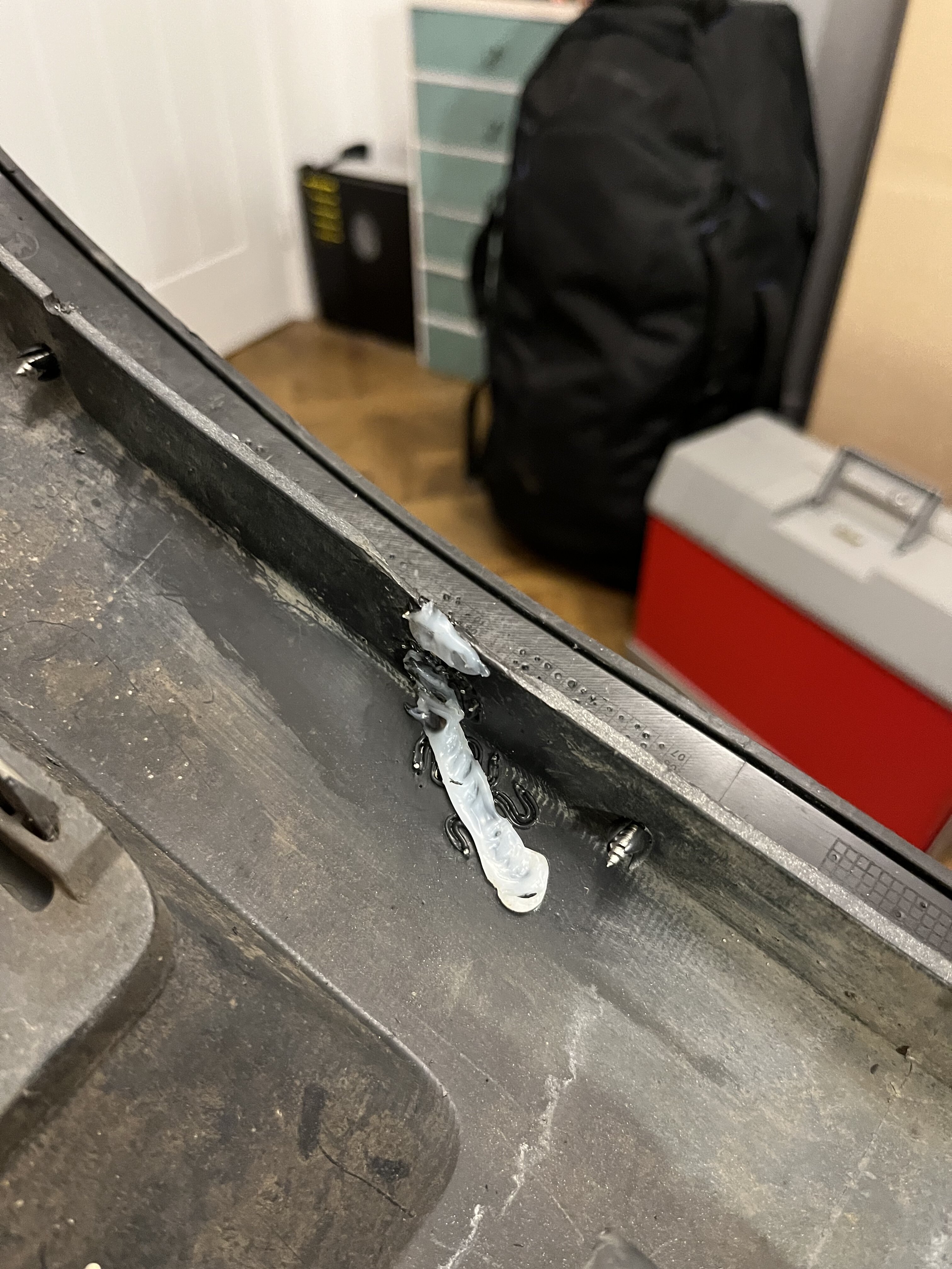

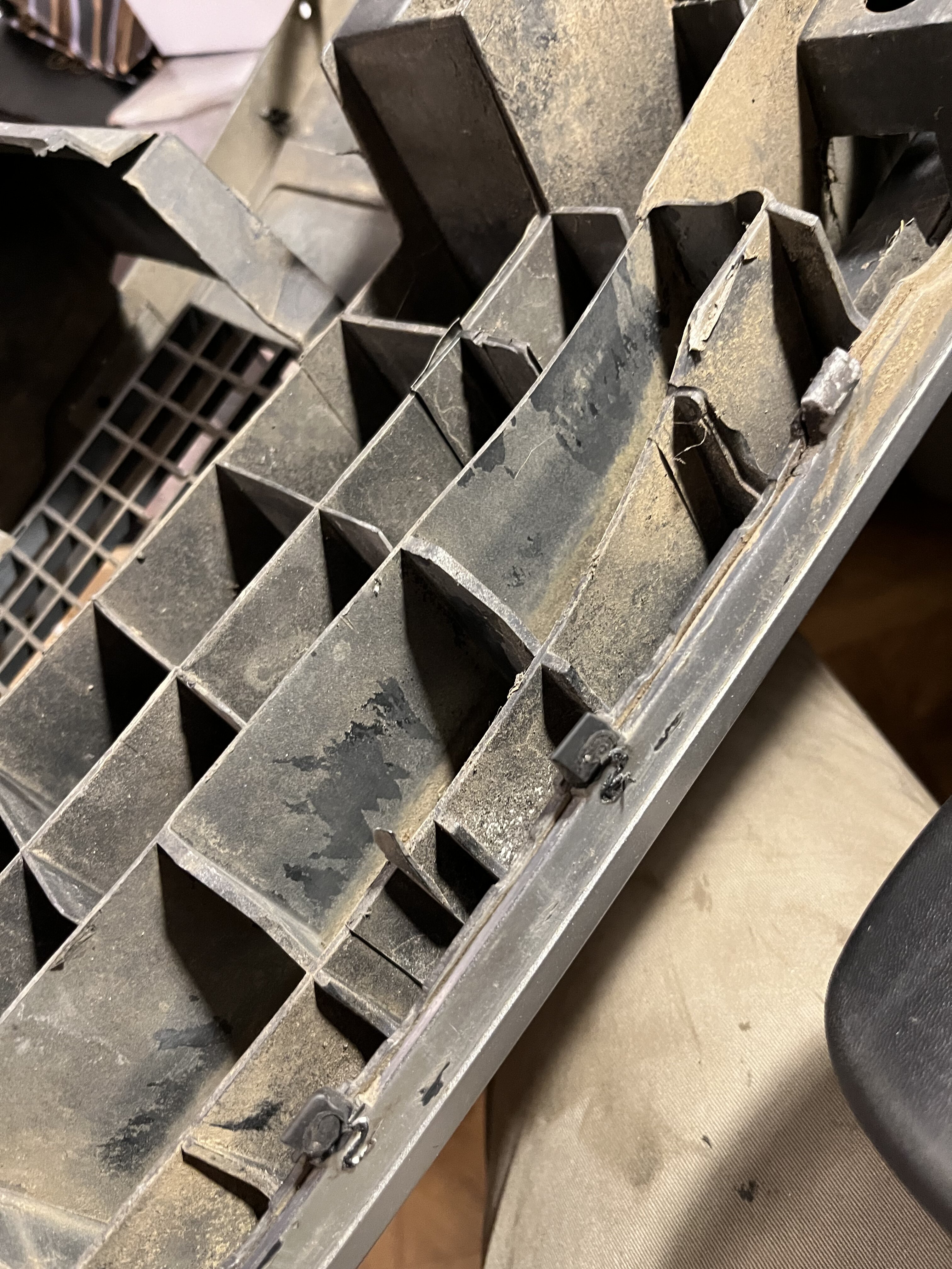

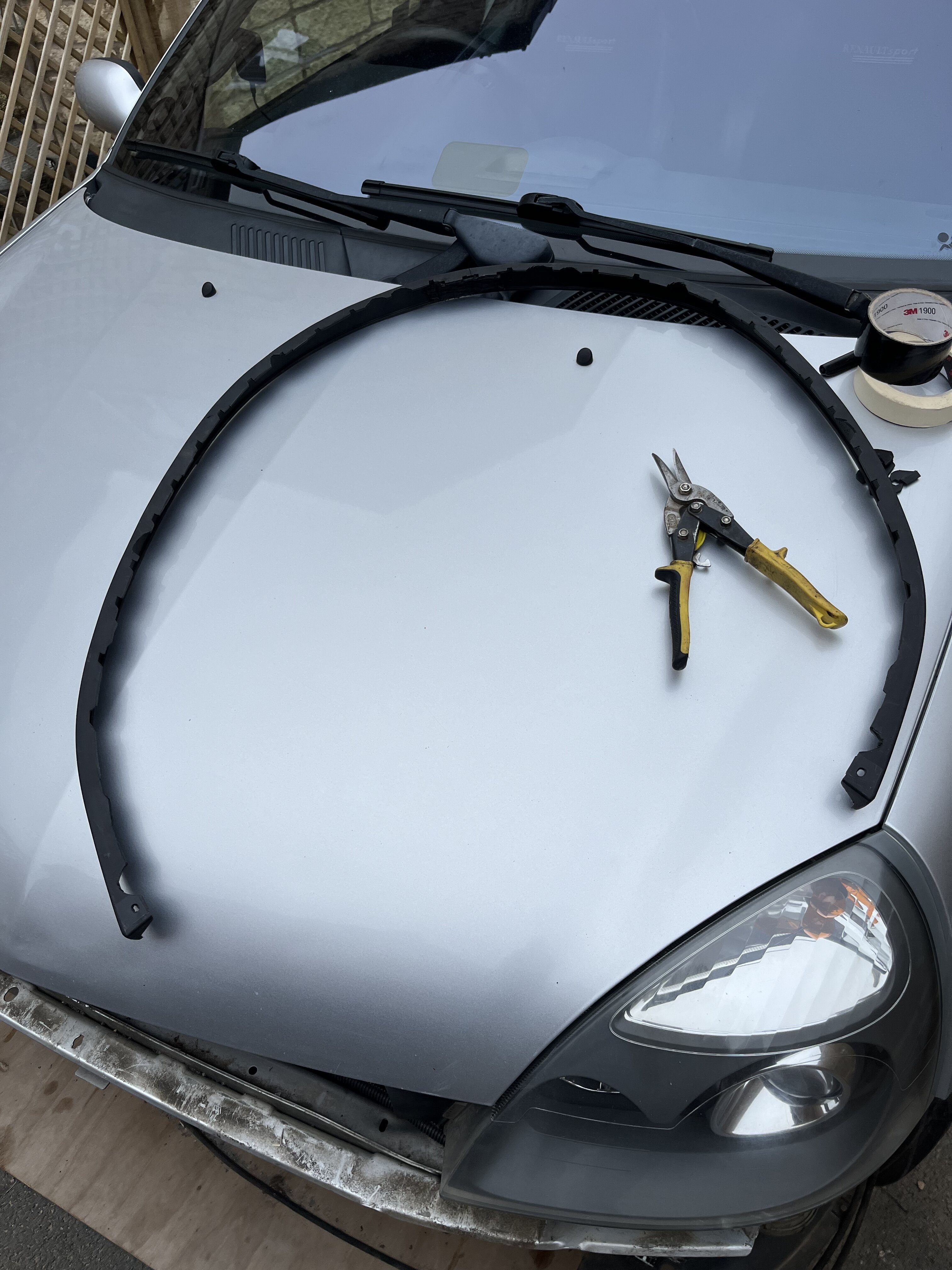

And on to plastic welding the bumper:
And then:
And with the Fabia splitter attached. The bumper needs painted but that is down the list of priorities for now:
Missing grille attachment clips bodged on by plastic welding the clips cut off the Fabia spoiler.
They seem pretty well attached so it should all be good!
Only headlights to polish and aircon condenser to sort and it can go back together.

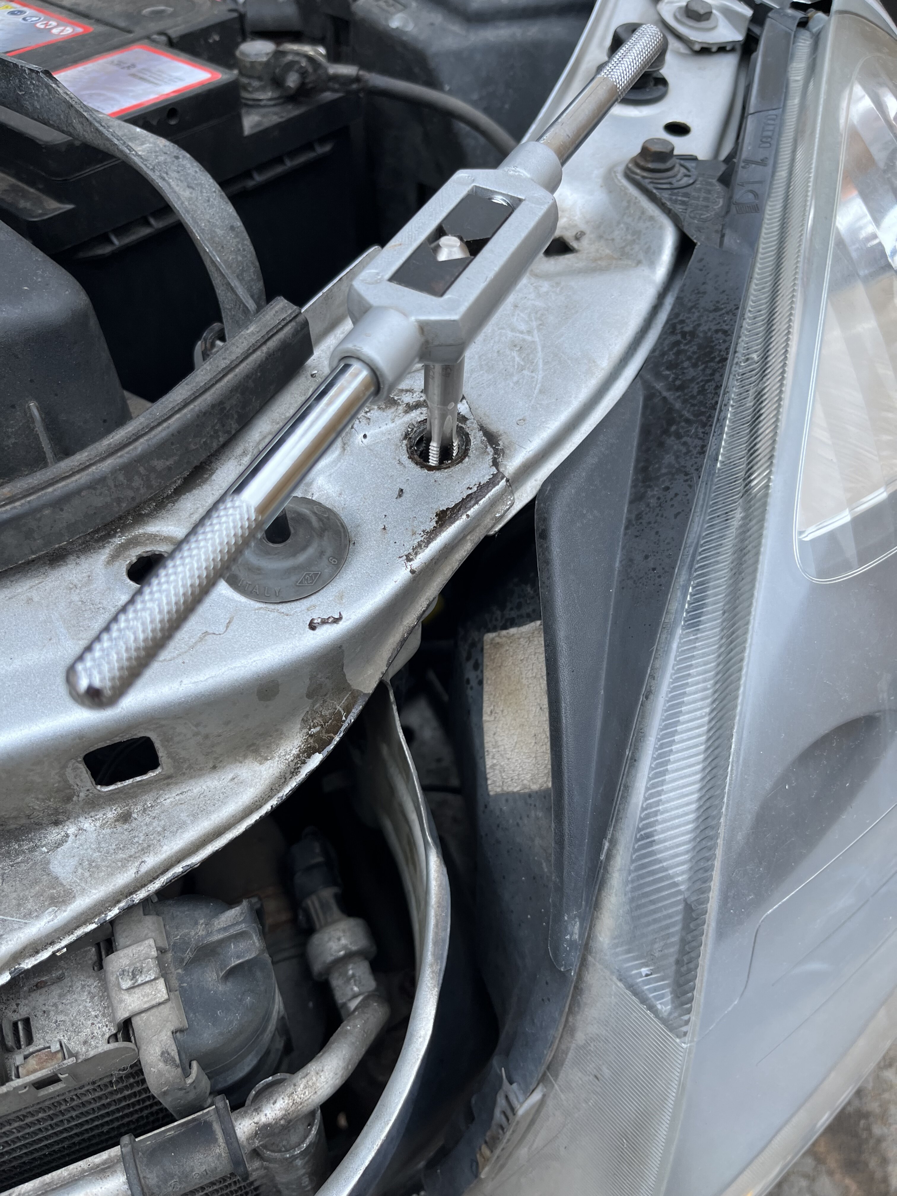

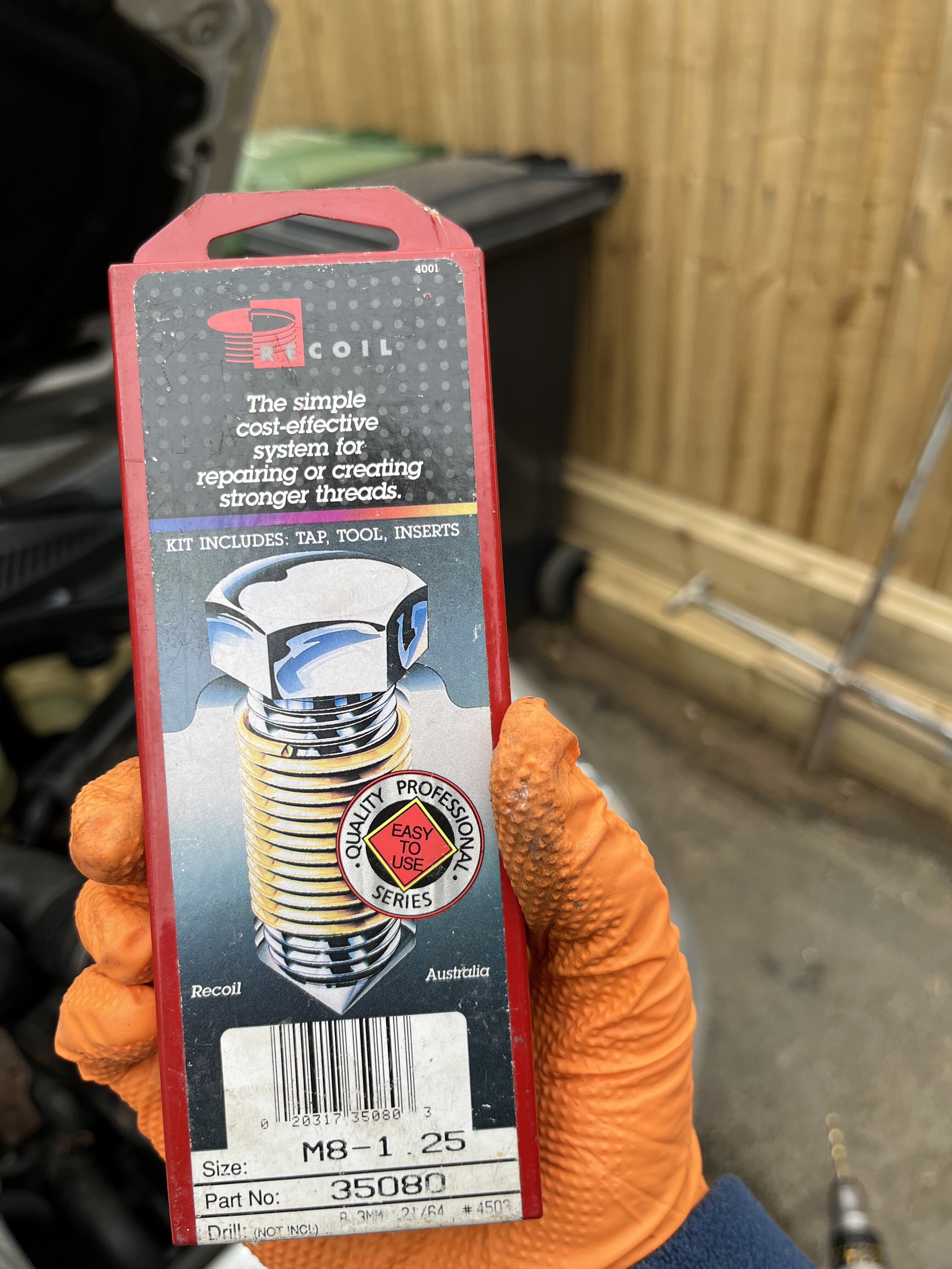

stripped slam panel nut drilled, tapped and helicoiled.
Bonnet catch was also cleaned up, centred and refitted. The bonnet actually opens properly now for the first time in my ownership of the car…

Headlights, centre caps, rear spoiler all lacquered up:
Everything drying off. Headlights look good at present. Let’s hope they stay that way this time.

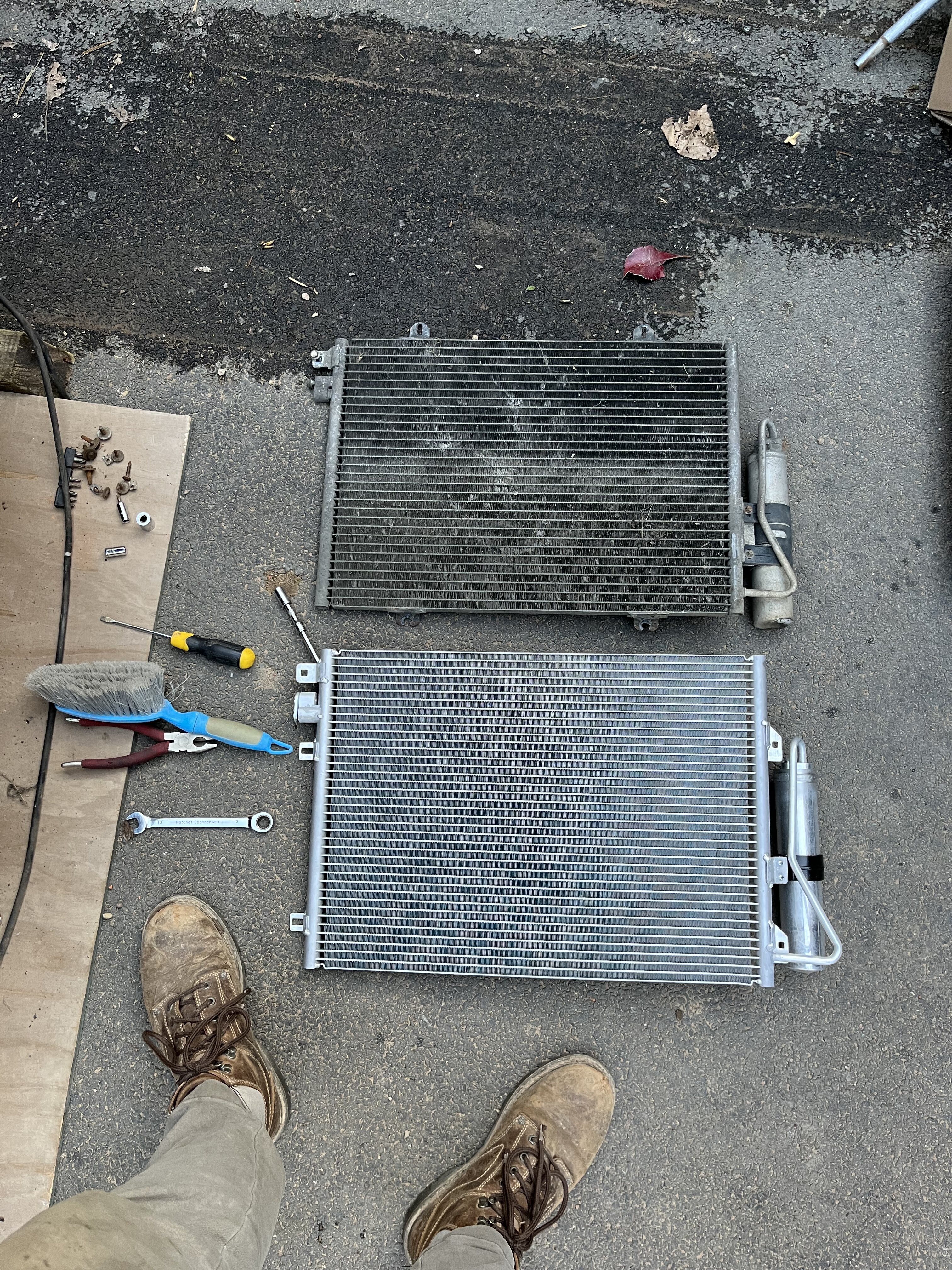

Hella aircon condenser arrived and fitted.
Not sure what I feel about the quality tho. The dryer is larger than the genuine one so only just fits and the ports are at the wrong angle (about 30deg out) for the pipes to fit on it. Also, it came with just cheap rubber plugs in the ports, not pressurised with nitrogen like I’d expect.
Whatever, the car needs to be back in one piece so I ‘persuaded’ the receiver to the right angle and fitted it all up.
Putting the bumper back on confirmed that the repro base model wheelarch liner that I thought would be a stopgap is useless. Ho hum, removed.
Grille and number plate back on. I have a car again.

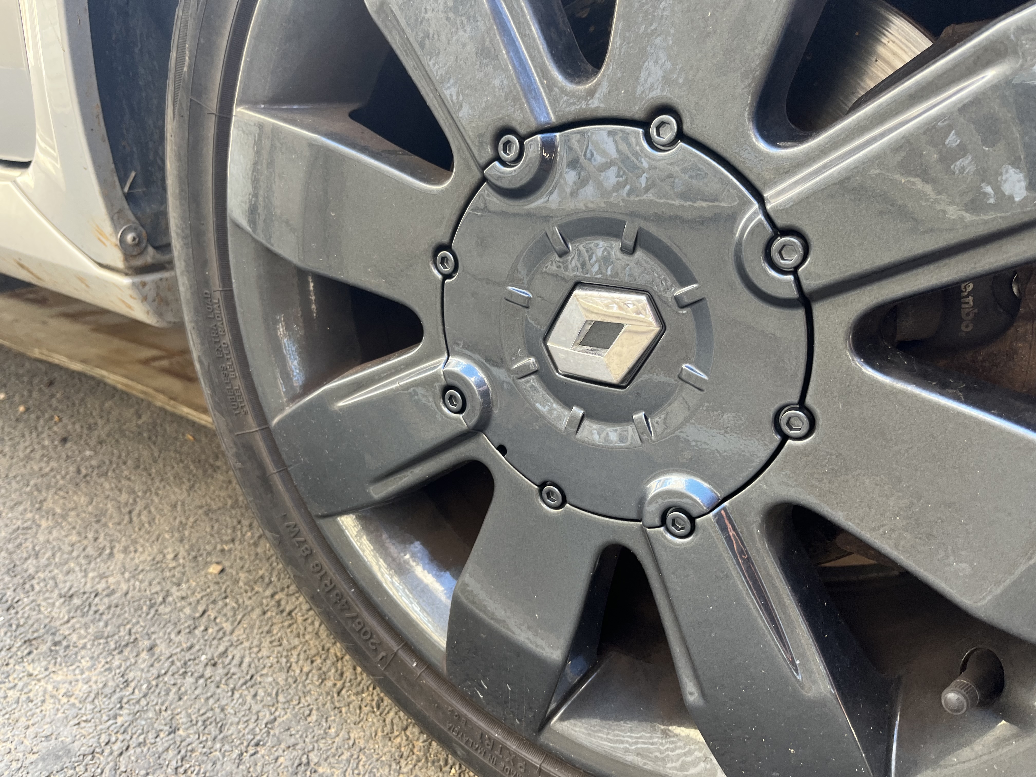

Renault symbols refitted to the centre caps and centre caps on. Not a bad paint match although the dirty wheels makes it look worse than it really is.
