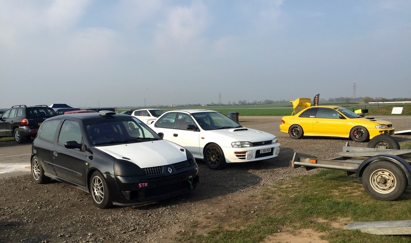

I went out in this one;
Totally stripped, fibreglass bonnet, no door cards, headliner, minimal dash etc and it felt mega.
Obviously that's extreme but I felt it made a big difference.
