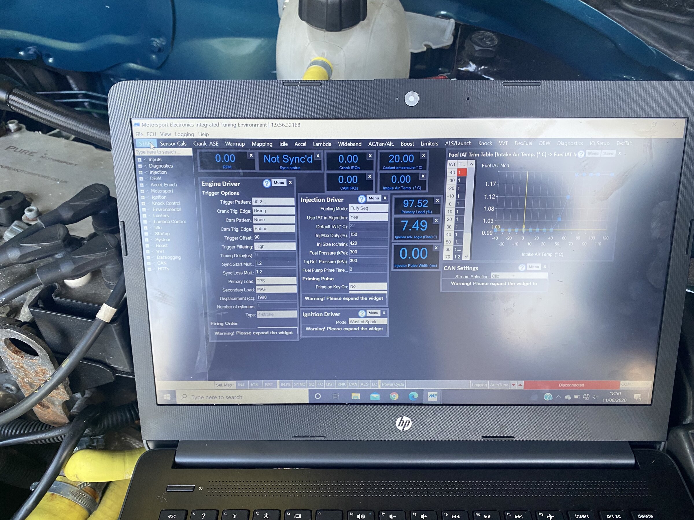

Done the mech install for my ITBs on my ph1 & trying to get it started on the PnP ME221 and I'm hitting a brick wall
As the car is a ph1 then I have done all the pin swaps necessary

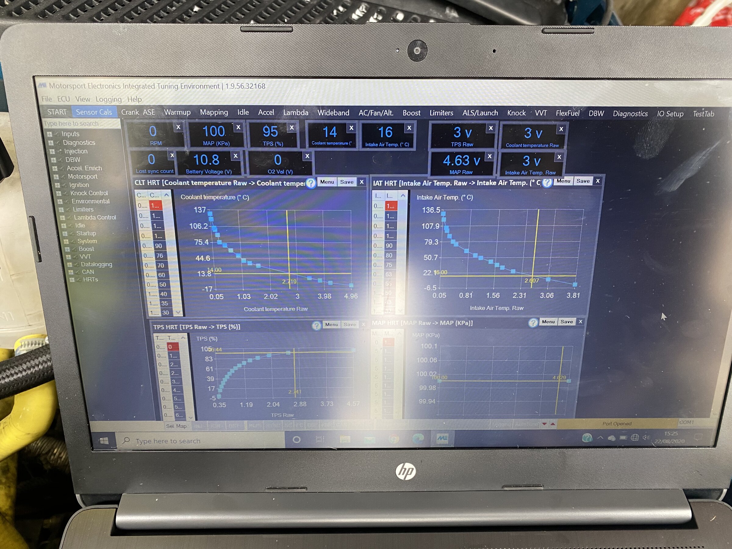

The fuel pump is priming but the TPS signal doesn't change with pressing the throttle & the IAT is reading 0
I'd like to be able to sort these so I can drive it for final mapping
Any suggestions?

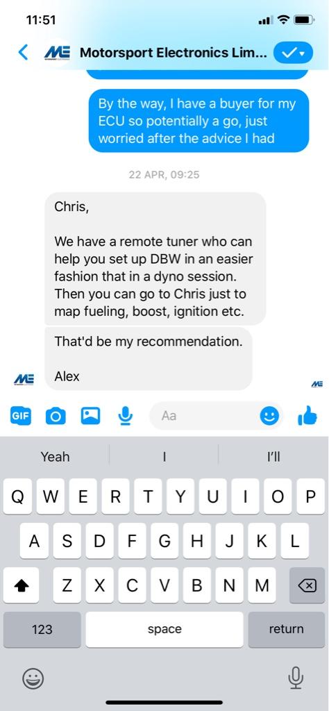

Hi mate, I’m sure you have but Alex was very helpful when I was looking into the ECU for mine on FB messenger
Do they not have a debugging screen to help with this? Do you have any noise on either TPS or IAT when logging? Is coolant reading anything? Also screw using DBW with this.
ME couldn’t help at all, they said they’d need to collect the car to diagnose the issue
No noise that I’ve noticed
Coolant is reading a sane figure
Car is a Ph1 so mechanical throttle not DBW
Ahh, fair enough. Can't help much either without some testing. You need to buy a multimeter (even a cheap amazon one) and do some simple tests. I am betting a pin or two are in the wrong place or an earth is missing.
Normally the TPS, CLT and IAT will have a separate signal GND back to ecu (separate from the power gnd) good chance this isn't there if all three aren't working. Don't count on the CLT working without heating it up to check. Normally they have a bias network which places the reading at a bit less than running temp so when the connector is disconnected or sensor is open cct the engine will still run after a fashion (which is why a 0deg on IAT is a surprise).
Also make sure IAT cal is not at fault (by heating the IAT and looking at readings). If the temp changes then its the cal which needs sorting.
Some ECU firmware does not give any readings when the TPS is wired backwards. Check this by holding full throttle and zeroing TPS cal then release throttle to see if reading changes.
If none of that works then its likely a wiring issue or ECU issue.
Good luck.

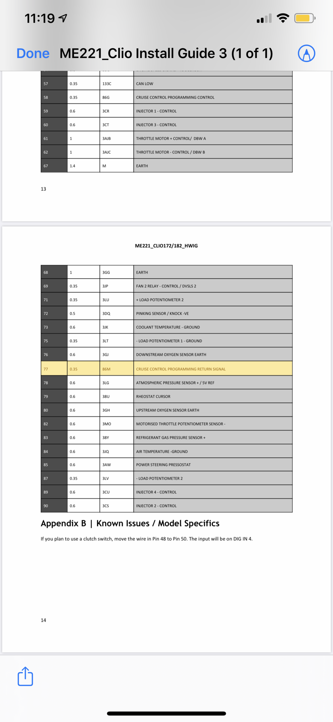

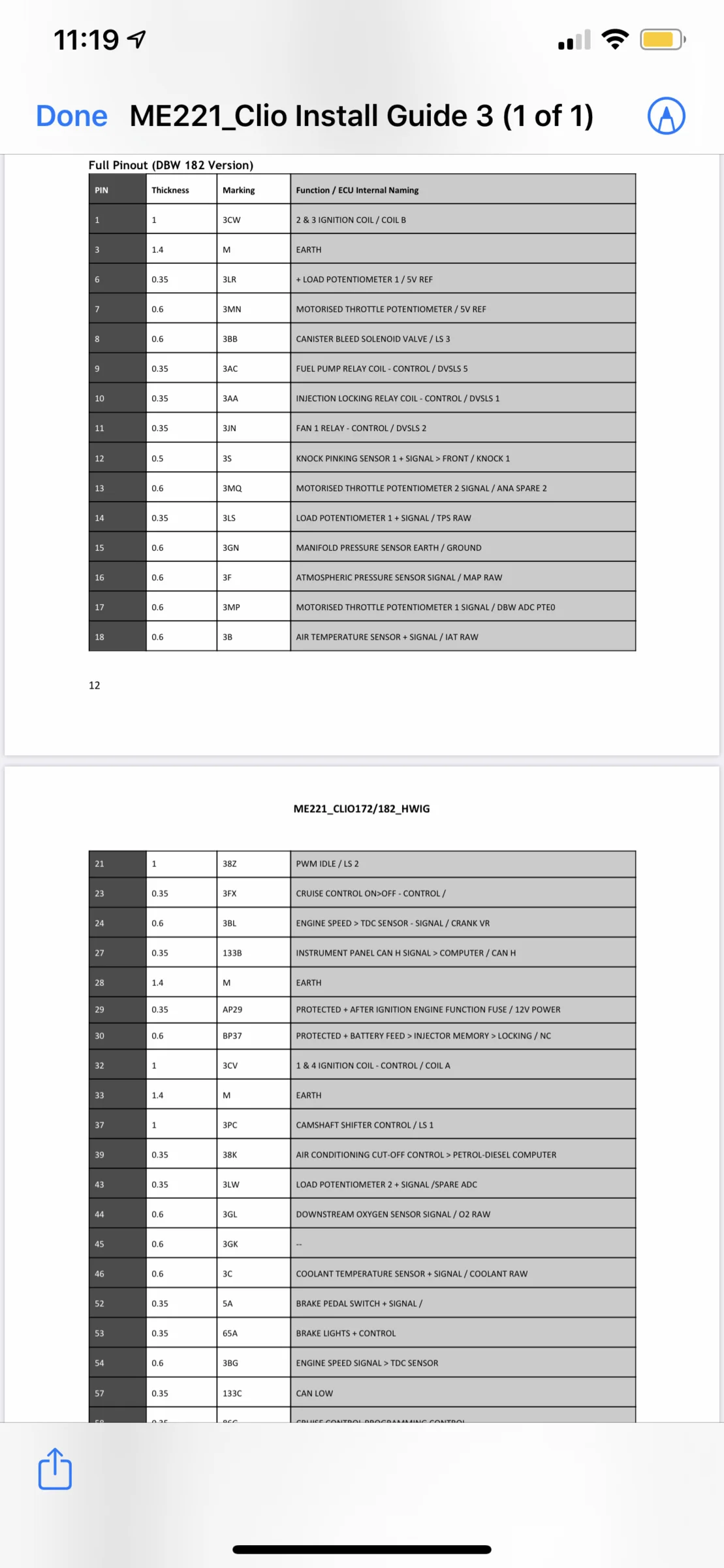

Give me your WhatsApp and I’ll send you a wiring diagram and ECU pin outs if it helps?
Scratch that, I only have the 182 diagram.. but I do have the Gen90 pin out chart if you wanted to cross reference any pins?

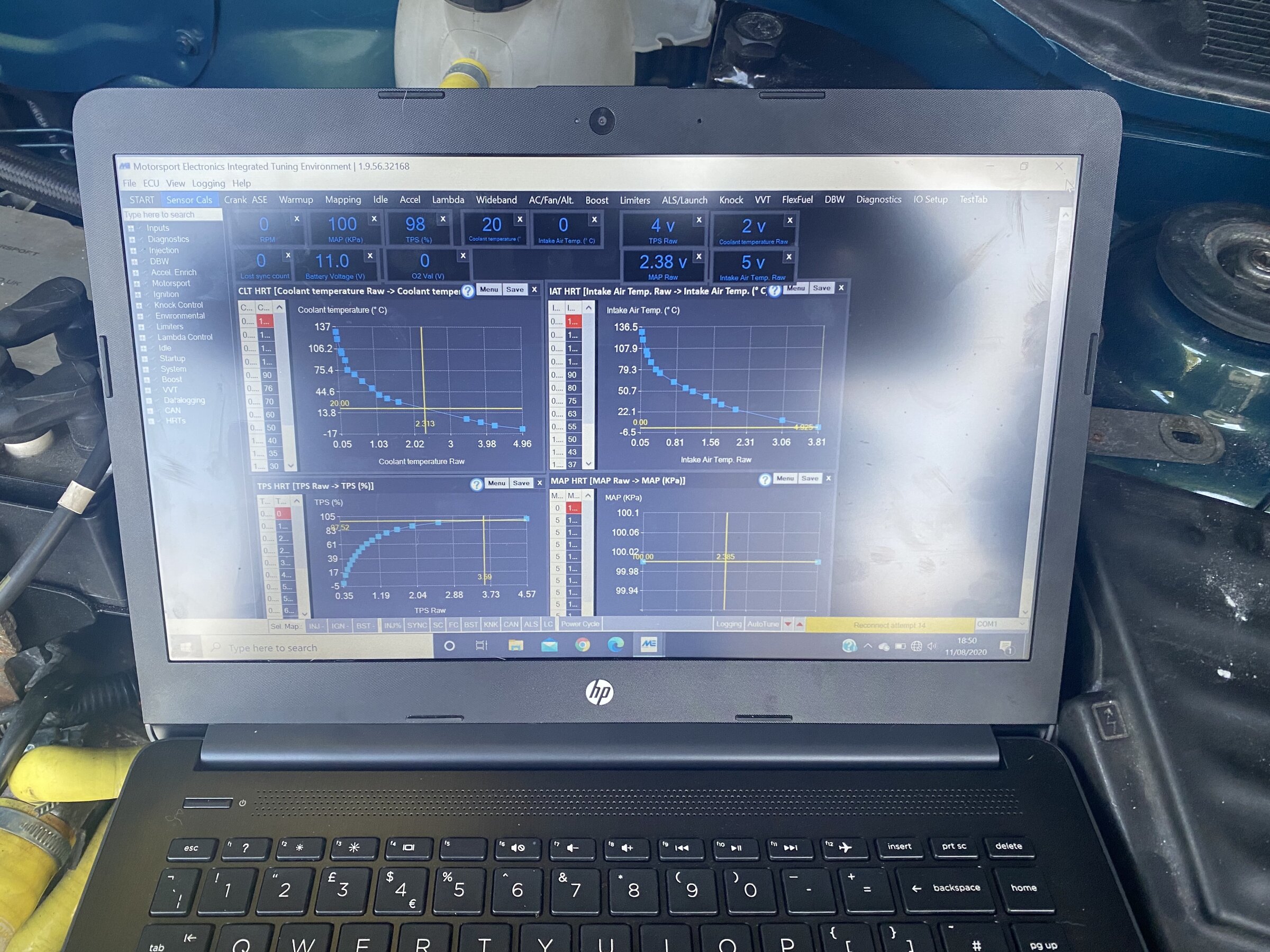

so I’ve swapped a few pins and put a different TPS in and we’re getting a sane IAT reading. But the TPS is going between 95 (off) to 97 (on). Which is a step in the right direction but it’s not right - any ideas?
