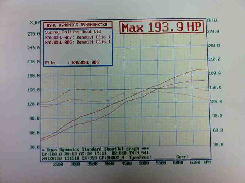

Adds 15 or more BHP, and improves the spread of torque across the rev range. Pricey, but then anything to get power out of the engine is.

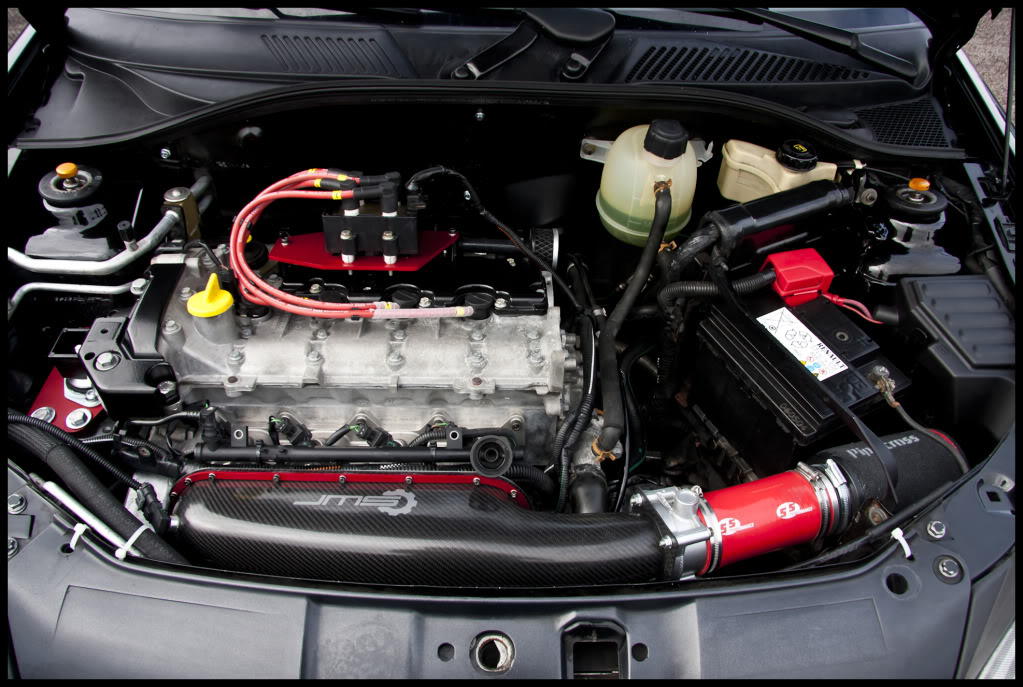

Maybe. He posted on Pistonheads (where I got the picture from) and he wrote 'you can get a RS2 for 18bhp dyno proven gains'
I've never had an RS2. Well actually i did, but i never fitted it, so sold it to Nick172Cup (as it was his old RS2+ setup).
Re: PH, that was posted on the 5th July 2010, so was probably from one of Tom's posts on the subject.
