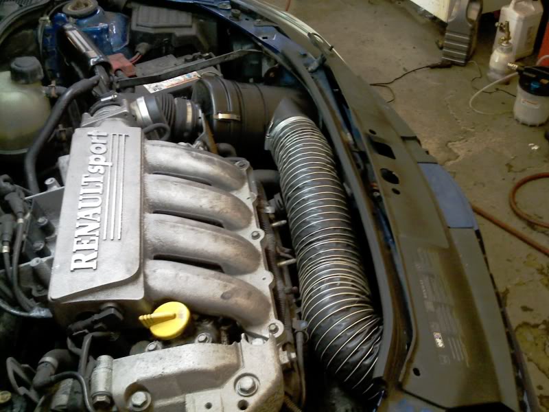

Here's a few pics of mine in the thread above.
My 5K kick is still there in all gears so not sure why the two are different. Like I said earlier I did think it pulled better at lower revs though
Now has a black Samco induction bend, K&N replacement filter and the air feed into the airbox is the standard V6 Espace pipe cut down then into a flexi-pipe

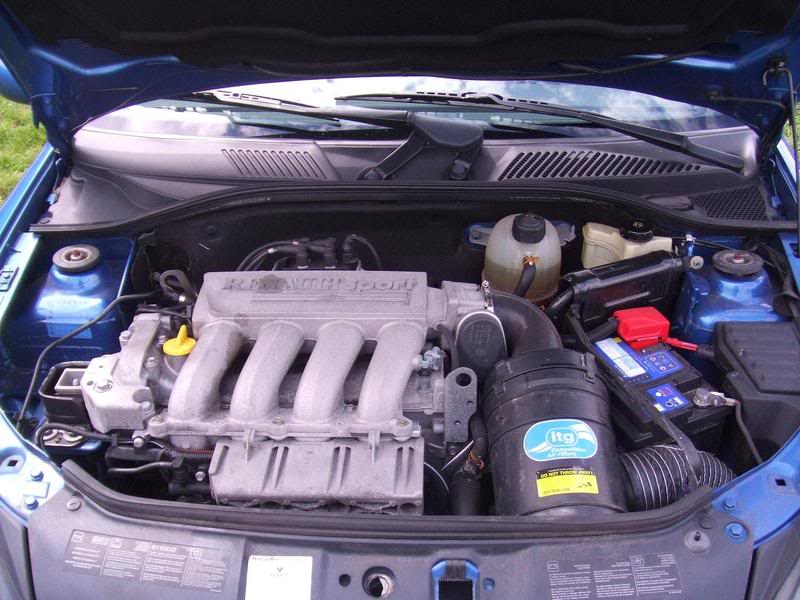

I have one fitted to mine with a ITG filter, it's deffo the best IK i have had on the car by miles!
It also sounds very good too.

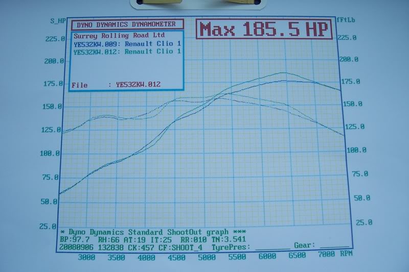

Here's mine. Can't say I've noticed much difference from it, but this combined with taking the power steering off saw my curve go from 176 bhp at peak up to 186 bhp (shows a small loss below 4k now but goes like a banshee above 5k)...most of which was probably down to the steering pump...
Before and after for comparison...
