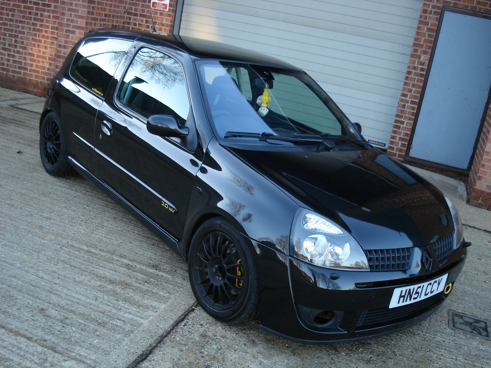

I've previously had two 172's which I like to think were finished to a good standard before parting with, won't bore the thread with specs but they were fairly respectable, the second one actually had more done to it!

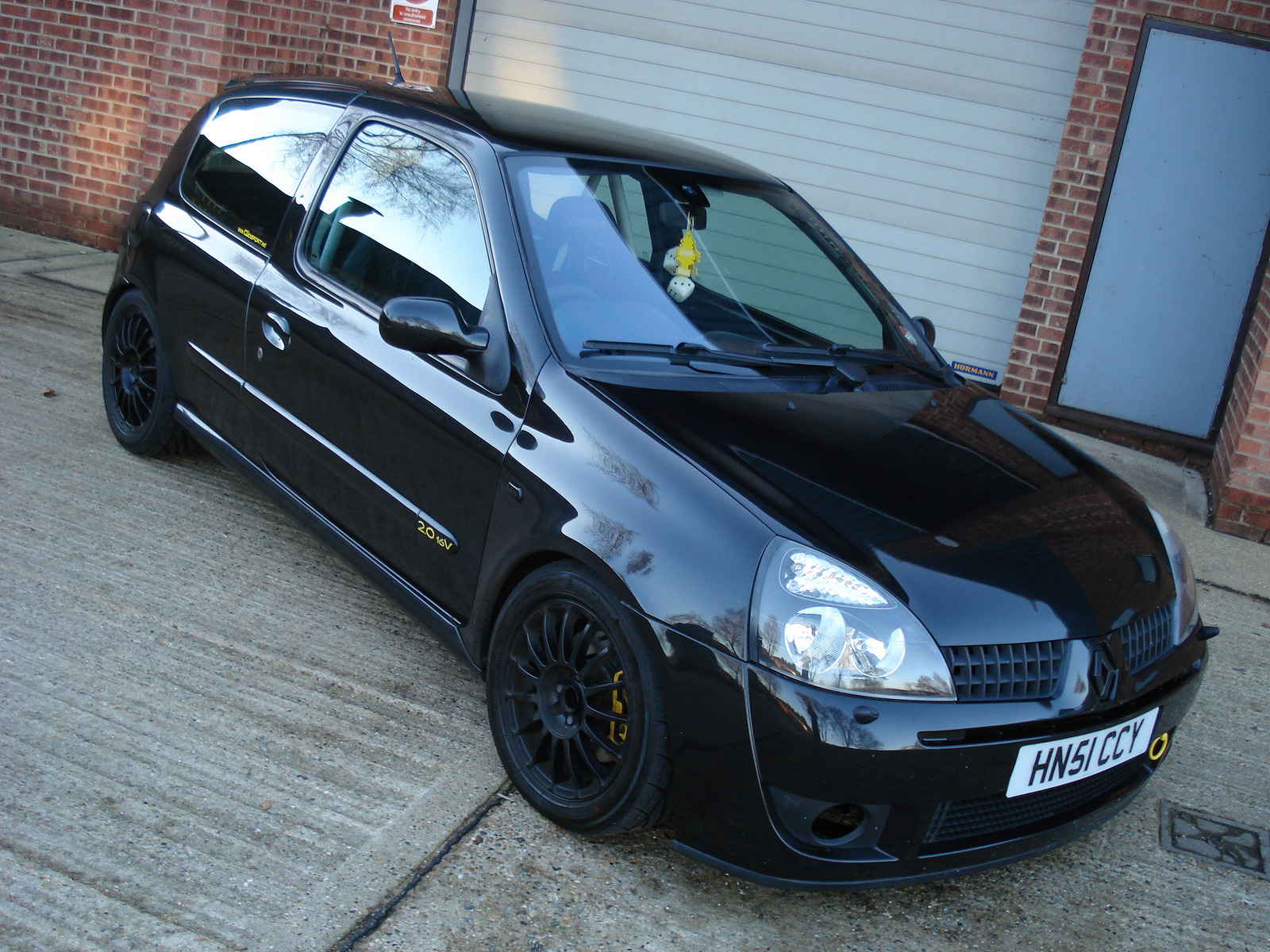

First black 172:
DSC002011 by danfullstop, on Flickr
DSC00301 by danfullstop, on Flickr
DSC00314 by danfullstop, on Flickr

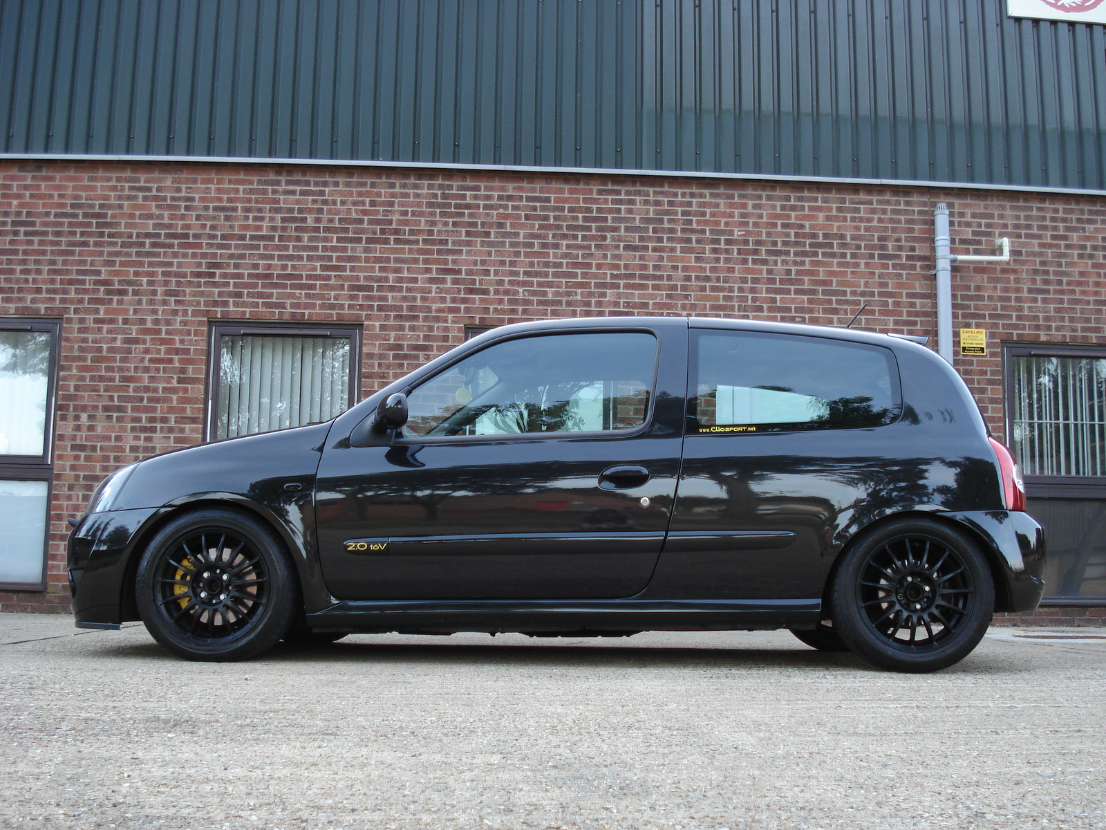

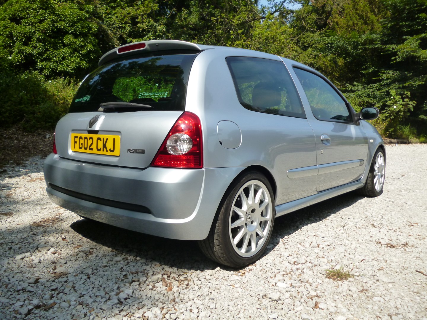

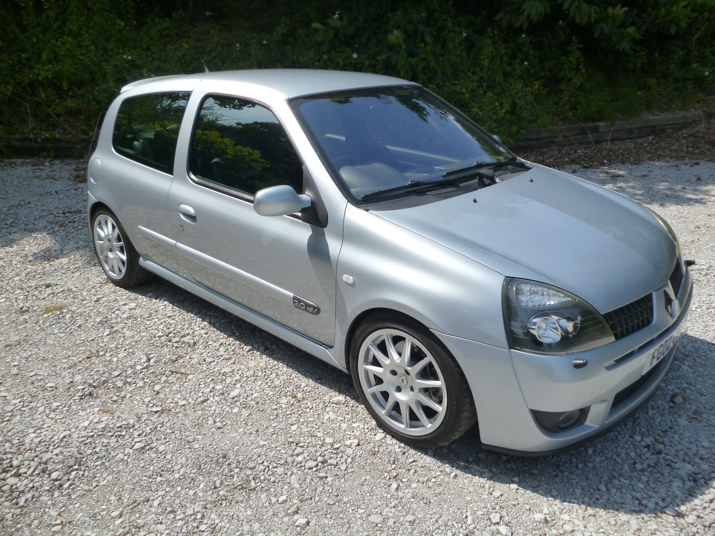

Second Silver 172:
P1010372 (Large) by danfullstop, on Flickr
P1010361 (Large) by danfullstop, on Flickr

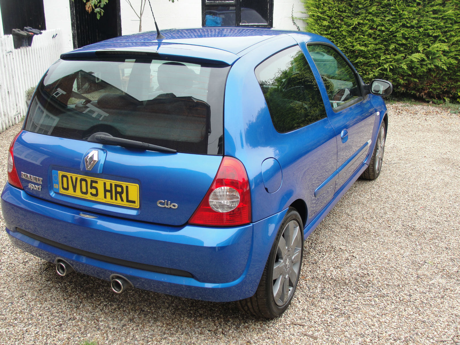

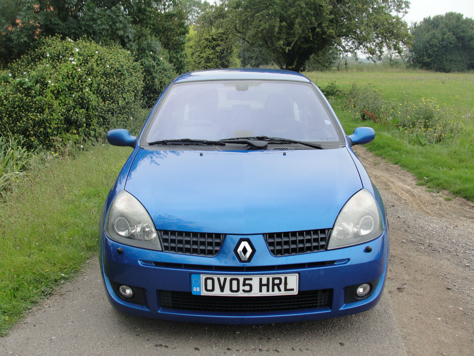

182 advert photos:
$_57 (10) by danfullstop, on Flickr
$_57 (9) by danfullstop, on Flickr
$_57 (4) by danfullstop, on Flickr
$_57 (1) by danfullstop, on Flickr

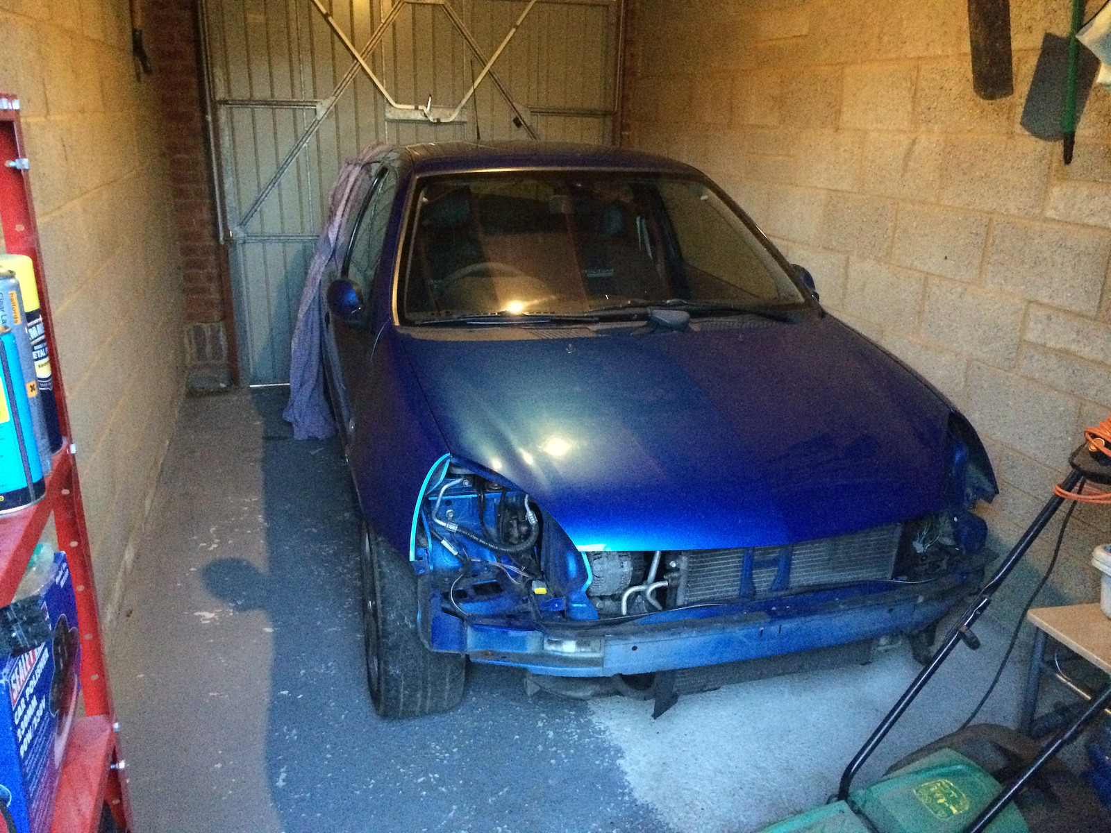

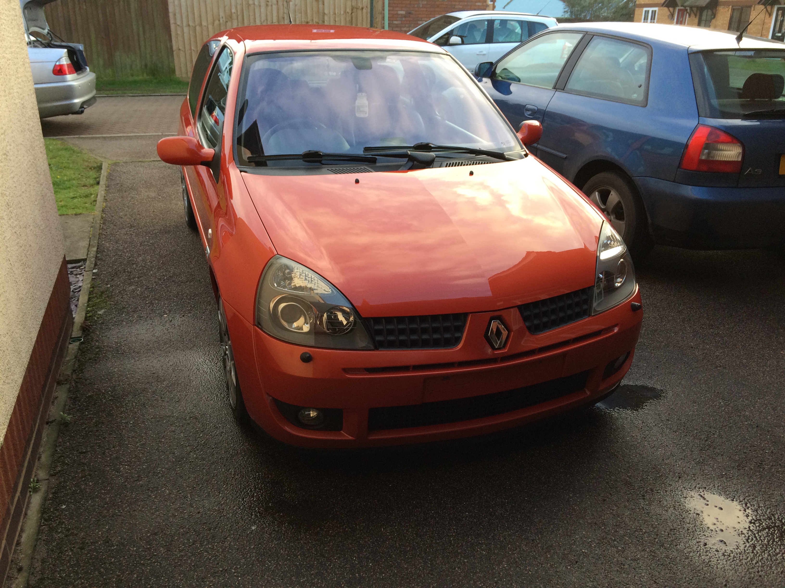

How it currently looks:
IMG_1126 by danfullstop, on Flickr
IMG_1121 by danfullstop, on Flickr

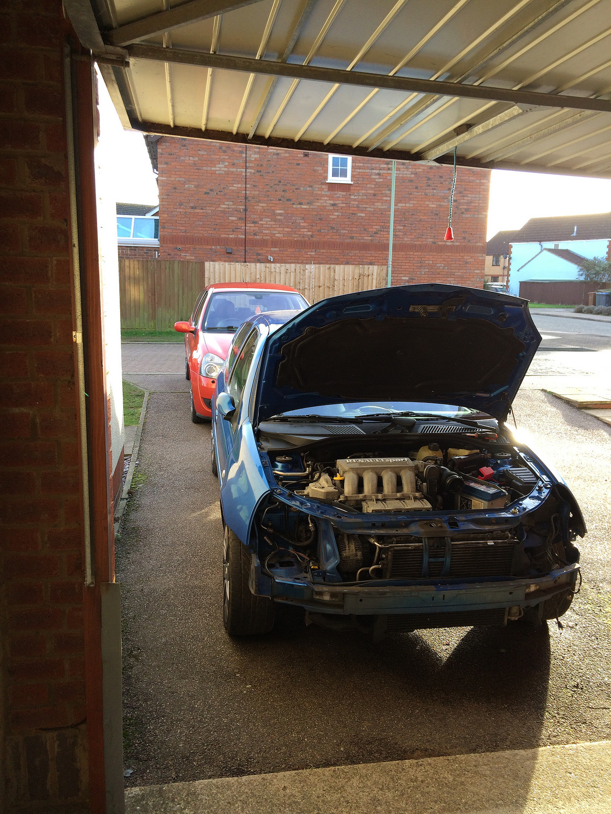

Today I have:
Removed the bumper and fitted the now 'standard' cs skoda splitter
Removed fog lights (one to replace the Fiancée's broken one!)
Removed the Airbox & Ancillaries
Removed the Headlights
Removed the Carbon Canister
Fitted Fake eBay Silvervisions (ofc)
Found out it needs an inner tie rod (currently knocks when moving the wheel)
Found out it has hardly any PAS fluid!
Had delivery of some coilovers that might not fit it (due to me not checking the hub spacing....)
and made some room in the garage for it :)

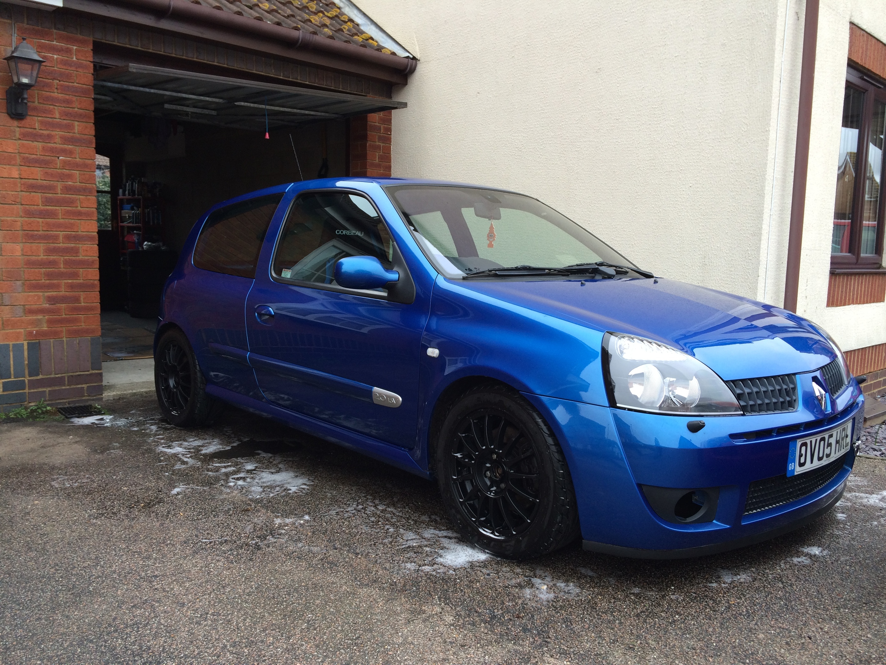

Done a few small bits today:

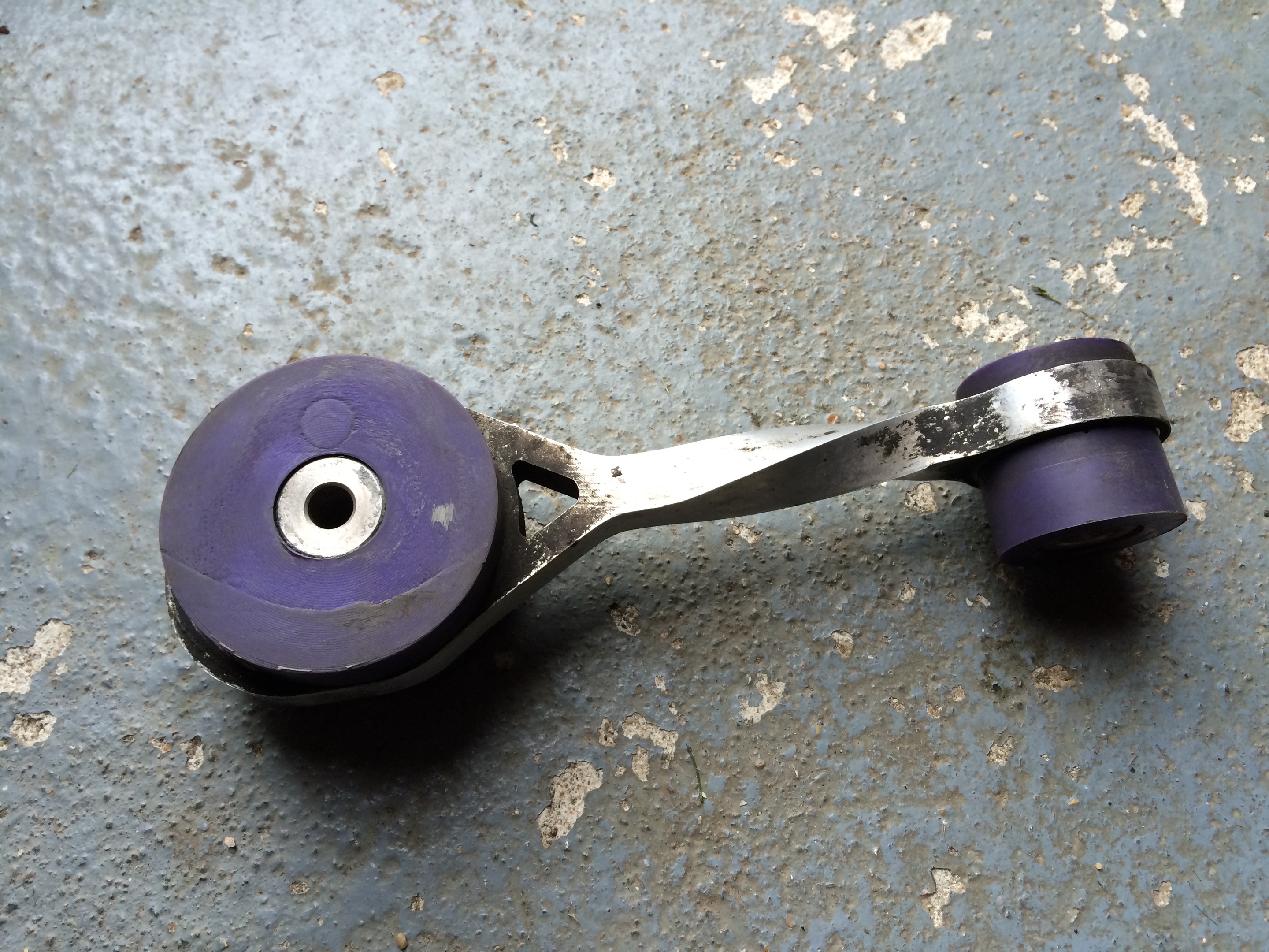

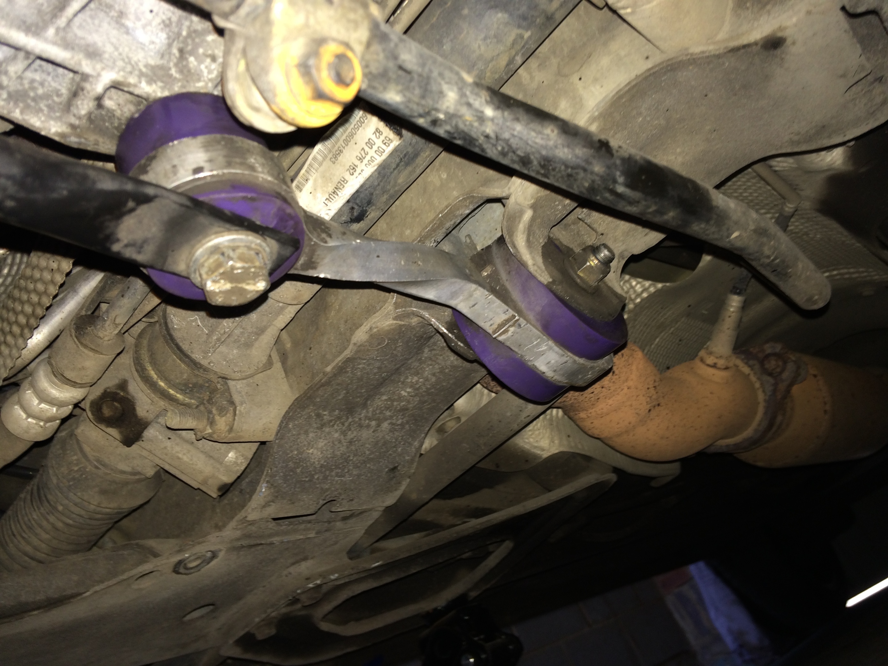

Dogbone off eBay:
IMG_1156 by danfullstop, on Flickr
Fitted:
IMG_1162 by danfullstop, on Flickr

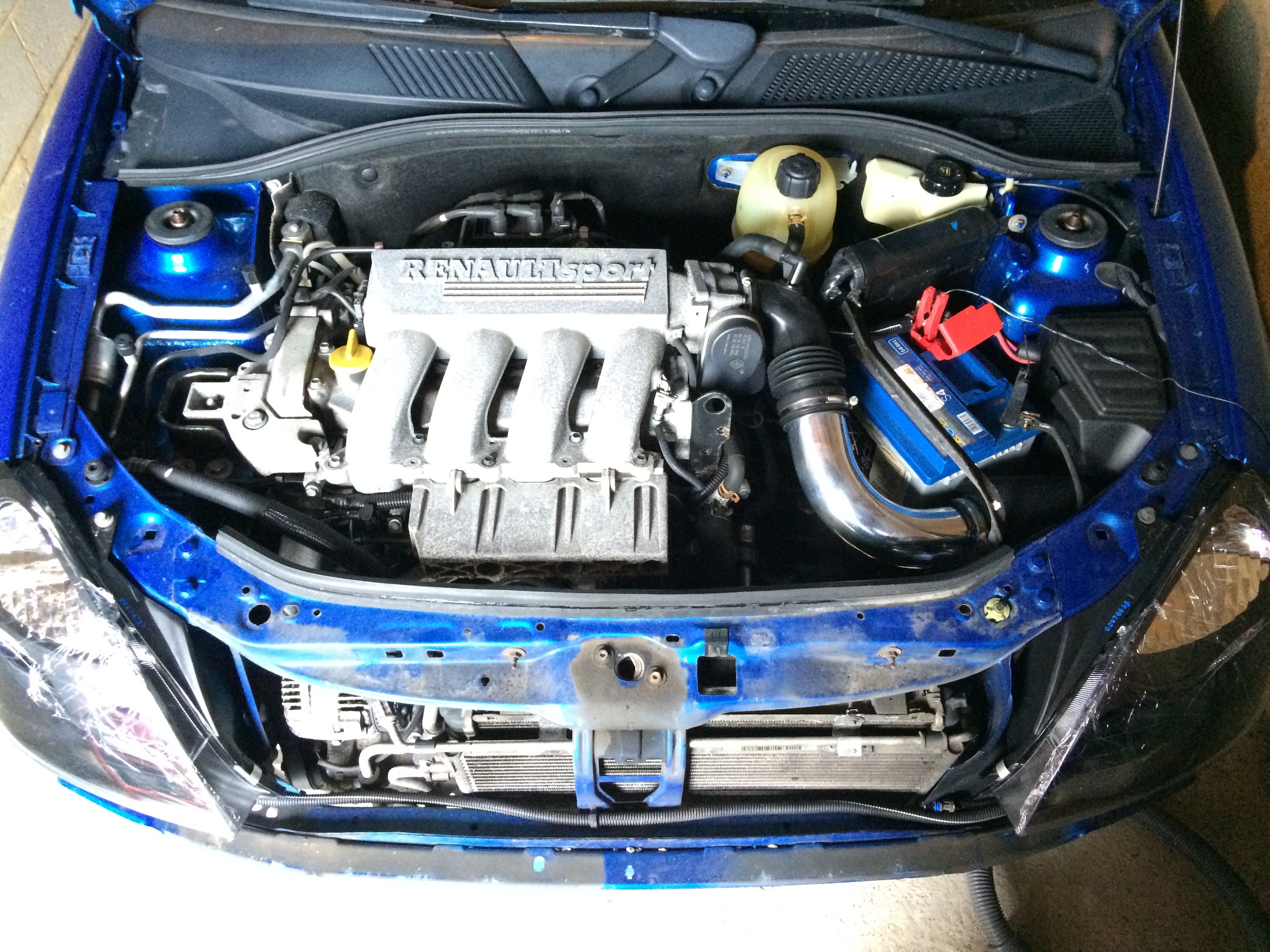

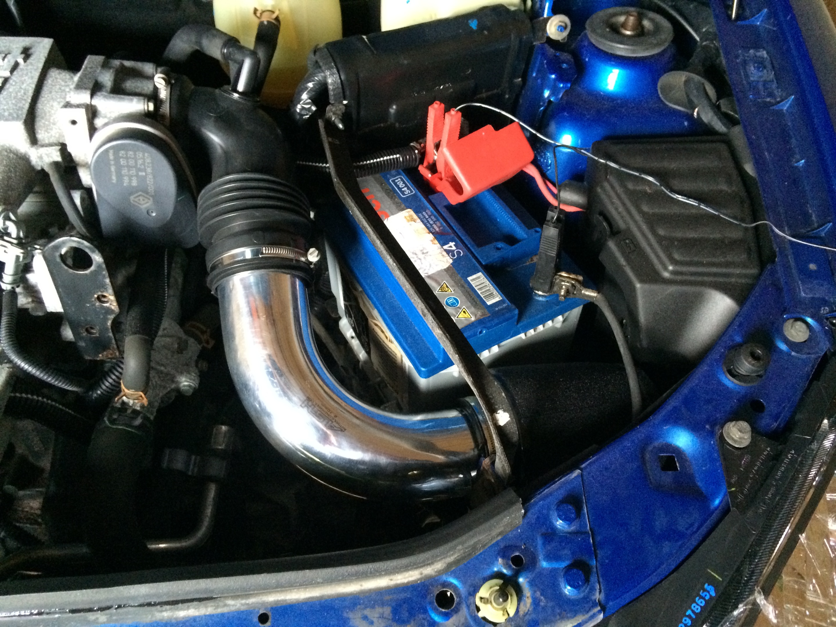

Temporary Pikey Induction Setup fitted, all for the grand sum of £35:
IMG_1154 by danfullstop, on Flickr
IMG_1155 by danfullstop, on Flickr
Picked up these Team Dynamics Monza R 15's from @Snails ready to be sprayed up when the weather gets better:
IMG_1167 by danfullstop, on Flickr

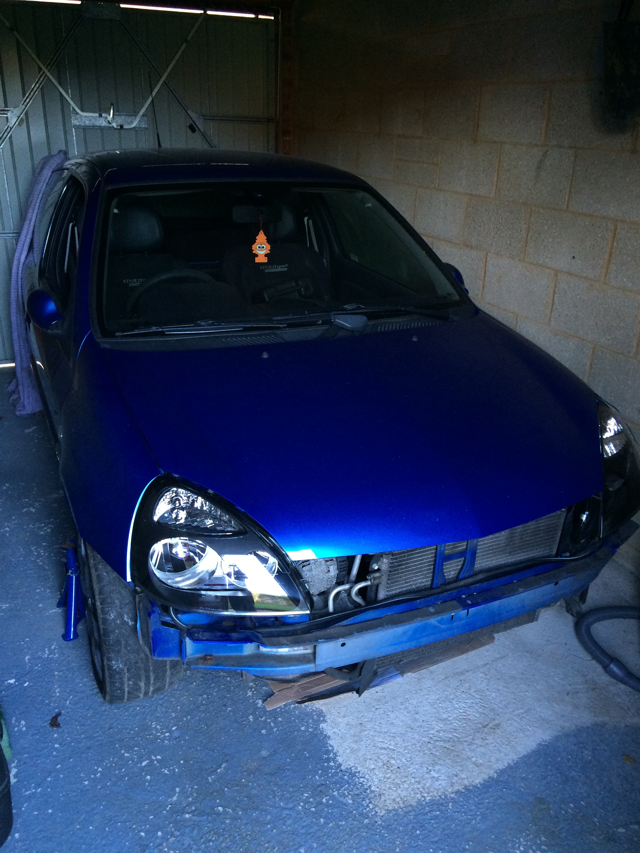

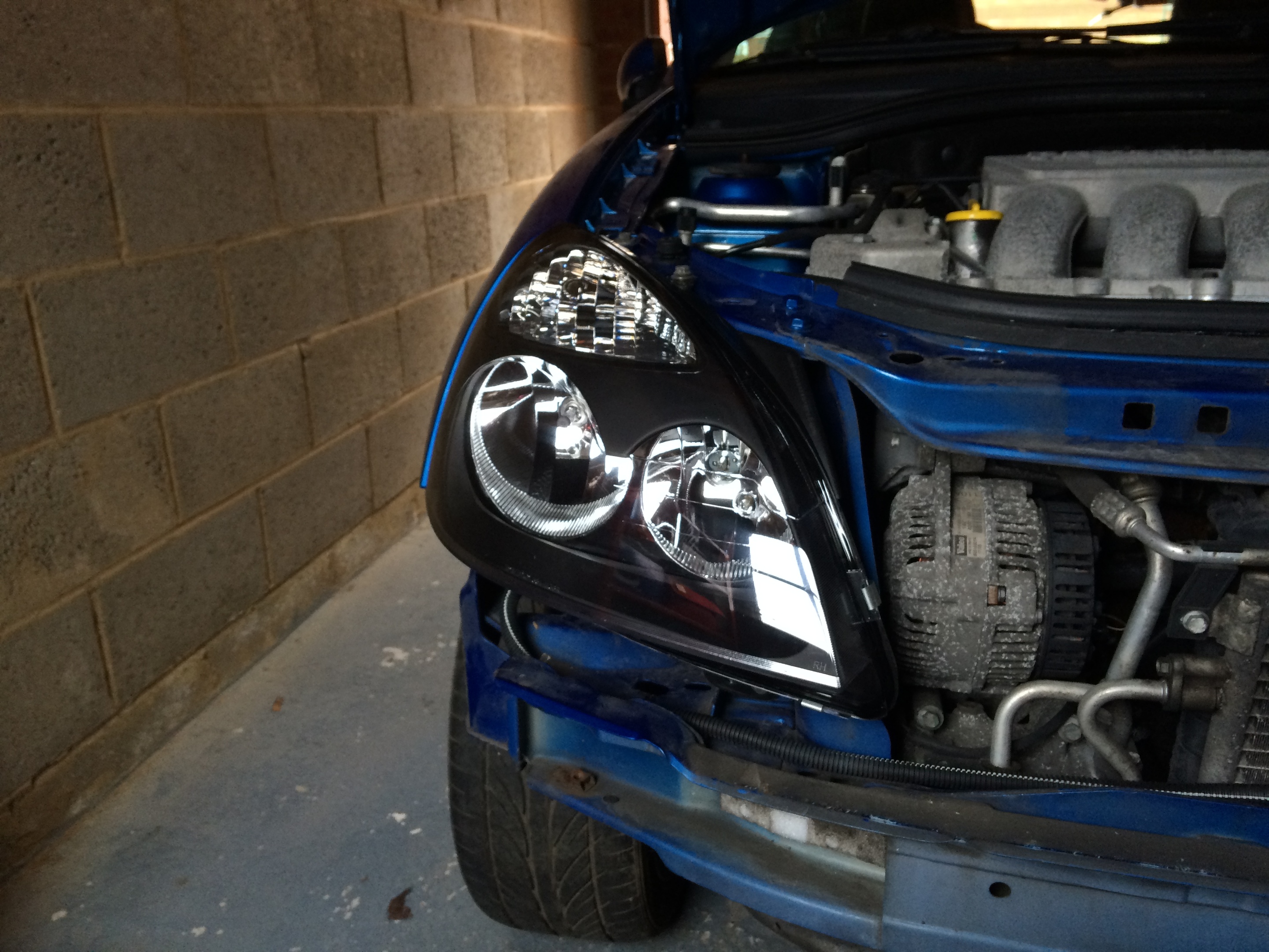

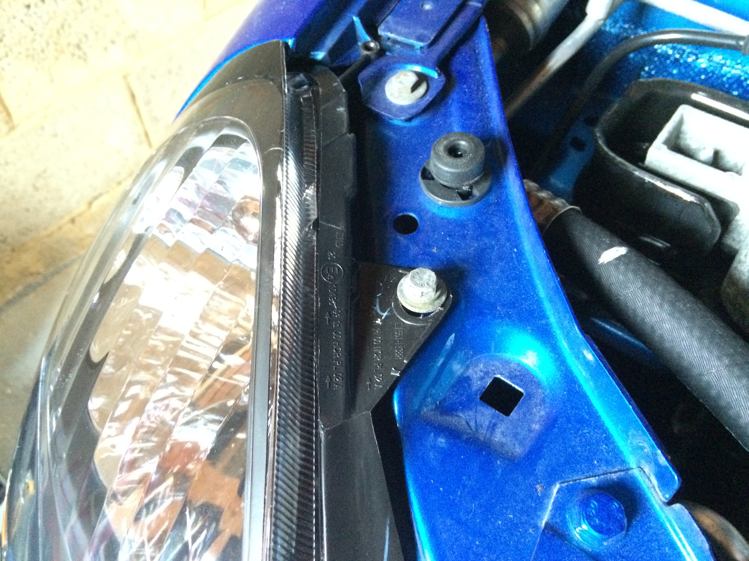

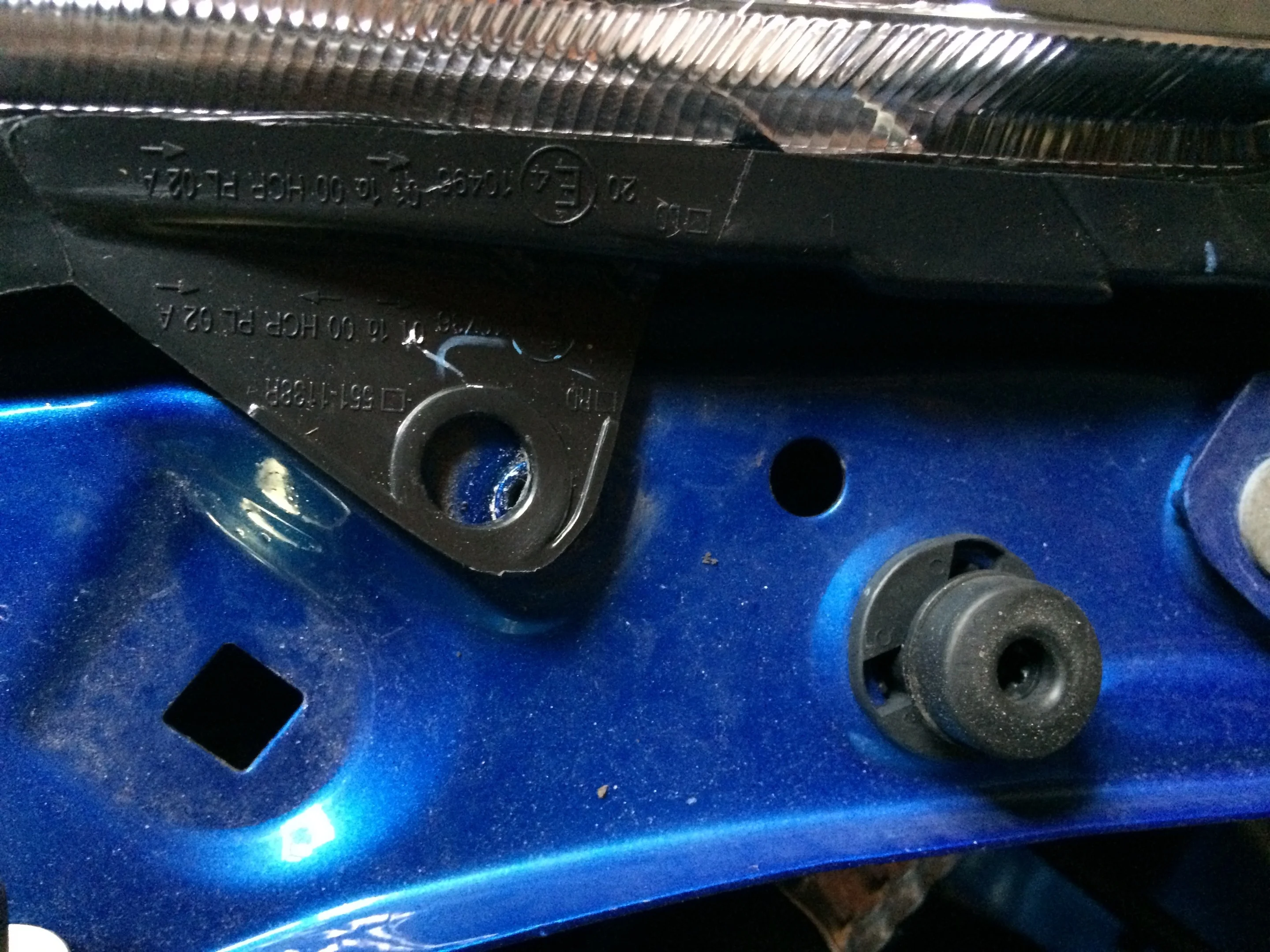

Fitted aftermarket Budget Headlights, nice to see that everything lines up nicely lol:
IMG_1157 by danfullstop, on Flickr
Bosh! :)
IMG_1158 by danfullstop, on Flickr
IMG_1159 by danfullstop, on Flickr
IMG_1163 by danfullstop, on Flickr

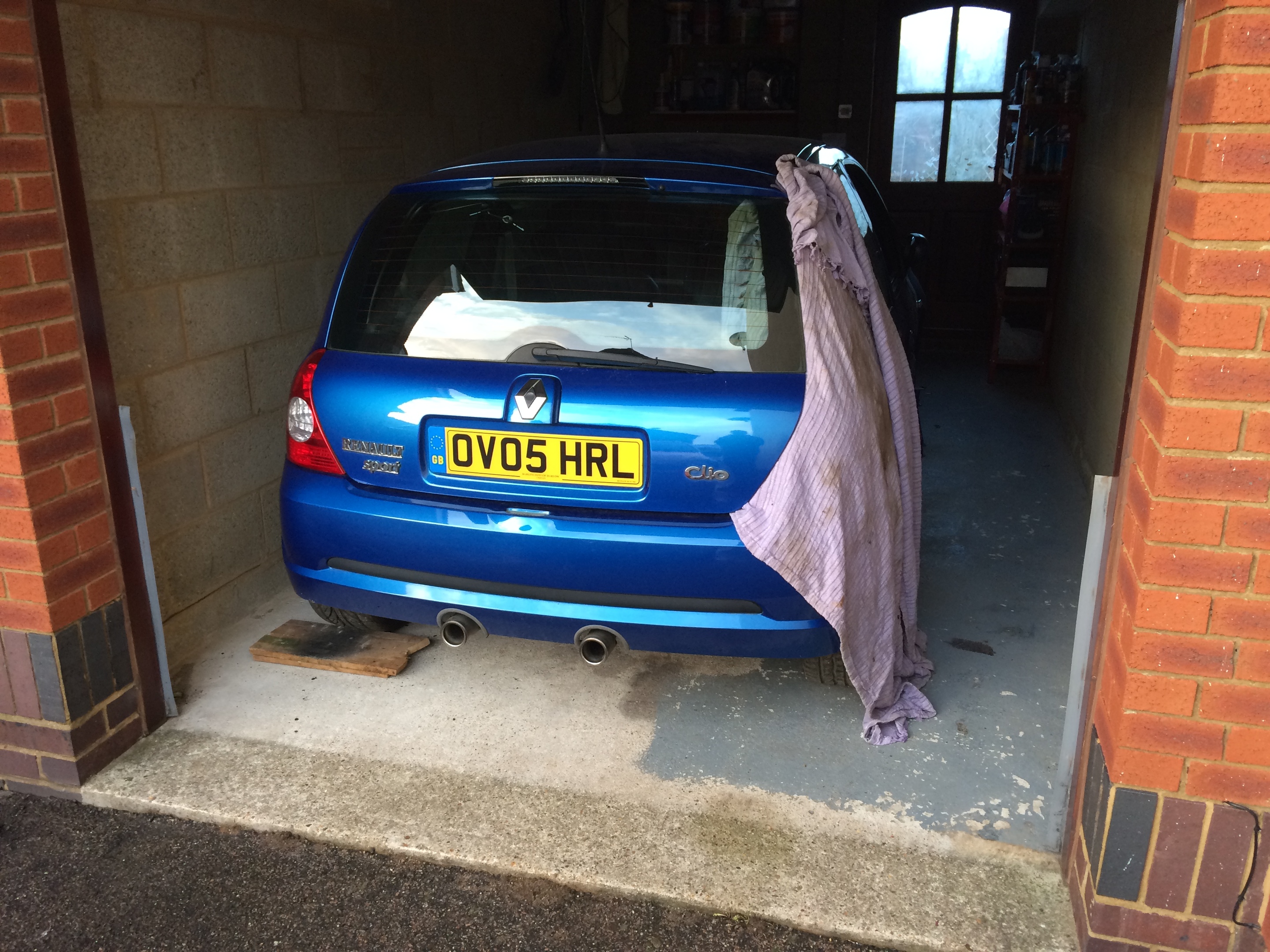

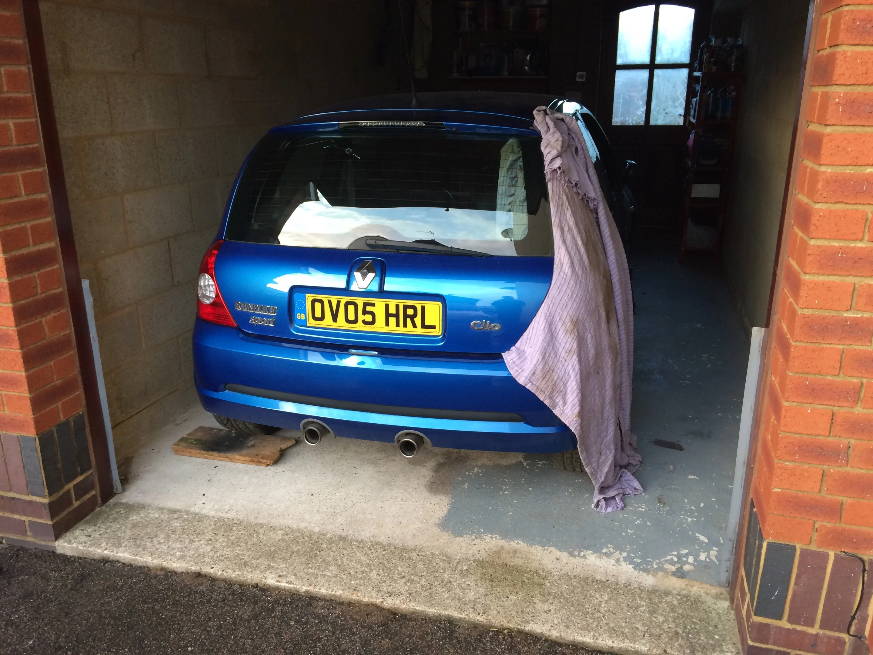

Tucked up with its 'protective' rag:
IMG_1166 by danfullstop, on Flickr

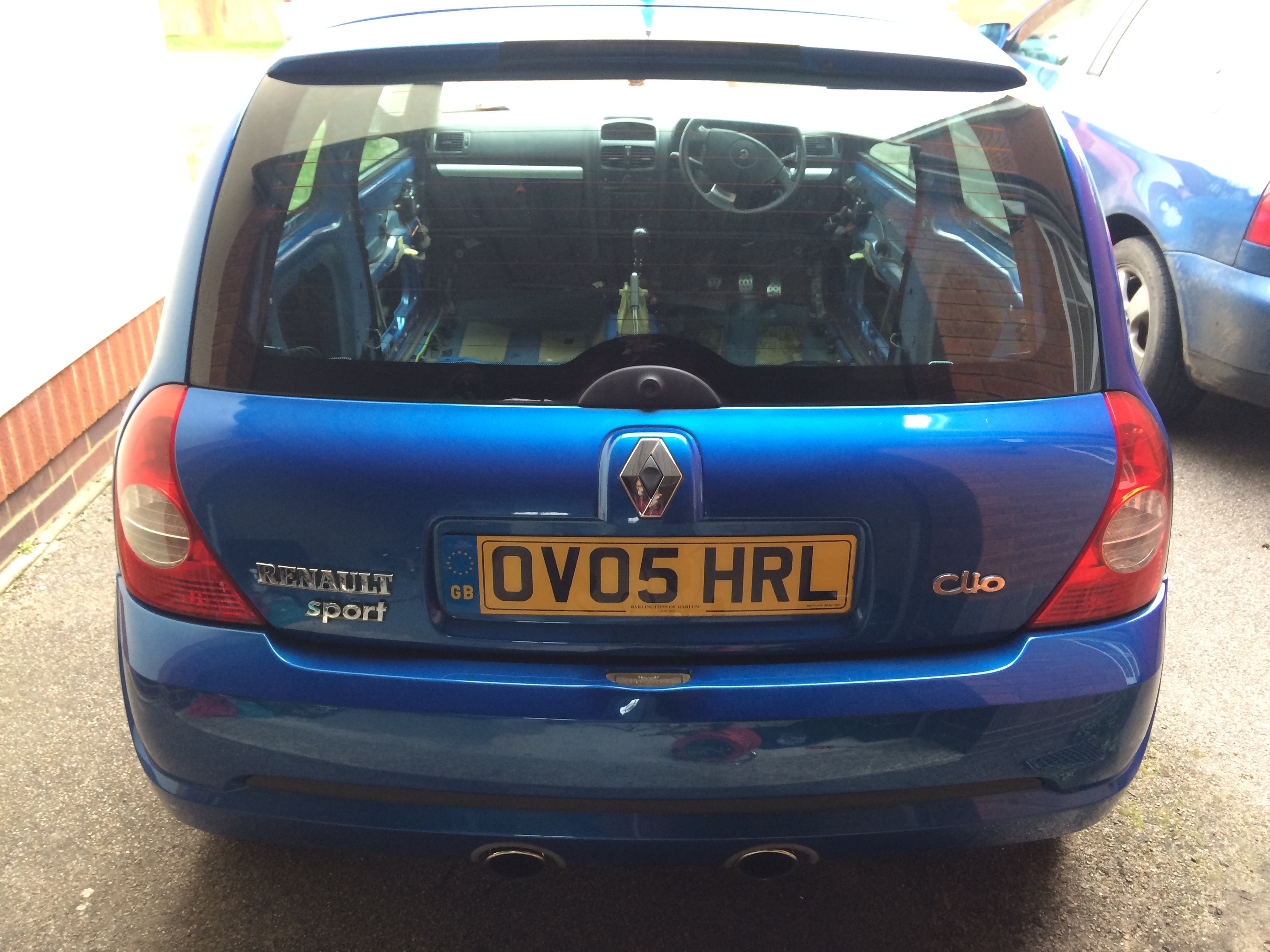

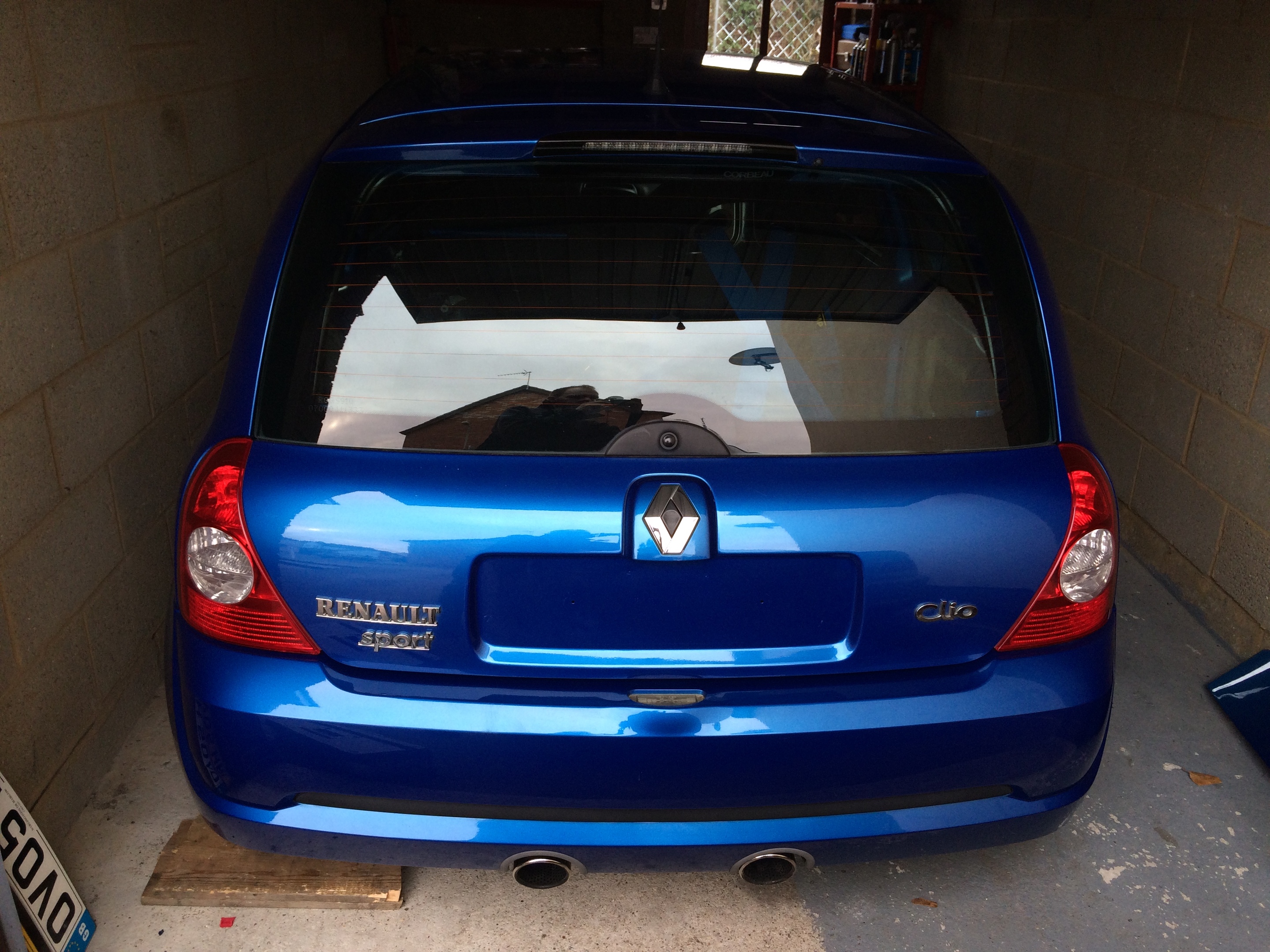

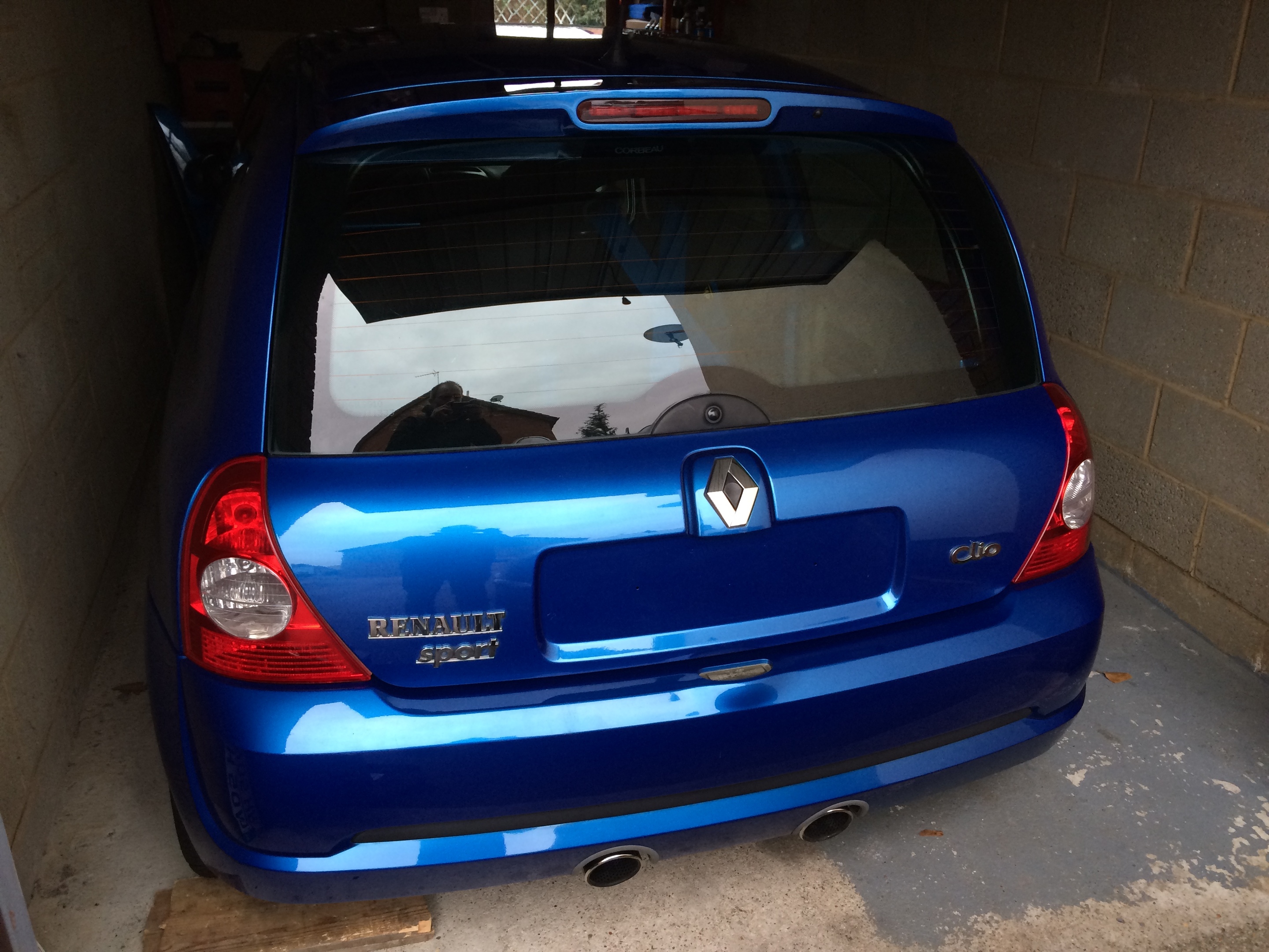

So spent the last couple of days working on the toy, this arrived the other day:
IMG_1191 by danfullstop, on Flickr
Ktec/Janspeed supersports exhaust, saved a good bit off RRP and came with a de-cat which ill fit once it has a fresh MOT in June.

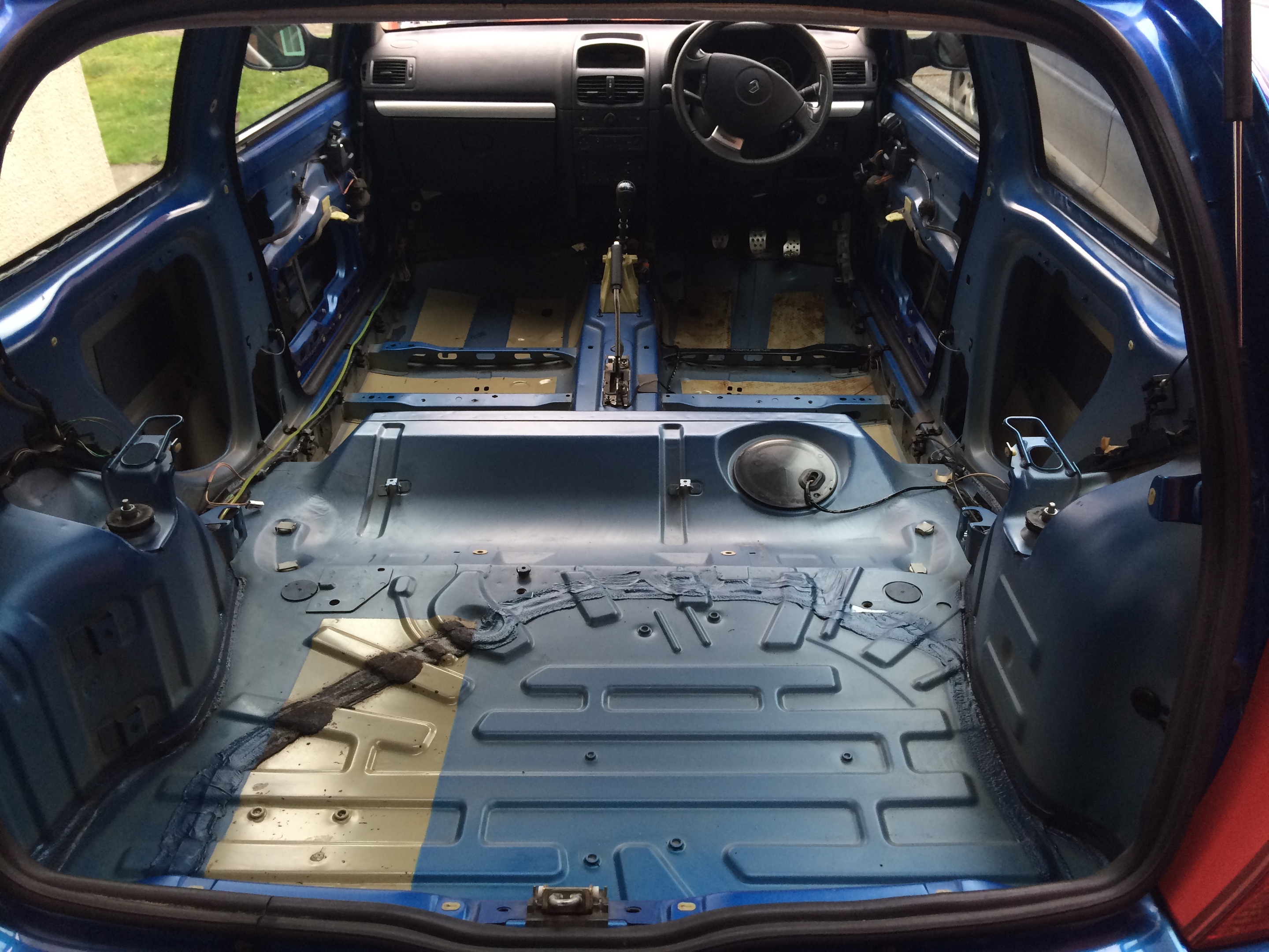

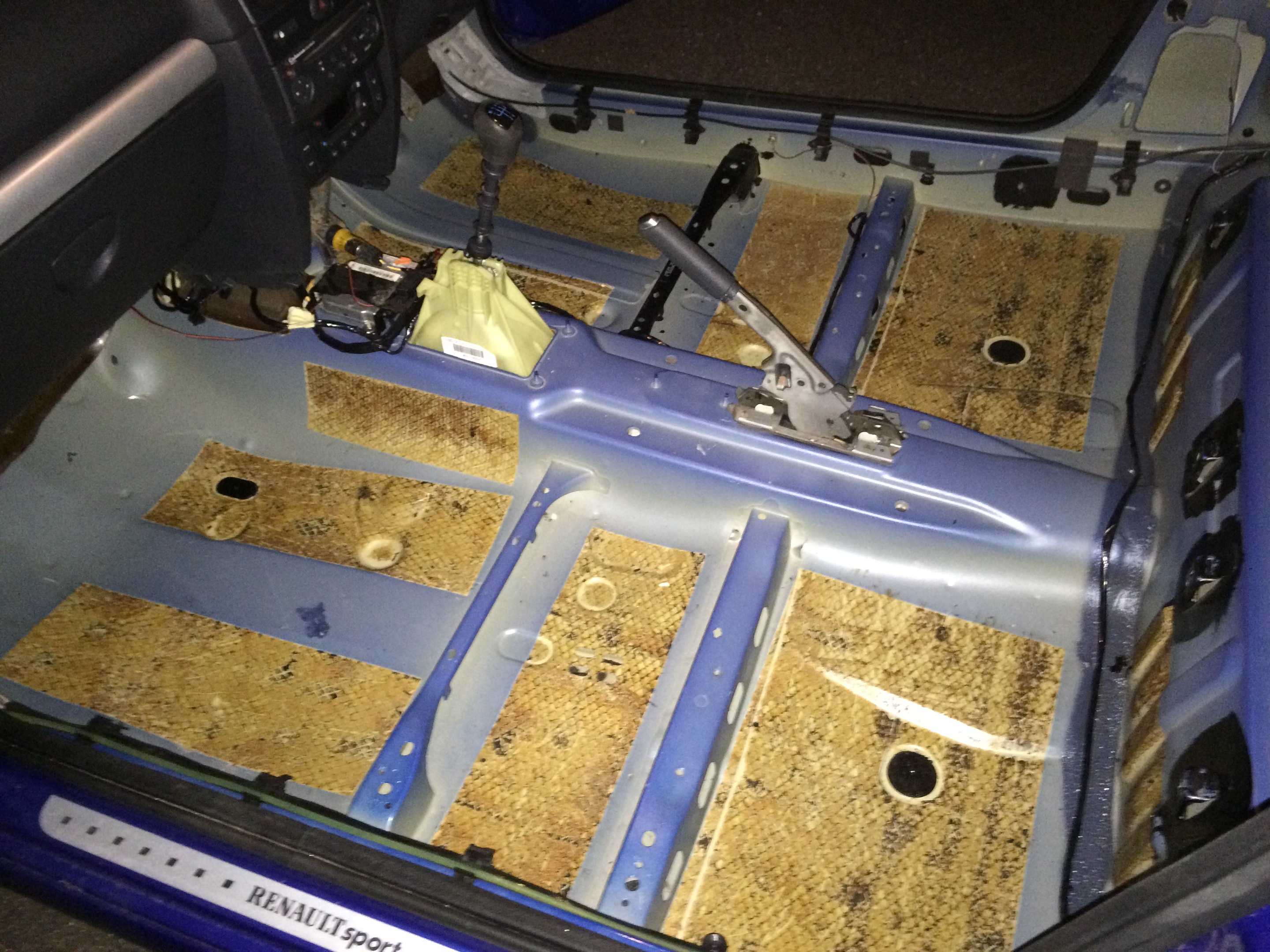

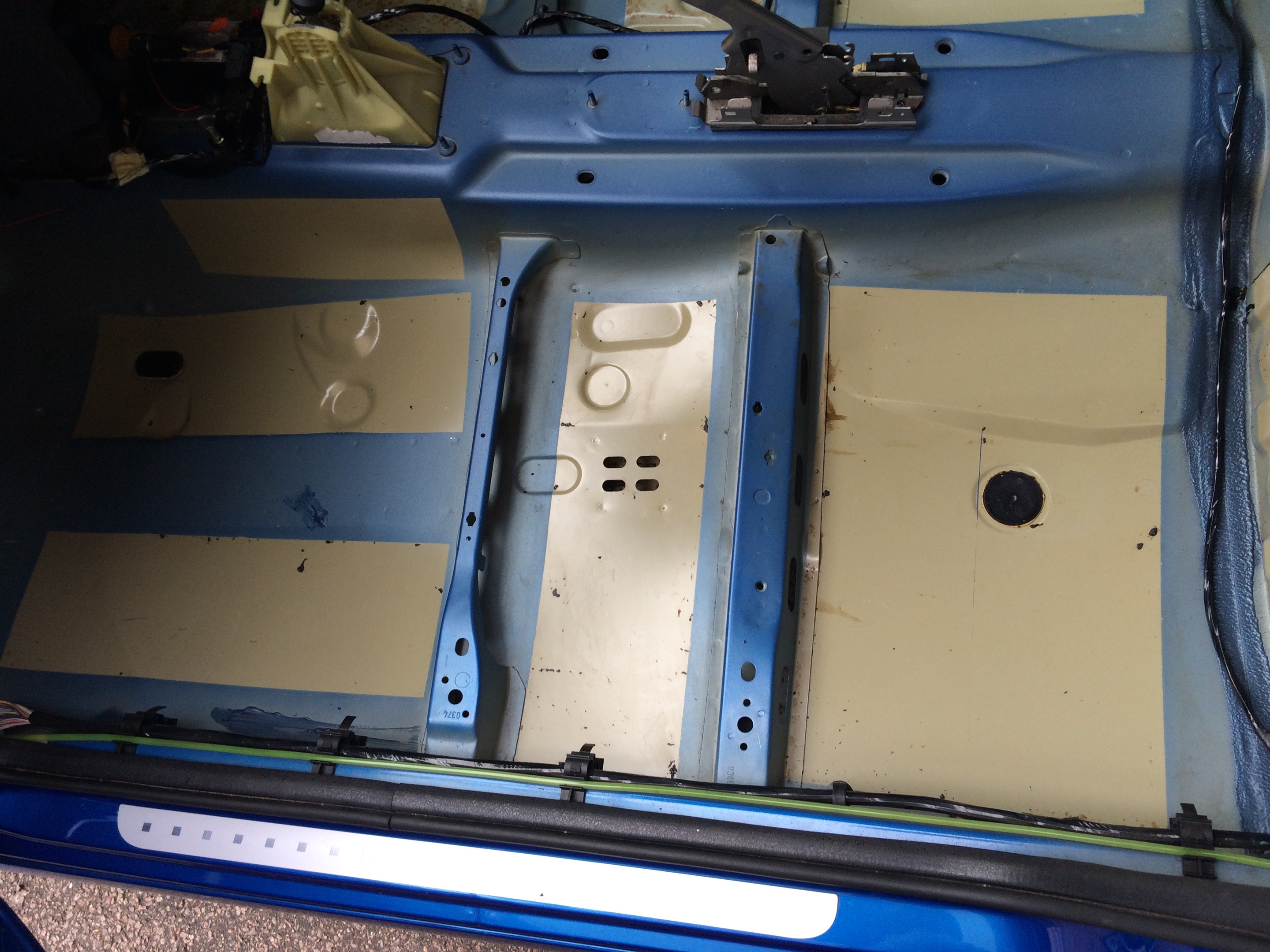

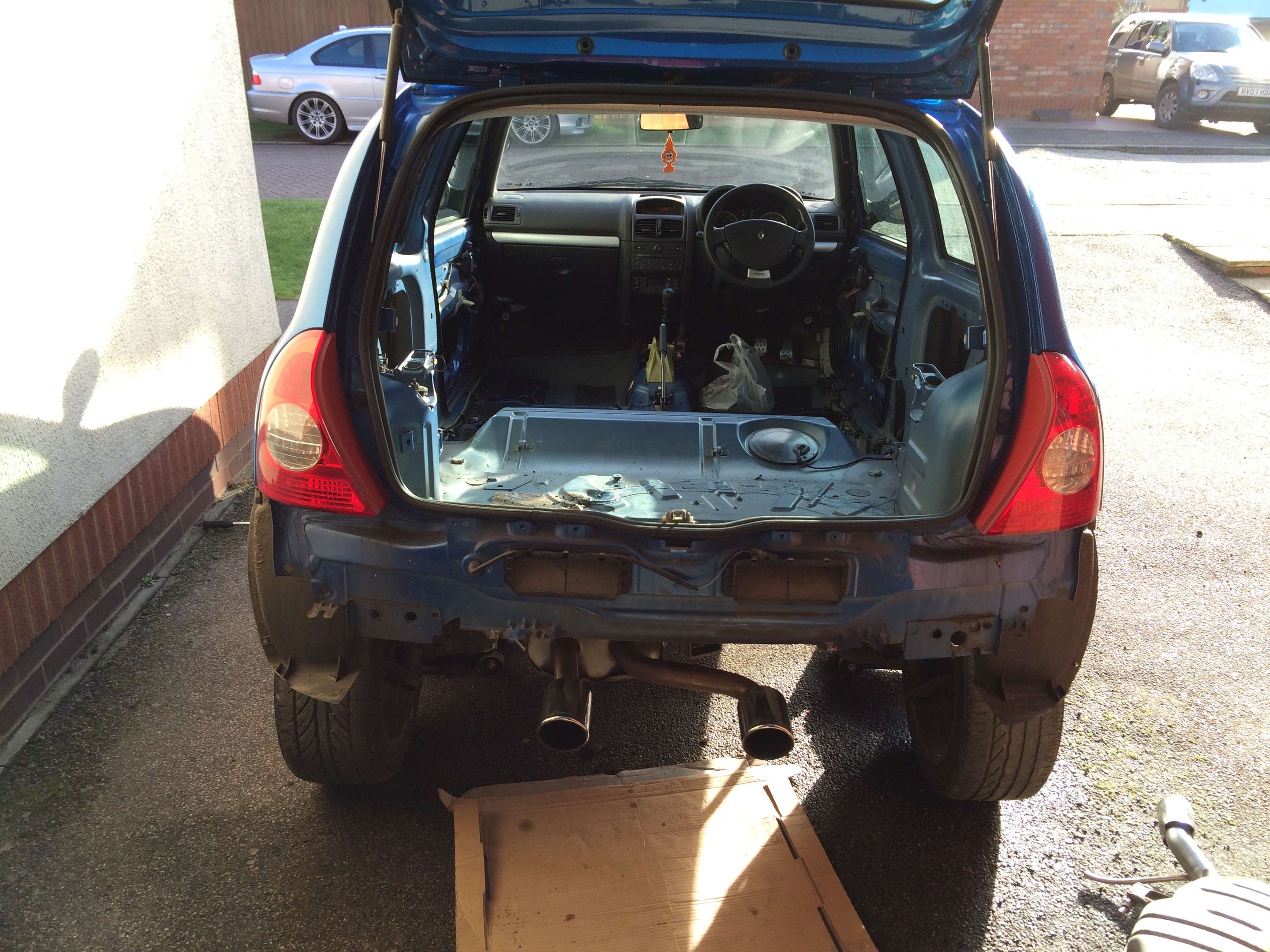

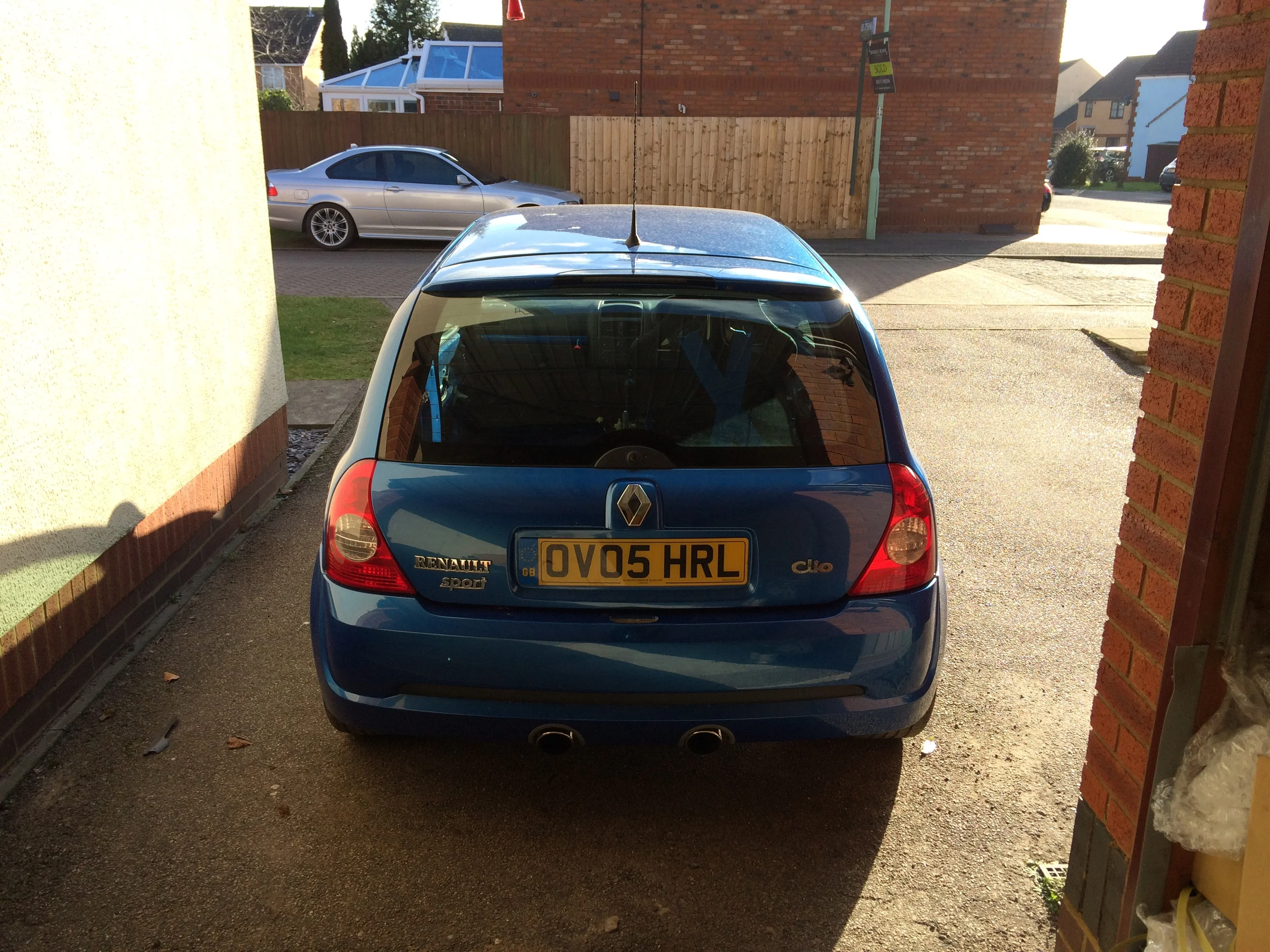

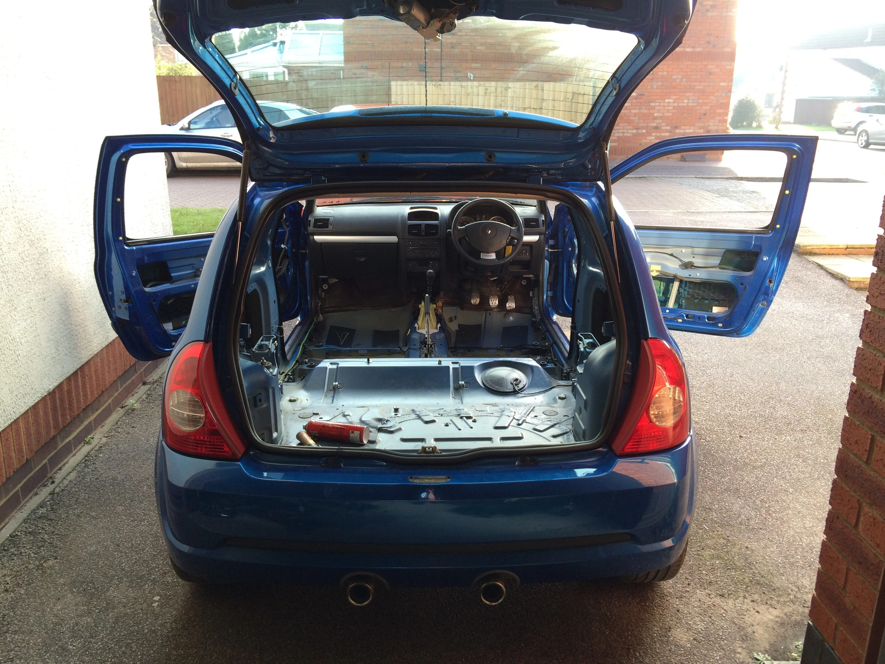

Started my stripping the car:
IMG_1175 by danfullstop, on Flickr
Half way there!
IMG_1179 by danfullstop, on Flickr
Done! Left the headliner in for the time being, will probably remove it once I get a cage next year though.

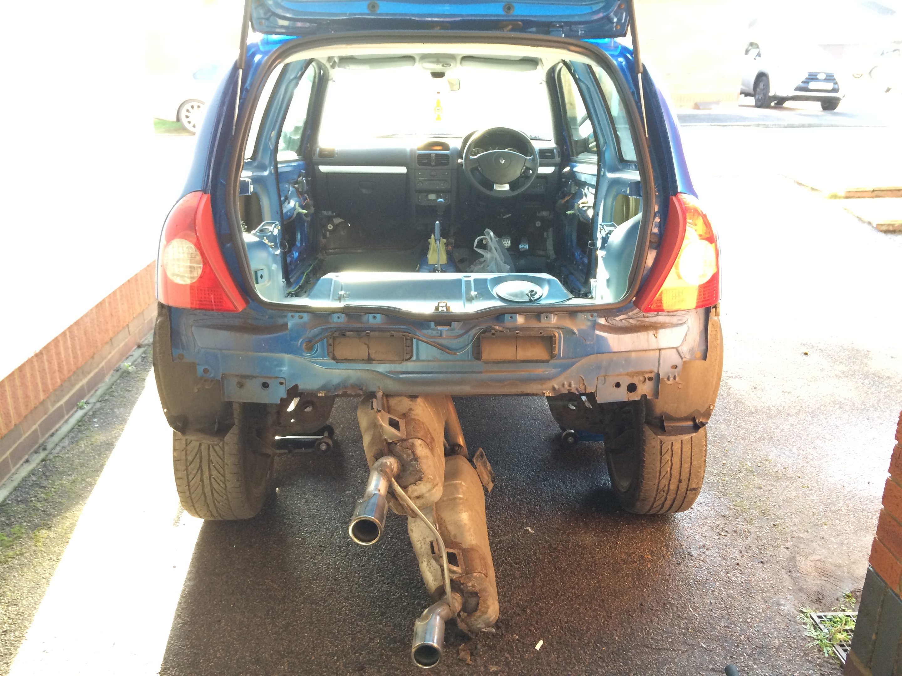

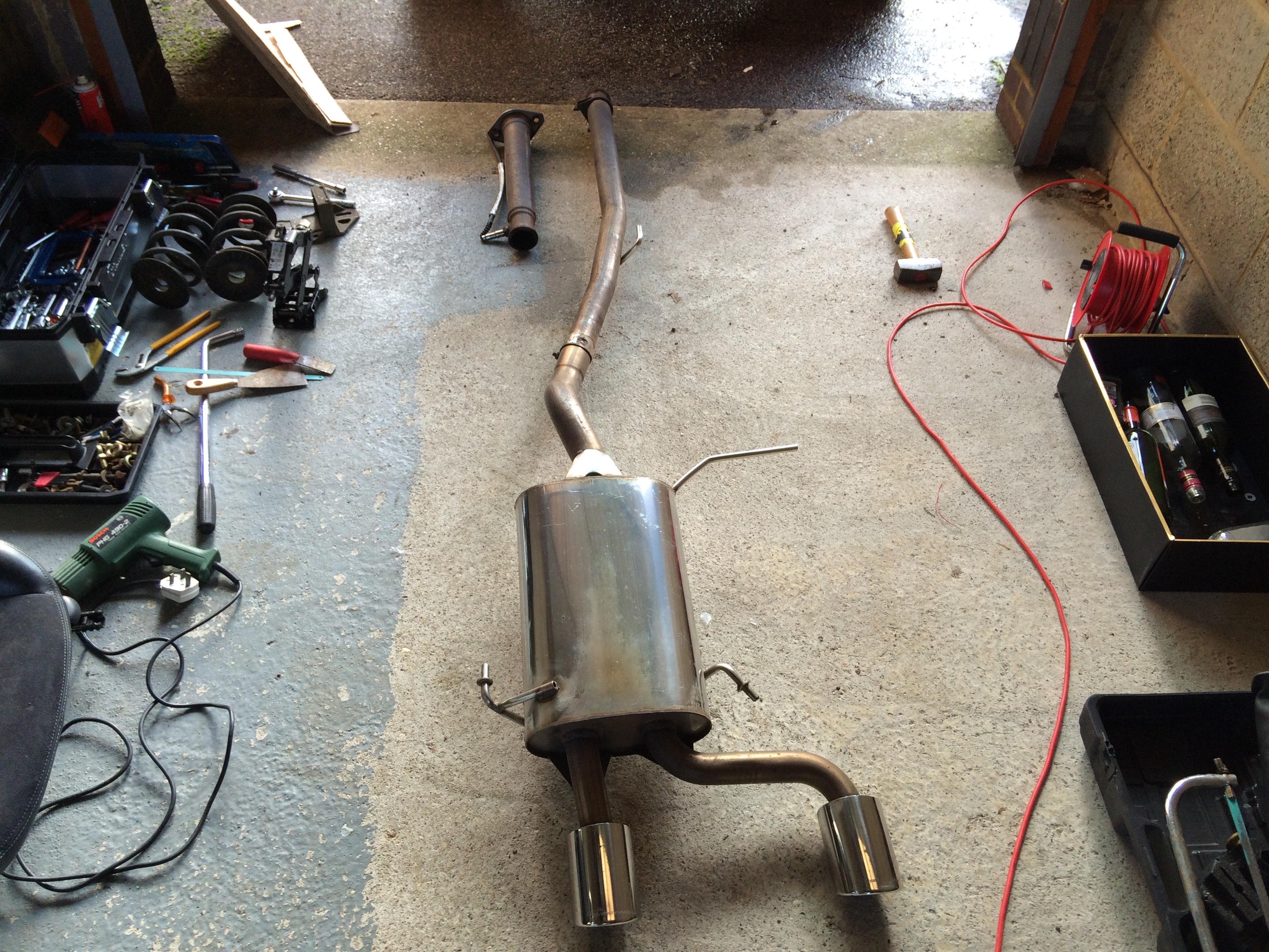

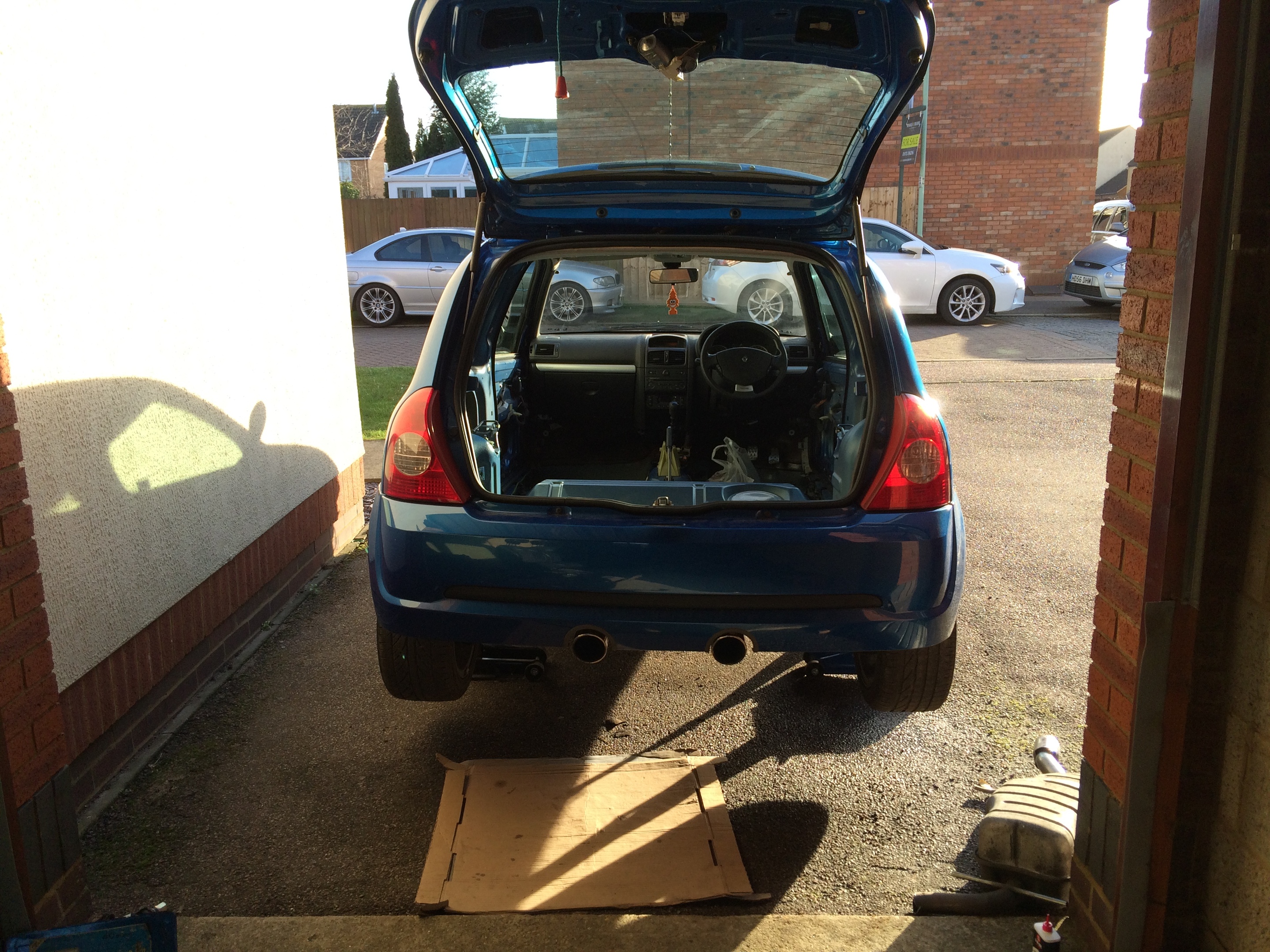

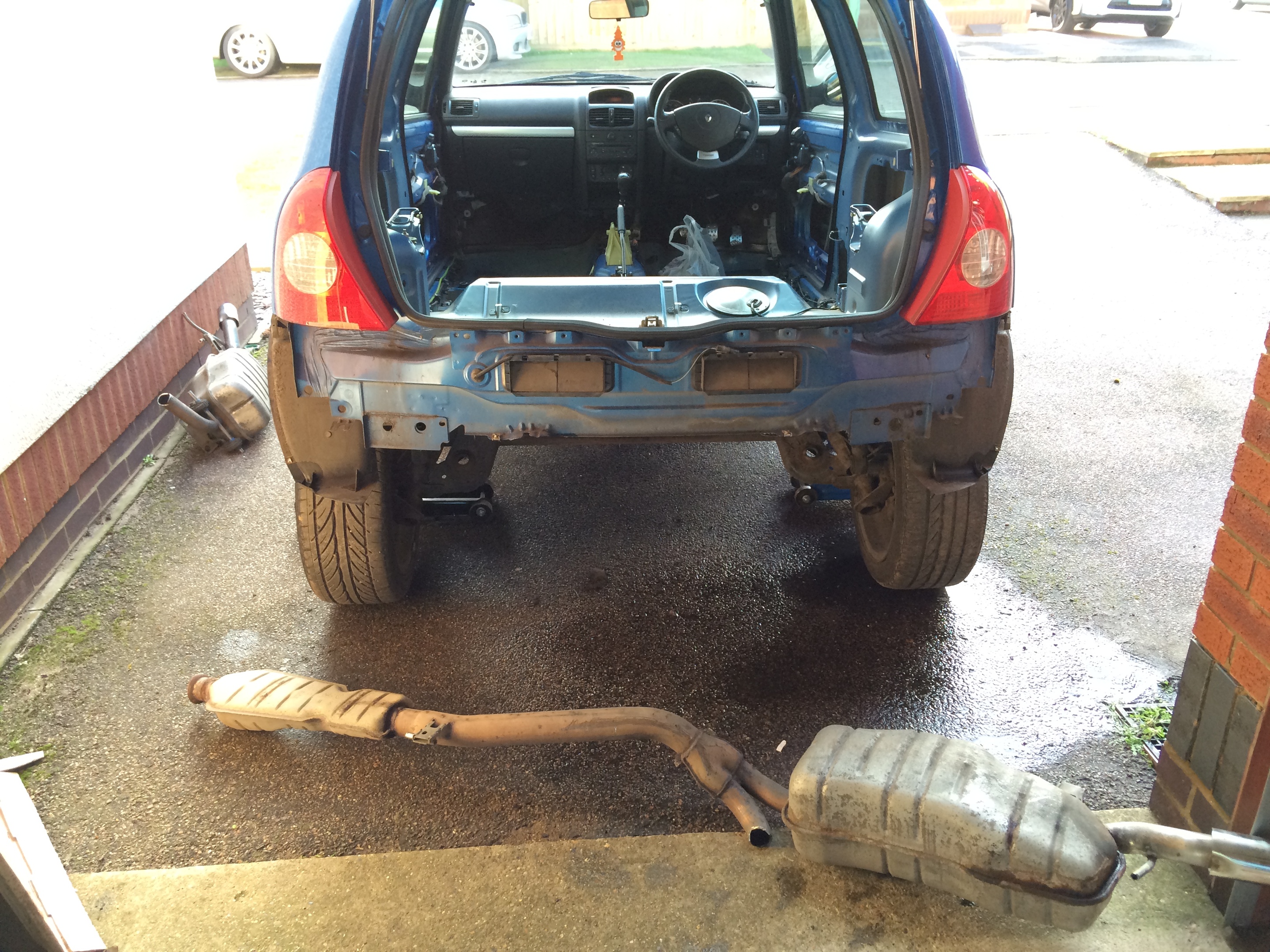

Standard exhaust next....
IMG_1189 by danfullstop, on Flickr

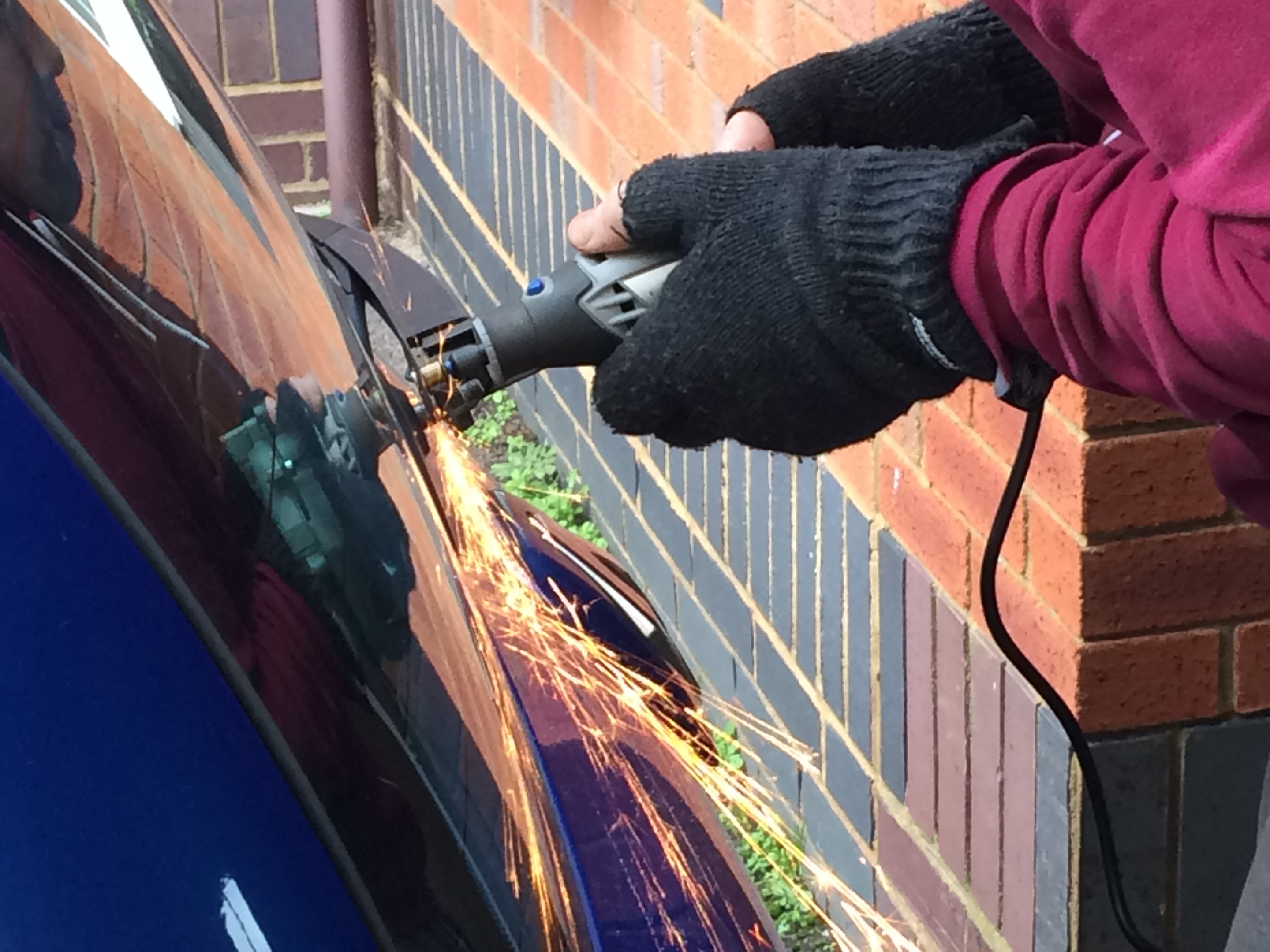

Couldn't get the car high enough fit it out, both jacks on full with the rear beam dropped :(
Busted out the Dremmel and cut one of the boxes off :)
IMG_1190 by danfullstop, on Flickr
Done!
Then went onto fitting the replacement:
IMG_1192 by danfullstop, on Flickr
IMG_1193 by danfullstop, on Flickr
The right tip is slightly off centre, did the classic old socket trick in the rear hangers but couldn't get it any further over, the left is fine so I think its been slightly bent in transit to me, not bothered tbh as it doesn't appear to rattle and looks good enough for me.

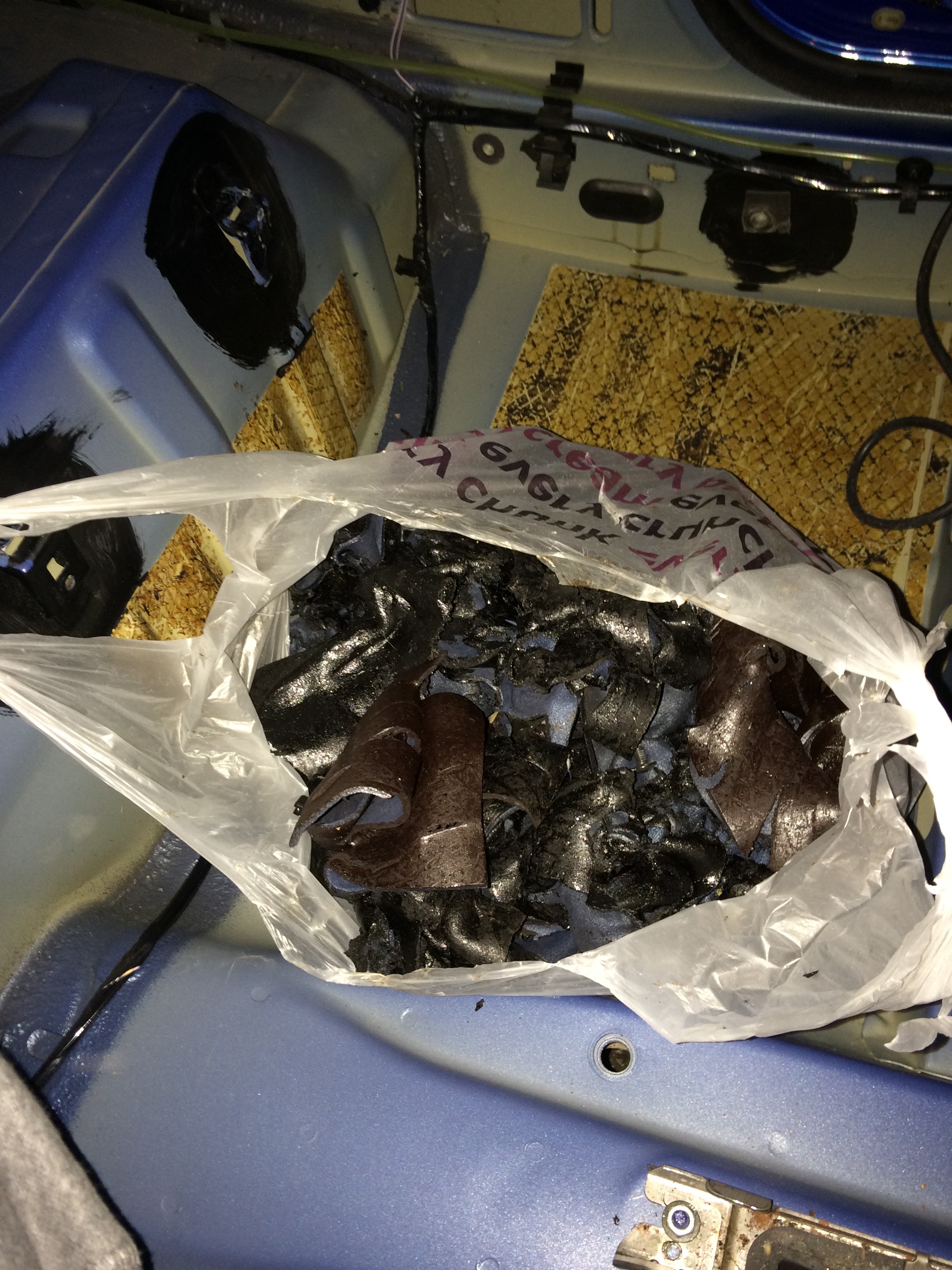

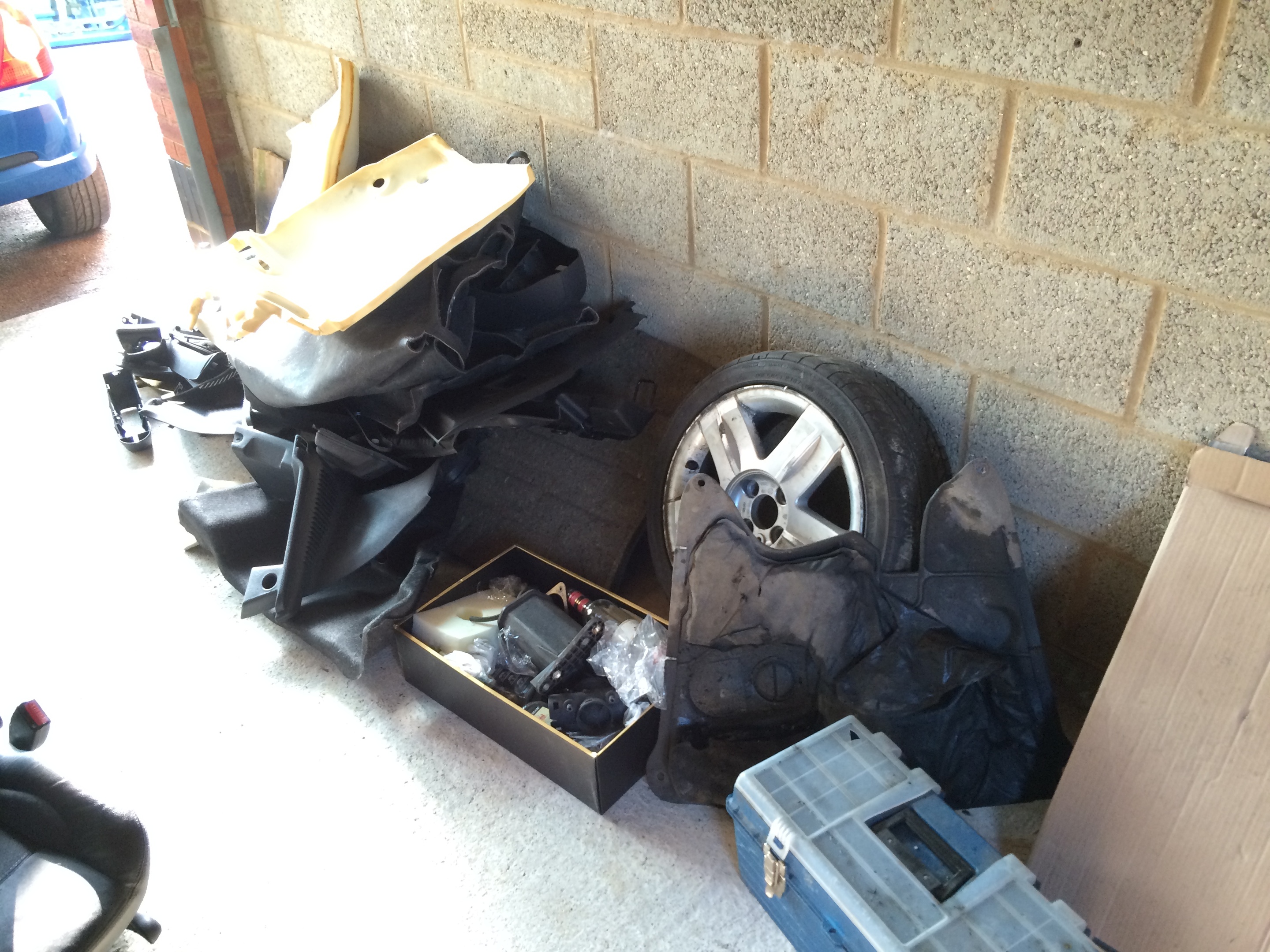

Tar next:
IMG_1197 by danfullstop, on Flickr
IMG_1196 by danfullstop, on Flickr
Cya 10Kg's!
All the crap to dump, ignore the wheel :p
IMG_1180 by danfullstop, on Flickr
All in all, good start, need to finish getting rid of the sticky s**t left by the tar, will then prep it (lol) to paint the inside next weekend perhaps. Might have my coilovers by then as well, so will probably tackle the front brakes at the same time.

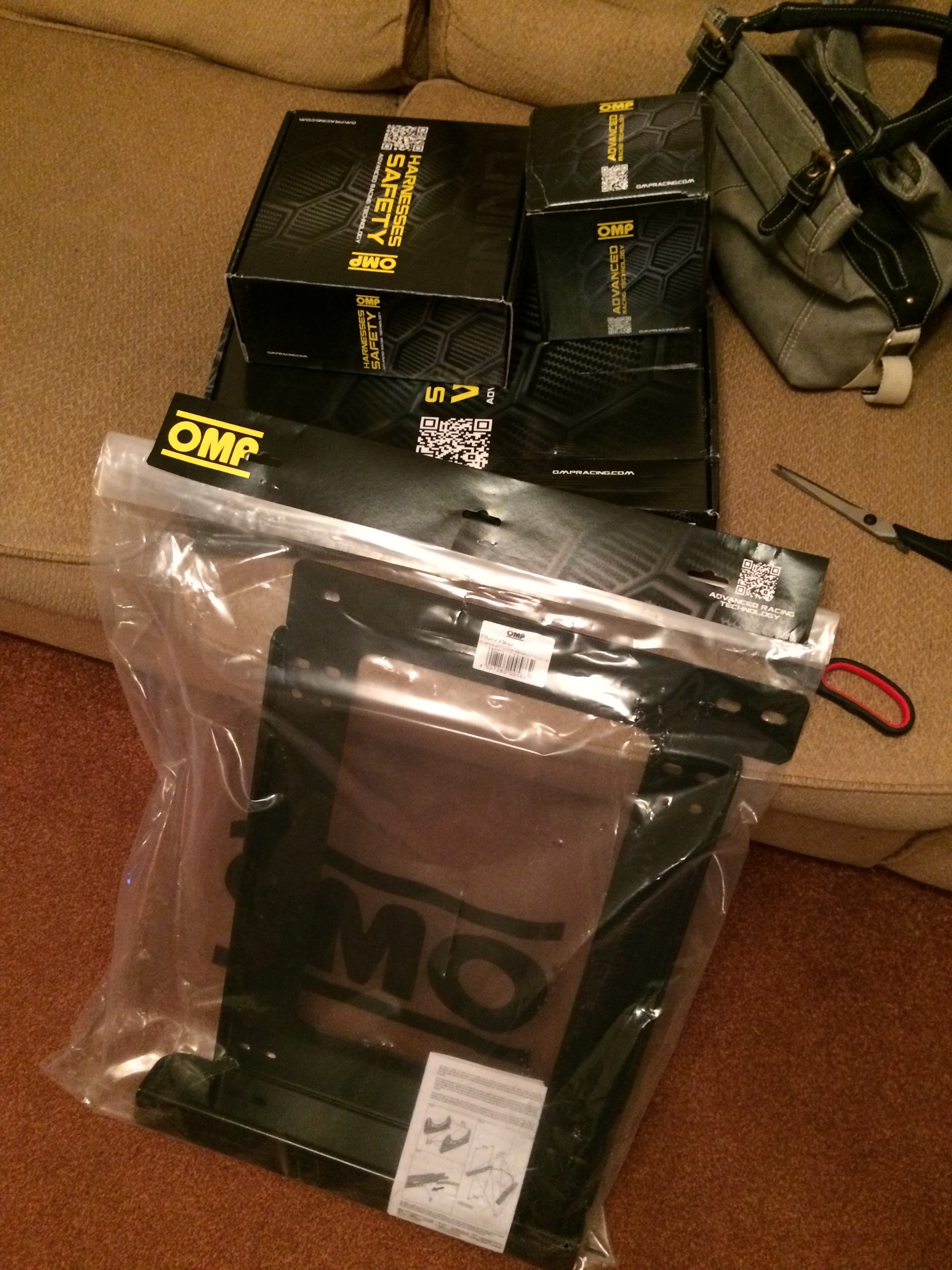

Got a few bits in the post!
IMG_1210 by danfullstop, on Flickr
IMG_1211 by danfullstop, on Flickr
IMG_1214 by danfullstop, on Flickr

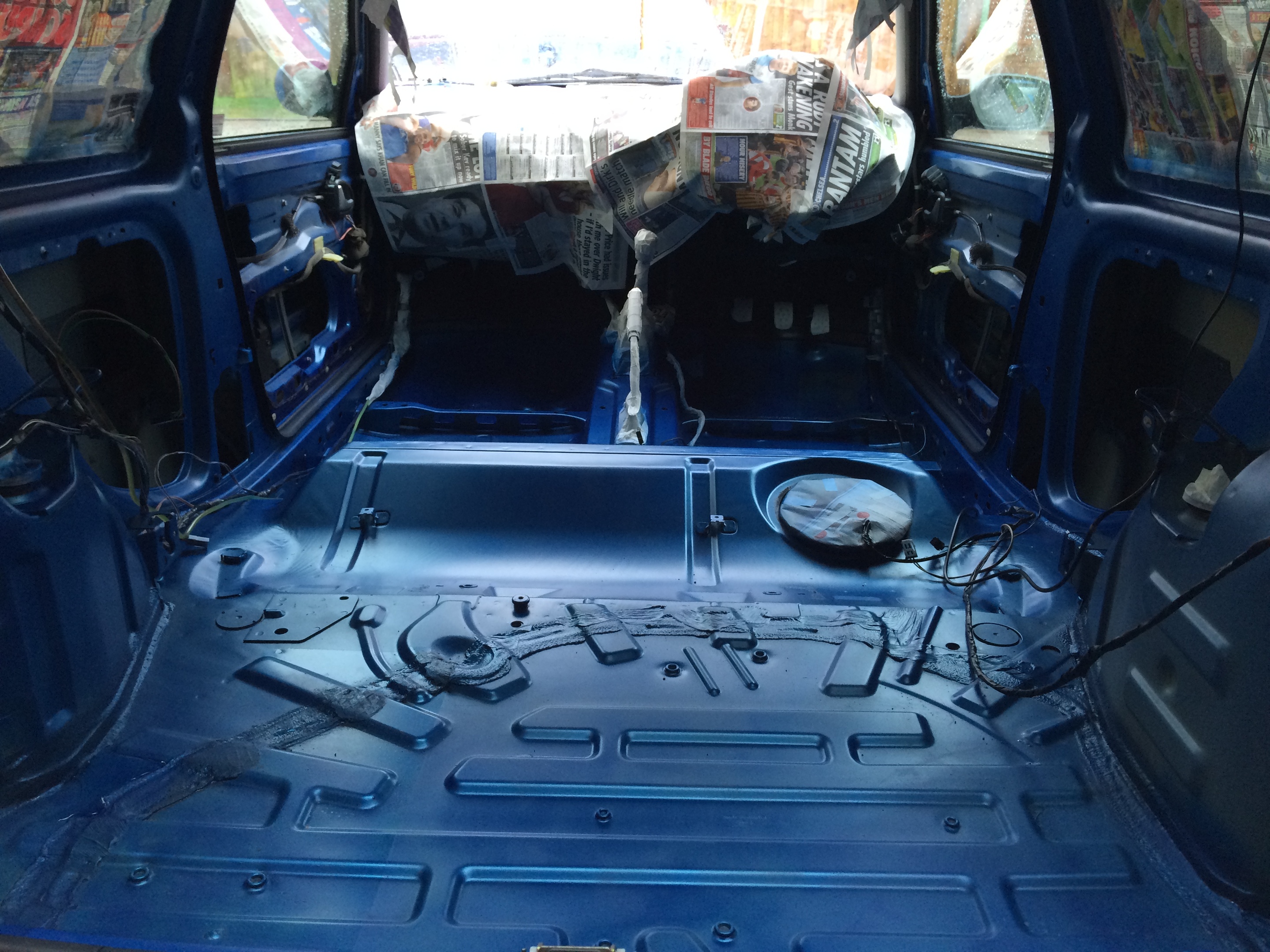

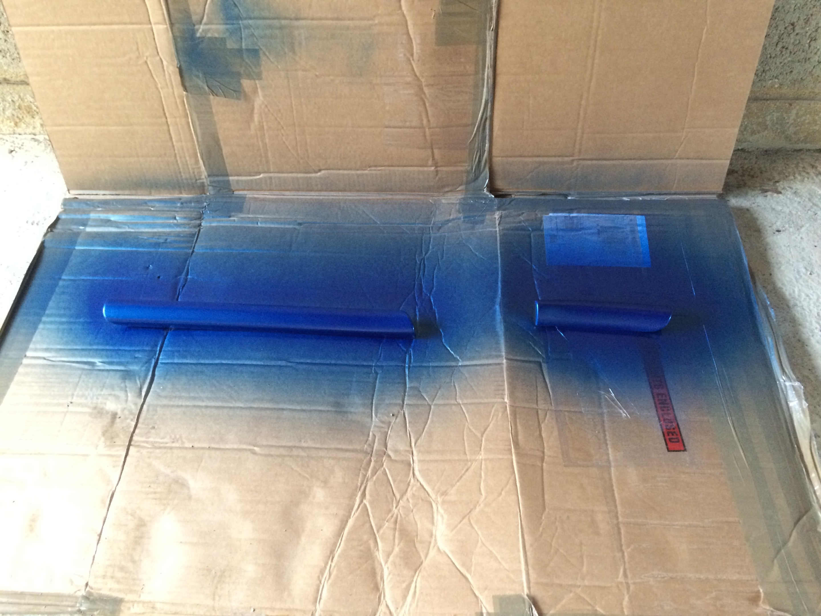

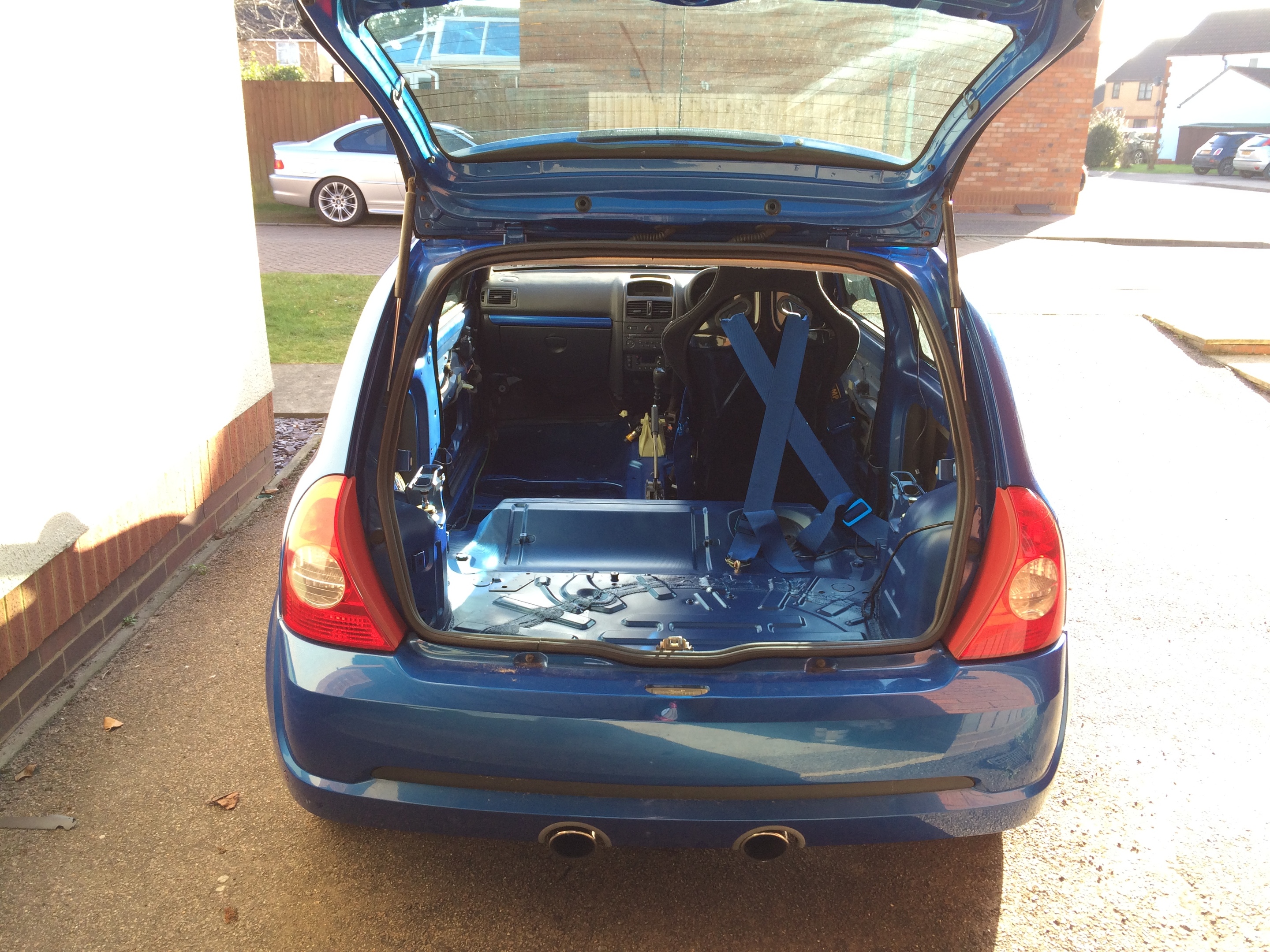

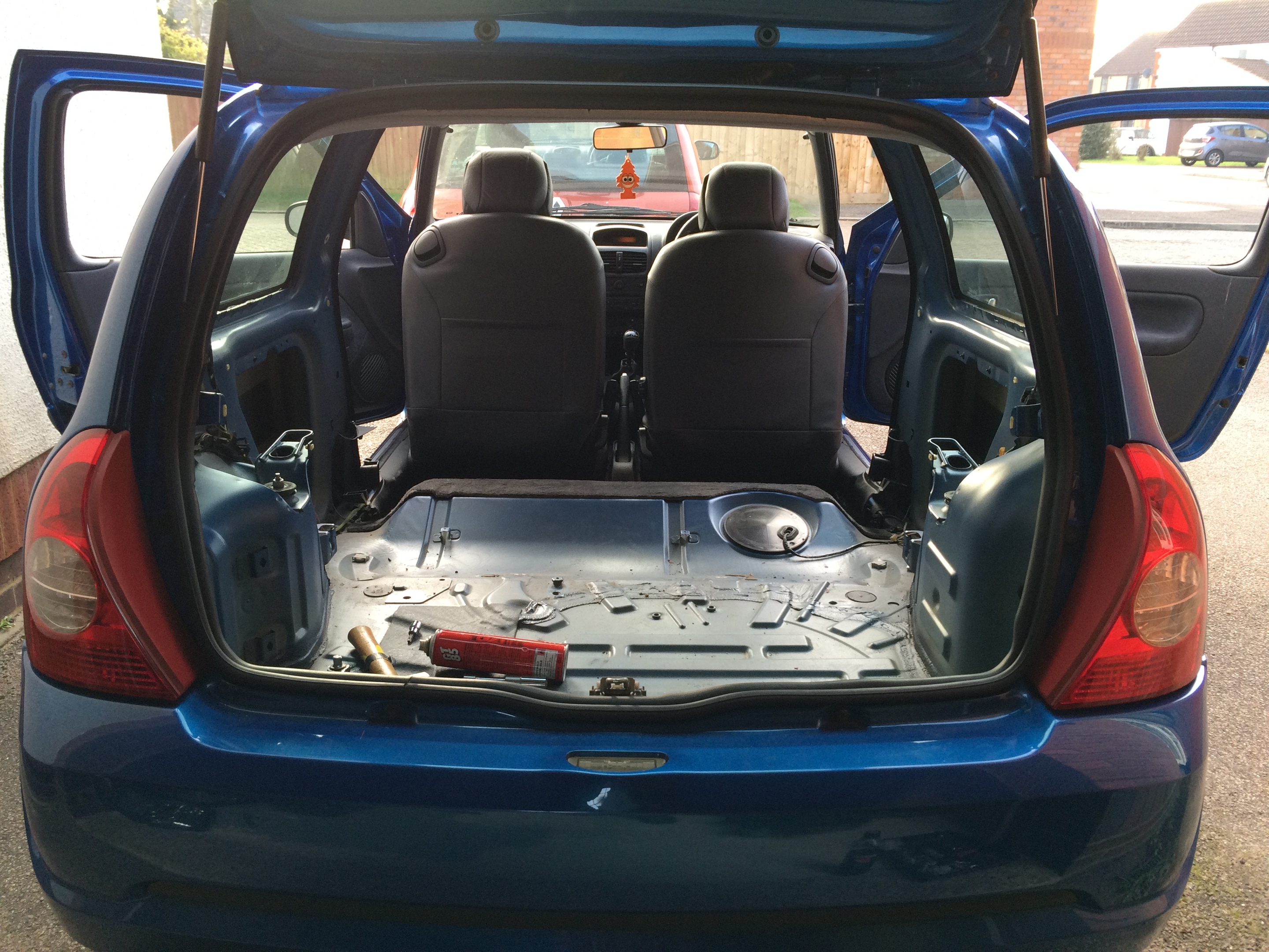

Cracked out the paint and sprayed the dash strips
IMG_1227 by danfullstop, on Flickr

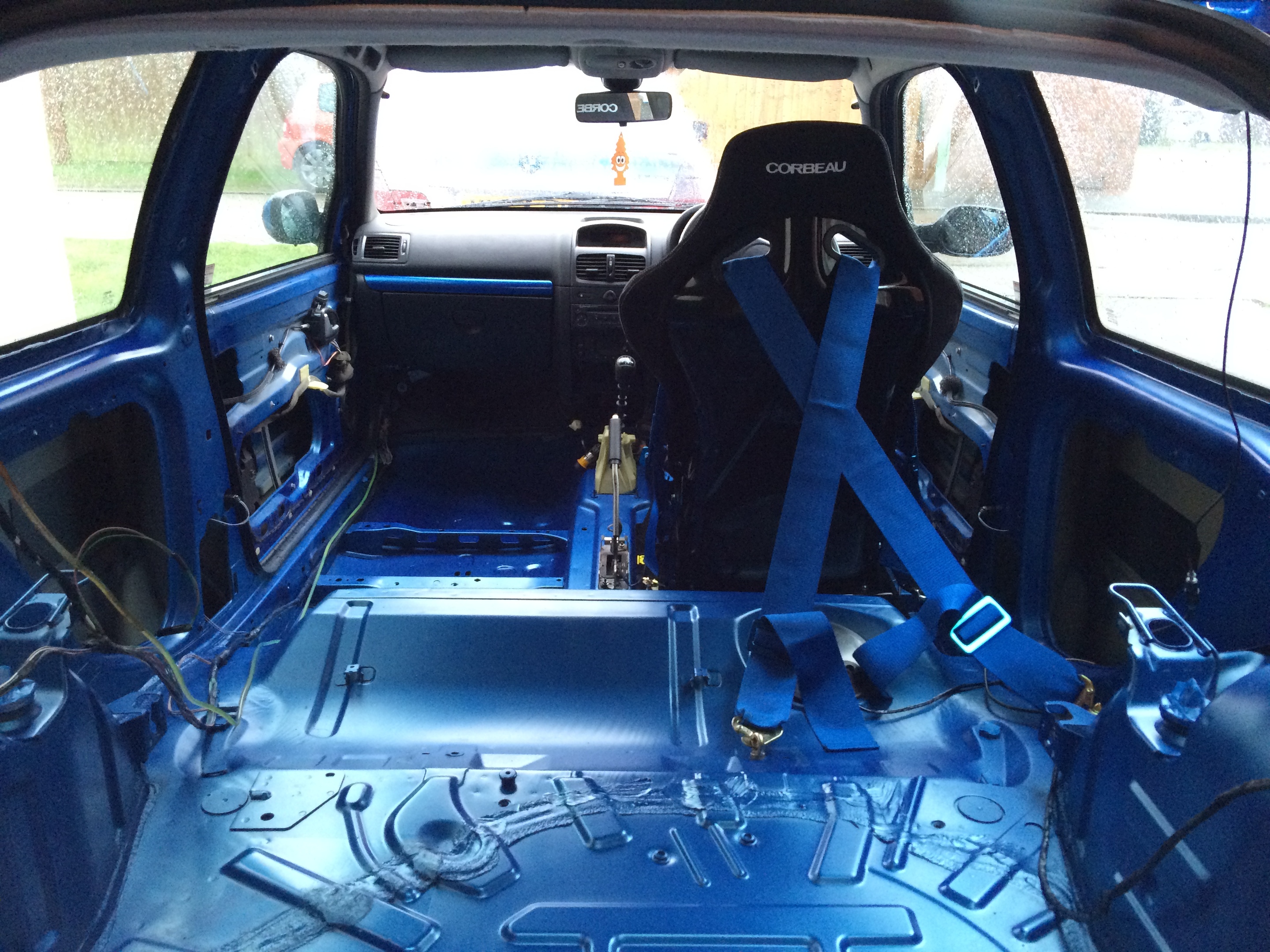

Then set to spraying the inside, not the best job in the world but better than it was! :)
IMG_1228 by danfullstop, on Flickr

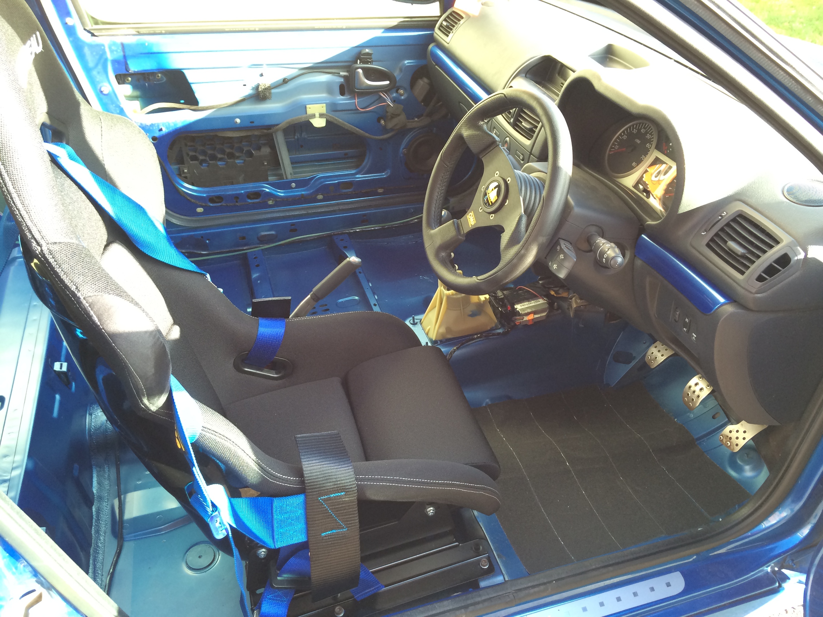

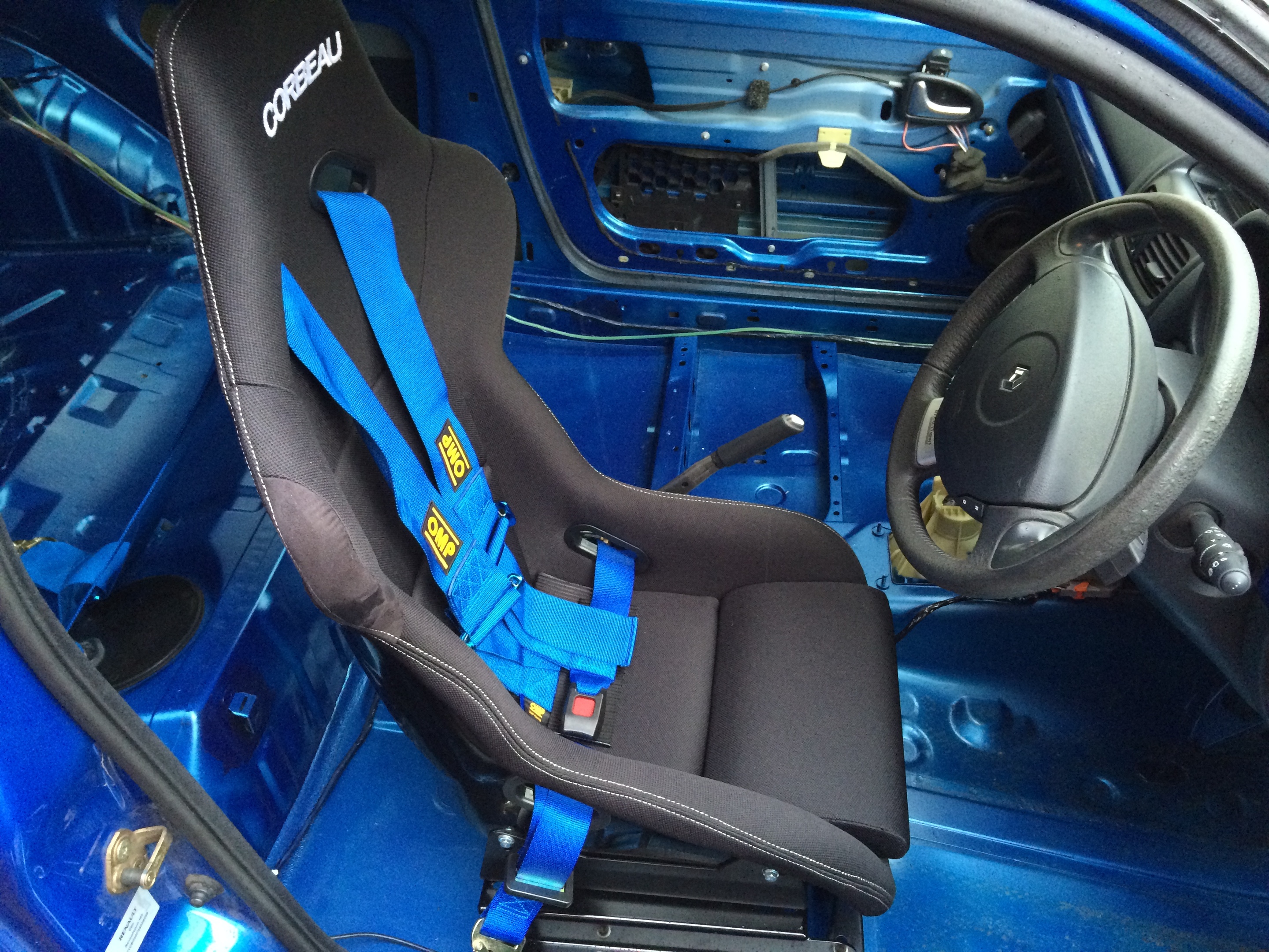

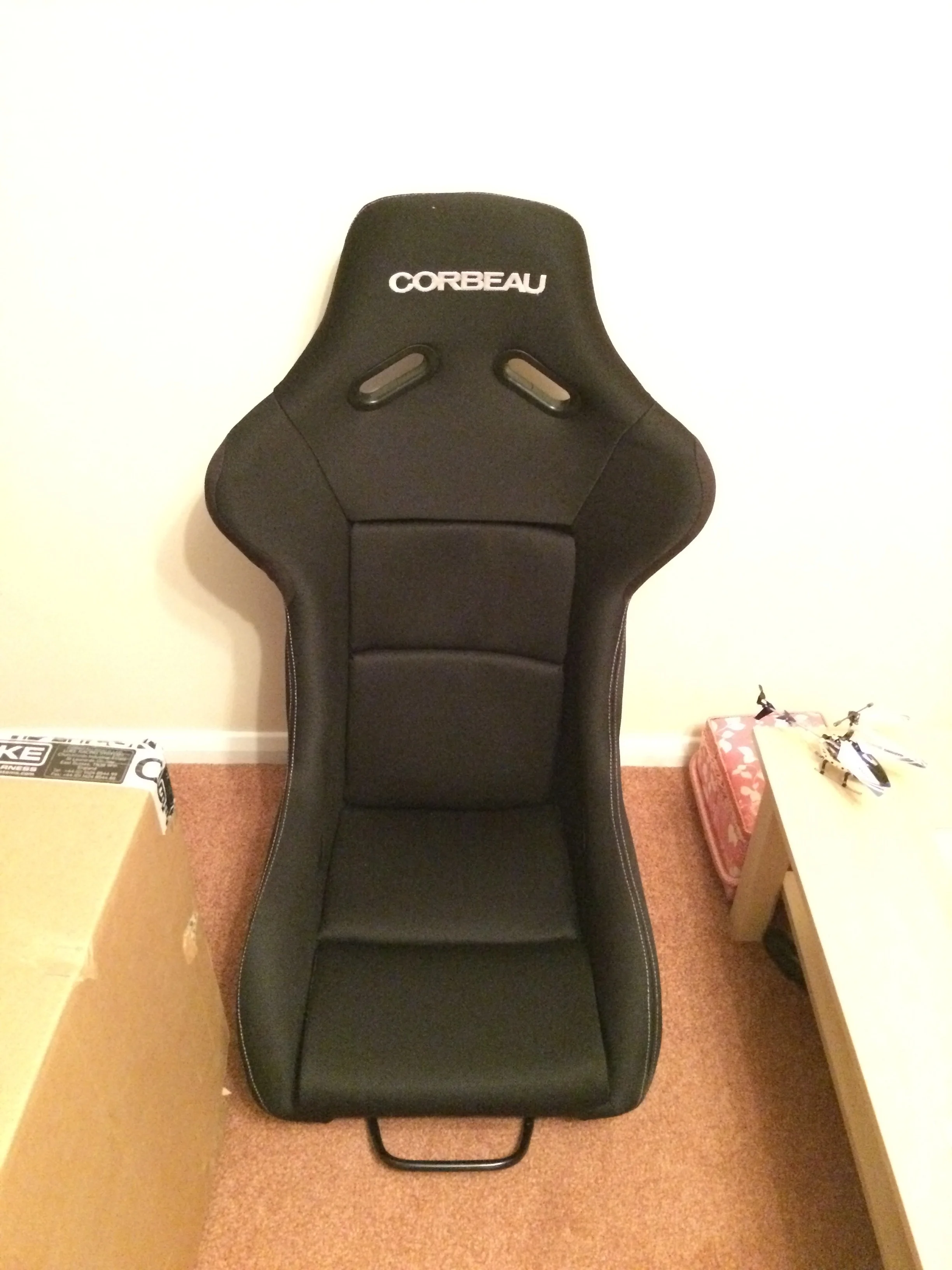

Seat and harness in!
IMG_1232 by danfullstop, on Flickr
Seat in, makes the bus drivers wheel look lovely lol.
IMG_1234 by danfullstop, on Flickr
Was hoping to fit the OMP wheel as well, but the weather/light got the better of me so will continue next weekend, coilovers should be here by then as well :)

So yesterday and this morning I got a few bits done:

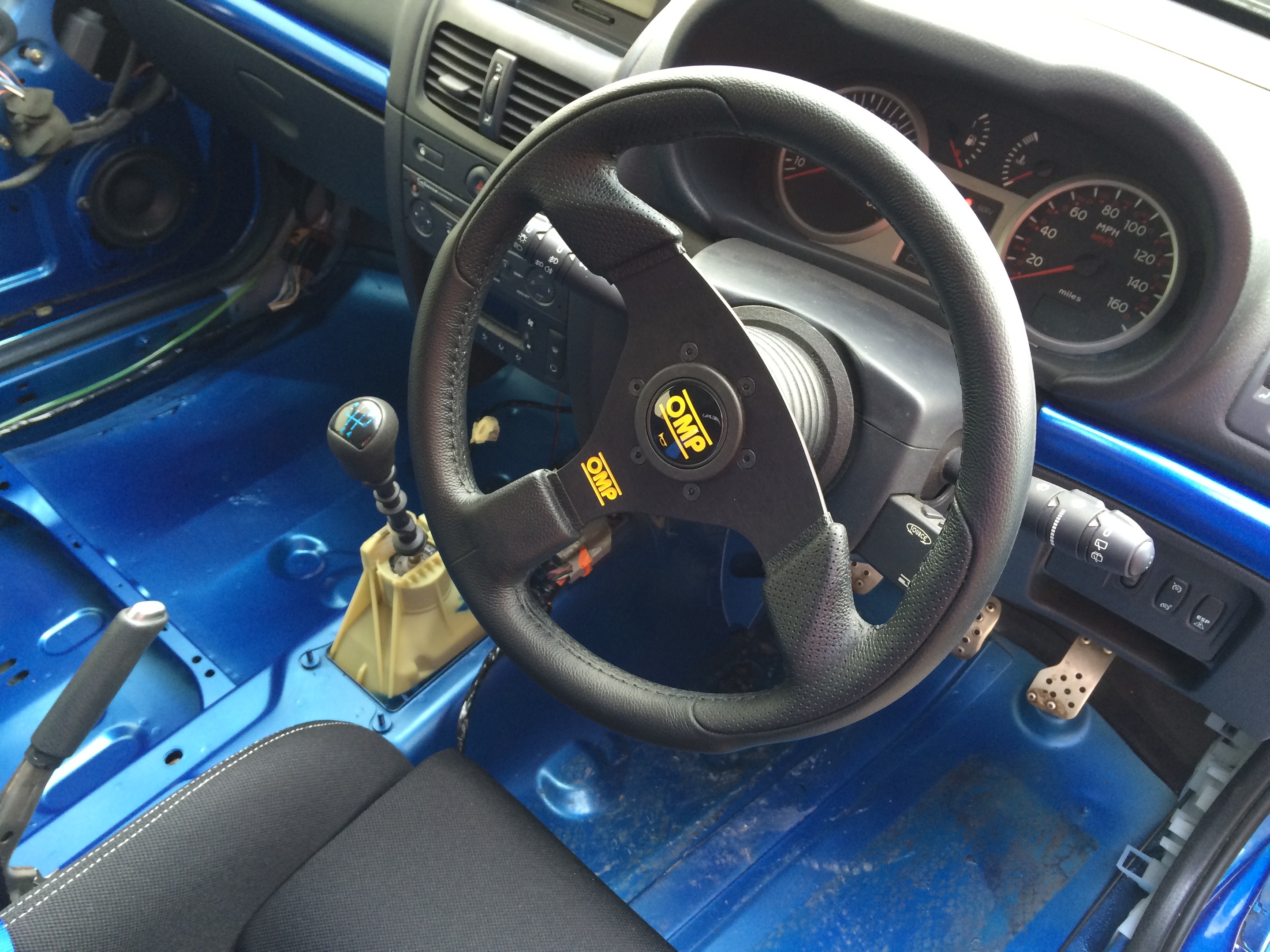

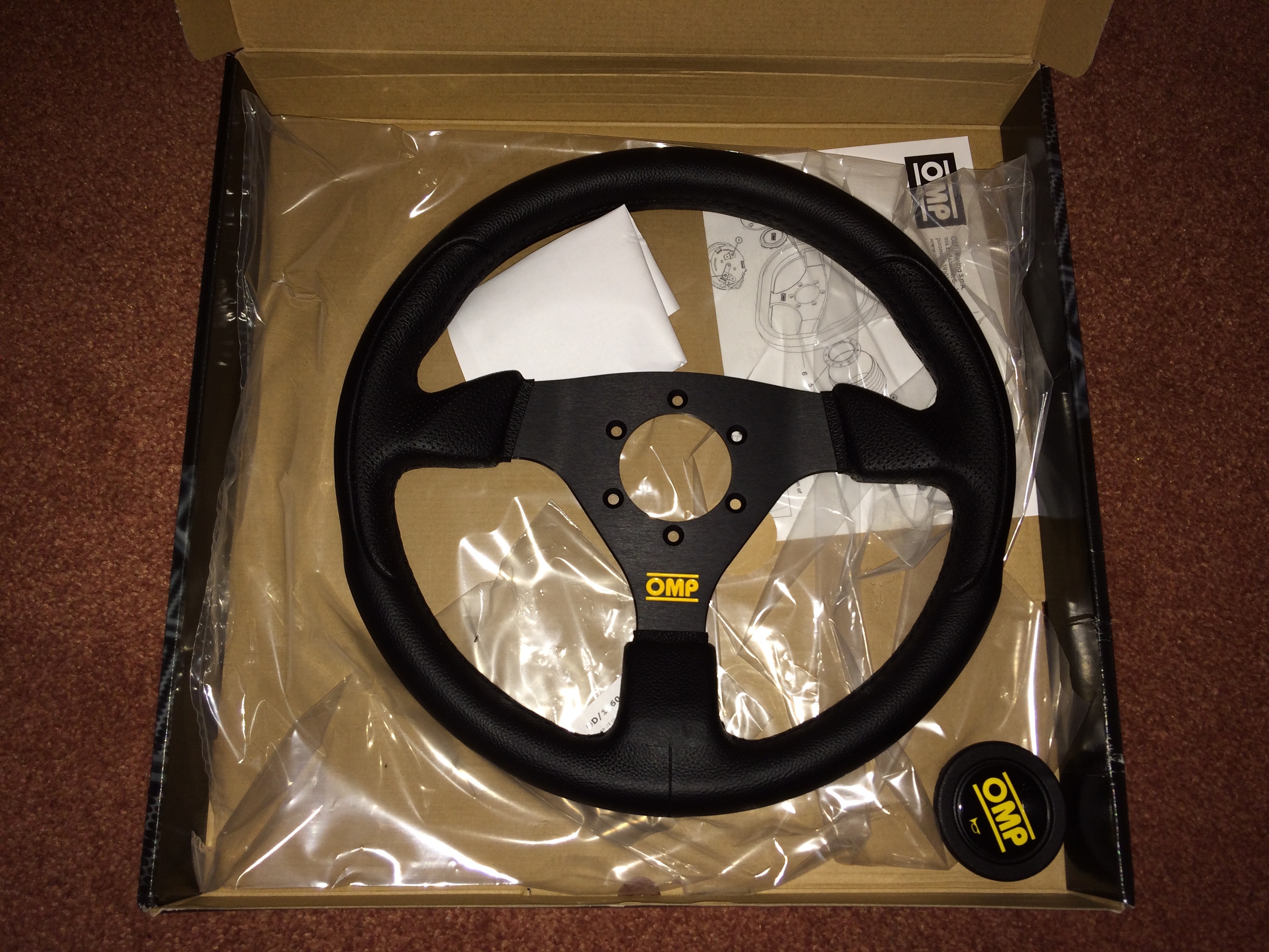

Fitted the OMP & wired up the horn, OMP boss's are s**t btw.
IMG_1258 by danfullstop, on Flickr

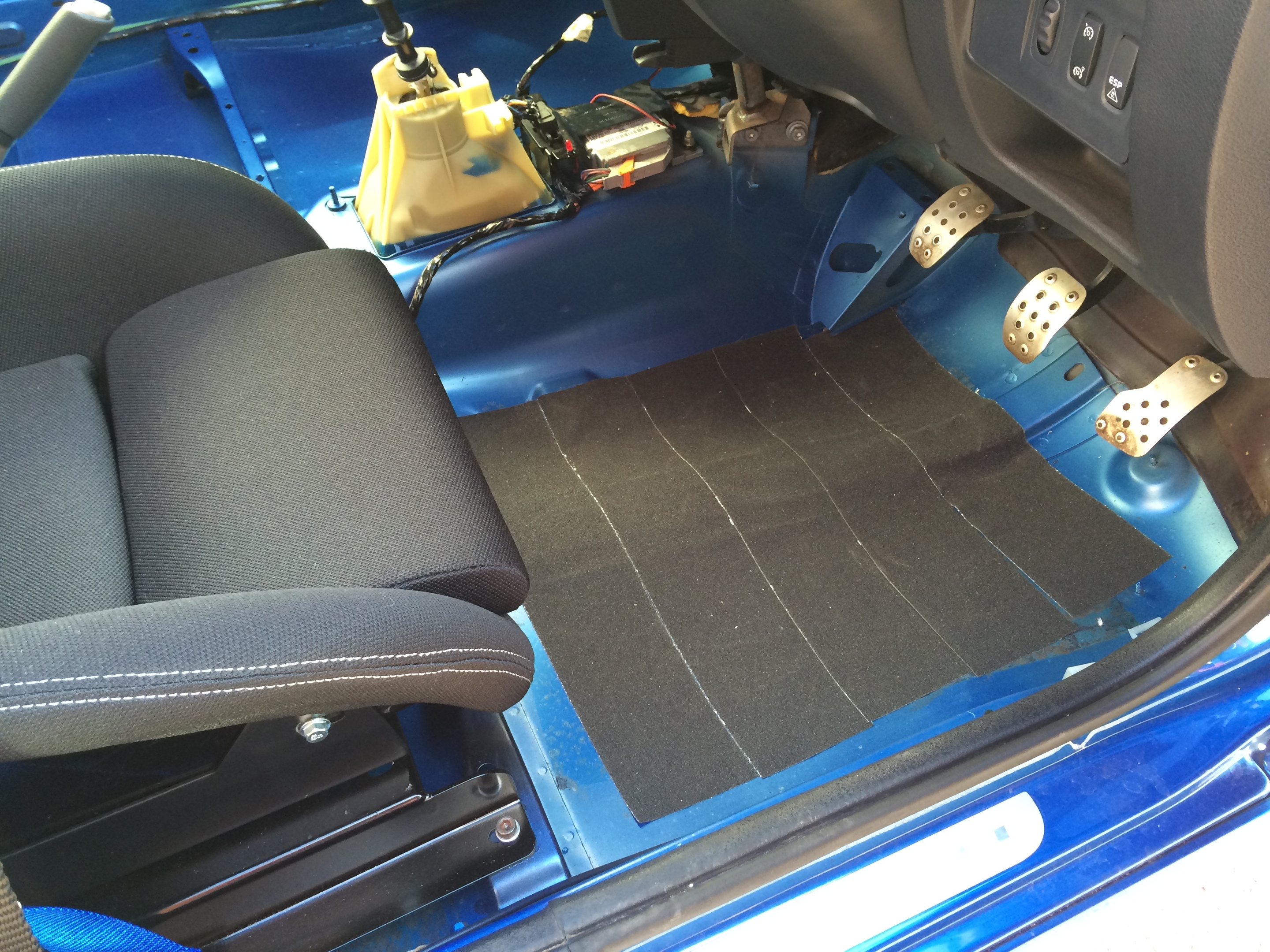

Fitted some eBay special grip tape, doesn't look the best but serves a purpose!
IMG_1263 by danfullstop, on Flickr
Done!
IMG_1264 by danfullstop, on Flickr

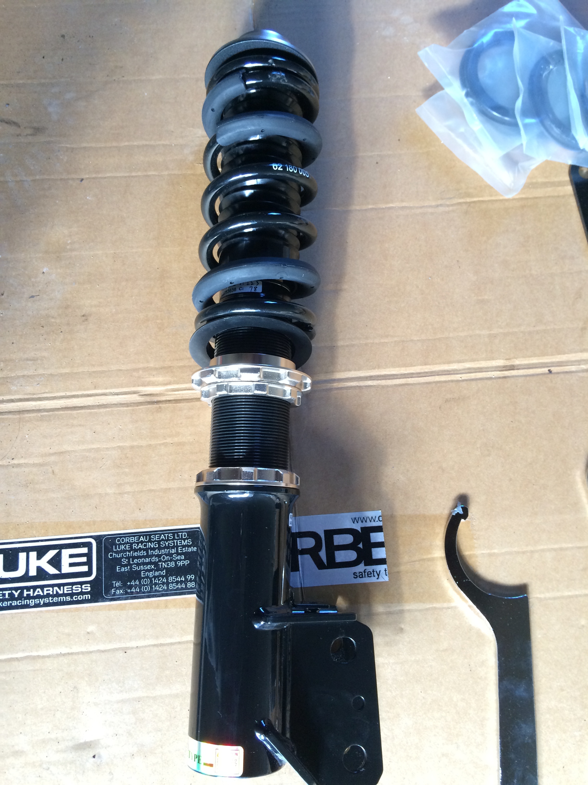

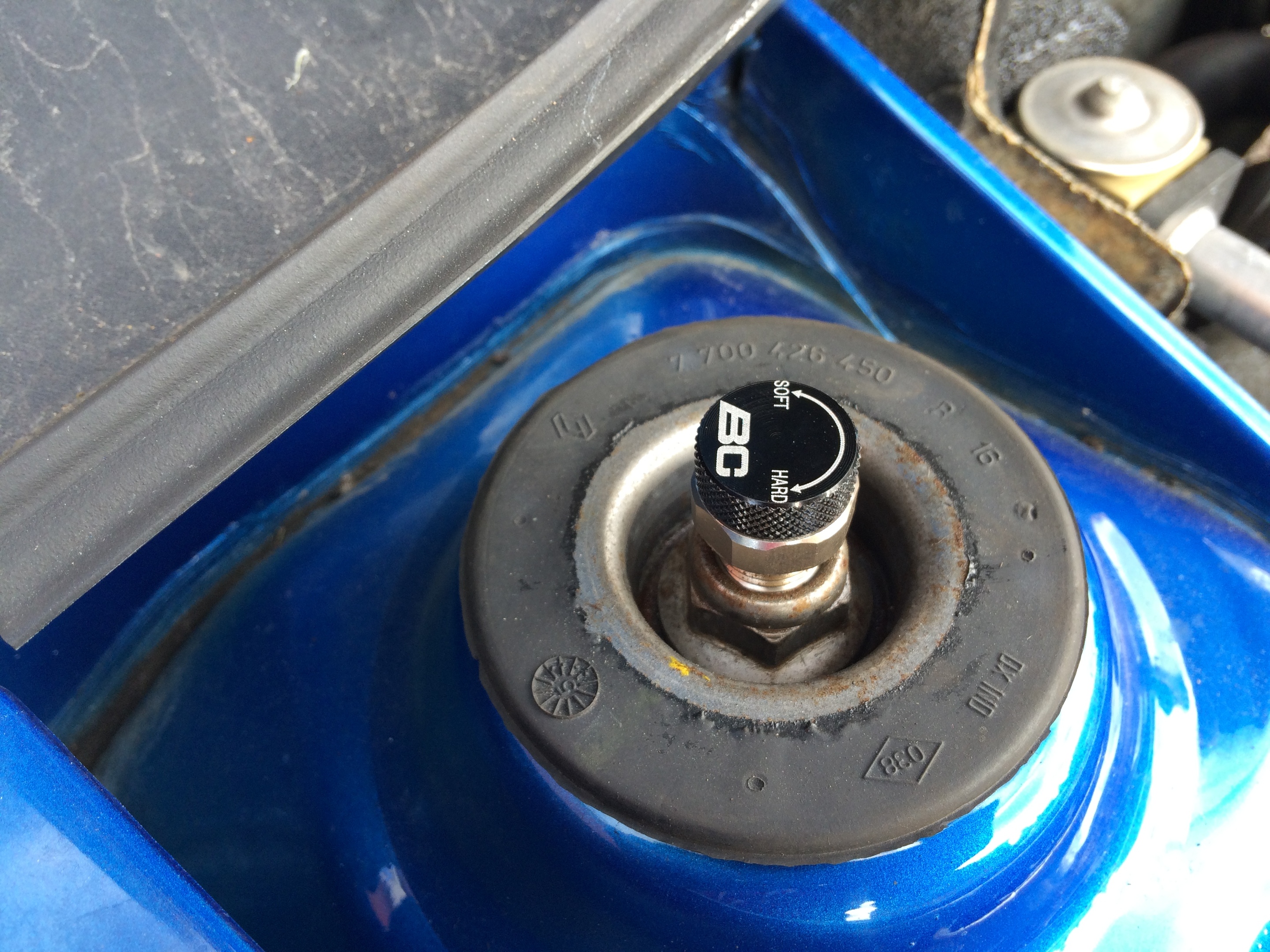

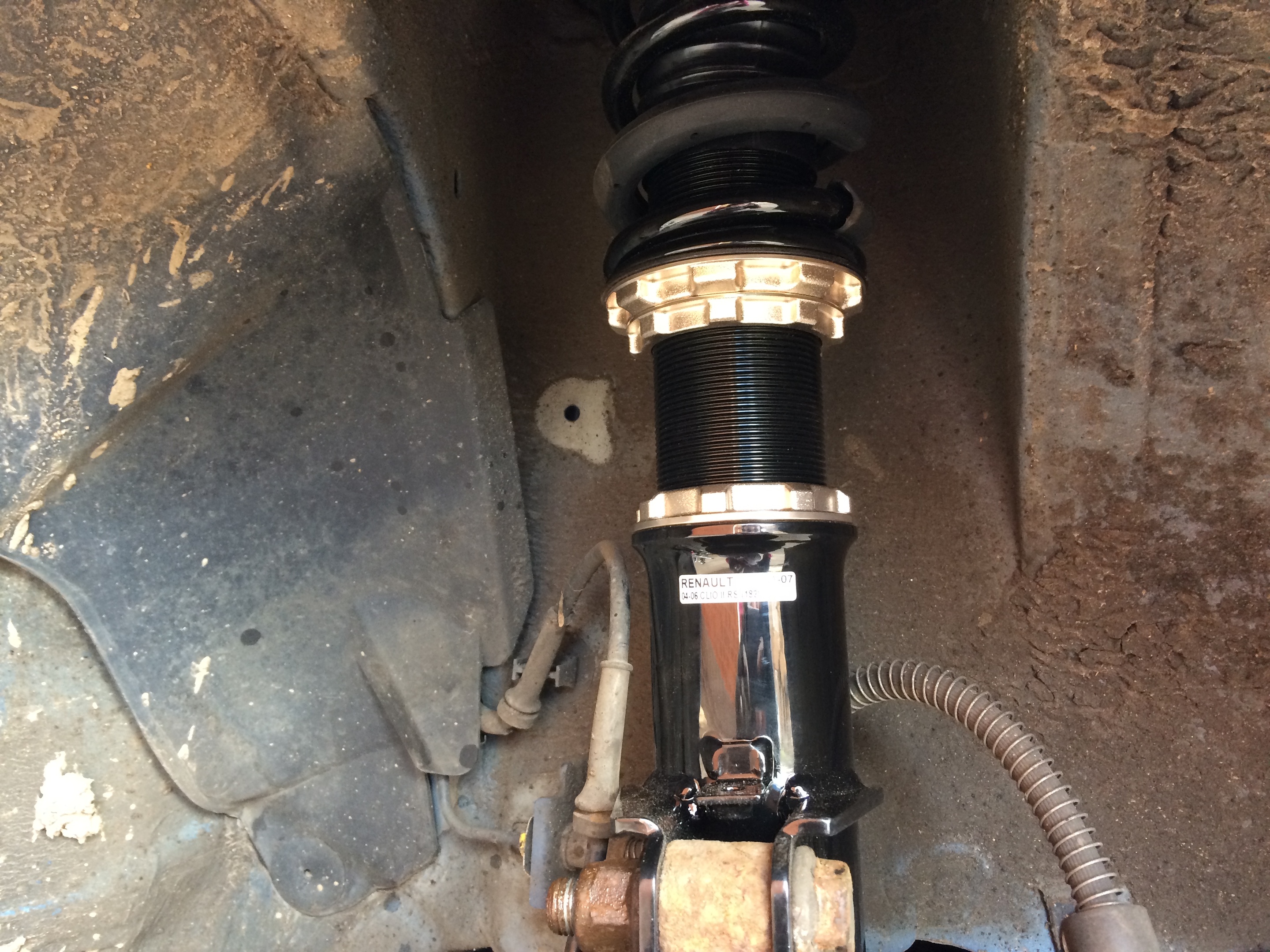

Unboxed and fitted the coilovers:
IMG_1255 by danfullstop, on Flickr
IMG_1256 by danfullstop, on Flickr
IMG_1257 by danfullstop, on Flickr

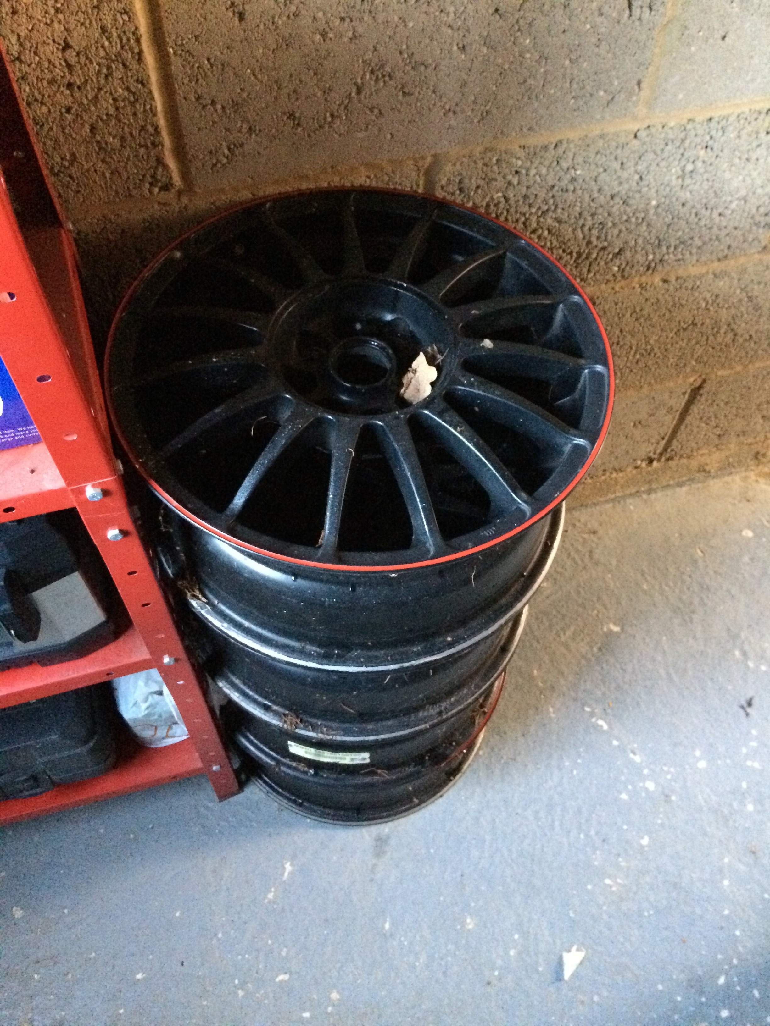

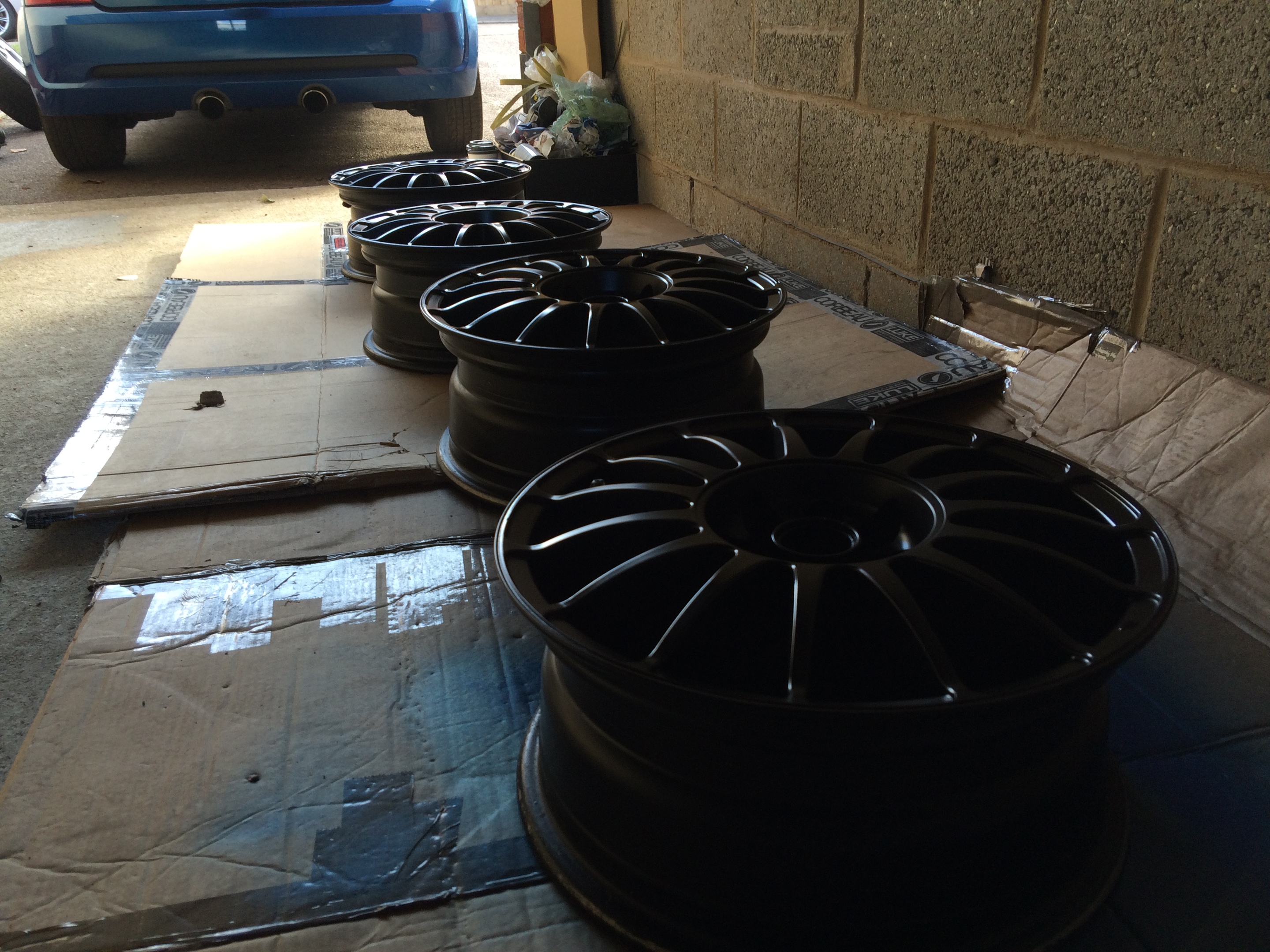

Sprayed the Monza's satin black ready for the RSR's to be fitted today:
IMG_1274 by danfullstop, on Flickr

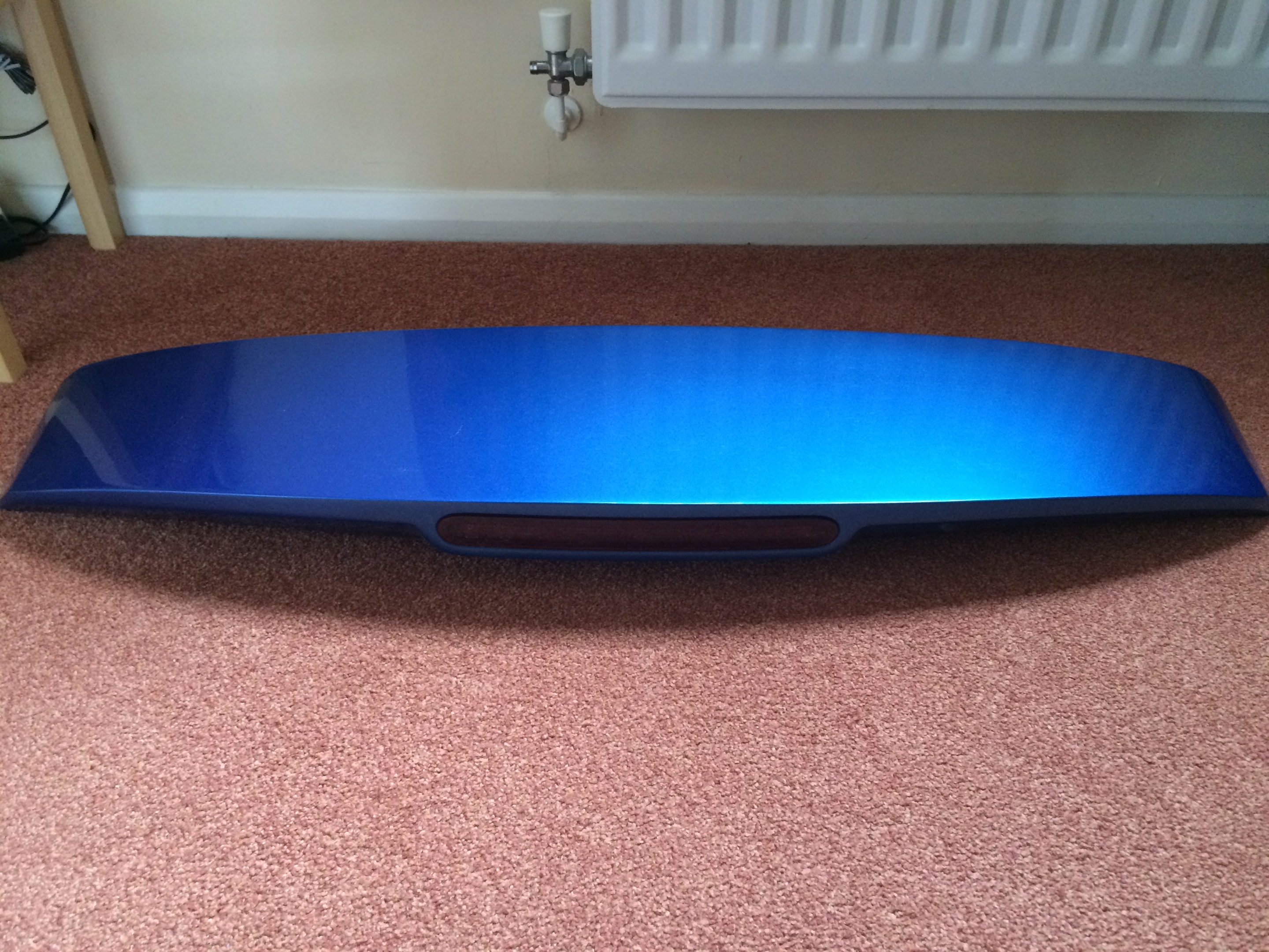

Cup Spoiler is in the post, wasn't going to bother but the rear end looks really strange without one tbh.

Whats up with OMP boss's?
s**t fit compared to the Momo ones, about as good as their subframes lol. Luckily that seem to be able to make harnesses and steering wheels ok
you realise you need a momo one for the 182 becuause of the cruise control bits? I tried to fit an omp one to 182 and it didnt fit, just saying
Greeny.
  440i + 182
Oh right, no didn't realise that, did away with the cruise control bits anyway and it fitted, not fine, but fitted never the less.

Sooo sending the OMP boss back to ybracing, so far they have been very good about it and purchasing a second hand Momo boss off here with the notches! :) Win!
Greeny.
  440i + 182
No pics but sent back the OMP boss and bought a second hand Momo one with the correct lugs on the back for 182's. Re-fitted the OMP wheel using the Momo boss and it was a complete joy compared to the OMP boss, purely due to the hole being a much better size!
