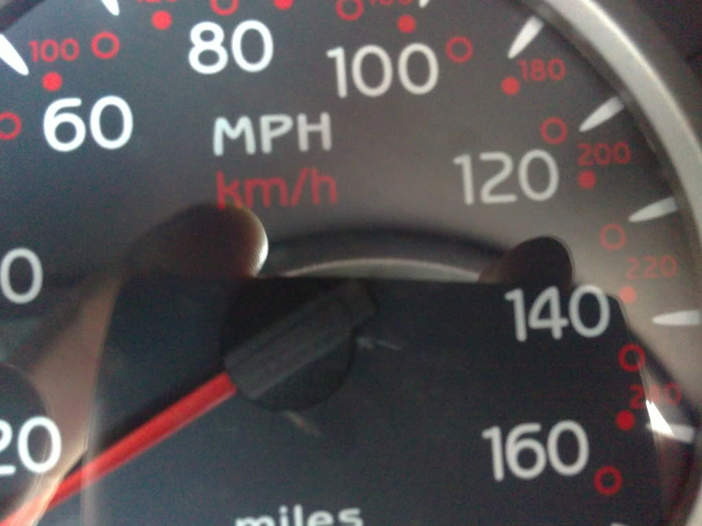

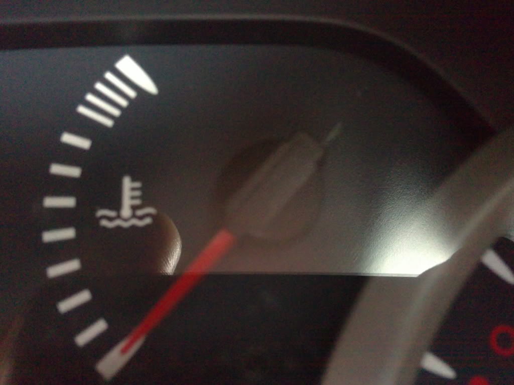

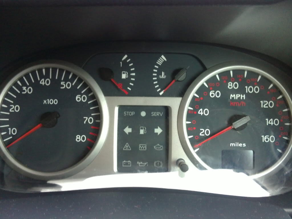

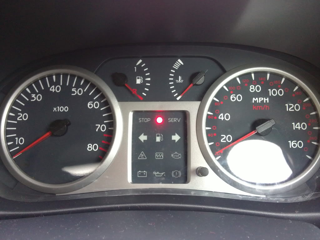

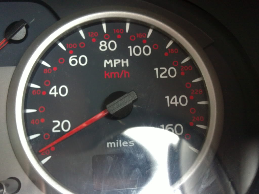

i was thinking about replacing my dials for some lockwood ones, but just out of Curiosity i think mine have been taken off before, they have marks by the needles (as pictured below) as when you take them off with a fork ? or other removing item?
also i was wondering if the needles looked to be sat in the correct position (with the engine off)
when i turn my engine off the needles seem to drop from where they are now,
(below the lowest rev counter mark + onto the bottom of the last speedo mark)
then go back up into this position.... is this correct?
cheers
speedos def wrong. hold the trip computer button and turn ignition on the dials will go crazzy but they stop on 20 40 60 etc n fuel and heater gauge do same
hey mate, just tryed this, and my needles went to 45, 85, 125, and off over 160..... so obviously somone has taken the needle off and replaced it incorrectly?
