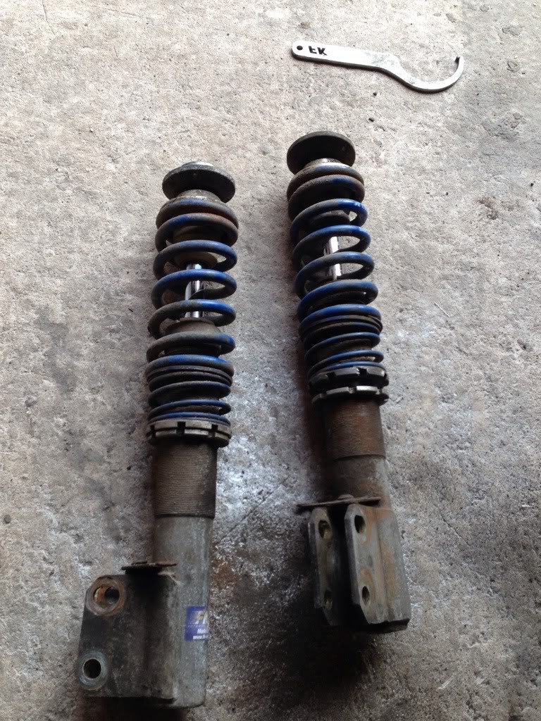

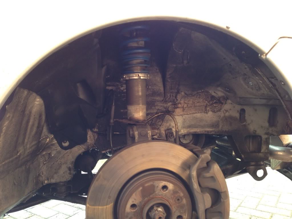

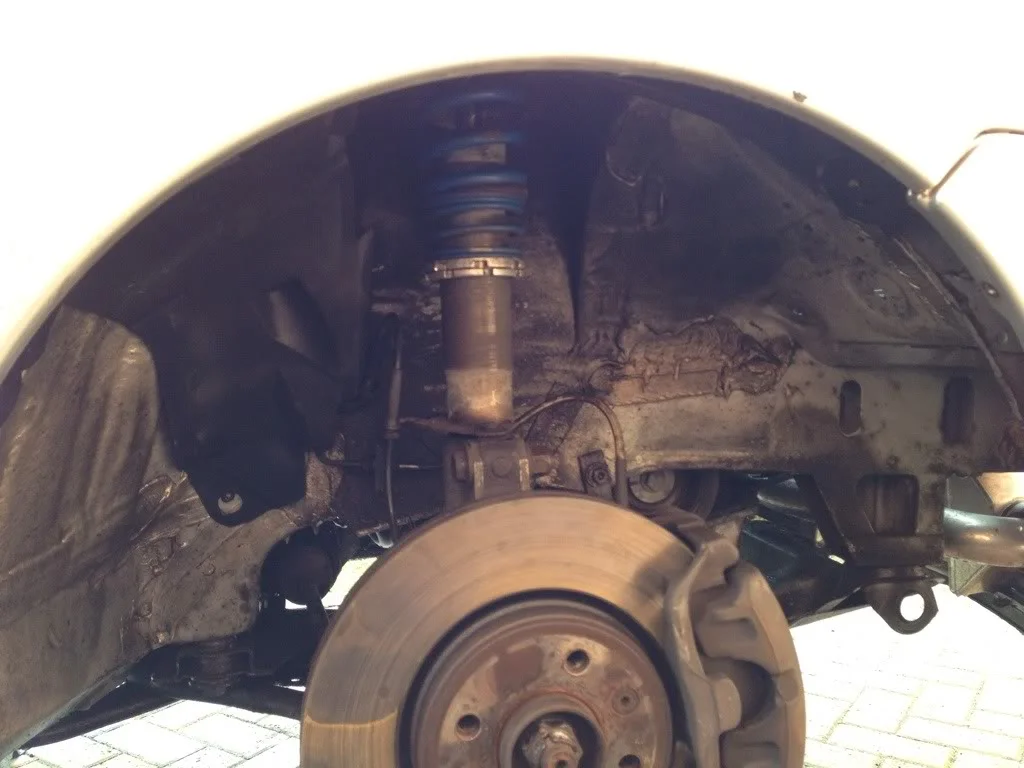

Then onto the coilovers basically they were stiff as s**t and propa struggled to move them
Gave them a propa rub down with wire brush cleaned em all up and I can now move completely free by hand also looks alot cleaner
Chucked the spacers back on aswell and tried setting the camber dunno if did it right (boat level on disk) lol oh well do until get it set up
