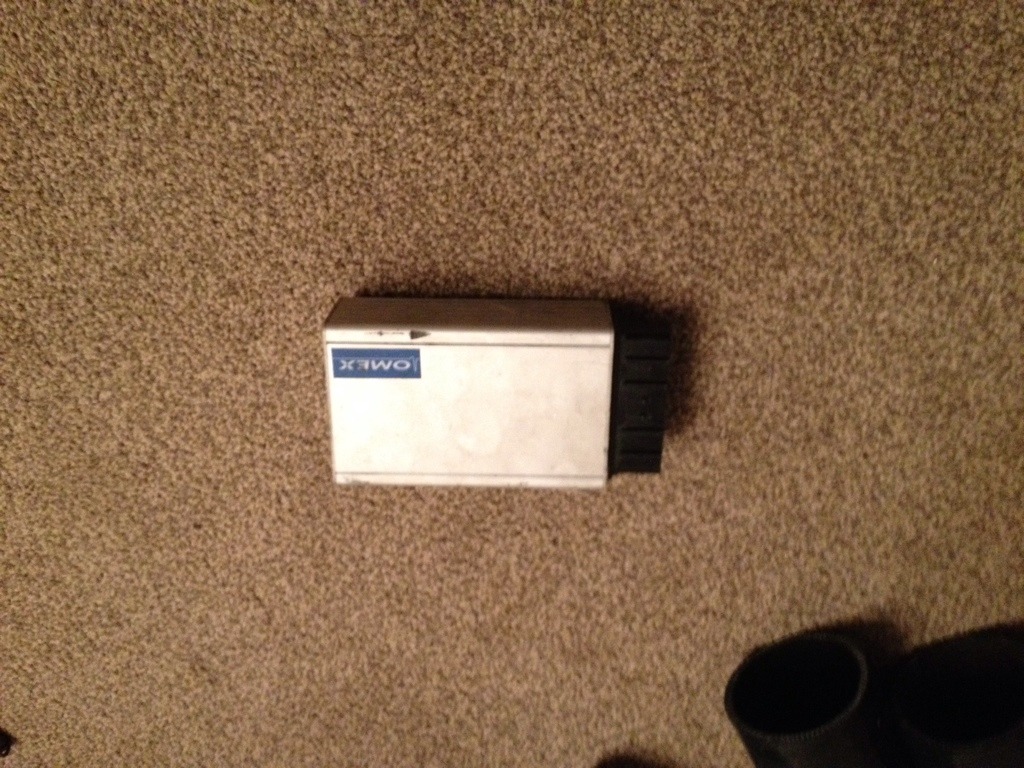

When I was speaking to the guy who's fitting the ecu,wiring loom and mapping the car he asked about if I just want to run the omex or connect it up with standard aswell as I mentioned it cos I'd spoke to a few on here that said about doing it that way..
People's opinions? Run just the omex or tie it in with the standard?
  182/RS2/ Turbo/Mk1
It doesnt really make a big difference, just gives the advantage of stuff like immobiliser still working, wont actually effect how much power it makes or how it drives etc though.
  Ph1 T
Yeah think I will then as I'd still want immobiliser and other bits he said its not a problem either way

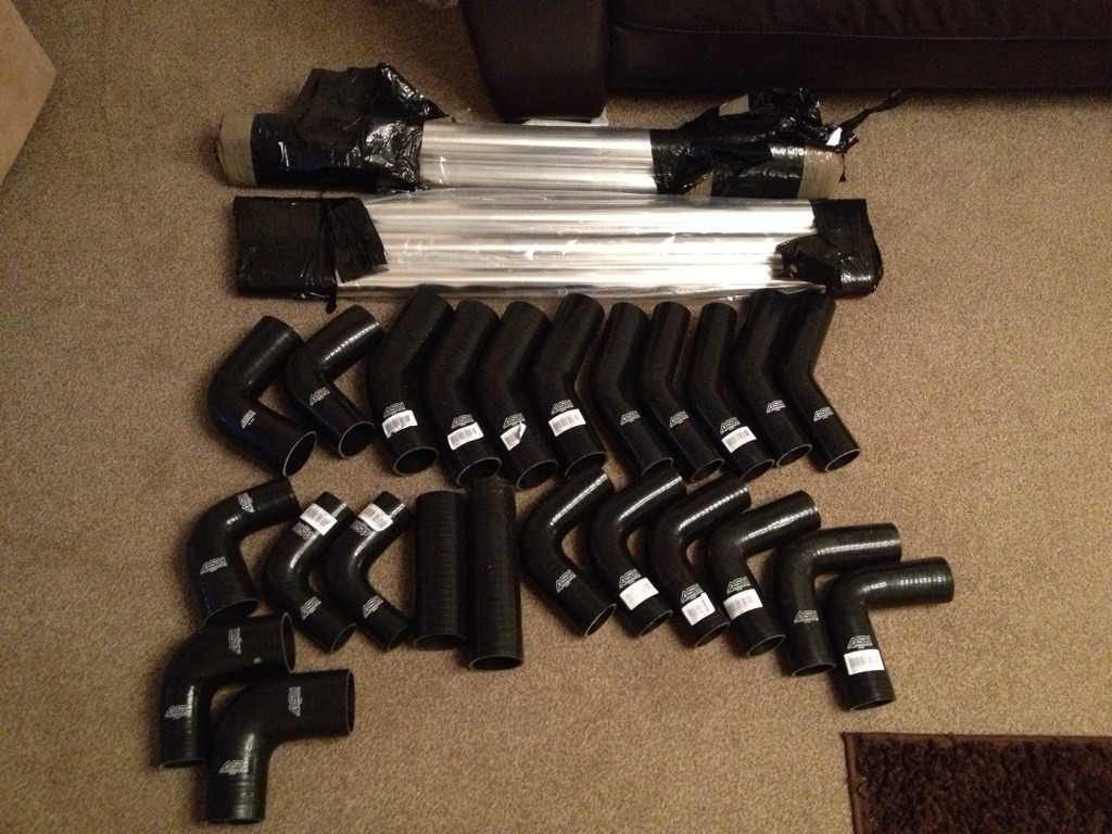

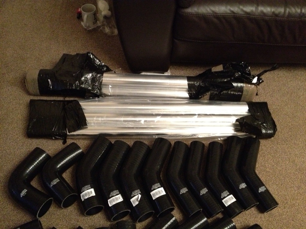

Postman delivered a few bits today
So that's all the hoses and omex 600 ecu delivered..
Not done bad out of ASH to say I only ordered 14 items lol over £400 of bits for £204 steady away

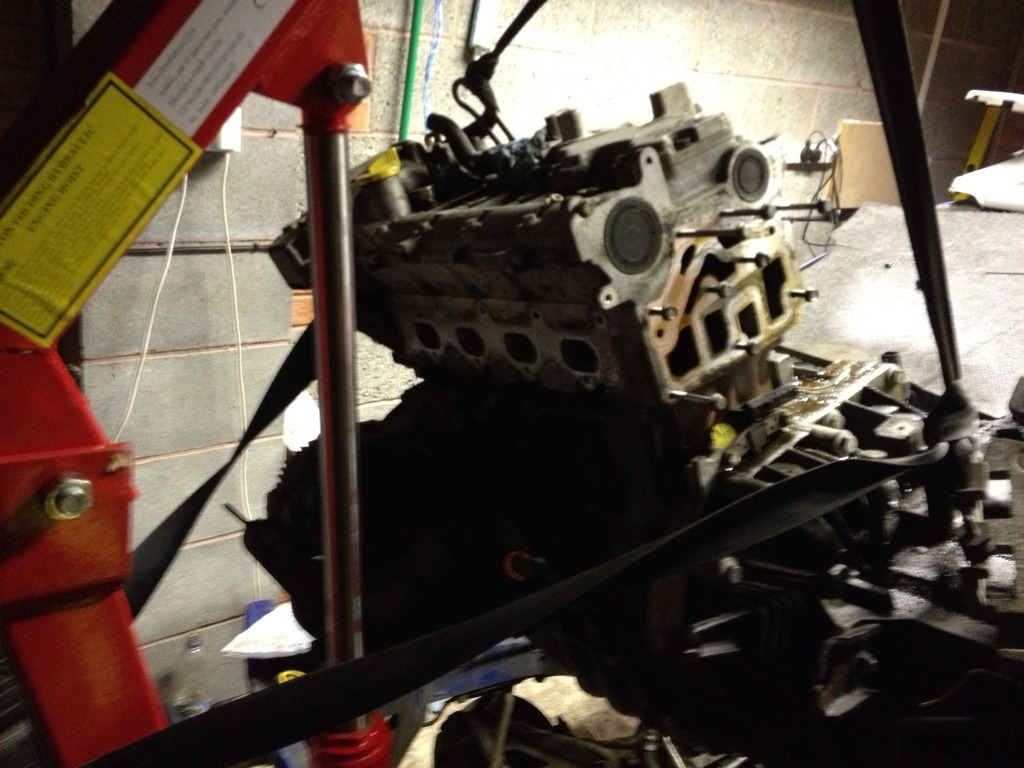

Got a big but done today which means I can get the cup out the garage and the ph1 in finally
Got it all out, didn't realise how much of a tight squeeze it would be.. I'm dredding when I have to out the ph1 turbo engine back in :/ definately going to get a hand for that..
  182/RS2/ Turbo/Mk1
Yeah there really isn't much clearance.
Think I will put my turbo lump back with minus the aux setup as its so easy to fit the cup setup in the car anyway.

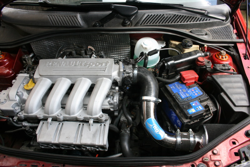

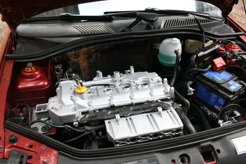

Been thinking of other bits and bobs i could do with getting while im doing all this.. Would it be worth getting uprated engine/gearbox mounts? ive got a polybushed dogbone mount at the min
also would like to freshen the look of the engine up what parts are easy/simple to remove that i could drop of to be powdercoated? or cant they?
Id go for solid mounts simply as i like the way they make the car feel.
As for engine bay, the gear box mounting piece (not the mount), cam cover and inlets could all be powder coated though a coat of silver vht will freshen them up cheaply. If you have already loose the dirty old carpety heat shield and replace it with some nimbus heat shield. Will make a fresh looking bay.
