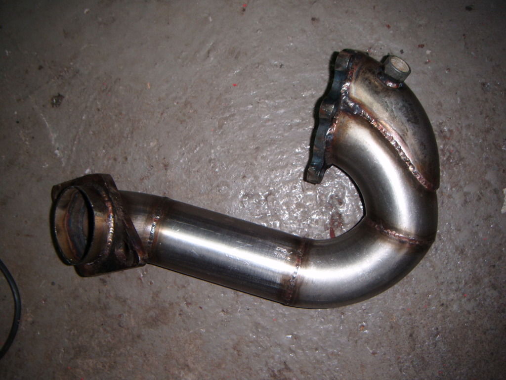

Also noticed today that my downpipe isnt going to match up to my exhaust what so ever stupid of me really for not checking when i first got the parts. Now would i be able to fit my down pipe to turbo end so its coming down under the car then take my straight through bit of exhaust of, take it to be cut to size i need and have the flange (bit where sits/connects upto downpipe) welded onto it? Thats only thing i can think of other than have a new downpipe made but i cant take the car anywhere so imagine that will be difficult...
  172 cup, Impreza P1
Are you going low boost? I have a 2.25" down pipe for Garrett t25/28 turbo if you need one?

yeah going low boost.. id more than likely still be in the situation i am though now wouldnt i if i bought the one you have. still have to get my straight through exhaust piece cut down?

What is your connection like from your down pipe to Decat/cat? Not sure what you mean.
Edit, just checked your pics from earlier on in your thread.
That looks like it is to connect up to a megane 225 link pipe which I have. Is it 2.5"?
Managed to sort the driveshaft nuts towed it to the local garage did them easy..
right from the decat (centre of the car) it joins onto a straight bit that goes upto the manifold. Just undid the straight piece that will be going onto the turbo downpipe and thats 2.25 inch but my turbo downpipe is 2.5inch take it thats another big problem i have :(
could i get my exhaust pipe modified to fit the 2.5" downpipe? as im going to need to get that straight piece cut anyway..
I was thinking fit the downpipe turbo end then see where it comes to and line my exhaust upto it mark where it needs to be and take to fabricators?
Will your cat mate with this?
