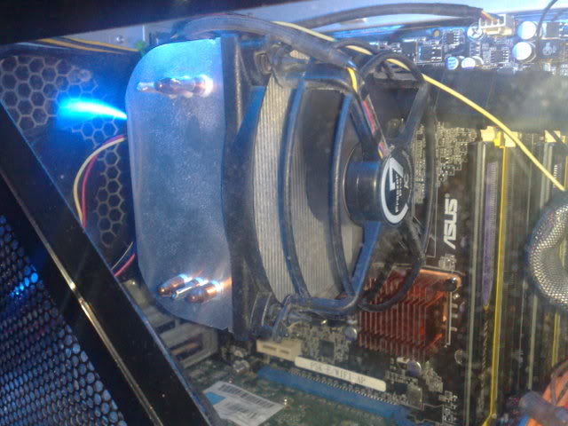

Agree with the cooler above.
With a decent asus motherboard I've managed to easily overclock my q6600 to 3.6ghz and even up to 3.8ghz with that cooler.
Also had my 667 ram to over 800 mhz. Corsair xms2 ram, very good.

3.8 on air cooling...seems a bit unlikely. Your temperatures must be through the roof.

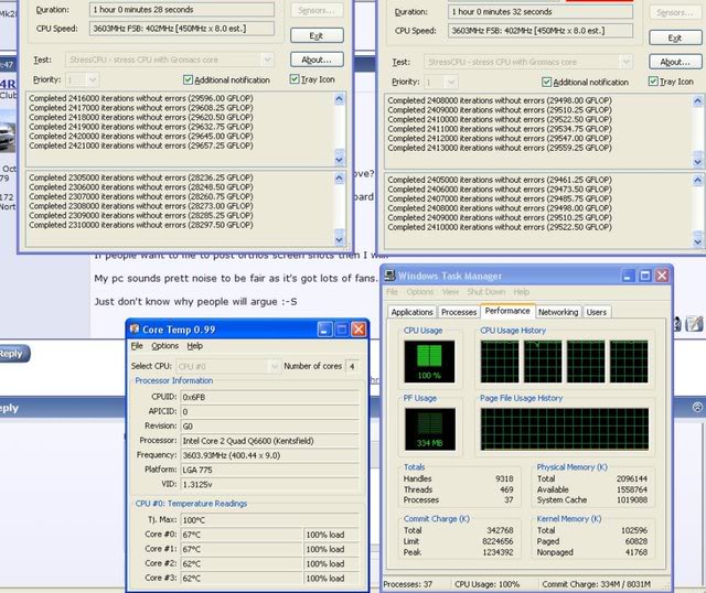

Unlikely?
Using Orthos at 100% stress gives 55 degC with the Freezer Pro.

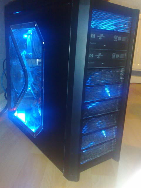

My case is an Antec 900 with front, rear, side and top fans.
I leave it at 3.6ghz for maximum stability.

Doubting that myself sorry, that's not running all cores at 100% otherwise you'd have hit a thermal scaling point. I'm liquid cooling mine (3x120mm rad) and at 4ghz on as low a voltage I can get away with it's running a load temp of 65 degrees...

Why do people want to argue. What have I got to prove?
I had it up to 3.8 stably before I flashed the motherboard to newer version. I can't get it quite that far now strangey but its sat at 3.6 since March. Stable.
I play COD4 for hours without any problems.
If people want to me to post orthos screen shots then I will!
My pc sounds prett noise to be fair as it's got lots of fans.

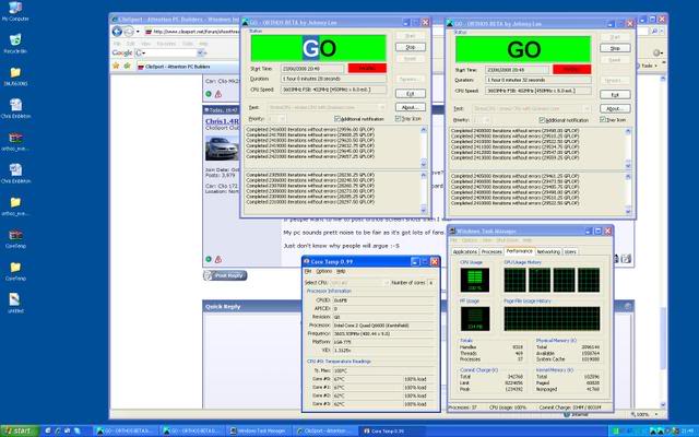

Hang on jpeg is a little small. I'll see if I can enlarge.
  ex Clio 172 owner :(
Granted 67 degC isn't exactly ideal but I've never had problems.
Full system:
Antec 900 case with addtional side fan.
OCZ Stealthxstream550 psu
ASUS PK-5E WIFI
Q6600 @ 3.6Ghz on ac7
Corsair xms2 667 @ 801 Mhz
eVGA 8800GT SSC @ 701mhz stock
2x Raptor 74gb in Raid0
2x Seagate 80gb in Raid1
2x Lightscribe HP dvdrw
Creative 5.1 digital sound
Leadtek tv2000 expert.

Mate you are running it at that temp with that voltage, youve knocked a multipier off and put a 450mhz FSB!! Enjoy that CPU while it lasts thats all I will say!
Stupid?
The Orthos program just estimates how you got the clock speed so the 450Mhz x 8 above is wrong. You're going to have to take my word that my motherboard is set to 400Mhz x 9. I haven't over volted anything either.
