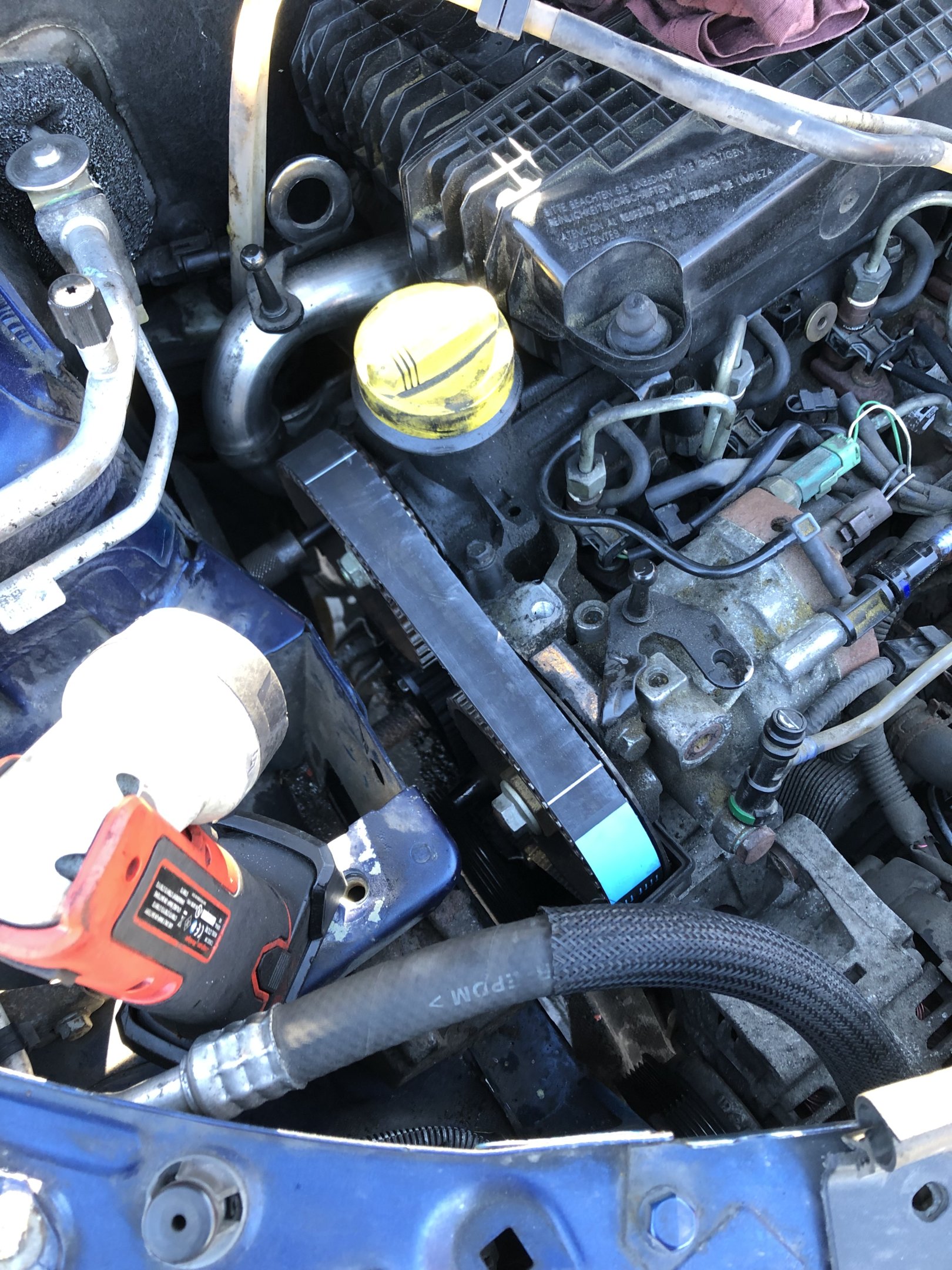

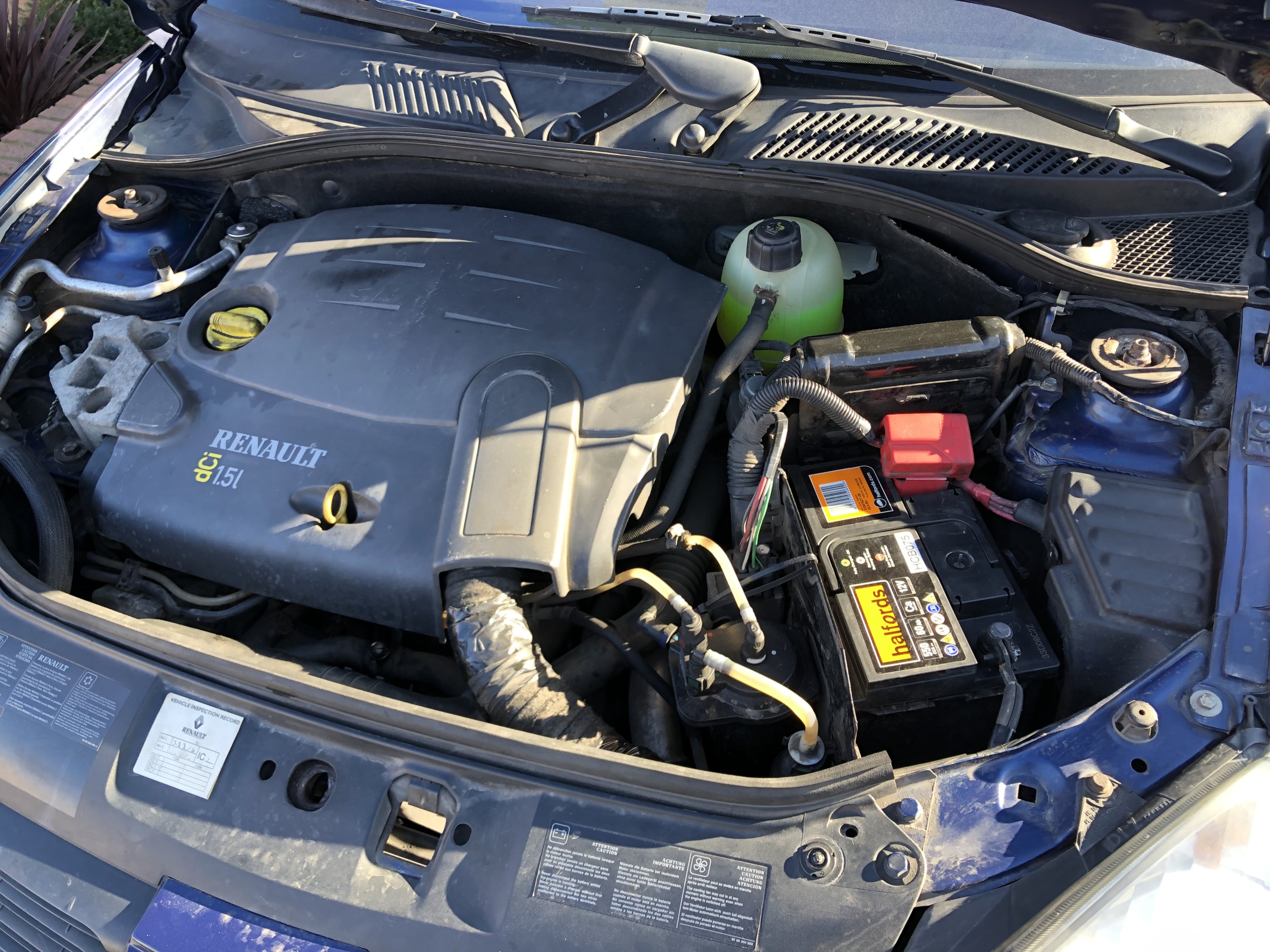

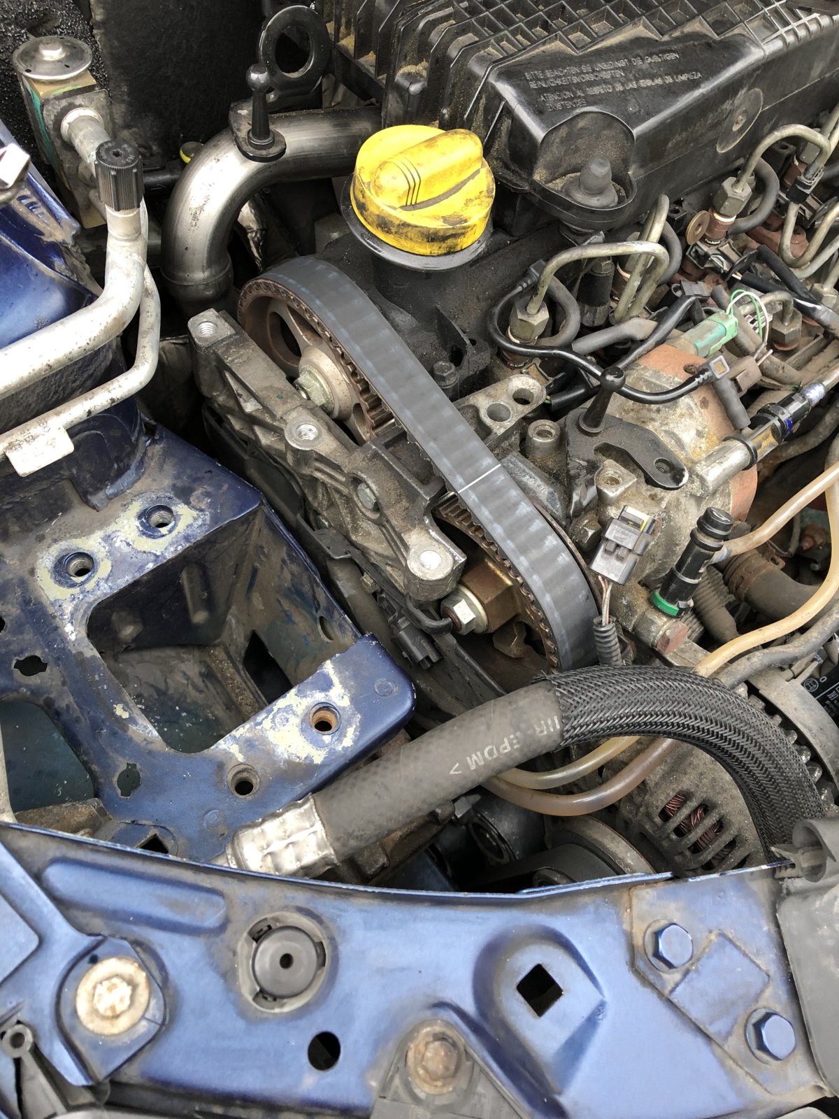

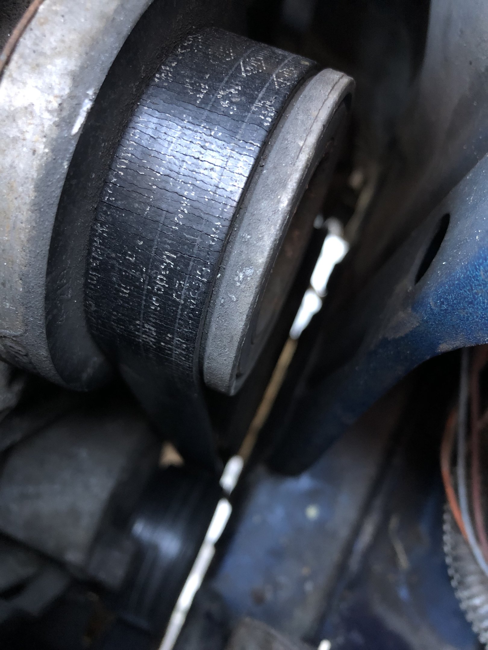

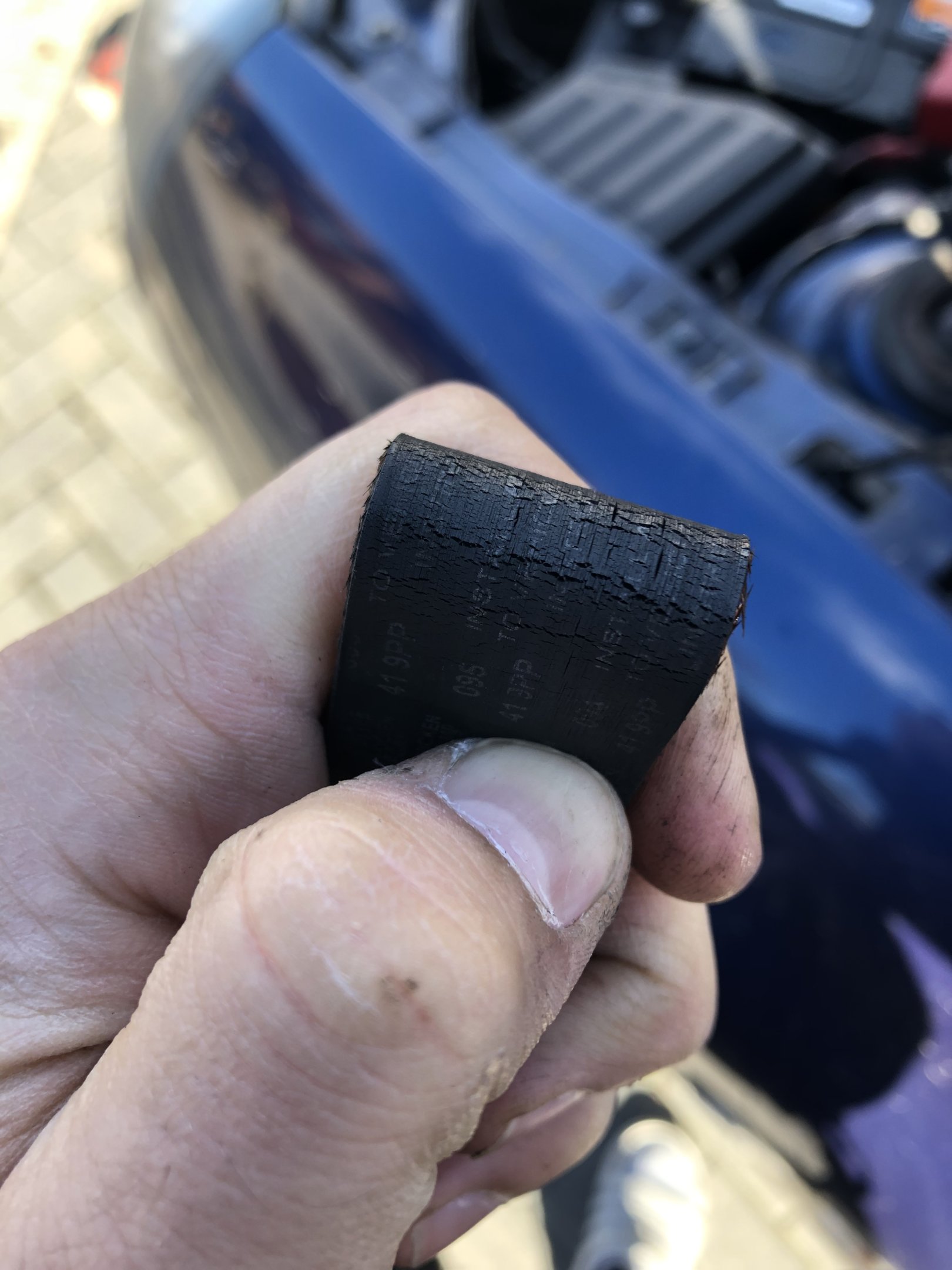

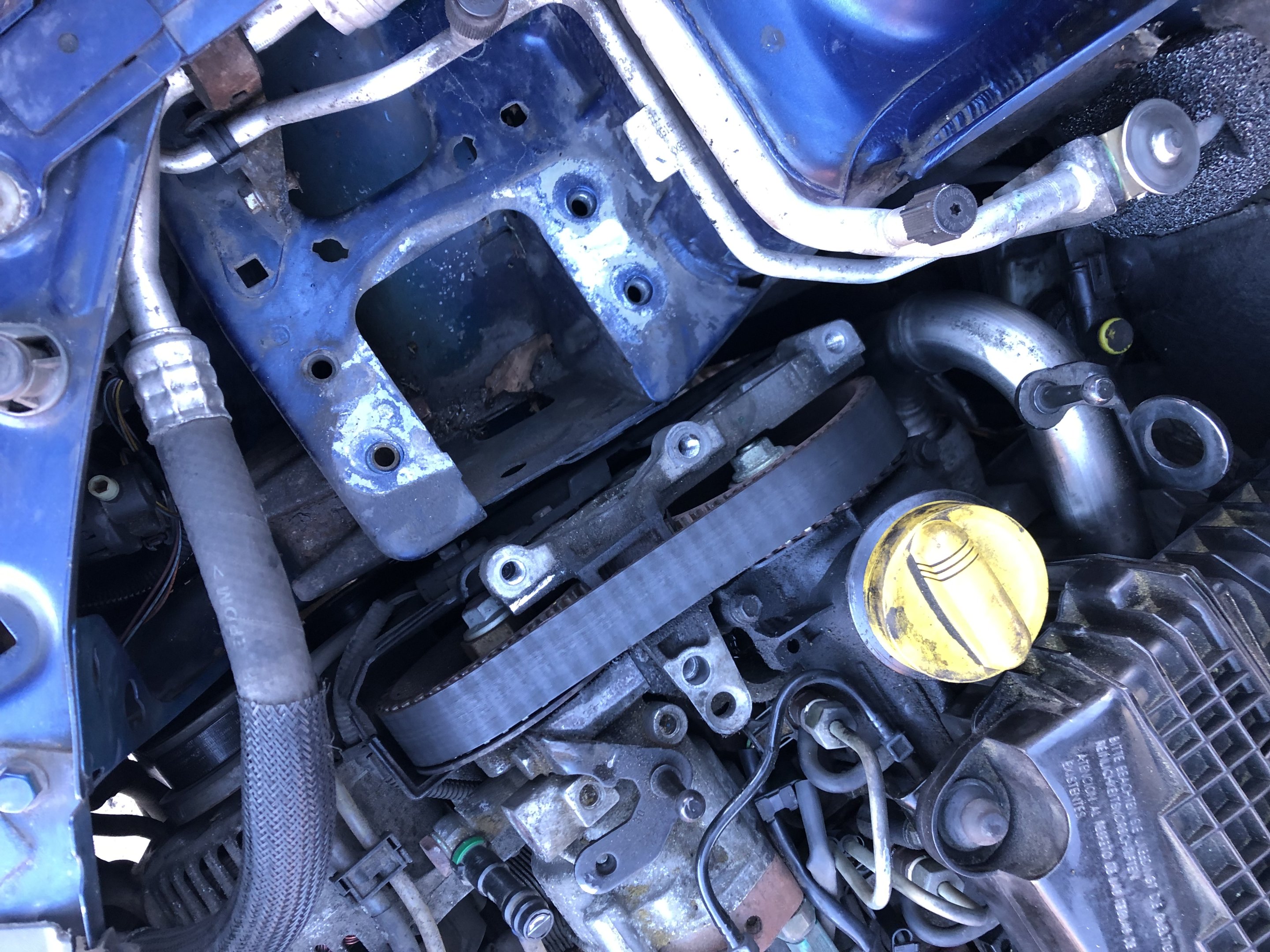

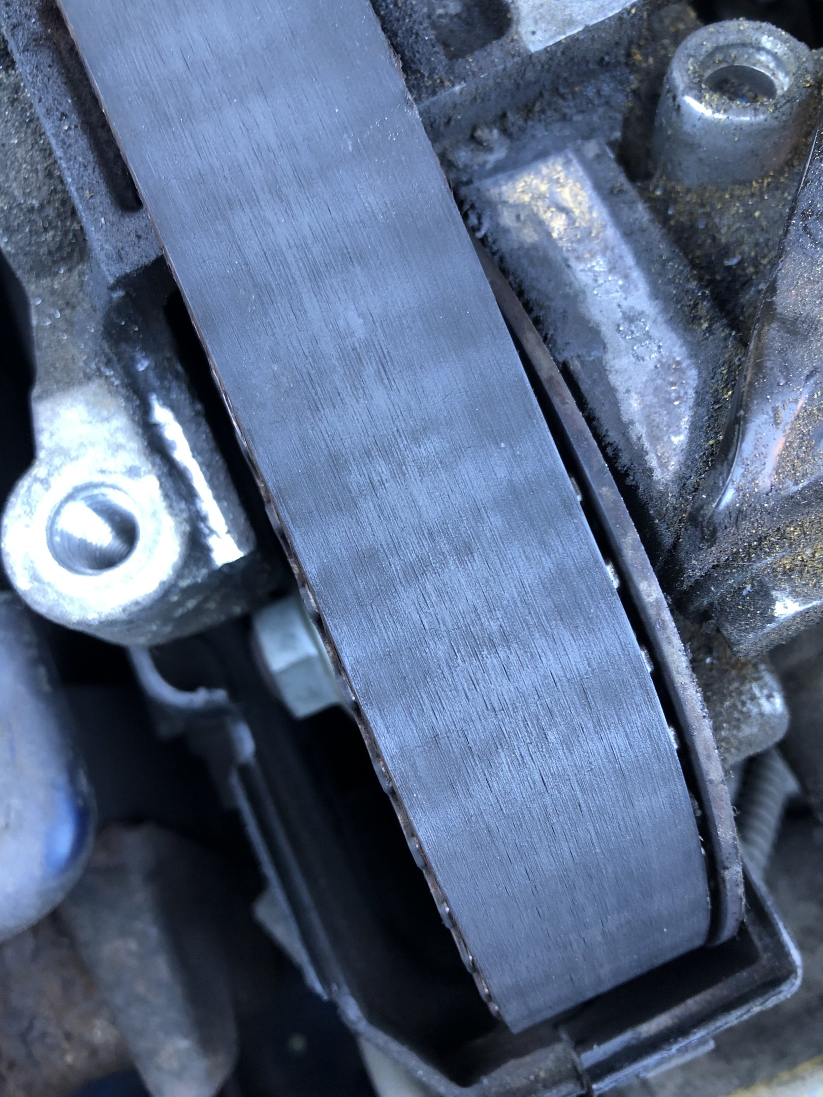

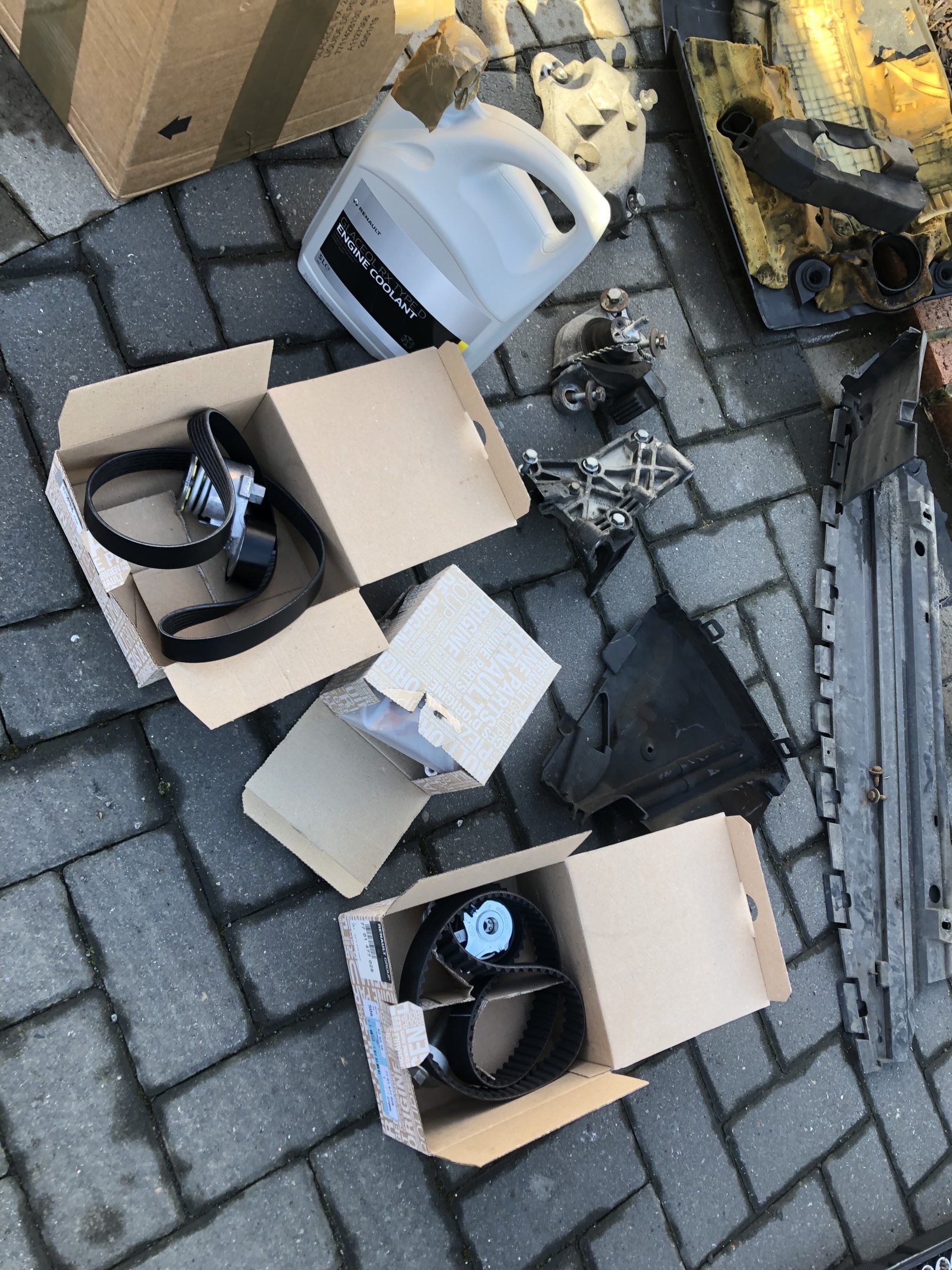

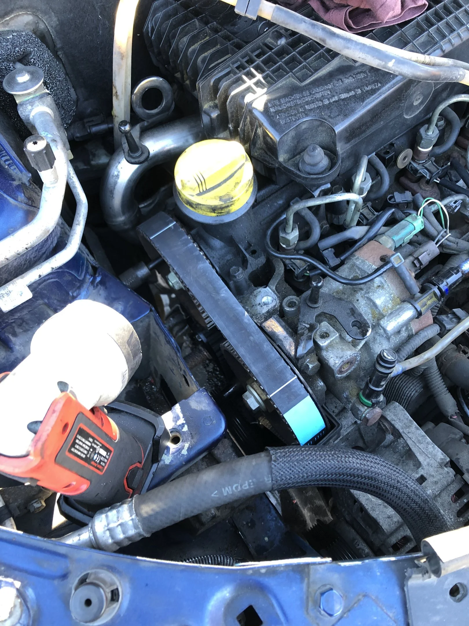

Cambelt day. Thanks to @geordie for coming and helping me with it (doing it)
I watched the youtube video quite a few times so managed to strip the bay down myself ready for Geordie to work his magic.

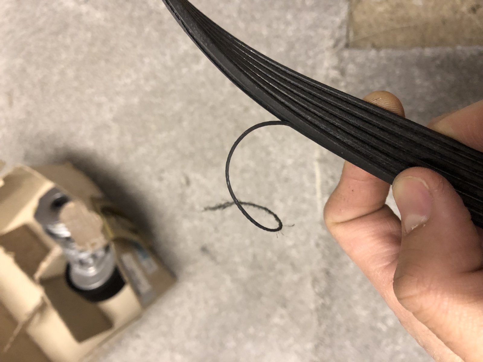

Both belts were cracked and look like they were probably well overdue the change.
1409453
1409454
1409455
1409457
1409456
1409458
1409460
1409459
Fantastic news ??? any insight to how you thought it went? Straight forward?
Really straight forward mate! Once the timing tool pins are in place, you cant go wrong! Its just a case of tensioner off, belt off then put the new belt and tensioner back on. Just under 2 hours to do.
Not a bad job at all the dci cambelt. Ive got to do mine again as the fecking crank seal has started leaking at the pulley end, pain in the arse

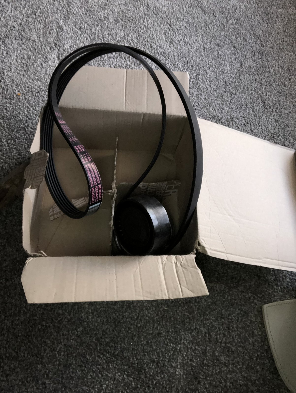

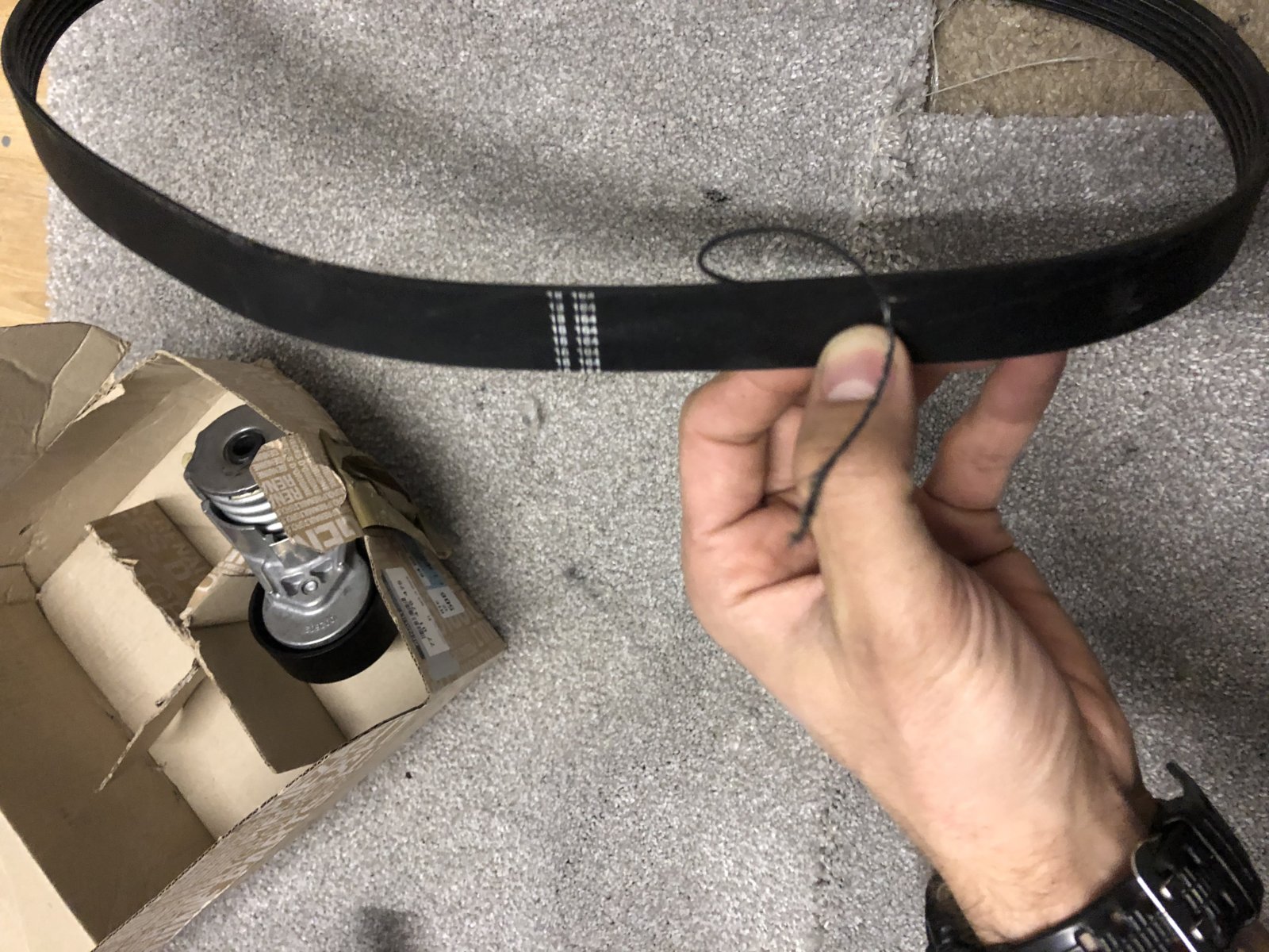

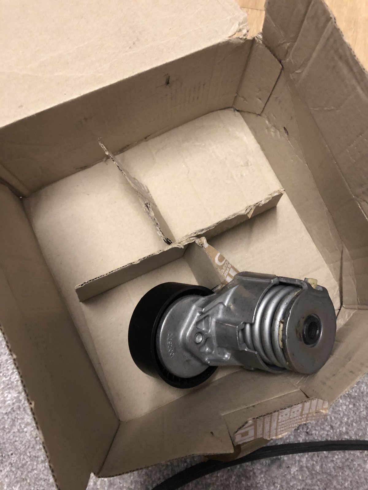

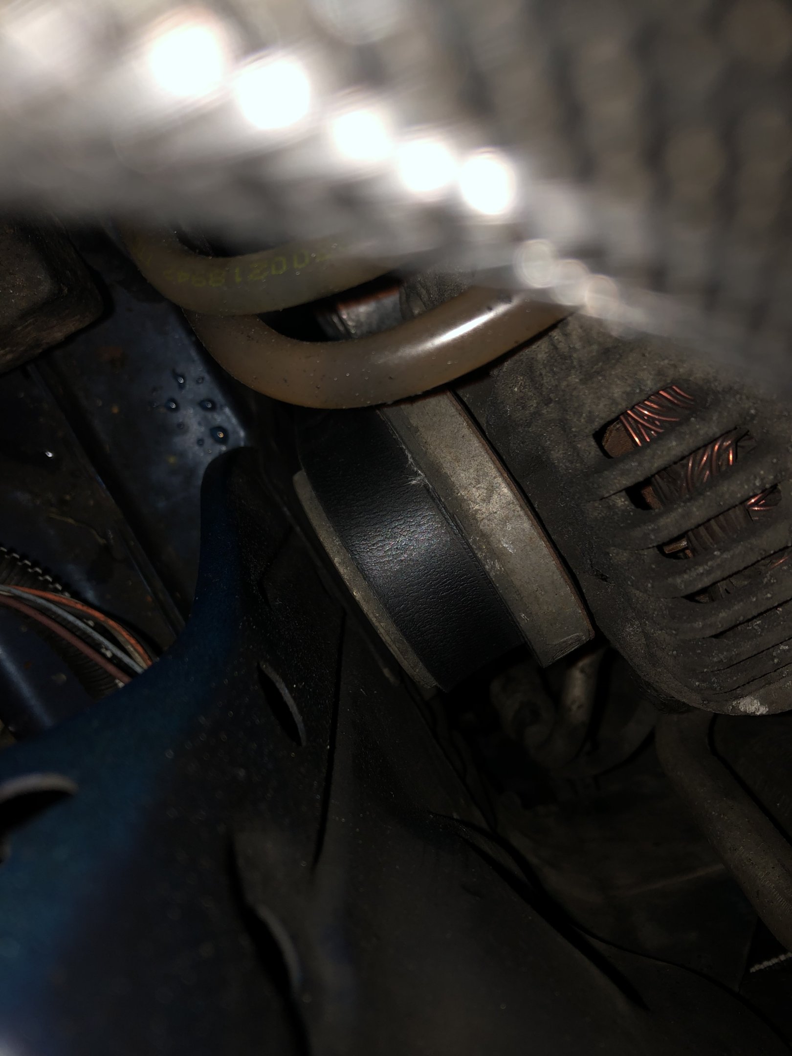

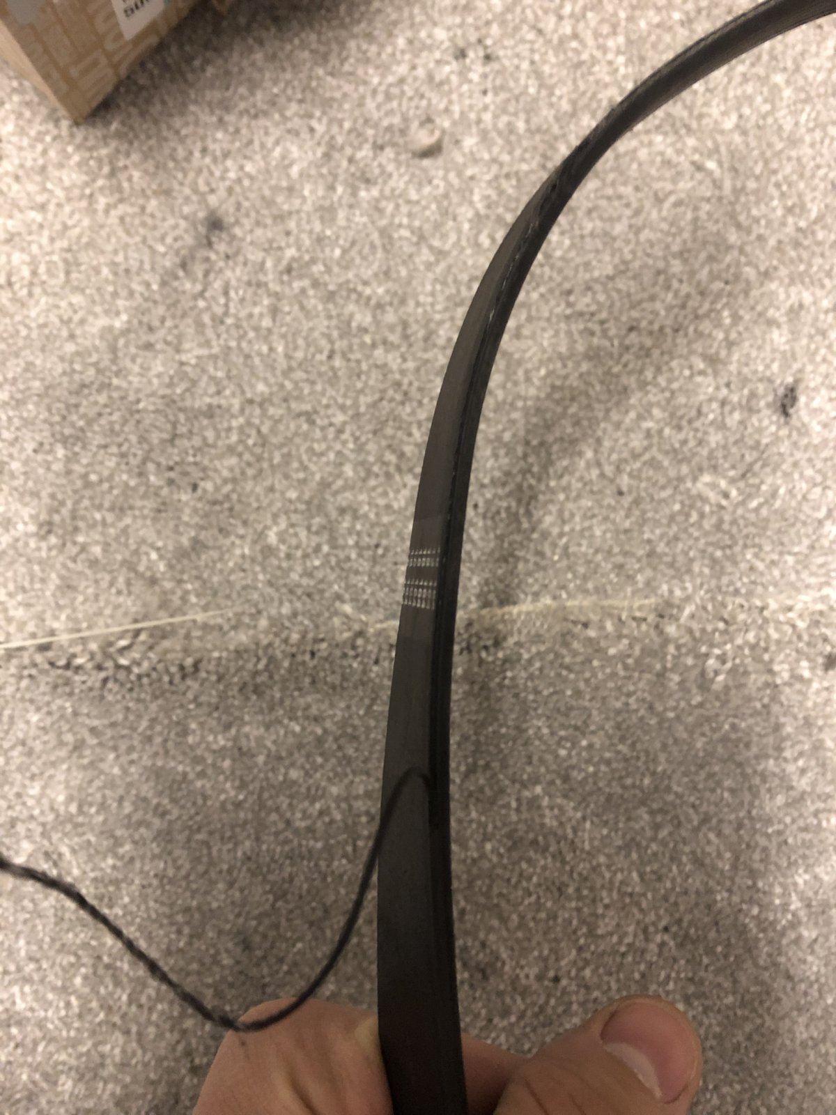

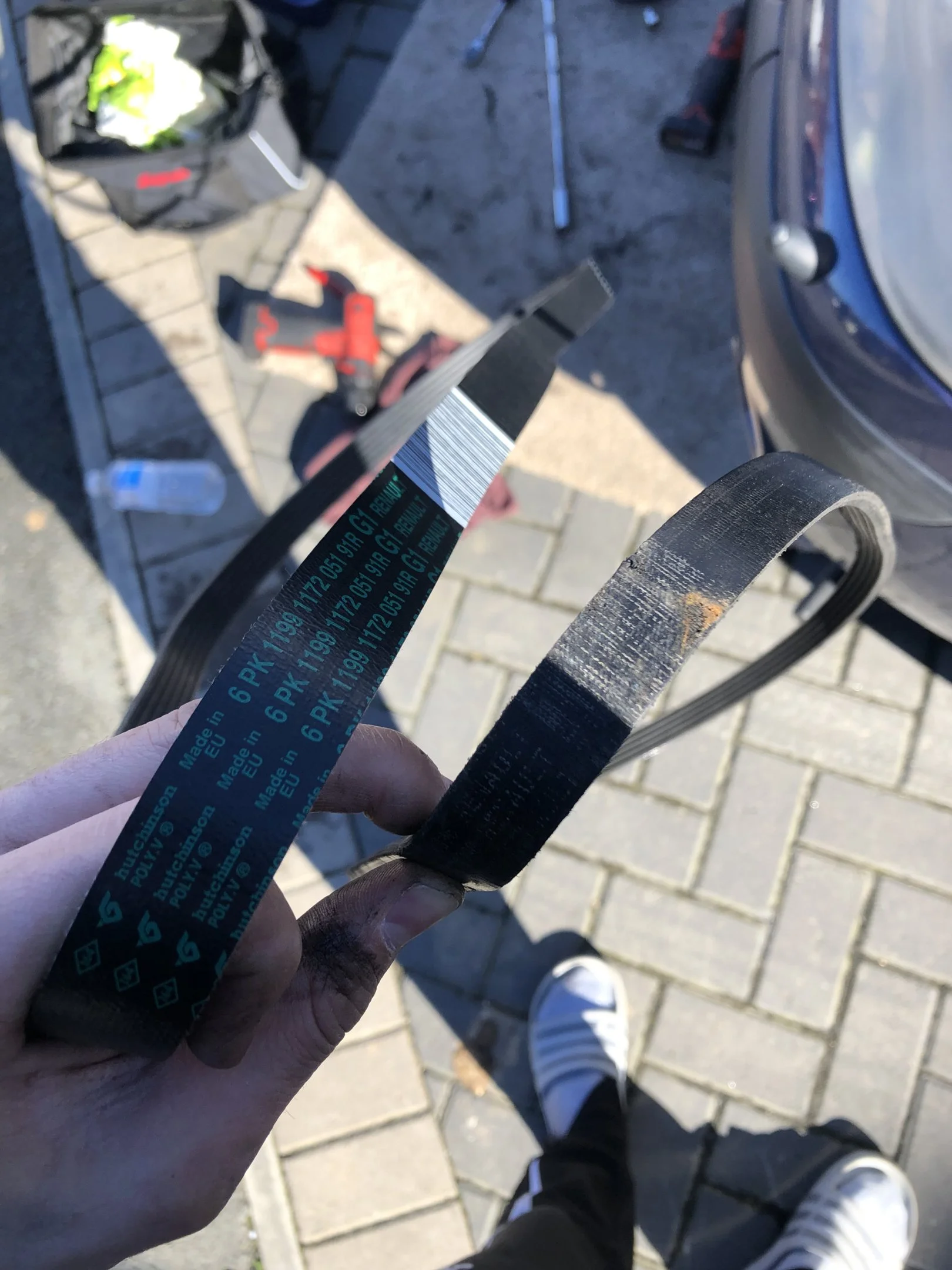

Mine has to come apart again too! Getting a chirp from the belt and after investigation, it appears i have been sent the wrong alternator belt kit! The old one was a 5rib and the new one is 6rib. When looking up the part number it shows it is for a k9k from a meganne 2008 onwards!
@gez 172 make sure you get the right one and check before you fit it lol!
Renault Wolverhampton sent me a replacement kit out in the post. They said my car lists 3 different belt kits which is what caused the problem.
My advice for fellow dci’ers is check if your alt belt is 5 or 6 rib before ordering to ensure you get the right kit.
They thought the tensioner would be fine but sent a full new kit just to be safe. Funny thing is the 1st one they sent with he 6 rib looks identical to the original from the car and the newest one they have sent with the 5 rib looks slightly different ??‍♂️
All 3 have different part numbers on them but when searching online they all seem to be the right one for it. The new one was fitted anyway as that was supposedly the correct one for the 5rib belt.
1410178
I feel quite lucky that I figured out there was a probem straight away from the chirping noise being caused as if there wasnt any noise I would have assumed everything was fine and the belt could have ended snapping.

if any dci’ers need a tensioner let me know and you can have this spare I now have as Renault didnt want it back.
The car is now running without any unwanted chirping / screeching noises from the alt belt ??

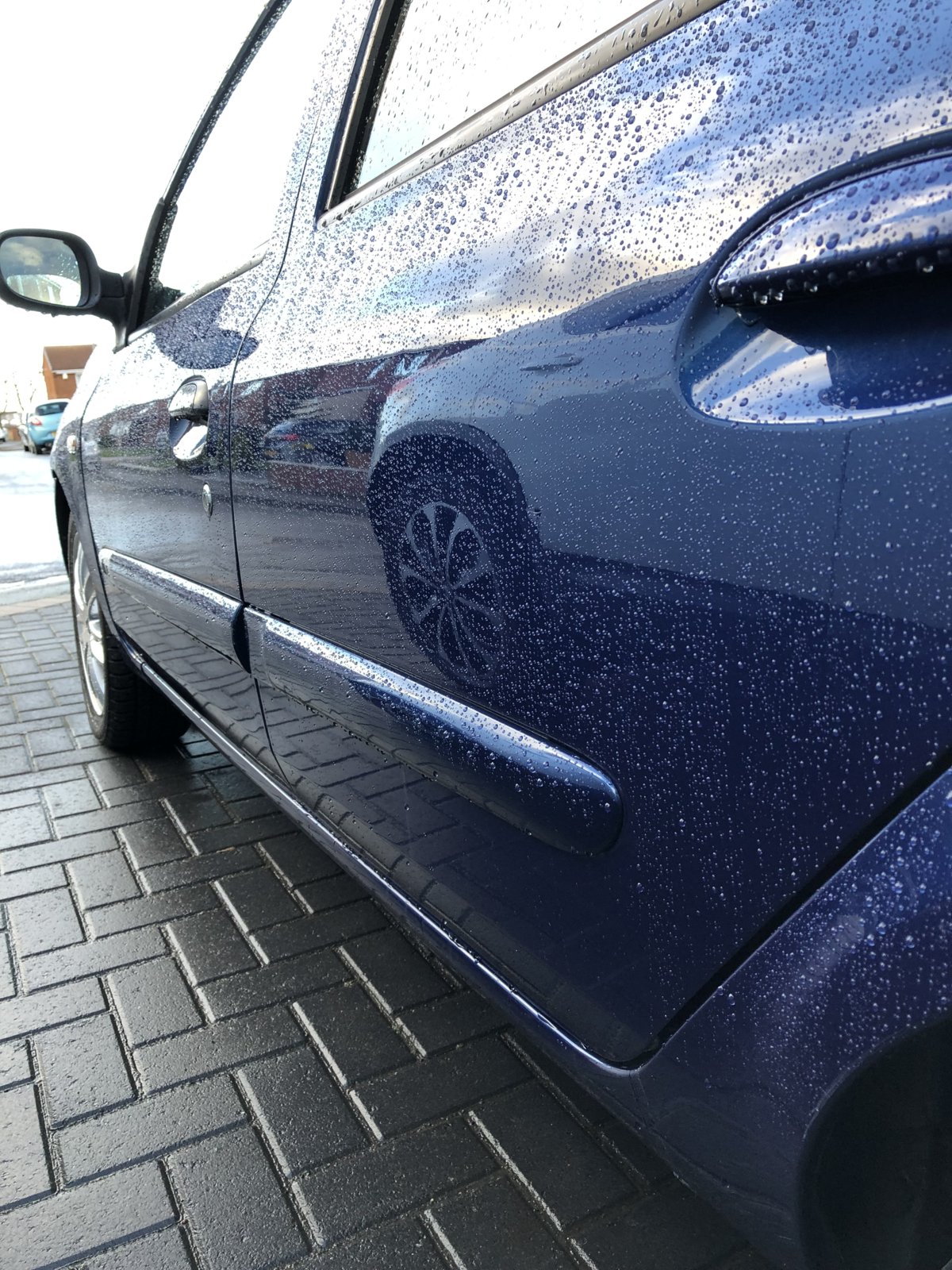

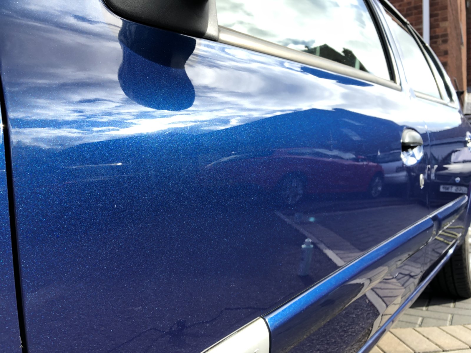

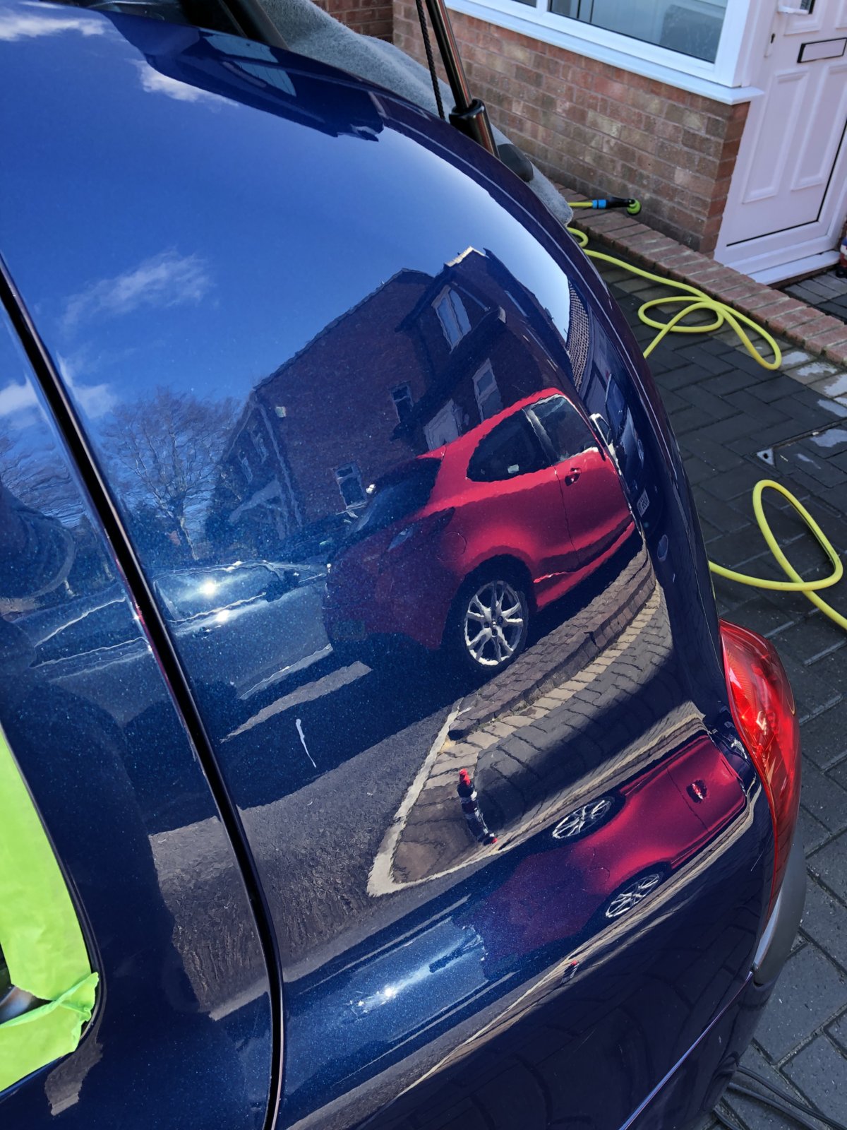

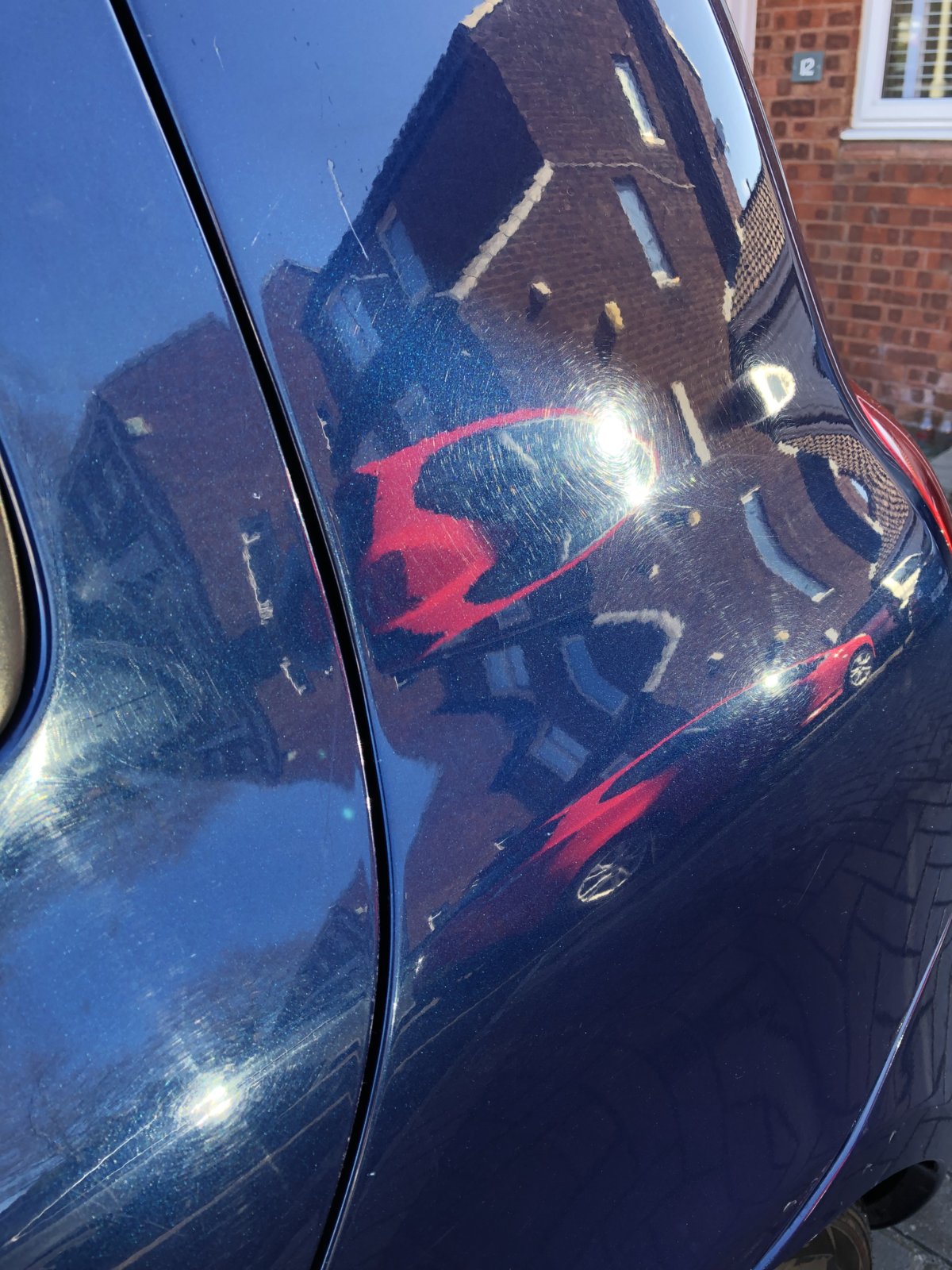

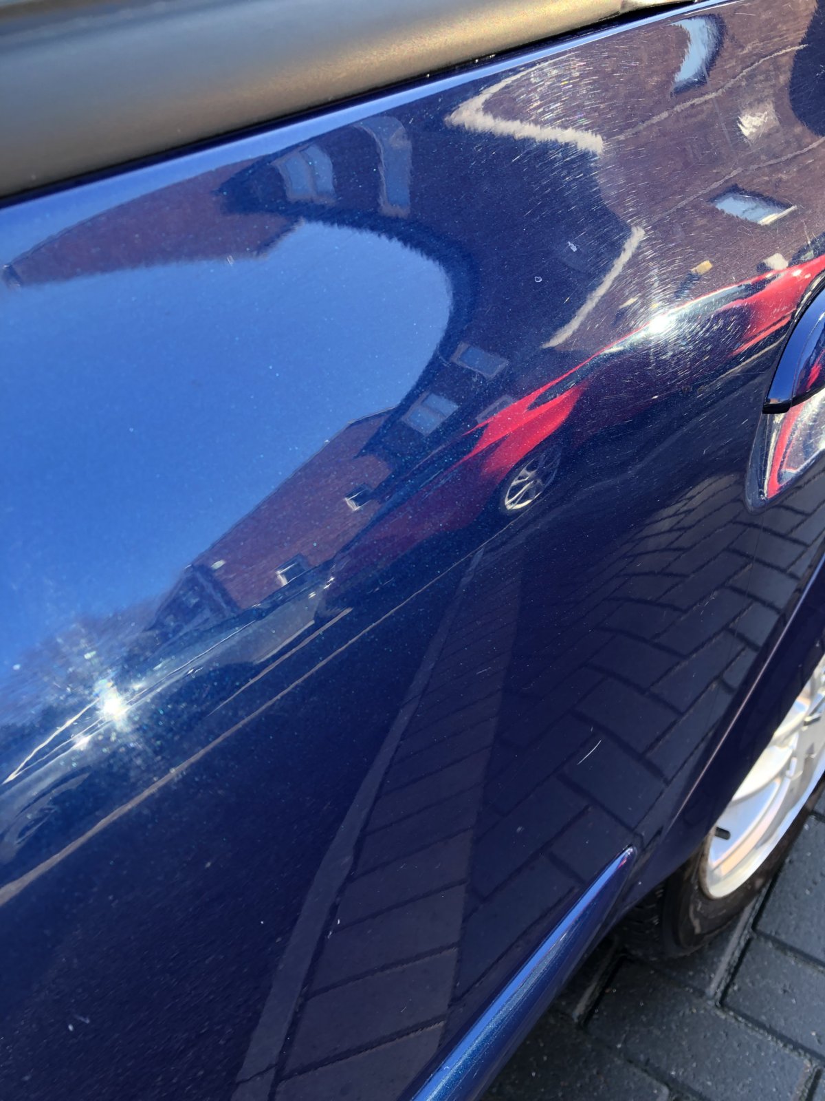

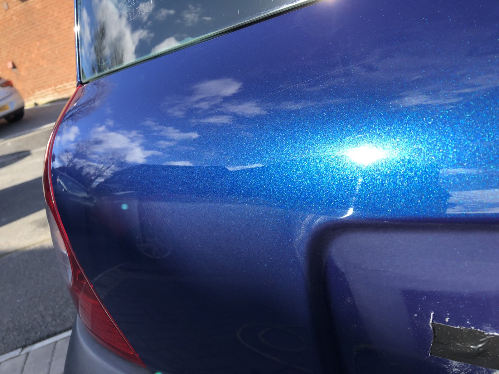

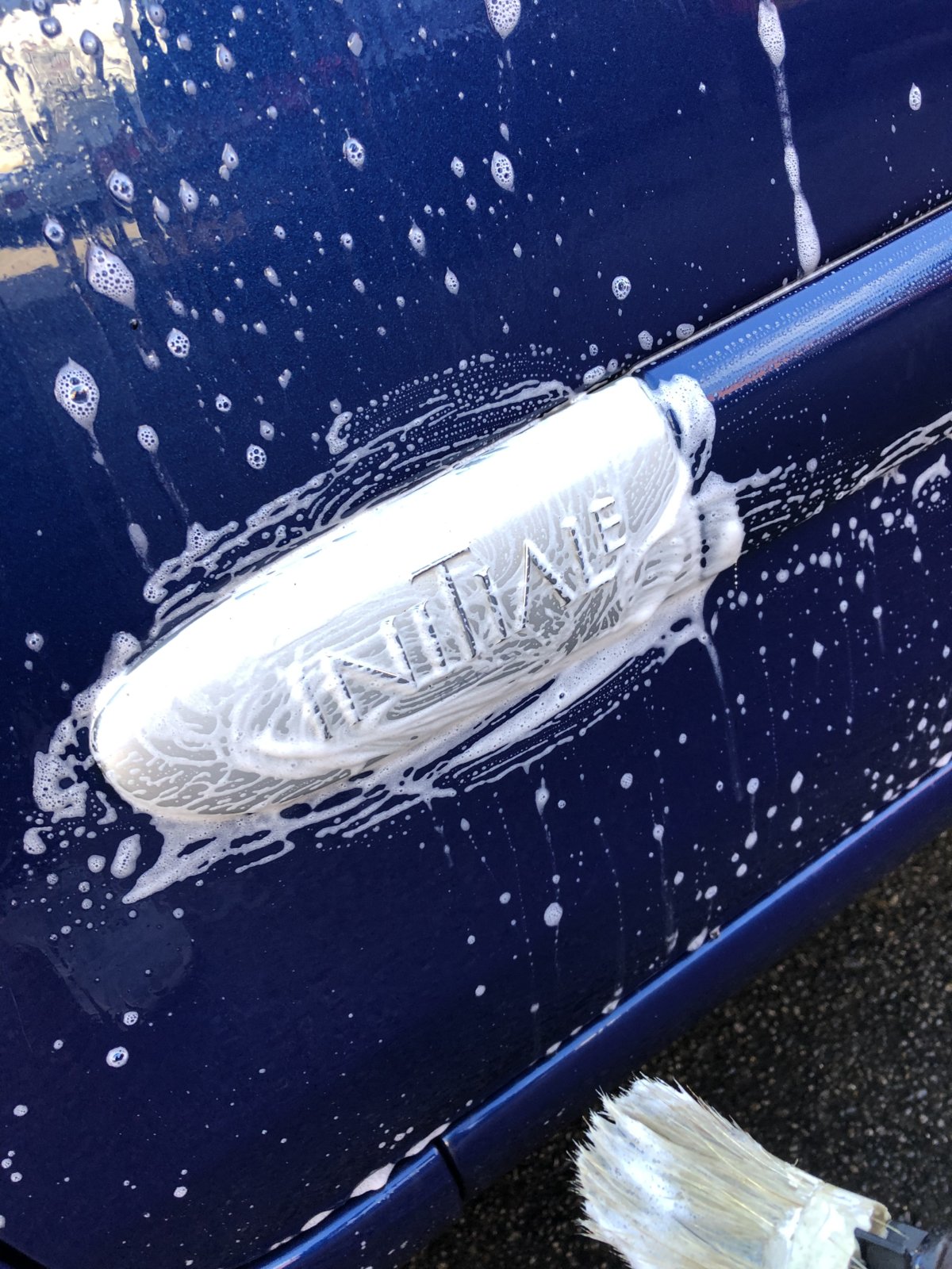

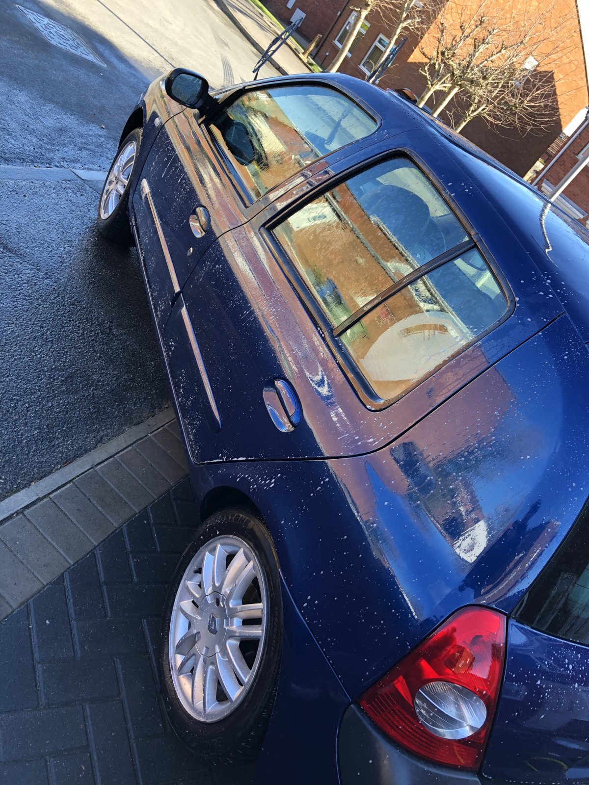

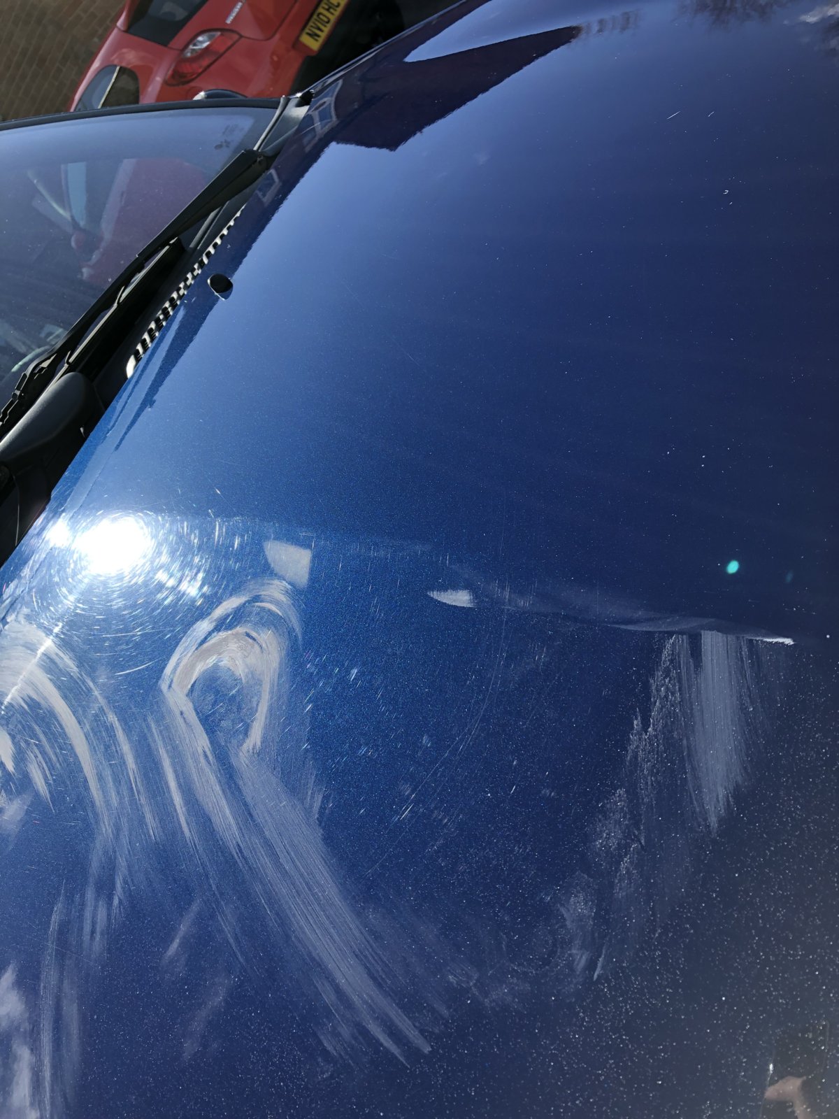

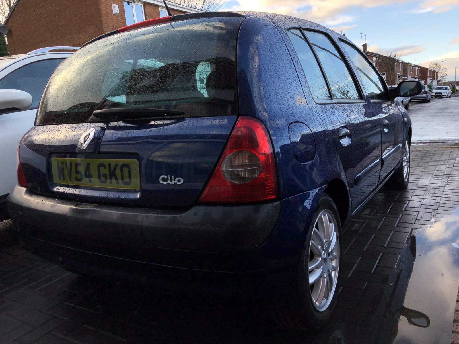

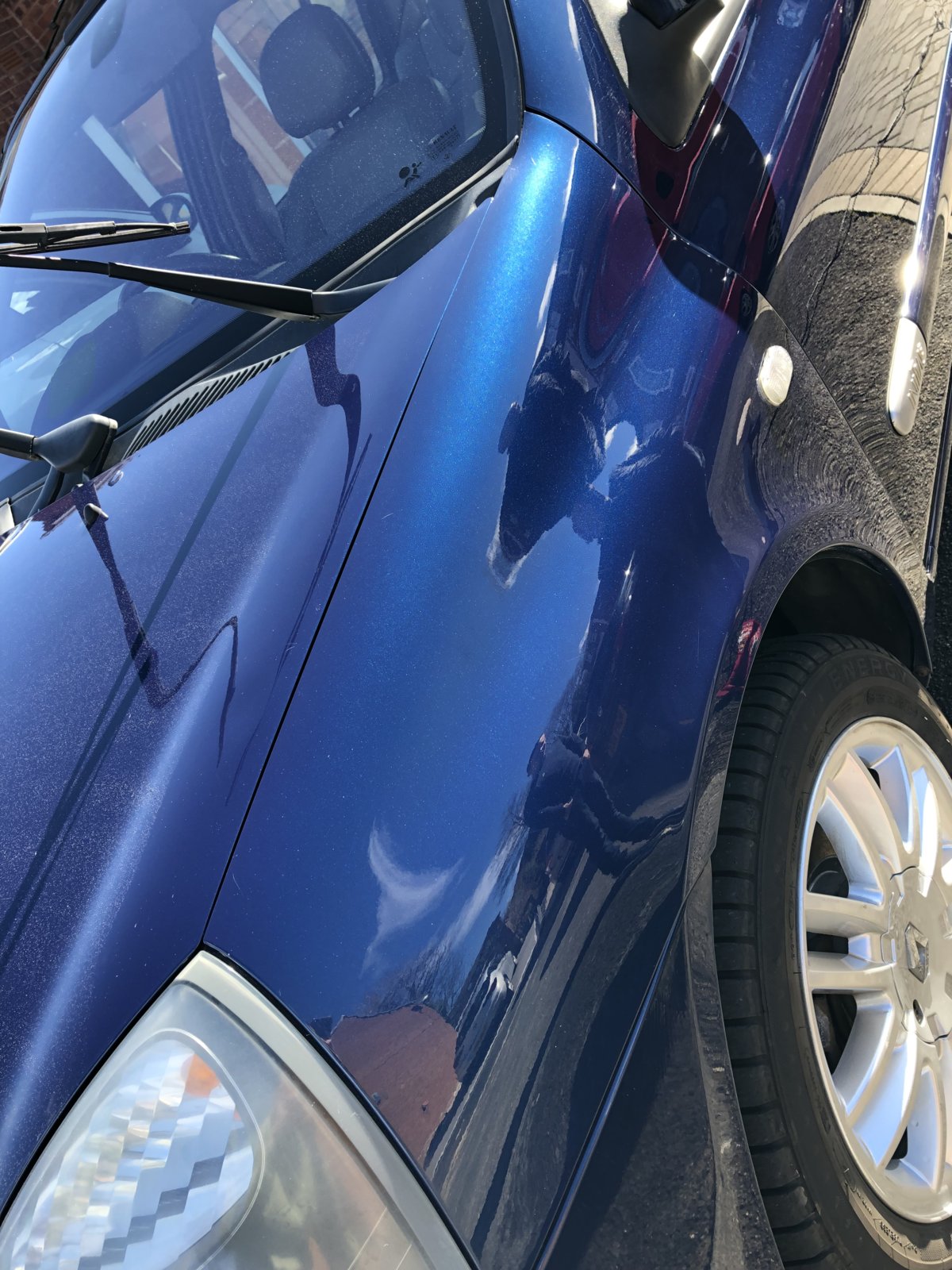

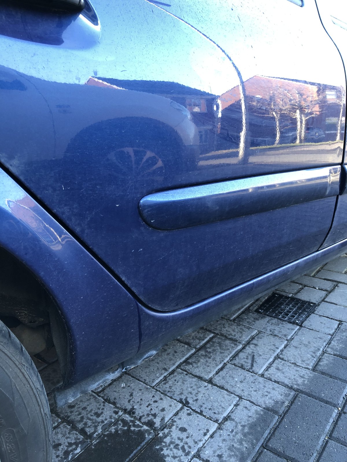

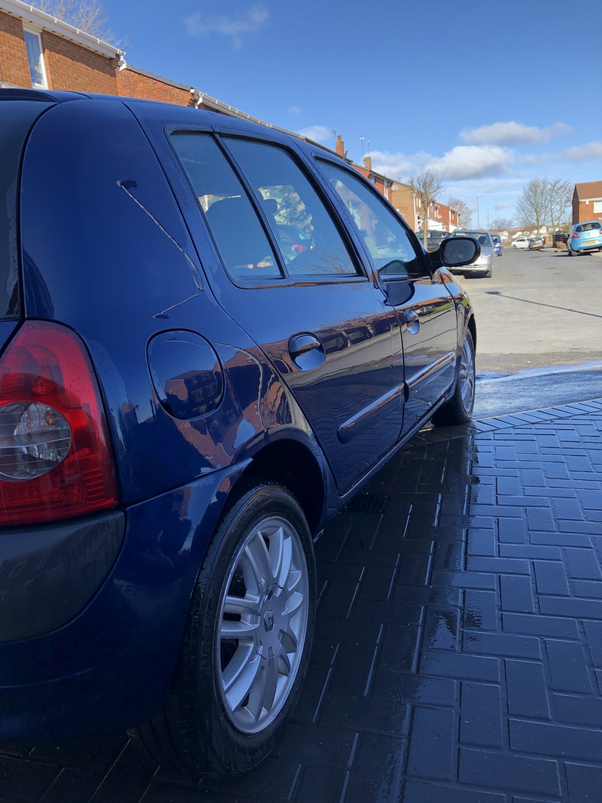

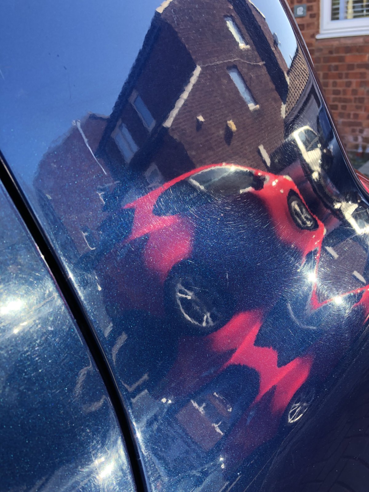

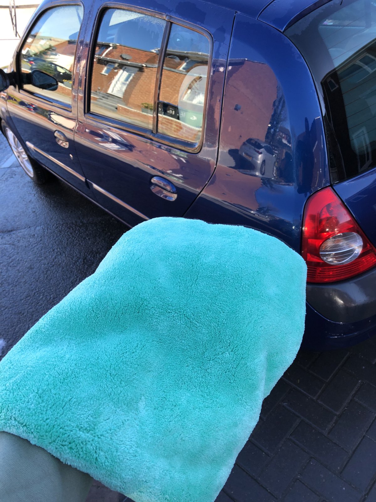

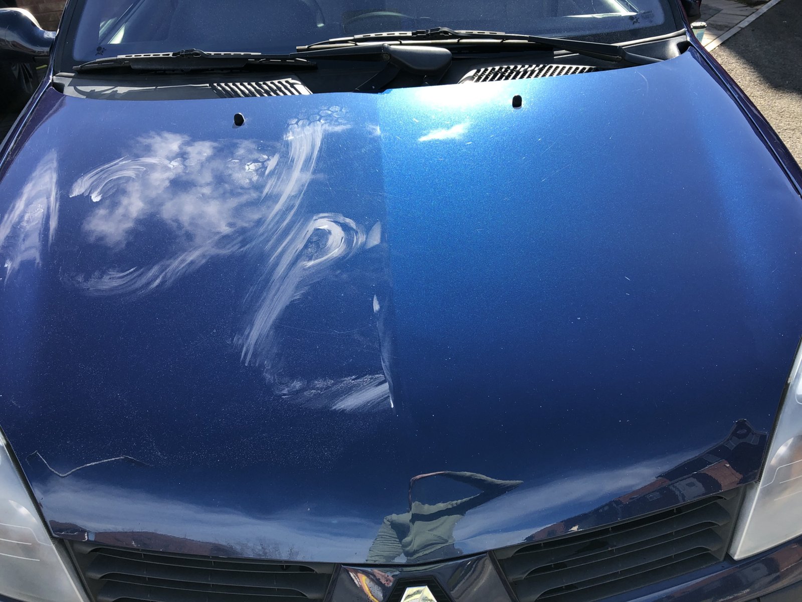

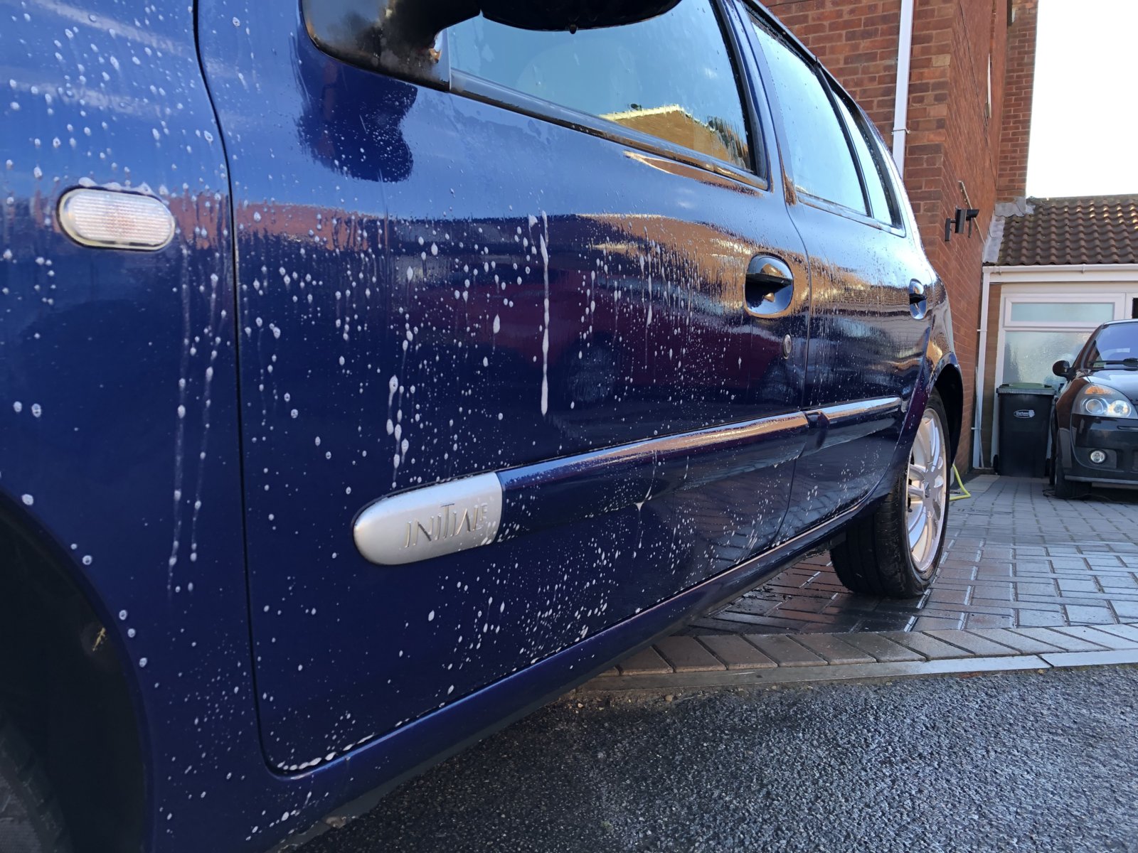

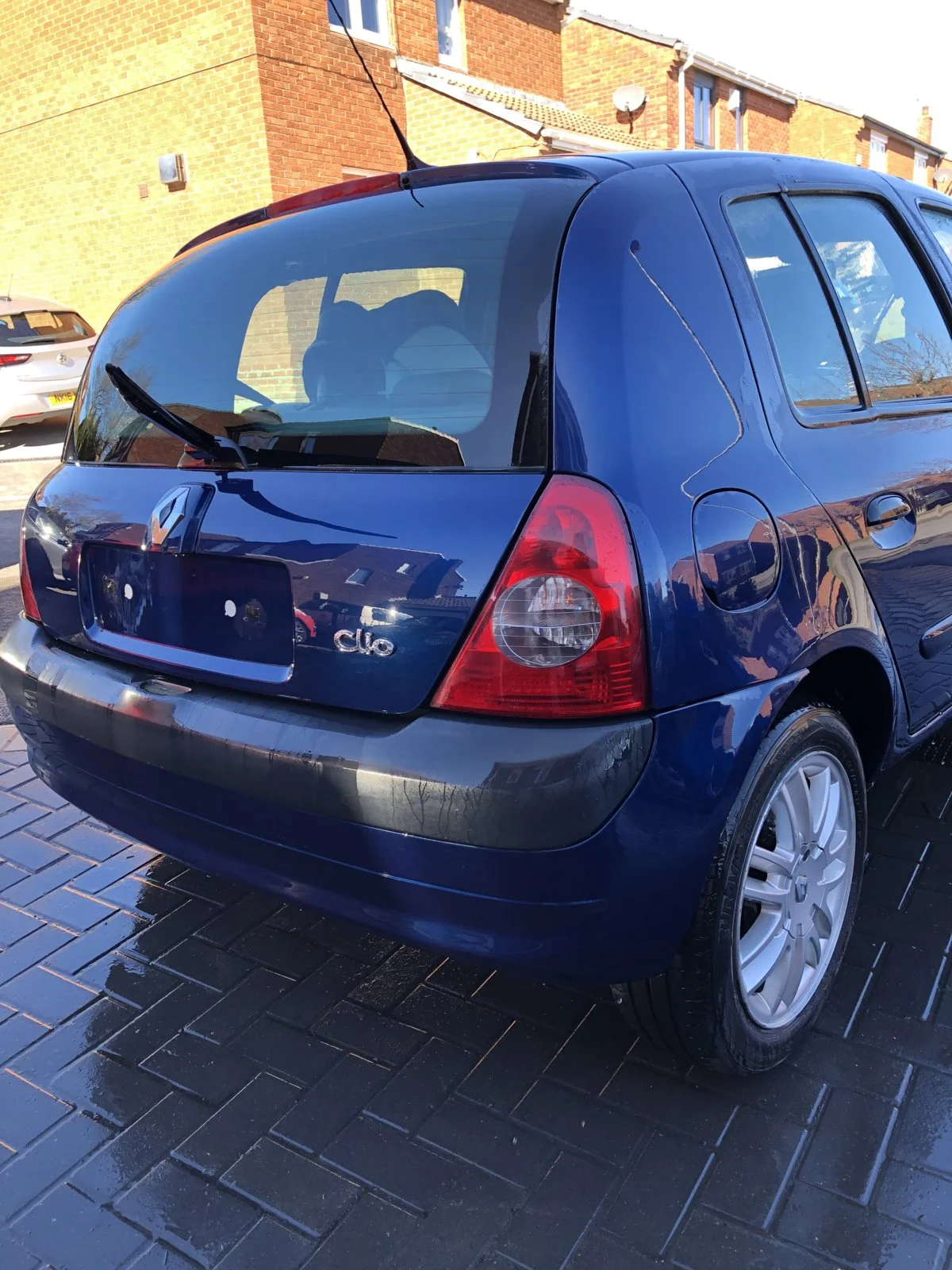

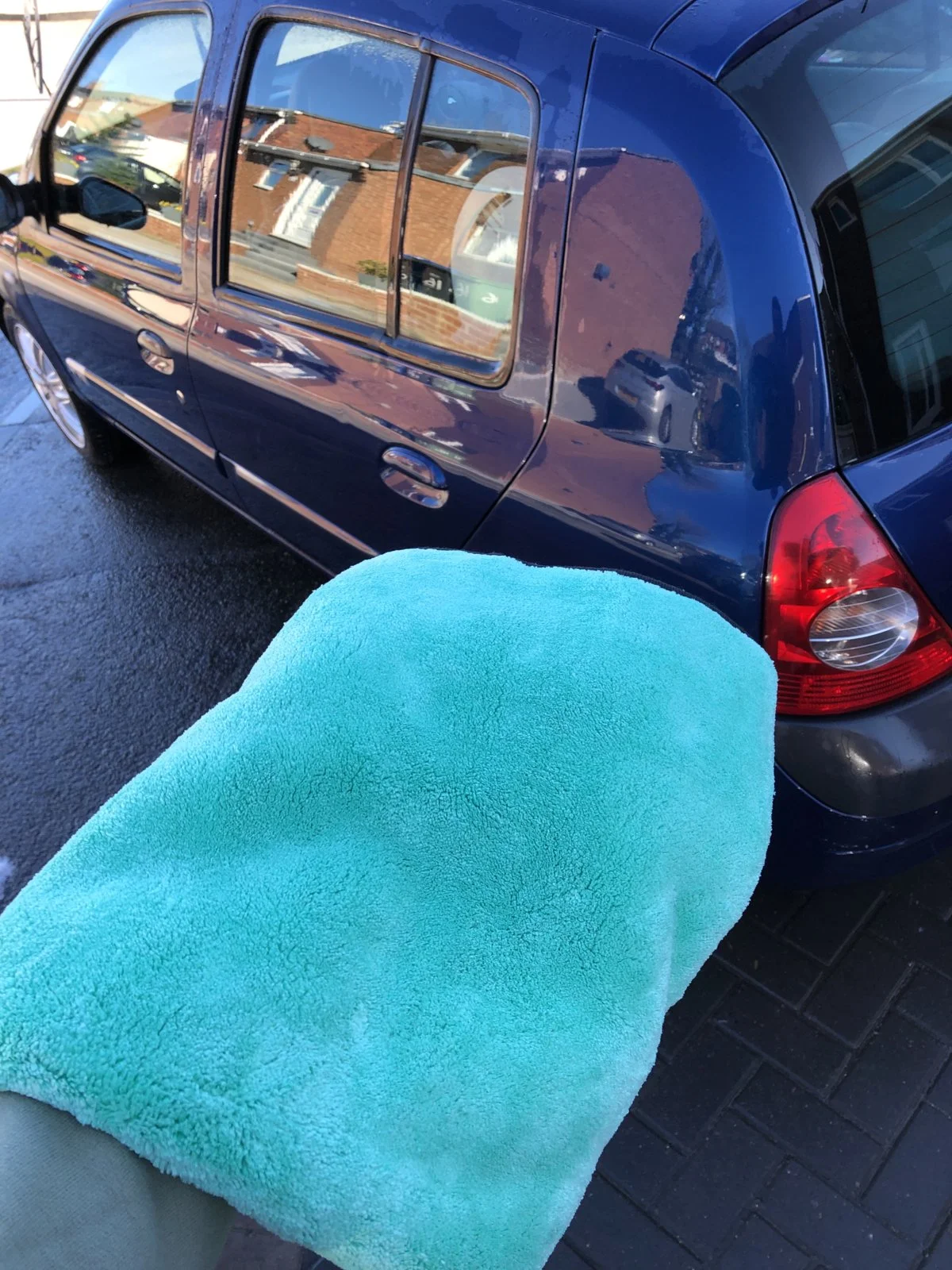

I bought a poorboys DA on here last year for the 182 and was waiting for decent weather to try it out. I have wanted to have a go at machine polishing for years but never got round to buying one and the amount of different pads and products has always confused me and put me off a little.
After buying the DA last year I have collected together some different pads and compounds ready for use.
With todays decent weather i decided i would give it a go. The Dci is perfect for me to use as a test car before i go at rhe 182 as im not worried about damaging the paintwork on the dci.
For anyone bothered, the process was;
Car washed
De-greaser used

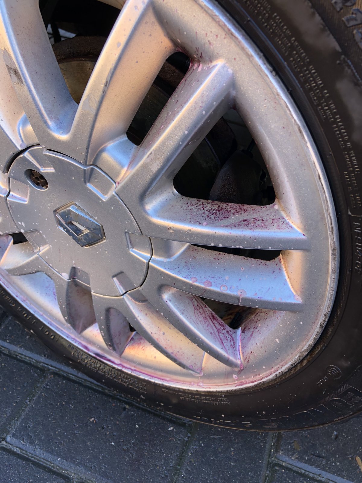

Iron x fallout atuff used

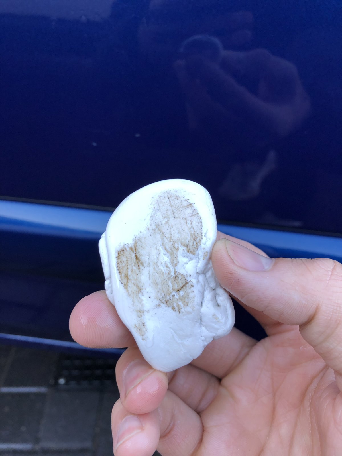

Clay bar over the full car
Car washed again and dried off with a new auto finesse towel
Orange hex logic pad with menzerna 400 compound
White hex logic pad with poorboys SSR-2
Black hex logic pad used to cover the car in chemical guys butter wax
Microfiberes used in between to clean the paintwork after each machine polish

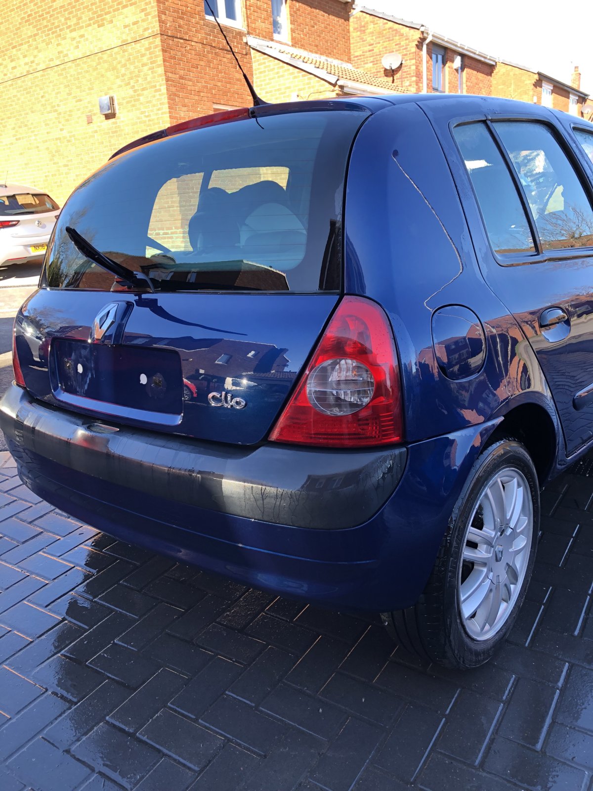

Finished off with a set of new reg plates
The paintwork isnt perfect but it is 1000x better than it was and is silky smooth to touch.
I will update a load of pictures from in order from start to finish

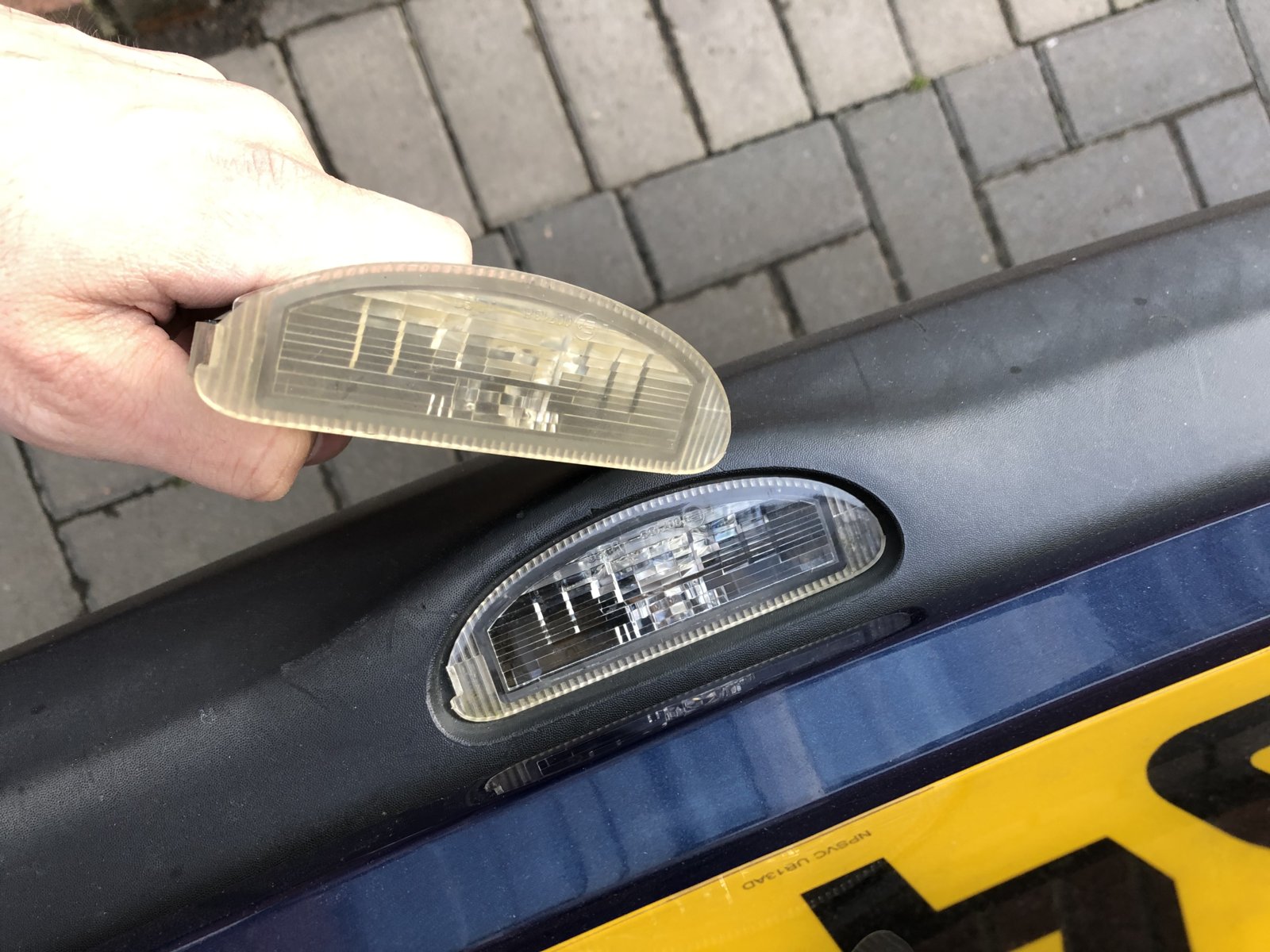

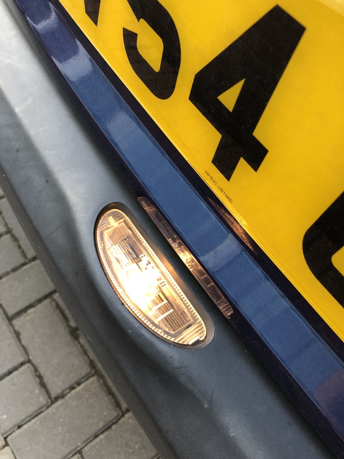

Bit of a pathetic update to even bother making but the rear number plate light holder arrived in the post today. I wouldnt of bothered changing it but it didnt work at all so was an essential buy.
Same as I did with the mats, the new one went on the 182, and the one from the 182 has gone on the dci which was pretty much brand new anyway.

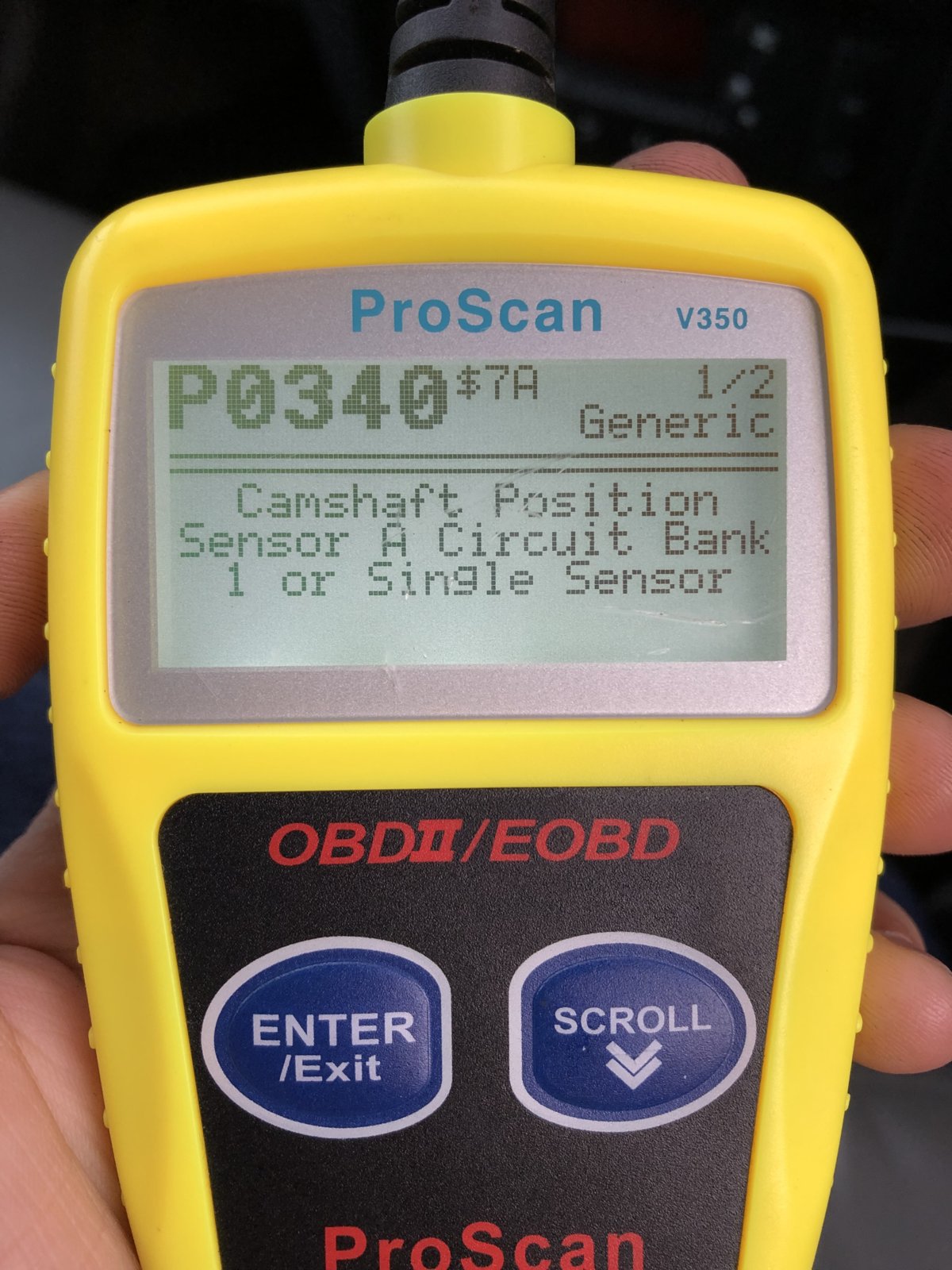

Less than a mile away from home earlier, the engine starting making a horrif loud noise. With the clutch in you could hear it but not as much, and when in gear / driving or revving it sounds really bad. Sort of loud ticking / knocking type noise.
I have plugged it in just to see if anything else was showing as I wouldnt have known if it brought the eml light on, due to it already being on for the egr valve.
And guess what....
P0340 - camshaft position sensor A circuit bank 1 or single sensor.
Anyone know what this means as i have no idea? Hoping it is something fixable though...
Im clueless as to what the problem is. Timing is getting checked next week. If it isn't the timing then it looks like its time for the scrap yard. Perfect timing for this to happen just after i had finished doing everything that needed to be done!
