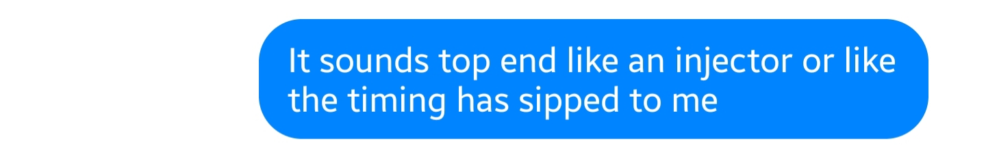

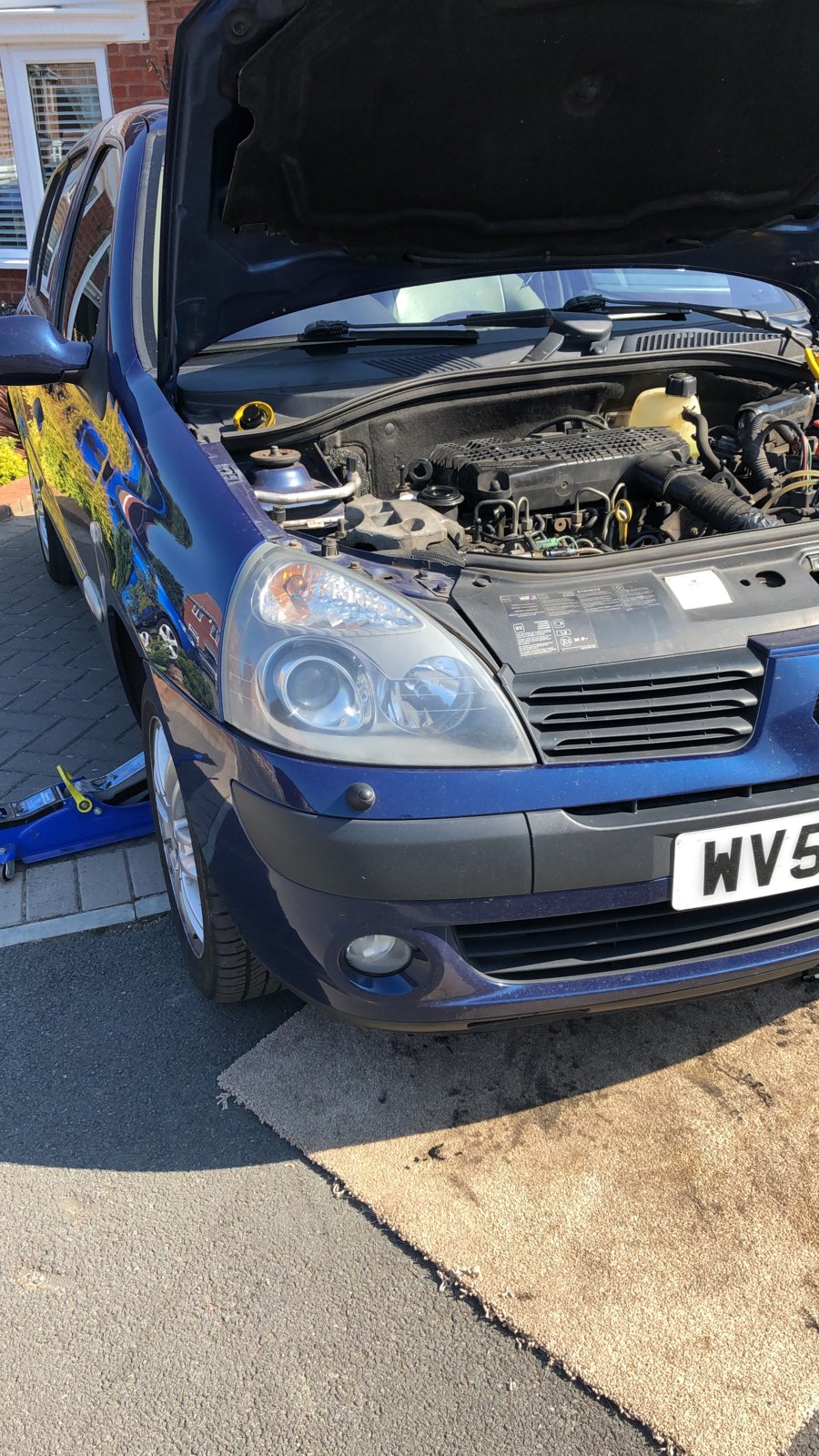

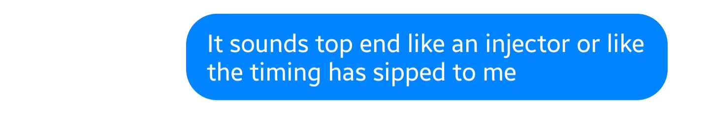

Check the timing ; I’m betting on its jumped or by chance the cam pulley key has snapped off and advanced the cam.
I’ve done plenty that come in sounding like that. If it was bottom end , it’d be knocking like hell
  182
Oh no.. is the belt tight? Did you do up the tensioner the right way ?
Im not sure mate. A few people have mentioned this. You mean angle torquing it?

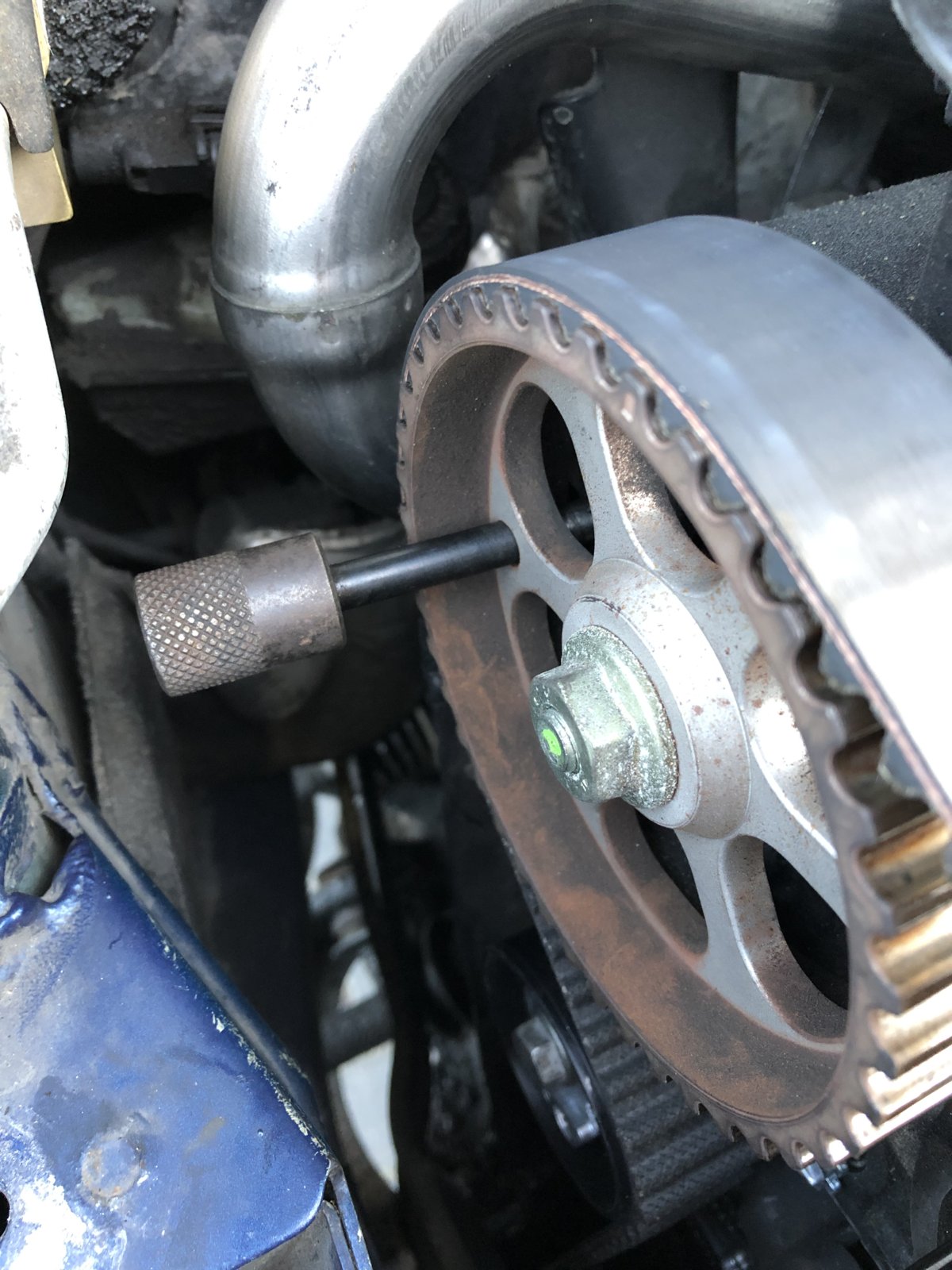

Its back up on axle stands now stripped down ready for the timing to be checked during the week.
Dr HMS Derv Destroyer
  MK1DTi/vivaro/corsa
He means have you turned the tensioner the right way to tension it , some tighten the belt anti-clockwise or clockwise depending on kit installed

It still runs , not scrap yet mate.

Crank pulley bolt not tight enough this letting the the bottom pulley slip ( if it’s not a keyed one ) is the only way i can see that happening other than incorrectly set tensioner.
Either way atleast it’s sorted, 1tooth is cutting it close , 2 tooth out and it’ll do damage.

Good to hear its sorted. How come did the timing slip ?
No idea mate but assume Ryan below is right. I forgot to mention in the post, but when the cam cover came off it was worn down with bits of plastic coming off so it looked like the belt had maybe been rubbing on it. Not sure if that coud have caused it?
Whatever it was, I know that clouting it up the slip road is what made it start. Silly really not sure why i did it, actually dont think i realised what gear i must have been in. Maybe this hasnt caused it and its just a coincidence.

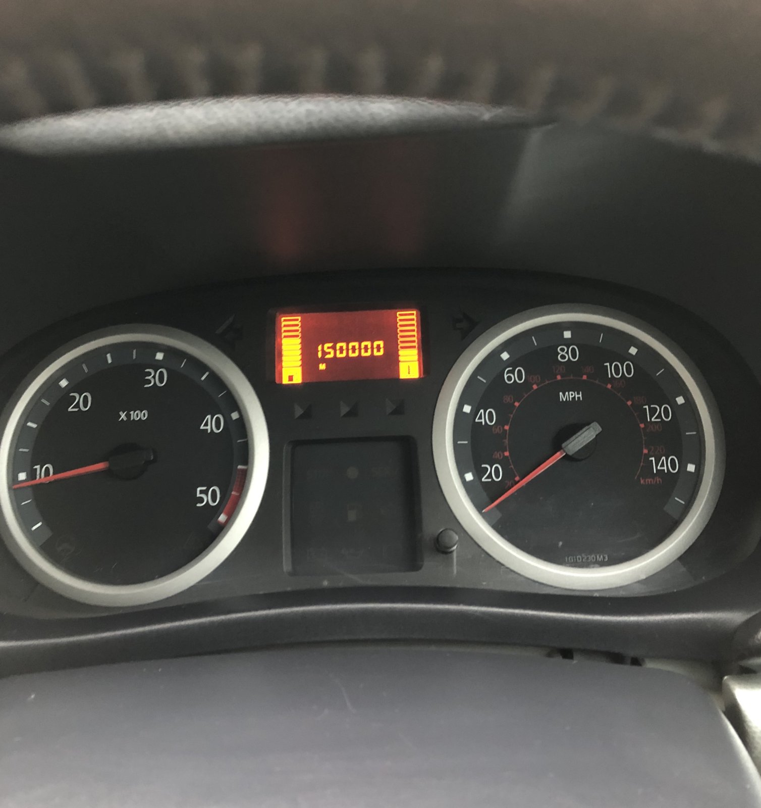

Not updated here in a while as not much has happened other than it being used daily without any issues at all.
I removed the sport grill and put the standard back on. I have put some £6.50 eBay wiper blades on it and this morning it ticked over to 150k
The engine management light finally disappeared after a couple hundred miles after relacing the egr valve and it has not been back since.

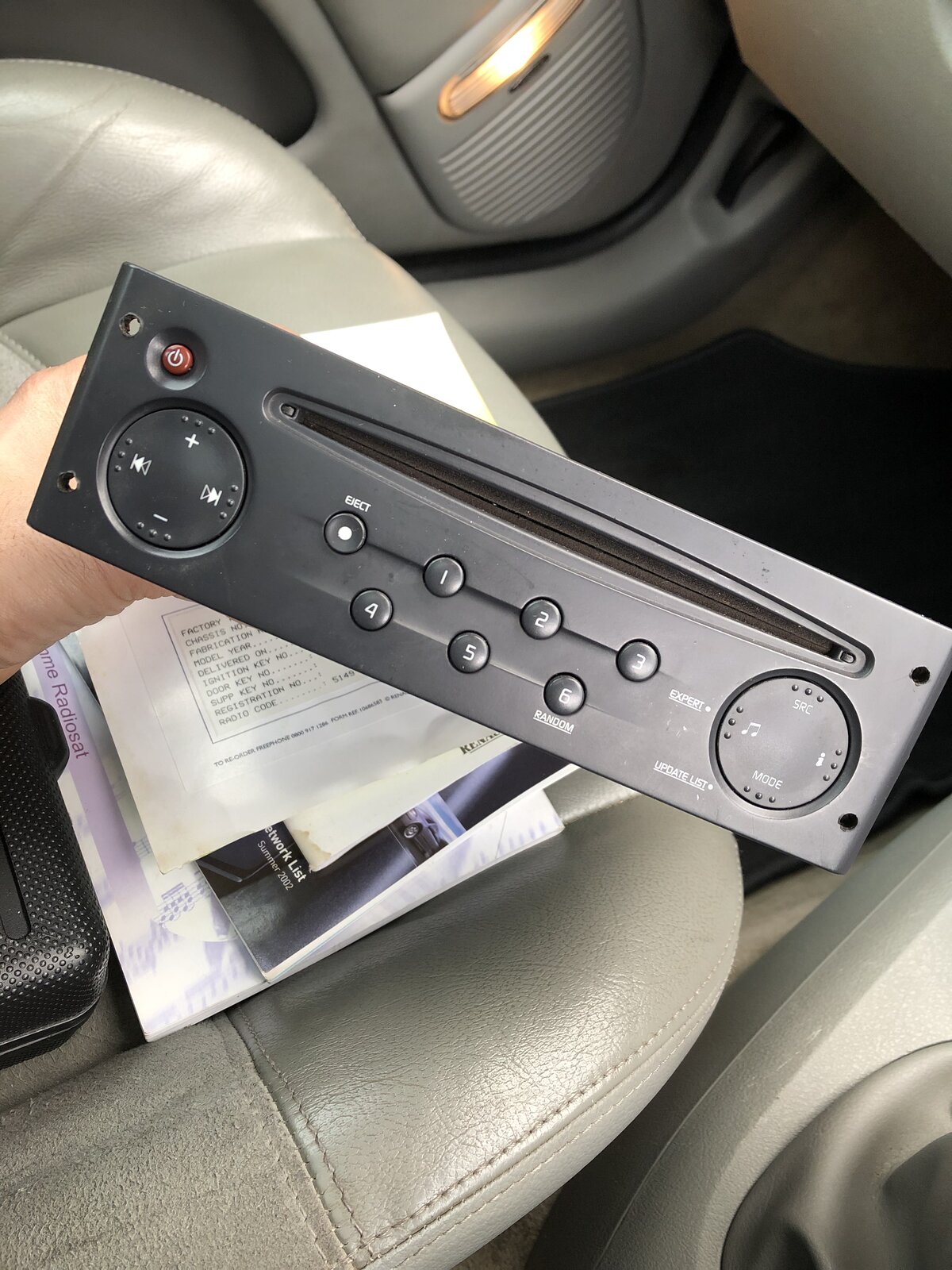

I went to the scrap yard to try and get an engine under tray but they didn't have any in. I did manage to get an update list head unit for £5 though which i have wanted for a while so I can add an aux wire in. Anyone know how this works when there is a 6cd changer plugged in? Do I need to loose the cd changer to have an aux?
Krarl
Update list won't work in your motor mate
Just get a connects 2 box. Had one in my dCi 100 and never had an issue with sound quality etc with the cabasse unit
