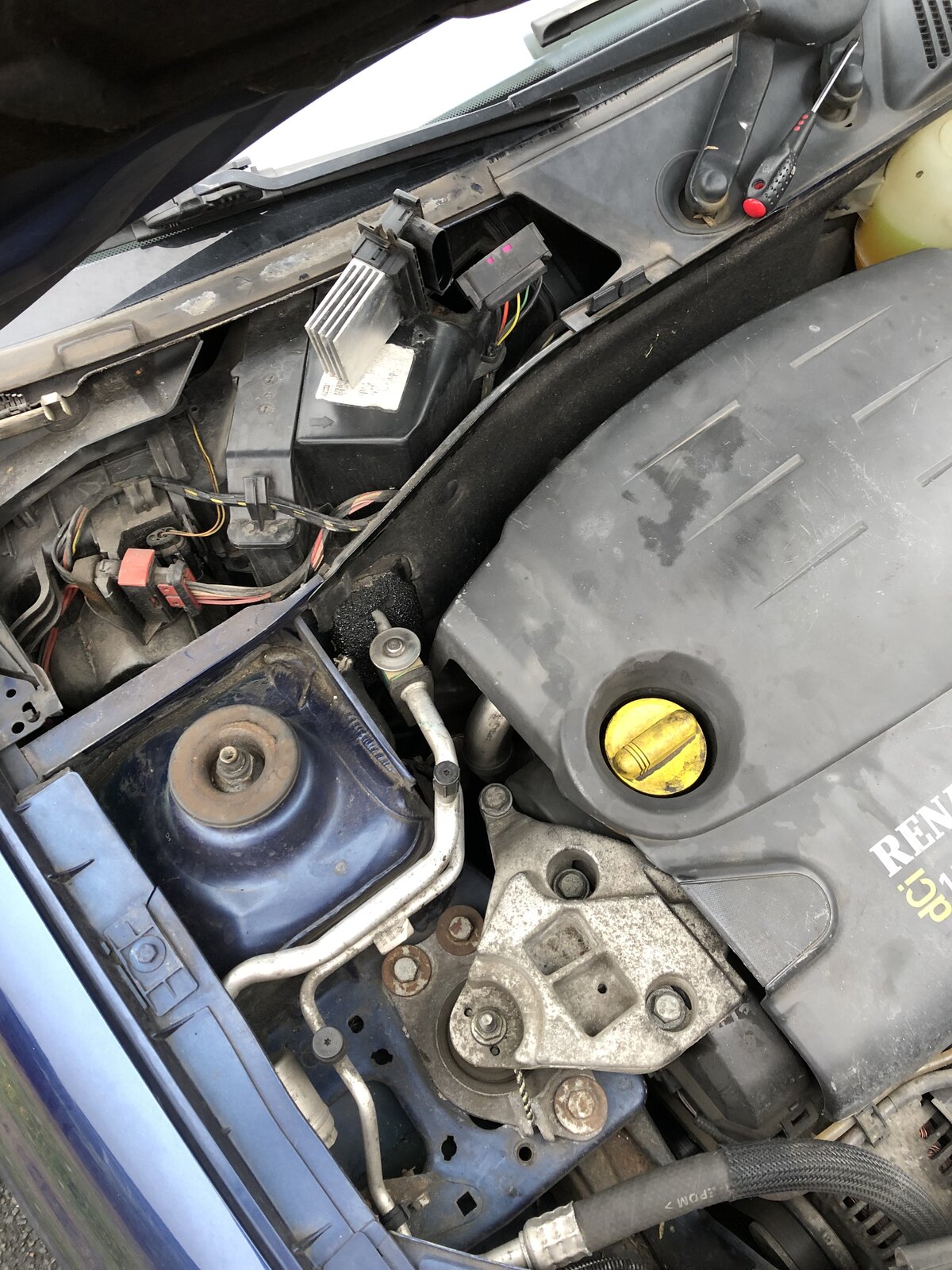

Heater resister pack went faulty as the blowers were on full spped even when turning them off on the climate control panel. Ordered a new aftermarket unit on eBay for £11 and it is now fixed. Fiddley job and needed a 6mm spanner to get the bolt out.

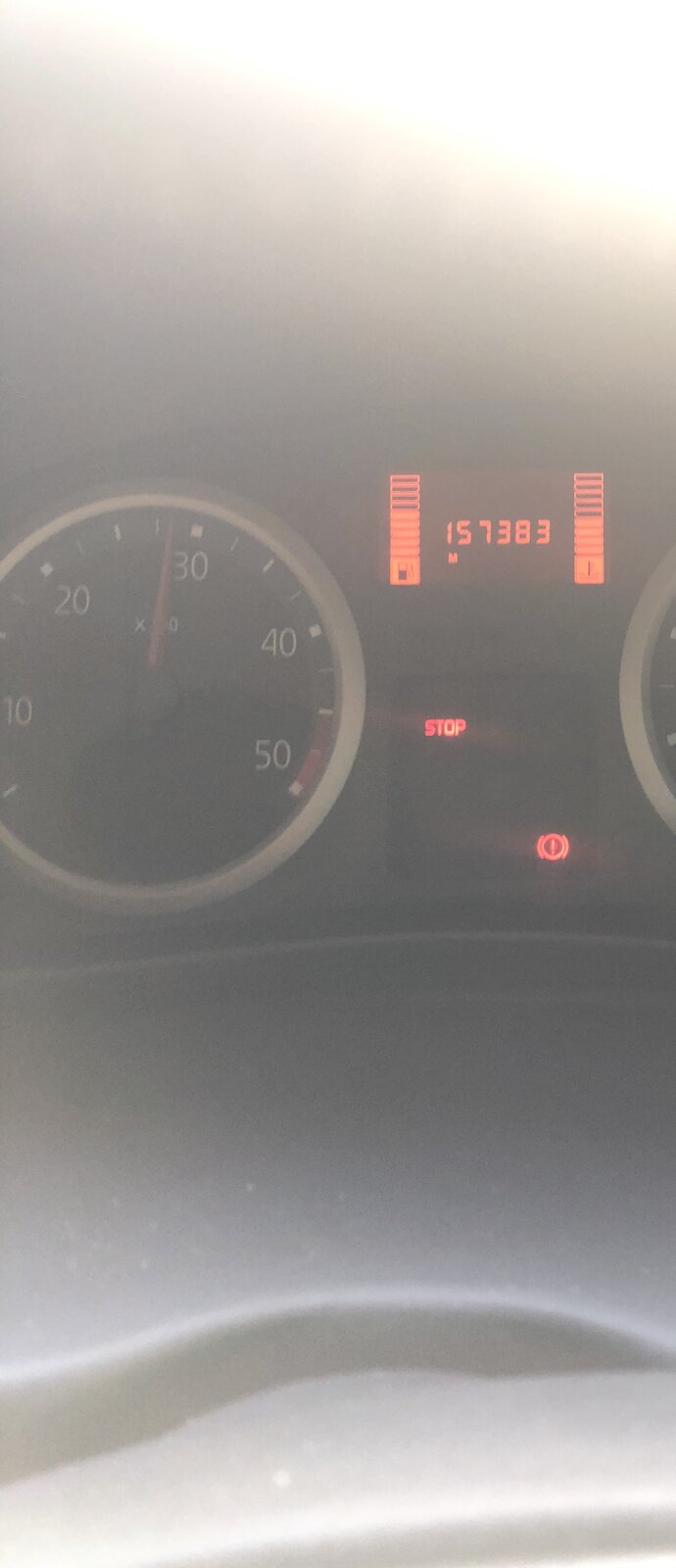

Thanks mate. Multimeter shows 12.9 so its fine. I was wrong though, its the STOP light and the handbrake light that keeps flickering! Any ideas?
MRBILLYUK
  FF Jeden Osiem Dwa
Handbrake light is flickering when you're driving , especially round bends?
If it is ,that's usually low brake fluid level which could also indicate your brake pads are worn down causing the brake fluid level to drop.
  182
Brake fluid solved the problem 👍🏽

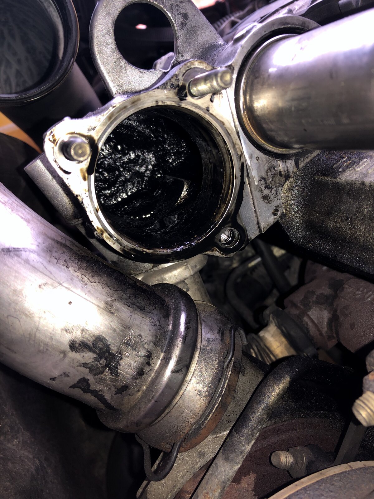

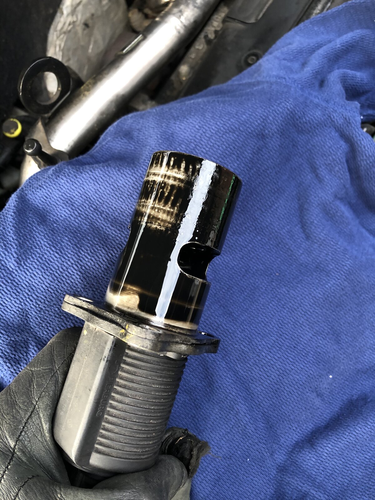

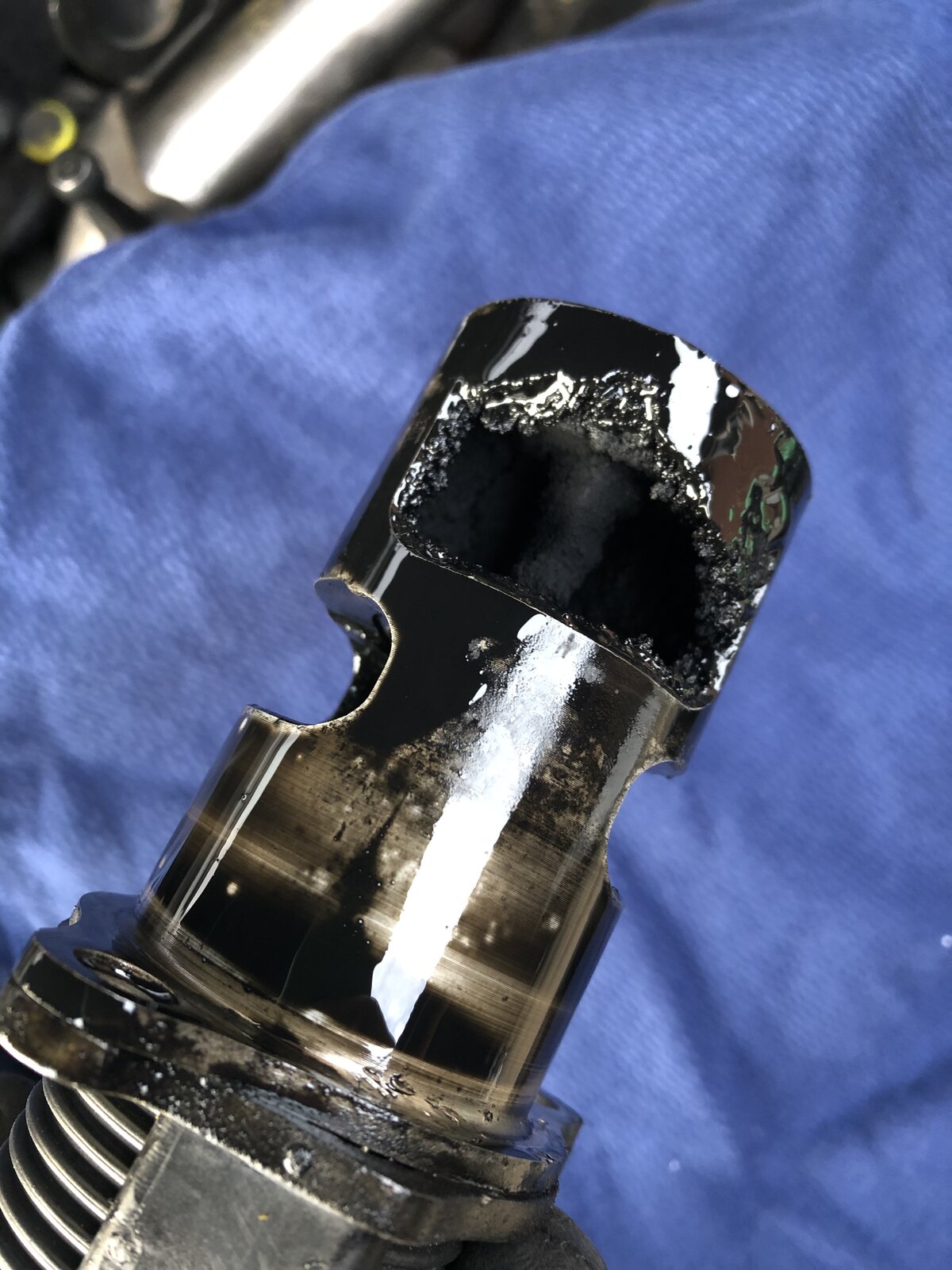

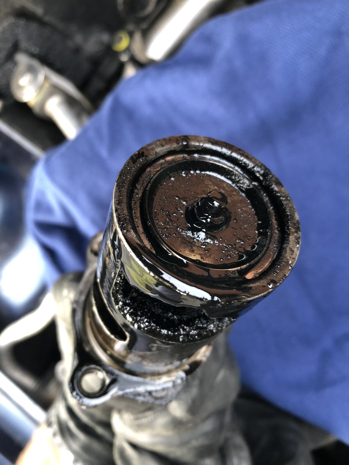

cleaned the egr today as its been lower than usual on mpg and although no engine light on, when i plugged it in there was a fault logged for gas recirculation (egr)
same as it has always been. The outside of the casing was covered in wet oil but inside the chamber was the usual thick dry sooty stuff.

Get a screwdriver and an old hoover with a bit of hose taped to the end in that inlet!!! That thing is gross!😂
Have you taken the J-pipe off and cleaned that too?
  182
Wait!
i did the j pipe a year ago when i bought it and it was clean. Strange as i expected it to be full.
The other bit, the inlet? I didnt even know what that was and how you would get it off? I cleaned as much as i could with a screwdriver but it looks like it needs a proper clean. Is it even possible?
I’d say you have a leaky turbo Austin. Think about getting a new cartridge for it with new seals, they’re only around £100.
Also on these 100 is very easy to clean the inter cooler out once the bumper is off, I’d try that too.
I Changed My Name
Not all gingers stink of piss. But I do.
The inlet mani is cast into the head so you can only clean so much. But the EGR housing can be removed (bit of a pain in the arse)
And yeah, your turbo is spewing, mine was the same when I sold it. Your EGR will just keep clogging over and over
  182
I still think it's your turbo on the way out I said this months ago on this thread iirc
Why do you think that mate? I have no idea when it comes to turbos. I know this was said before by yourself and others, but i have done 11k over the last year since owning and it is still going. What other signs would there be that the turbo is failing?
  182
I wouldn't have a clue where to start with that mate. I will try anything, but i need to see it first before i give it a go.
  182
Yea looked at it and though how would i get the rest of that off!
What do you mean? Leaking oil from the seals? How would it be resolved?
What? Lol. Honestly no idea where i would start with that and what i would need to remove.
Yeah it's a stupid design from Renault! Yeah basically the turbo is leaking oil past small seals around the sore shaft down the inducer shaft and flinging it through the intercooler and then it's making its way into the inlet in small amounts. You can find the cores for them pretty easy or just get a new turbo
  182
thanks mate you are always very clued up.
whats involved with changing a turbo? Is it difficult? Bolt on bolt off?
