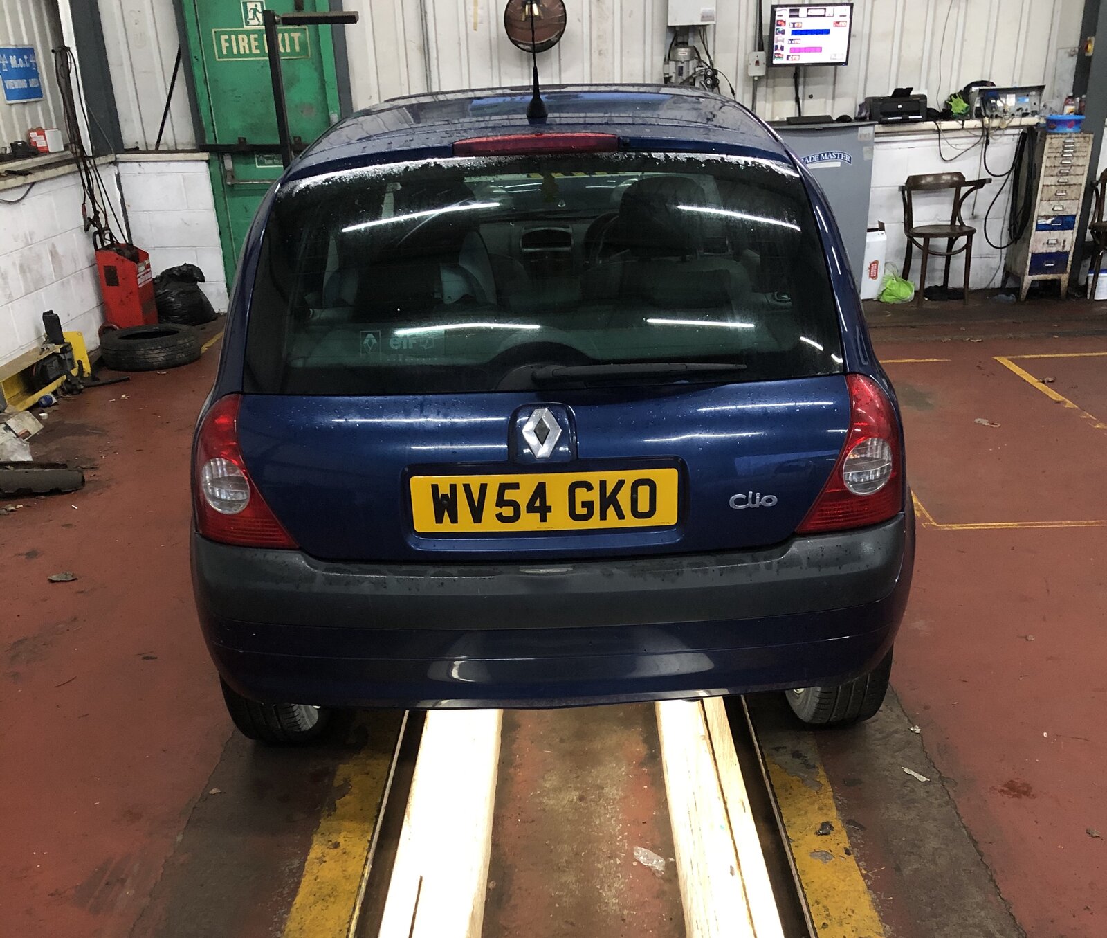

MOT booked for Friday this week. Not sure what the outcome will be....
  182
MOT passed this morning.

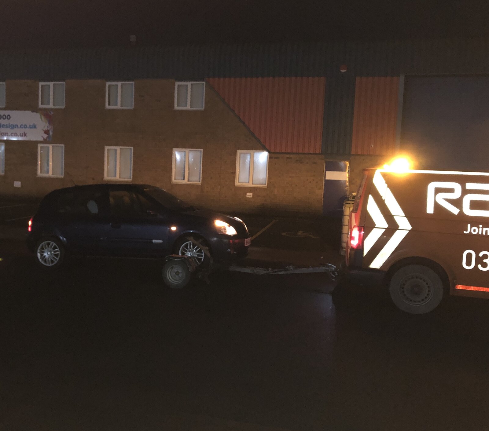

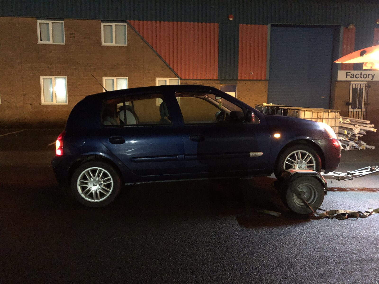

I had the clio towed to Ren-Sport last night by the RAC. Id bought a 12 month membership code on here 10 months ago so it finally came in useful.
kris at Ren-Sport has messaged me today to say it ws a nightmare to get the clutchout and that the inside of the box was soaked in oil, and the clutch and slave cylinder well and truly gone! He also thinks its still on the original clutch which is good going if it is.

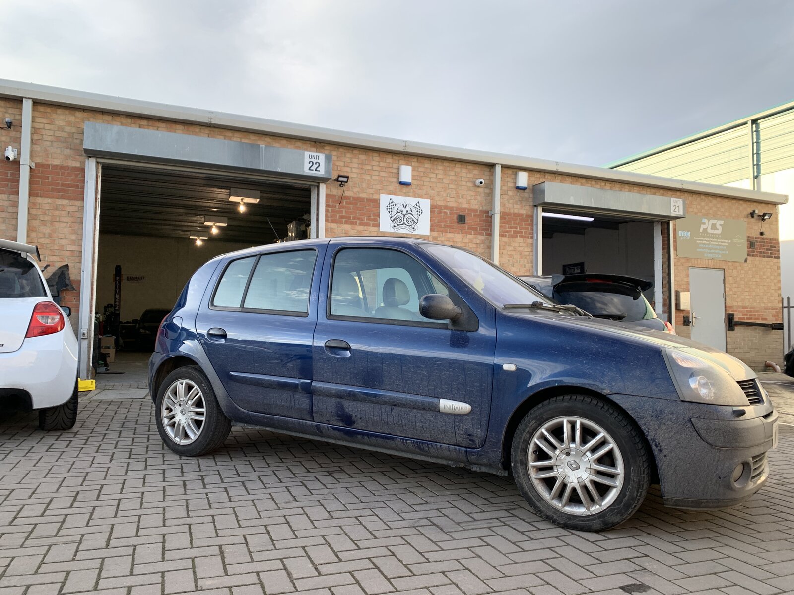

Back on the road again thanks to Kris at Ren-Sport. First time I have met Kris and very grateful for his help getting the clio back on the road within a few days.
Ended up being a bit of a pain with subframe bolts seized on and damaged clutch line but Kris still got it sorted and back running.
Anyone in the North East looking for a Renault Specialist i would 100% recommend Ren-Sport.
