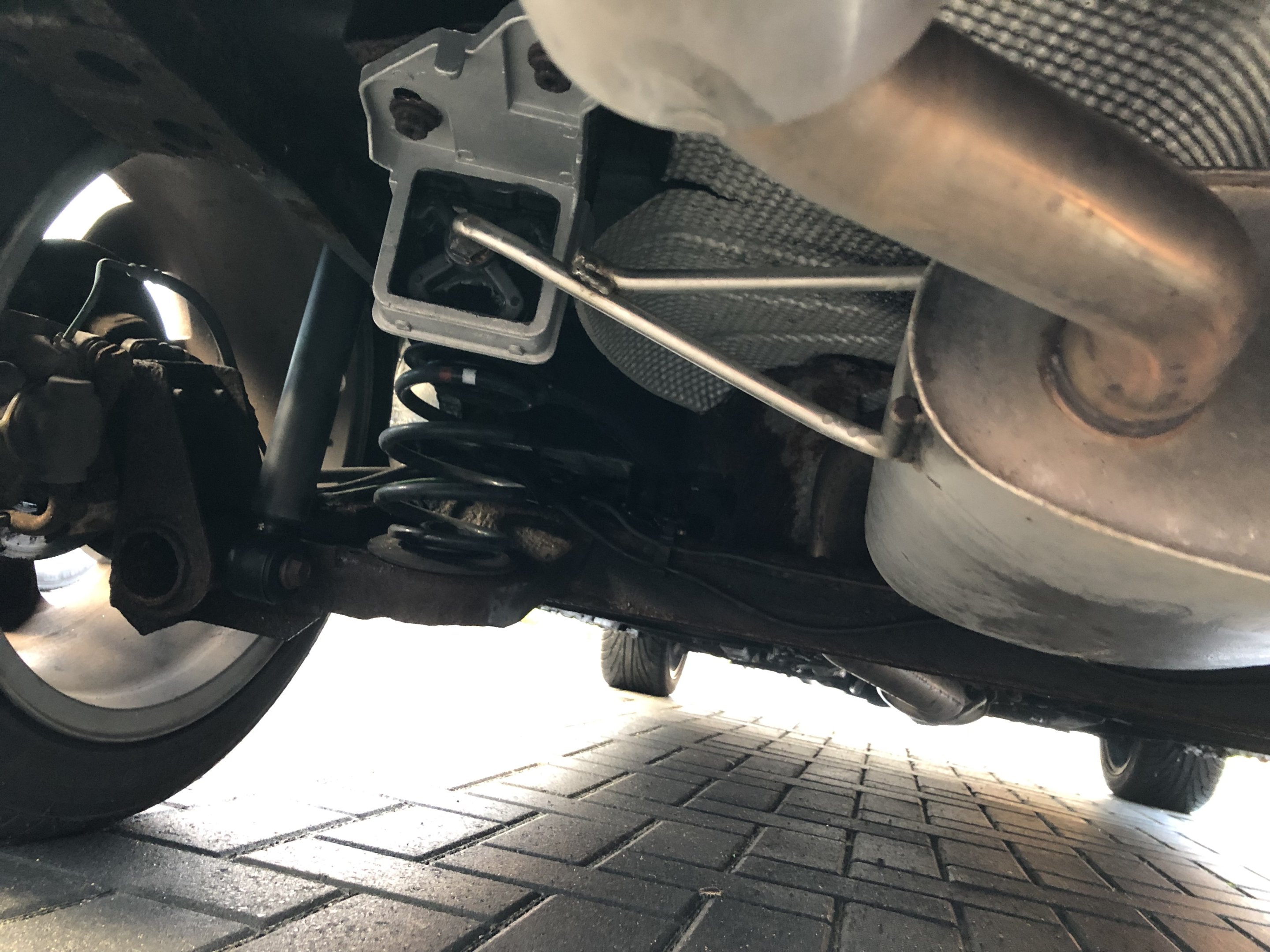

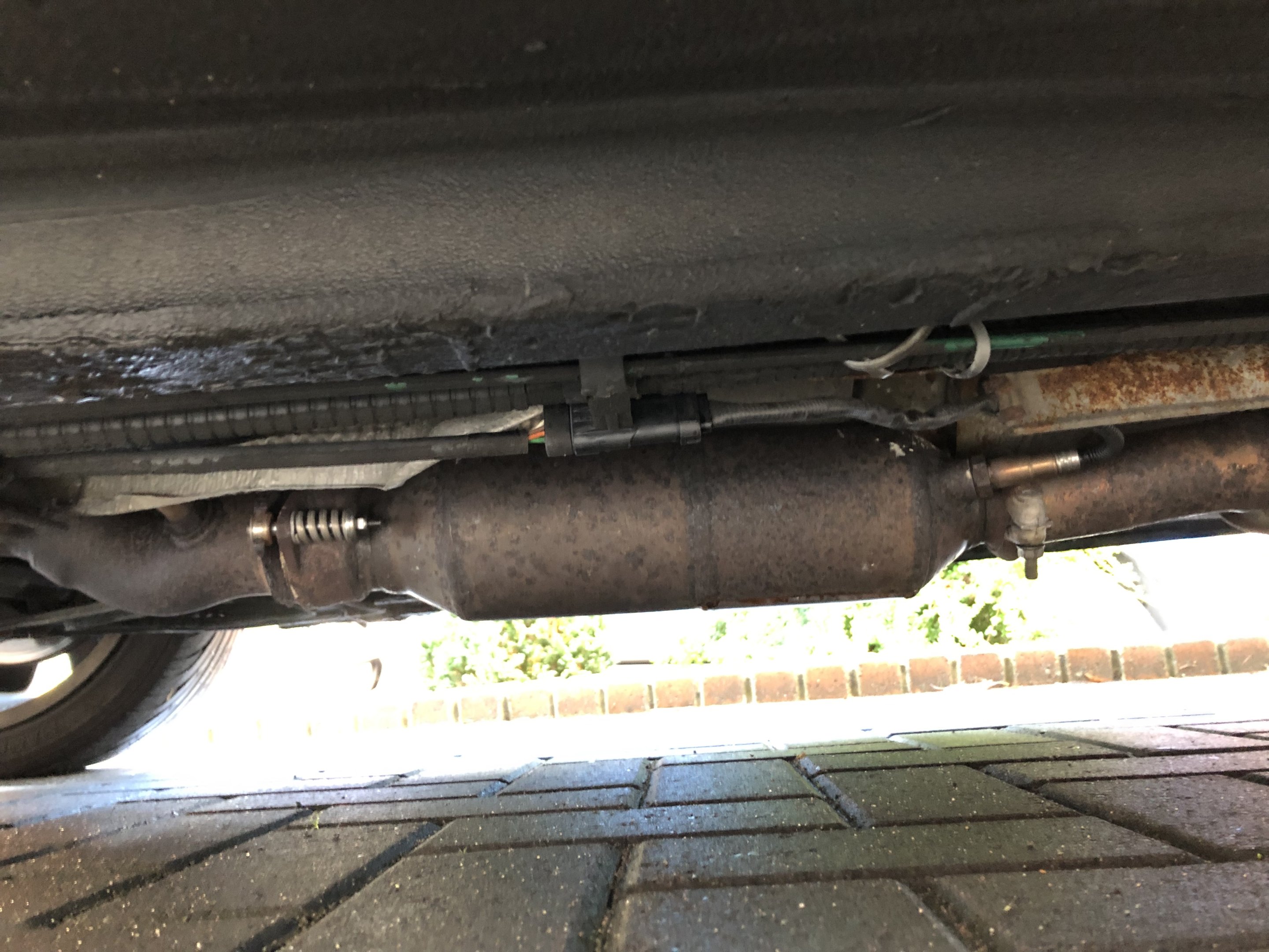

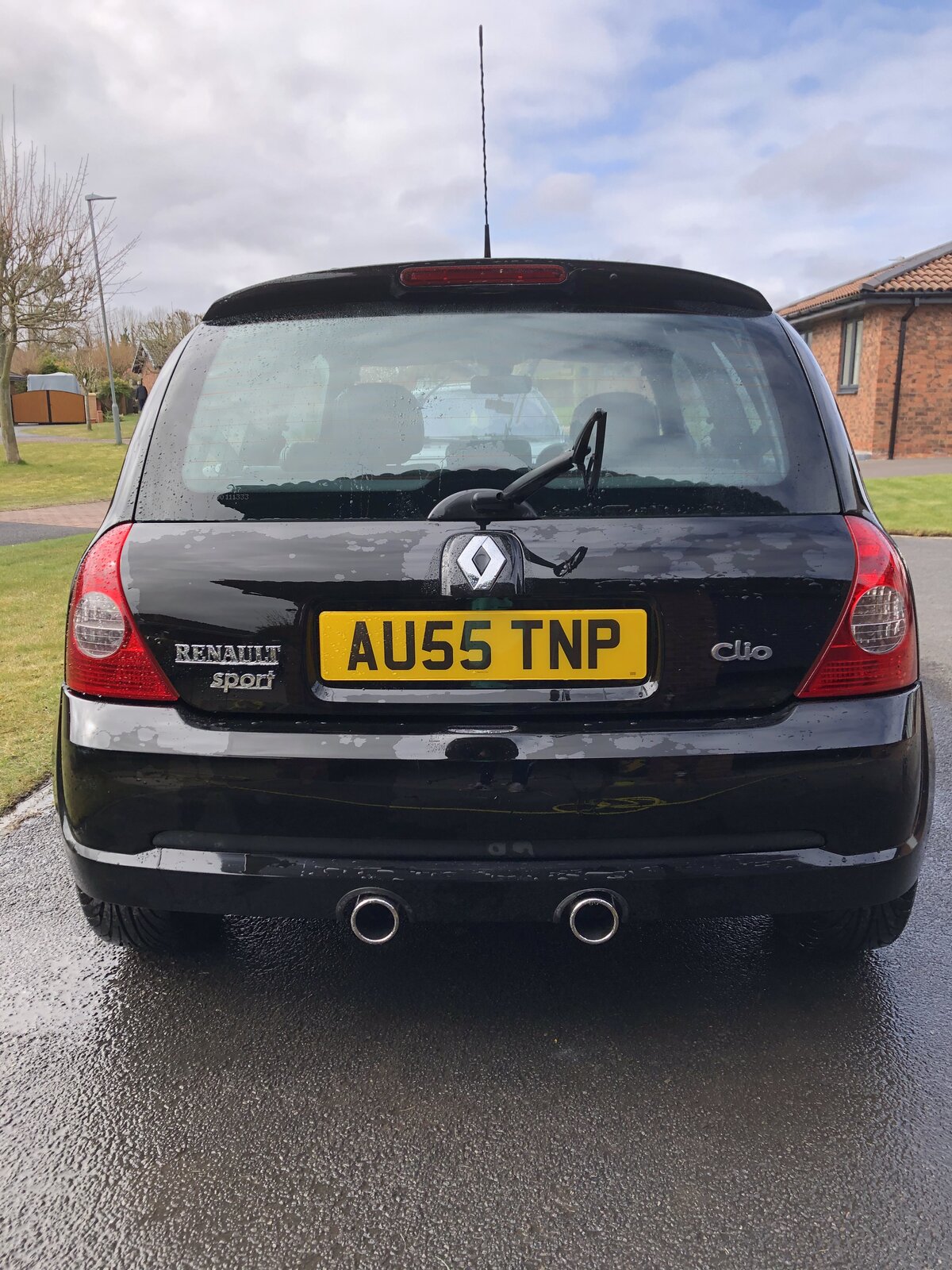

First of all, the exhaust needed attention. All of the rubbers had perished causing it to rattle and start to melt the exhaust trims. I also wanted the decat off because im getting old and the droning noise is no longer cool to my ears.
I went back to AAS who have replaced all mounts, welded a small crack on the original cat from when it was on coilovers and scraped along the floor, and re fitted for me with a new genuine fitting kit.

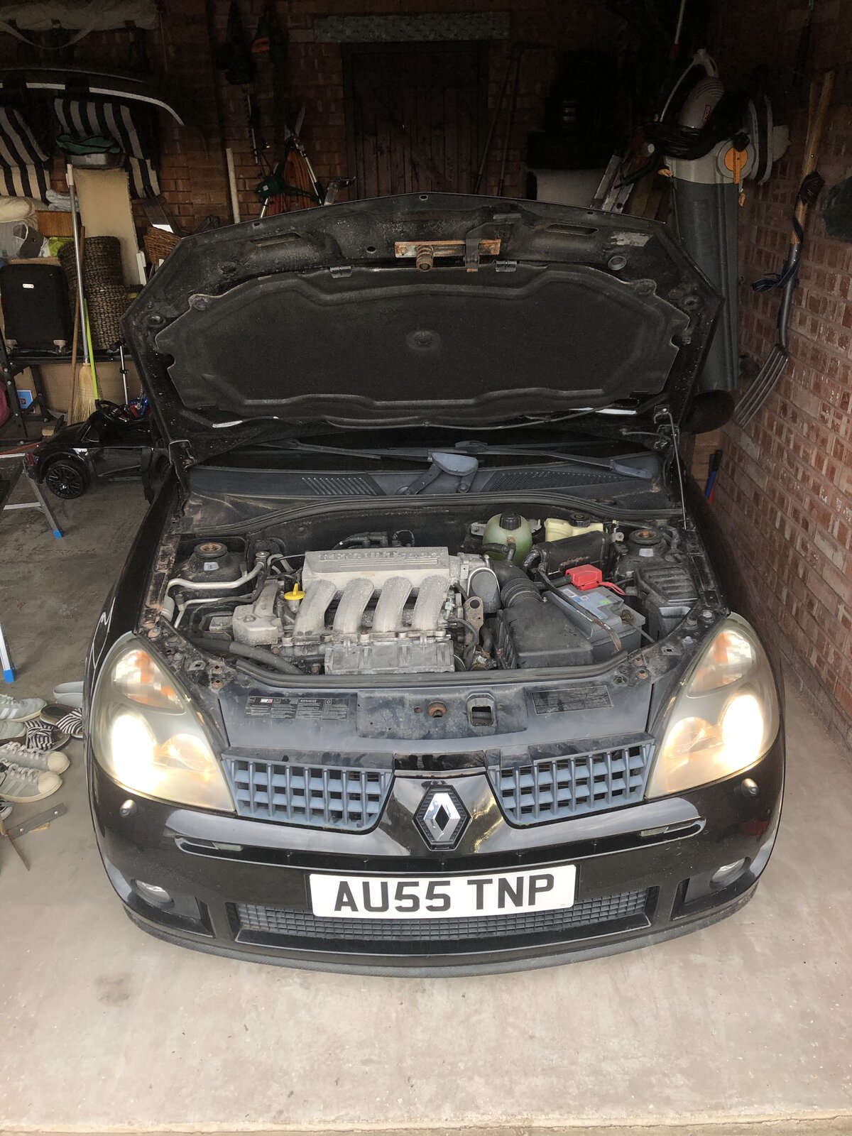

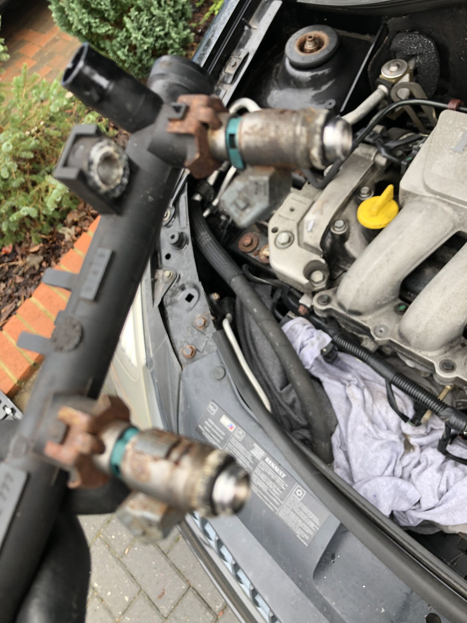

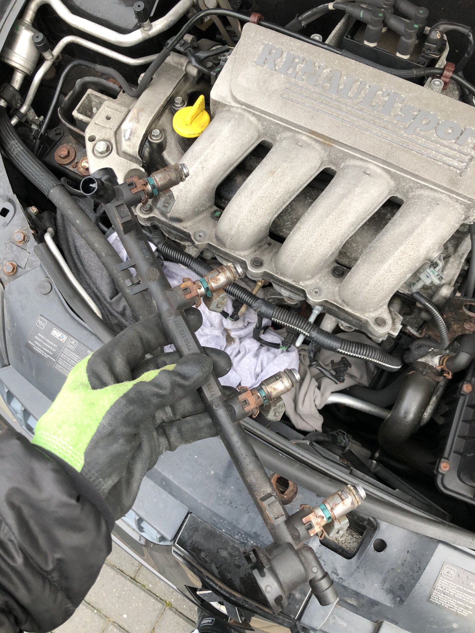

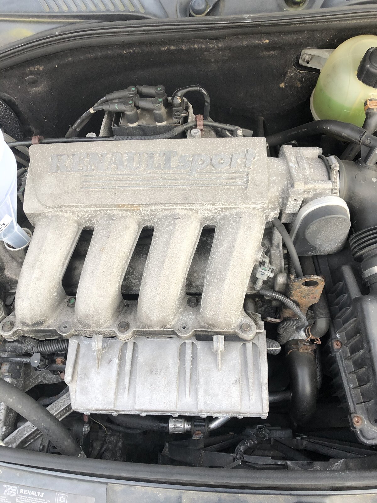

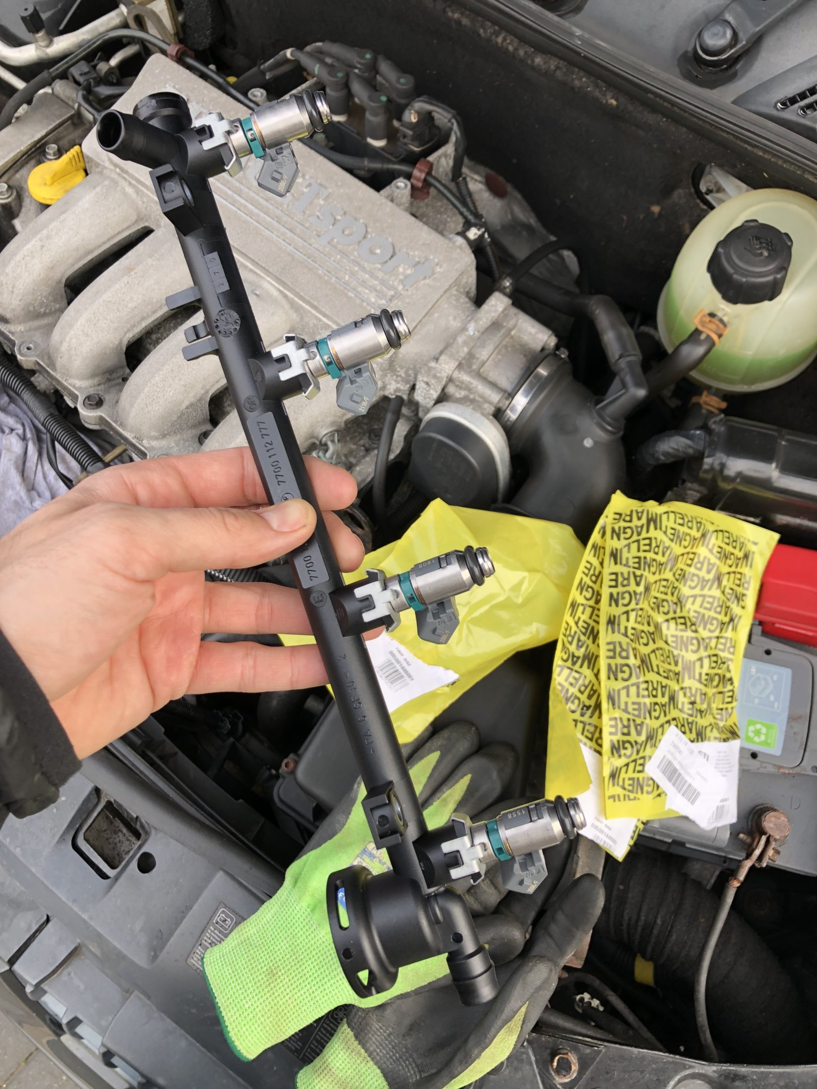

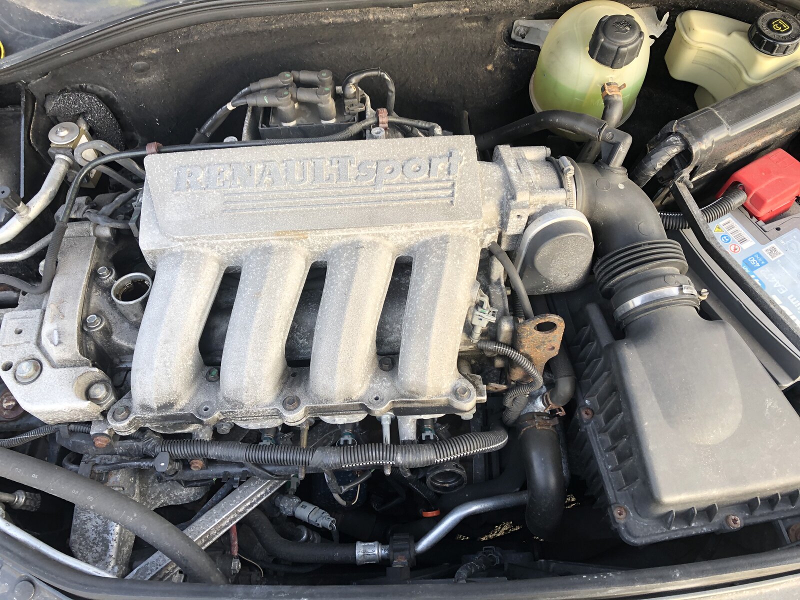

Next up was 4 brand new genuine injectors and fuel rail. Mine were swapped ages ago when diagnosing a missfire, which didnt turn out to be the injectors but i was left with a 2nd hand old set. I was also told at a later date when it was plugged in that there was a slight missfire onnone of them so they have been on the list to change for a while now.

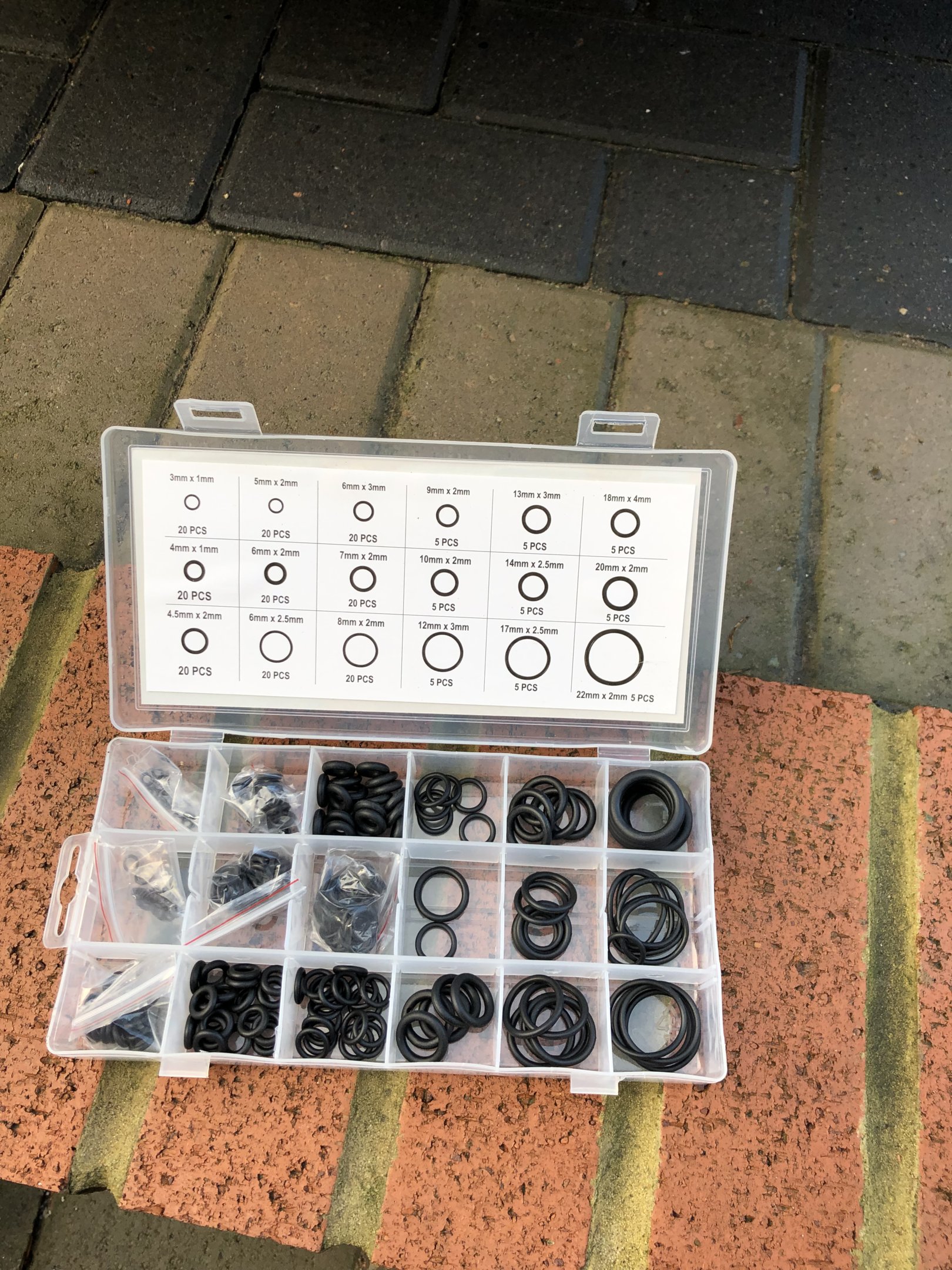

When starting the car, the fuel line popped off and sprayed petrol everywhere! I realised one of the o-ring seals had snapped!
I managed to find a pack of seals in screwfix and one of them was the same size. Job done, car running again.

Thanks mate.
Yes, they are nitrile, although i had no idea what that meant so good to know they are the right type.

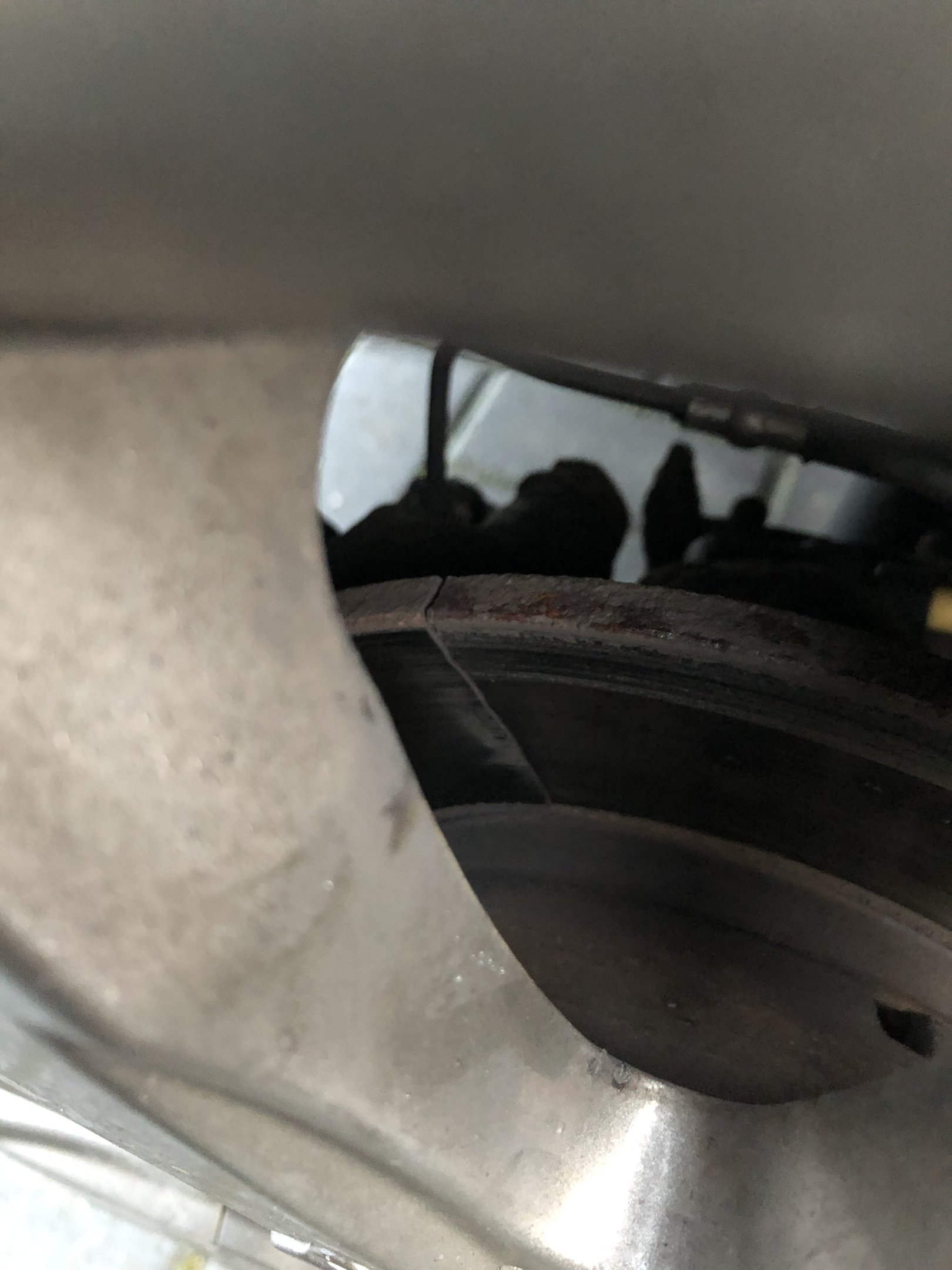

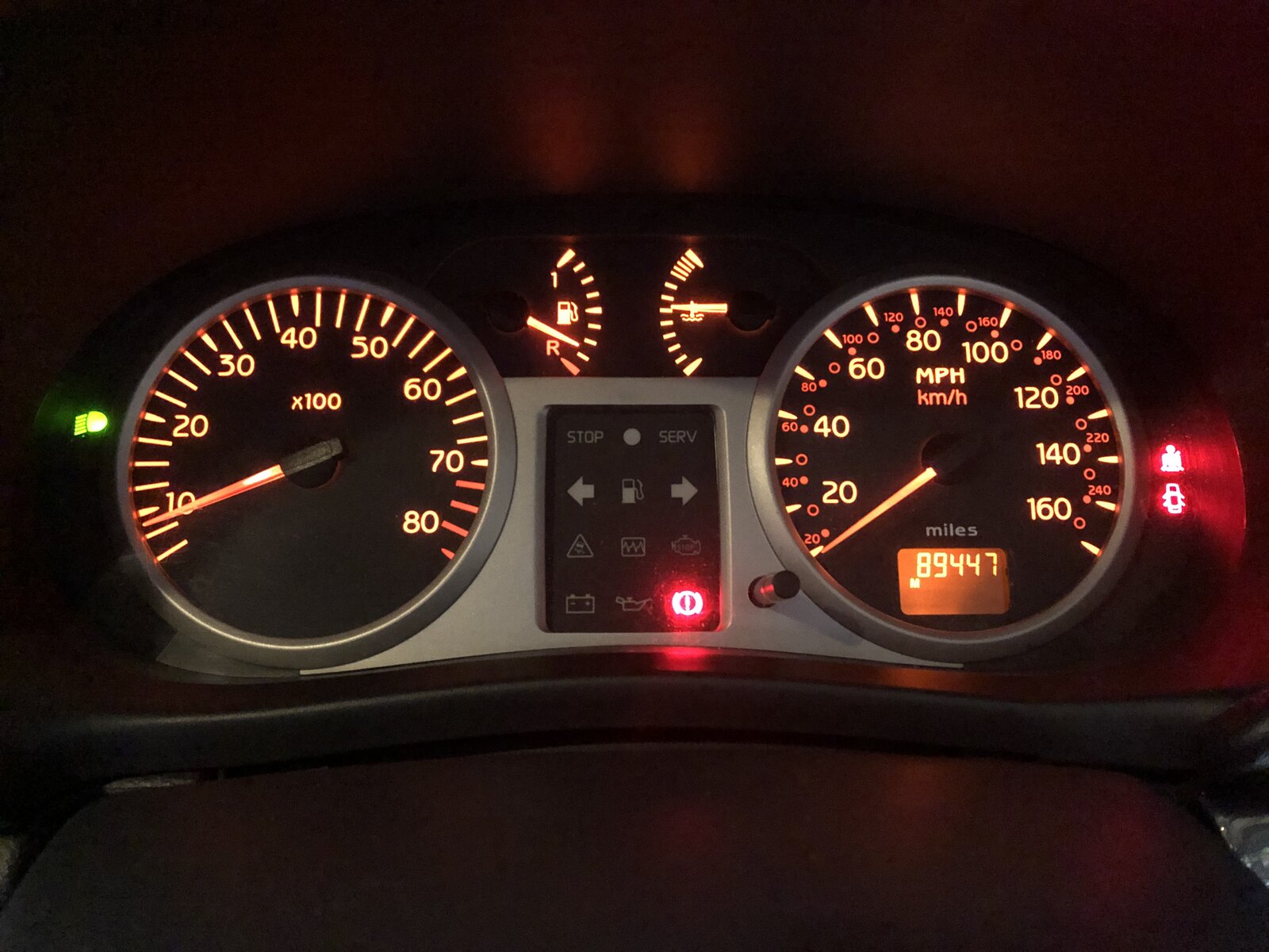

My rear brakes were an advisory on the mot and they dont seem to be working at all. The ABS and service light have came on the dash, along with the engine management intermittently.

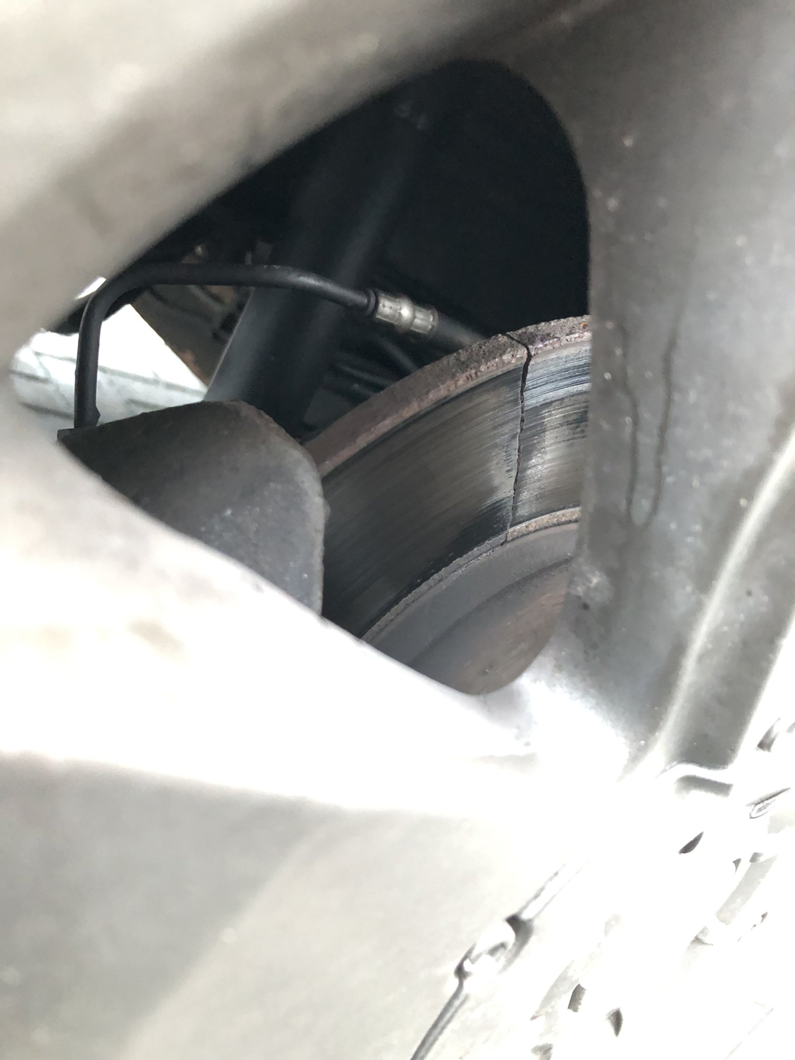

2 days before it was due in the garage i noticed one of the rear dics had a crack straight through it! So i knew it would need at least 2 new discs and had a feeling there was a calliper issue causing this.
The garage confirmed this so have replaced the following at a cost of £648!

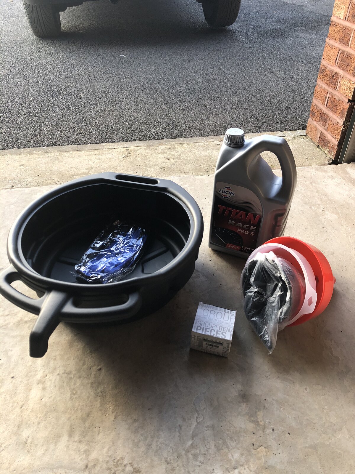

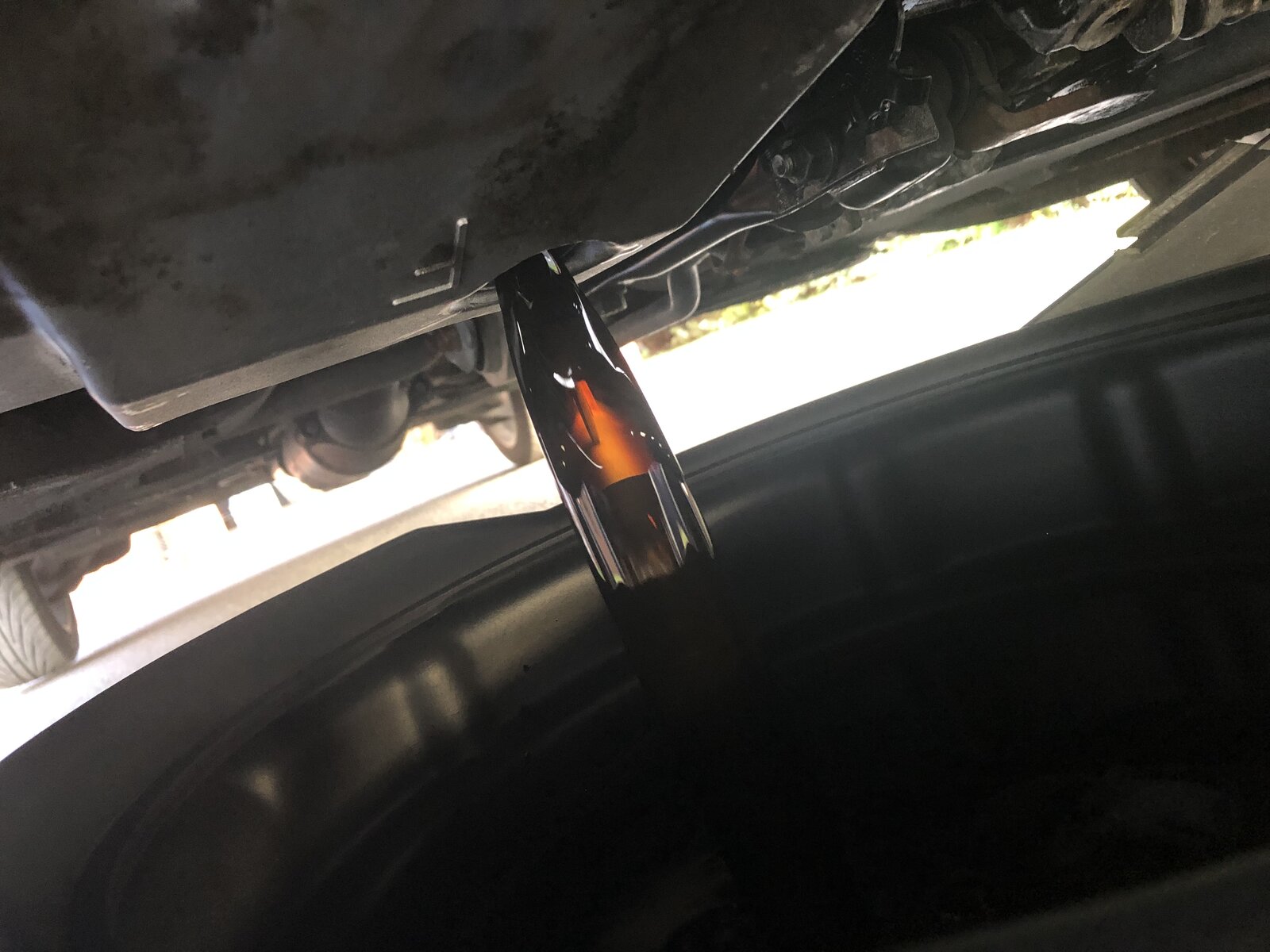

I took it to work today (50 mile) so I could service it when I got in this afternoon. It was last serviced in November 2018 so just over a year ago. I don't like going over 12 months in between services No matter how low miles it has done. Never mind, its done now and I will make January the annual month for service.
As usual, Fuchs pro s 5 40 used with genuine filters. I also put the replacement fuel rail guard on which I have had fo ages since I had to drill the last one apart to get the stuck nut off.

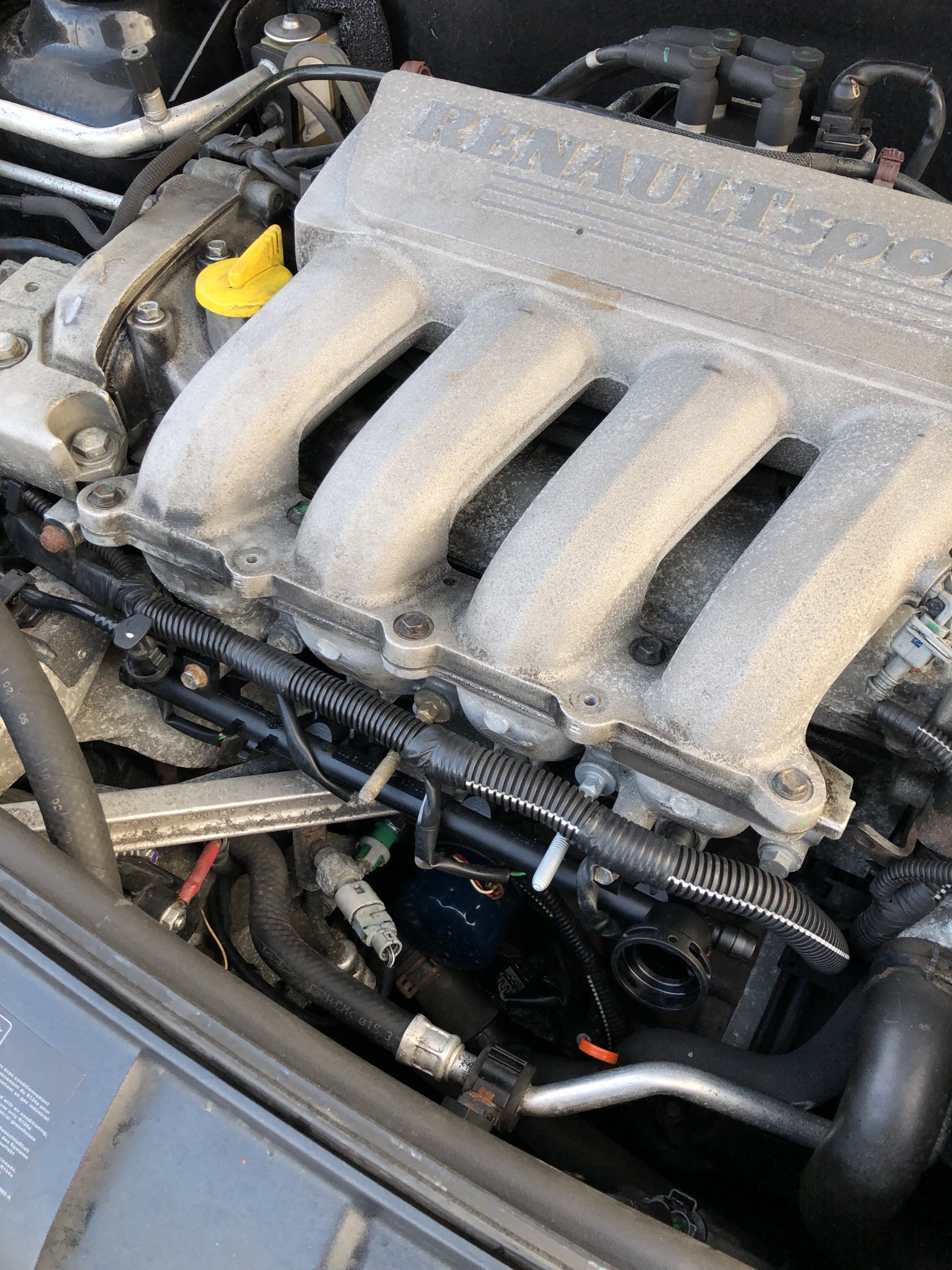

  182

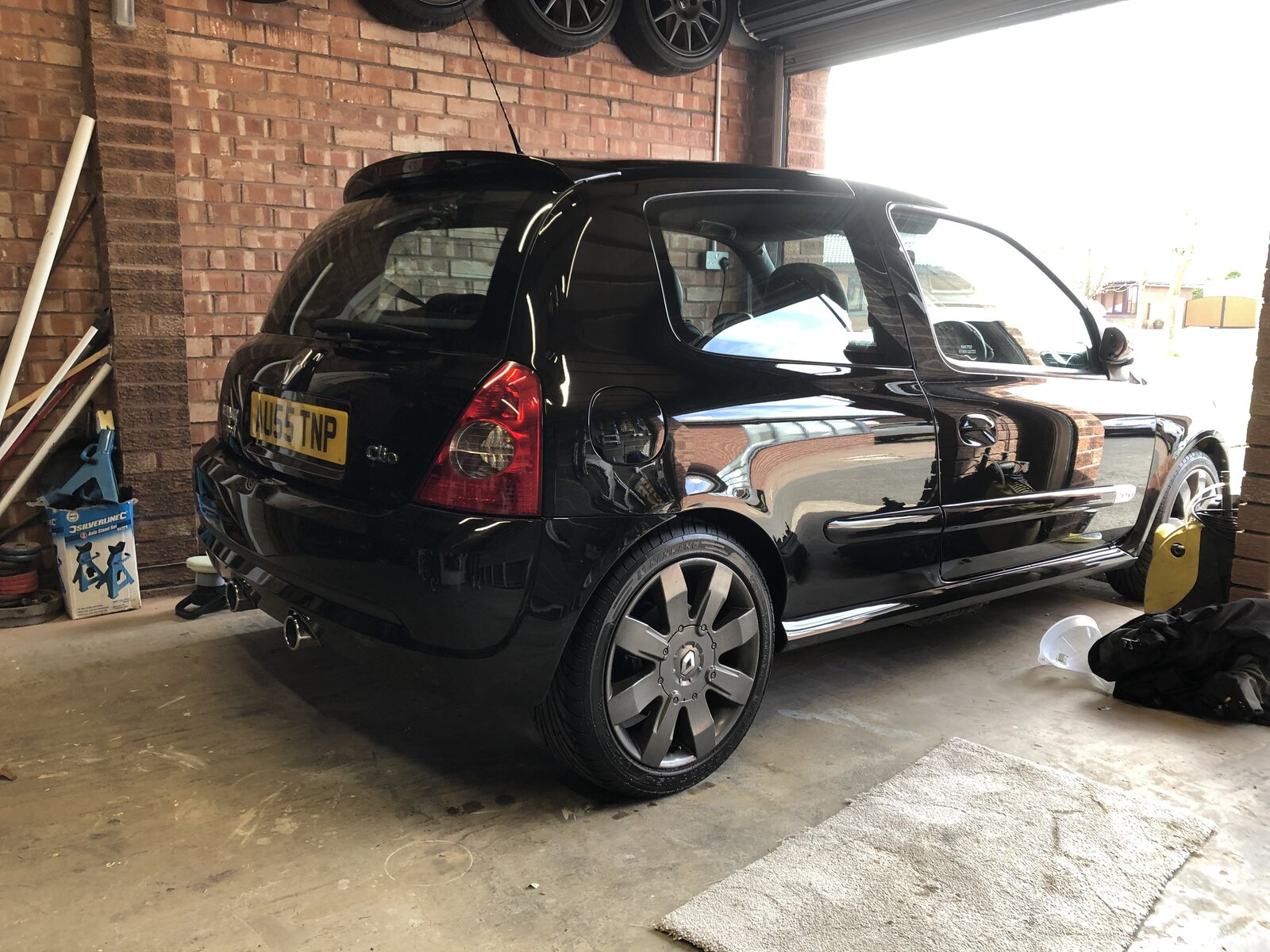

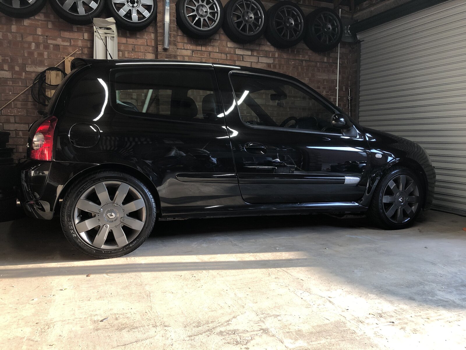

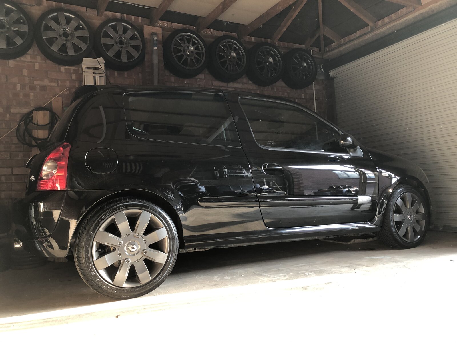

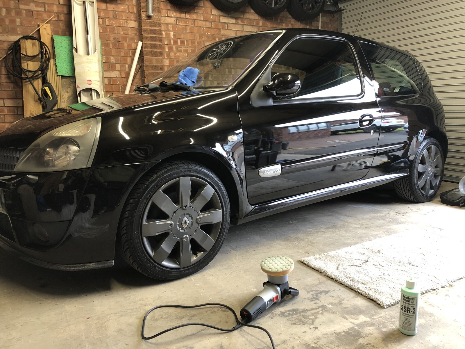

I got the clio out the garage today to clean the engine bay, door and boot shuts which have been on my list to do for a while as they were really dusty from some construction work in our old street. I also took the bonnet catch apart and fixed that as it had seized meaning the bonnet wouldn't shut.
While I was on I gave the exhaust a clean and polish which hadn't been cleaned for a long time.
Having a garage is a real luxury and your car is protected so much more which is a great feeling. Something I have dreamt of for the last 12 years I have owned the 182. The car itself needs a clean but still looks great just because of it being kept in the garage since it was last washed over a month ago.

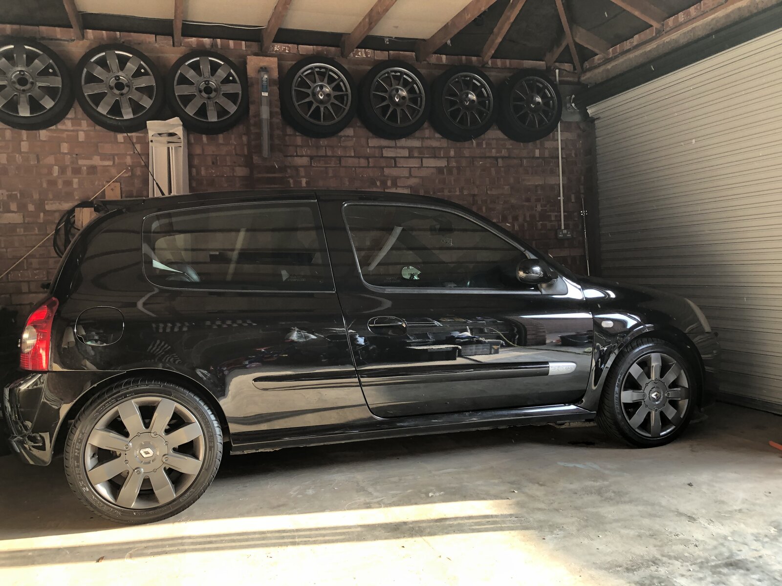

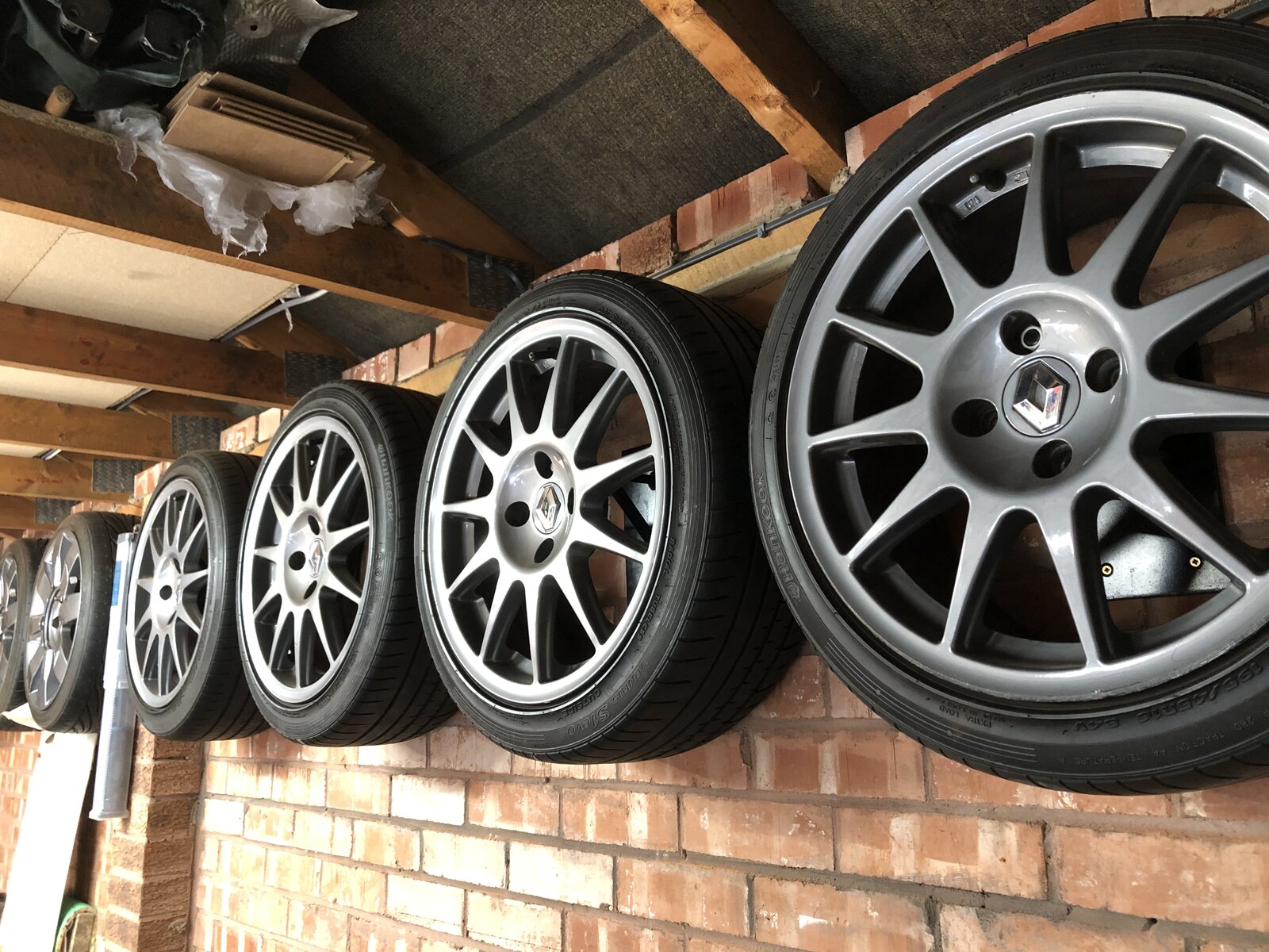

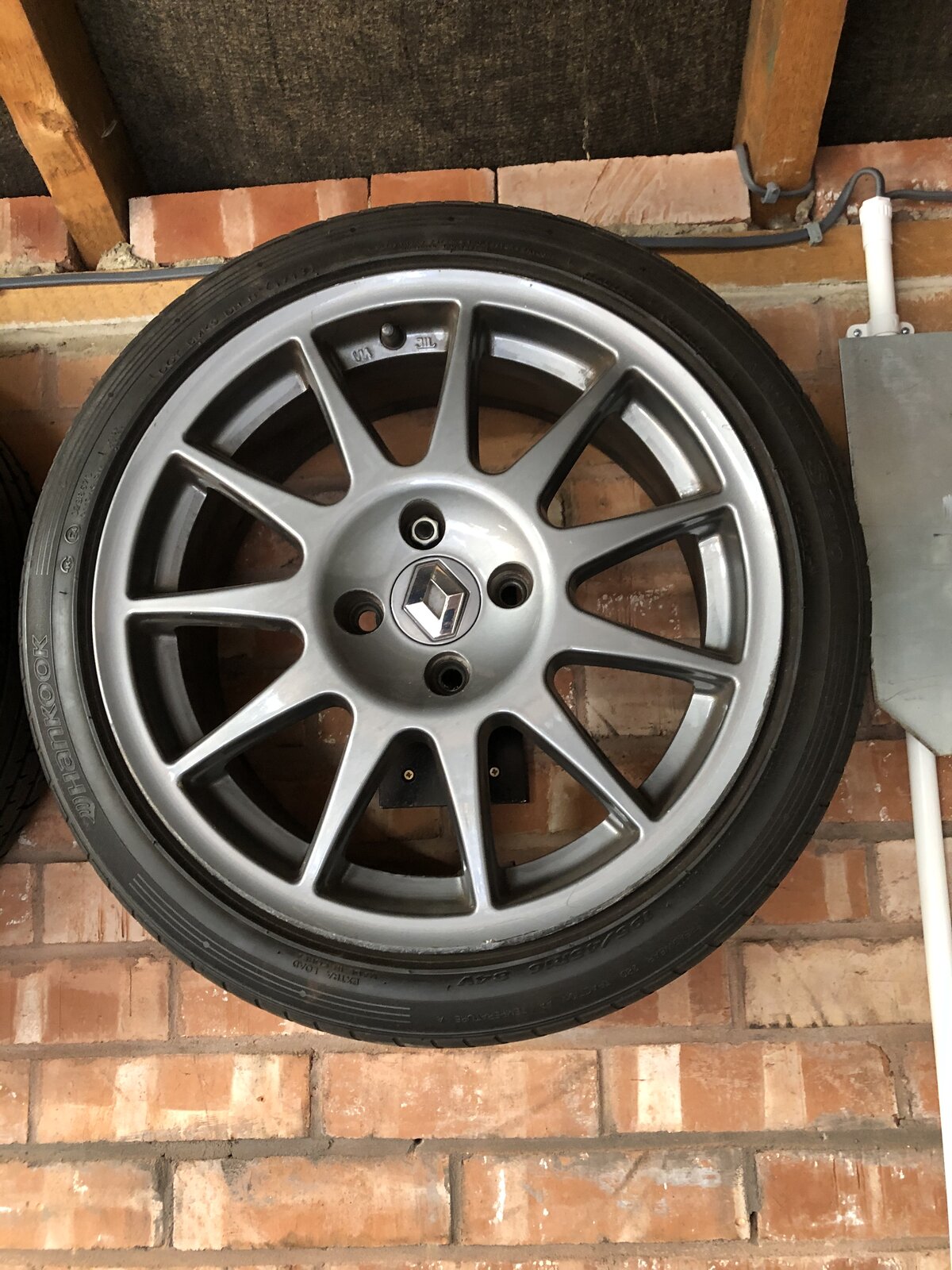

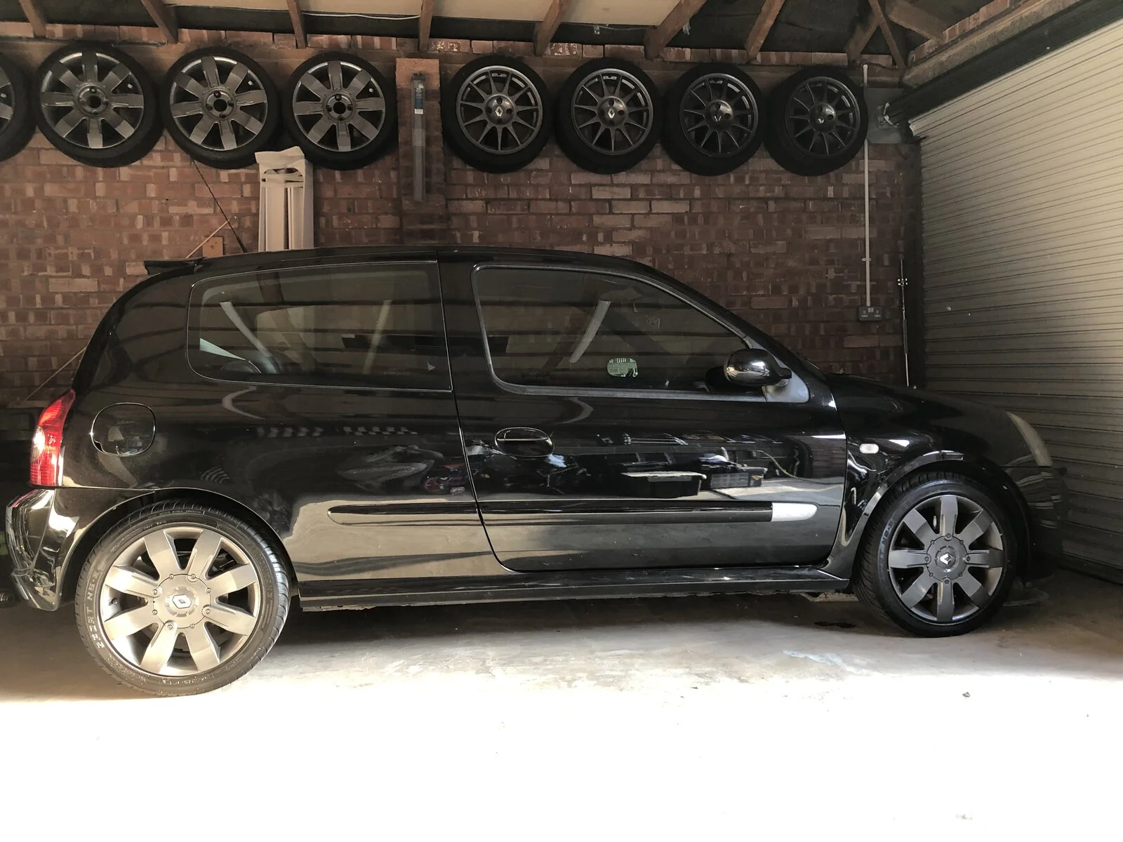

Also got all of my spare wheels up on the wall with some custom floating brackets I had welded up.
  182
Garage looks lovely and nice size! Take it the wheels bolt onto the brackets.
Love a BG 182 too.
Thanks mate, its a beauty indeed and loads of space. Looking forward to getting the machine polisher out in it.
Yes thats right, wheel slots on through one of the bolt holes and they were threaded so I can put a nut on the end for extra safety to make sure they don't slide off lol.

  440i + 182
Glad to see you still have this, lovely car and I love the wheels wall mounted. Was that something you to had made or something I could purchase off the shelve?
mossyv6
  Trophy,V6,5GT,AG200
Looking great mate :)
And that is a great idea with the wheels - I maybe pinching the idea!
Thanks Greeny, had it such a long time now and will never sell it.
Brackets were made for me by a family member. I did ask how much he would charge if he made some sets up to sell and he would be looking at £100 ish for time and materials. Obviously a lot of money for some brackets but if anyone was interested I could supply them.

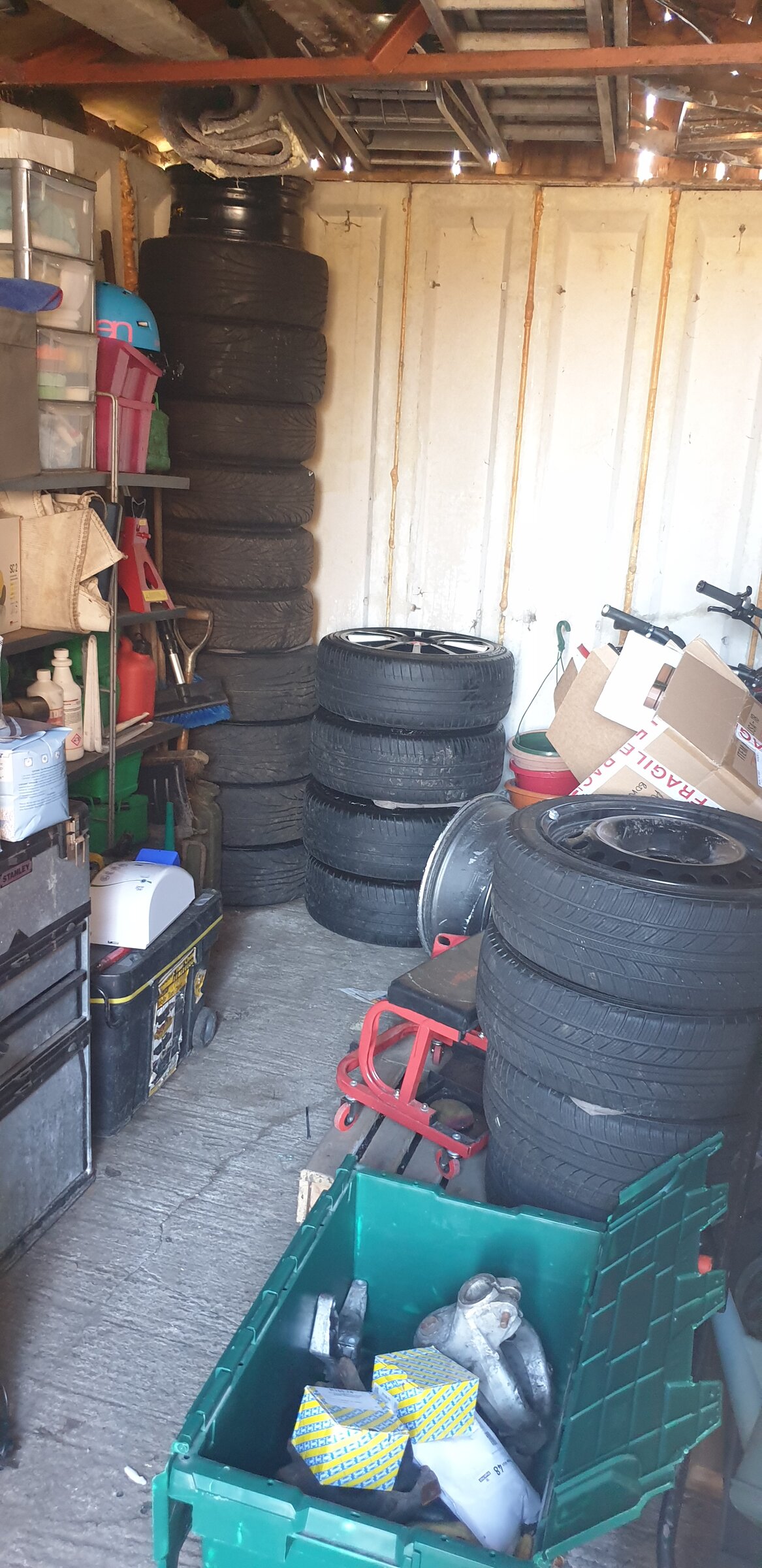

top garage setup Austin, proper jealous here! also those wheel holders look ace too... how many bloody wheels do you need ?!
Thanks Mazz, lol the 182 cup wheels are the standard wheels from my car and the other set are genuine trophy Turin's which I have had for about 8-9 years now.
The 182 wheels currently on my car I only paid £150 for a few years back and all had brand new tyres so it made sense as my standard 182 wheels at the time needed 4 tyres anyway.

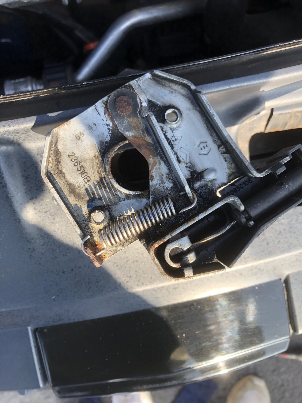

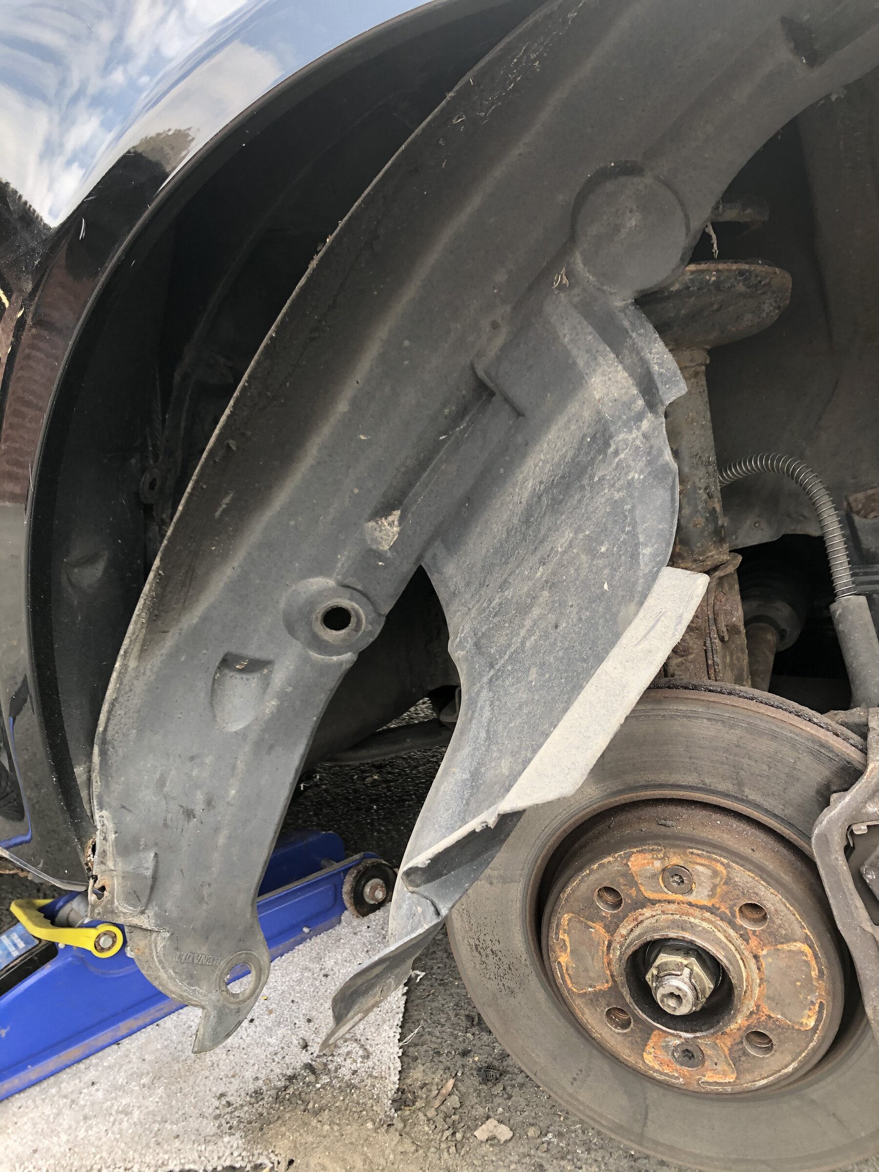

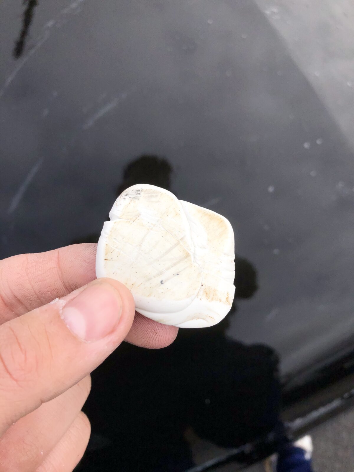

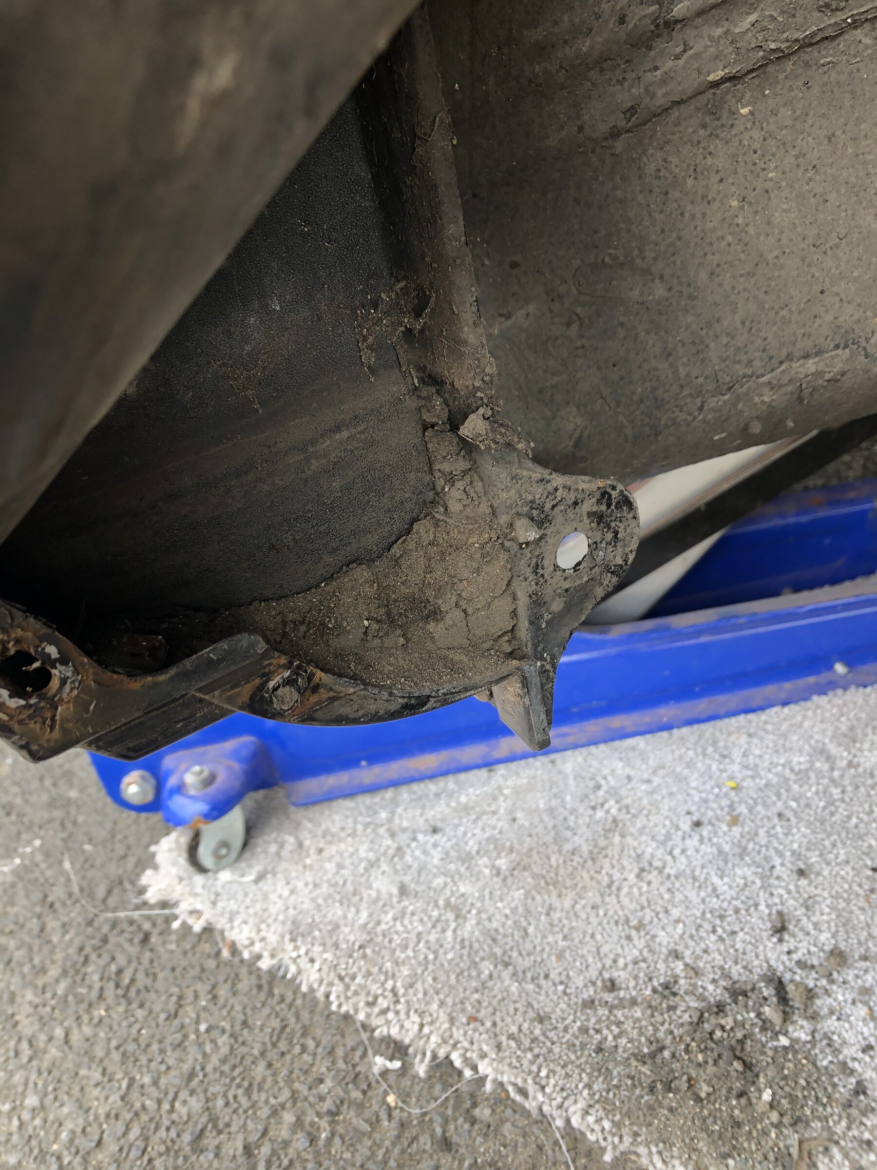

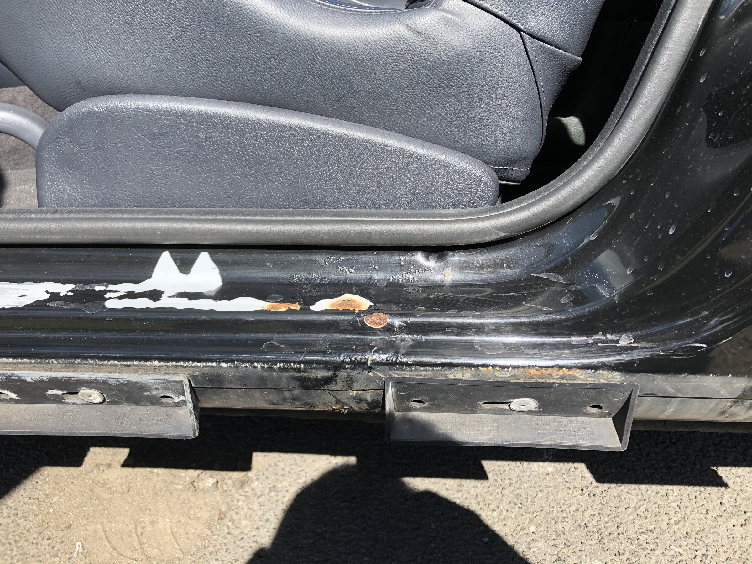

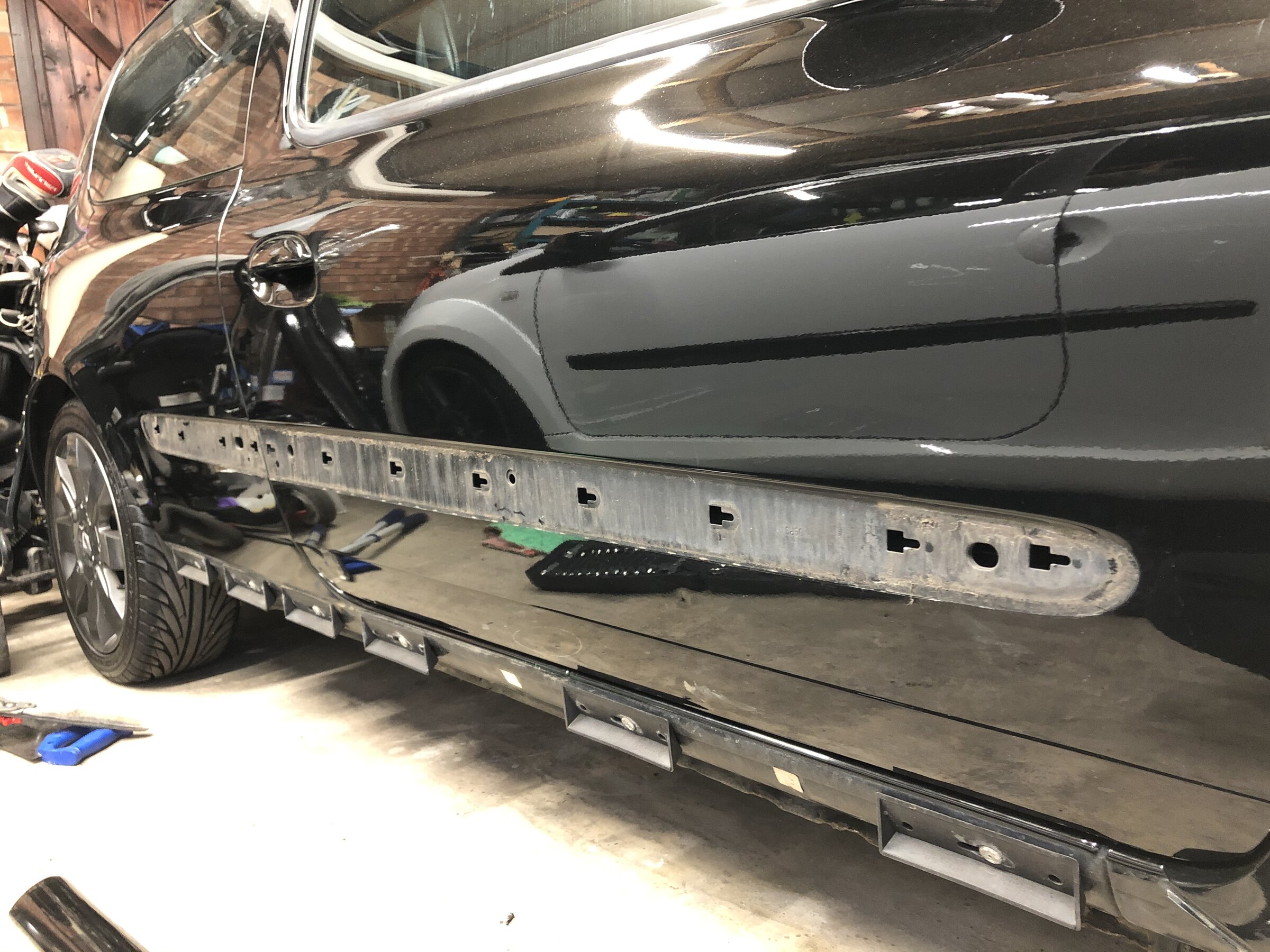

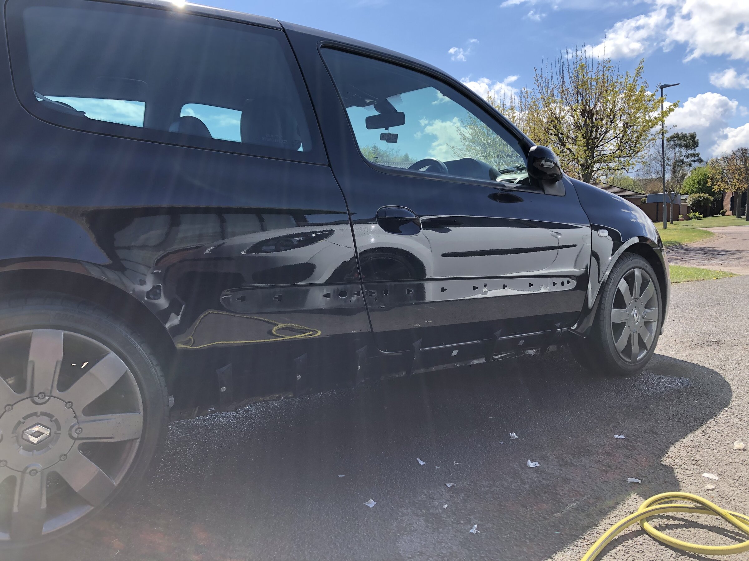

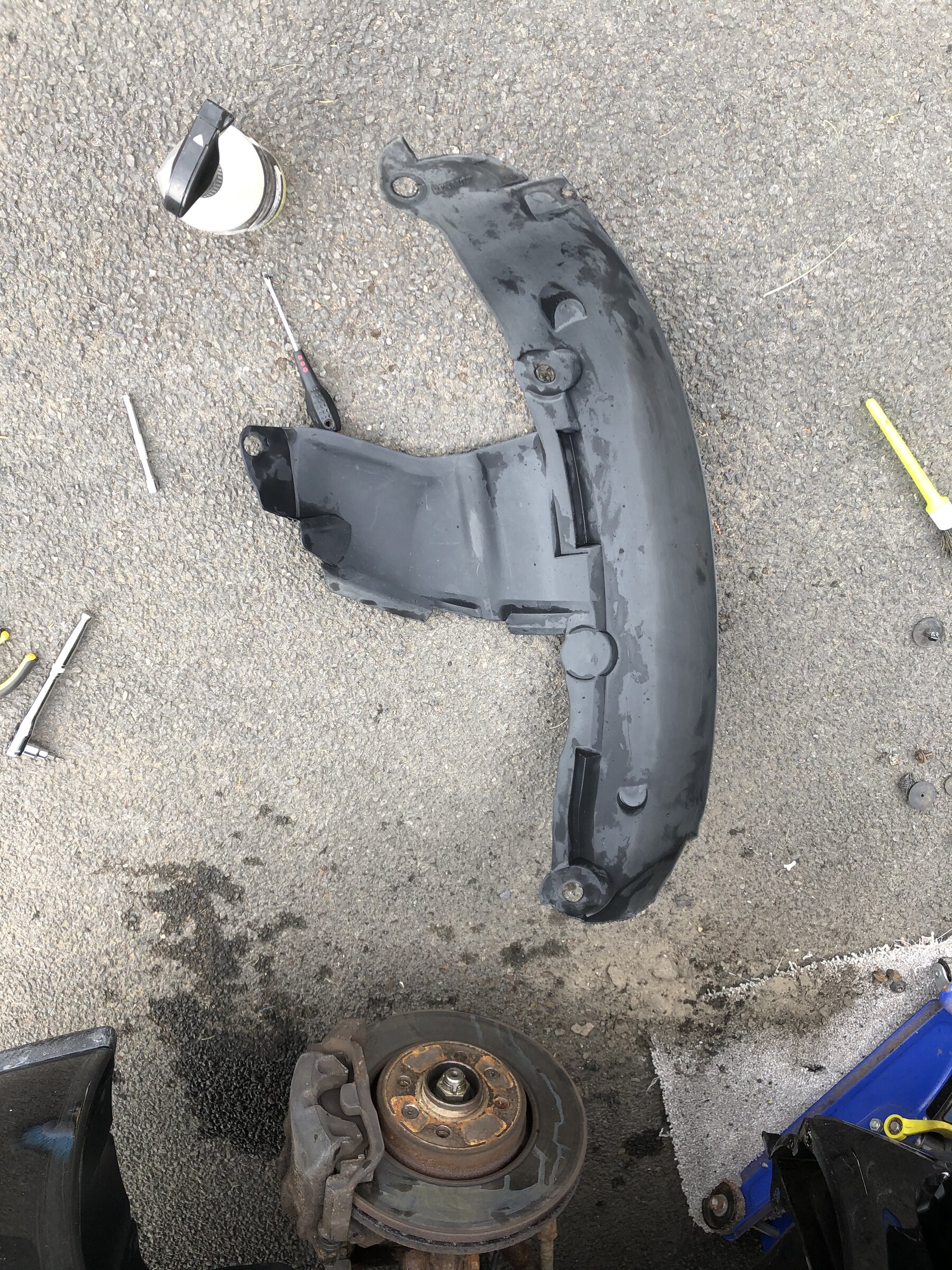

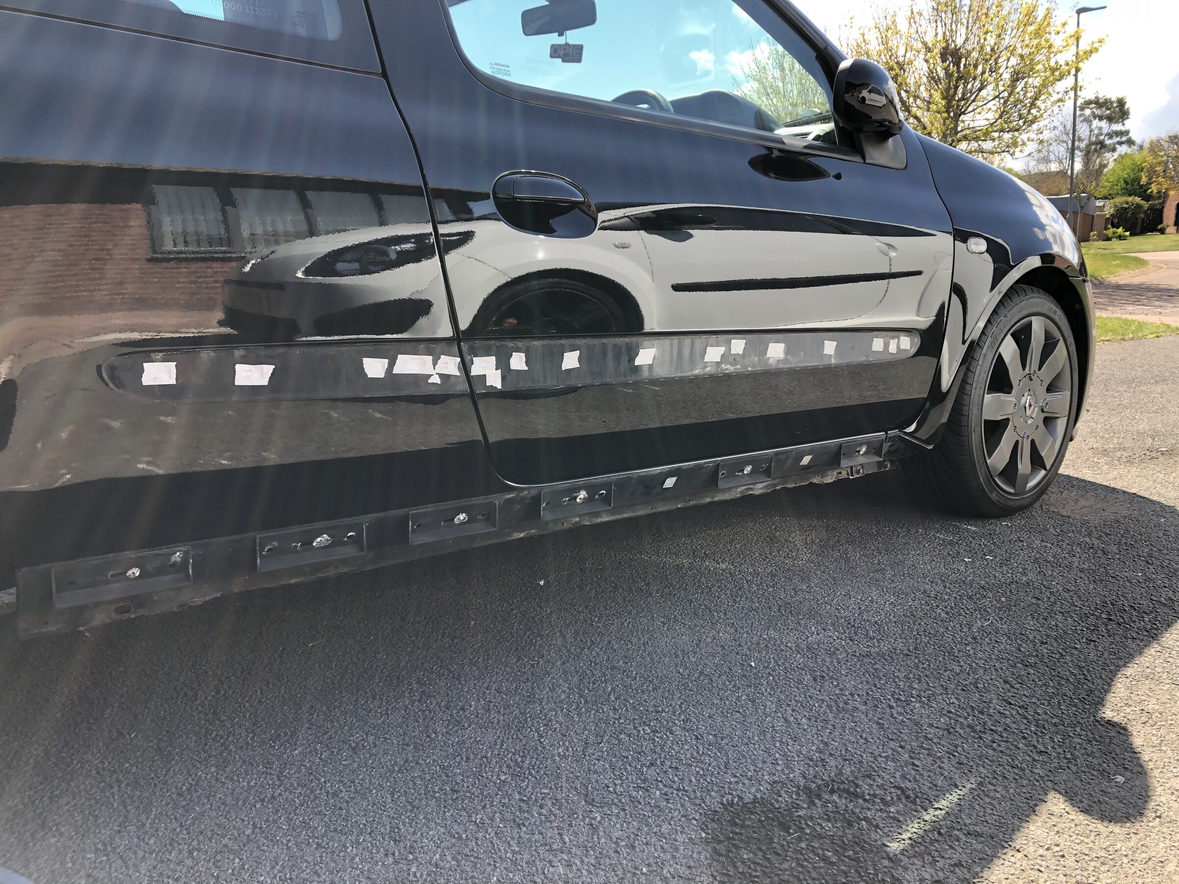

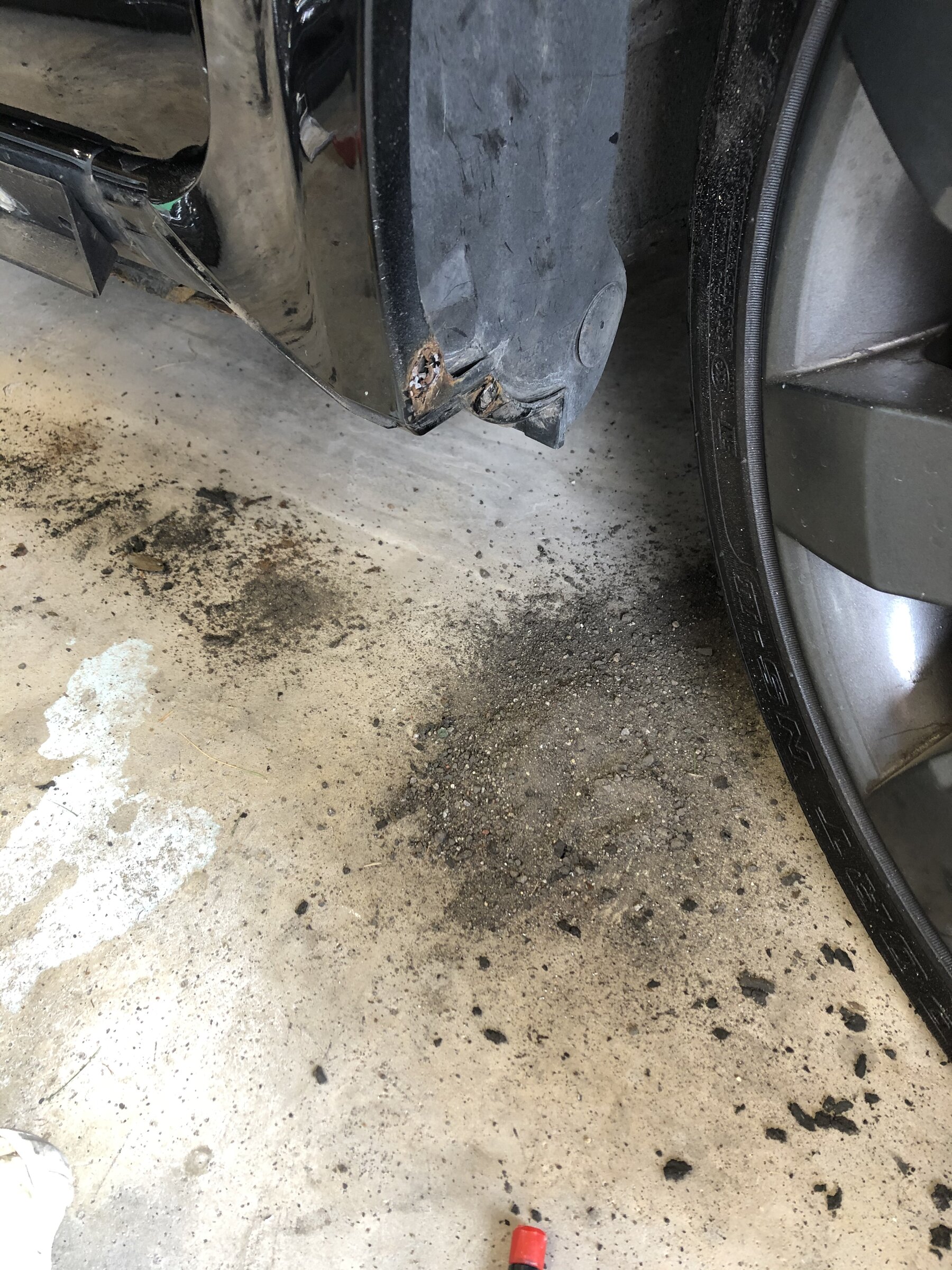

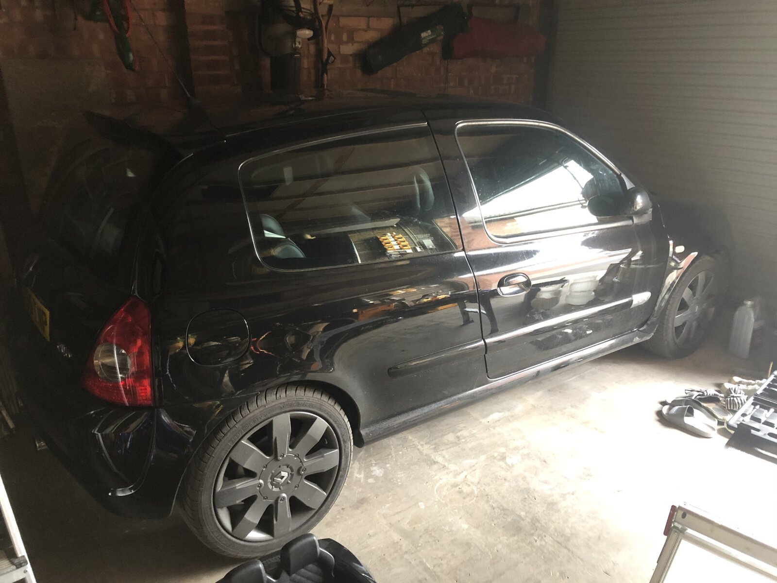

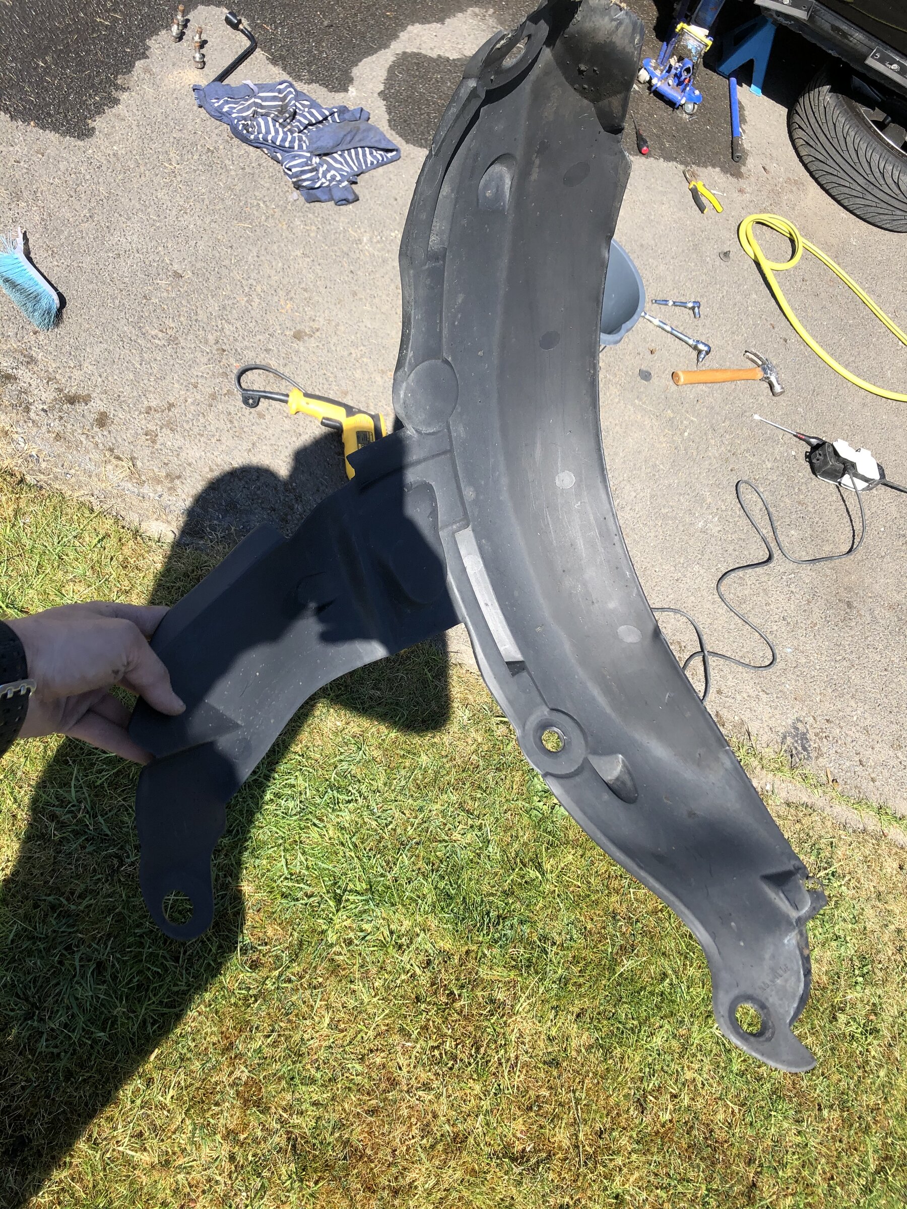

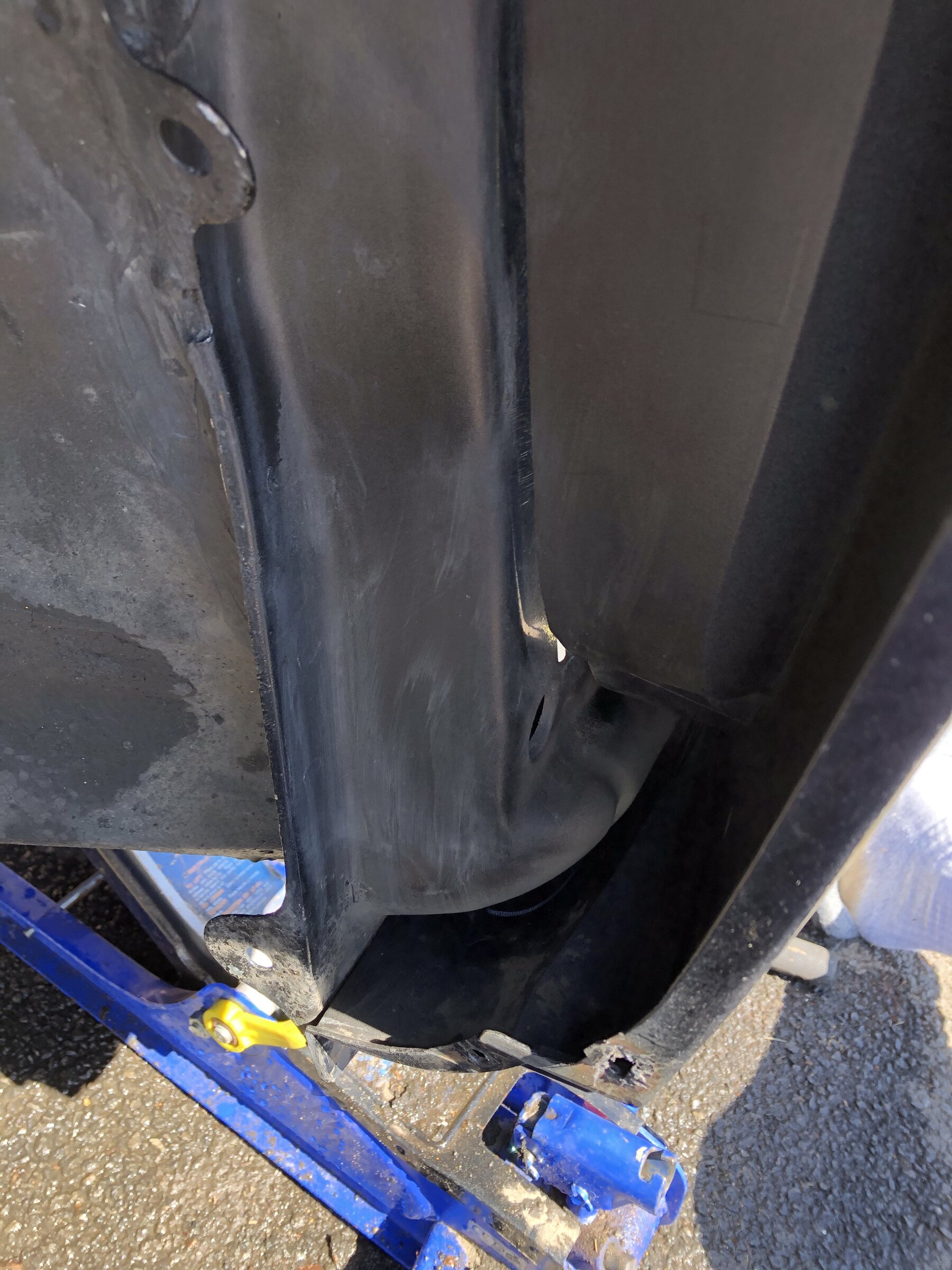

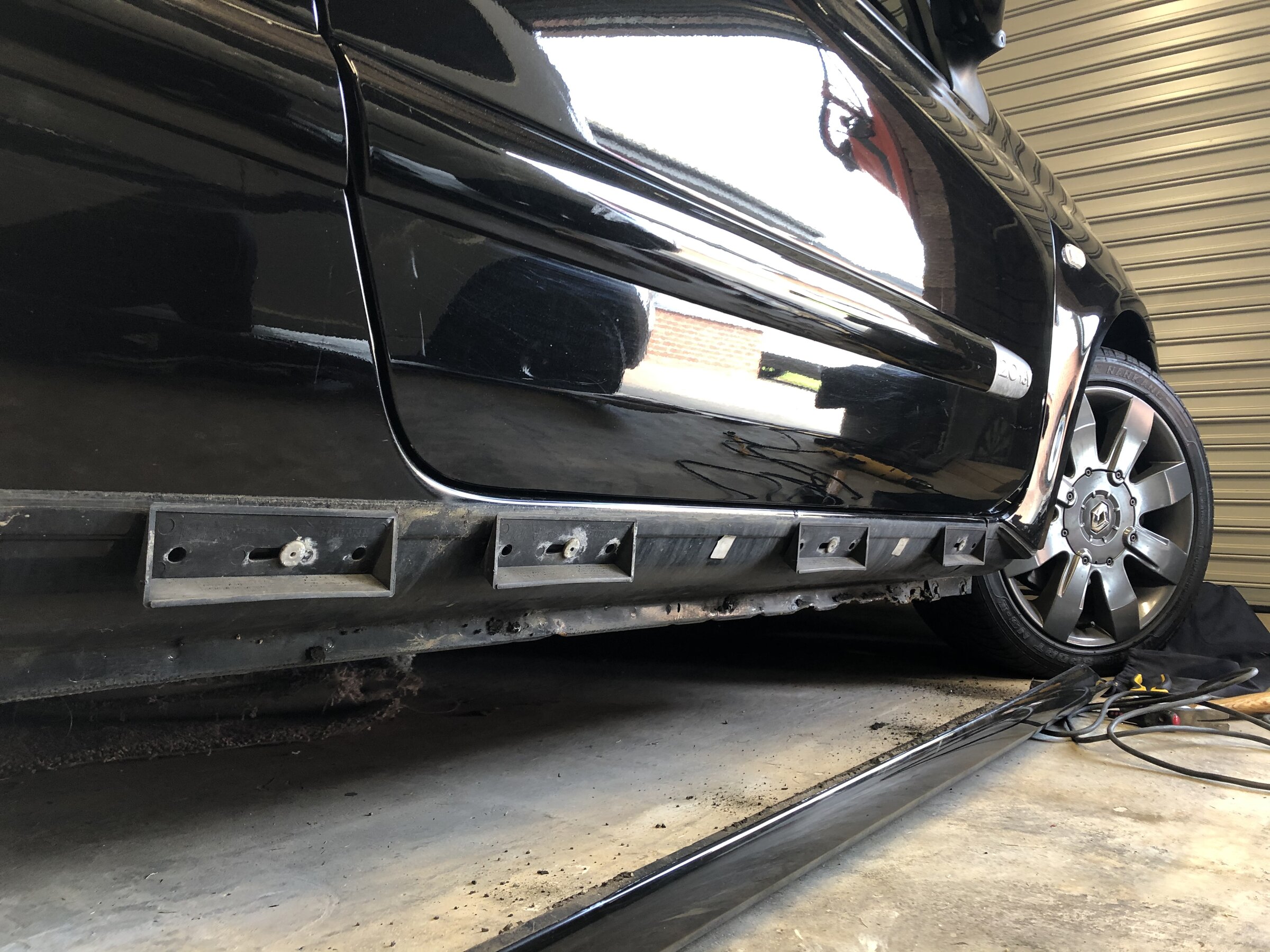

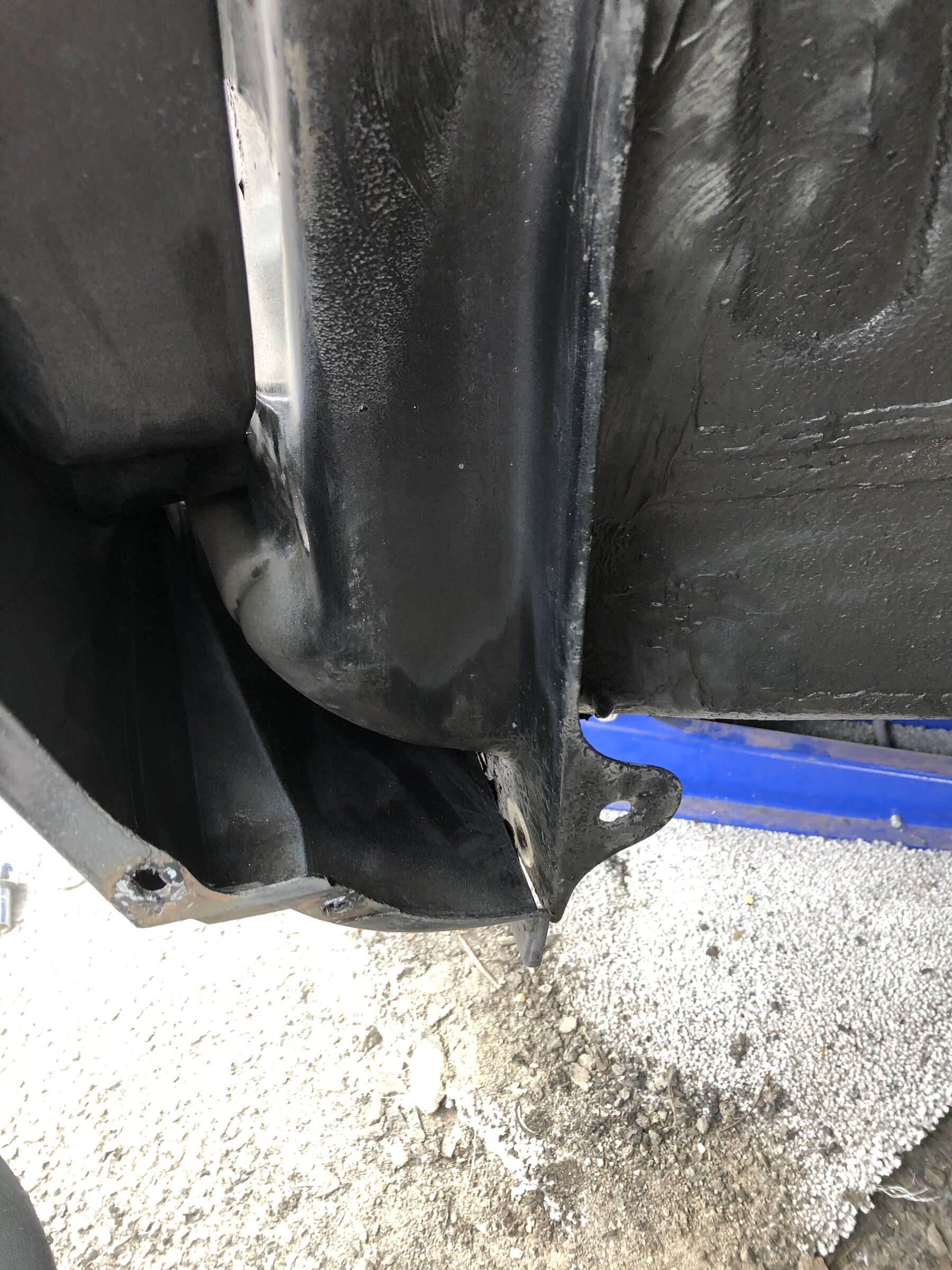

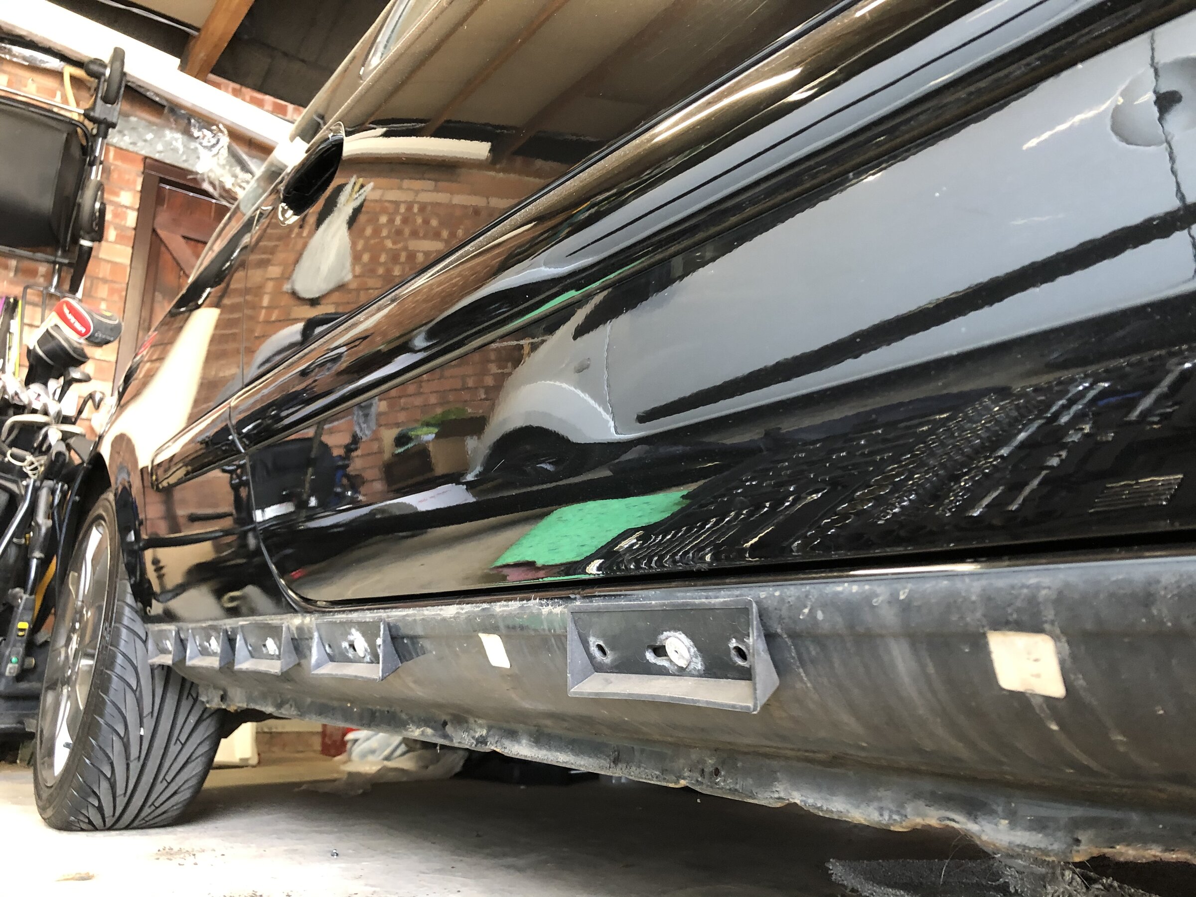

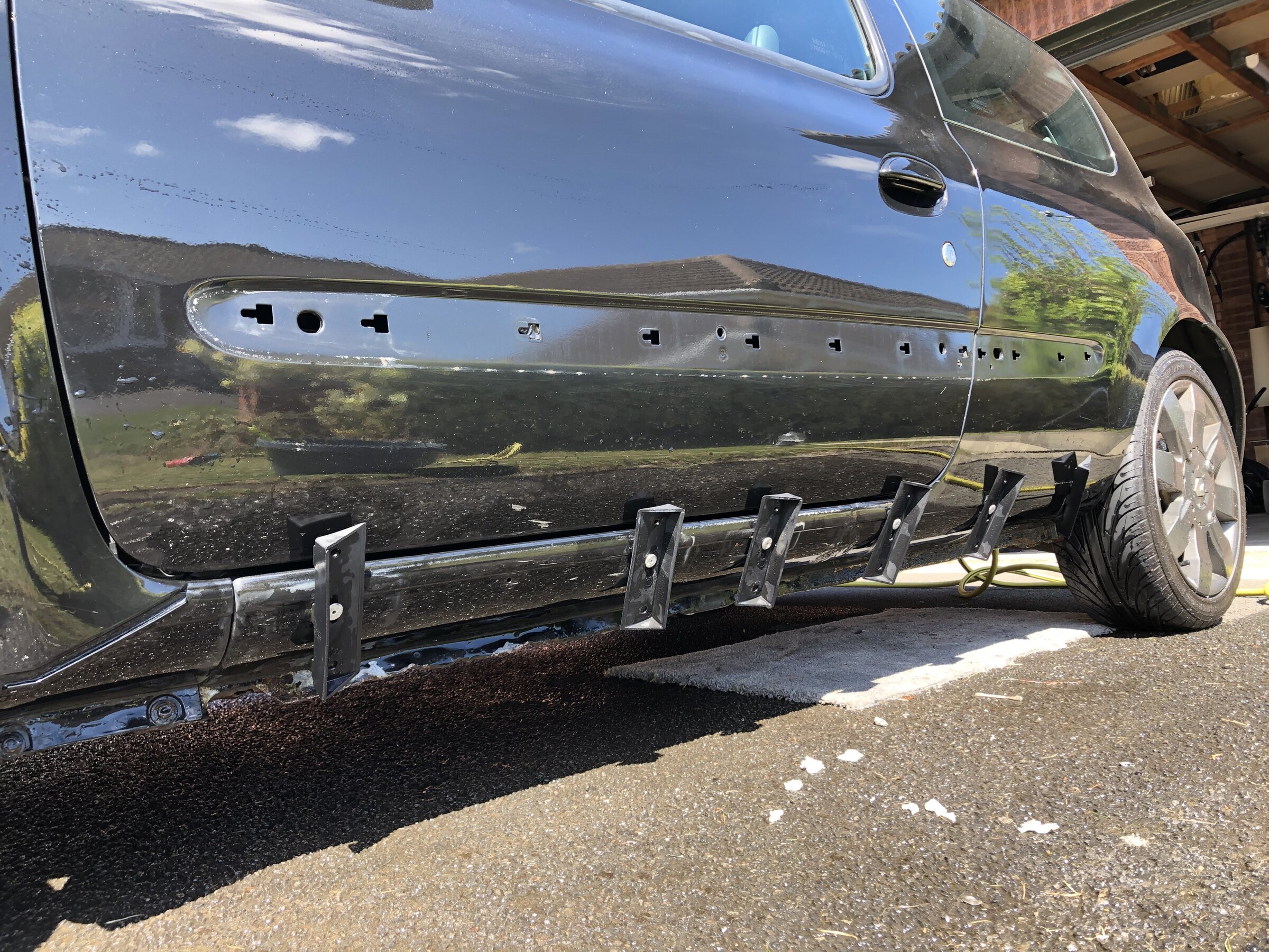

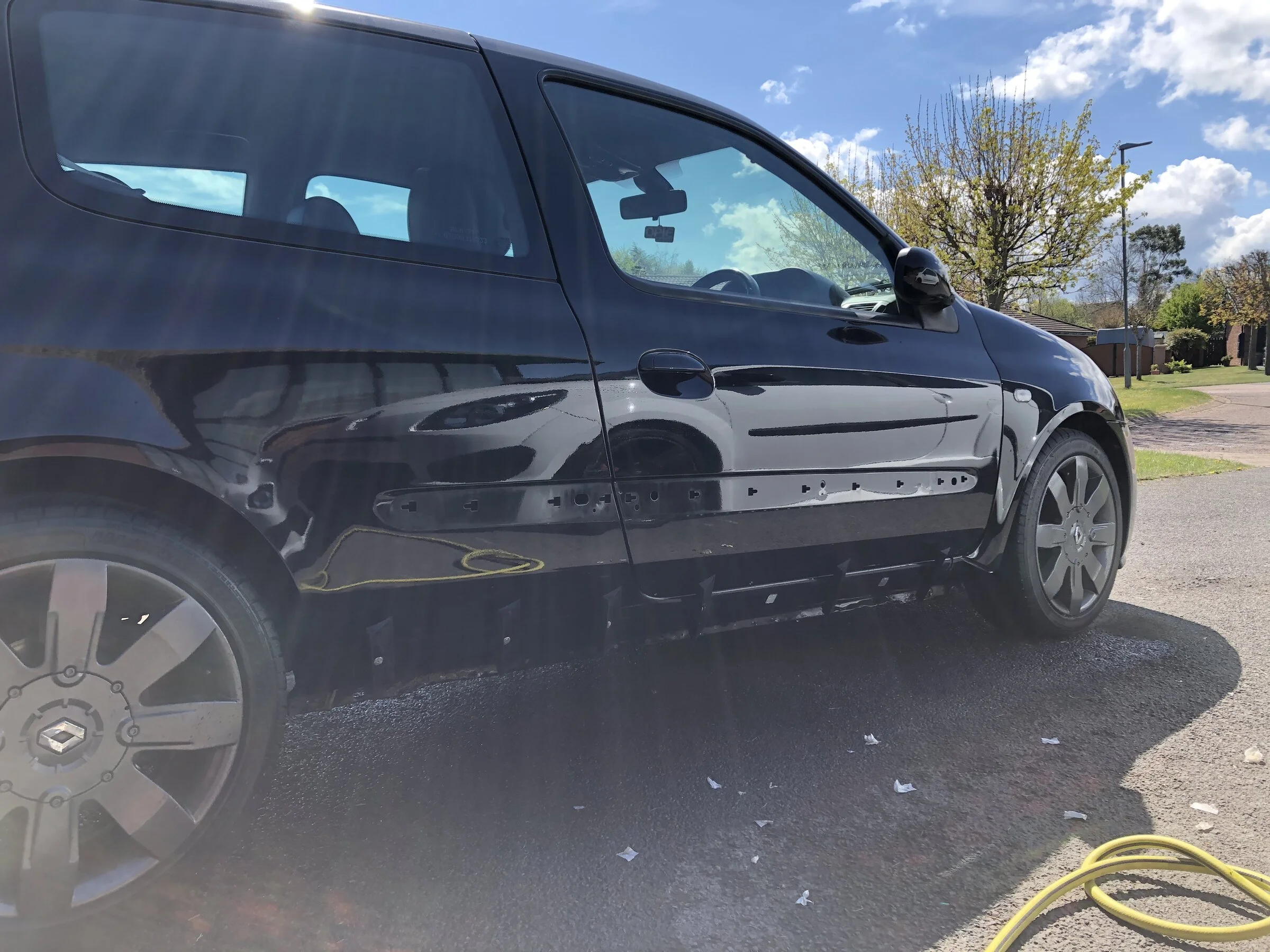

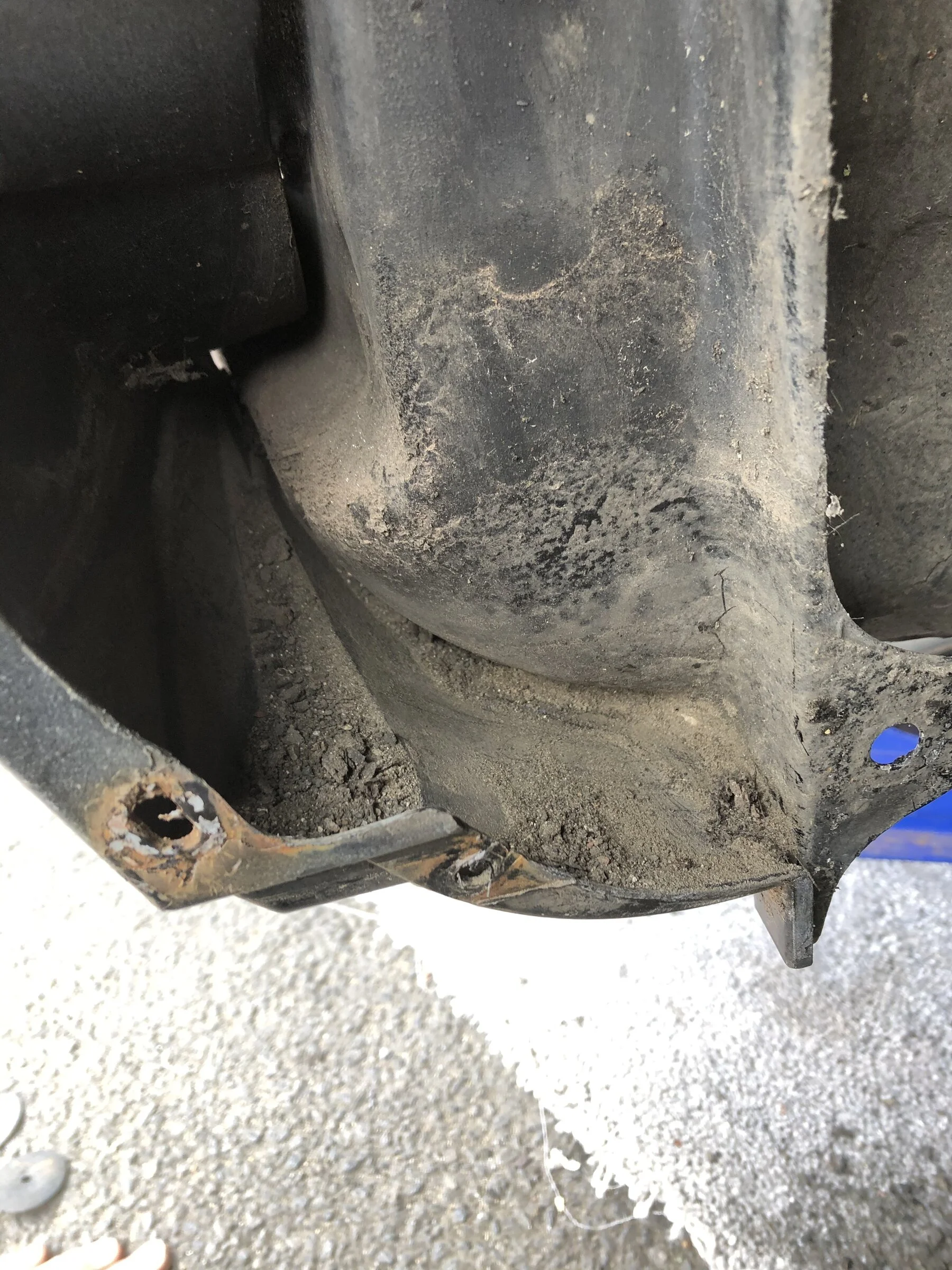

After wanting to remove the side skirts for a long time now I decided today was the day. The sills have annoyingly been squashed like most clios and started to go rusty. I will straighten them as much as I can and might look into some rust prevention, but will need to read up as have no idea where to start.

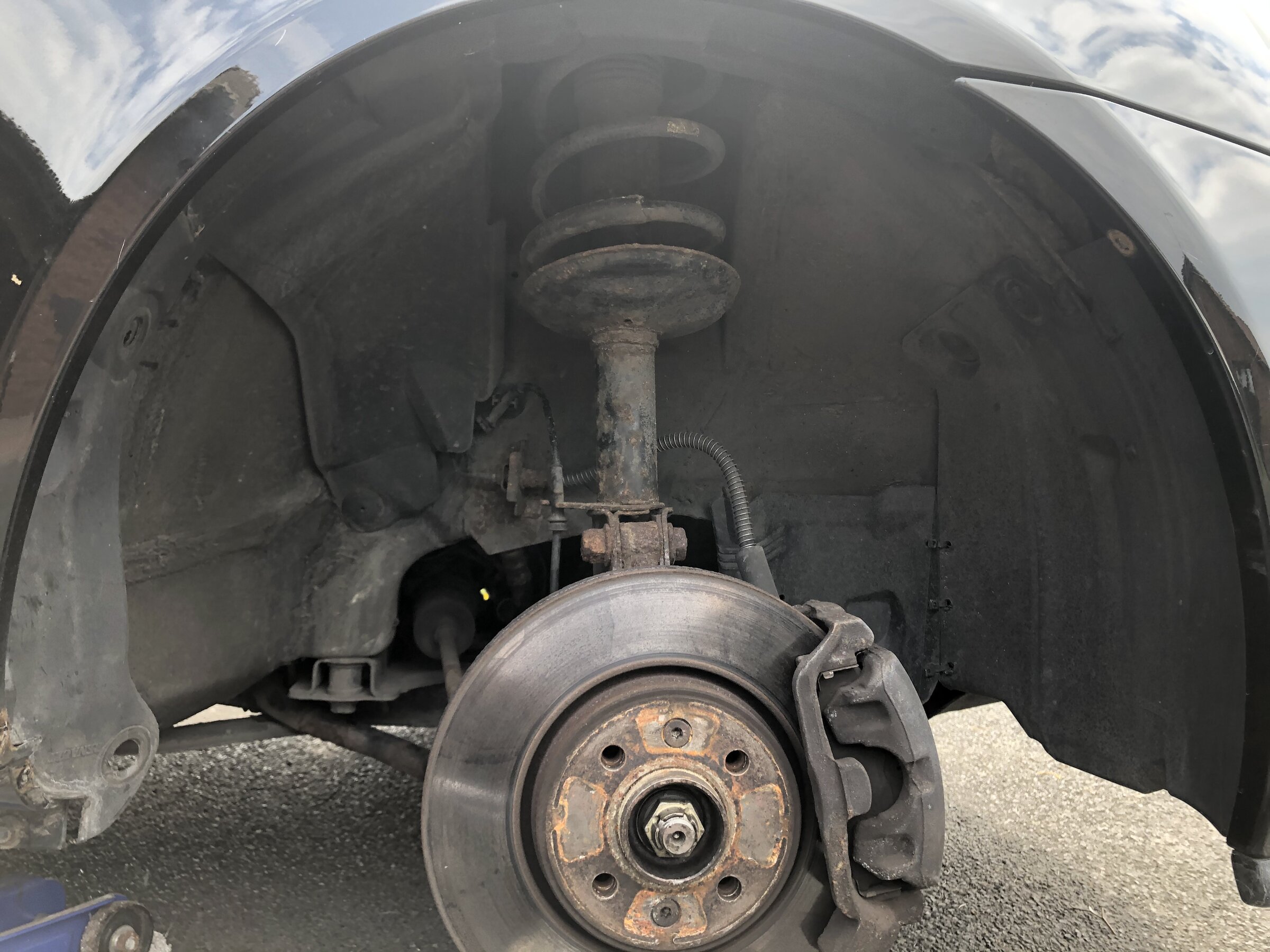

I removed the drivers side first and decided To take the front arch liner out while I was on after seeing recent threads on here and there being a lot of dirt piled up behind them. No surprise mine were exactly the same....
I have took the side skirt off the passenger side and need to do the same with the wheel arch. The passenger side sill has quite a bit of rust which has been visible for a while now, just where the renaultsport plate sits. I think this will need to be dealt with by a body shop at some point.
Rivets were drilled out which was easy! Screws in the wheel arch also needed to be drilled out which was a pain of a job to do! New m6 flanged bolts ordered along with arch liner clips as they were damaged removing them.

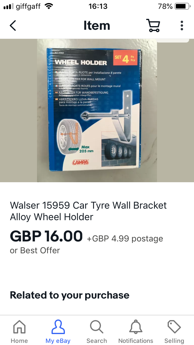

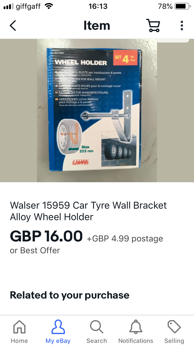

I said it was an awesome idea and then found these on eBay (thanks matey):

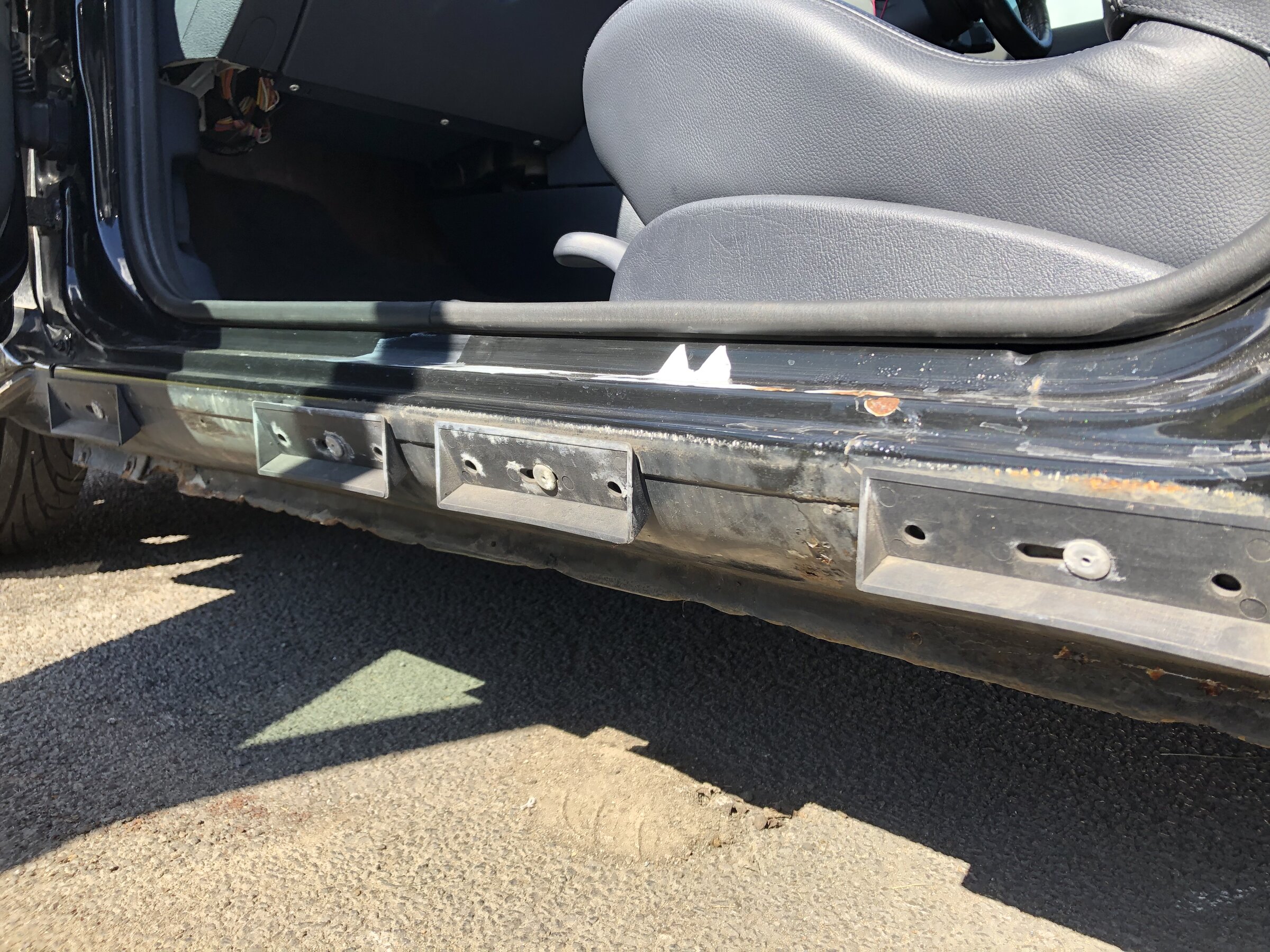

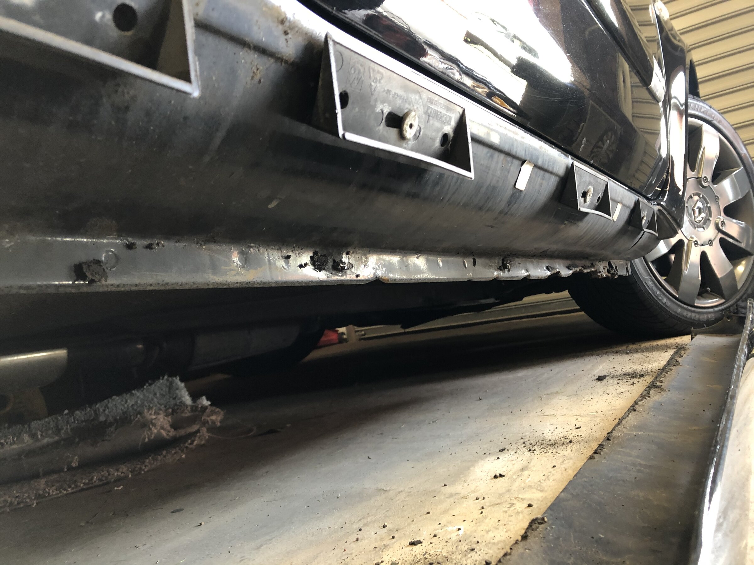

Passenger side sill is worse and a big bit of rust that is going to need sorting properly. I will get a price at some point for it all but for now at least its all cleaned and the pile of dirt is removed. It will remain In the garage and only come out in the dry so hopefully that should prevent things getting worse.
  182
Has it had side impact or been a cut and shut?!
Never seen a Clio rust there before
Not as far as I'm aware mate and I have owned it for 12 years now lol. Water used to sit at that point when it had rained and I wonder if thats got in the side skirt and rotted away

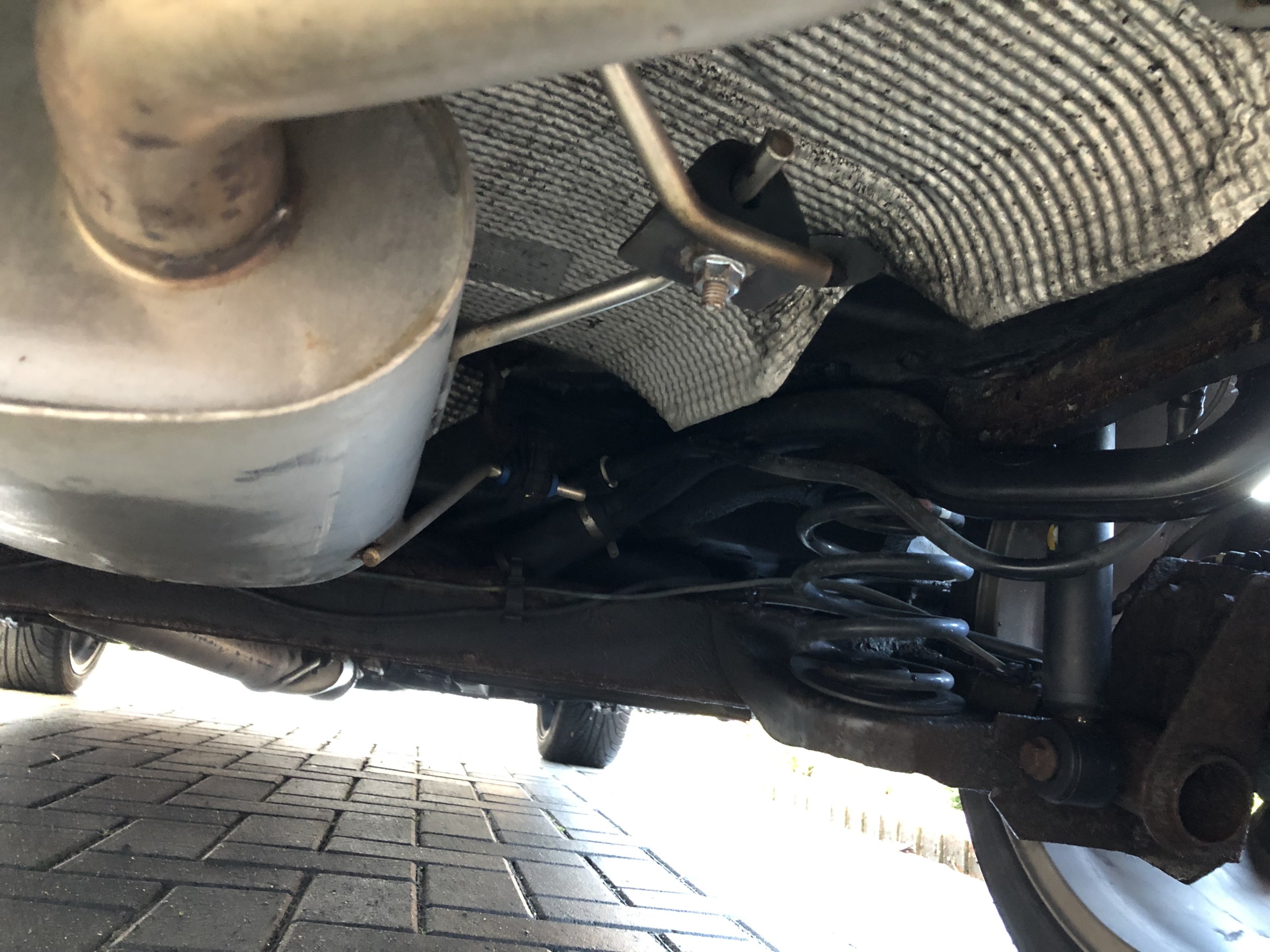

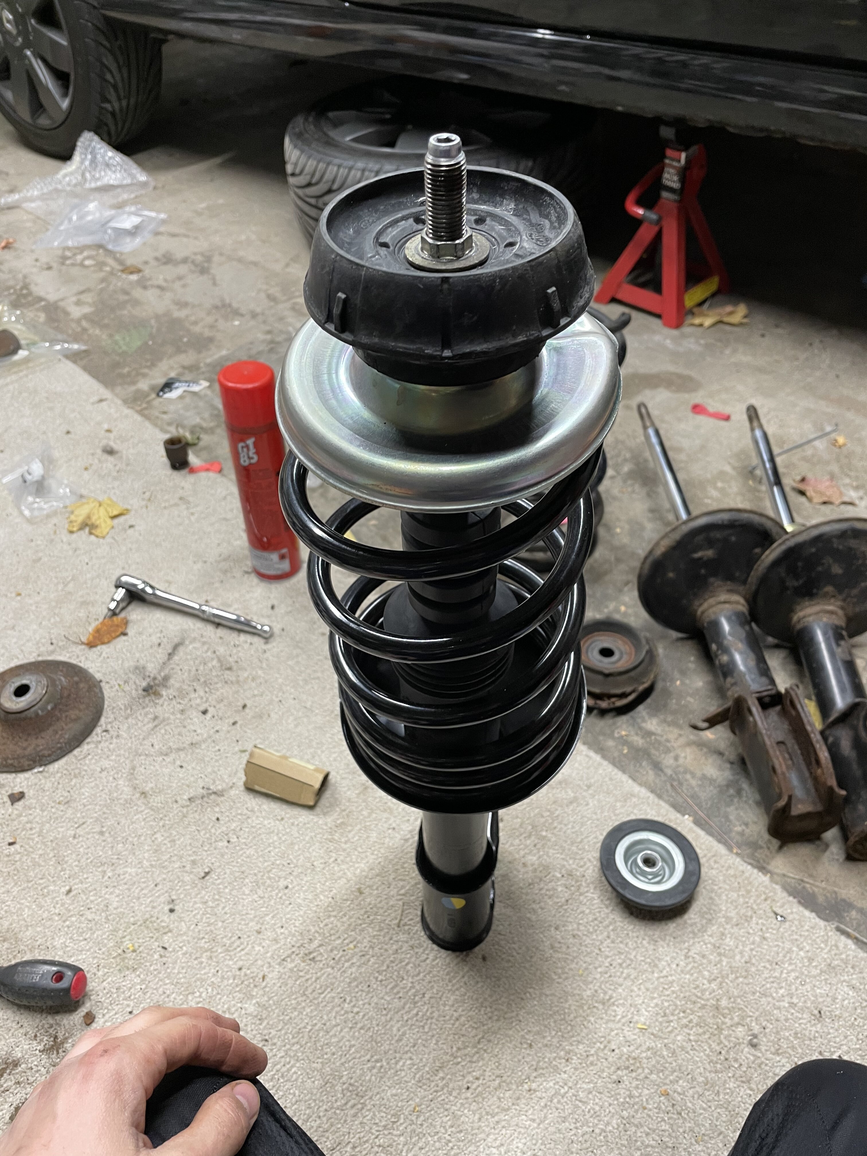

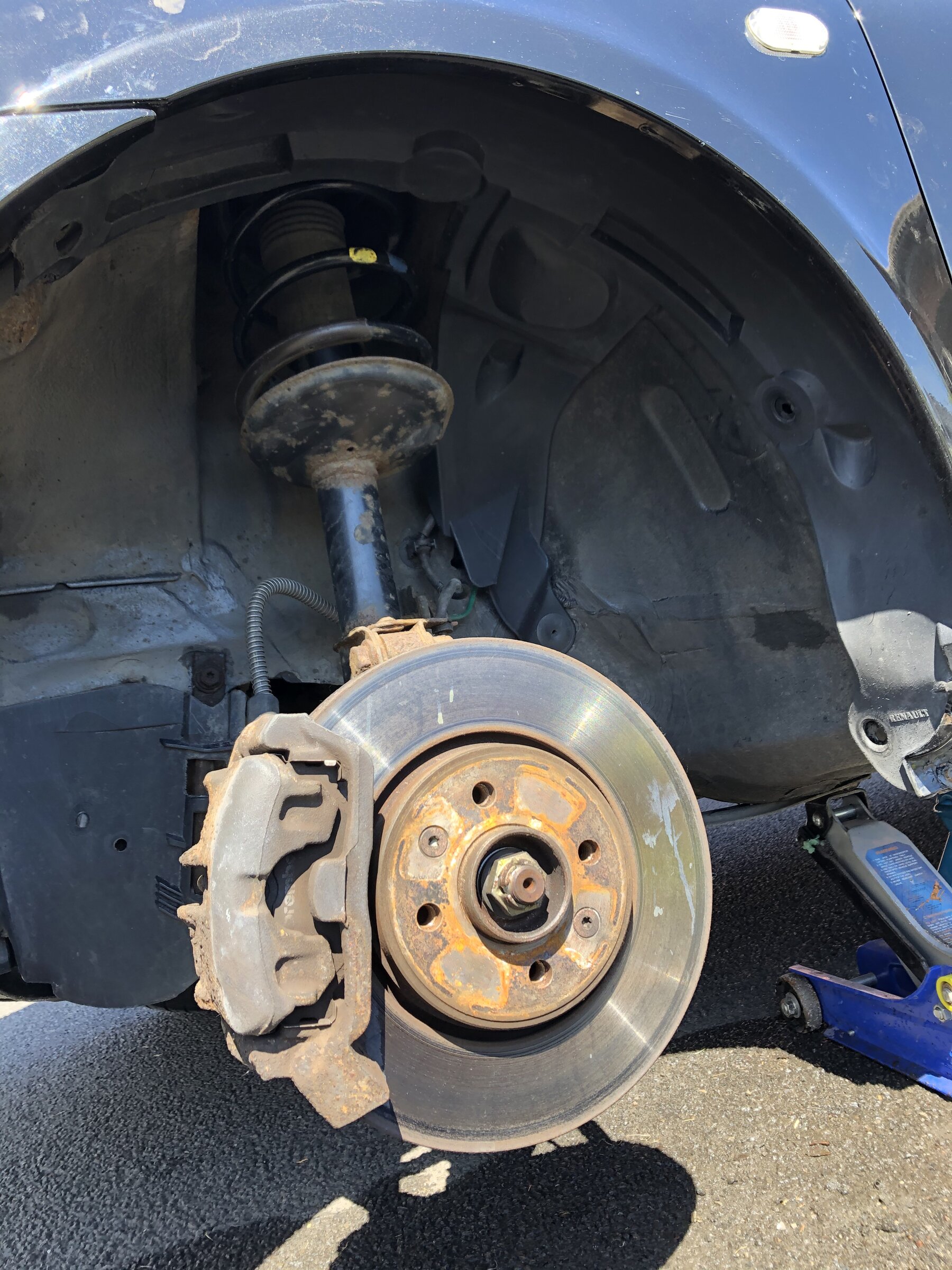

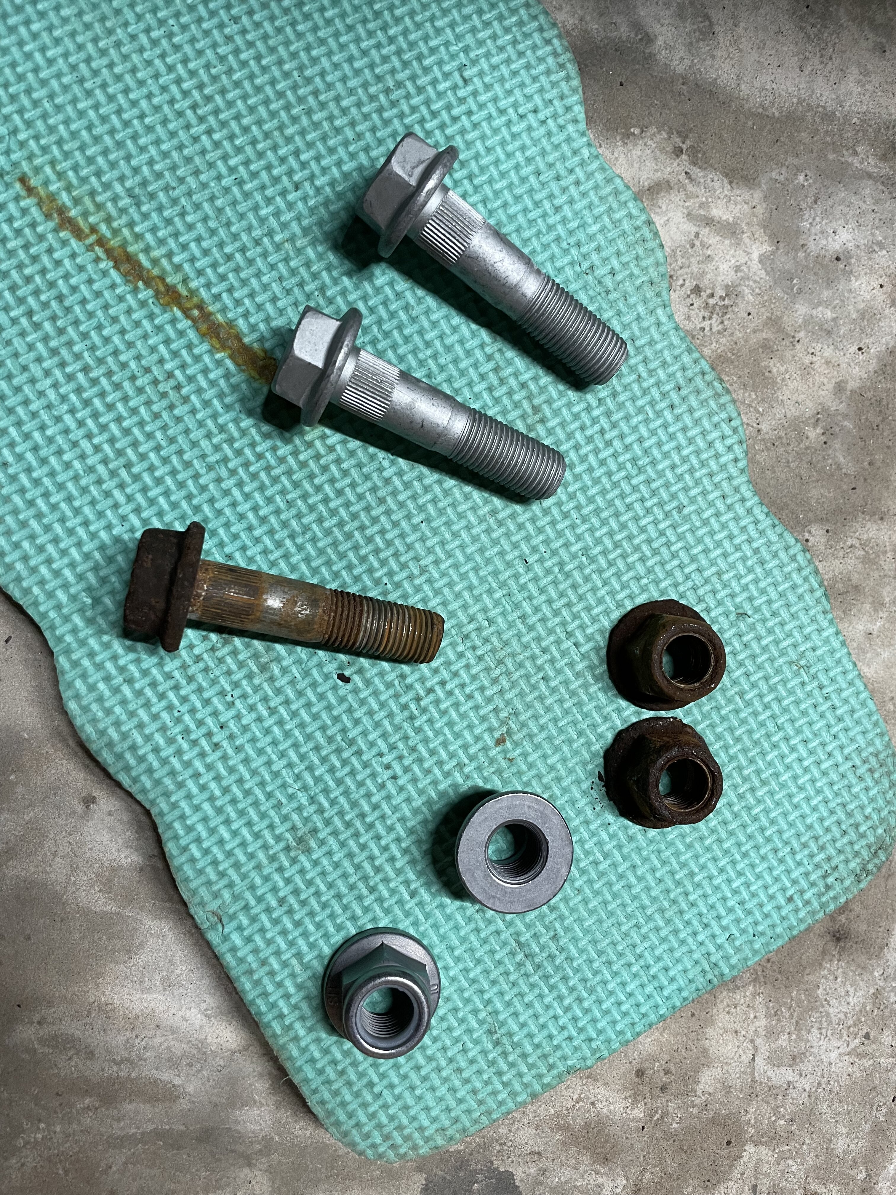

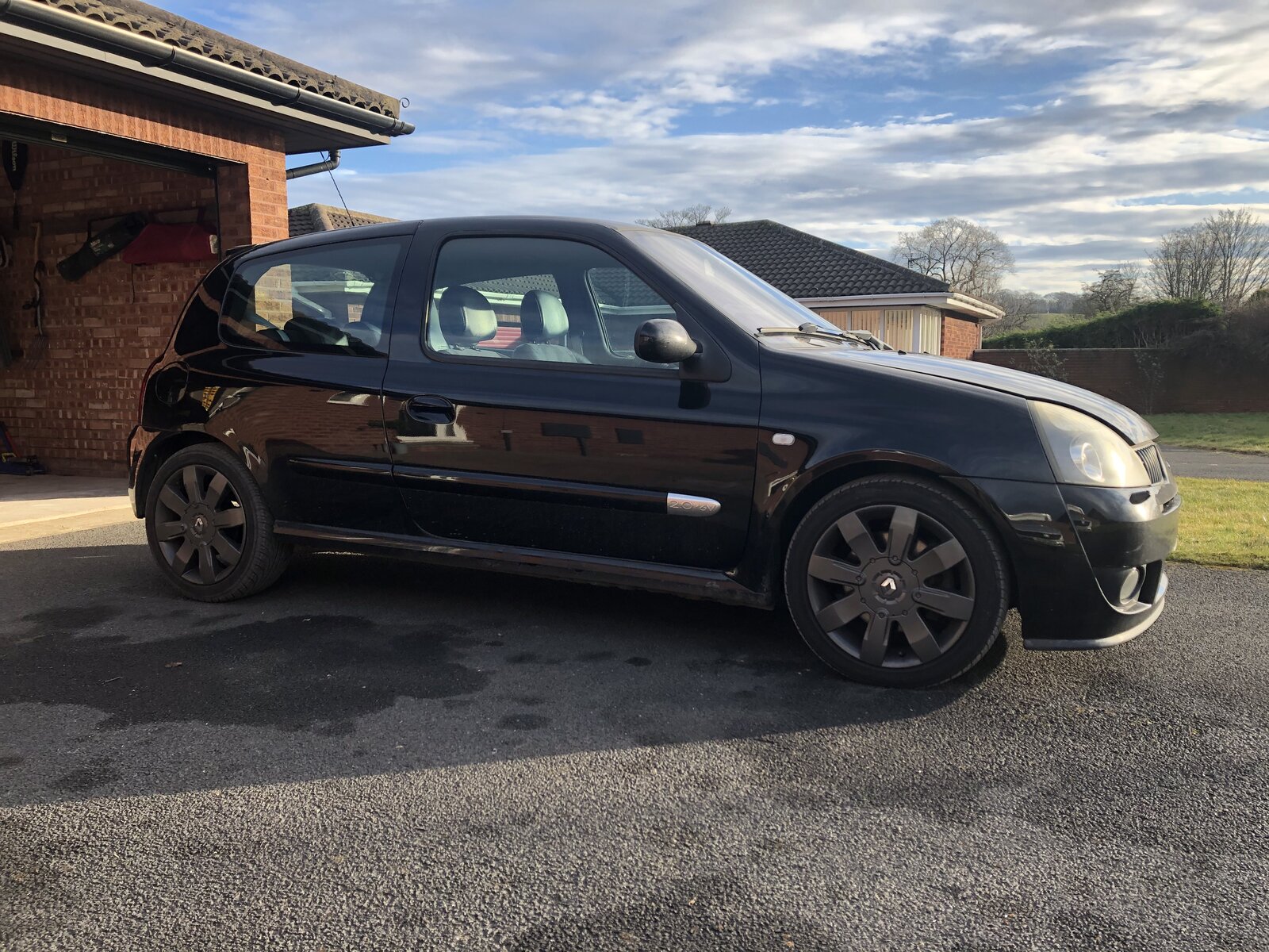

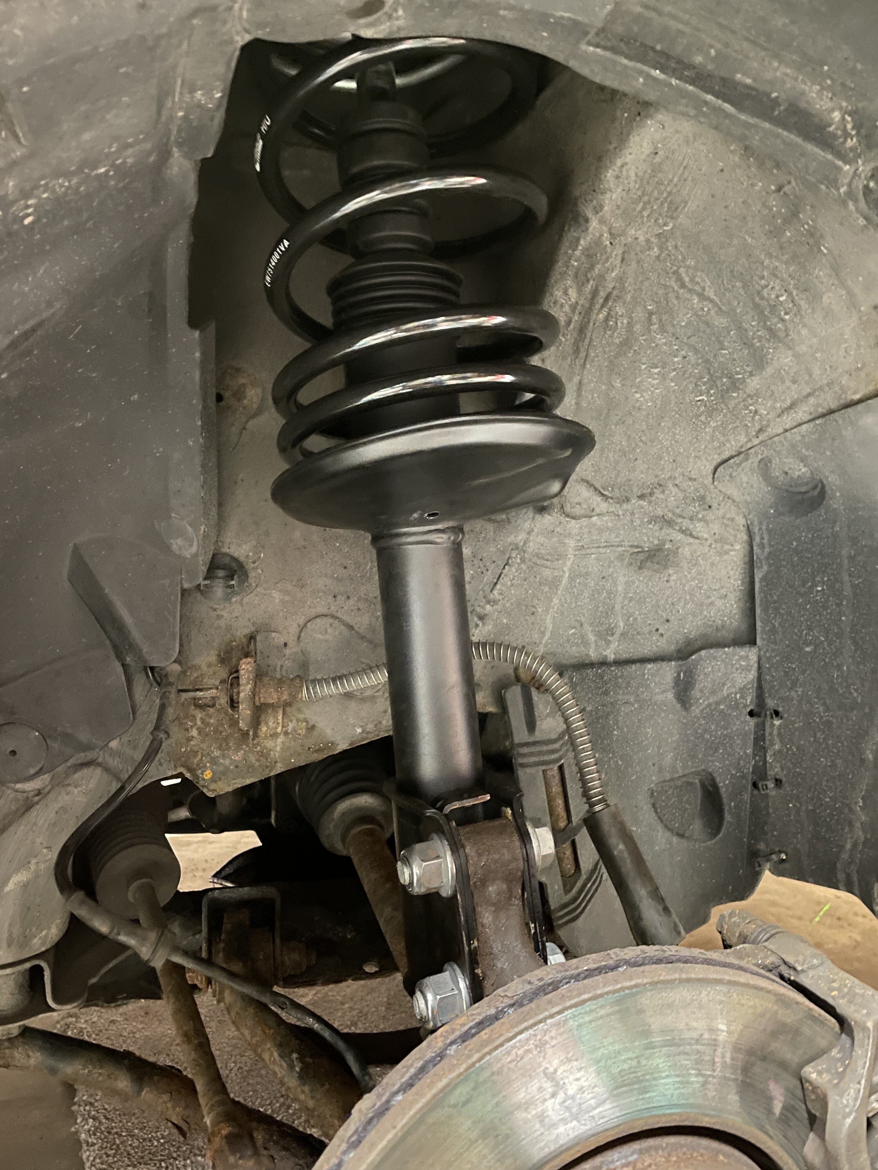

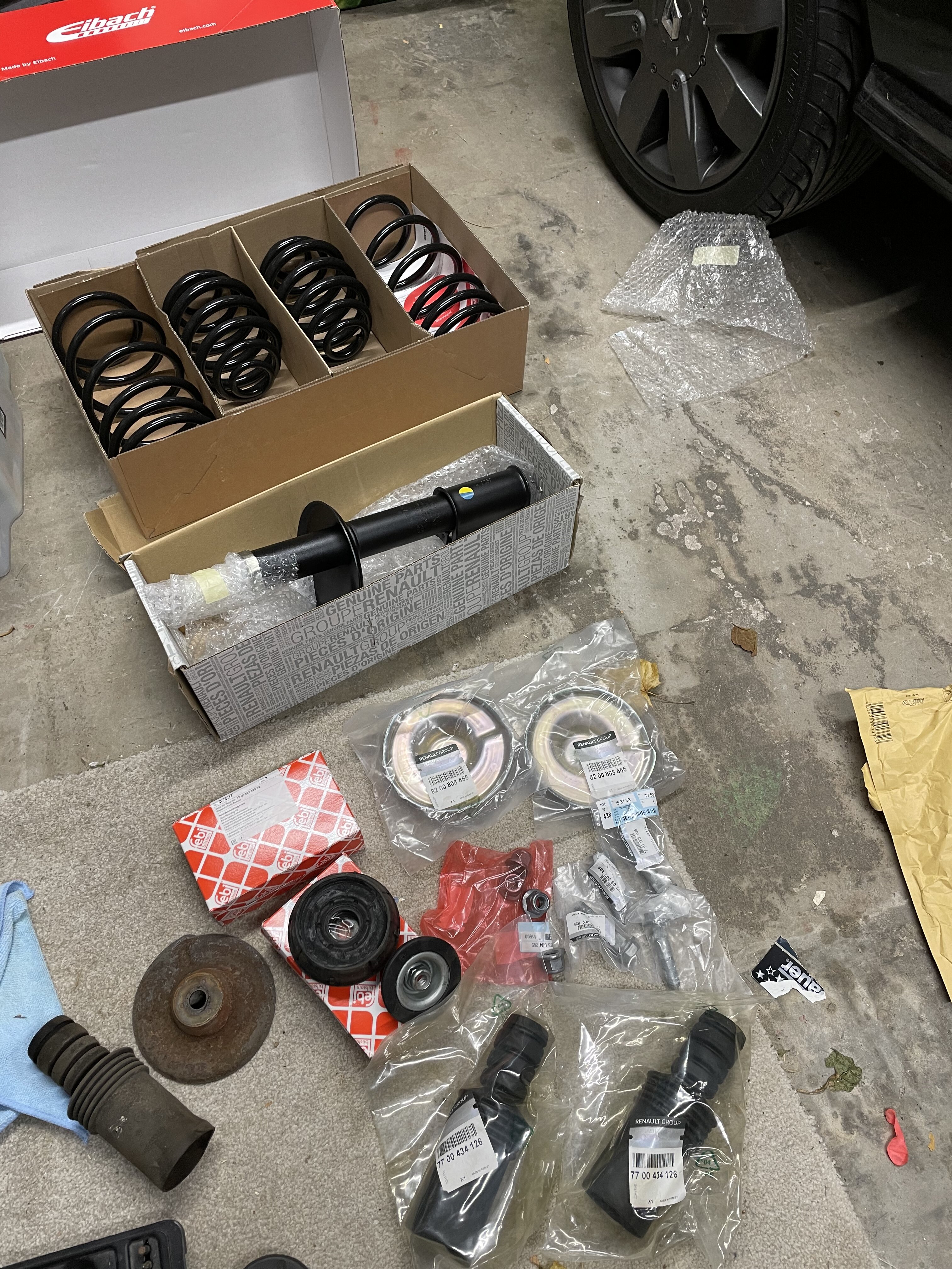

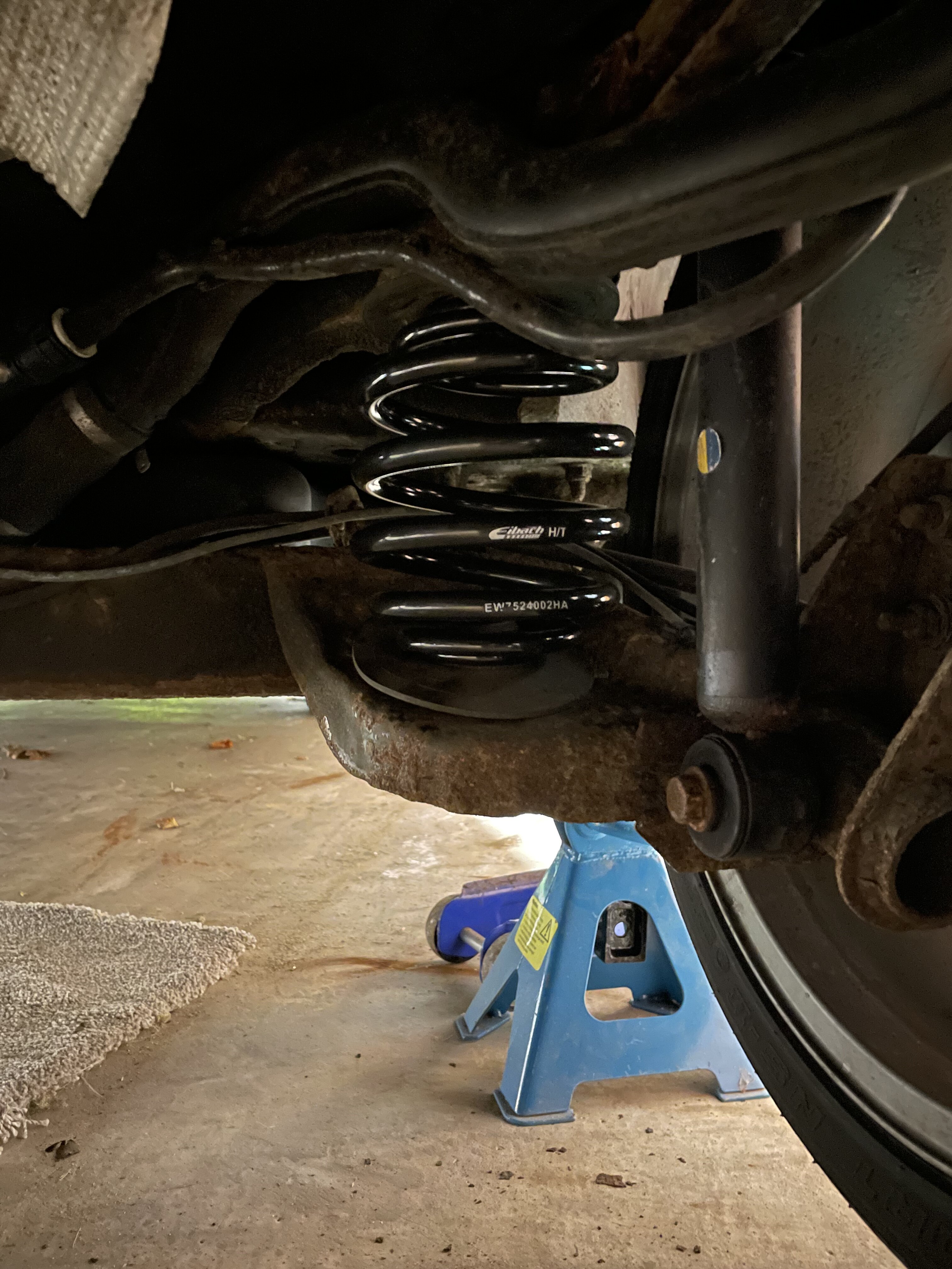

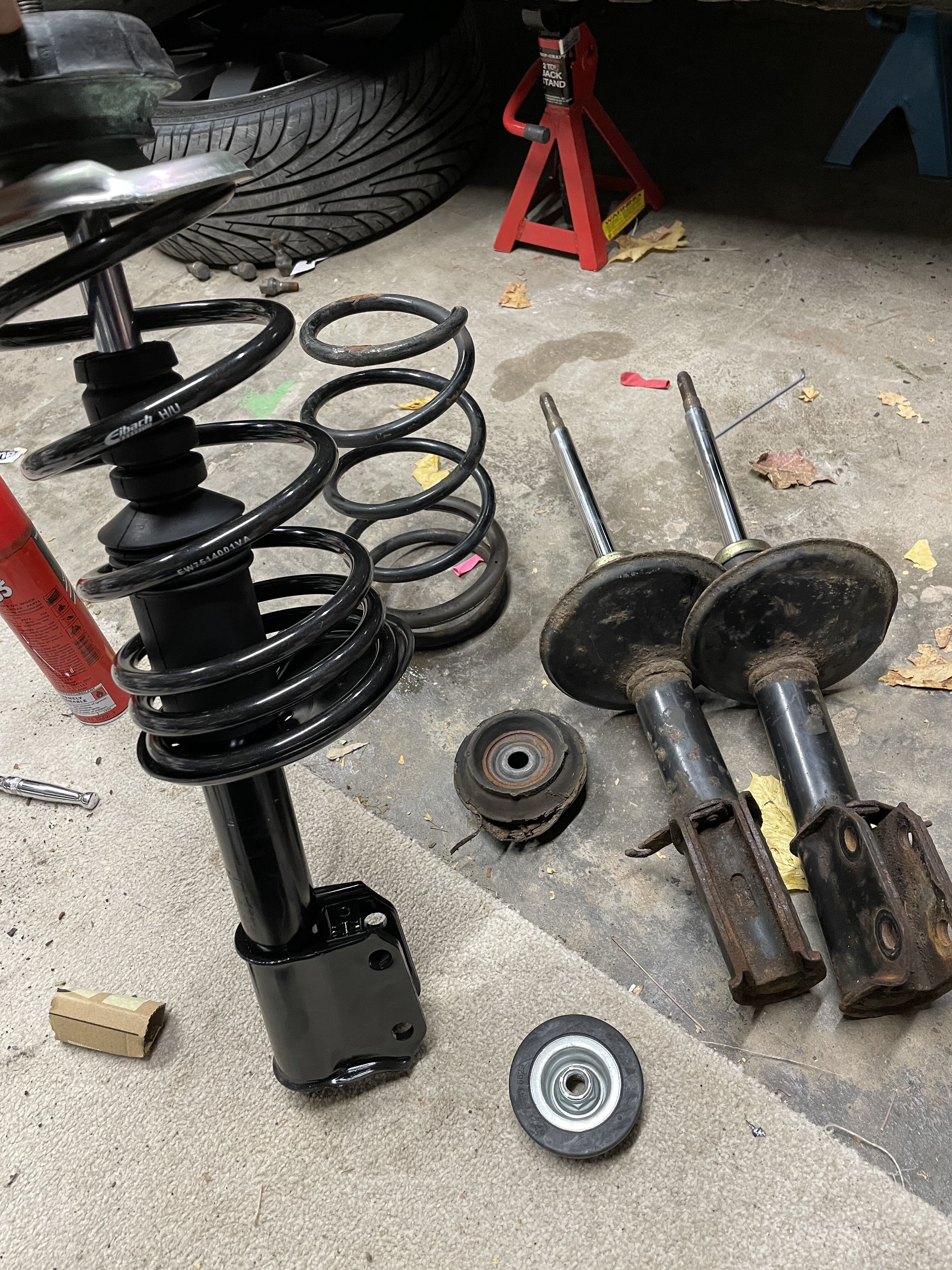

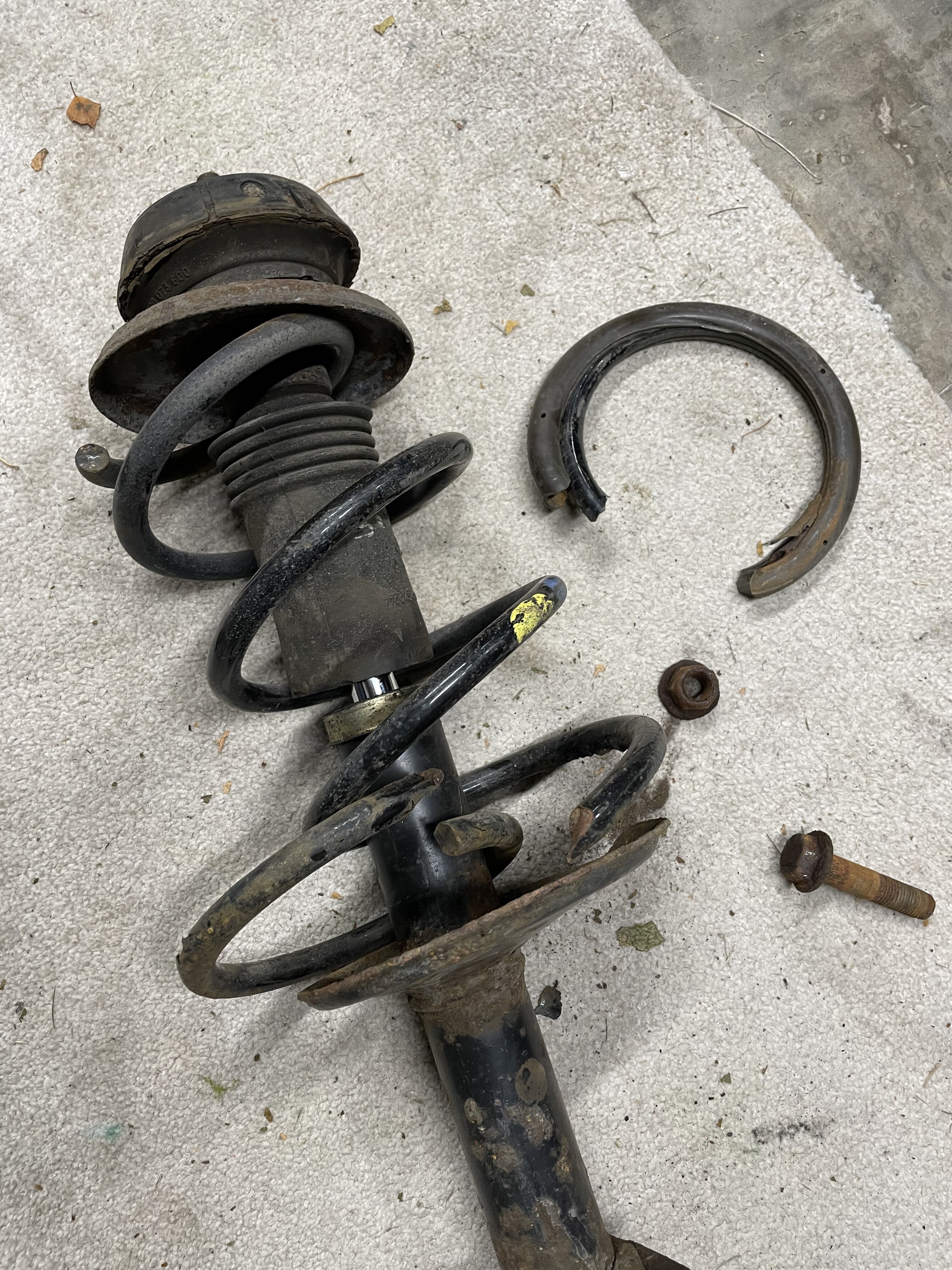

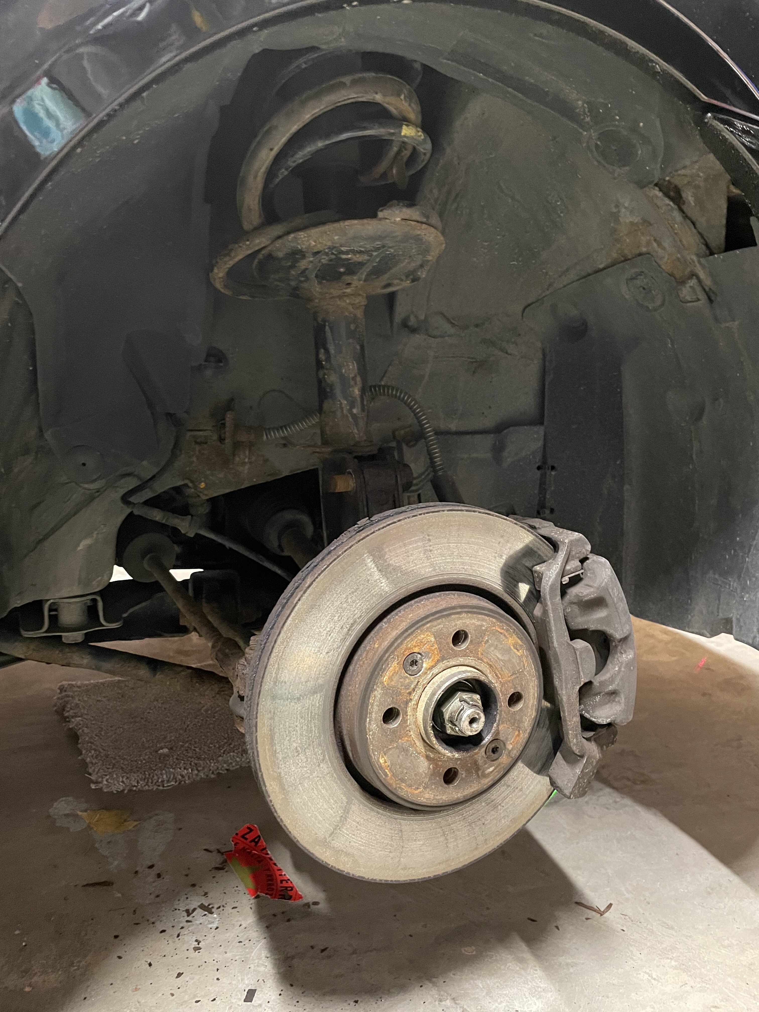

following the mot last month the front spring snapped so i decided to change the dampers also as the current dampers are the originals from new. I replaced the front dampers, top hats, gaiters, bolts and top mounts. Renault no longer make the cup springs so i went for the eibach pro lines as I read they are closest to standard height which is what i wanted to retain.
the clio covered just 300 miles over the last year between mot’s. It is taxed and insured all year round and gets a drive out every week or so to keep everything running.
Belts are due even though it has only covered 8k since they were last done. I will book it in with diamond motors next year.
