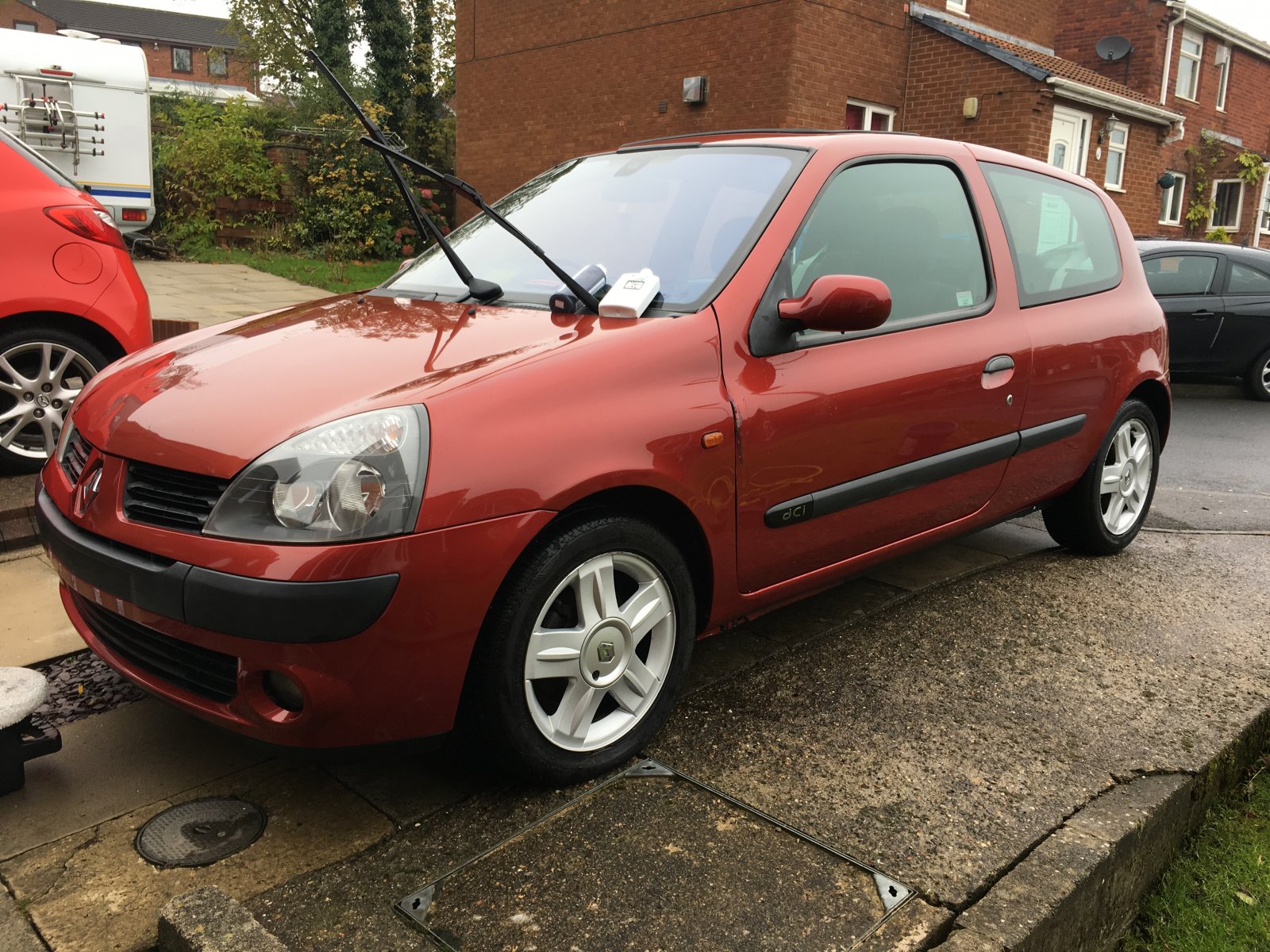

Due to a change in circumstances and needing to use my own car for work I needed something that would be cost effective. Im travelling 50 miles dail and sometimes more so it isnt practical to use renaultsport for this IMO.
I had been looking for weeks with nothing coming up close by. Until a few weeks back when I spotted a low mileage (89k, but this is low for a 12 year old car and its a diesel anyway) 20 mile away from me. I went to view it the next morning and brought it home with me. It needed a few things doing to it which has added up the cost already paid for the car itself, but at least I know what has been done and that its been done properly.

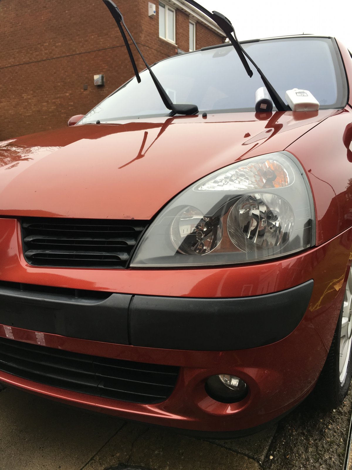

Since getting it, I have completed the following;
Service, including oil, oil filter, air filter, pollen filter and fuel filter
Front wheel bearings
Front discs and pads
Wipers
Car mats
Headlight restoration kit
Exhaust mount
New number plates

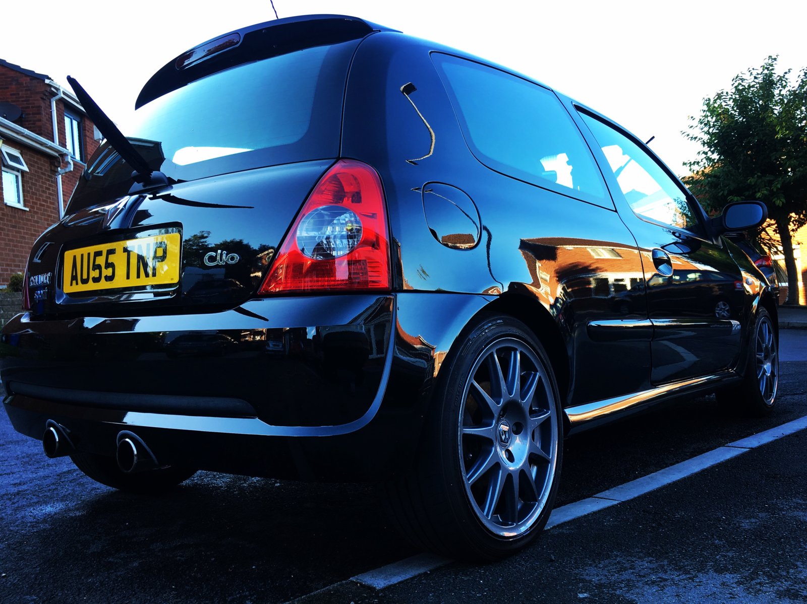

My long term plan since day one of owning was to keep the 182 forever. And this remains the plan...
The need for a new daily helps put this plan in place as it means im no longer using the 182 so the mileage wont massively increase.
I will continue to maintain the 182, as I always have.

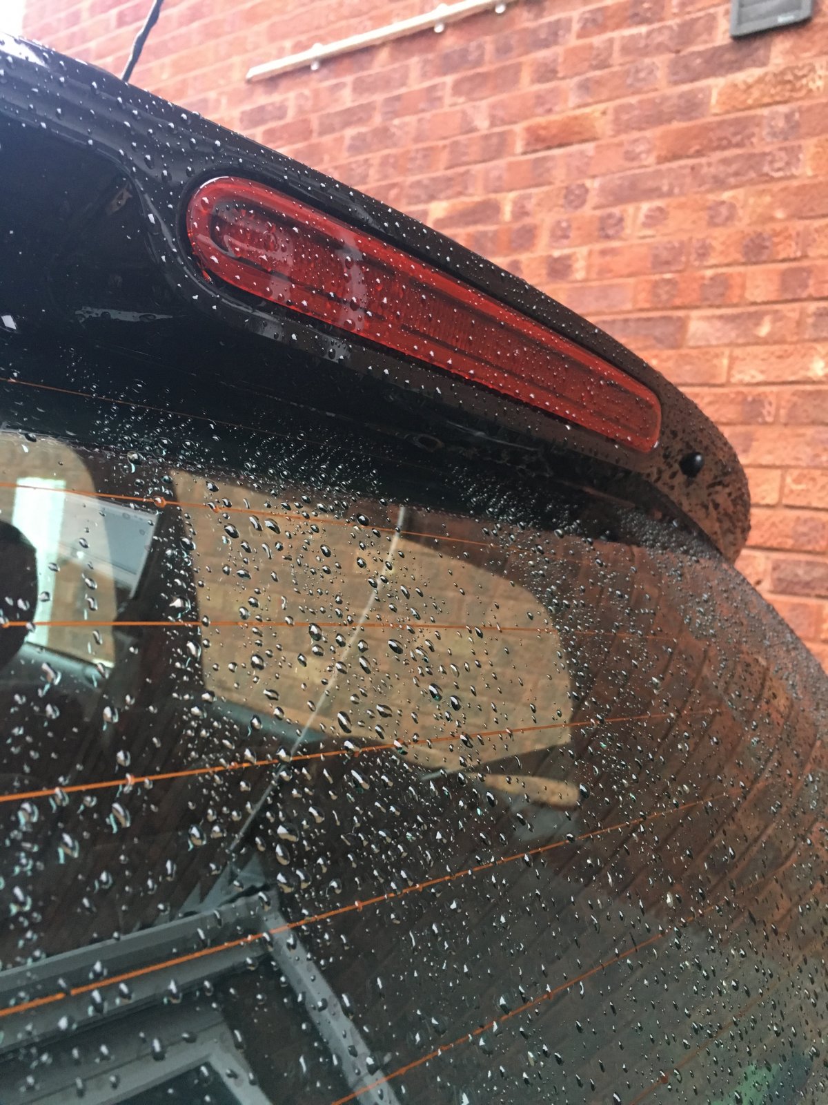

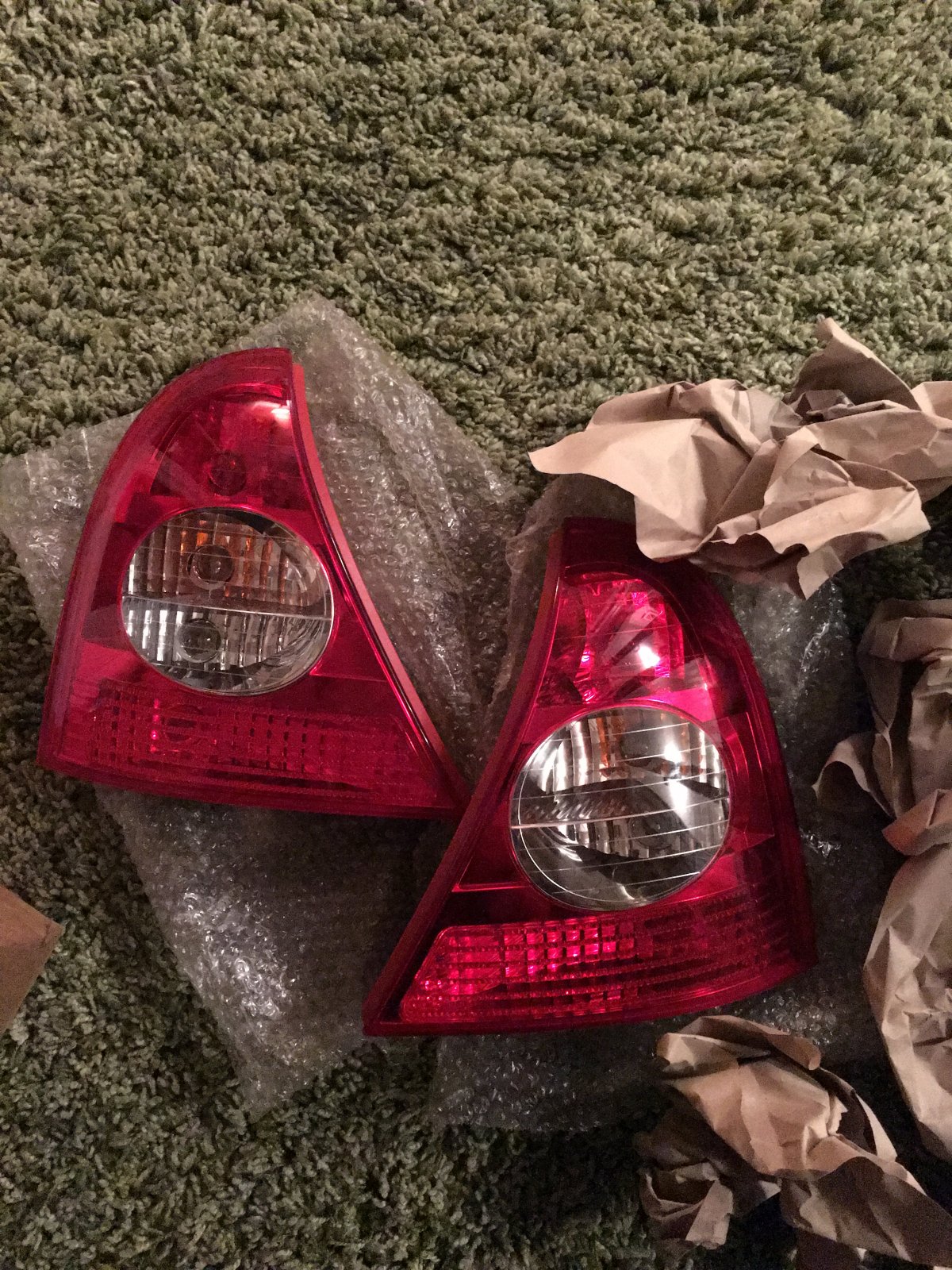

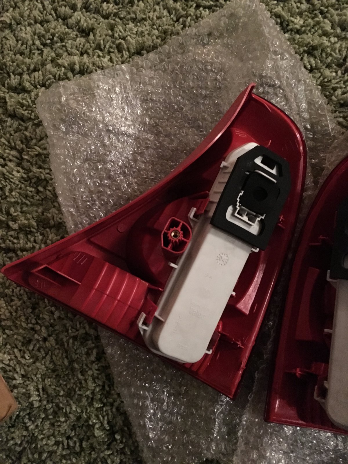

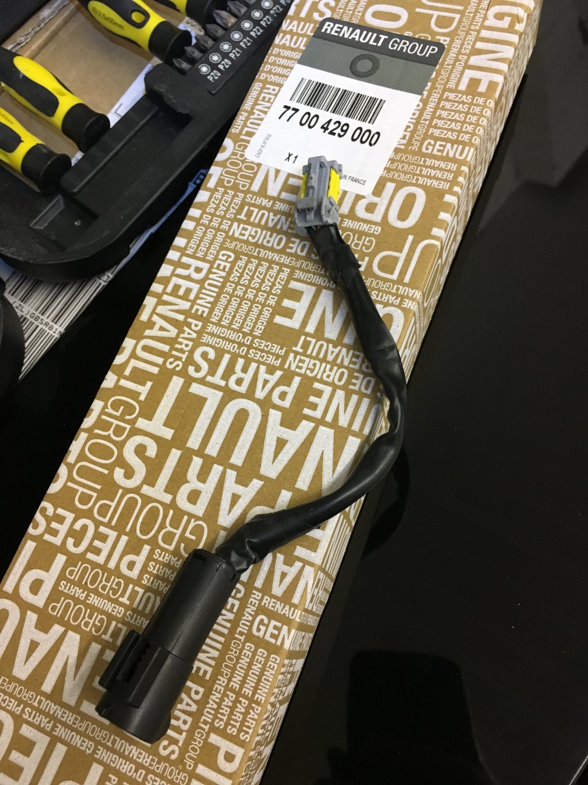

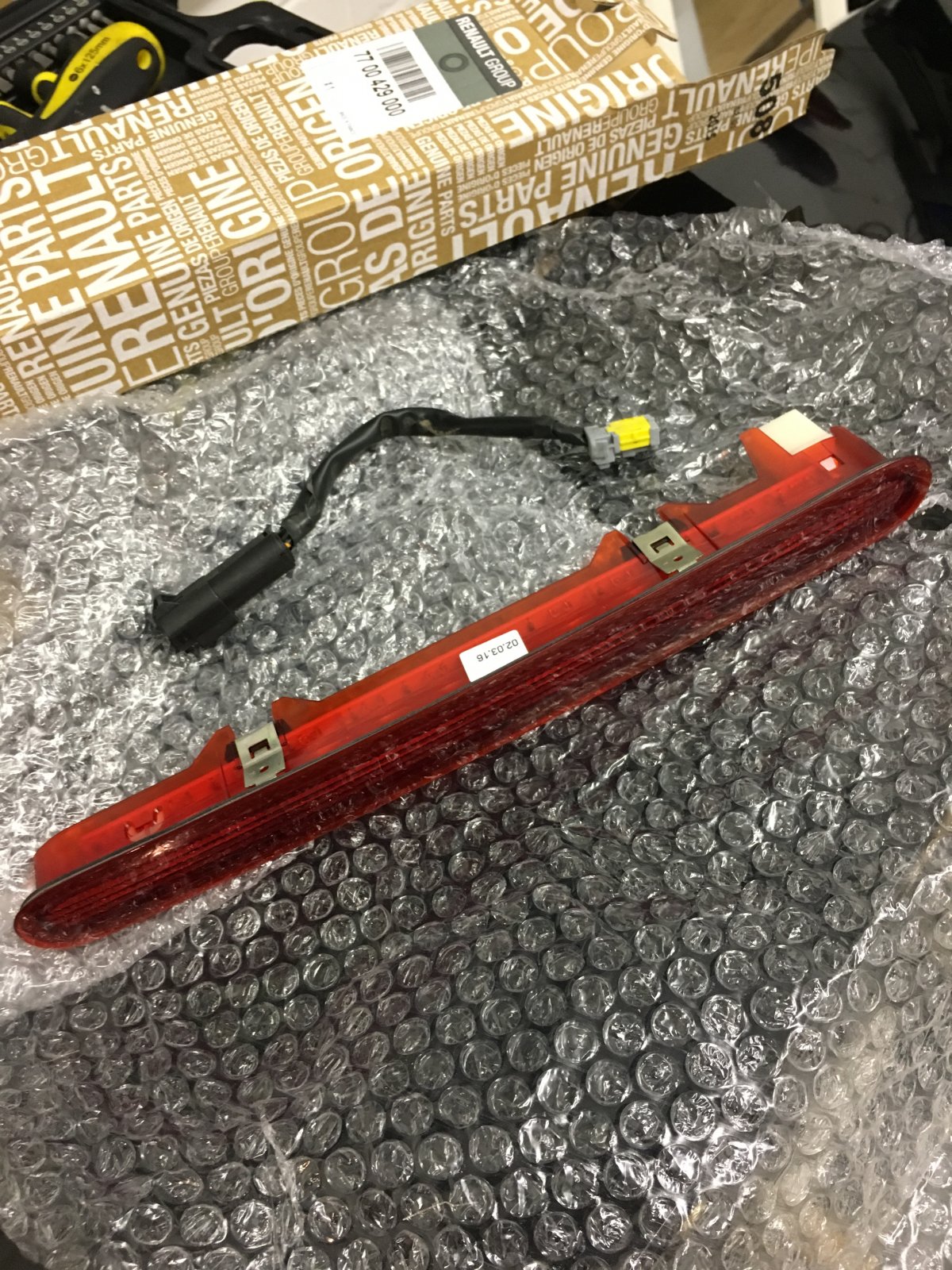

The rear cup spoiler brake light stopped working so I had ordered a new one from Renault and fitted this yesterday. The old one was filthy underneath and the connections corroded which must be why it had stopped working. While i was fitting the new one, I cleaned the whole area and retaped the wiring loom.
I also managed to pick up a brand new set of genuine Renault rear lights for a bargain which are going away with the rest of my stored items for the future.

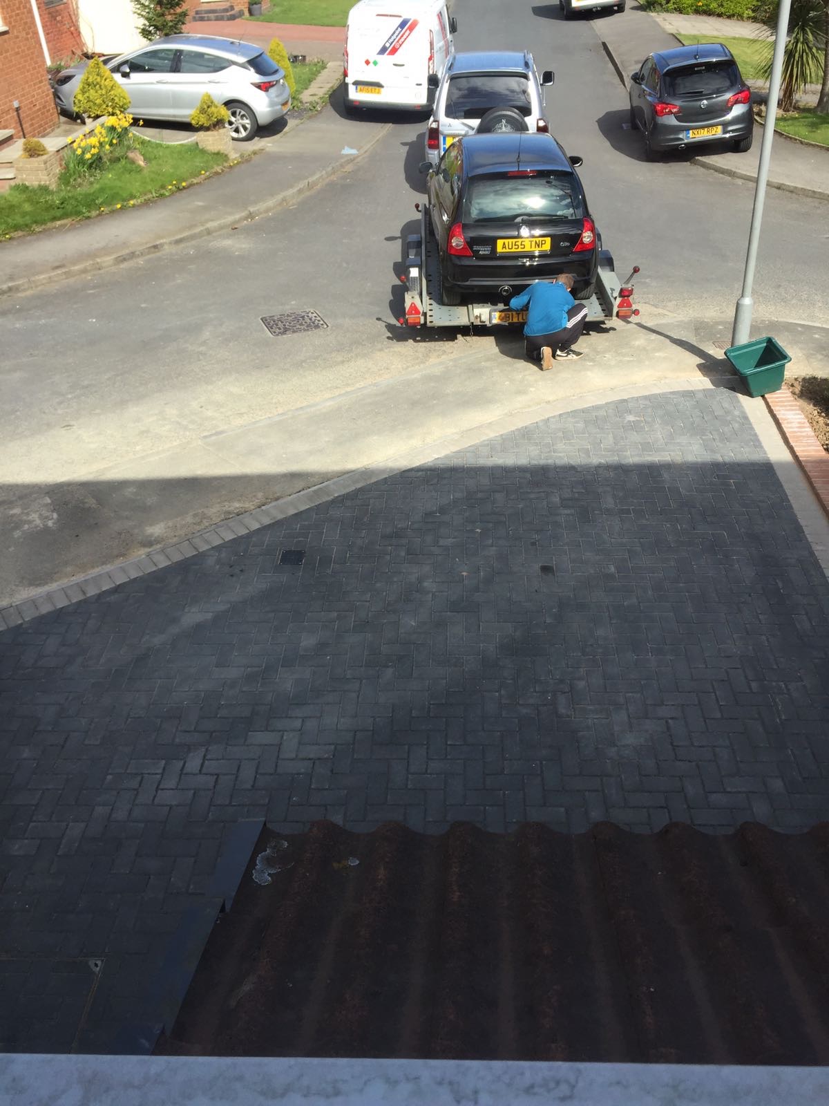

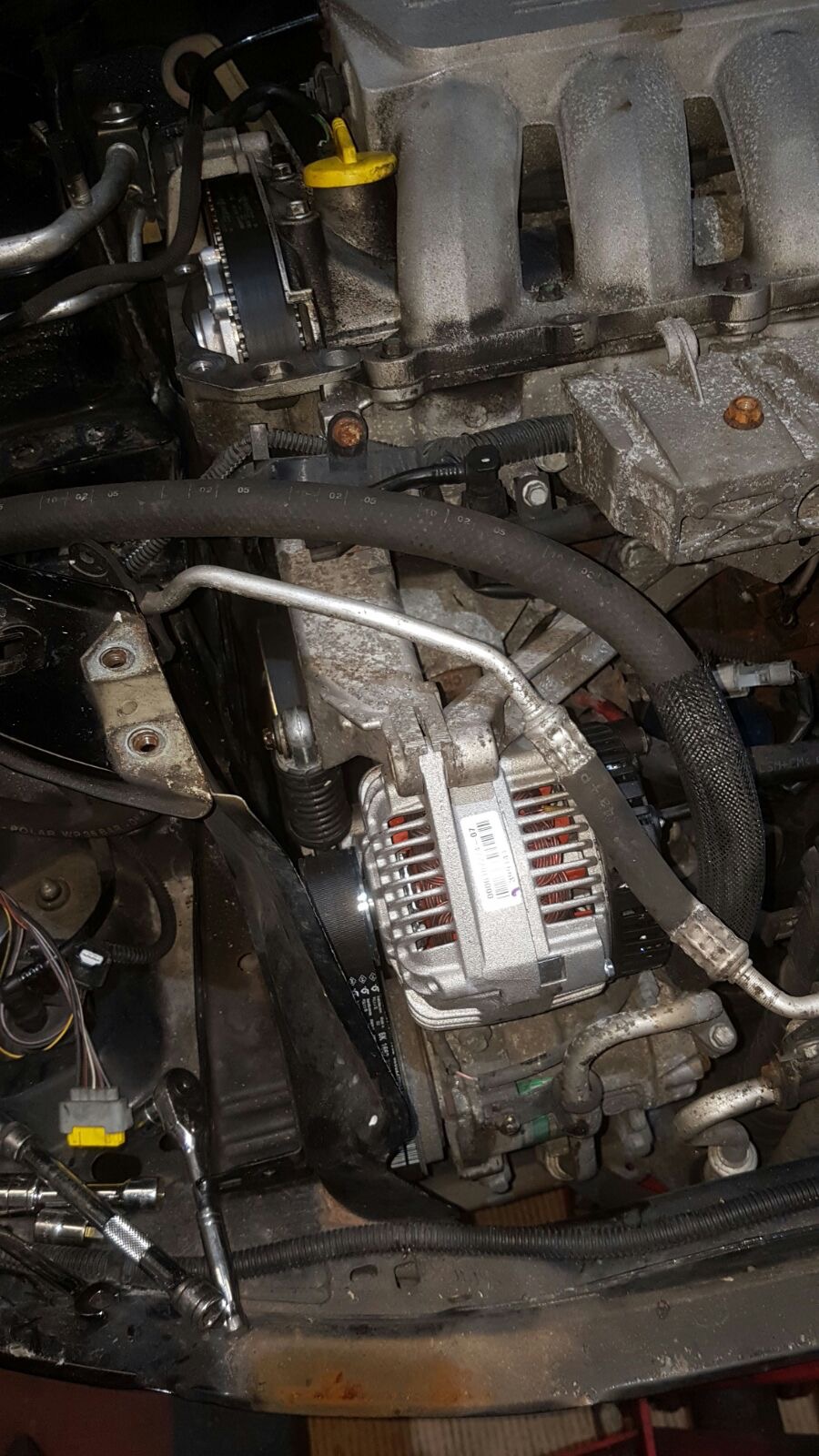

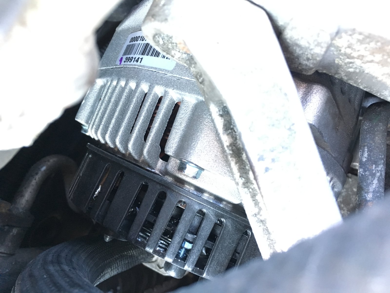

6 months later at the end of March, it was a nice day so i decided to move the car off the drive and was it (had just had the drive block paved so we can fit all 3 cars on easily). While washing the wheels I could smell burning but assumed it was someone starting the bbq up due to the nice weather. I then noticed what I initially thought was steam coming from the bonnet / grill. Then realising it was too warm for it to be steam, combined with the stronger smell of smoke I knew it was the clio! I opened the bonnet and the alternator was on fire! Luckily i have always kept a spanner in the glove box to disconect the battery ever since i had the omp wheel fitted years ago. I had the hose next to me from washing the car so quickly sprayed it onto the alternator. If i hadnt been at the car at that point it could of gone up in flames and destroyed!
A couple weeks later i had it taken away on a trailer to have a brand new genuine alternator and new aux belt fitted.
£360 later it was back and running (working) as normal.

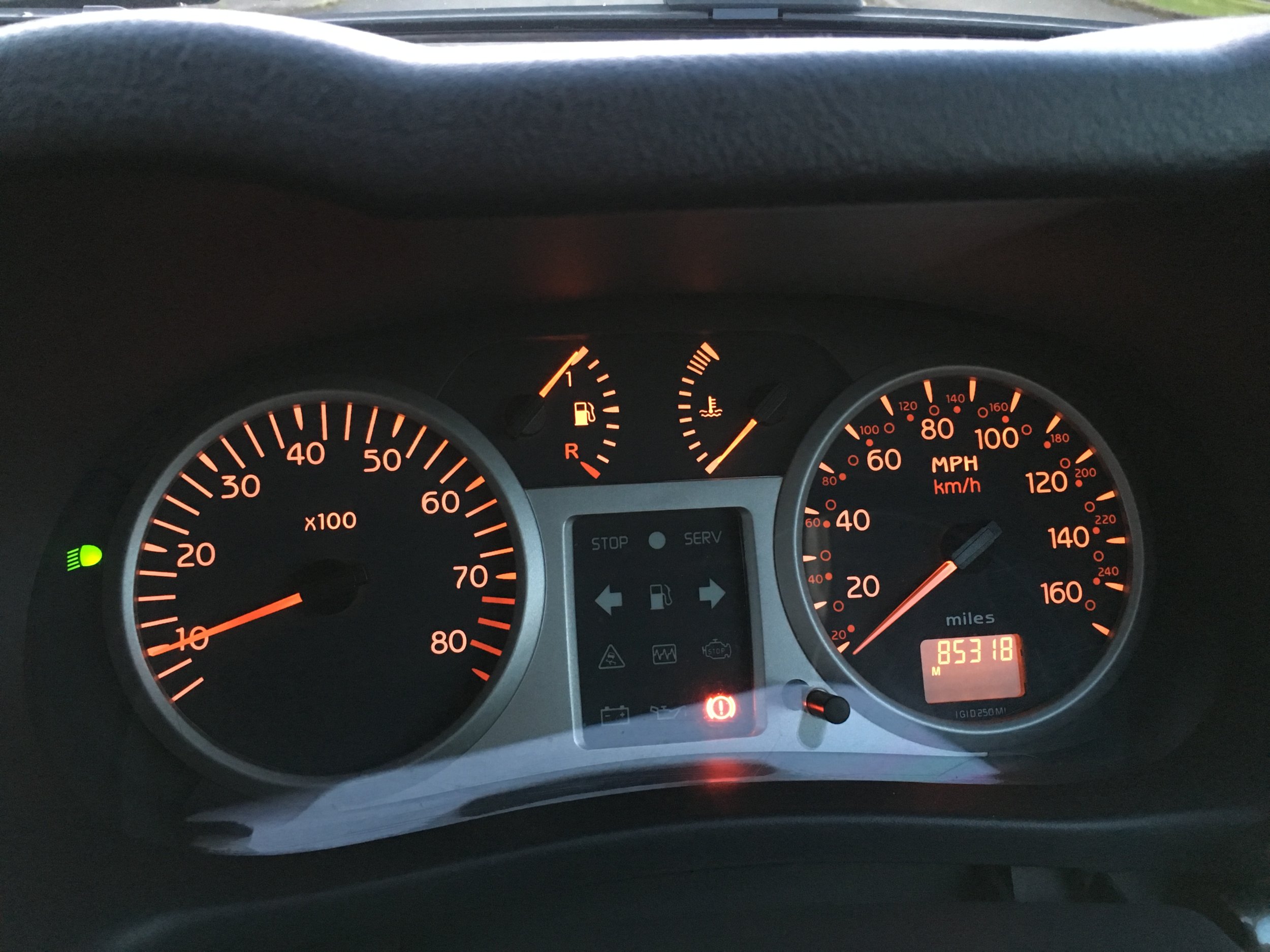

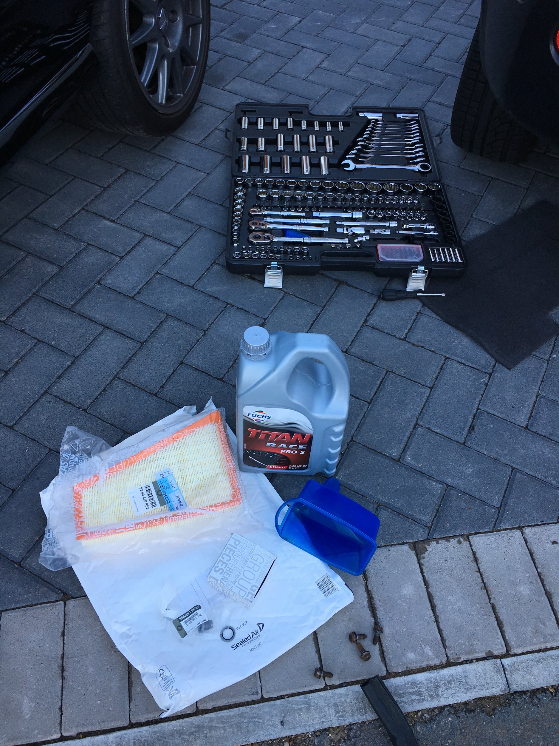

I serviced the 182 tonight which is the first time I have actually serviced it myself. It had the major service done last March when it was on 81799, so althought this was now 16 months ago, it has only covered 3519 miles. I will be doing a lot less than this each year now, but will make sure it is serviced at least every 12 months.
Only the best oil used as usual, Fuchs pro s 5 40, along with genuine filters. I also replaced the sump plug as it had never been changed before! Another reason why I learnt myself to how to diy service, so i know things have been done properly.
You realised just how easy it is to service it now then, always do my own now and just keep all receipts and take pics during the work to show it was done.. just fitted a GOLD magnetic sump plug to mine

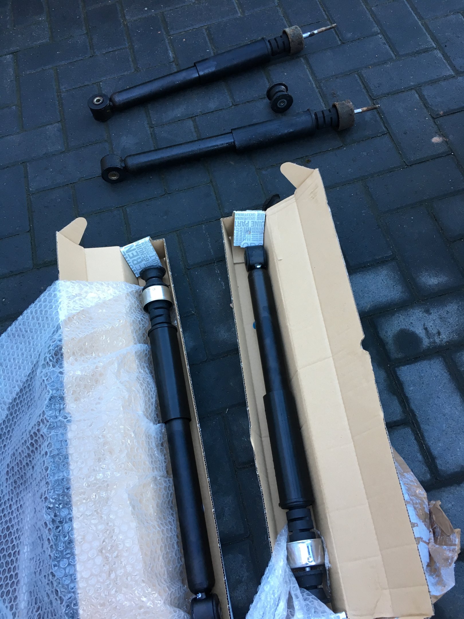

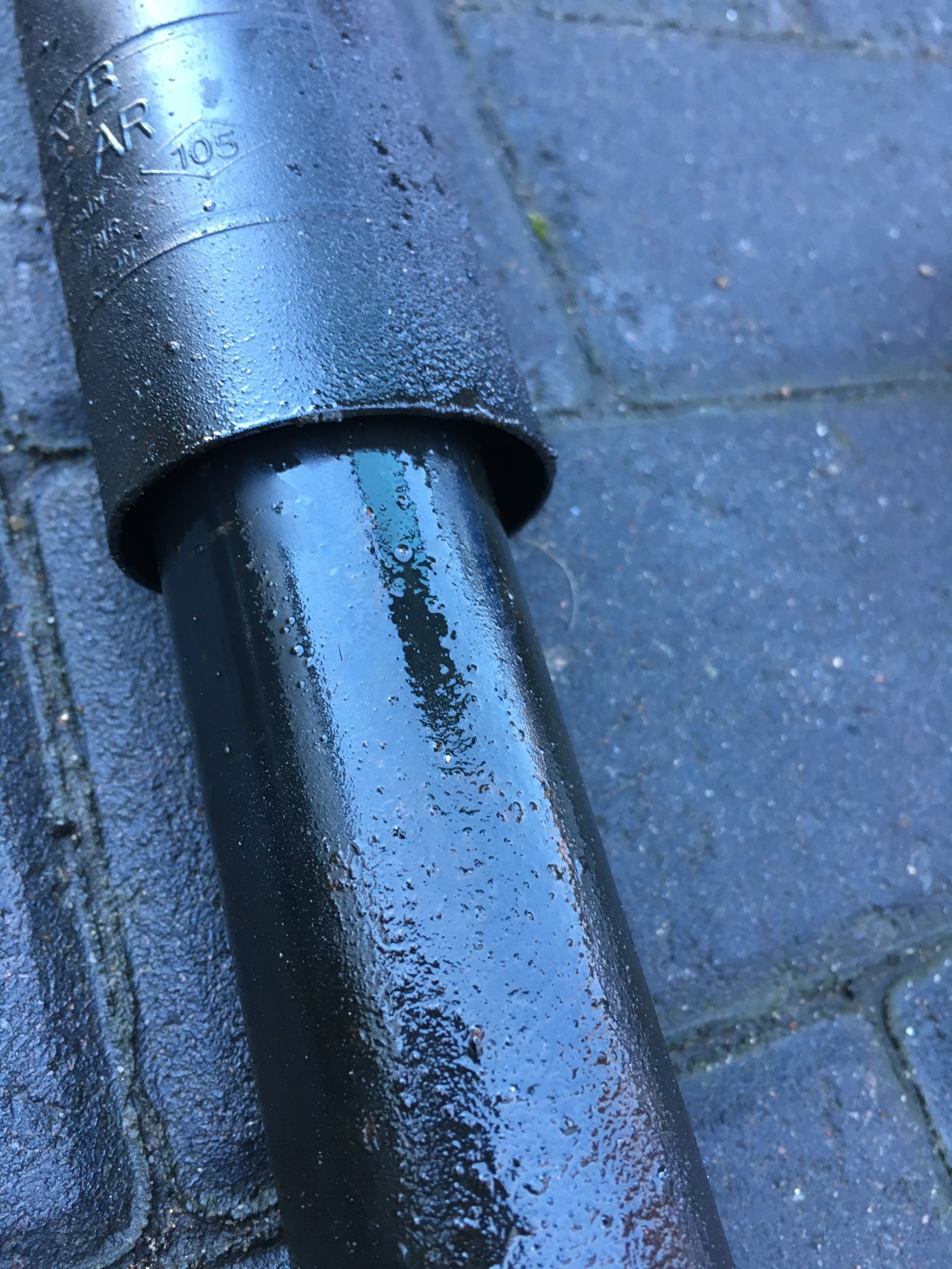

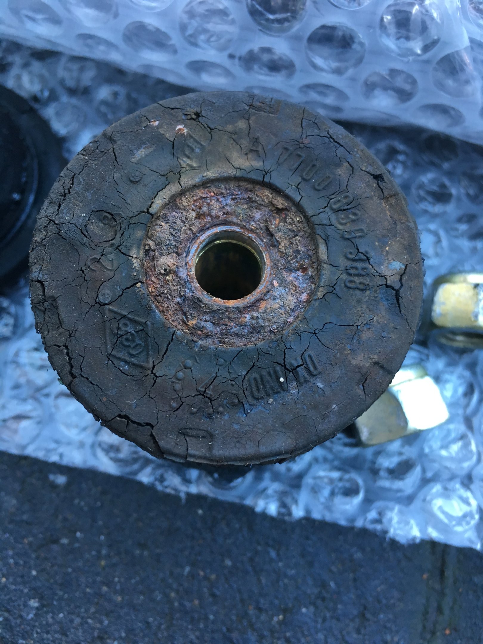

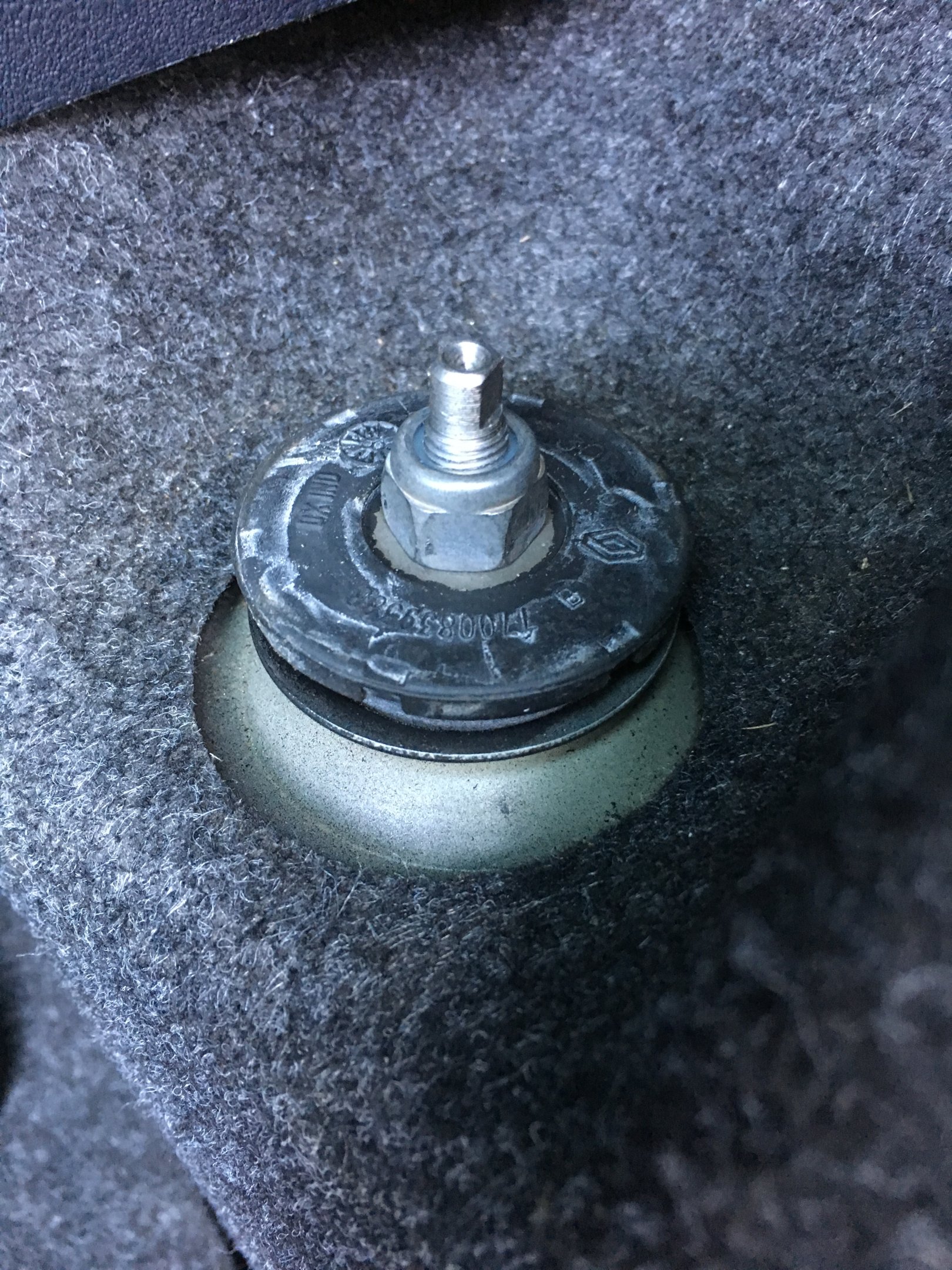

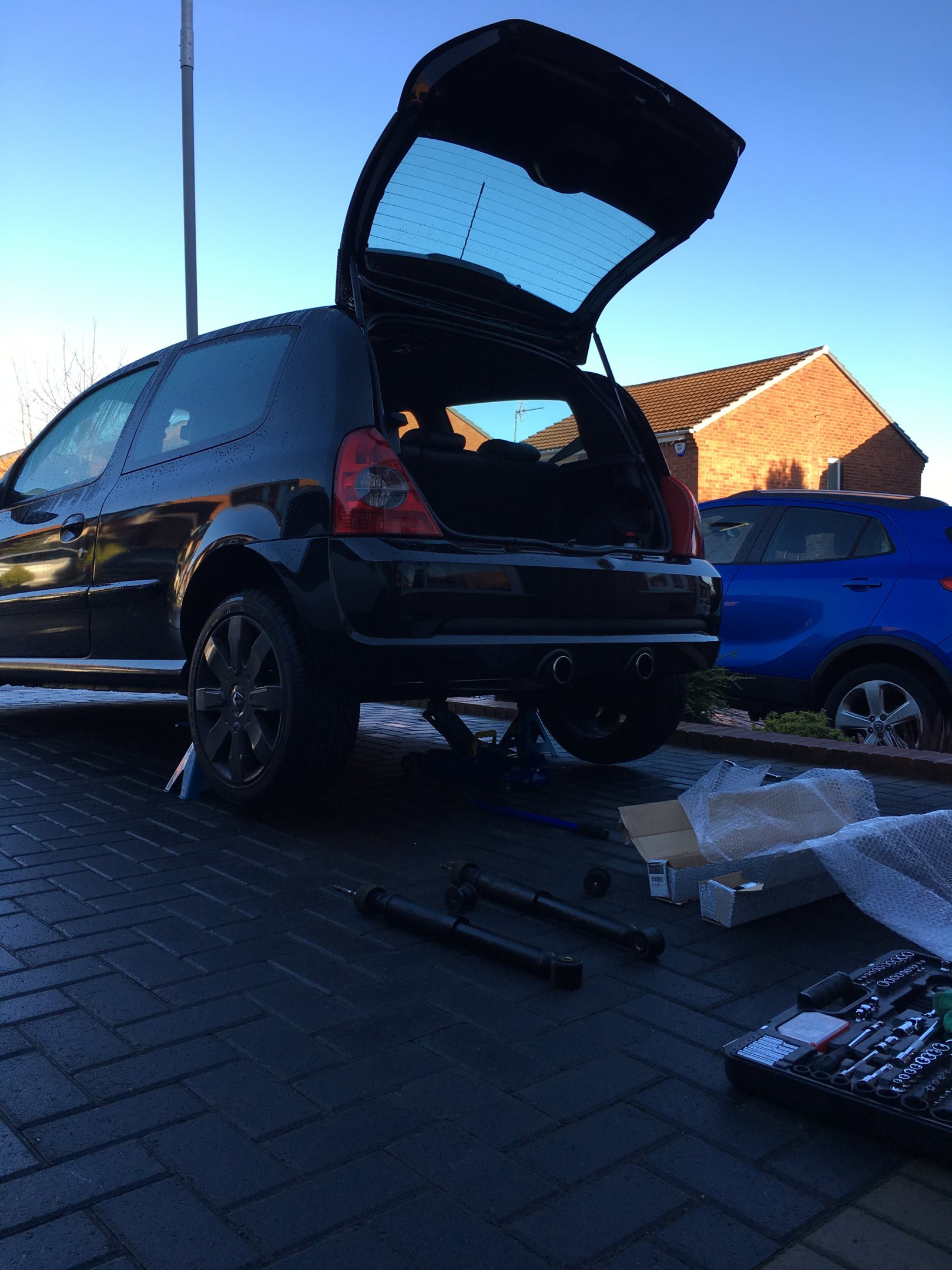

I will be doing the rear shocks within the next few weeks as they are definately need doing. I spotted them leaking when putting the wheels on.
Rear shocks were well and truly gone! Replaced with brand new genuine renault 182 cup shocks at a bargain price of £63 from renaultpartsdirect.
Good service for 12+ year old shocks.
Tbf they only covered around 30k as i put coilovers on when it was 4 years old. Put the standard supension back on last year but rear shocks were no good. Front and all springs are perfect though.

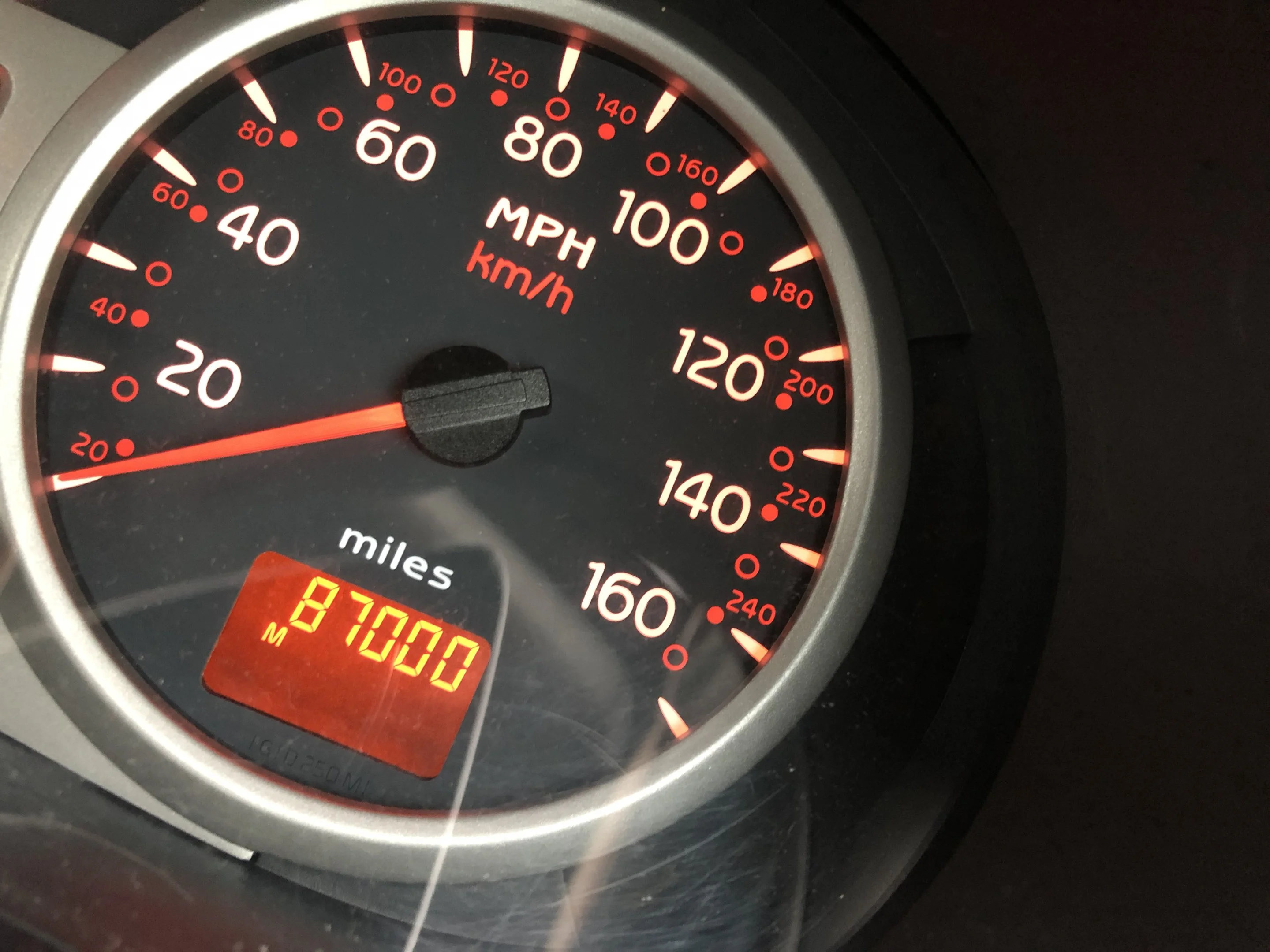

It has just ticked over to 87k

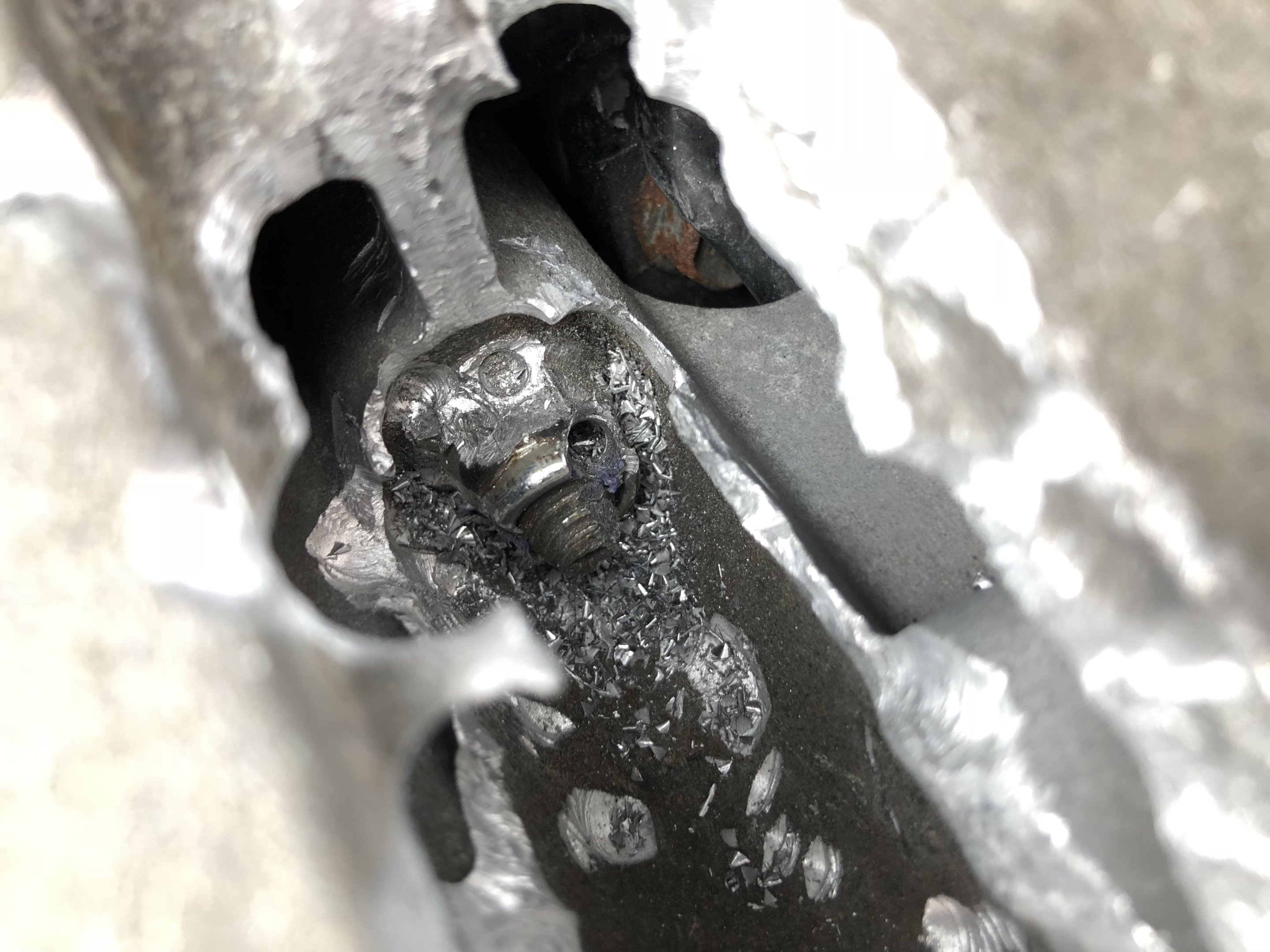

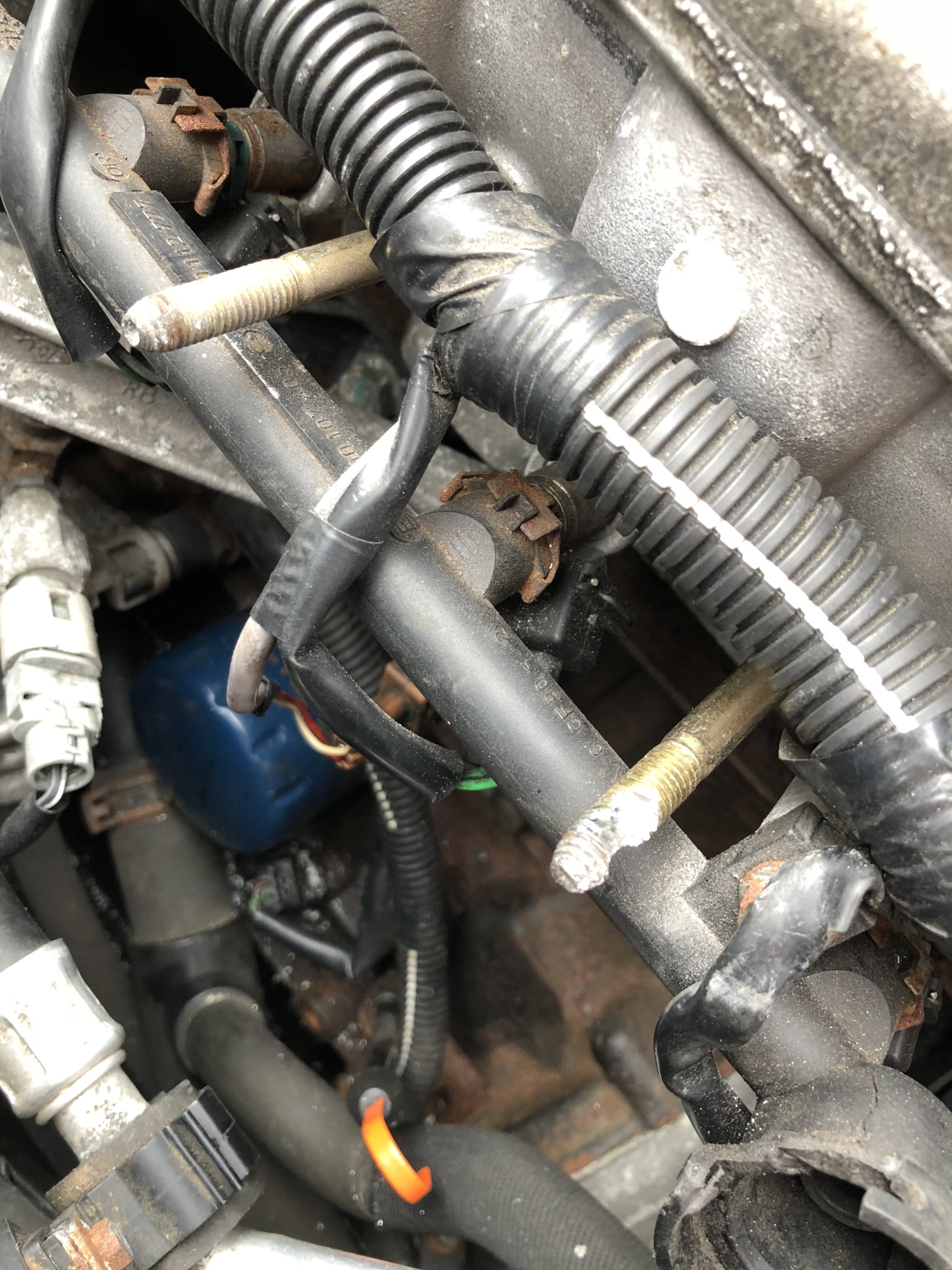

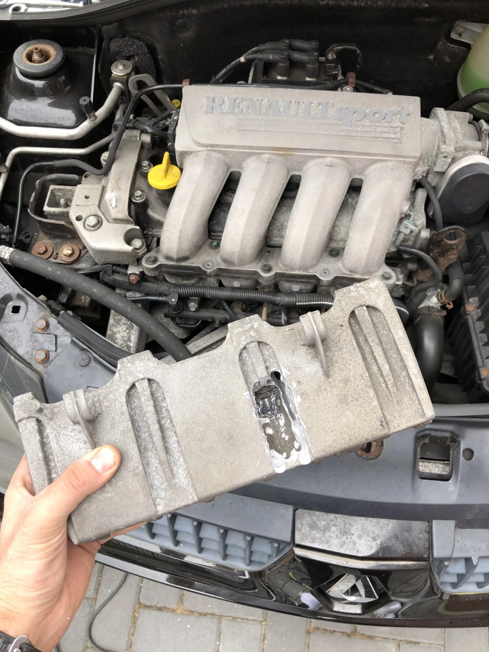

When i serviced the clio last year i couldnt get the fuel rail gaurd off and it was a pain removing the oil filter! It only had one bolt on, and i ended up rounding it off during my attempts to remove it. It was also a 13mm and im sure standard are 10mm. It was last took off and put back on by the garage who did my alternator.

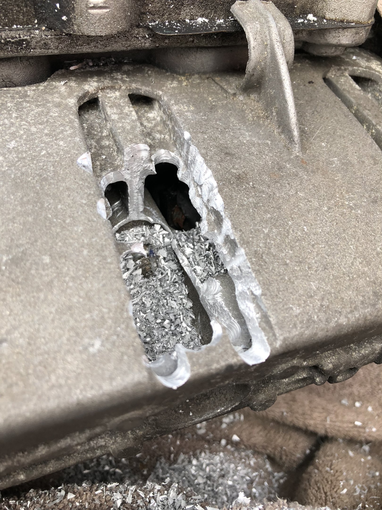

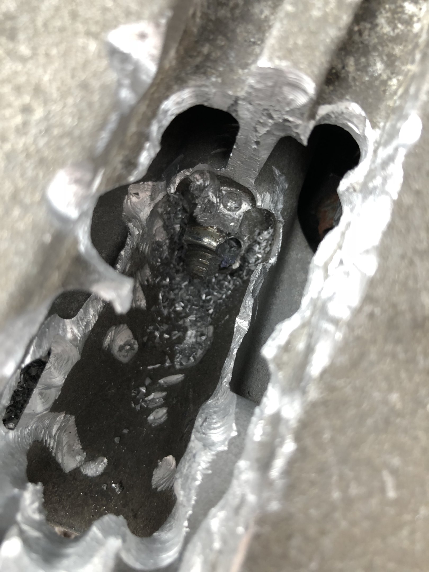

Im going to service the car again before the end of the year so wanted to sort this out first. After spending weeks working out what would be the best way / looking for specific tools to remove rounded bolts, i still wasnt any further forwar because of the lack of room to work with around the bolt.

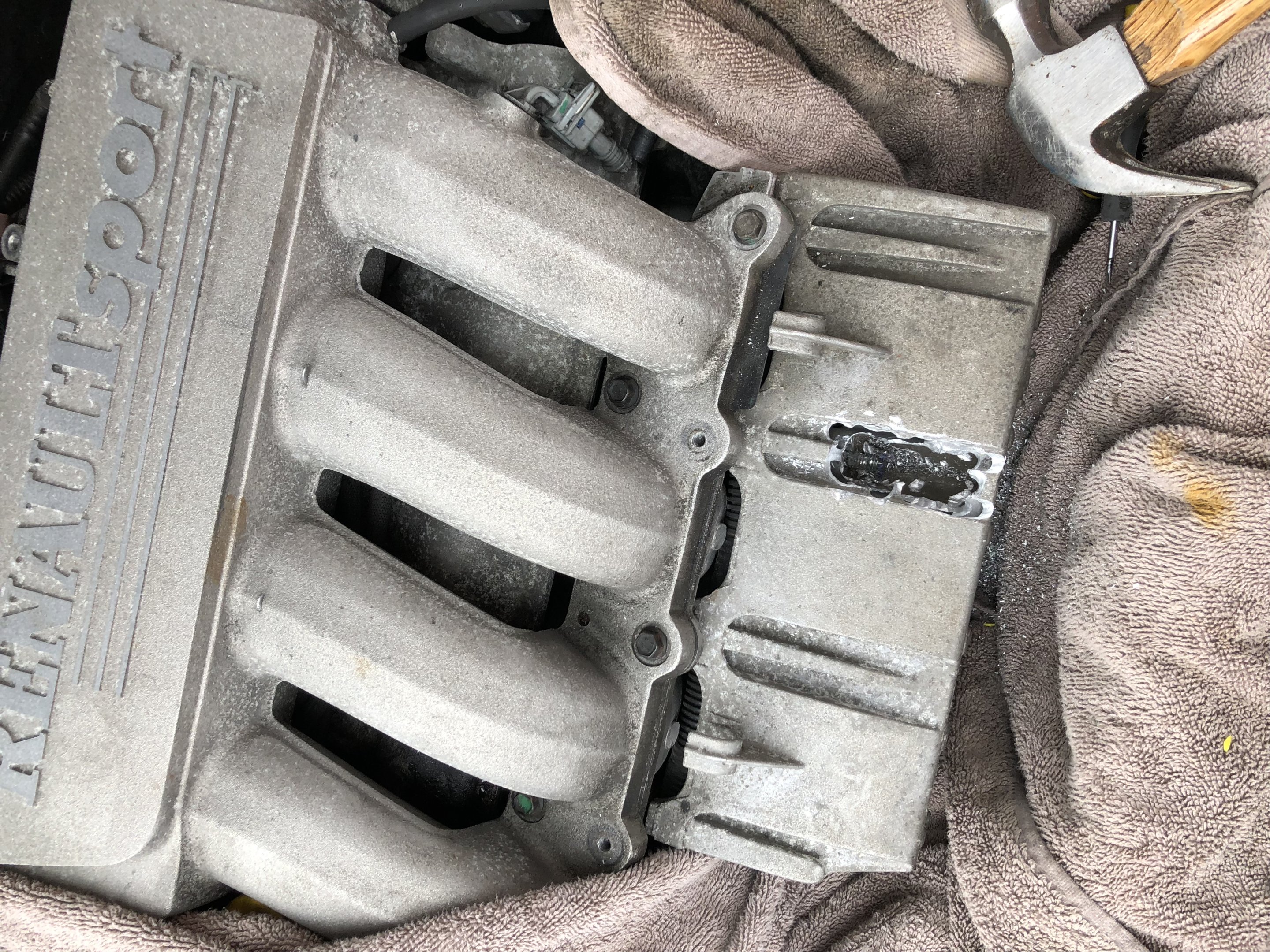

Today, i decided to try and drill out a piece of the guard to get to the bolt, it took me 2 hours but is finally done!
I have damaged one of the bolts on the RS inlet which holds the rail in place. I will see if Renault supply them seperate as it looks like the do come off the inlet.
What a nightmare getting the fuel rail cover off, promising to hear that you should be able to source and replace the damaged stud. Love the fact you are still driving this, I've taken so much inspiration from your thread @Austin-182 for my own BG 182 ?

Getting the gaurd off was one of the worst things i have ever done on it. Took me 2 full hours to do but when it finally came off i felt so glad. Yea, hopefully i will be able to get a replacement stud, but even if not, its just an inlet i will need to find which shouldnt be too difficult.
Thanks Gav, i still say the same that i will never sell this. I have had it 10 years now!
it just unscrews off with a spanner. Genuine part number is 8200584570 . Then its just a flanged M8 Nut, if you want gen its 7703033155 but that will be now be a 13mm head.

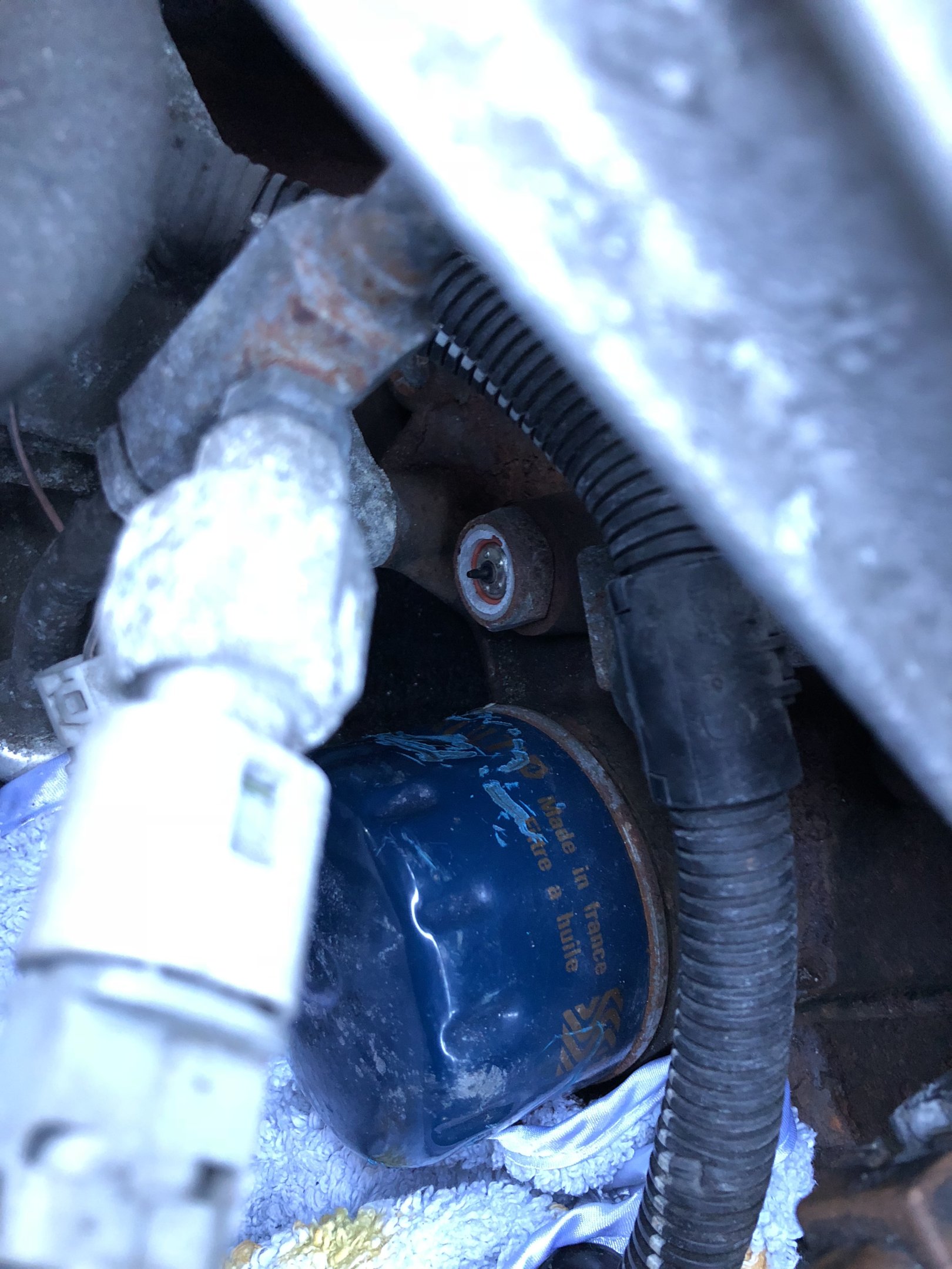

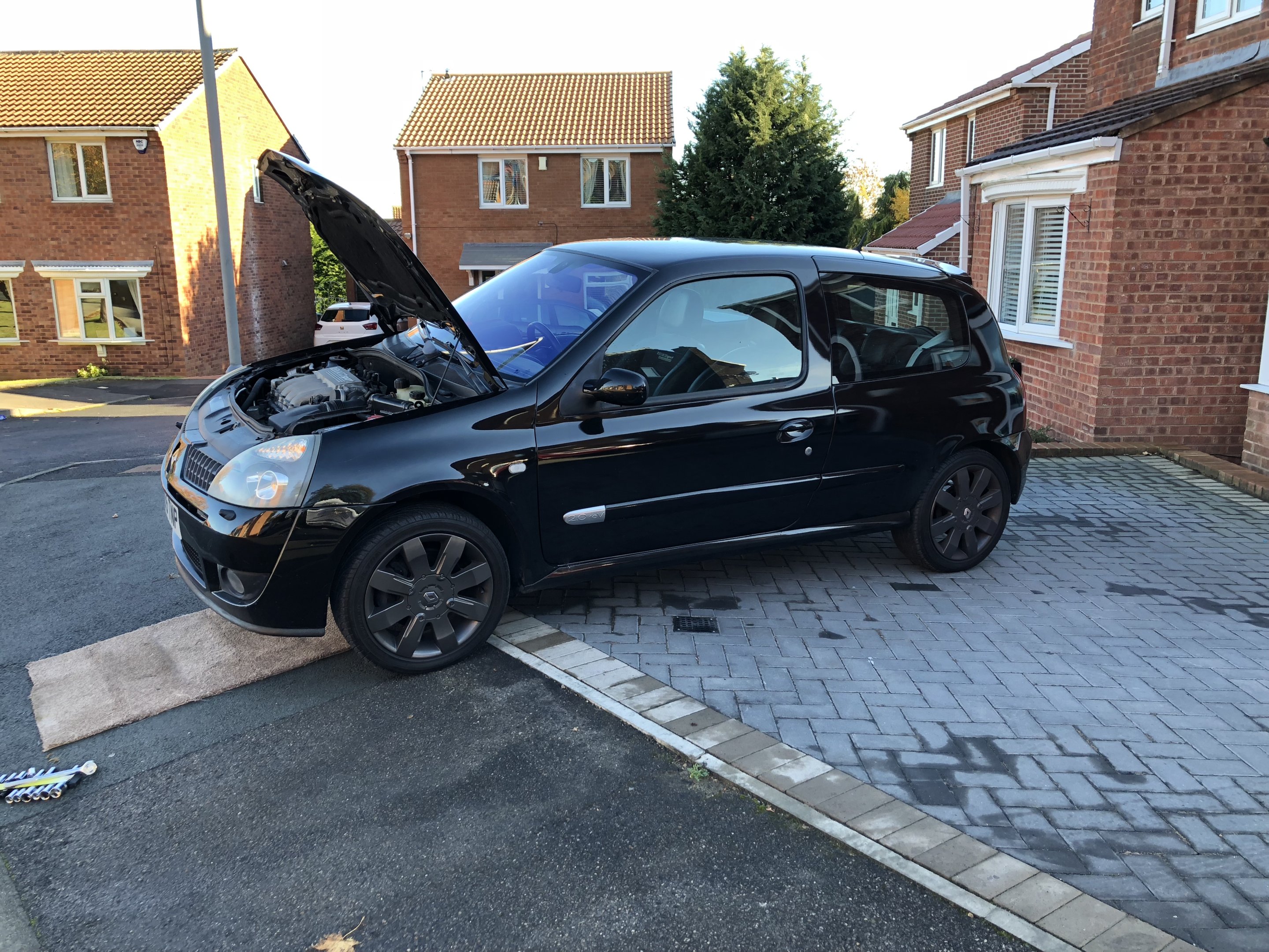

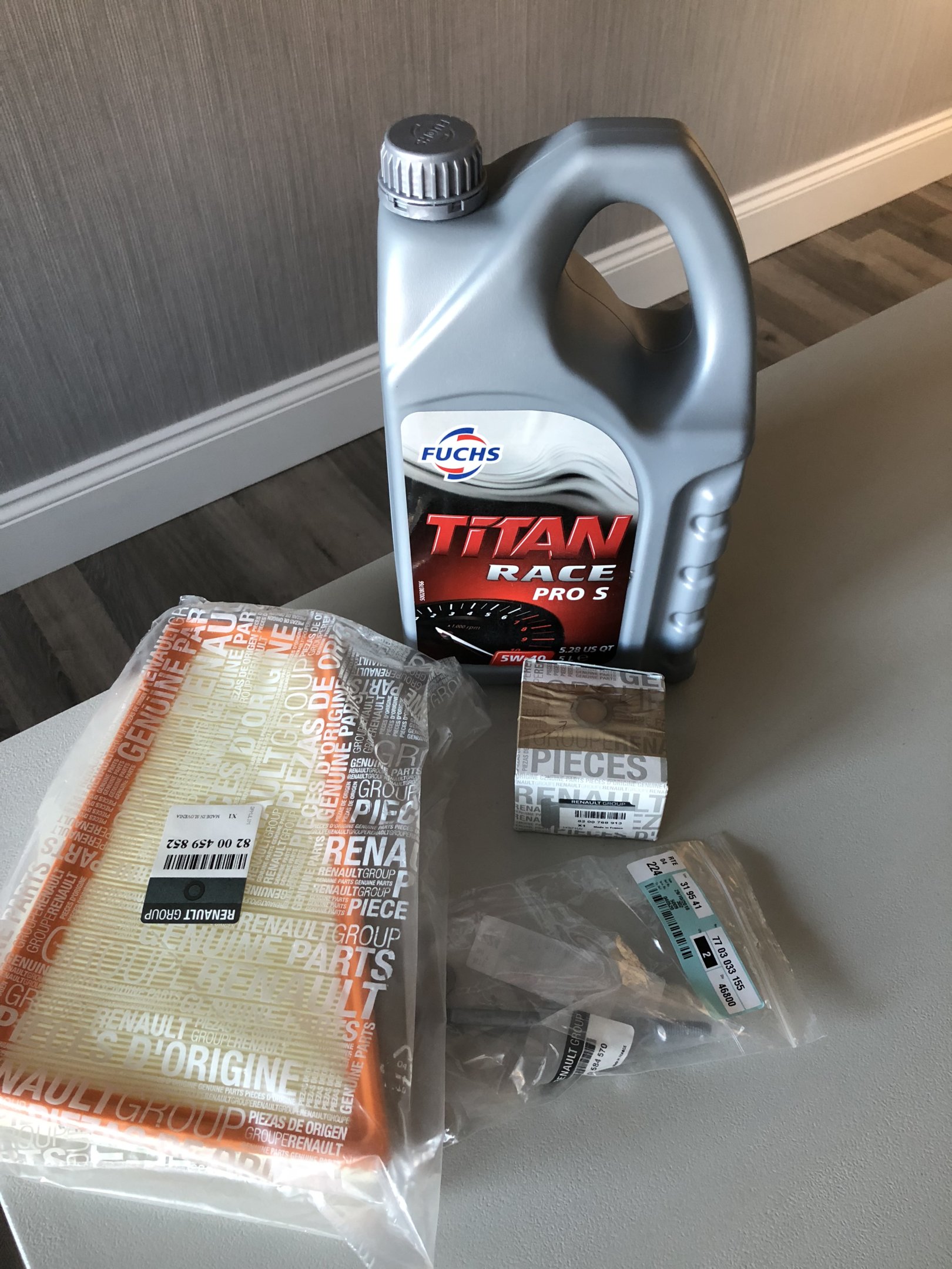

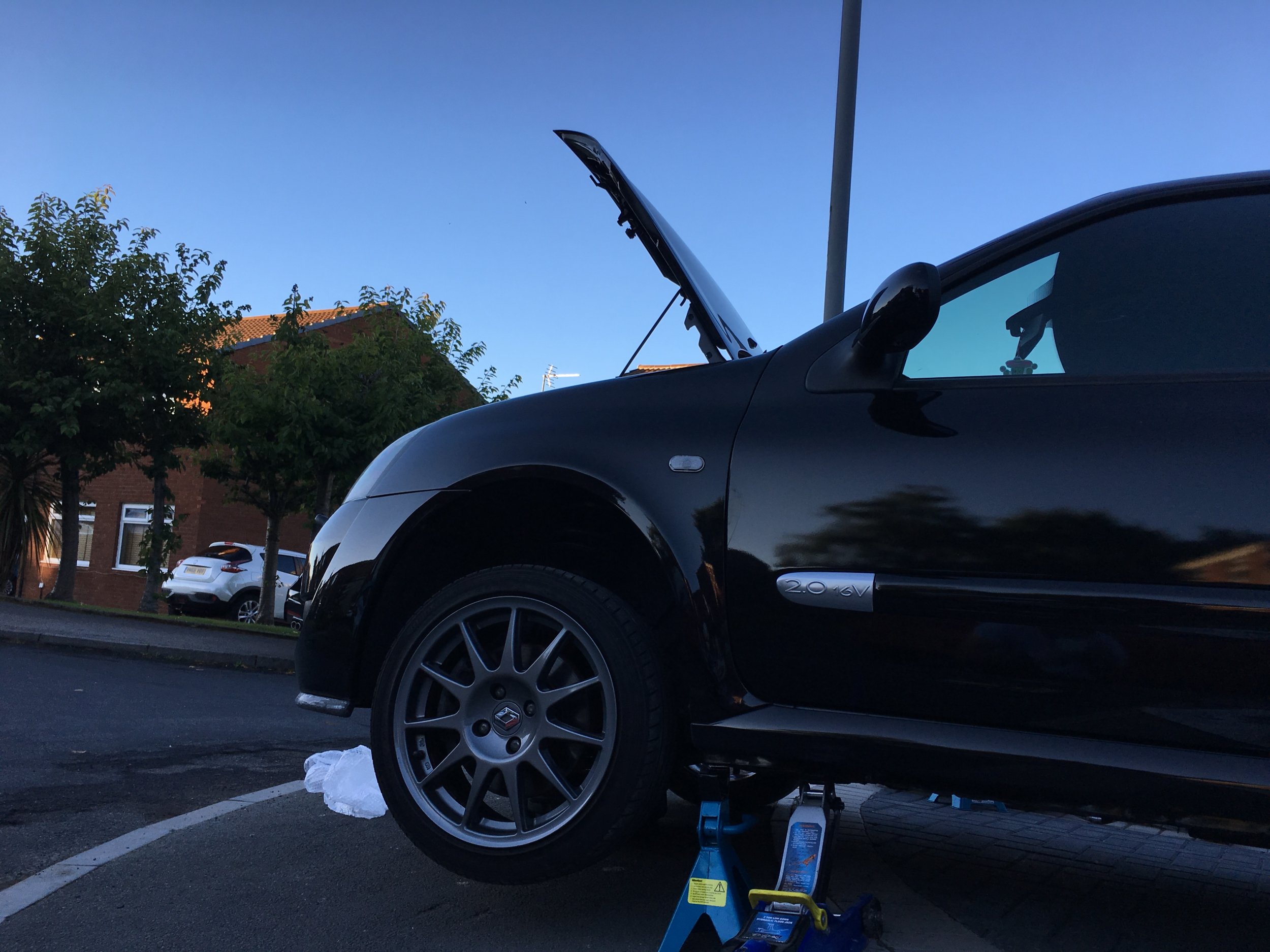

All of the service parts I ordered arrived so I decided to do the service today... what a pain it was taking 6 hours before i finally got it done...
Car jacked up and everything ready, thought it would really easy with not having the fuel rail in the way anymore...

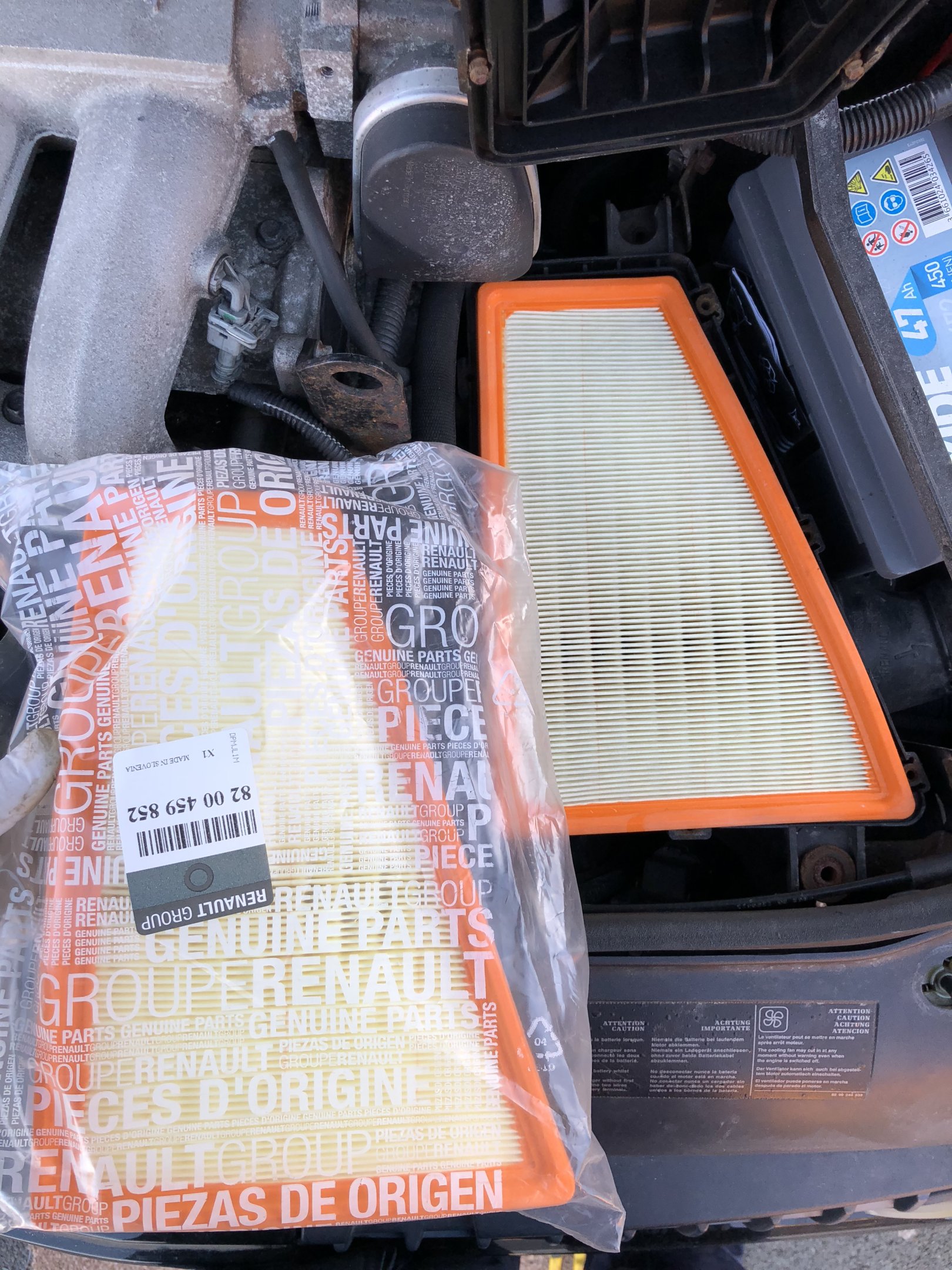

I have only covered 1763 miles since it was last serviced in July last year, but as that was 15 months ago i wanted to refresh everything, regardless of the little mileage covered.

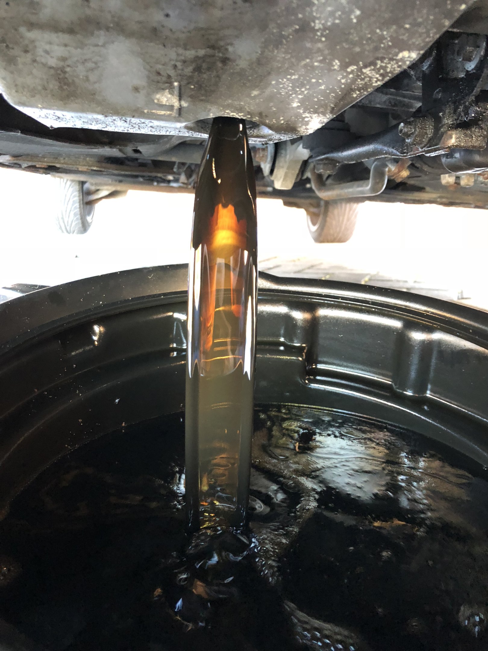

All started well, and as expected, the oil still looked decent...

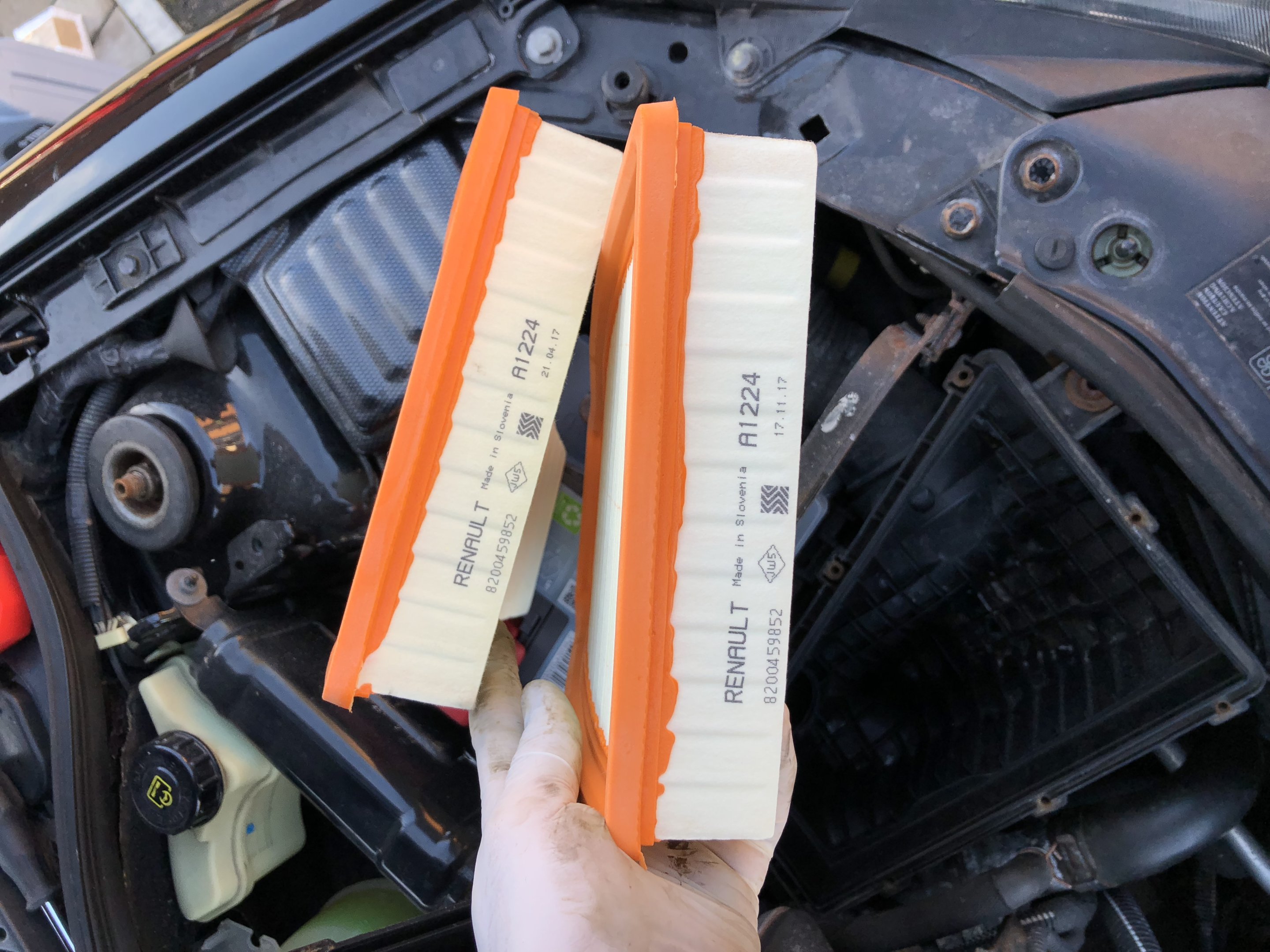

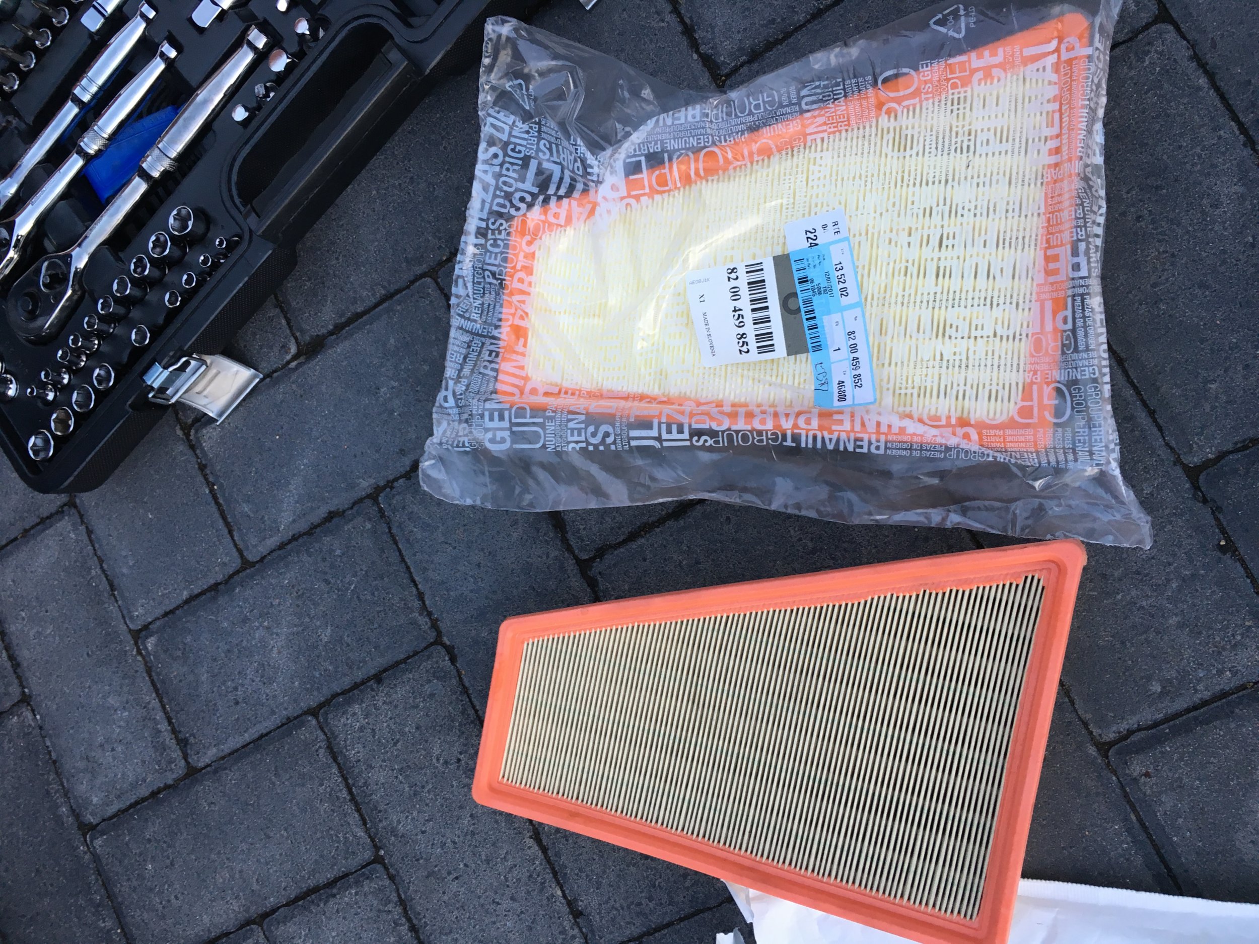

I knew the air filter would still look good, but when i opened the airbox it still looked brand new and could of easily got another year out of it. As i had ordered a new filter, i thought i might aswel change it anyway, and next time i will just do the oil filter.

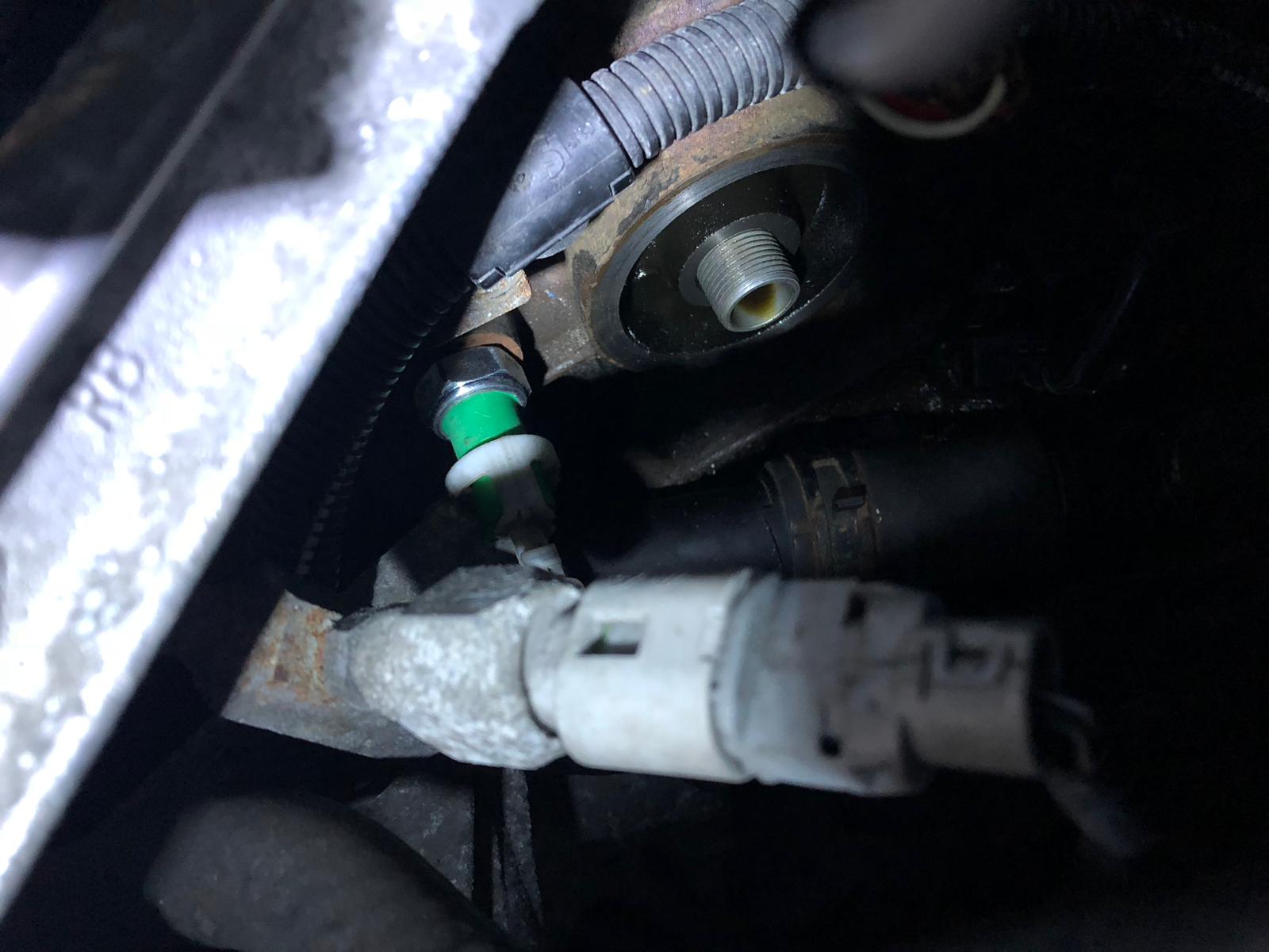

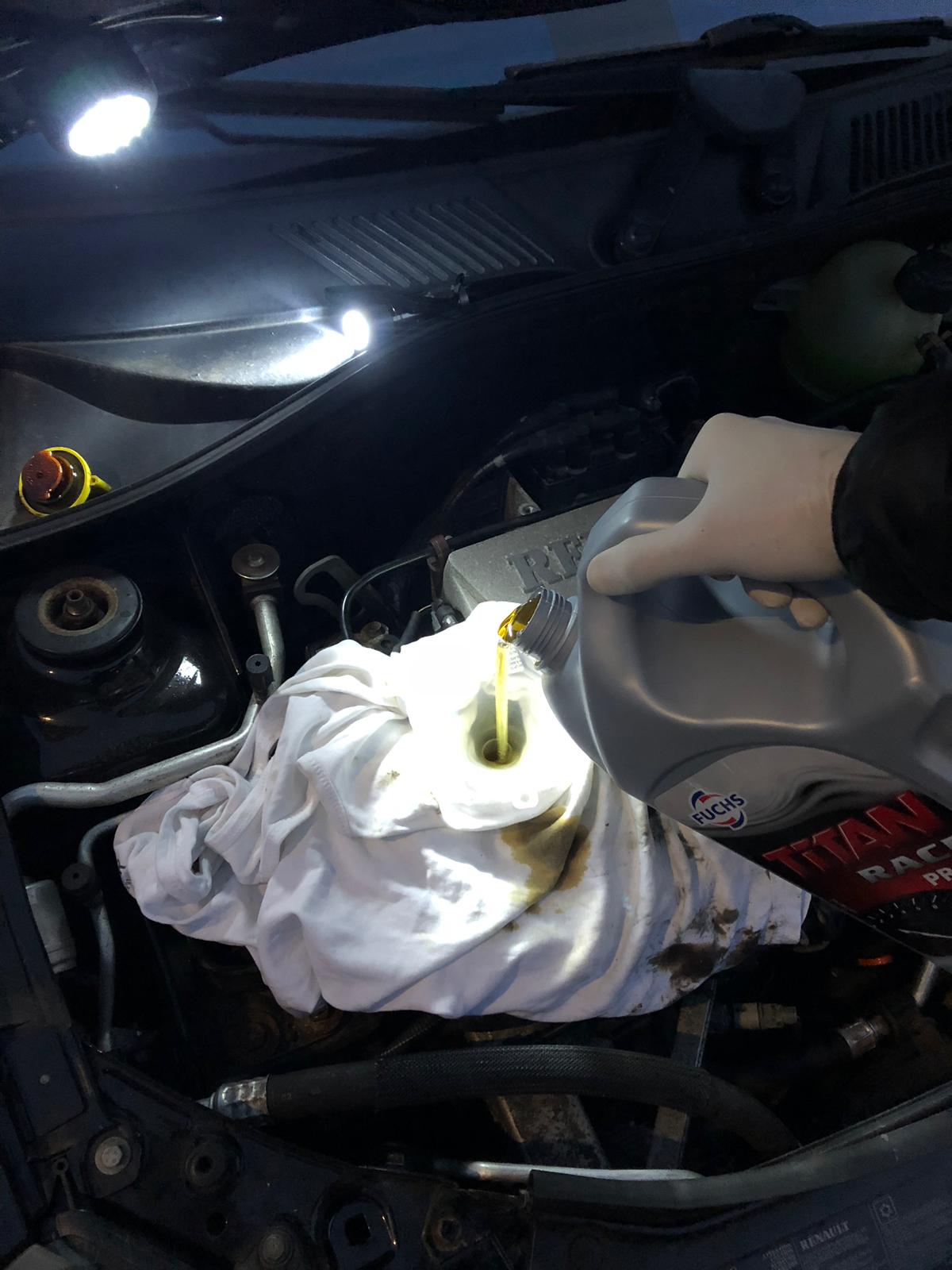

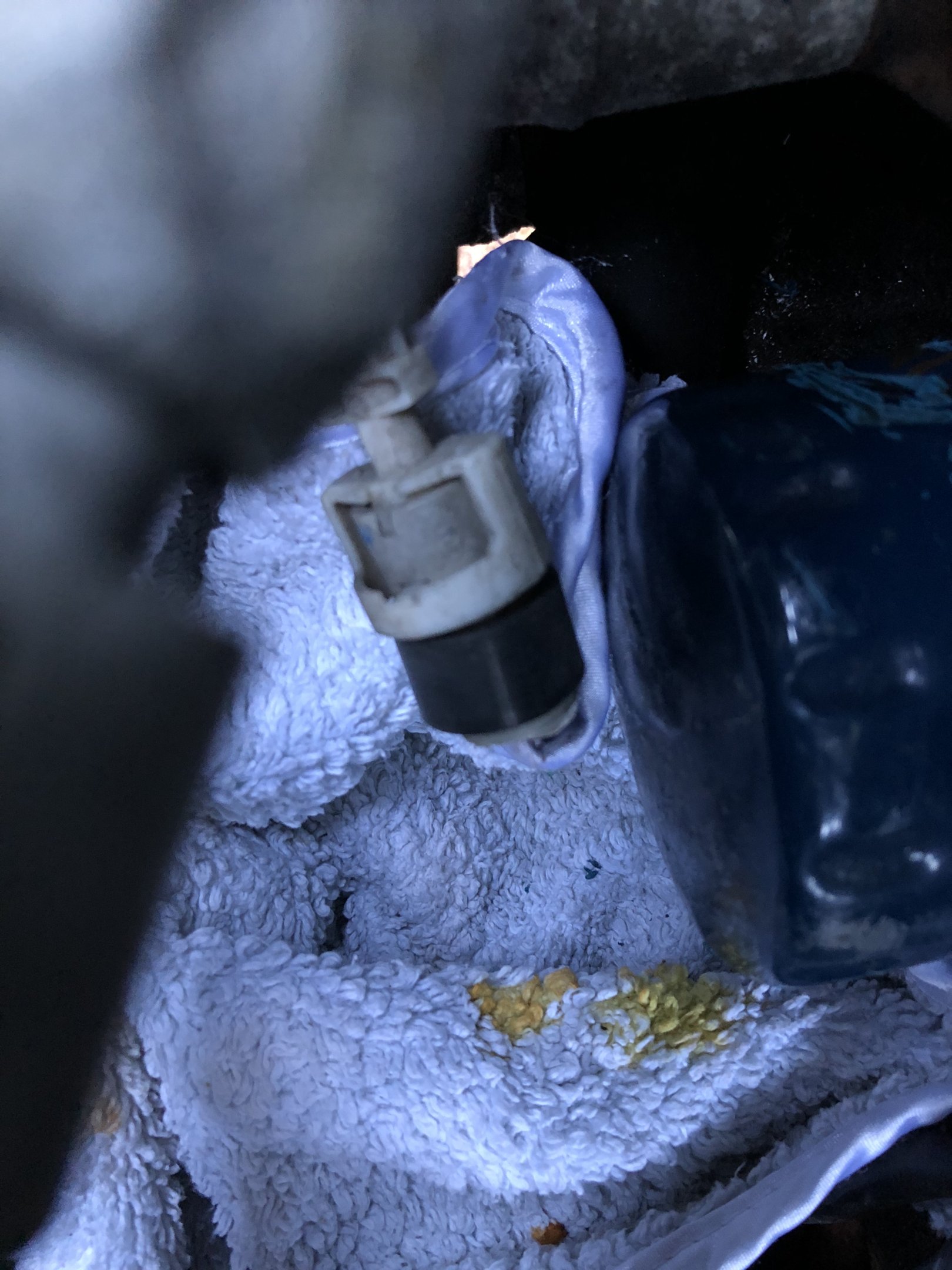

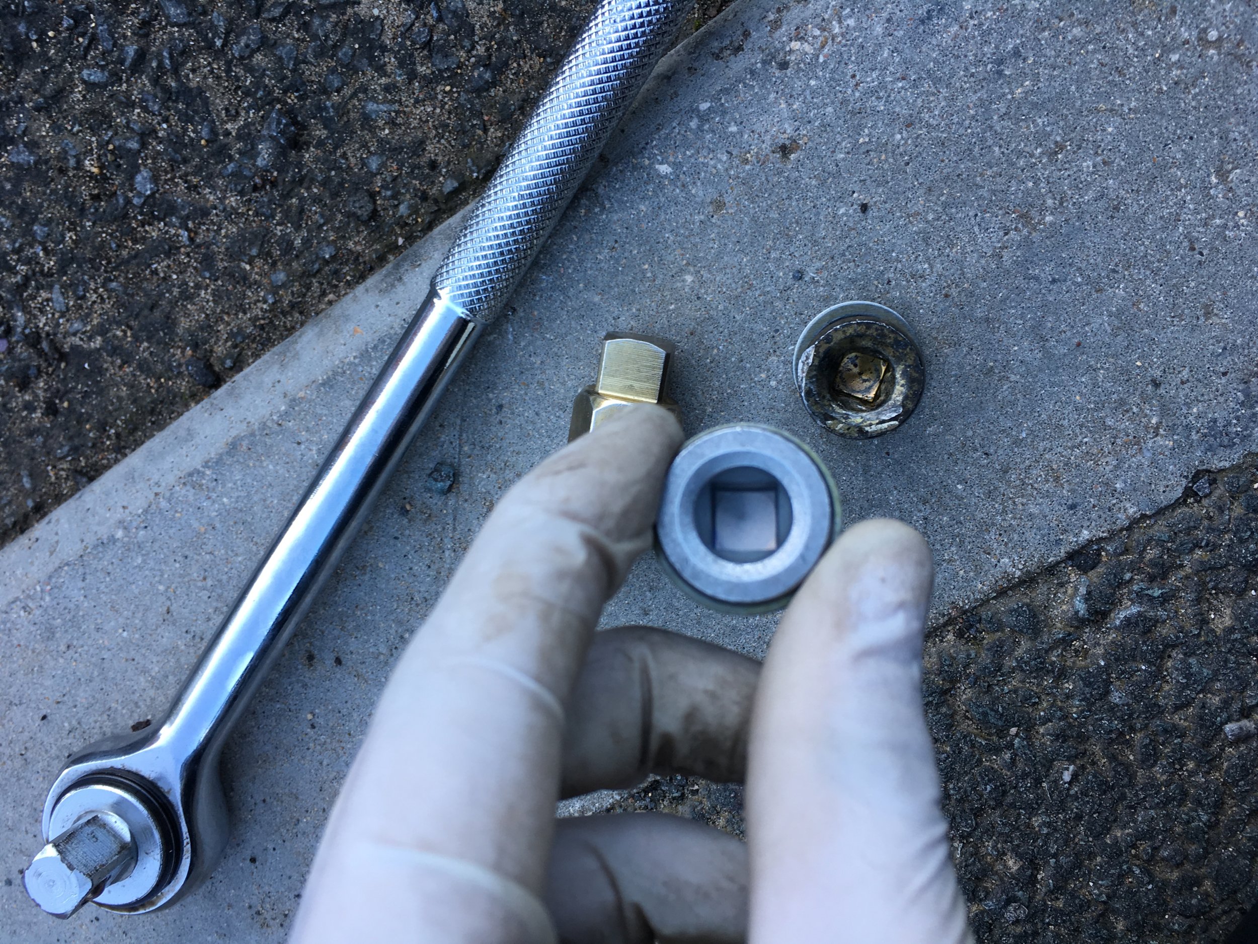

This is when the fun started! While trying to remove the oil filter i ended up snapping the oil pressure sensor. This is what took so long, as i have been ringing and driving around trying to find one. I managed to get one ordered and was told it wiuld be on the lat delivery of the day.

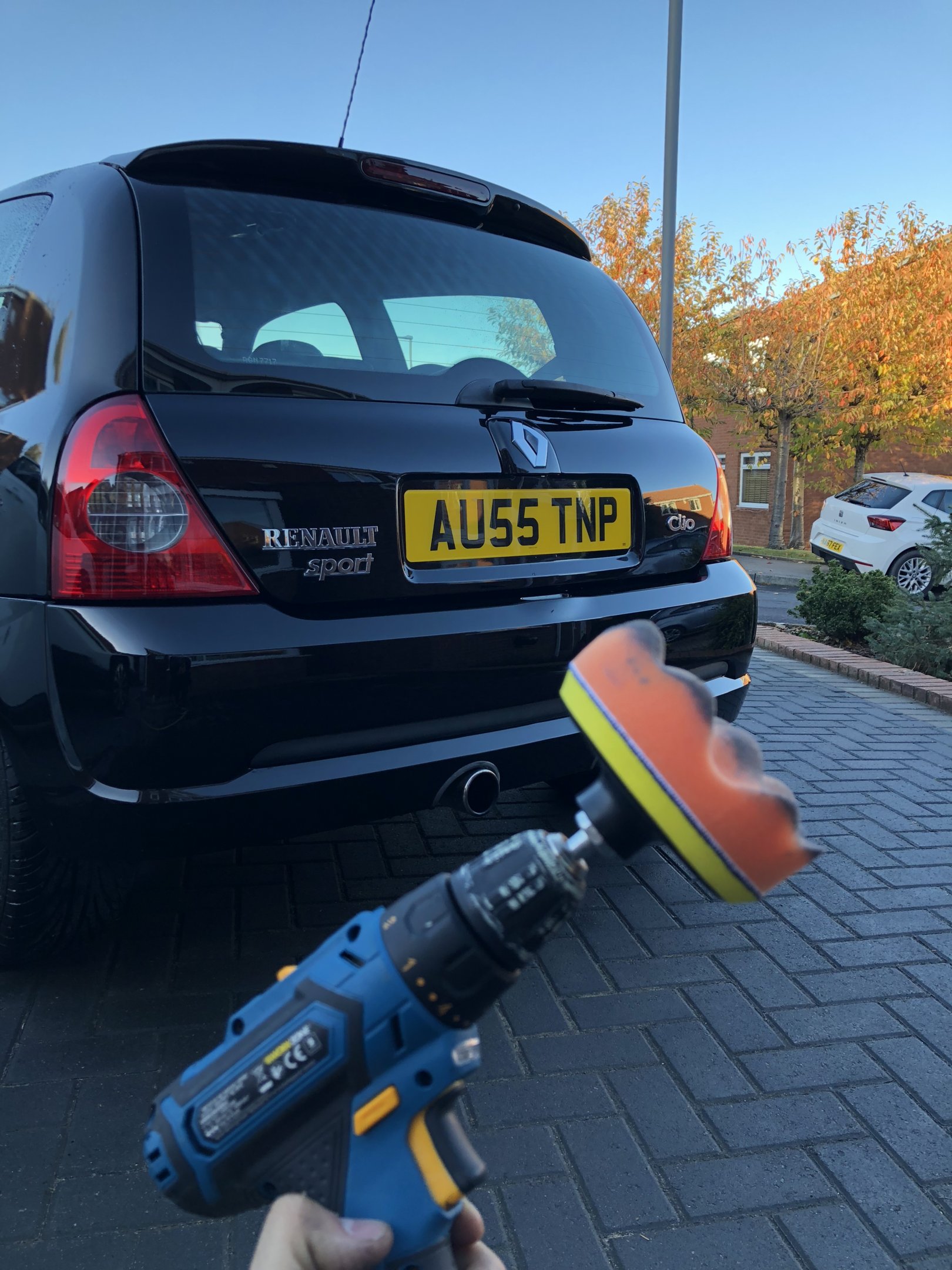

While i was waiting for this, i decided i would give my ebay special machine pads a go. You use them with a drill...
They actually did a decent job. I will get a proper machine at some point.
The dark was now setting in and i picked up the oil pressure sensor, and managed to get it on along with the oil filter and oil in.

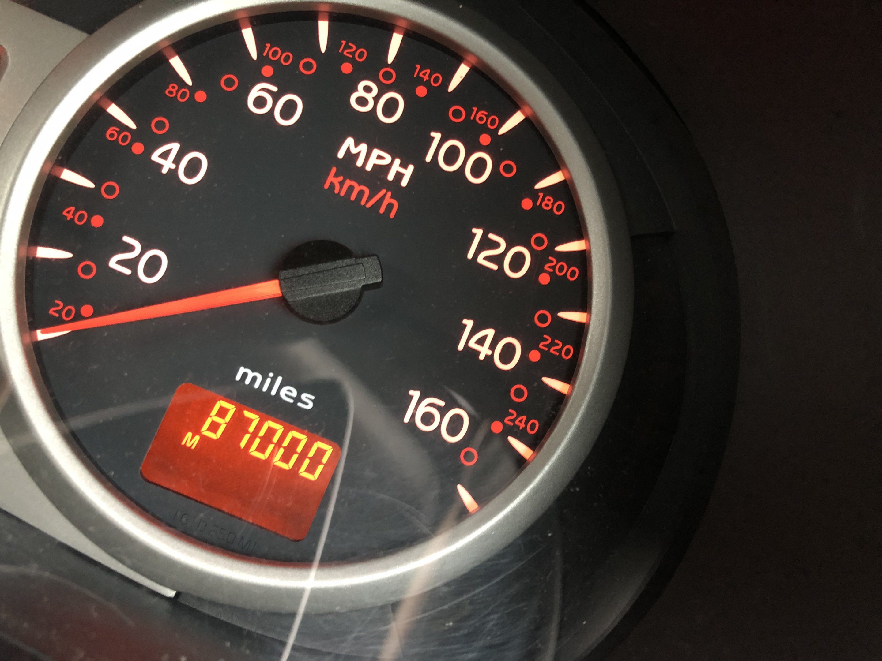

Mileage is now on 87081, and i have just filled the service book which now has a total of 12 stamps in it.
