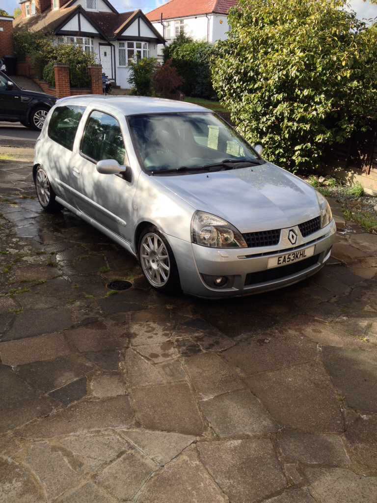

Test One for me, unfortunately the weather stopped play but I managed to get the products applied to the chosen panel on my car before rain stopped play.
Not many pictures I'm afraid as my SLR battery was flat so had to resort to my Iphone.
The car was pretty filthy having been down to S&MWM to have a new engine fitted (The guys did offer to wash it for me but I declined due to wanting the car back ASAP)

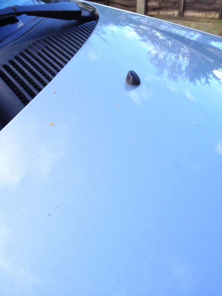

I decided to use the bonnet as the test area as it gets the most weathered blatting up and down motorways and country lanes it gets heavily soiled.
Hopefully you can pick up the debris / bugs and grime in these pictures (above and below)

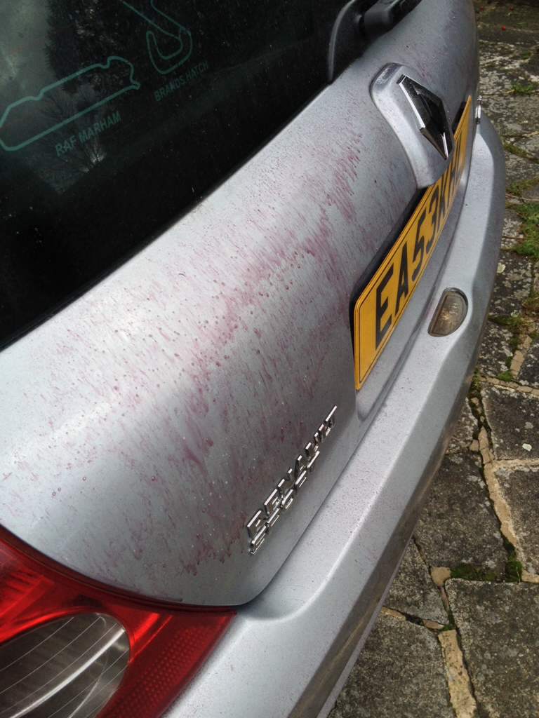

First up was a wash and basic decontamination, the car has been well protected having undergone a thorough wash and protection earlier in the year, in the interest if fairness the bonnet was washed (2BM) with Auto Finesse Lather (V1), Clayed with I4Detailing clay and then a liberal spritz with Auto Finesse Iron Out.
As the car was filthy same process was followed over the rest if the car (apart from clay). Strangely there was a lot of fall out present considering it was hit with IronX about 6 months ago, possibly due to parking up where I work.

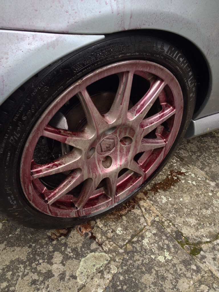

Wheels were hit with Bilberry followed by Iron Out

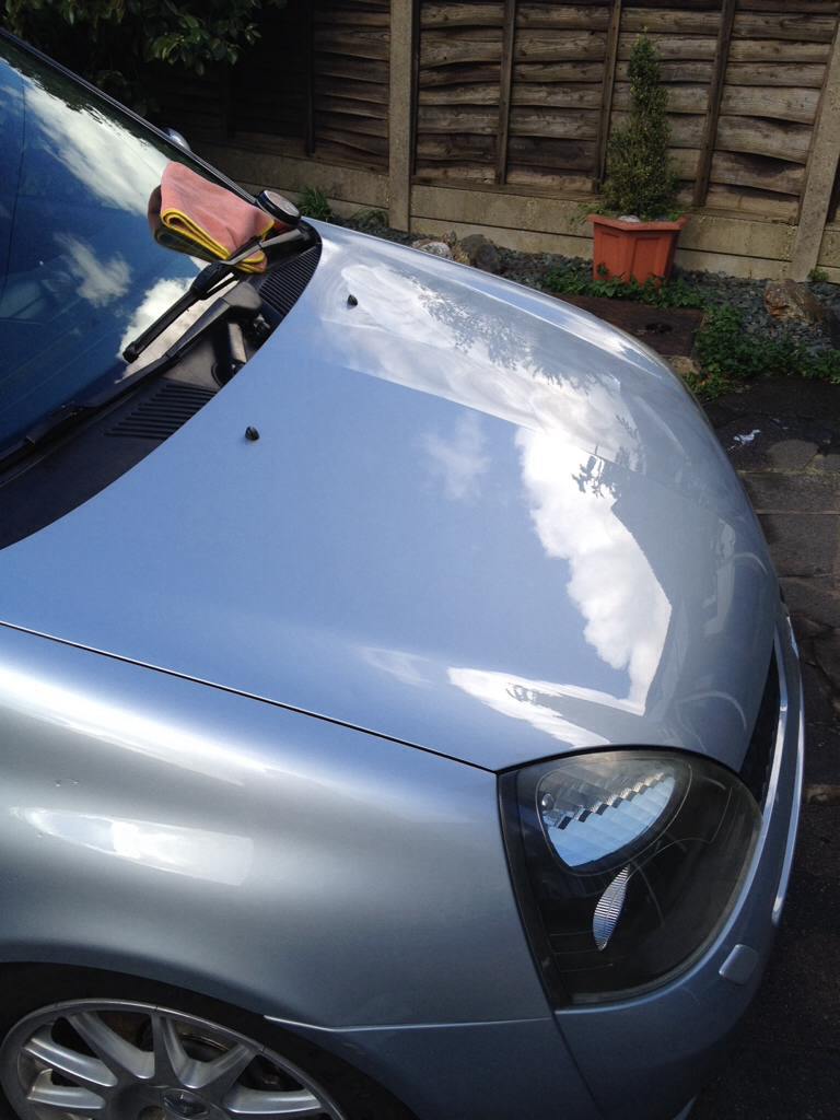

Both side of the bonnet buffed off with ease leaving a nice slick finish with noticeable improvement to the flake pop in the paint with minimal dusting created from the product, the swirls present in the paint were also noticeably improved as the Tripple filled minor imperfections.
One thing I did note, despite wash, clay and decontamination Tripple still managed to pull dirt from the paint, impressive.

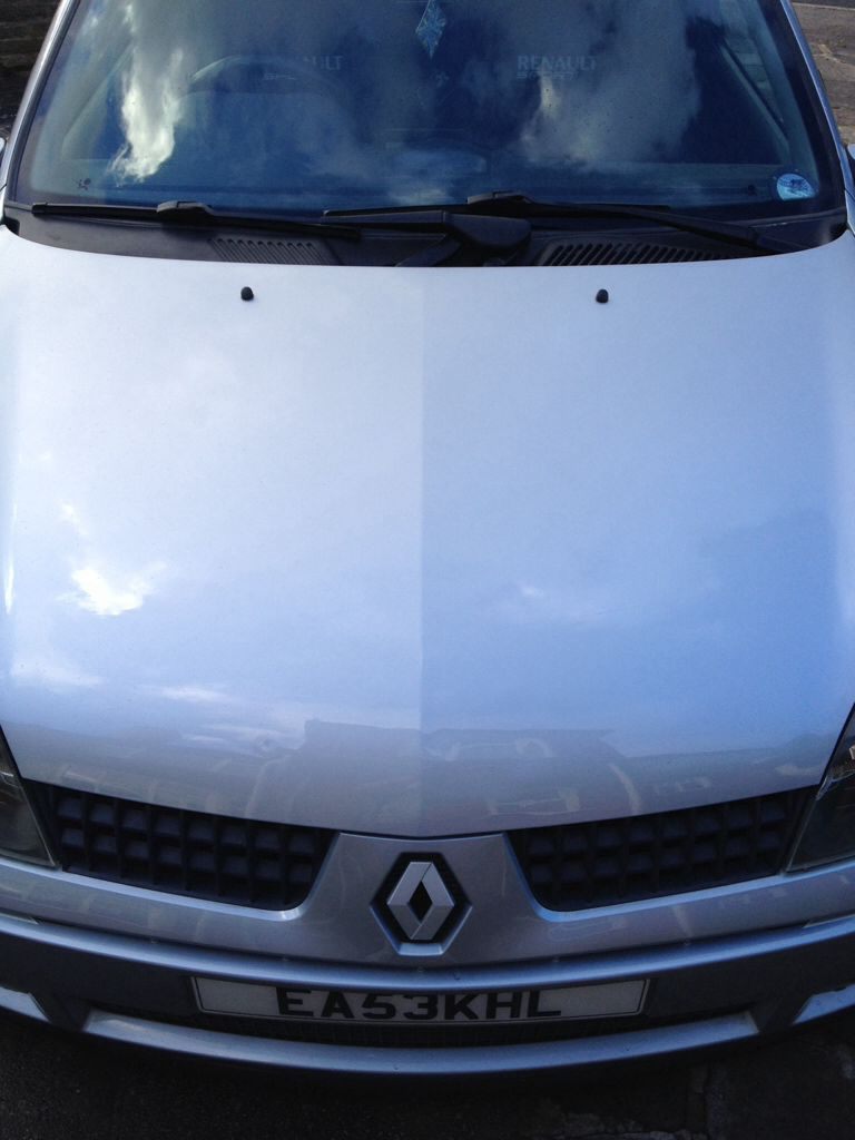

Tripple on left, Spirit on right.
Over the Tripple only side if the bonnet you can (in person) really see the difference the wax gives, with the Iceberg Silver on my car it really enhances the blue tinge, leaving a wet slick to the touch finish.

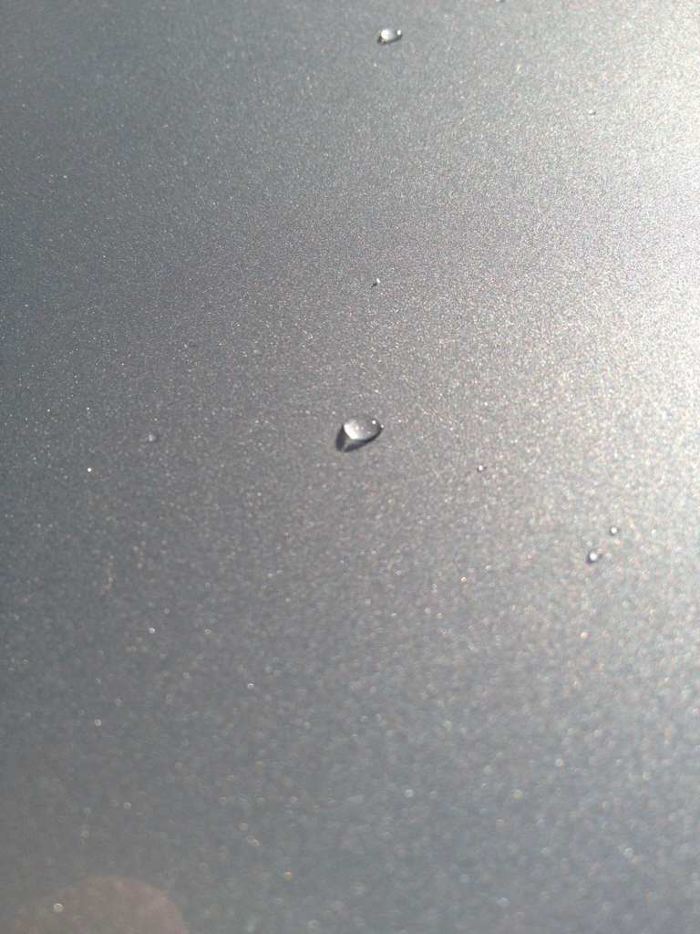

A few spots of rain fell at this point as I was working my way round the car with the wax, so I gave up with its application on the rest of the vehicle for now but did get a quick shot of how the wax beads up

The fall out was bad, especially when you consider it had already been done a short while back!

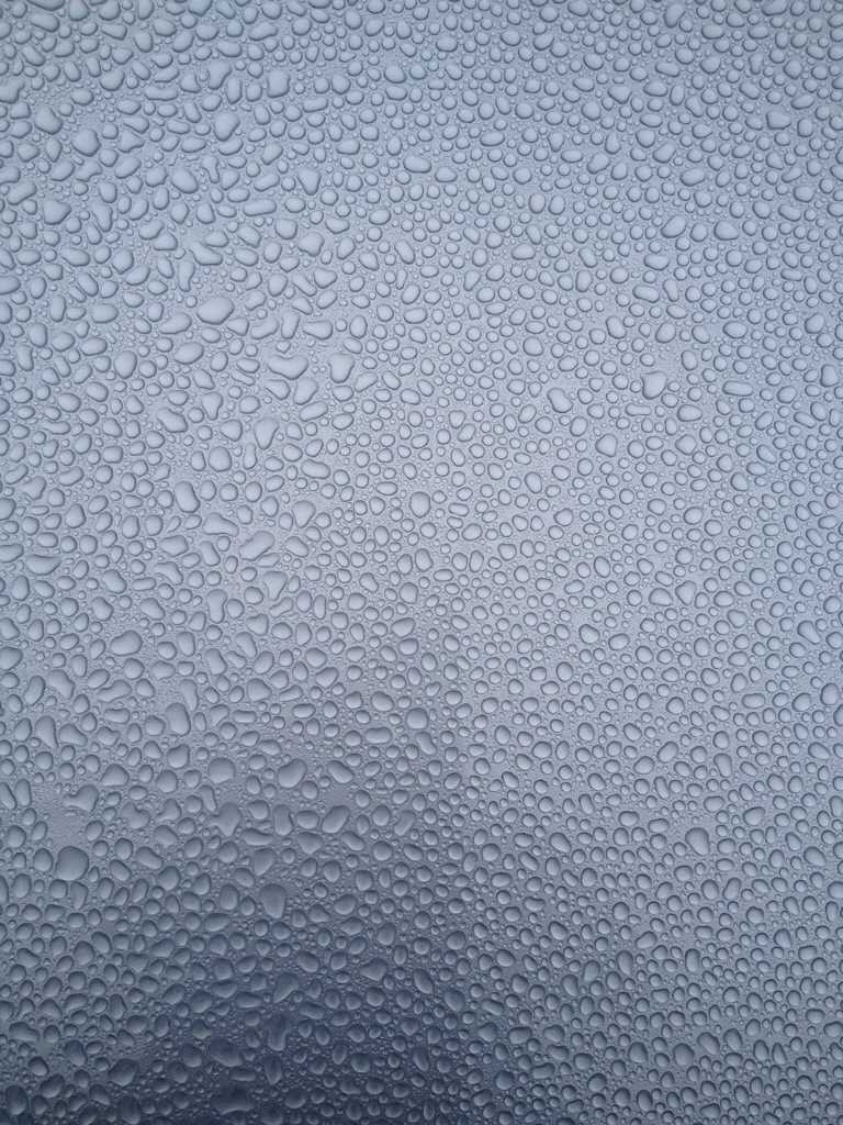

So, it's been wet and windy the past week.

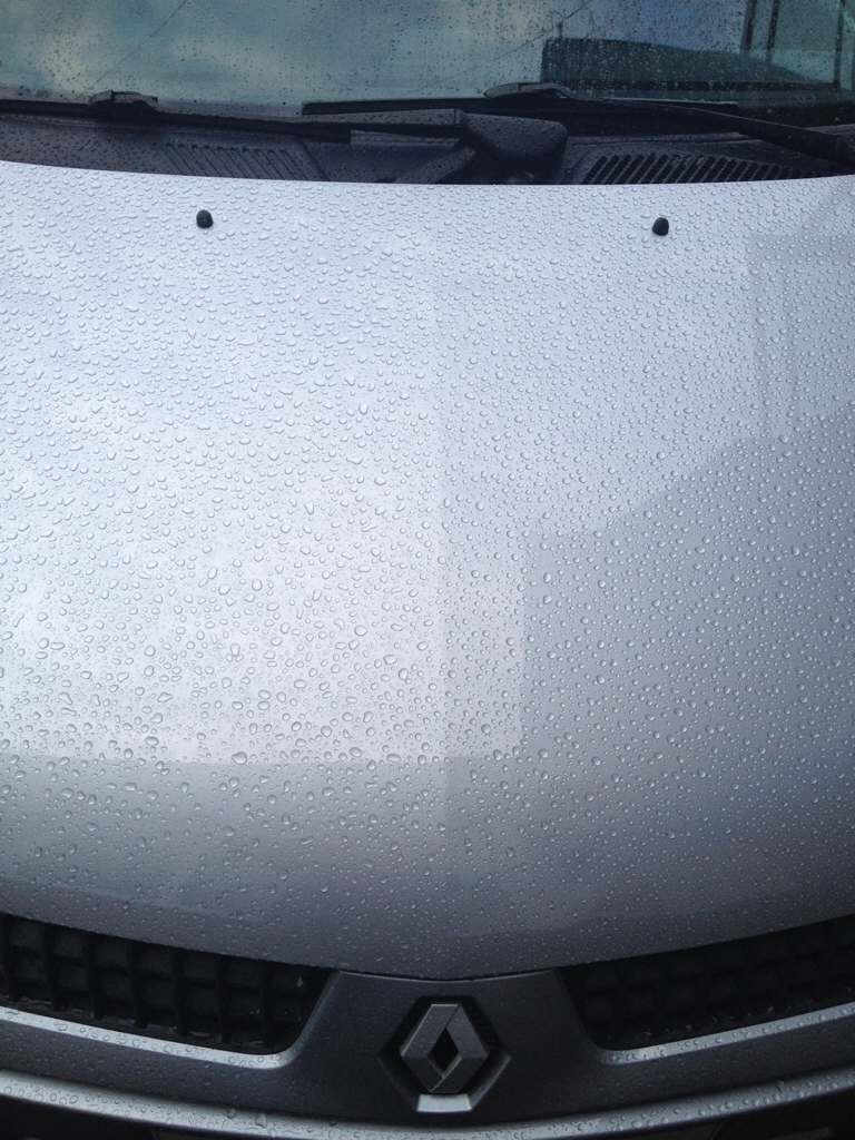

Couple of pictures of the bonnet test panel.
Observations: As you can see both products are offering protection (Tripple and Spirit)
Left: Tripple, beading well although not as uniform as the Spirit.
Right: Spirit, nice tight uniform beading
No offense, which is always read as "offensive", but that's not tight beading, -J- It's not bad, perse, but it's certainly not the best I've seen. Interested to see how everyone else gets on.
Other thing to note is I presume the car is dirty, so that affects beading?
When I say tight beading I mean Vs the Tripple on the left of the picture the Spirit is tighter.
Car was washed last weekend but has done 100+ miles since so there will be a degree of dirt on the paint.
Make sense and yes, defo will chap. Get some photos after a wash for comparison.
