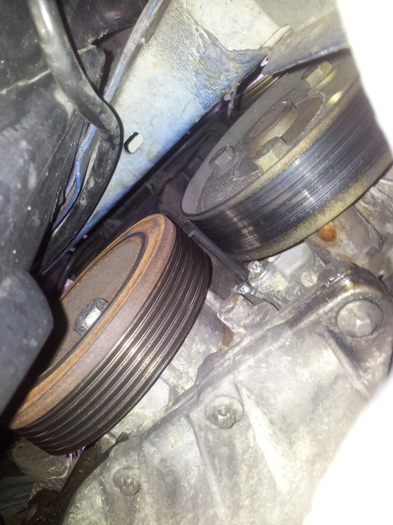

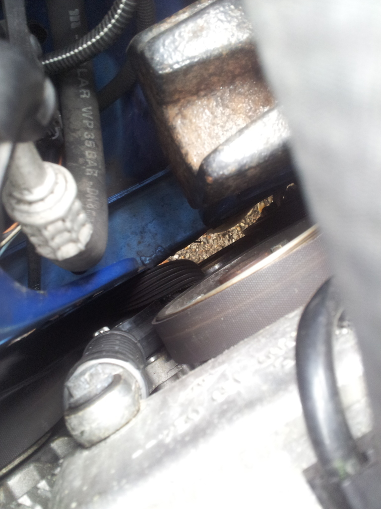

couple pics showing what has happened

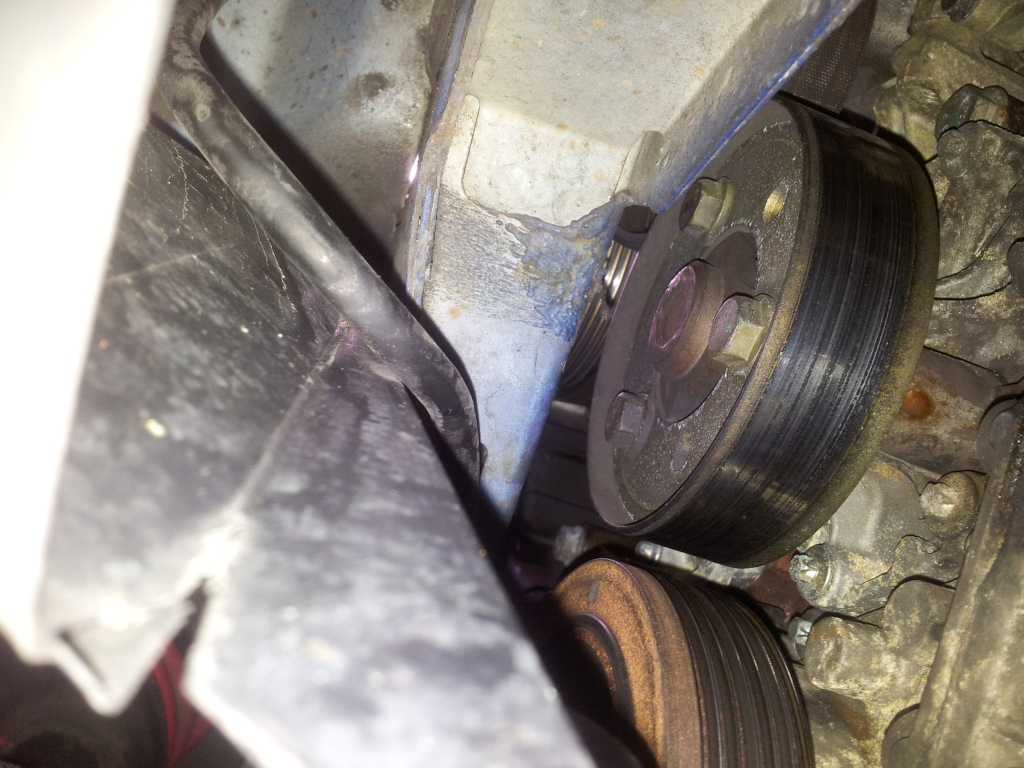

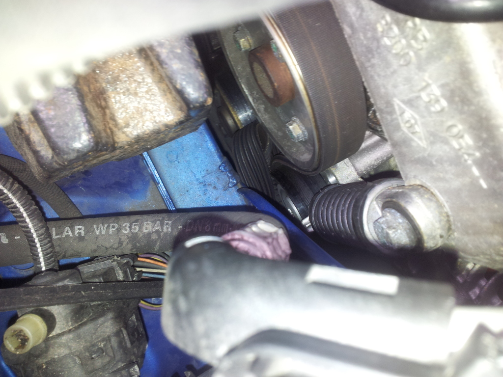

from underneath
  Lionel Richie
the temp flying up will be caused by the belt not turning the pump! The belt has "probably" come off due to a f**ked pump
if you look at the photo you posted you can see brown spoof under the waterpump which normally means - dead

Will be interesting to find out why the belt came off, nothing is seized, and the belt appears in good condition.

right so we stripped it down to find out where the problems was in hope that we could find that it had just come off and put the new belt on there. turns out the only thing wrong was the alternator which had been missing a bottom bolt and this has shaken it loose and caused the top bolt that was holding it together to snap from the bracket off so now I have get hold of an alternator and change that and get hold of new bolts.
