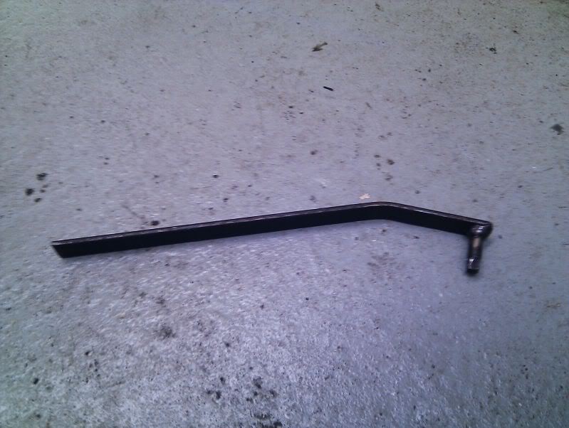

I don't know why people are obsessed with this jubilee clip idea. It's crap and dangerous
proper way of doing it, with a proper tool
I've ordered the bits to make a few of the tool I made so a few people can buy one. I'll put a thread in group buys or something when I've done them
Cheers Dan I will have one as I used the old tensioner for now and need to revisit it.
