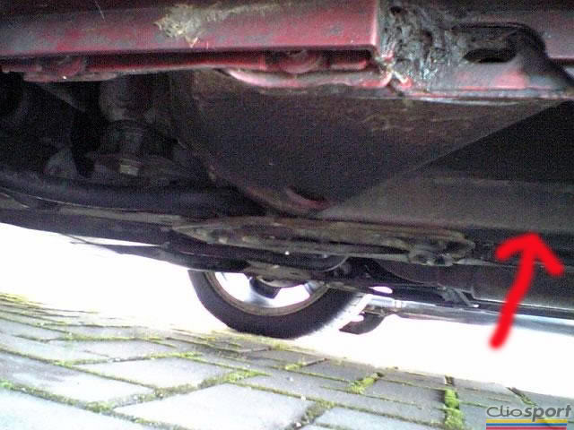

look at picture

if you jack from the point i've indicated in the pic, you will lift one side of the car completley off the floor (useful for changing wheels)
wack in an axle stand just behind that point
lower back down and repeat on other side

Fred....i jacked the car up on the standard jacking point and it lifted up both front and back lol...bit scary really!
Nope you shouldn't jack on those points at all you can with the right stands hold the car on those points.
You need to jack behind the thingie your jacking on. I jack on the bit so that the jack corner is up against the metal bracket your jacking on.
You cna jack on the sills safly so long as you either jack slowly or preferably jack on the front and back at the same time or you use a spreader plate to lower the pressure over a larger are of the sills.
  Ford Fiesta
if they can hold the car why not jack on them?
take your point though, need to be on the floorpan bit that is lower to ground yeah?
