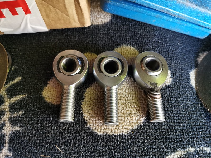

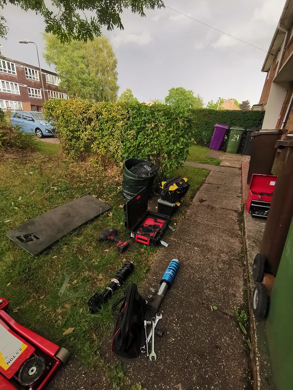

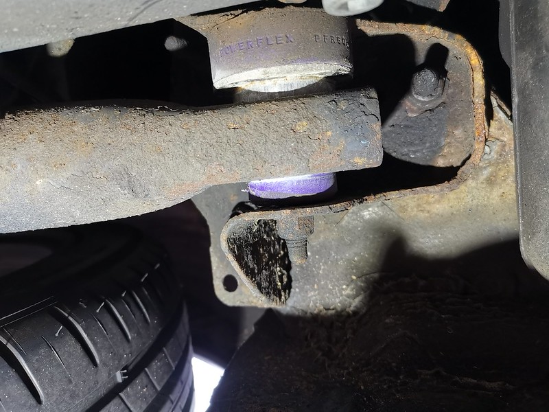

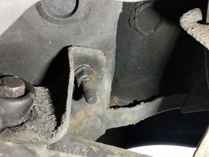

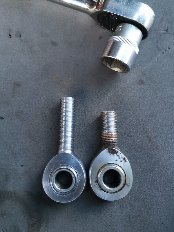

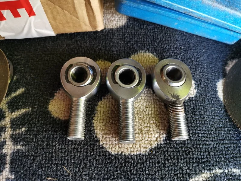

The rod ends had also gone pretty stiff for some reason, so off they camr to be replaced
Straight away another simple job wasnt so simple 😂

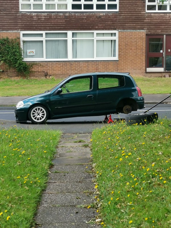

Luckily I had a cutting disc at home (keep them at the unit normally)

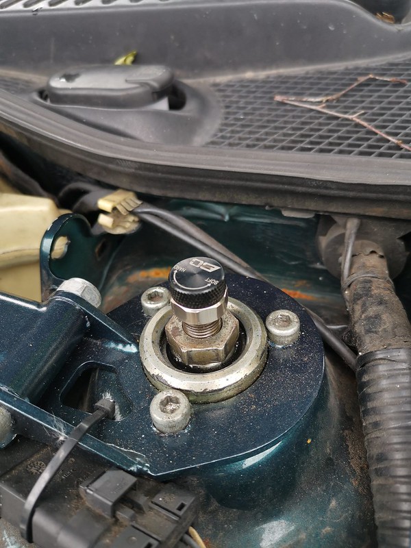

Got those on, and the passenger coilover and clap... thunder
Had to halt and get everything inside.

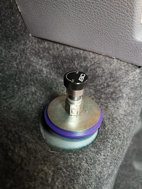

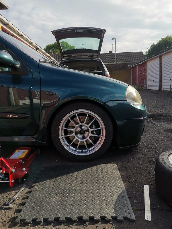

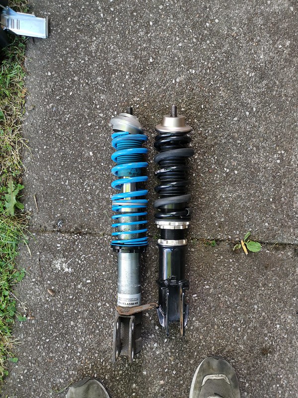

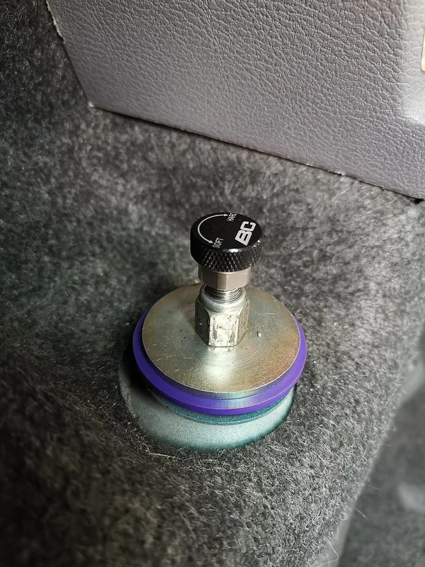

Quick camparison of the BC's to the B14s
Managed to get everything fitted, now just to get the ride height correct
Started sorting the fronts and once again, stopped by a storm
Fronts dropped, felt like the rears could do with coming down a bit more
It's been one of those times where nothing has gone as planned, but I think we're finally getting somehwre.
Castor seems even now both sides, so thats the odd castor issue fixed,I think
Steering on test drives seems far lighter, despite the tracking being out and toeing in making it heavy.
So once tracked I should have beautifull steering again.
Will be taking it to have it properly alingned and corner weighted. Debating swaping the gearbox before this though as that may cause a change in it with taking bits back off.

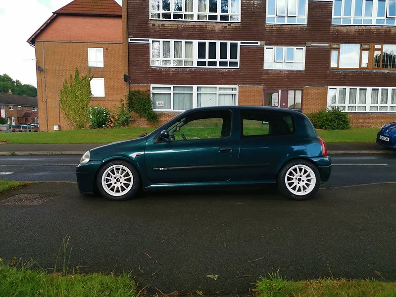

Heres a pic I like
These wheels are properly growing on me, even the white I'm realliy digging atm.

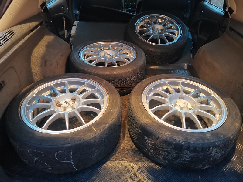

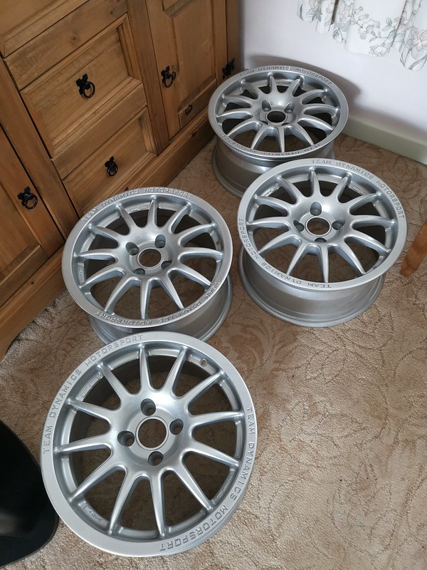

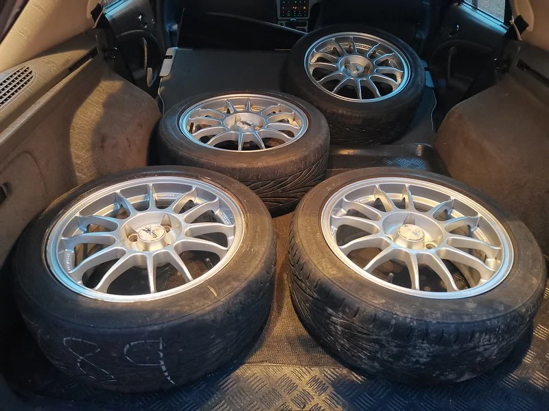

Talking of wheels, spotted these on a facebook group and quite simply couldnt help myself for the price.
15x7 OZ Superlaggera
No idea if they will clear the brakes, will find out when I get round to test fitting I guess

What size spacer are you running on the front with the team dynamics to clear the brembos?

Take it they're not ET35 then?
Pretty sure they are 35
Reason I got 1.2s was because theyre known for aving loads of space for brakes.

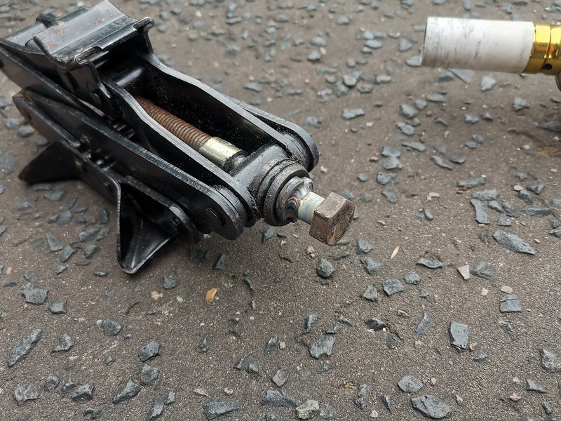

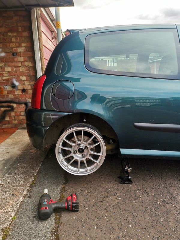

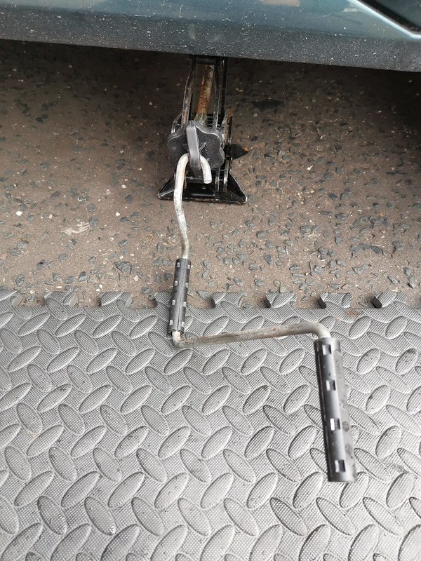

I'll start with something random, anyone had this happen with the OE scissor jack?
Completely bent the handle, so did a cheeky mod
Can use the scissor jack with the gun now, which is decent lol.

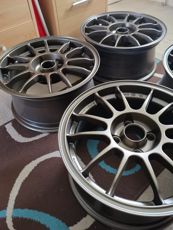

Got the Supers back from machining, fit perfectly.

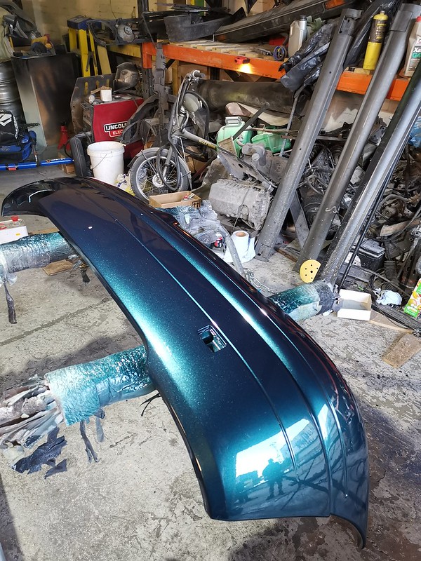

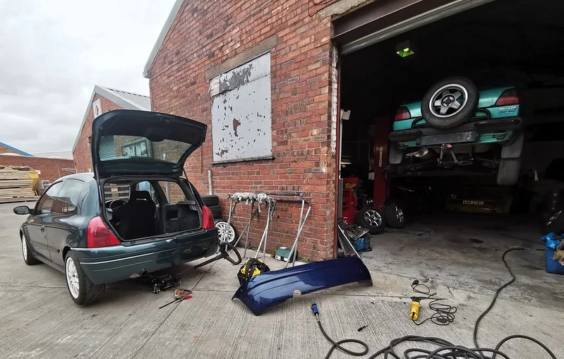

Made a start on bumper prep, at new unit doing exhaust cutout
Next up is the begining of the gearbox fiasco, But I'm going to skip that for a moment and give it a post of its own lol

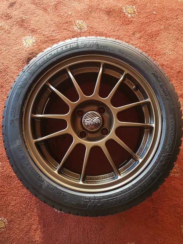

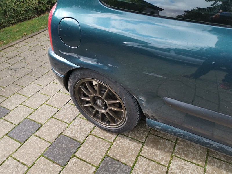

Supers back from powdercoating
Matt bronze, thoughts?
PS3's on and centrecaps fitted

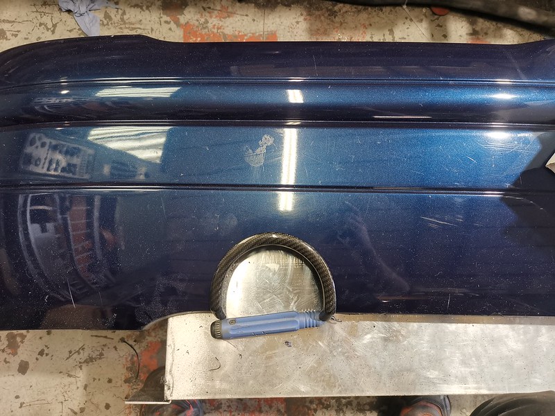

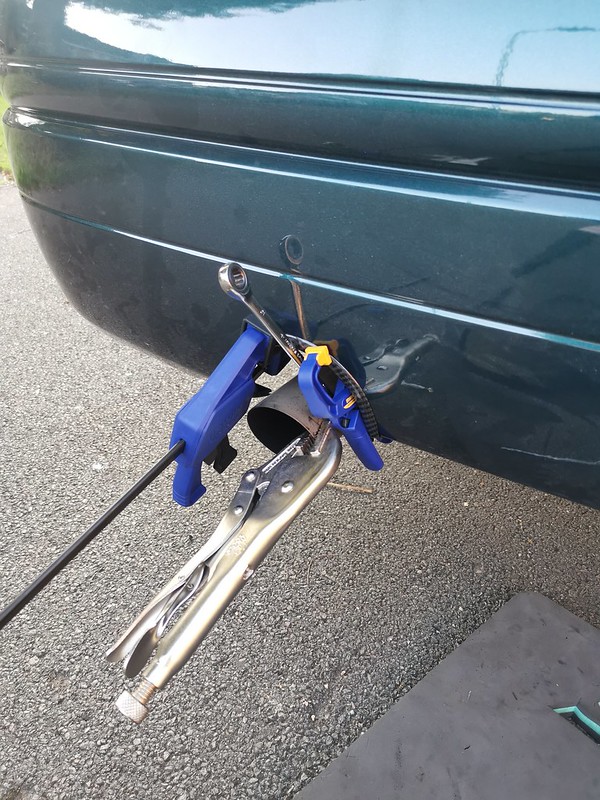

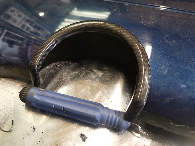

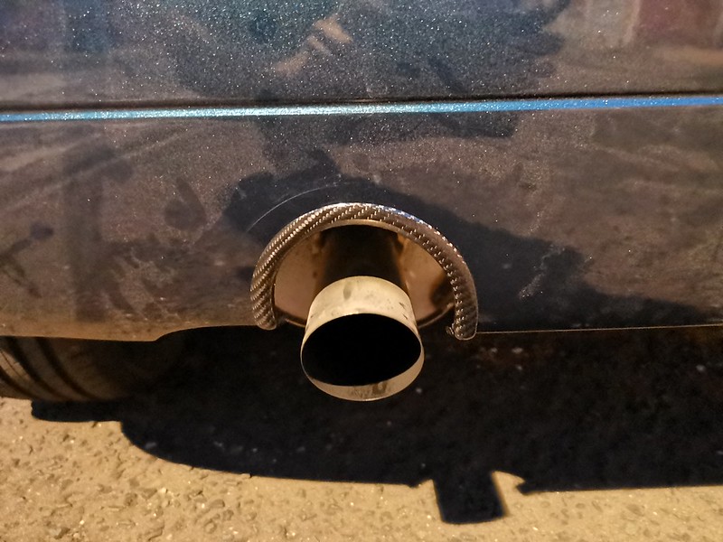

Decided to buy PMS carbon exhaust trim thingy, cutout has to be bloody massive
Looks nice though.

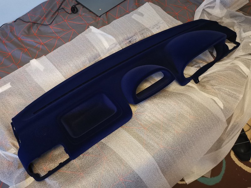

Finally got round to booking the dash in for flocking. Took a gamble and went navy blue as thats what ph1 interior is right? I've seen bllack ones and thought they looked odd being the only black in the car.
Before:
After:
Looks good right?
Just wait to see it in daylight :ROFLMAO: coming to an update soon

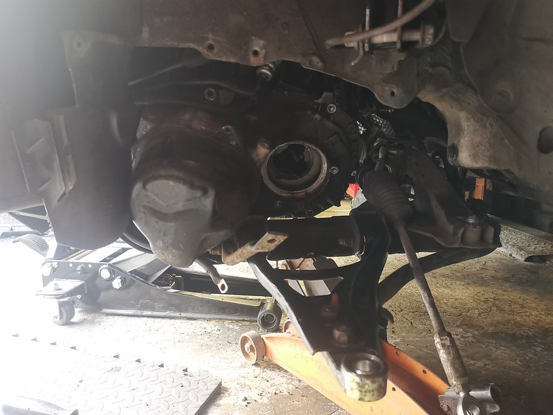

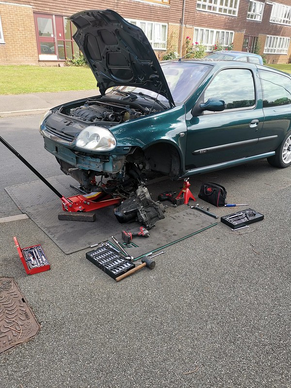

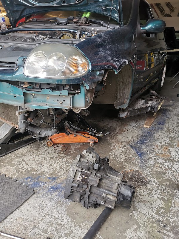

Right then, onto the gearbox.
Read all the guides and threads on doing this, most said its a fairly easy job, done in 90 mins... Jokers :ROFLMAO:
Drop subframe a couple of inches and it slides out? Jokers :ROFLMAO:
Anyway, here goes nothing

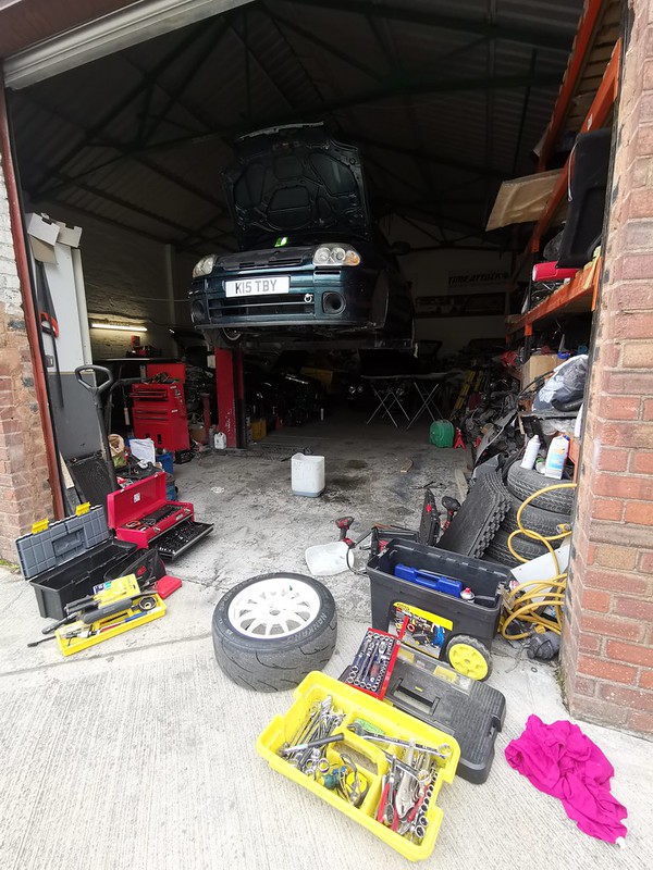

Grateful of access to a ramp now, makes a s**t job slightly less s**t.
After a lot of struggling and pretty much dropping the entire subframe off, got the fucker out. Bit more than 2" that

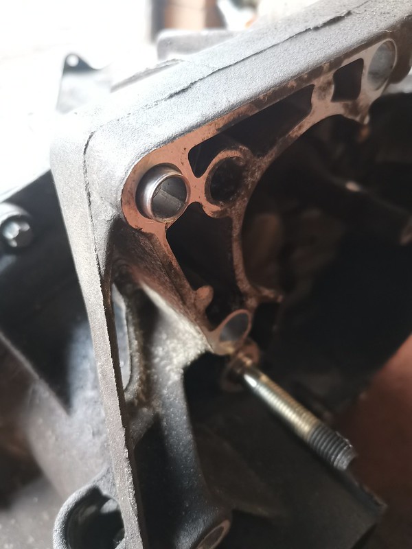

All going back in, nice and easy, just as you think its all going to plan, find out this thread is well, no longer in the box
Decide to go helicoil over drilling and tapping to M10
All back together and its making a funny noise when it starts. I'm not even going to try insert a video here, just imagine a treading on a cats tail every time you start the car.
Turns out, this was missing from the new box, starter motor locator dowel

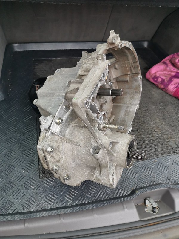

Now, I asked the chap if there was anything up with this box, said I'd rather no so i can rebuild it before fitting so I dont have to do this twice over.
Was adement it was mint. he may have been telling the truth, seemed trustworthy enough.
HOWEVER
Diff or diff bearing is seriously noisy
After a fairly nightmarish job, I've gotta do it all over again aswell as spending even more getting my original box rebuilt. Best pleased, I am not.
Box went to Agency Transmissions

Annoyingly theres a car stuck on the ramp at unit and I really need this box swap doing as the cars booked in for cornerweight setup the following weekend.

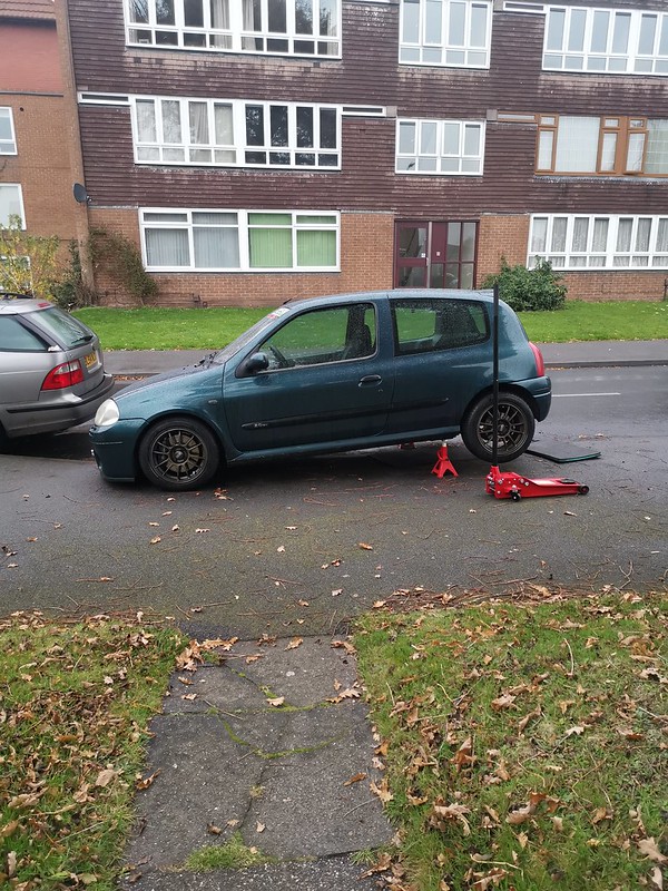

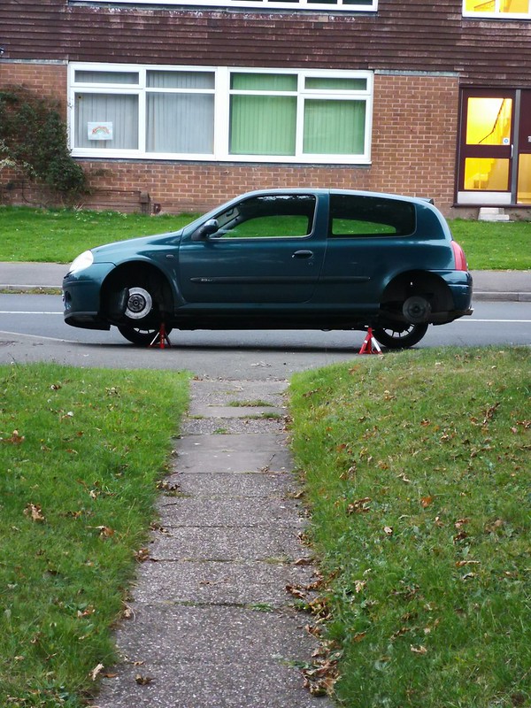

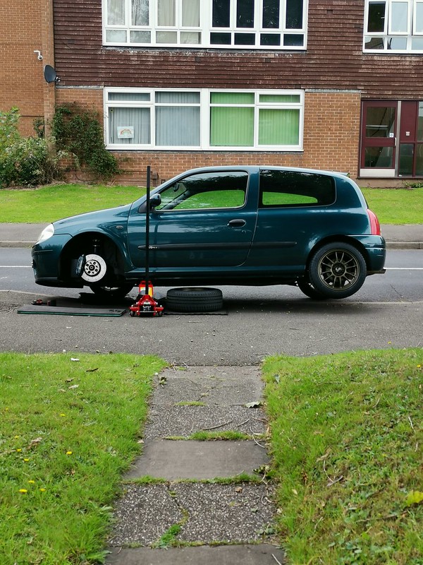

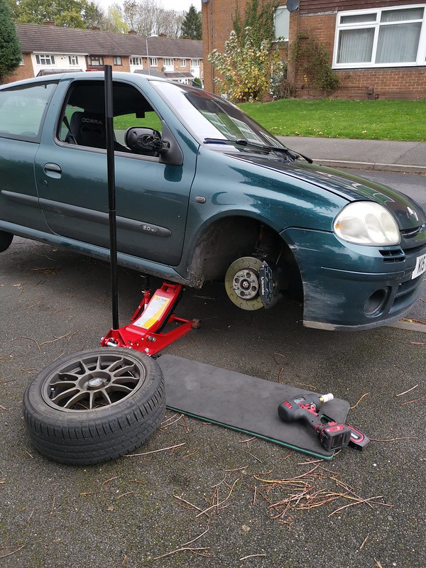

So, I do it outside the house on the road, should be easier now I know what I'm doing.
For once I was right :ROFLMAO:

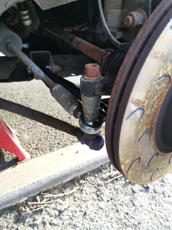

Dropping the subframe had obviously messed with the UJ on the steering rack, unbeknown to me. Was having issues with the steering all day, kept getting stuck when turned right, not ideal :ROFLMAO:
Sorted this the next day,itd just pulled off the column and not gone back on all the way thus locking out.

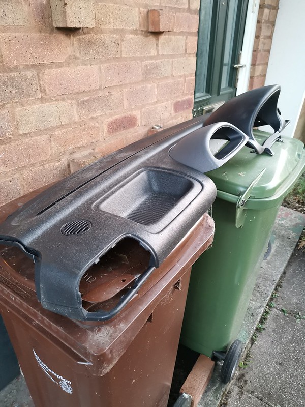

Remember that dashboard....
The less said about this the better, shouldve gone black, will be going black at some point.
It's even more blue in sunlight, like blue blue, nope, not for me.

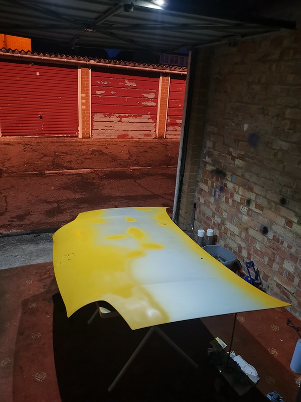

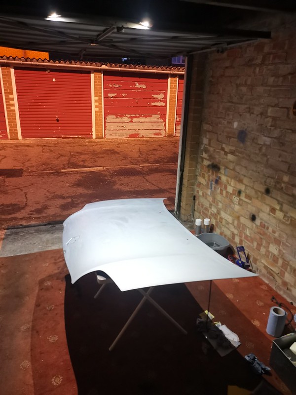

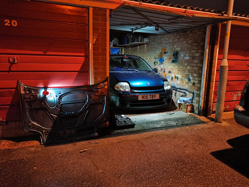

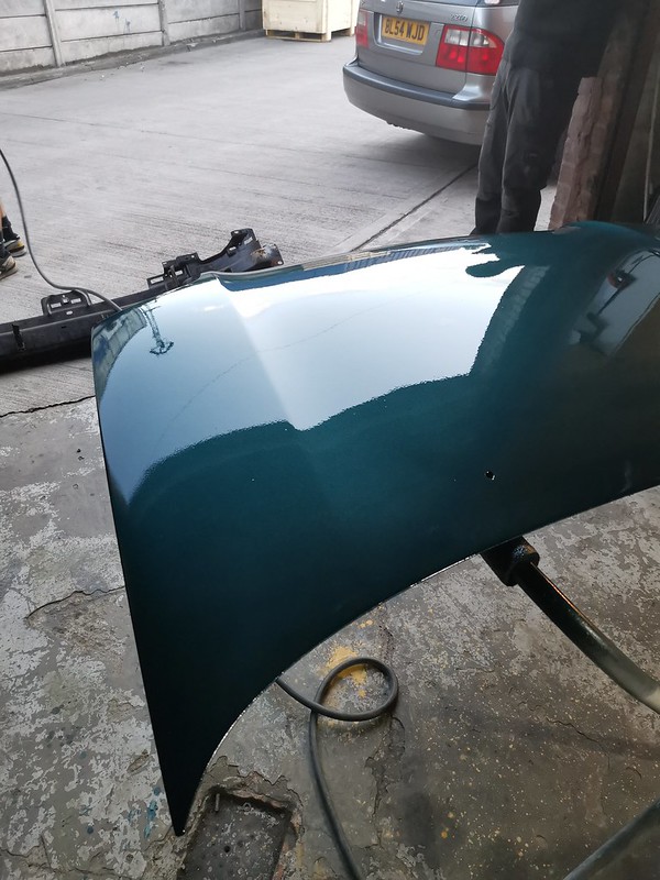

Also remember that ally bonnet I bought 2 years ago... lol
Bumper too

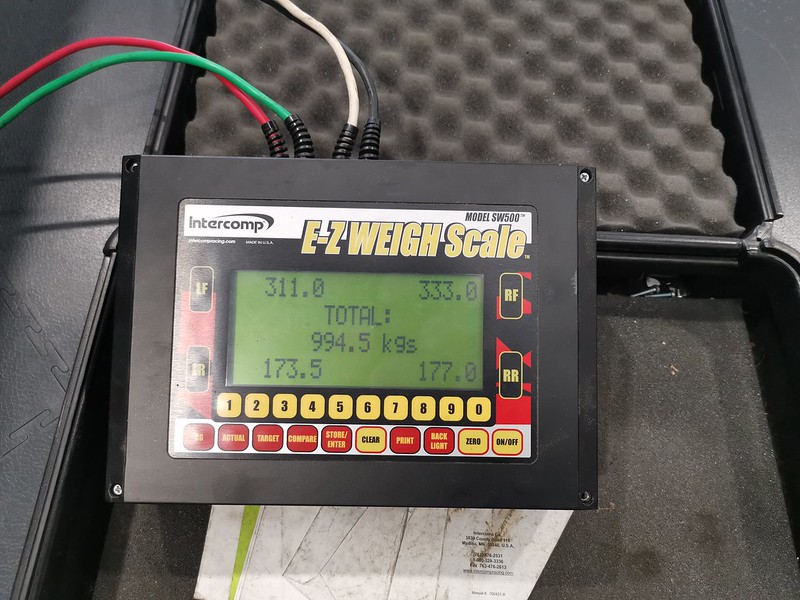

Night before cornerweight setup, had to loose that 5kg, every little helps lol.

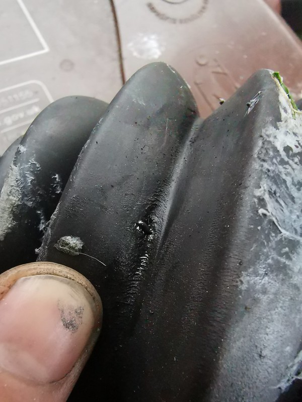

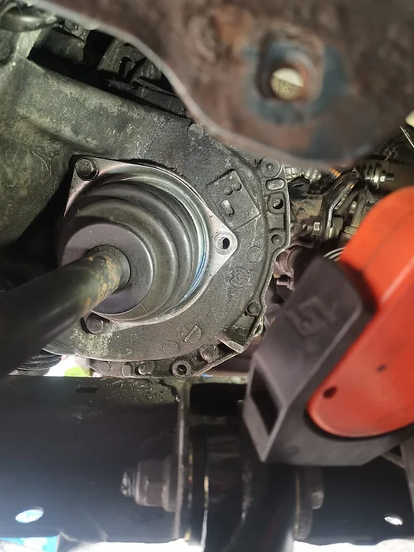

Next up, the CV boot fiasco :poop:
Put the Supers on, drove it to Spires and... yeah
CV boot split

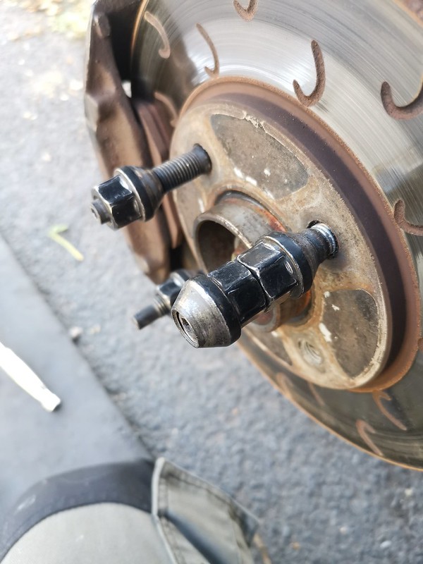

Also before I took it here, I noticed the lower joints were locking out on the machined nuts so it had to be raised anyway.
I don't have the final specs from the setup yet as Matt forgot to email em over, will add this when I get it. But for now, heres the weight with half a tank of fuel.

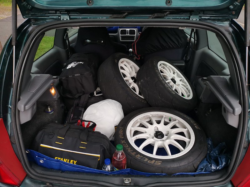

Loaded the car up with tools and semis
Get on track at cadwell, all is good apart from that rear wheel bearing I shouldve replaced. absolutely howling it is.
Or, so I thought...
Session stops for lunch and I notice the wheels full of CV grease again. Less than 24 hours after fitting the new shaft, bloody boot has split AGAIN

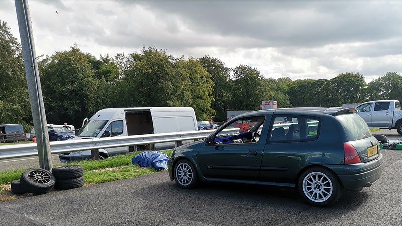

Fixed it though, gorilla tape and cable ties are any trackday must
It's contained atleast

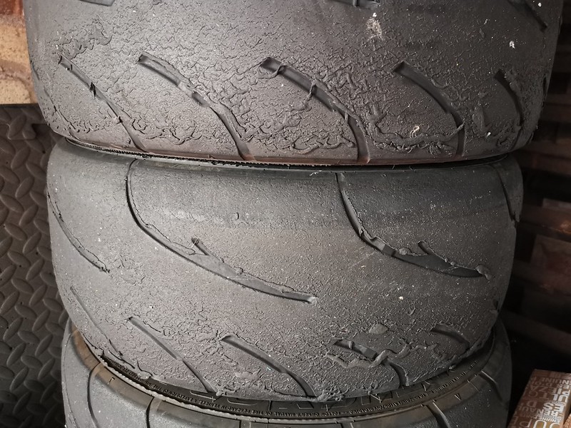

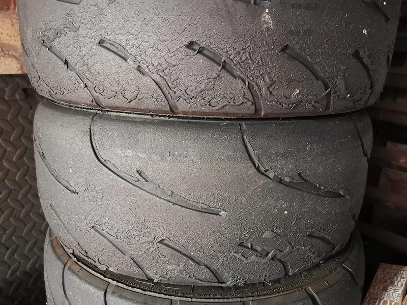

Morning was a bit wet, so kept the PS3's on. theyre really impressive on track in the wet.
Dried out towards midday so banged the AR1's on
Damn these are impressive tyres, damn corner weight setup makes such adifference aswell, Damn the bearing is causing me to go deaf.

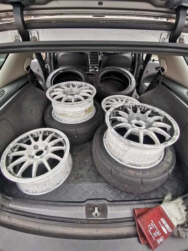

Stripped tyres off the 1.2s and dropped them off for powdercoating.
See if I've made the right colour choice in 2 weeks :coffee:

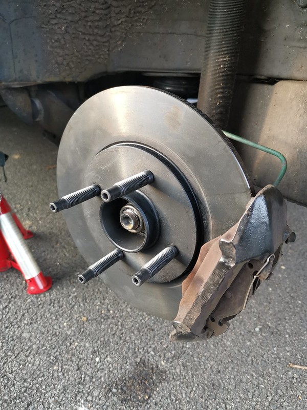

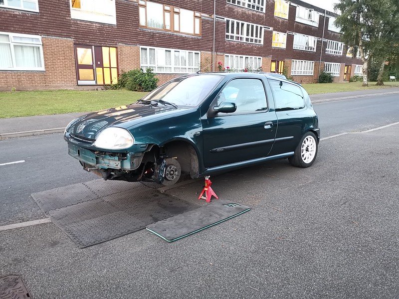

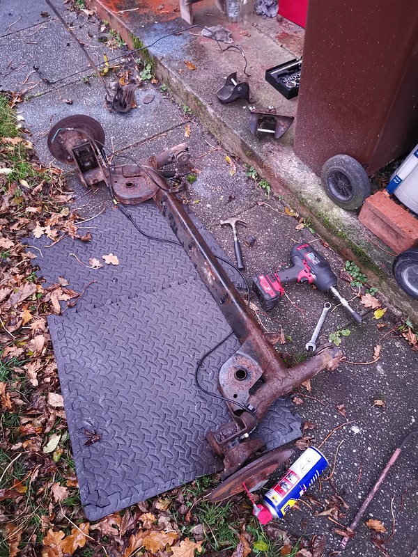

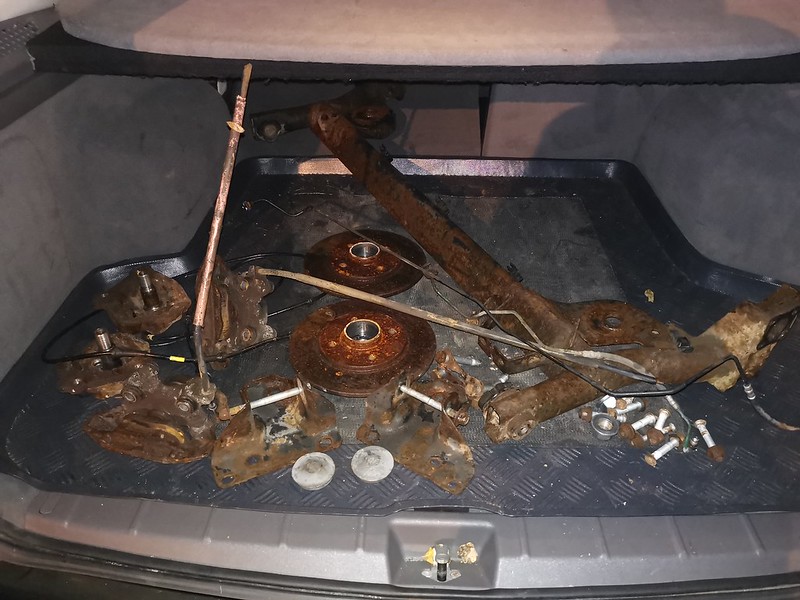

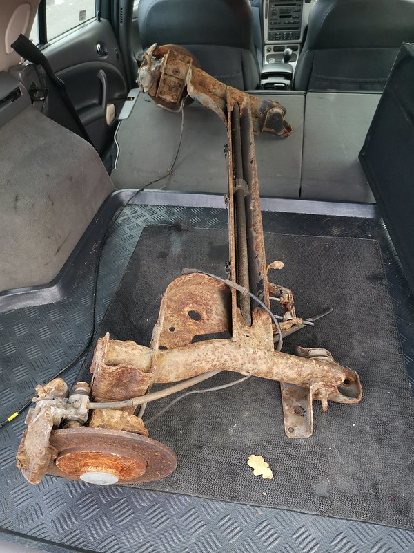

Did the rear bearings/discs
Lesson learnt here, dont buy godspeed cause the bearings arent up to it compared to OE
Studs out
Studs in
1st time in history, this job through up no issues :ROFLMAO:

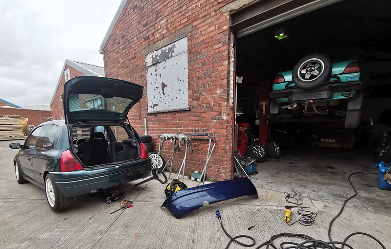

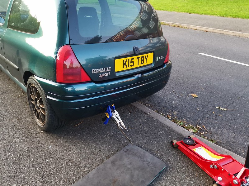

Decided to do bumper this weekend too
Went a bit out of shape so made something work
Tasty, new number plate light too
But why PMS do you make it so big?
Looks lost in there.

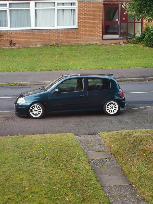

Kinda looks better with white wheels...
Btw, weight comparation, 1.2 vs superleg?
Not weighed either of them stupidly. forgot to do the OZ's before I put the tyres on, theyre around 5kg though.
If I remember I'll weigh the1.2s when I get them back from powdercoating.

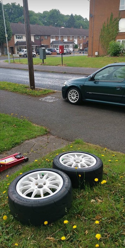

White has grown on me but not enough for me to keep them white unfortunately. It's not subtle enough for my liking, all a bit shouty.
Coops Mk1
  Lots of Scrap...
Supers 4.9kg 1.2's 6.2kg
Good progress and the carbon trim is for a 182 really so made to fit standard 182 cut outs ;-)
Coops Mk1
  Lots of Scrap...
Suspect b****cks and same mould as for the 182 ones, why go to the effort. Or maybe it's even bigger for wacecar exhausts 🧐

If they do fit I’ll probably order some....like you Coops I don’t understand why it wouldn’t work, but I won’t order some just to ‘try’ could be an expensive mistake 🤣

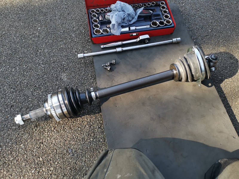

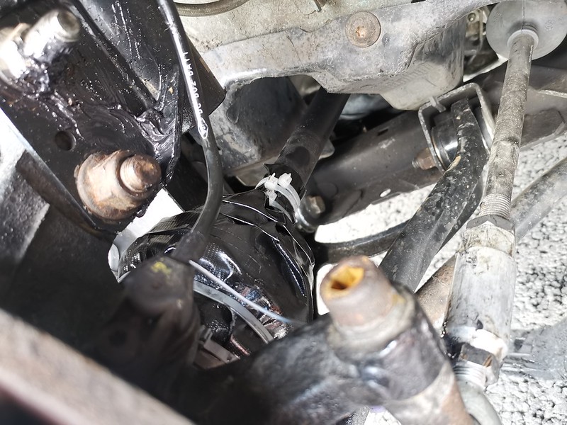

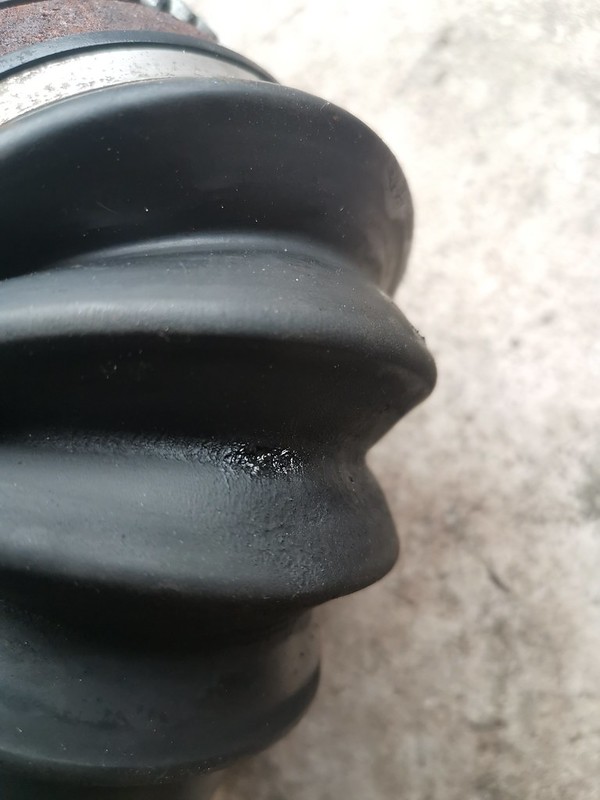

But 1st up, I think (hope) driveshaft is sorted after spending days like this again
This was the split in the brand spanking new boot
New shaft with a stretchy universal type boot, see how long this lasts, hopefully more than 150 miles

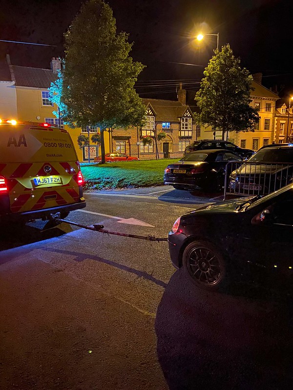

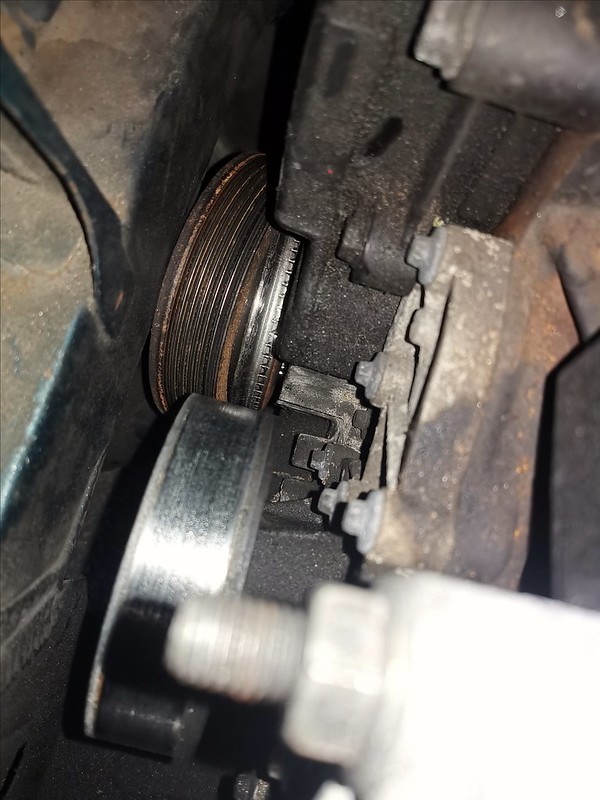

Test drove it to the pub, and this happened...
That's me, on the AA app sorting recovery :poop:
The culprit?

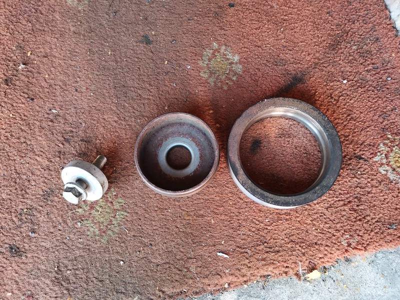

Rubber damper decided it no longer wanted to be part of the pulley

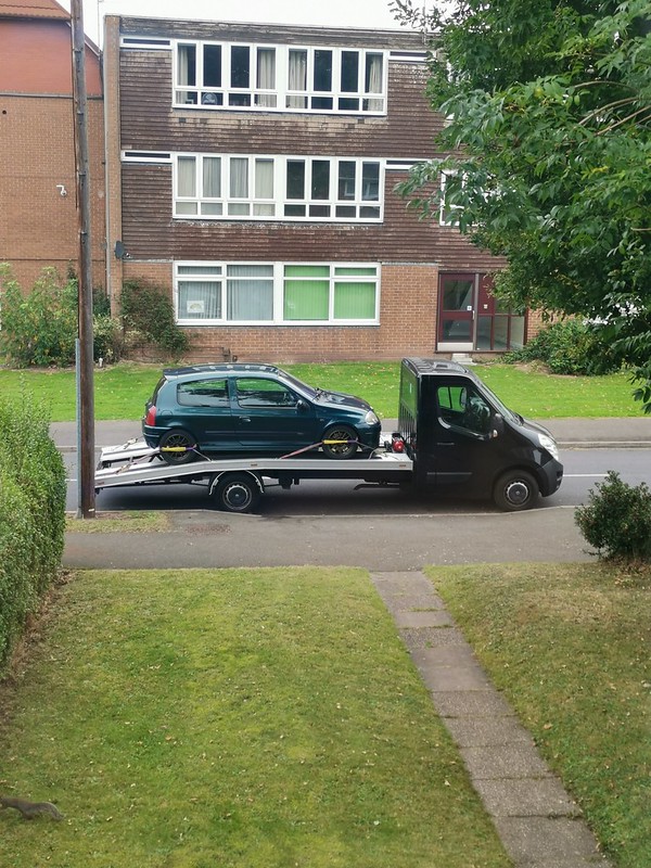

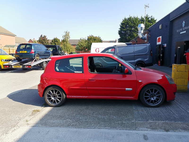

In a mad rush on Sunday I managed to sort out getting it in with @MicKPM and hire of a transporter to get it there.
Weather I still have a job in the morning thoughis questionable :ROFLMAO:
Tried a few people offering recovery/transport, got ignored by them all, ud think nobody wanted my money.
So I just picked a transporter up and took it there myself.
I'm not saying you should all look to replace your pulleys, or that you should go to Mick to get it done, but you should defo should get Mick to replace your pulleys
I got lucky, I don't think its caused any catastrophic damage, but it couldve been a different story entirely.

OE pulley and bits

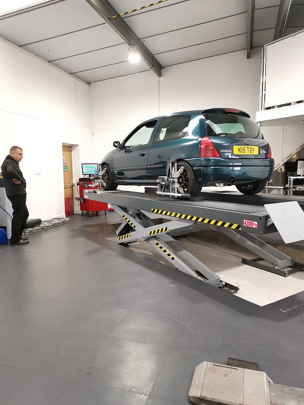

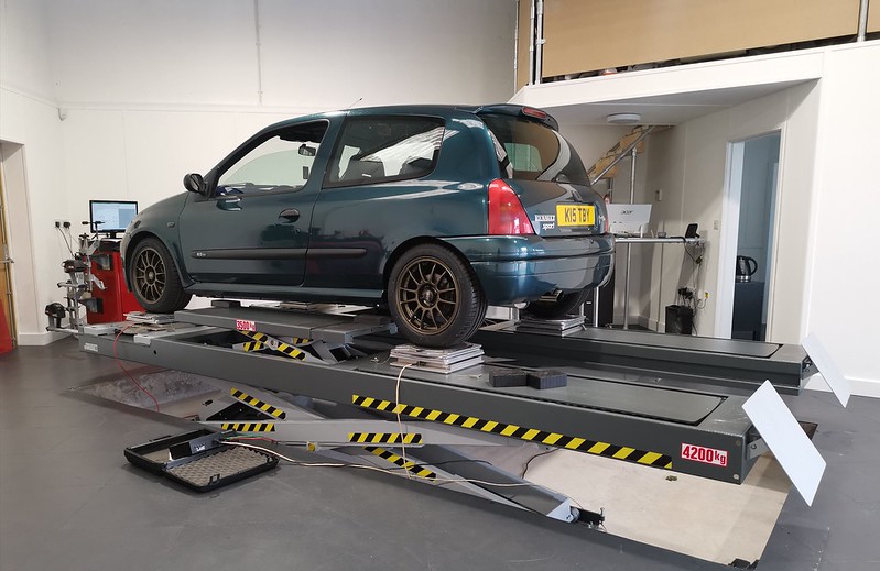

Went back to Spires yesterday to sort the toe out as it went out when I swapped the driveshaft

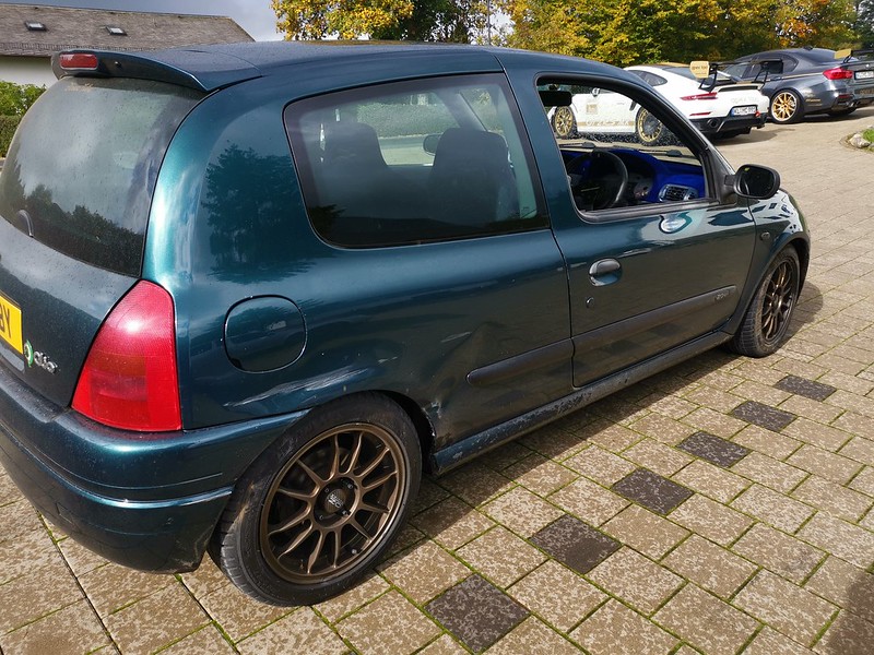

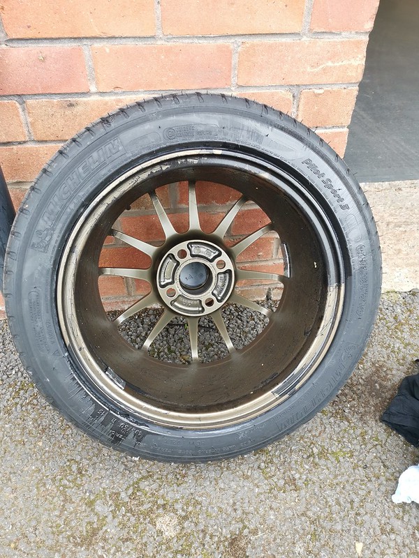

Collected wheels from powdercoaters too

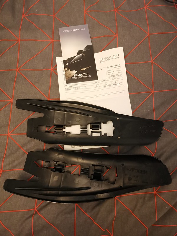

997 GT3 brake cooling ducts, clip onto the wishbone.

Ok soo, I've hesitated updating this as I'm still a bit emotional....
I crashed it at the ring :cry:
Was wet, lift off oversteer spun me 180 into the barrier.
800 euro bill for barrier "damage"
On the upside, it actually made it there AND BACK without missing a beat
Was still drivable after thank god.
I've still not looked over it properly yet, not wanted to even think about it tbh.
Issues I know of...
Drivers front camber is a mile off, steering wheel is pointing towards about 2oclock when straight, but weirdly drives amazingly straight (could take my hand off the wheel at motorway speeds and it kept perfectly straight lol)
Rear beam, not sure whats happened but toe/camber is out on drivers and its pushed the entire thing across, im tucking by about 40mm drivers and only about 5mm passenger.

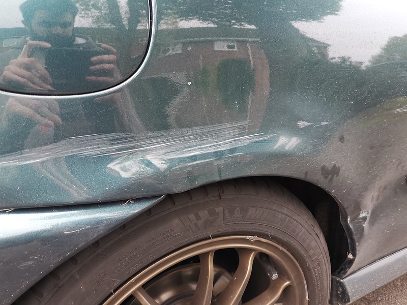

Bodywork isnt too bad, I expected far worse when I got out the car. Rear quarter has damage, my mirror cover is somehwre on the ring still and ive scuffed front and rear bumpers.
I did one TF lap the day before to show my mate around the track.
Overly glad I got this one fun dry lap in, and got some pics for the gram :ROFLMAO:
Overall was a great trip, just the crash obv put me on a mega downer. To happen so early on into the trackday too, I only did one proper lap, it happened on my 2nd.
Madly enough, I was having tuition in the car when it happened too, driving far far quicker than I would be comfortable with on my own in the wet.
Never mind though ay, I shouldve put more trust in them and not lifted off when my balls ran out :LOL:
This happened though which cheered me up at the end of the day.
You simply do not know what a "fast" lap around the ring is until youve done one in this car.
I deliberatly arranged this to be the last lap I'd do, so as not to make everything else feel walking pace, was unreal.
Might look at the car this weekend, try figure out whats actually broke/bent
More to come once I know what I'm dealing with.

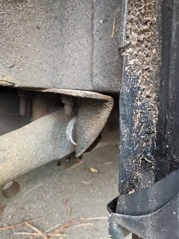

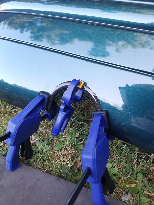

So, Last weekend I inspected the damage a bit closer
It looks to have just bent the beam mounts and pushed the bush sleeve out, just kinda shunted everything across.
handbrake feels like its kinda stiff/sticking on a bit, maybe just paranoid though.
Front, I cant see any damage, nothing looks bent despite the wheel pointing to 2 oclock whengoing straight.
Body isnt too bad, I think after a bit of hammering and cleaning/polishing it wont be too noticable.

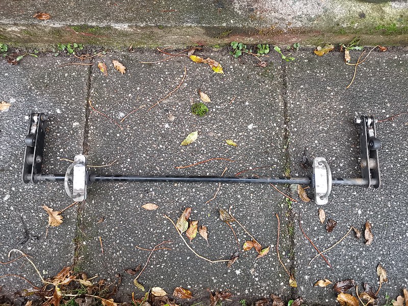

Picked up a beam the other day from a lad local for the bargain price of £20
Does look like I got it from the bottom of the ocean but I'm sure thatll soon be sorted.
Got the PMS ARB off today, in the rain, commitment that.
For sale if anyone wants it..
Was already wet and miserable so carried on with stripping the replacement beam
Plan with the beam
Strenghening it, making a copy, kinda, of the PMS kit
Spherical bearings instead of bushes, I think
Powdercoated
Need to replace a bearing in drivers brand new disc :(
May change the spacers, increase camber, will speak to Matt at Spires to see what he advises.
