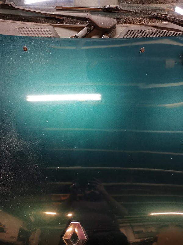

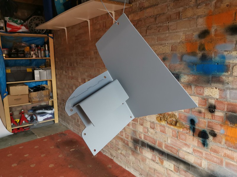

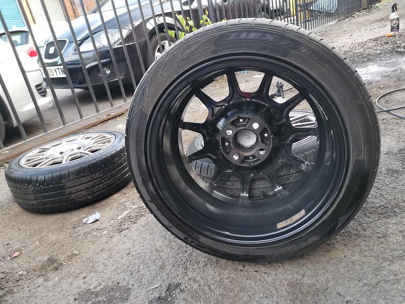

All painted now, not the best finish but will sort that out before I fit it

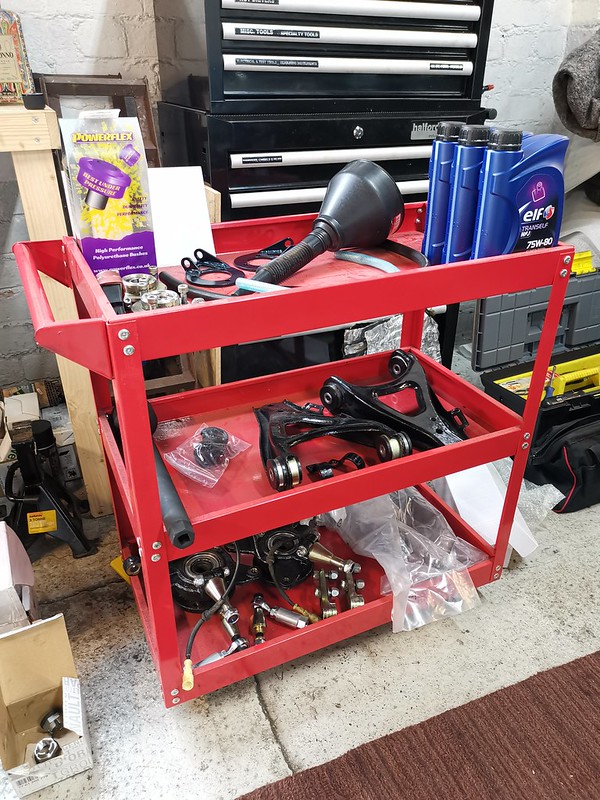

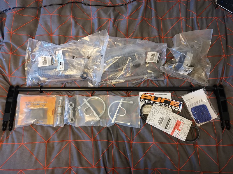

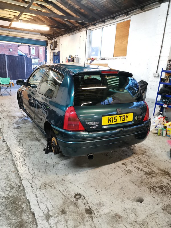

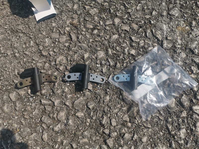

Some bits turned up this week
Really need a ramp, doing this s**t on my back is killing me off, feel absolutely ruined this morning haha.

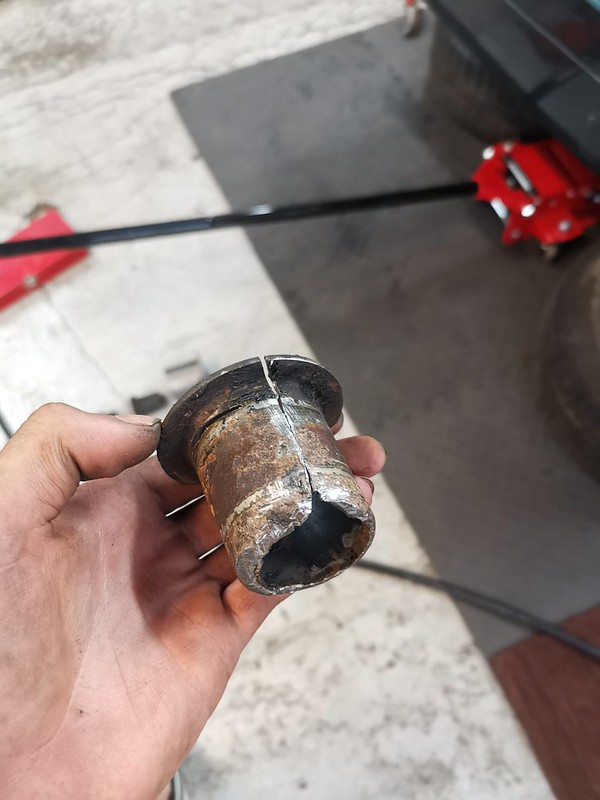

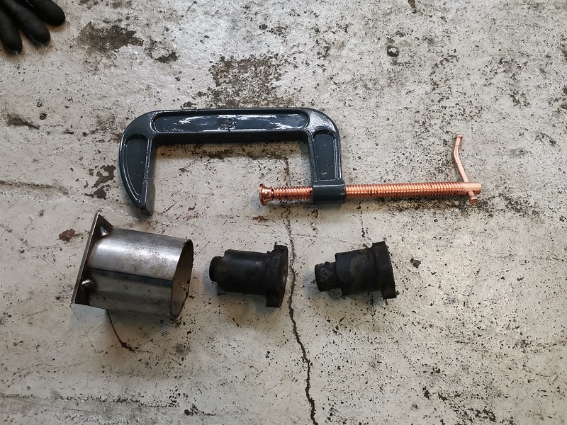

Everyone bangs on about cutting and drilling and burning these out, this literally took seconds..

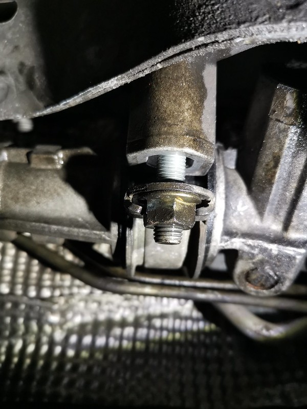

These not so easy, but still not bad with the right tools.
Bought myself a massive airline so I didnt need to keep moving the compressor, used air saw and air chisel. Air is such an incredible tool, dunno how I did without it until recently

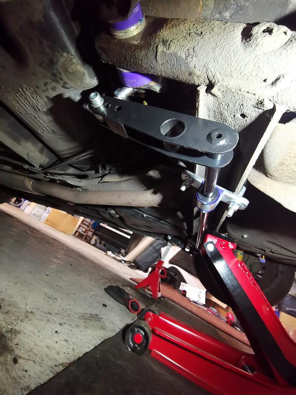

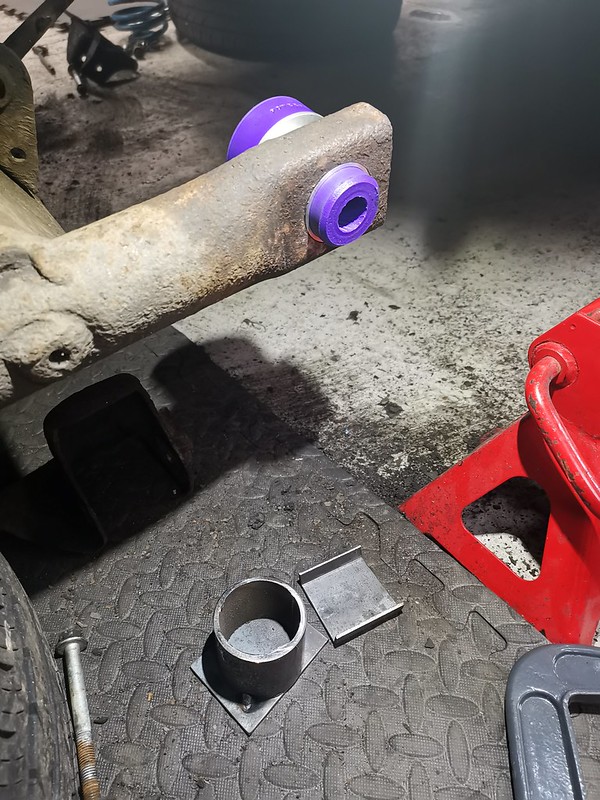

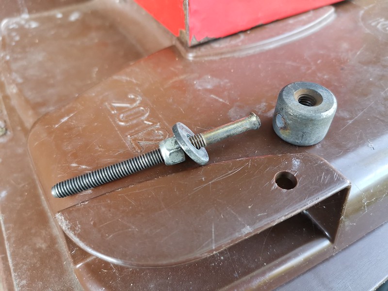

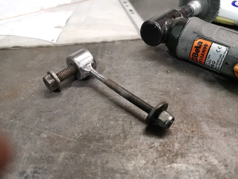

Got these so far in, thought that was it as they were stepped and I broke the G clamp getting them this far. Double checked the diagrams on the instructions and turns out they needed to go further, so made another tool

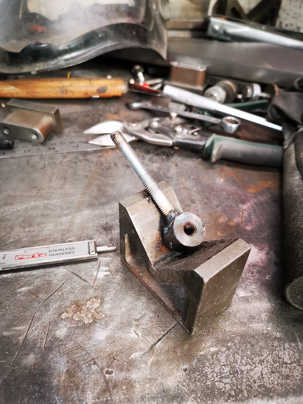

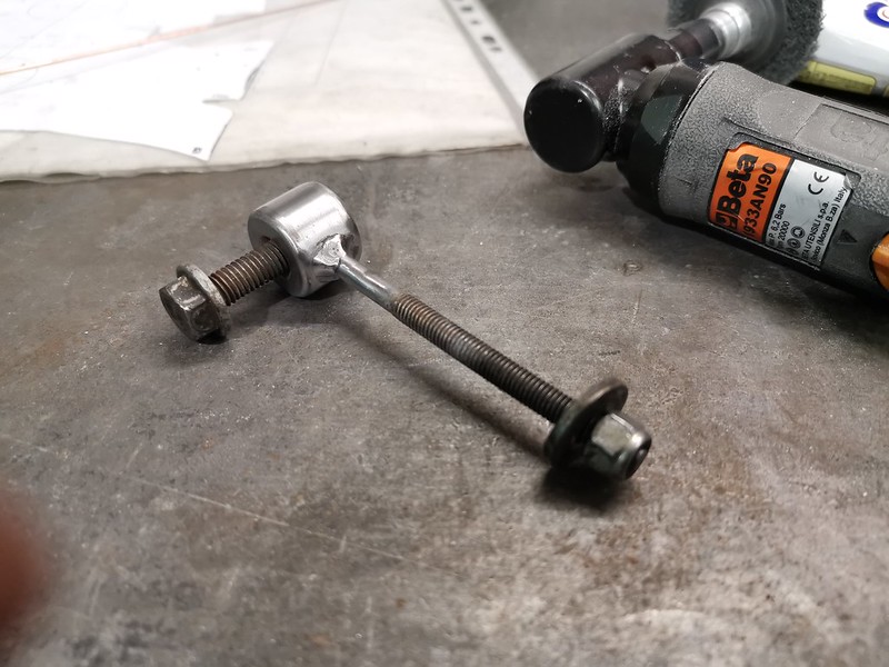

M10 all thread, offcut of some tube from the Porsche Rotisserie and some 3mm plate.
Again, it's bliss now having a setup where I can bang stuff like this together in 10 mins, id be stuck in the water if I were doing this outside the house lol
All fitted

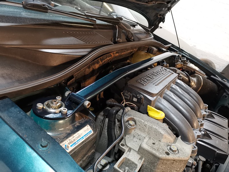

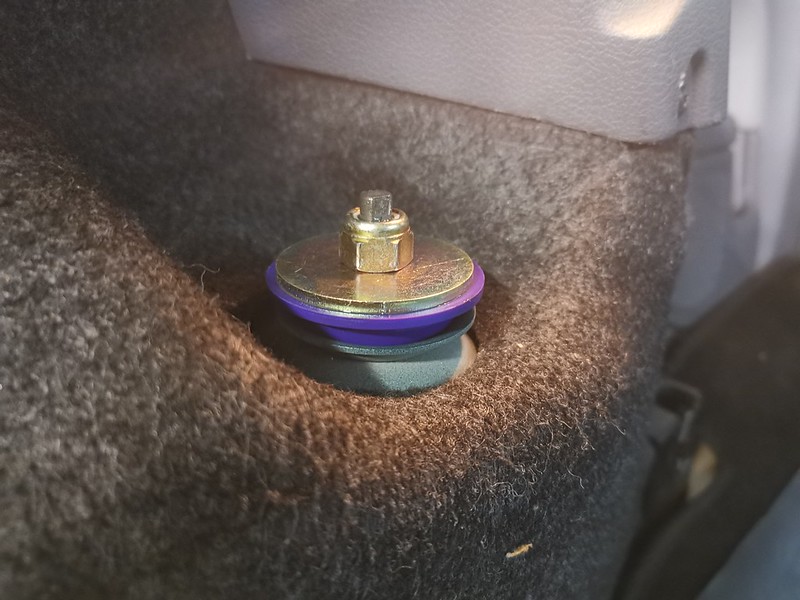

Just fitted the pms arb and purple beam bushes to mine. It took lots of time but we got there in the end. Not had chance to really test it yet though but the old bushes definatly needed replacing.
Forgot to mention, I bought the rubber boot kit along with the PMS ARB, don't waste your time if you're thinking about getting them, I managed to get the top ones on but it turned out impossible to fit the bottom ones without cutting a part off, when I did manage to get them on, I turned the bolt instead of the nut and it spun and ripped without me realising, took it back apart and binned em :ROFLMAO:
Yep, mine were a bit of a mess, had gone real soft.
It made a difference on the drive back, just felt firmer. But wont really be tested for a while, cant wait to see the difference at Anglesey from the last time I went, especially with all the front bits going on.
Took me hours, but that's because I'm lazy and people kept coming to the unit distracting me, spent more time chilling on the sofas chatting than working I think.
Got home at 2am :ROFLMAO:

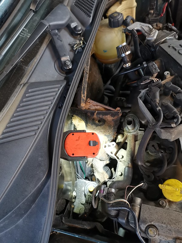

Guess what... that blasted cup PAS line I fitted is leaking
Think its cracked on the join, the leaks lower than the thread for the switch... So off it comes again, going to try welding it up at work.
We did a repair on a PAS line last week for the garage over the road, worked fine so hopefully be the same on this.

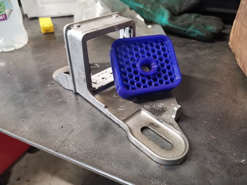

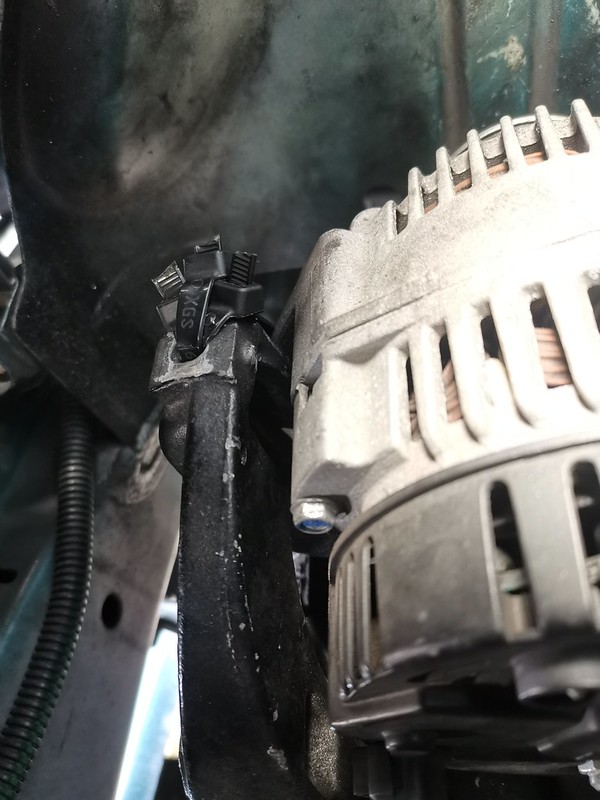

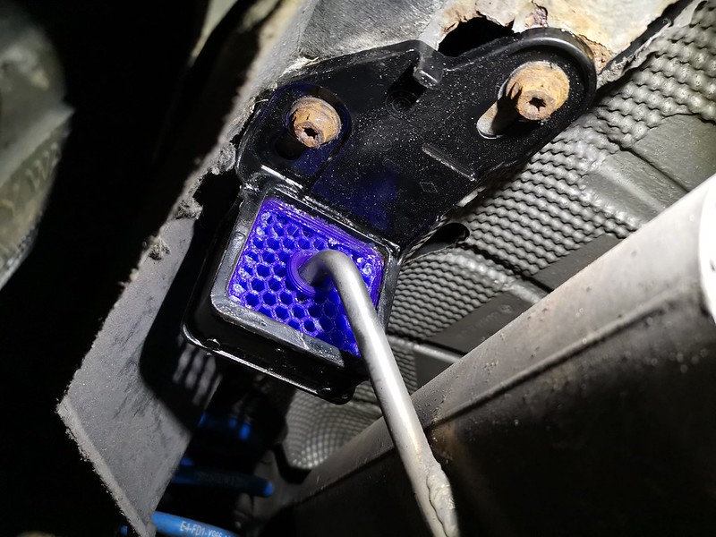

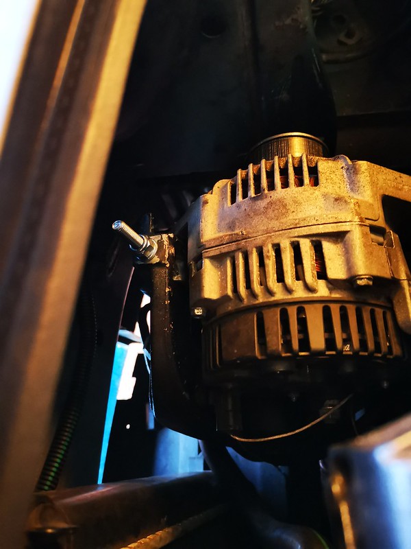

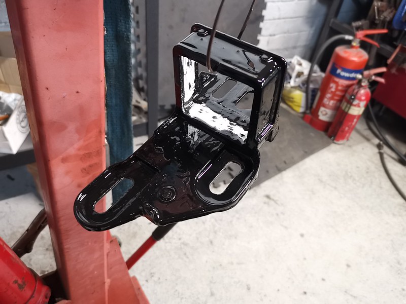

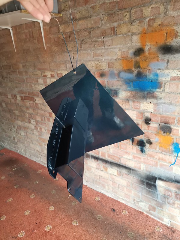

Started on exhaust mount though.
These 3d printed @Kev@KAM ?
Hammerited the life out of it to stop it doing what the Prima one did.

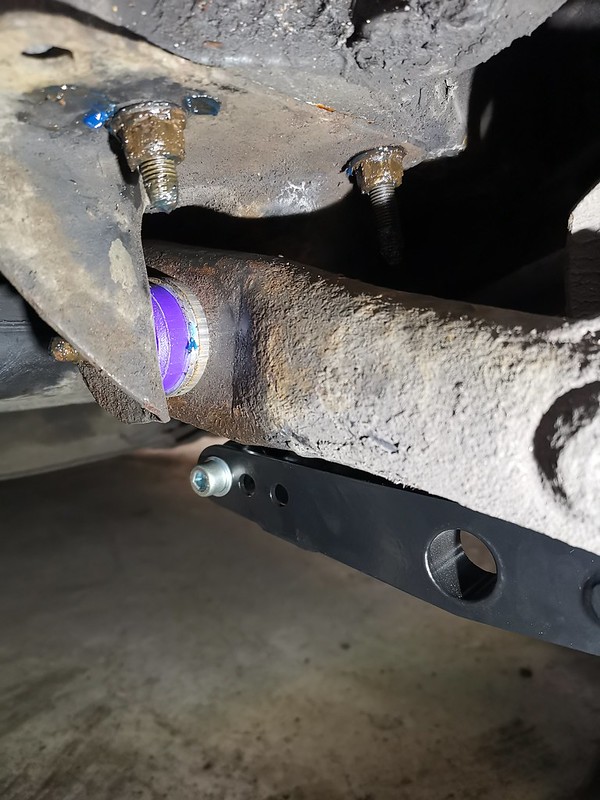

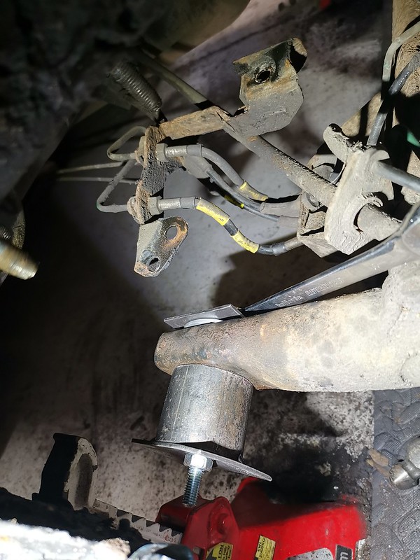

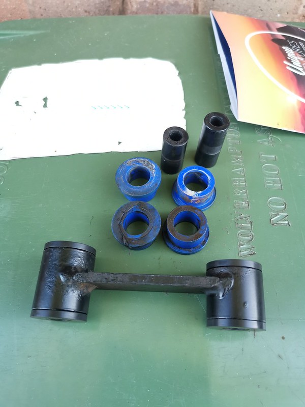

Beam bushes are fairly easy, just time consuming. Could be tricky without an arsenal of tools though.
1st up, undoo lower shock bolts to allow you to remove the springs, then do them back up.
Then the 3 nuts either side to drop the mounting points down low enough to remove the bolt through the bush.
Also undo the bracket to the left that holds all the brake lines up, else ull f**k the lines.
Then I supported the beam on 2 944 wheels (other wheels are fine too), i dropped the shock bolt out on the side I was working on to get it a bit lower, but do be aware of the brake lines. drivers side will go lower than the passenger because of them.
Then remove rubber then metal sleeve, press back in.
U'll need a tool like mine to get them back in, they're pressed normally but obv on the car you cant really use an actual press.
Then do it all back up, fitting a PMS ARB whilst you're there ;)

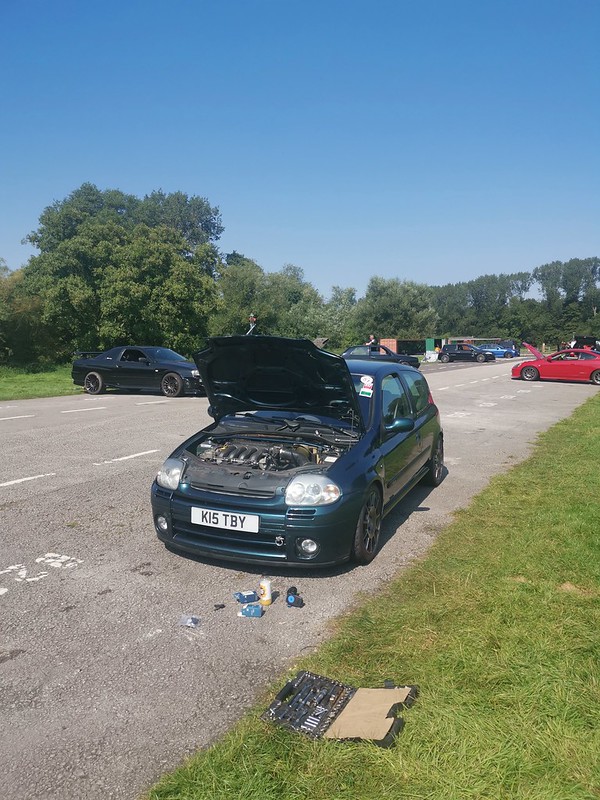

I'm at Retro Rides Gathering then mate at Shelsley Walsh hill climb. The clios on reserves list for the hill :cool:
Come to that instead

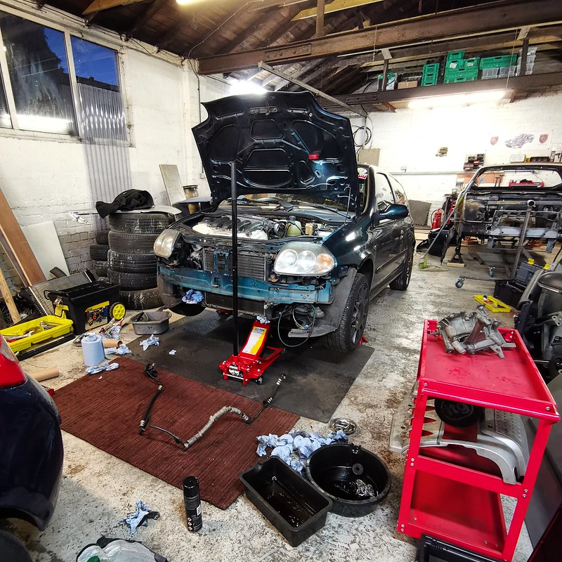

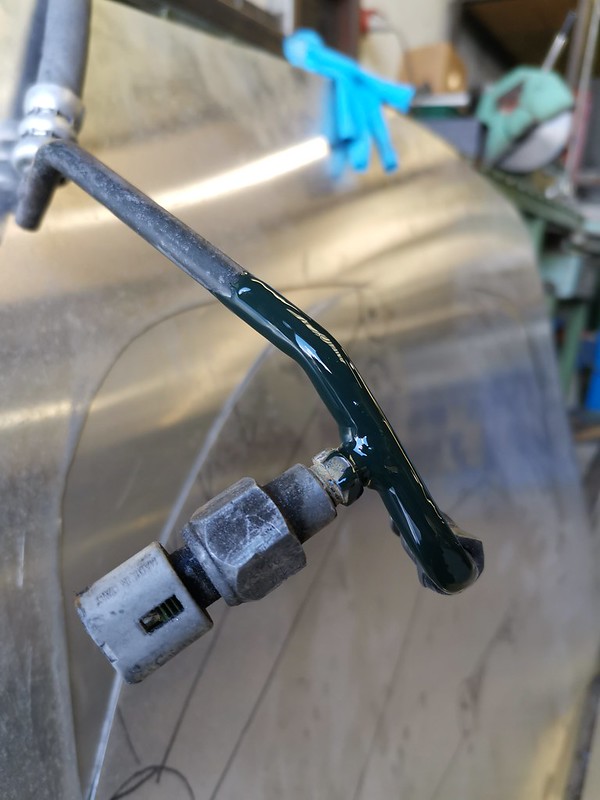

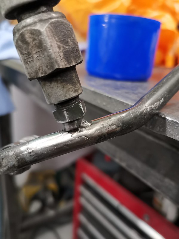

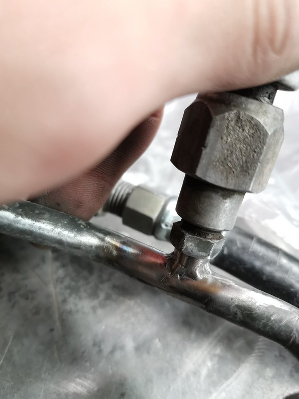

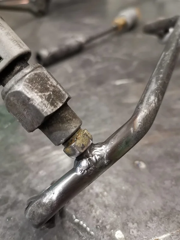

Thursday at work I tried to get the PAS line repaired, welded it up once, tested it, still leaked. Welded around it again, still leaked but less, ran out of time to do it again.
This was the original bit before welding, weather that was a crack I don't know as I didn't bother testing before welding, but yeah...
Ran all the way around it and over the crack, wasnt the nicest stuff to weld, dont know what actual steel theyre made from. used just normal mild wire at 1st.

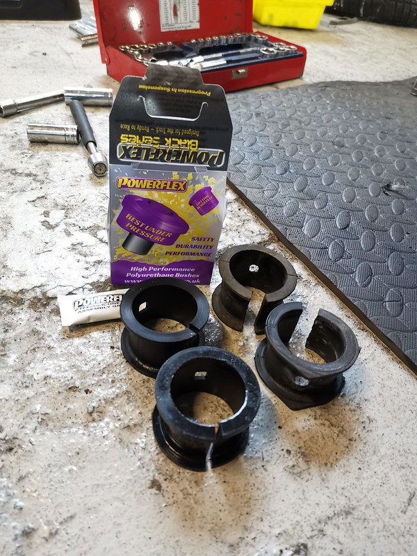

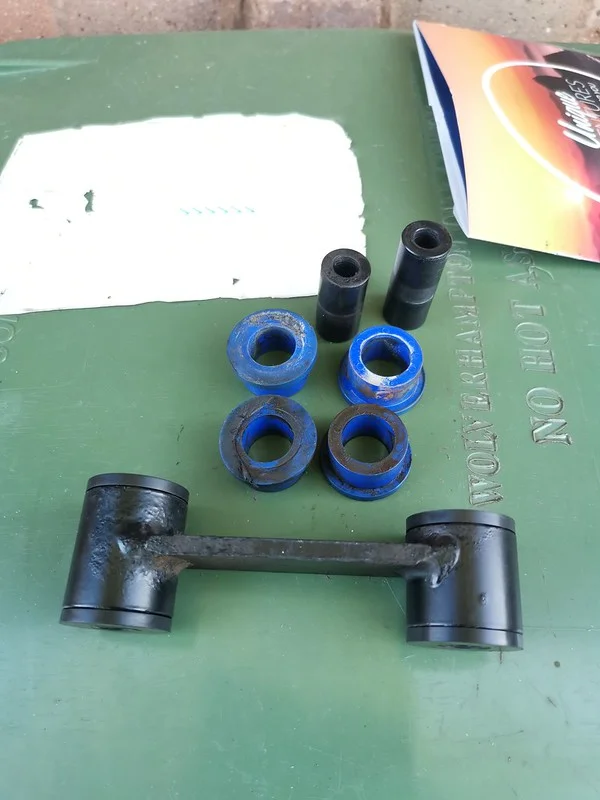

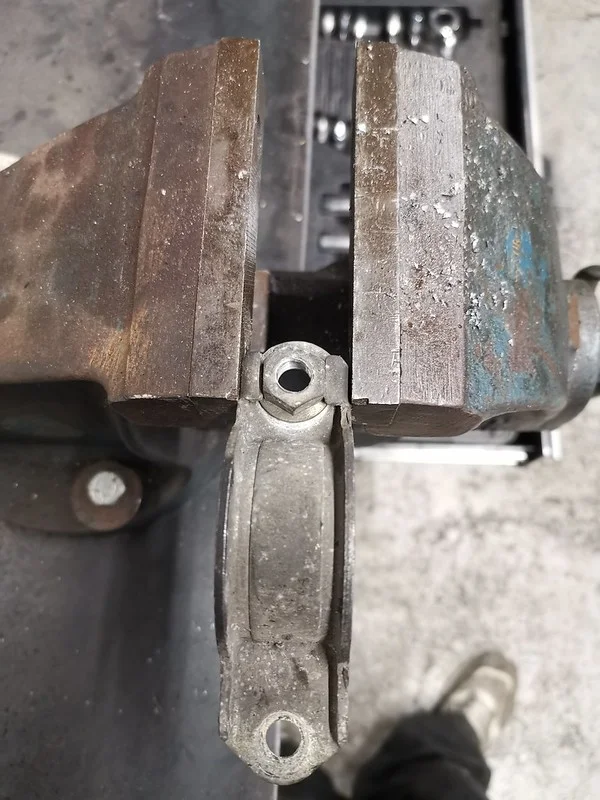

Thursday night after work I decided to fit the rack bushes, as i had better access and couldn't do anything else.
These were a bit loose so banged them a bit tighter in the vice, had to hold with the spanner to undo the one.
Why they make them so long I don't know, so annoying when you're on your back with no room to move your arms.
Did them in a little under 3 hours, at a relaxed pace. Would be a lot quicker if I did it again now I understand how everything comes off and how to access everything.
Hardest part was getting the one that has a locating pin off, and the new one on, as you can barely move it enough to get around it, then there's no room/not enough hands to pull it out. Half the time on a ramp I bet.
Anyway, went into work early on Friday and managed to completely fix the leak.
Used A32 wire and upped the amps more, did the trick.
Found some dark green hammerite, no brush though so my finger in a latex glove would have to do.

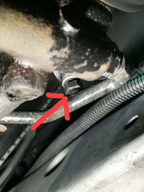

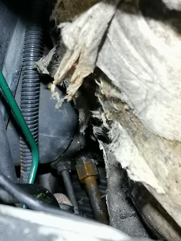

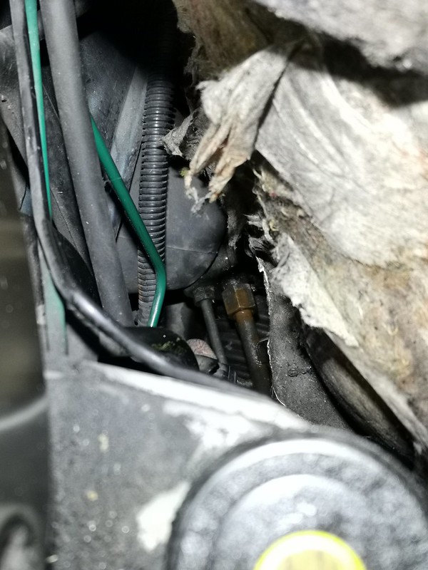

This is the absolute t**t of a nut you have to undo....
Cant see it in those pics but there is another line the other side of it. Getting a normal spanner on is impossible.
When you get the modded spanner on, you have about an 8th of a turn before you have to rotate it to get it another 16th of a turn to get it back on the other way. The more you can do by hand the better, but even that's a pain. There's no way to get on it from below so down this gap is the only real way...
The heat stuff is fiberglas also, my hands and arms are red raw (was too hot yesterday to wear long sleeves)
Everything gets in the way, you need a torch to see what you're doing but your arm blocks the light no matter where you put it, or the light just gets in the way.
Its honestly the worst thing I've ever had to do :ROFLMAO:

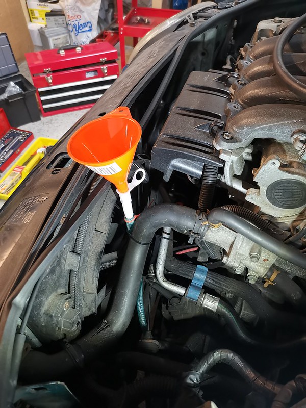

Sooo, I've bought a pair of new driveshafts and some new oil for the box, to be fitted when I do everything else this weekend.

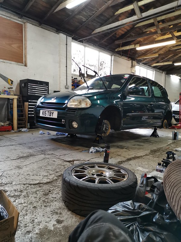

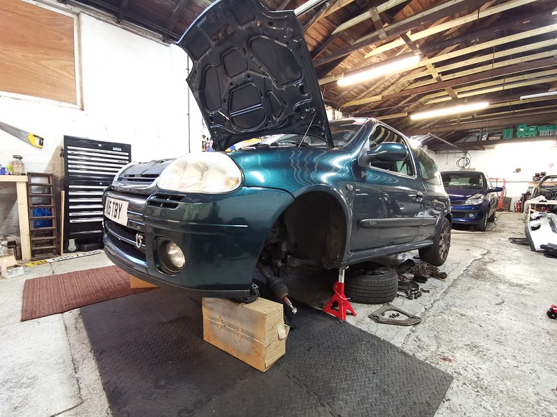

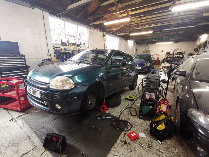

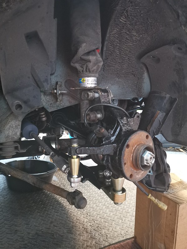

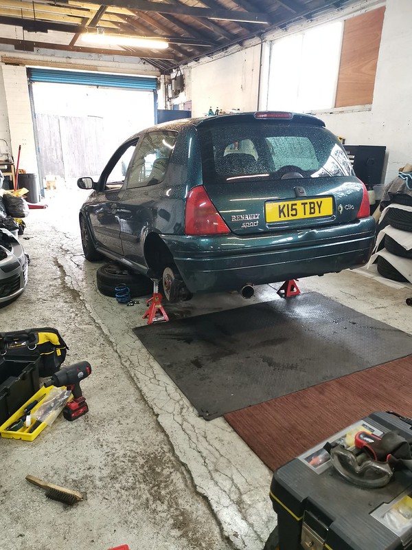

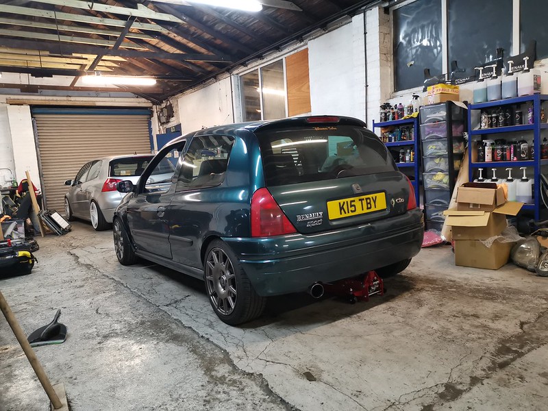

Saturdays progress...
Arrived at the unit for around 12, later than I wanted but I'm never on time for s**t so expected I guess ?

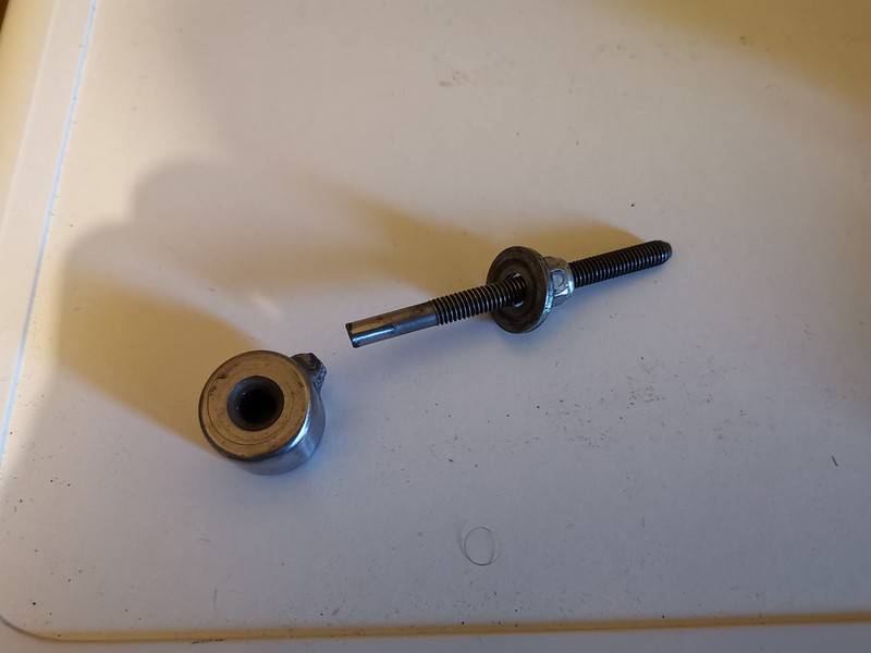

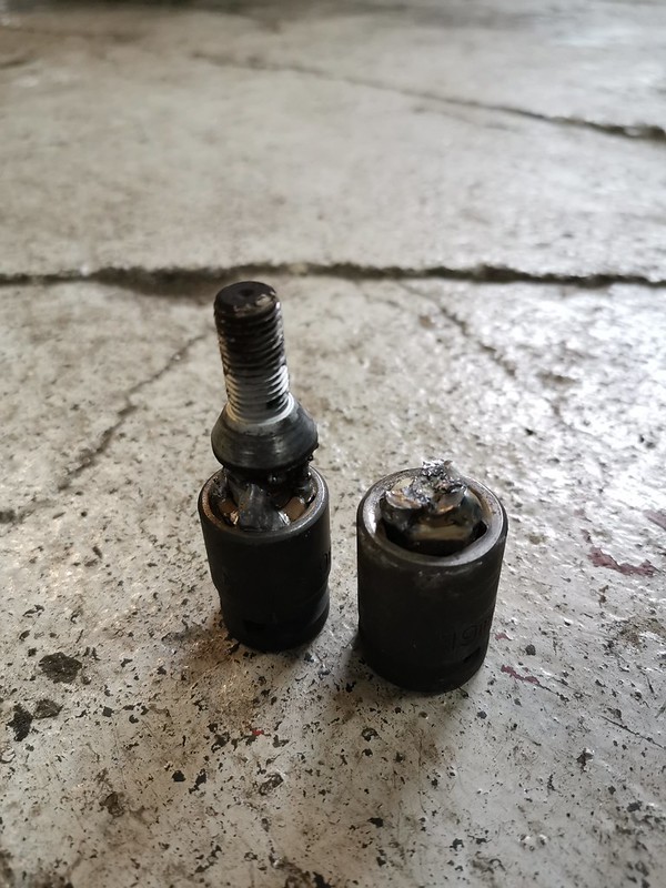

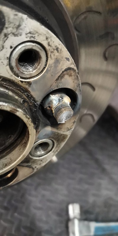

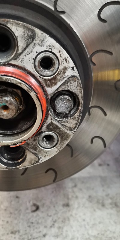

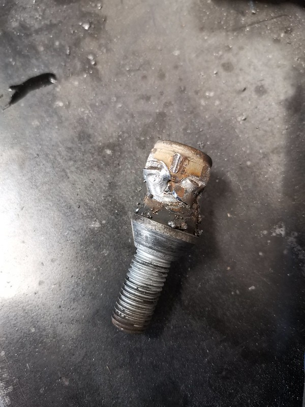

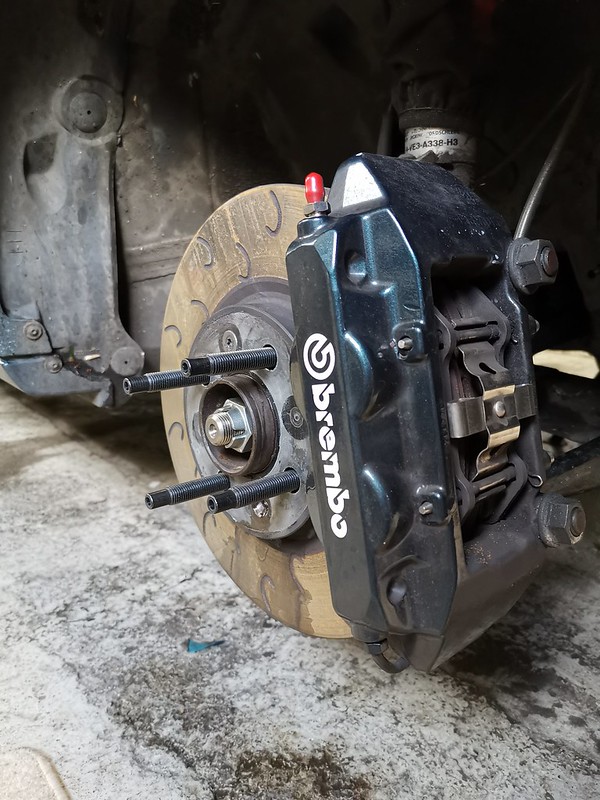

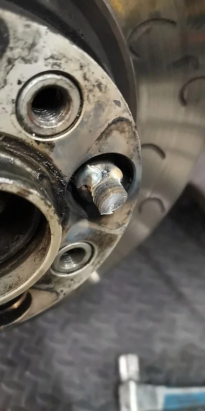

Literally got stuck at the 1st hurdle, shouldn't have even been a hurdle but it well and truly got me
This one spacer bolt was well and truly stuck, resulting in it rounding off.
Tried both the gun and the bar, nothing got it.
Tried mashing a smaller socket on, rounded it more
Think these H&R bolts are made of cheese
Was going to resort straight to the air chisel, mate suggested welding a bolt onto it though so...
Welded a VW wheel bolt on, this was the result
Threaded a nut onto that, welded it on, that snapped off
Did the same again, snapped the lot off the Bolt
Welded another VW wheel bolt on, did a full run of weld all the way round, that snapped the bolt in half again
Welded another nut onto that, again with considerably more weld
BOOM, cracked it off.
This, as you can imagine, set me back a while and put me into a foul mood.
Was angry and had lost all motivation.

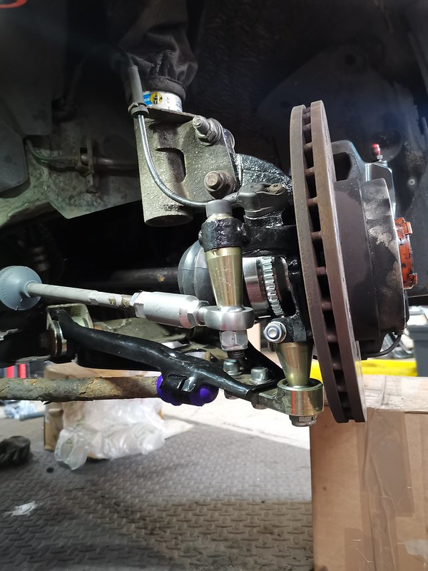

Still, I cracked on and stripped down brakes, rod ends, bottom ball joint, wishbone, ARB, coilover, hub etc.
Wanted to get at least one thing back on before I went home. Went for what I expected to be the hardest job.
If I can get that out of the way, it should be plane sailing.
Turns out, it was a piece of piss.

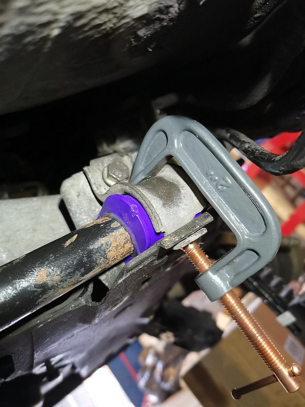

I tried the longer bolt and clamping etc method, as I was doing it I noticed itd be better to clamp it down rather than clamping the mating faces...
I mean I don't want to blow my own trumpet but I feel I had a stroke of absolute genius.
Not including the 1st attempt as per most people advise, I had them both back on in about 15 minutes, if that.
No longer bolts, no trying to clamp it to stop it moving. Just 1 2" G clamp, a small screwdriver and a larger screwdriver and boom, bolt was in.
Method...
Clamp down with G clamp enough to get small screwdriver in the holes
Loosen off, use screwdriver to pull it more in line whilst doing clamp back up.
Repeat with larger screwdriver, it should then hold in place allowing you to get the original bolt straight in.
Must be a small G clamp like my 2" as this allows you to still get the bolt in. a 4" would be in the way.
Size isn't everything, sometimes small is better.
I had to cycle home (12 mile) so I didn't stay too late, once these were on I tidied up and headed home.
Everything else sorted tomorrow hopefully.

Oh and cause I thought it was cool, my trolley of goodies.

A pain in the arse job made easy.
People should definitely use this method as way to do so. Myself and others have struggled doing it the "manual" way and this way is a no brainer.
Not many pics but a brief update
Had to wait for my mom to go shopping before I could nab the car and go to the unit, was 3 before I finally got there.
Drained box oil, swapped both driveshafts and tie rods
drilled holes for top mounts and fitted them and the brace
loosely fitted rod ends, hubs, wishbones.
Wishbones were by far the most difficult thing I've done yet, trying to get the washers in either side of the bush when its tight as hell, killed me off, had enough and went home :ROFLMAO:
Be finished tomorrow, unless something goes tits up.
Just realised I forgot to measure the bolt for the spacer to get the right one ordered
Sooo as always, I've been having a bit of a mare with this lol! Hence me not updating, been too annoyed by it all to find motivation to write something up.

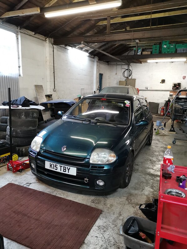

By Monday evening everything was fitted and the car was back on all 4 wheels.
Decided to clean the wheels inside and out before getting the tyres swapped over.
Luckily the guys I share the unit with are mad into their cleaning/detailing. So never short on decent cleaning products to steal.
How to: fill your clio gearbox up easily

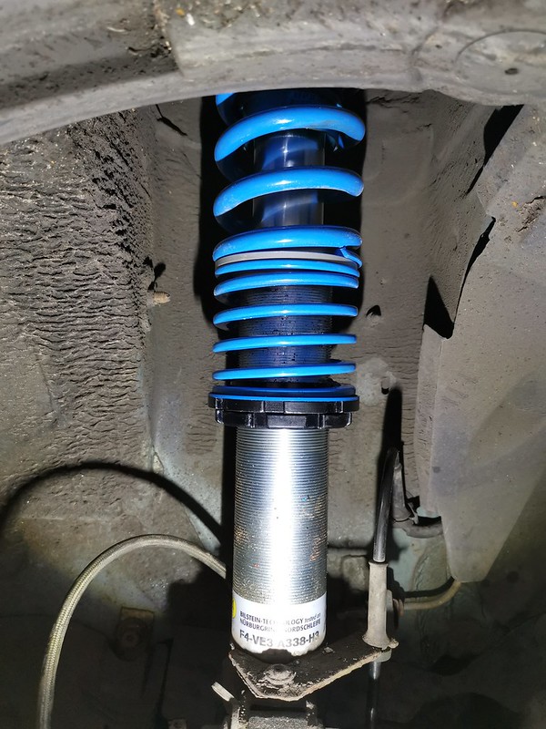

For some reason, the front sat lower after fitting everything. I'd actually forgotten about this until now with all the other issues I've had.
Not sure if the top mounts may cause it to sit a little lower. I have seen this mentioned before.
Following day (Tuesday) I got to the unit early and raised the car by a fair amount.
Everyone should buy coilover covers, look how mint these are after more than 2 years of daily driving

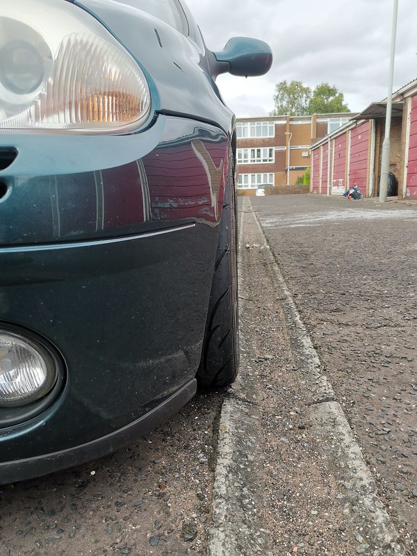

The increased castor had pushed the wheels toward the bumper, the widened track from the correction kit had also added to this, meaning it was pretty much sat on the bumper/inner arch.
Once it was sat level, I couldnt help but notice the passenger side wheel looked further forward than the drivers, maybe it was the bumper, I persuaded myself it was the bumper and ignored it.

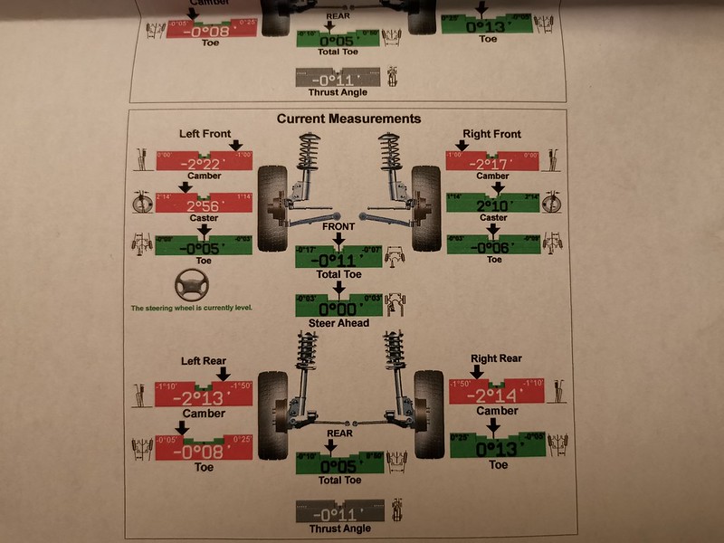

Got it to A-line for tracking and well, they confirmed the worst.
Passenger is indeed further forward for some reason. Was bang on before I fitted all of this, can only assume it's a wishbone.
Noticed on the drive back, steering is very heavy and the wheel doesn't self centralise when you let go.
Instantly jumped to it being the difference in castor.

Whilst I was starting to remove the wishbone, I noticed how stiff the lower bearing was. Dropped Mark a message, we thing they may have seized a little.
Steering is heavy with both wheels in the air, so this kinda confirms its a bearing issue rather than castor?
Hes sending me some new bearings, so will see if this helps.

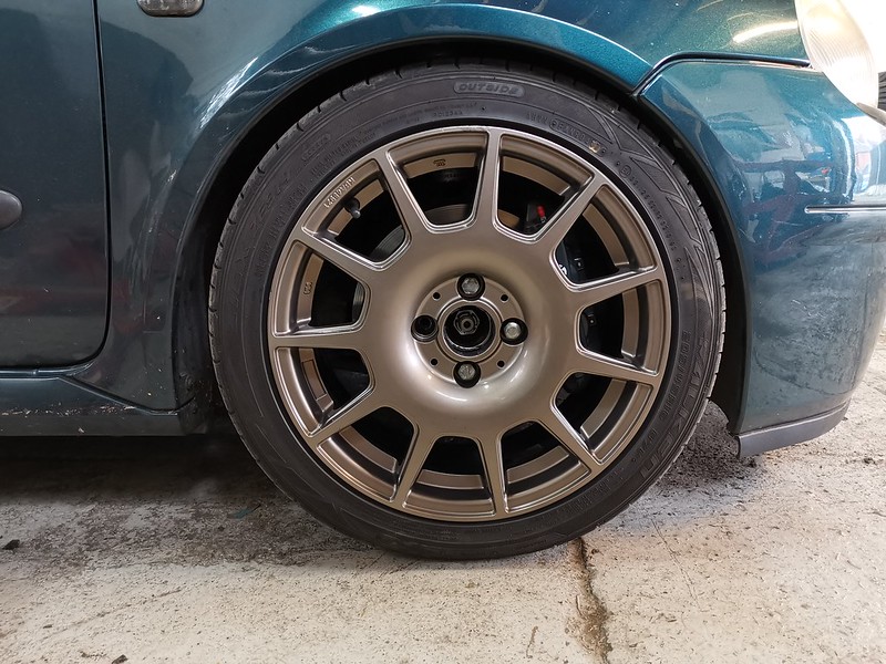

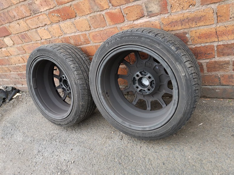

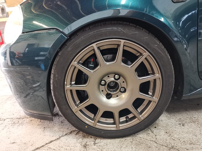

Looks great with the wheels spaced out so far, but it's not usable so I'm changing my spacer setup.
Ordered PMS stud conversion today and 10mm spacers instead of the 20mm H&R spacers. This should put it back to how it was before without the correction kit fitted.

The clunking noise I assumed was suspension related was still there, upon me trying different things whilst driving to see when it did it, and when it didnt. I got home and concluded it had to be the dogbone mount, despite checking it and it looking fine the other day.
Had it on the ramp at the garage opposite work today and confirmed the Evol mount has given up.
Waiting on a reply from him about replacement inserts.

Started Saturday at about midday, snowfoamed it
Shampood it twice, went to dry it and it was still dirty so went over it again.
Covered the thing in fallout remover, washed off
Got any tar off with tar remover and dried it all.
Already looking a million times better
Pulled it into the unit to start on some other jobs.
1st up, studs
Spent 3 blasted hours claying the car, but my god did it make a difference, the paint is so smooth now its amazing
Time to start polishing, I didnt really get any pictures of this, one bad comparison shot
One of the guys I share the unit with popped by and did some polishing for me, whilst I sorted fitting the wheel.
It's getting very late now, so taking pictures is the last thing on my mind.
But I wasnt going to stop half way through so i soldiered on, machine polished the entire car, sealed it, waxed it, hoovered it, put wheels back on and tadaaa, was done, by about half 2 in the morning.

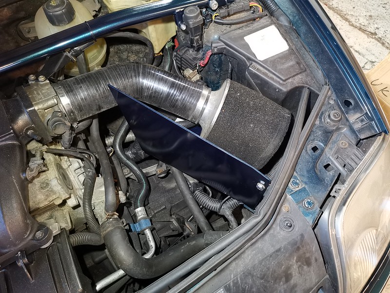

Whilst I was there, finally gotten round to fitting the new exhaust hanger
Aaand my ECU bracket/heat shield
Today I managed to sort the dogbone mount, as it turned out this was fucked too
As always with this car, this fixed one issue but highlighted another.
I've still got a knock coming from something when i break/accelerate. So I guess further investigation is needed still.
Maybe one day ill actually fix an issue and that'll be it, there wont be anything left to replace.
Oh, fitted the smaller 10mm spacers when I did the studs. I now have no rubbing issues up front at all, which is nice.

Suspected Crank position sensor, went ECP to get one, didnt work. Ordered OE renault one with repair loom just.
Surprised I didnt jst tell him to take it to the scrap yard 😂
Quick one before I go to sleep
Bad earth to ECU was the fault, main one which goes from the box into the main loom from ECU)
Sorted that today and then instantly discovered another issue 😂

Had to modify the heat shield thing slightly, so thats being painted again currently

This happened again whilst on track
My front wheels almost fell off too due to PMS studs all working loose from the heat.
Anyone managed to fix this issue? I've seen its a common thing for stud conversions on track.
This was my temp fix for the alternator, thanks to the friendly guys in the 182 in the garage next to us.
Aparently im a mad man for going back out on track like this hahahaha
Anyway, I'm now running an M8 sized one, just like @Dr Jekyll we both kinda made them at the same time, he took better pictures of his though.

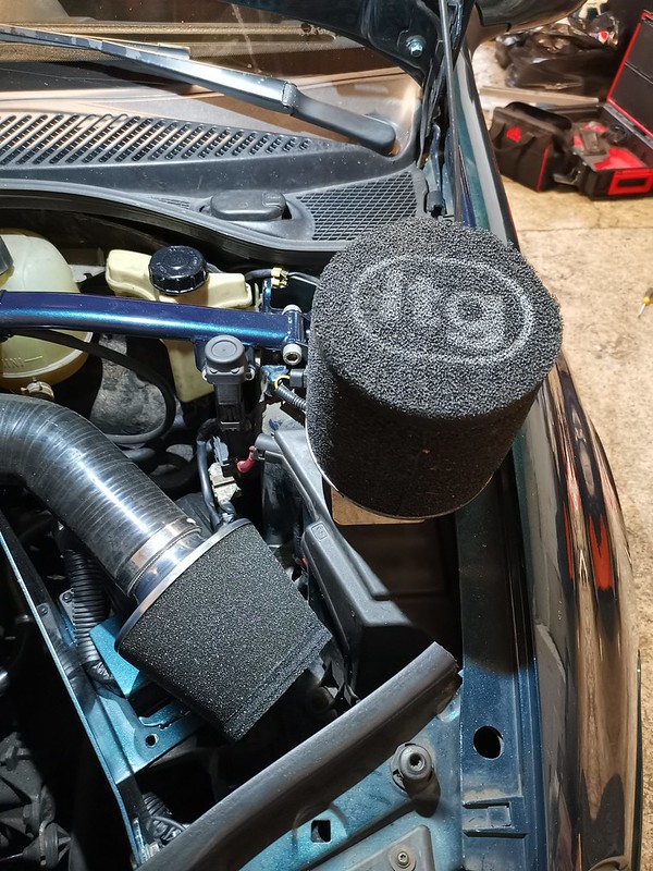

Dropped the height by 5mm up front and got tracking done again. Finally got round to swapping my air filter
Old one was starting to break up so swaped for another ITG one

Unsure what they supply but should be pretty good. Just a high temp studlock should suffice, 270/271
Jekyll
I may have took more pics but your welding is better! For what little time it took and the extra security in tapping/threading and going up from m6 to m8, I think its worth it. If you break it now, then your driving it to hard, clearly.
Car looks great mate, always does. Shame you didnt get more pics at anglesey as like you said, it's a very picturesque track. Do love the cable tie trick and it held well, but not sure I'd of gone back out but your more mad than me!!
Shame about the studs. Does worry you but maybe some stronger loctight would be an idea. Odd as that's what's supplied with the kit. The threads not slightly stripped or stretched has it?
