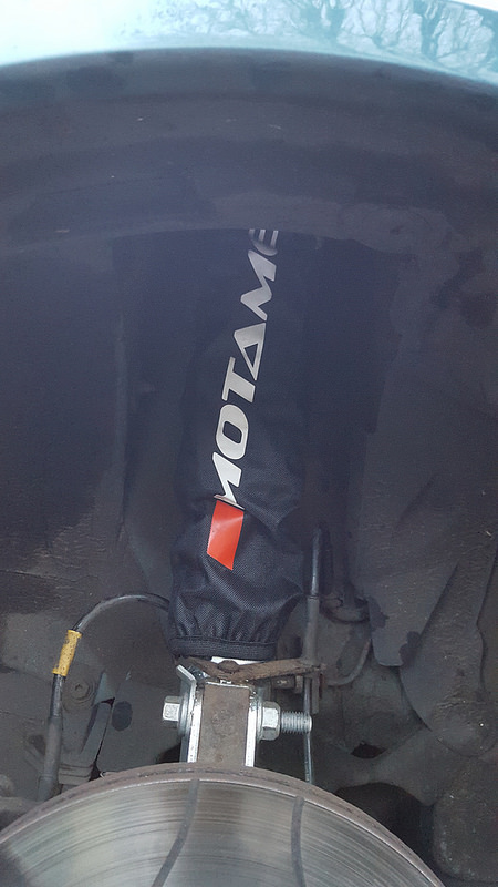

Coilover socks arrived the other day too, got a couple of other bits to fit too :cool:

Need to raise the front as it's scrubbing the inner arch on most turns

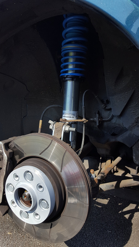

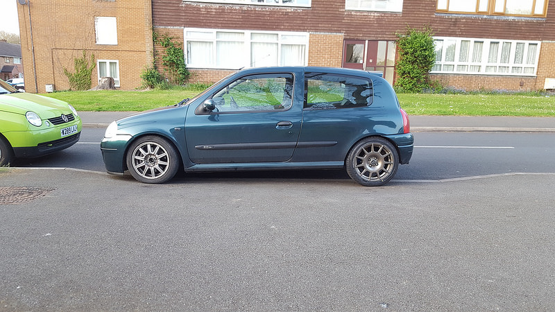

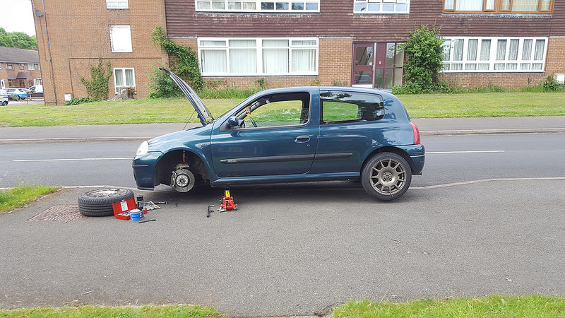

Anyway, raised the fronts a touch
Dropped it a tiny bit after this when I fitted these..

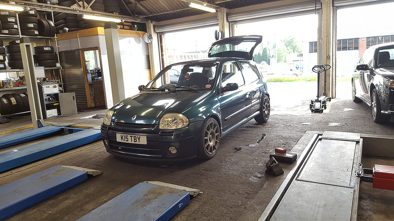

Re-did the alignment at work today and it's spot on now.
Can actually push round a corner without it scrubbing to s**t.

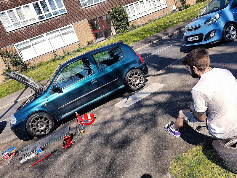

So glad the weather was sick today, normally it rains when I want to do stuff
Anyway, I did stuff
Started off like this..
Took some stuff off
Fucked this stuff off after seeing @Dr Jekyll without them
Added some new shiny stuff
More shiny stuff
Then after even more stuff, it looked like I'd done stuff to it
(ignore the million degrees of positive camber in the last pic, I adjusted it after with camber adjusting stuff)
A mate caught me admiring my stuff
Put some old stuff back on the front as the tracking seems pretty bad, will do to get me to work where I can bang it on the Hunter tomorrow.
I'm quite happy with it :grinning::cool:[emoji813]eyes:

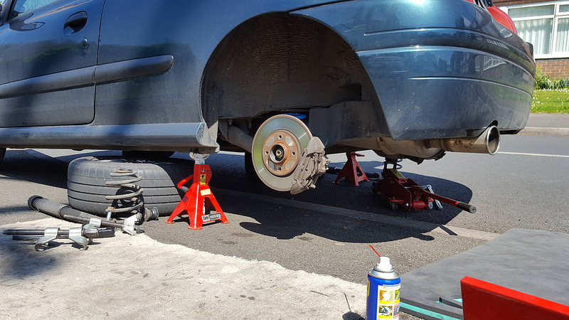

Warped disc NSF (causing vibration)
Warped disc NSR (causing pad movement)
Strange how they're both the same side, strange how the rear has warped at all tbh.
Annoying as the fronts arent all that old (about 2 years) and it's not like ive done that many miles, or a lot of track days (2)
I'm happier now I know what's causing the issues, still annoyed they're there at all haha!

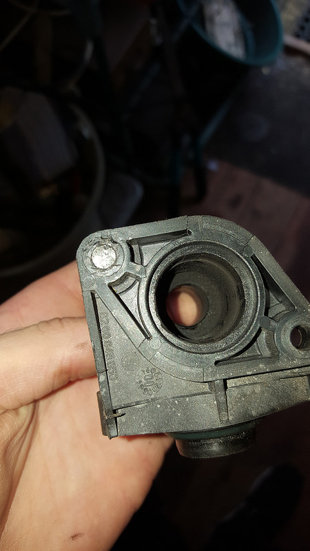

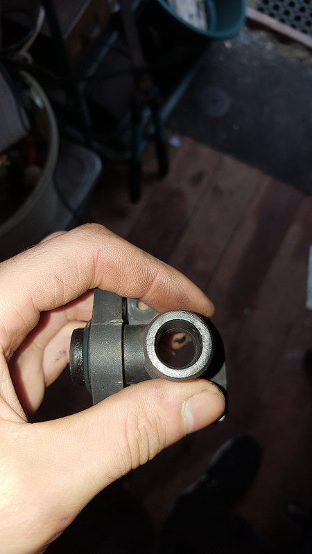

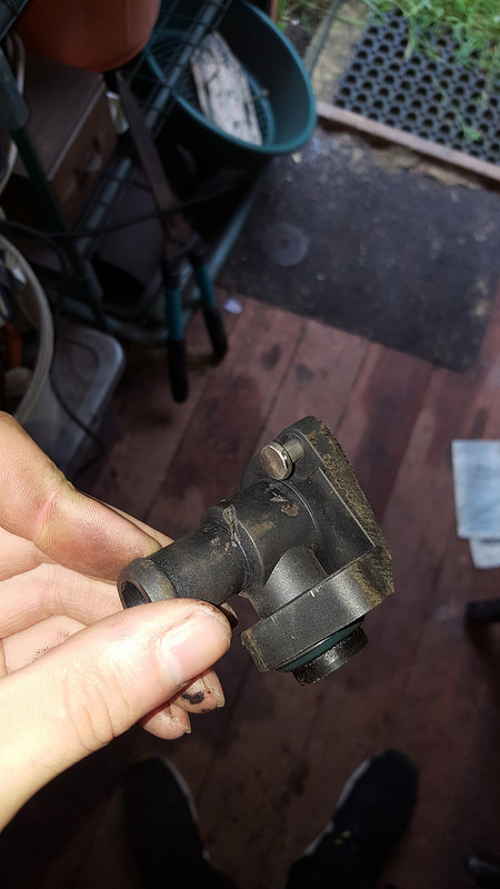

Housing has cracked in multiple places whilst trying to punch the 2nd pin out. 1st came out nice and easy, this one was stubborn, and is still stuck in there even after cutting the plastic from around it haha.
So, that's £120 to Renault for a new one and a day off work wasted, great stuff, thanks car!
Housing for the idle control valve.
Renault only sell it as a single piece because of the way they're joined. Renparts sell the replacement without the housing for a fraction of the cost, but you have to punch the pins out.
Said pin wouldn't come out, ended up cracking the housing. So had to prepare my anus and go direct to Renault.
Will be here tomorrow hopefully!
If it doesn't fix the issue now I shall cry, £40 wasn't so bad if it didn't fix it, £120 though..

Bodged it back together today, runs spot on.
Cleaned the valve, glued the cracks, bolted together, silicone sealed just encase.
Just not sure how long it'll last, Not bothering with the new part from Renault, just going to buy up all the second hand ones I think haha!
