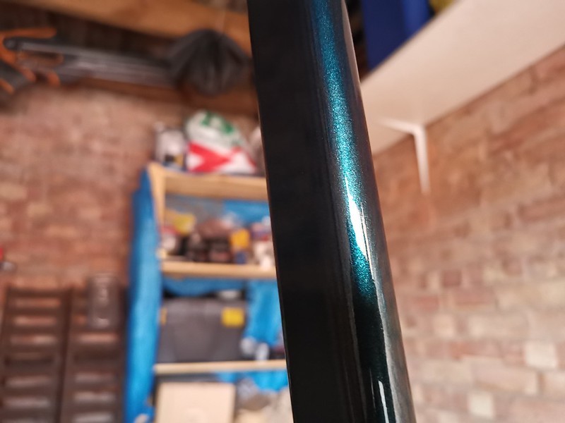

The sabelt DIY paint is terrible. I'm in the same boat as you now Toby, being yellowless and needing a refurb.
You going snappy, royal, or someone else?
Any ideas on re-painting it? Not sure on the best route to take.
Spend ages taping it up/cutting around it then spraying?
Touch up pen?
Very very fine brush?
May use a Porsche colour ?
Friend is doing the wheel for me, not expecting it to be perfect as she is learning still. But I'm confident it'll be more than good enough.

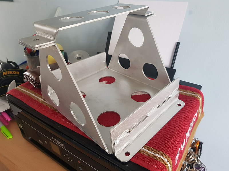

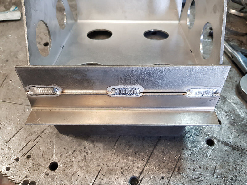

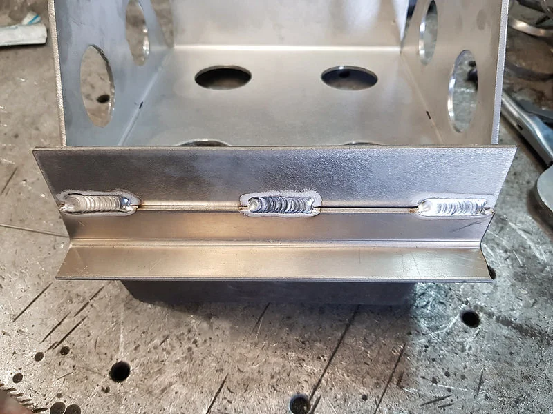

Battery tray is all bent up, testing and final work to get it mounted tomorrow.
Few thing's I could've done differently but it'll do. Will be hidden anyway, maybe if it was out on show I'd make another.

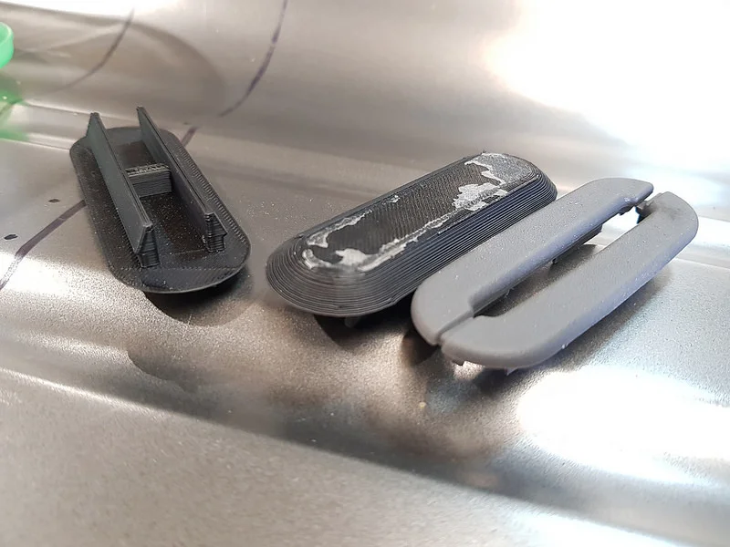

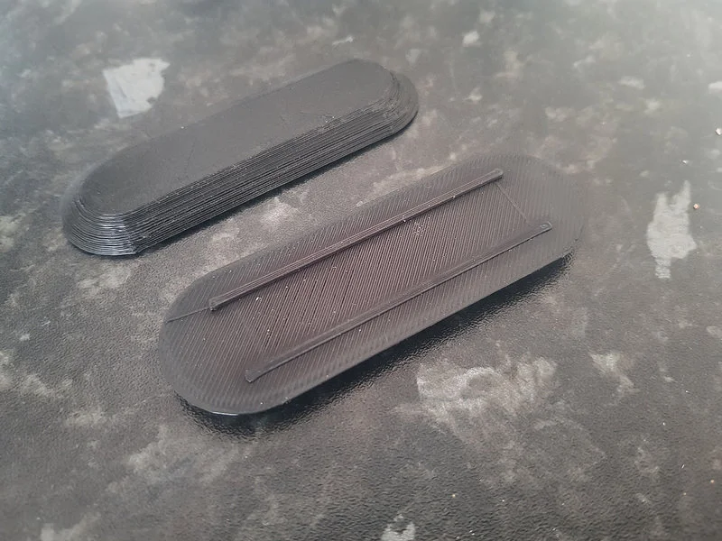

Chap at work is making me a few little bits and bobs with the 3d printer atm.
These are the 1st things I'll be trialling, something a bit pointless but it's all about the little touches imo.
I've had one missing since forever and just never get around to finding one. So why not make some proper blanks instead?
Will prep/paint/fit over weekend probably.
1st attempt that broke;
I dunno if anyone would be interested in them but can get a few more made up if anyone is.
Same with the battery trays to be fair. I could make a better final design and get a bunch laser cut. Don't take long to bend them up, setting up the press tooling took longer than doing this one lol

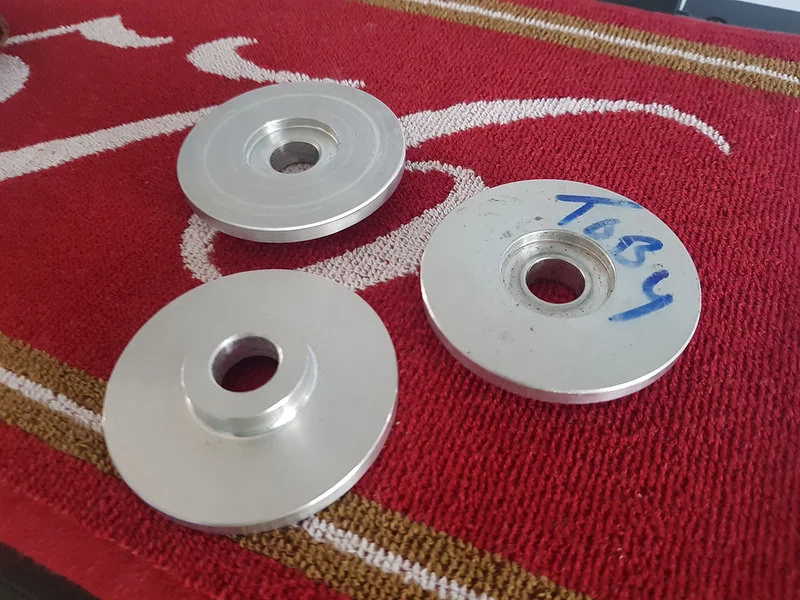

Vibra mount top washer made, ended up with 2 for some reason ?
Selling a pair of Vibra-technics mounts if anyone wants um? Will get an advert up later.

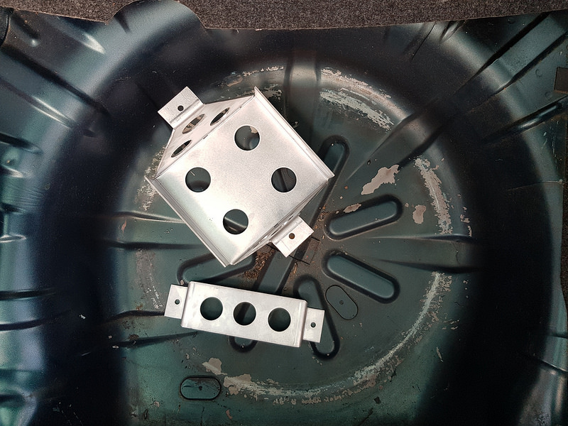

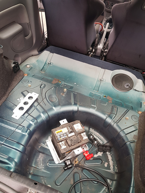

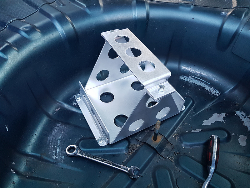

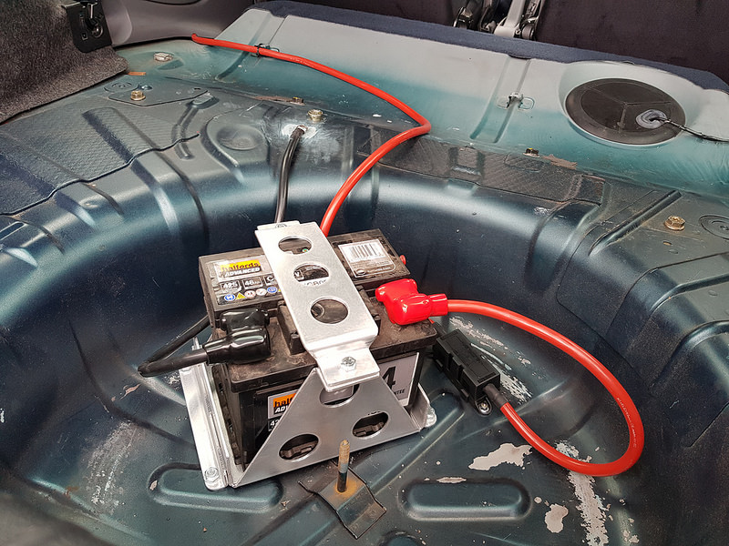

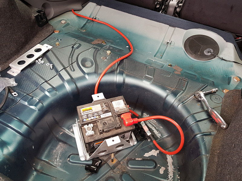

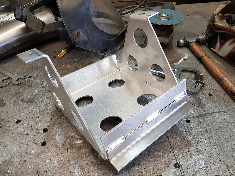

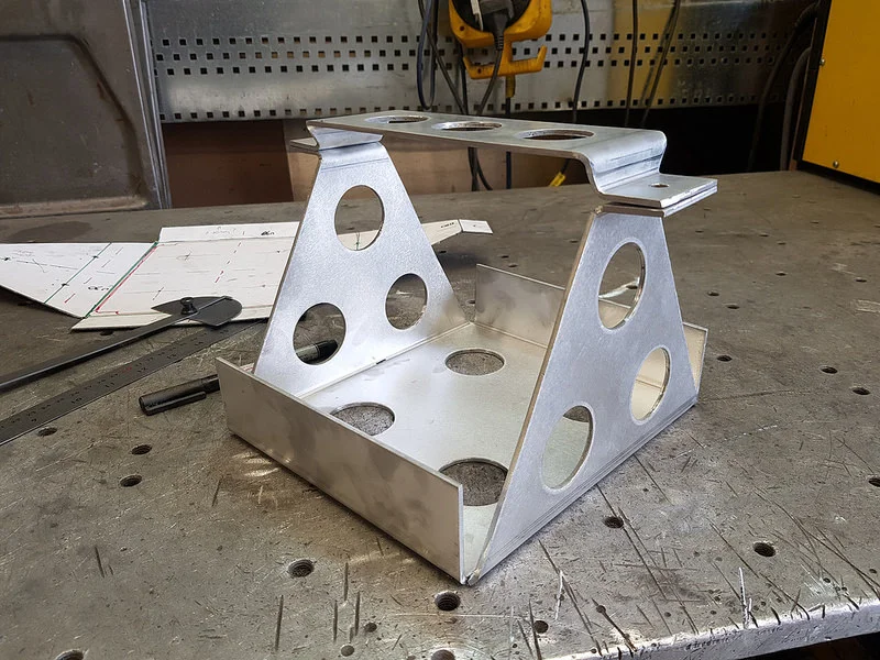

Finished the battery tray ?

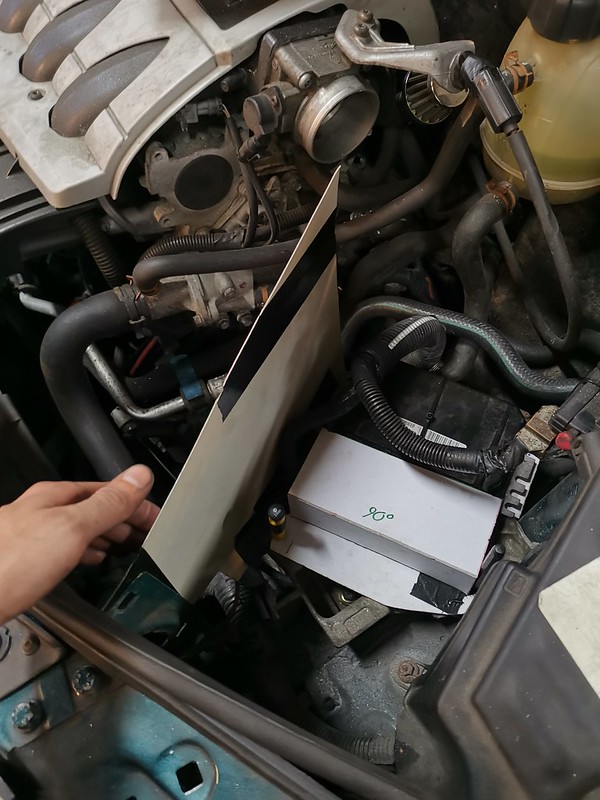

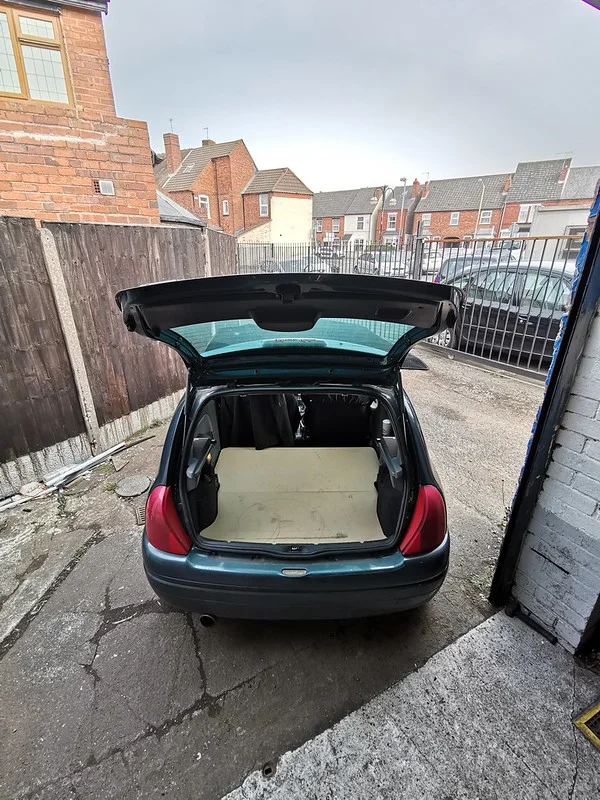

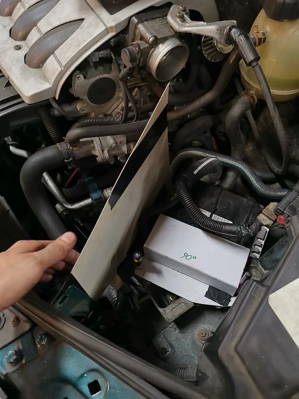

Placement plan, as far to the middle and forward inbetween the wheels as possible, whilst being in the wheel well.
May try get this bolted in over the weekend, going to order all the stuff I need to relocate and to tidy the bay up.

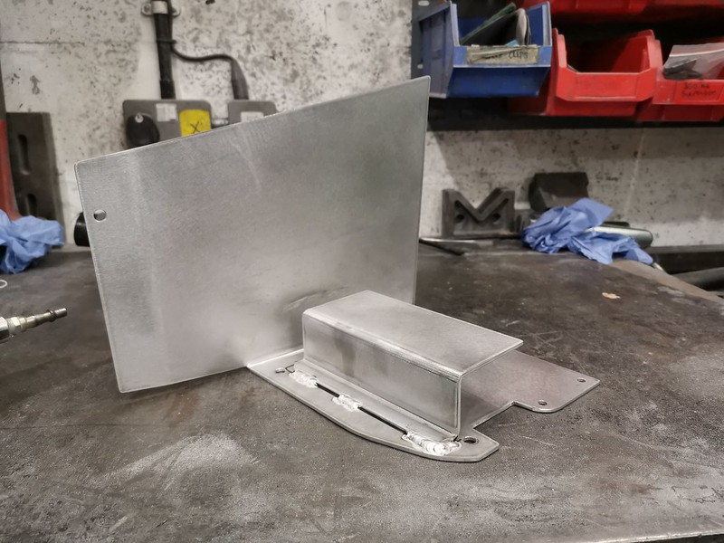

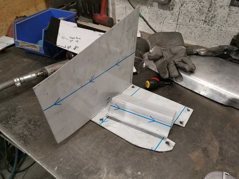

Will start making a heat shield for filter soon as that's done.

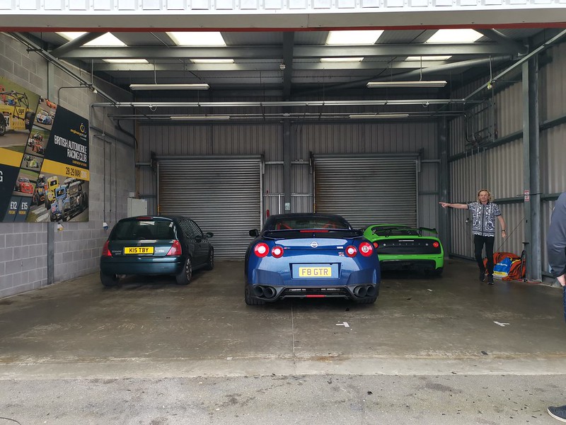

Saturday @Dr Jekyll took a photo of my clio
I was inspired to get a move on and get some trackdays done, Maybe doing one in Dec, will see.

Drilled some holes and bolted this thing into place

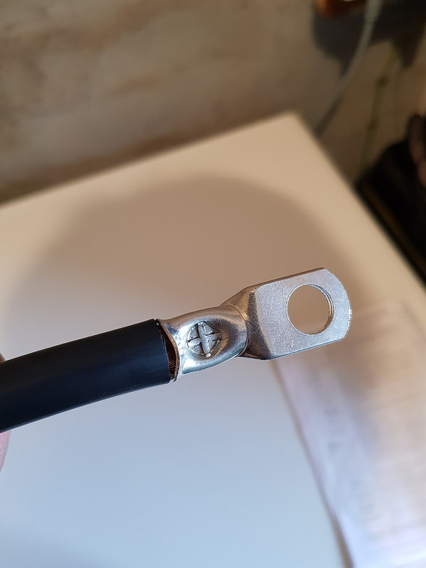

Poked some holes with a big red cable

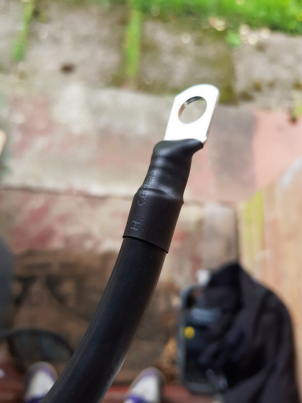

Tried out the fat crimping tool, I like very much

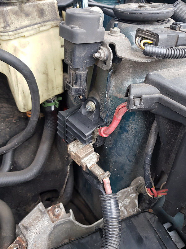

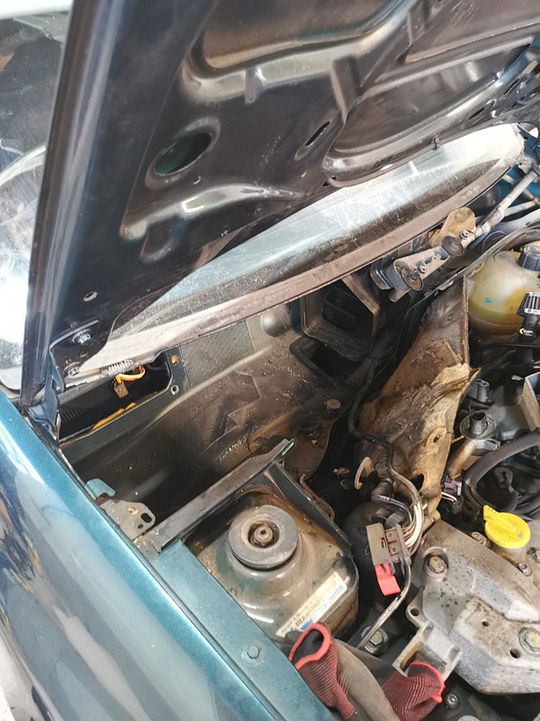

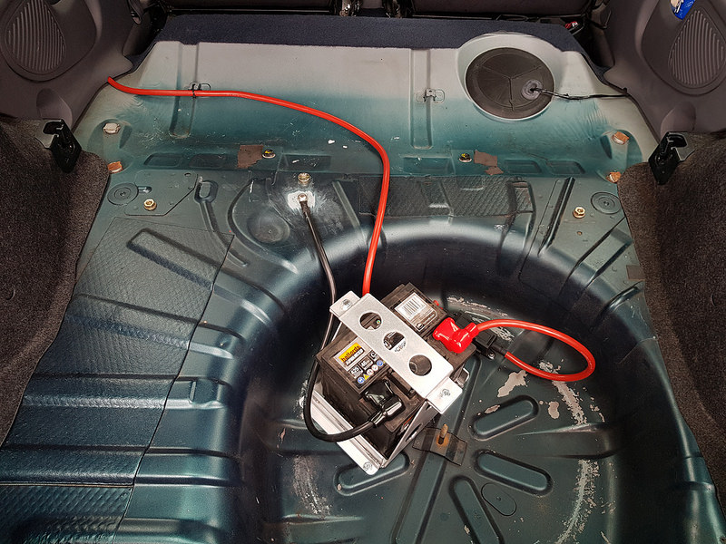

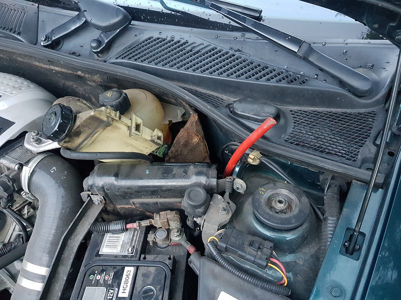

Removed battery and all retaining framework & ECU, fitted the Junction Block
Still hadn't trial fitted the battery in the cage I made, luckily it fitted (I had no doubt)

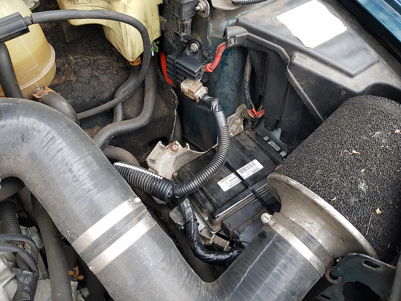

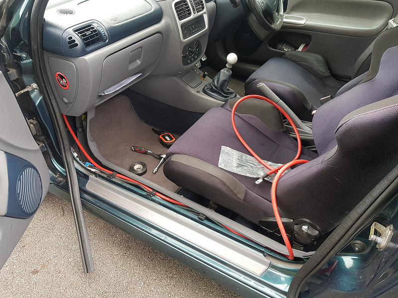

Started to properly route the cable after I'd done it roughly to measure, cut, crimp etc.
Managed to hide it all really well, quite happy with it.
Positive all in and done, with mega fuse
Negative all done
Both all done, all started fine, nothing went up in flames or shorted out haha.

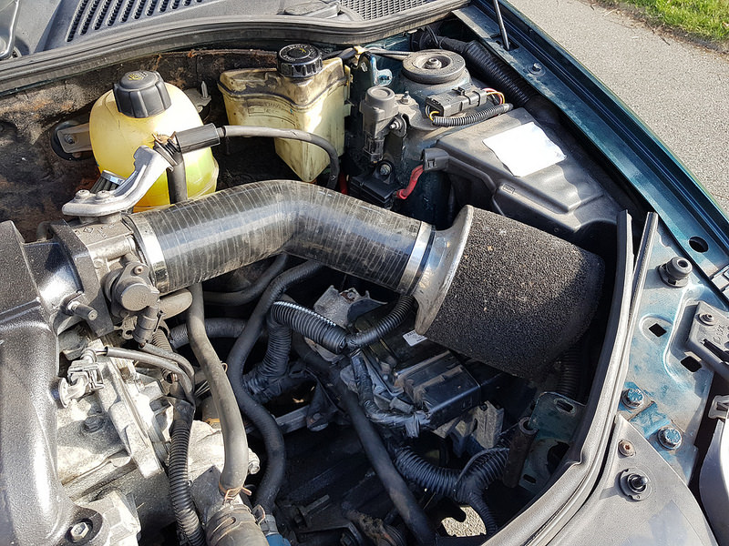

Temporarily secured ECU and tidied the cables a little.
Yeah, I know... filter is filthy.
Will be being cleaned up, I've a 45 degree hose to change the route, and will be making a custom bracket and heat shield for ECU & filter.
All done, nobody would be any the wiser...

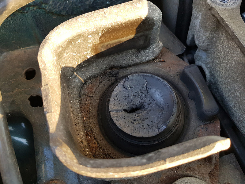

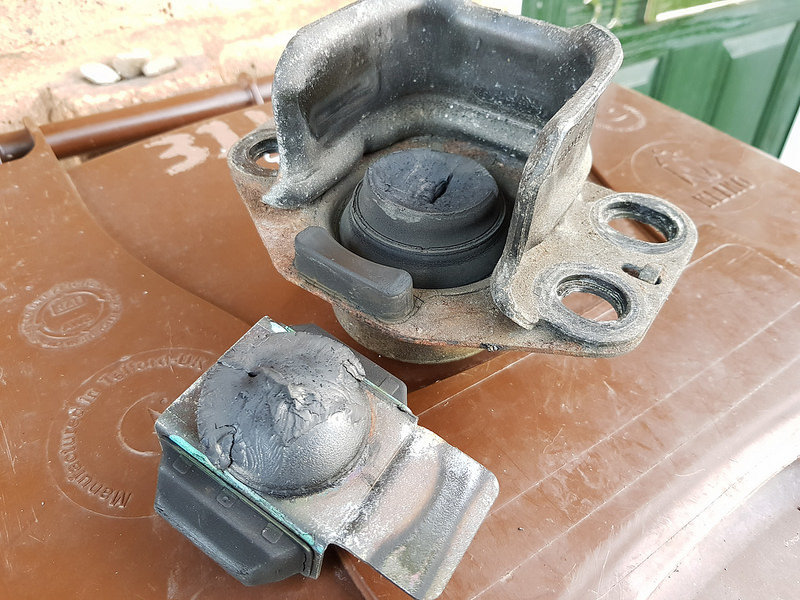

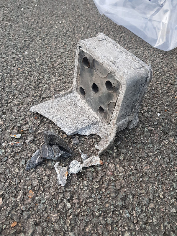

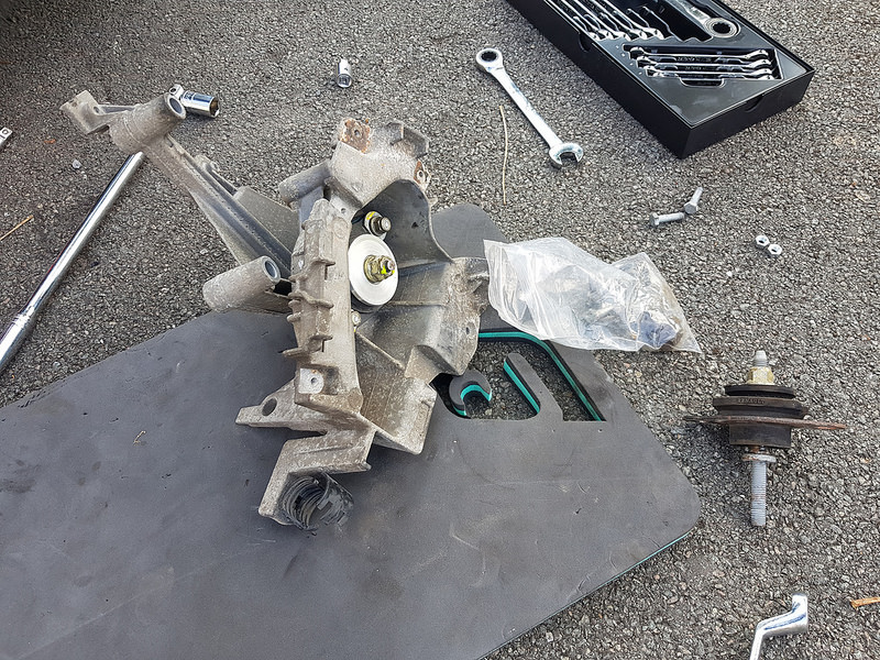

So, waaaay back in 2015 when I had the belts done by @MicKPM he advised I changed the upper engine mount.
Prooobably should have listened to him ?
And this... really renault?
Both gone anyway, new one in, kinda.

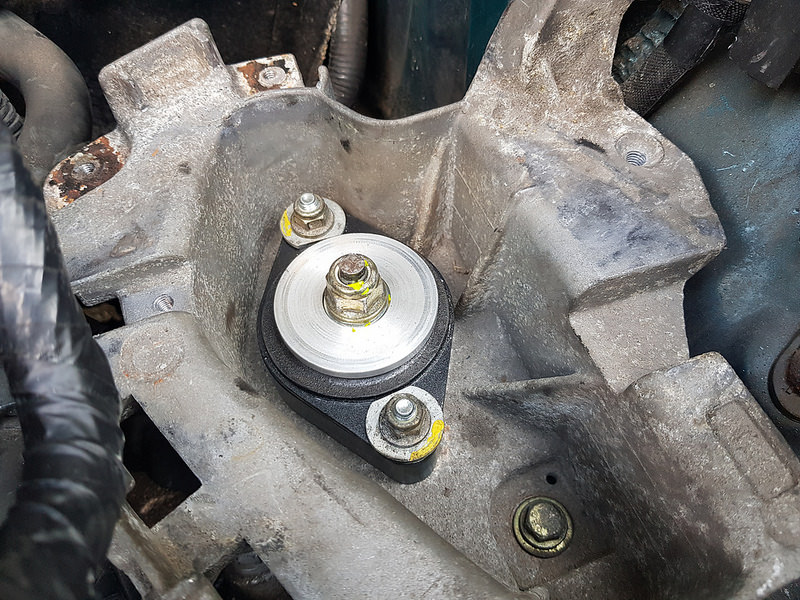

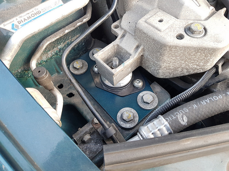

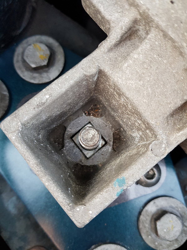

Not happy with the possibility of movement in these mounts, with the square hole in the upper part of the mount. Going to make a square washer in the morning to fit inside.
More to follow
glad im not the only one who was worried about those engine mounts moving! dont want to make/sell me a square washer too if it works? ?
I'm just sanding down a normal washer man.
Probably wouldn't move, you'd assume if it was an issue Vibra would supply you with one, but still... rather it be there just encase than not.
This car has been a bellend to me today, Not happy with her haha.

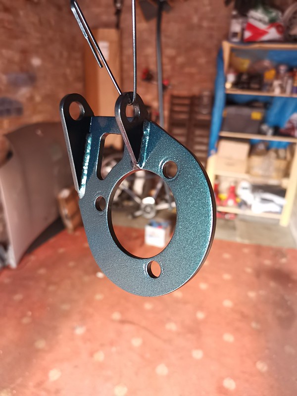

Started the morning, made my square washer, upper engine mount all done ?

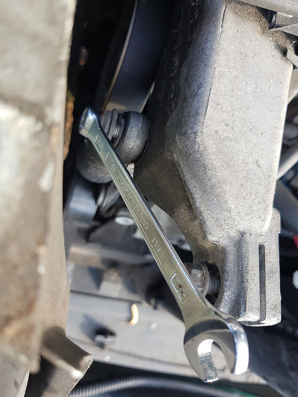

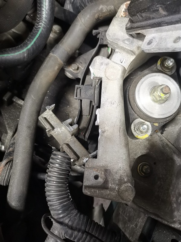

On to the gearbox mount, top nut was just twisting the rubber so I got angry and took the entire mount off the box/car to do it.
Sorted it though, that's all back on ?
Put it on backwards in that pic ?

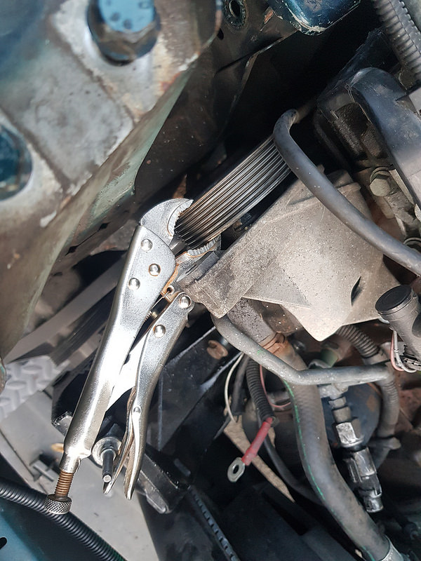

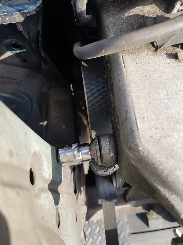

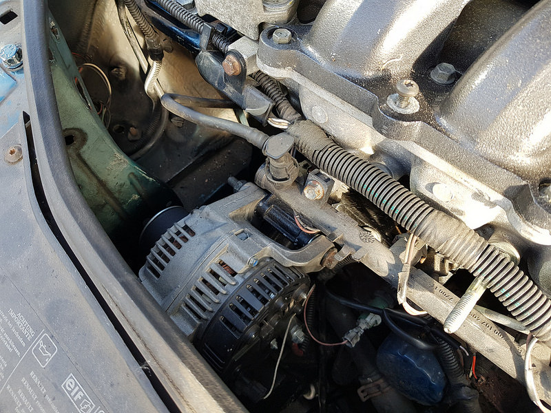

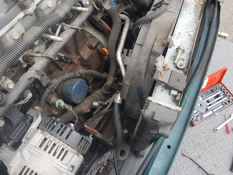

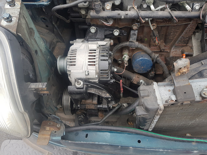

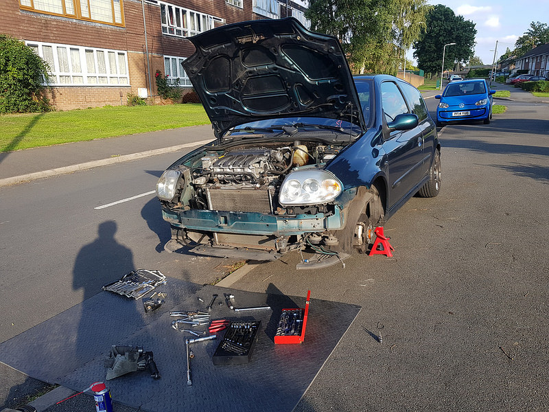

On to the cup alternator setup... whoever says this is a nice easy swap... has never actually done anything that's nice and easy, its a right pain in the arse lol!
Started to strip everything down, most bits are off by this point

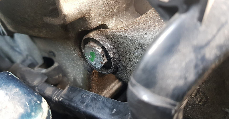

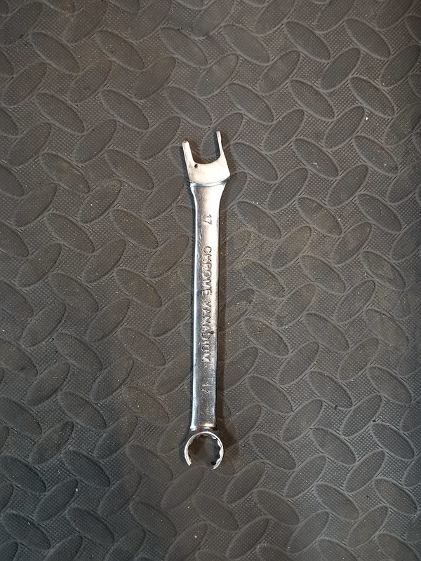

Top tensioner torx head bolt... great design from Renault

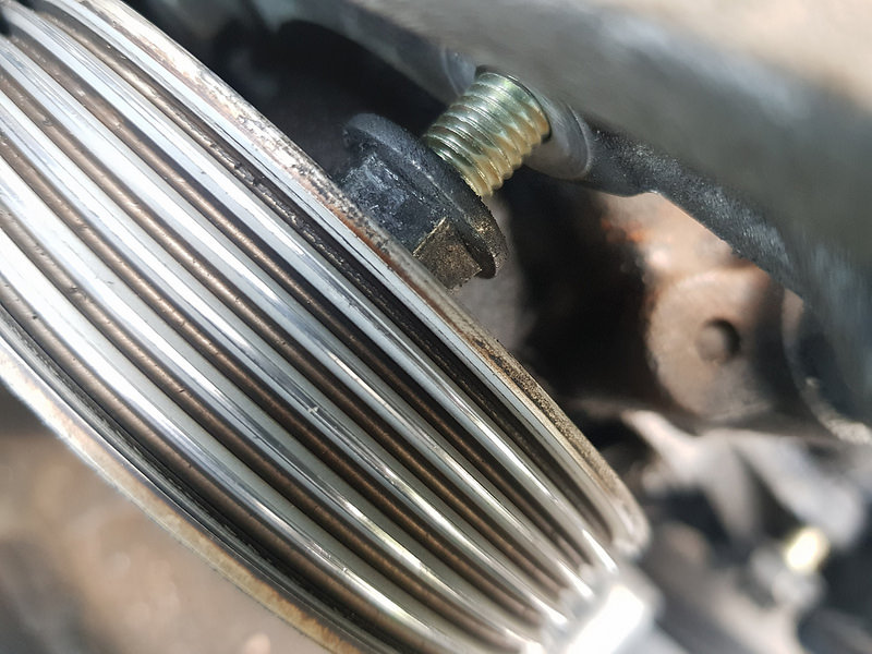

Molegrip on the socket managed to crack it off, then a 3/8 spanner worked it the rest of the way
Top alternator bracket, again brilliant idea Renault
Socket ant ratchet? nope
Socket and molegrip? nope
Spanner x3? Nope
Had to undo engine mount and jack the engine up to get a socket on it
Realised I had to move the PAS pump, removing it meant I had to remove 3 bolts behind the pulley, I thought when I saw that they must be short else they wouldnt come all the way out with the pulley in the way? This is a Renault so of course not...
No proper way to lock the pulley to undo the bolts holding that on, for the millionth time today molegrips saved the day.
Finally it's starting to go back together but by now it was starting to go dark and I had a garden littered in tools and car parts needing putting away.
Both mounts are bolted to the block, just need to sort the PAS pump out, gotta bend some s**t, not ideal but whatever ?
Hopefully better luck tomorrow

Forgot to update this, was shattered after finishing Sunday and wanted to catch the F1
Got it all done, besides a few teething problems it seems.
Got it all bolted up, realised the belt I got with the kit was for a non-pas setup.
ECP saved the day on a Sunday and came through with the belt on the shelf.
Can see in this pic the PAS lines that needed bending. Not sure I'm happy with them, may try find full cup setup on these lines. bending the lower one has meant it sits below the splash guard and up against the sump, cable tied it out of the way of both but this is far from ideal. Task n half changing them all though.

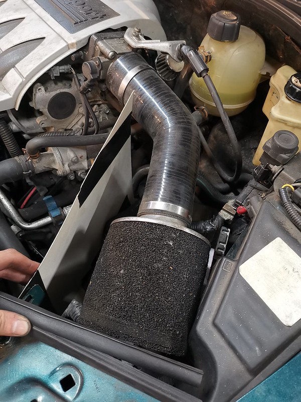

All in and running, even swapped my intake hoses over (Still need to clean the filter)

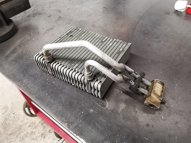

Also still need to remove the air-con from the heater unit, ideally I want the cup blanking panel rather than gluing something over it/

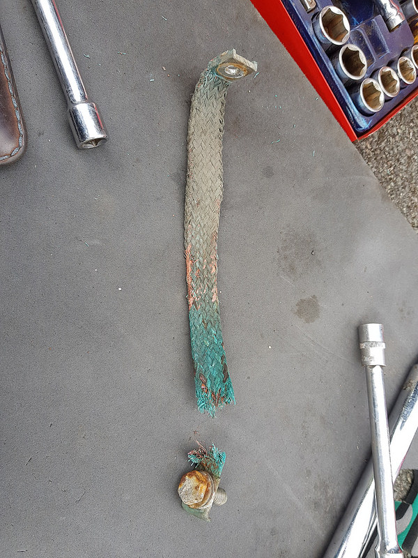

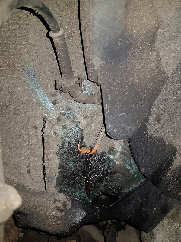

Starter motor has gone really slow, not sure if an earth has come off that I didn't see or what.
Don't think its related to the battery relocation as it worked fine right up until it's 1st start after doing this on Sunday.
Always seems to start, just like the starter struggles on 1st couple of turns.
Also, even though all I did with the wheels is remove and re-fit, ive got some pretty bad wheel wobble at anything above 50.
Annoying no longer working at a garage, could've checked balancing myself. But I don't see why it would be out, all weights are as they were to begin with, even made sure the wheels went back on the same sides they came off lol.
Stuff like this rate annoys me, like s**t was fine before now for no reason what so ever its not ?
More to follow this weekend if the weather is kind.

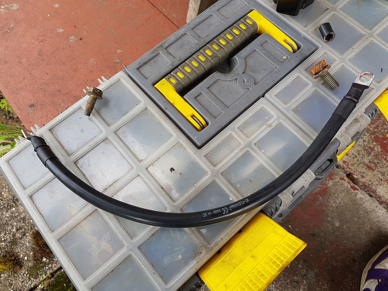

Well... this will have been the slow starter issue
Had the perfect length of cable left over and some lugs from the battery relocation.
Better than it's ever been now I think.

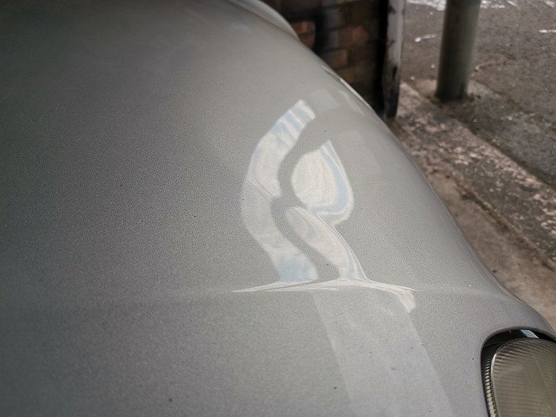

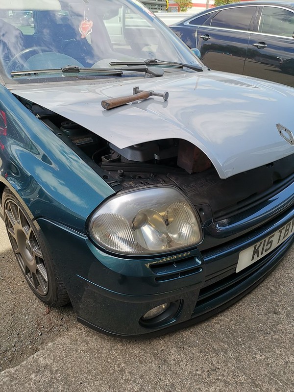

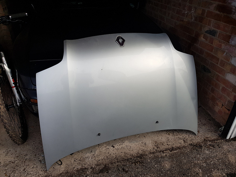

Did a buy

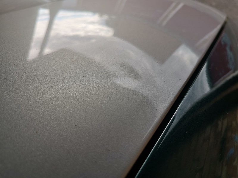

Ally Bonnet, one that hasn't been ruined by aero-catches, Rarity nowadays it seems.
Bot a slight crease in it, hoping we can sort it at work.
Will be being painted when I get both bumpers done and maybe some other bits blown in.

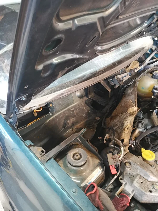

Still not removed the last bits of the air-con stuff (heater bits) but I did change my dipped and main beam's for Osram nightbreaker lasers and LED interior lights.
Can see inside and out now, which is handy haha.

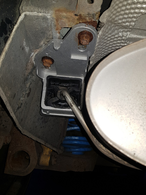

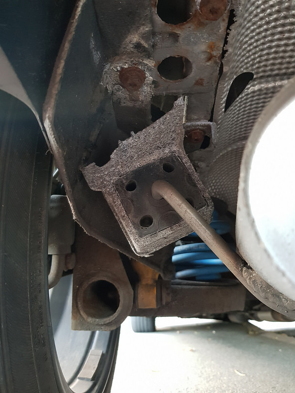

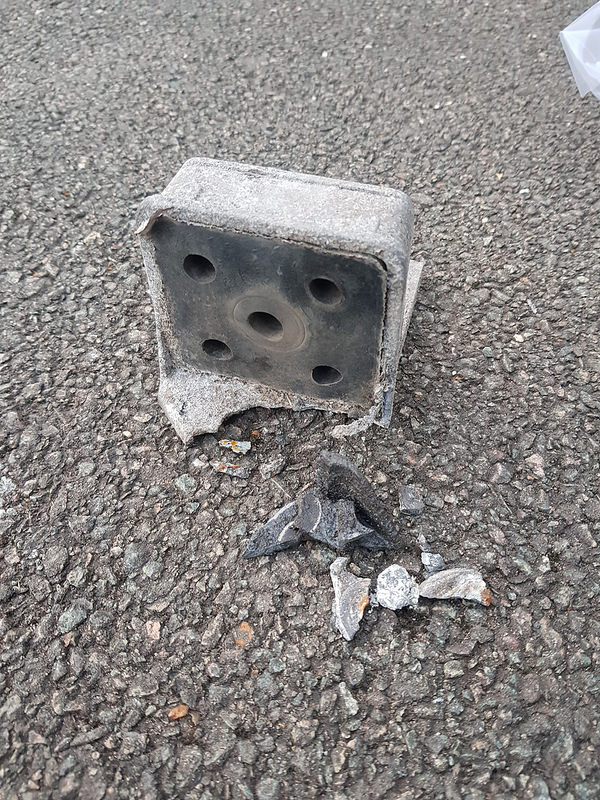

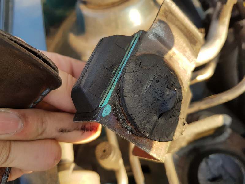

Also, Buy a prima racing exhaust mount you guys said, last forever you said....
Currently got this one on, kinda want another prima one but they're so much, and for them to end up like the one above...
On a positive, Ordered PBS brake pads yesterday, buy fronts get rears free. Gladly they let me order brembo fronts and get 172 rears on the offer.

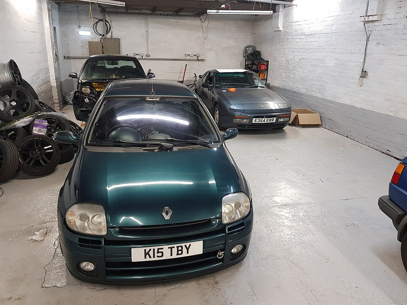

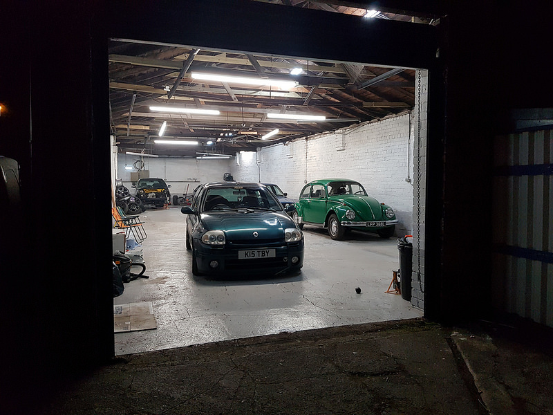

However, the main reason for things on the clio slowing, FINALLY FOUND A UNIT
Work can now start on the 944, and I've somewhere dry and soon to be warm to work on the clio. come the new year I'll be able to get back onto reducing the large shopping list for the clio.
Dry and warm sounds good, f**k messing with cars outside in winter! That exhaust bracket died well, at least the rubber didn't fail?.
Take rubber out of old bracket and refit in new one, cable tie to secure job done. I went ultra pikey and fitted a universal polyehxaust hanger inside my dci exhaust bracket. 20k later still solid
Rubber was fairly fucked around the edges, where the ally had corroded, it expanded and pushed the rubber all out of shape. Else I'd have considered keeping it.

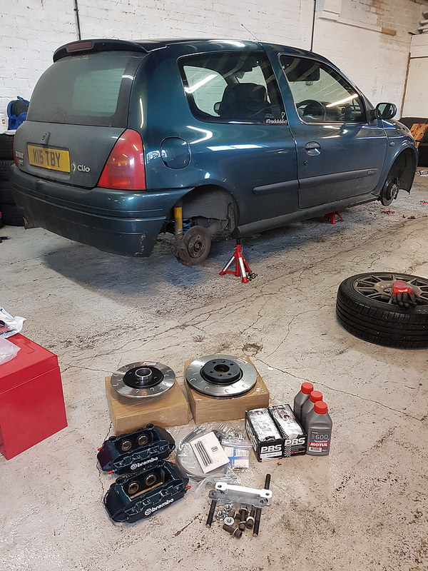

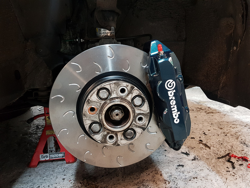

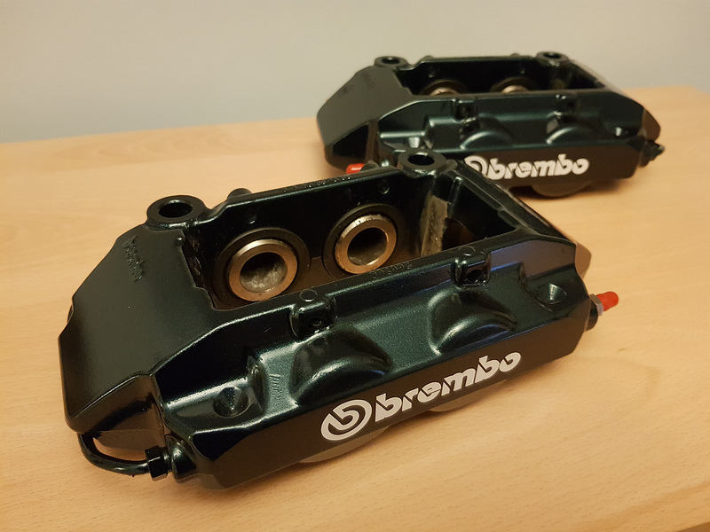

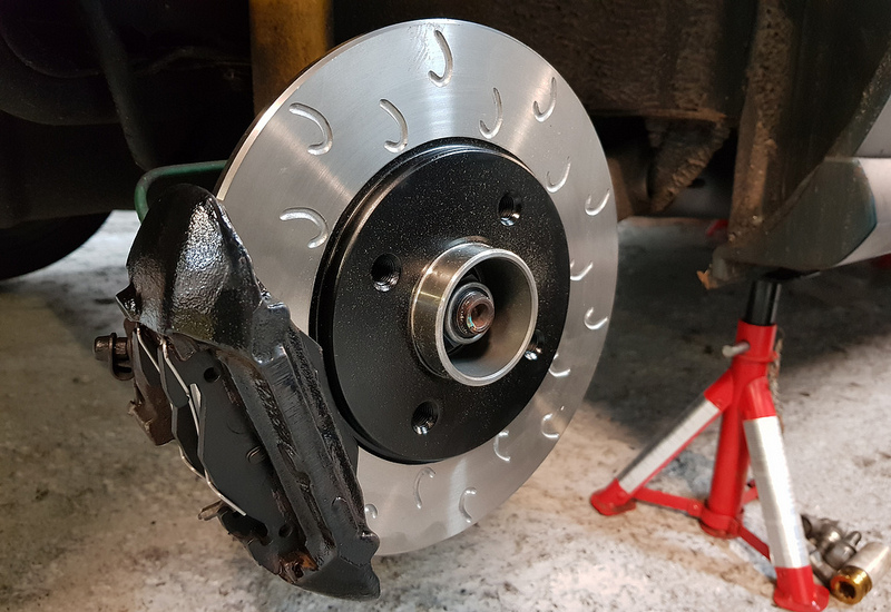

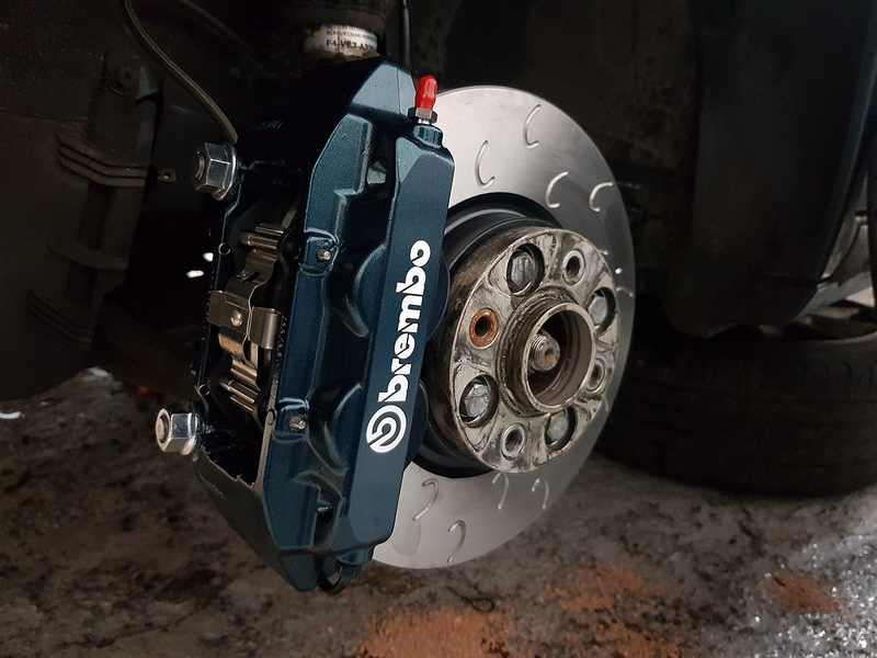

Built the calipers up today
Fairly pleased with them if I'm honest

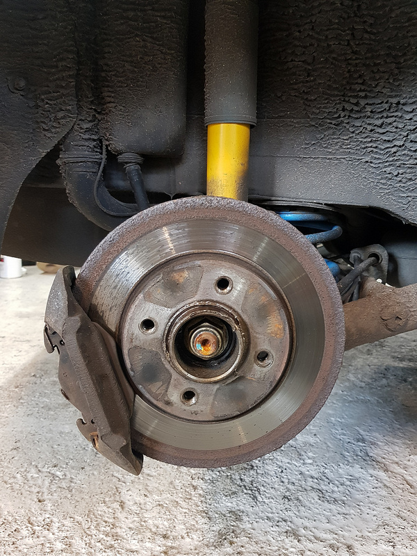

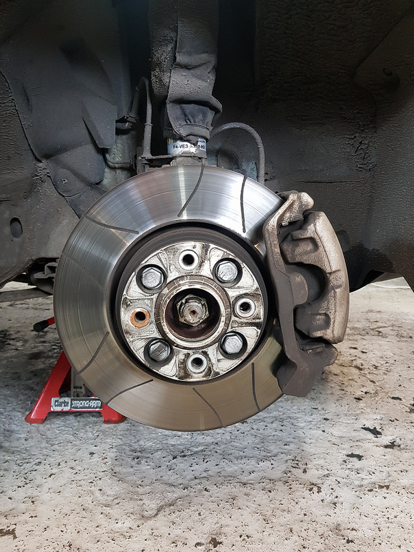

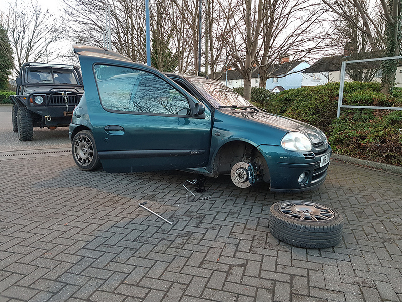

Started doing brakes yesterday, everything was all going so well until I got to NSF ?
So, brakes have been pretty fucked for a while, still worked but have been on their last legs.
Rears were long gone, defo got my moneys worth haha.

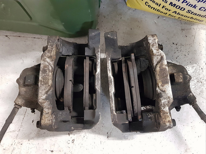

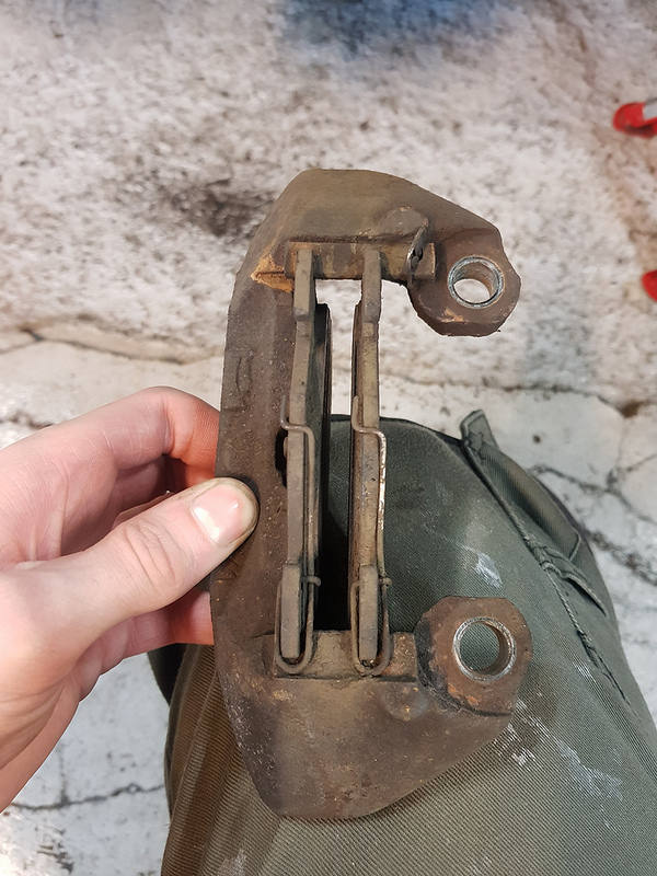

Fronts were different, Had a vibration from the front left for ages but never really effected performance so kinda just ignored it. had them apart many times trying to figure the issue out, assumed it was a warped disc.
Didn't get a pic yet but strangely on both sides, the inside pad was almost completely dead, but the outside pad had loads of life. No idea why, everything moved freely, was all greased correctly. Will get pics today though.
She filthy
What £850 of brakes looks like, cannot believe thats where I'm at on spend so far, just on these brakes.

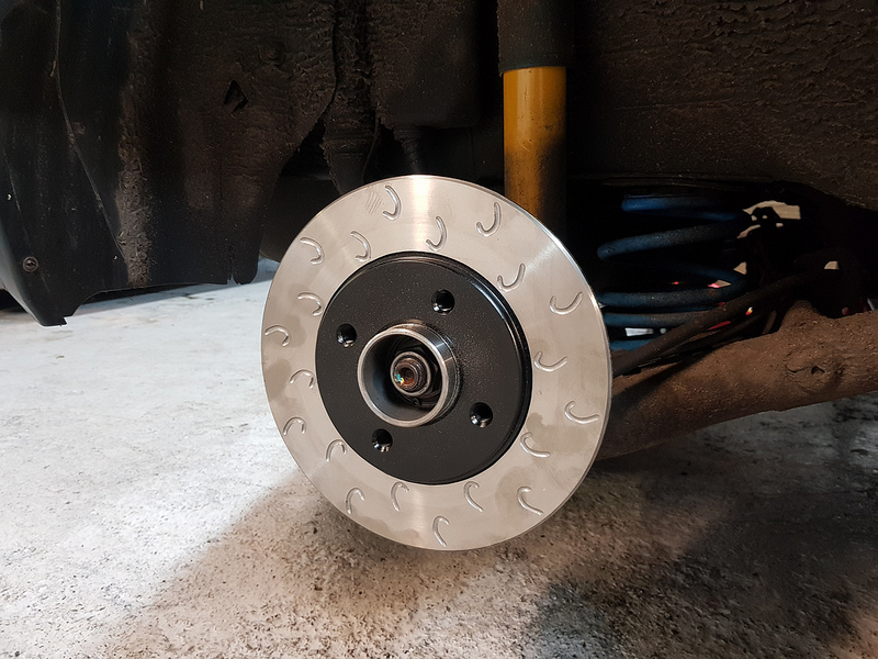

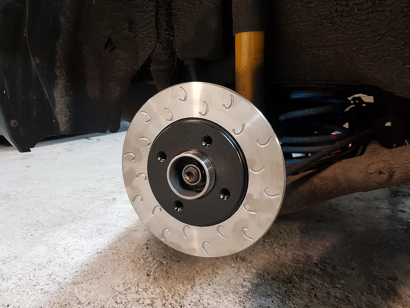

Rears, discs are on but as I'd painted the carriers and they weren't fully dry, figured I'd leave that until the following day, due to not being able to progress with the fronts.
OSF is all on and plumbed in, annoyingly chipped the caliper when test fitting wheels without spacers, can confirm my wheels wont fit without spacers ?

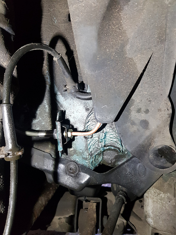

NSF, was undoing the union not paying much attention, then realised the union had seized to the copper line and twisted. twisted it some more to stop the fluid coming out, then cut it.
Collecting line, unions and flaring tool from Halfords in a mo and gonna get cracking on that. This line was replaced less than 2 years ago anyway, hoping I can save this as there's loads of excess above, if not I'm going to have to do a full new line from the ABS unit.
Went into it knowing nothing ever goes to plan with this car, so not too surprised this has happened. I just hope this is the only issue I come across.
Will bang a full spec list up of what I've gone with once it's all fitted.
Line fixed
Everything is now plumbed in and working, I think. Got me home ok anyway, no noises or obvious leaks.
Will check over everything in a few days, need to touch the caliper up too

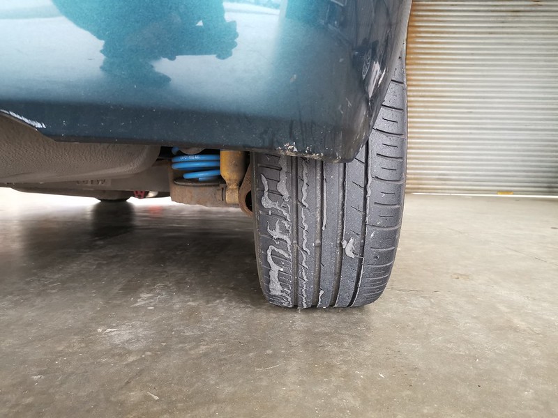

Uneven wear on fronts...
Will grab a pic of them behind the wheel once I've cleaned it, gotten some daylight.

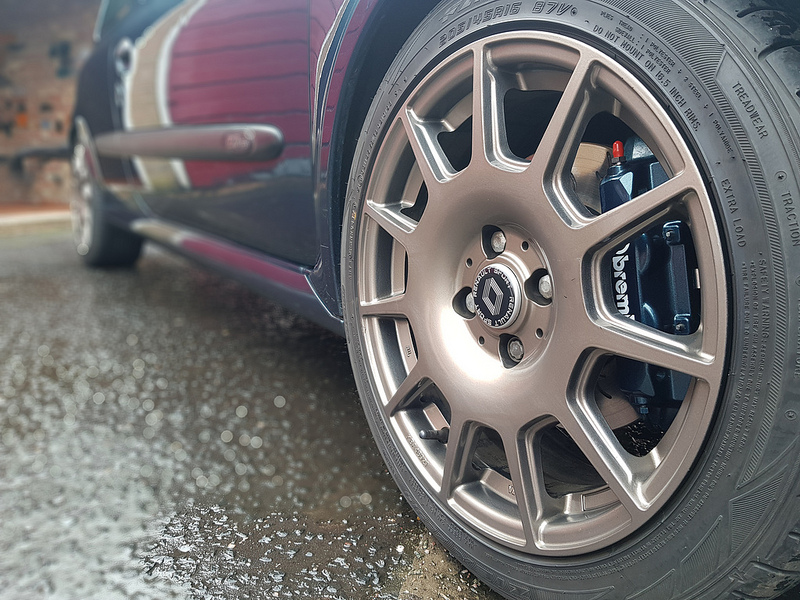

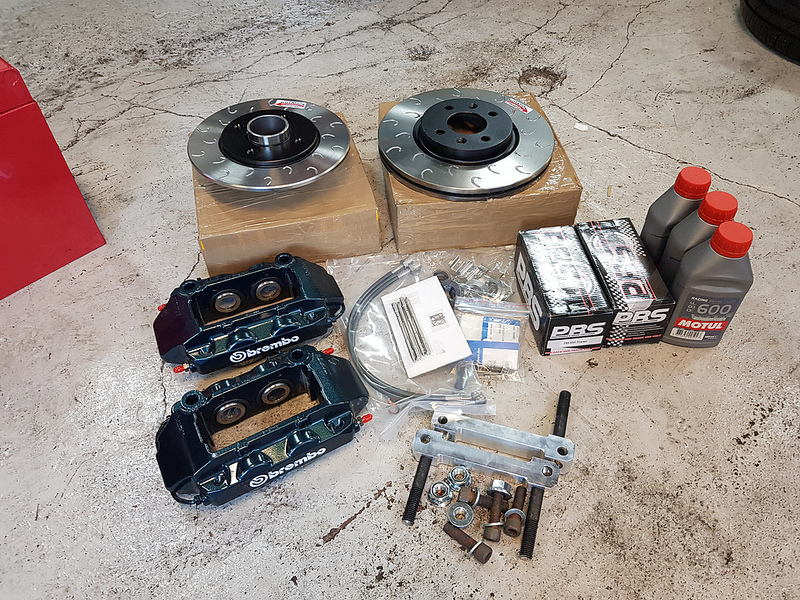

Spec list
Brembo 4 pots rebuilt with Big Redd rubbers and titanium bleed nipples
Mr Pinks stainless pins
New anti-rattle shims
Adaptors to suit 15" wheel fitment (calipers machined too)
PMS/Goodridge braided hoses
PBS pads front & rear
Godspeed G hook discs front & rear
Motul 600 fluid
New rear pad fitting kit, bearings, abs rings, disc spacers, hub nut bolts.
Can confirm, they do not fit under the Exclusive BBS wheels.

Made some removable boarding for the boot, constantly lugging tool boxes n stuff too and from the unit was taking its toll, especially without the spare wheel in, couldn't put anything over that area.
This just sits in with the carpet on top so i can roll/slide s**t in easily and it isn't falling all over the place.
knocks when there's no weight on it, but it shouldn't really get used like that, just pop it in when I'm loading up with tools.

I'm getting a clunk in reverse when I brake, dunno what it is so replacing everything, it all needs it anyway.
Top mounts, every single ball joint and rubber bush, few other bits (hopefully gearbox rebuild too just without the LSD)
Oh and my hubs n shizz from @NorthloopCup should eventually be going on, just a year and a bit later :ROFLMAO:
Done some buys
Fresh OE Track rods and front bearings for the new hubs

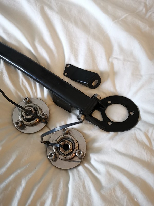

PMS solid top mounts and strut brace
Powerflex everything as soon as I've more money, then rear ARB I think

PMS bits arrived off of Stu
Now Scarab green

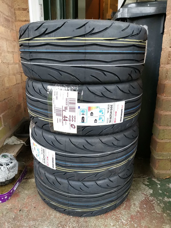

Tyres I mentioned above
Im not sure how these will be, they come very highly recommended off a fair few people, but there are always others who have bad reviews of them too.
But, for the price, I cant see me having a bad thing to say about them (£260).

Test fit the ally bonnet as I wasn't sure it was still straight given it was creased.
Got the worst of it out, and seems to still be the right shape. Lot of flex in these ally bonnets though.
Need to get the paint stripped and give it a skim of filler in places. Debating buying the kit for painting myself or getting it painted at a bodyshop. Bumpers and spoiler need painting.

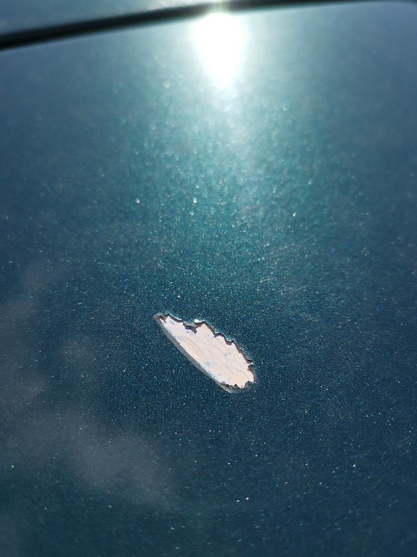

Talking of the spoiler, this is why it needs painting...
No idea when, what or how. properly deep though, bit annoying

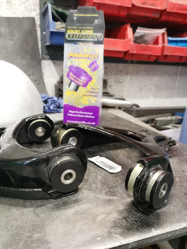

powerflex everything
Wishbone bushes
ARB inner and out bushes
Steering rack bushes
Rear shock top bushes
Rear beam bushes
Cant wait to fit these.... not
Wishbones were easy though
Bearings have been pressed into the new hubs too, cant remember if I've already mentioned that though,

This one was really crap, I took absolutely no pictures aside from one of the spanner I had to modify
Changed my normal PAS lines for the cup ones. OH MY GOD what a c**t. Literally spent 12 hours doing it. Getting to the one that goes into the rack had me stuck for hours, almost impossible. I guess you should drop the subframe to do it but I wasn't doing that.
Done now though so I'm a little more happy with the air-con delete.
Also finally got round to removing the rest of the aircon from the heater unit.
This was also an annoying job, which again I didn't really take pictures of. The last bolt on the air duct into the cab was a nightmare to get to but managed it in the end after spending about half n hour figuring out what I was doing wrong/why it wouldn't come out.

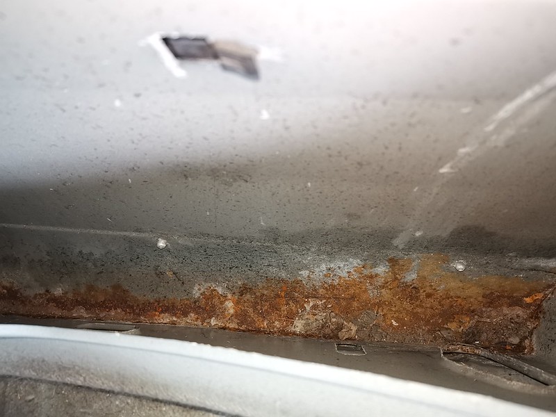

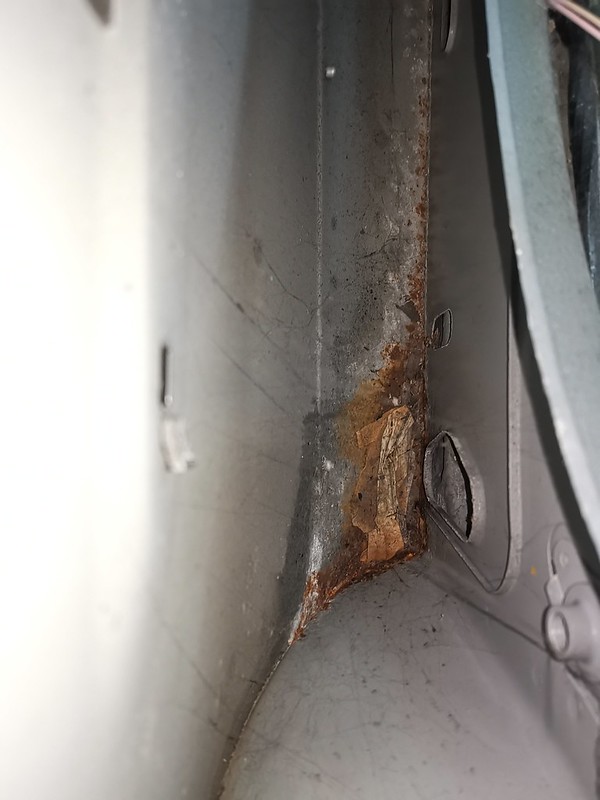

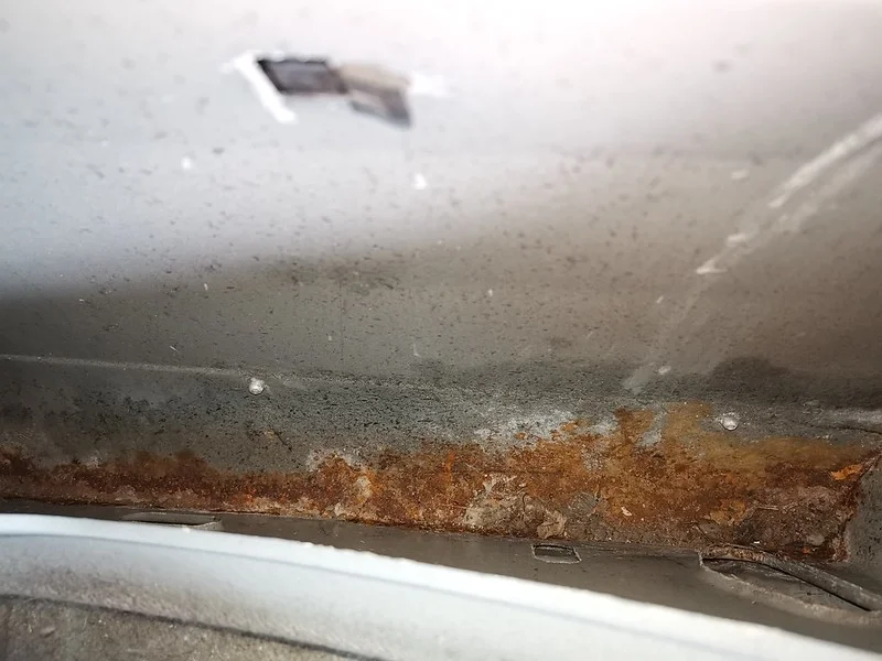

Had a look behind the rear doorcards instead....
Passenger:
Driver:
Sooo, looks like I may have some welding to do.
Going to buy all the kit needed to treat/protect the insides, and a rivet gun and I'm gonna strip it all back repair.

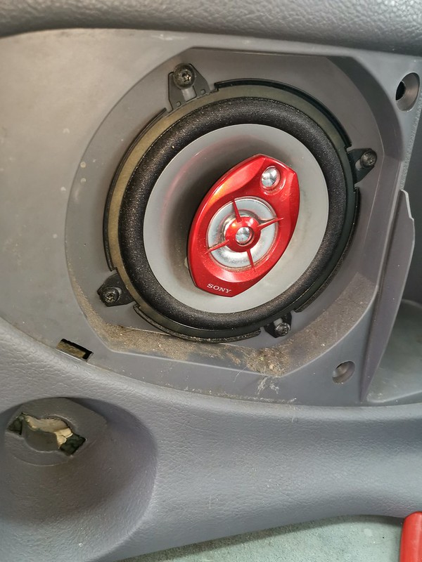

On the plus side, found out I have Sony speakers

Going to design/make a heat shield/ECU bracket over the next few days at work too, something I've wanted to do since battery relocation.

Sooo actually did something I said I was going to do today, now there's a 1st :ROFLMAO:

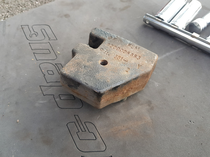

Removed some unneeded bits from the gearbox mount, just battery supports I believe.
Made cardboard template
Will try get it cut out & bent up at work tomorrow/Friday.
