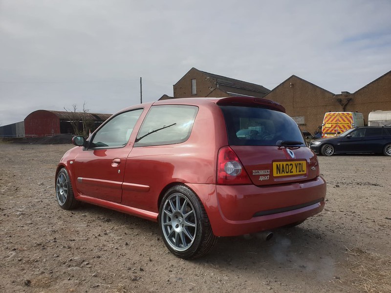

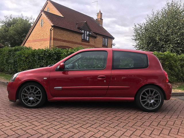

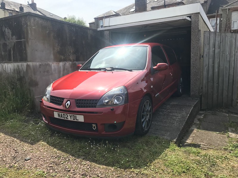

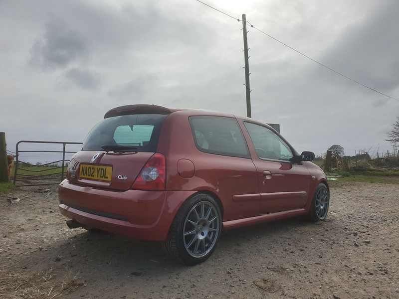

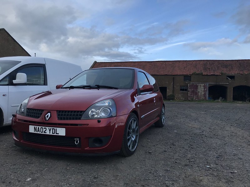

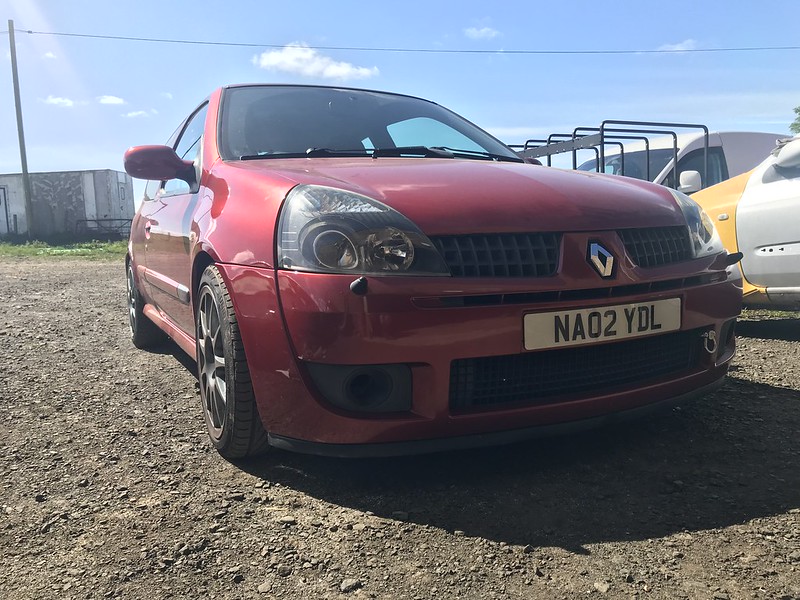

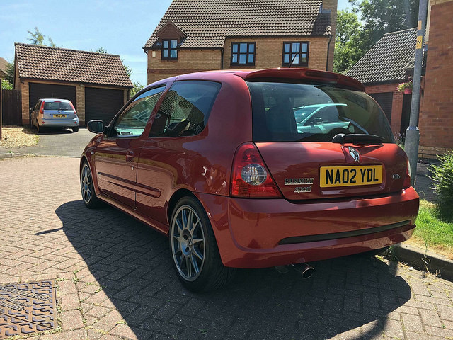

Managed to find my way back into a Clio after a good few years. Fancied a second car as my GTD was becoming very boring.
With the intention of next year doing a few road trips and track days I was on the search for another Clio, This came up for sale on the Clio sport owners club on facebook and I had to have it.
From the advert the car as follows :
Clio 172 Flame Red
96k miles
9 months mot
Folder full of history
Full belts and water pump at Beaniesport renault specialists in February 18
Full service at the same time
Gearbox reciept for nearly £600 also this year

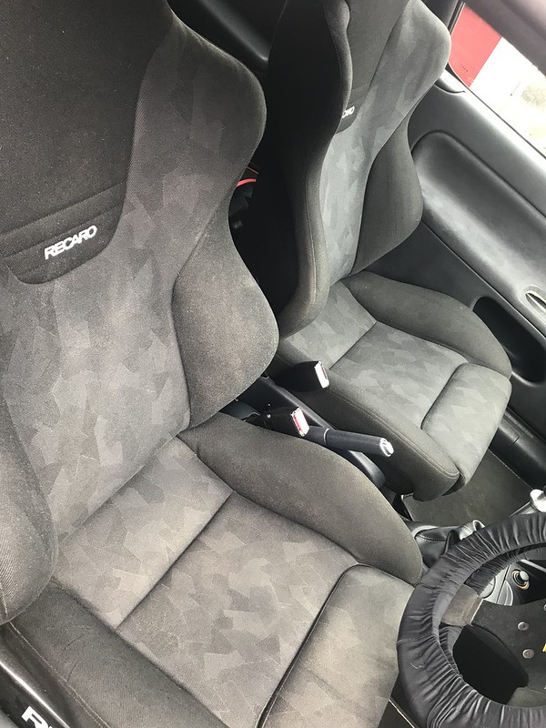

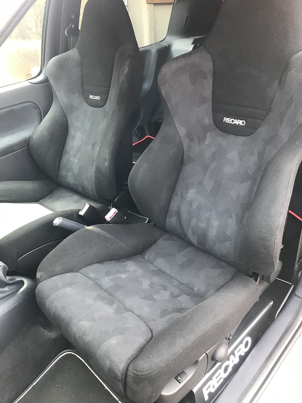

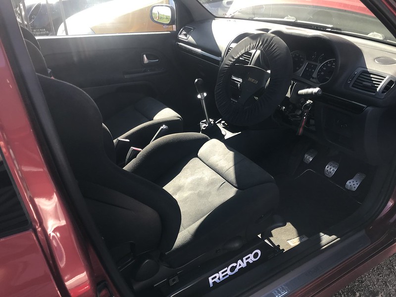

Recaro sportlines
Yozza exhaust with ktec sports cat
Turinis (could do with a refurb)
Cup spoiler
Near new shocks all round on cooksport springs
Xenon headlights
Solid top mounts
Solid gearbox and engine mounts

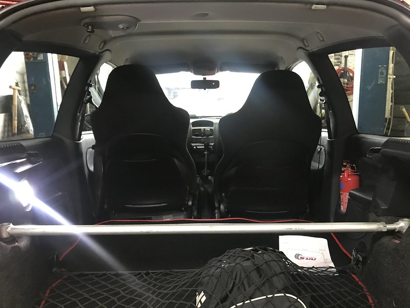

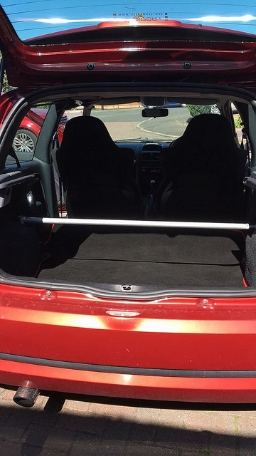

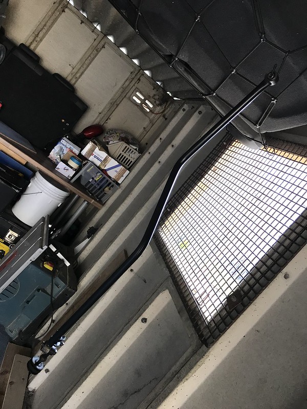

Rear strut brace

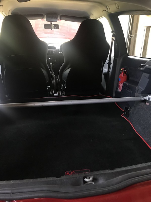

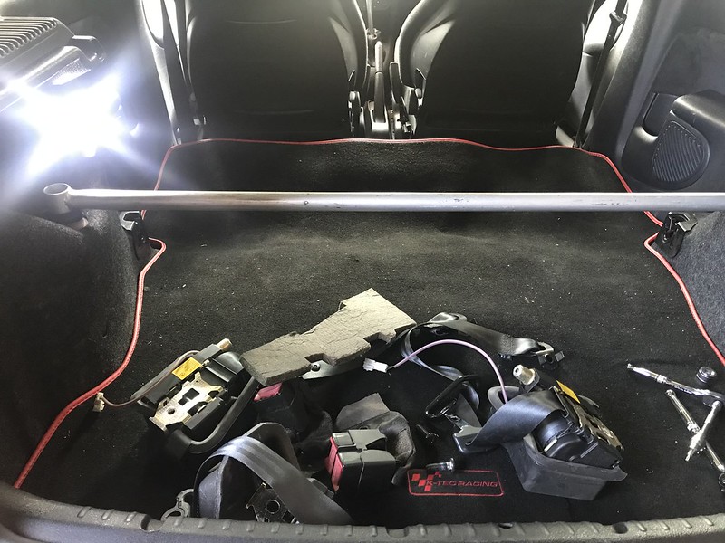

Rear seats removed and ktec boot mat fitted (still have rear seats if required)
Ds3000 pads up front.
Braided Brake hoses
So Plans for the car apart from drive it..

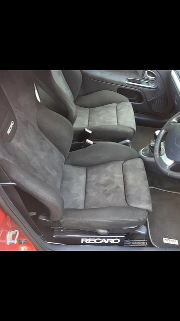

I want rid of the Recaros For something like a Recaro SPG or similar to lighten it up and fit a harness.
Half cage painted in Flame red
PMS shifter
Change the tyres on the Turinis to Rainsports for the road
Get myself a set of 2118 or similar for some AD08r for track
Then drive it and most likely break and expose its weak points.
Enough waffling heres some pictures.

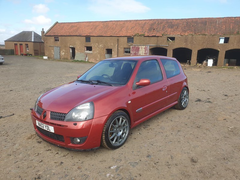

Yes for 16 years old I can't fault it, it had some ling long tyres on the front though and the wheels need a refurb but apart from that it would seem like it has been very well looked after. the folder of history is very very substantial every little thing accounted for.

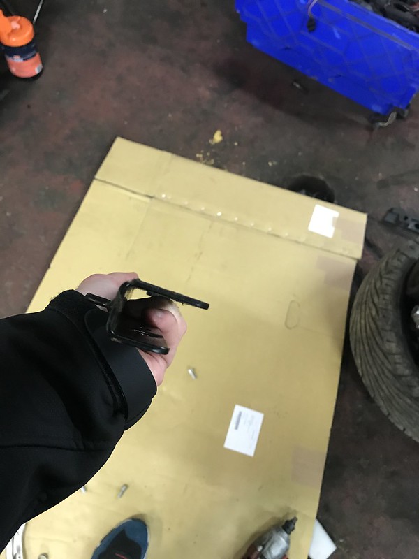

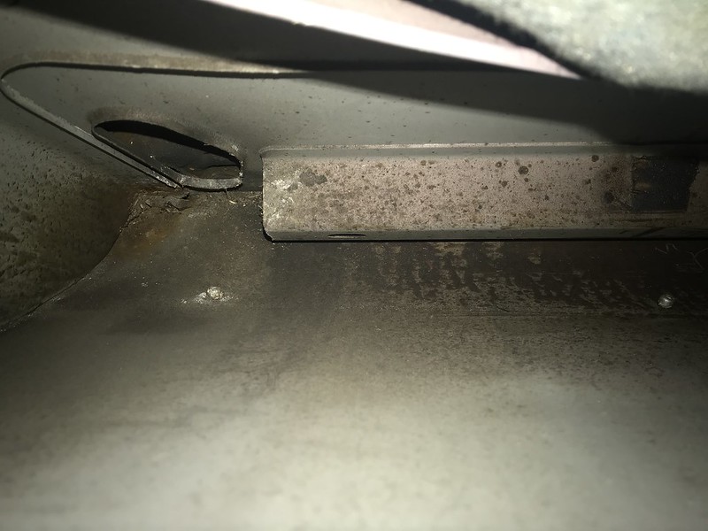

first being the aircon rad bracket rusted and fell off burst the rad and I was left stranded with no coolant. but was shortly fixed and back on the road.

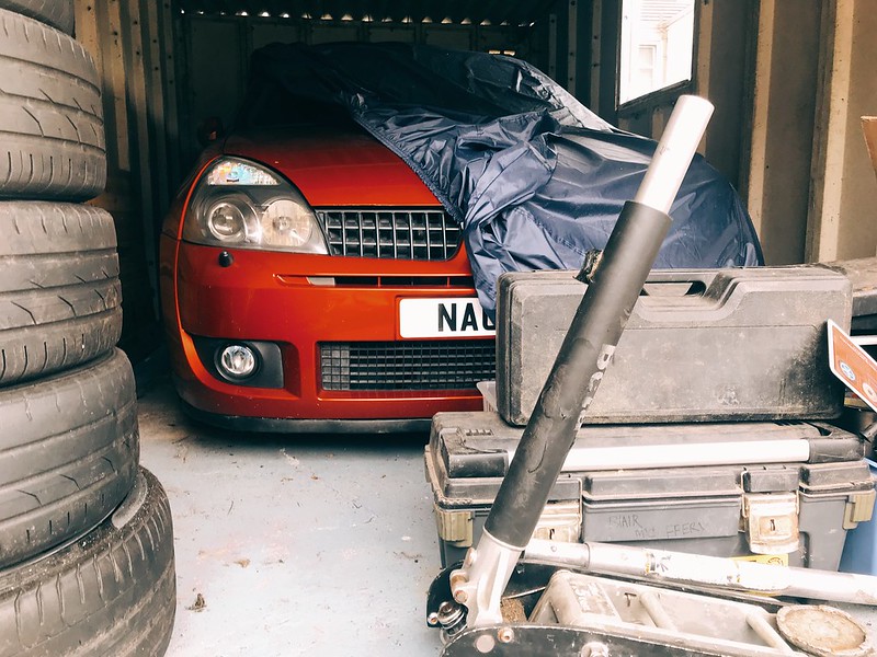

Had a lot going on last year with moving etc so the car went into storage and ive just recently been acquiring some bits and bob:

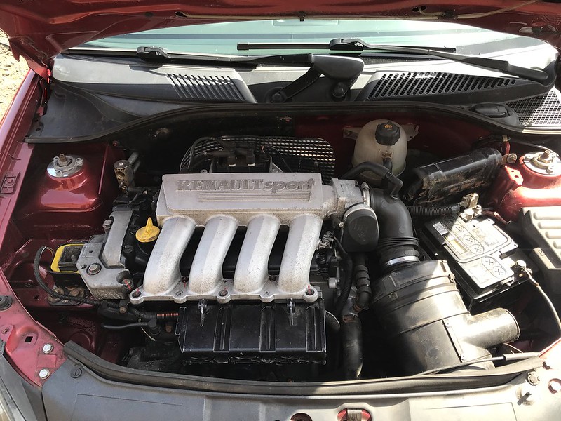

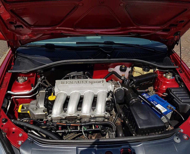

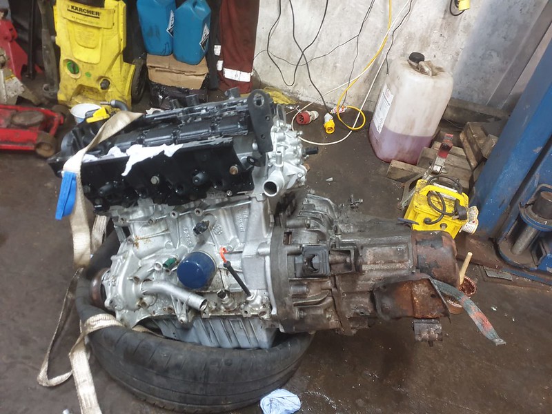

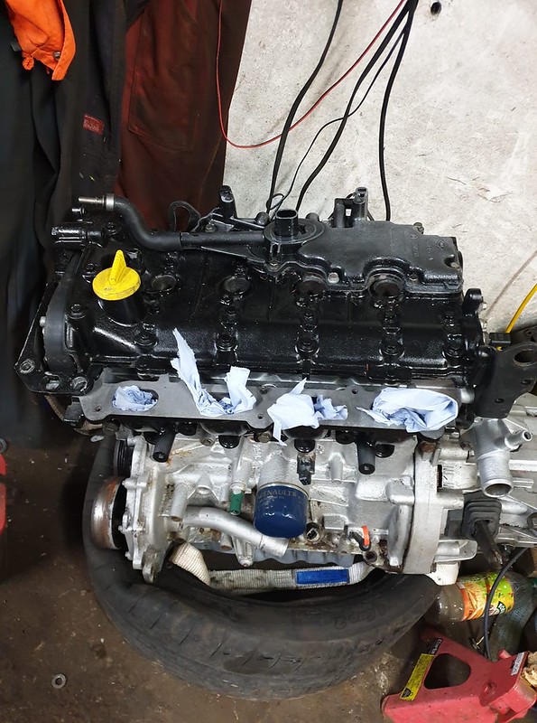

So my friend was selling a 197 cam'd ph1 engine with arp rod bolts. so I jumped on that.
along with cup alternator set up, also going to run Epas on this as my power steering pump was on the way out as well.
and last night i've ordered all the fluids any car would need, some nimbus heat shield for the bulkhead and a little hand held fire extinguisher.
also acquiring a ph1 airbox as ive ordered a pipercross filter for one.
the engine previously rolling roaded at 199.2bhp so im hoping anywhere close to that I will be happy.
I shall try my best to upload as I go along this time.

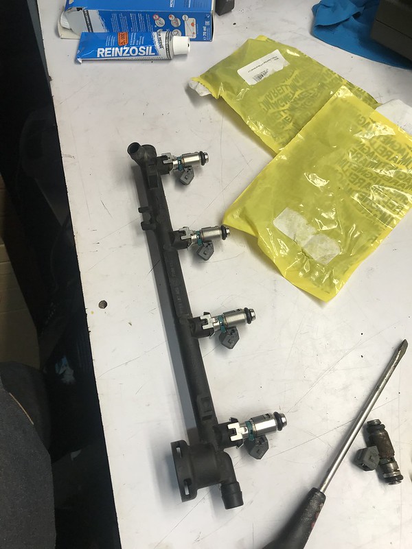

The Clio shall be getting picked up this weekend to get its new heart and some improvements, ive vowed to not buy anything else this month as the old credit card has been taking a beating.
Ordered all the fluids oils/gbox oil/ coolant / brake fluid and a new clutch cable and some washers from RPD.
Small hand held fire extinguisher and some nimbus heat shield from demon tweaks.
A ph1 pipercross filter from kam racing.
Won a Sparco steering wheel on bids on eBay and ordered some new hardware for it.
Hoping that we don't come across any nasty stuff along the way really as the bills seem to be mounting up.

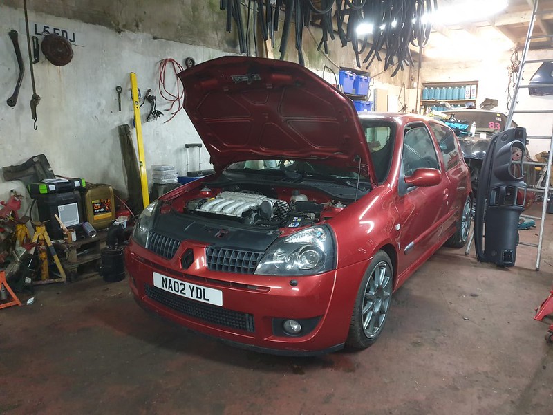

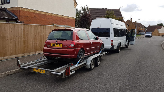

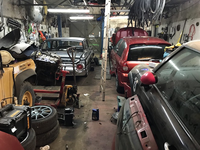

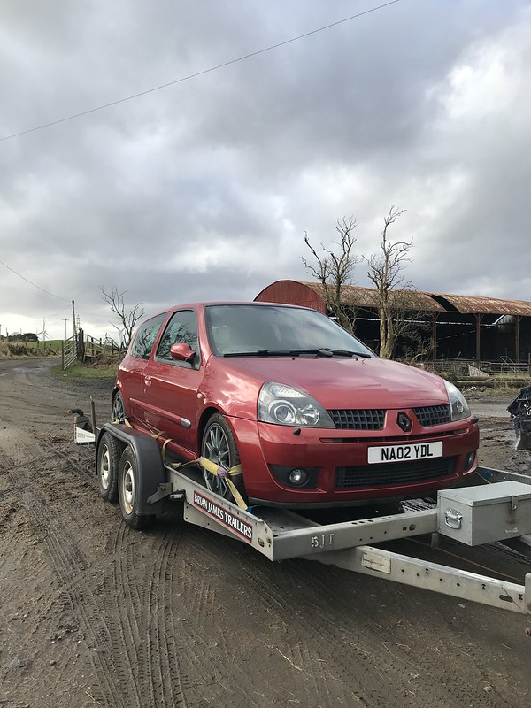

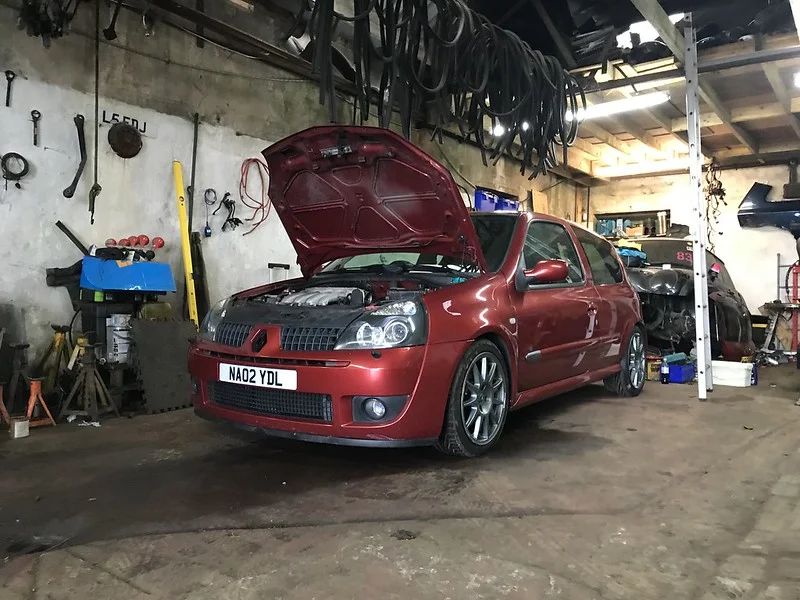

Packed up and off to Stu to get the new engine etc fitted.
Untitled by blair mccaffery, on Flickr

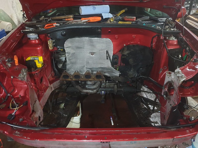

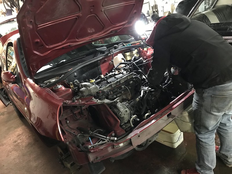

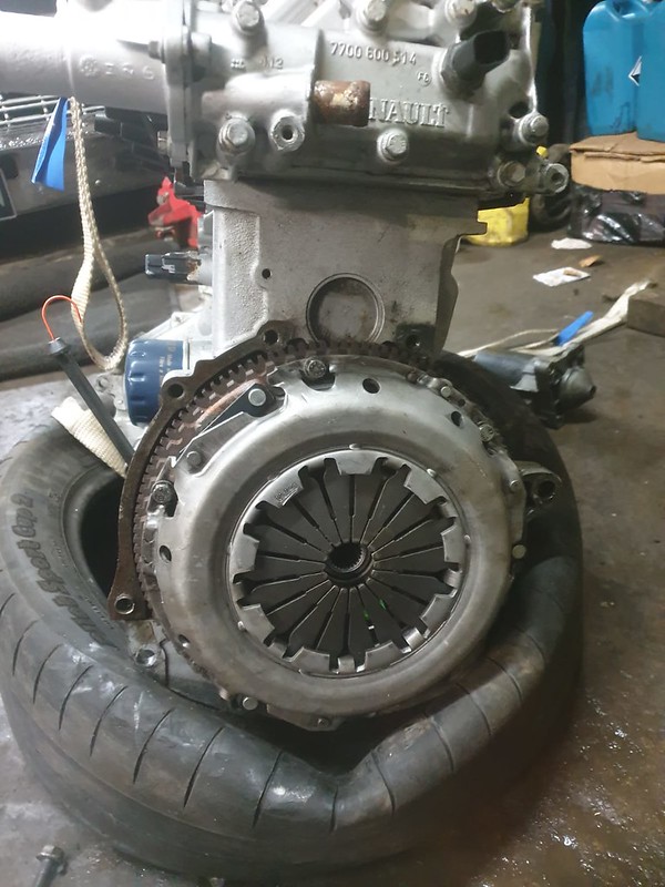

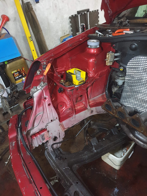

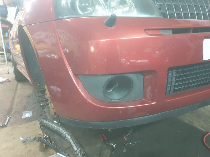

He got to work straight away, stripped the front end down and dropped the coolant.
Also compression tested the old engine, Cylinders 2/3/4 all sat at 160psi. Cylinder 1 was 60psi Oops
I guess it will be good for a coffee table.

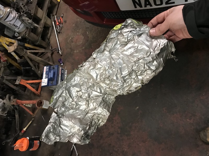

Thankfully bought that nimbus heat shield to replace this nonsense...
Big thanks to Stu for his patience.. car had been sat since last April so had a locked on calliper and the car just wanted to die every 2 second and run like a Subaru.
Hopefully have it off to get mapped in no time.

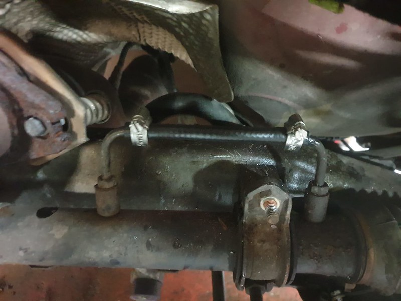

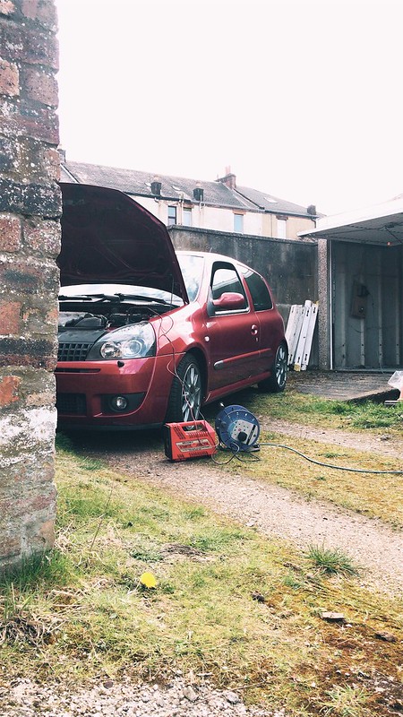

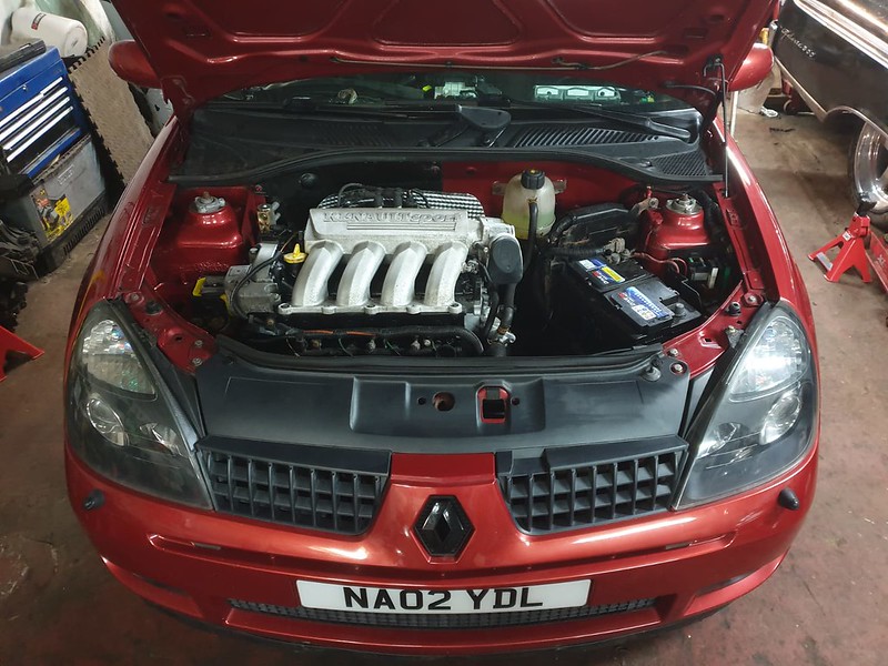

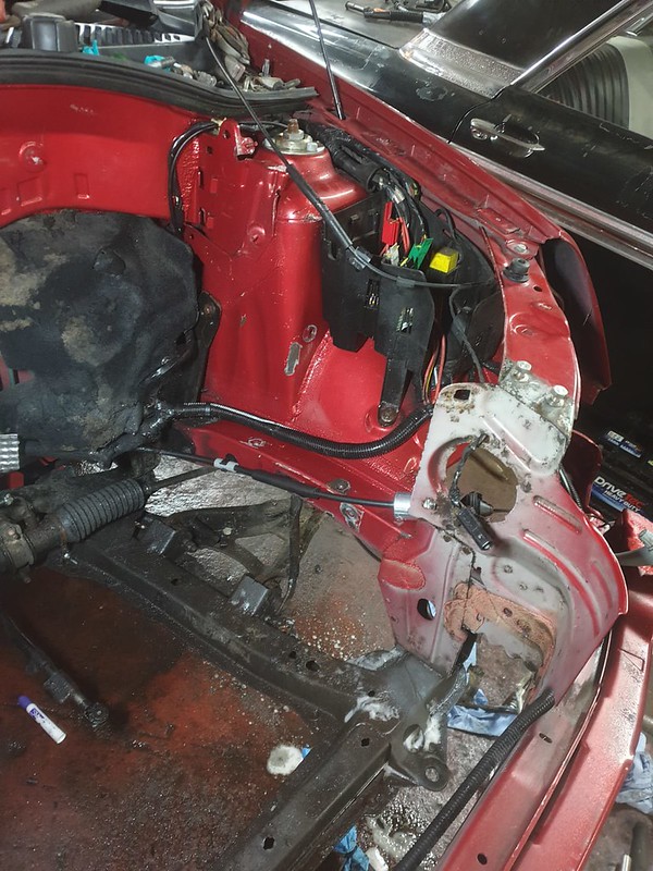

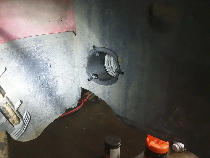

Stus cracked on again this evening and sent me some pictures over so I may as well update this.

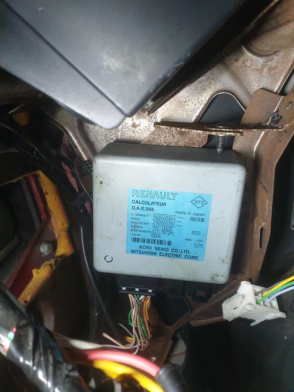

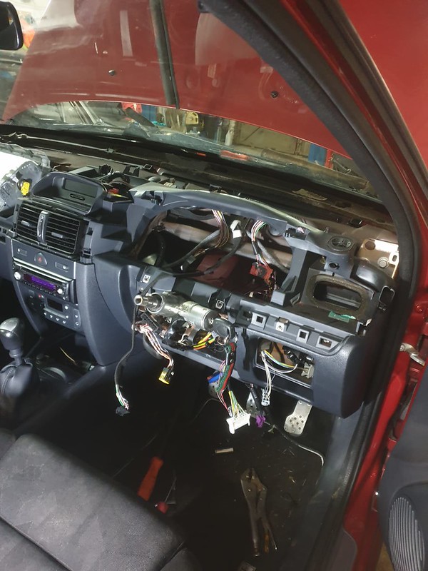

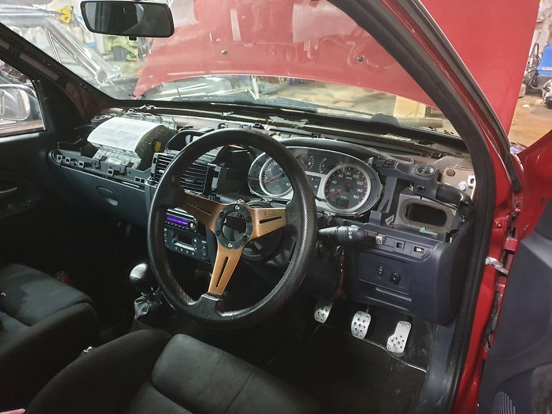

Epas Column fitted and the ECU mounted in the standard area, some wires connected up and earthed to oem point. Just waiting on the controller being delivered to wire the rest up.
Cut and looped the rack pipes and new clutch cable fitted.

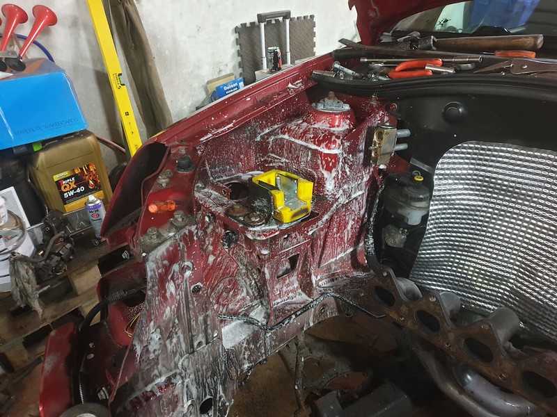

The absolute star also cleaned up the engine bay for me (now that's service) has also mocked up the heat shield and trimmed it to near enough the shape.

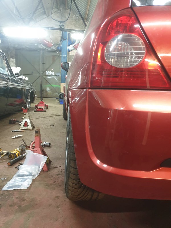

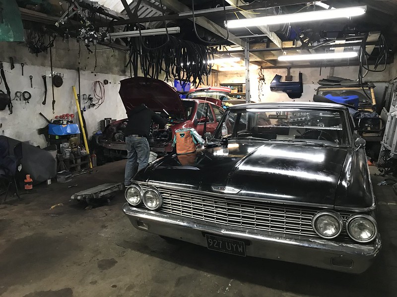

90% back together @Stu. hoping to get the car back running tonight but having some electrical problems. Im sure he will get to the bottom of things.

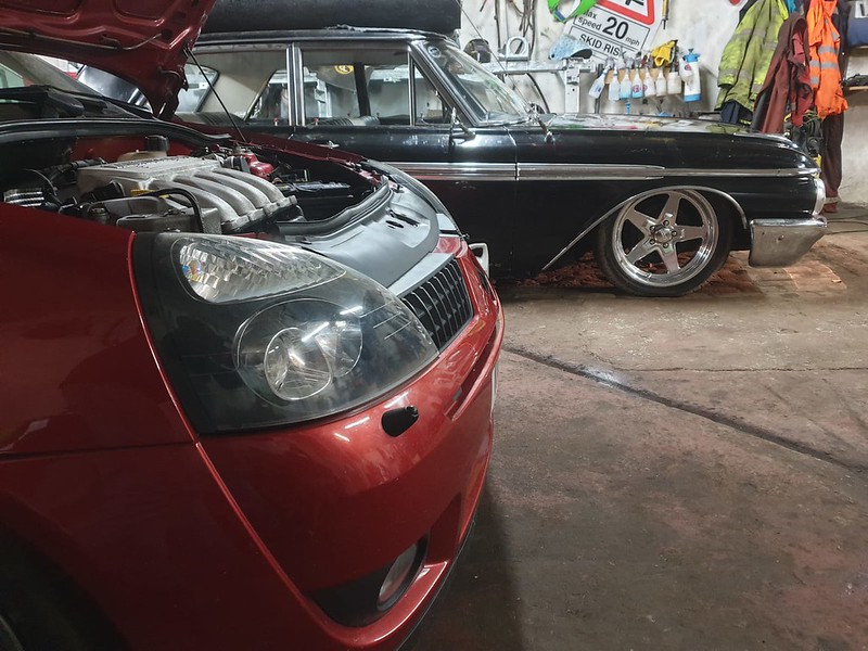

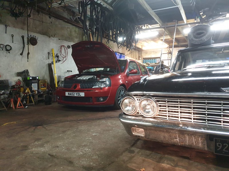

Heres some pics of her back on the ground and some size comparisons to Stu's 1962 Galaxie 500.
Also excuse the wheel its only in temporarily.
Both cars where lined up at boot level.

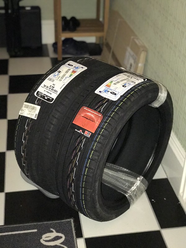

Someone posted up a discount code PAID20 for eBay and I used it to get a couple of Uniroyal RainSport 5s for a grand total of £87.70.
Needed a pair of tyres for the rear so I will swap the RS3s onto the rear and put the 5s on the front and see how we go.

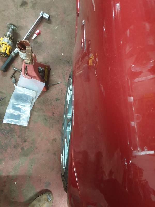

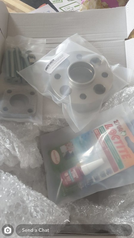

So the cars still over at @Stu. 's unit so I took the opportunity to order some more bits and bobs to keep my friend busy. (As I know he just loveeeeees working on clios ;))

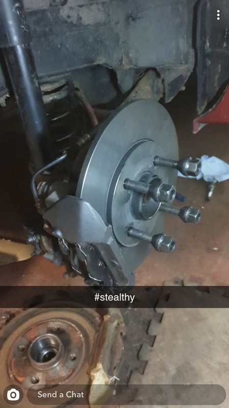

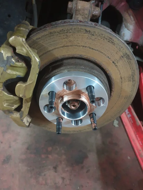

Ordered PMS Stud and nut kit 68mm rears and 75mm front
Also some front PMS 18mm hubcentric slip on spacers
Rear PMS 10mm Stub axel spacers
@George@RTR_Parts aslo sorted me out with some rear OEM discs and Brembo pads. Very quickly may I add top bloke.
Ordered up some new plates from Pro plates front plate is the shorter type 520x90

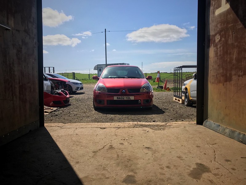

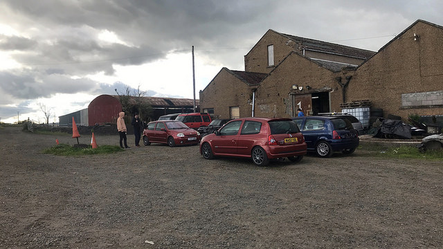

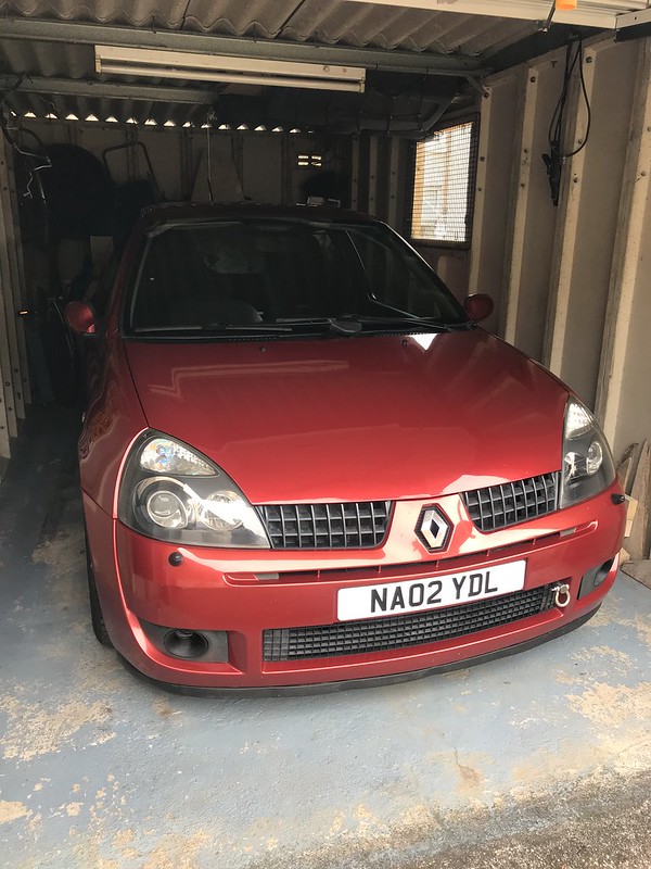

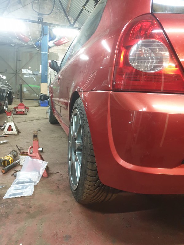

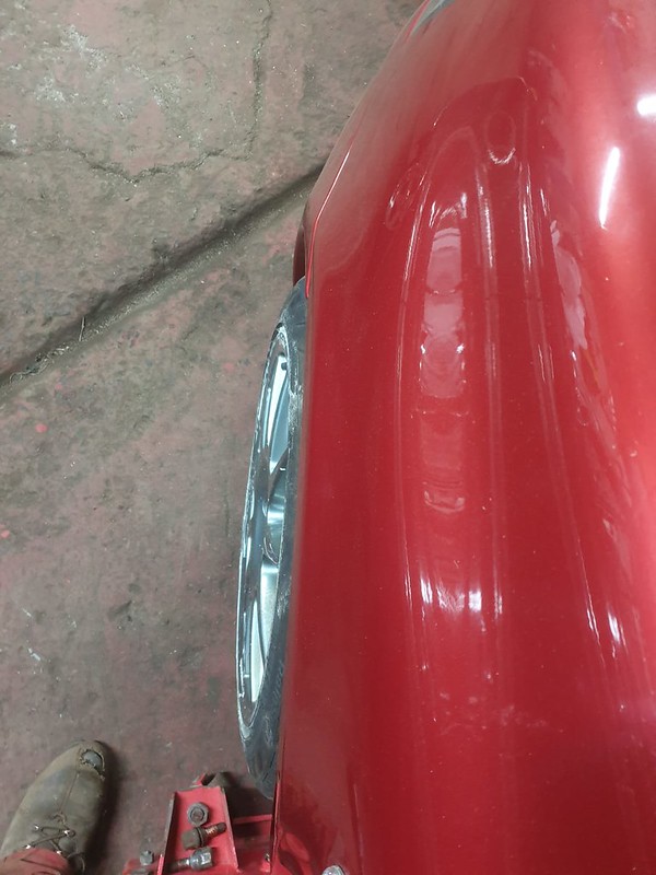

First pictures of her sitting pretty moved out of the unit. Absolutely bursting to get it back now once it's safe to do so.
Looking great if I don't say so myself!

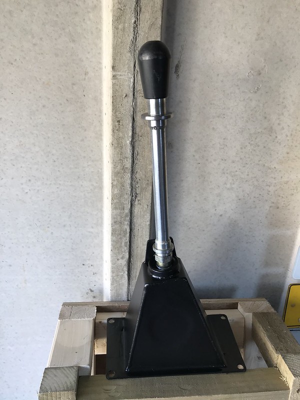

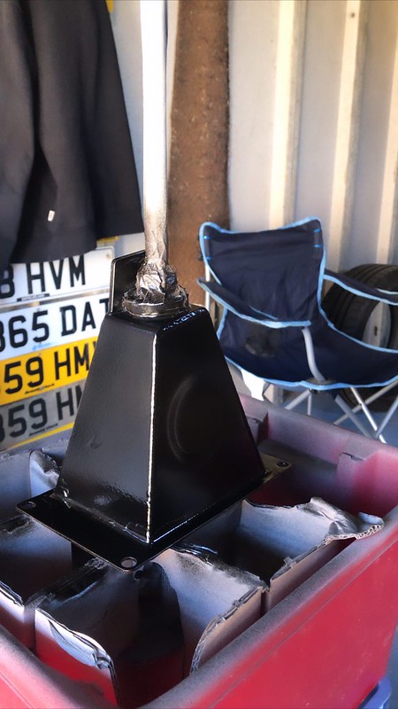

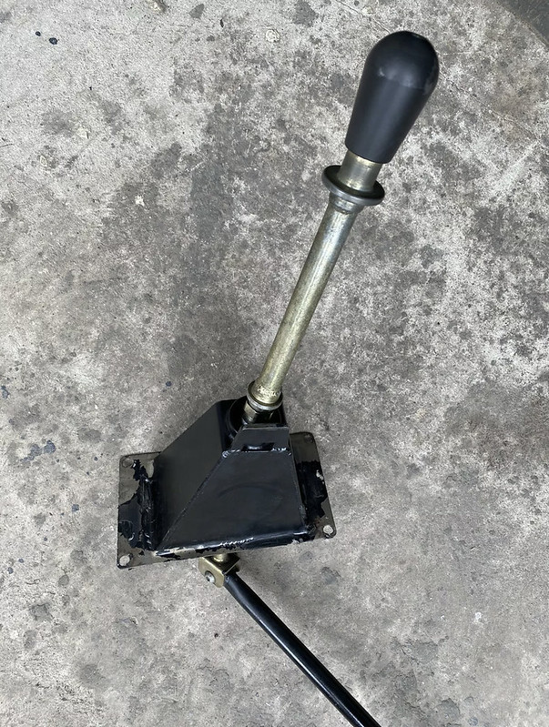

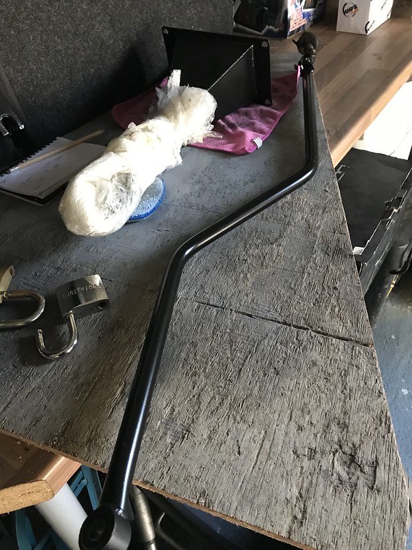

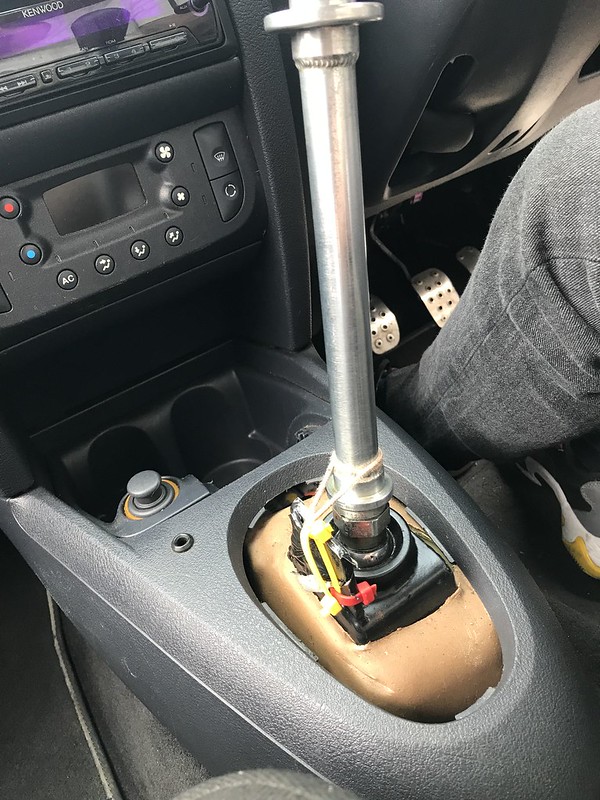

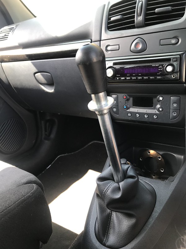

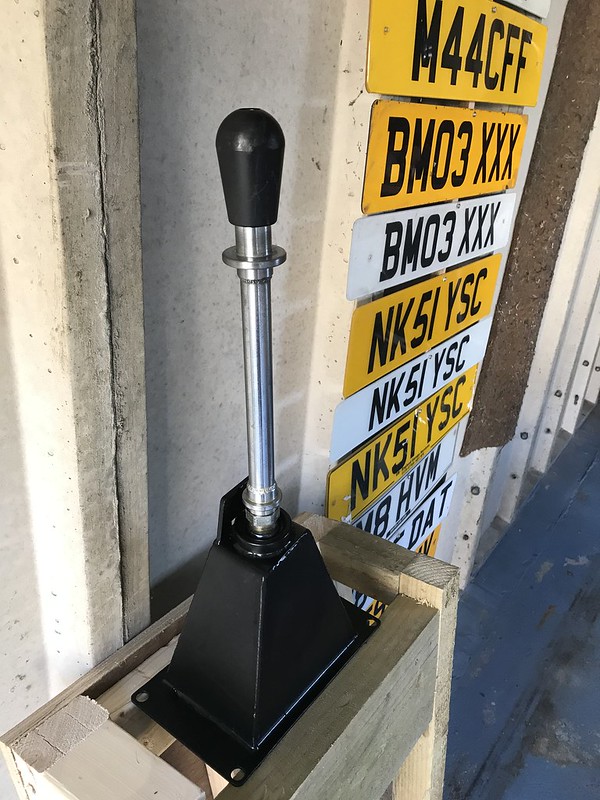

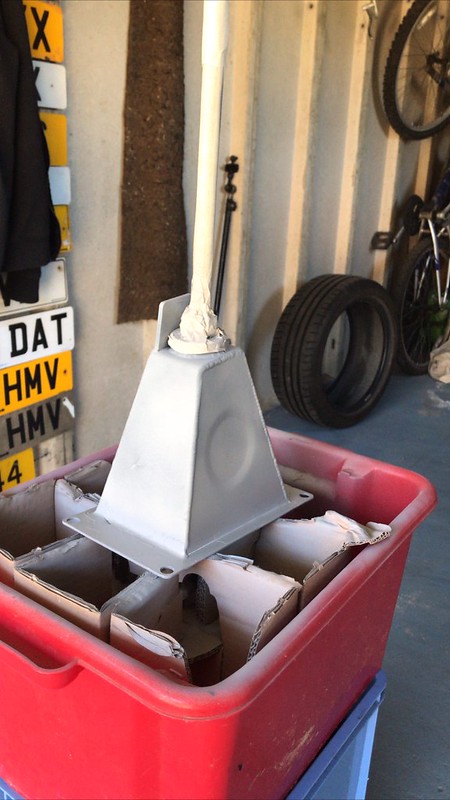

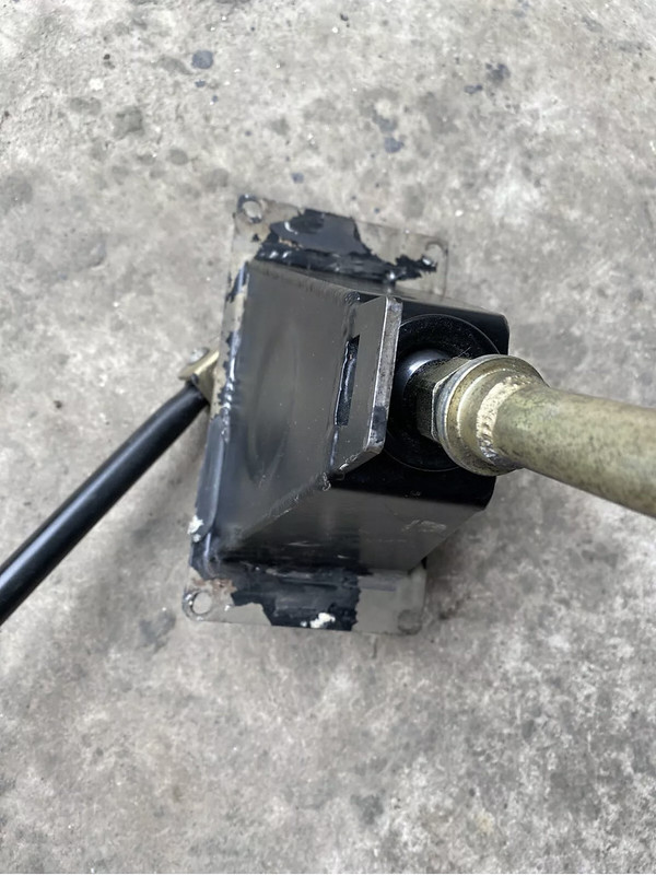

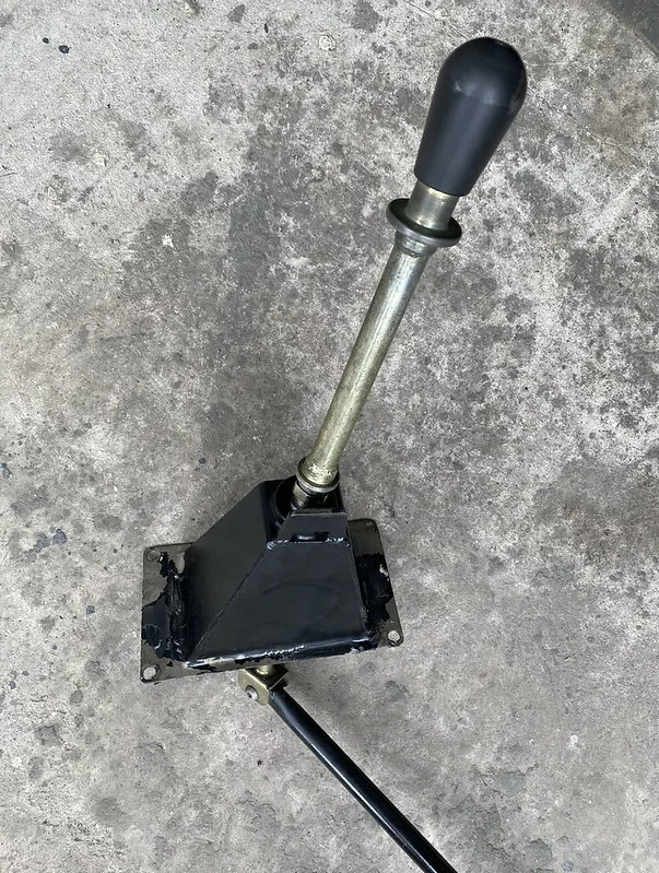

PMS shifter came in the mail, as ive had an abundance of free time I set about doing a mini restoration on it.
I will note the paint job isn't the best however it will keep it protected. On a plus I will be keeping all the interior in and the gear gator.
some before pictures:

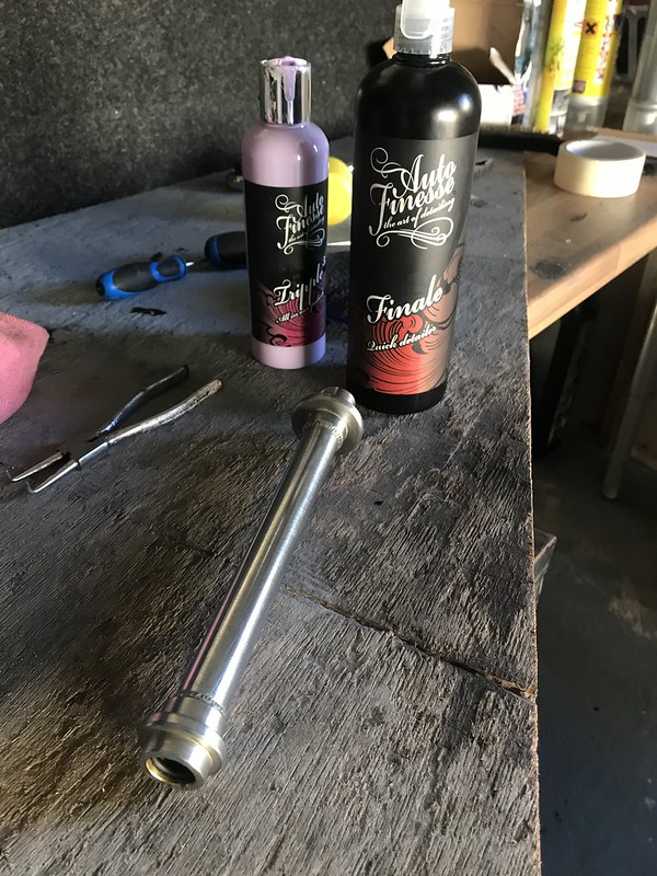

Set about polishing my the shaft. Used a mixture of sand paper, wire wool. polish and just some detailer to clean the residue up.
Rubbed down the rough stuff on the base, due to lack of vice and 24mm spanner I struggled for a while and gave up trying to take it fully apart. so ended up just masking it all up.
All re-assembled:
Ive ordered new bearings, bushes and hardware for it as well so that will all be changed at the time it goes back into the car.

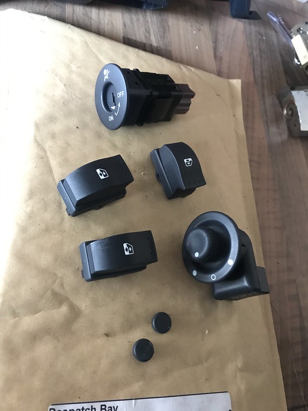

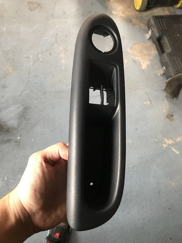

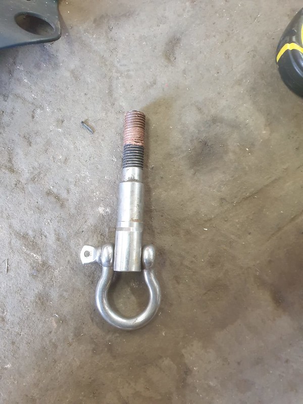

My friend was also breaking another 172 so scooped up a couple bits that I fancied.
Tow eye:

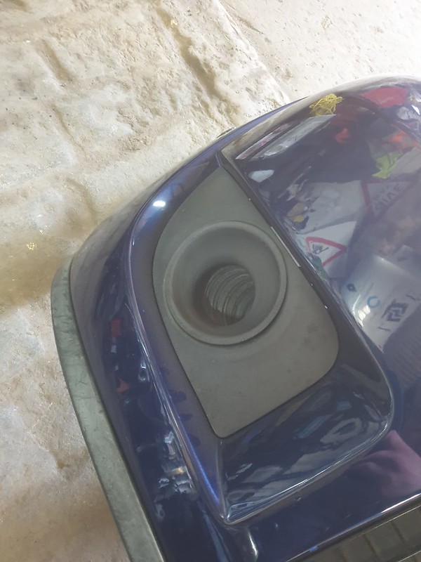

Fog light brake ducts:

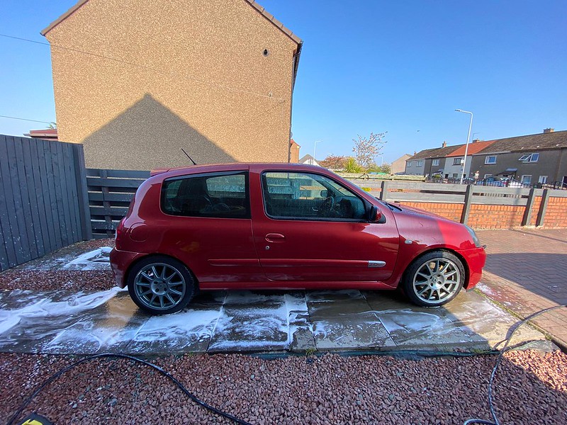

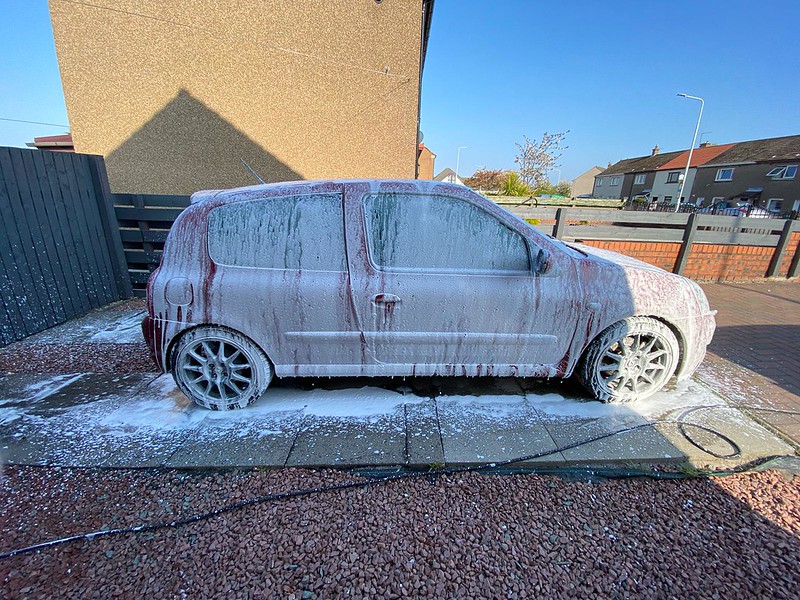

Cars being kept in good hands as my mates Mrs gave it a clean yesterday:

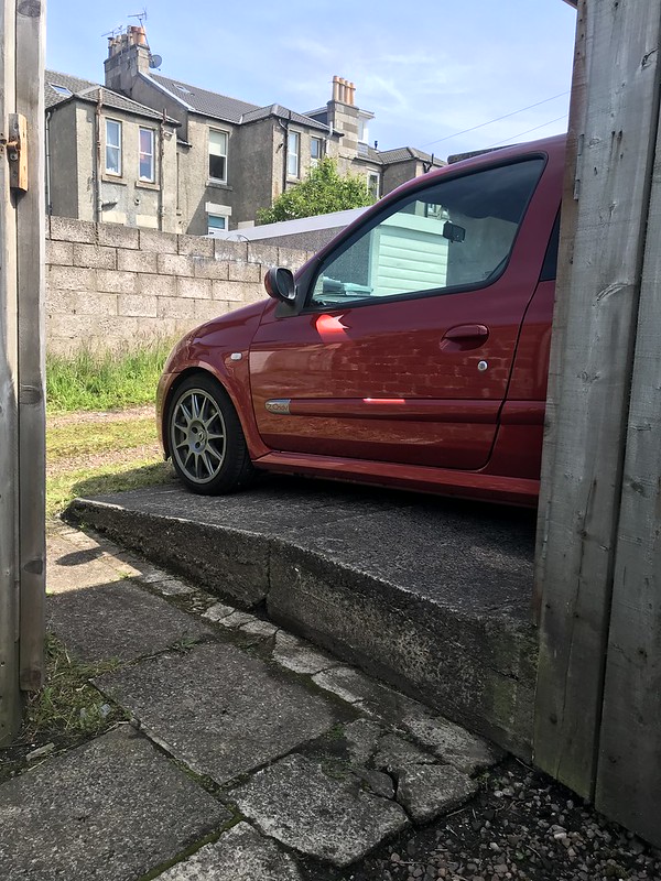

Getting close to a point where I will be able to plan some trips with this now, few final bits done just some injector/misfire issues and we should be rocking.
Fog light brake ducts are on.

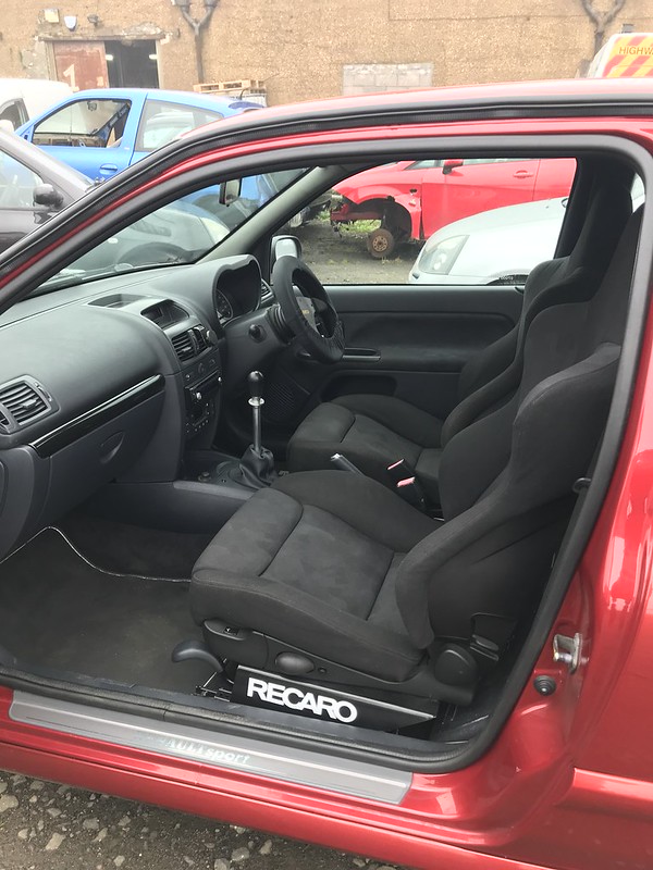

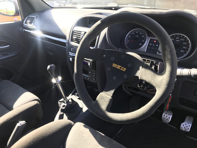

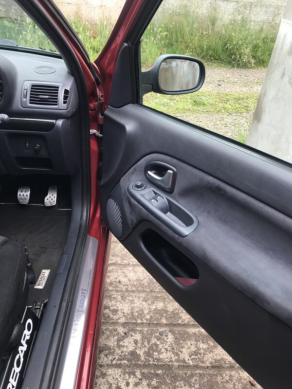

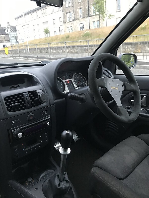

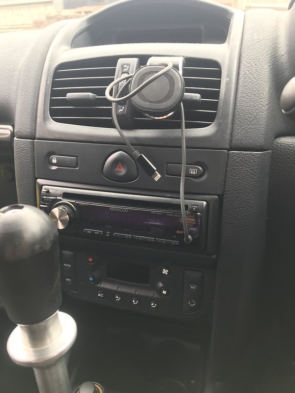

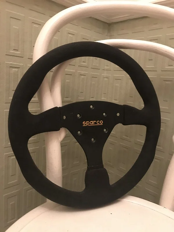

PMS shifter fitted, new to me Sparco wheel is in. Have discovered the seats have an added mount that should once removed drop them about 25mm so happy about that.

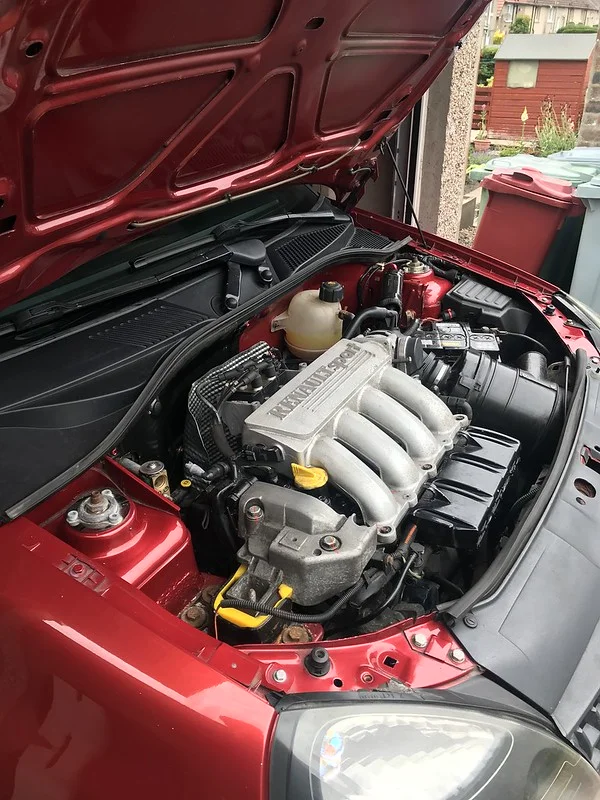

Engine bay isn't the prettiest but she's mostly back together:

Still having intermittent misfire, have swapped out an injector however was a non genuine one, Stu is going to run it for a while check if our misfire comes back. Bar a set of new injectors im hopefully not going to spend much more on it this side of the year and try and enjoy some time on the road.
Getting very close now to my ideal road car spec, Drives great on the road not too harsh, minimal rattles, pms doesn't rattle too much either. Sounds absolutely fantastic when pressing on with the yozza and Ktec sports cat. However im going to need to get a new silenced centre section welded up pronto for the motorway and longer drives out as it just drones away, that's next on the list.
Wheels badly need a refurb and im dreading taking the skirts off to check the cills, however I think im going to hold off until winter until I go down that rabbit hole.

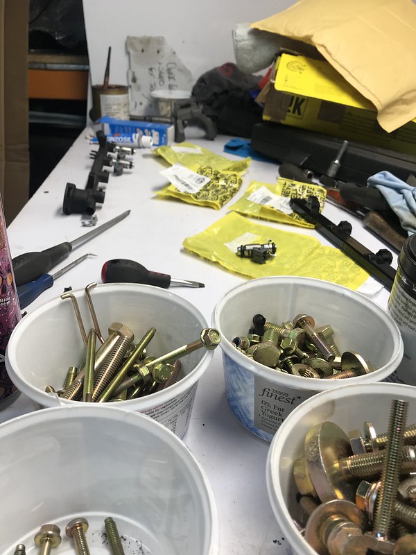

Fired in 4 new injectors from Renparts, seems to have sorted the intermittent misfire.

Heres just some random out and about pictures:
The start of the little anal things now to tidy it up, took the rear belts out the middle one always annoys me seeing it swing about. good couple of KG out of the rear.
Checked down at the inner cills, thankfully no nasty surprises. I will give this the rust treatment come September time once the cars back off the road again for winter.

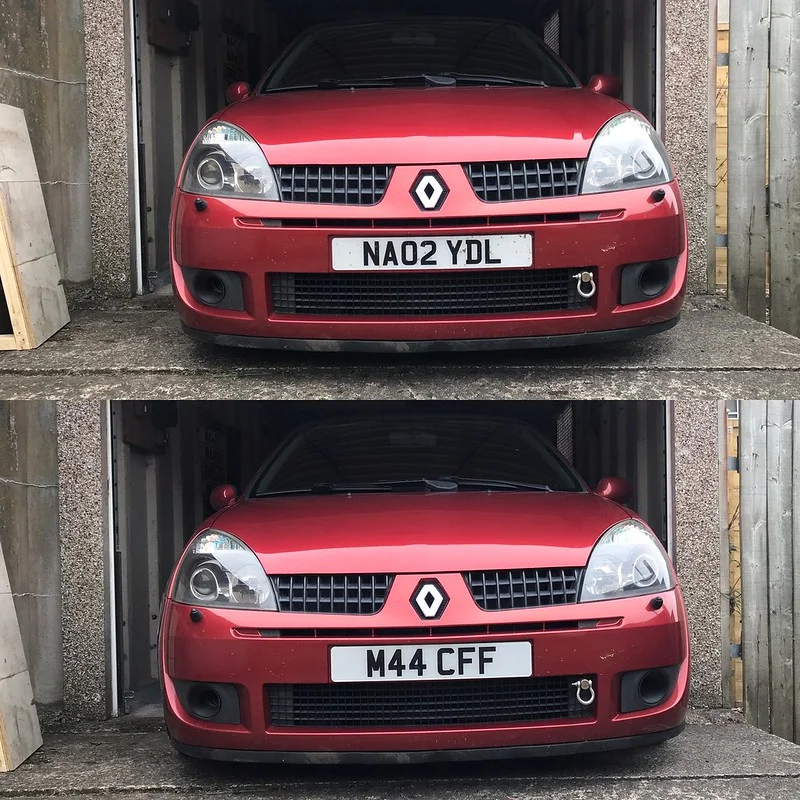

Tried my private plates on, still undecided if I'm going to run them or not.

Quick wipe down polished the tip and back in the garage for another day.

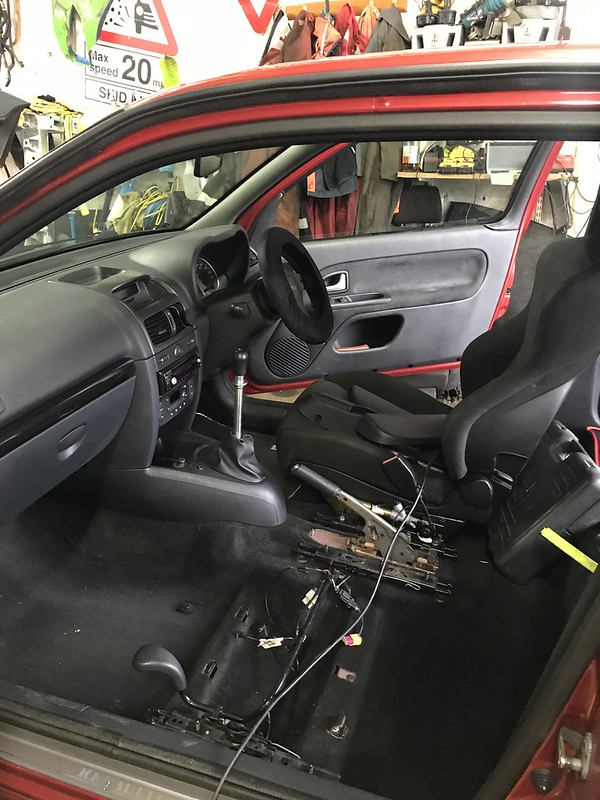

Got the seats out and lowered today and all the carpets hoovered out.
Biggest gripe with the car since day 1 has been the fact you basically sit on top of the Clio with these seats, sussed out there was a bracket that raised these about 25mm that was not needed, think whoever ordered these for another car it came with the bracket for a pretensioner or something along those lines.
Seats out:
Can sort of tell the different of height difference between drivers (lowered) and the high passenger seat:

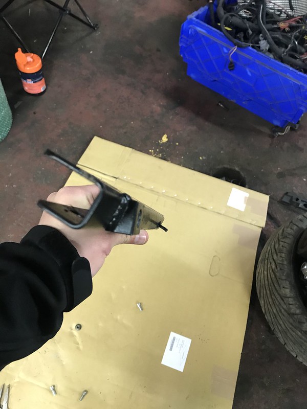

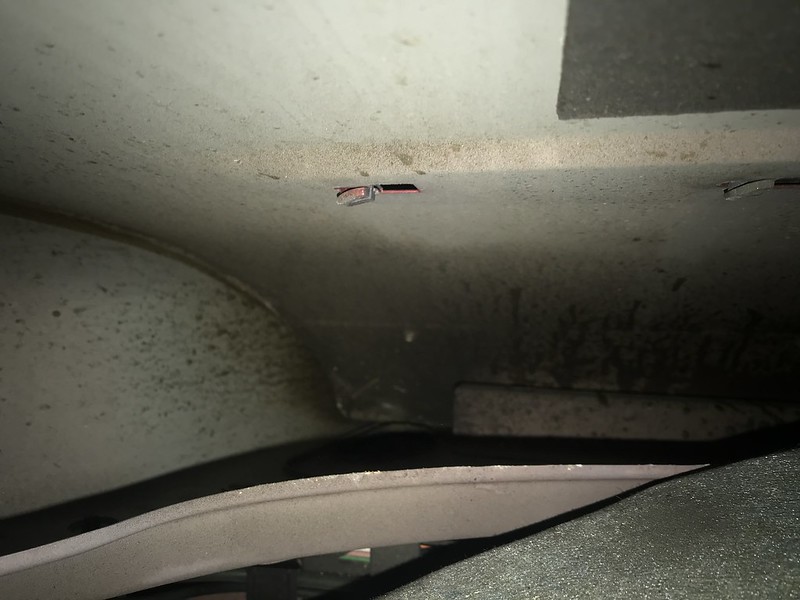

The offending bracket:

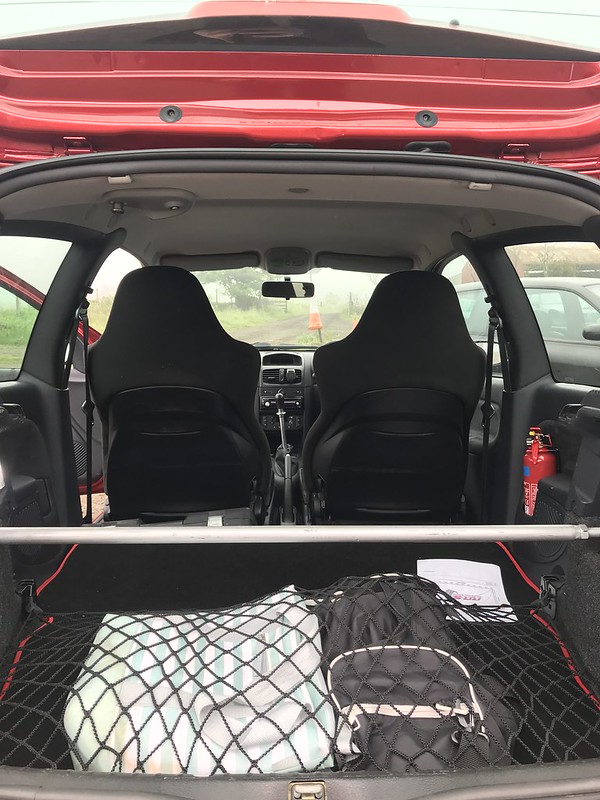

All back in and sorted, also acquired a nice bootnet to keep the garbage in the rear from rolling around:
Seating position is now vastly improved! I no longer need to splash on new seats :D
The seat and steering combo looks perfect 👌 And much better lower, I remember first taking out the bungs in the oem seats which helped loads, now on buckets..

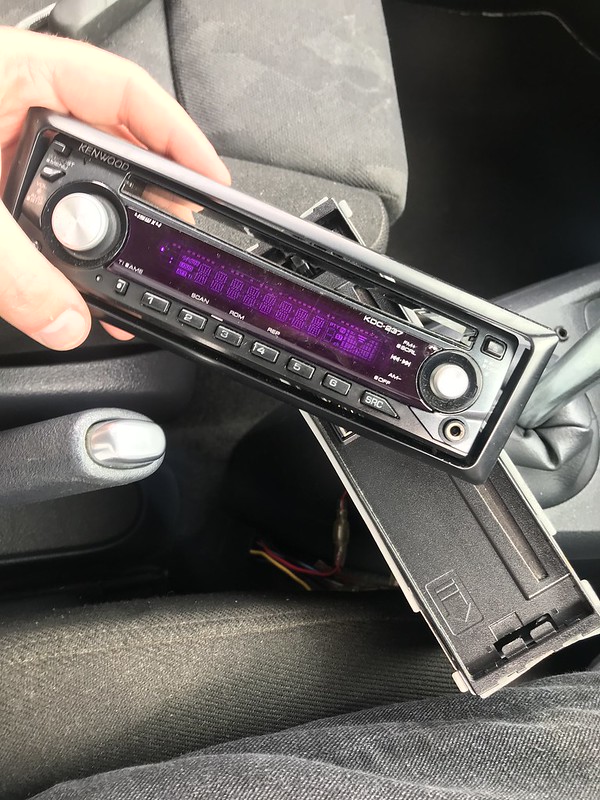

Aux function packed in somehow on my head unit, had a spare one laying in the garage from a previous car. Had forgotten what unit it was I had so was pleasantly surprised when I took it out the box and was almost identical.
Out with the old:
In with the "new":
Made an attempt to negate the rattle of the shifter when cruising in 5th. A bobble 4 cable ties and some tape.. yet to try it out however i'm not optimistic:
Next up was the Recaros.

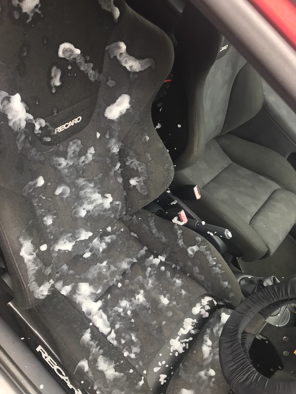

Been avoiding giving them a scrub for a while. I would still like to get a wet vac on to them but just not had an opportunity to do that yet. However they have been vastly improved with some foamy fabric cleaner.
Before:
During:
After:
Gave the car a very quick wash and tucked It back in the garage.
Now on the hunt for a method of getting a pressure washer that I can either run off a battery and bucket as i'm too far from the house to run a hose and power out here. Feel free to throw me some suggestions.
I noticed the fridge engineers at work using one of these to blow out the condensers on the fridge packs, I'm not sure how powerful it is for a car but it looked reasonably powerful when I seen them using it! they had it hooked up to one of those big water bottles (maby 25litre?!) that has a pump on the top to pressurise it but it says it will draw from a bucket etc
WORX WG625E 18V (20V MAX) Cordless Hydroshot Portable Pressure Cleaner
That does look handy, Thank you. Realistically the cars never extremely dirty so I don't think I'm going to need an extremely powerful washer. Once I've had it detailed I can just do maintenance wash with something like that.
