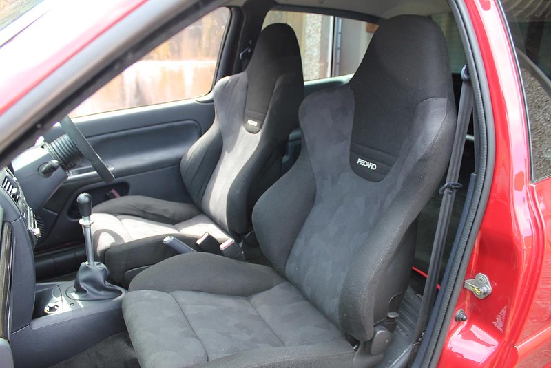

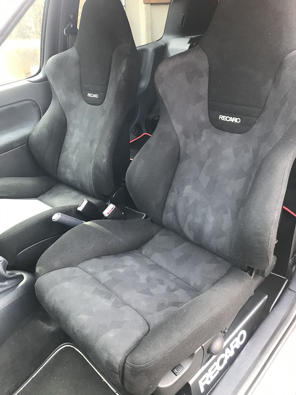

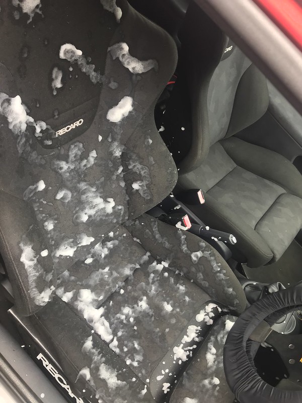

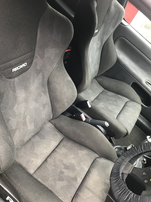

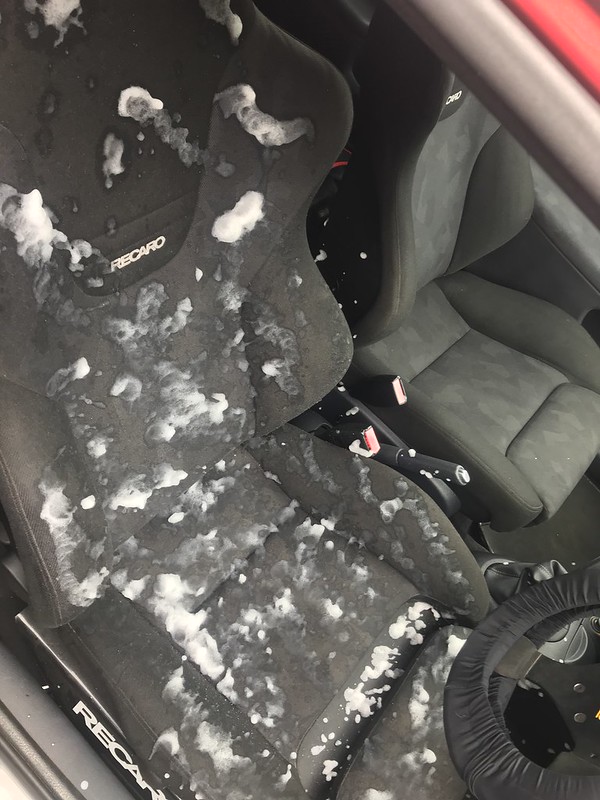

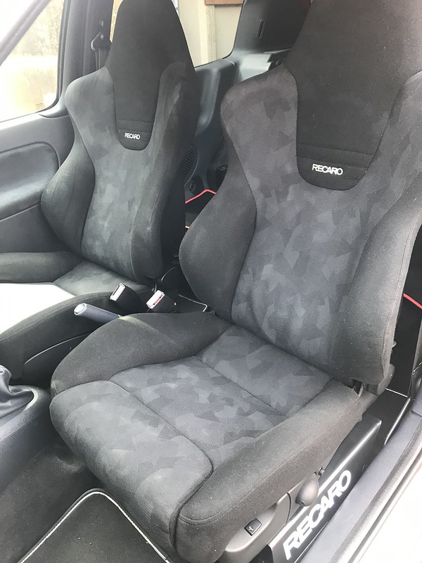

Next up was the Recaros.
Been avoiding giving them a scrub for a while. I would still like to get a wet vac on to them but just not had an opportunity to do that yet. However they have been vastly improved with some foamy fabric cleaner.
Before:
View attachment 1480860Untitled by blair mccaffery, on Flickr
During:
View attachment 1480861Untitled by blair mccaffery, on Flickr
After:
View attachment 1480862Untitled by blair mccaffery, on Flickr
Gave the car a very quick wash and tucked It back in the garage.

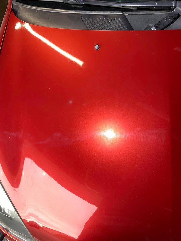

Haha both look nice from afar, bonnet has a little spot of rust so I'm on the constant look out for a mint flame red one, bumper also needs a bit of paint!

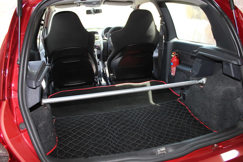

Love the seats, what are they out of? Do the tilt forward?
Cheers man, Yeah they tilt forward. They would have been a special order from Recaro. Done some research on them the other night someone paid and eye watering amount for them at some point then they ended up in a Clio.

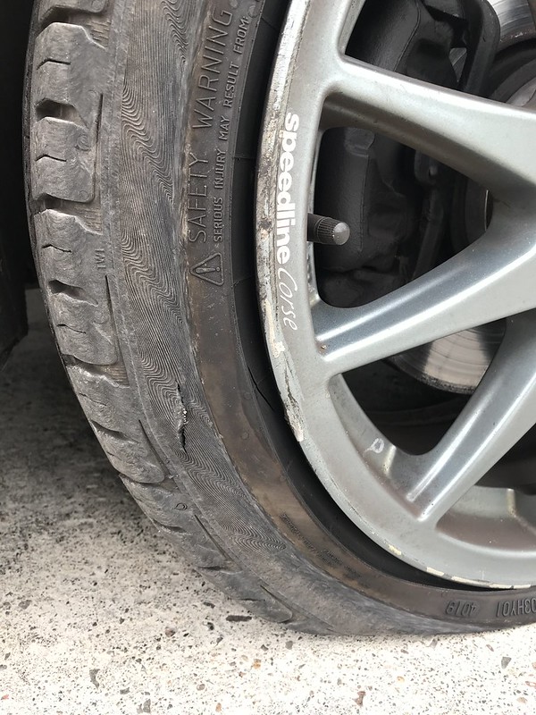

Had popped a tyre while out on a trip over some country roads.
some pictures from the trip and tyre:

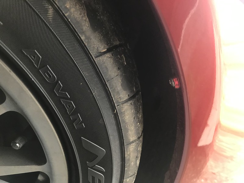

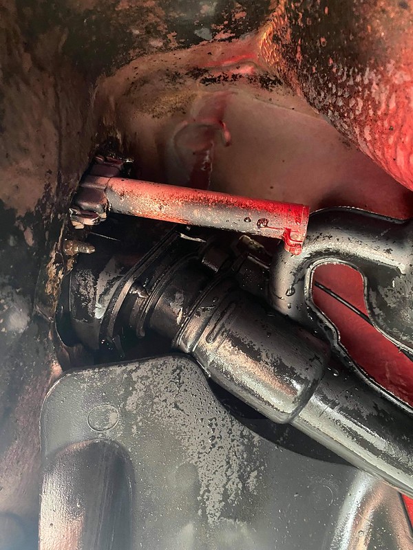

So dropped off a ledge and hit a pothole, ripped a hole in the tyre. Thankfully had a spare with me:
Ive ordered a new Rainsport 5 from Camskills today, pretty sickening as the last one had barely done 500 miles.

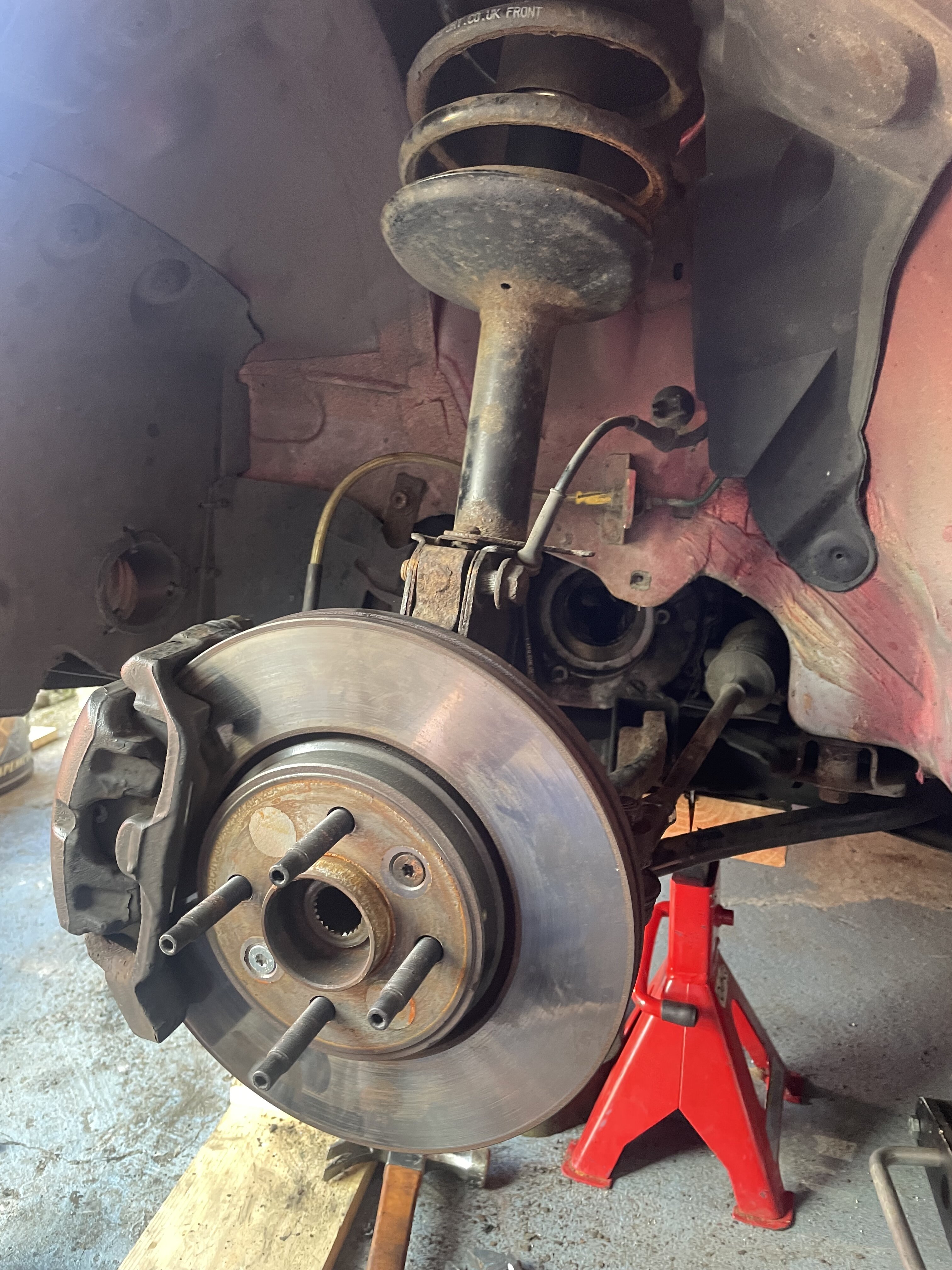

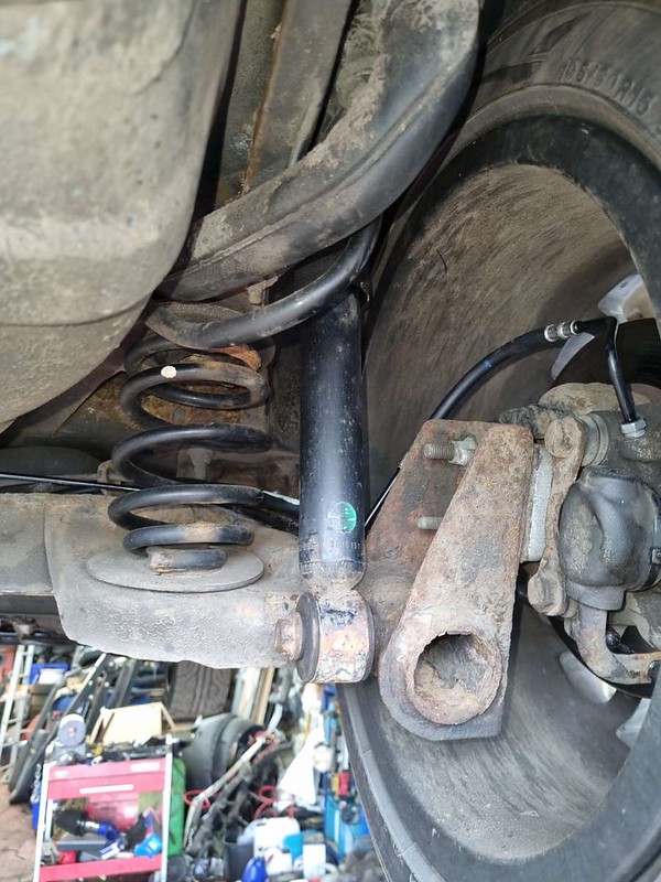

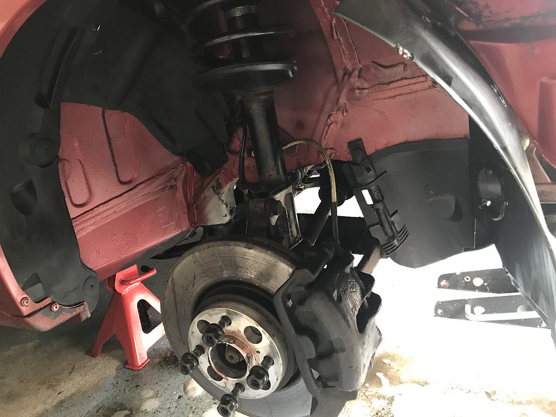

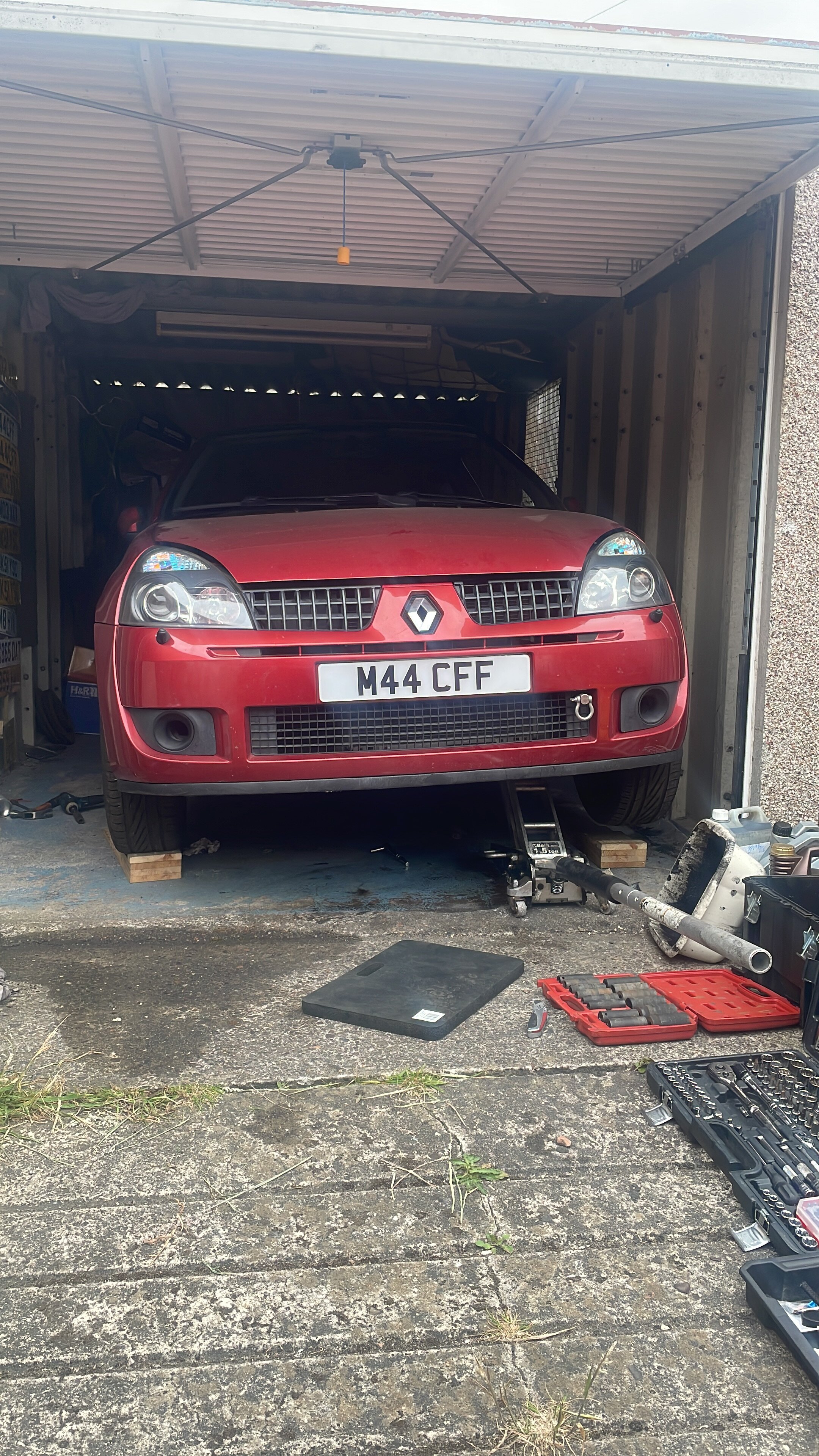

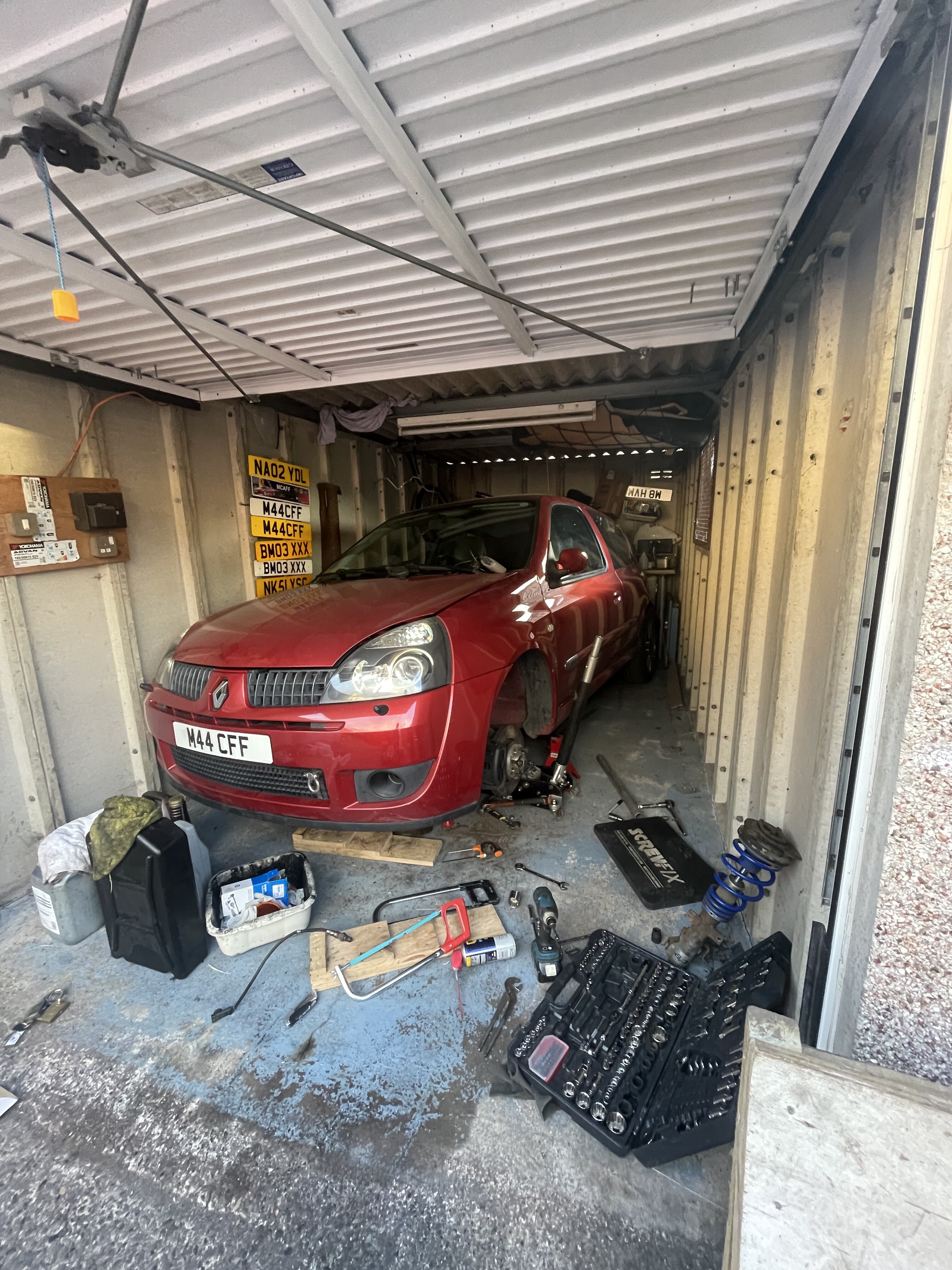

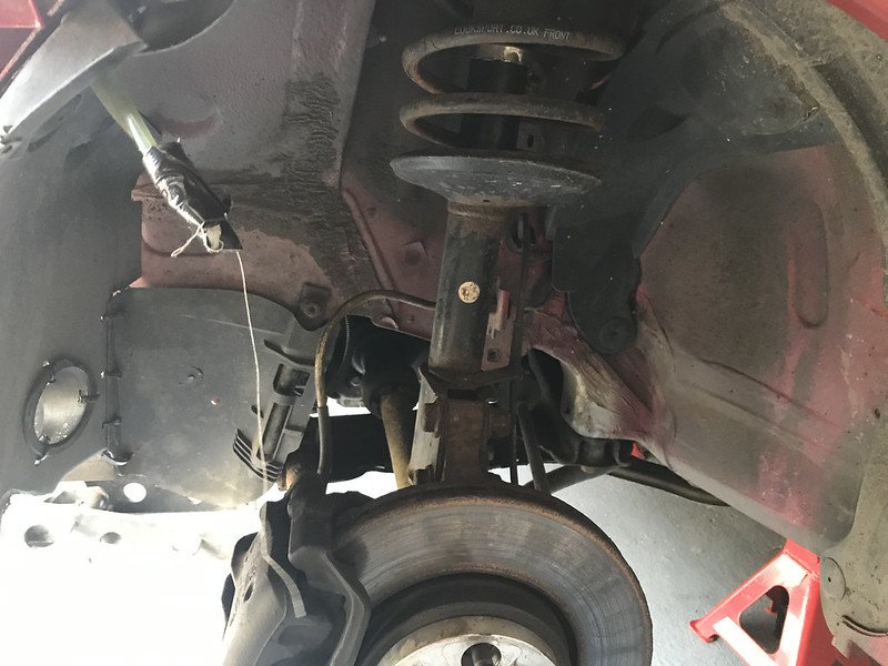

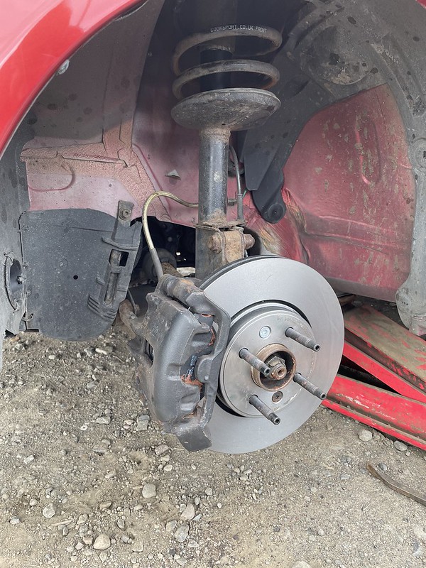

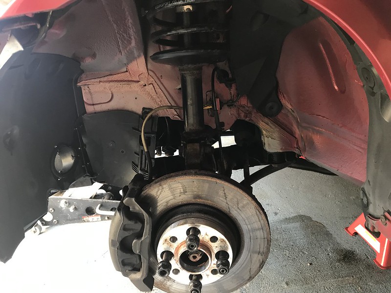

Both front wheels need balanced so was best just to get the car up in the garage and do a few jobs while the wheels where off.
With limited space in the garage bumper off and jacked up off the subframe up on stands, and set about cleaning out under the arches:

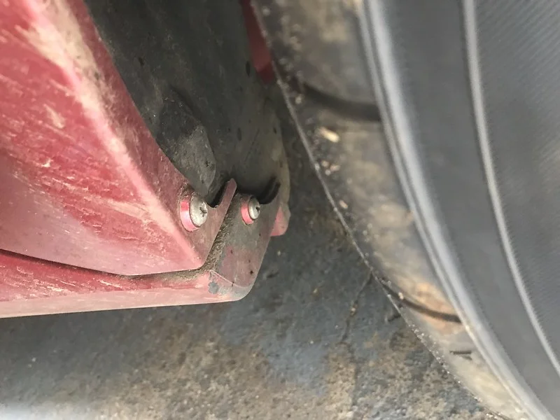

My Fabia splitter has seen better days as has the condition of the front bumper. However re mounted the splitter again to square it up as it was seriously on the piss.

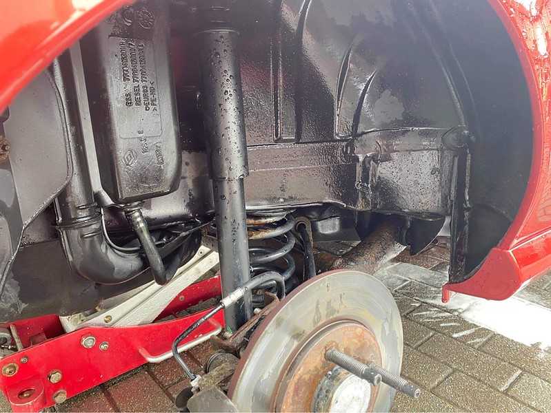

Having had some chats with Stu about what's next on the list, I plan on getting it off the road again around September/October time.
Would like to drop the rear beam, subframe and wishbones etc and have everything powder coated along with the wheels refurbed as they again have seen better days.
While everything is off id like to under seal everything and address any rust spots.

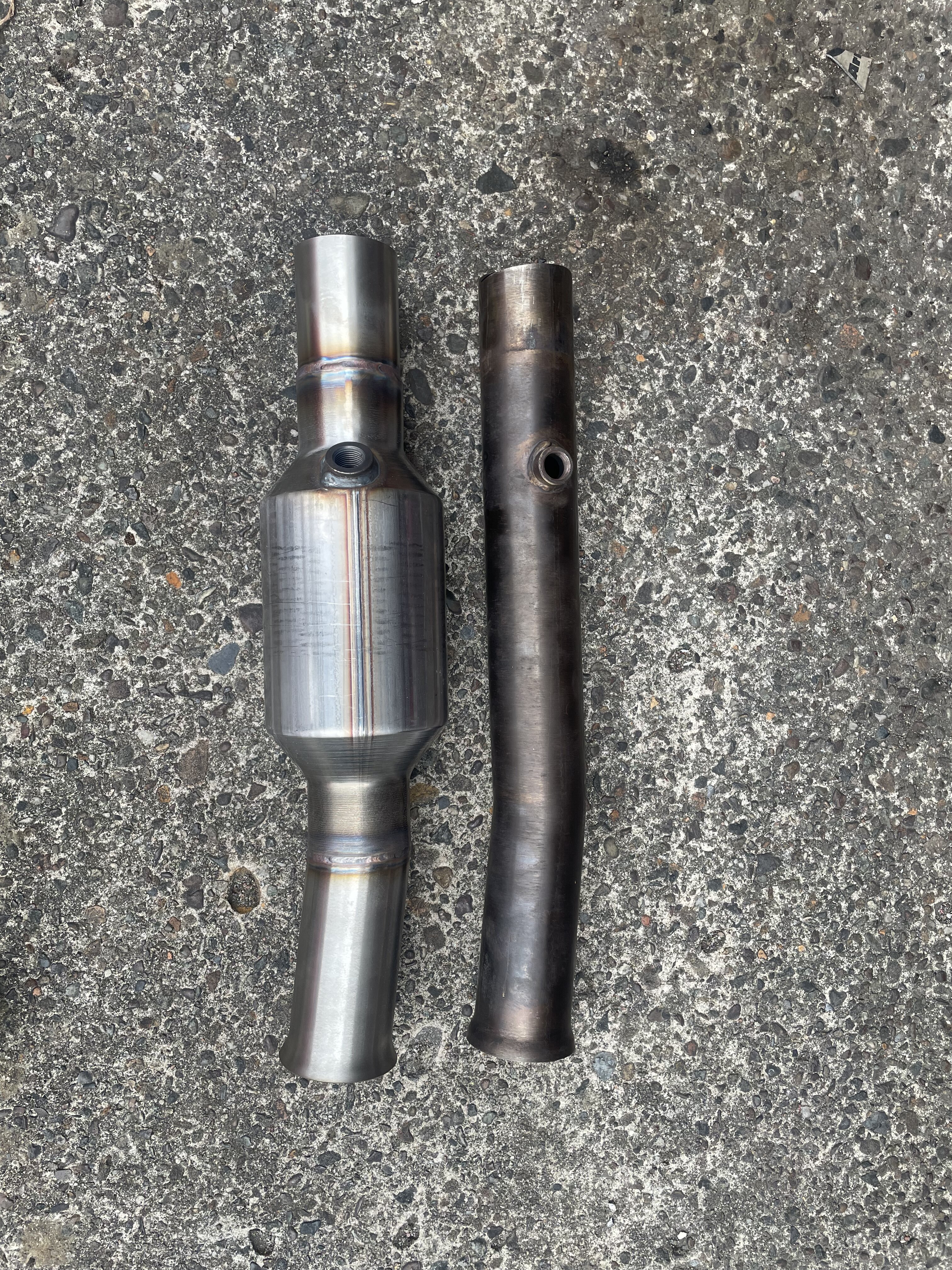

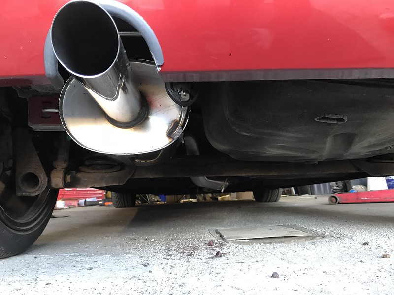

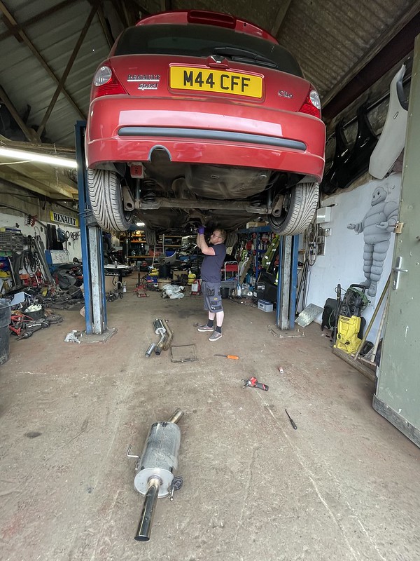

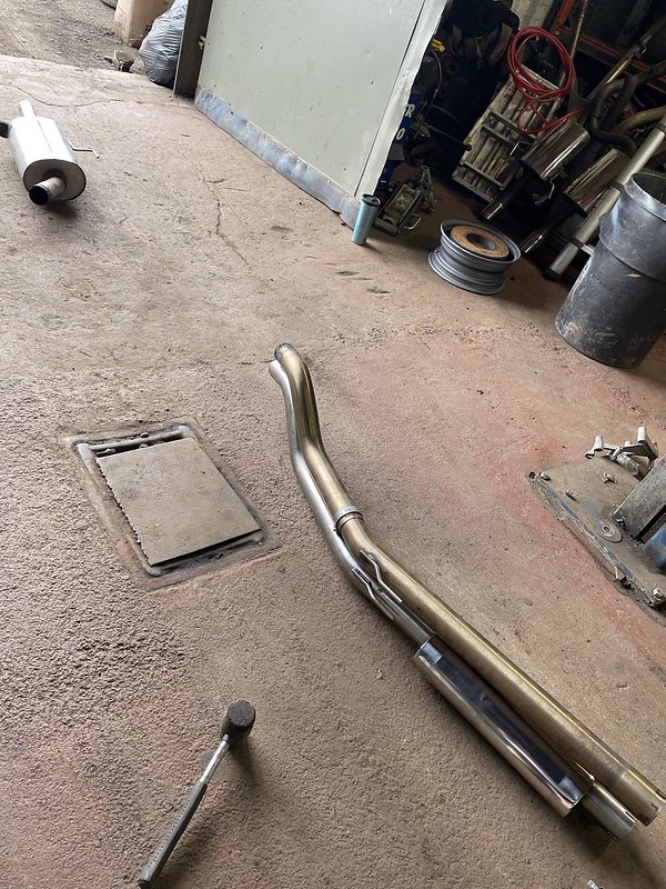

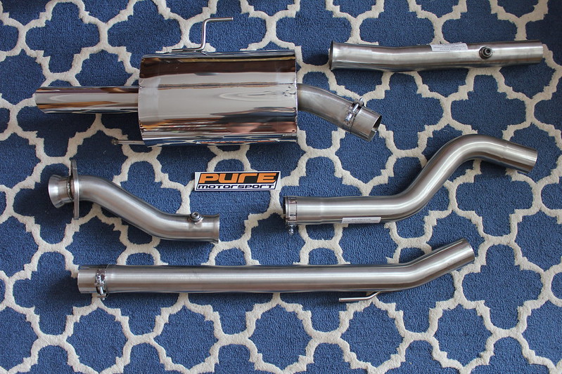

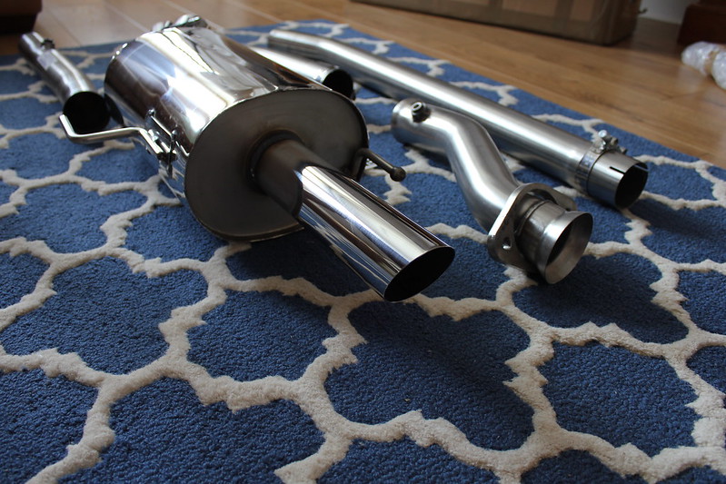

Bit the bullet and got myself a pms system, it still baffles me how this is going to be quieter than the yozza with a sports cat and a mid res.
Went for the tried and tested decat and no mid silencer.. I'm hoping for quieter at low speed and just as loud when giving it some beans. Time will tell if this does the trick, I can always order different parts of the exhaust later if this doesn't quite suit my needs.
Should have this on next week some time, so if anyone is after a Yozza + a Ktec sports cat I should have it off and polished up shortly. Feel free to shoot me a message to discuss a price, I will more than likely have an ad up for it as soon as its off.
Mcaff

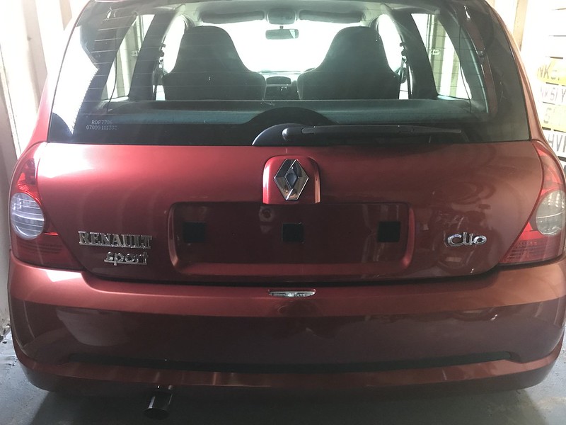

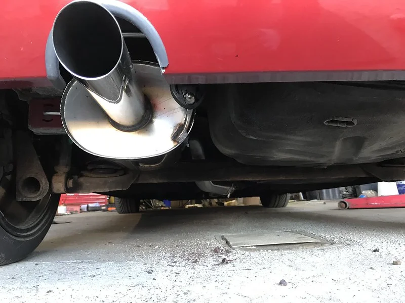

Got the PMS exhaust on over the weekend, first impressions are very good. Really happy with how it sits in the bumper in comparison to the yozza, also much prefer the motorsport inspired slash cut tip. was never a fan of how the yozza sat under the bumper and inward rolled. Need to find an intact 182 exhaust surround that's not going to cost the earth. Not a big fan of the whole carbon fibre thing that pms sell.
Got the car out yesterday for a decent run, on first start up of the car I was worried it was roughly the same noise wise as the yozza, however after listening more the pms has eliminated the drone that we had before.
In comparison on actually driving the thing its much more civilised, you can travel at normal speeds and it will be fairly quiet with a slight hint of rumble. Where the yozza would verge on impossible to not make your presence known.
Motorway driving with the yozza id travel at 60 mph and you couldn't hear yourself think with the drone. Pms I can travel at 70mph and it is not very intrusive, im not saying it is silent at the end of the day its still a Clio with a straight through exhaust with a back box however it is very surprising how quiet it is.
Giving the car some throttle, honestly nothing in my eyes beats the sound of a Clio at full chat with a yozza, the drone disappears and just sings. Pms is definitely quieter now and replaces the deep tone of the yozza with a lovely rasp.
All in all I'm over the moon with the PMS exhaust its ticking every box for me that I wanted out of a system for the Clio, I was very wary before buying a system with only a back box to silence it, I didn't quite understand how it would be as quiet as it is. Another pro for the pms is now I have lost the 200 cell sports cat and a centre silencer it has lost a very slight amount of weight. Has transformed the car for me and made it much more enjoyable to drive.

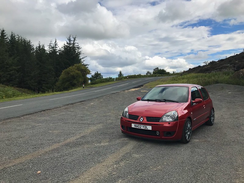

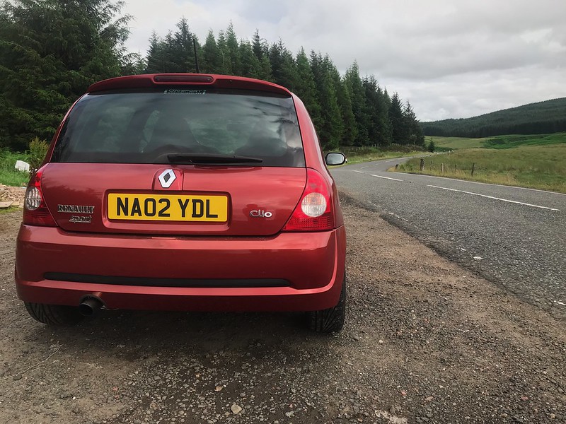

Heres some pictures from my run out yesterday:

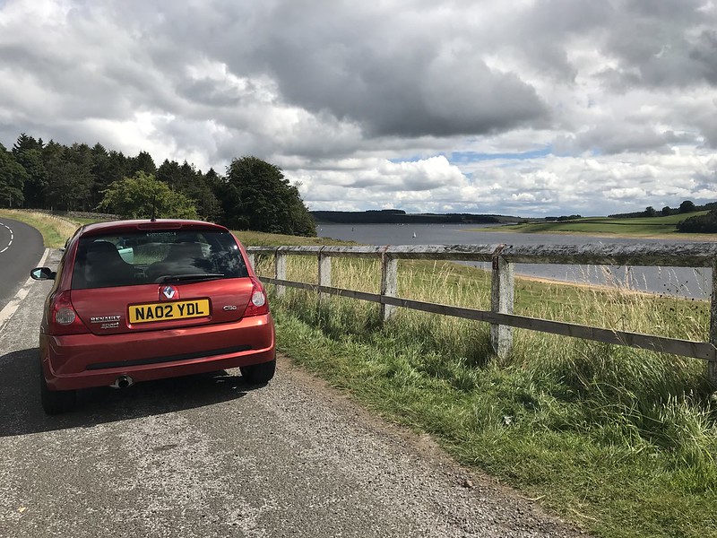

Some pictures around Derwent Reservoir:

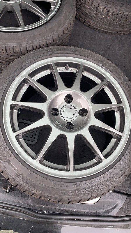

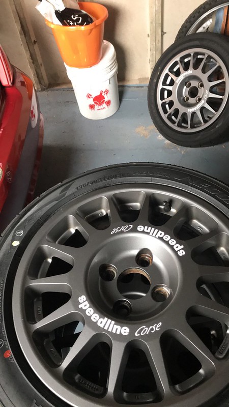

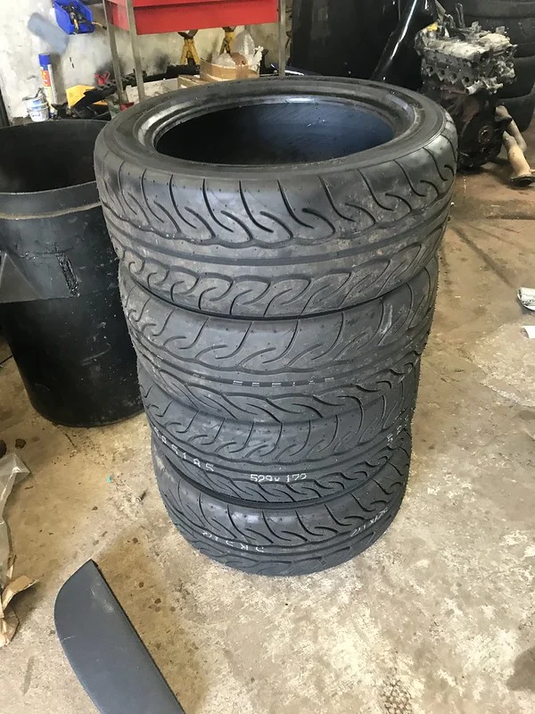

So back home now ive picked up some AD08 RS, cleaned and degreased the wheels and applied new decals. unfortunately made a balls up of one sticker so goes along with the perfectly imperfect characteristics of the Clio.
Sitting a bit high at the front as it was just off the jack, looking forward to getting some snaps at the weekend.
I will still be keeping the Turinis however ive wanted a set of 2118 since back in 2008 when I had my first Clio , its been a long time coming.
Turinis have also needed a refurb since long before ive owned the car.

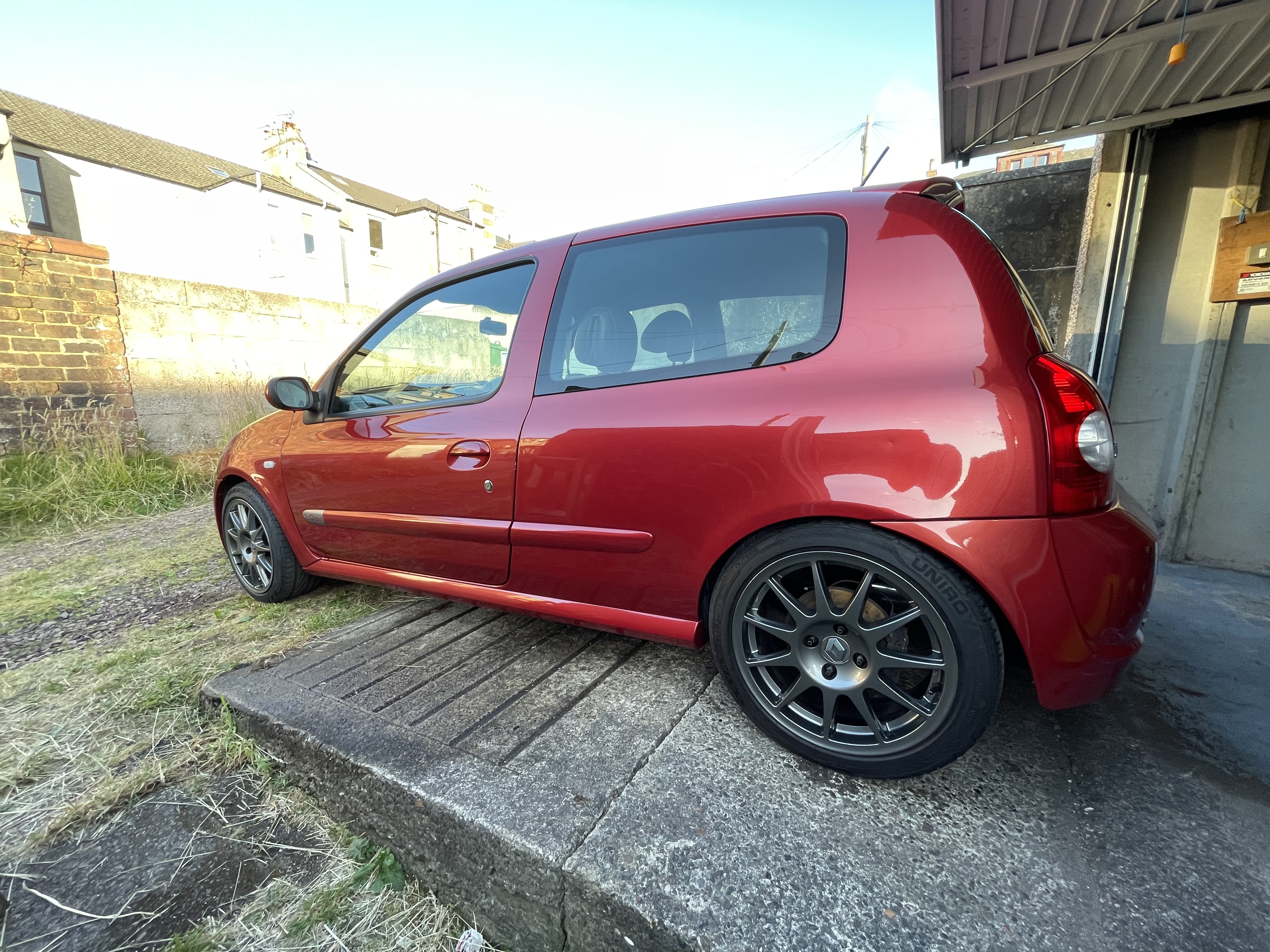

Love the look on the 2118s has really grown on me now the suspension has settled.

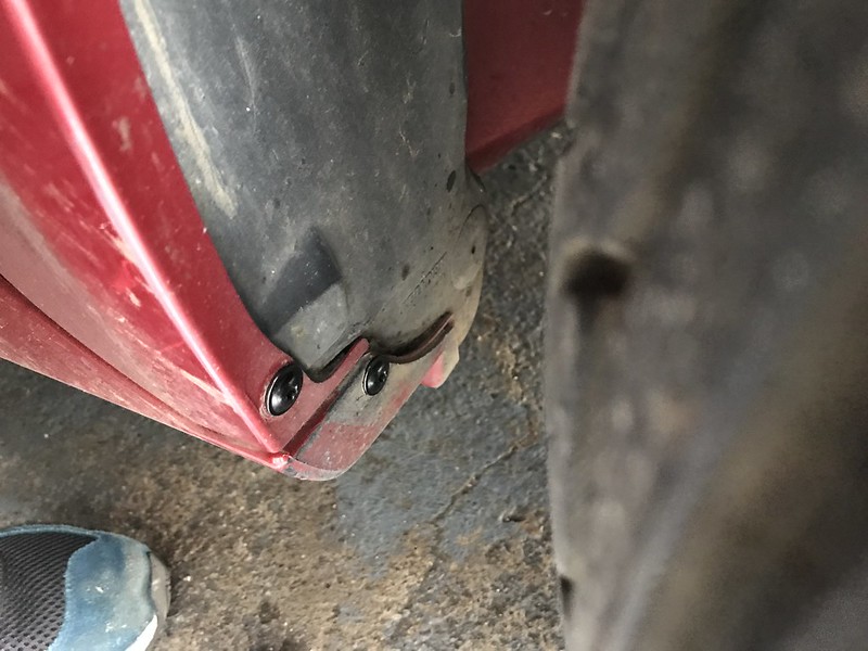

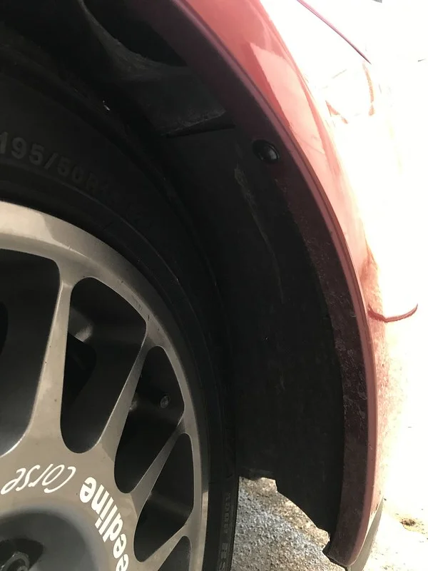

Getting back to the little odds and ends to tidy the Clio up I had ordered a few things mixture of eBay and RPD.
First up was something that's annoyed me since the day I got the Clio 2 years ago, getting rid of the little anodised screws/washer that someone had used to hold the arch liners on.
Please excuse the dust and dirt not had a chance to give it a good scrub after last weekends outing:

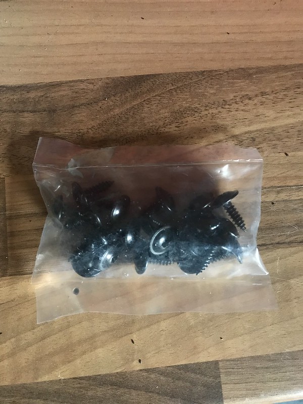

Bought these in black from eBay: https://www.ebay.co.uk/itm/20-x-VW-...e=STRK:MEBIDX:IT&_trksid=p2057872.m2749.l2649
I had done both sides however I'm sure you get the idea. Much better anyway.

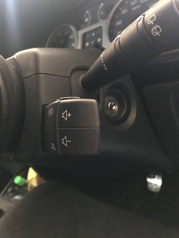

Next up is something that bothered me however didn't even know this part existed until I either saw someone on here or instagram that had changed theirs out, the radio stalk controls that don't work when you have an aftermarket head unit. Renault still sell a blank for the cowl totally ideal! Ordered from Renault Parts direct.

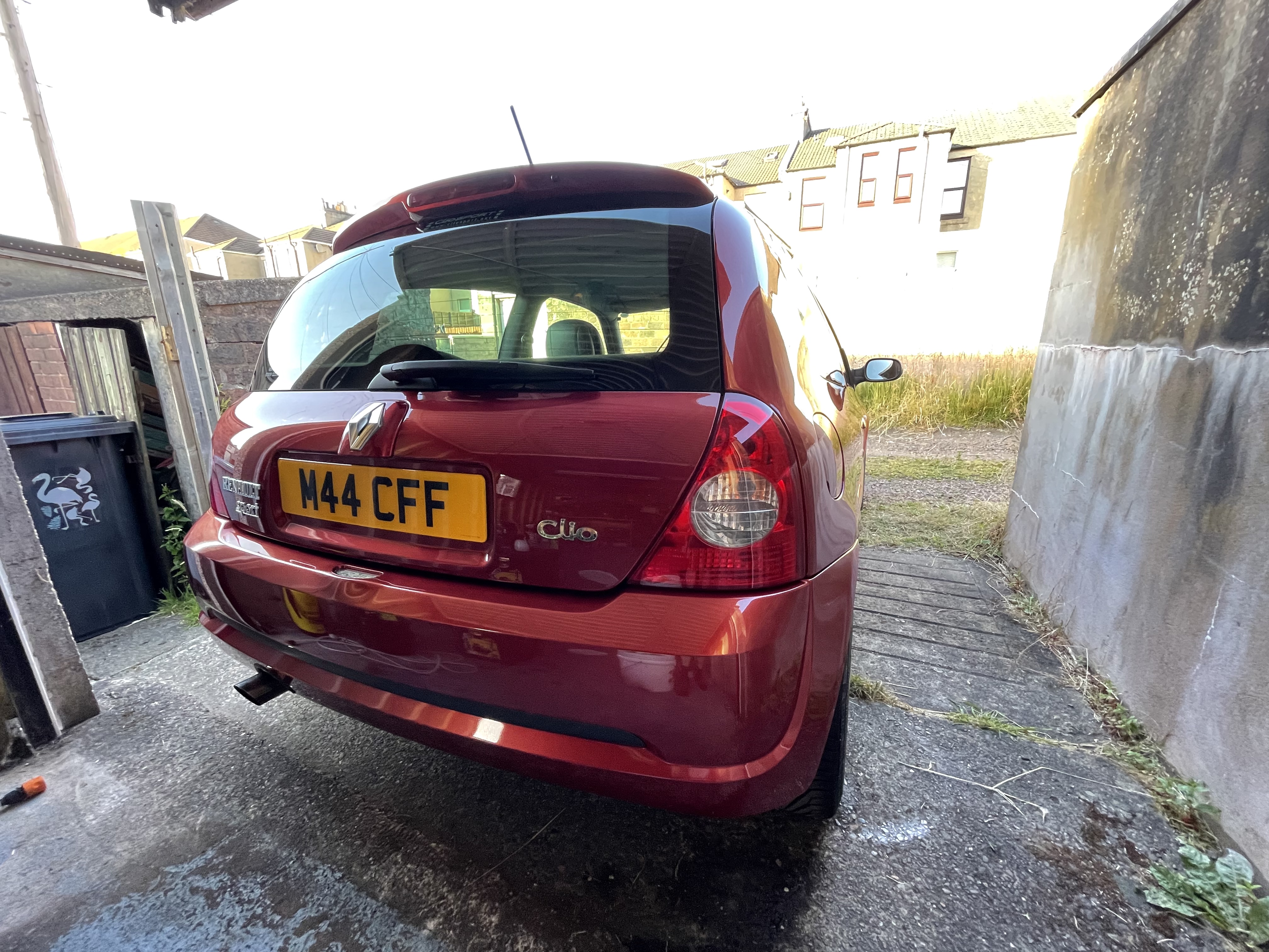

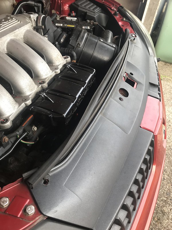

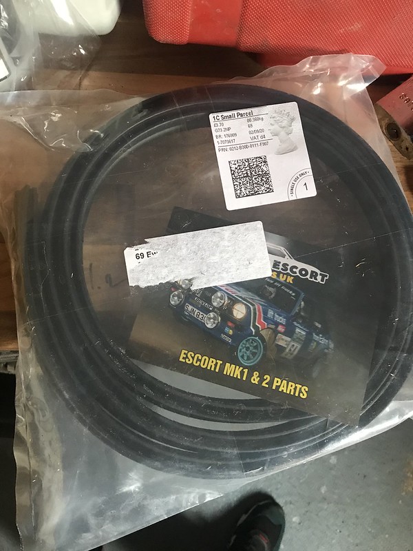

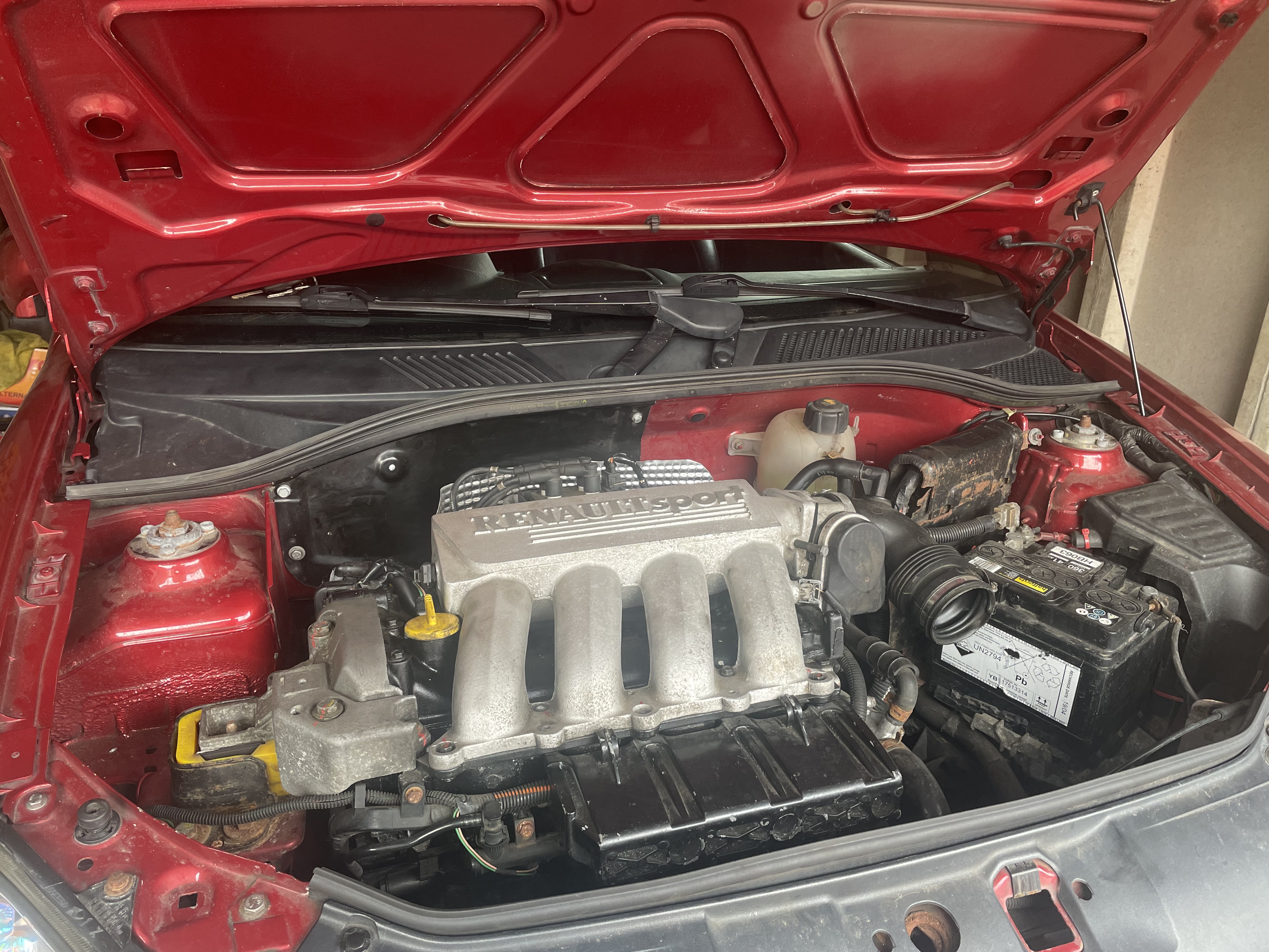

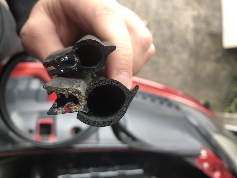

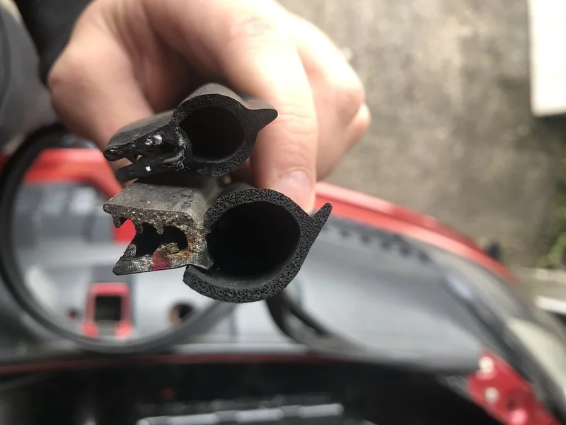

Next up was my slam panel/ bonnet seal, Again had been burst since Ive took ownership of the car:
Ordered from here on eBay: https://www.ebay.co.uk/itm/Renault-...e=STRK:MEBIDX:IT&_trksid=p2057872.m2749.l2649
Not a million miles away from OEM although slightly smaller diameter. Loads better than a burst one:

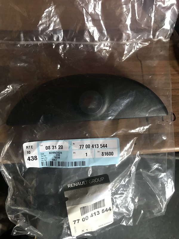

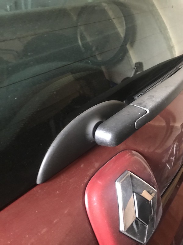

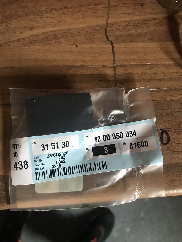

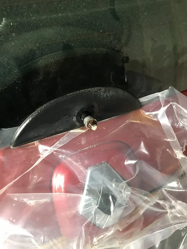

Also from RPD I had ordered a new rear wiper surround, now I had put this off for some time even though the part was only £6.24 or there about.
As anticipated everything pretty much fell apart or was seized.
pictures don't do it justice just how faded it was:
New Part:
Soaked in WD40:
Then snapped the wiper arm off and soaked in more WD40:
Didn't take any more pictures because I was getting my sweat on trying to remove the little nut tried hammering on a small socket over it but wouldn't budge. Resorted to removing the motor and cutting it off then cleaning the threads off.
Cleaned up and re assembled:
Have now ordered a new wiper arm and blade so will wait for that to come and have it back together looking fresh again.

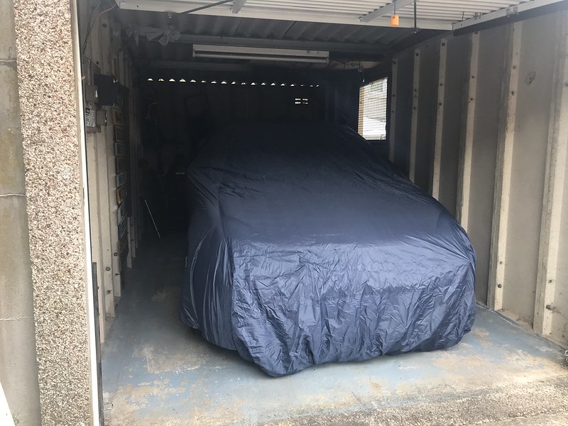

Thats it tucked away for winter, gave the car a final dusting off got all the road grime off it, shall keep it turned over got a few bits and bobs id like to address over winter. Little rust patch under the fuel filler cap and some preventative maintenance in at the inner arches. They are in no way bad however passenger side showing some very light scabbing on the inside should buff off no problem.
Other than that I'm saving for a new daily so might not see too much in the way of big changes between now and next May, however I've said that before..

Bought Stick on Velcro from Screwfix after seeing my mates s14 Drift cars full bodykit held on with the stuff.
Cleaned up the sticky stuff off the front bumper:

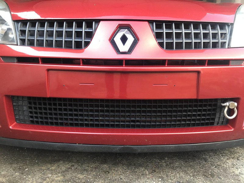

Added some Velcro:

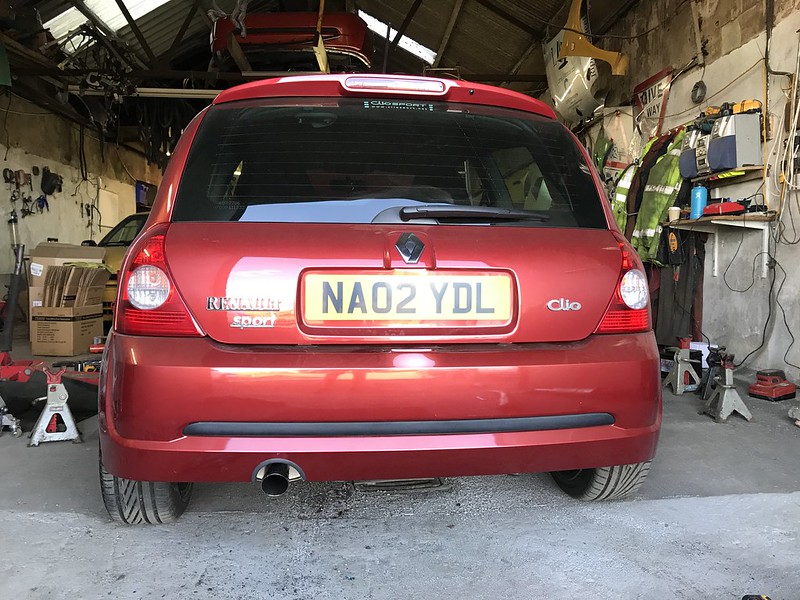

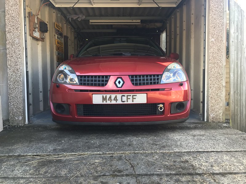

Hey Presto we have new plates:
At the moment I still prefer having it on the standard style plates, possibly once I have a new daily I will swap these back off.

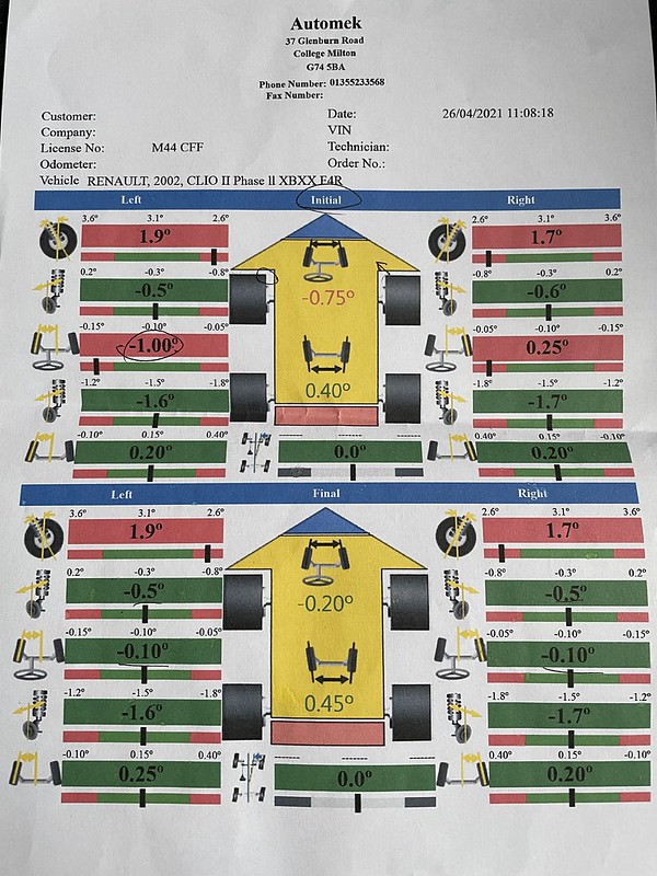

I had known the alignment needed sorted for quite some time, I really had no idea how bad it was. I did think I had maybe slightly buckled a wheel as I was getting a vibration over 70mph.
Booked in to Automek in East Kilbride, can't recommend Andrew and the team enough. Really Knowledgeable and pleasant to deal with. The initial results are shocking.. As you can imagine its like a totally new car to drive.

Had a good look over the car during service time, in the back of my mind for a while I wasn't too happy with the brakes. from the outside everything looked ok, was running HC discs and DS3000 pads. I don't have pictures however the pads and discs where totally glazed on the inside. On further inspection the rear lines needed replaced as did both handbrake cables.
So a quick and pleasant chat with @George@RTR_Parts and I had some Mintex M1144 pads and HC Discs along with some Typ200 fluid and the other odds and ends needed on their way. Also have some new Powerflex ARB bushes waiting to go on as well as the current ones look a bit past it.
Set about yesterday changing the discs and pads with Stus's supervision as I'm not what you would call the most handy around cars. But job done and she stops like she should now.

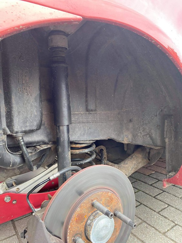

Some maintenance done to the car, Had brake lines on the rear replaced as they where looking rather crusty.
2 new handbrake cables and a new shock as one had blown on the rear.

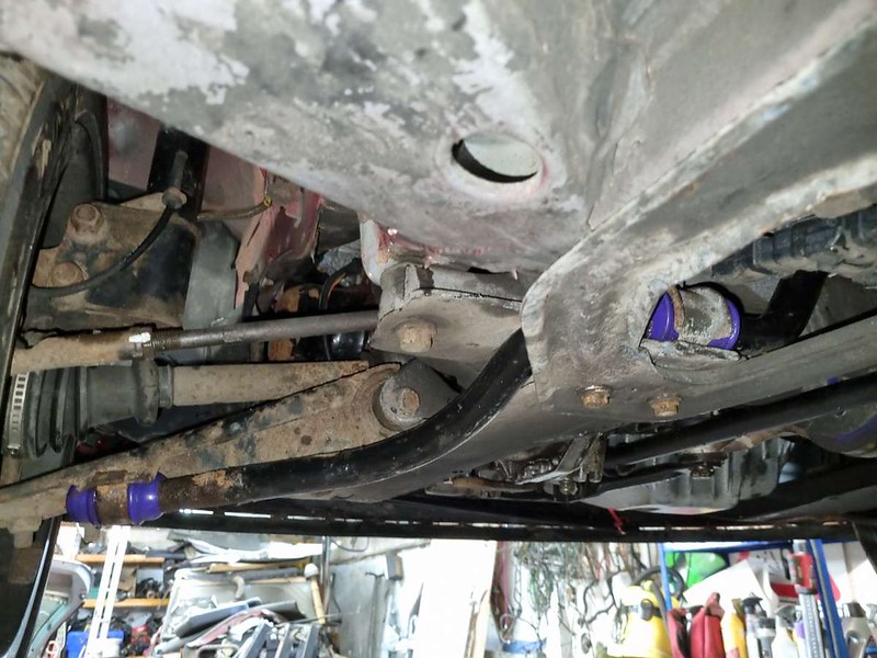

Also Had New ARB bushes fitted went for purple Powerflex as they worked out to be the same cost as oem.
Thanks once again to @Stu. for his wrenching skills.
Got my Turinis back from powder coat too as ive sold the 2118s. Loved the wheels but with doing more road miles and wanting to make the car a little more comfortable I think the turinis suit it better, I had them refurbished in a Porsche Anthracite.

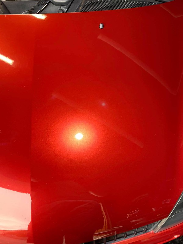

Picked the car up from @Michaelfoz after a stage 1 polish. Really pleased with how it's brought that POP back to the stunning flame red paint. If you're in or around Scotland I highly recommend a visit if you're thinking of having any work done. Also cleaned out under my arches while it was there. Some Before and afters:

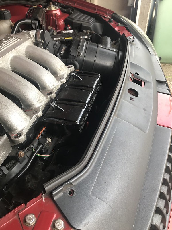

After moaning on here about a the car being a bit too harsh for me on the longer drives we set about making it a bit more liveable.
I had been following @frayz progress with sound deadening, but as a cheaper heavier way ive just lobbed the rear bench back in the car for the time being and it seems to have cut down cabin noise a fair bit.
Car had developed a bit of a hesitation very intermittently, still not sure why it was happening but I changed the throttle body and it seems to have done the trick thus far.

Sold the 2118s and had my Turinis refurbed in a Porsche anthracite. Really do like the look of the ph2 on 16s just feel they suit it better.

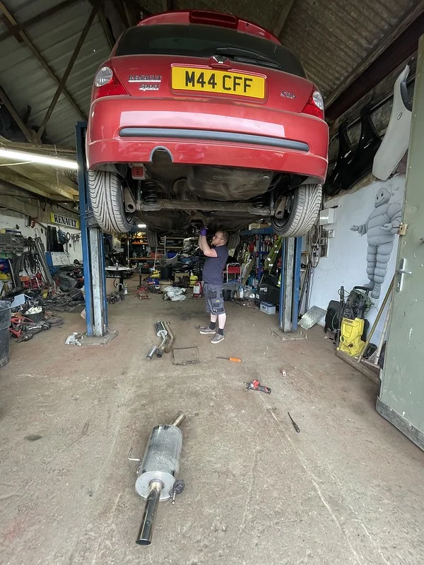

Back to quietening it down, dabbled with the idea of adding the sports cat and centre silencer to the pms system, but with the sports cat being out of stock (and quite pricey) I opted to try the centre silencer for the time being and can lob in the cat at a later date if need be.
Up to @Stu. once again to borrow his muscle to get it fitted along with some odds and ends needing sorted.
Glad I didn't attempt it on the drive as it tuned out to be quite a footery wee job.

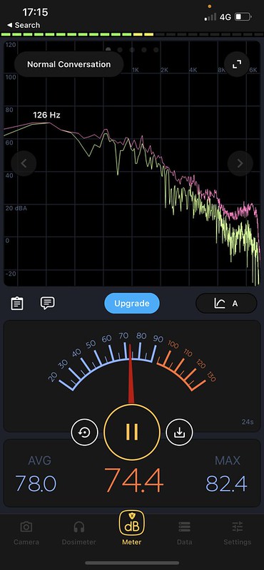

I didn't get as scientific as Frayz however I did take an after DB reading on the motorway with the windows up and windows down at 70mph.
Hugely happy at how it is now on the motorway, not intrusive at all and I'm pleased to report the drone has gone.
I actually prefer the overall sound of the exhaust now, sounds much less piercingly raspy. To me it sounds just right now.

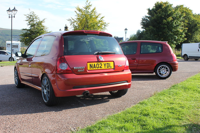

Im taking the car to Clios and Coffee Drive on the 1st of august where I think I will rack up close to 600miles over about 3 days of driving, so that will be the test.

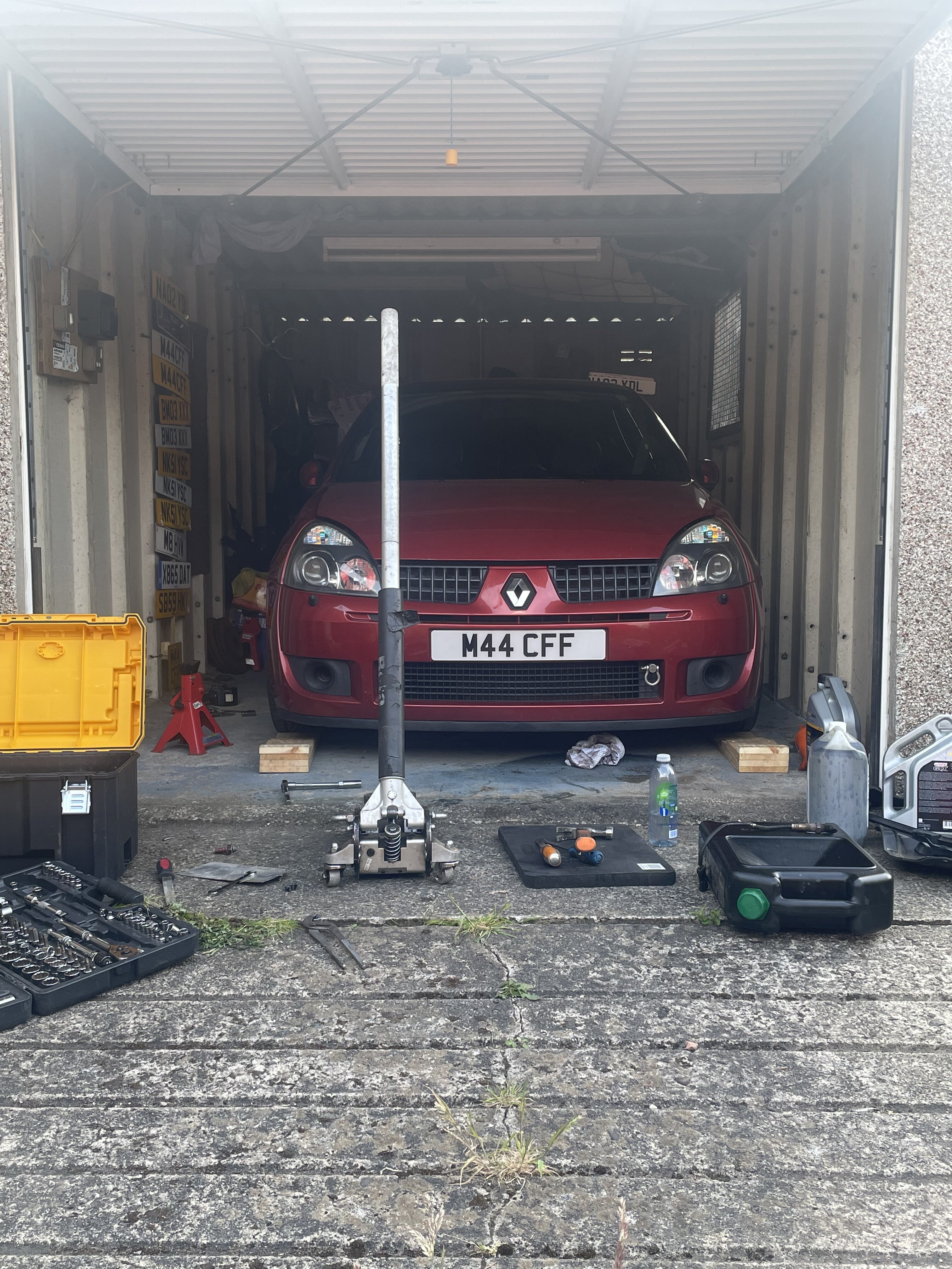

I’ve fairly neglected the car for the winter period and with CS festival booked I wanted to get it MOTd and serviced.

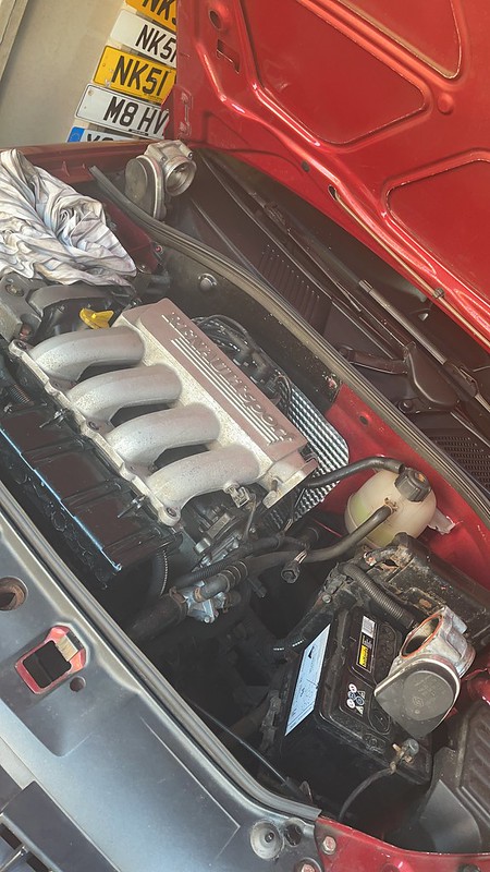

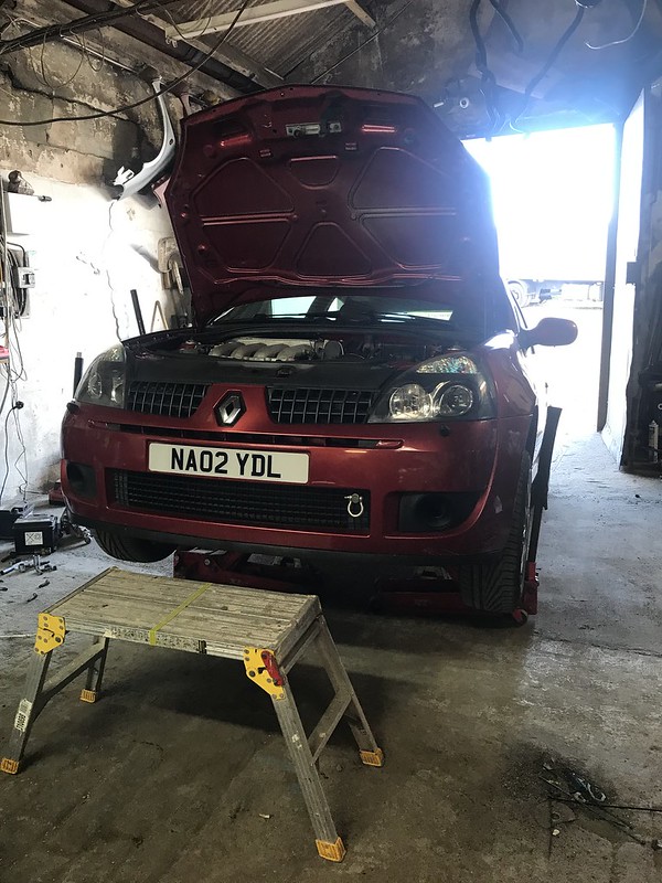

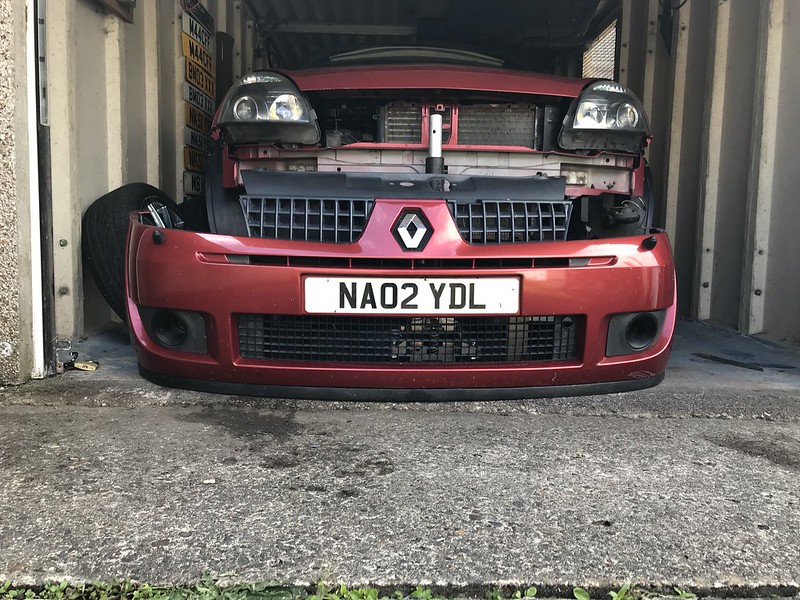

dropped the oil and ended up noticing a few bits I wanted to sort out…

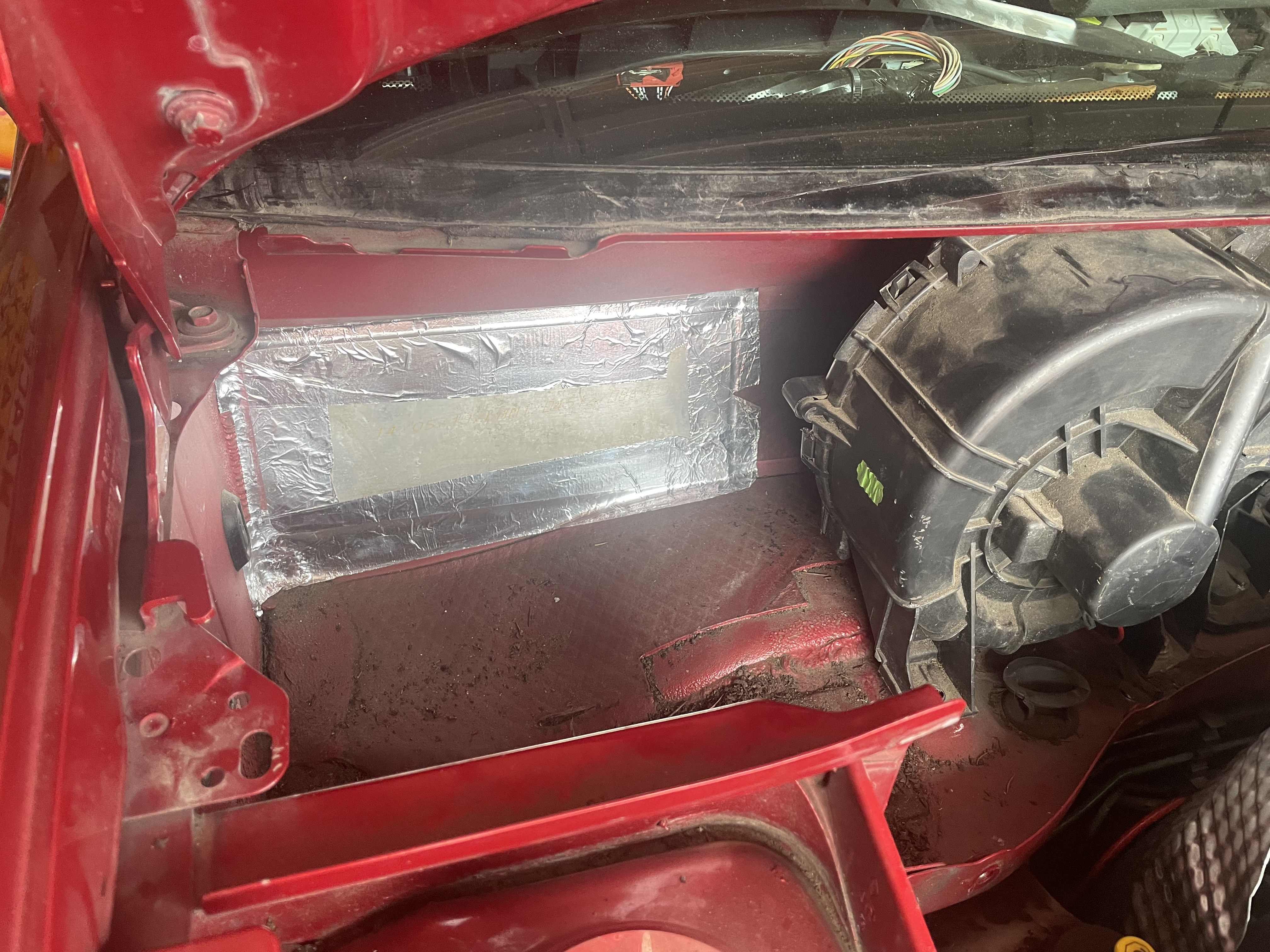

Installed a cup blower motor and blocked off the hole in the bulkhead.
Turned out to be an inlet off job so fired in new plugs while I was there. Really didn’t anticipate having to take the dash top off etc to get the blower out, Sod’s law always a bigger job than expected!
Also took the exhaust apart to get a Sports cat welded in that i can swap in and out when need be. While having the cat jacked up the box decided to leak it’s fluid everywhere, not yet investigated that but I’ve bought new fluid and plan on getting under it and seeing what seal has gone, appears to be coming out of the shaft.

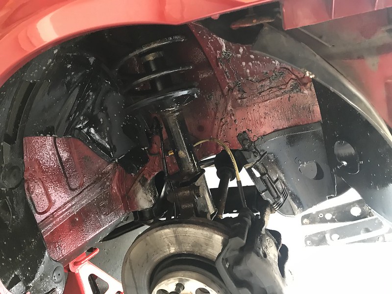

Also while prodding about I noticed that the radiator had come apart at the bottom, this happened before a few years ago and dropped its Coolant and left me stranded, I pick up a new radiator tomorrow so set about today getting it out.
Stripped down the bonnet latch while I was there and gave it a clean and re grease, along with the radiator brackets have given them and the ecu cover a lick. Didn’t bother taking photos as I was just getting wadded in!
Hope to have it mostly together this week when the exhaust is done and get her motd and on the road. Have a slightly rumbly wheel bearing that I don’t know if I can ignore before going down south, but might do it just for peace of mind!

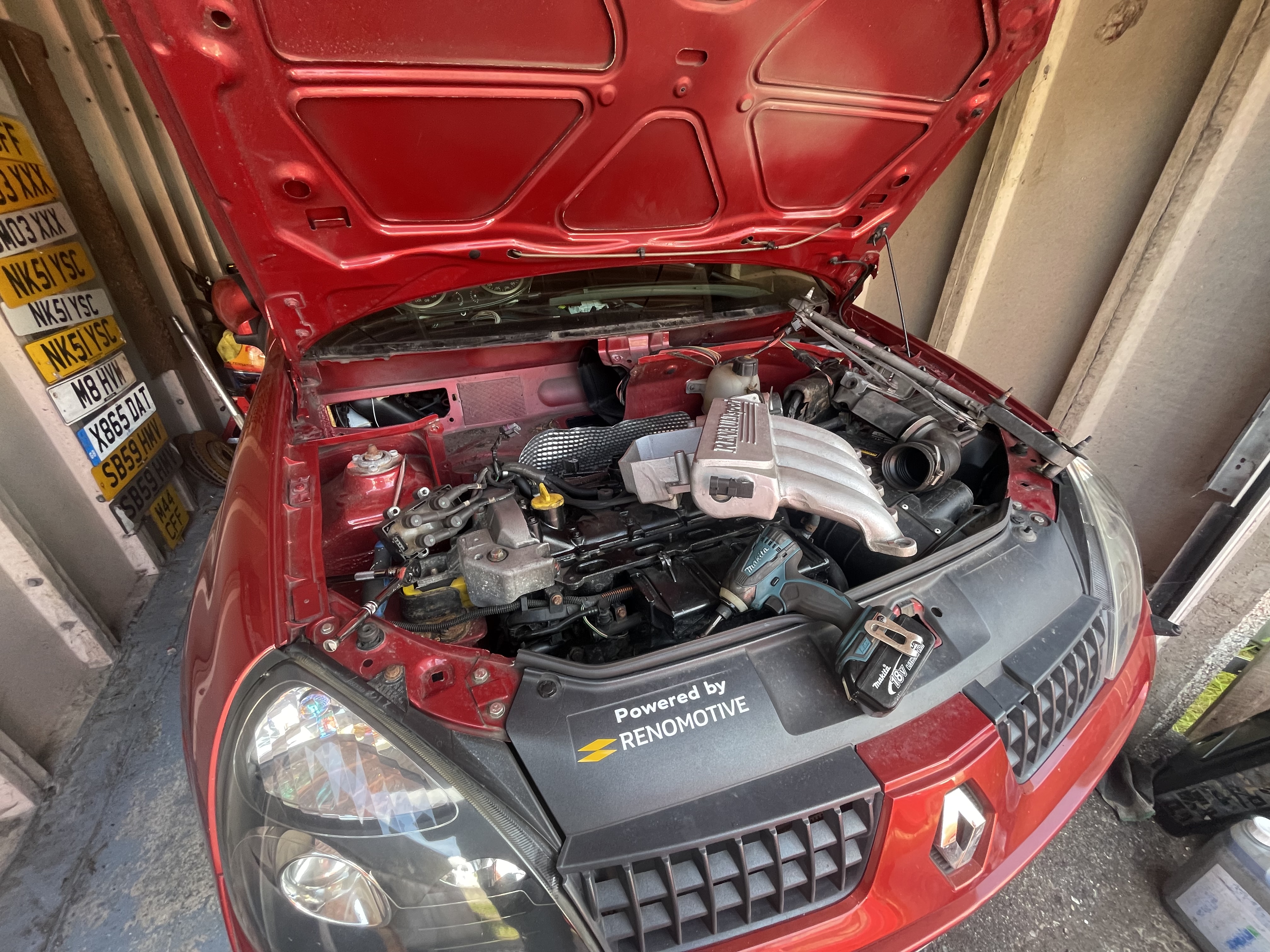

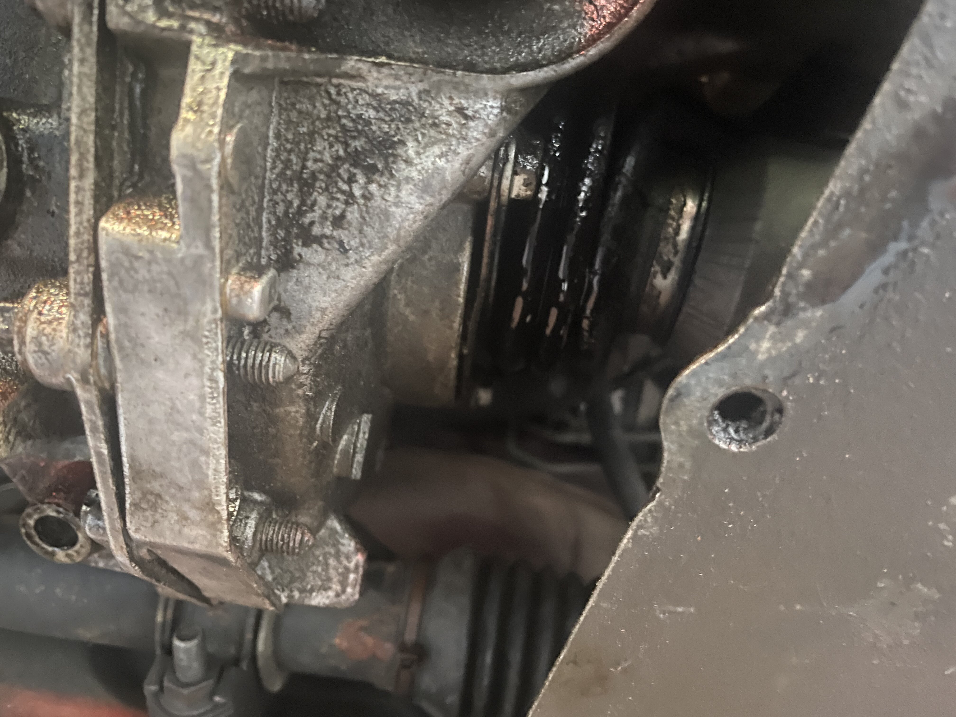

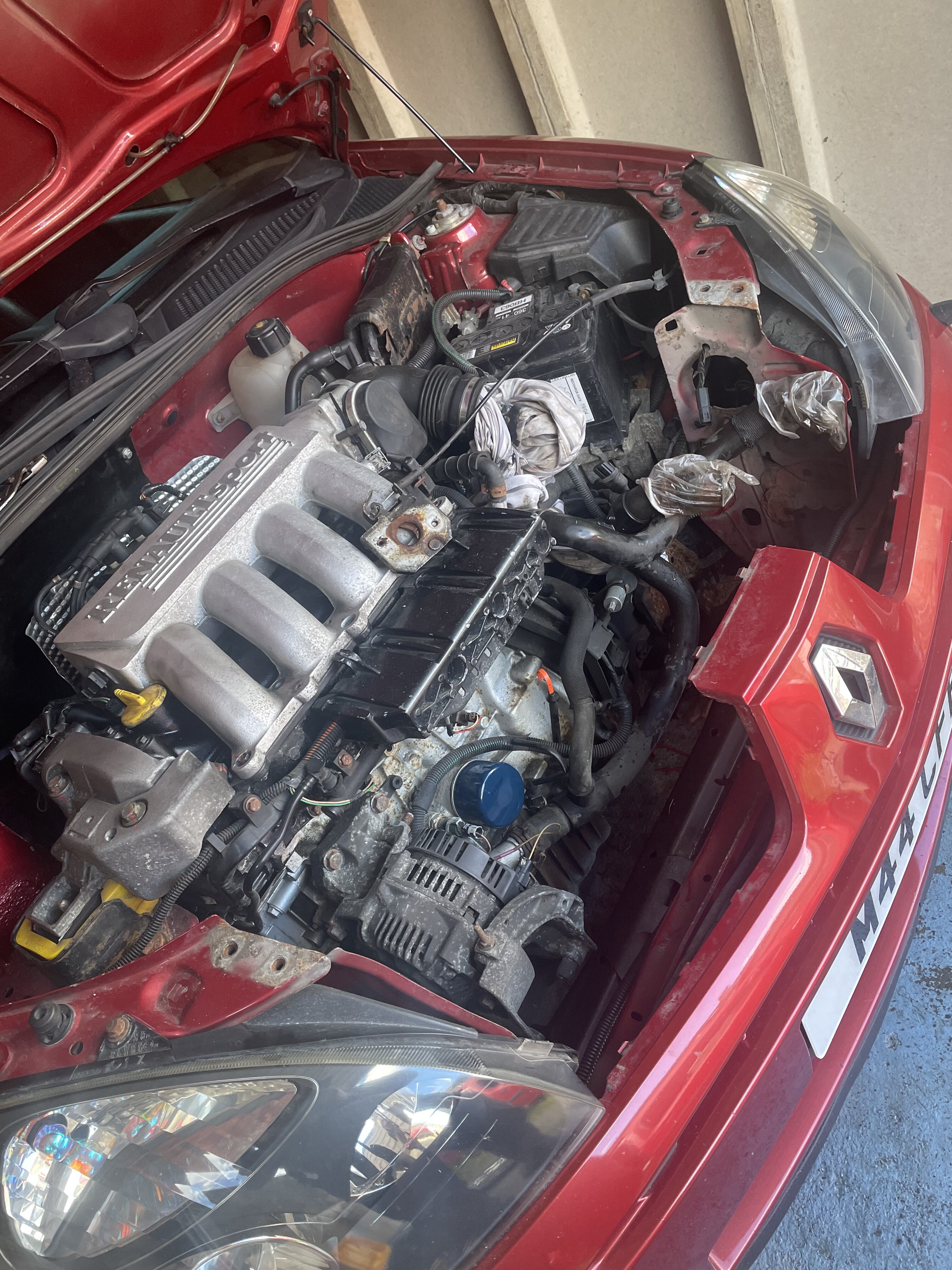

I’ve not been too picture heavy here as I’ve just been working sweating away on the car. I’m not used to this manual labour these days!
So after investigating why my box was leaking turned out to be a torn seal at the gearbox end. Easiest solution was grabbing a shaft from renomotive and throwing it in.
Really less than ideal in my tiny garage but I got there in the end.

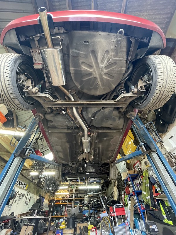

Had a sports cat knocked up for mots and to try and kill some fumes on the longer drives. It’s just a cheap Chineseium one so I might have a better one made at some point if it doesn’t strangle the power.

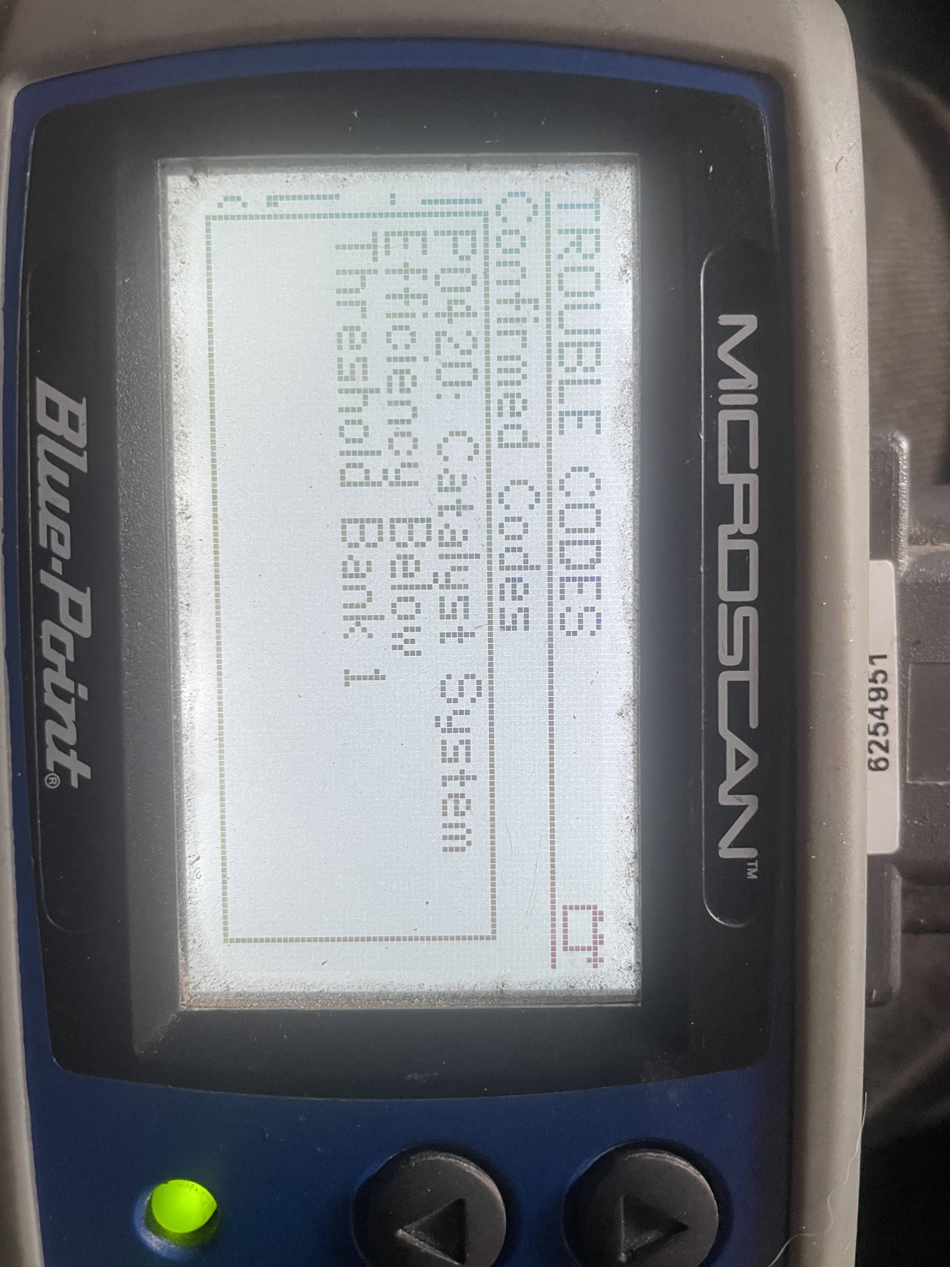

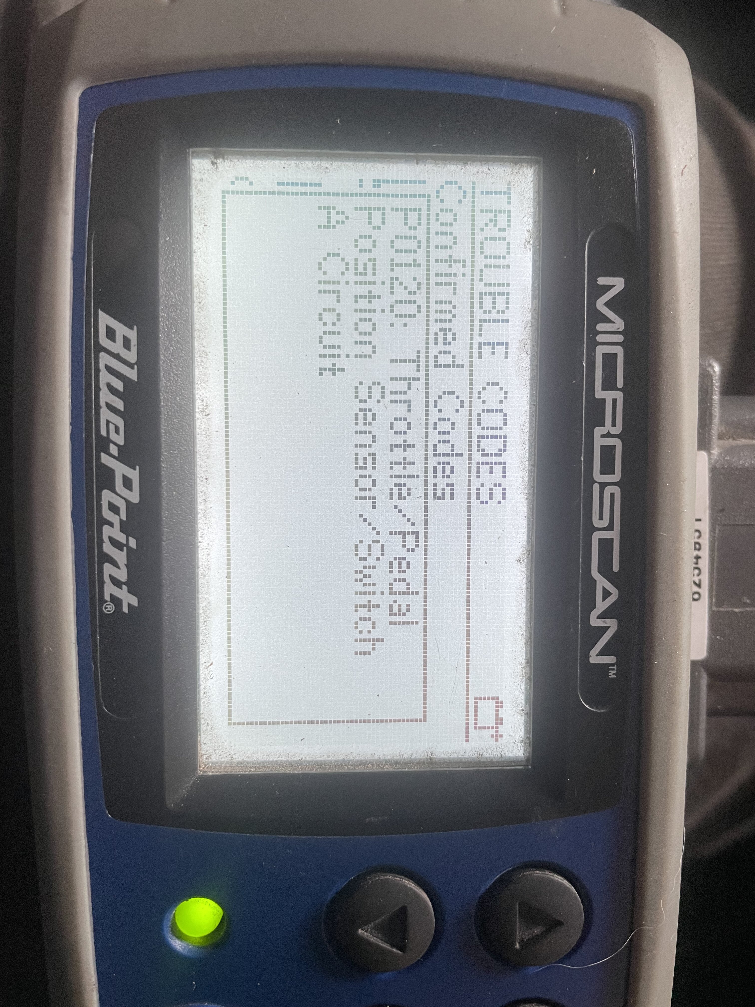

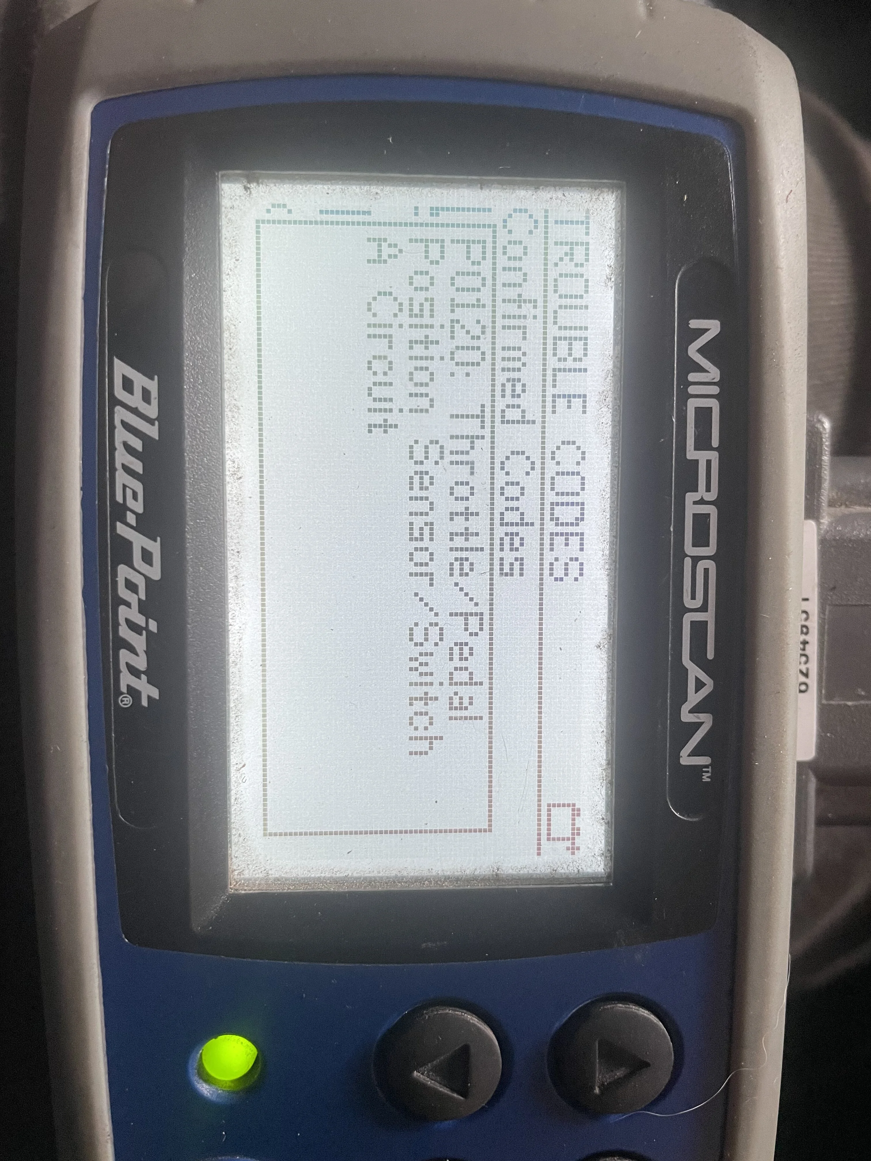

When I parked the car in winter I had an eml light come on and I wasn’t sure why, I ignored it and left it anyway.
So on starting the car again she was rough as a dog and had occasional “coil”? Light anyway I done the obvious things first code read and cleared codes and they kept coming back on.
So after changing the throttle body and pedal over for some spares and nothing changing I set about pulling apart the dreaded white plug. Low and behold green and fuzzy inside. Went at it with some sand paper and a screw driver and plugged it all back together. Job jobbed car back to normal. Let it run for a while and bled up the radiator. Off for MOT this week so fingers crossed I can just clean it up and hit the road to Blyton park. It’s now time to work on the van!!

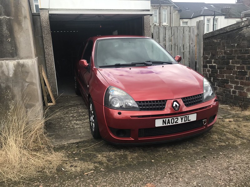

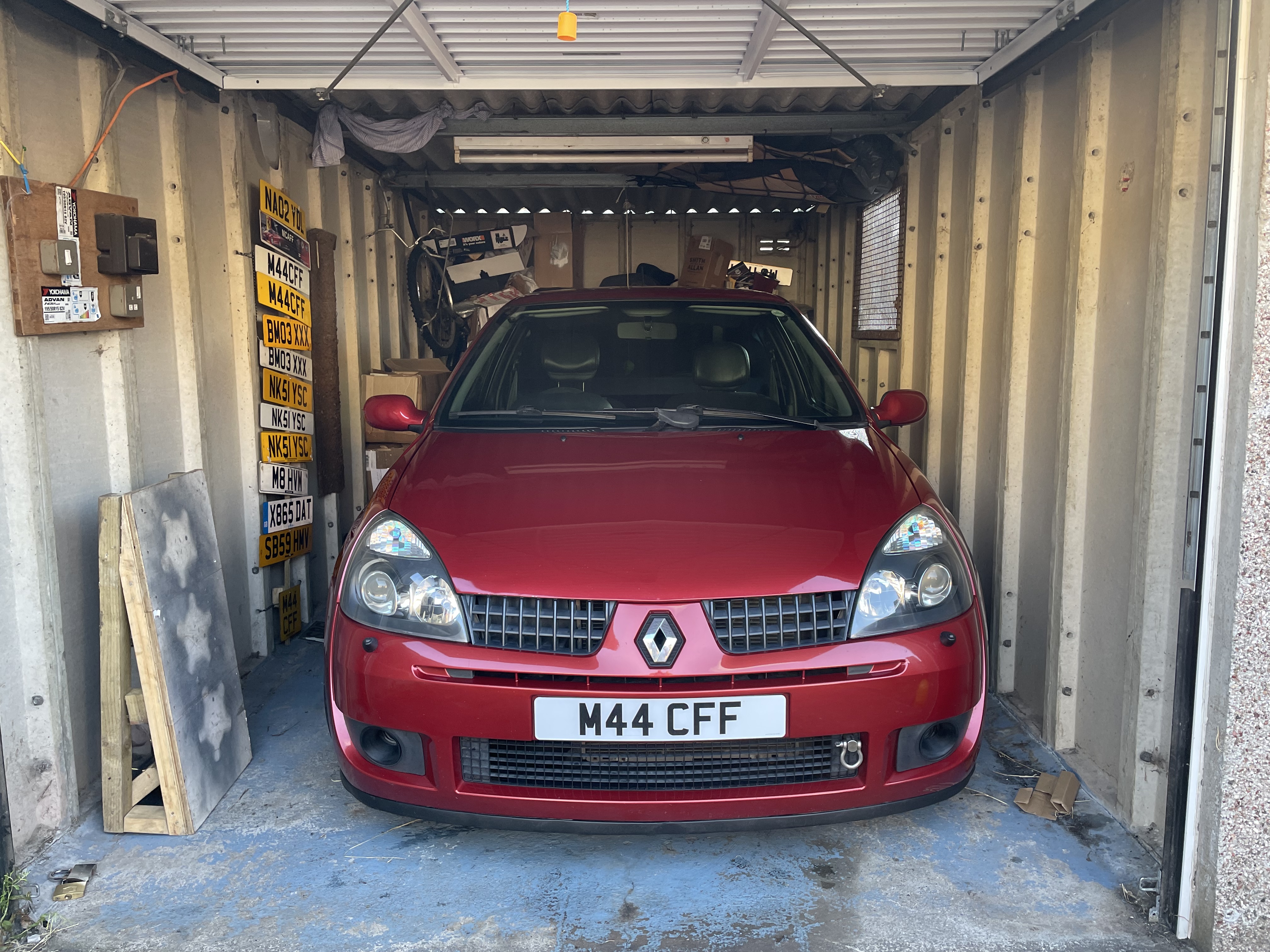

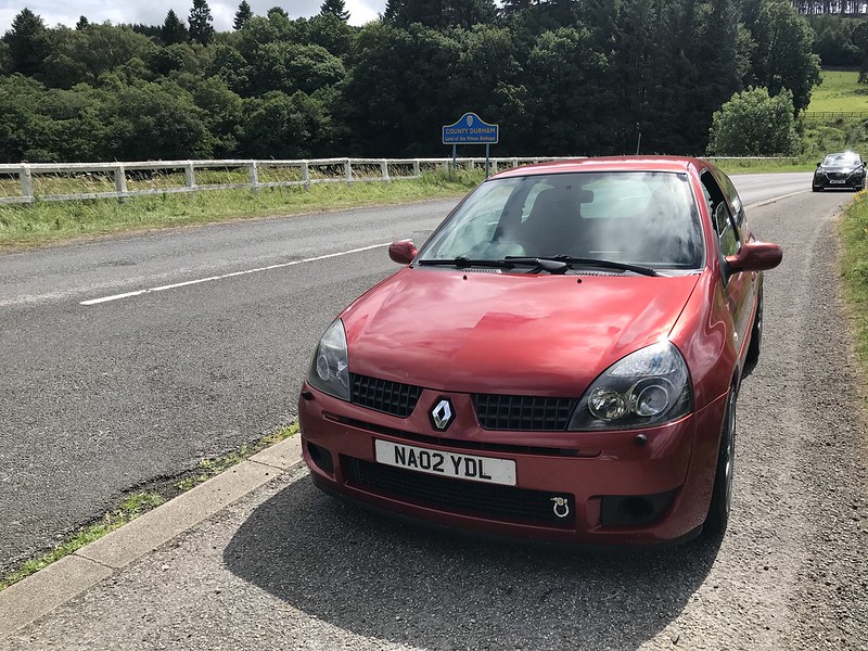

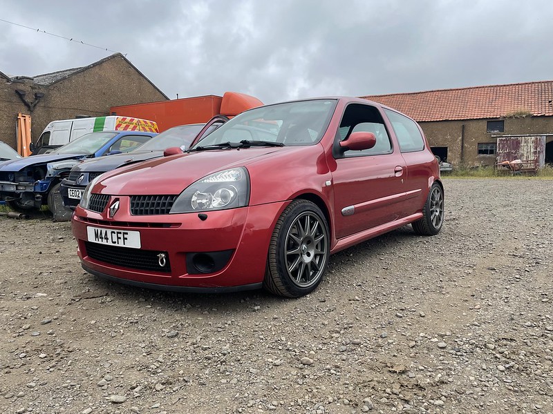

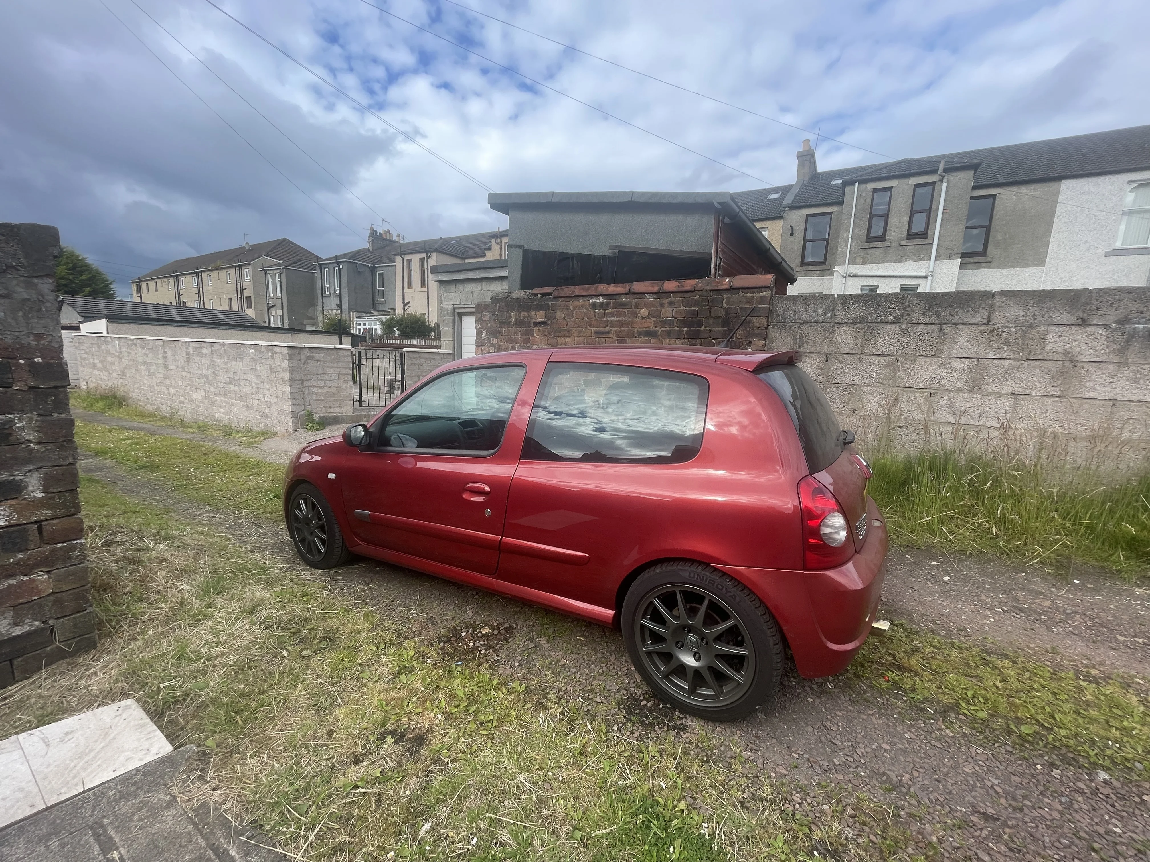

Clio has been MOTd, fuelled, cleaned and tucked away, ready to hit the road on Friday.
Managed to get a set of used but good condition NS2r’s and fired them on some dynamique wheels for blyton at the weekend. I was going to run it on the rainsports but I was getting a bit worried about temperatures and having to drive 540 miles round trip on them too. So these should save my road wheels at least.
Cars looking good, beginning to look forward to CSFestival now, I’ve decided I won’t be taking 2 vehicles to something like this again it’s too much stress 😂!
