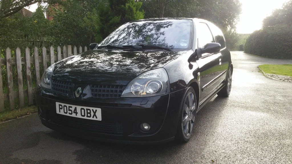

Really happy with car, drives excellent and have no real issues apart from a squeaking noise when i go to full lock from cold [any ideas?]
Lowered on Eibach springs, Scorpion cat-back system and a rather splendid re-trimmed steering wheel.
Just today i fitted a cold air intake, new gearstick gator, led sidelights/interior lights. Stubby aerial, stainless steel tow bar [shiny, i like :)] and rear led numberplate light. Was going to take out foglights and clean them, fit new bulbs but will do them tomorrow.
