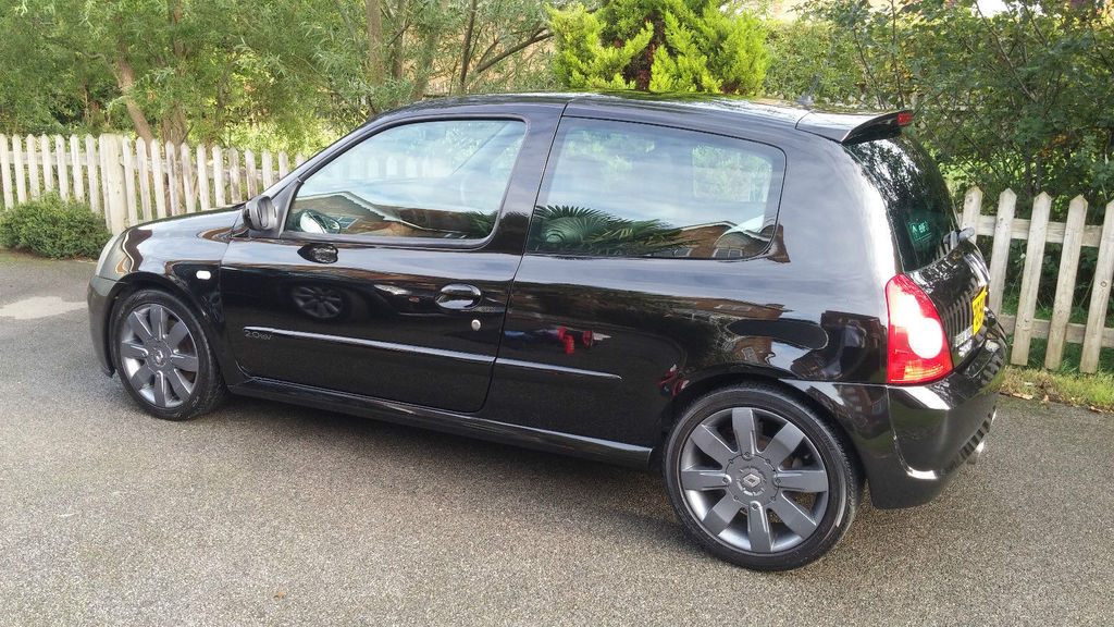

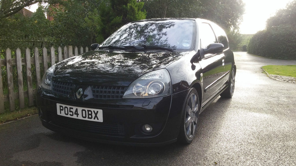

Really missed my old 182, never had much chance to drive it sol had to sell it.
After 2 years the i finally got back into driving and fancied joing the 182 brigade again.
After a few week spying various 182's on Gumtree, Autotrader and Ebay finally found one in my area that isn't a million miles away.
A well looked after FF BG 182 on EBay, female owner, Clio.net member, for just over £2000.
Really happy with car, drives excellent and have no real issues apart from a squeaking noise when i go to full lock from cold [any ideas?]

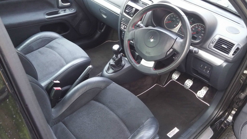

Lowered on Eibach springs, Scorpion cat-back system and a rather splendid re-trimmed steering wheel.
Just today i fitted a cold air intake, new gearstick gator, led sidelights/interior lights. Stubby aerial, stainless steel tow bar [shiny, i like :)] and rear led numberplate light. Was going to take out foglights and clean them, fit new bulbs but will do them tomorrow.
