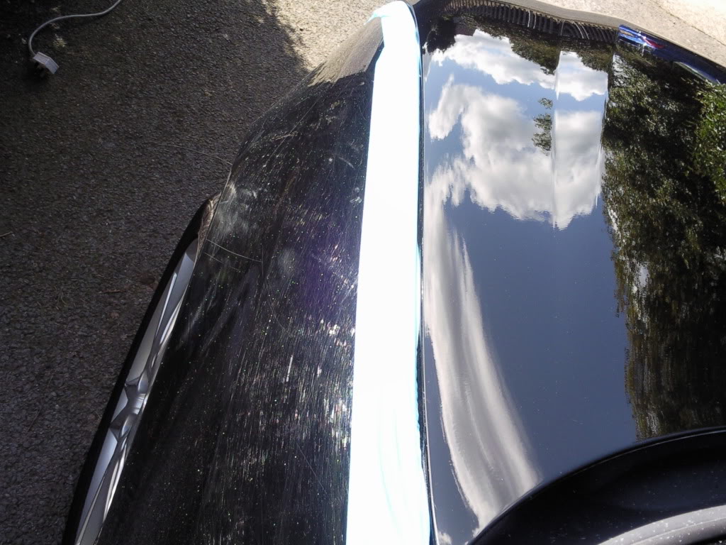

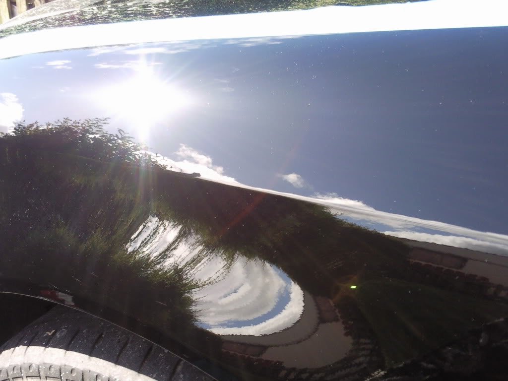

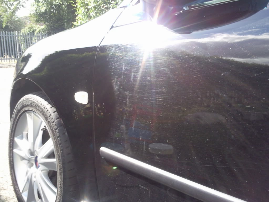

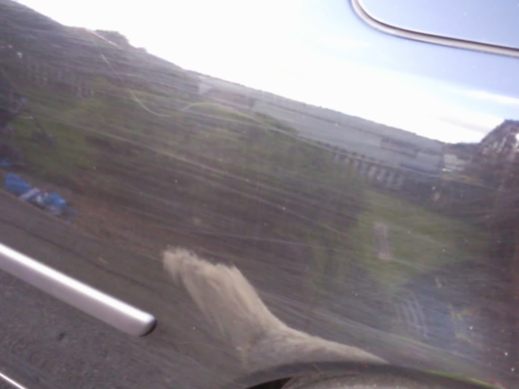

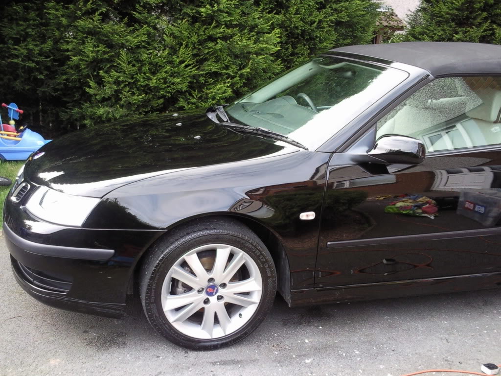

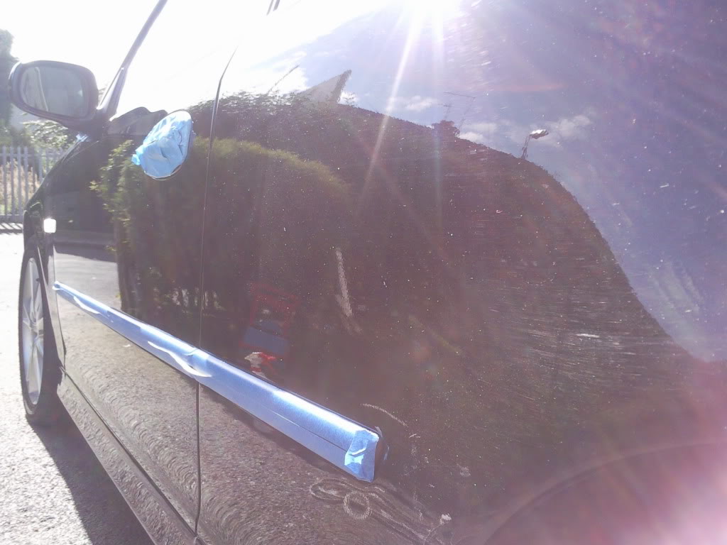

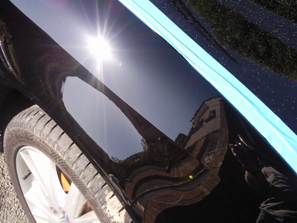

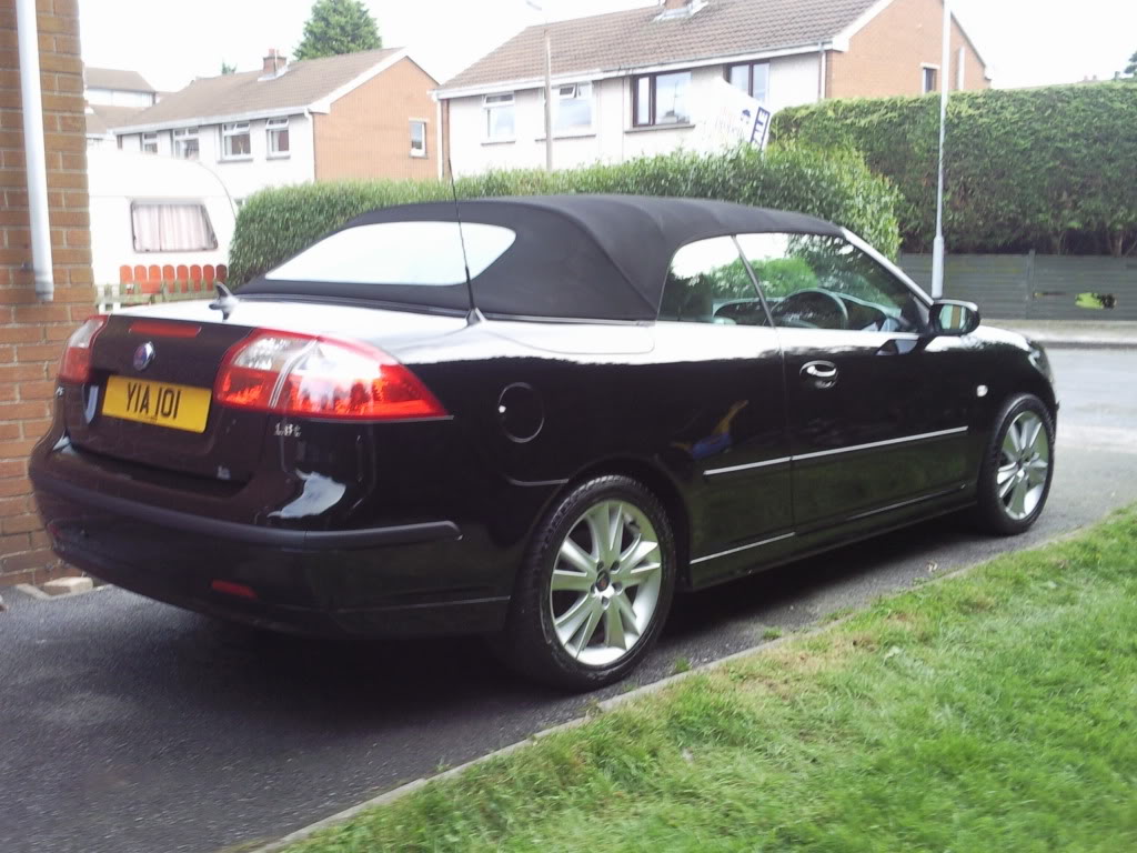

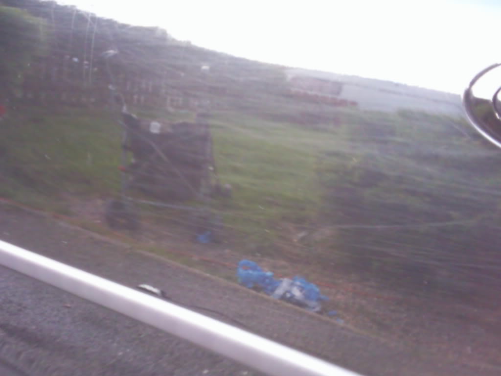

after feeling sorry for this wee saab 93 convertable i spent 9 and a half hours on it doing a correction ..the paint was the worst i,d ever seen the car is nearly 2 and had never seen polish or wax and driven alongside bushes all of its life the owner was so happy she has decided not to trade it in after it was collected , she even shed a tear
1. elite tfr
2. power wash down megs wheel brightner for the alloys also
3. elite snow blizzard
4. hand wash
5. elite tar remover
6. clayed
7. many variations of turtle wax cutting compound with a rotary
8. menzerna final polish megs g220
9. fire glazed megs g220
10. megs tec wax 2 megs g220
11. elite rubber care for dressing
12 ag fast glass
13. elite air oxidiser
so 30 micro fibres and nearly ten hours later here are the results all comments welcome
am not into 50/50 shots as i dont have time to fart about but as you can see the paint is really bad in the first couple of pics nice challenge tho .. and yes the fire glaze works well with black

THANKS GUYS MAKES IT WORTH WHILE WHEN CUSTOMERS HUG YOU , I ONLY DO IT AS A HOBBY AS I WORK FULL TIME SO DONT CHARGE VERY MUCH ..BTW I DONT NEED ANYMORE WORK BEFORE YOU ALL START LOL ..... THE CAR EVEN SUPRISED ME WHEN I WAS DONE

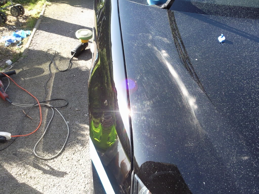

Great turn around lad! Don't think I have seen you around these parts before, but welcome to the select few ;)
What polish were you sing?? I see lots of nice little blobs that have been splattered around??
I had that with SSR2.5 when I used it the other week...it made me sad :(
