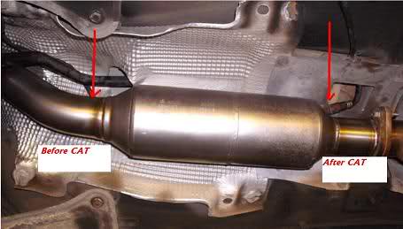

I didn't realise the front lambda was directly infront of the cat/decat? I thought it was further up?

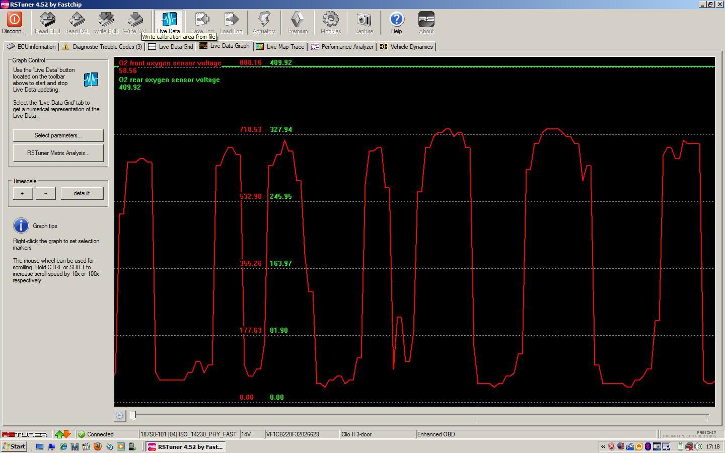

Again, image of pre-cat and post-cat lambda in operation:
Rear doing nothing, which I now know is correct as they run at a constant .5v. Front one seems to be working fine (if fine is that sort of graph). When I disconnect the post-cat lambda, both run at .5v and don't move regardless of how I rev the car.
If the front lambda sensor is way out of calibration, it would still LOOK like its wokring, but the AFRs would be skewed by its results.
