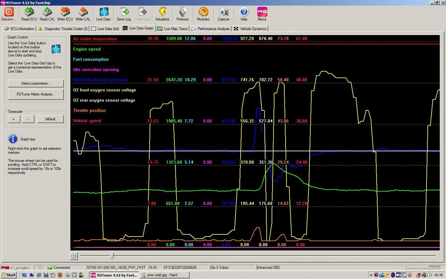

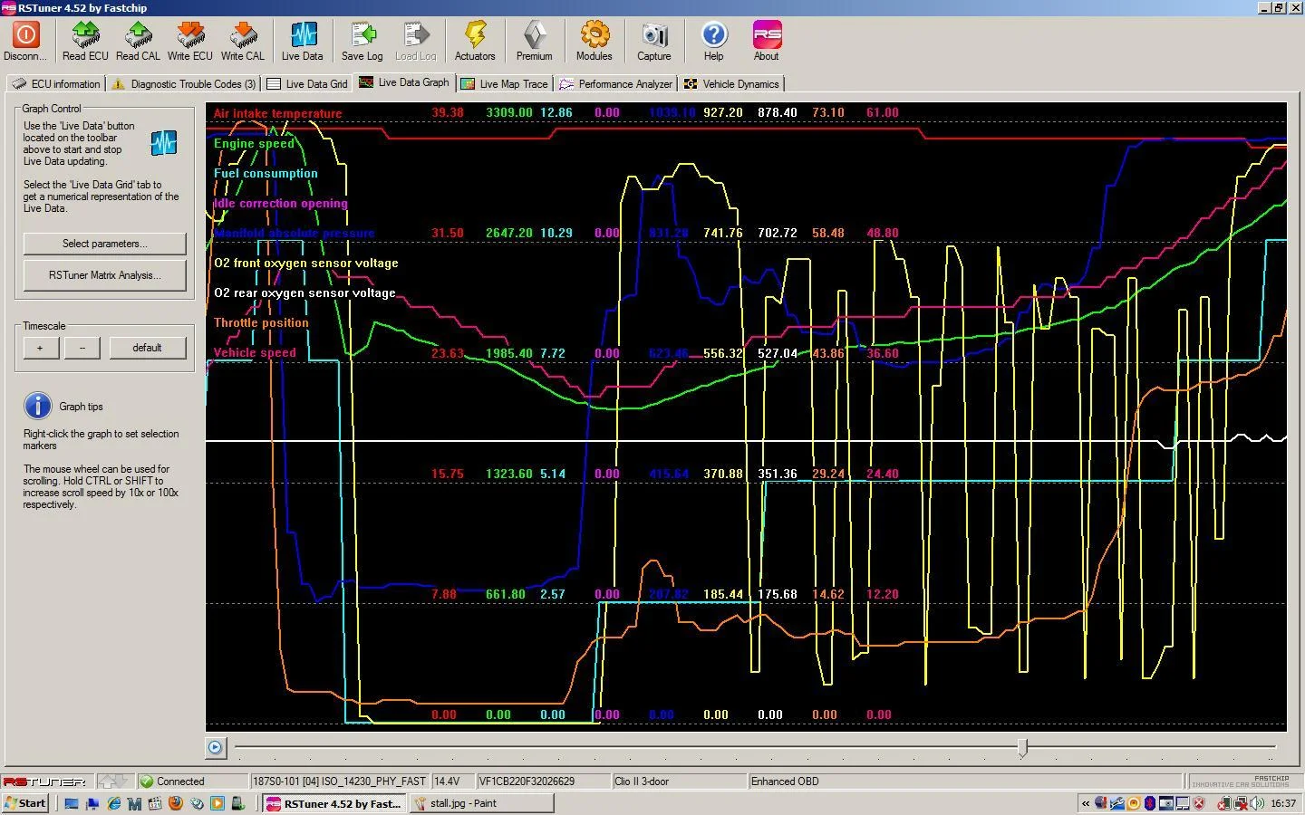

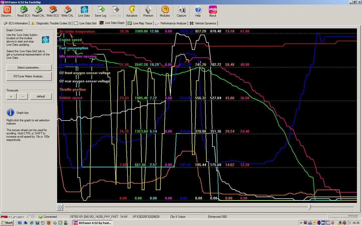

I'm assuming the Map sensor is the one in blue on the following:
Setting off:
Prior to cut out:
Cut out:
Can you tell from these graphs if there's a problem at all? You can see from the stall image that the MAP goes up to 1000 as you suggested.
