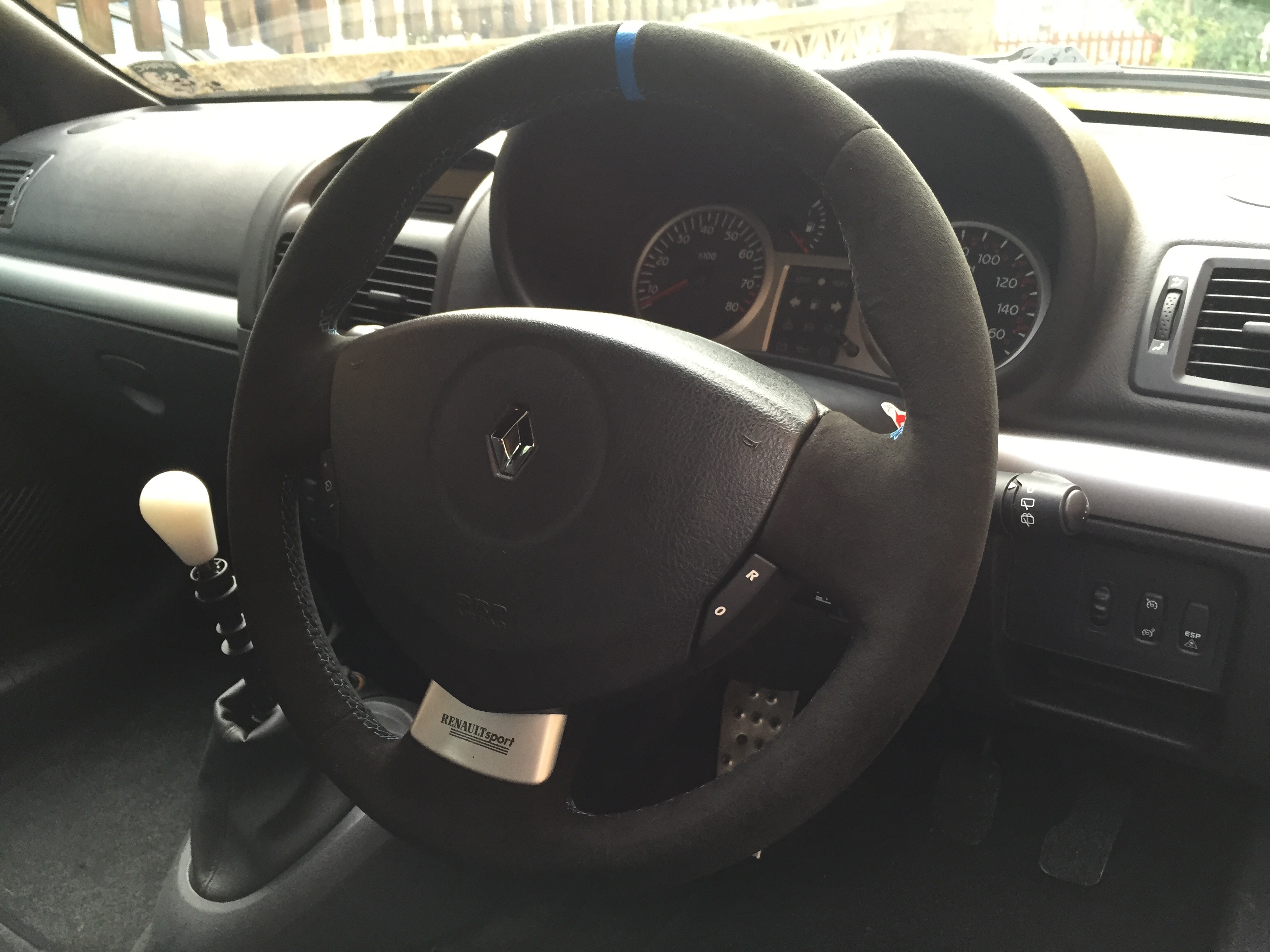

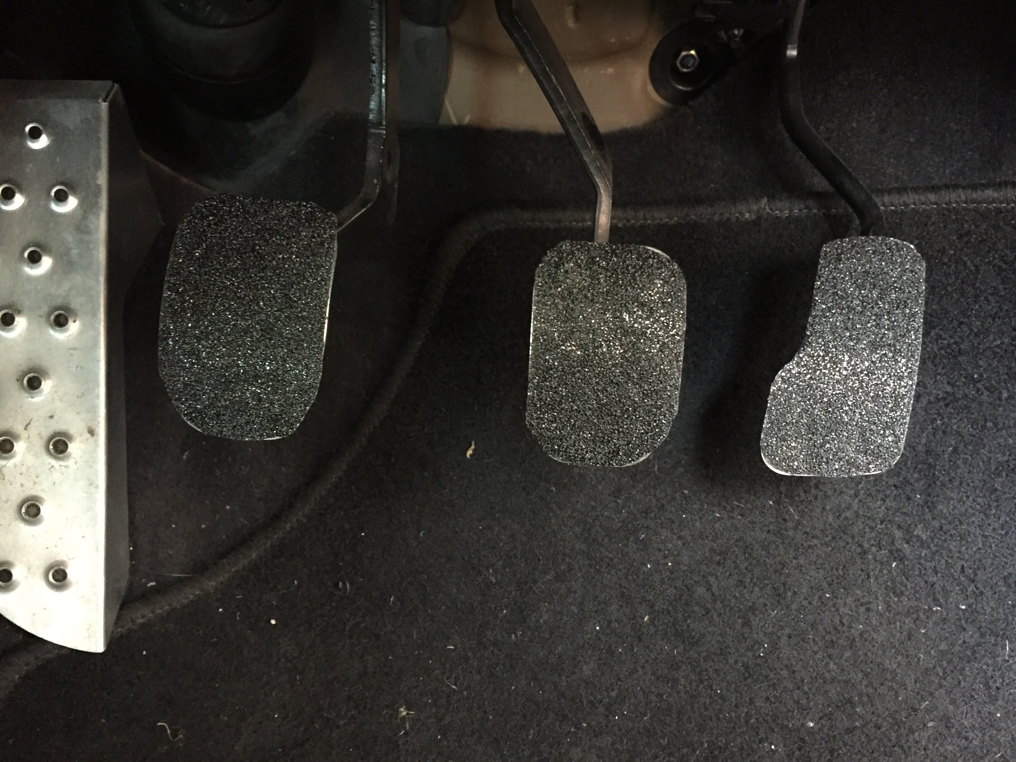

Sick of my feet slipping on the pedals when wet i have stuck some industrial grip tape of the pedals, cost £3.50 for a meter of the stuff from eBay,
also managed to get the wheel fitted:smile:,

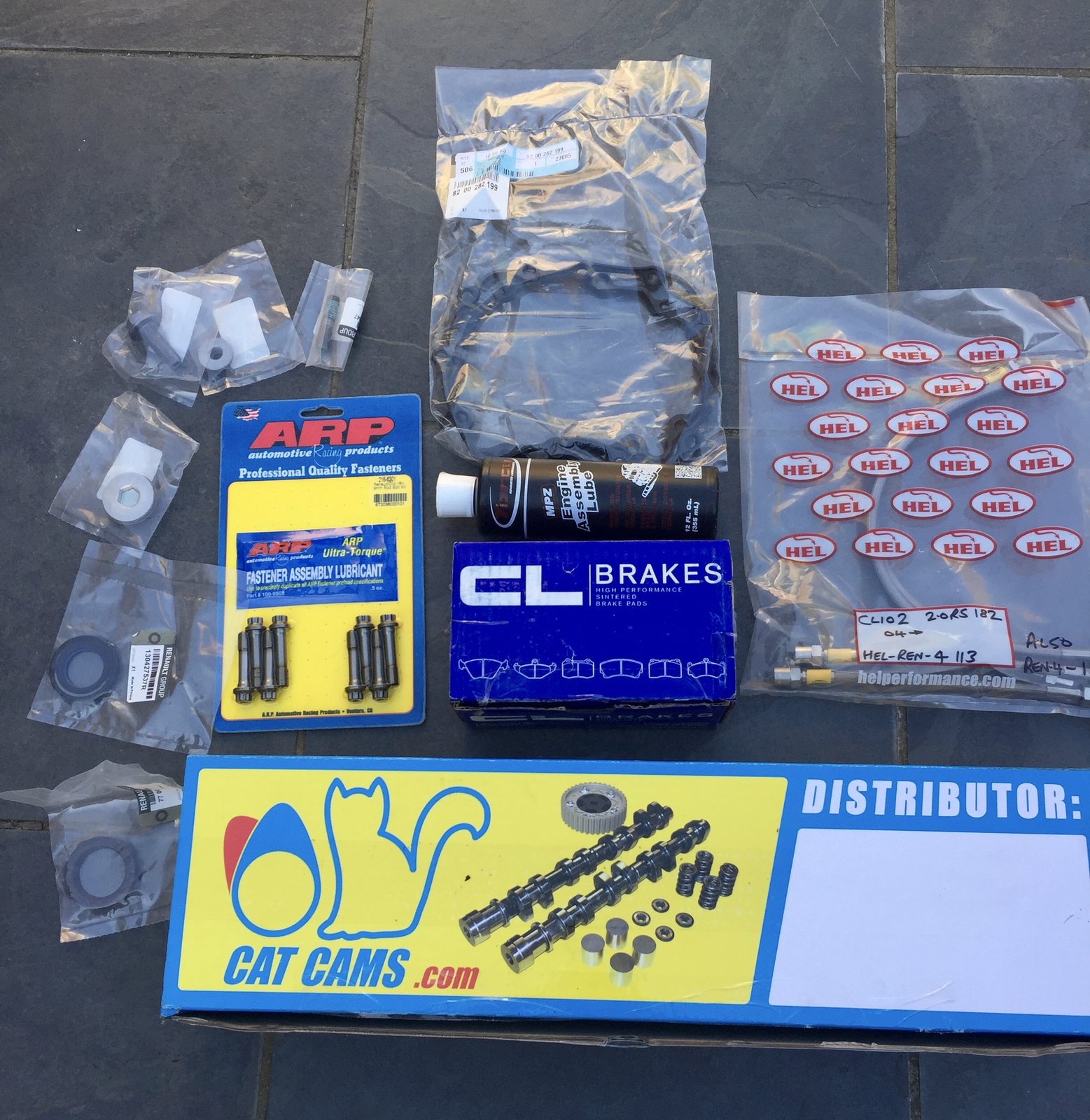

The shiny bits fairy has been this week and dropped these off,
the cams are 438 to help the turkish inlet (hopefully here this week) produce more ponies,
arp rod bolts as the engine should still be producing power around 7500 rpm
RC5+ pads for slowing it all back down

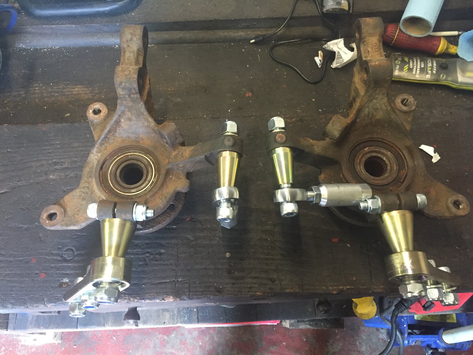

And I went to pick up my set of roll centre correction hubs from @NorthloopCup , to eerrrr correct the roll centres

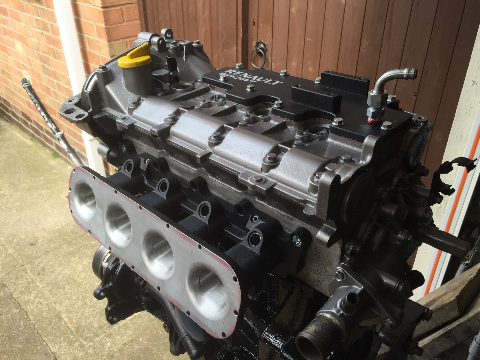

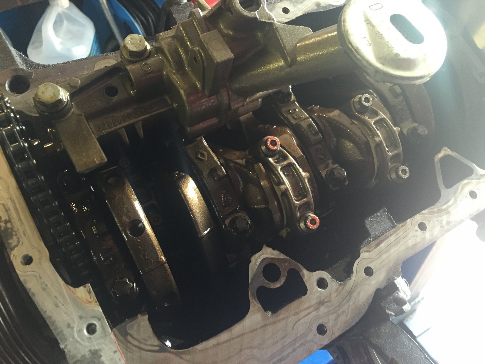

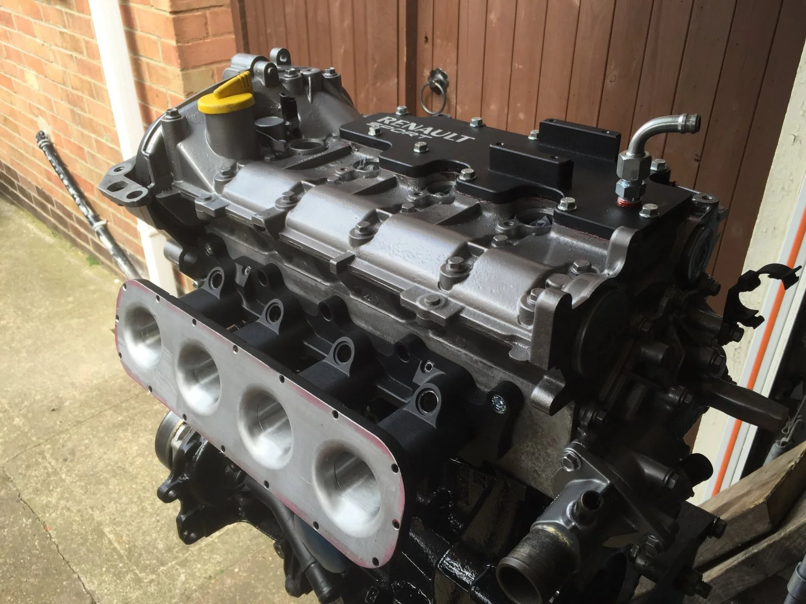

The Engine is out for some fettling,
Fitted the ARP rod bolts

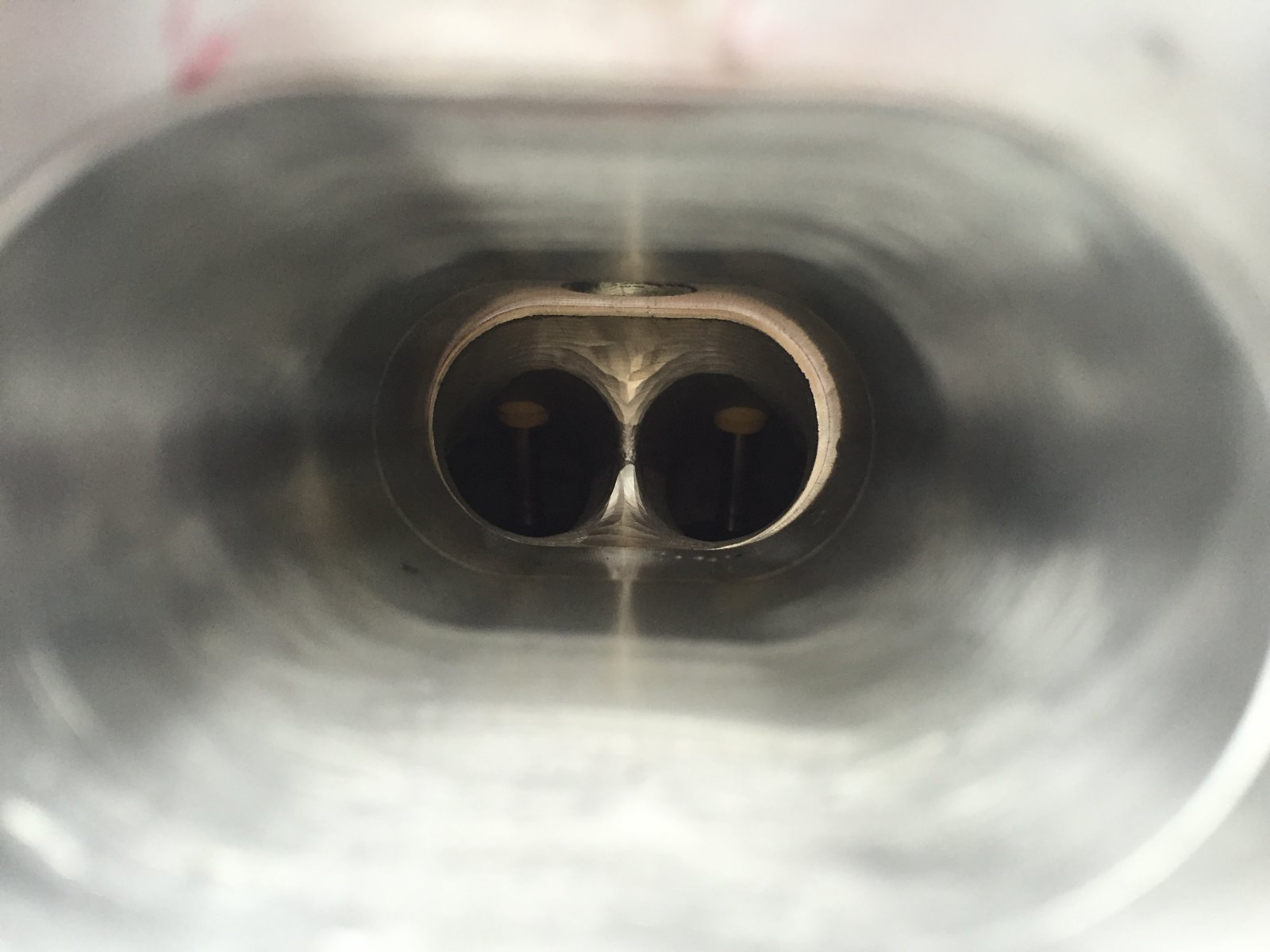

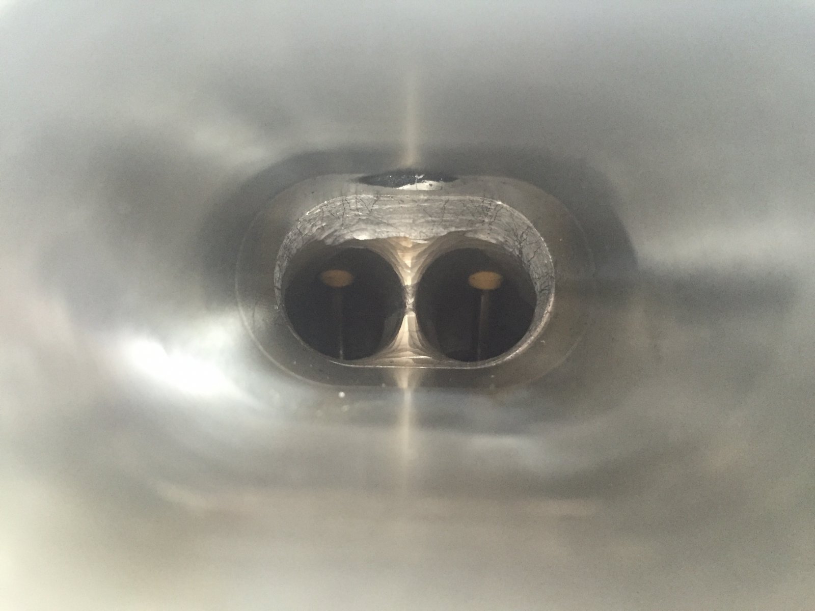

Also port matched the head to the SM intake Manifold as you can see in the first photo the lower edge is well matched but the upper and sides need a couple of mm of blending for good airflow, I would say these lips will sap 5-10hp if not blended in.

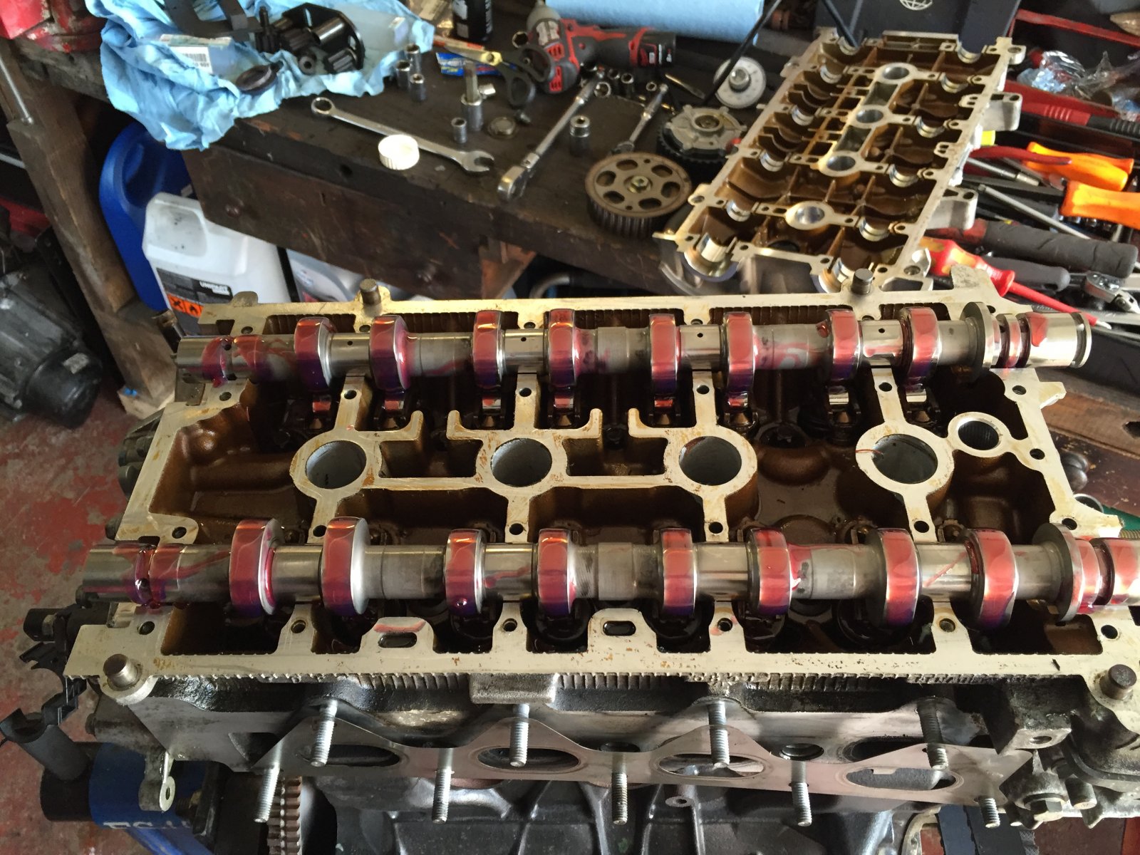

Fitted and timed the Cat cams 438's,
also made a few more mods to the manifold that i'll put pics up later
Yey it's running,
New Cams should always have a run in period which involves keeping the revs around 2000-3000 for 20 minutes as the loading on the lobes is much higher at idle revs and can cause premature wear of the case hardening of the metal, as you can see in the photo above I coated the cams and journals with Torco assembly lube to give them the best chance possible for a proper bedding in period.

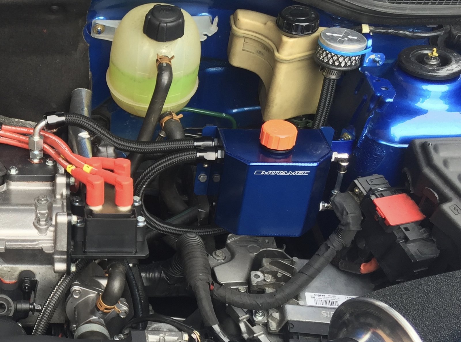

The new breather set up
Hi,
I love the connectors and hoses for the breather set up. Is there any chance you still have a list of what you ordered to make that. I have the same oil cooler and SM inlet and havent got round to ordering the connectors and hoses yet.
Also for the SM inlet ASH sell a really good 15 degree silicone 70mm id hose for the filter , you may need to cut a little of the old bracket it fouls on the car. Only thing is they only sell them in blue. Im still trying find a supplier that sells black ones. Its pretty much perfect though.
Cheers matey, it's mapped now, gained a few ponies but torque isn't where I want it so I'll have a play with cam timing and possibly look at the pure motorsport 45mm bodies,

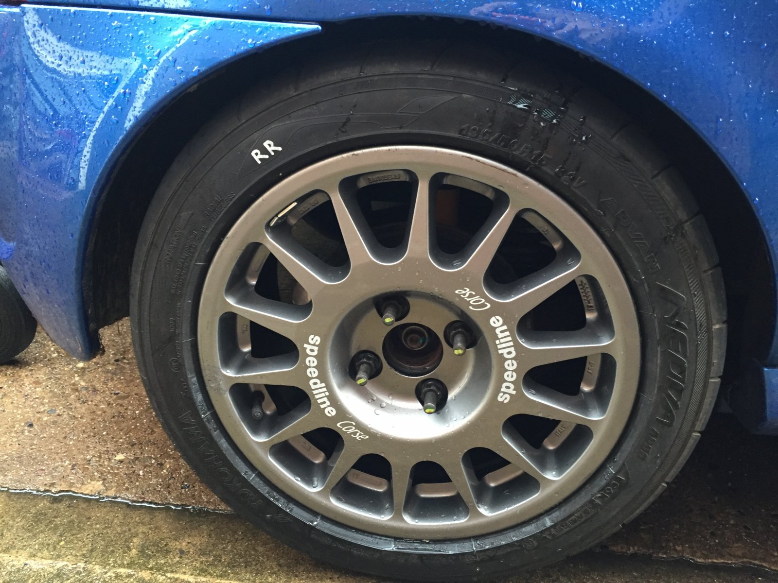

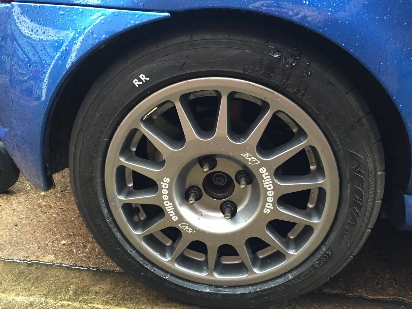

on another note, new road wheels are on :smile:
