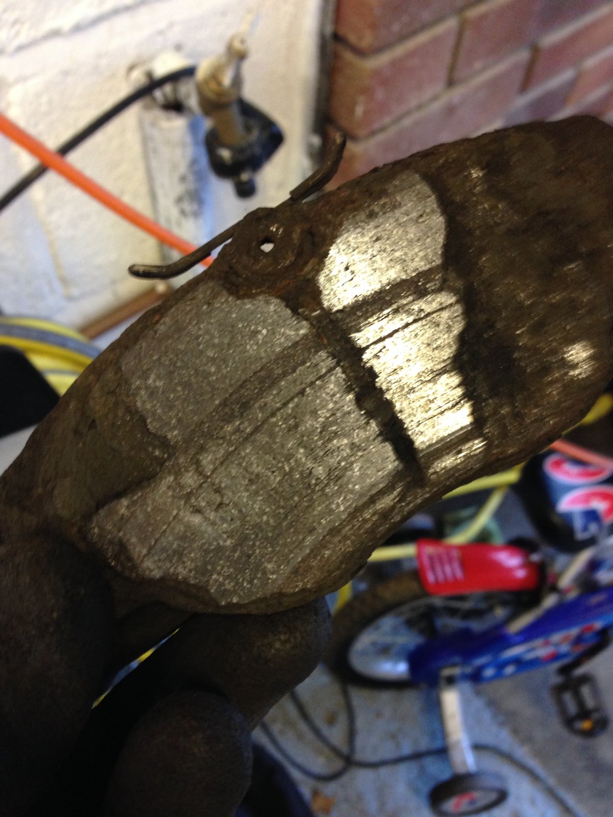

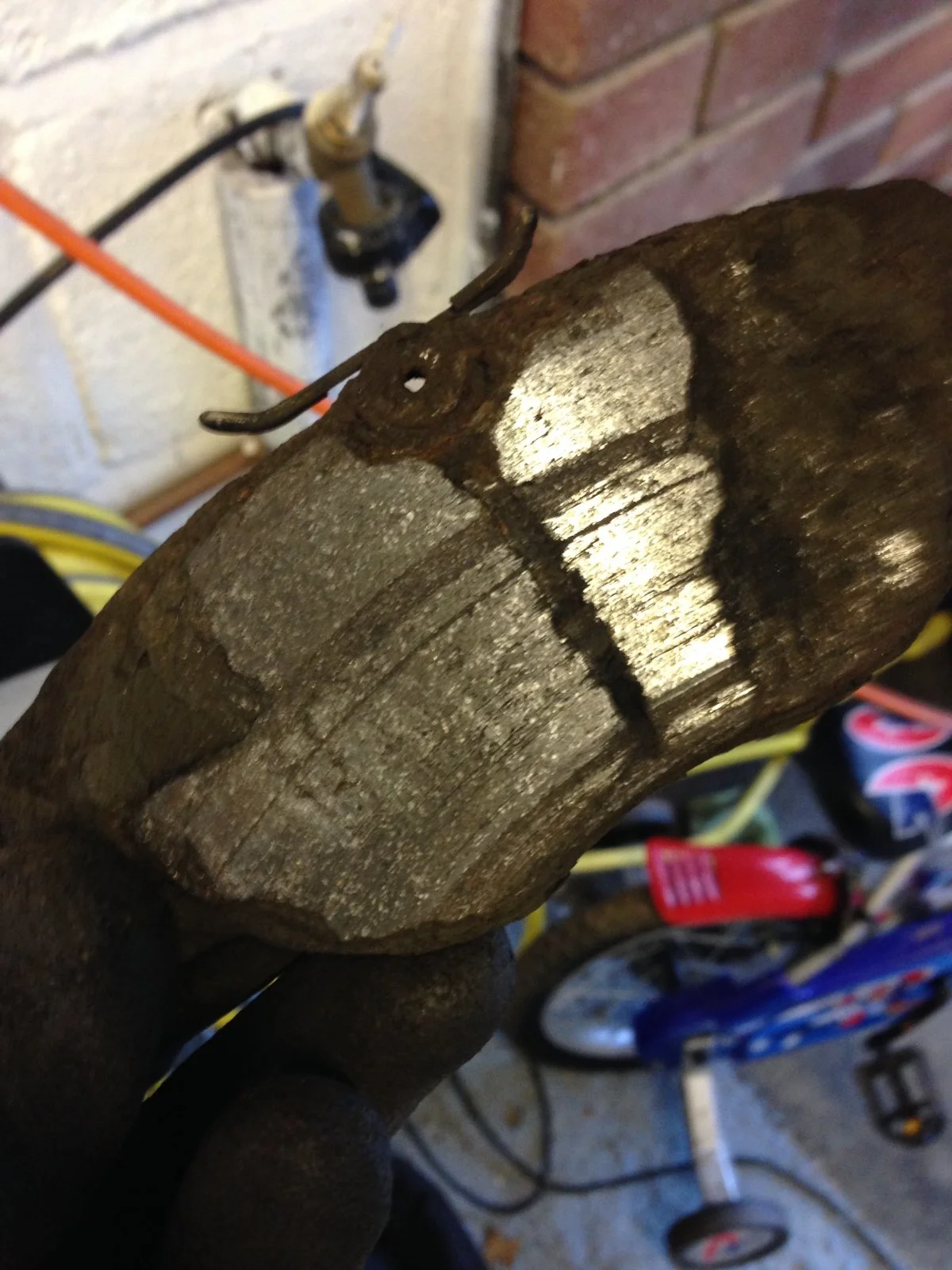

Why someone cannot ask a straightforward question about rear discs & pad fitment, without being fitted up with a set of £135 Ferodo DS2500 front pads, that won`t get near optimum operating temperature even when making a last second decision to pull off the A127 into McDonalds, within 4 posts , I don`t know.

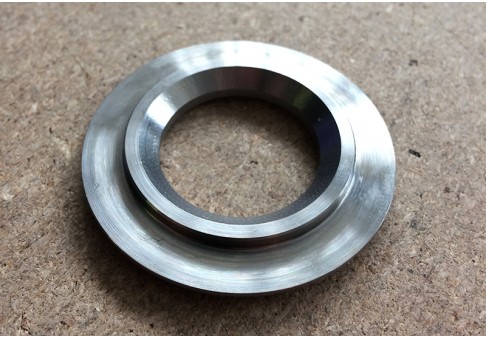

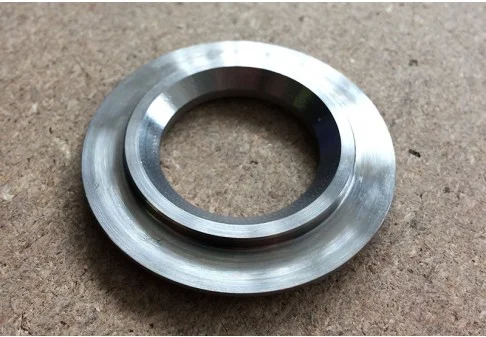

Who ever gets the pleasure of doing the work, make sure they pull the spacers off the back of the old discs, and the flat face butts up to the disc bearing.

Check the little spacer washers are fitted and refitted the correct way (Tapered side Towards car) and re-torque to 175nm, this is important for the life of the bearings in the discs. They have been discontinued by Renault but I have had my own made up locally and have lots on the shelf , and will stock them going forward
