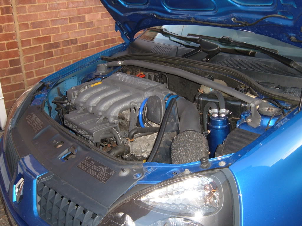

Heres mine painted with the Renaultsport bit part polished. Took me half hour to prep and paint it, dries really quickly.
Looks much much better than hammerite/powdercoating it.
