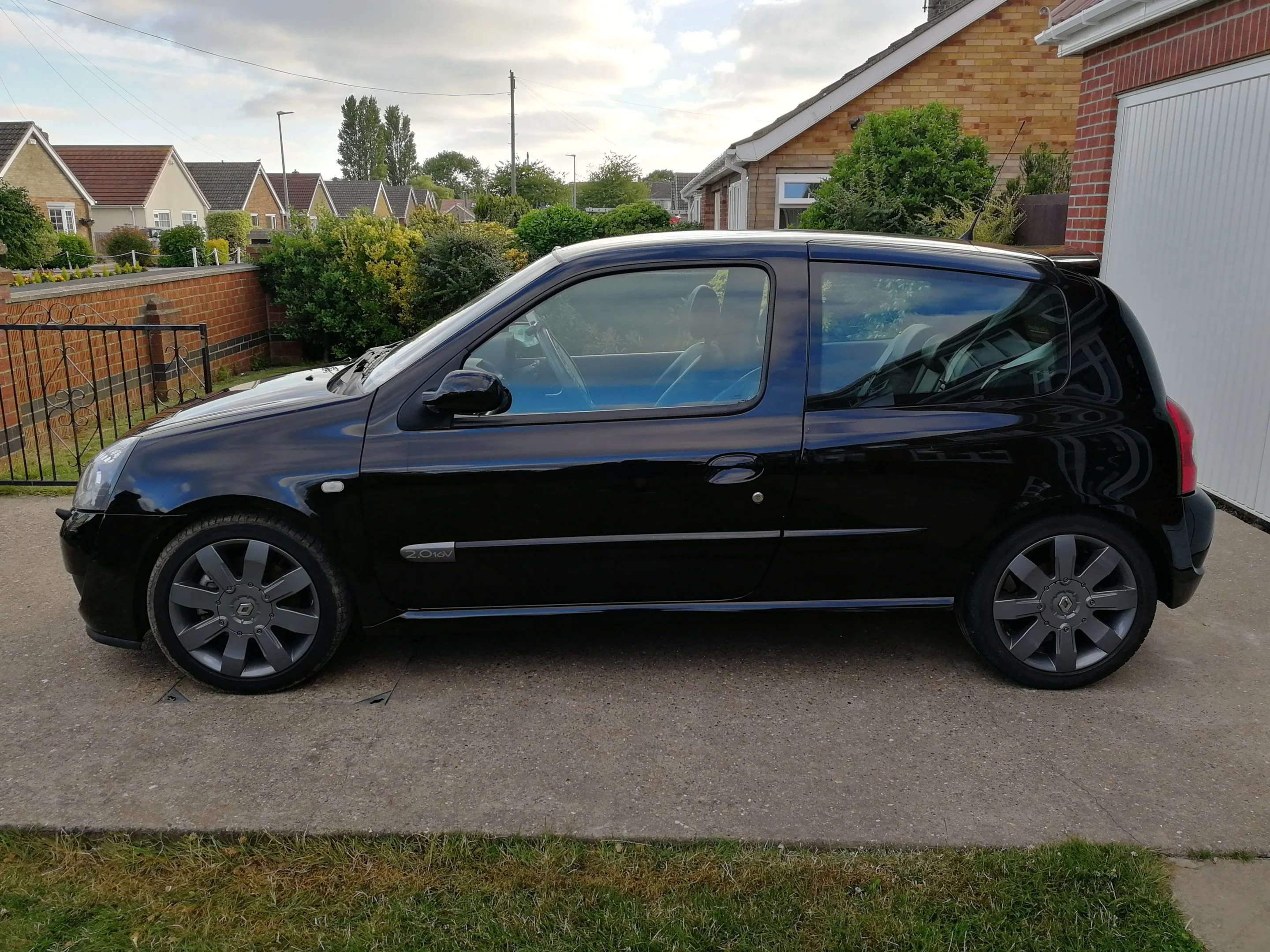

BG 182 FF daily.
I bought this 182 with the intention of tracking it but it really is too good.
My old Saab 9_3 was getting long in the tooth so I thought bugger it why not make the 182 my daily!
The Saab sold within an hour!
On with the daily... ?

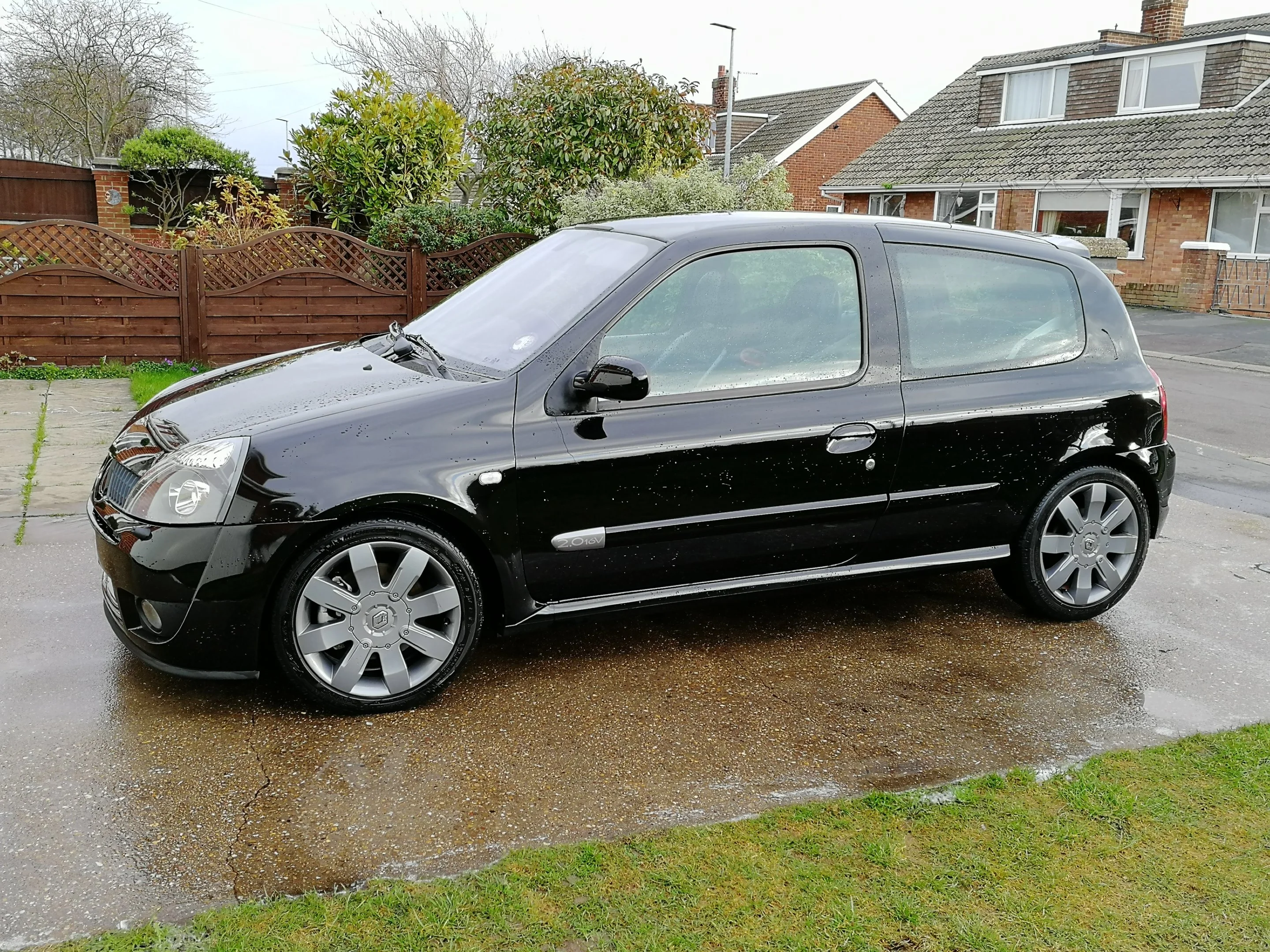

So far it's pretty much just had service items.
Given its been stored for approx 5yrs it's pretty mint.
So far I've done the full service all fluids genuine... cambelt/dephaser belts etc etc. Again all genuine parts, this was due to time rather than the milage (33k)!
