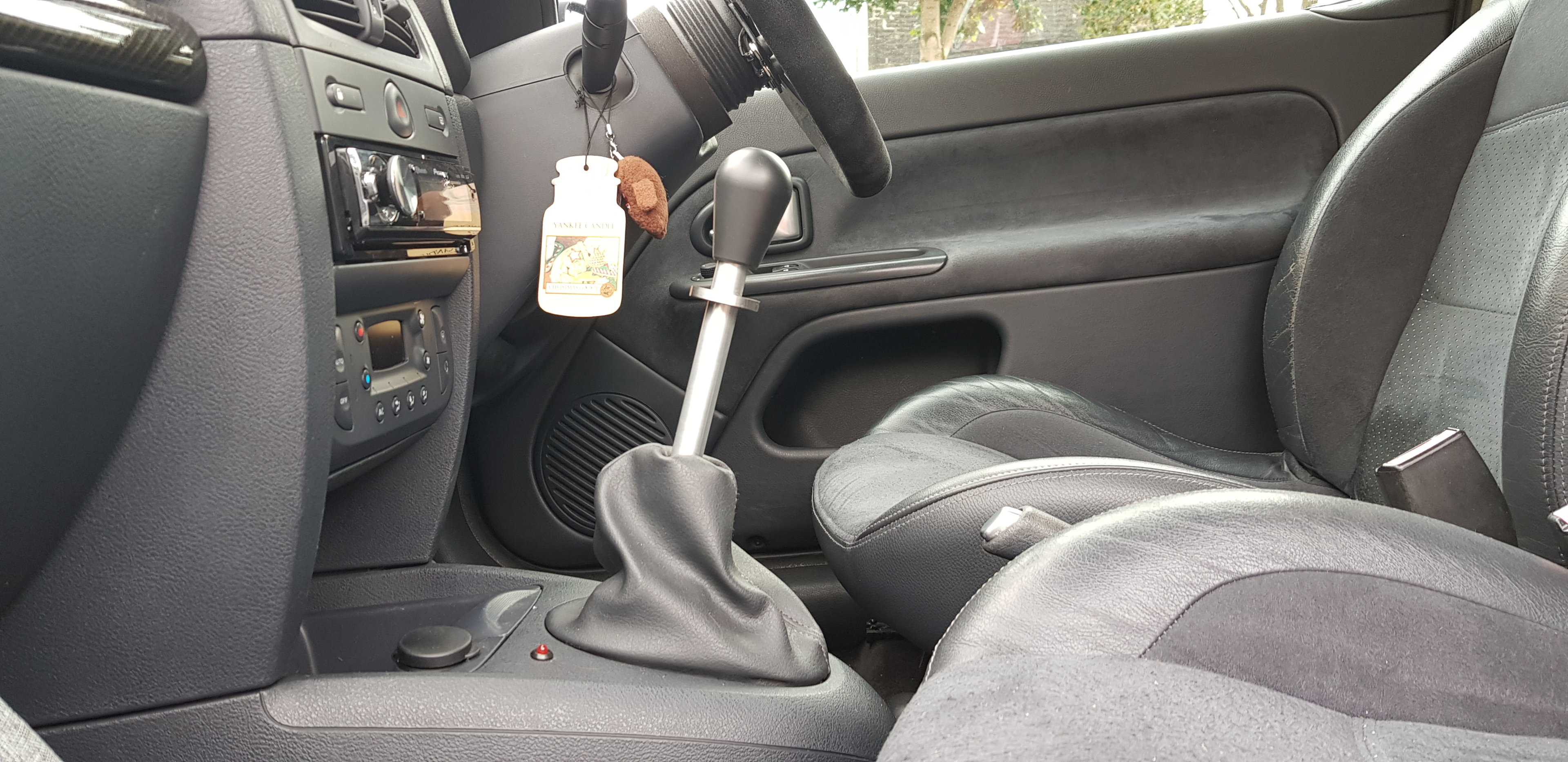

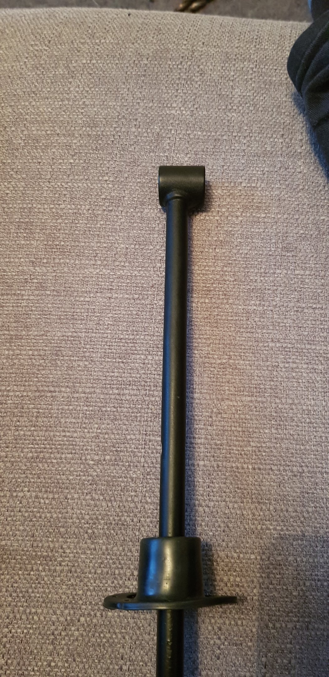

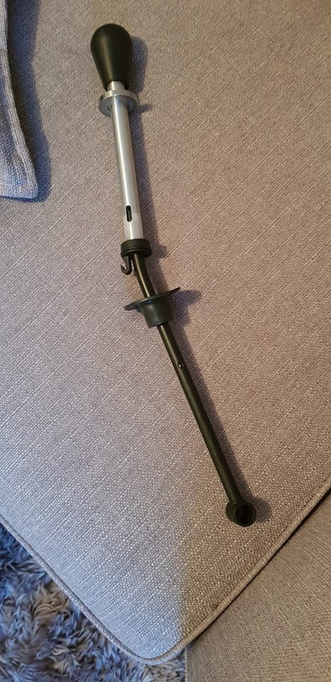

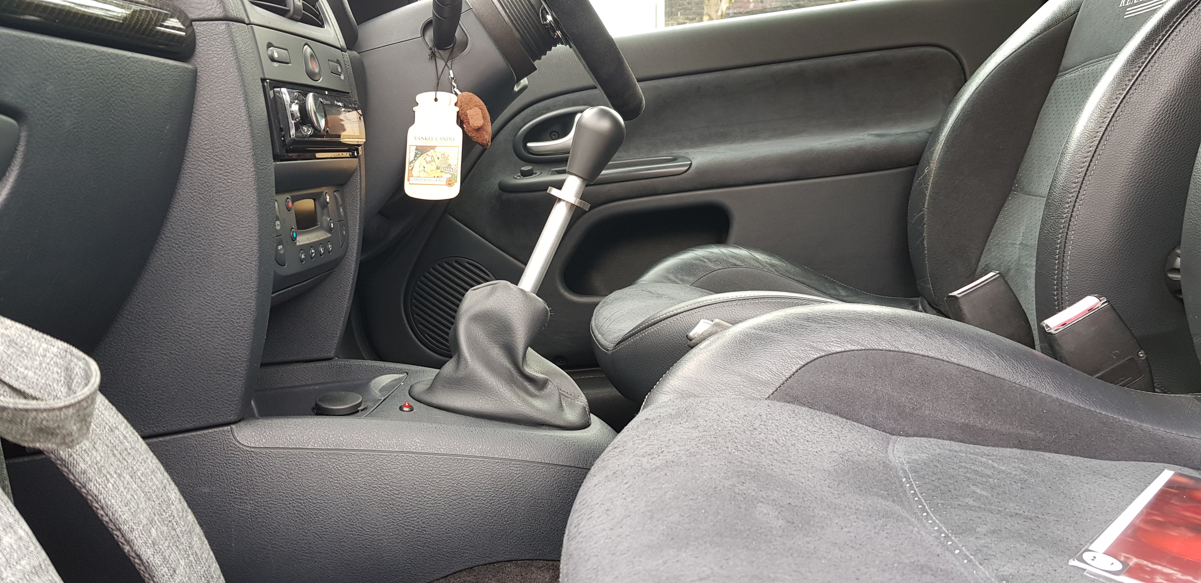

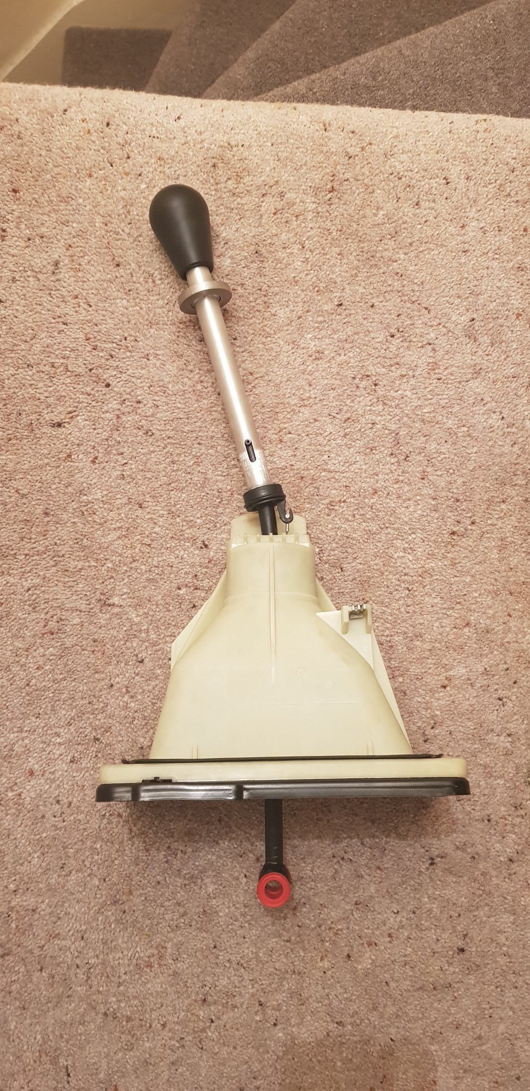

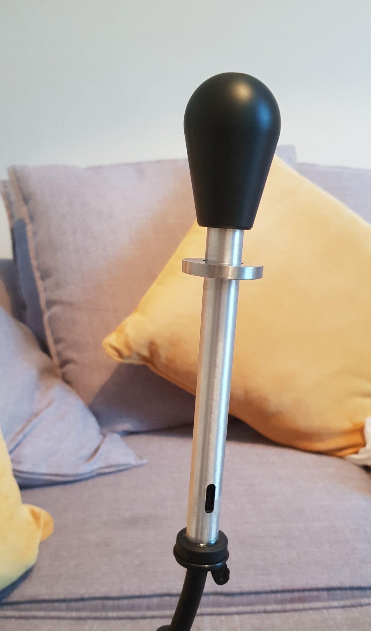

My shifter is coming along now. Going to re-assemble with red rubber grease on everything then get it fitted. Hopefully it's stiffened up slightly too but time will tell.
I fully mig welded the bottom extension id previously tigged, ground it back and painted.
Louis
I Love Ed Sheeran

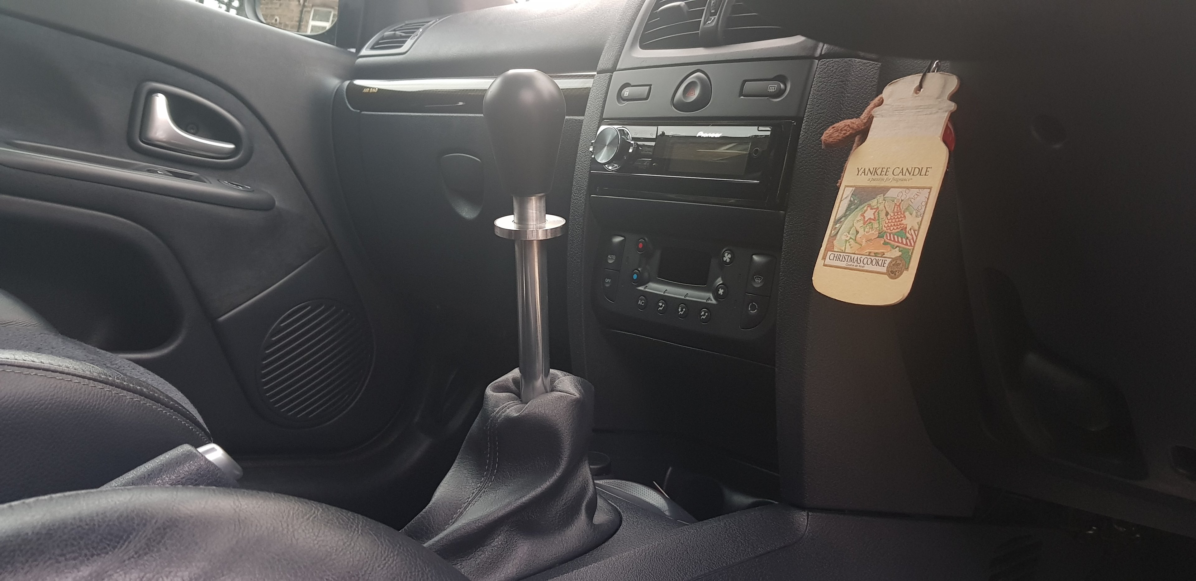

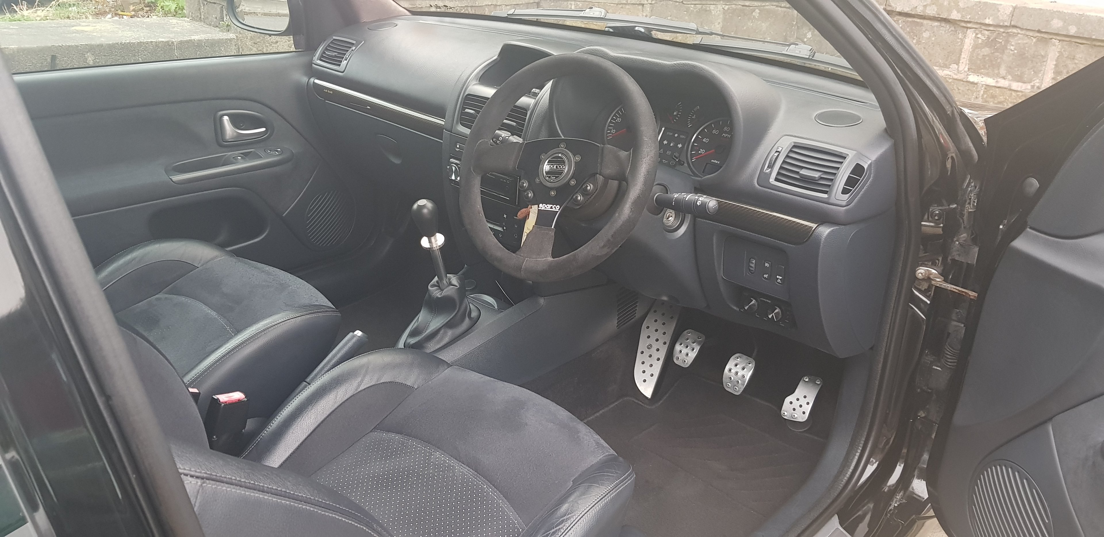

Fitted today. Feels great! Still have some left and right play when it's in gear but it's loads better than the OEM shifter!
Do people have the same slack with the BMS?
This is stiffened up with an O-ring inside the plastic ridged ball and around the outside of it.
  dan's cast offs.
the rubber ring is normally floppy in the housing, get it out and get a loads of silicone etc at the top of the housing and around where it sits. fit it back in and get some more silicone in if you can, next bit you need an extra circlip, fit one but instead of letting it fit in the groove go past that and then fit the second circlip, this normally tightens things up a bit but with the standard set up it's never going to be amazing.

That's not a bad idea, @dann2707 said the BMS ones use an o ring to squash that rubber housing more. I presume this is why the yanoo gets rid of the slop.
I've enquired as to some PTFE shims that replace that rubber housing that used to be run on the Laguna cup cars. It feels much better than the OEM one for now and I'm chuffed. I know PMS is the ideal way to go but for the money it cost me to make this myself I'm proper happy!

am sure you could find a spherical bearing and just make a sleeve for it and set it up that way.

Just go hard and go home and use a Spherical bearing, you’ve already made it nice to look at so make it decent to use... then I can give you some money and you can do mine at the same time [emoji6] x
It feels great as is! Maybe something for the future but its not an overly 'mechanical' feel which I like, just is tight into each gear.

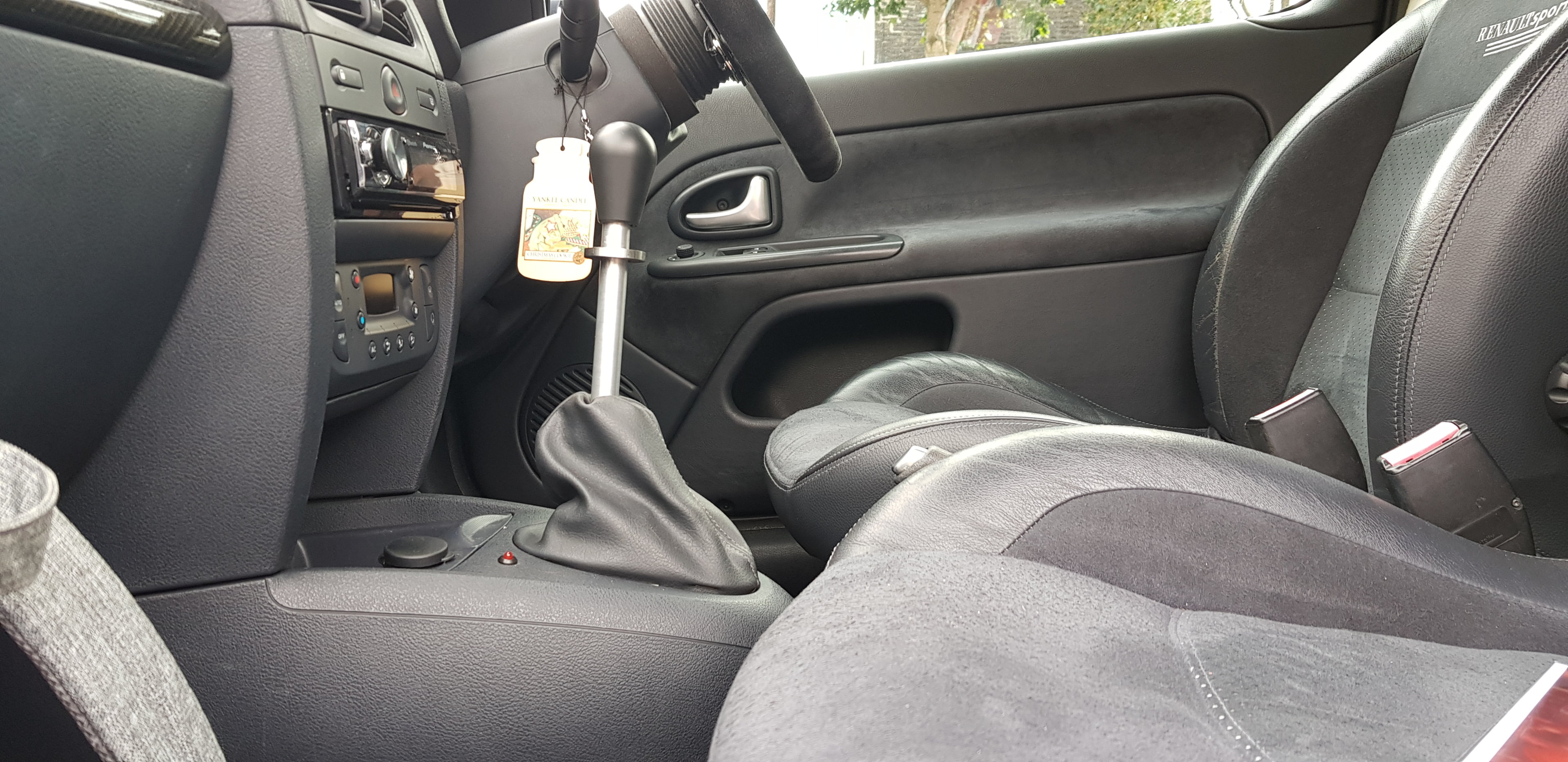

I need to get my scenic stick put together and in. How much did you bend it by Louis? Take some pics with it in gear for us please.
Will do tonight if I remember.
It could probably have done with being bent a tiny bit more but it's loads better at the minute.

Neutral
4th
3rd

Looks spot on that Louis. I've bent mine to 25° which looked about right when I drew the angles out compared to the standard stick. Will have to wait and see how the height affects it.

It feels perfect. Next up is replacing the bushes in the linkages which should help even more
Does this help? I didn't really do it to a specific angle, just by eye.

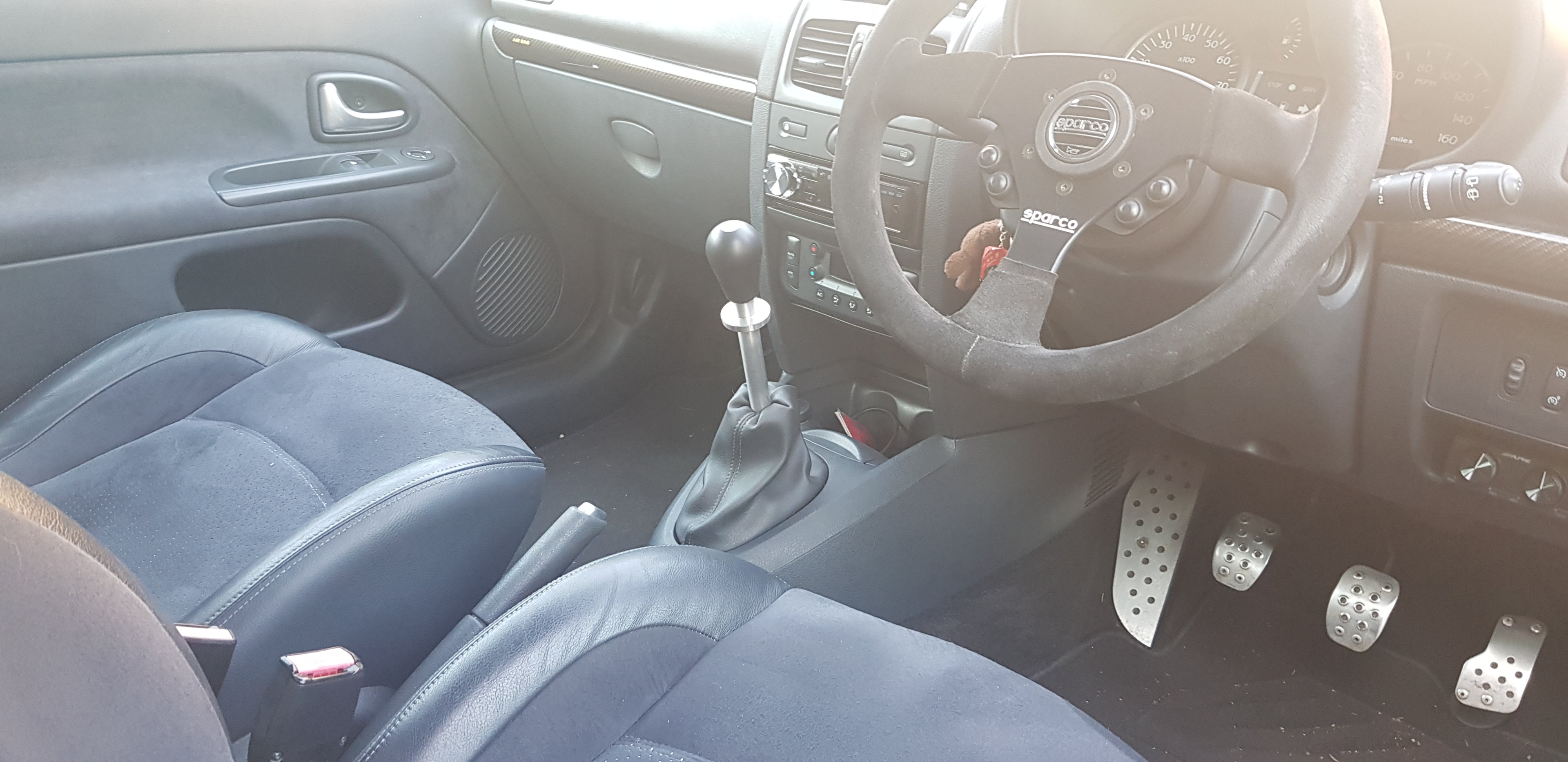

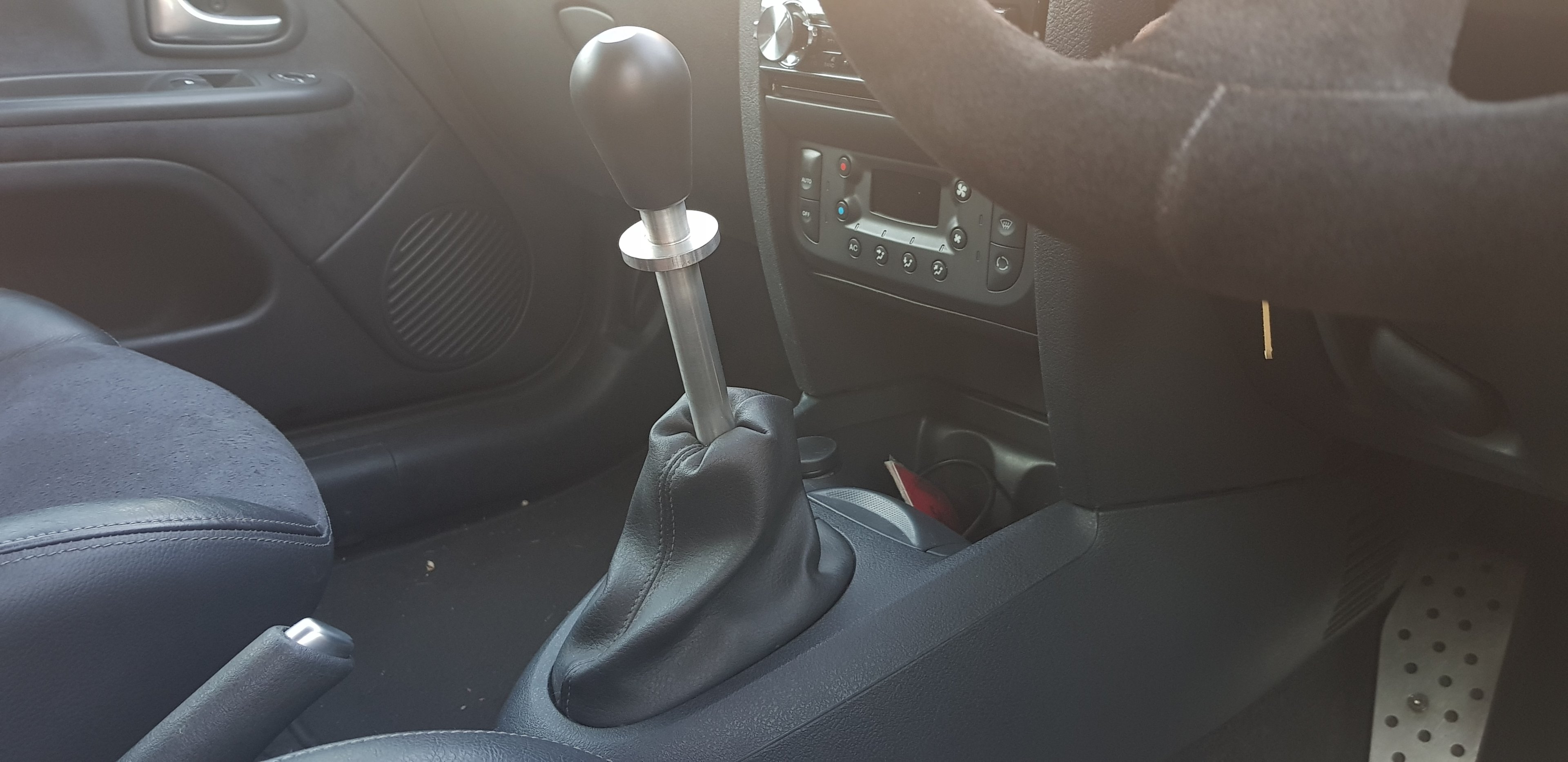

Gear shifter received a polish with silvo whilst I was at it. I'll be taking this out soon as it has some vertical play which I want to sort out.

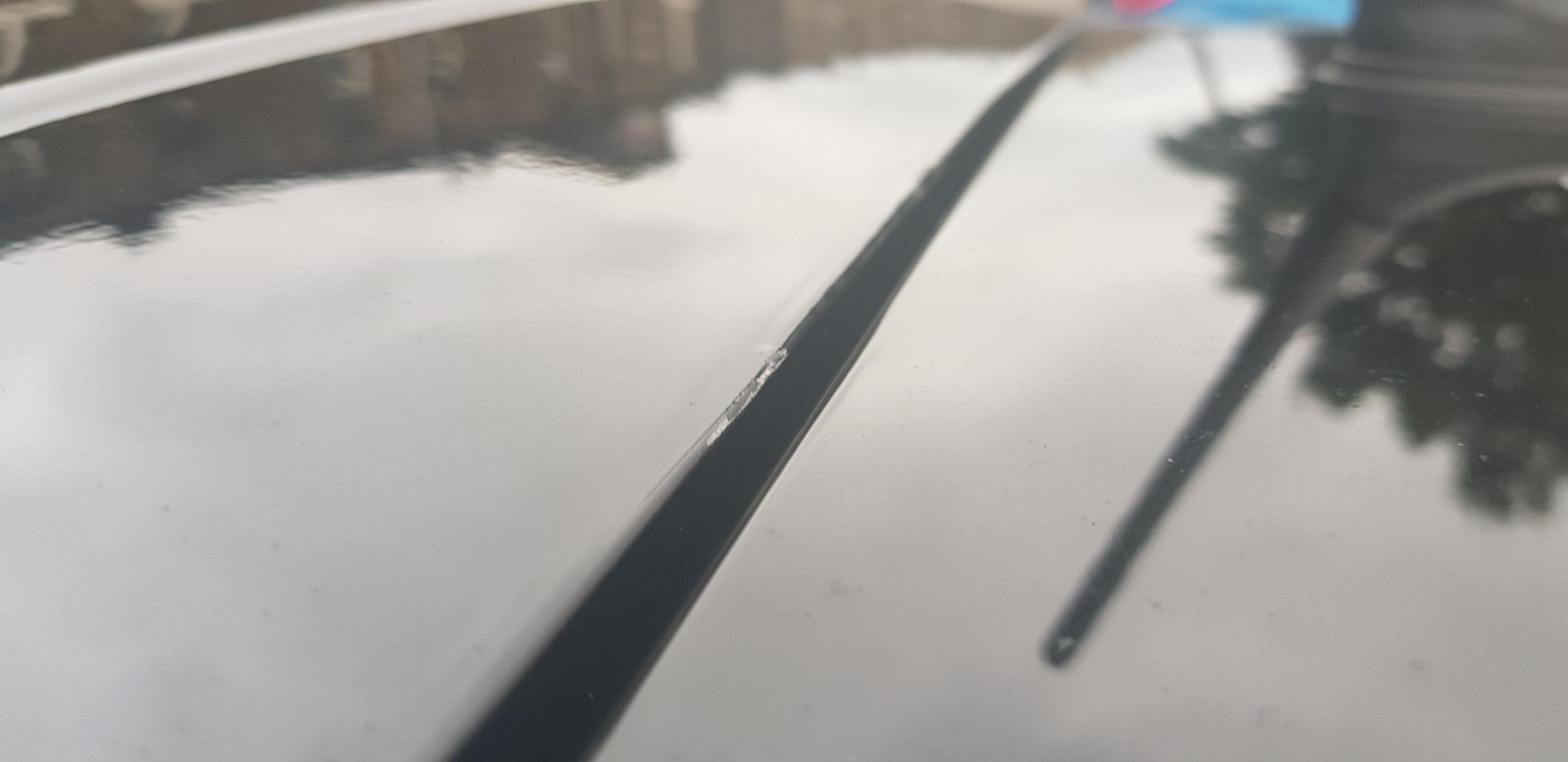

Frustratingly the spoiler started catching the roof on one of the really hot summer days and took away some of the paint. It's fine again now without any adjustment so must have been the high temperatures causing the problems!

Did you get the shorter boot struts I mentioned?
I got BMW ones mate. Its not those that were the problem as it caught within a few cm of going up.
The heat must have warped it slightly at the back as it's so close. I could smell my car from about 100m away because of all the fibreglass at the time
