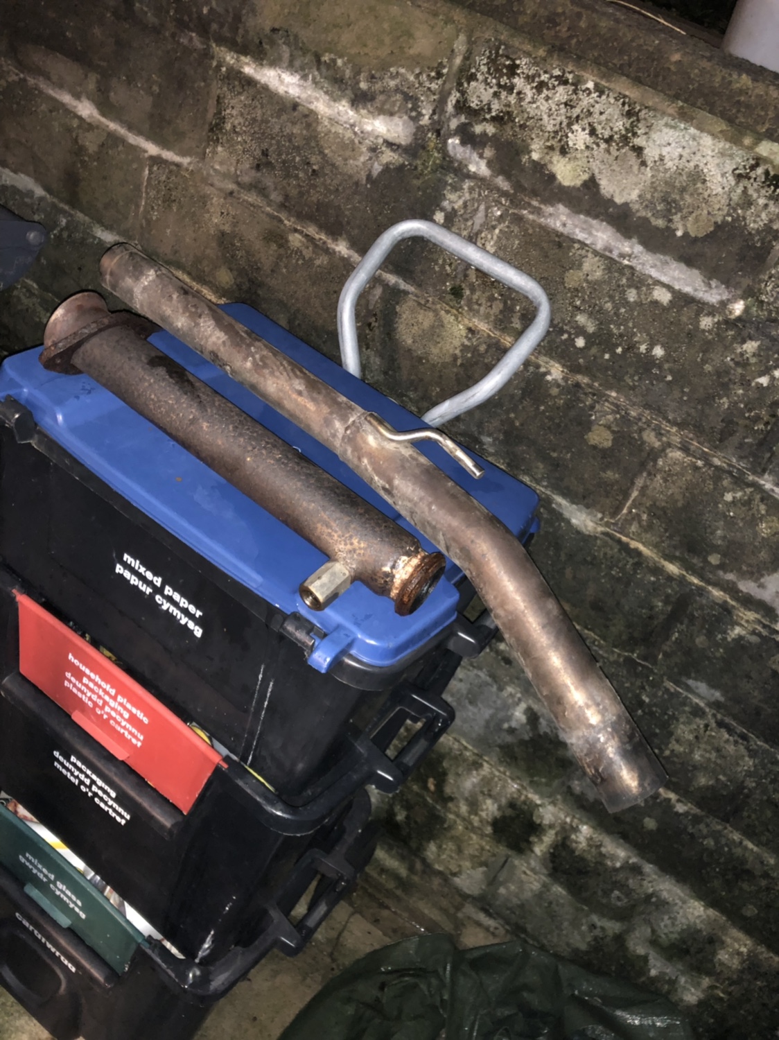

How does it sound & drive like,before & after decat?
I've always had a decat mate, it's just that the flange was all bodged on the manifold so was blowing really badly and also cracked at the back.
It feels better now it's not blowing but can't comment on how it compares to cat. Not run one in ages and never with this system!

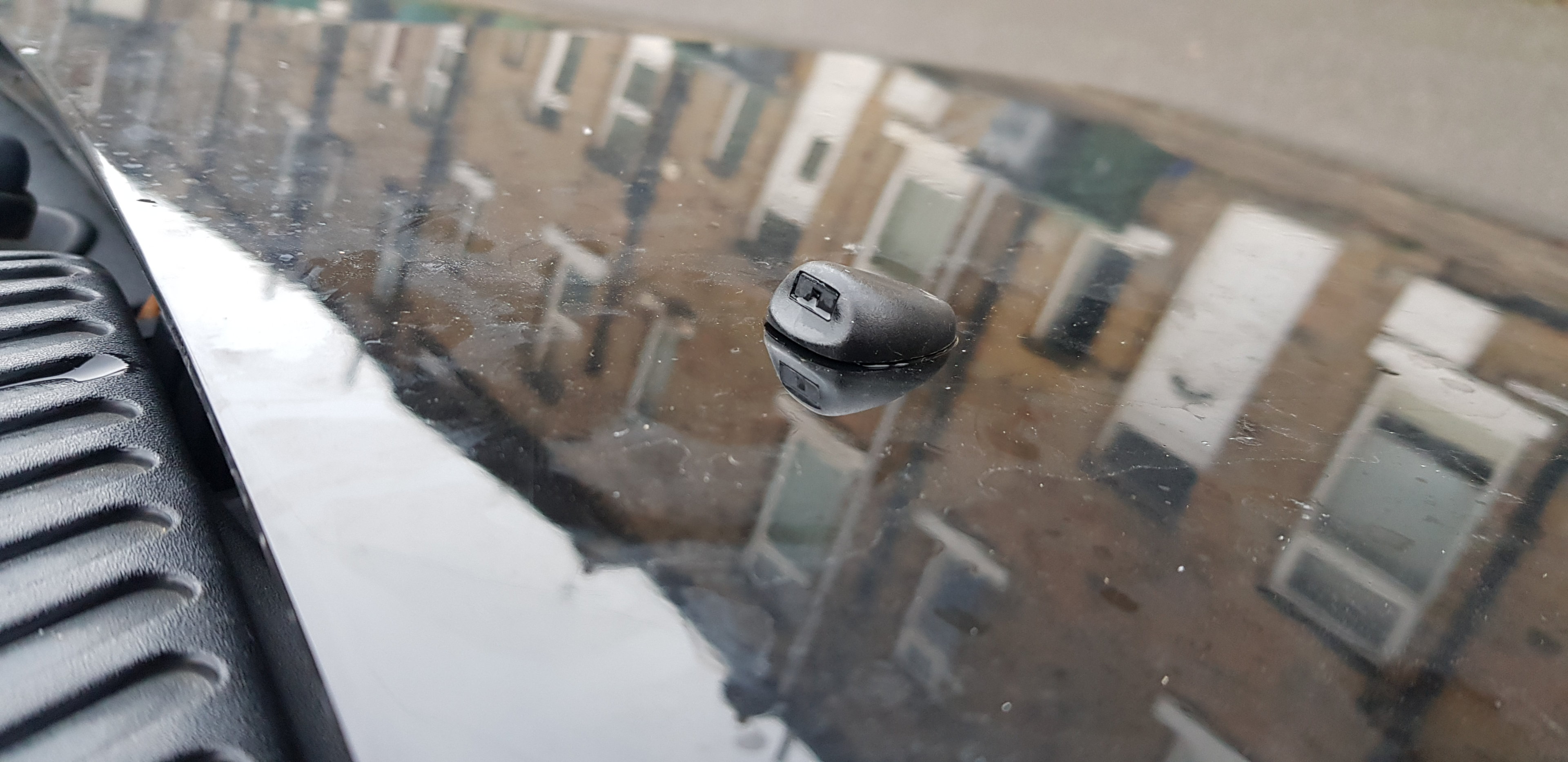

Swapped over the washer jets for those Alfa mist ones and annoyed I havnt done it sooner! They're loads better and it's literally a 2 minute job to change. They've been sat in my parts pile for a while as I put it off thinking I had to remove sound deadening lol.
Actually clean the whole screen really well now.

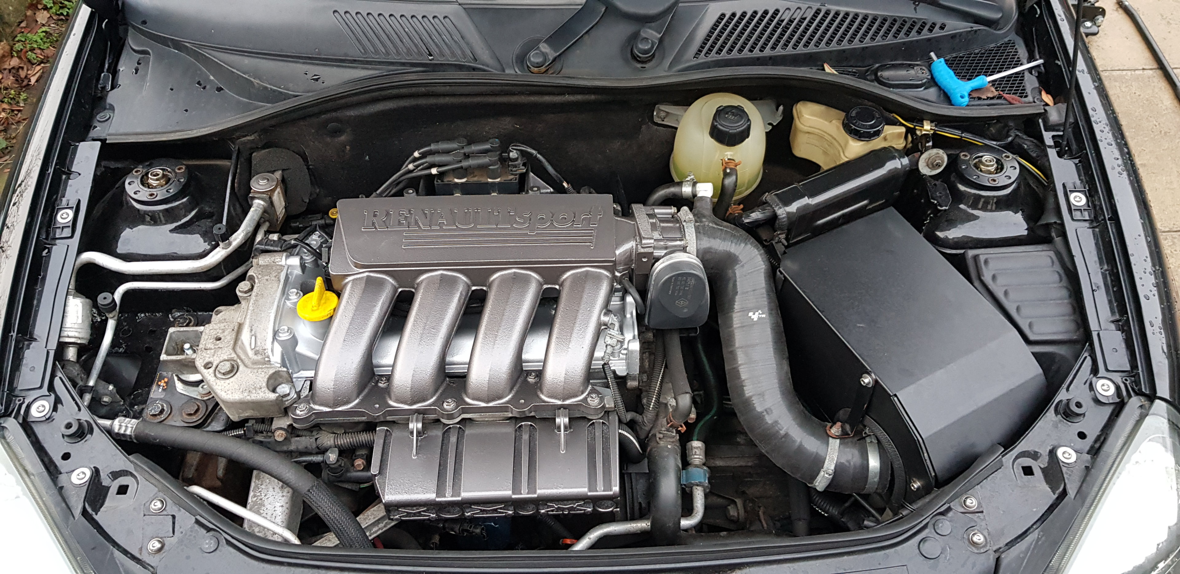

Quick picture of the unfinished bay but should look good when I do the engine mounts properly. Had no time!

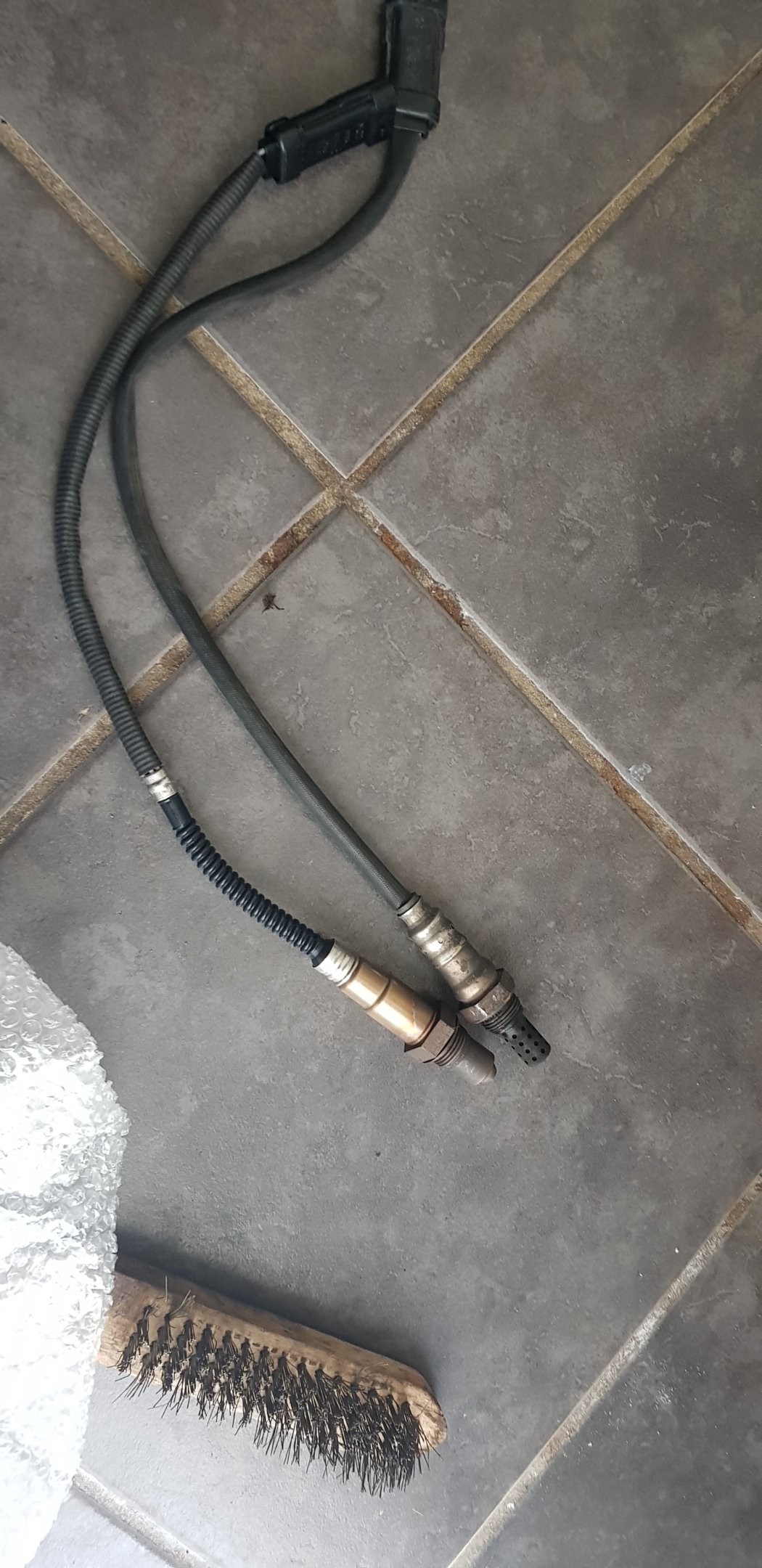

Also been having an issue with slightly rough running and the car revving itself when coming to a stop (clutch down revs come up at slow speed).
Swapped over the precat lambda with a genuine lambda (but may be having issues with this too, will explain later!) Noticed it was none genuine and just a generic eBay one so glad I swapped it.
Whilst I was there I also loosened off the decat and engine mounts and shifted the engine forward slightly before retightening.
Did improve things and gear changes are much nicer. However the blip is still there!
Went over to see @bloke who worked his magic and plugged it into clip to check live data. Everything seemed normal but the lambda is graphing quite slowly so I'm going to just buy a brand new genuine one. This was only meant to be 200 miles old but it's obviously not right. I'd rather change it for peace of mind especially whilst the lambda isn't seized up (Used a dob of copper slip when refitting).

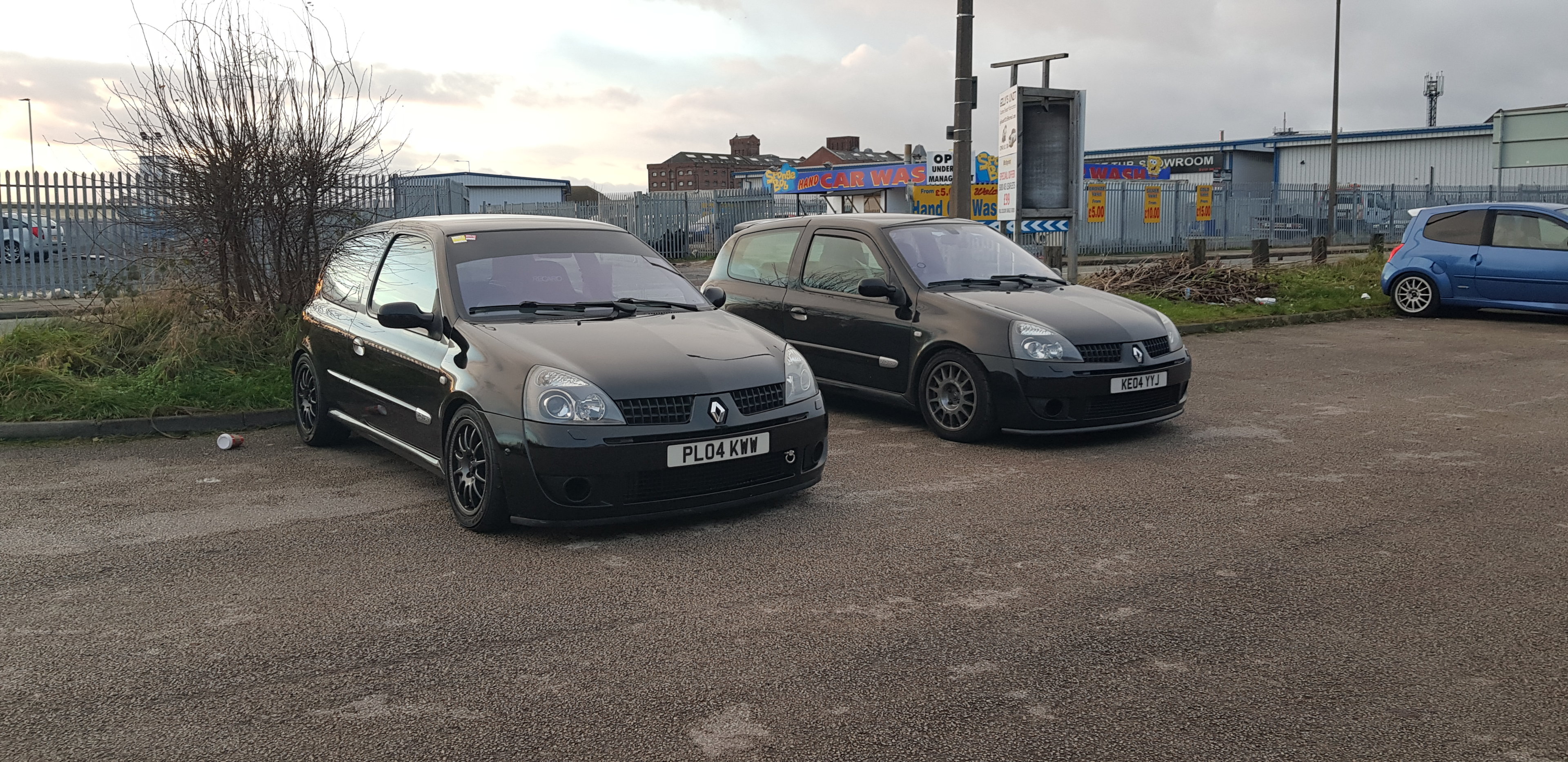

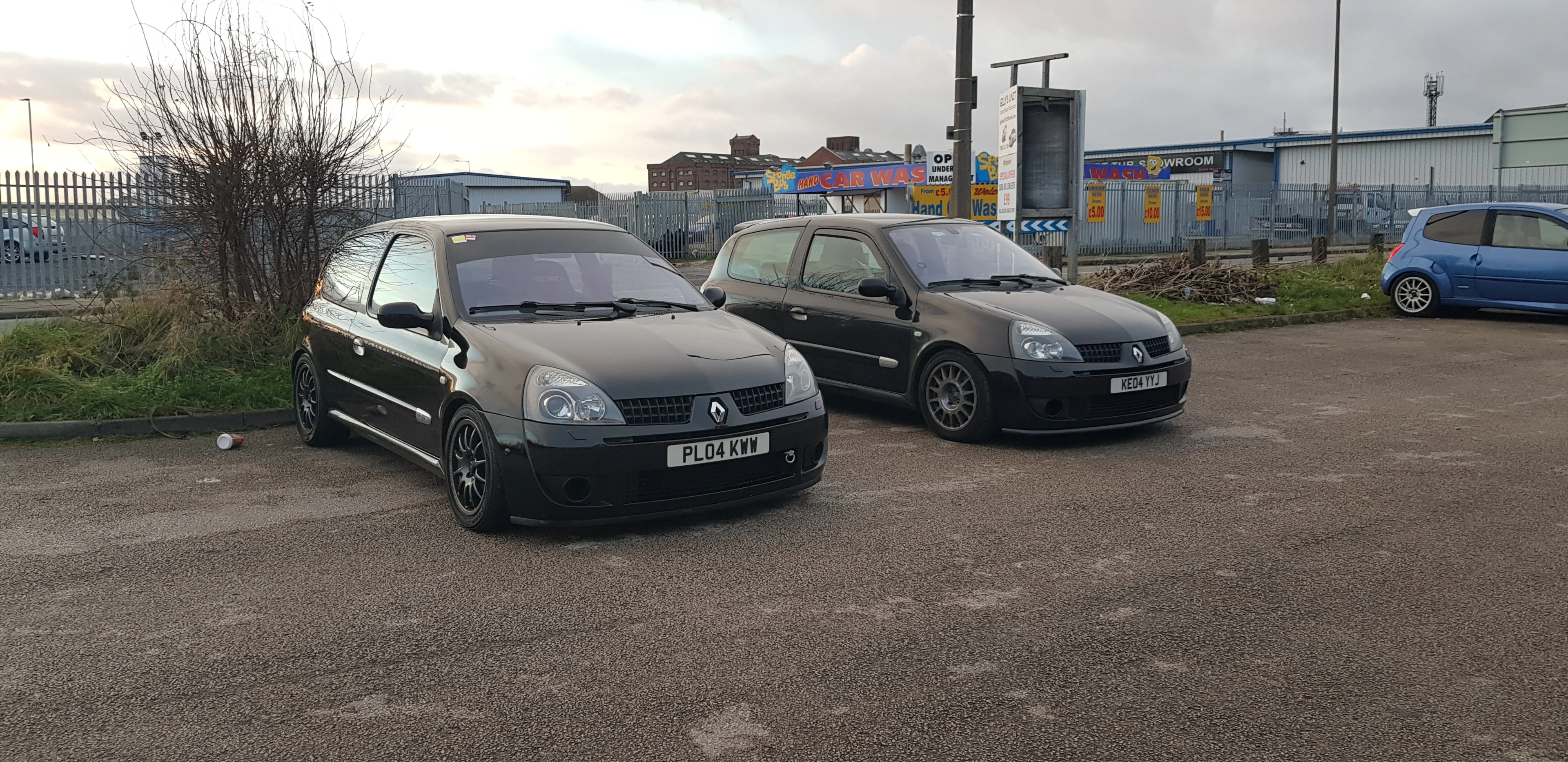

had to wait before i left as i thought three pb cars all pulling out together could look a bit sad ?
Hahaha, sounded like a photo opportunity to me ?
You'll have to take me out in that boosted BG! Niall said it goes mint

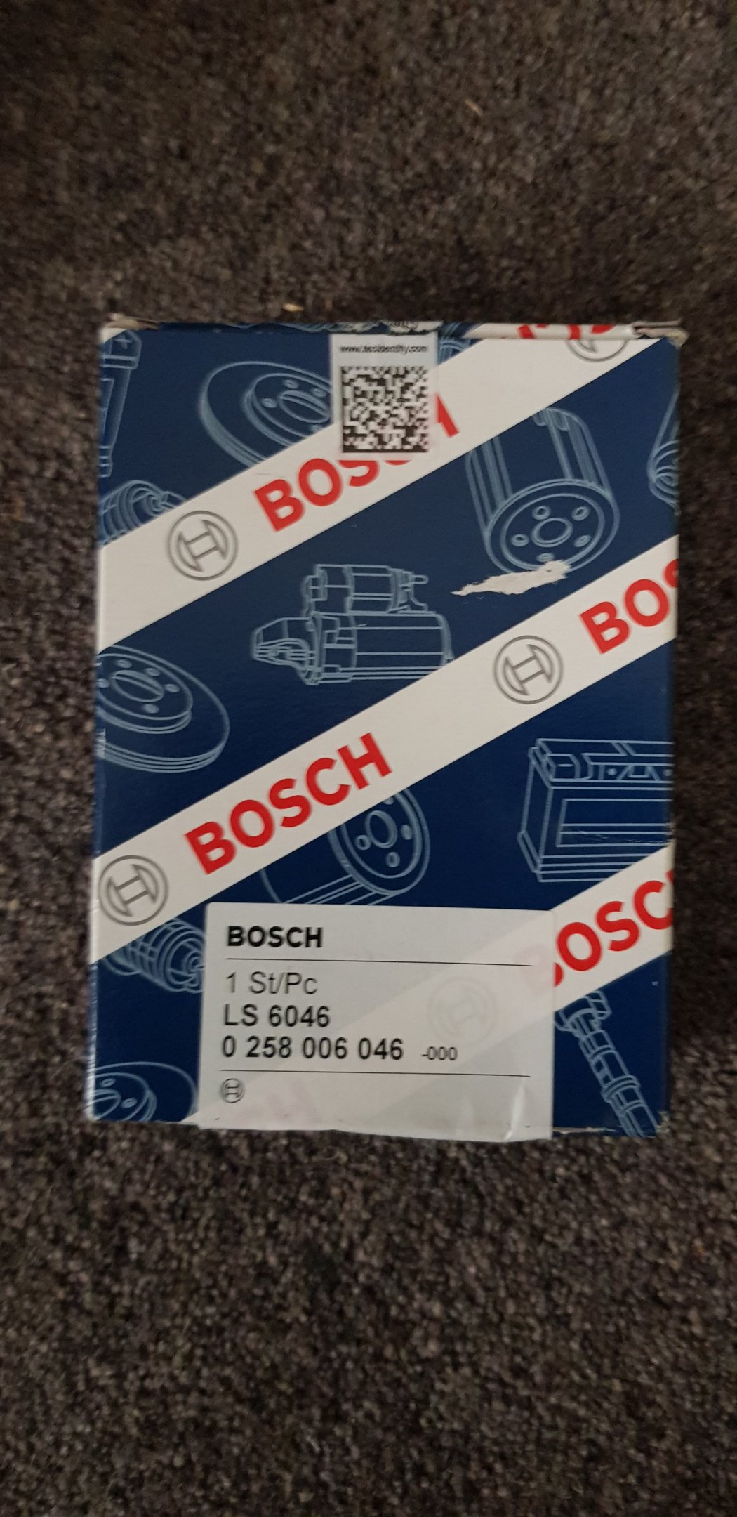

Fitted another brand new genuine lambda after Carl said the other was graphing slowly. Fingers crossed it solves my issue!

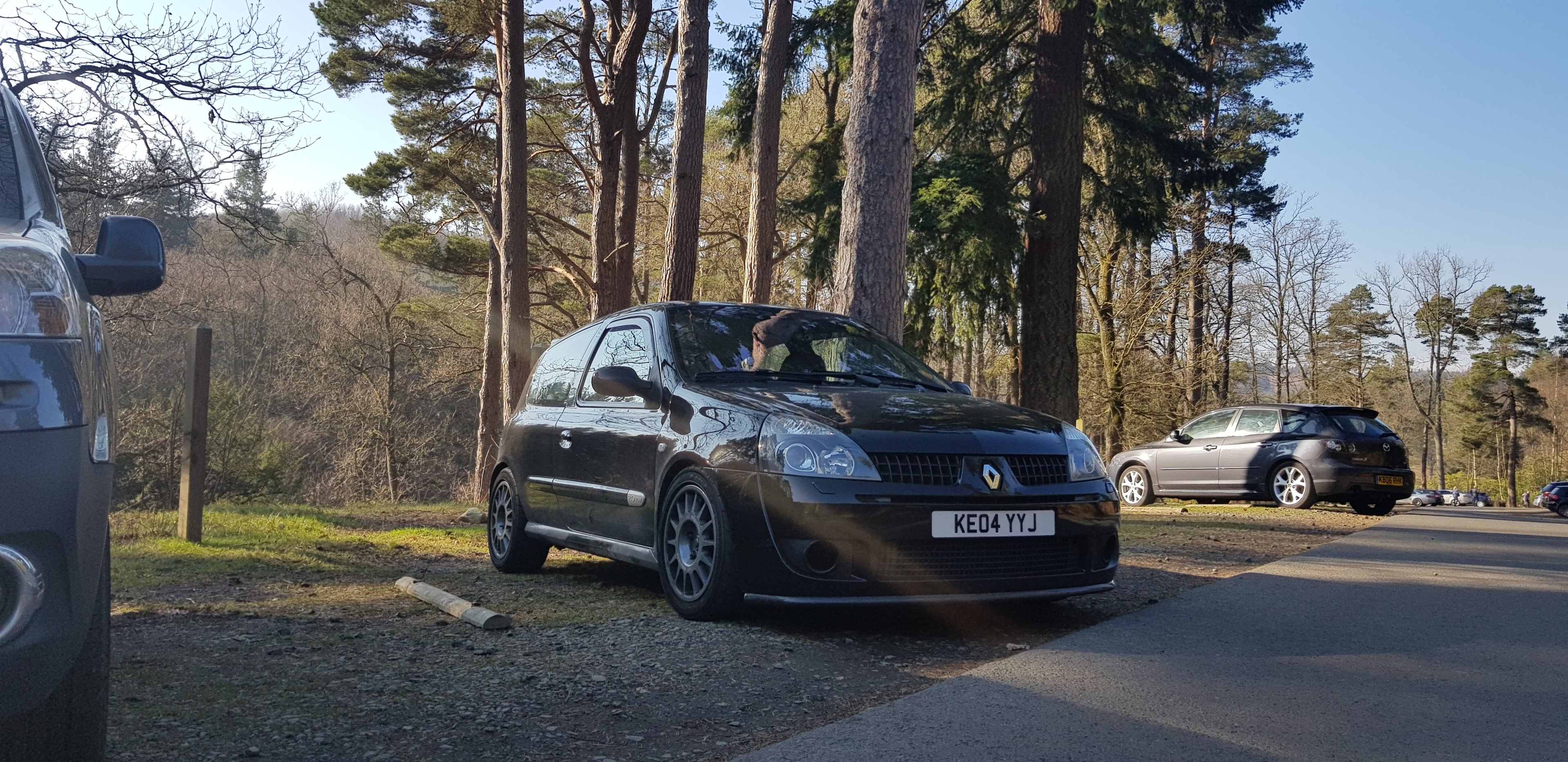

Been to cragside today, roads are ace near here. Always get stuck behind some oldies doing about 20 in a 60 though. Make me feel like a yob passing them on the limiter ?
Another downside are the pot holes, hit a few bigguns! Will all get a refresh soon anyway.
Grabbed this picture, car is filthy but it will be after all the miles it's done!

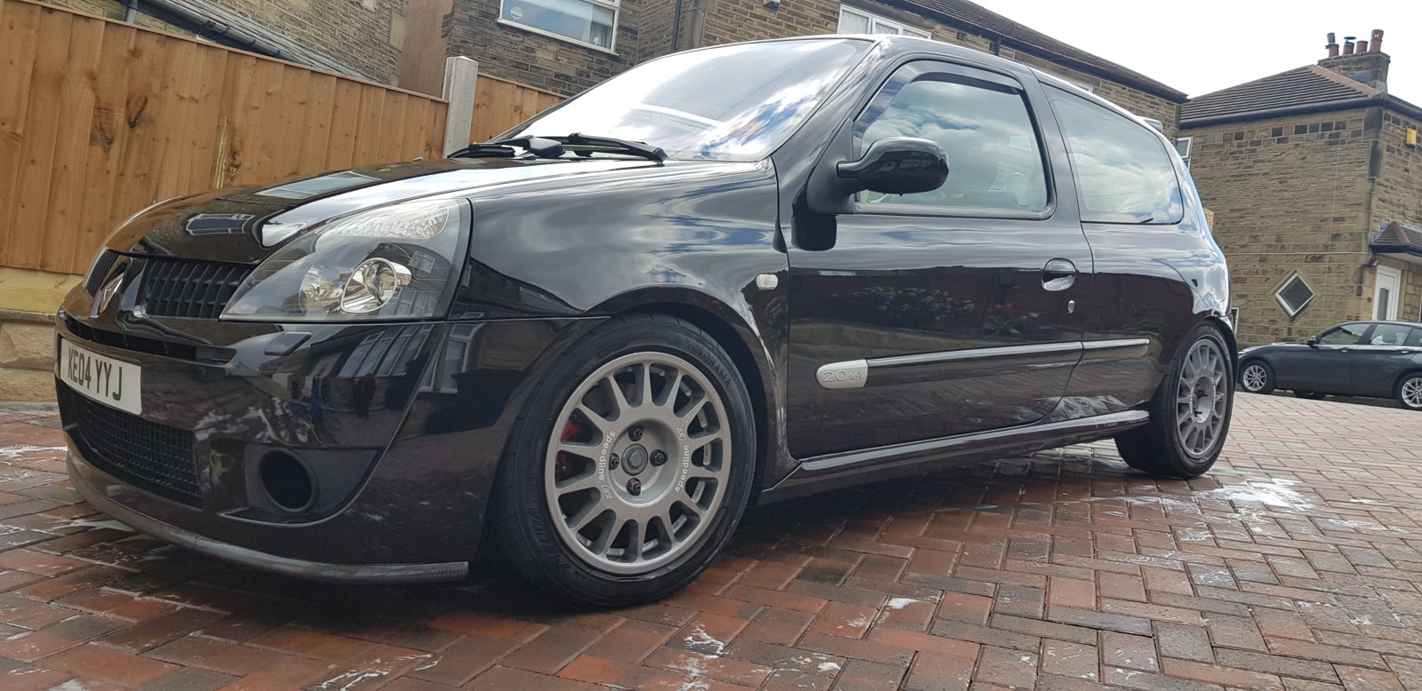

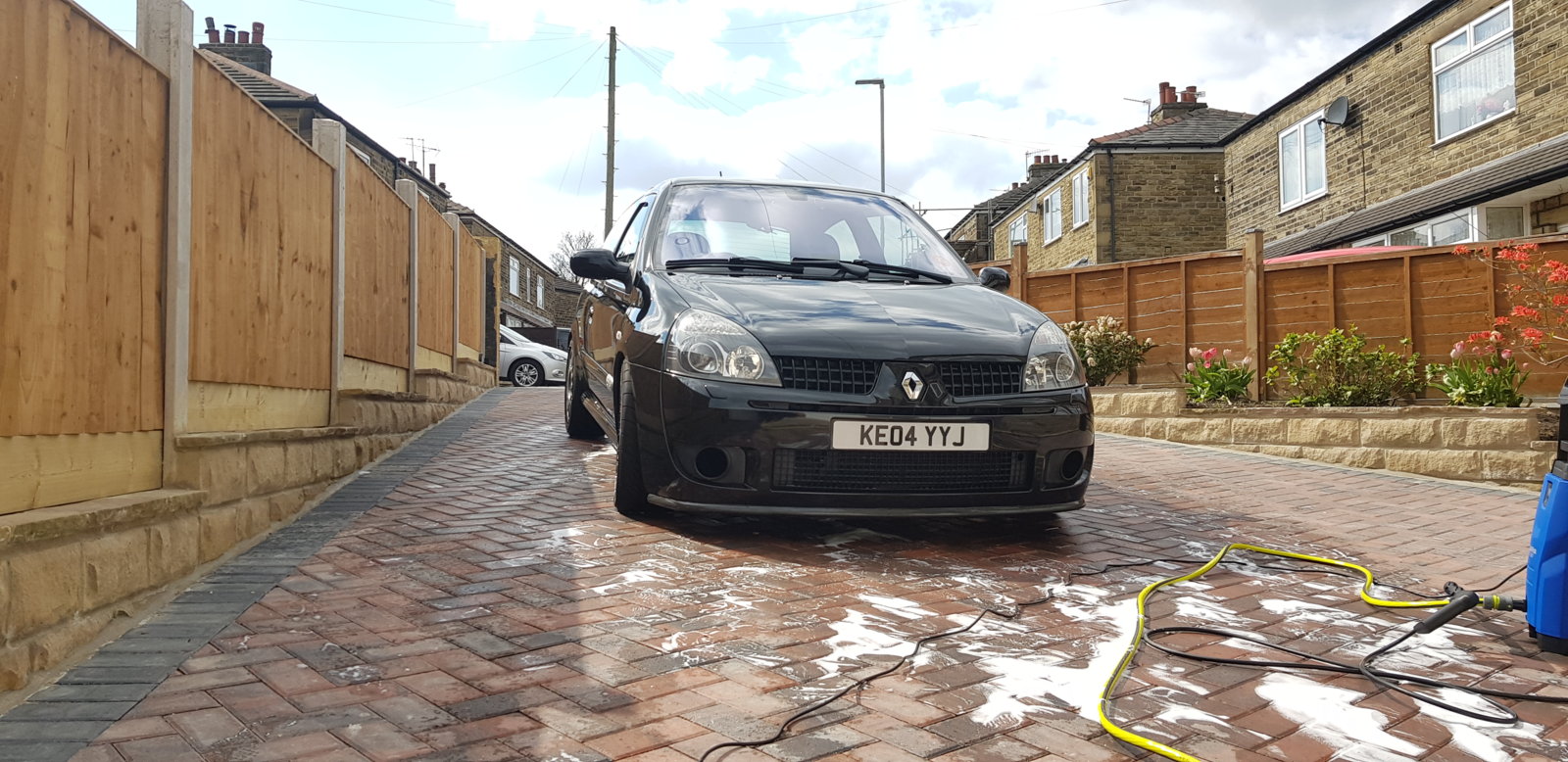

Moved house recently and I've finally got a proper driveway. Treated myself to a pressure washer and snow foam lance during the move!
Washed it after it being filthy for 2 months and used snow foam for the first time too. Decent for a pre wash and definitely helps reduce the amount of crap going into the wash pad.

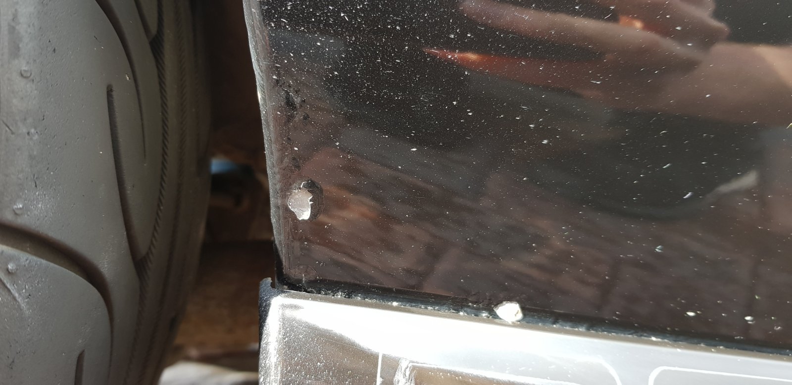

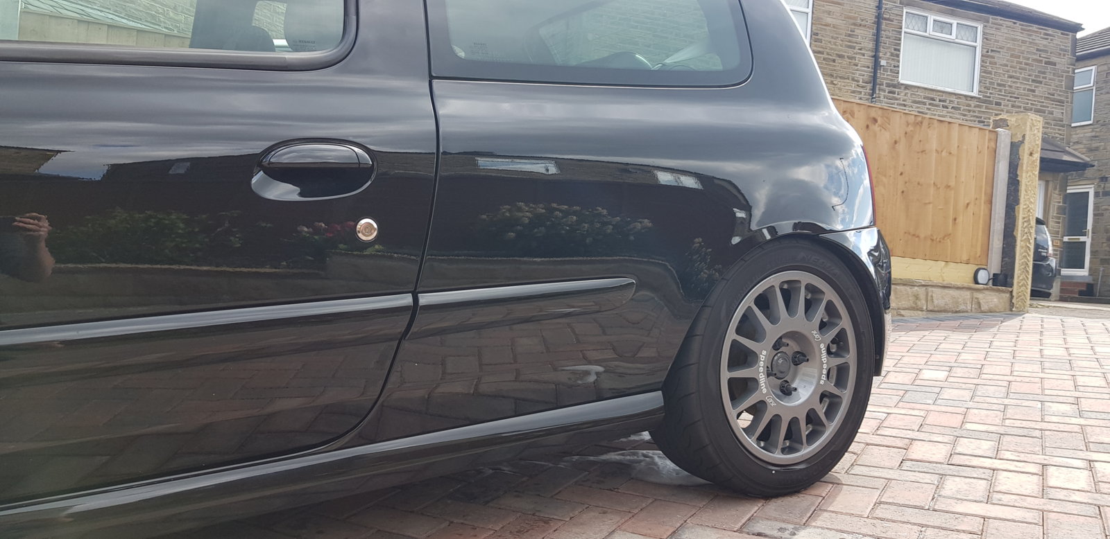

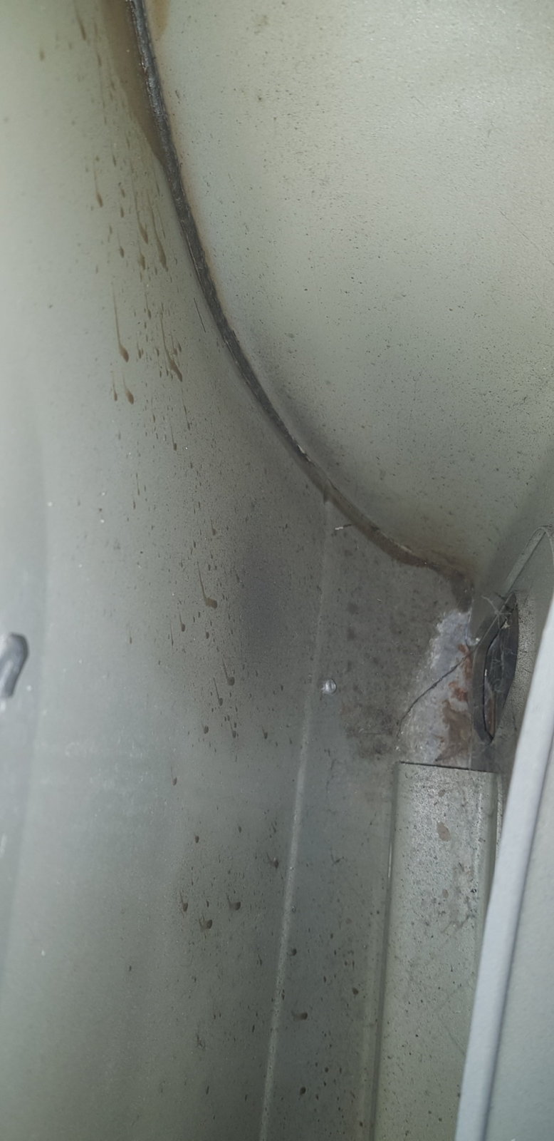

Unfortunately noticed this when removing the side skirt decals
Clean metal underneath so I'll treat them and touch it in. Bubblibg around the whole arch has begun so will be respraying at some point. Going to treat all the inside sill too so it doesn't get worse.
I like the stickers gone, makes it look much cleaner and fancied a change!

Get that rust treated and touch it up for now so it's not visable and covered and then get it painted. Has both sides gone?
Many man times.
I agree, they weren't real bright and they were the nicer style than the Ebay ones. Just makes it look cleaner with no stickers down the side and going to machine polish it when I get chance as it's full of swirls!
I used some iron out on it yesterday, cleaned, primed and touched in. Inside the arches aren't bad
But I will be treating it anyway. I think it's just 135k miles of stones finally causing it to bubble and peel!
To be fair other side isnt as bad which is odd

Congrats on the new place, driveway will be great for car stuff.
Car looks good considering the mileage and love the V6 post!
Cheers mate, appreciate the kind words. It certainly doesn't come up bad with only a wash! Not polished in that photo.

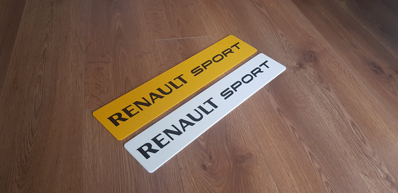

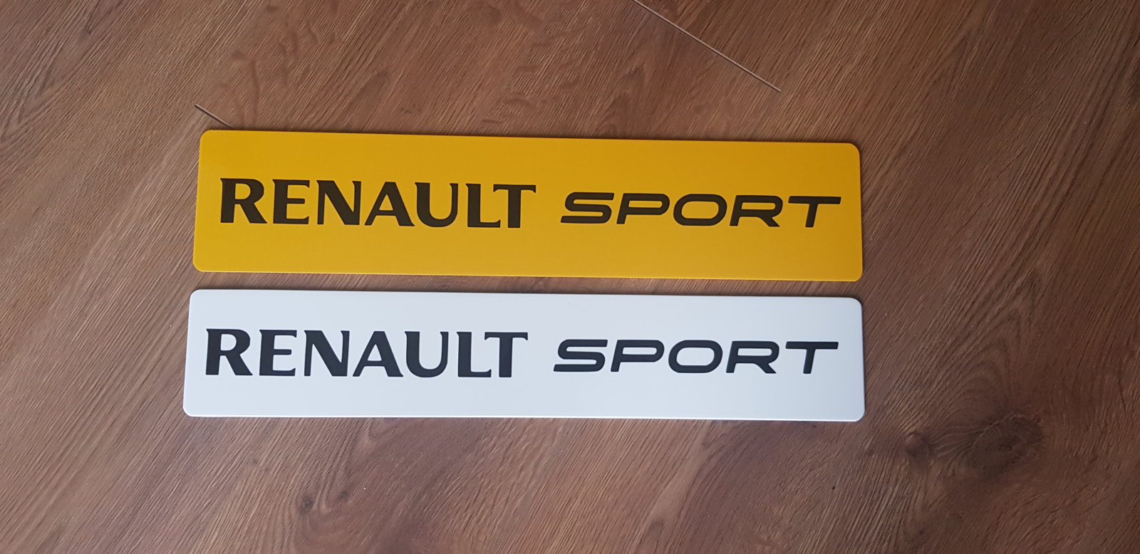

Something else I received today were these
A @Dr Jekyll special and they're ace! Cant wait to get out and take some photos. Be brilliant for CSF. Cheers mate.
