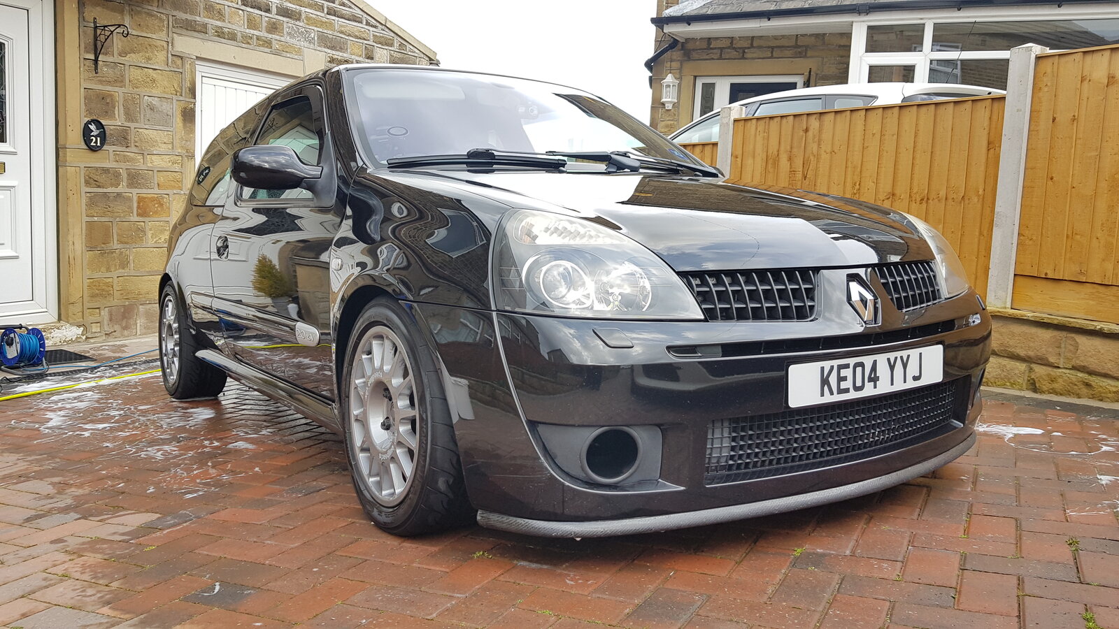

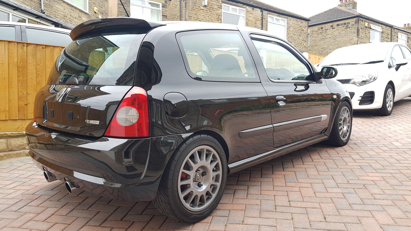

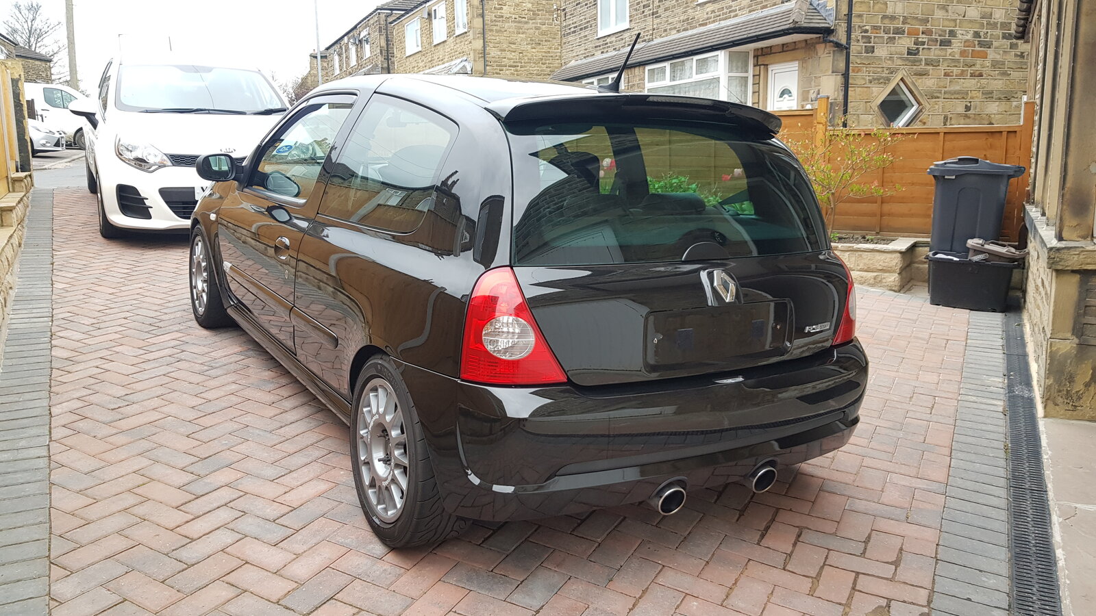

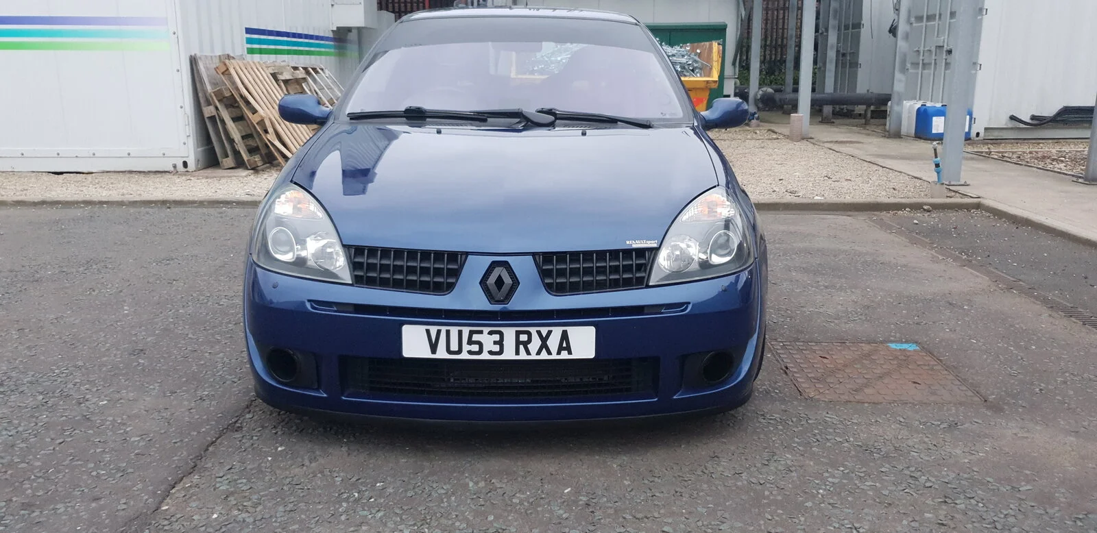

Some photos from today, washed it before we went but I've done 300+ miles since.

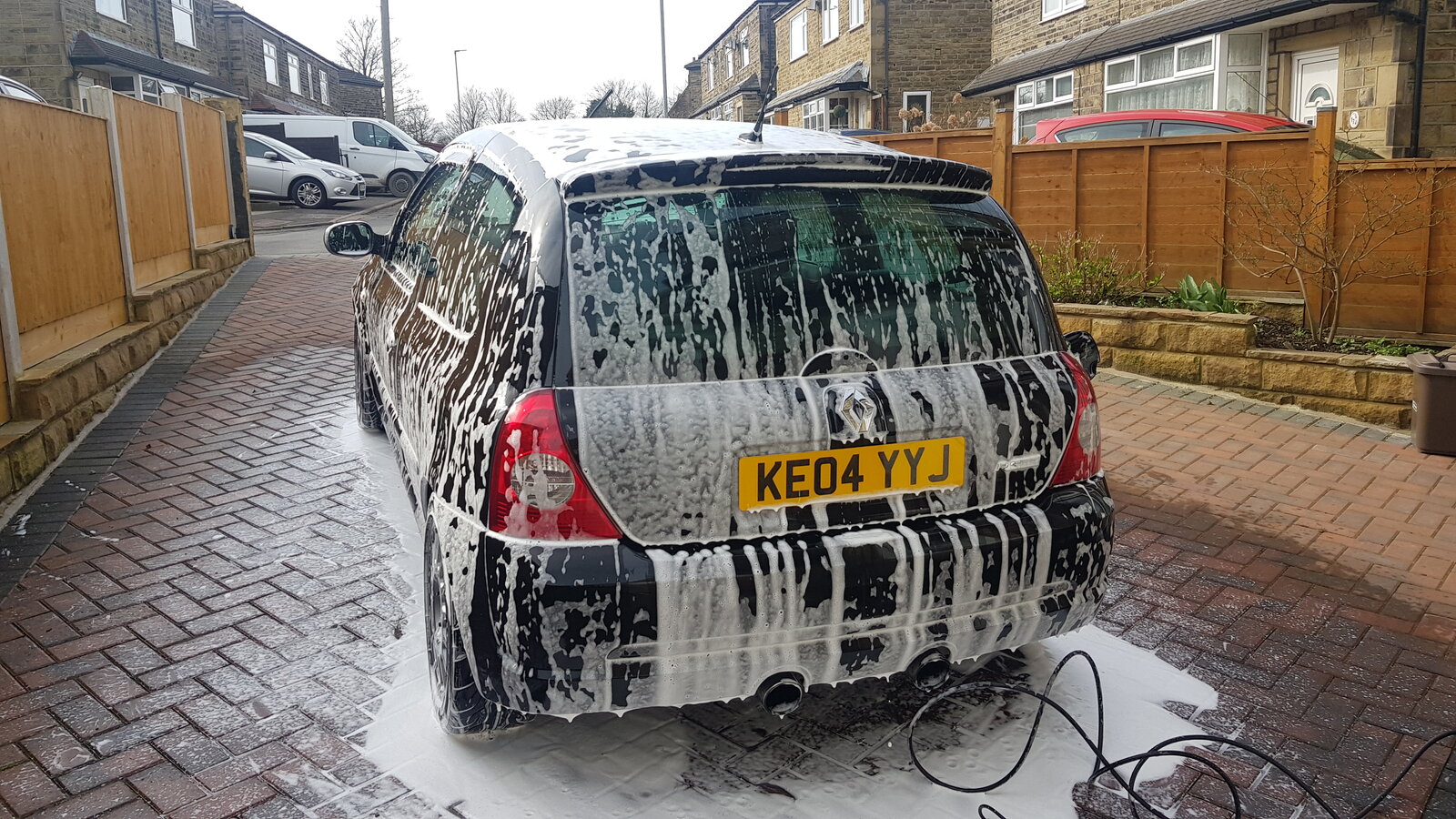

Back from Anglesey and the car didnt miss a beat. Had Tesco momentum in and averaged 40mpg for the whole duration of our stay.

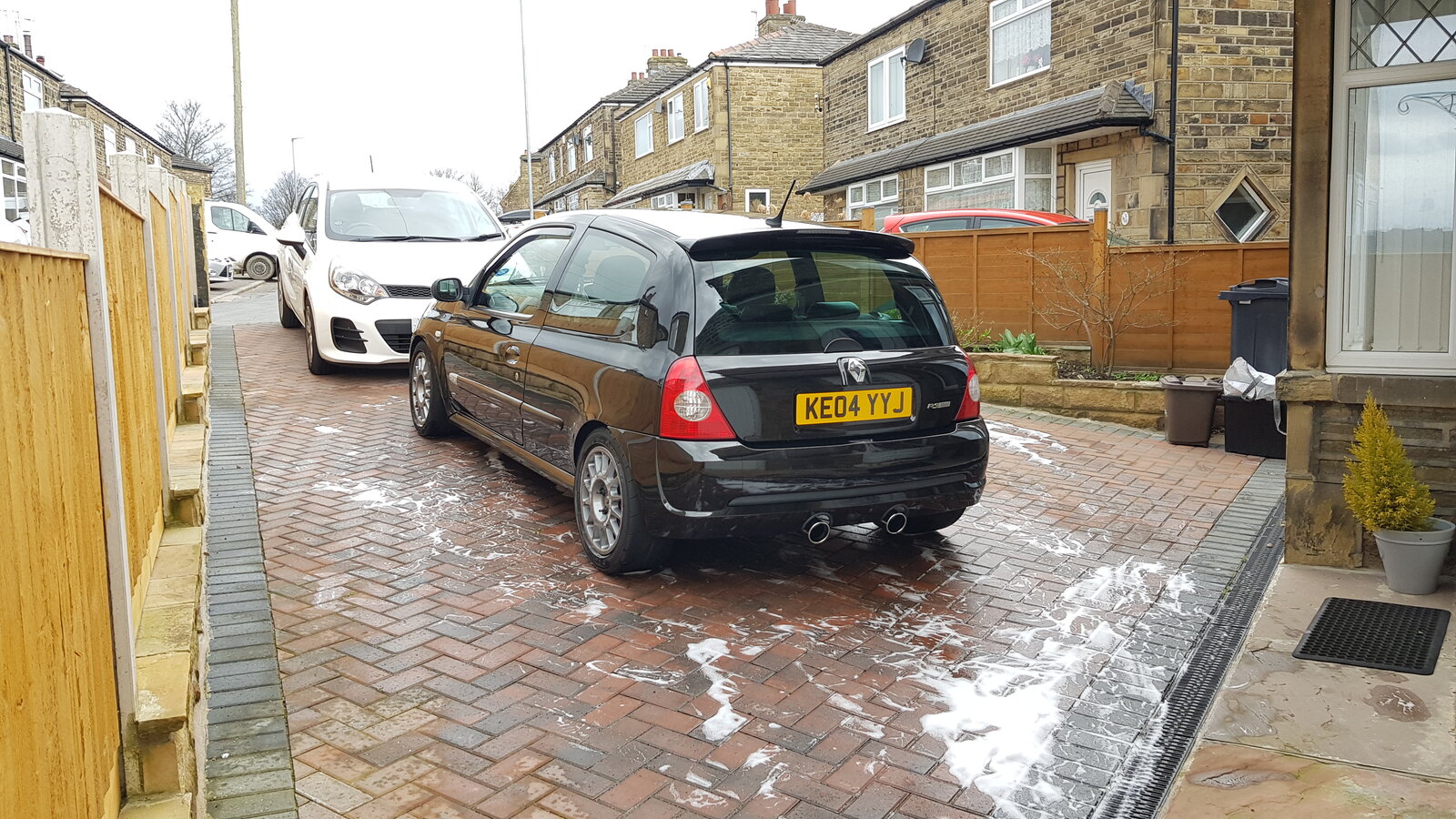

Gave it a quick wash to remove all mud that had gotten plastered on. Came up alright and this was without a polish just citrus, snow foam, 2 bucket wash. Run out of wheel cleaner so ill have to buy some more for next time. Will probably seal the wheels again soon as the dirt sticks more than it used to.

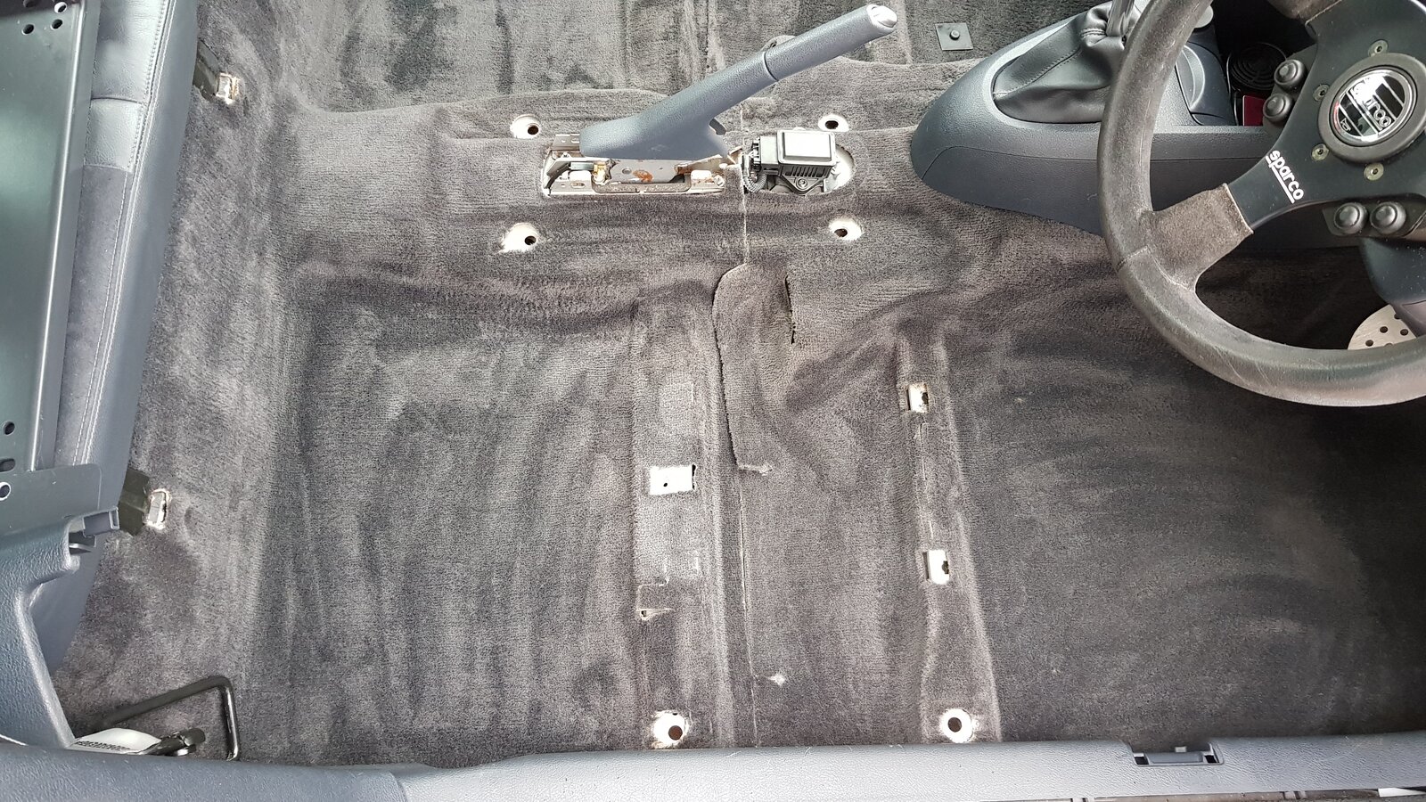

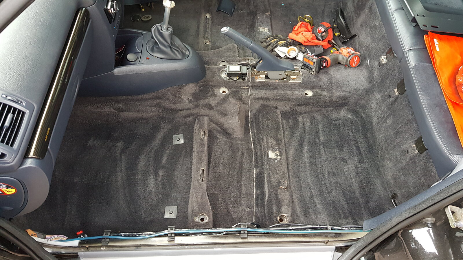

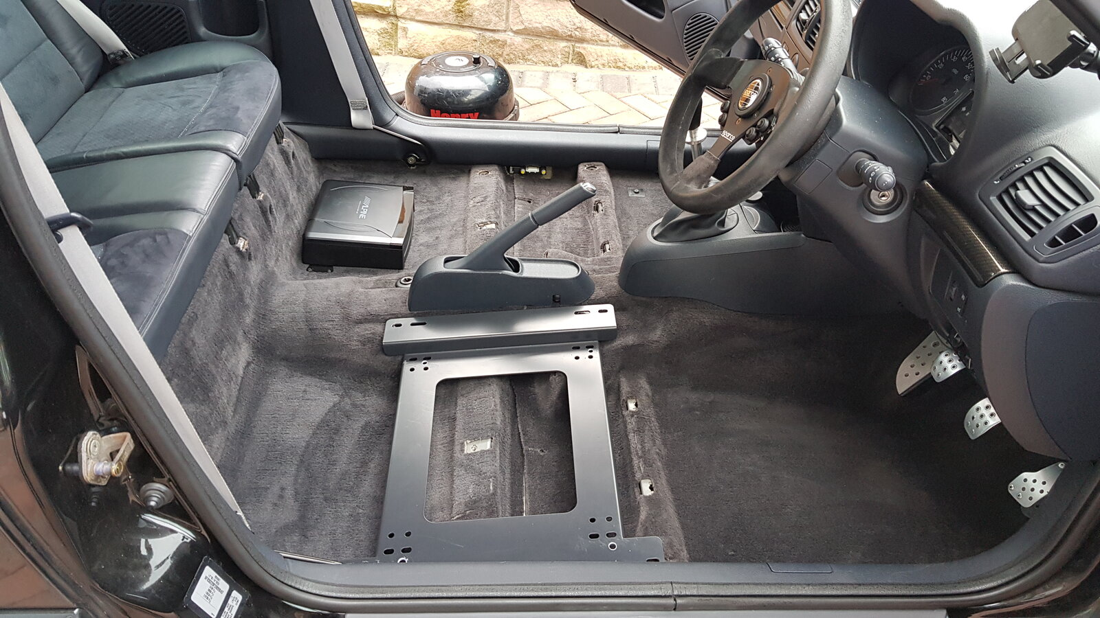

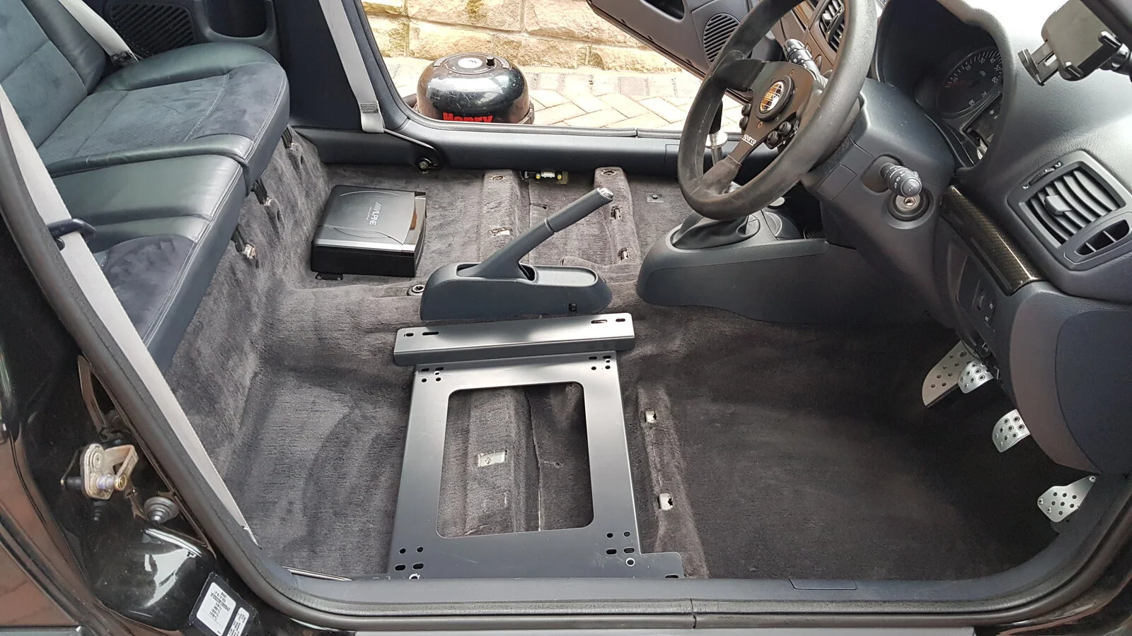

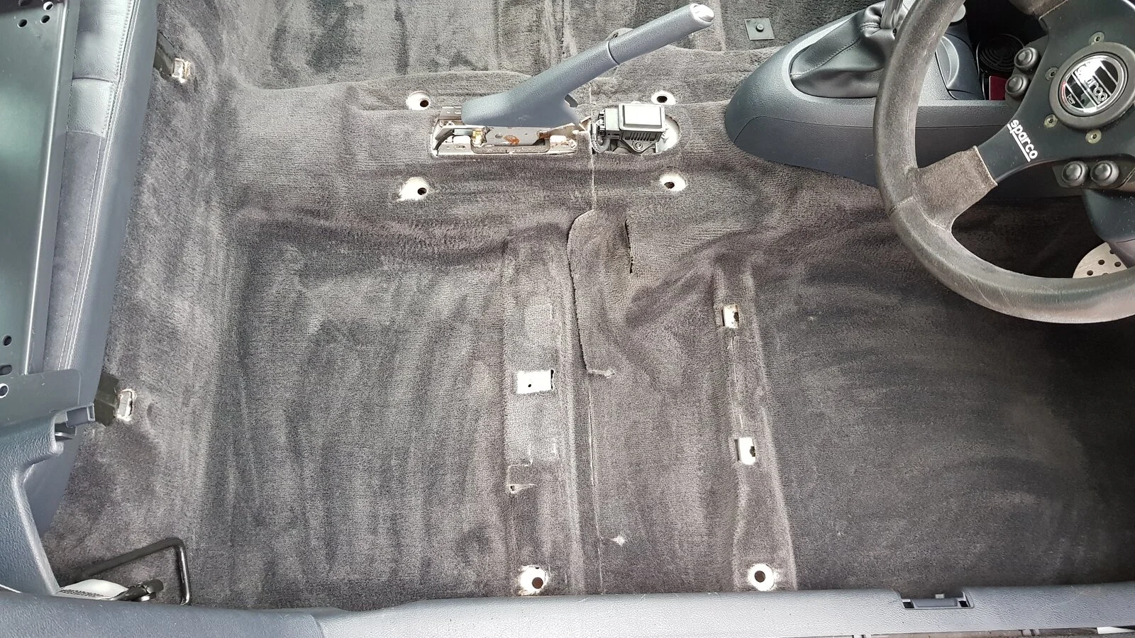

As we have finally started having good weather on weekends I made a start on getting my car ready for the Recaros.
Started by removing the drivers seat and stripping out the satnav system from underneath. Tidied all cabling (nav and airbag) away into the sill trims and wrapped with proper fleece cable tape. Took photos of all the cabling for future reference but wont put that in here as it's not very exciting.
Removed the passenger seat and did the same job of tidying away all the airbag wiring. Seats were easy to remove as I'd covered the studs in copper grease a couple of years back so that was nice.

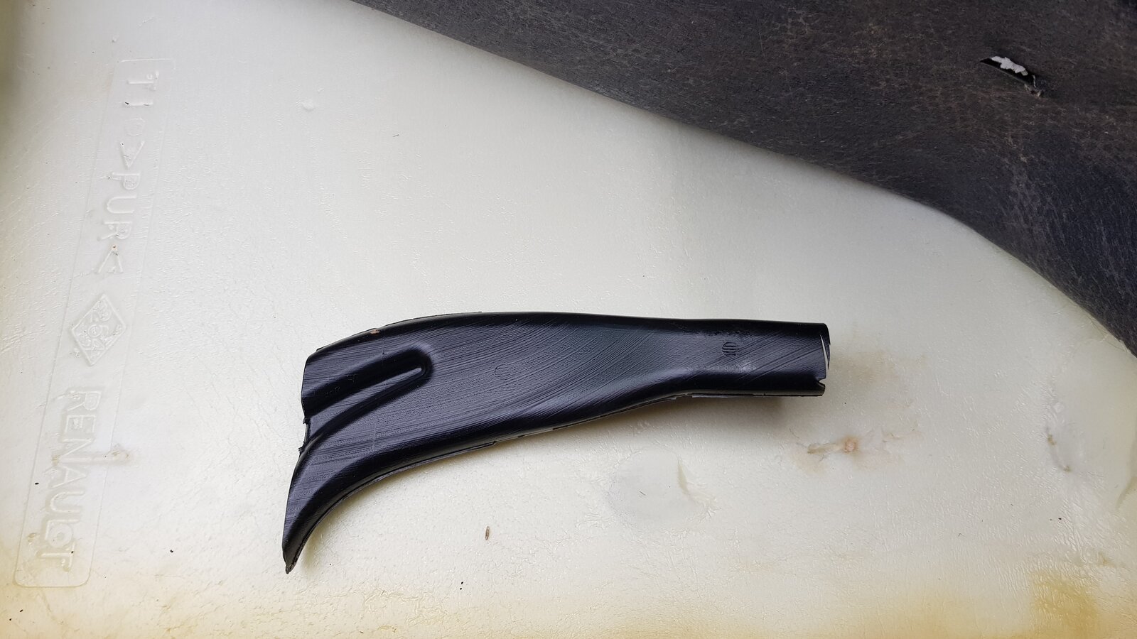

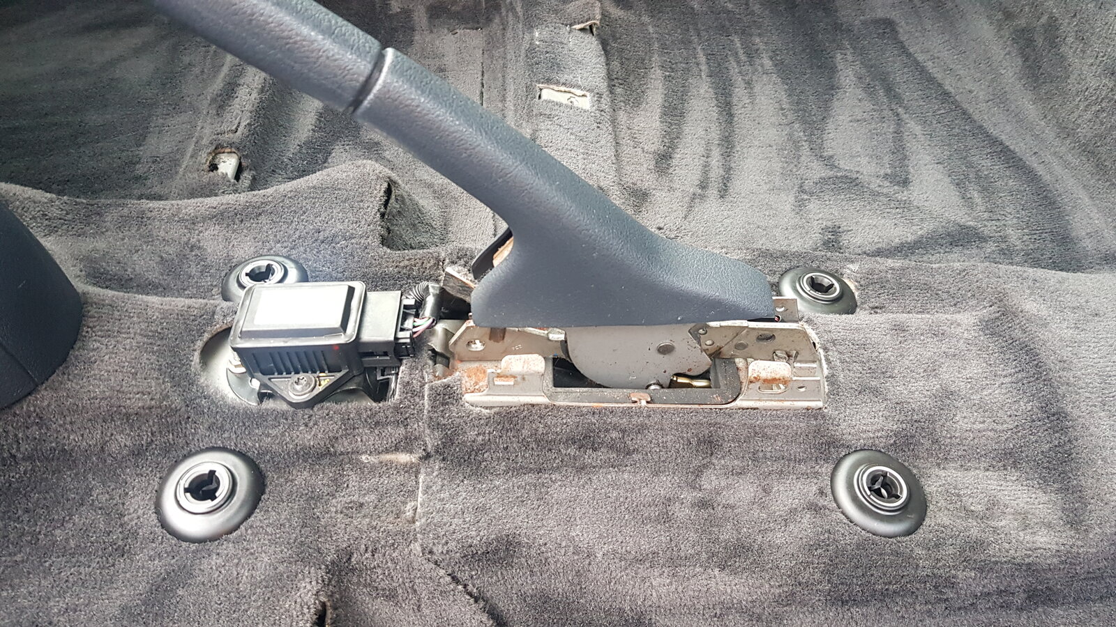

Next up was cutting away the heater ducts to allow the Jon Foz frames to fit properly. Have to pull the carpet up and it's a little fiddly but a sharp stanley cut through it easy. Did the same on both sides.
Weirdly the cross member under the carpet has been painted at some point. No idea why! Dont think anyone has been here before me other than the factory.
Anyway, cleaned all the carpets using autogylm interior shampoo and a scrubbing brush then vacced everywhere.

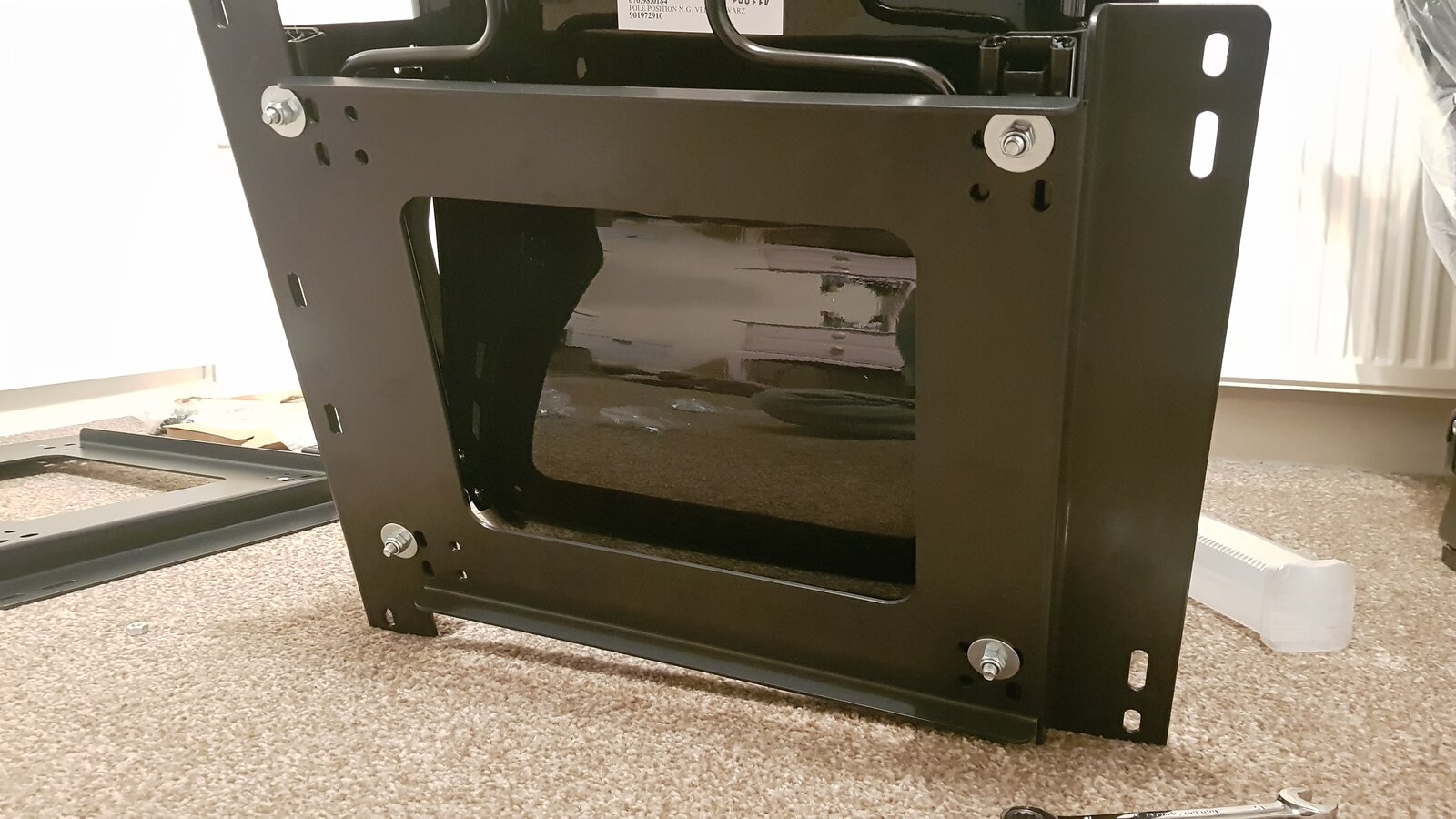

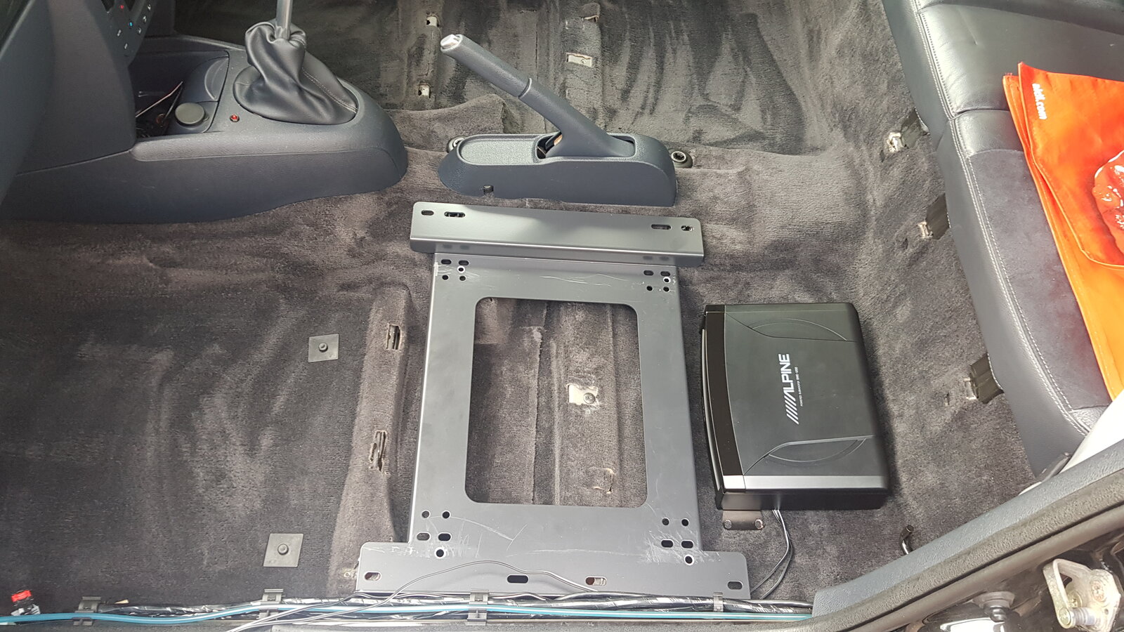

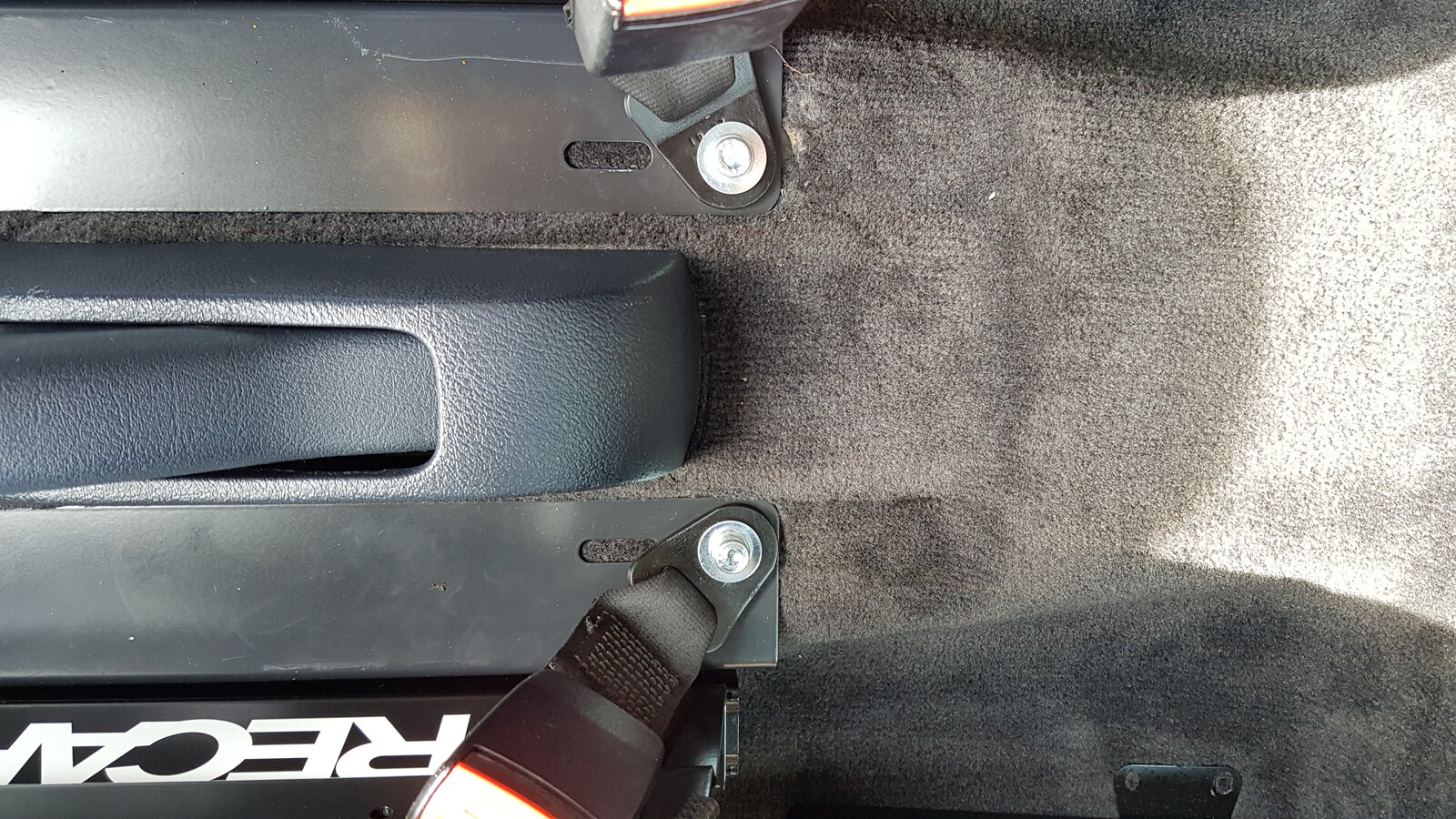

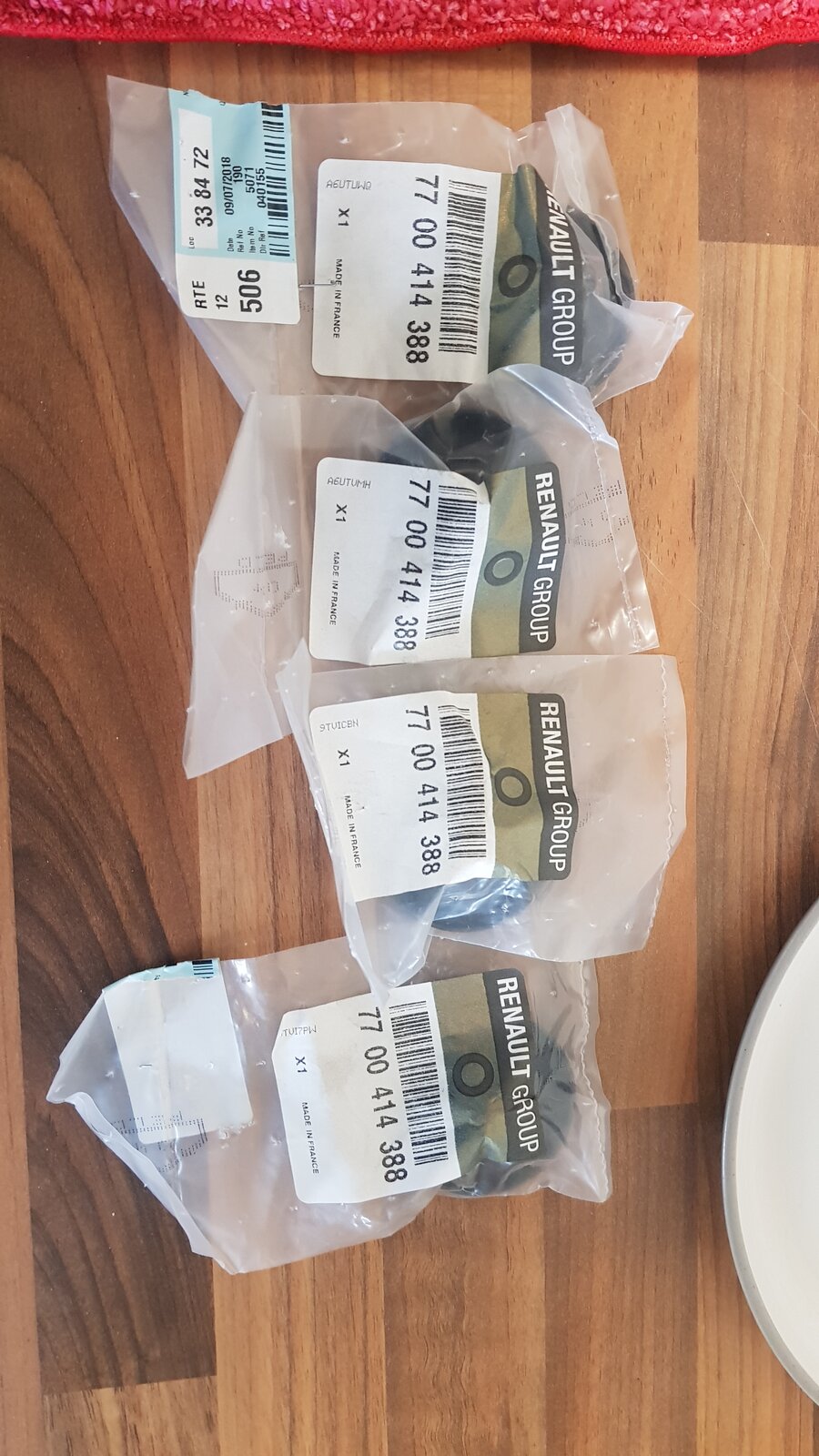

Fitted 4 brand new seat spacers as the seats will lean when in place. Part numbers for reference.

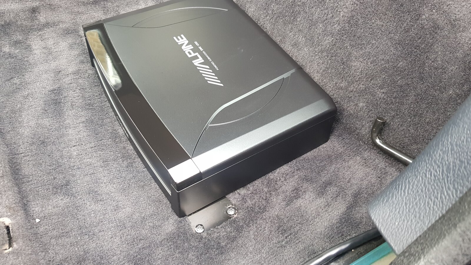

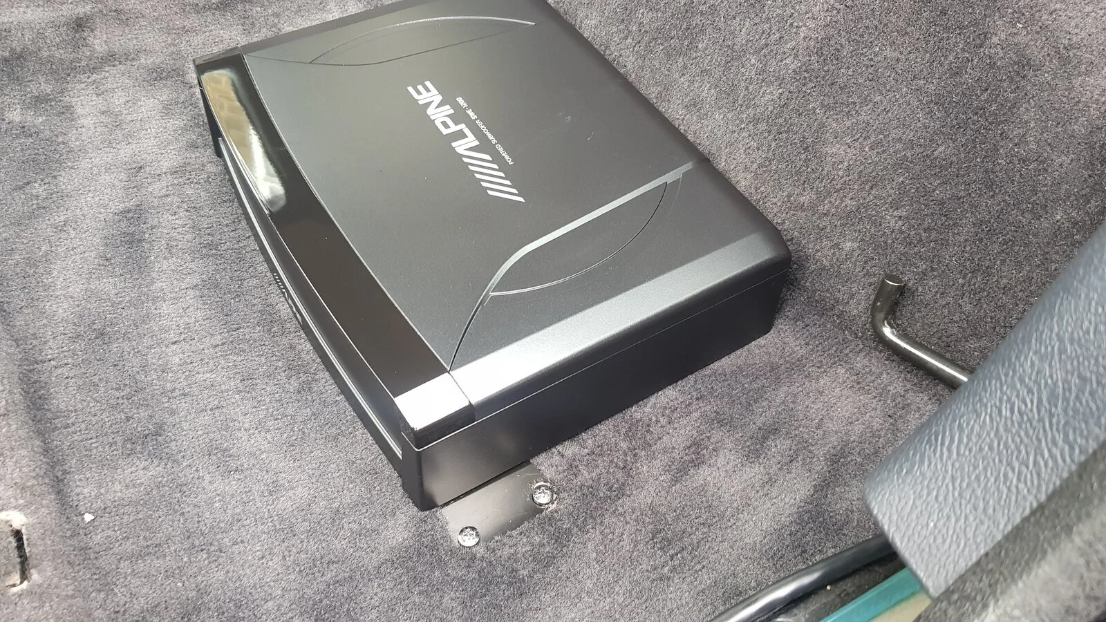

Unfortunately the underseat sub no longer fits with the Jon Foz frames and theres no room above these because of the sliders on the seat. Means I have to move it and the best option is just in the rear footwell as noone will be sitting in the back anyway!

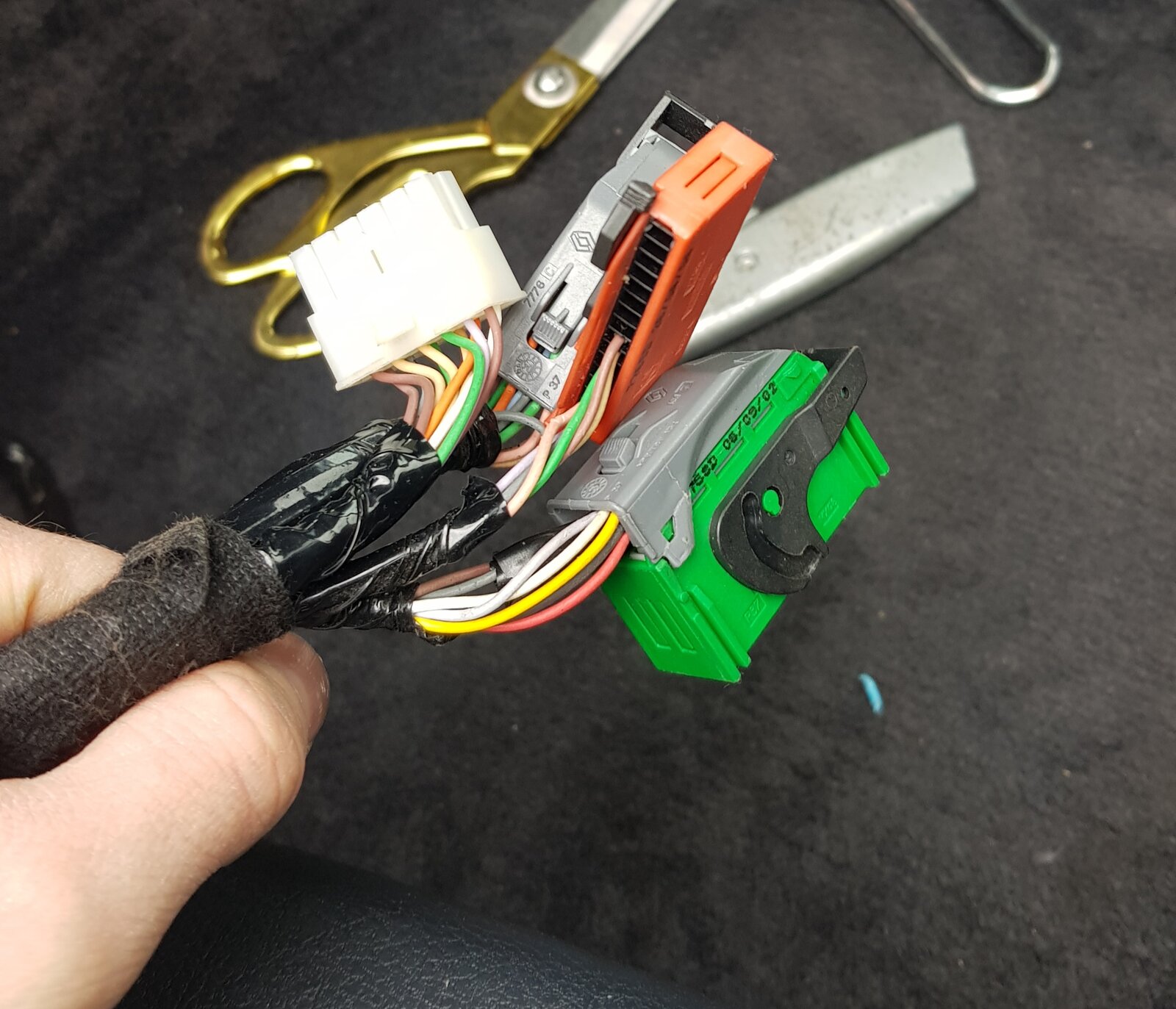

Got it central and drilled through to secure it with self tappers again. Wrapped all the cable in fabric tape and then cut the carpet to run it away neatly.
Happy with that! Next up is removing all the top dash to get at the wiring as I need some extra length now the subwoofer is further back. Seats should be in tomorrow all being well but being methodical with it all so I dont miss anything out!

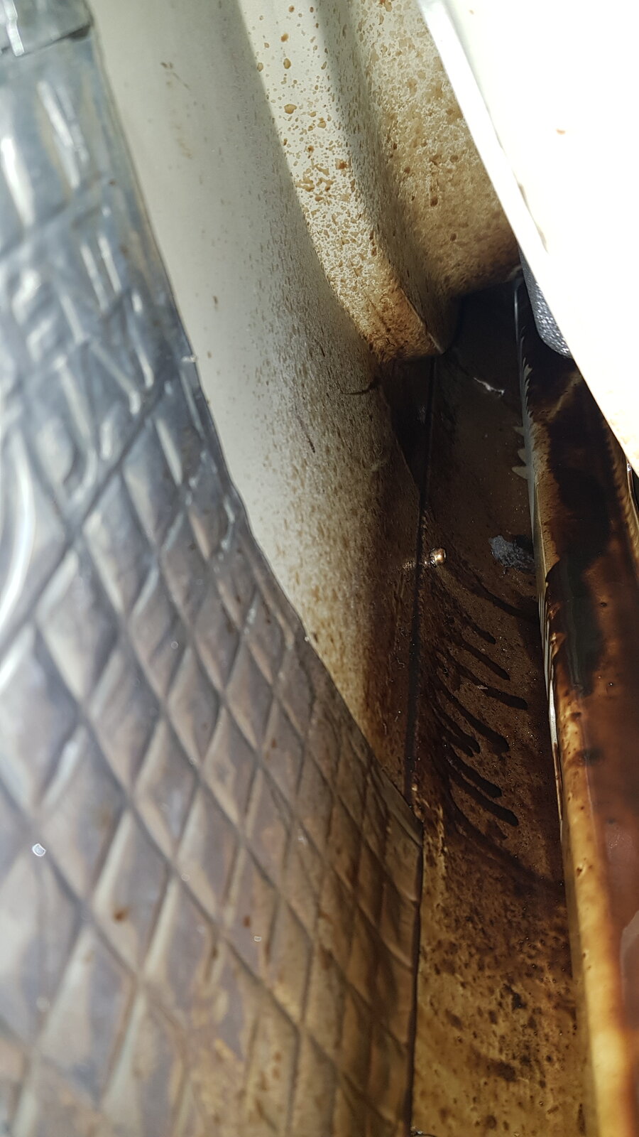

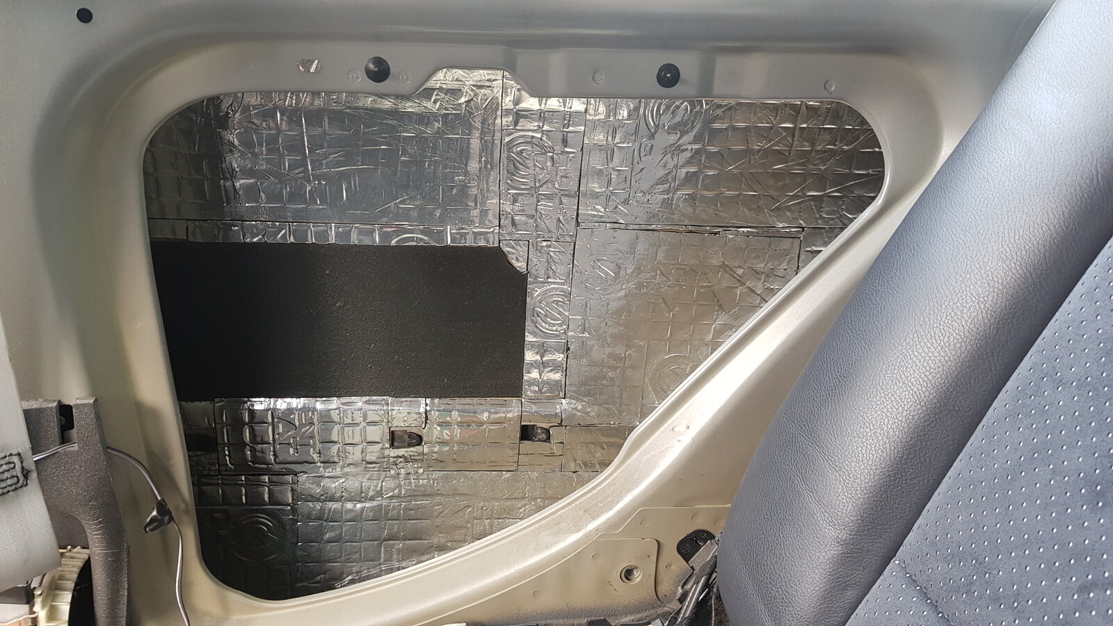

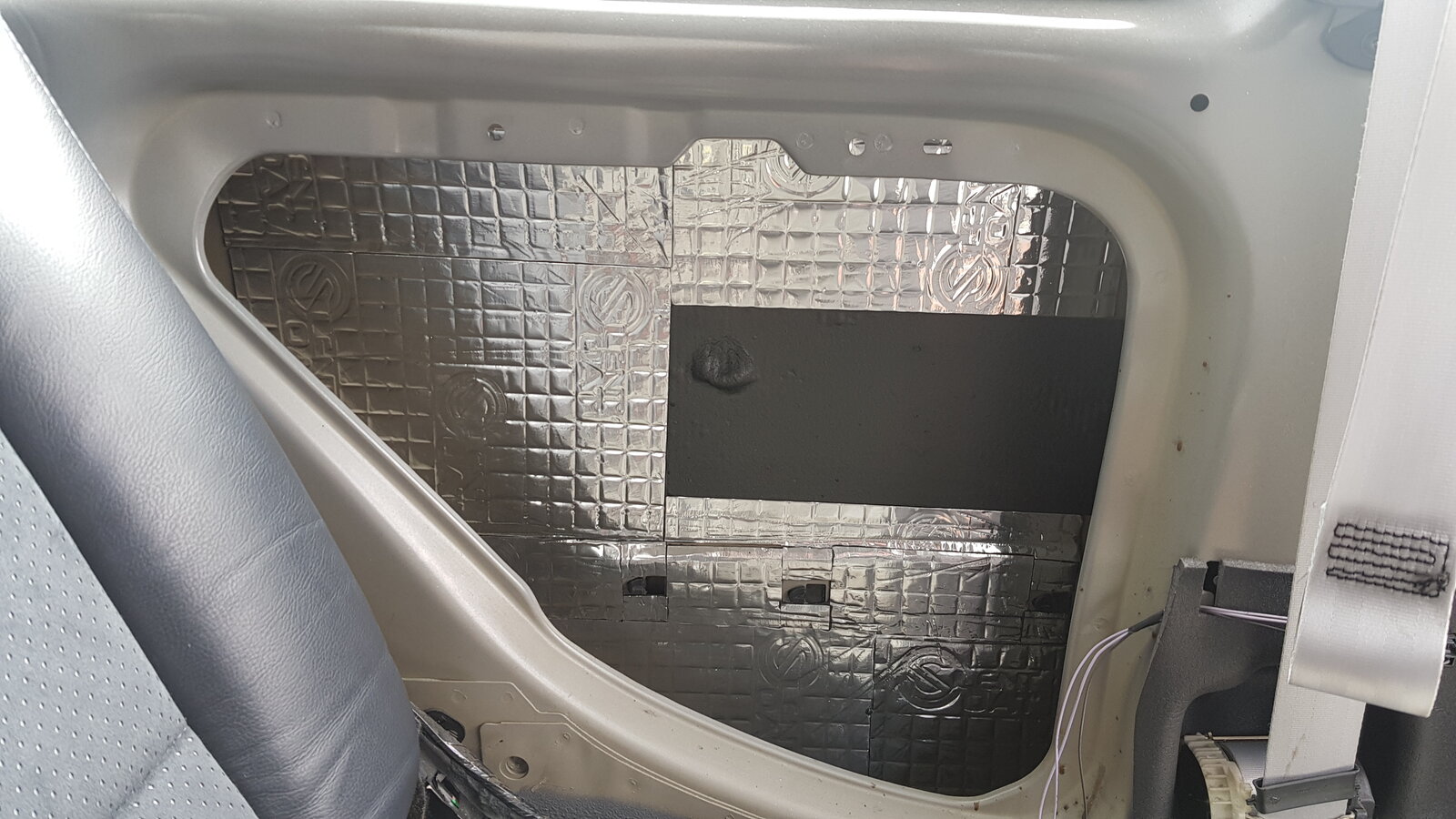

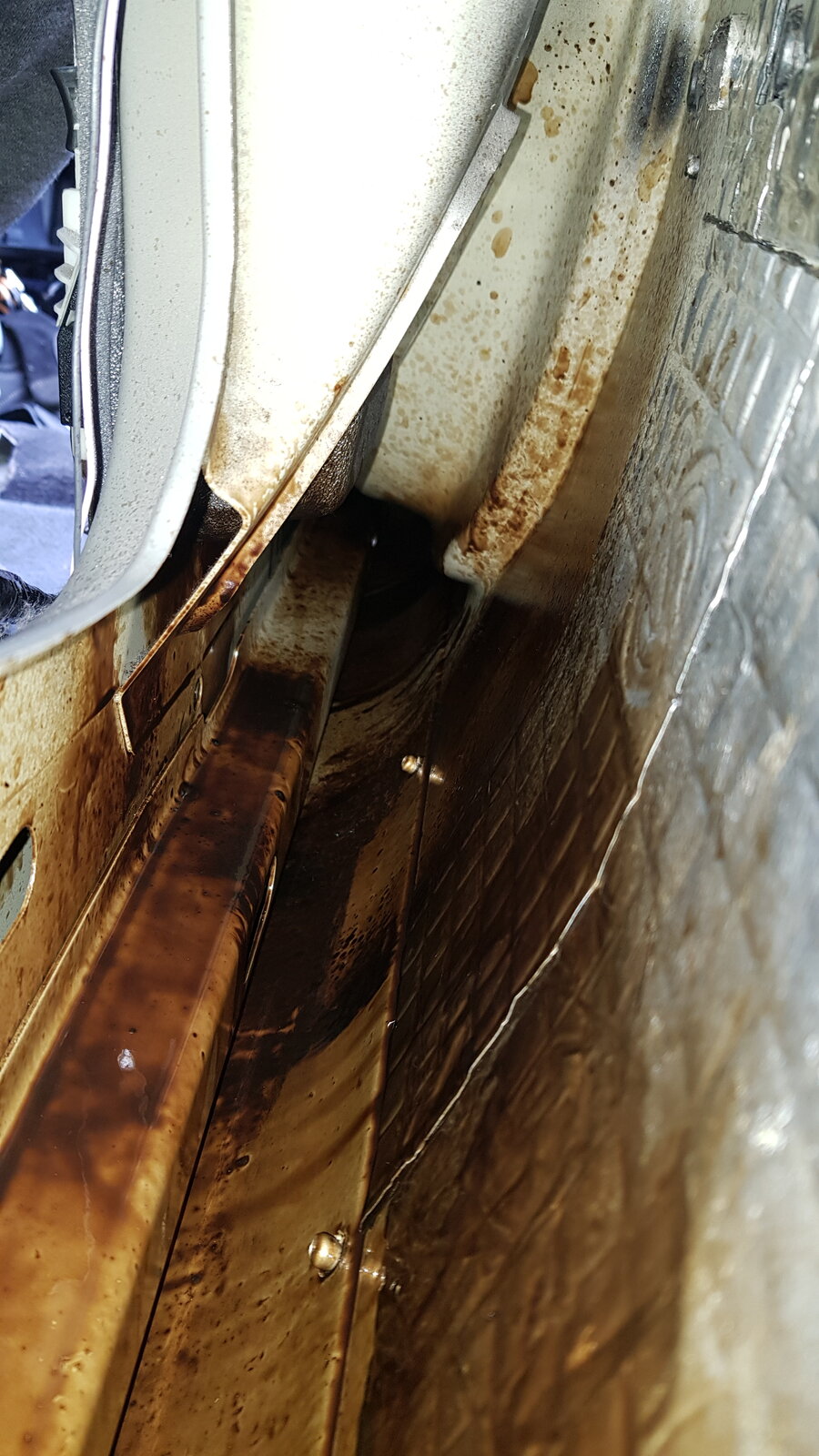

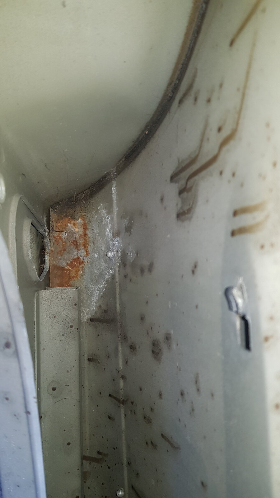

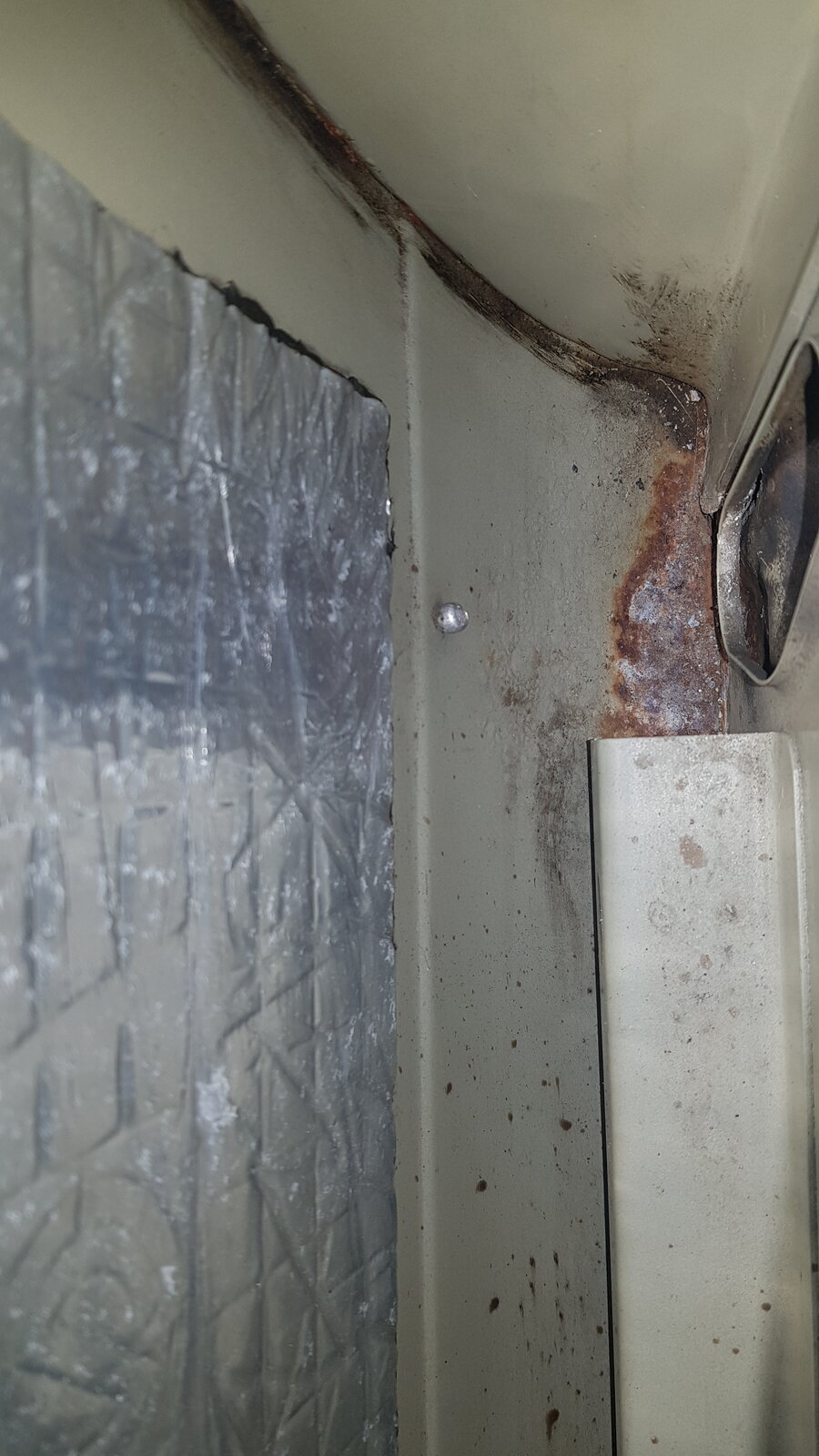

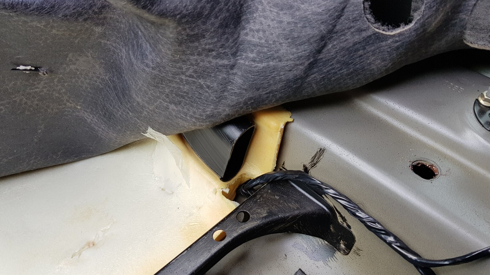

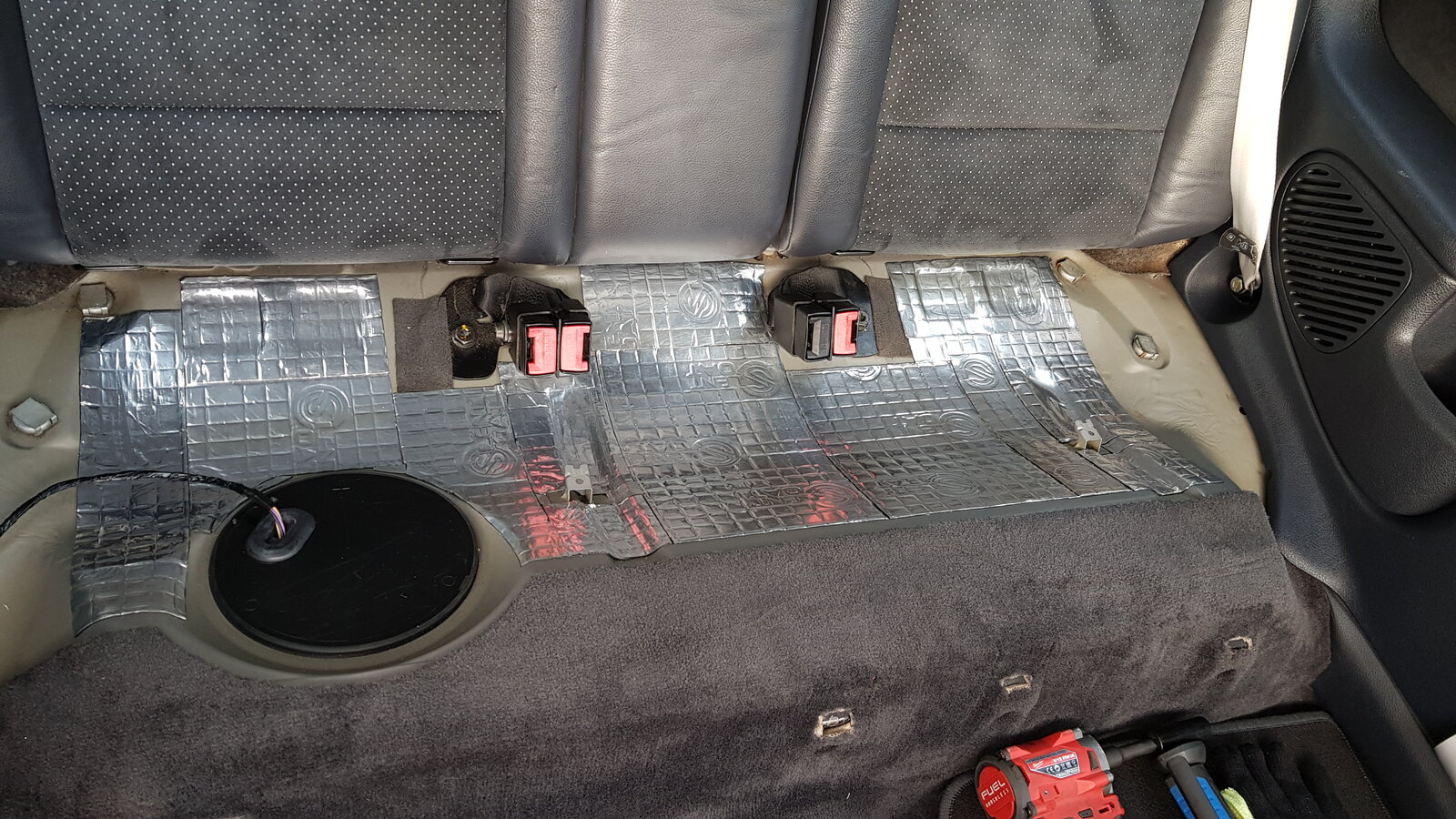

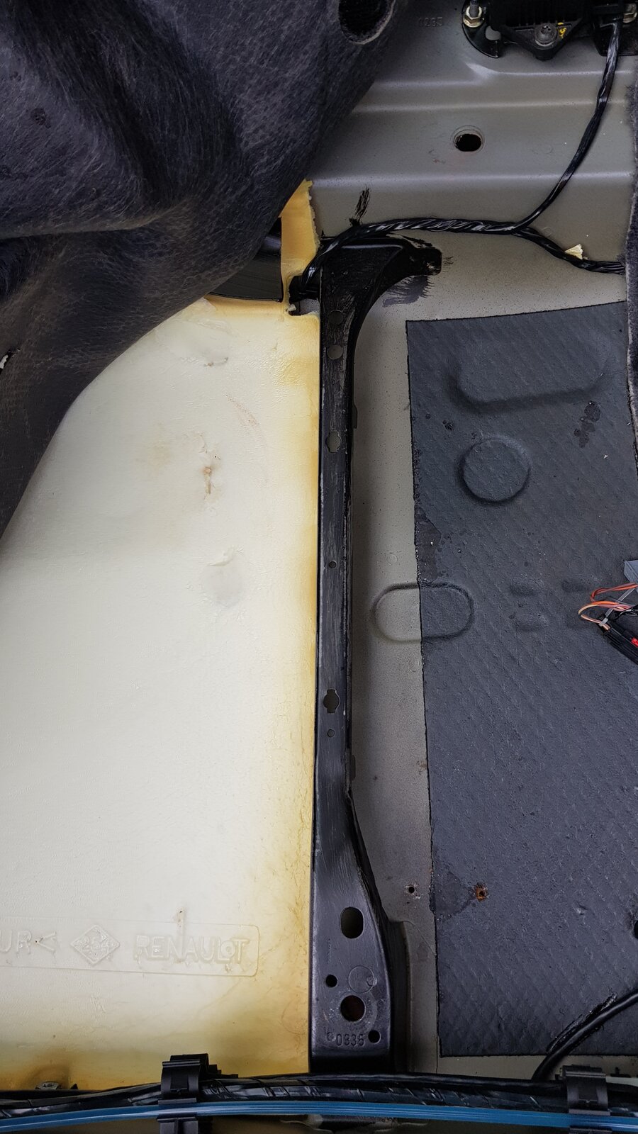

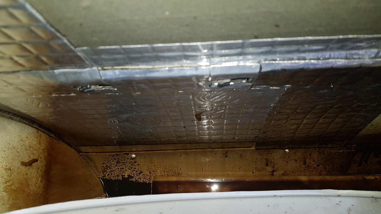

Another good day of progress. Stripped all the rear bench out and removed the door cards on both sides. Inspected each side for rust and was very similar to the last time I looked in that they were pretty good. Only surface and no holes that werent meant to be there.

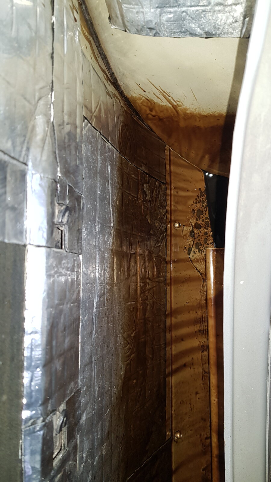

Treated the rust using some Deox-C gel and left it to dwell for 2 hours. Whilst that was working away i decided to apply some sound deadening on my rear quarters. The black is the OEM and then the rest is silent coat. Quite satisfying when done and should help some way in reducing road noise.
Also did the bench itself to remove any drumming and minimise drone from the milltek as much as possible. May not do too much but it cant hurt.
When I'd finished this I washed out the Deox-C from the sills and then wiped with brake cleaner to remove any moisture left. Dynax S50 was then copiously applied inside the rear quarter and down the full length of the sills. I removed the cable fixings along the length of the sill to feed in the nozzle and ensure it was all coated.
It pooled a fair bit on the area of treated rust and the plan is to let that dwell for a few days before wiping it away, priming and top coating the rust. The dynax has neutralising chemicals within too.
Re-fitted bench and door cards to get the stuff out of the garage and free up some space and thats how I've left it for now. Didnt get chance to get the seats in but working from home this week so wont need the car.

S-50 is the final step? You’ll enjoy removing it again.
It wipes out with a rag and thinners. I'm literally just going to remove it on the small area of treated rust, not the whole lot!
Probably dont even need to as the rust is 'converted' already but better safe than sorry. I wasnt going to coat it but got carried away when I was doing the rest of the sills

Yeah I think you’ll be fine as you’ve already deoxed it. I just used the S-50 over the converted rust, due to the inhibitors as you said.
I’ll have to check mine again at some point as it’s been nearly a year, but as I don’t use it in winter or the wet I’m not too worried😅

I've just done the very same job on my sills today, drivers side was about the same as yours but passenger side was near enough totally clean.

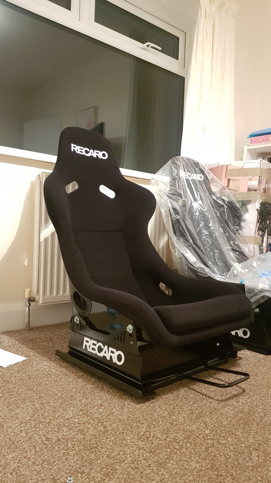

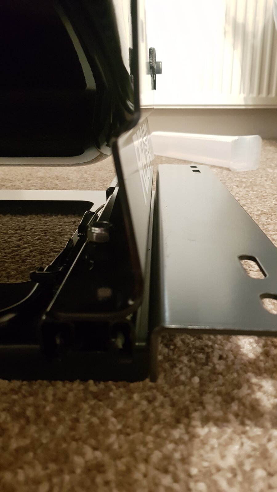

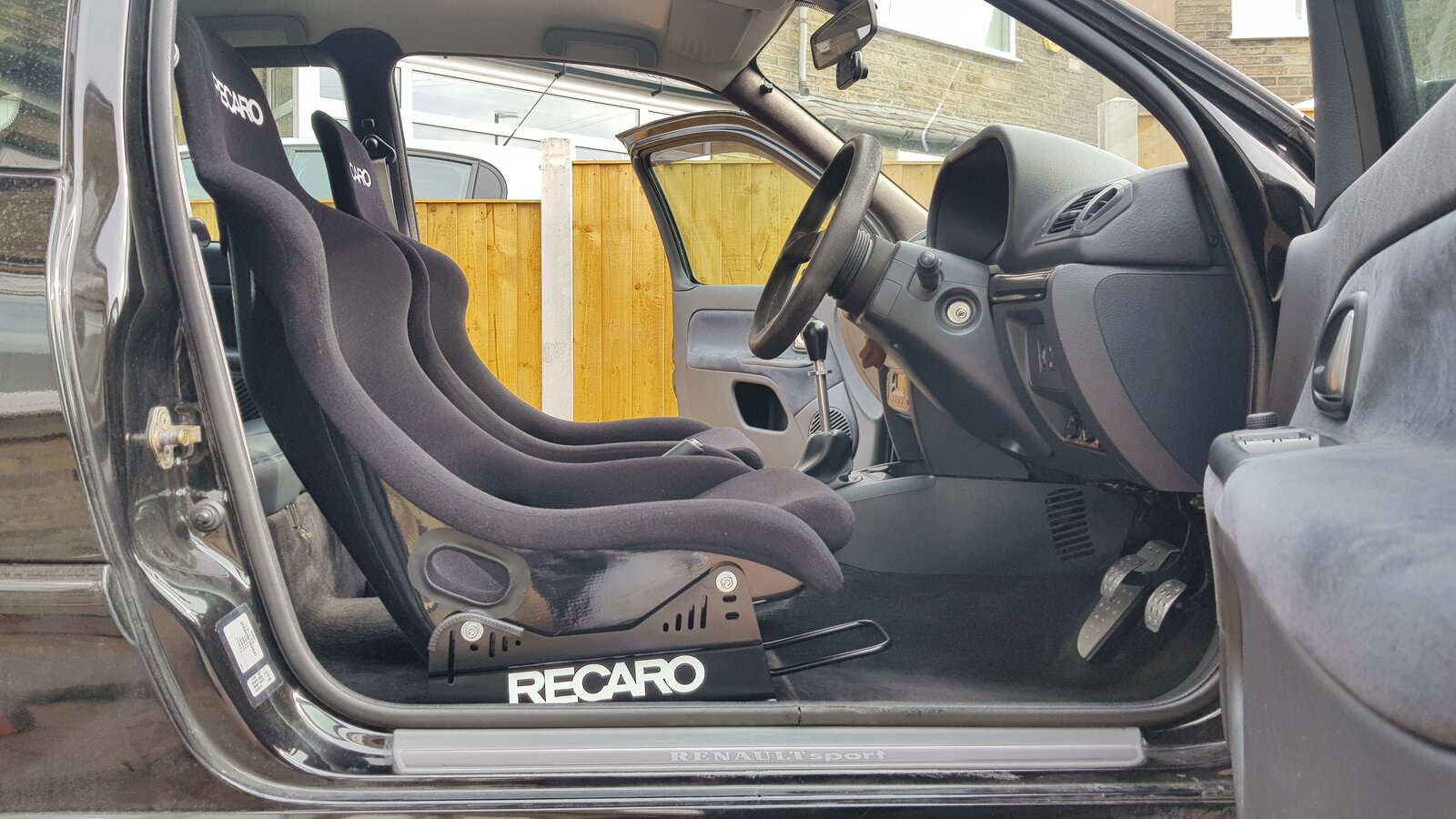

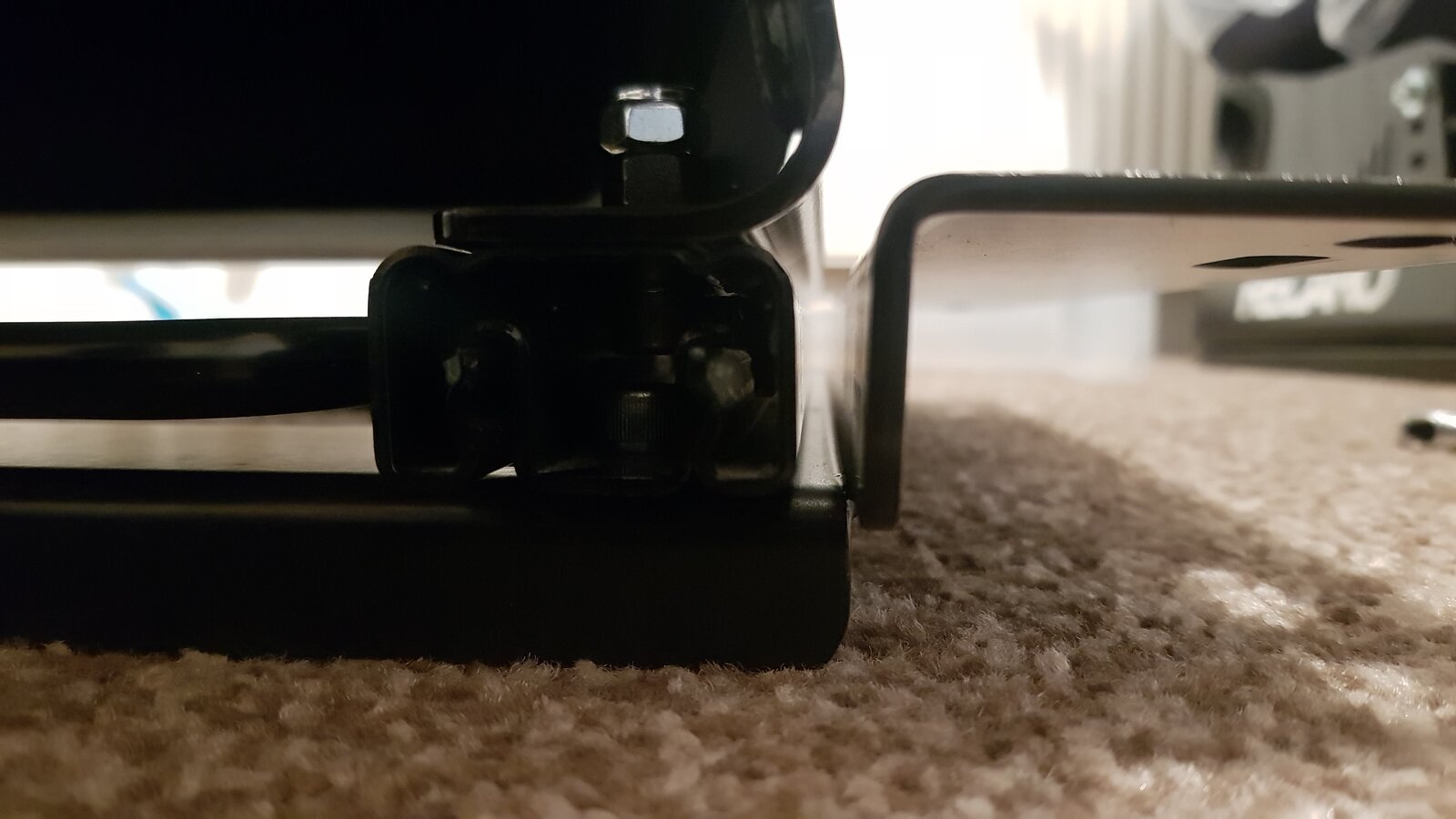

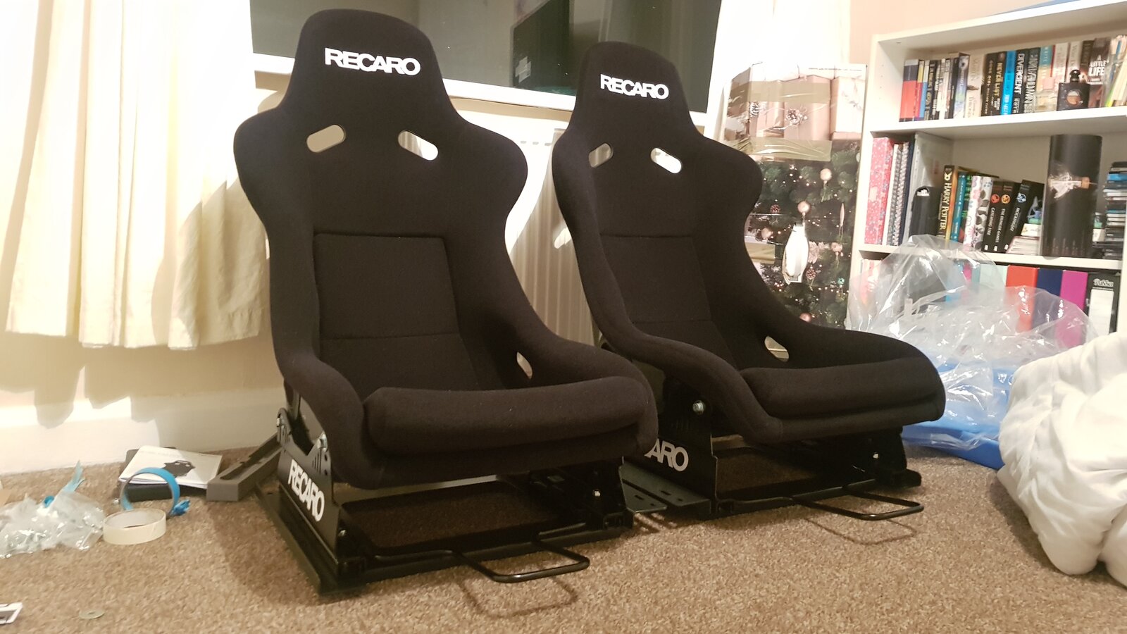

Got my seats mounted onto my subframes. Had a couple of issues with the sliders being 'tapered' by about 4mm front to back. I believe it's down to the tension the centre bar puts through. Enlarged my holes slightly (9mm one side, 10mm the other) and it all went together fine with the slider operating smoothly. Thanks for everyones advice over pm's!
All bolts torqued up to 35nm should see me right.
Krarl
They'll be in this weekend dont you worry. I've purposely avoided fitting them over winter, and then i've had all these other jobs to do first. WFH this week has meant I can leave my car in pieces, i'll be back in/out of the office next week!
That's the excuse I'm giving myself with my gearbox tbh...
Louis
I Park Like a C**t

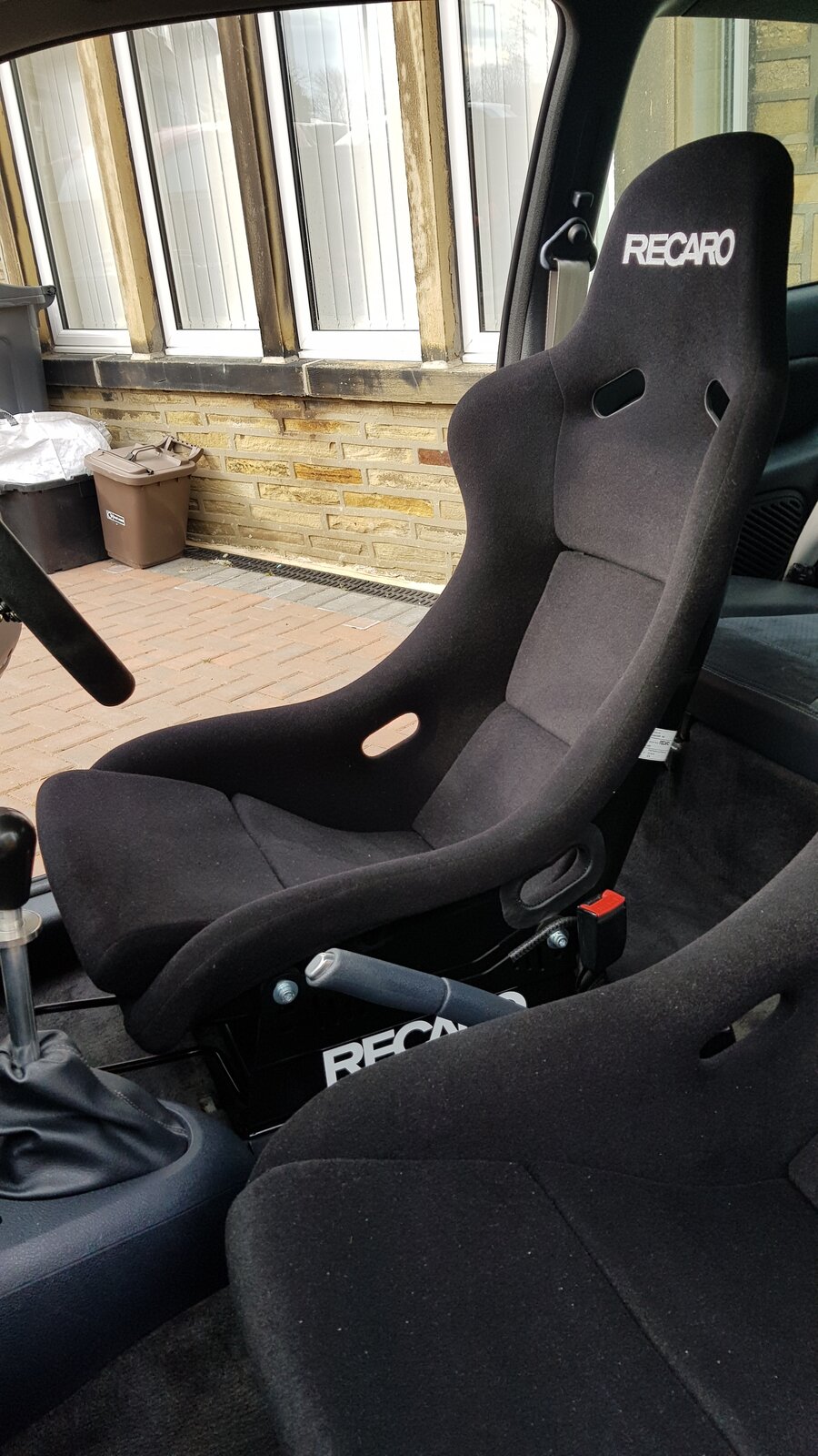

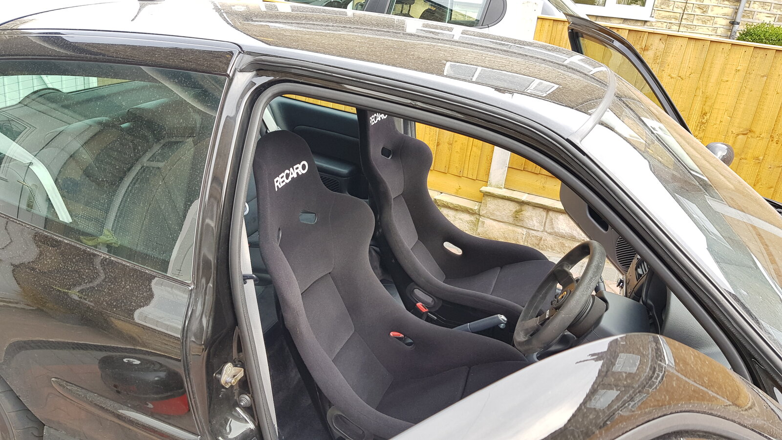

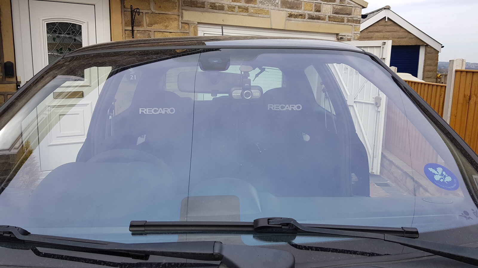

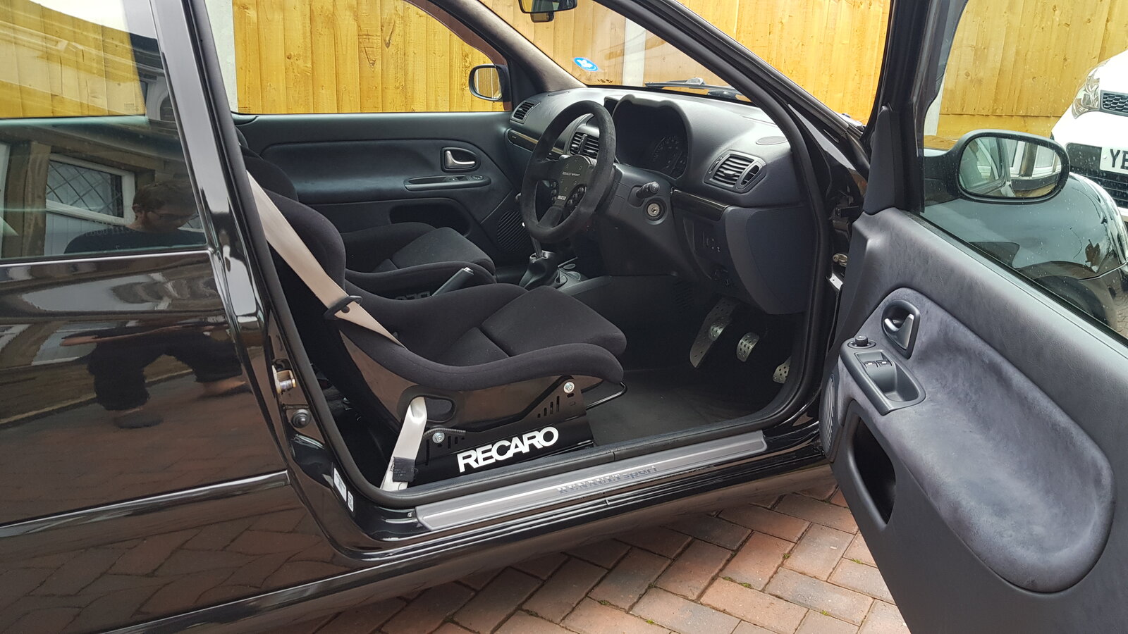

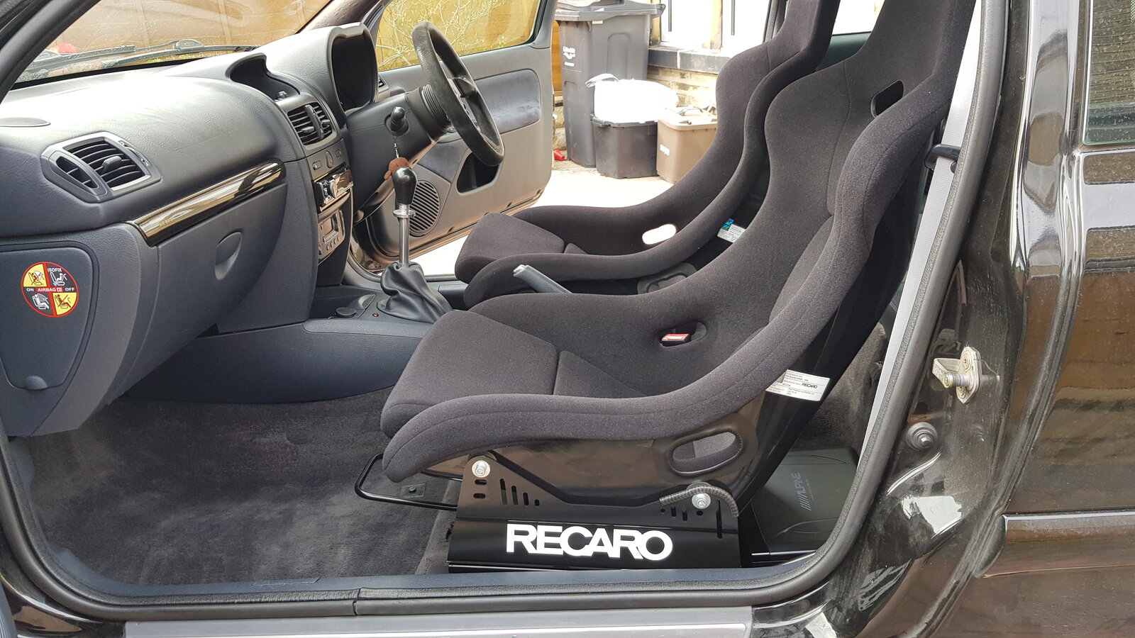

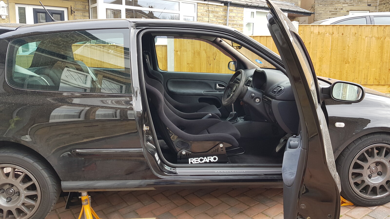

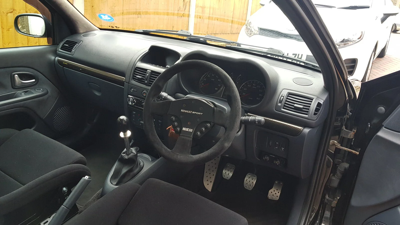

Seats are now in! Was a bit of a faff trying to get all the bolts in properly with the correct washers. Used OEM nuts underneath with nylocs to lock them off and also swapped the spacers from the inside to the outside as they were tilting. All then torqued to 30Nm-35Nm for peace of mind. Annoyingly the powdercoat on the subframes isnt very tough and comes off with the slightest touch! Shame really but maybe something to revisit at a later date.
Thought I'd get away with sliding the belts through after but I dont have a long enough torx socket to remove the bolt! Ordered some now and should be able to wiggle it by.
Really happy with how they look, going to take a bit of getting used to!

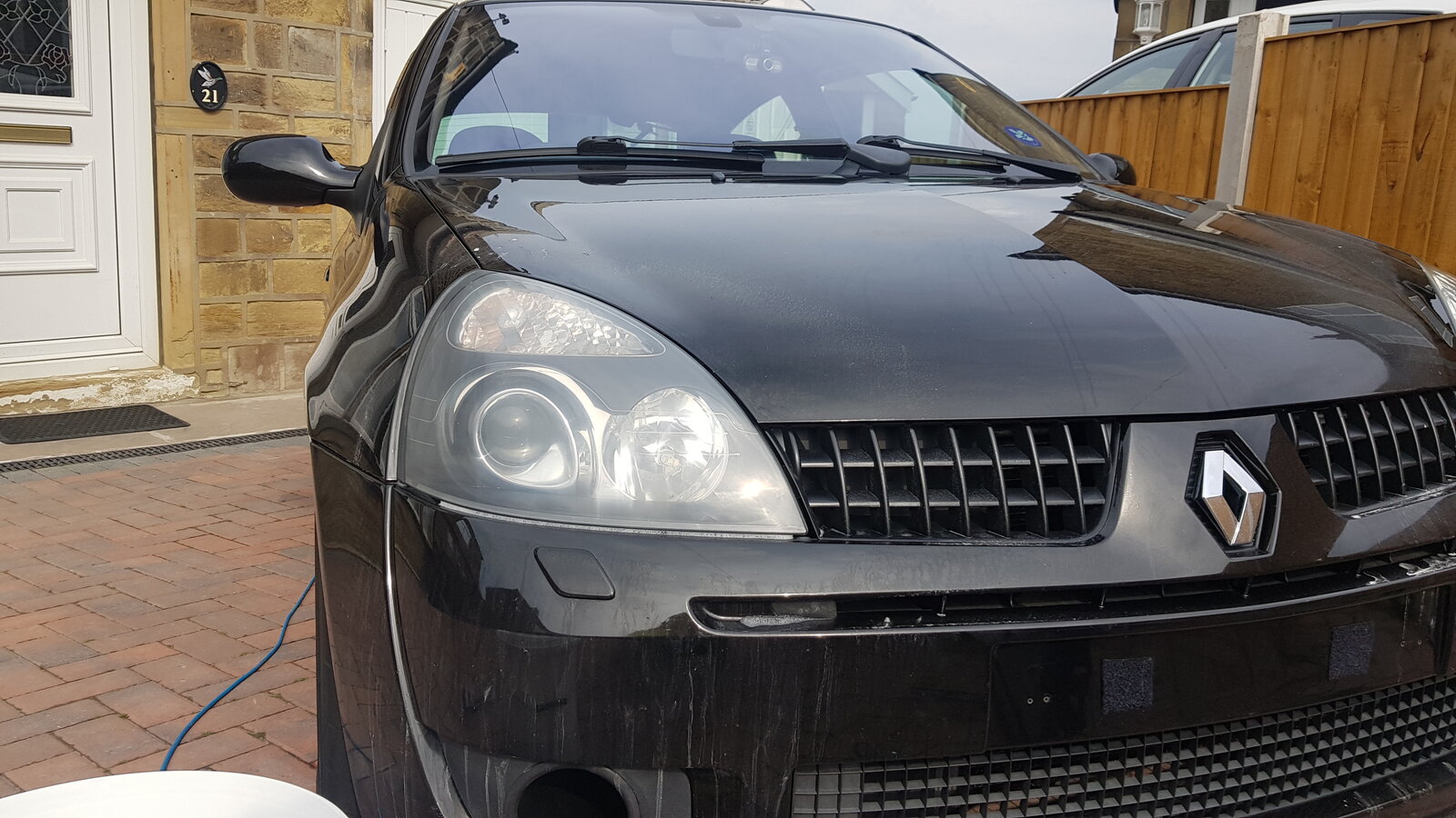

Noticed the headlights had started to yellow again so got out the wet and dry to give them a refresh. Began with 240 and worked through to 2000 and then ran a microfibre pad over them with some Menzerna 400/2500.
Finished with SRP and some AG HD wax and pretty happy with how theyve turned out. Should be good for another year!
Gave the whole car a wash aswell, not polished yet but thats the plan for tomorrow.

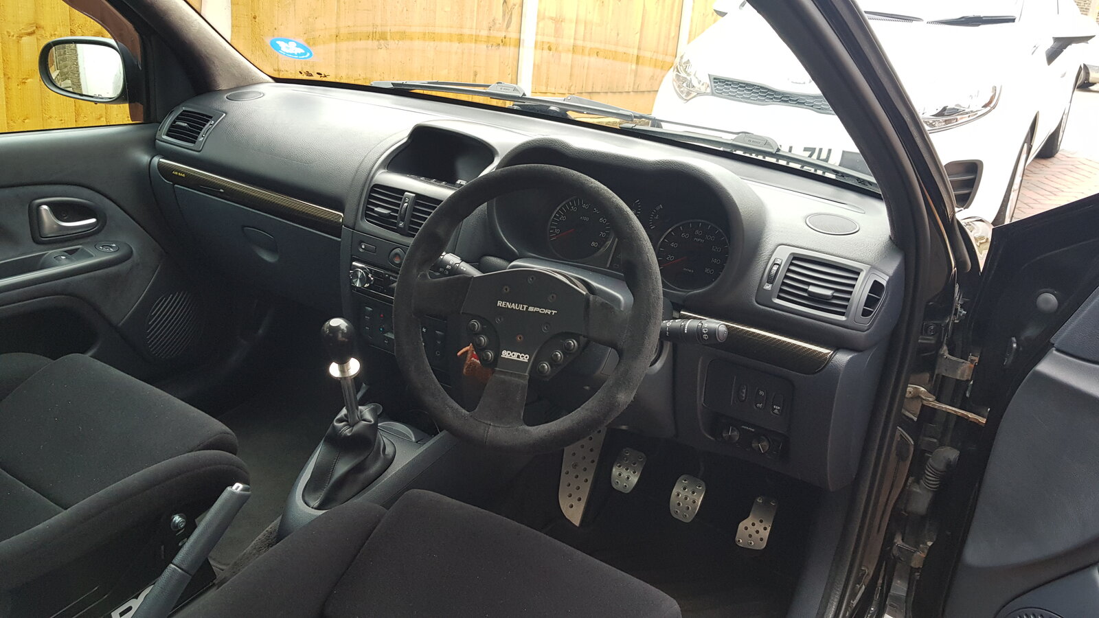

As I fitted the Recaros I decided to finally fit the Renaultsport wheel I've had sat in my garage for about a year and a half! Fitted a volantec bracket as the horn has now obviously moved. The bolts are titanium as I always had problems with the standards rounding, tempted to run a torch over them to get some colour out!
Super happy with how this looks and will be cleaning up the other sparco 330 to sell on.

The top grill needs another coat now too, has some chips. Maybe next weekend as it's a decent 2 day job with removing the bumper and waiting for parts to dry
I did all my front end apart from the fogs which proper annoys me hahaha
Does look loads better satin black than the awful faded plaggy
