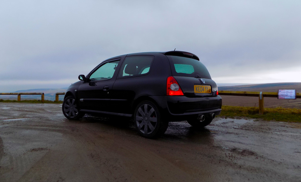

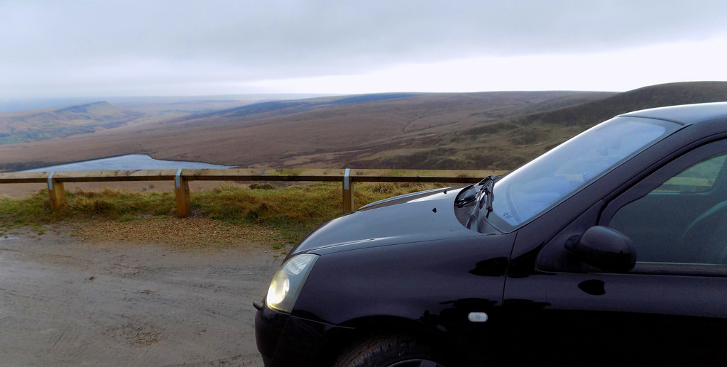

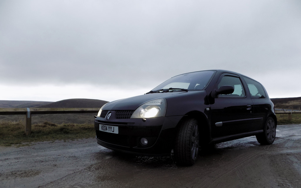

Went for a little spirited drive today through to saddleworth. Still getting used to this photo/photo editing lark so don't be too harsh! Wasn't able to get the car in the place I wanted as there was already another car parked in the pull in, but still nice views.

I aint had mine out for a fun run since our last Yorkshire meet. I must find somewhere local that's photogenic to sprint to occasionally. Where were they taken Louis?
Louis
I Love Ed Sheeran
These were taken on Saddleworth road (A640) and I believe it's Deanhead reservoir in the background.
I drove down the A640 to Dowry Reservoir then doubled back on myself.

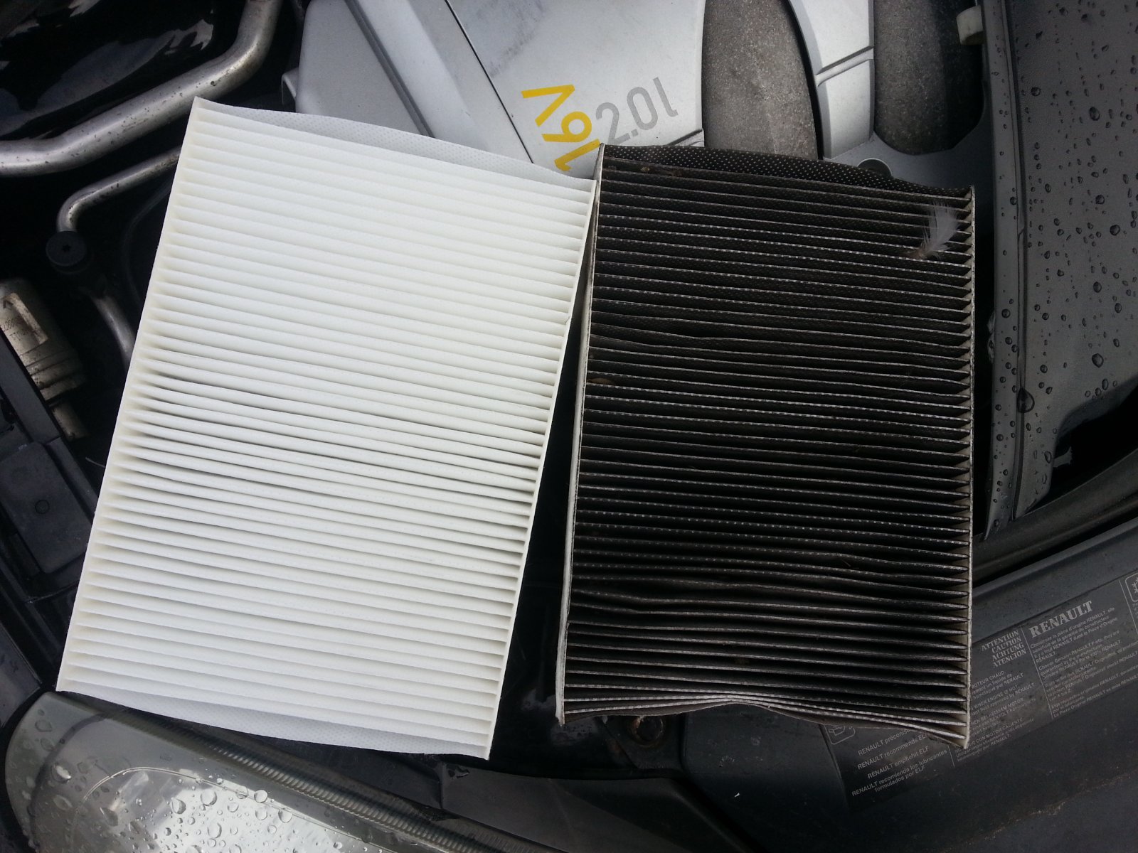

Replaced the pollen filter today. Quite clearly it's not been replaced in a long while! (Had 2008 written on the side of the filter, unless it was old stock).
Miles better now, and hopefully won't see any misting up of windows now this has been replaced.

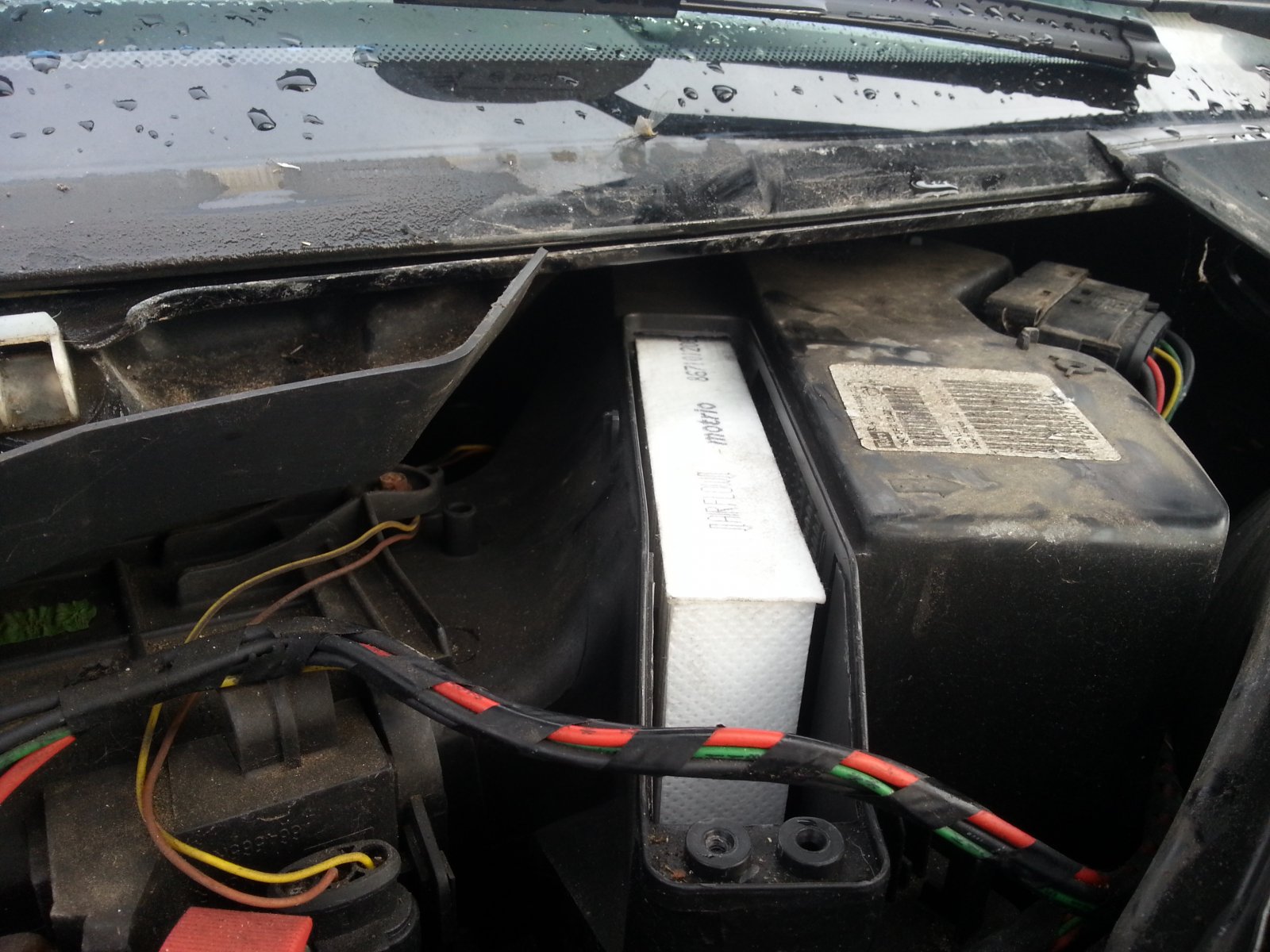

The scuttle panel trim also wasn't sitting right, and had some black gum stuff underneath it so removed all this and put some double sided tape on it. Sits flush on the windscreen now without moving anywhere so another job done.

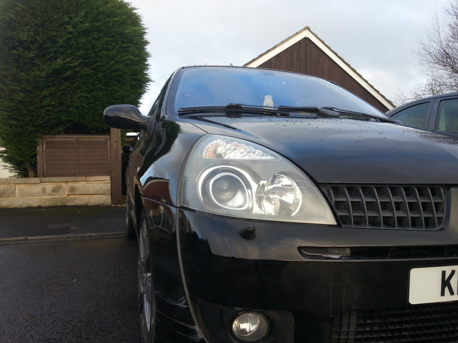

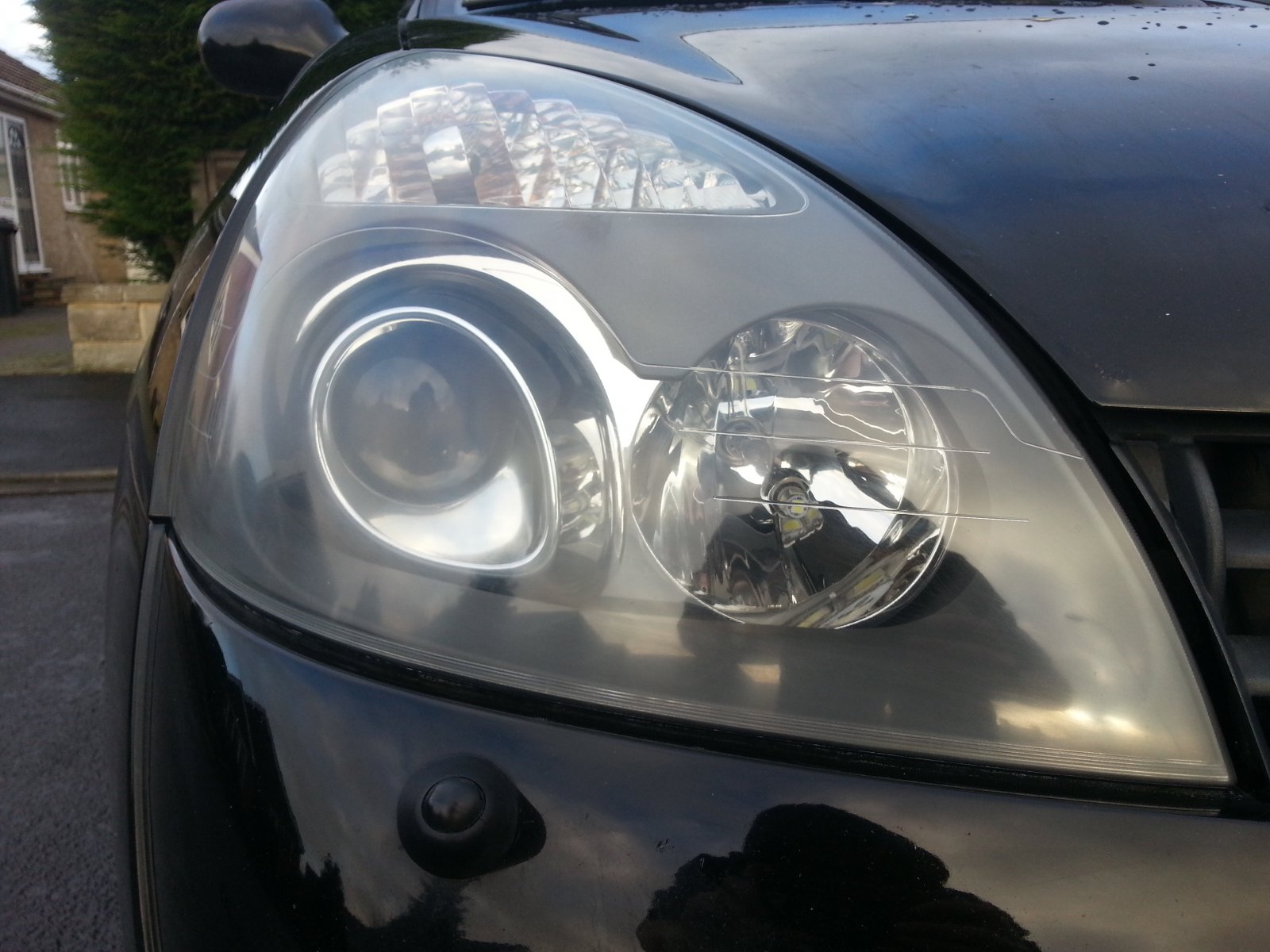

Next up I've done the obligatory sanding of the headlight/polishing. Only done by hand, but are noticeably better. Will get the DA on them in the summer.

Pollen filter added to my service list for next month. Never thought to check mine before but I imagine it will be similar to yours. Headlight polish makes such a difference to the front end. Nice easy job with great results.

Is the pollen filter easy to get to/change?
It's a 5 minute job. Pop off the scuttle on the offside (One screw, one clip and pull towards the front of the car) then remove the bolt holding the lid on the box of the pollen filter box. Then remove the old one. Takes a bit of bending/fiddling to refit a new one, but it's simple.

My filter was like that, still didn't fix my misting up problem when I changed it last year mind.

Yeh it's a piece of piss mate, takes 5 mins. Unclip scuttle panel under windscreen on drivers side and you'll find a thin box going diagonal. Think it's got a few screws holding the top on, remove that, pull filter out, put new one in, job jobbed.
leeds2592
  Bean 182 + E70 X5
I used a genuine one also. Just make sure you put it in the right way.
There's an arrow on the filter and on the plastic at the side. Make sure they're pointing the same way.

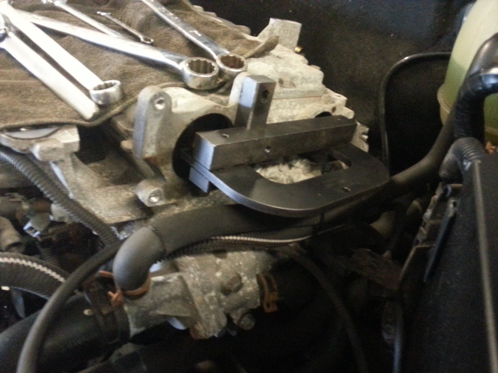

I drove down to Nottingham to visit @MicKPM in order to get the belts sorted properly as they're long overdue!
So glad I did as the timing was out by a fair bit, and there were tipex marks pretty much everywhere with the belt overtightened too... The idler also had a few splits in the back, which Mick told me I was lucky to have not fail!

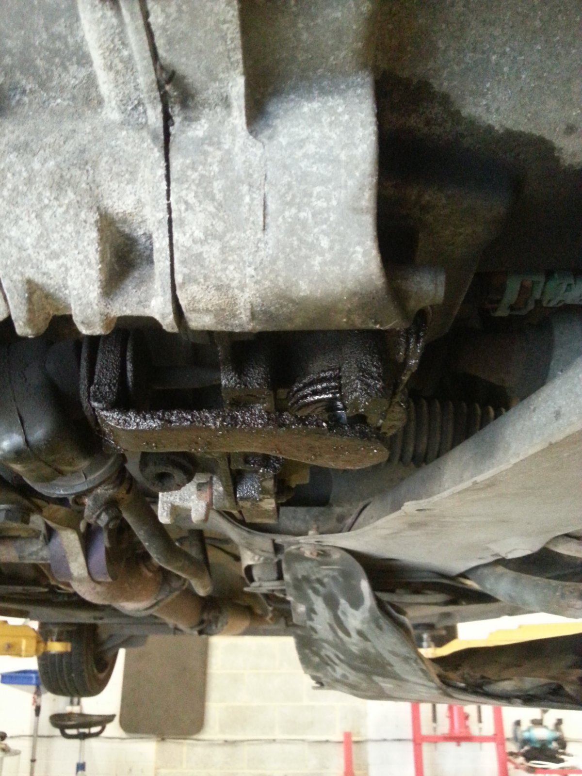

Unfortunately the water pump was also leaking, and looks to have been doing it for a fair while as it's caused a slightly rusty subframe. It had the original fitted, so again, long overdue! Also had a big chunk out the side of the crank pulley (?) which seems to have been used for leverage at some point which was replaced with a good used one.

I have a slight gearbox leak from the selector seal which I may eventually get sorted, but i'm unsure on how big a job this is? Might just keep an eye on the gearbox oil levels for the time being. I am also going to get hold of some arch liners to replace the non existant ones and sort out the blowing cat. Also got the cruise control switch to replace as it's not staying down when you press the button.

A few pictures, but not many as I was preserving my phone battery/ didn't want to get in the way too much. (Sorry about the quality too).

Oh and I wouldn't worry too much about that leak on the selector seal, think 99% of Clios have the same problem, mine included.

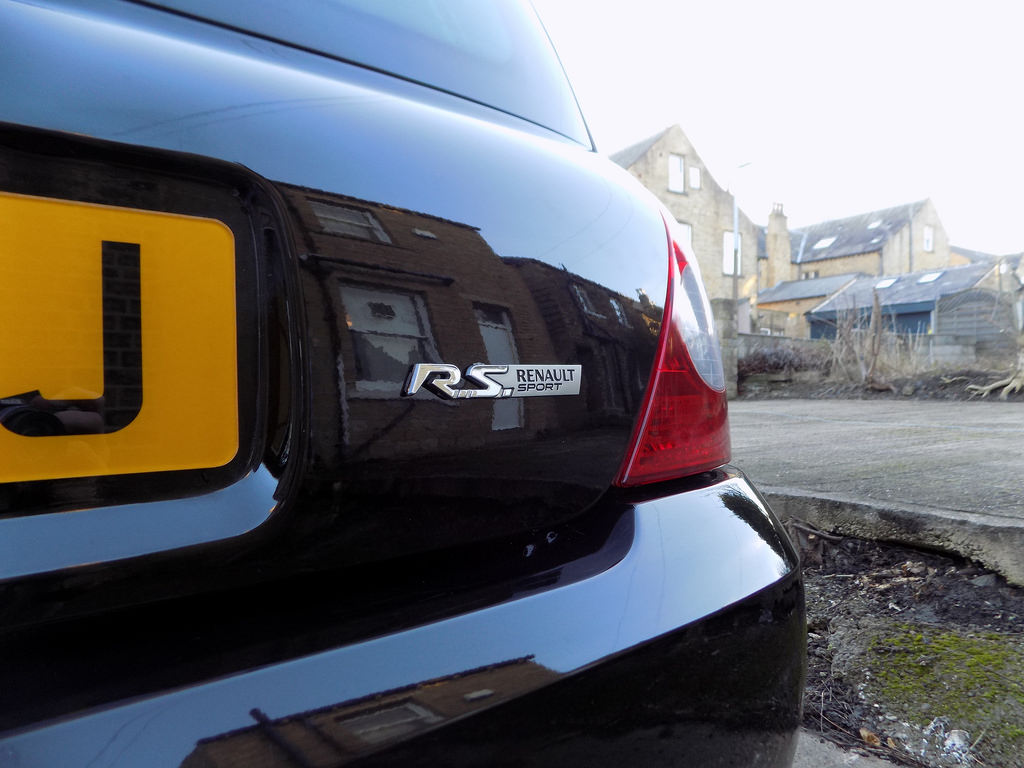

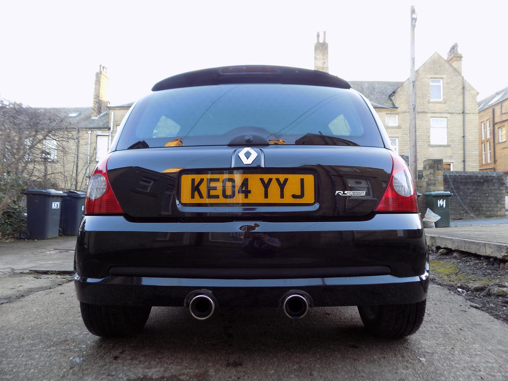

After around a 3 hour round trip on the M1 I decided it best to give the clio a quick clean. Nothing special just a 2 bucket wash and rinse. The AG HD wax I used is my first experience with any wax, and it makes the car so much easier to clean! It's shining again now, and I didn't have to completely polish it. Might top up the wax tomorrow to make it easier when the black inevitable gets dirty...
Whilst I was at it i removed the existing clio badge, and replaced it with the new style RS badge which I had been meaning to do for a while. Got a bargain of £15 for one off ebay.
DSCN0269 by Louis Walker, on Flickr
DSCN0271 by Louis Walker, on Flickr
Theres a slight bit of the double sided tape showing, so i'll probably do this again with some proper 3M stuff and trim it all down however for now it's OK.

They always look so much better with the newer badge.
Sort your wonky numberplate out though ;)
