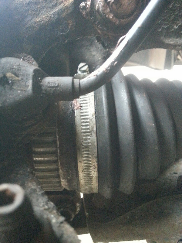

New ABS rings/jubilee clip

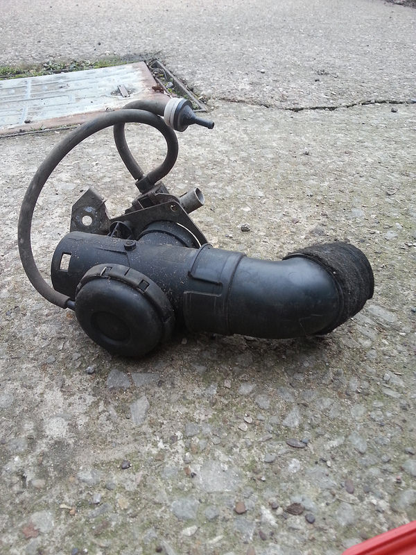

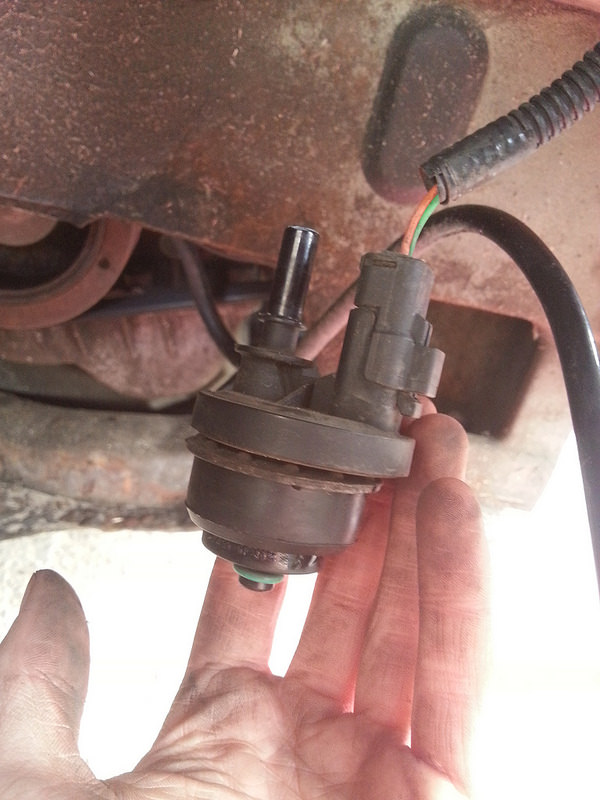

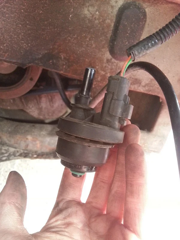

I also removed my acoustic valve today as there's lots of mixed opinions, but the general consensus is that it's not needed.
20170214_160911 by Louis Walker, on Flickr
How did you get on with this? Major difference? What did you go with the plug and any pipes etc?
Louis
I Love Ed Sheeran
Not any major difference really no but I'm yet to go for a proper drive.
All I did was remove the tube that went to it and disconnected the connector. Then put a bolt in the tube and tied them up. Simples.
Louis
I Love Ed Sheeran
How come you removed the acoustic valve if you have a KTEC setup? Other than saving 400g or something?
Seems pointless having something on the car which is doing nothing especially when running the KTR. Would it have even been functional without the airbox?
It was more of a 'whilst I'm there' job as I had the wheel off anyway just checking over my suspension etc for any movement as I have an MOT coming up soon. I have no arch liners either so literally took about 5 minutes. It's 2 bolts, 1 electrical connection and 1 hose. Think I'll remove the bumper tomorrow if I get chance and pop off the carbon canister as it's ticking away.

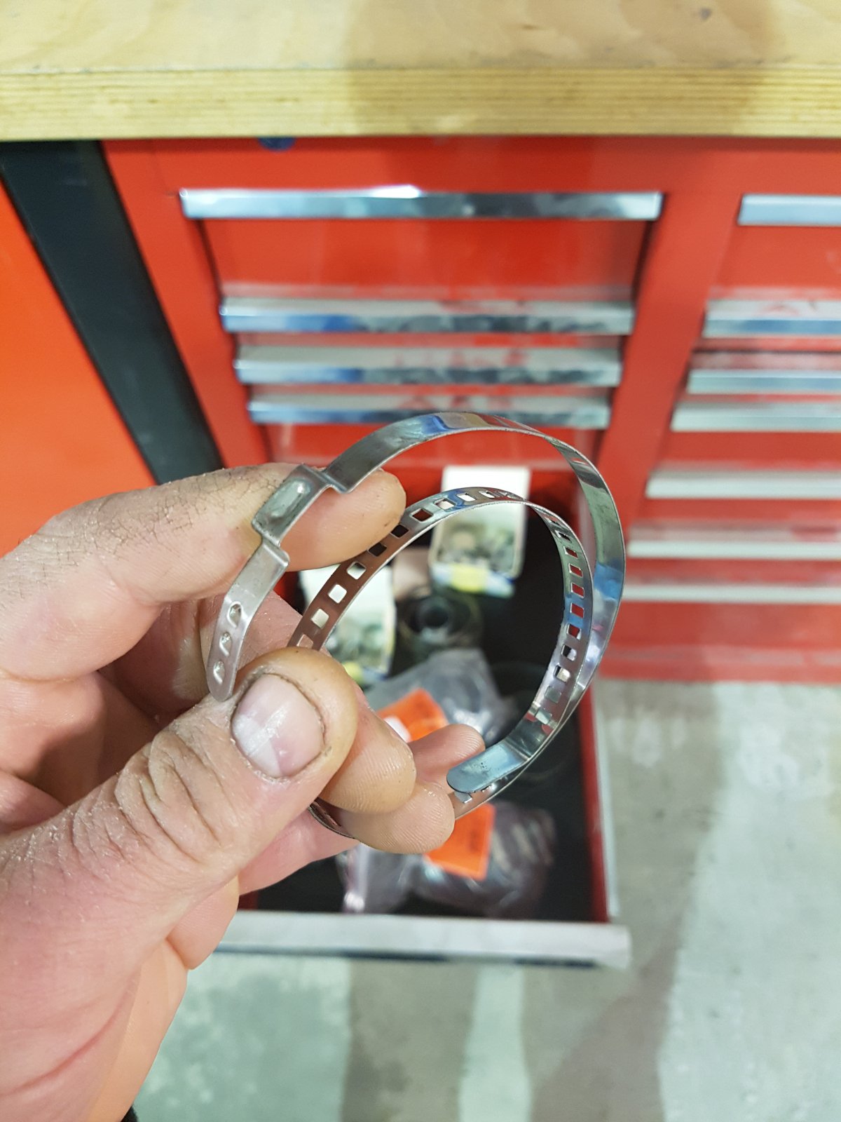

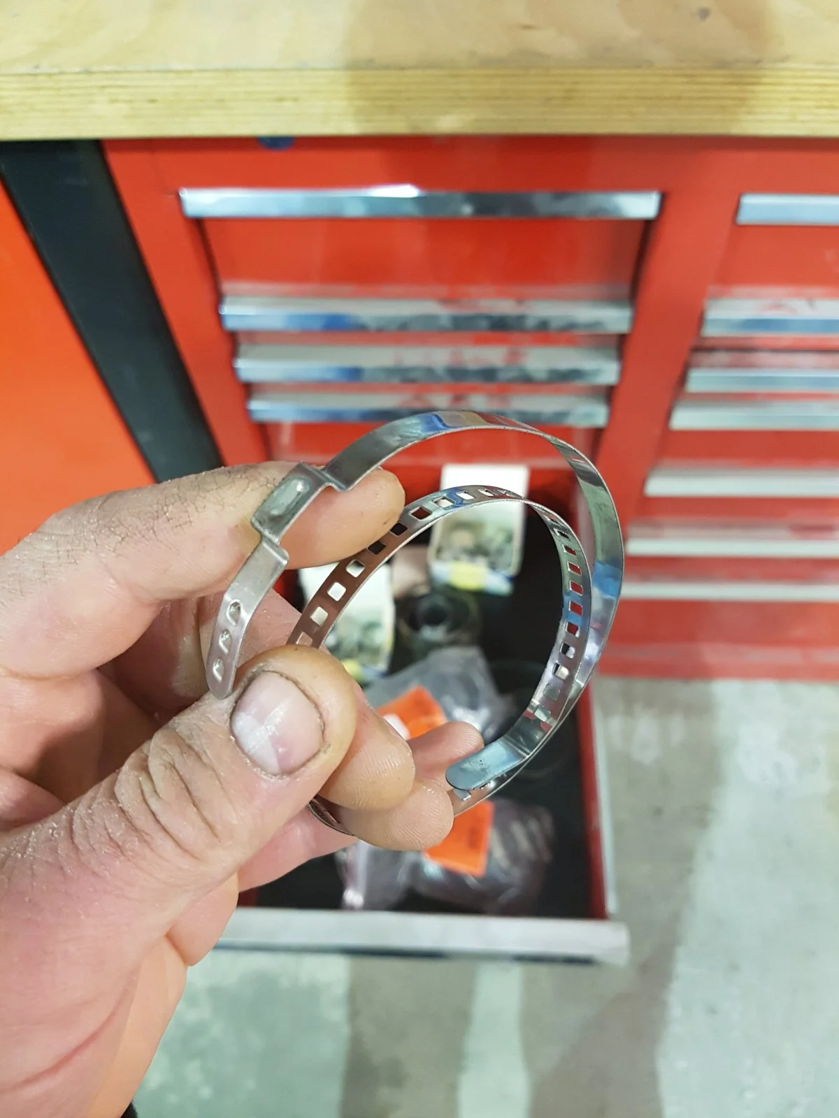

Personally I'd use the proper clips on the driveshafts mate. The tool is only £4 on eBay and the clips are just as cheap. Jubilee clips come loose very easy over time when moving.
Jekyll
I'd agree with Dan mate. You need these clips:
Ive removed my carbon cannister too. Threw away the cannister and the pipe from the inlet, and kept the lid connected to the other one and plugged it with a bolt. I looped a pipe from the back of of the inlet to the front air pipe.

Don't listen to these two, I've had jubilee clips on for aaaages now and they haven't come loose or anything ;)
Yes these are what you need !

I'd looked at the proper clip's the other day actually but I'd read a fair few threads where people said jubilee clips were better. It'll get me through the MOT for now anyway, then I'll look at buying the proper clips/tool.
Anything beats the cable tie that was on before.

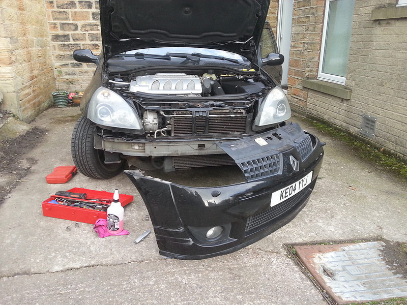

Another update as I remove more things from my car... weightsaving yo.

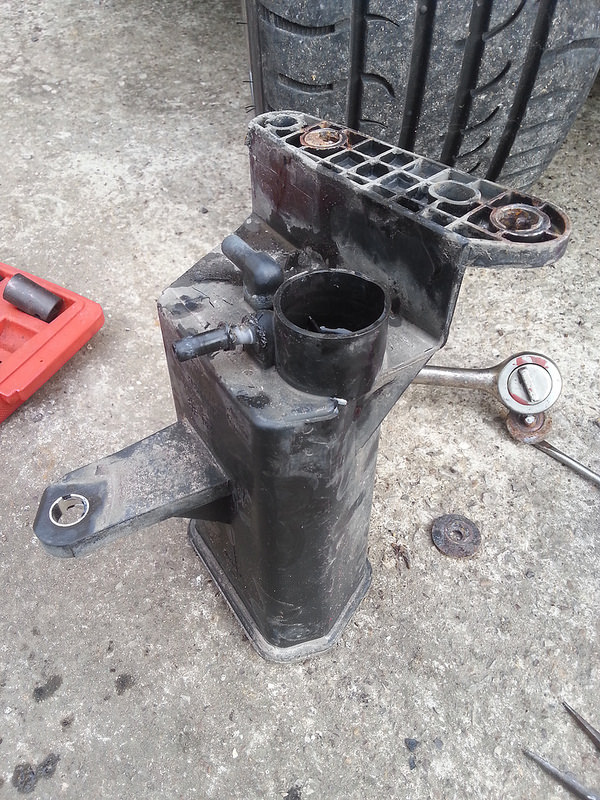

Had a loud tapping from my carbon canister, and again, it's completely not needed so I removed it. Both bolts underneath which hold it on snapped off, but thankfully the one behind the front bumper came out easily enough.

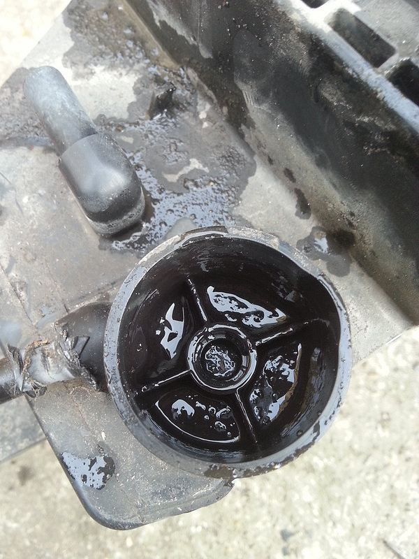

I removed the actual connection from canister to solenoid and it just was full of dirty grim looking watery oil crap. Could hear the stuff inside moving around too so it must have been past it's best.

I left the electrical connector on the solenoid, and disconnected the inlet pipe then blocked it up with a bolt.
20170215_150847 by Louis Walker, on Flickr
I left the breather for the fuel tank unblocked, and tied it up to vent just where the carbon canister used to be. Am I wanting to do something better than this or will it be OK? I don't want any fuel smells ideally.
Tied up the inlet/solenoid underneath too. Pretty easy job and no more tapping!
Quite surprised the difference it has made really, sound is much better from inside the car.

Does it sound better now? Different to your PM?
Yeah it does, sounds loads better! It must have been bouncing the ticking around a fair bit. Think I was just overly worried that something was wrong as I've never really heard these cars idling before.
You dont get any fuel vapour smells do you mate?
