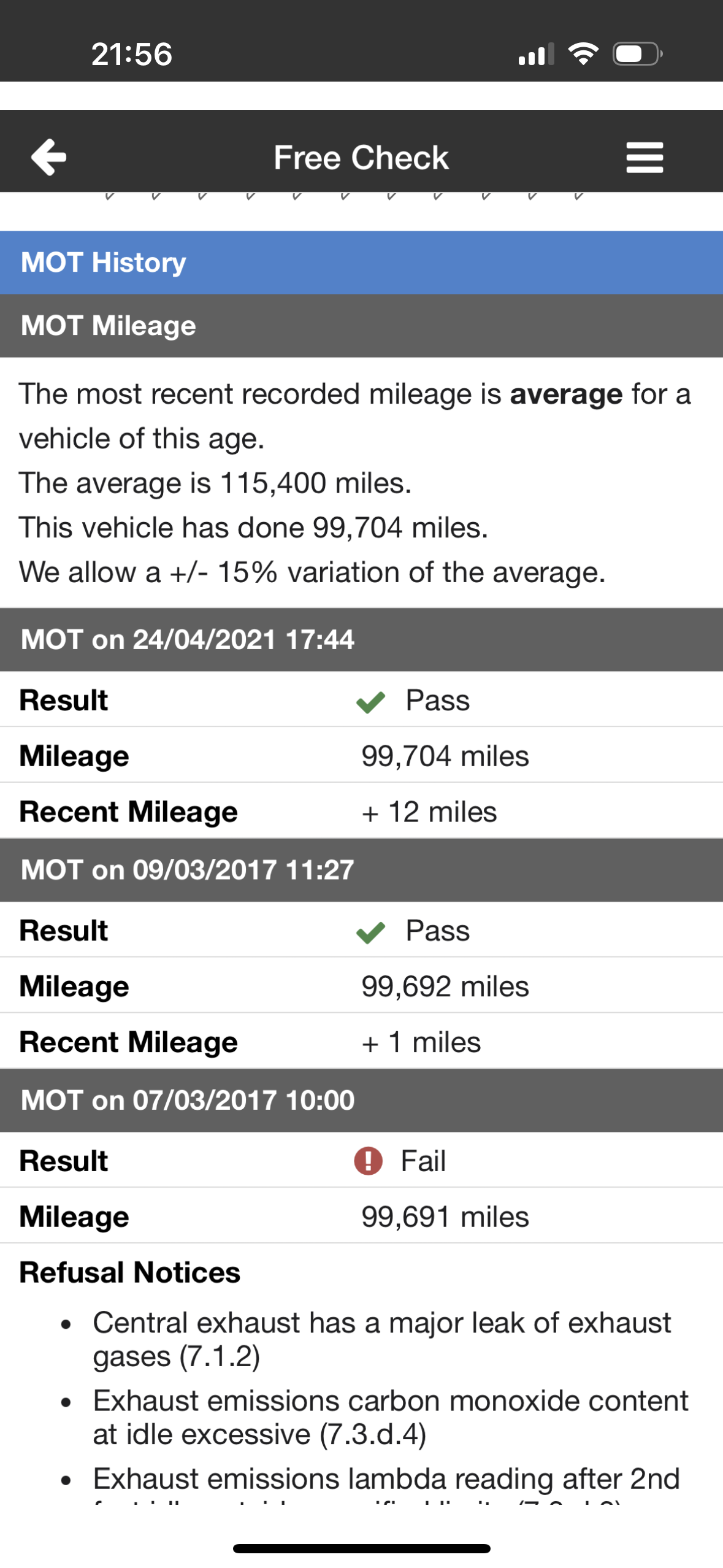

Clio passed MOT today, cat dropped everything in spec after a bit of a warm up.
Crazy the difference it made swapping exhaust tips out the back.
Oh well another 12 months on now! Did mention surface corrosion underneath, it's news to me that 👀

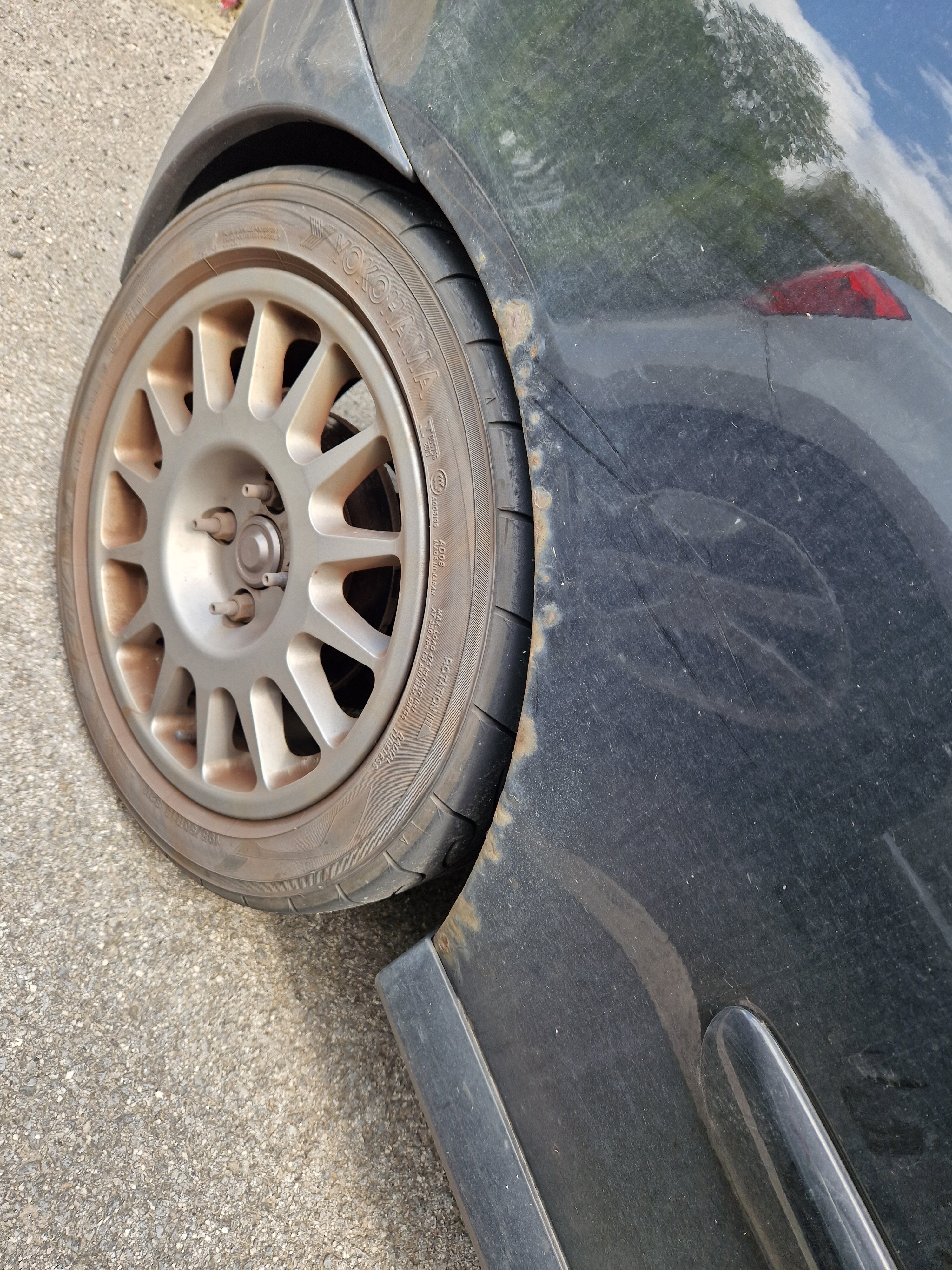

I've just started on some preventative rust maintenance today. Where in the country has your car spent most of it's life?
Interested to compare to mine, I'm on ~145k, but it's lived down south most of it's life I believe, not even a bubble on either rear arch. Not had the skirts off yet mind, inside the rear door cards wasn't bad at all though.
Louis
I Love Ed Sheeran
It's been up north the majority of the time, but it's also done 165k miles. I drive it every single day and it's not been washed for 8 months 😂
I treated the internal rust and it was fine tbh. Still solid

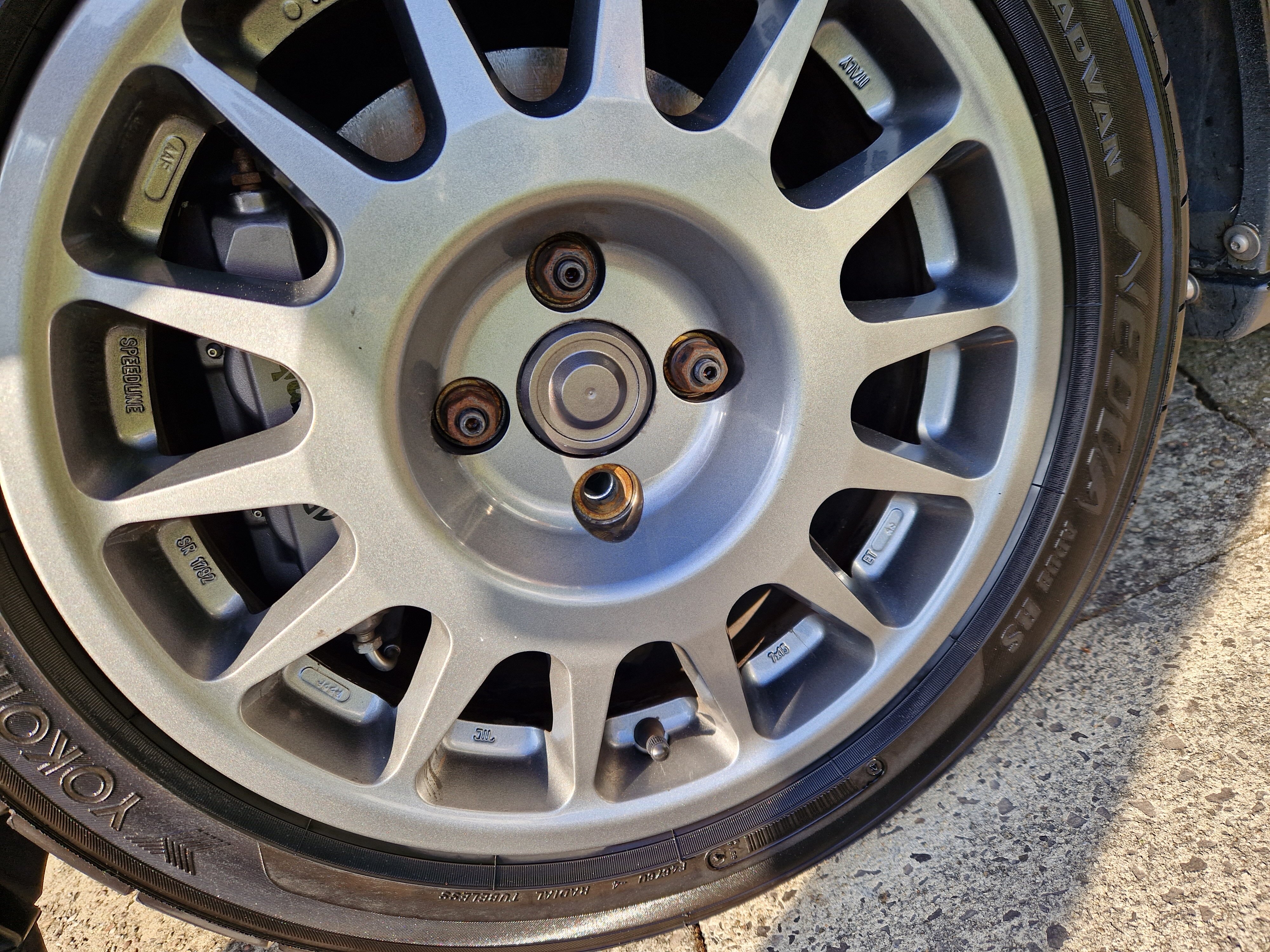

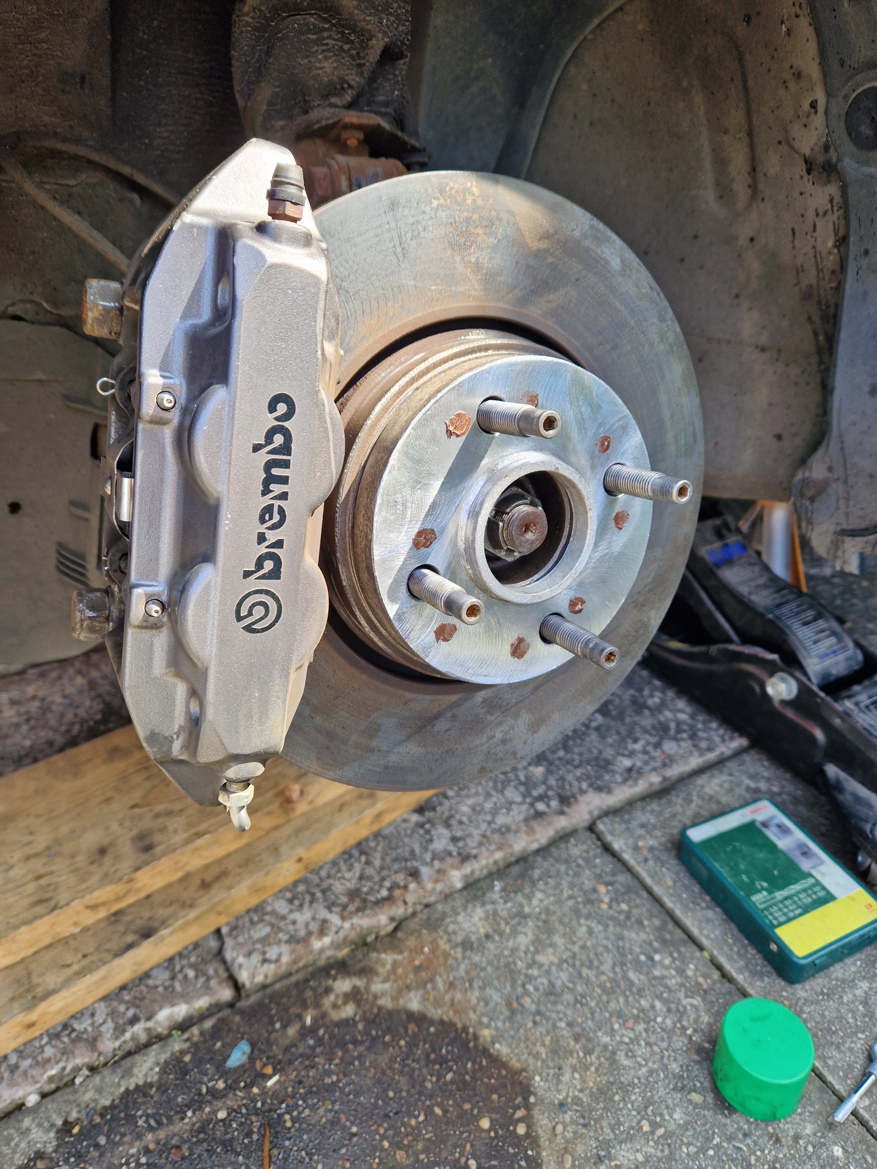

Fixed it.
Weirdly all the studs were kind of loose in the hub so I removed, tapped and reloctited all of them. Wonder if the bearings going causing excess heat? That stud was sheared in the flange, so the tyre monkeys have clearly ugga duggad it too much.
