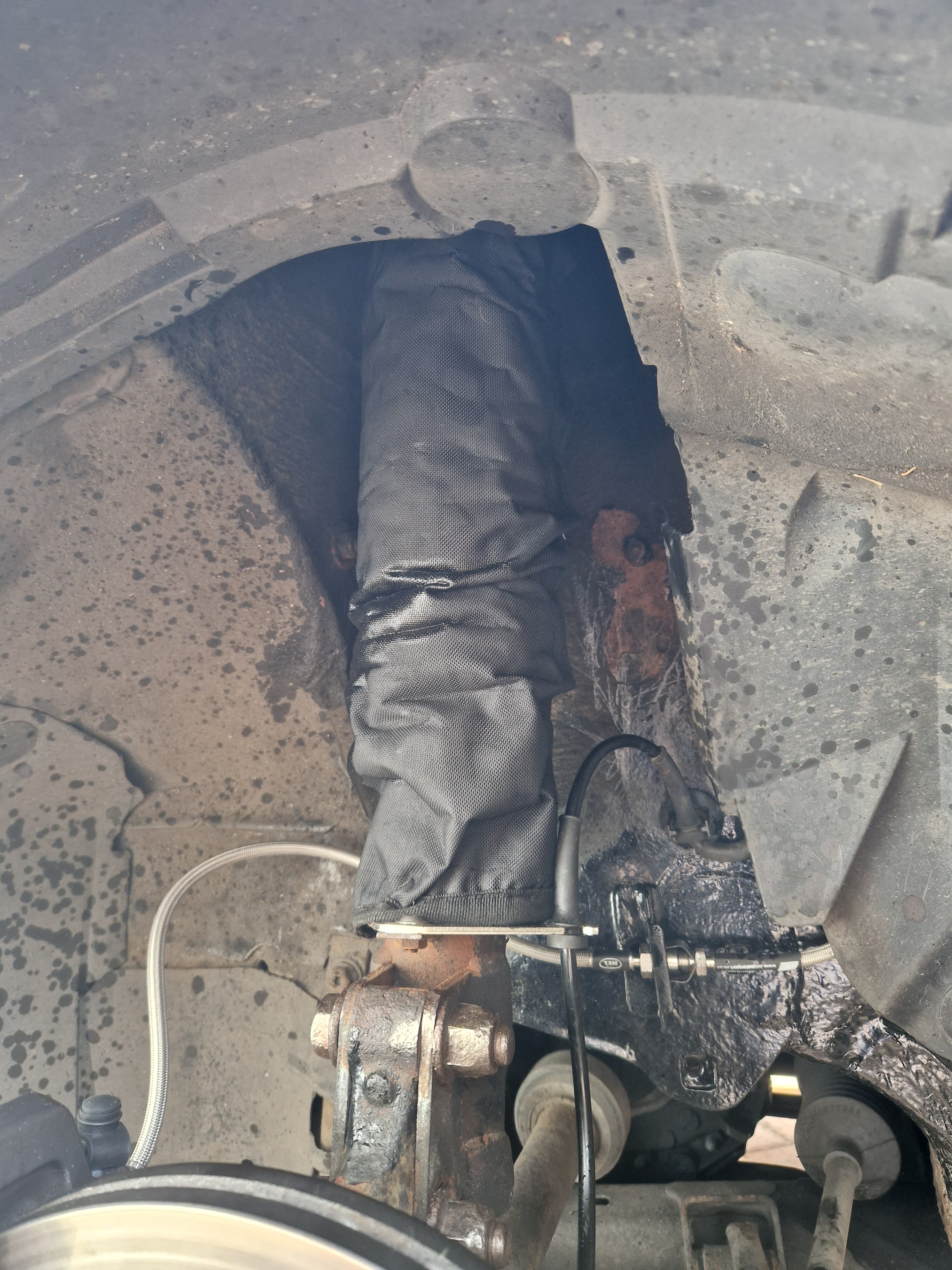

Decided I was going to make use of the good weather and fit my brembos today. Unfortunately my hardlines were rusty (obviously) so I needed to replace them. Spoke to BRT motorsport and with help from @Touring_Rob , @RichValver and using catcar I got the dims needed. Had a pair of braided lines made up and cracked on with fitting them.

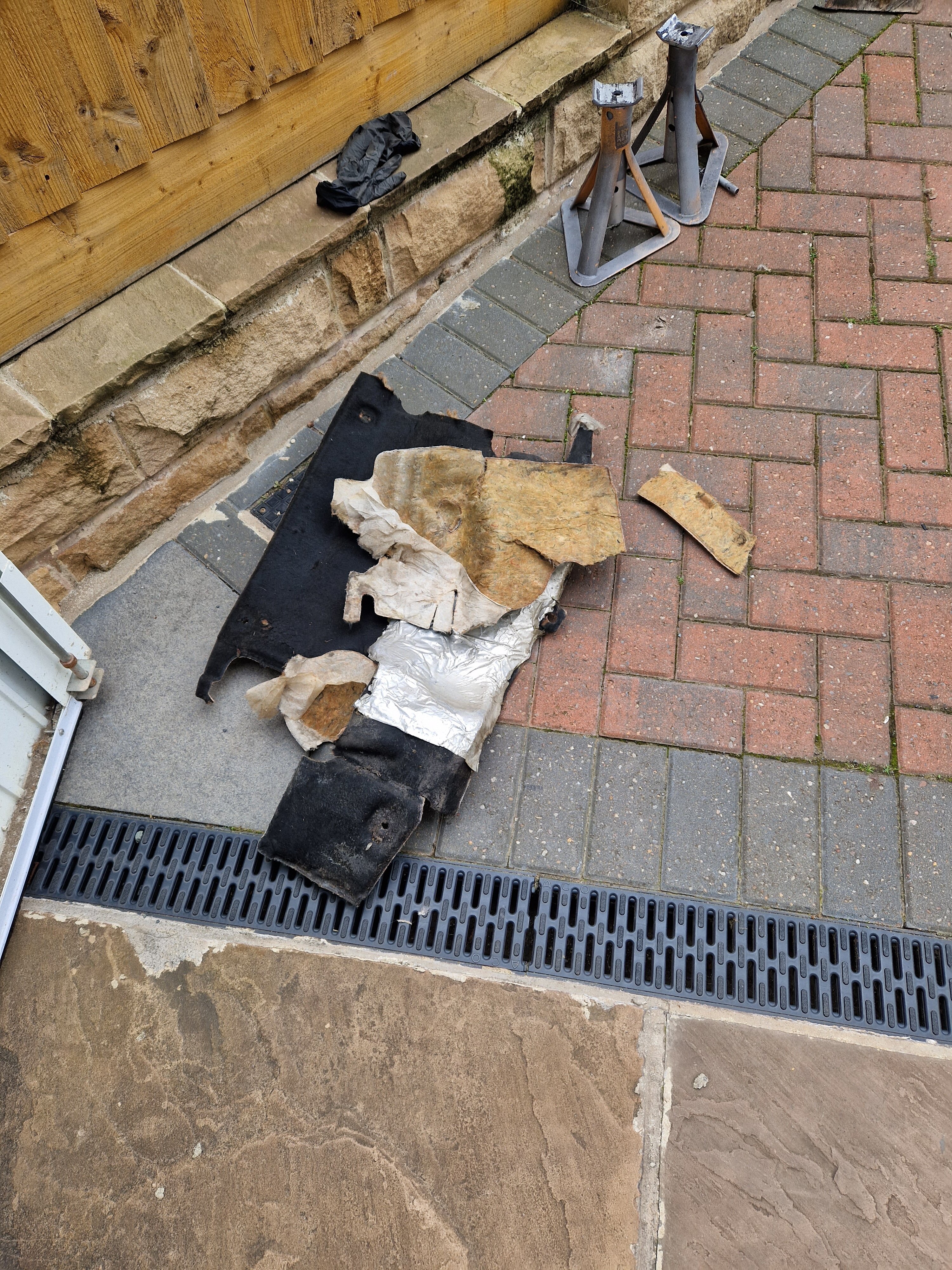

Now this isn't easy with the engine in place so I had to tear out the fabric heatshield to gain access.
I disconnected the hardlines from the calipers and plugged them with some blank m10x1 plugs. Absolute game changer!

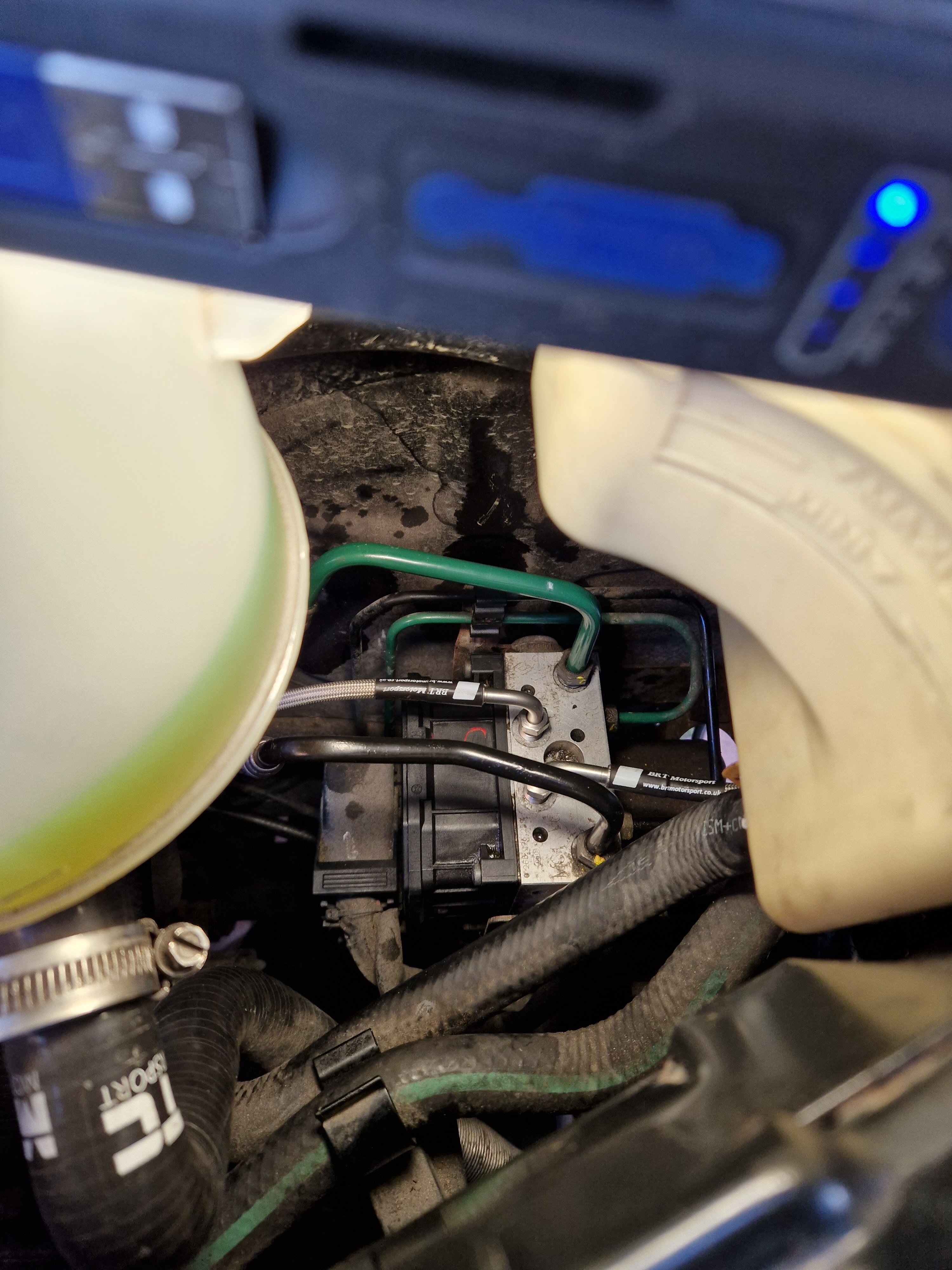

Hardlines out and ABS pump plugged this is where I was at.

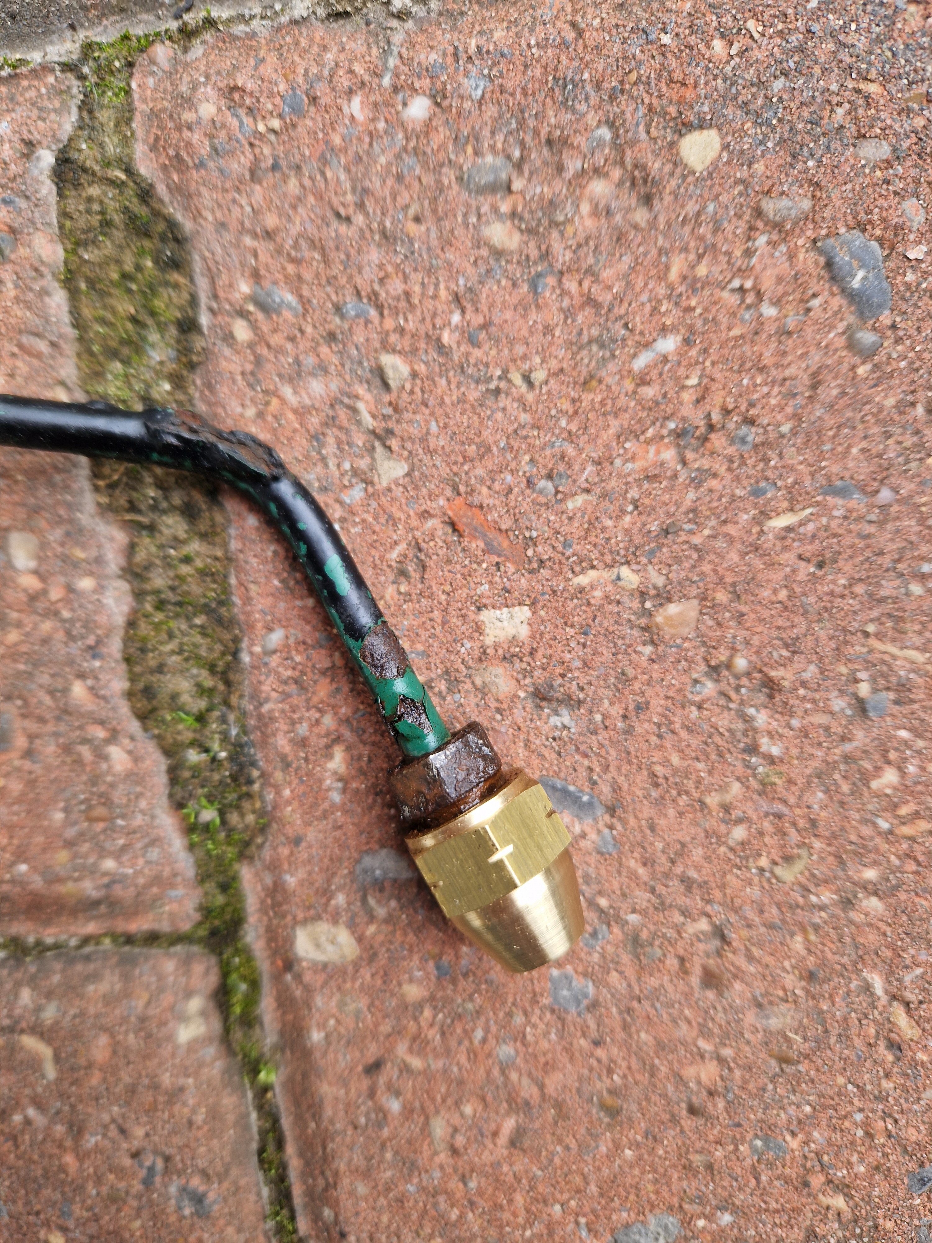

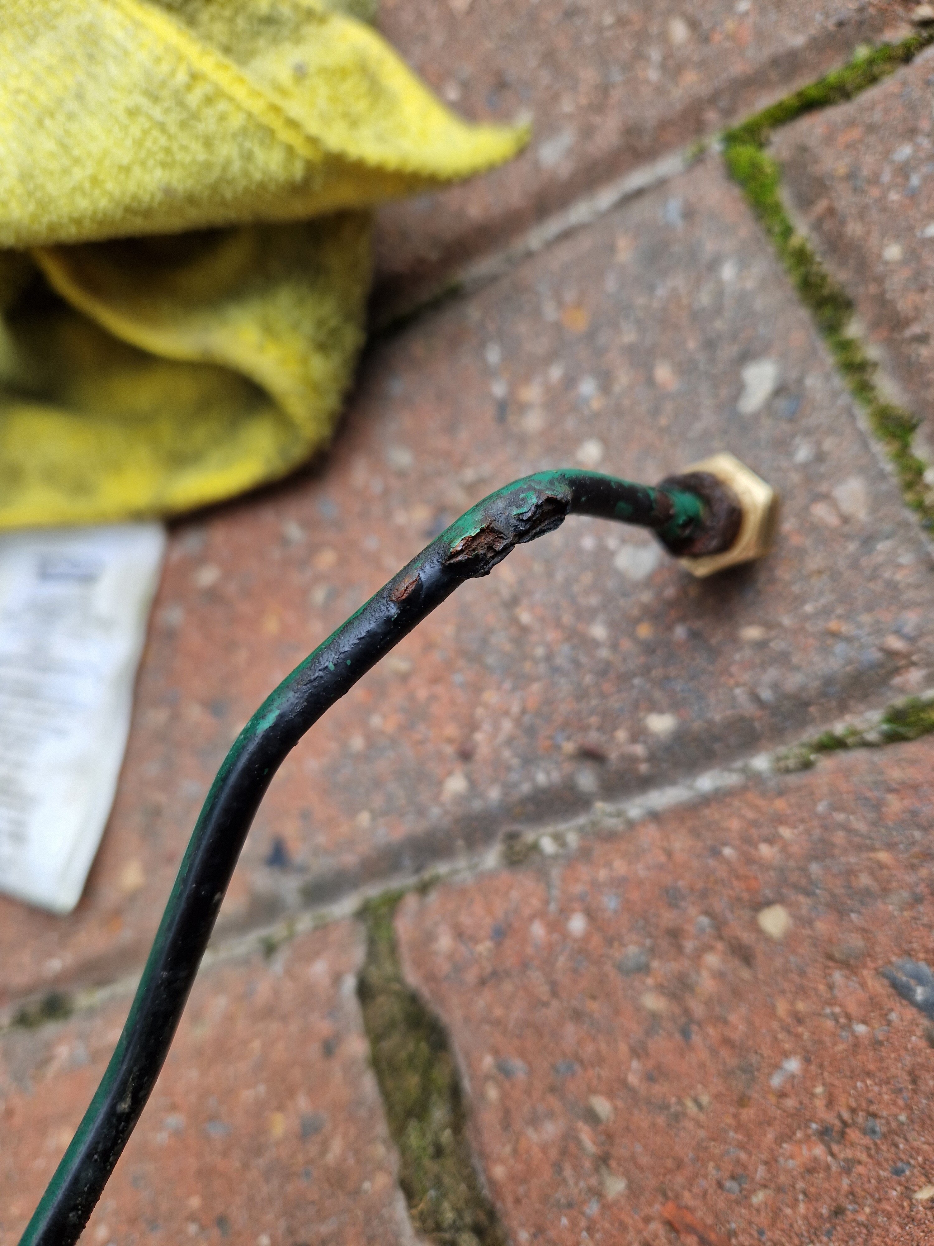

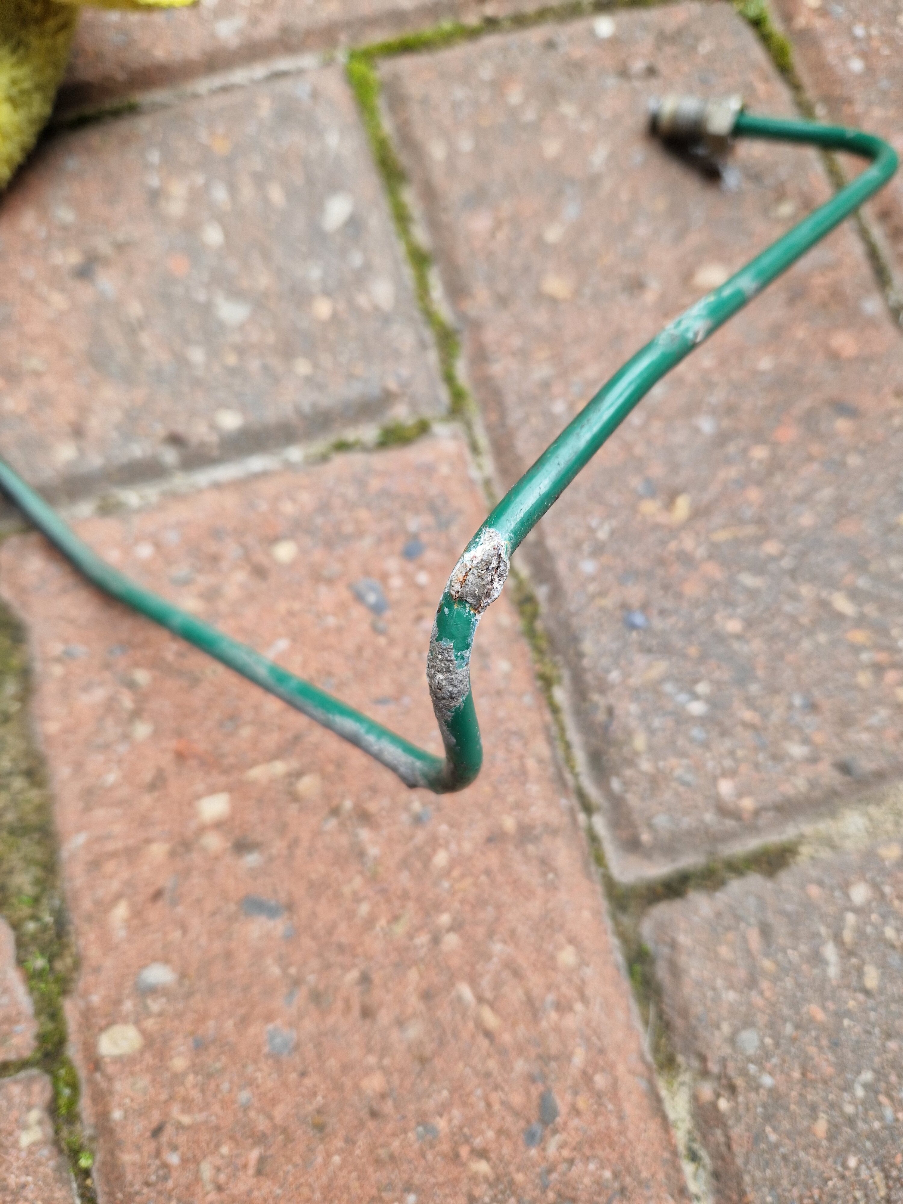

Old lines were fucked! Now routing the new lines was a pain but got there in the end and basically got the lines clipped into all of the oem guides.
Much better!

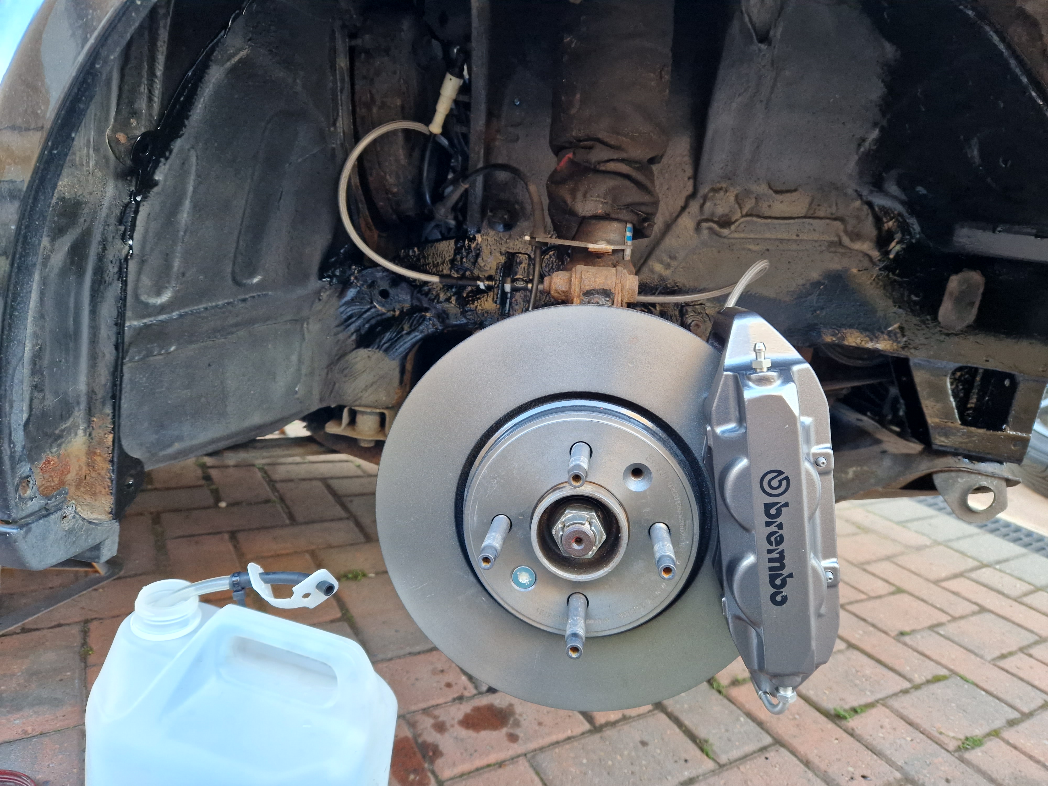

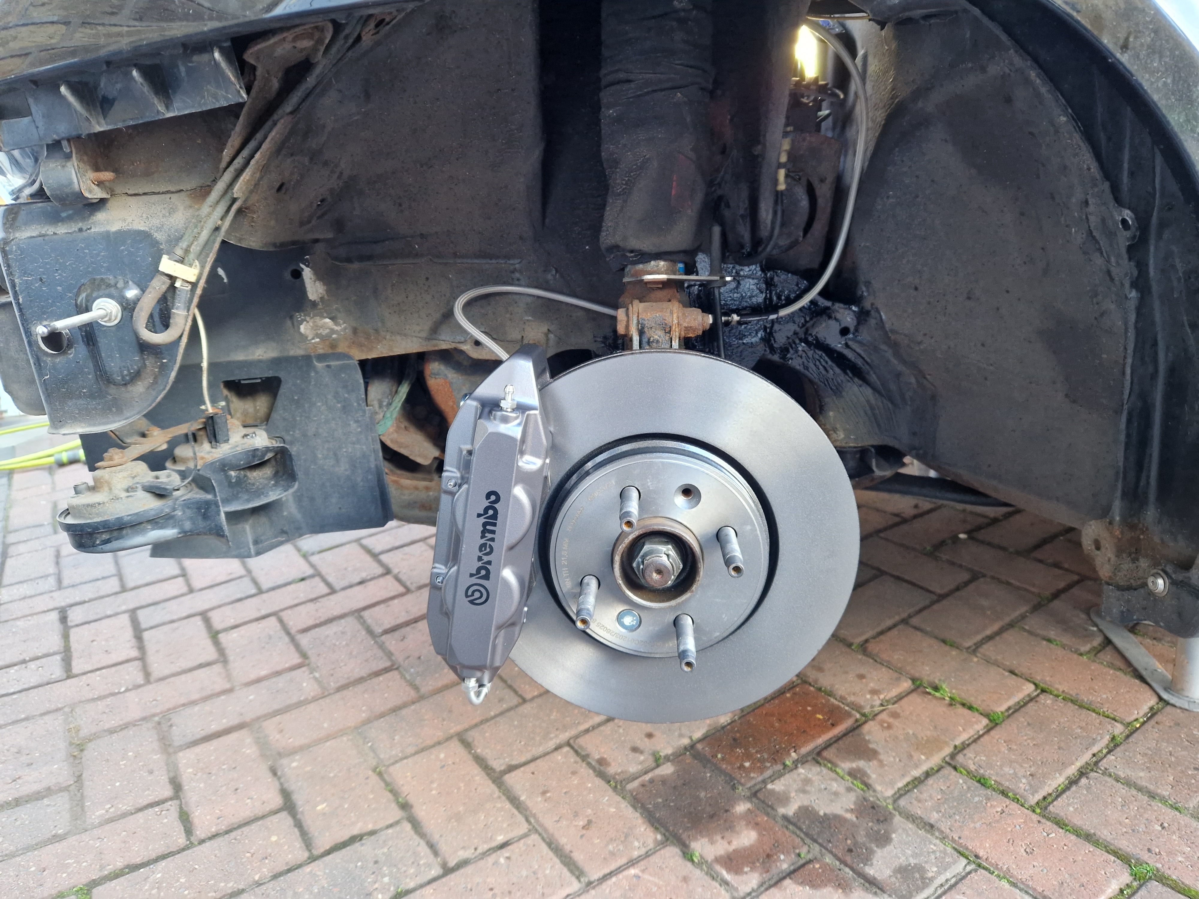

Fitted the brembos and needed to tighten pretty much every fitting. Getting the lines to seal on the pump was tough as there's not much space for leverage but got there eventually.
Brembos were bled but will definitely need doing again.
Some quality machining got the ds1.1.1.111s in the perfect position.
Fingers crossed no leaks in the night!

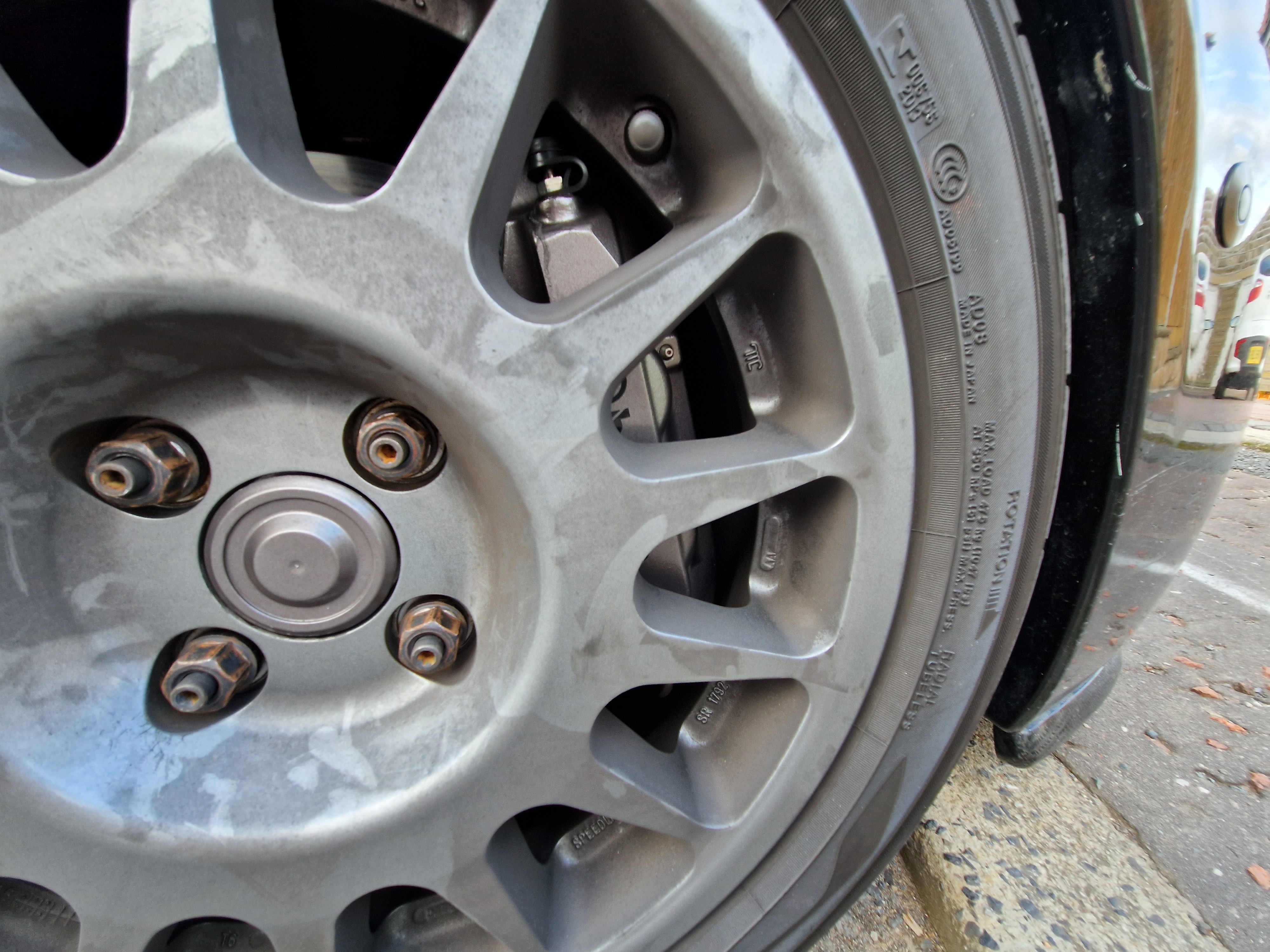

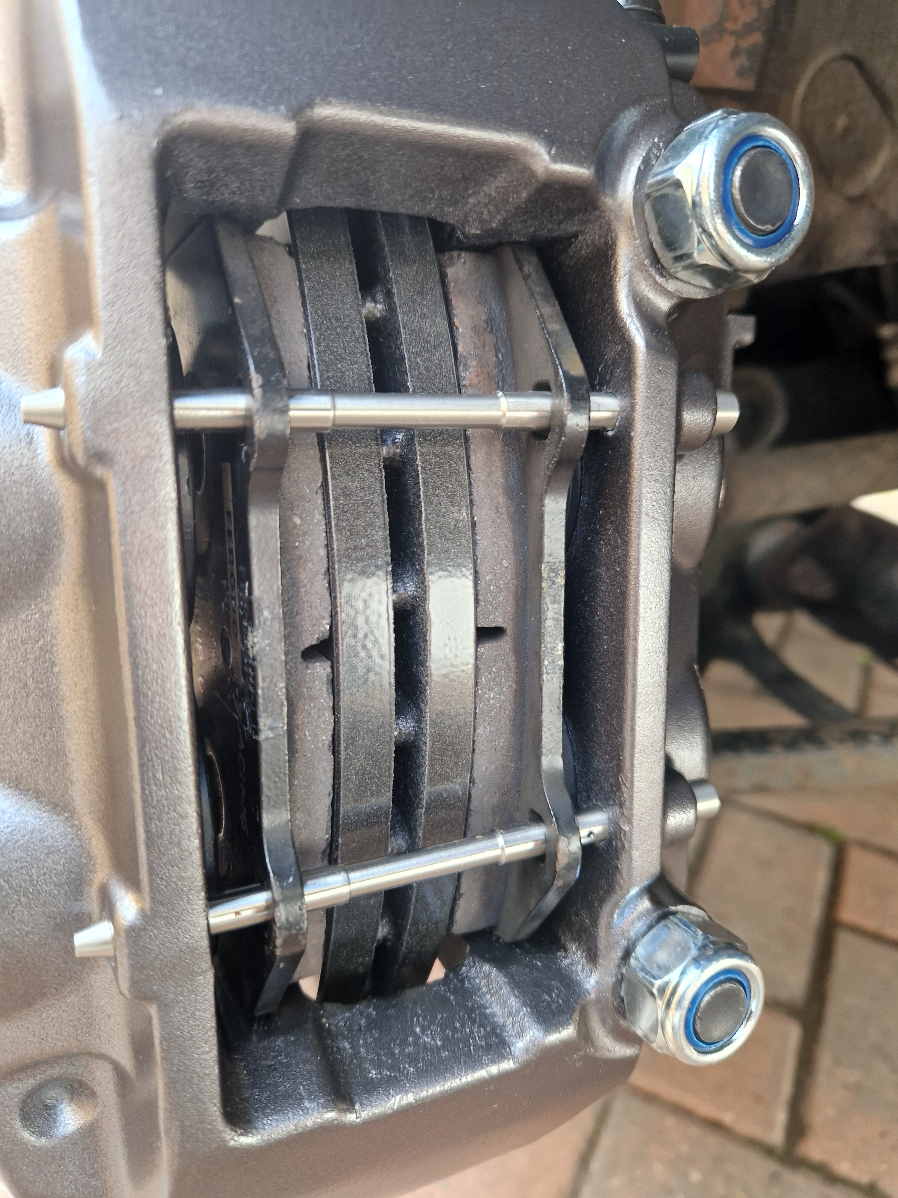

Just look at that pad alignment 😍. And the studs are perfect length for the nylock nuts too! Would you look at that @Iranian Pudding 😂.
Good work with the new lines Luios. Rob is probably right about taking the engine out to fully de rust the front, good job you'll be needing a derv beater for the commute eh.
Louis
I Park Like a C**t
Its weird because Kyle has absolutely loads of thread sticking out past the nylocs but his pads sit almost identical to mine? Probably the mill grinder he used 🤣 I had wanted to use a washer behind the nut but wanted to ensure the nyloc was engaged.
This was 100% only 5mm of material removed with your 280mm brackets.

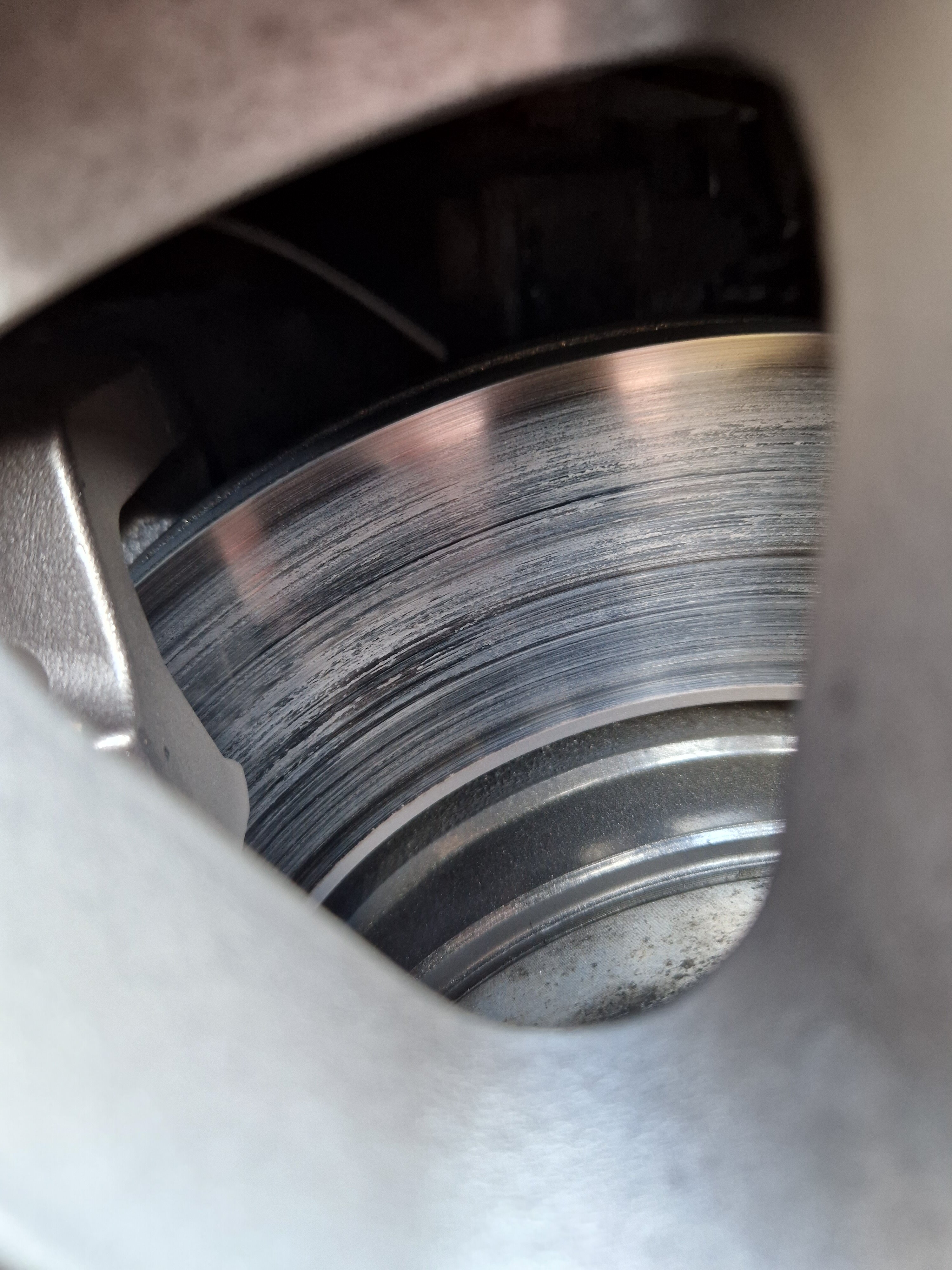

Went out and did some runs down the local industrial estate mexico to get the pads and discs hot. After a few runs it stops like nothing else! There's definitely some more pedal deadzone but I think they need bleeding again. I activated the abs so that should have cleared out the pump if there was anything there.
Got some deposit onto the discs so couldn't have asked for anything else. Shoved it on some chocks to let it all cool down.

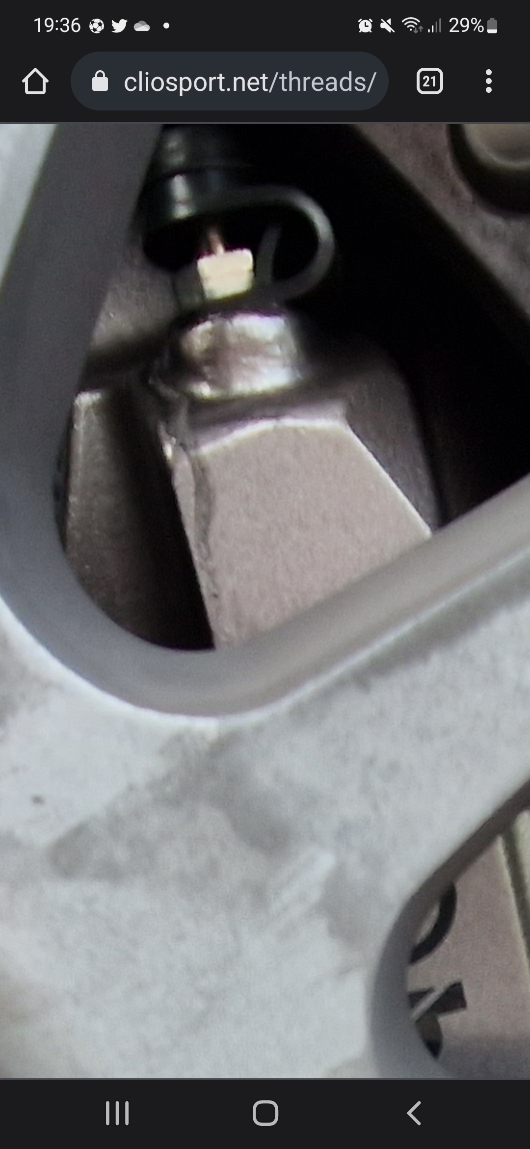

I spoke too soon.

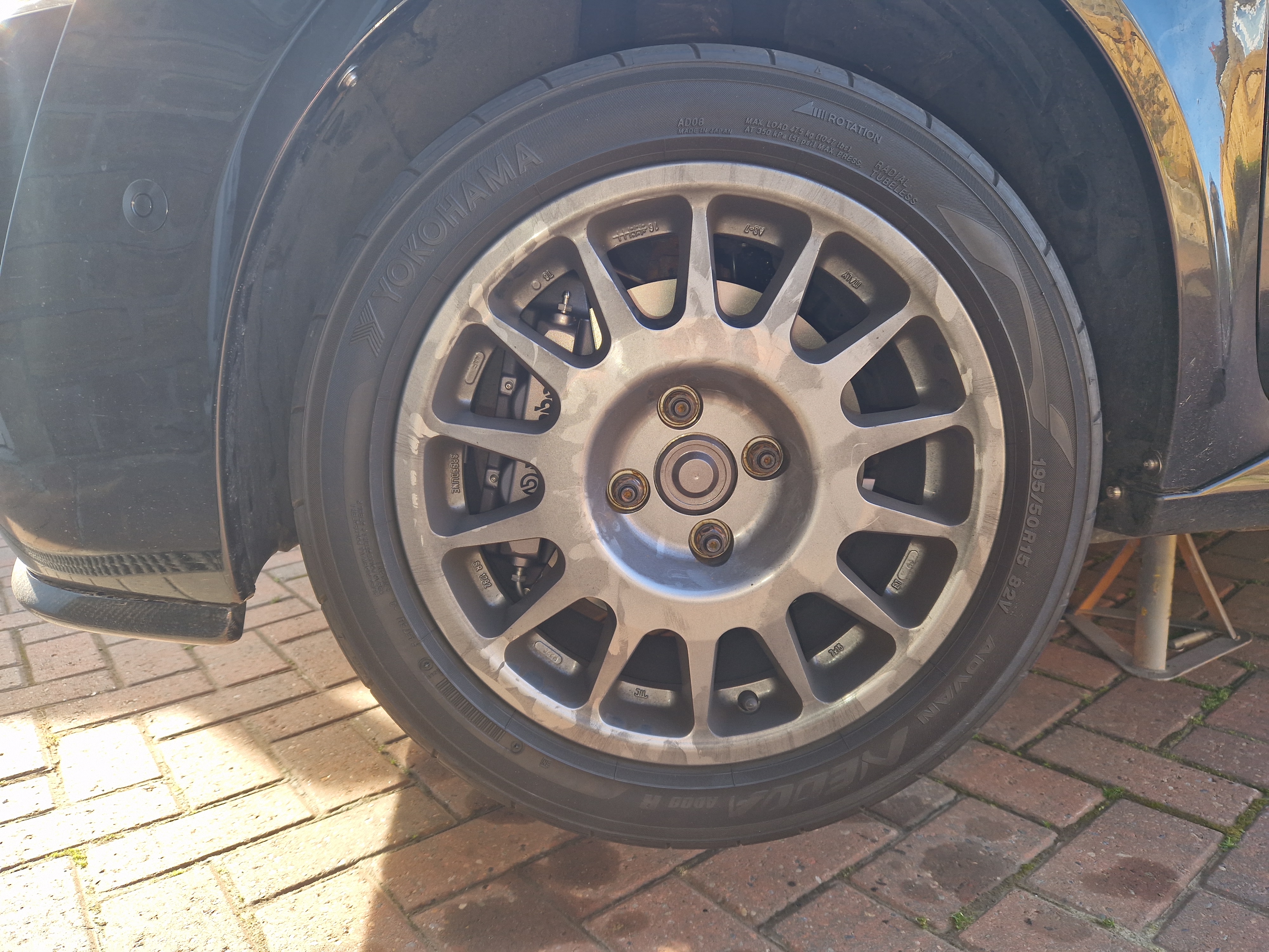

Zoomed in on this photo and I saw the telltale marks of dripping fluid.
Rushed out and both f**king bleed nipples on both calipers have leaked. I've no idea why, they're genuine HEL stainless items and I did them properly tight.
Now both calipers have a run line on them from leaking fluid.
I've swapped them over now and f**king wellied them tight. If it leaks again someone can come set fire to the car for me and I'll claim the 6k.

Are they leaking from the threads or the ends of the nips?
Pad alignment looks great though. I found the only way to bleed the Brembos properly is with a pressure bleeder. Trigger the ABS pump on rs tuner /clip and force a couple of litres of fluid through them. Doing the outer first seems to work better too. On mine there’s no dead zone, the brakes are either not pressed or you’re though the windscreen
Louis
I Park Like a C**t
They're leaking from the threads. New ones appear to be OK so far. So frustrating after all that work! Ahh well, better to just let it be as i can't go back now. Should have just powdercoated the calipers...
And yeah I have a pressure bleeder but will try that next weekend when I have more time. Need the car for work so it's always a mad panic!!

My braided lines leaked as well. I think it happens with the stainless fittings more because they don't deform to create a seal as much?
On the lines I just nipped them up and rocked them back and fourth I guess like lapping a valve in, did them up and all was well. f**k knows what you should do with bleed nipples other than Wang them up taf.

That's a shitter mate. They definitely the right bleed nipples? Wondering if the threads are doing a bad job of sealing when really the bolts are too short so not sealing against the mating surfaces if that makes sense.
Could the fluid have come from inside the nipple when stood still?
Definitely right mate yeah. Tapers matched that of the others I had!
It definitely leaked past the thread as the little rubber caps were just sat pooled in fluid.
I'm sure i won't be too bothered once they've had some mileage on its just the principle of a fresh set of calipers that I've kept mint. Definitely will powdercoat next time!

They appear to be OK for now. I'll let everyone know tomorrow when I've driven into a wall. Just self bleeding calipers 🥴
Went outside and hosed off the calipers and wheels just to make sure no fluid is sticking around.
Going to buy more brake fluid in preparation for this weekend and get the pressure bleeder on them.
Brigsy
  T.Turbo
Sometimes a bit of residual brake fluid comes out of the nips once up to temp, never seem to be able to get rid of all of it after bleeding. Agree with the stainless fittings sometimes weeping when fitted, does my nut usually end up going as tight as i dare.
Louis
I Park Like a C**t
This was sitting around the base of the threads. Annoying as I was so careful to keep them clean whilst bleeding etc.
New ones still appear to be fine so it must just be the stainless fittings. Word of warning for others I guess!

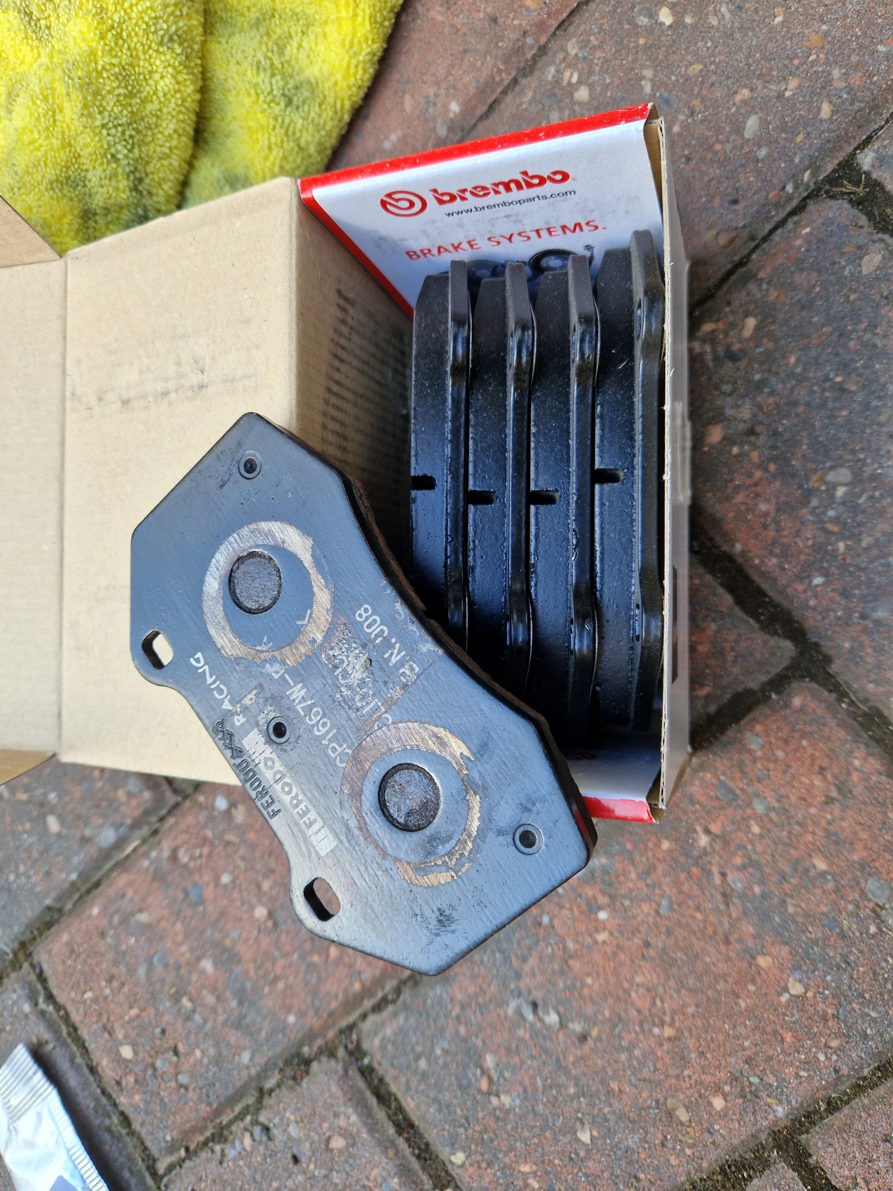

The ds1.11s got too much on the road and were squealing properly bad. @NickReilly063 can confirm how loud they were 😂
I managed to pick up a set of brembo oem pads for £28 so threw those into the calipers. Can see the metallic shine in the ferodo pads when the sun hits them which is why they'll be so noisy.
These new pads also have a chamfer on the leading edge which again should help reduce noise. I'm not expecting amazing things from the pads but for the daily drive to work they'll suffice.

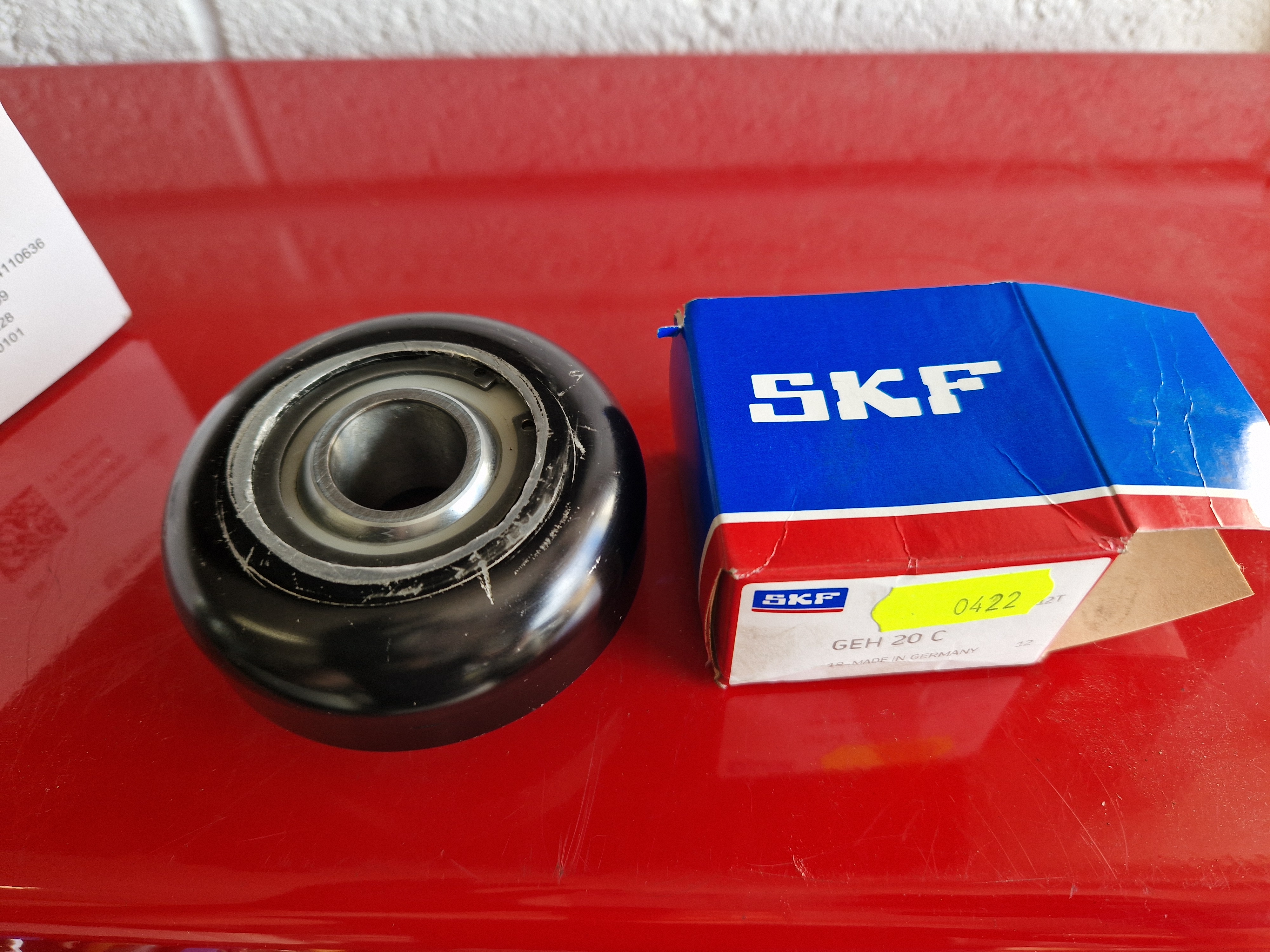

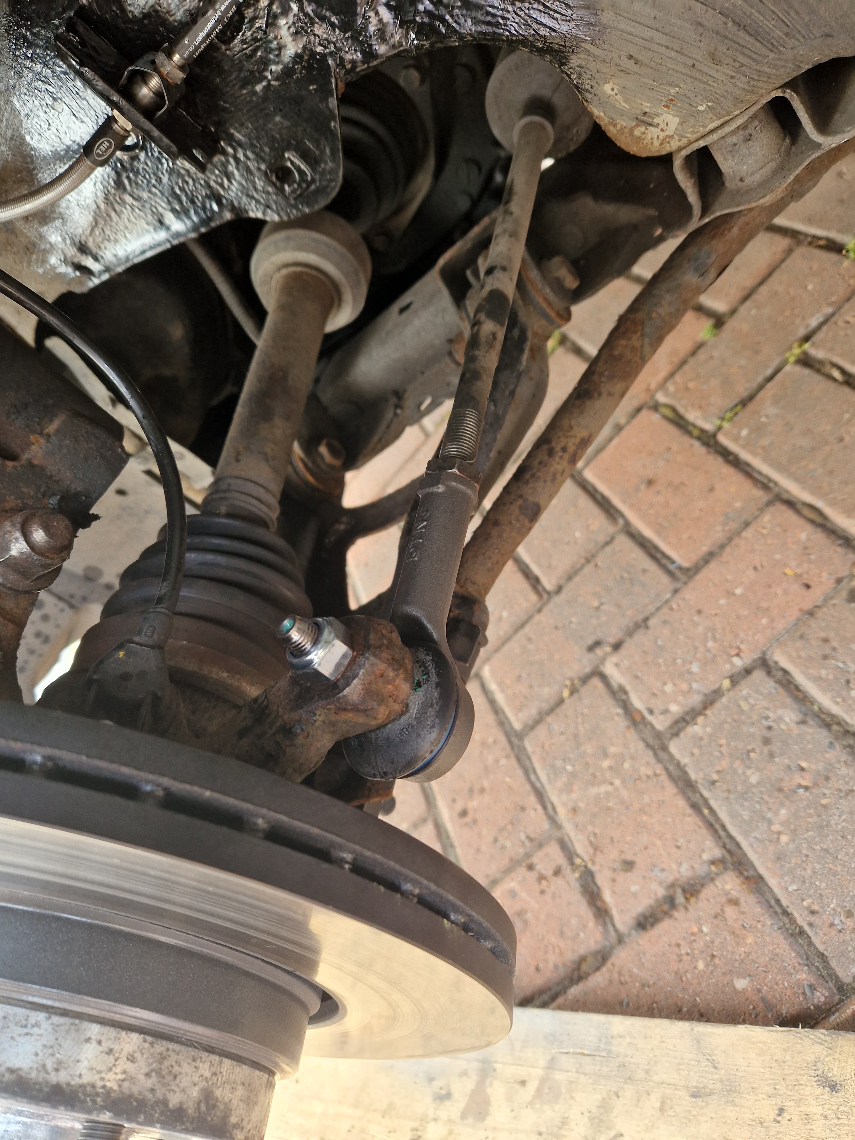

Next up was replacing the TREs as I was still chasing a knocking noise. Upon removal they were very notchy and definitely worn.
I measured all the distances with some vernier to try reduce the amount of alignment required. Obviously whilst there it's worth replacing the topmount bearings as it saves me having to pay for alignment twice if they fail in a few months time.
Genuine SKF bearings once more although the ones I removed were OK so will be added to the stock pile.

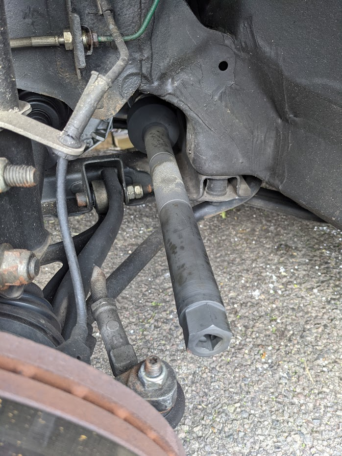

Louis if you don't already have one this tool is the shiz
I did my tie rods aaages ago and borrowed a tool from @leeds2592. They still feel fine but I do get through TREs and balljoints! It must be the s**t UK roads.
Finished up today bleeding the brembos. I think I may have been too premature on removing the stainless nipples as after bleeding fluid seemed to wick up through the threads for ages! 3 wipes later and it's finally stopped coming up so @Brigsy was most likely right on it being excess fluid. They bled up easy with the vizibleed, haven't felt the need to use the gunson.
What I did notice is that the osf braided line had been caught by the tyre at some point and gone through the clear shroud. I redid the connection and I think its far enough away now to cause no problems. I'll check it again next week!
Frustratingly one of the topmount threads will not torque to 33nm and is definitely on the verge of killing all the threads. The other 2 are solid enough so I'll rely on those for now. Helicoil job for next time!
Cleaned up the boots removing the motamec stickers as they'd all but come off and sprayed the b14s with acf50.
