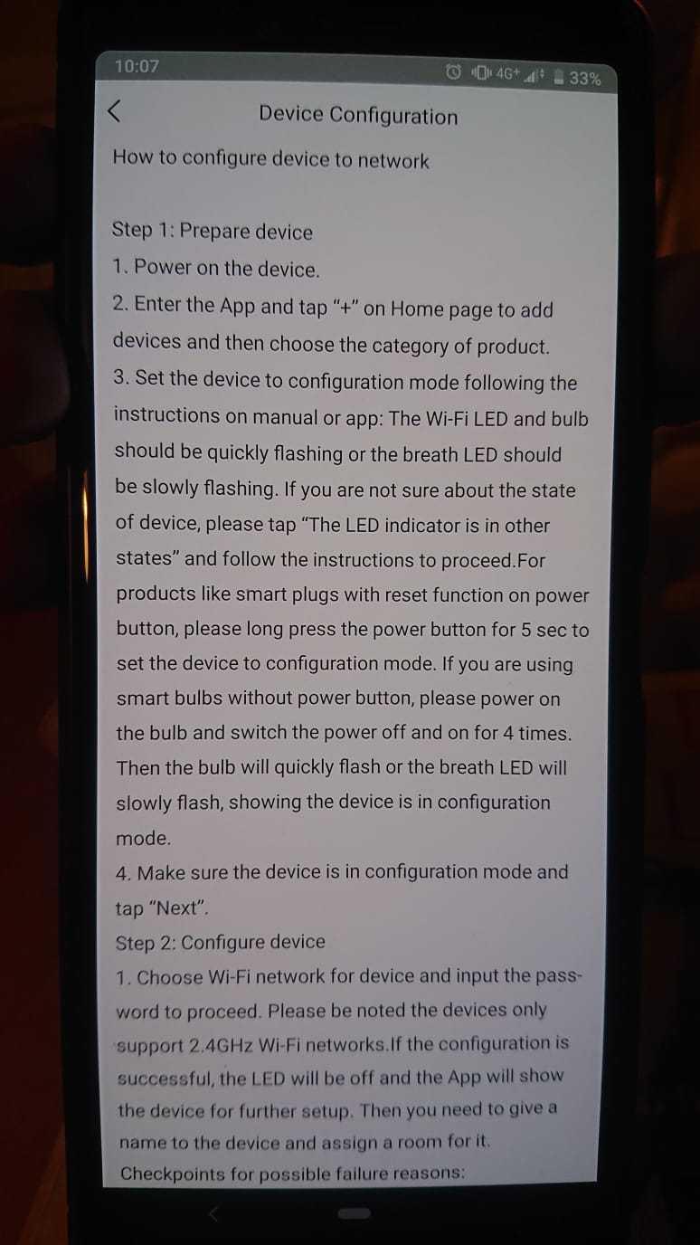

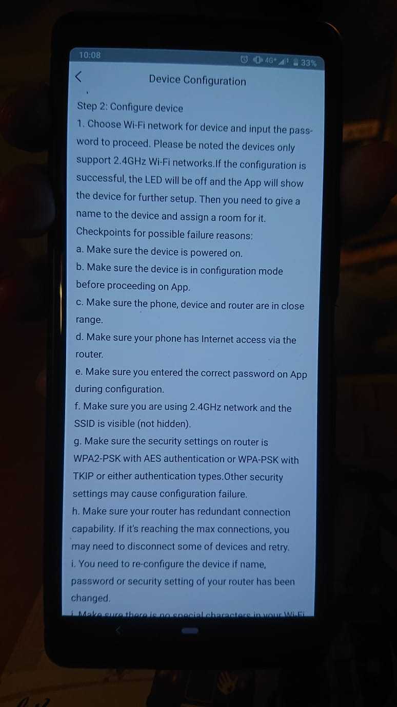

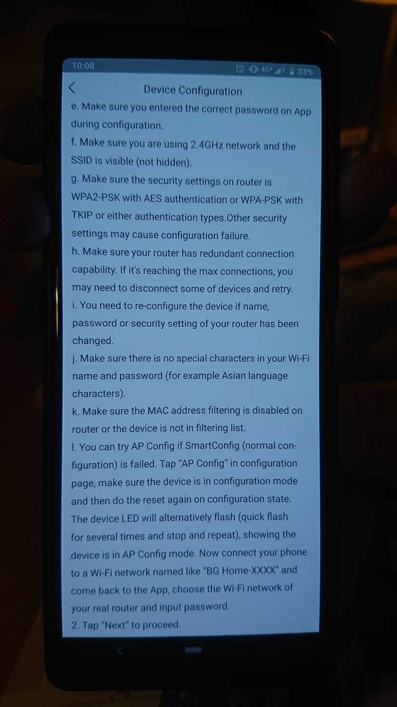

I purchased one of the above from screwfix, its not till you open the box and start reading the instruction your realise its not that advanced!! it only works with 2.4 not 5.
ive got a BT HH5, so ive split the signal into 2.4g and 5g but it will wont connect. anyone got any suggestions
Not this exact plug but had the same issue with my virgin router. I moved it to 2.4ghz completely to set the plug up and then moved it back to 5ghz and it works flawlessly. I had loads of trouble setting it up initially until I did that. So maybe don’t split it, change it completely then swap it back.
yes this worked, turned 5ghz off and it connected. I set up the timers.
